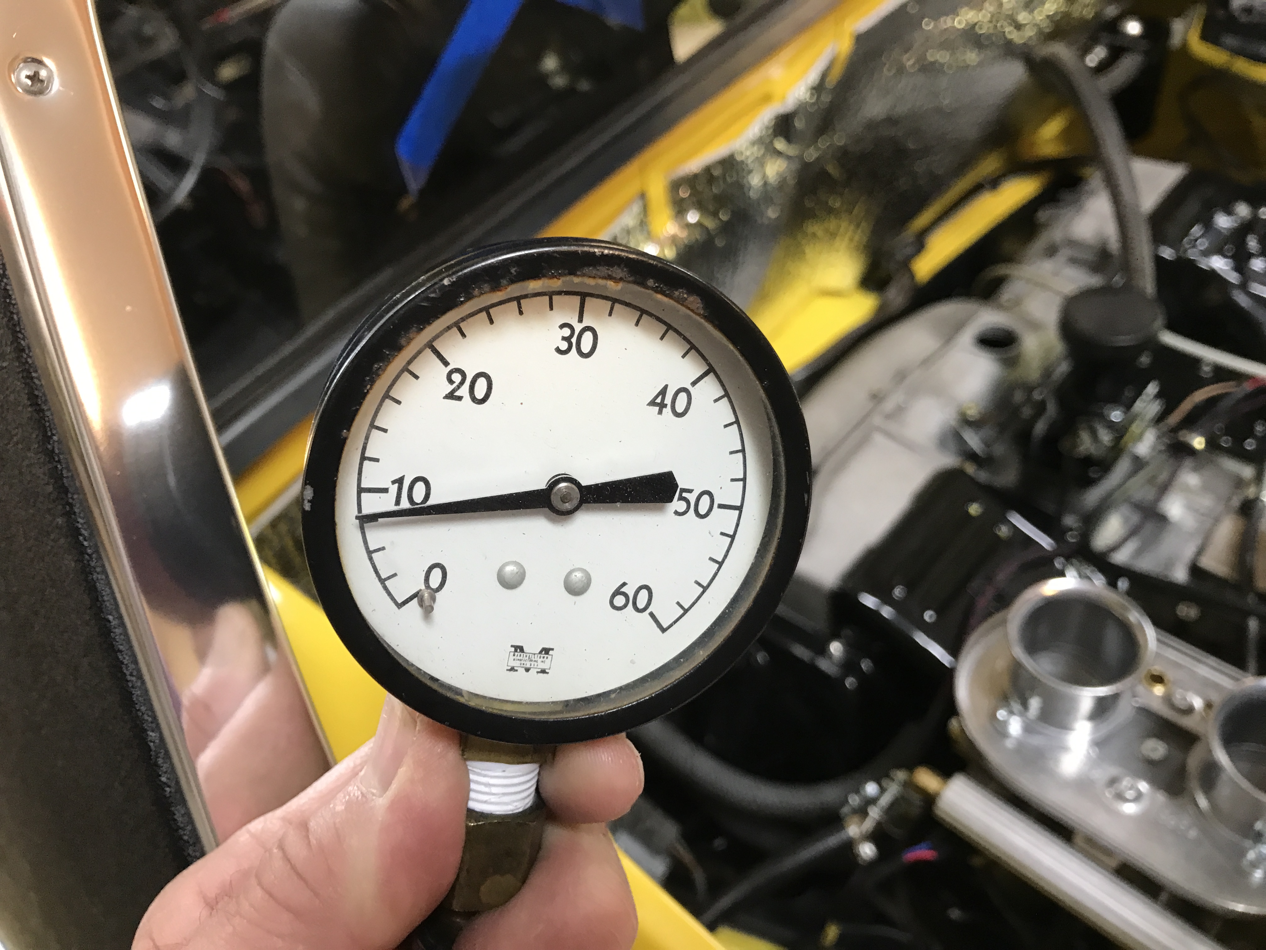

I had a bit of garage time today. First, I checked the fuel line pressure. It shows 8 psi after 48 hours, so I take that as a good sign of integrity.

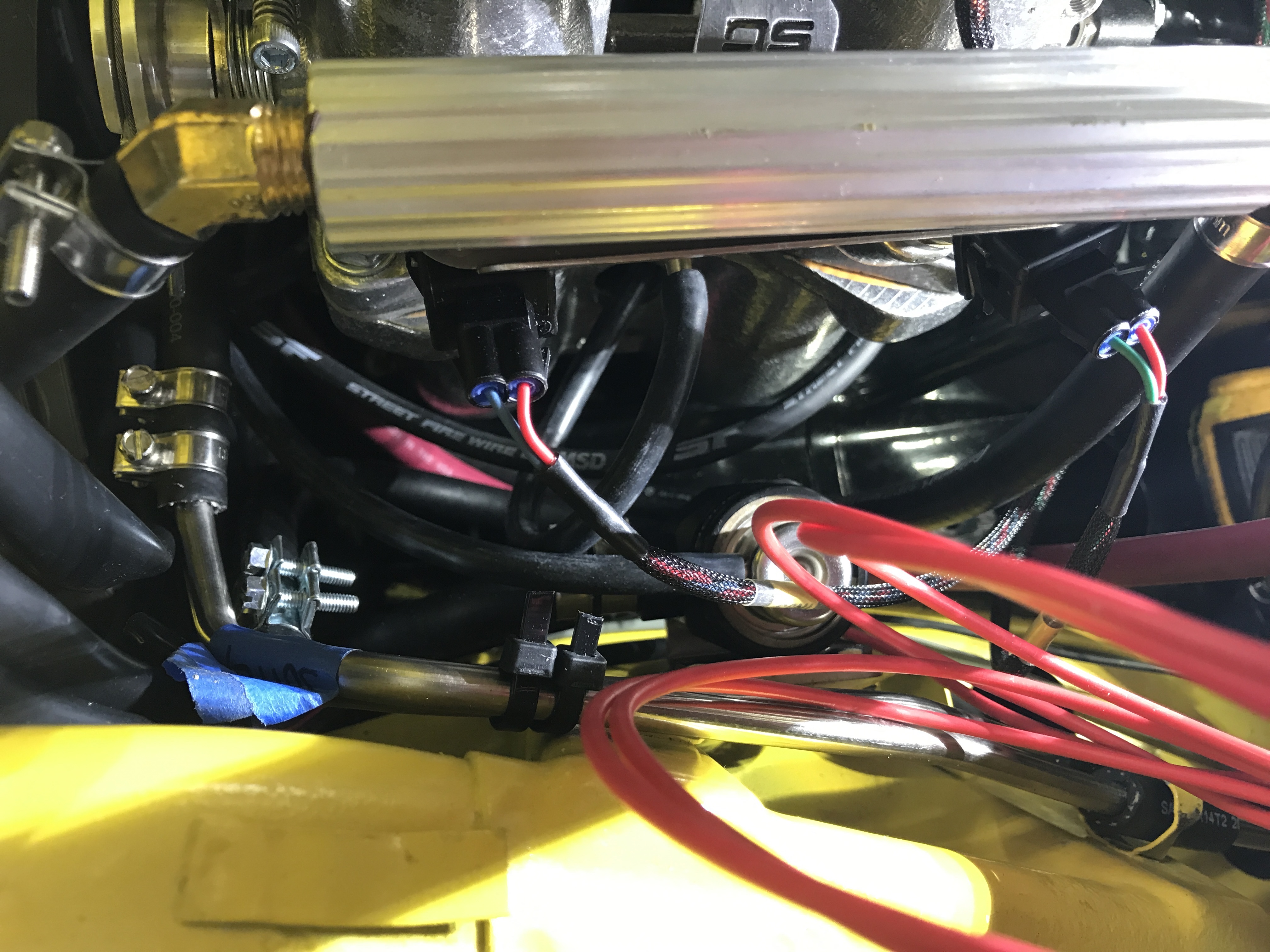

I agree--not many places for leaks:
mating surfaces of intakes and cylinder heads (installed with gaskets and sealant)
mating surfaces of throttle bodies and intakes (also installed with gaskets and sealant)
throttle body vacuum ports or lines
I started by getting a wrench on the nuts for the intakes, and tightened them just a bit more.
Then I did the same for the nuts holding on the throttle bodies.
I checked the new vacuum lines, and all connections (throttle body ports to a T, T to a Y, Y to the fuel pressure regulator and to the ECU) look tight.

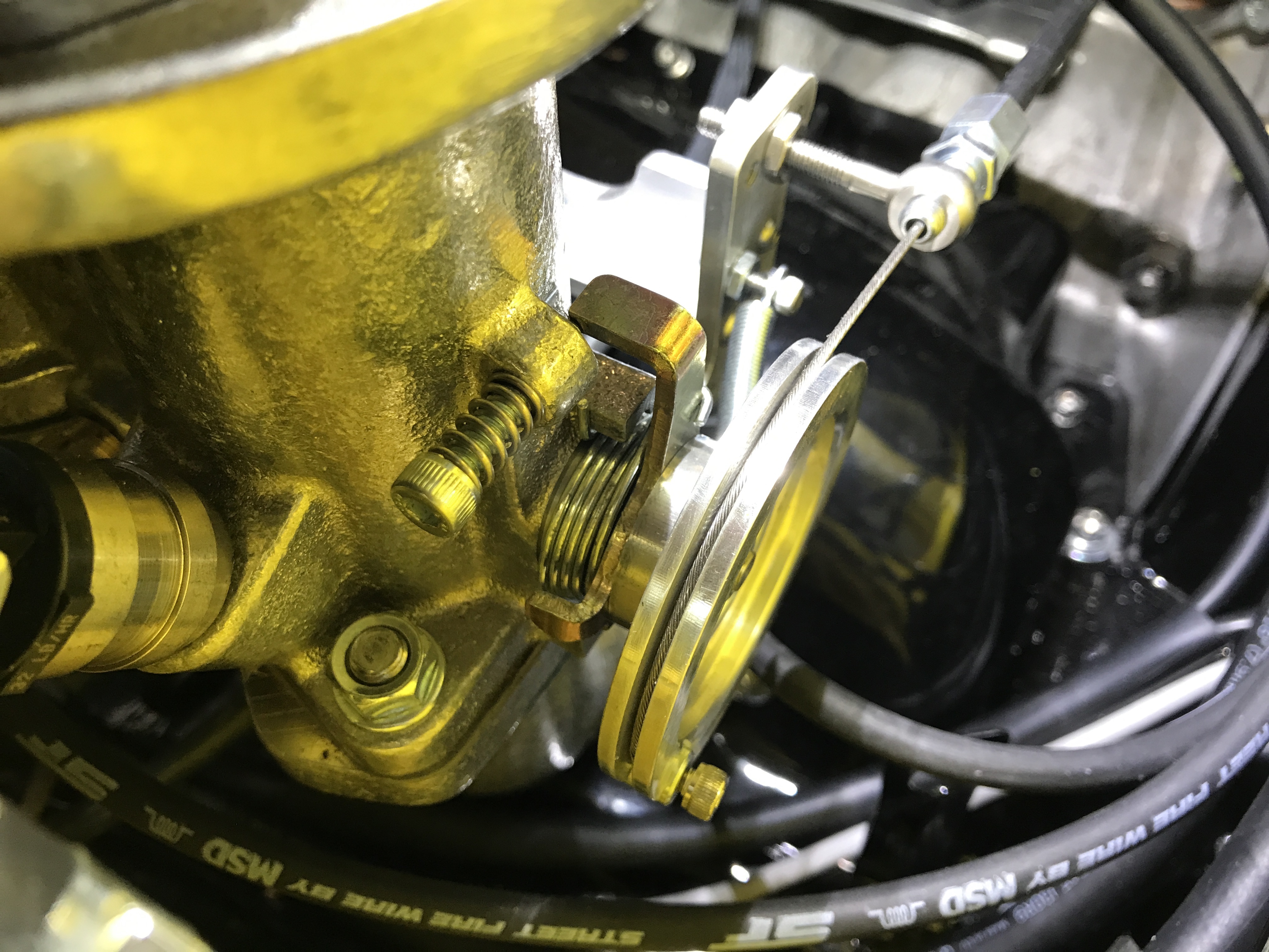

I then backed off the throttle stop screws pretty much all the way. I had them screwed in enough so the throttle plates were visibly open.

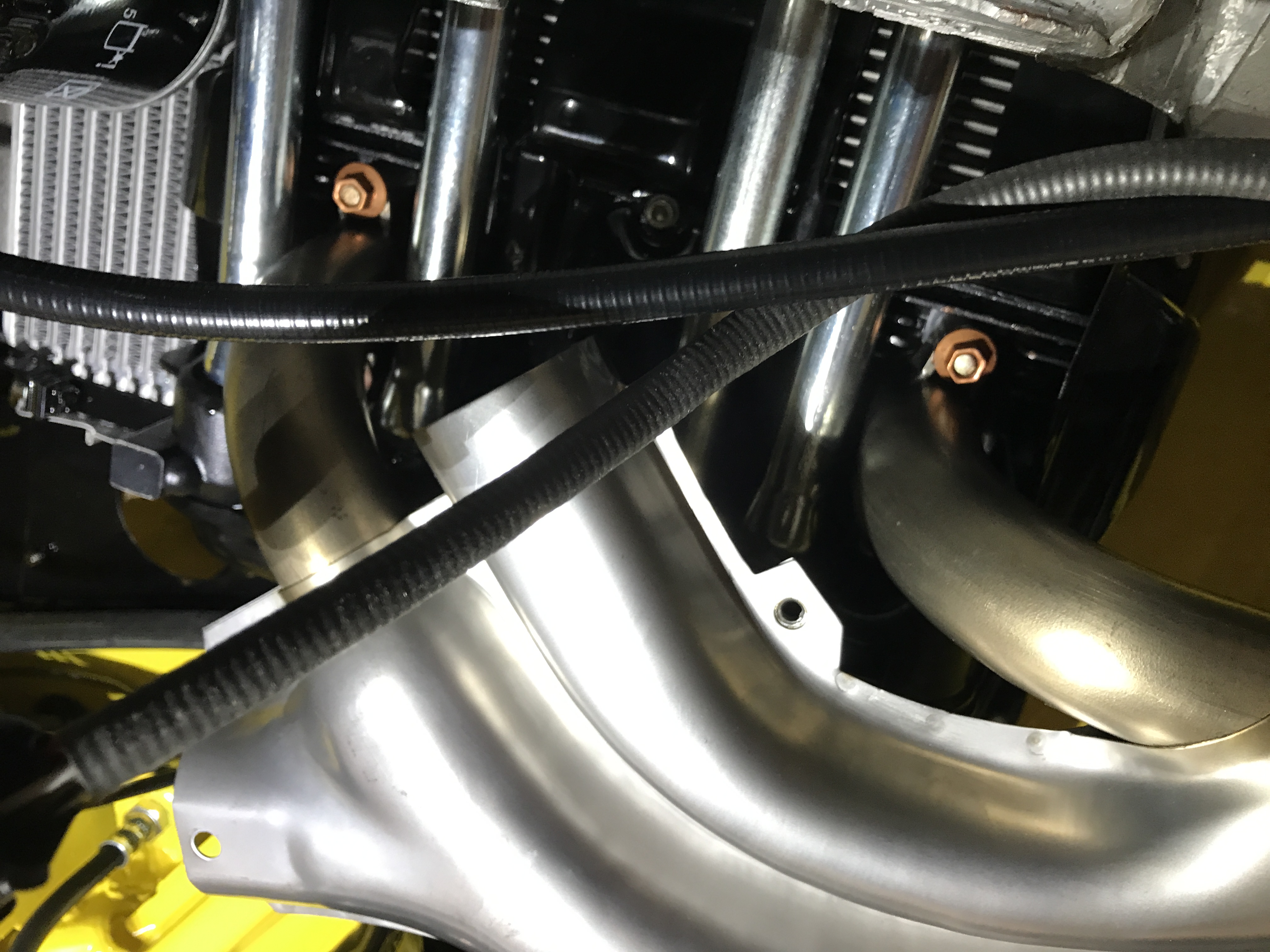

Then I went underneath and tightened up the exhaust port nuts.

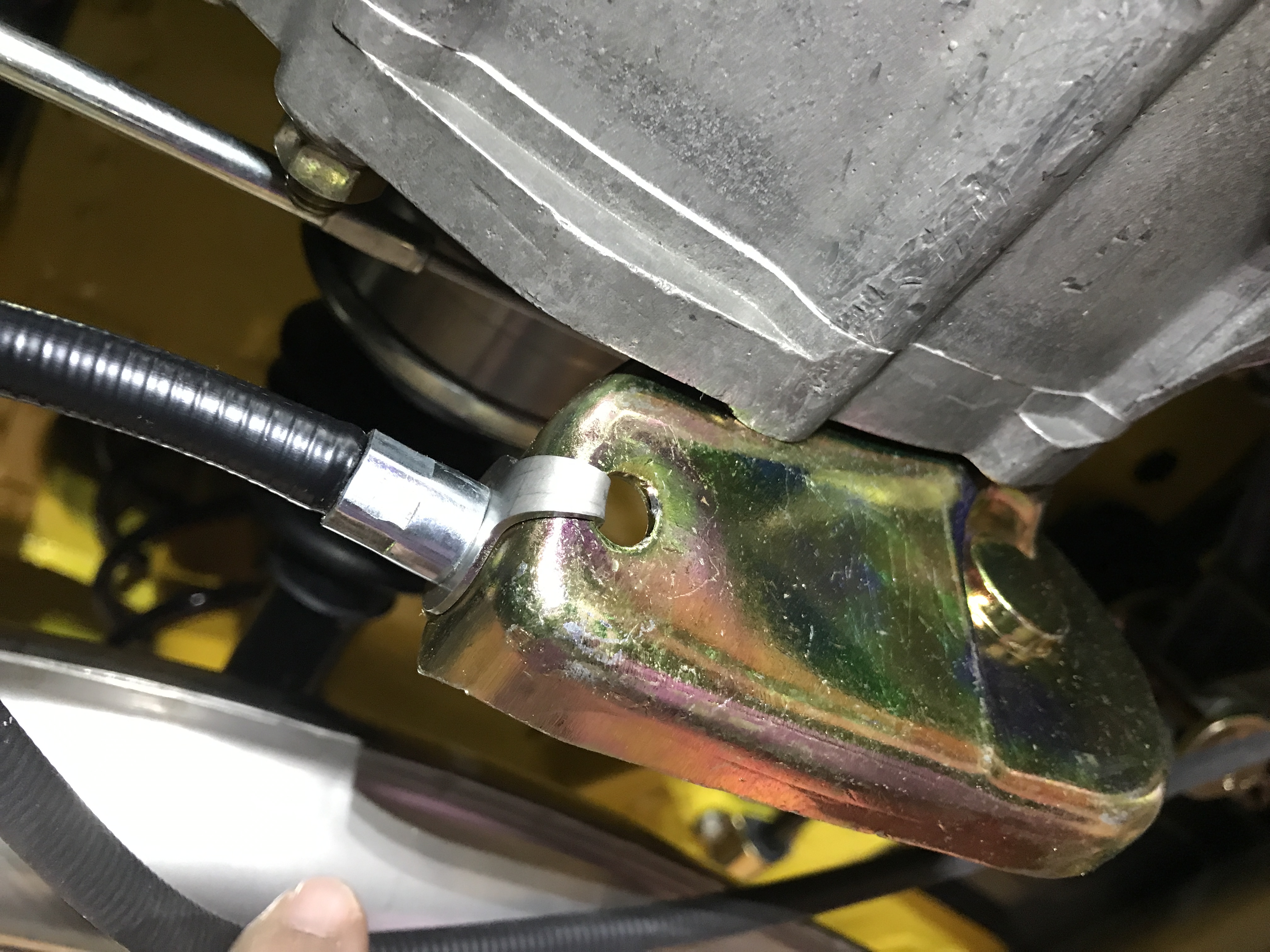

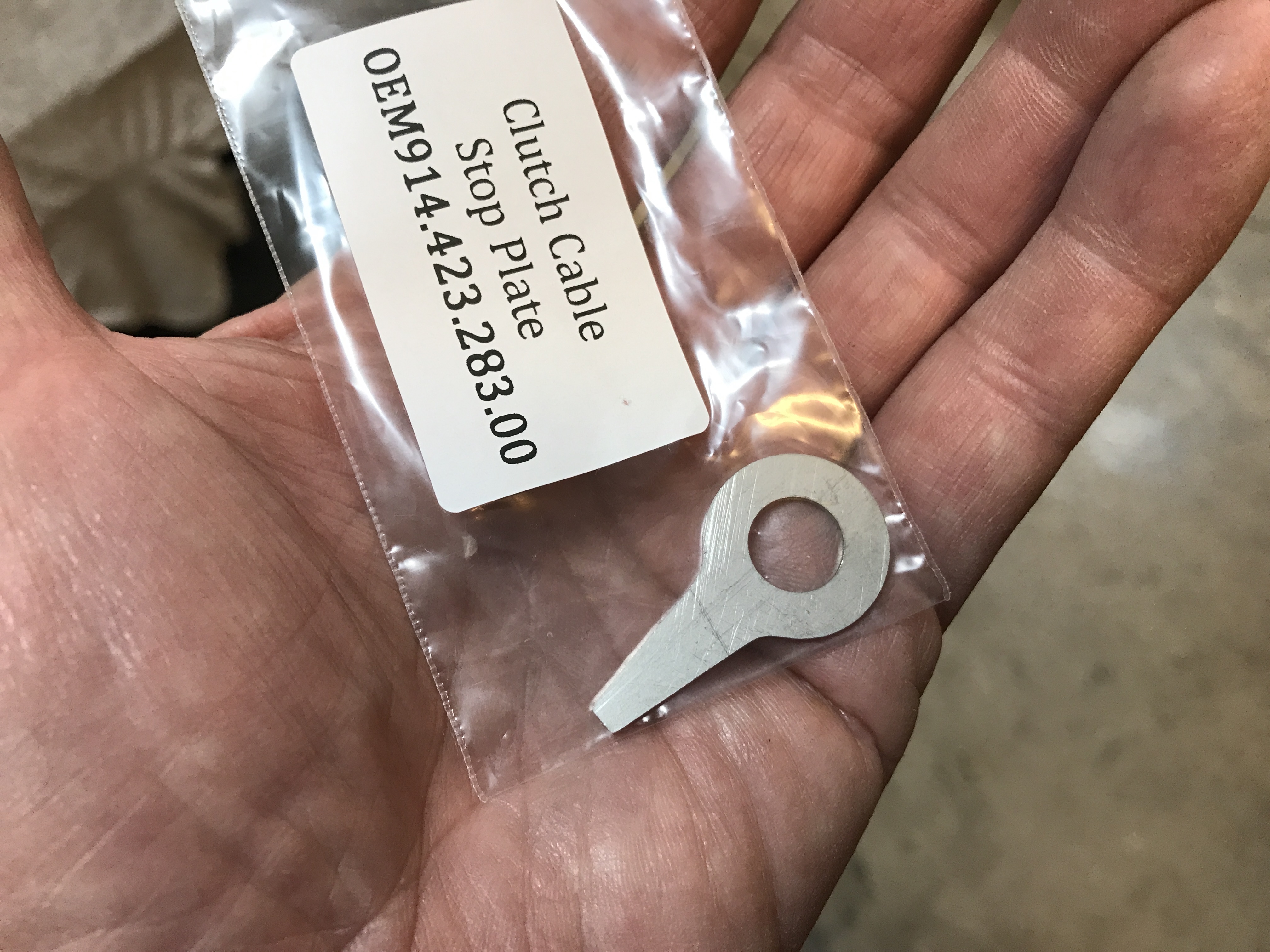

While I was underneath, I got out the clutch cable retainer clip that arrived yesterday.
bkrantz
post Dec 31 2021, 08:16 PM
Post #4557
Posts: 8,530
Joined: 3-August 19
From: SW Colorado
Member No.: 23,343
Clip installed.

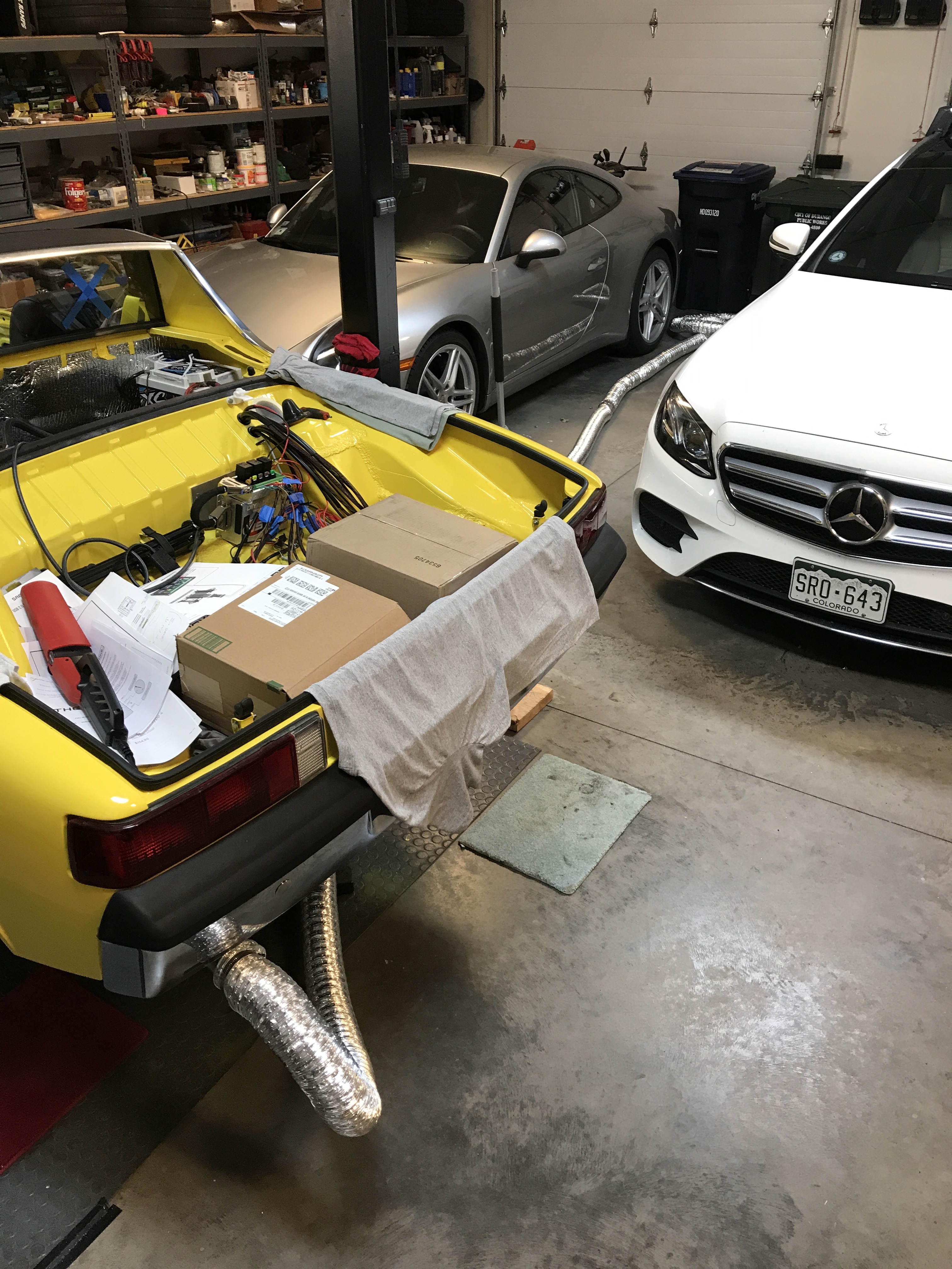

Last, I rebuilt my exhaust pipe-line, with more solid aluminum sections. The previous version had plastic foil after the first 8 ft, and was starting to melt through.
Too late today for another start-up, maybe next year.
