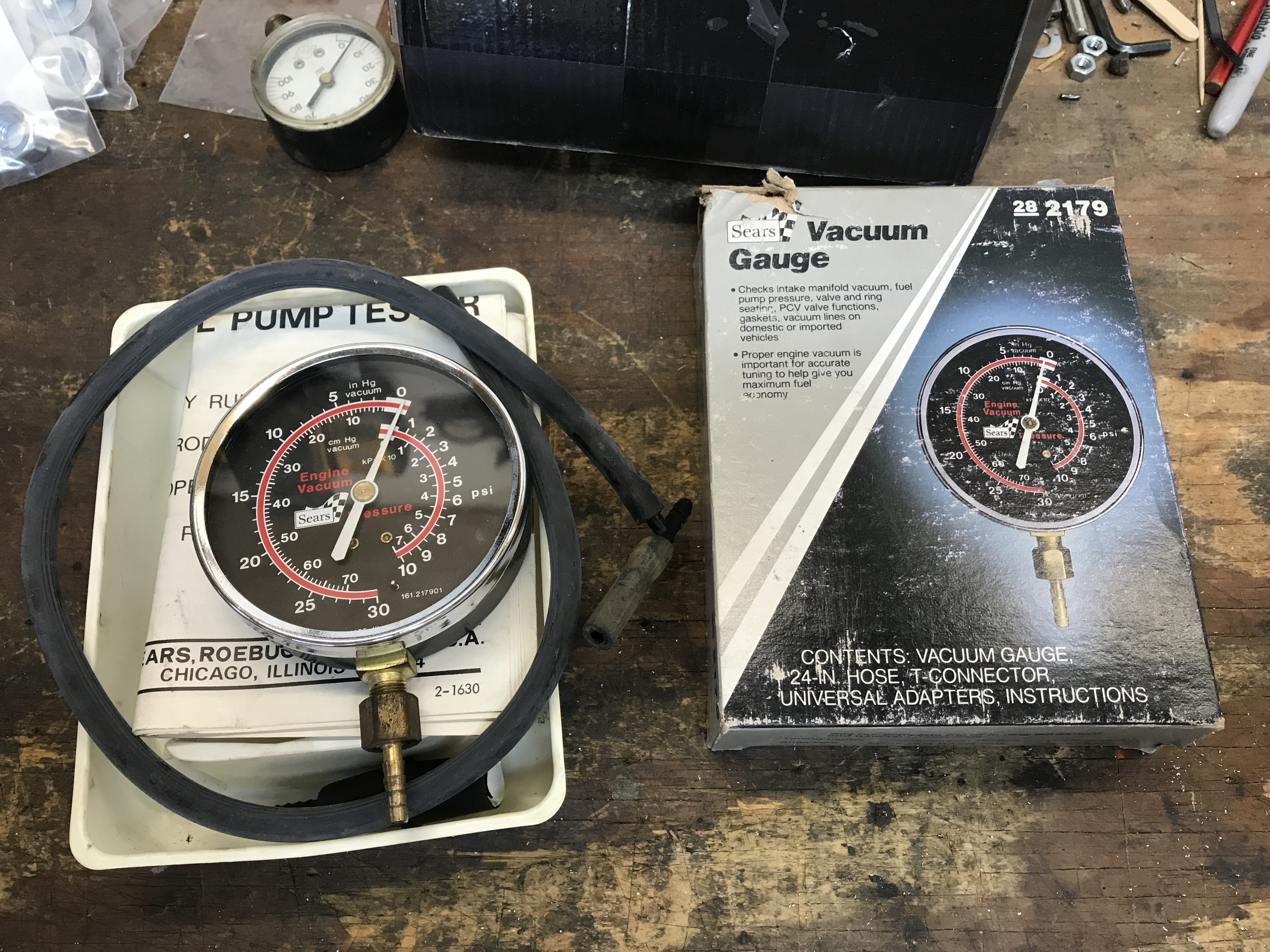

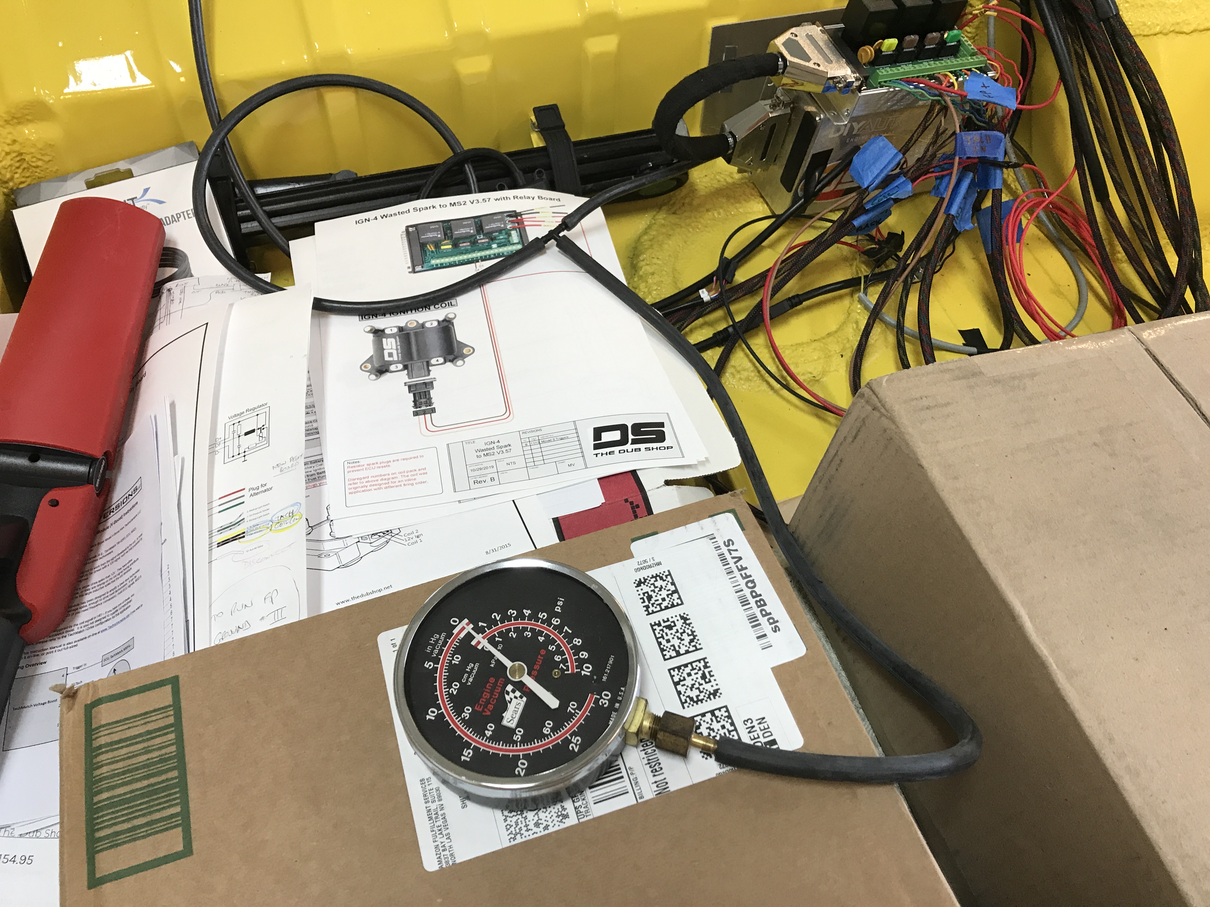

Just to tease you a bit, before I tried starting I got out my old vacuum gauge. This is another Sears/Craftsman auto tool. Most of these date from my early days of playing mechanic, in the 70s, 80s, and 90s.

I T-ed this into the vacuum line to the Megasquirt ECU.
OK, now we are ready to try starting again.

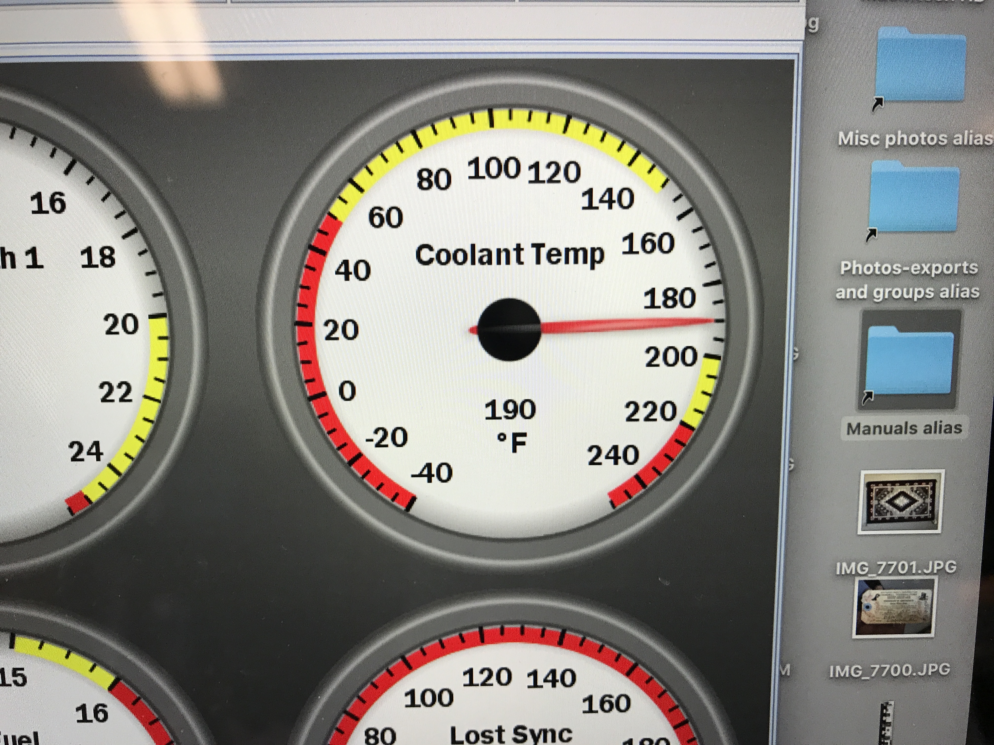

What else did I learn today? The cylinder head temp peaked at just under 200F after 15 minutes, with the air temp in the garage (with the doors open) about 35F.

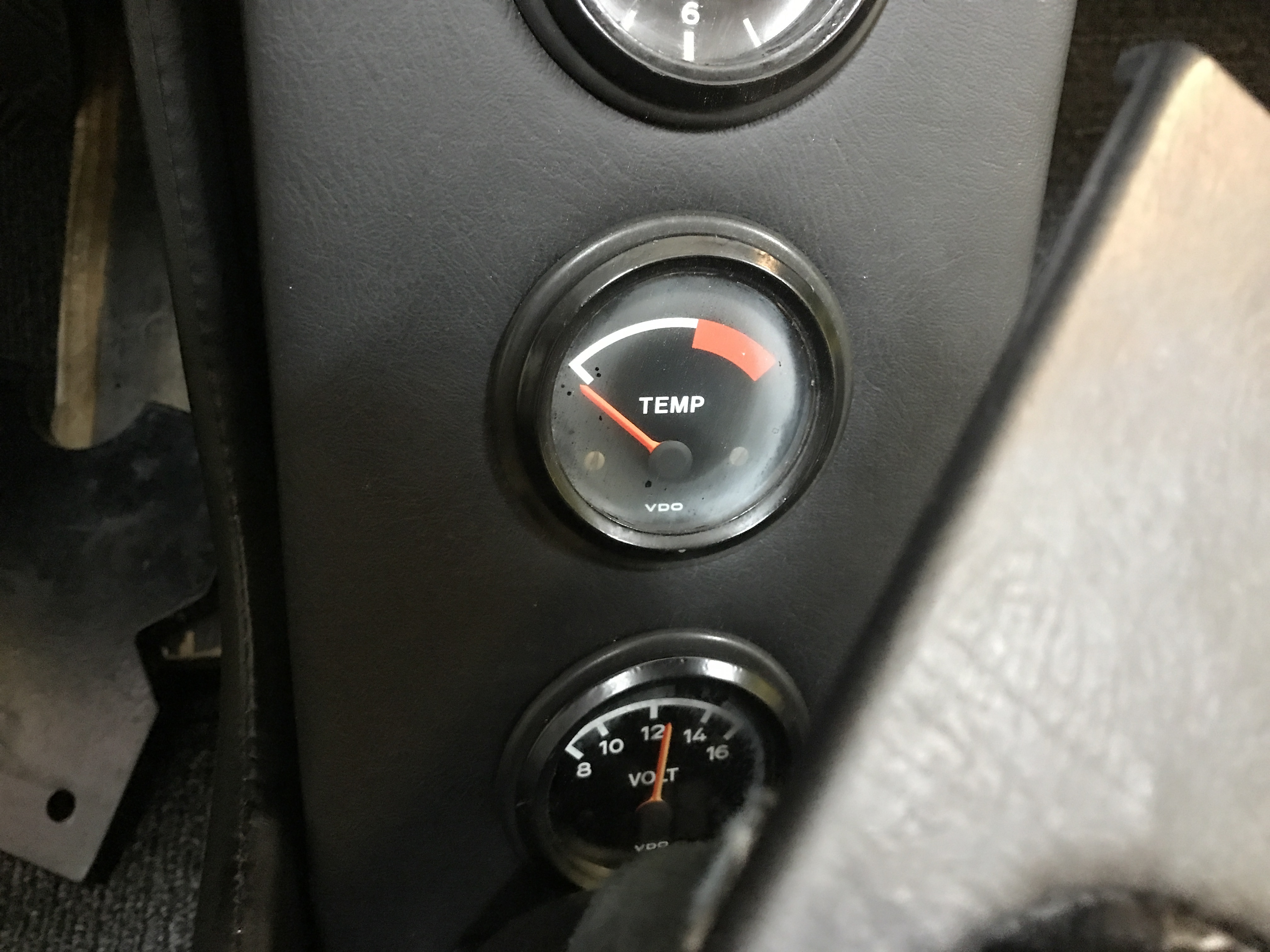

But the stock oil temp gauge did not move.
bkrantz
post Jan 1 2022, 09:14 PM
Post #4567
Posts: 8,530
Joined: 3-August 19
From: SW Colorado
Member No.: 23,343

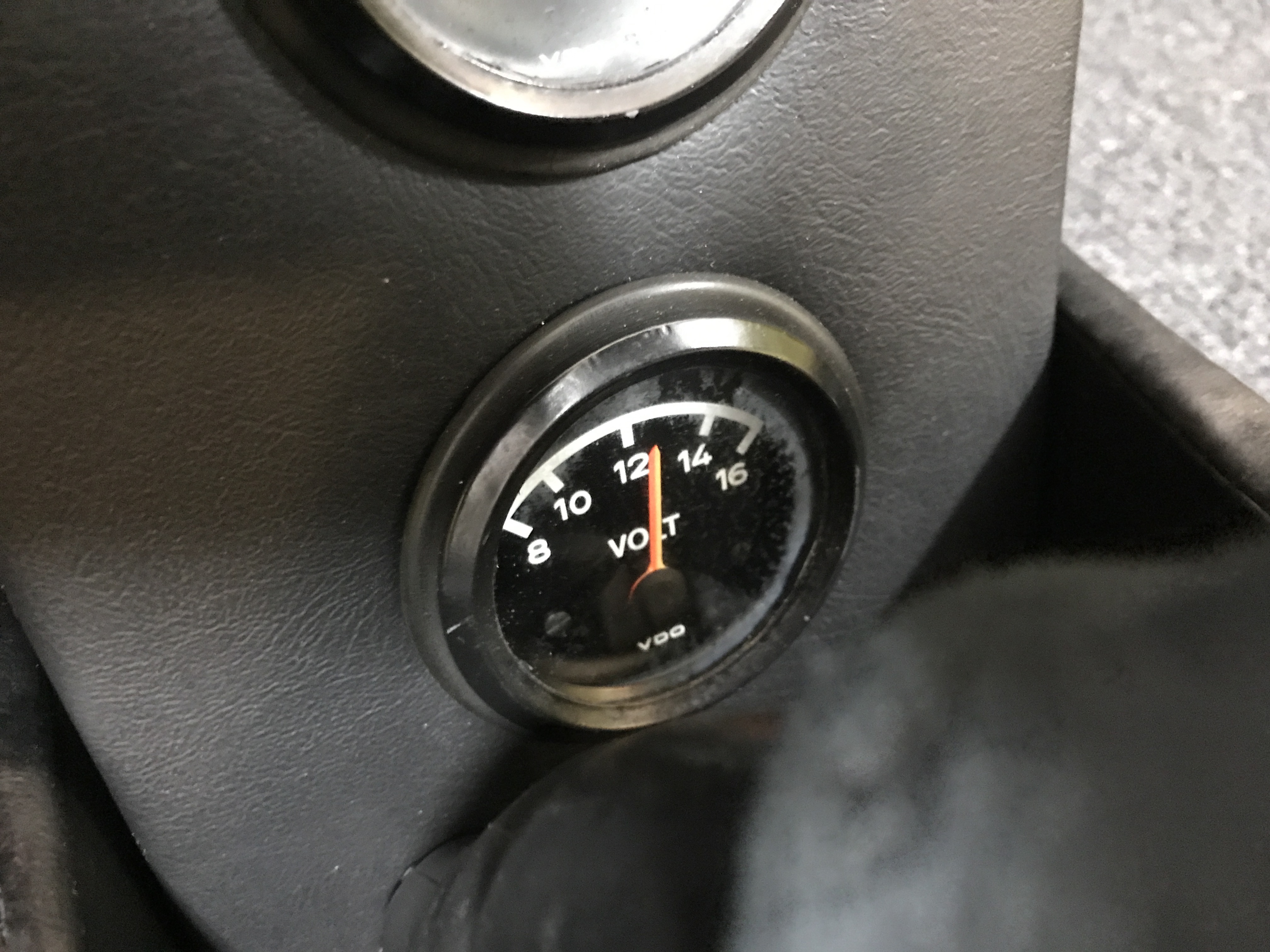

At least the voltmeter showed some volts.

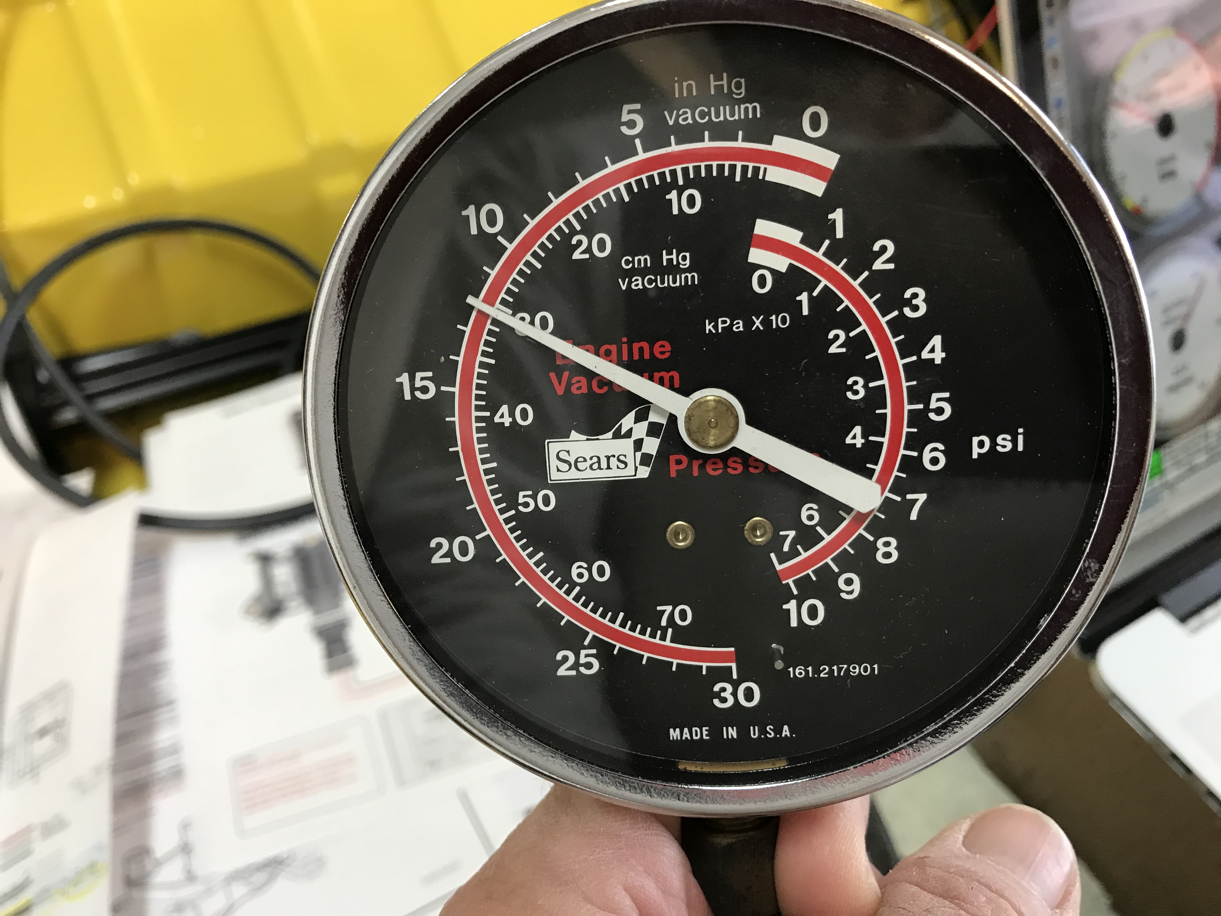

And the vacuum gauge showed some vacuum. (and very steady)

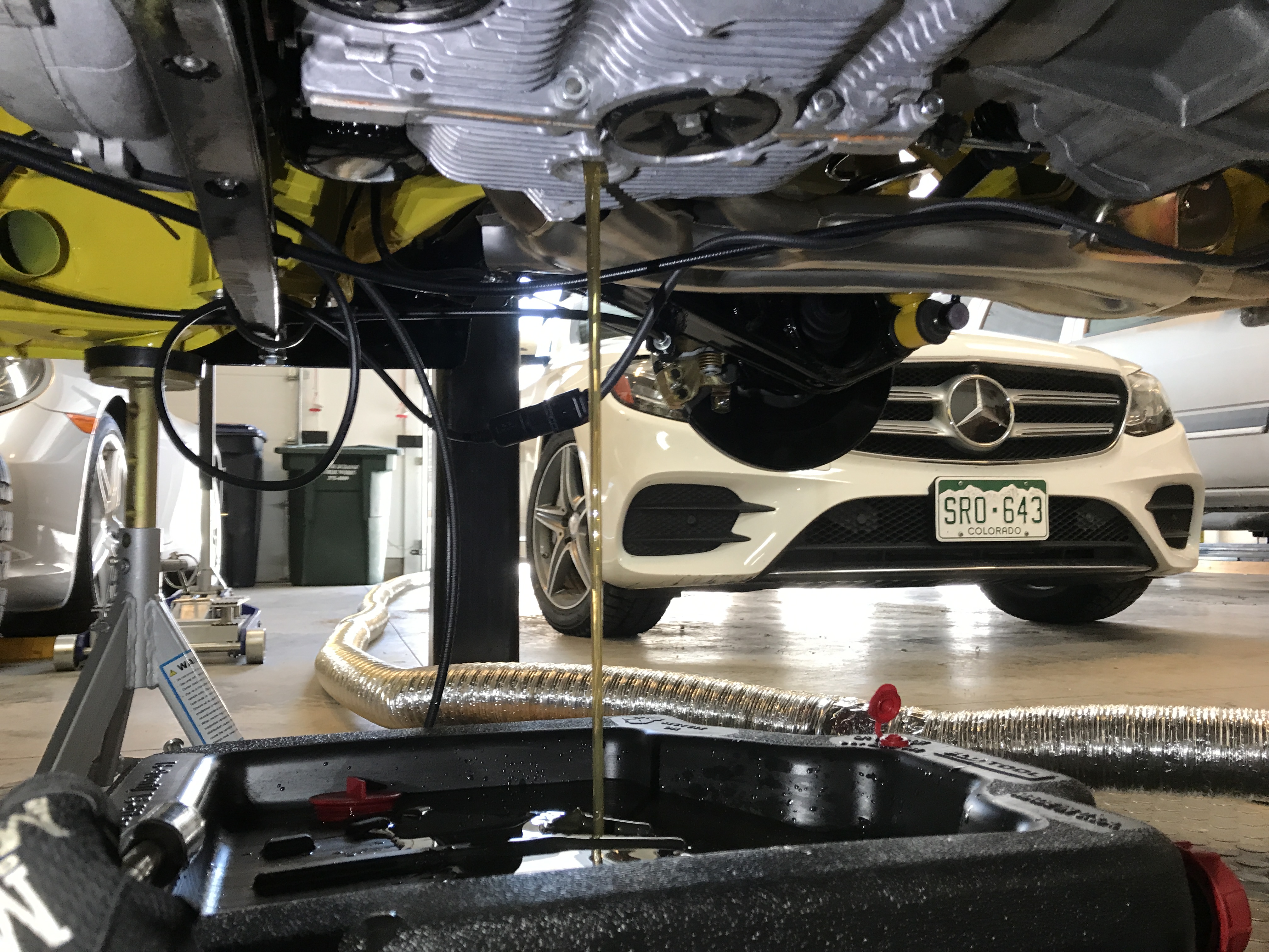

And while the engine was hot, I drained the first batch of oil. I will change the filter and refill with SAE 30 and another dose of Lucas break-in additive.

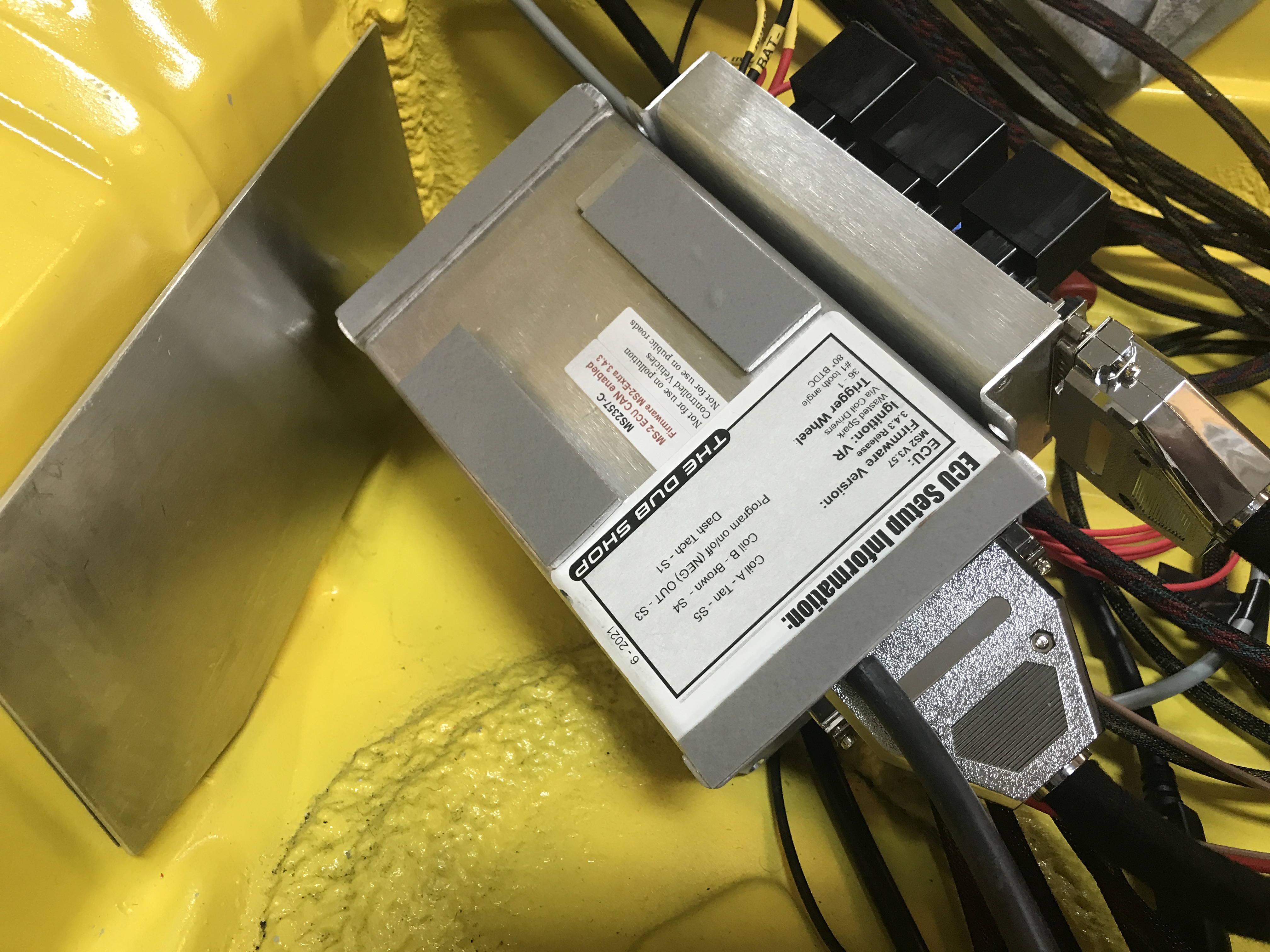

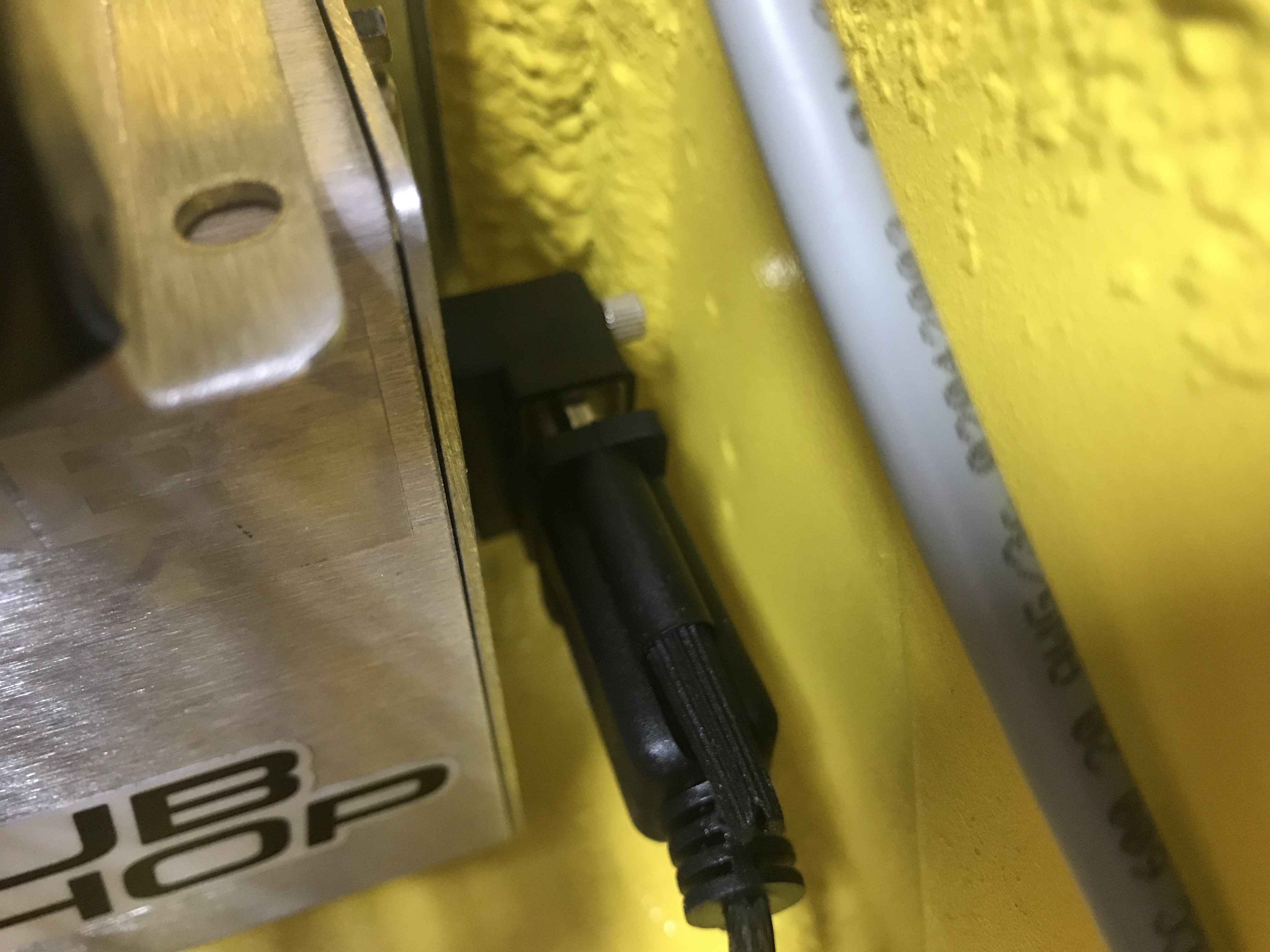

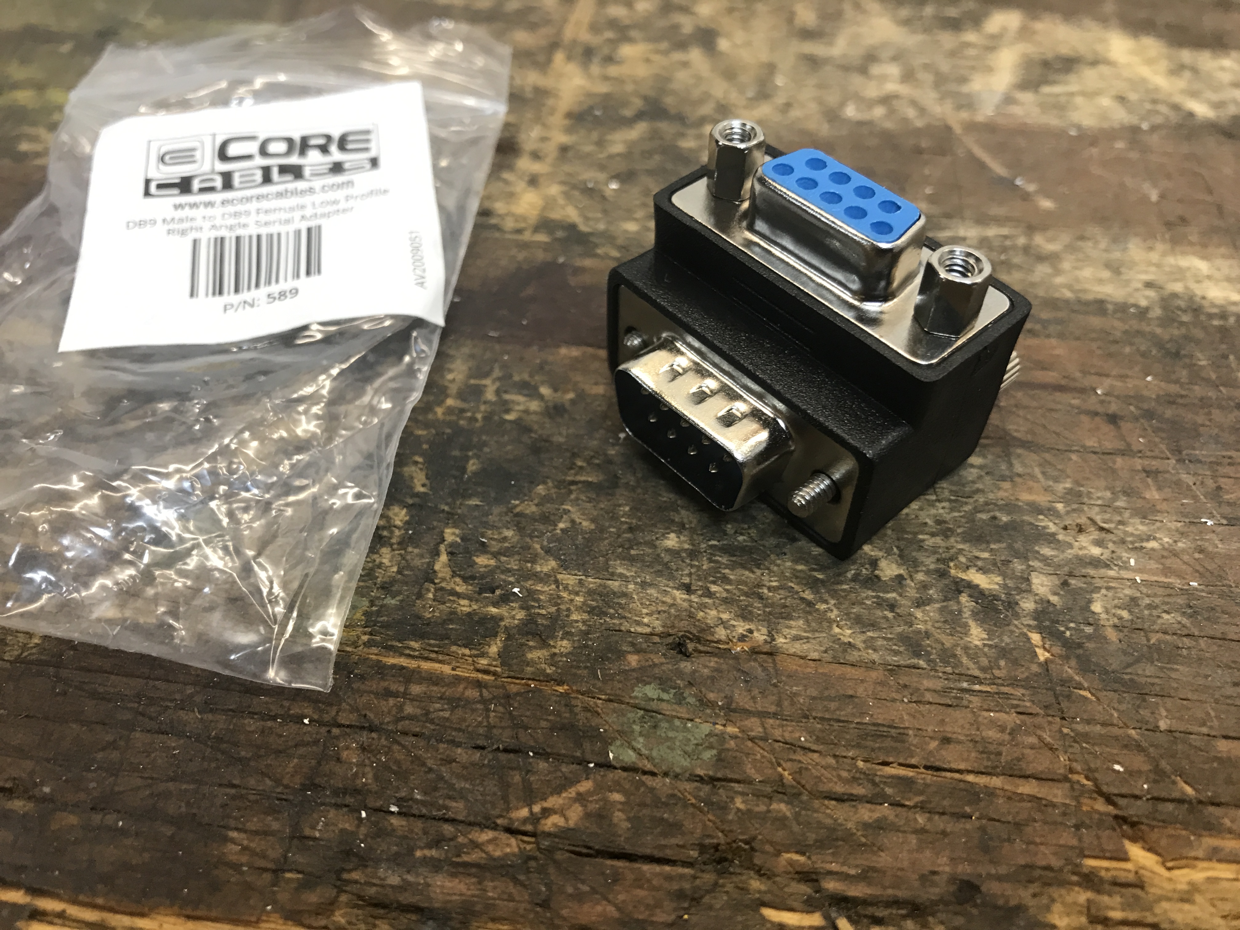

I finally got the correct right-angle serial plug adapter. It took 3 tries, since the variations are male/female and "left"/"right". So now I can mount the Megasquirt ECU for real.
bkrantz
post Jan 2 2022, 08:16 PM
Post #4577
Posts: 8,530
Joined: 3-August 19
From: SW Colorado
Member No.: 23,343

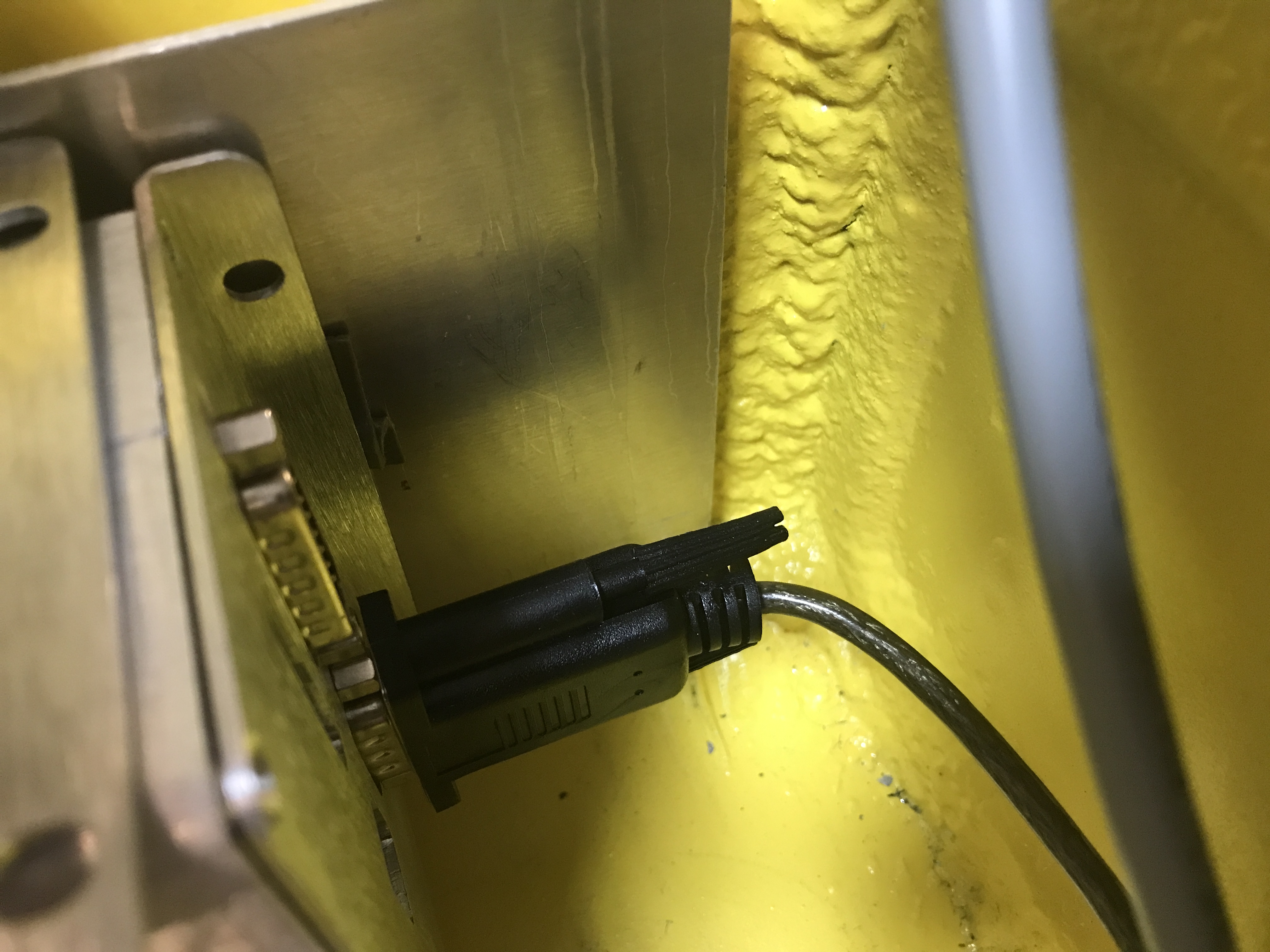

Here's why I wanted the adapter. The serial connector for the laptop lead sticks out, and keeps the ECU box too far to the left.
bkrantz
post Jan 2 2022, 08:17 PM
Post #4578
Posts: 8,530
Joined: 3-August 19
From: SW Colorado
Member No.: 23,343
With the adapter, the box can move an inch to the right, and I can still attach the cable.
bkrantz
post Jan 2 2022, 08:19 PM
Post #4579
Posts: 8,530
Joined: 3-August 19
From: SW Colorado
Member No.: 23,343
I got out my trusty 3M adhesive tape, and some spacers for the main panel since I wanted to increase the contact area.
bkrantz
post Jan 2 2022, 08:21 PM
Post #4580
Posts: 8,530
Joined: 3-August 19
From: SW Colorado
Member No.: 23,343

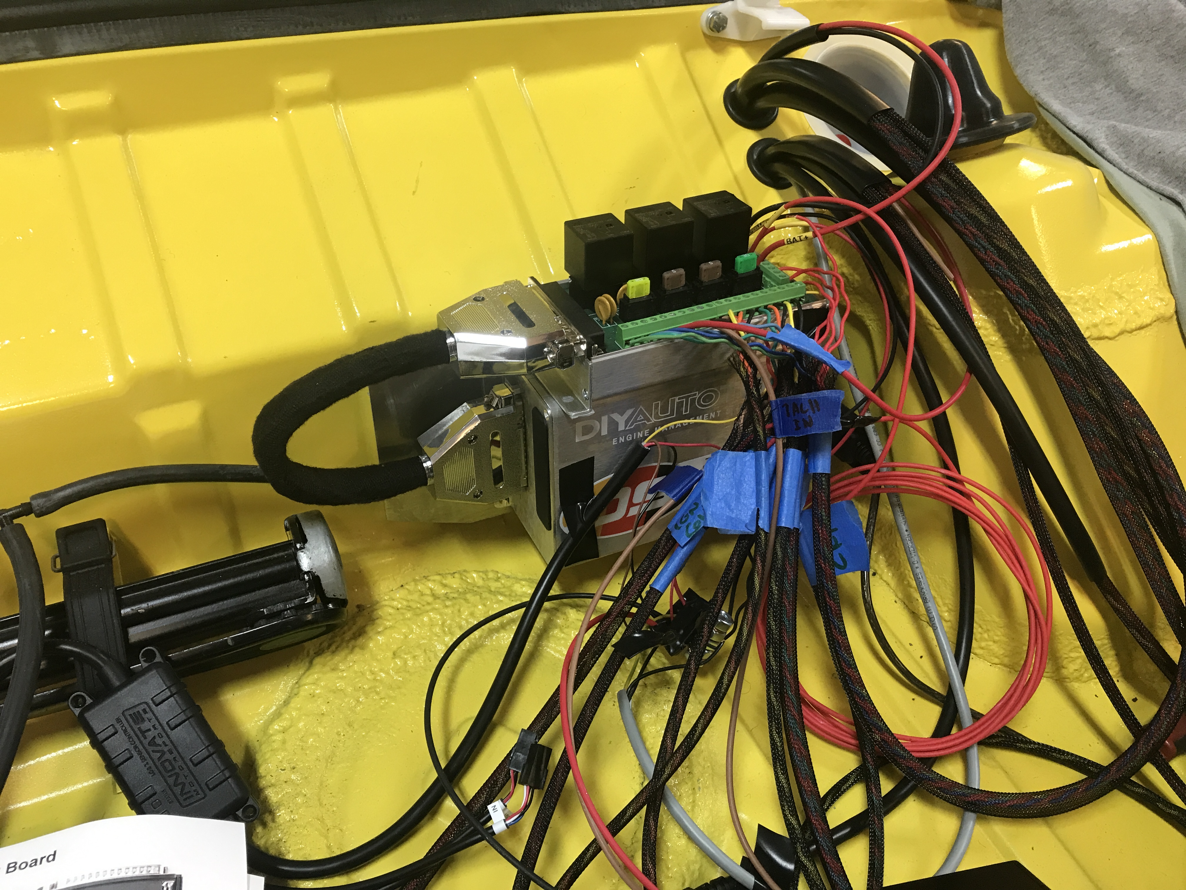

So I have the ECU and relay boxes mounted where I want them, at least for now. That means its time to start getting all the cables and wires tidy.
