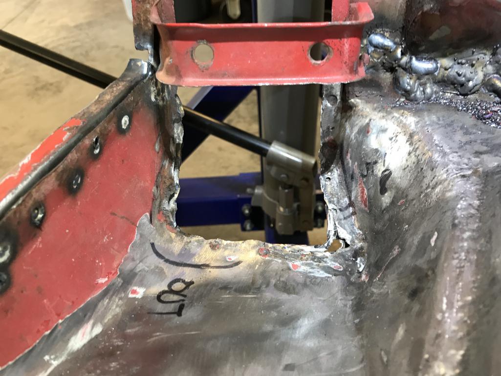

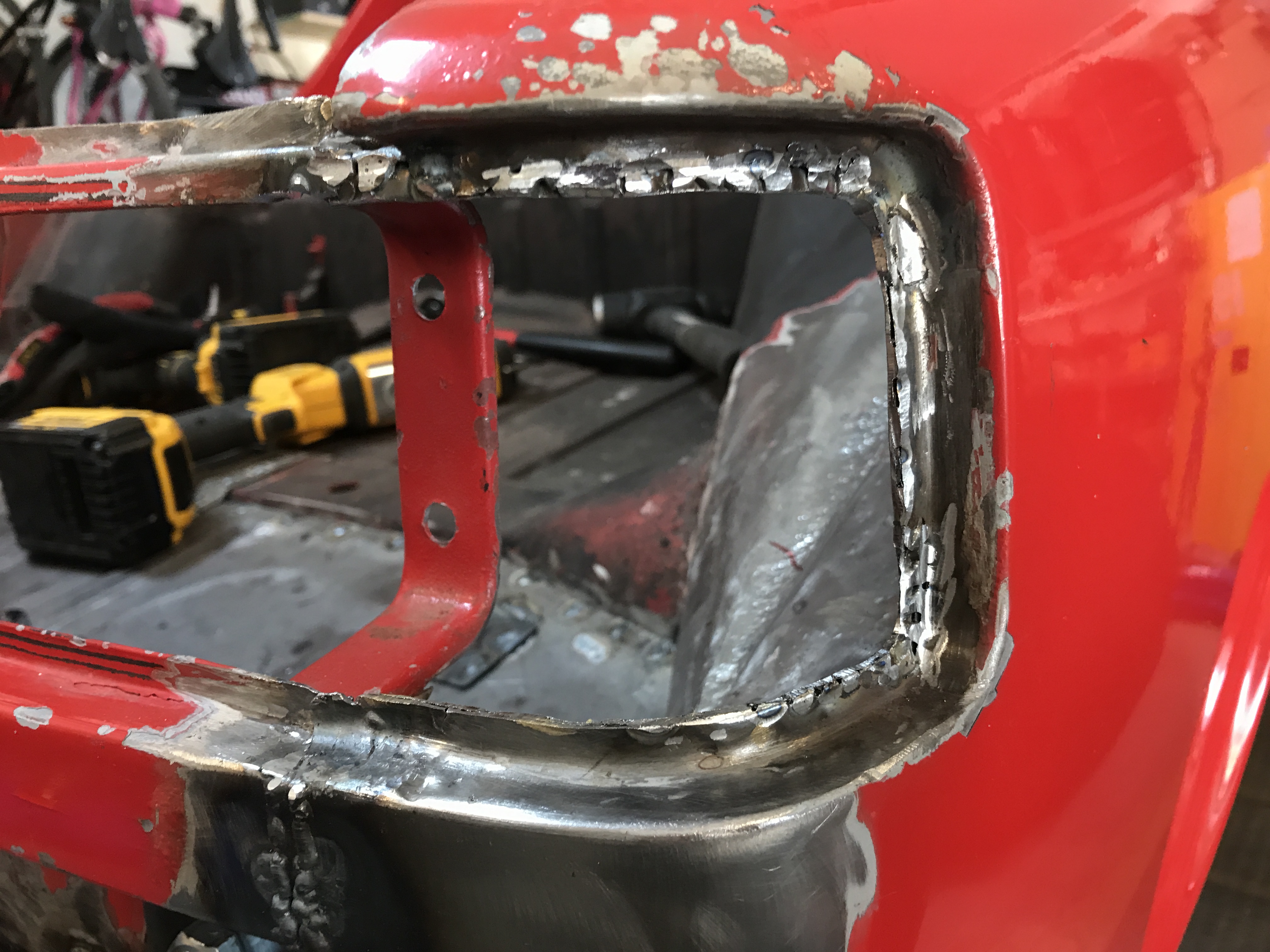

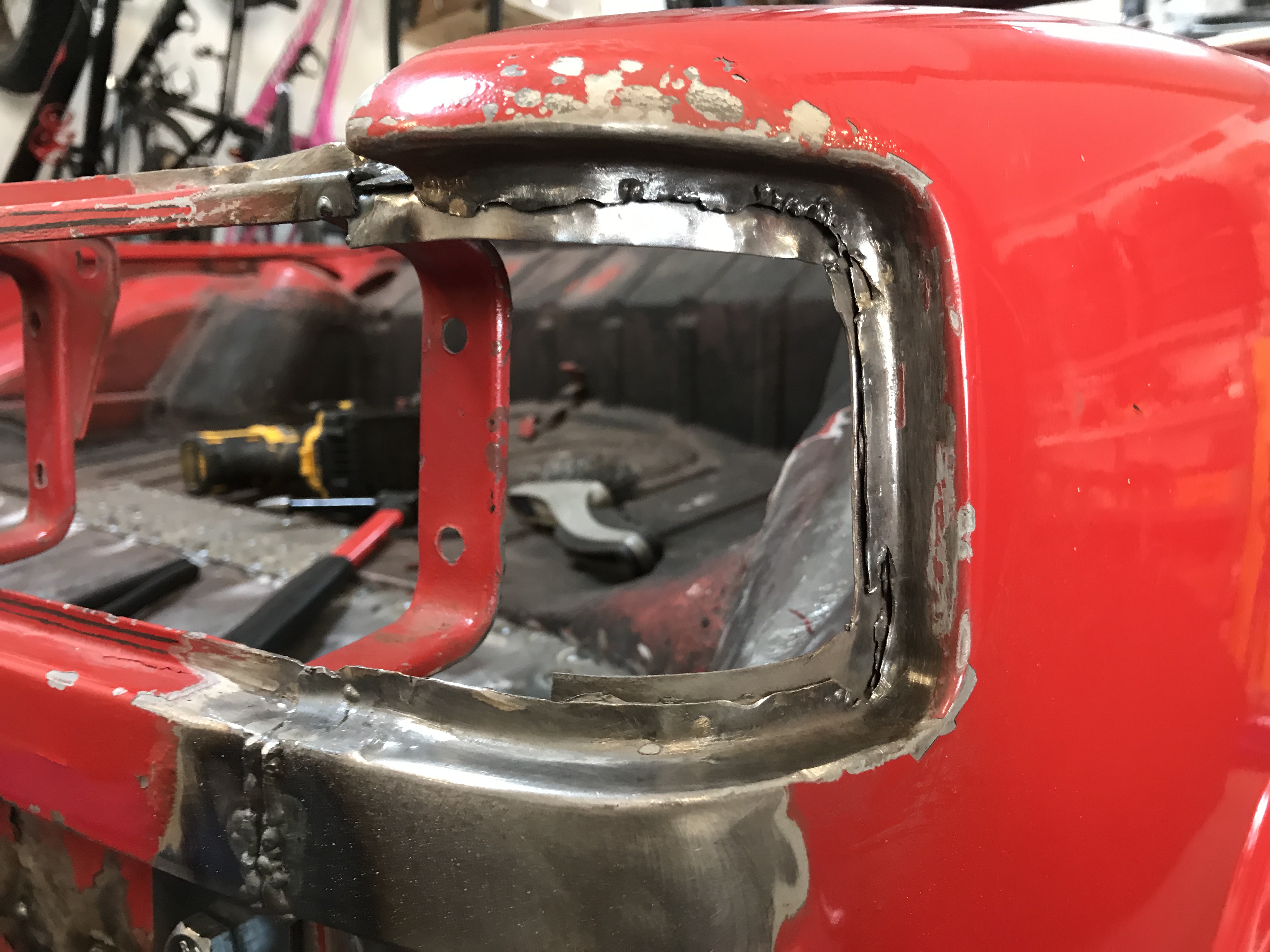

Today, I started on the right trunk corner, with bigger challenges than the left side. I have the same crude welding and gaps at the upper edge junction.

But a bigger issue is where the inner and outer fender panels meet around the tail light opening. The edges are pretty chewed up.

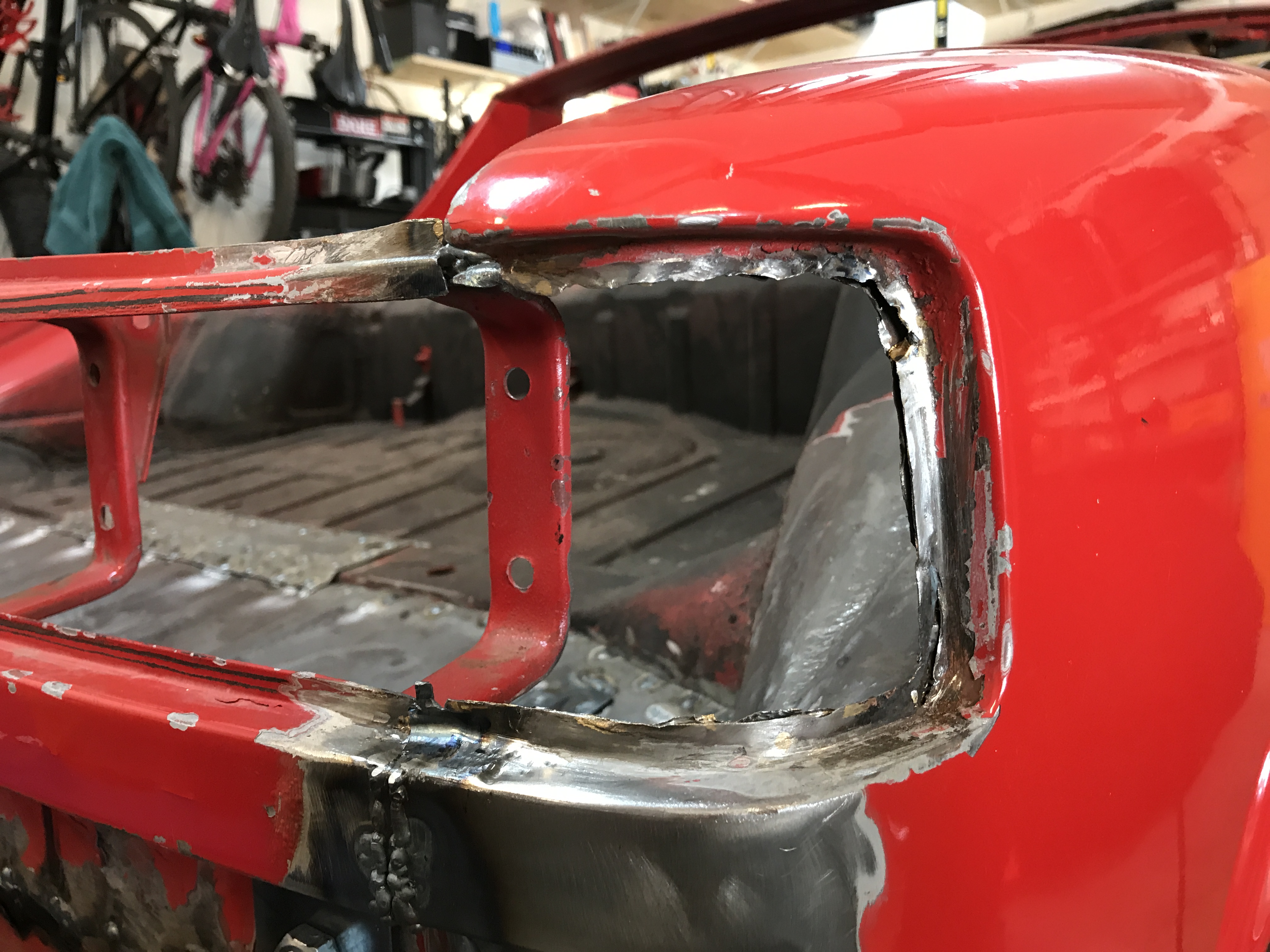

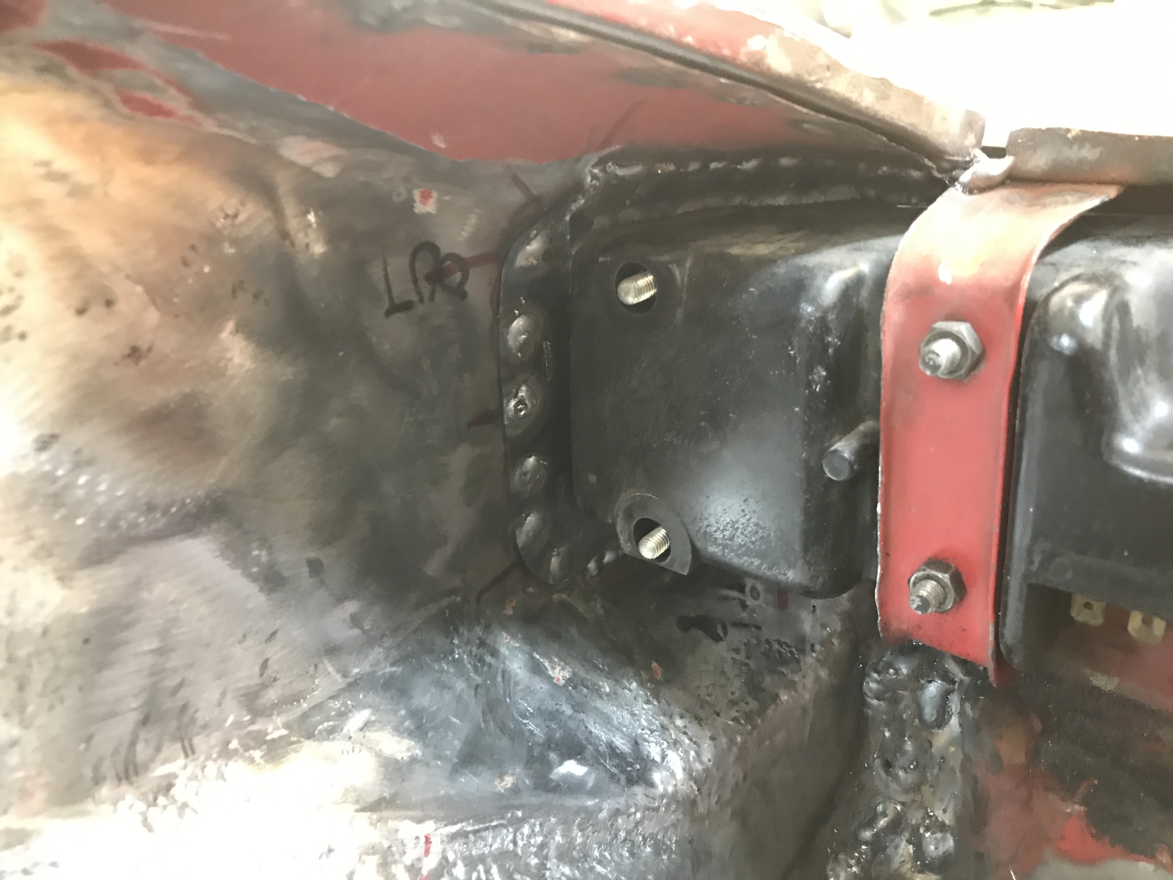

View from the inside.

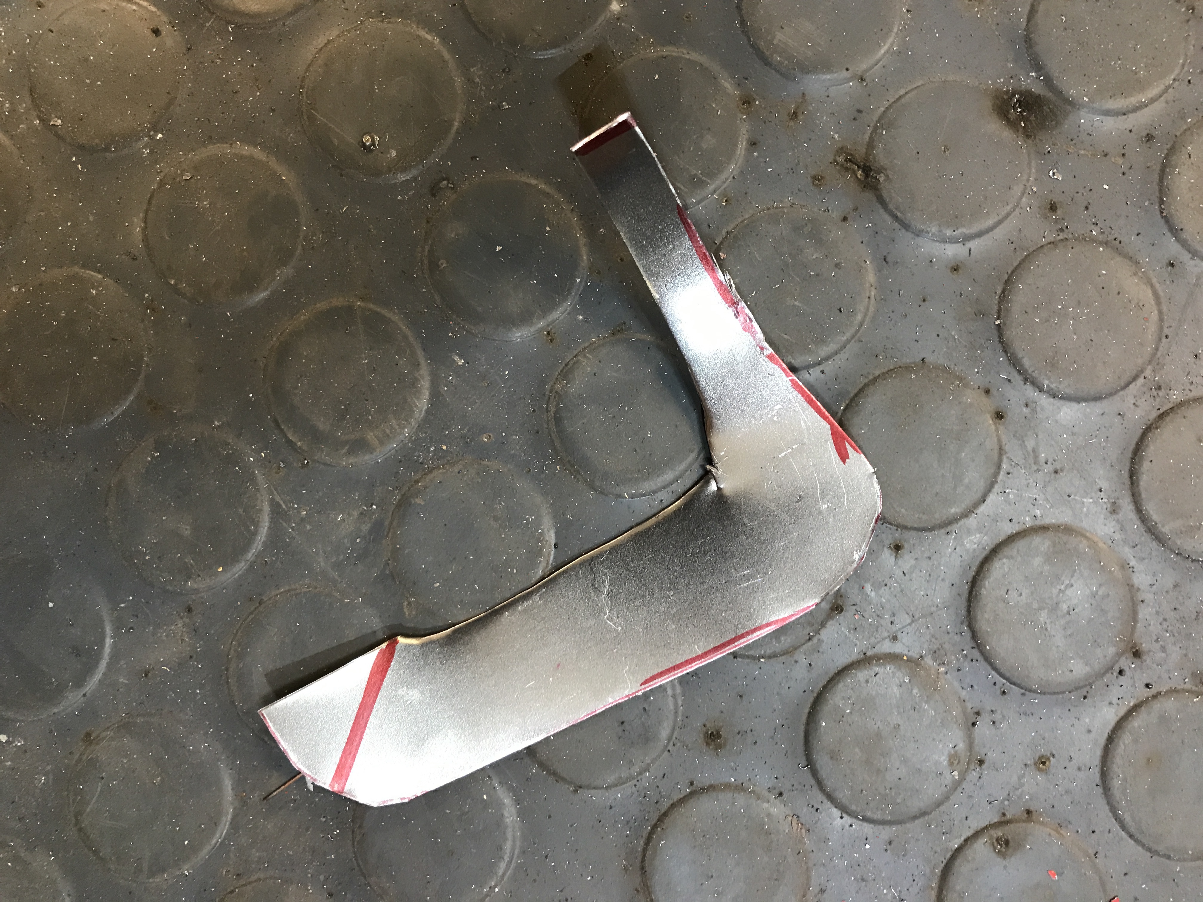

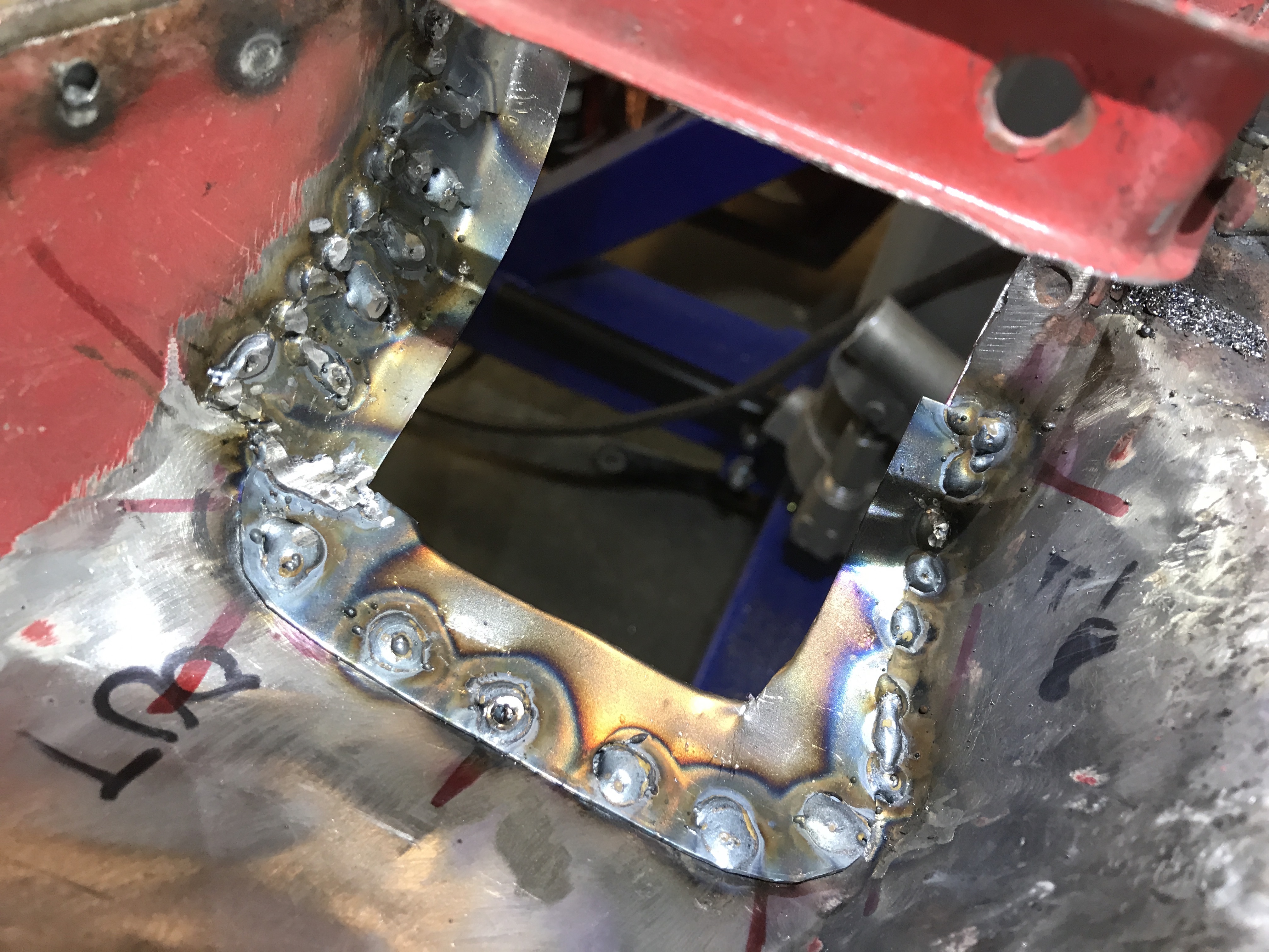

My plan is to start with a patch strip around the opening on the inside. This should give me something to work with.

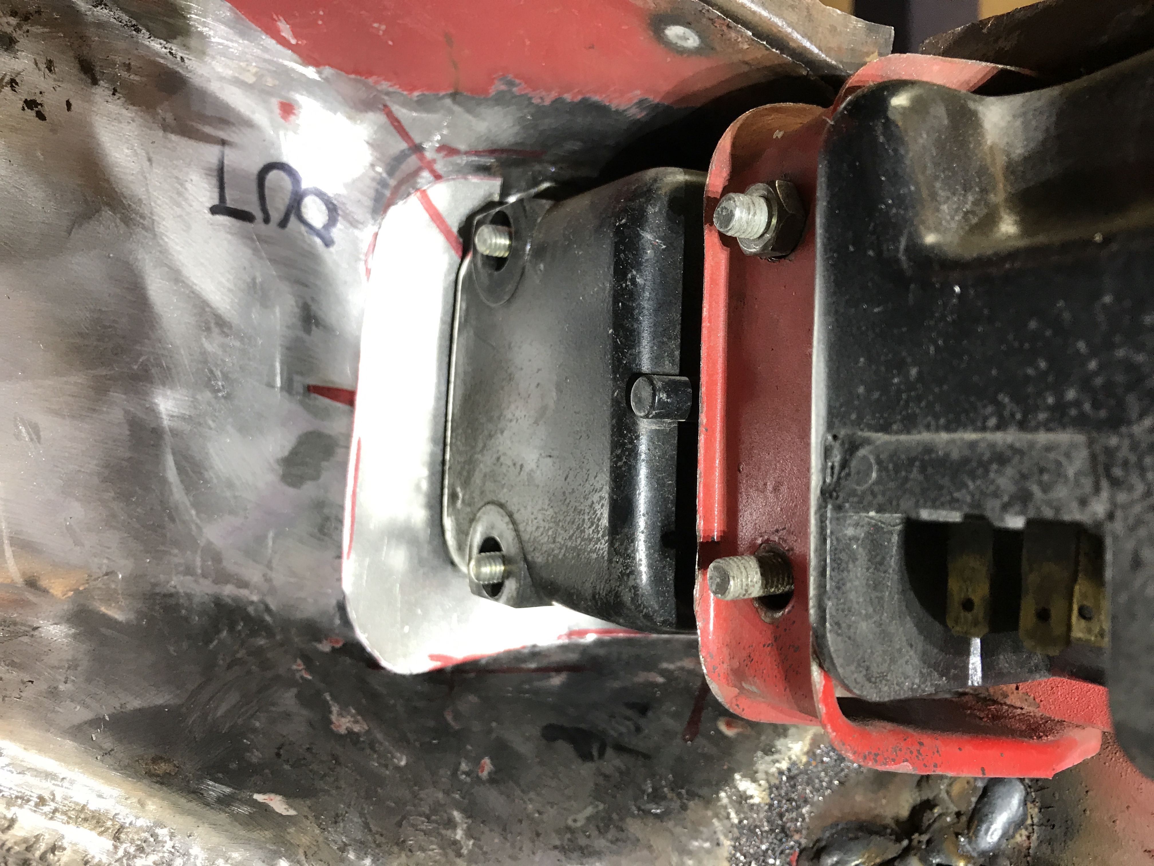

Check fit with tail light.
tygaboy
post Apr 11 2020, 10:16 PM
Post #469
Posts: 5,853
Joined: 6-October 15
From: Petaluma, CA
Member No.: 19,241
I feel for you, brother! I did a similar repair in that area. A bit of contorting to get in there.
Just keep knocking it out - you're doing great! (IMG:style_emoticons/default/aktion035.gif)

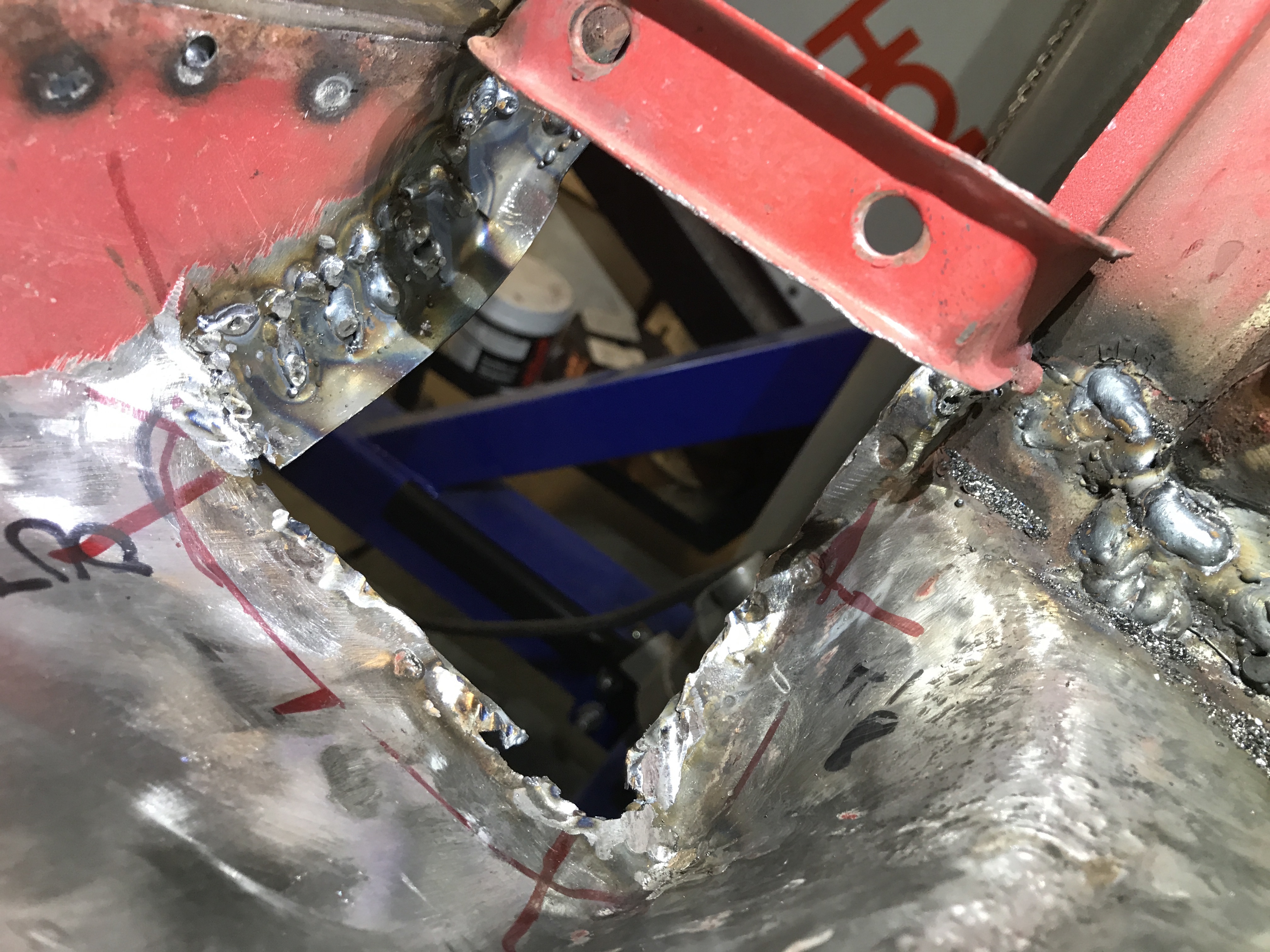

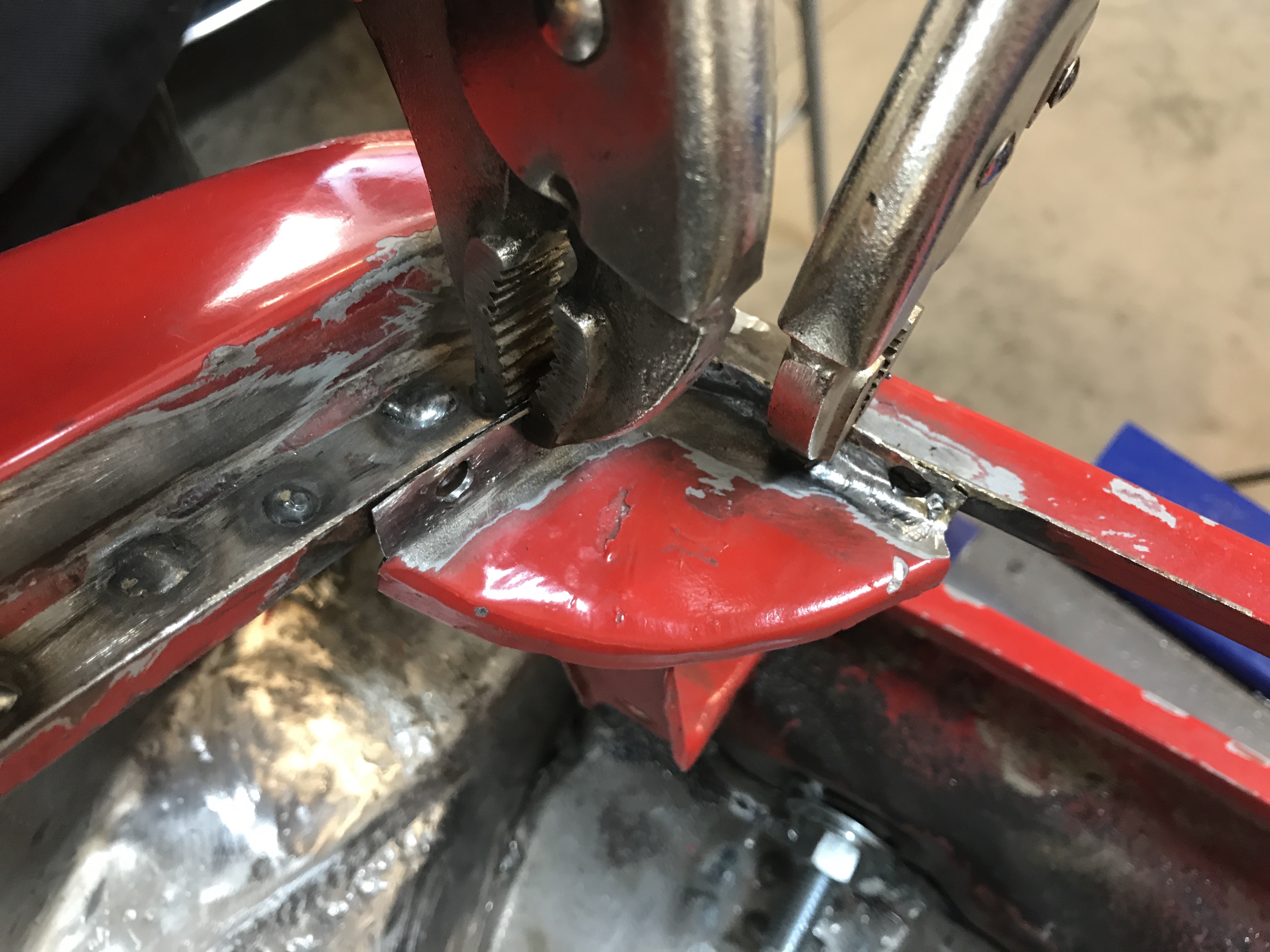

Got back at it today, with the car still sideways.
I started by welding in the top edge, that has a flange with variable angle.
bkrantz
post Apr 12 2020, 08:09 PM
Post #472
Posts: 8,796
Joined: 3-August 19
From: SW Colorado
Member No.: 23,343

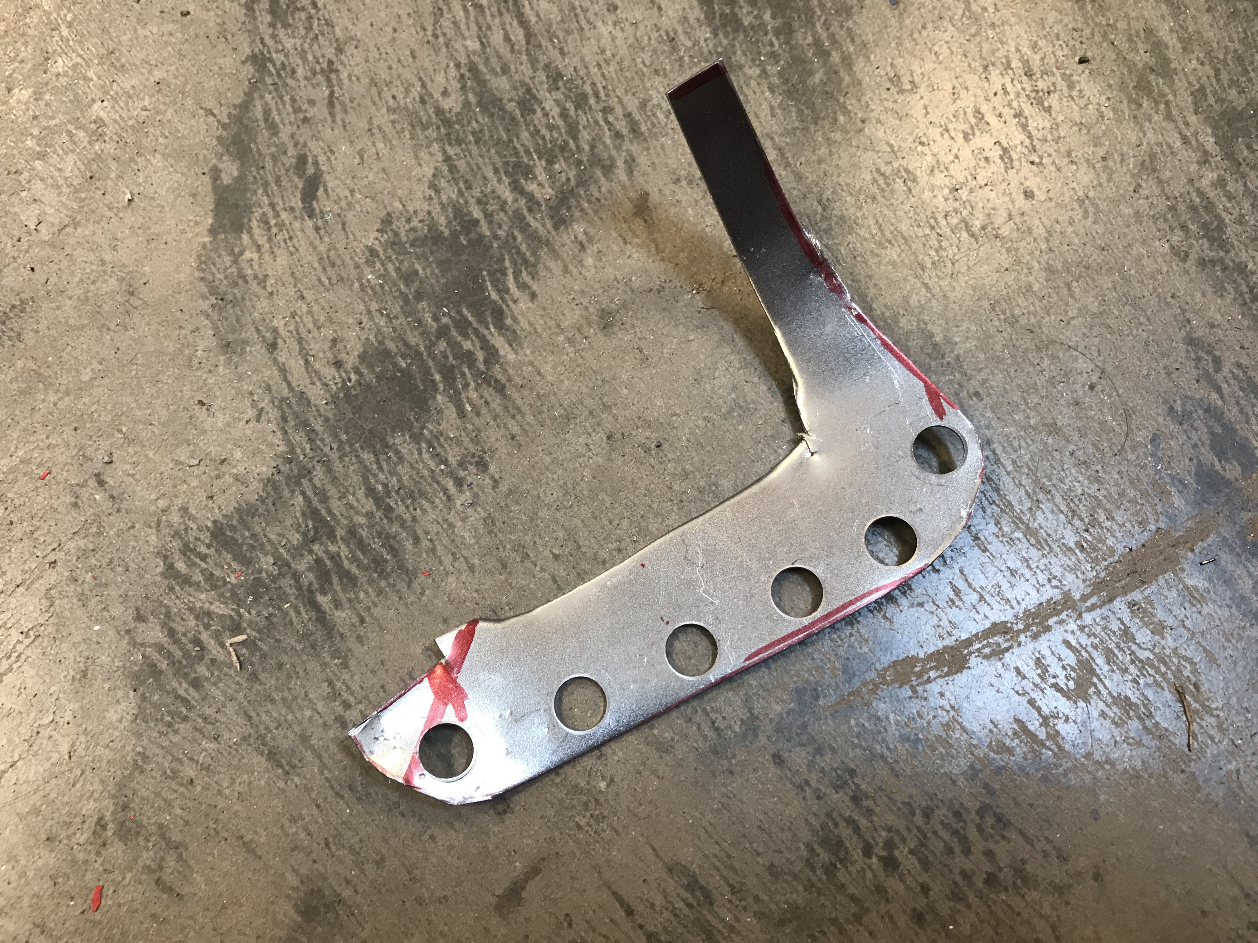

The lower piece is flatter, with some holes for plug welds.

And welded in place (inside).

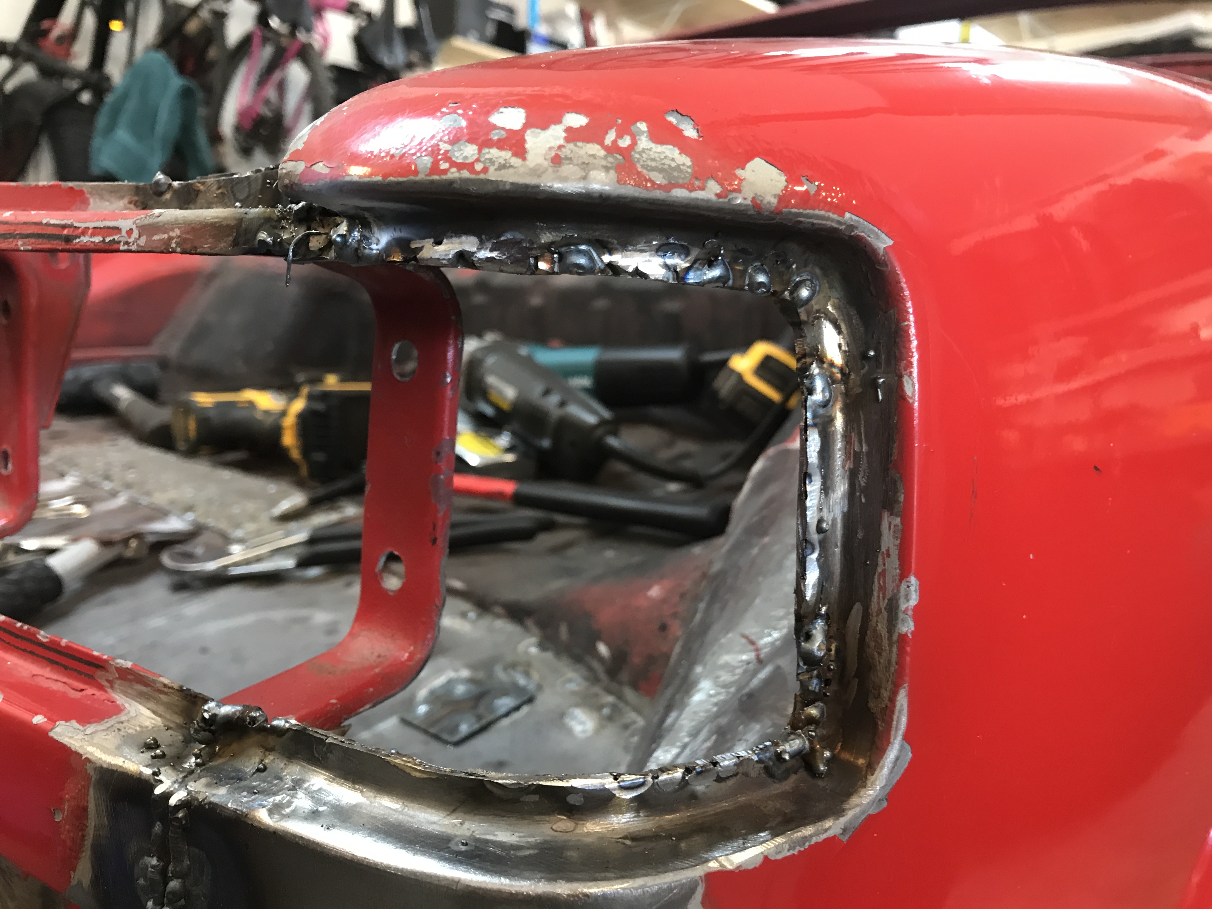

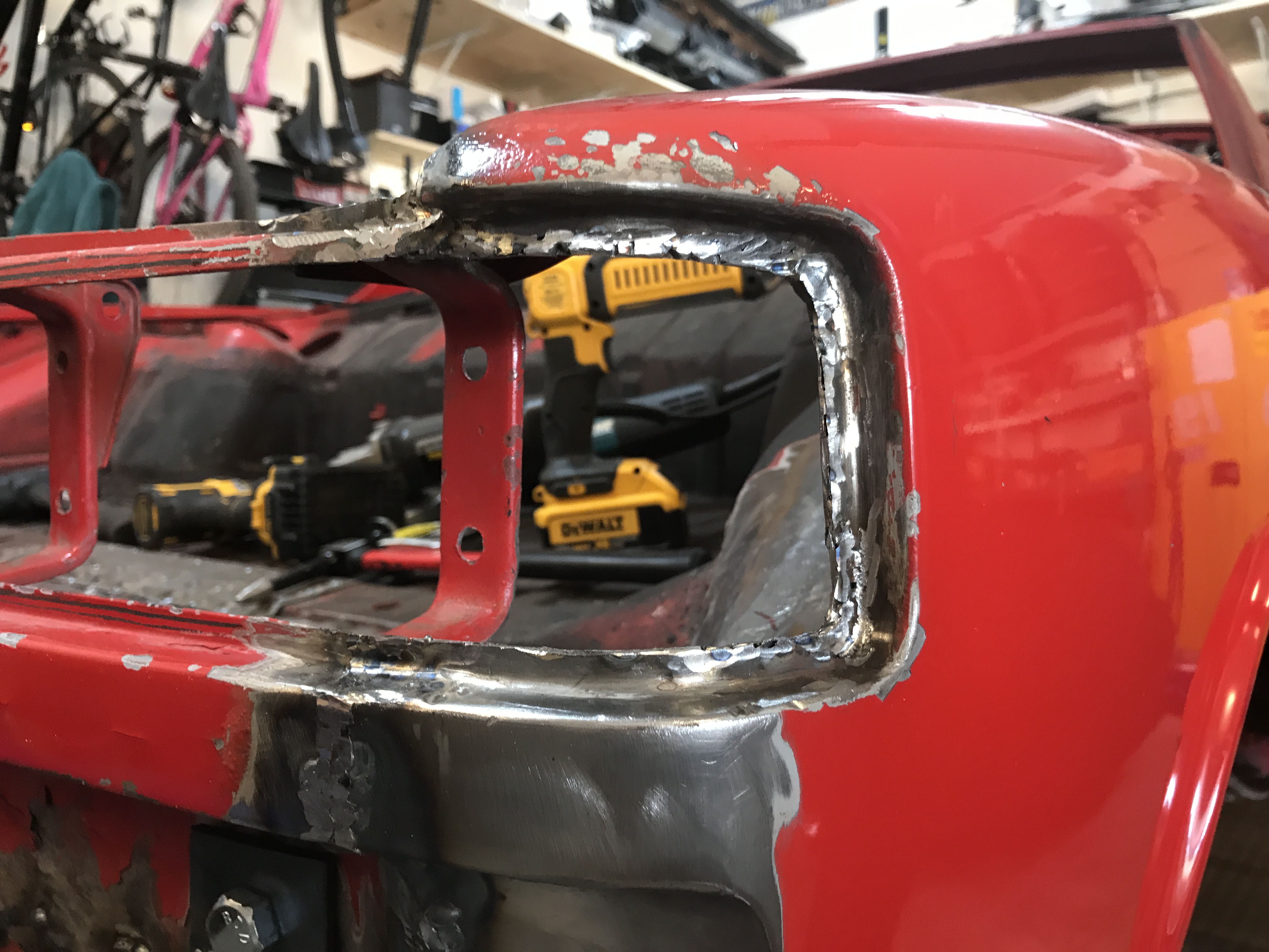

With the car rotated back to horizontal (love the rotisserie!), here's the view from the outside. Now I have something solid to work with.
bkrantz
post Apr 12 2020, 08:13 PM
Post #475
Posts: 8,796
Joined: 3-August 19
From: SW Colorado
Member No.: 23,343
After welding the ragged edges and building up metal where missing, and then grinding, I got it at least 80%. Still needs some touch-up, but better than I hoped.

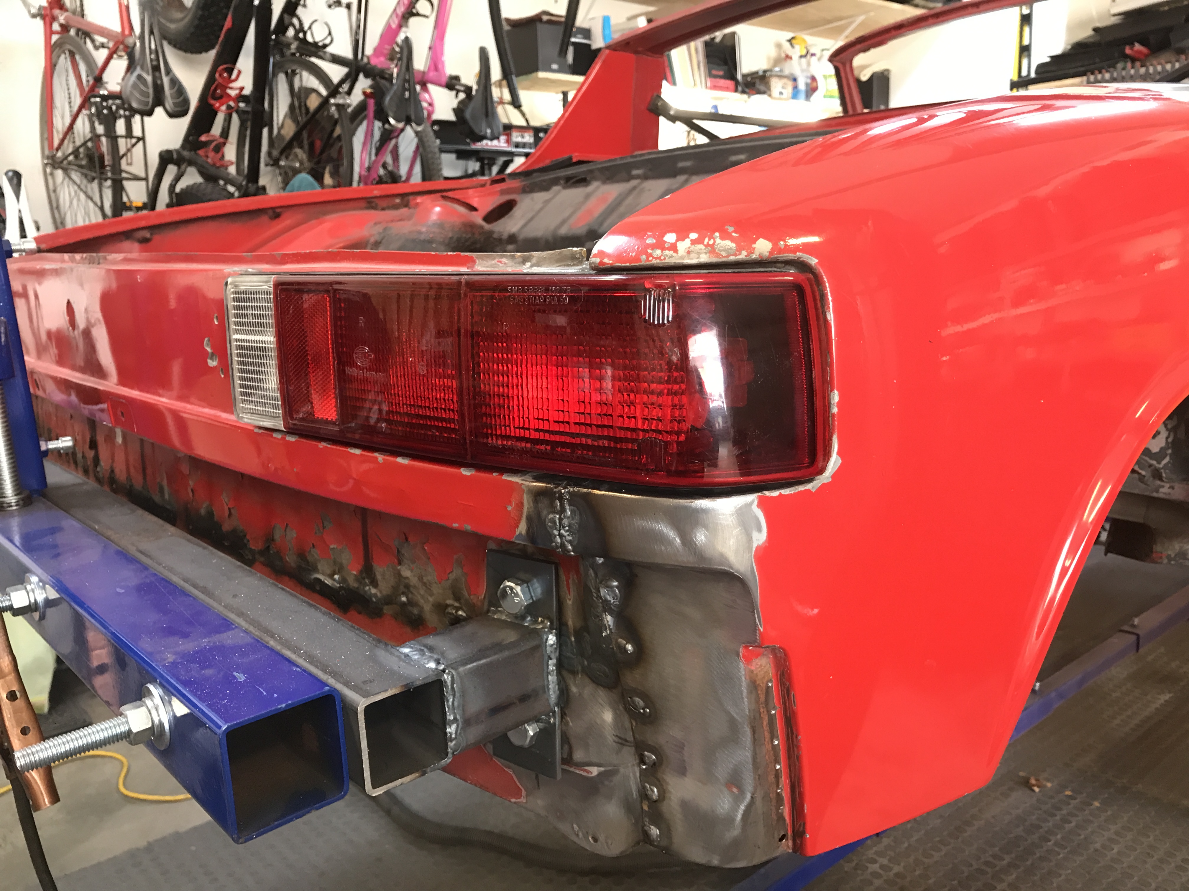

Test fit with the tail light. Sits straight.

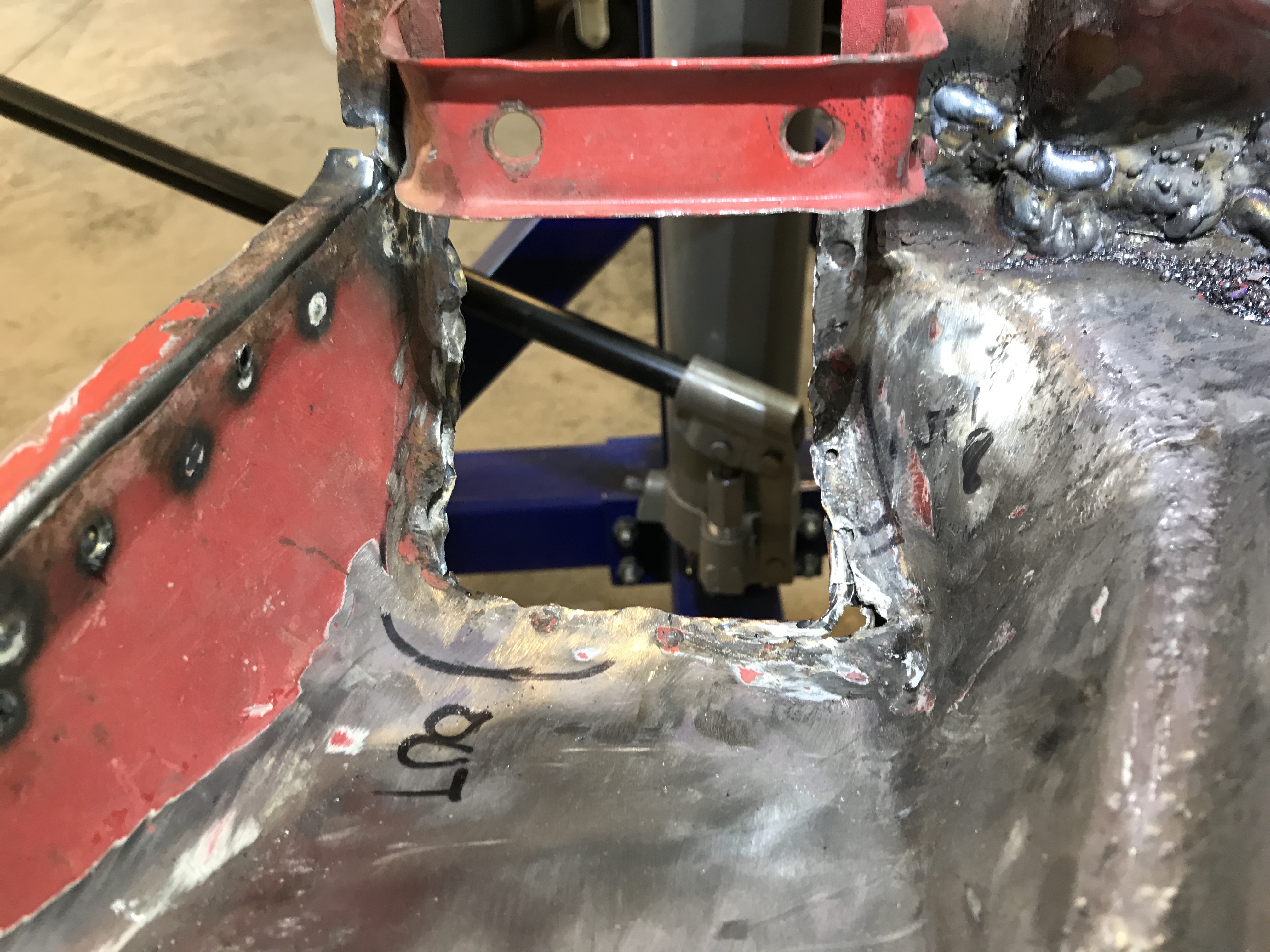

View from inside.

Got the right side done today. First some touch-up welding around the tail light opening.
bkrantz
post Apr 13 2020, 07:53 PM
Post #479
Posts: 8,796
Joined: 3-August 19
From: SW Colorado
Member No.: 23,343
Ground down and god enough (for now).

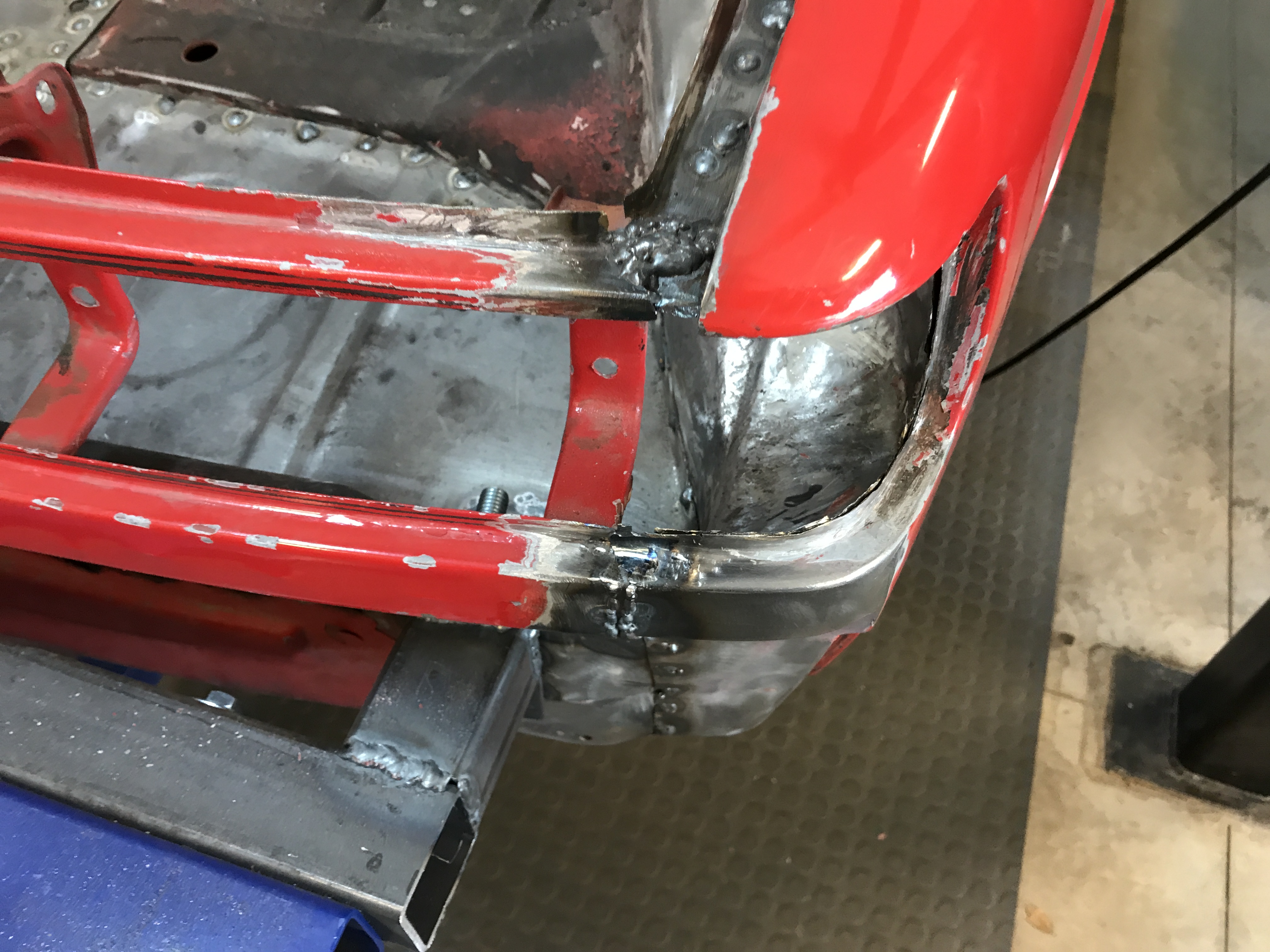

On to the top. Here's the corner gusset in place.
