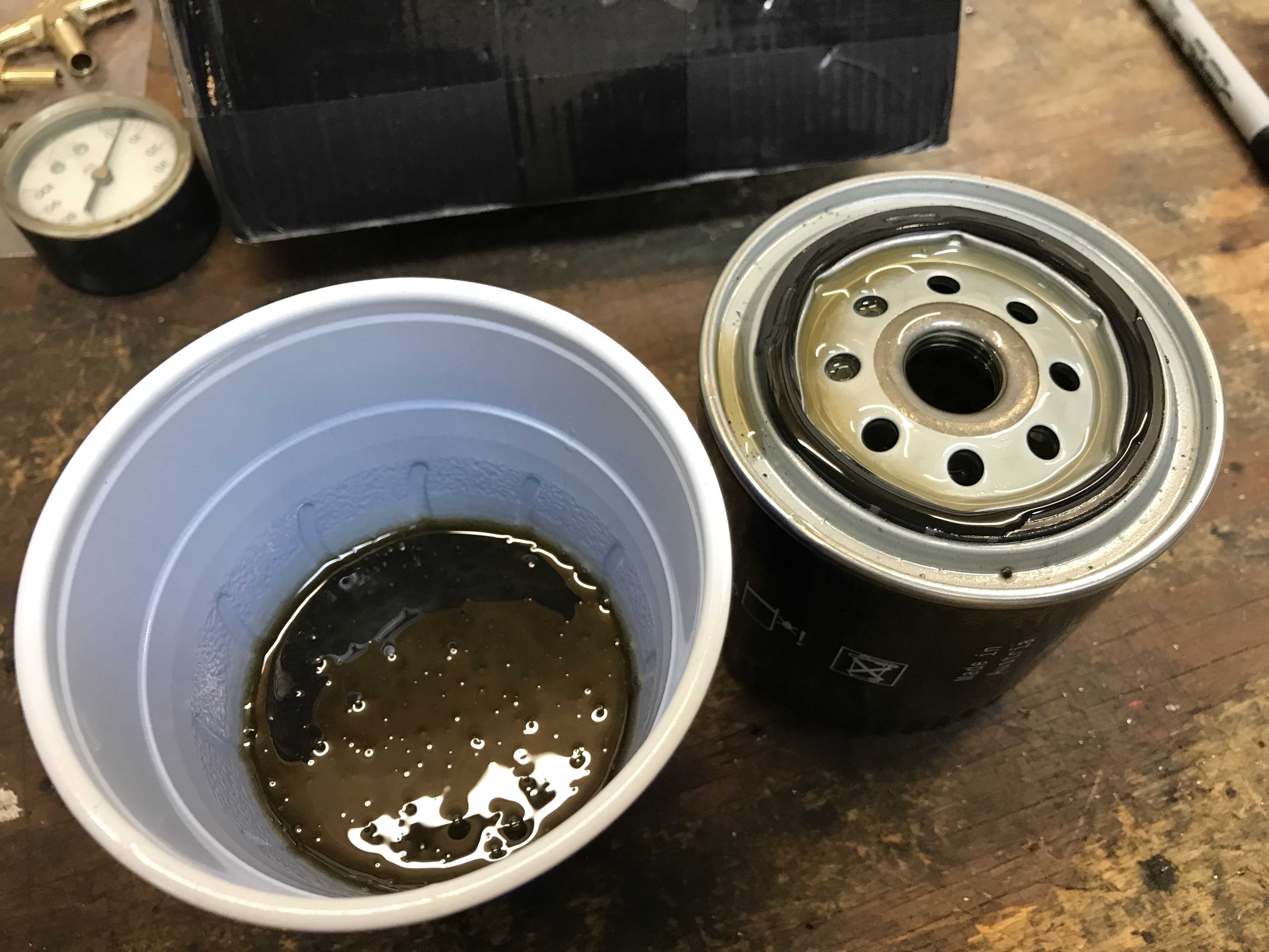

Here's the filter and some oil from the initial startup. I might cut open the filter and check for crud.

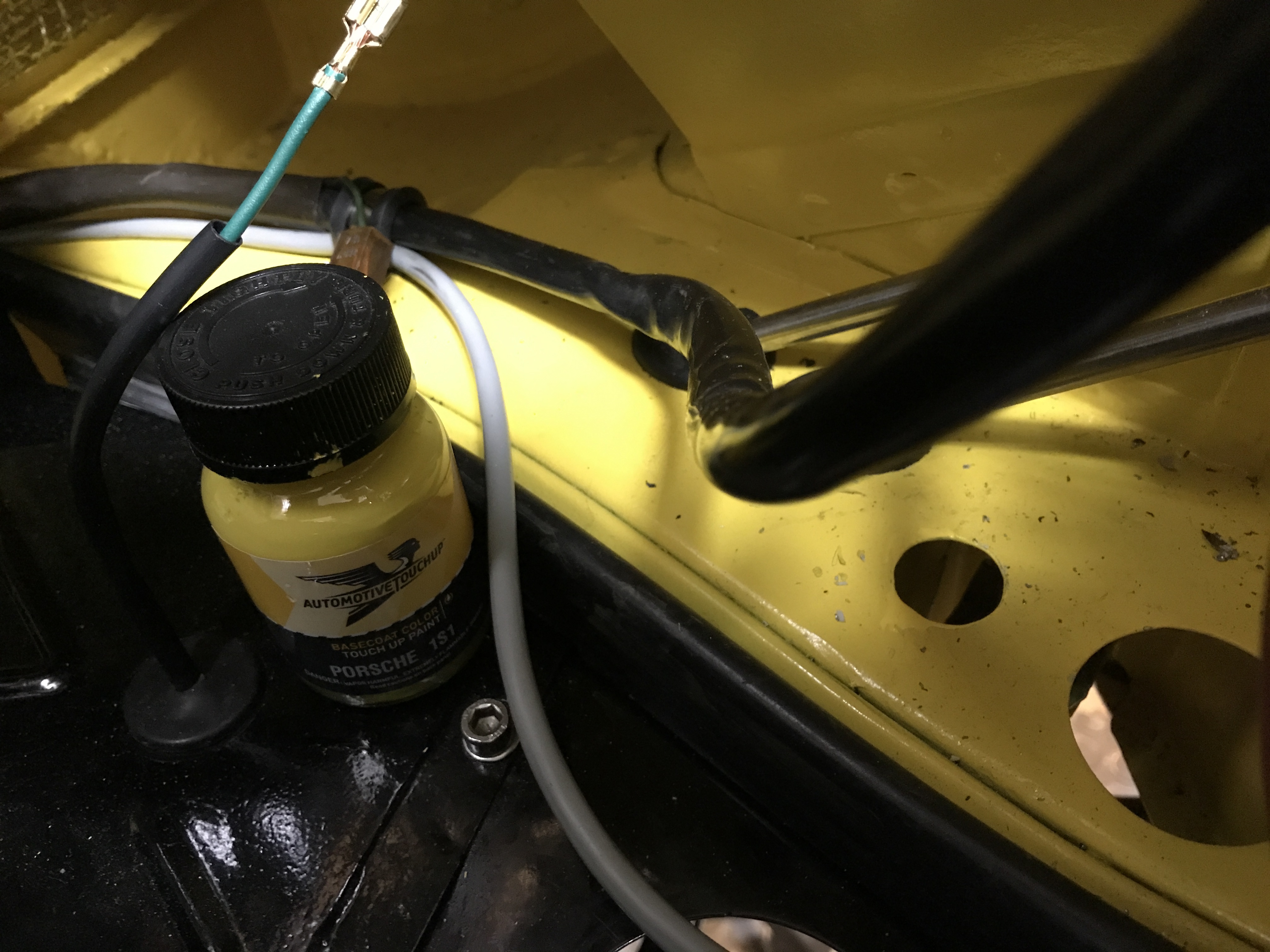

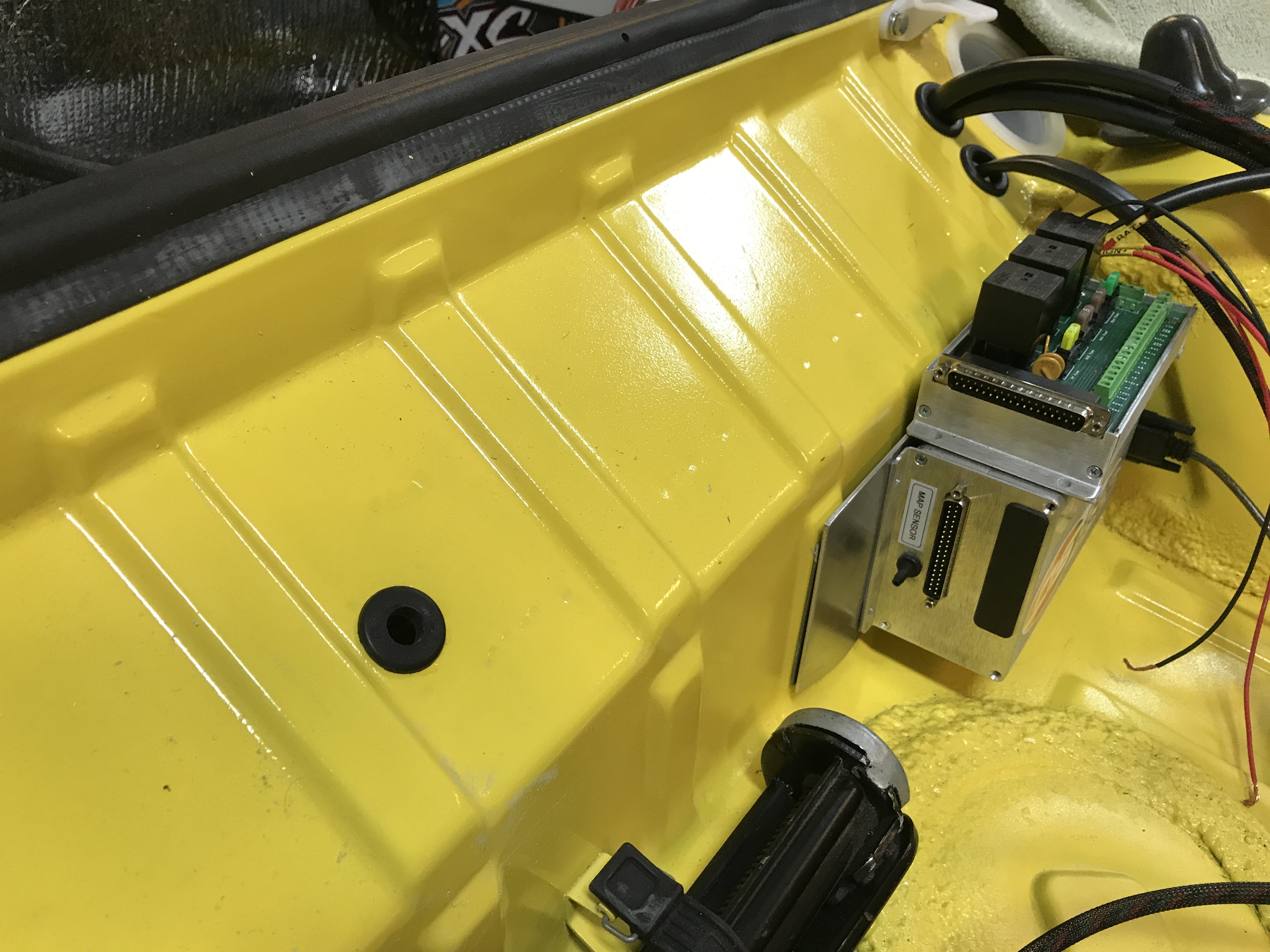

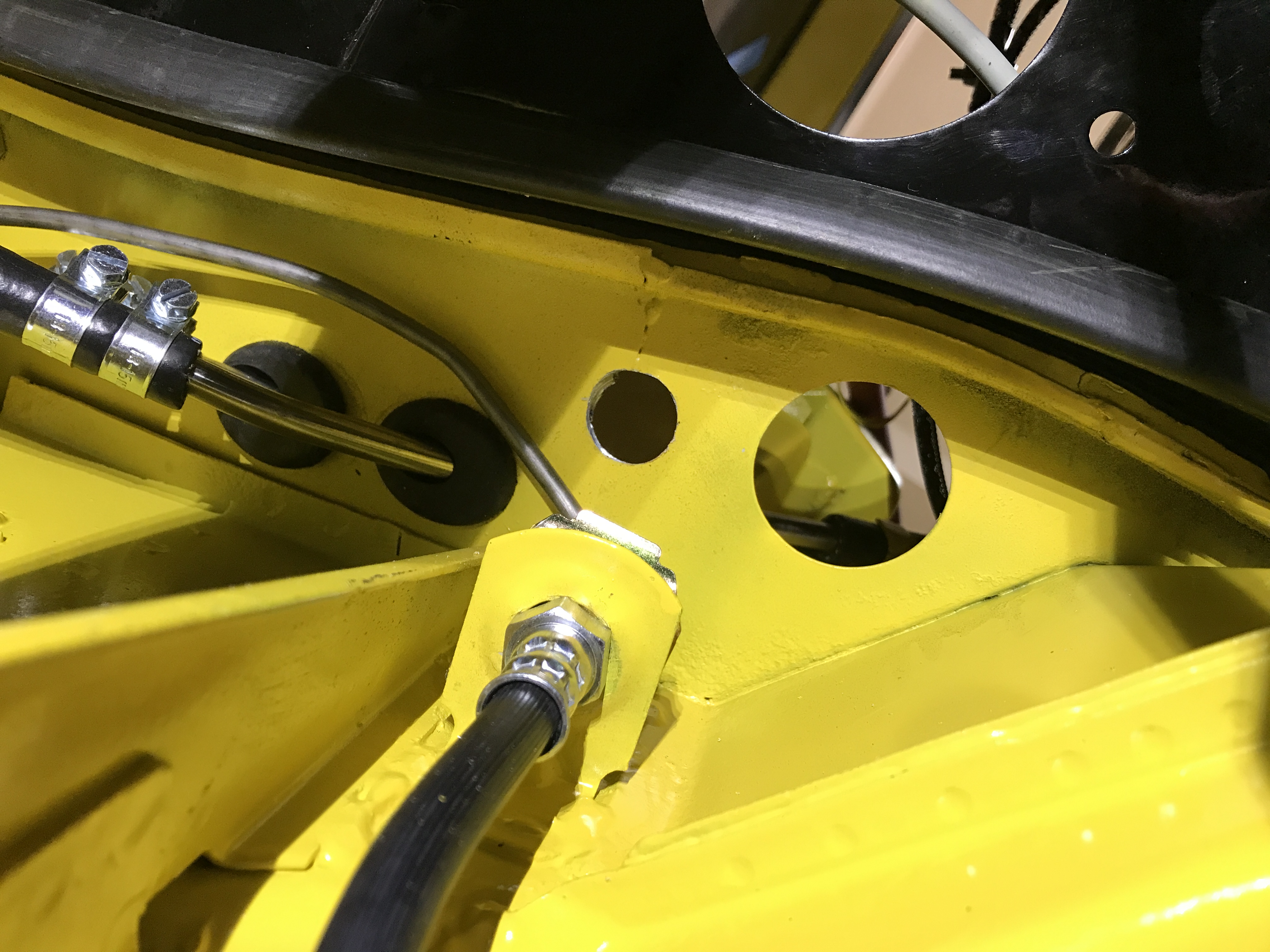

Time for some more holes! This hole in the right engine shelf is for the O2 sensor cable. I am trying to follow the logic of where cables and hoses go, along with disconnects, so that the engine can drop in the future with minimal fuss.

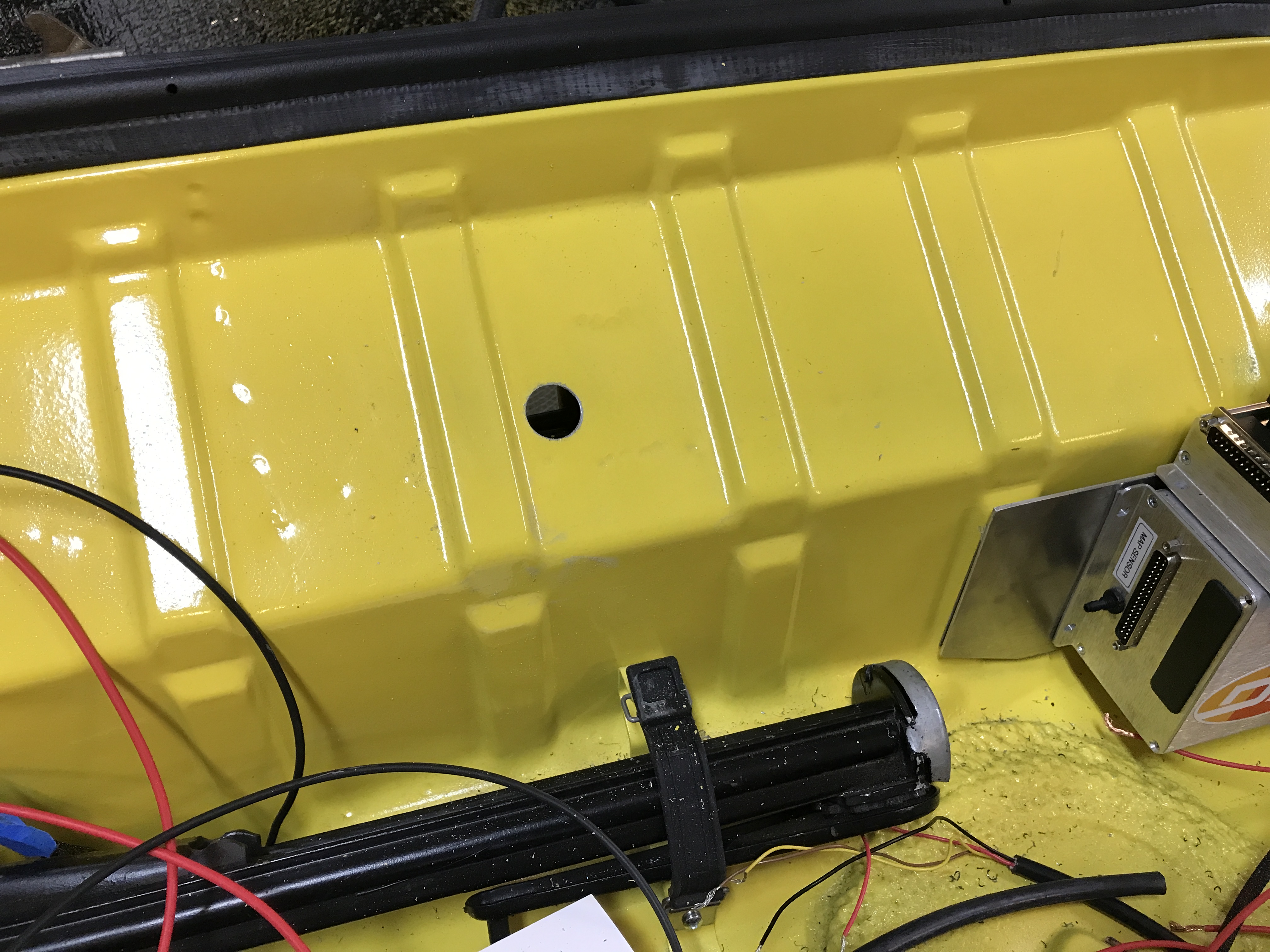

And this hole is for the intake vacuum line.

And of course I need to paint the new raw edges.

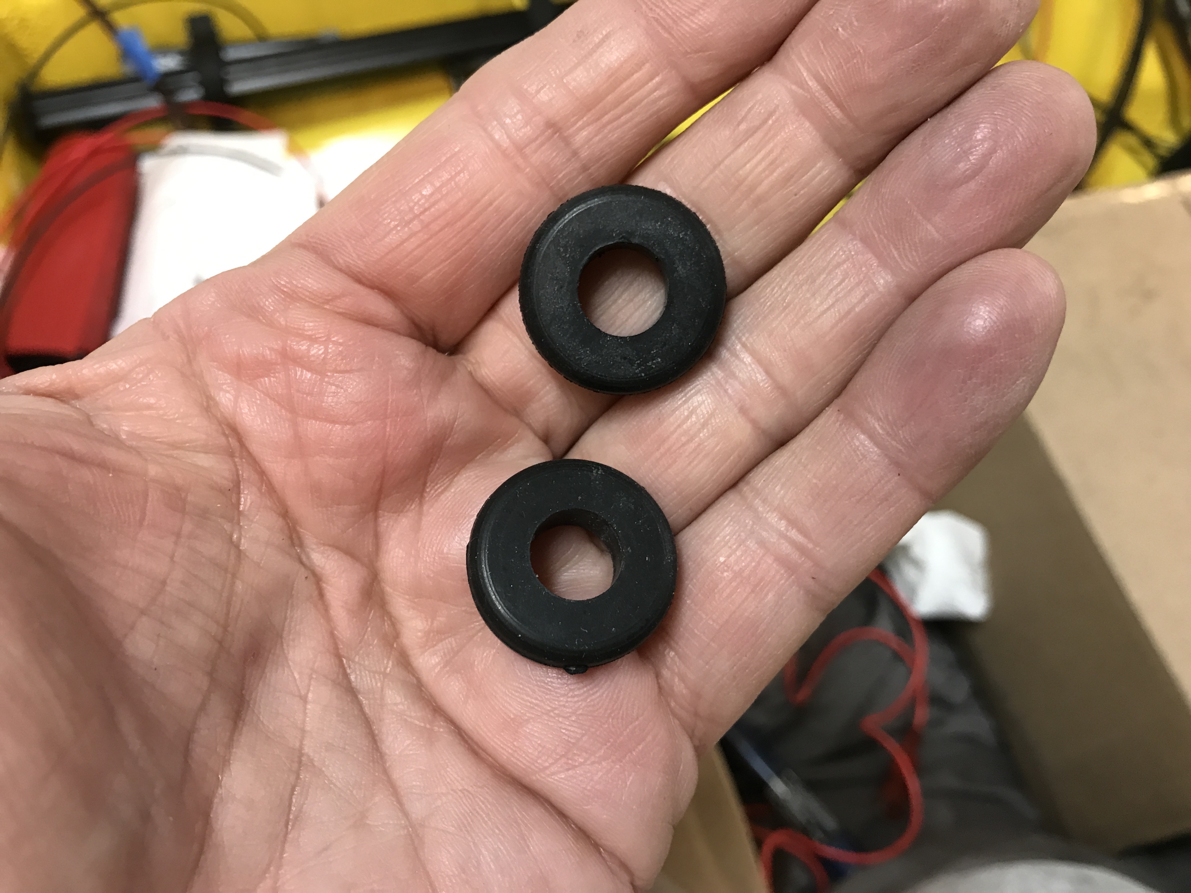

Holes painted and time for grommets.

Hole ready for the vacuum tube.

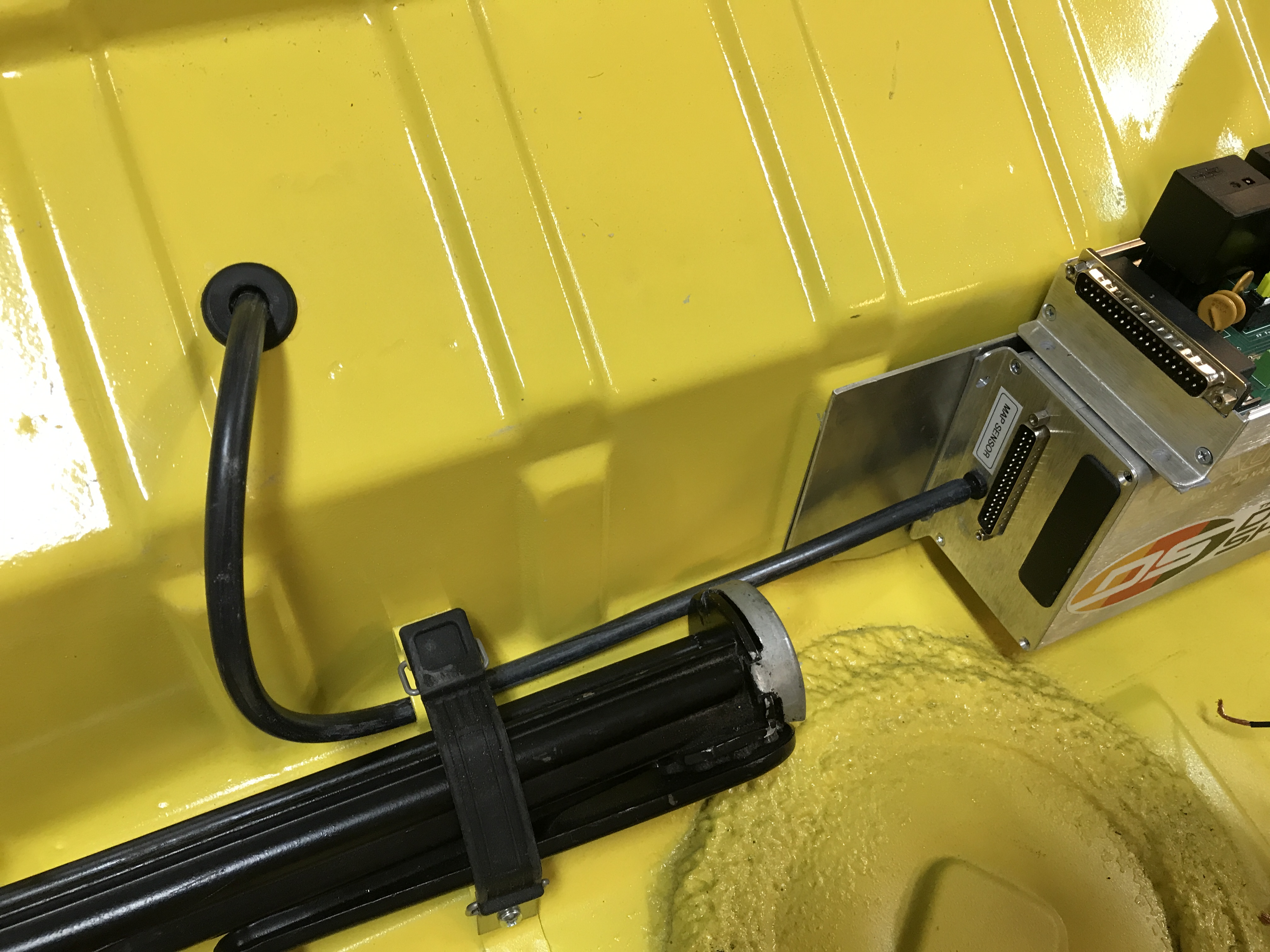

Vacuum line connected.

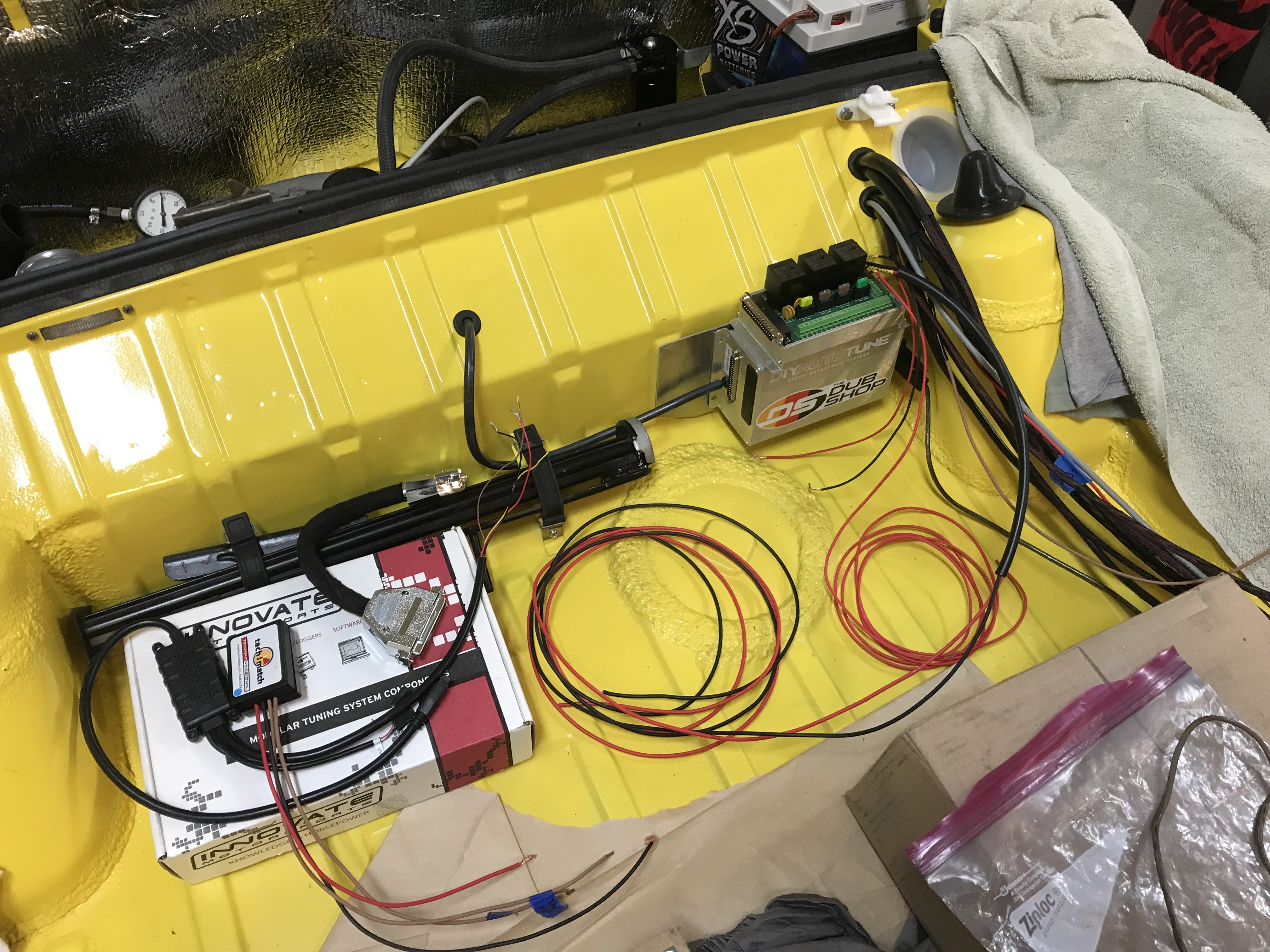

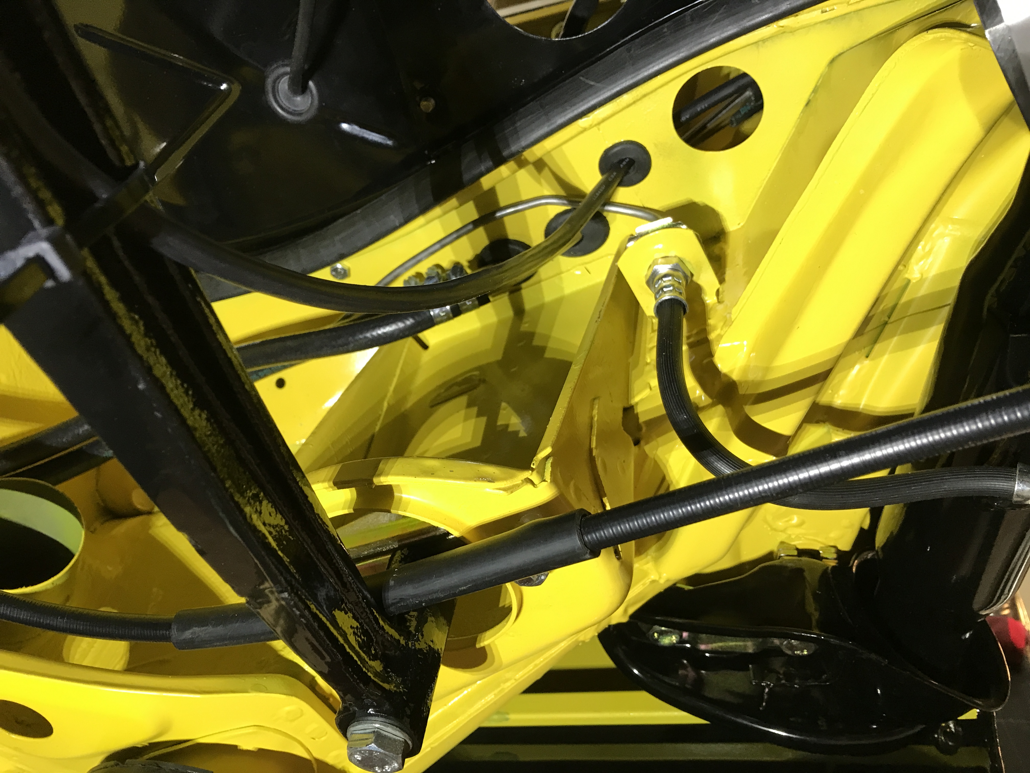

O2 sensor cable fed from below.

Just about ready to start trimming cable lengths and making permanent connections.

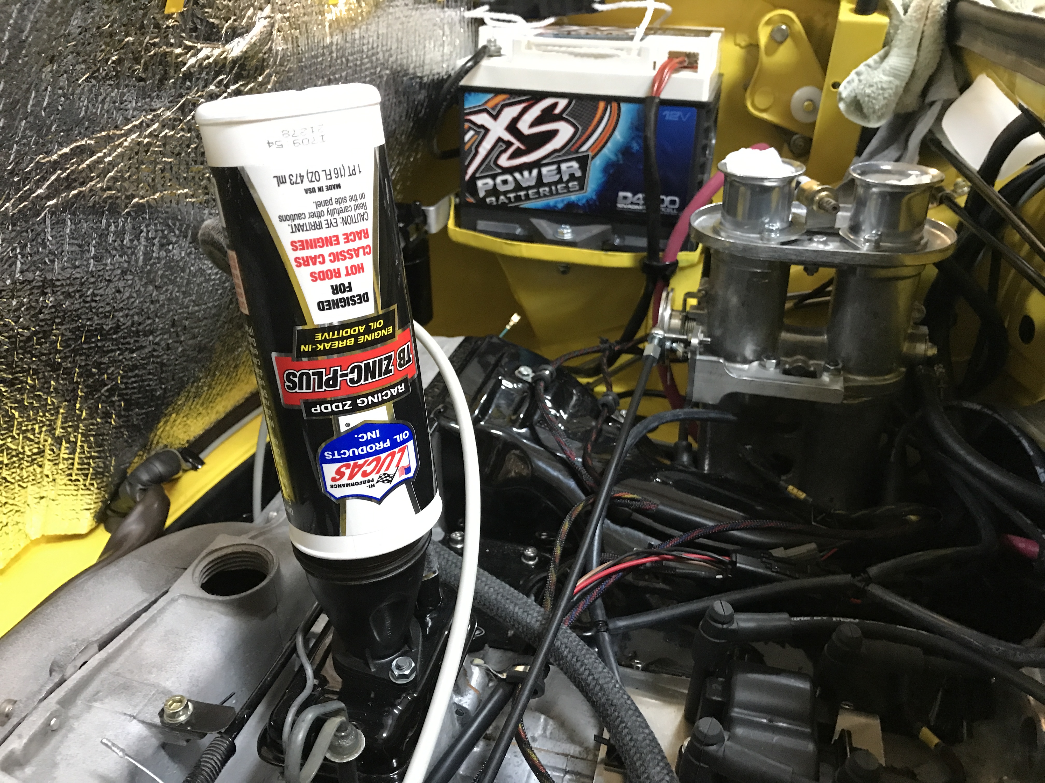

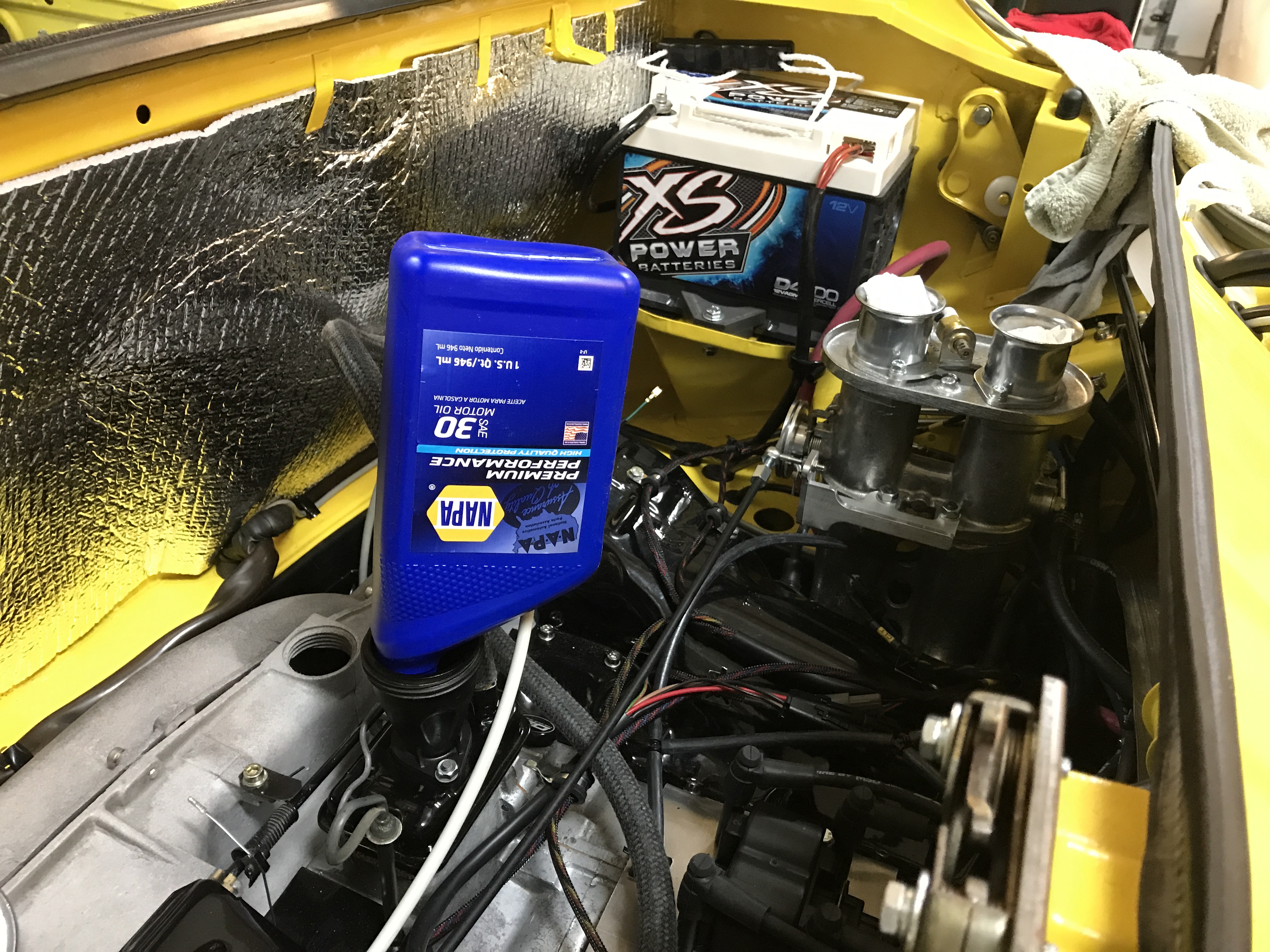

Before I forget, I refilled the crankcase. More break-in oil, SAE 30.
bkrantz
post Jan 5 2022, 08:13 PM
Post #4612
Posts: 8,530
Joined: 3-August 19
From: SW Colorado
Member No.: 23,343
Plus more zinc additive.

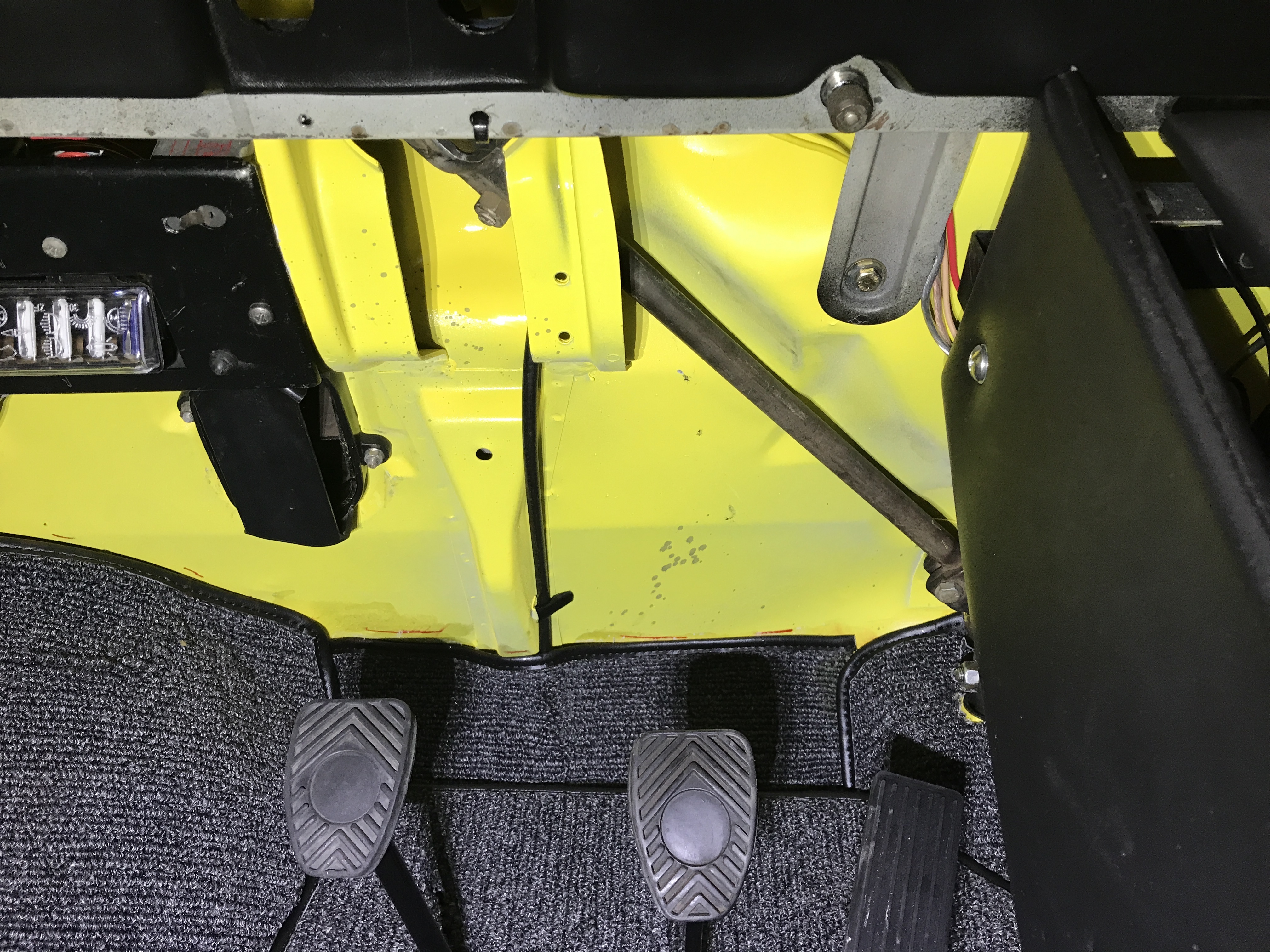

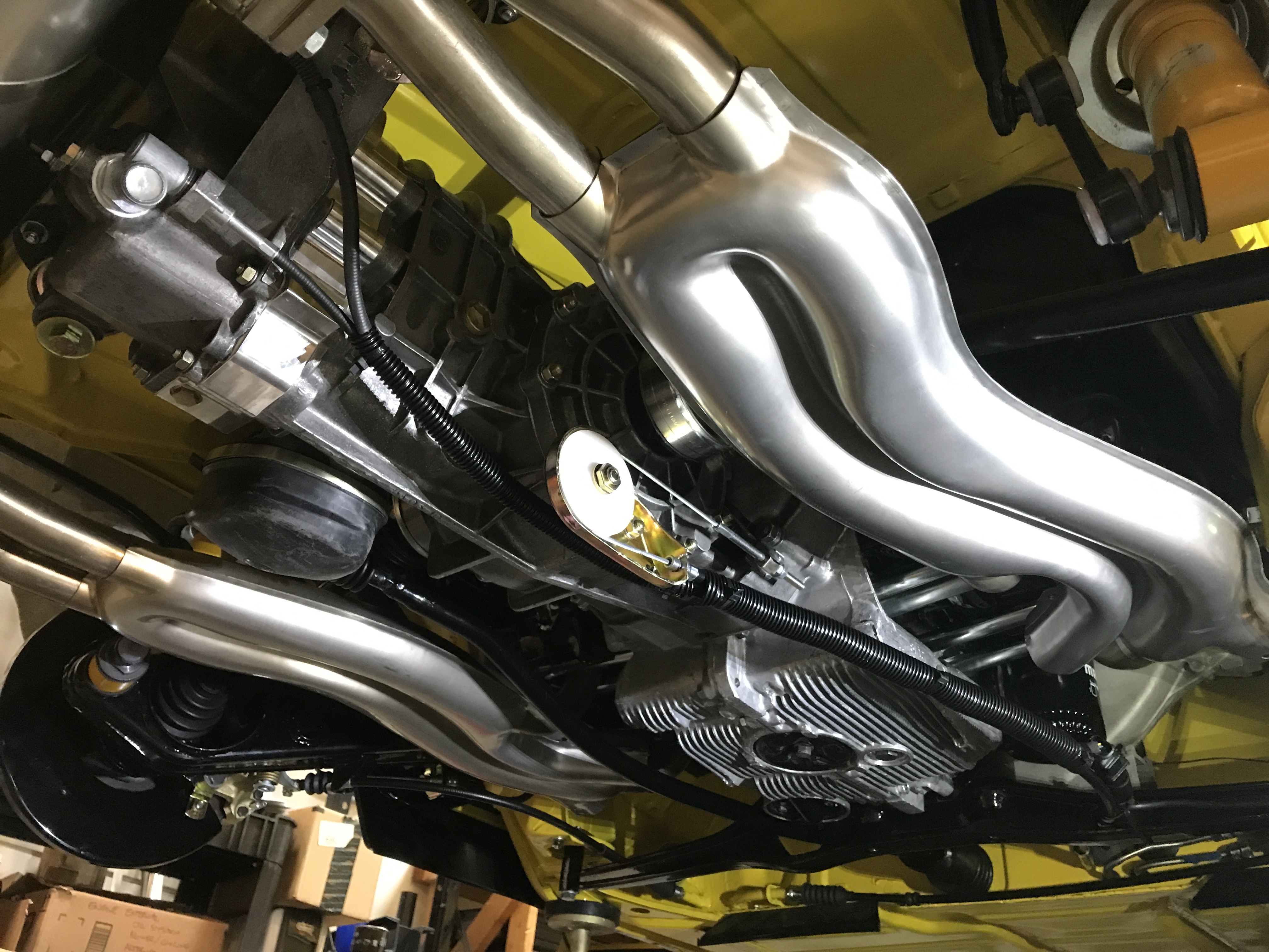

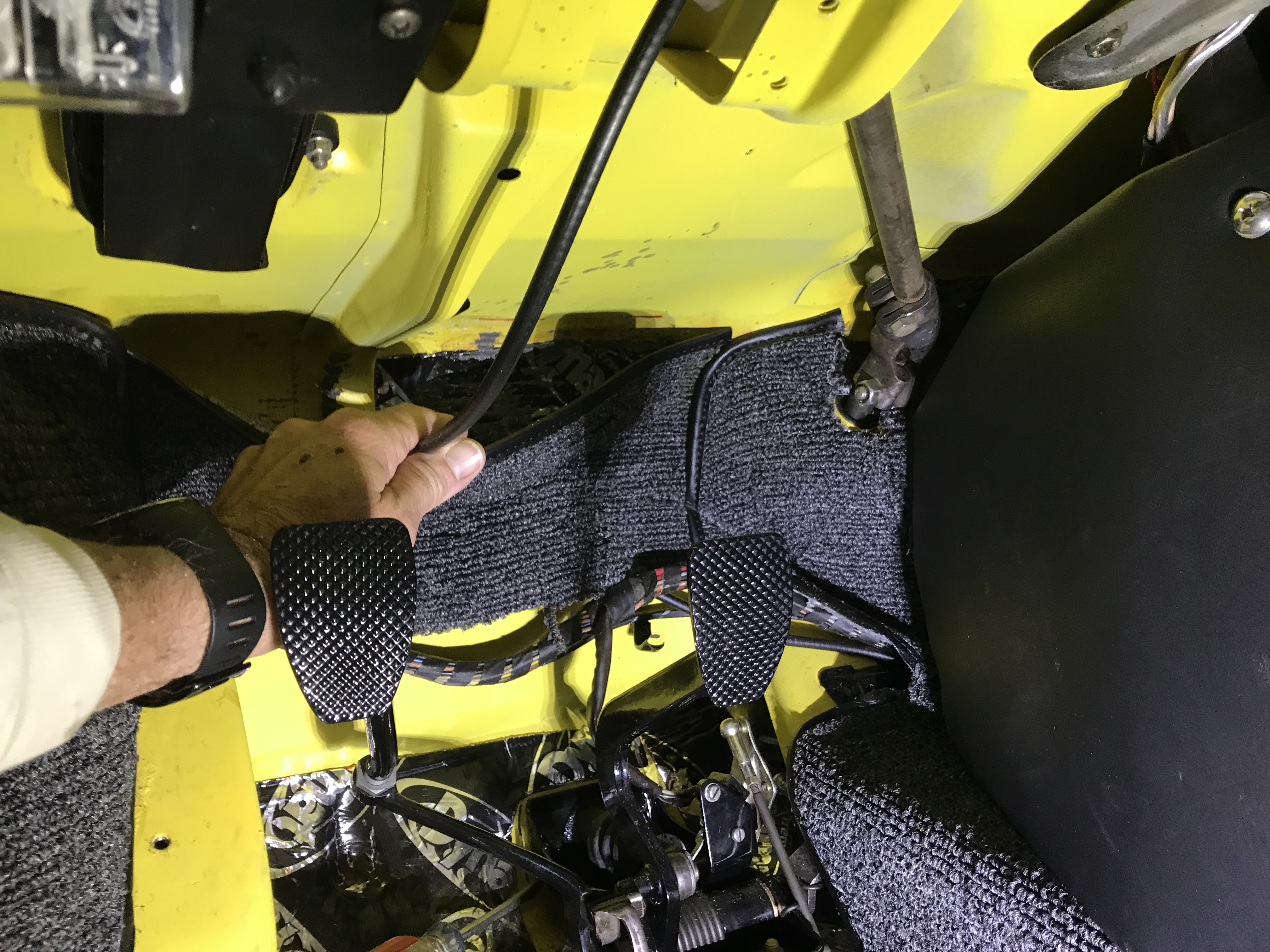

Next task: the speedometer cable. When I installed the cable in the interior, I did not leave enough projecting from the fire wall to reach the angle drive on the transaxle. Looking under the dash, I ran the cable straight forward from the gauge.
bkrantz
post Jan 6 2022, 09:33 PM
Post #4615
Posts: 8,530
Joined: 3-August 19
From: SW Colorado
Member No.: 23,343
Once I removed the pedal board and pulled the carpet partly off the front firewall, I changed the route of the cable and fed excess into the tunnel.

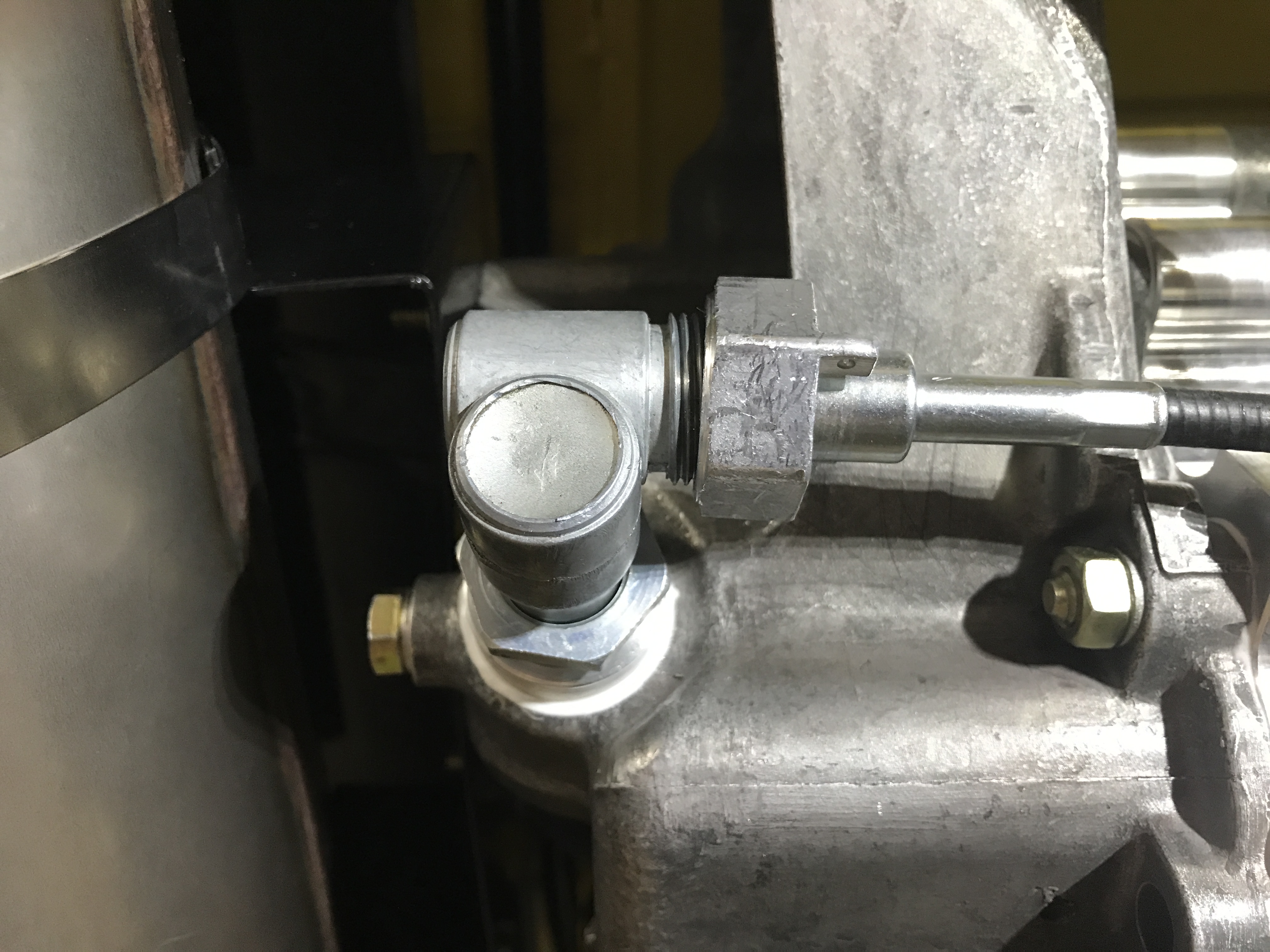

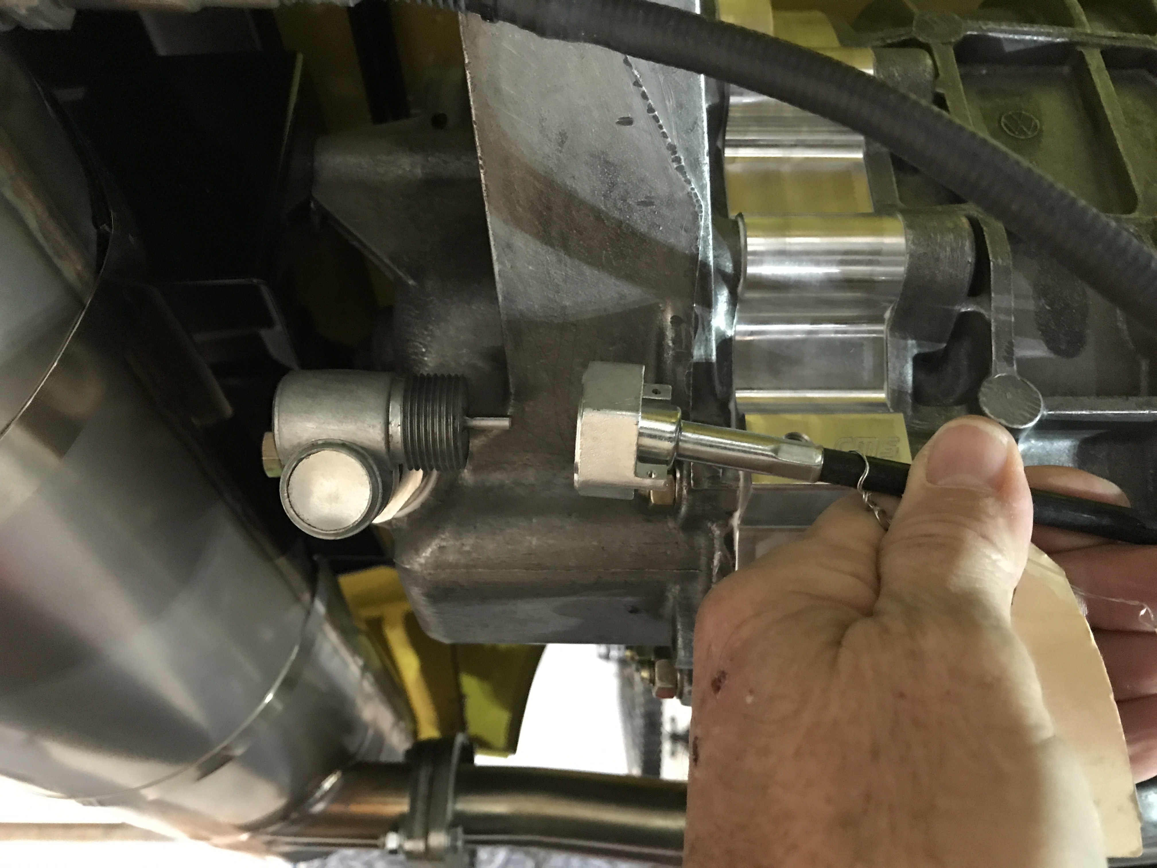

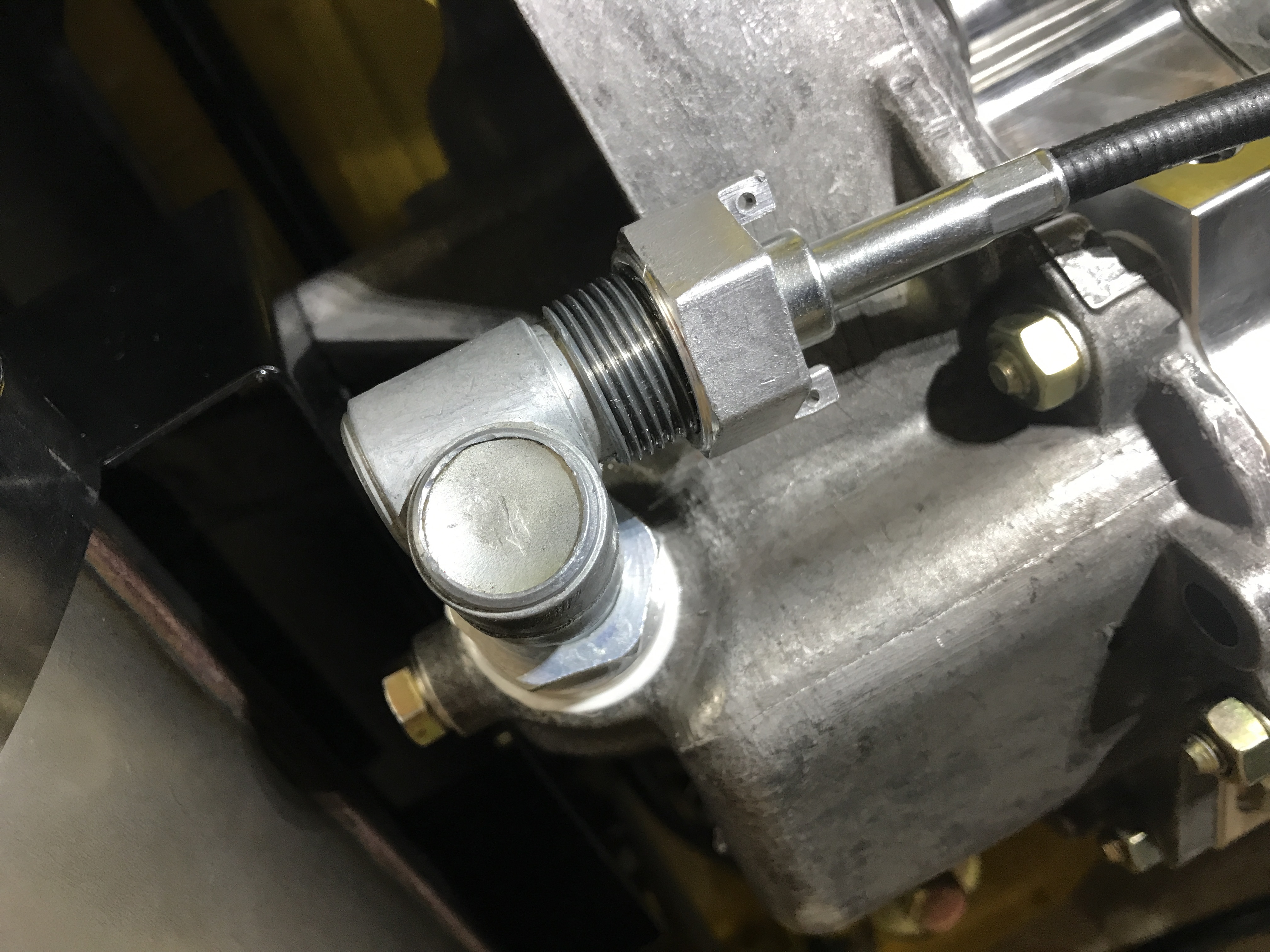

Now, another problem. The cable retaining nut does not want to screw straight onto the angle drive.
bkrantz
post Jan 6 2022, 09:38 PM
Post #4617
Posts: 8,530
Joined: 3-August 19
From: SW Colorado
Member No.: 23,343
I spent almost an hour on this. First I chased the threads, but no luck. Then I used my Dremel to chamfer the first threads in the cap and on the angle drive. I got it started straight, and it held for about two turns--yay! But as I screwed it tight, it cocked twisted again. Fudge!
I will probably hold just fine, but this will bother me and my OCD.

With the speedo cable attached, I bundled it with the O2 cable and the clutch cable, and used some plastic cable cover. I want to get some high-temp wrap over this.

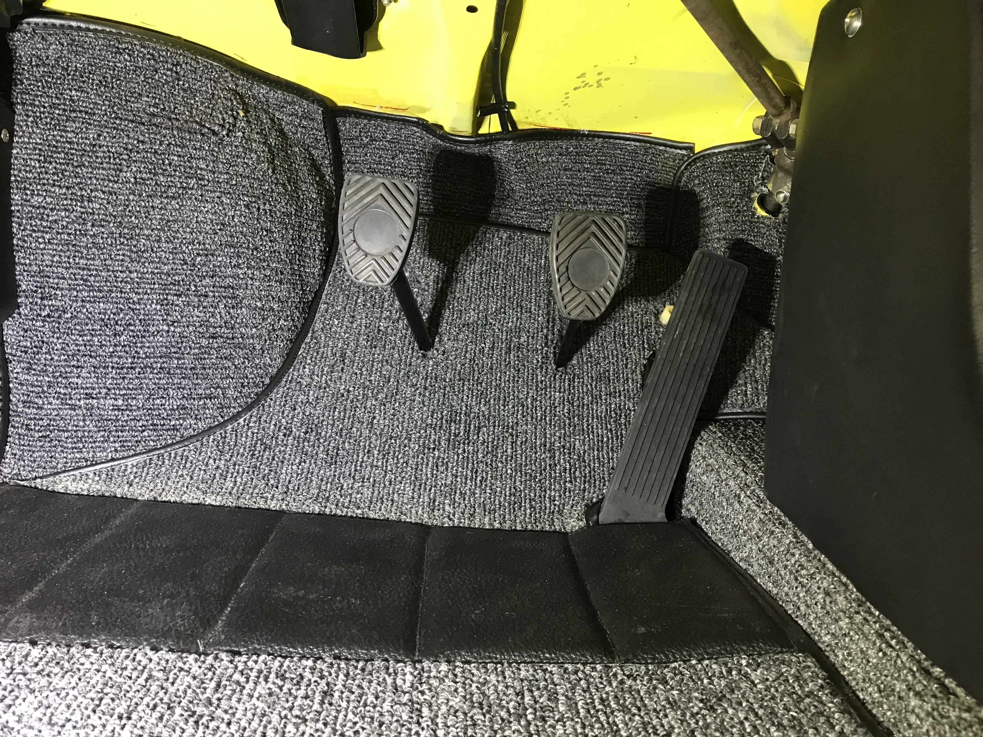

Inside buttoned-up.
