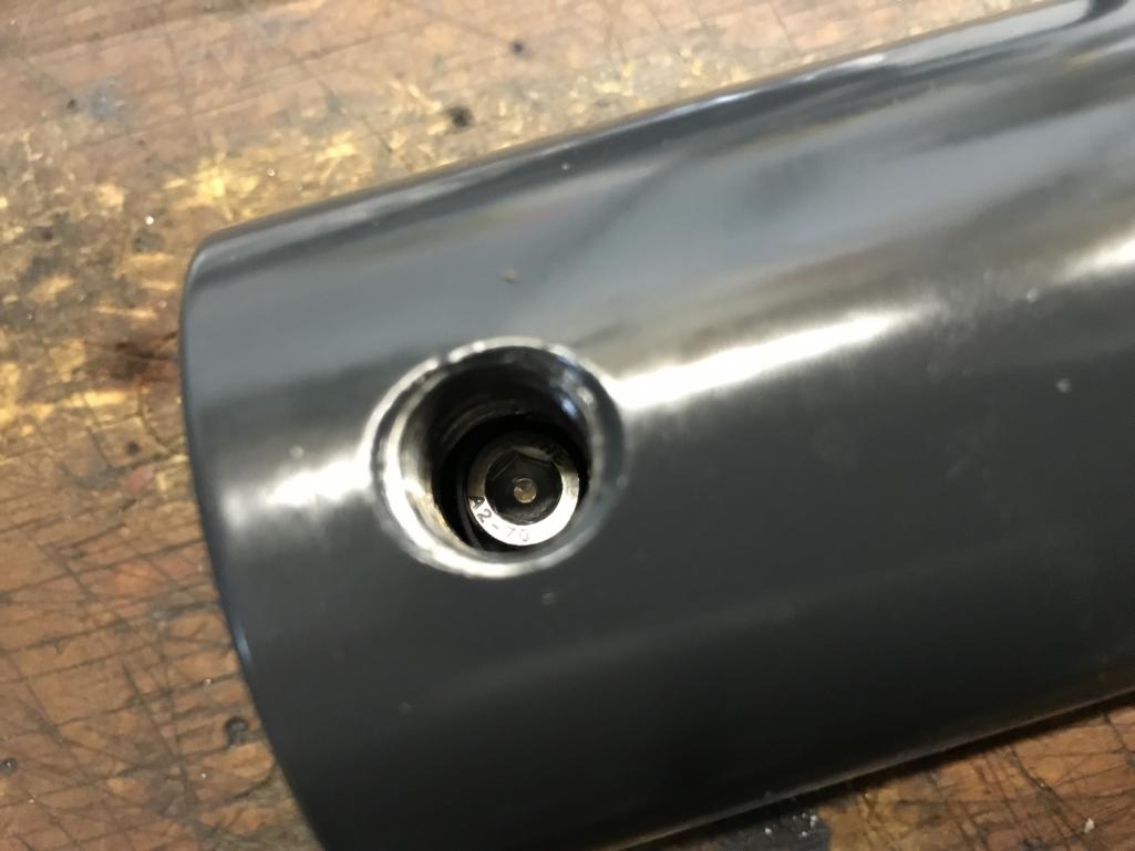

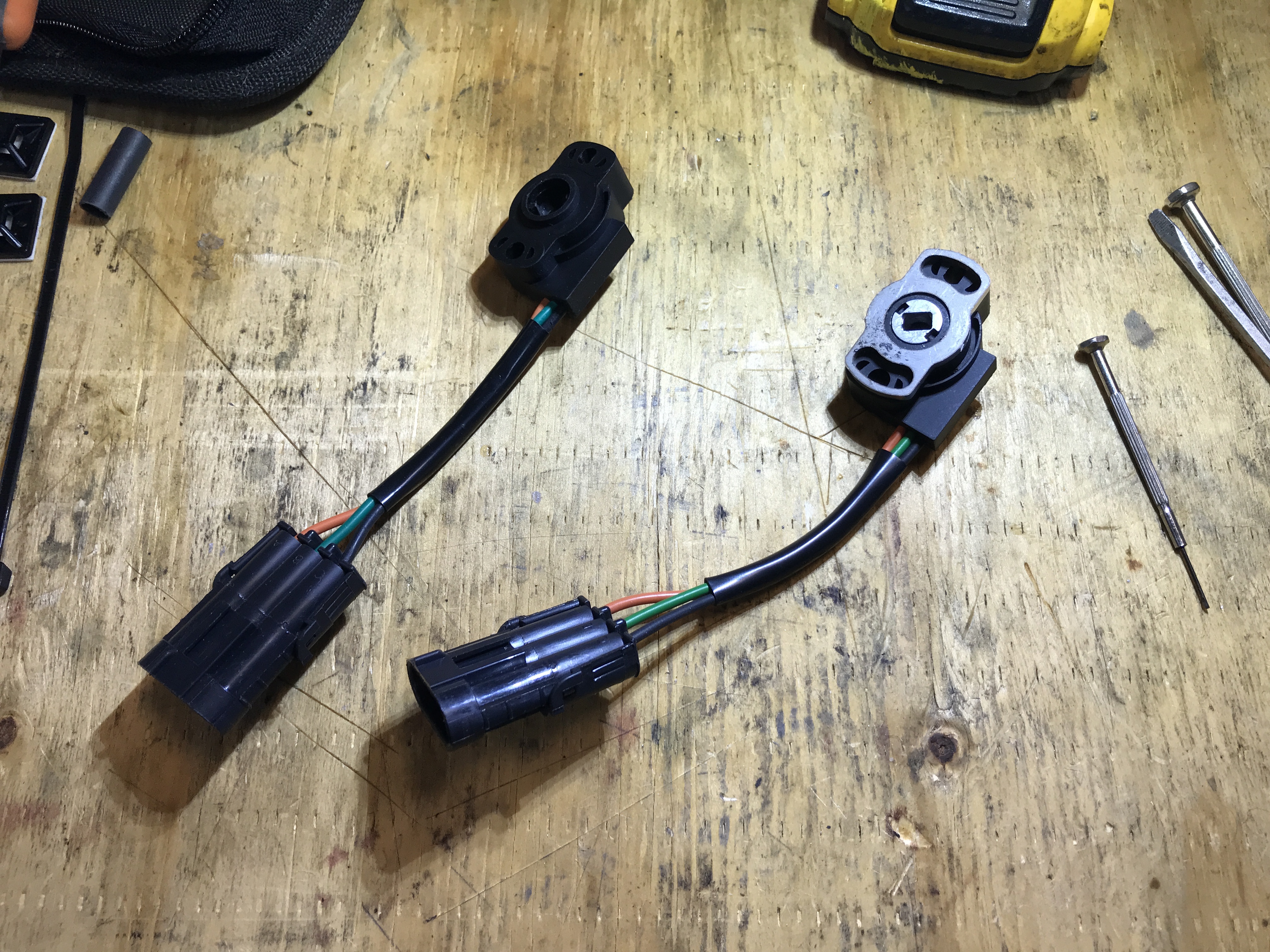

New sensor (on the right) ready to install and test--but dinner time.

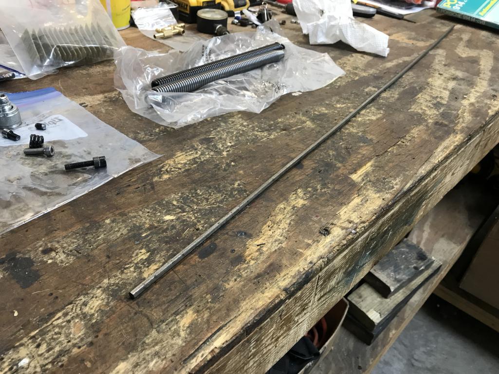

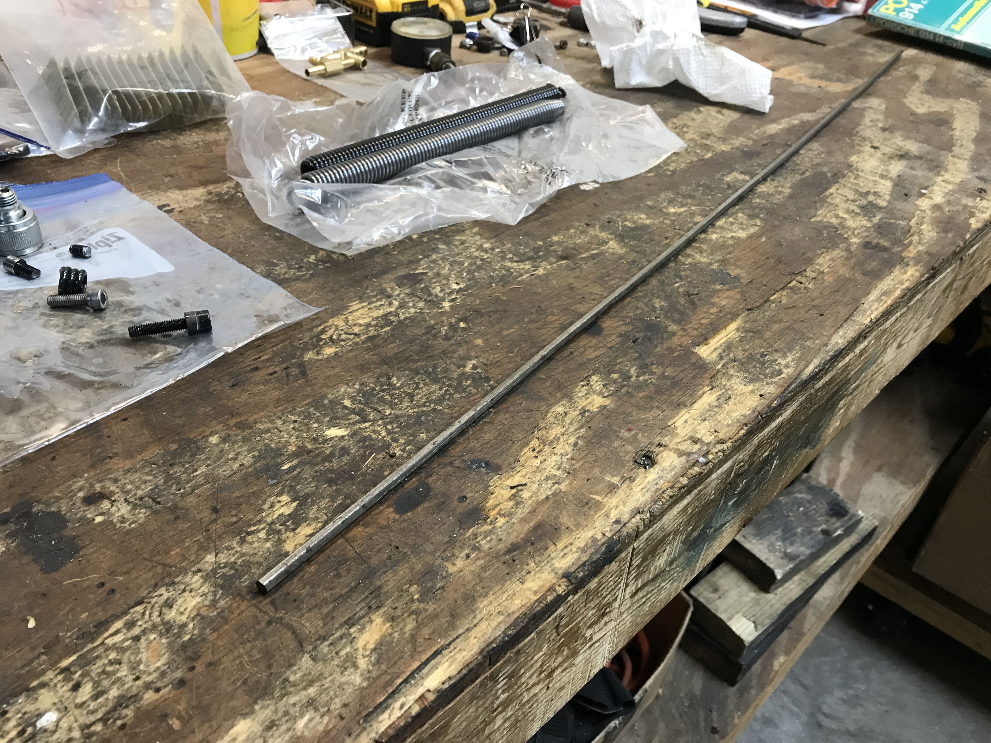

Lots of stuff delivered while I was gone, including a 3 ft length of 5 mm hex. Why?
bkrantz
post Jan 26 2022, 07:50 PM
Post #4703
Posts: 8,530
Joined: 3-August 19
From: SW Colorado
Member No.: 23,343

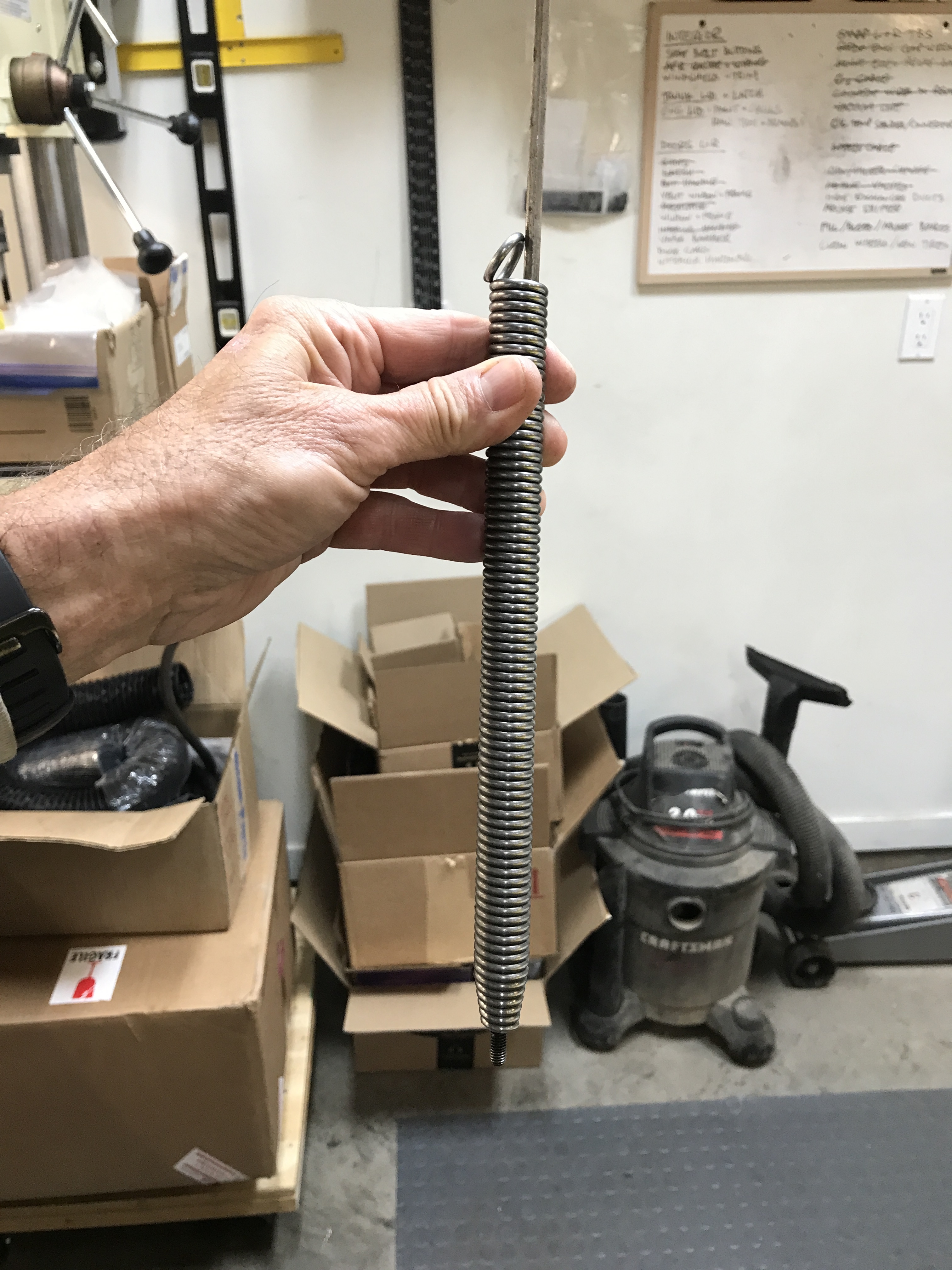

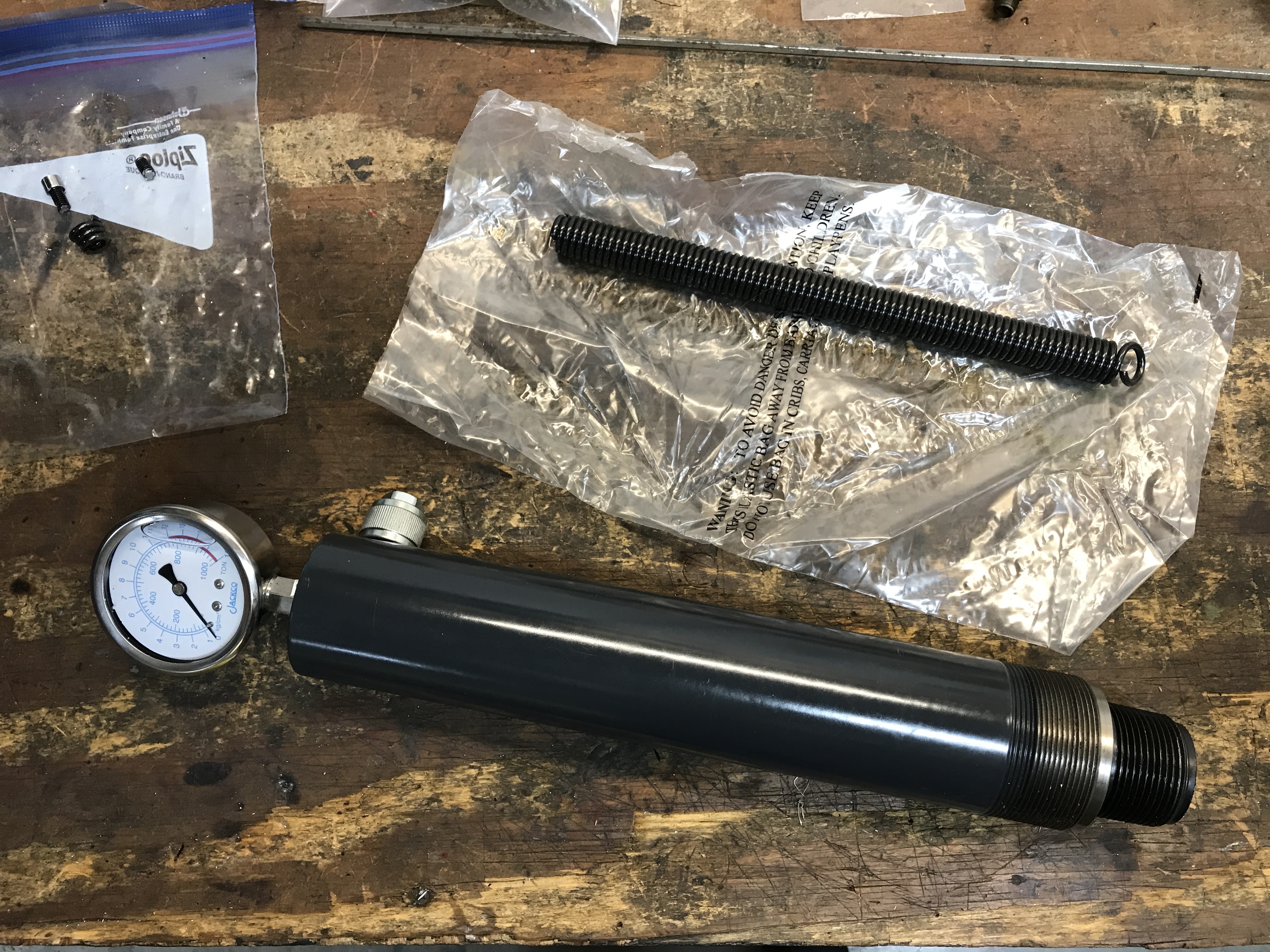

This is a tool to finally repair my hydraulic press. The hex has to reach inside a 12 inch long spring in order to screw down the end retaining Allen bolt. Even the extra-long Allen wrench I have will not reach.

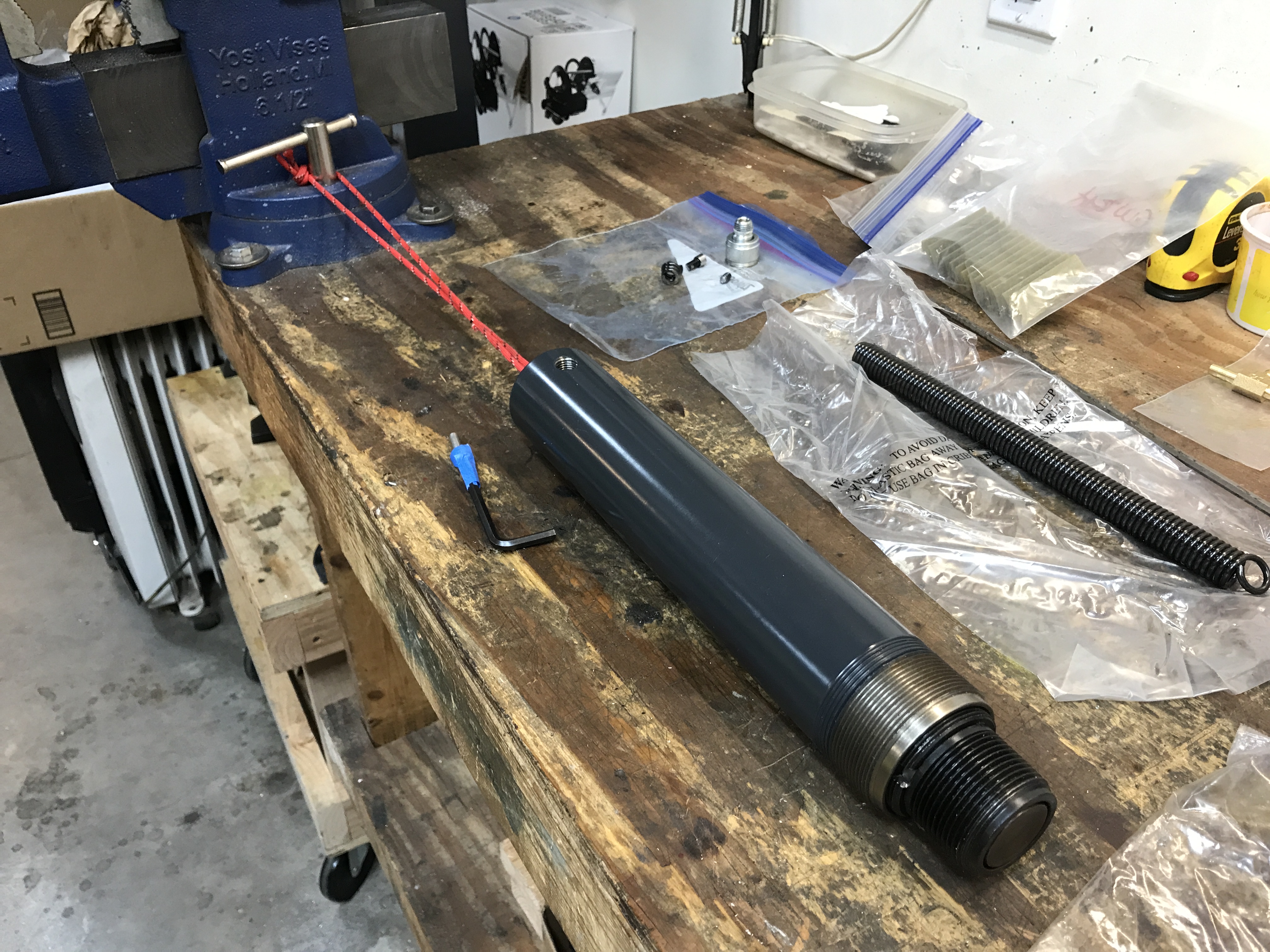

With the spring bolted to the bottom of the piston, and the piston inside the cylinder, the next trick is to pull the spring far enough to screw in the upper anchor. Definitely a three-handed job.
bkrantz
post Jan 26 2022, 07:53 PM
Post #4705
Posts: 8,530
Joined: 3-August 19
From: SW Colorado
Member No.: 23,343
Somehow I got the second Allen bolt in with only two hands.
bkrantz
post Jan 26 2022, 07:54 PM
Post #4706
Posts: 8,530
Joined: 3-August 19
From: SW Colorado
Member No.: 23,343
Piston and cylinder ready.

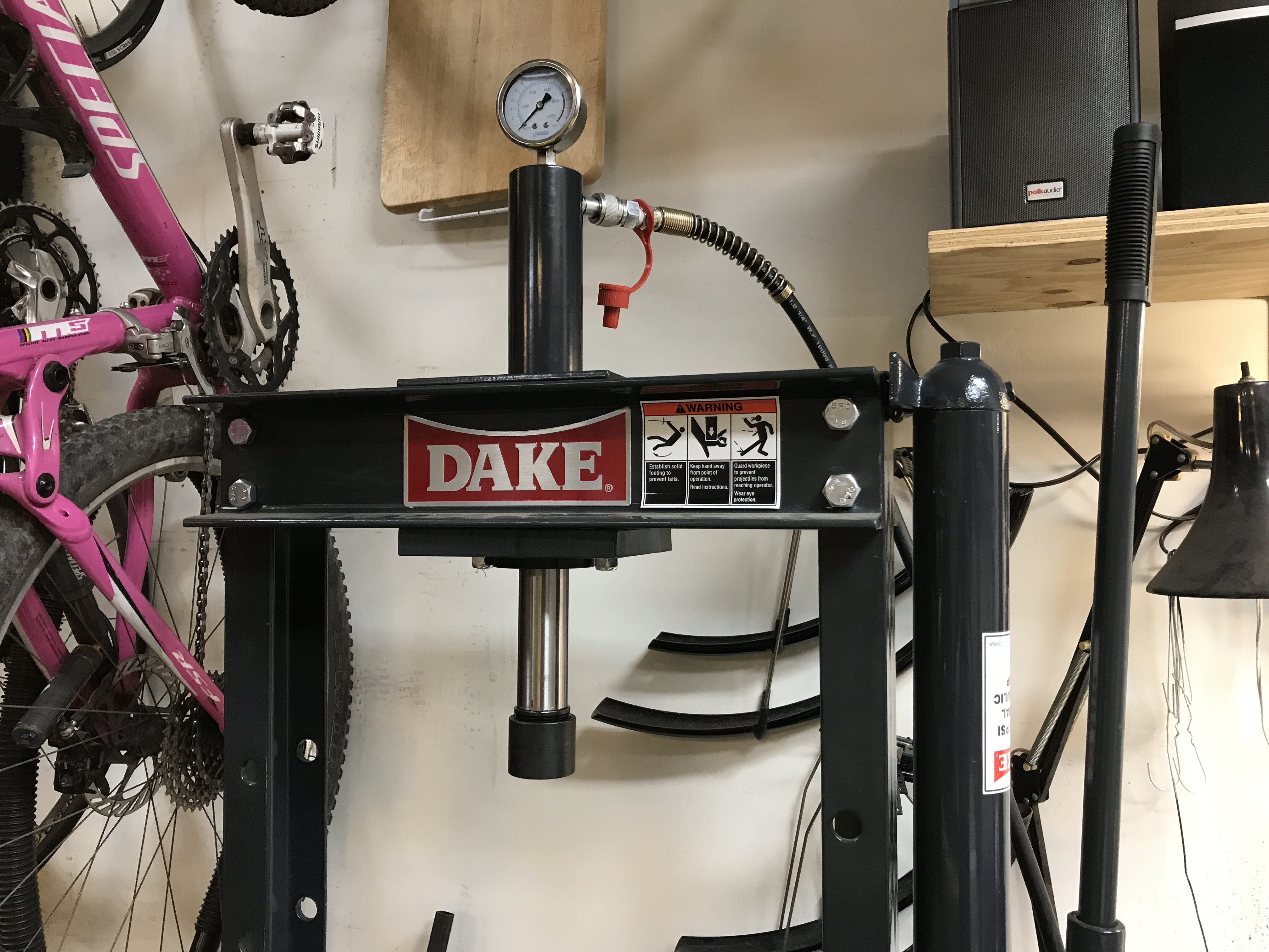

Nice to have the press working again--especially the auto return.

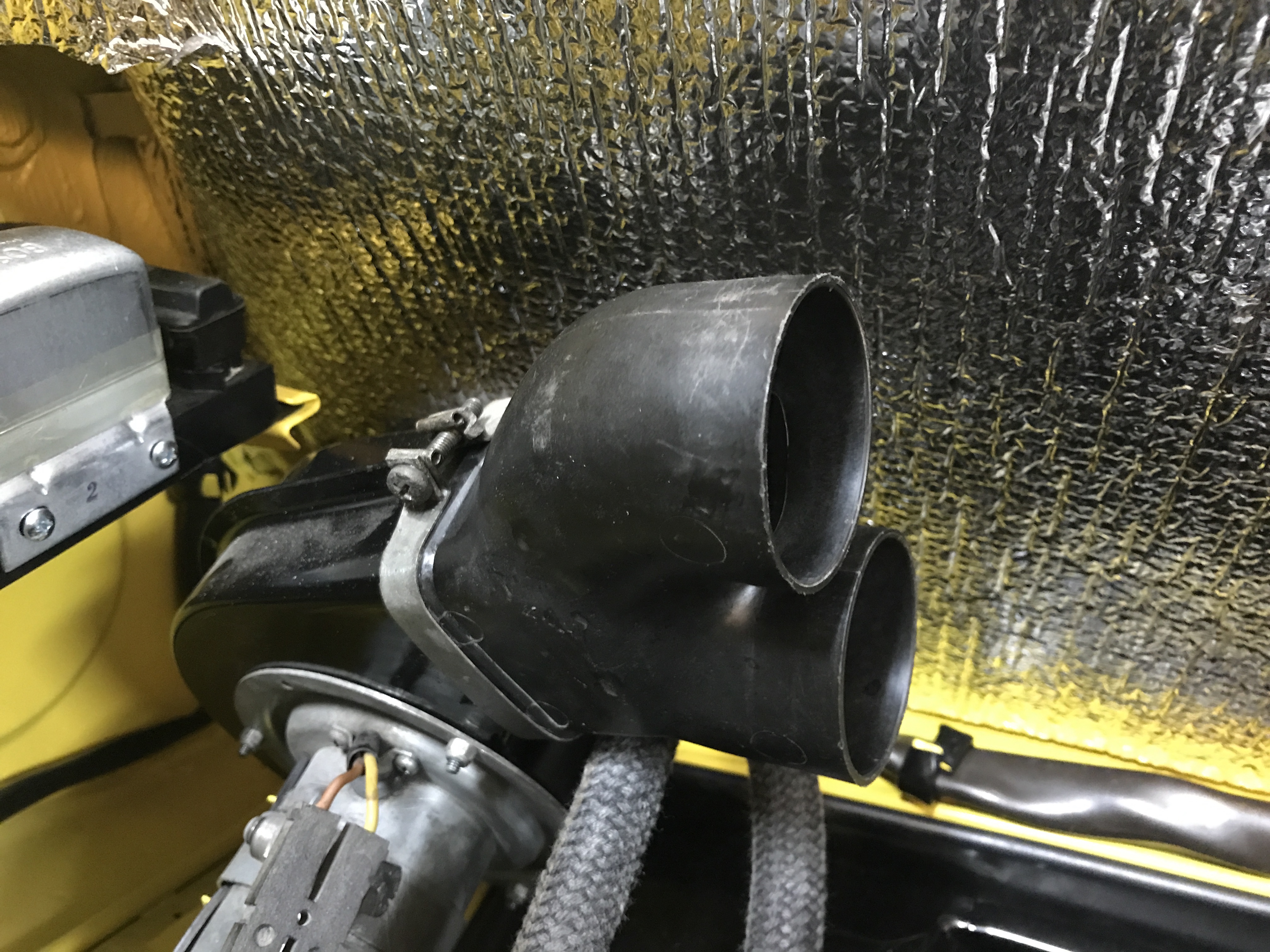

Back to working on the 914. A warm-up with dual outlet for the heater blower.

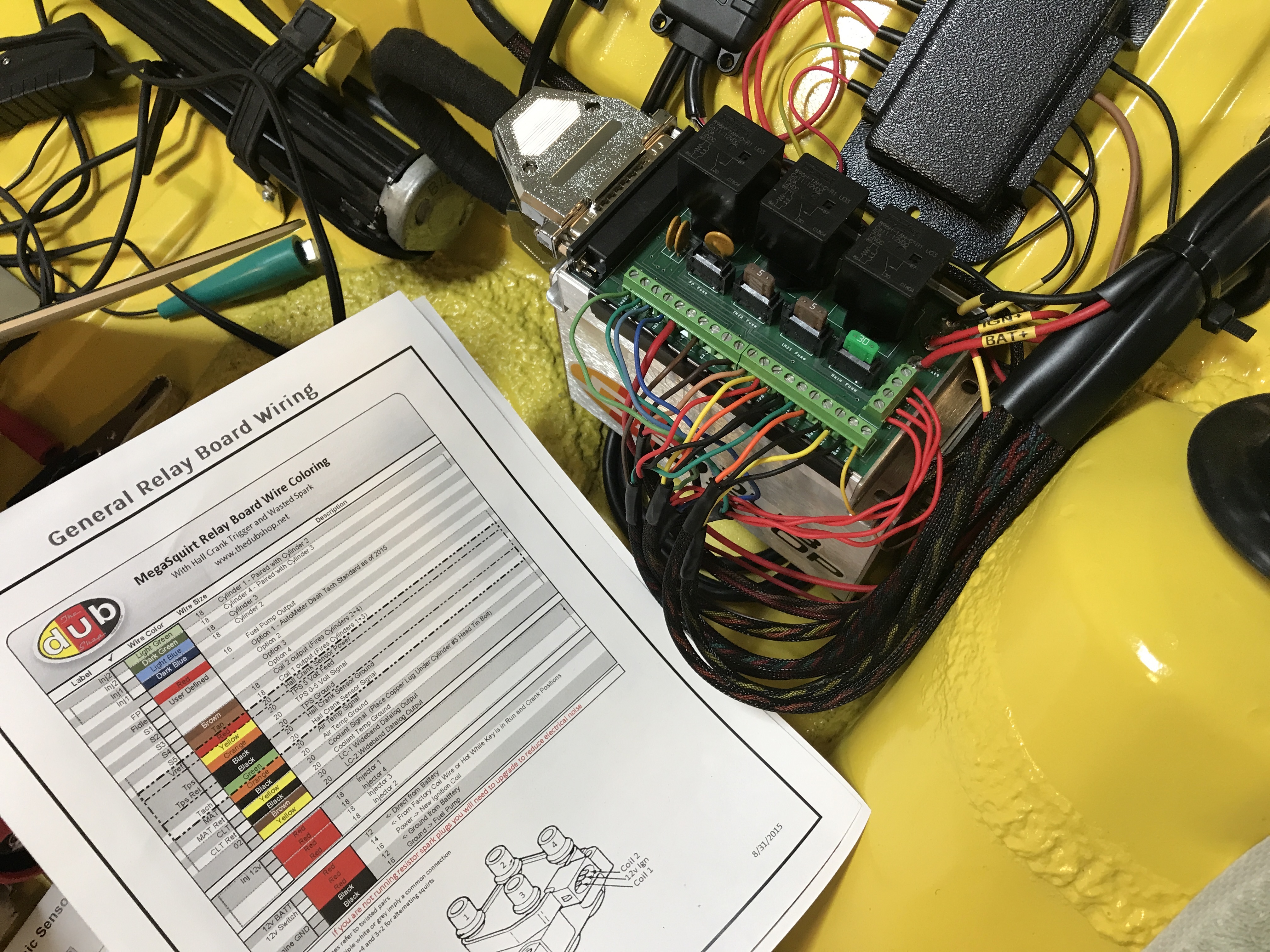

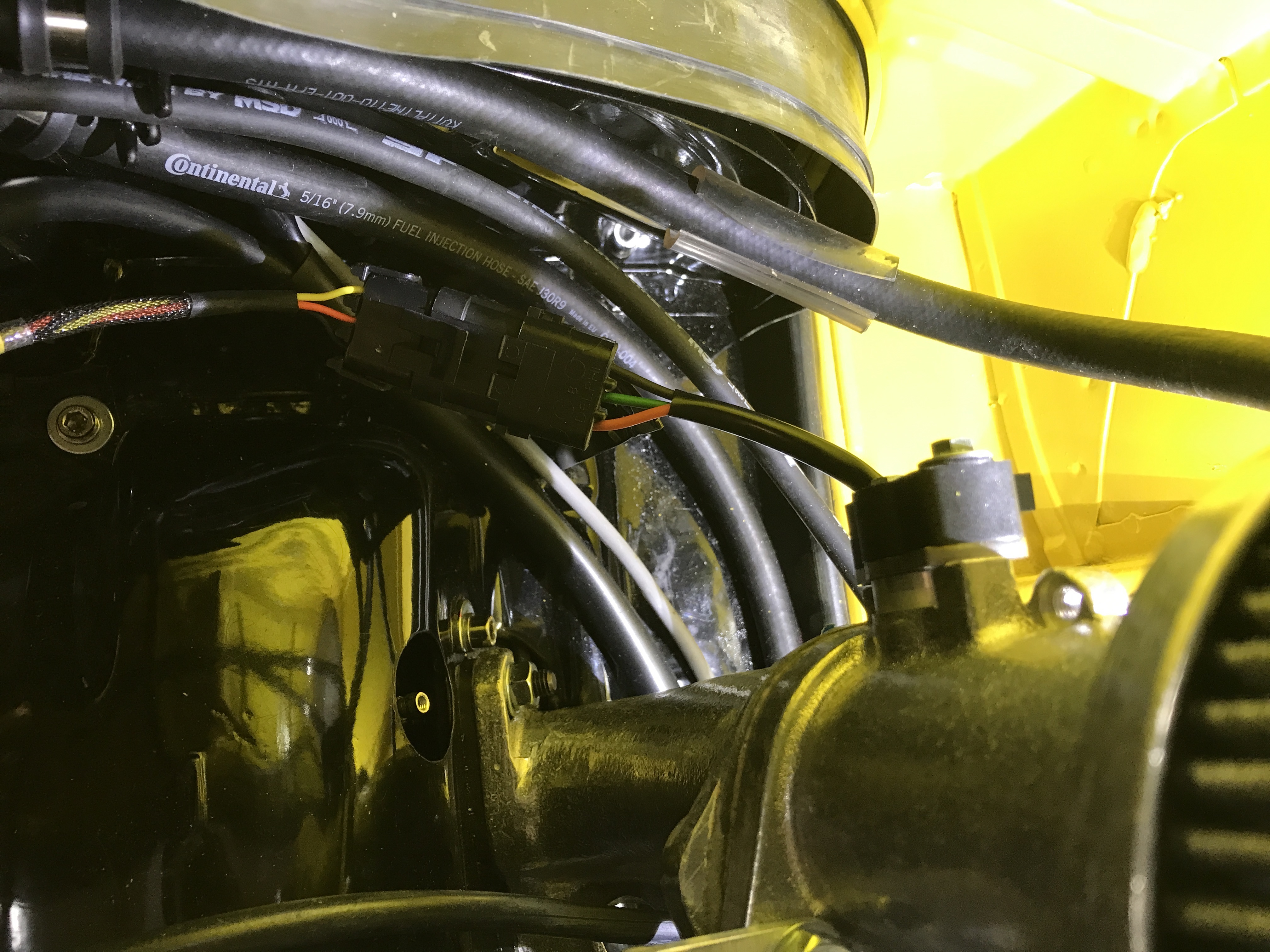

Then I moved the wire leads from the Hall sensor back to where they were in December, to match the one-page diagram of the lead connections (and confirmed by Mario).

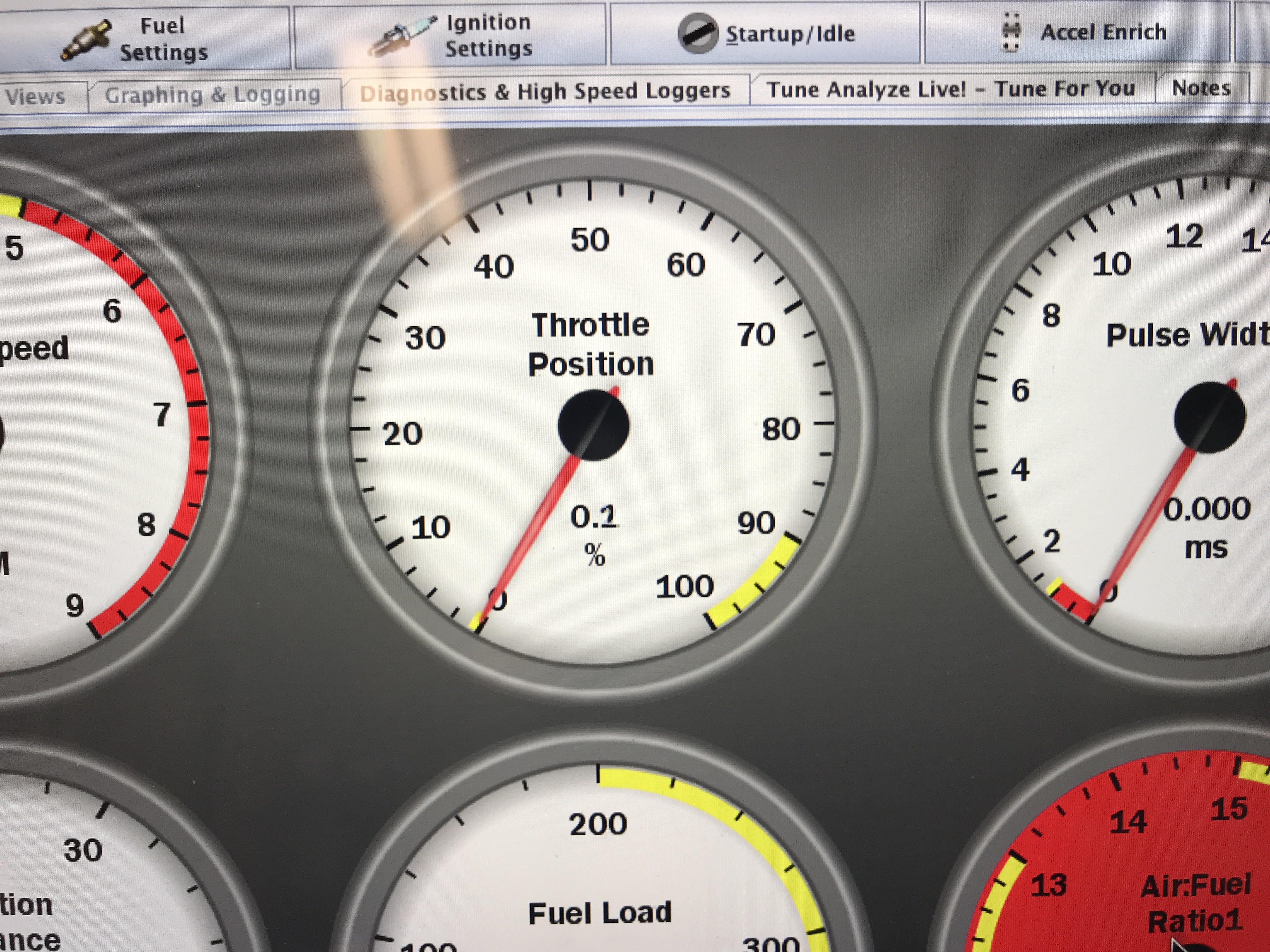

Then it was time to install the replacement throttle position sensor.
bkrantz
post Jan 26 2022, 08:09 PM
Post #4711
Posts: 8,530
Joined: 3-August 19
From: SW Colorado
Member No.: 23,343
It works! A quick calibration, and now I have consistent 0 to 100% opening.
I then tested the ignition spark with a spare plug, and now have a healthy spark with the engine cranking.
While on a roll I hooked up my timing light and tried to check the static timing, again with the engine cranking, but could not get a consistent light flash.

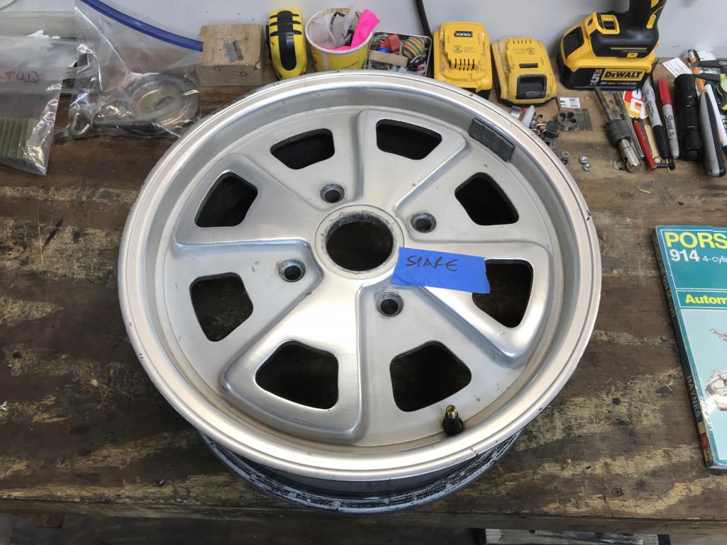

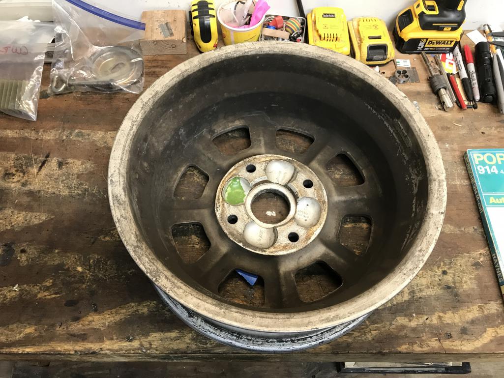

Just a few minutes to play 914 today. I did stop by a tire shop to have one tire removed, from the wheel that will be my spare. This rim has the worst curb rash.
bkrantz
post Jan 28 2022, 08:09 PM
Post #4713
Posts: 8,530
Joined: 3-August 19
From: SW Colorado
Member No.: 23,343

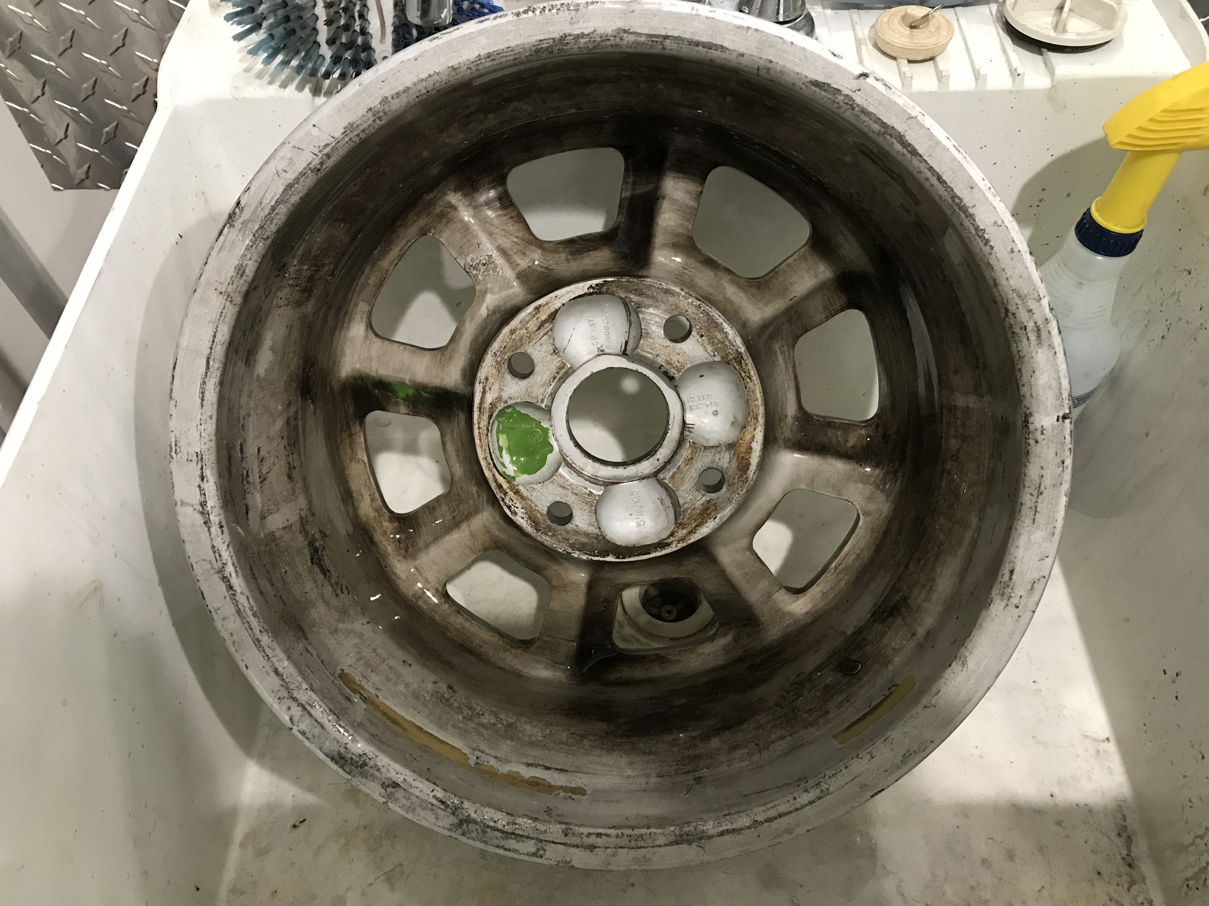

The inside has many years of road crud.
bkrantz
post Jan 28 2022, 08:10 PM
Post #4714
Posts: 8,530
Joined: 3-August 19
From: SW Colorado
Member No.: 23,343
After a quick clean, first with detergent and then Simple Green. Still some work to do.

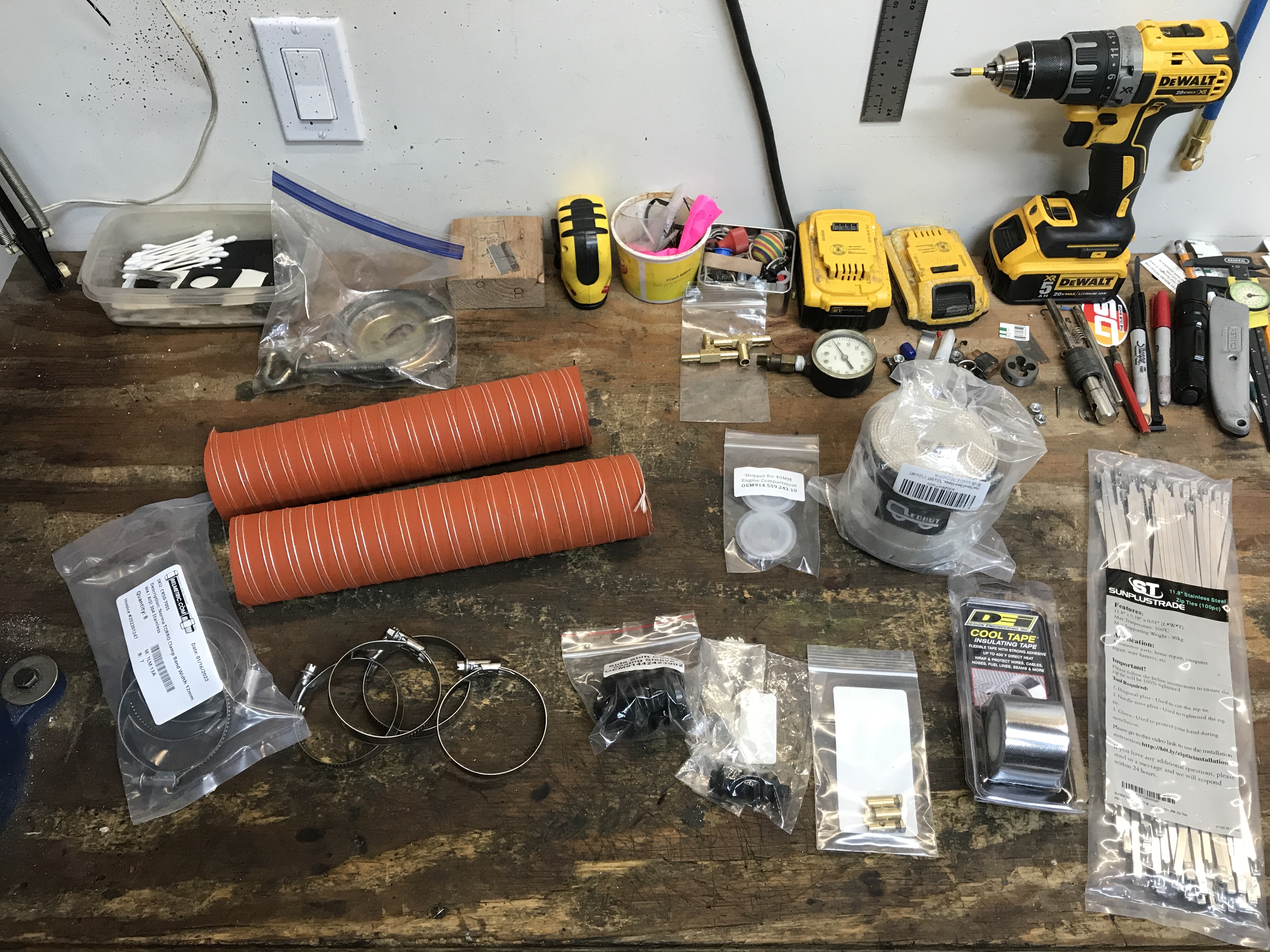

Andmore new stuff, mostly small parts.

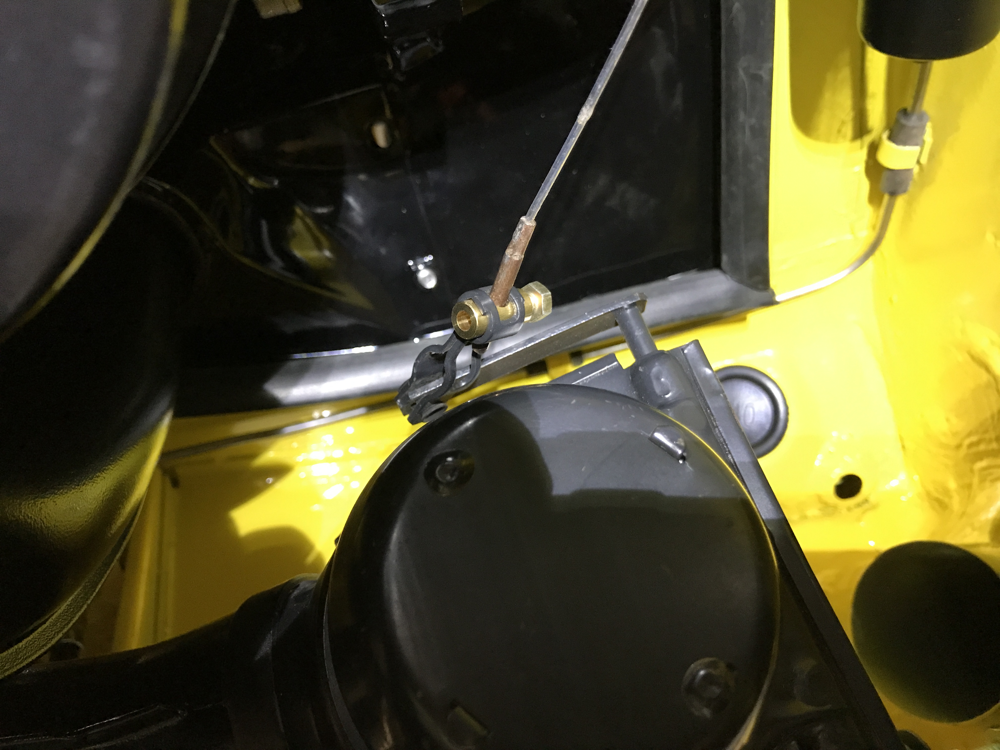

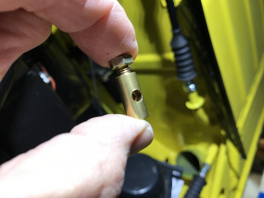

Back under the car, with a new barrel clamp.
bkrantz
post Jan 29 2022, 08:49 PM
Post #4719
Posts: 8,530
Joined: 3-August 19
From: SW Colorado
Member No.: 23,343
That goes on the left heat control box.

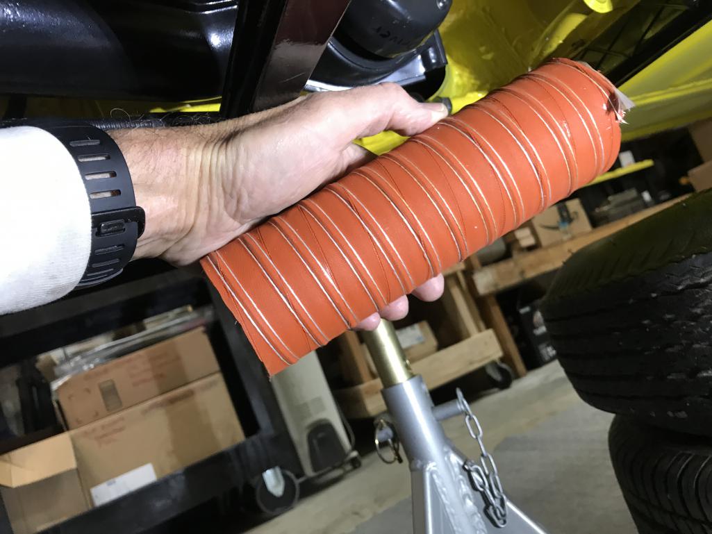

Then a length of high temp hose, cut down to fit.
