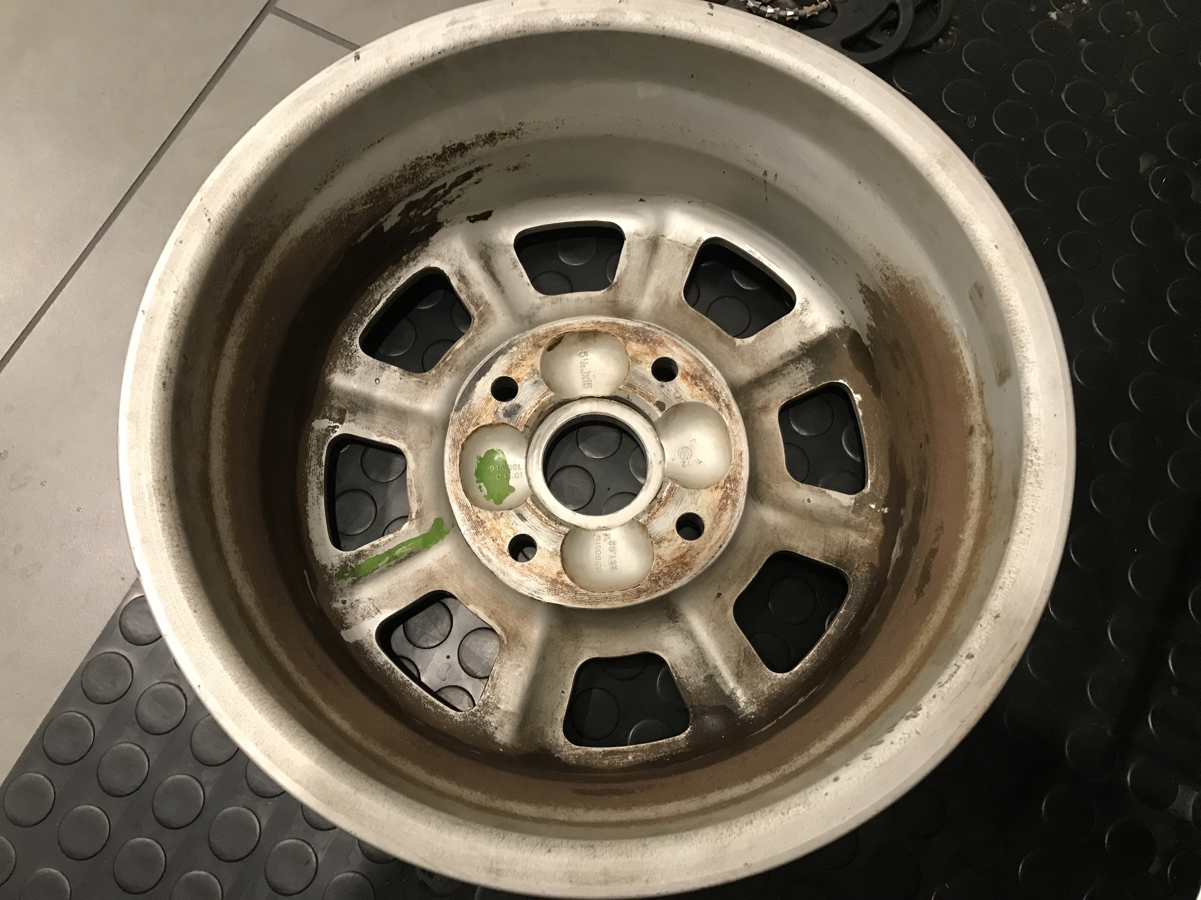

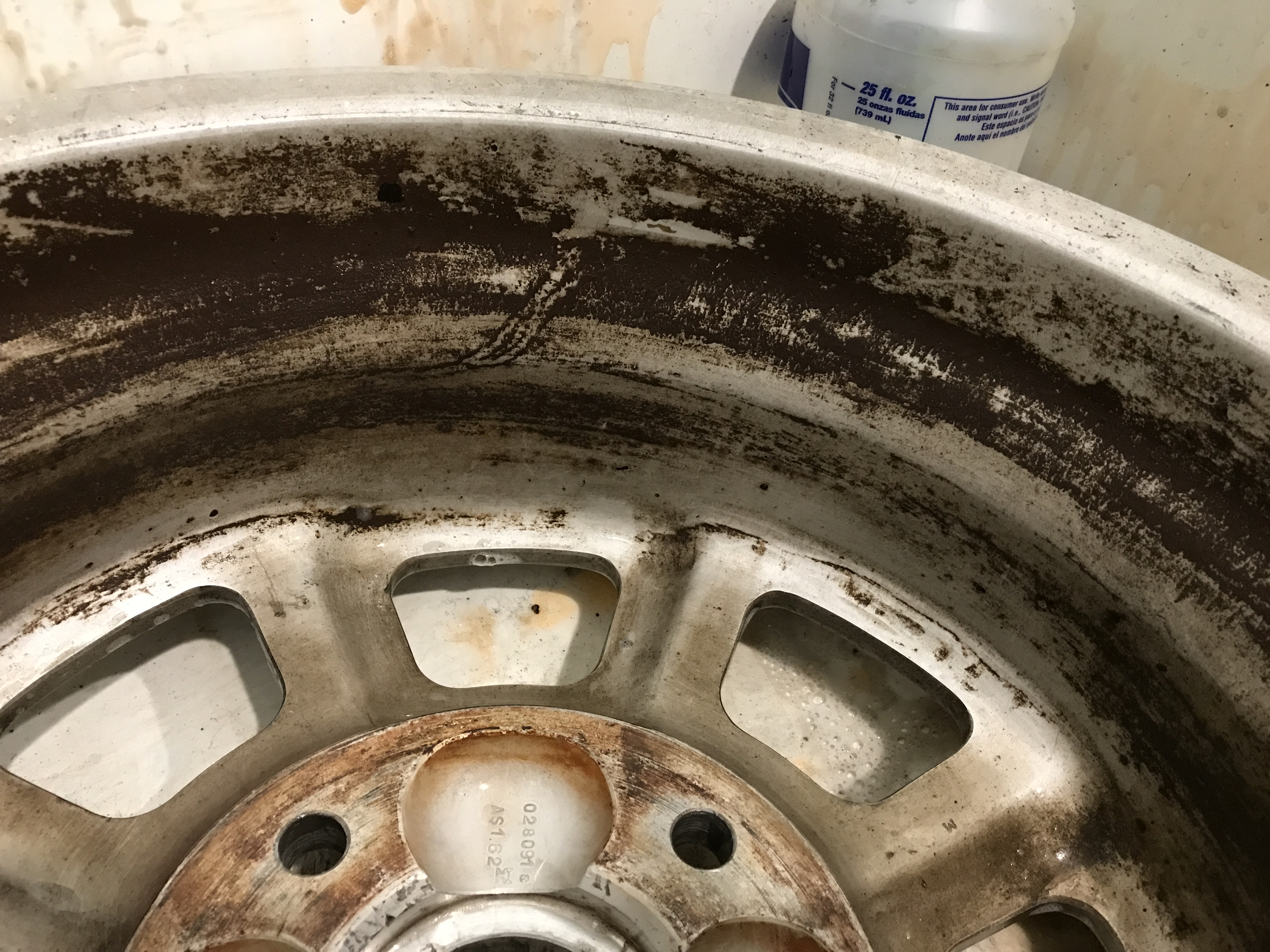

Step 6: Attack the crud inside the wheel with cleaner. Note, this wheel and one other have a pretty solid coat of hardened brown crud.
bkrantz
post Feb 5 2022, 09:43 PM
Post #4783
Posts: 8,530
Joined: 3-August 19
From: SW Colorado
Member No.: 23,343

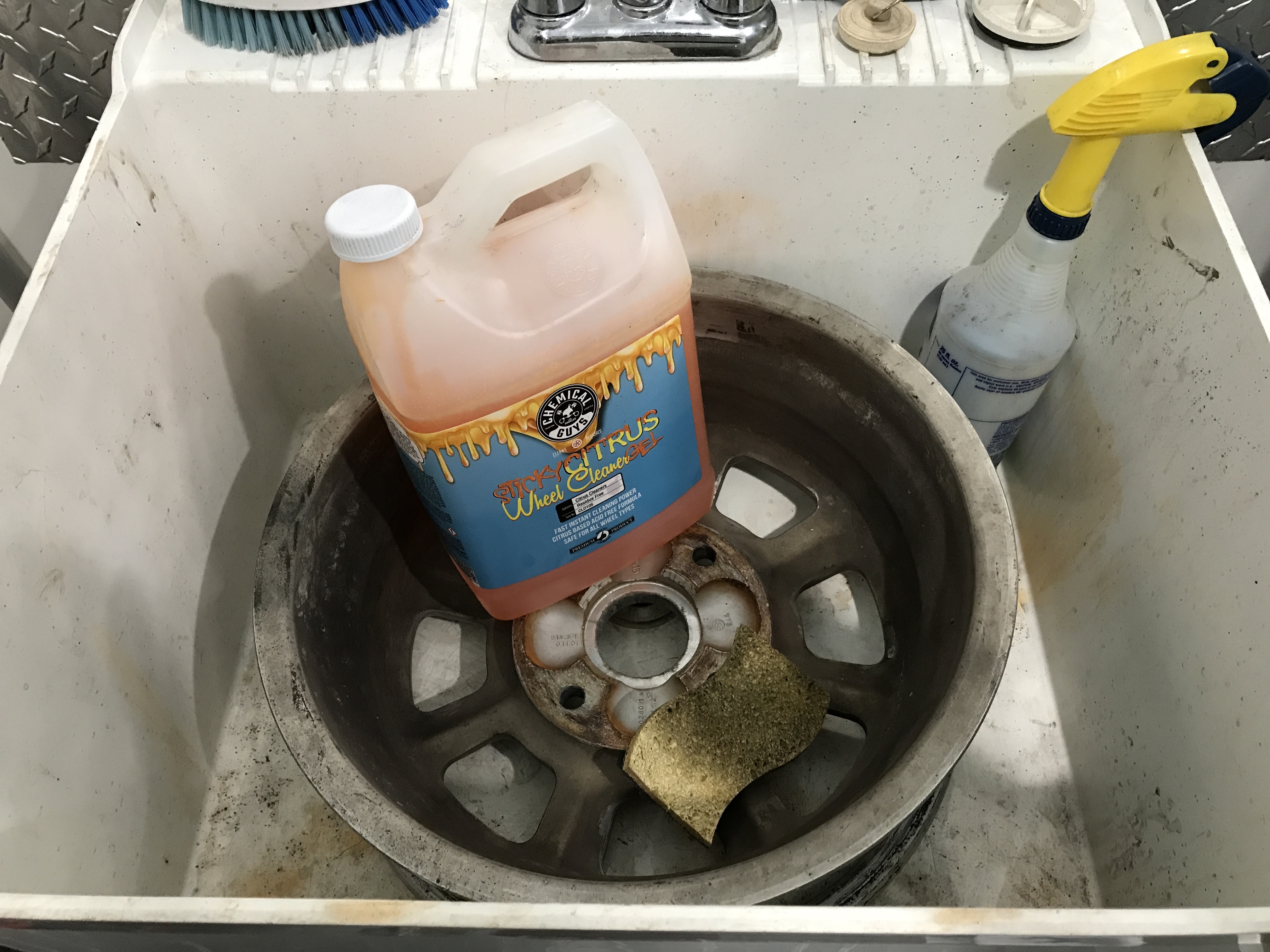

I tried letting the cleaner sit for about 20 minutes, and then scrubbing with a Scotch Brite sponge. A lot of scrubbing.
bkrantz
post Feb 5 2022, 09:45 PM
Post #4784
Posts: 8,530
Joined: 3-August 19
From: SW Colorado
Member No.: 23,343

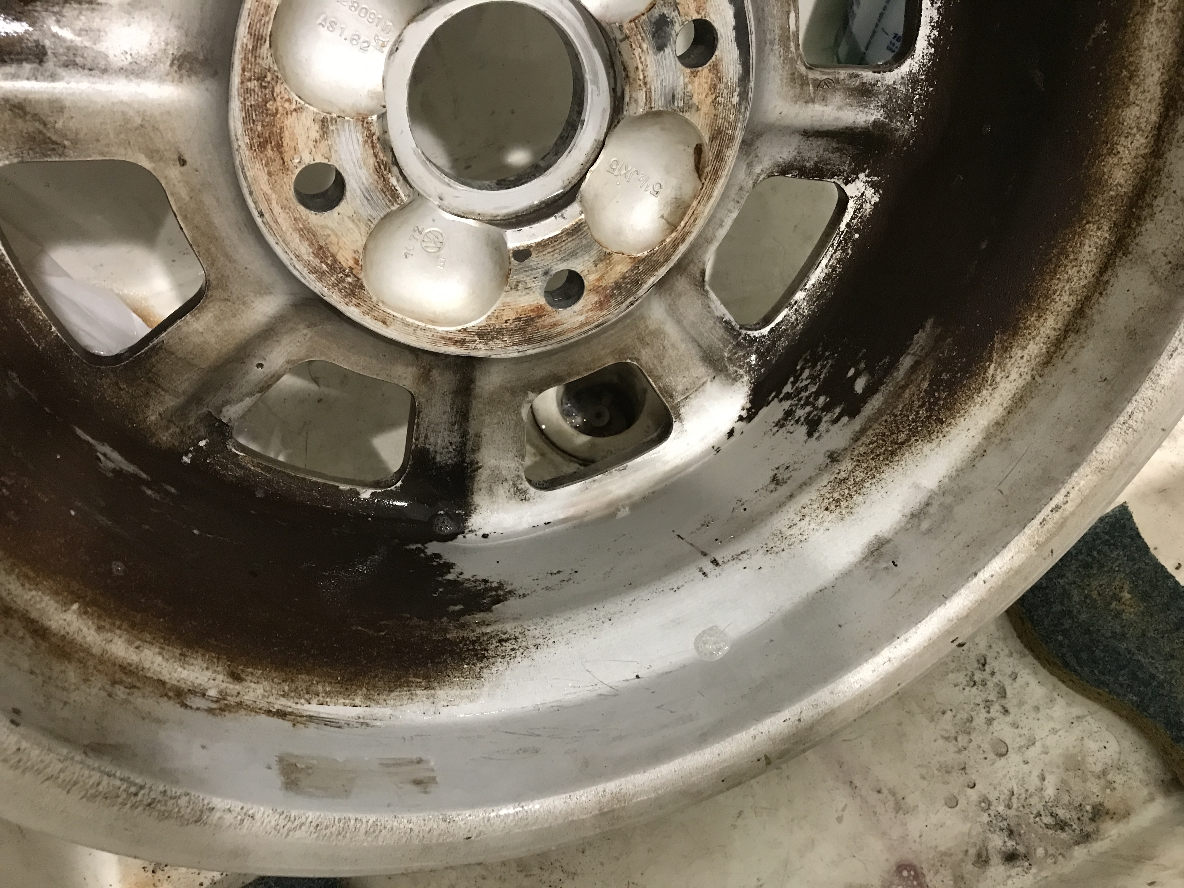

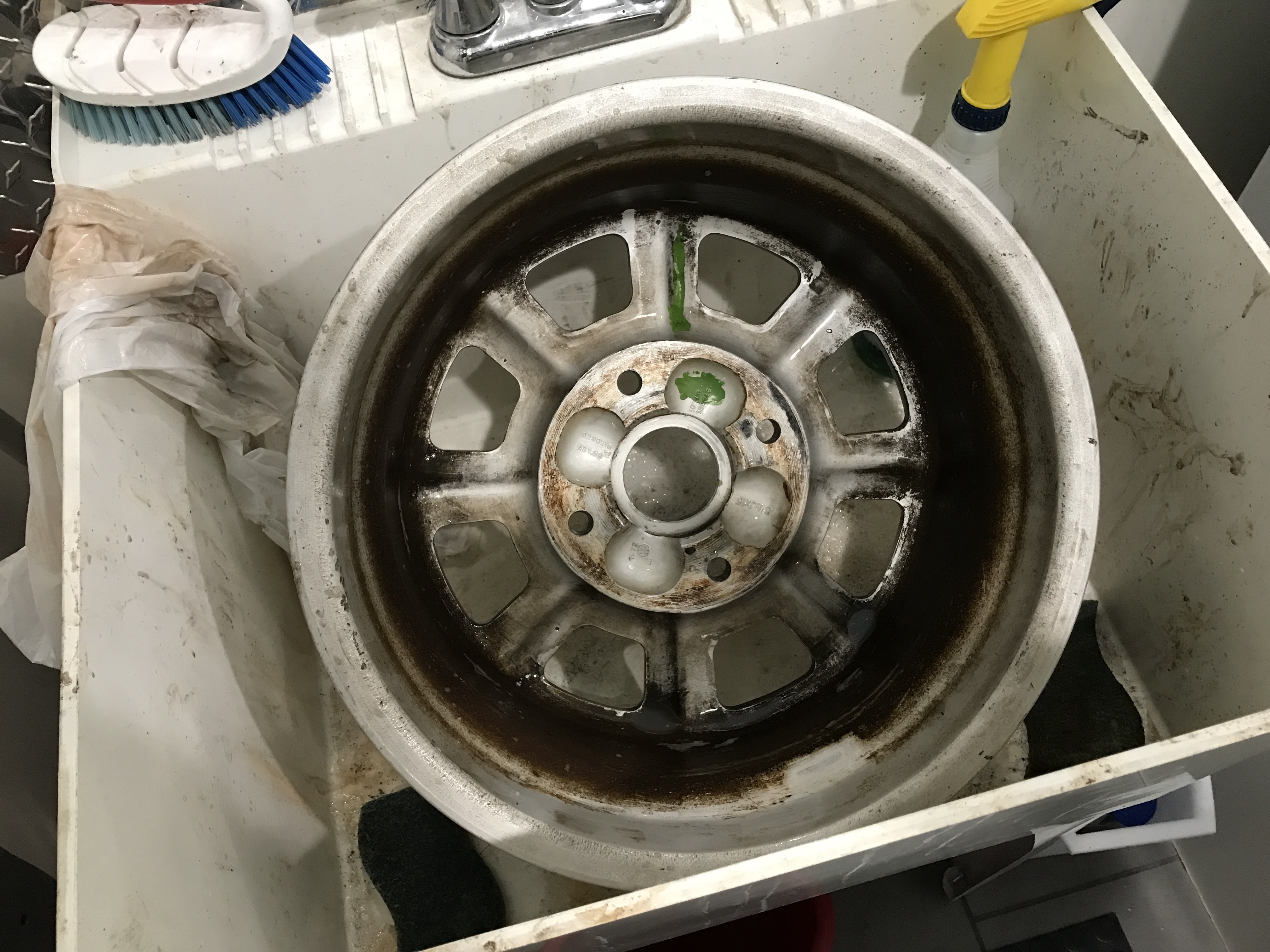

After about an hour of scrubbing, this is what I got: partly cleaned but still lots of hard crud.
bkrantz
post Feb 5 2022, 09:46 PM
Post #4785
Posts: 8,530
Joined: 3-August 19
From: SW Colorado
Member No.: 23,343

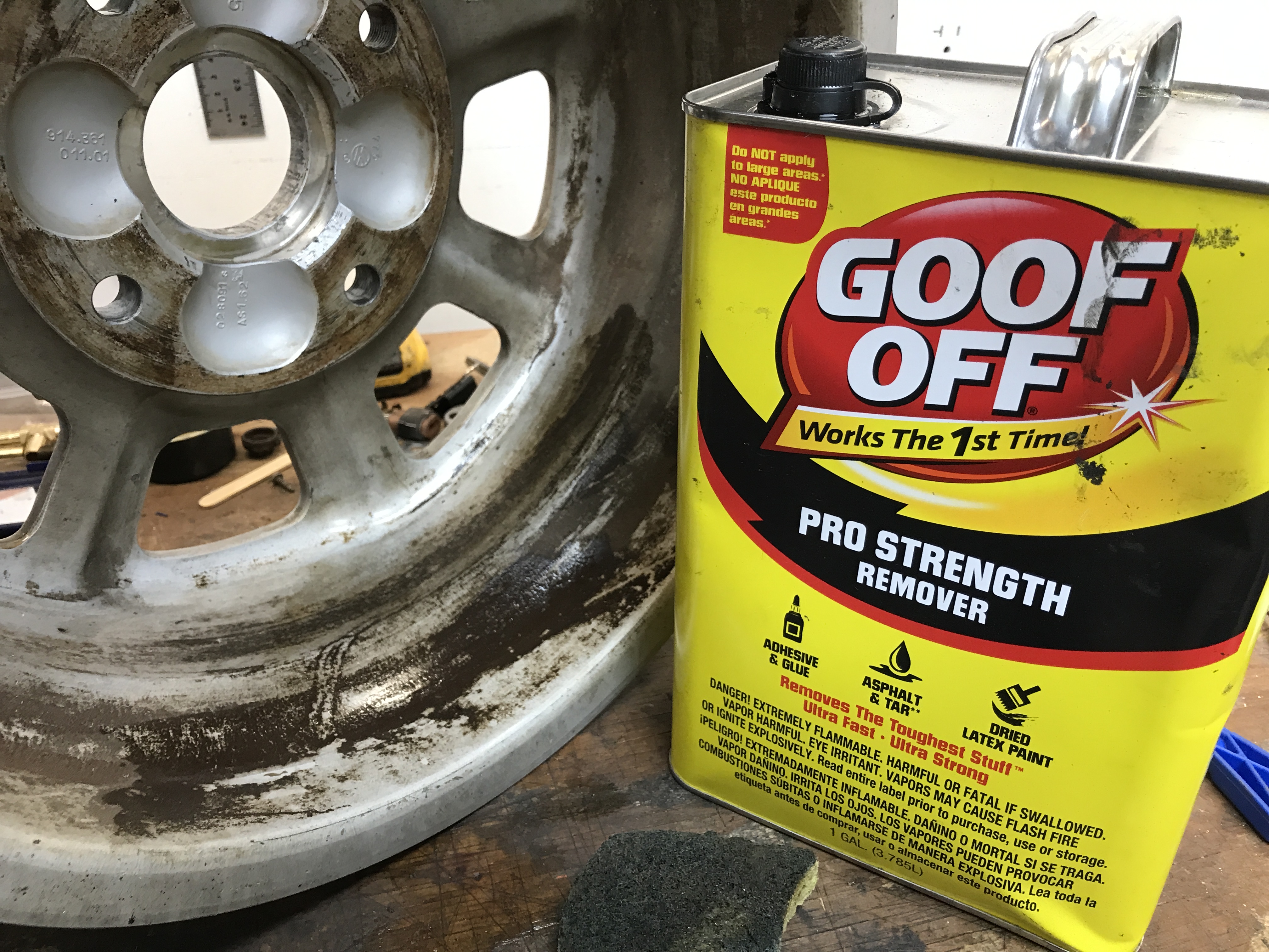

So, Step 7: I tried some more Goof Off. Nothing.

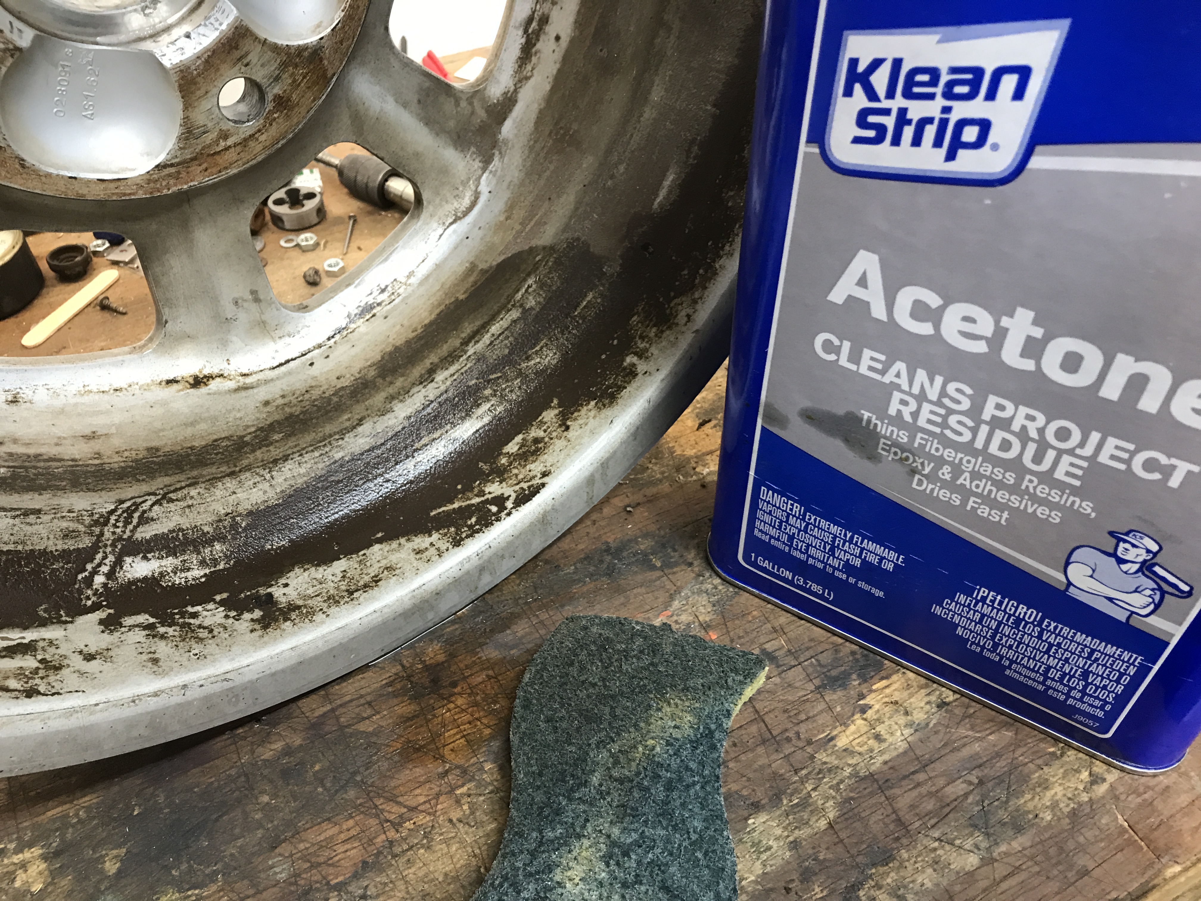

Step 8: acetone, no effect.

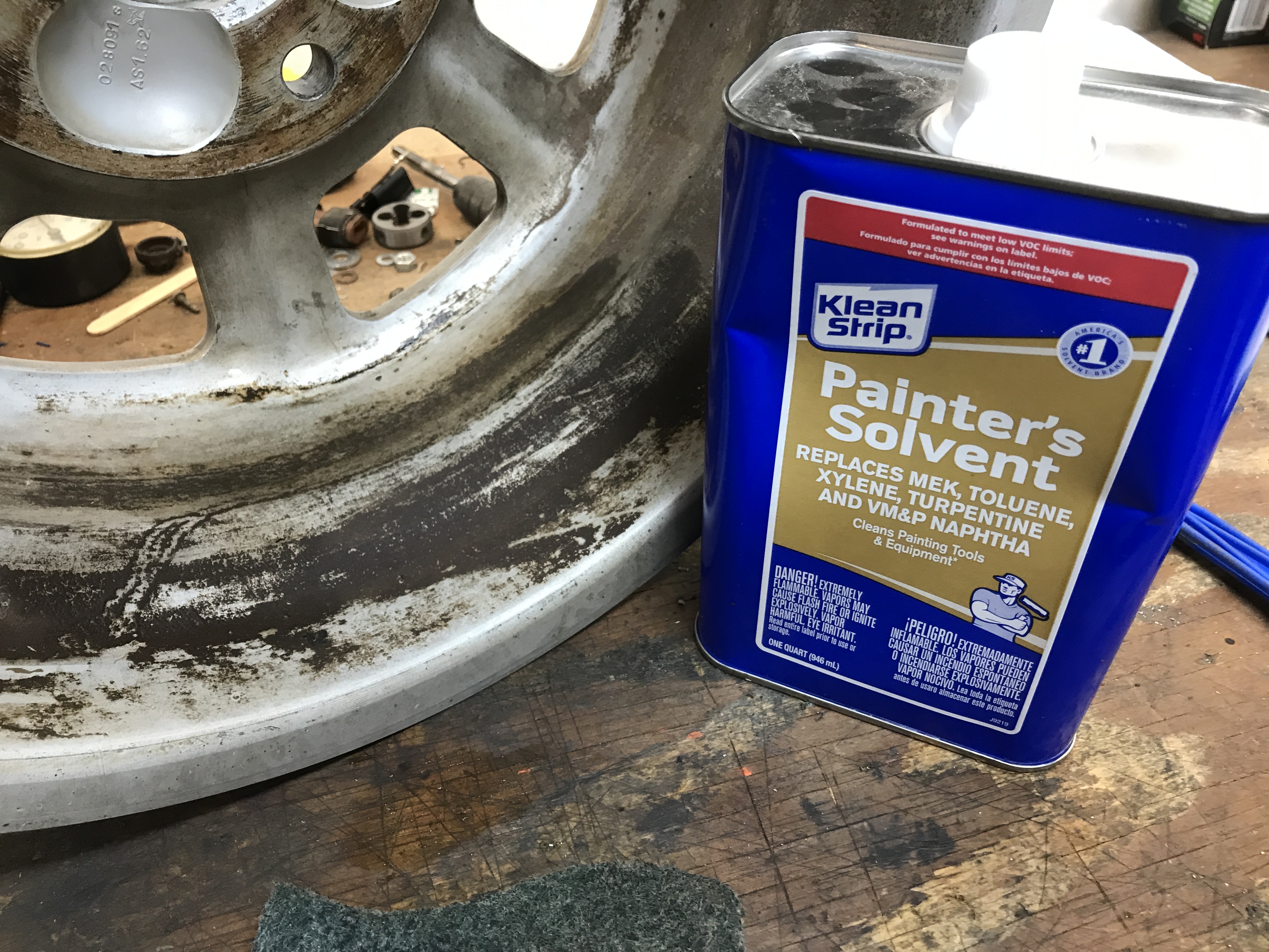

Step 9: painters solvent, no effect.

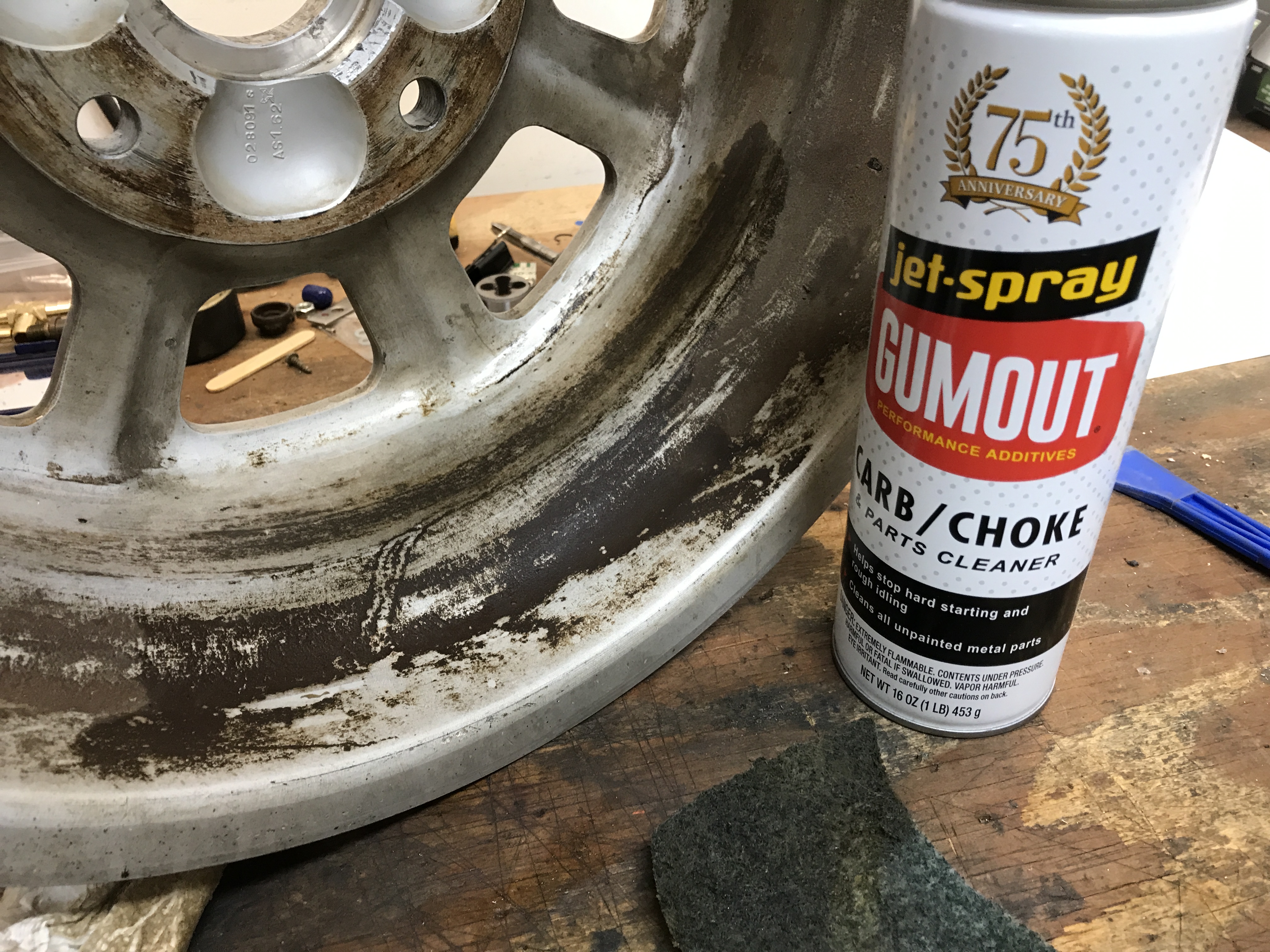

Step 10: Gumout, no effect.

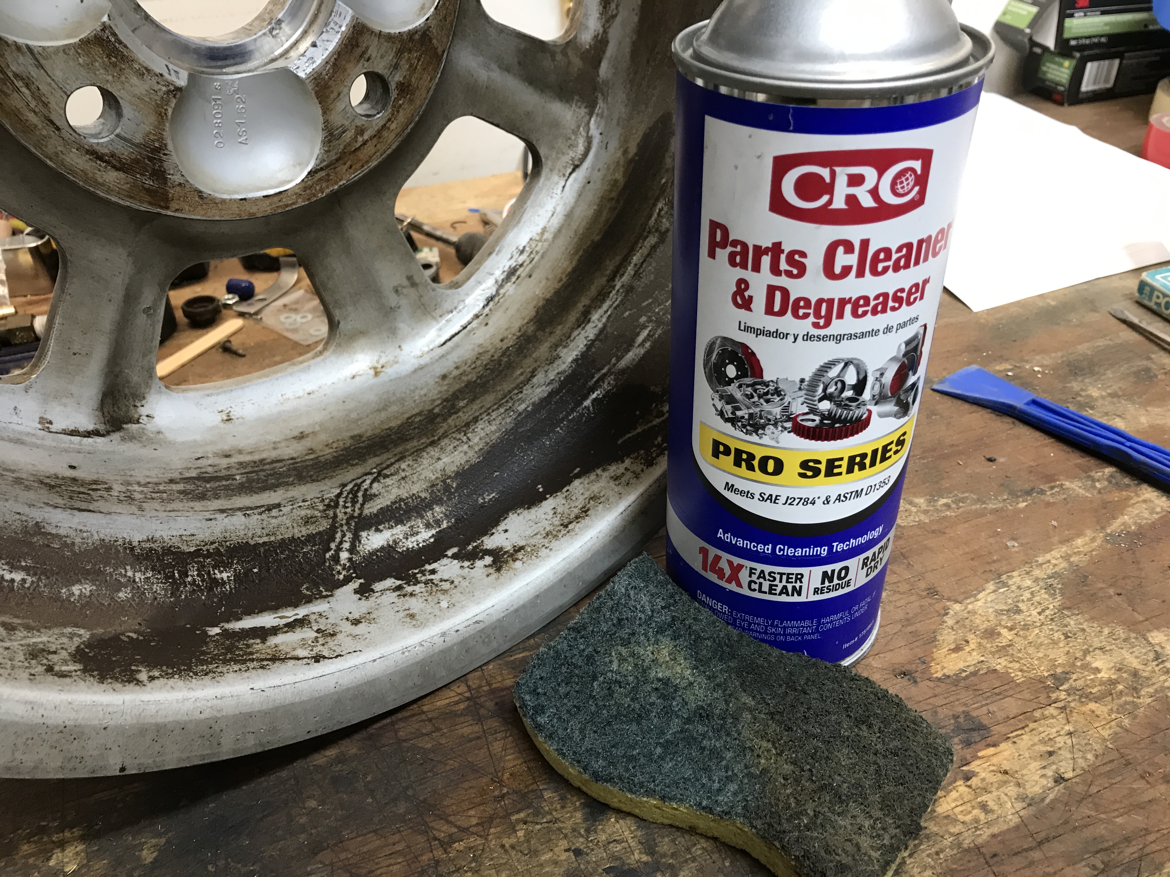

Step 12: parts cleaner, no effect.

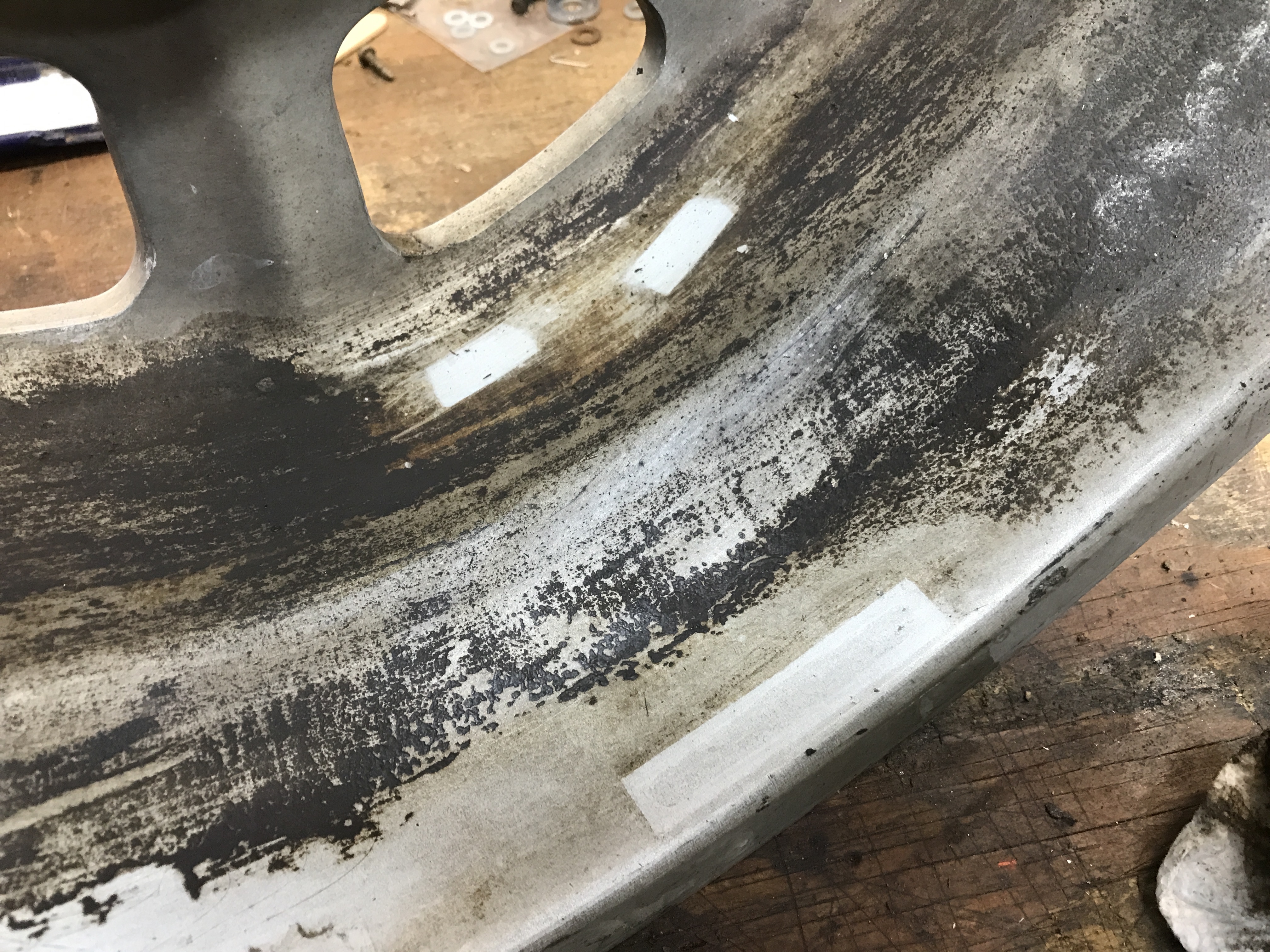

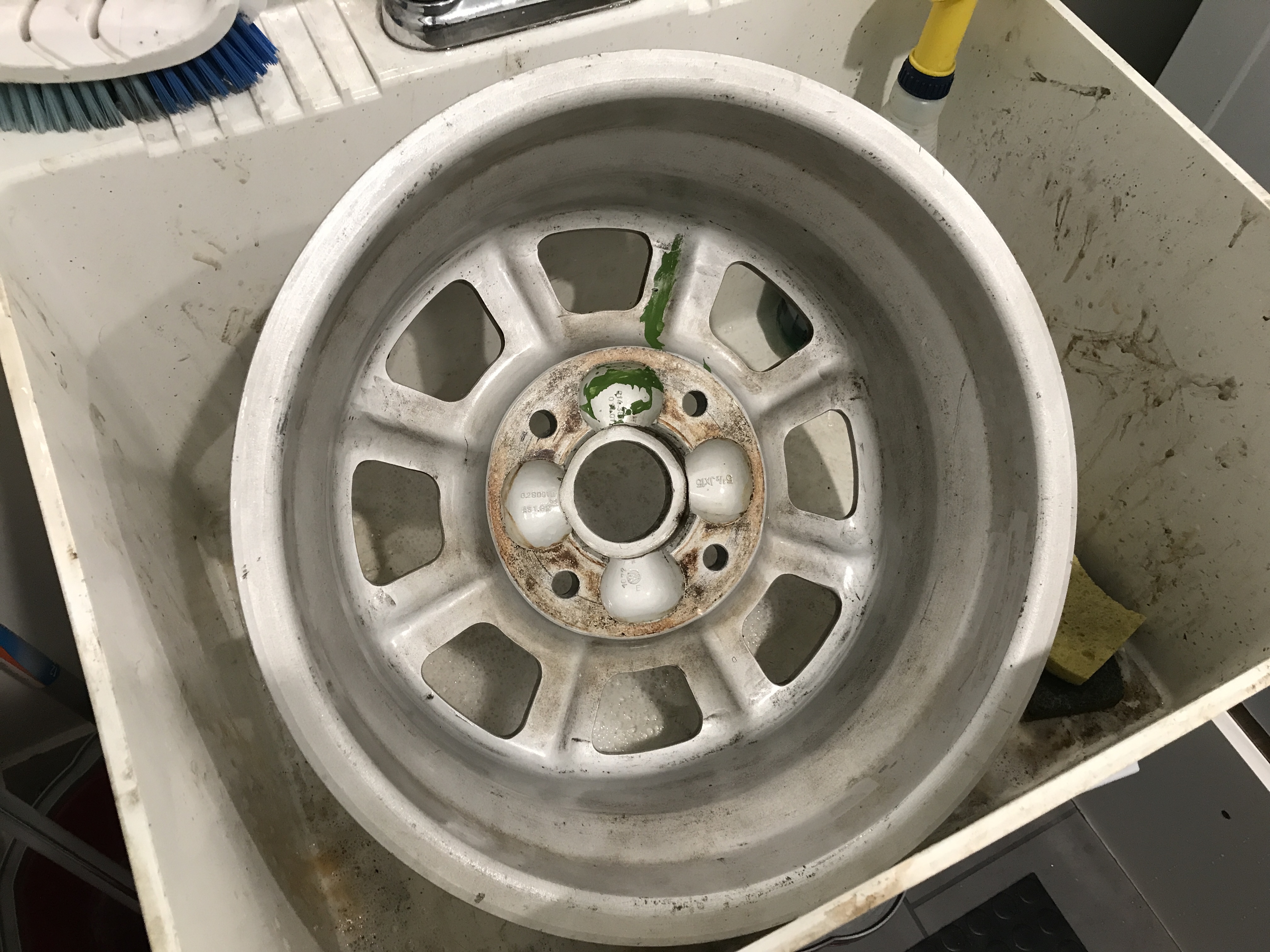

I decided to attack the remaining wheel that had "normal" dirt. About 45 minutes with the wheel cleaner got this.

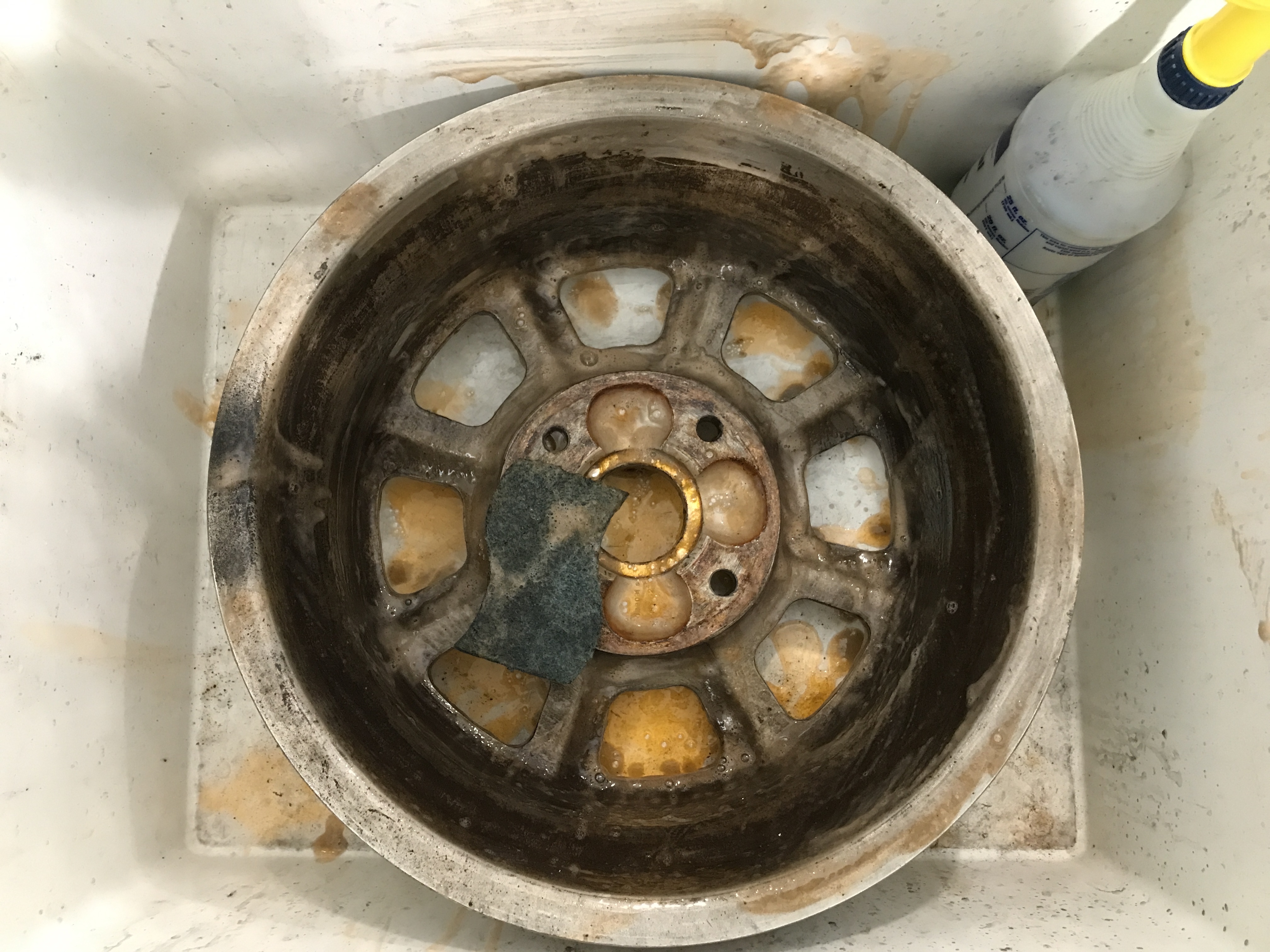

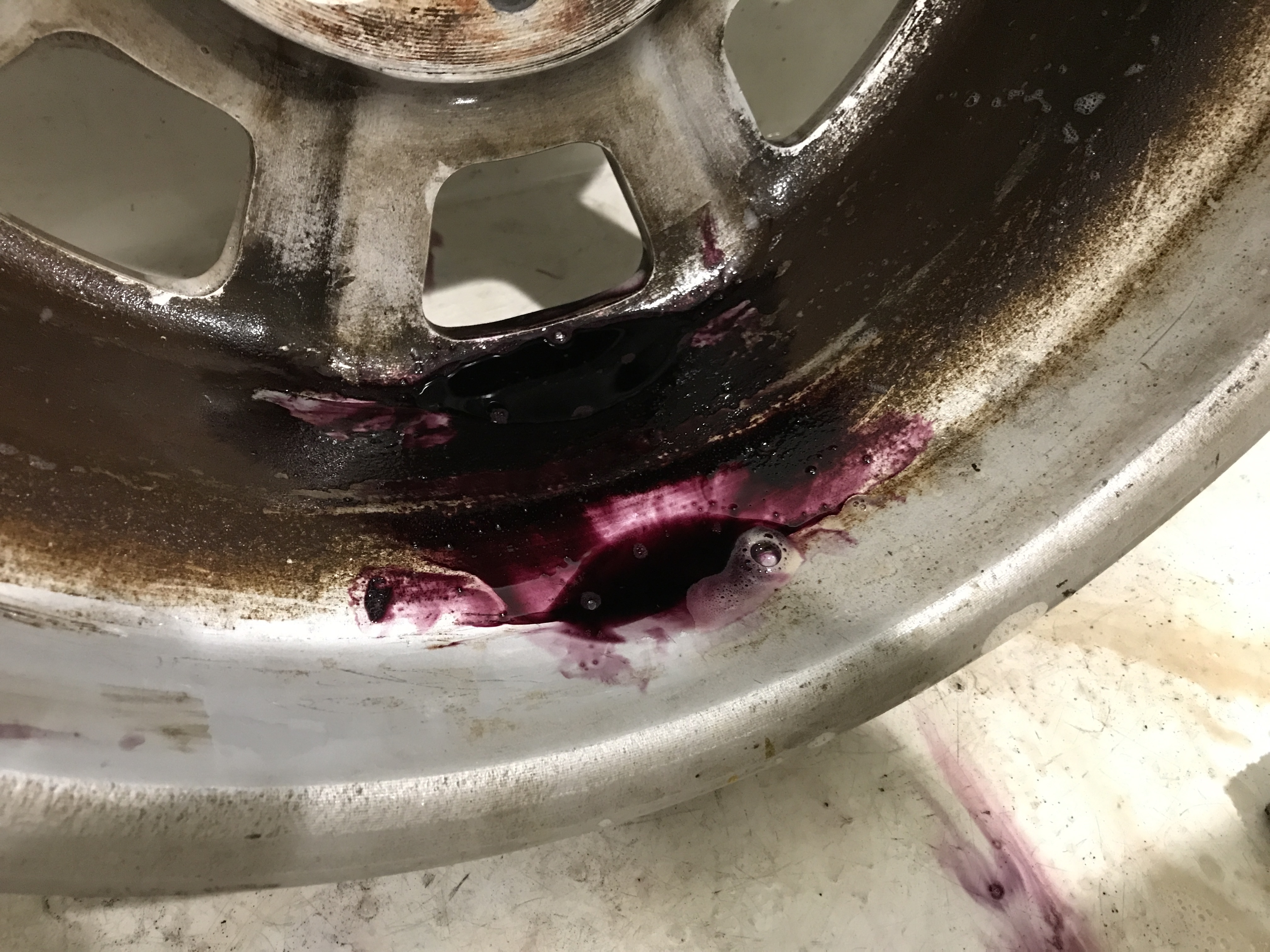

Based on something I found on the web, I tried one more material: iron removing liquid. I think this is based on the idea that the crud is a mix of dust from the disk, pads, and road grime.
bkrantz
post Feb 6 2022, 08:11 PM
Post #4795
Posts: 8,530
Joined: 3-August 19
From: SW Colorado
Member No.: 23,343
First application: as it works, it turns purple. It also smells pretty bad, like old-fashioned hair salon perm fluid.
bkrantz
post Feb 6 2022, 08:12 PM
Post #4796
Posts: 8,530
Joined: 3-August 19
From: SW Colorado
Member No.: 23,343
After 3 cycles of Iron-X, scrubbing, and rinsing. It works!

Unfortunately, my bottle of Iron-X was almost empty, so I only got about one-fourth the way around. More stuff ordered.
