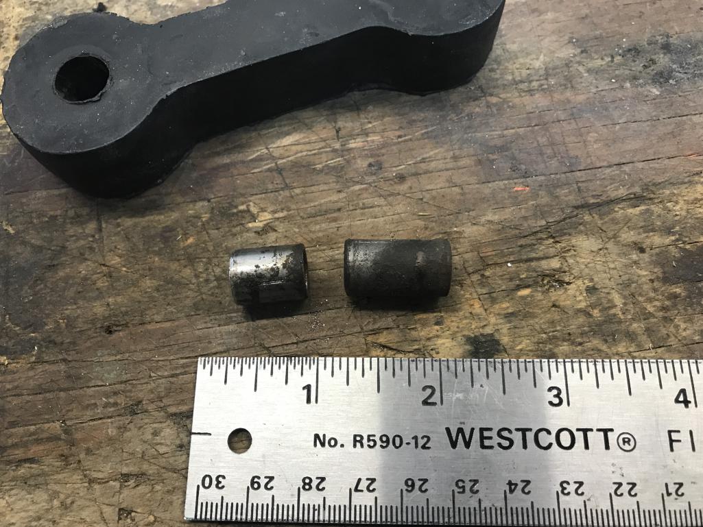

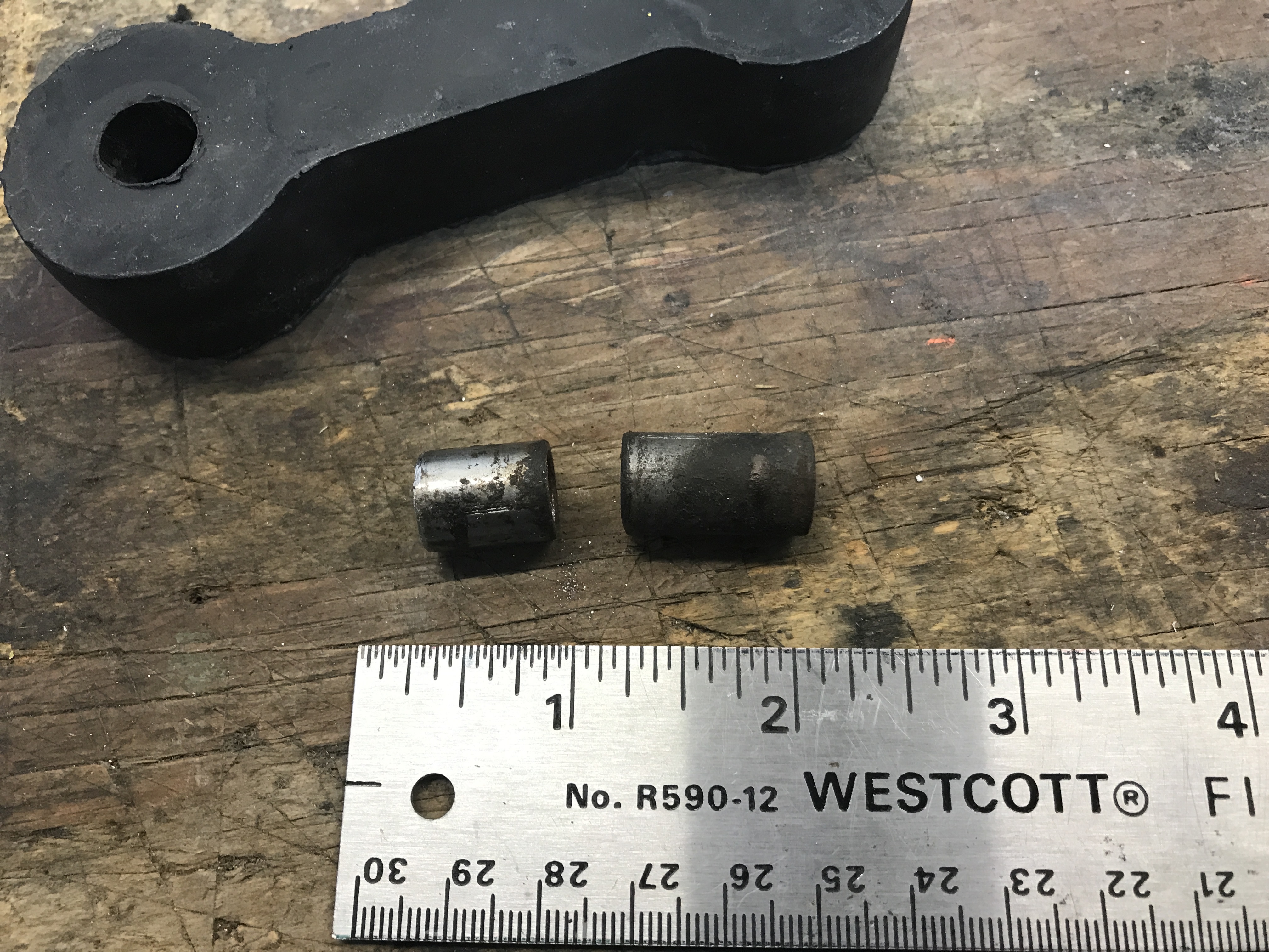

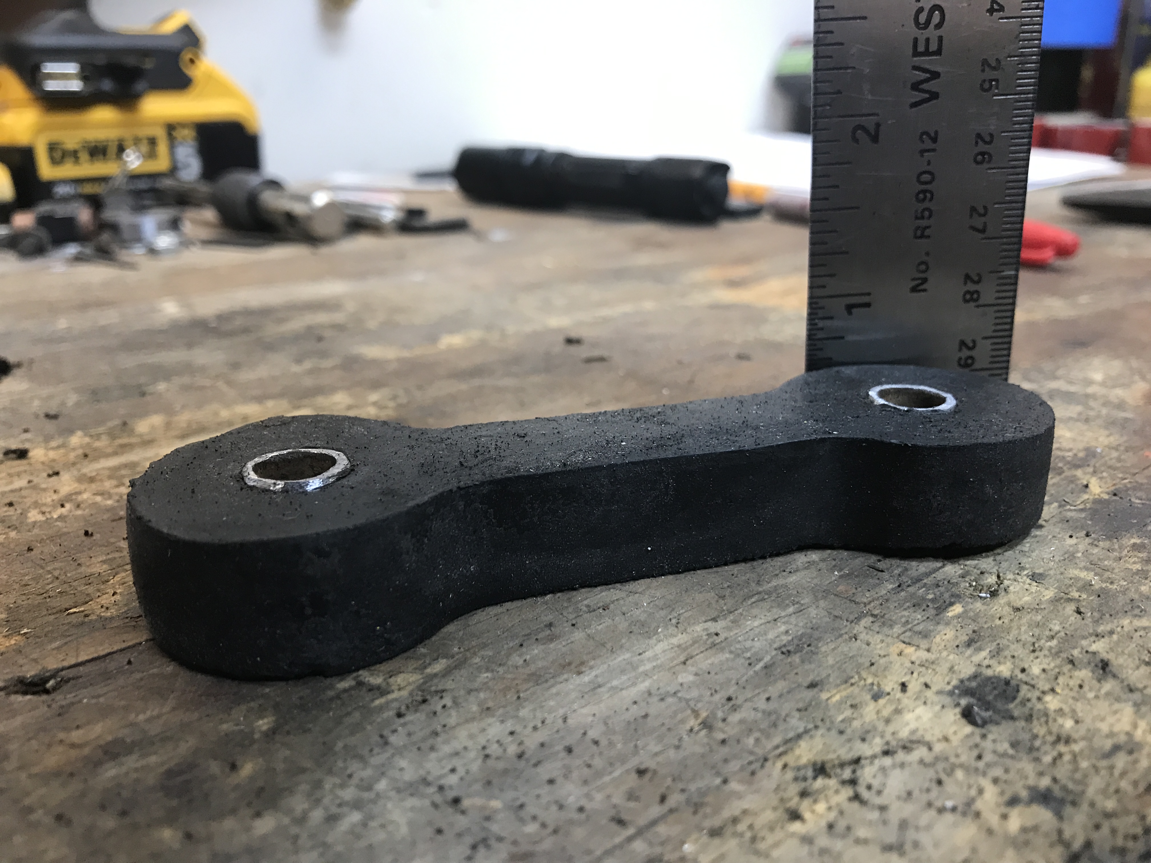

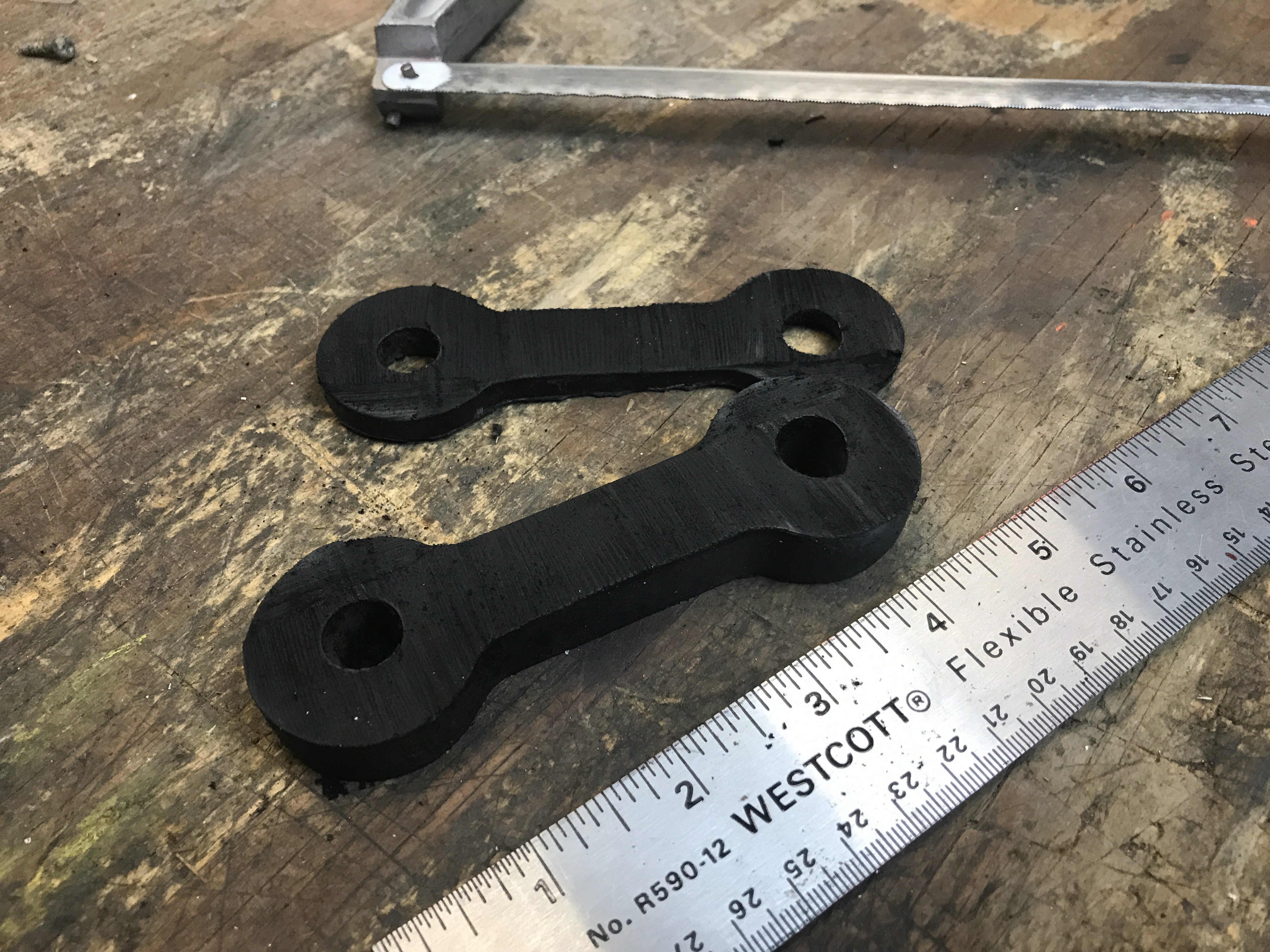

I trimmed about 1/4 inch from each insert tube.
bkrantz
post Feb 16 2022, 08:54 PM
Post #4862
Posts: 8,530
Joined: 3-August 19
From: SW Colorado
Member No.: 23,343
And also about 1/4 inch from the rubber.
bkrantz
Post #4863
Posts: 8,530
Joined: 3-August 19
From: SW Colorado
Member No.: 23,343
Skinny dog bone ready for installation.

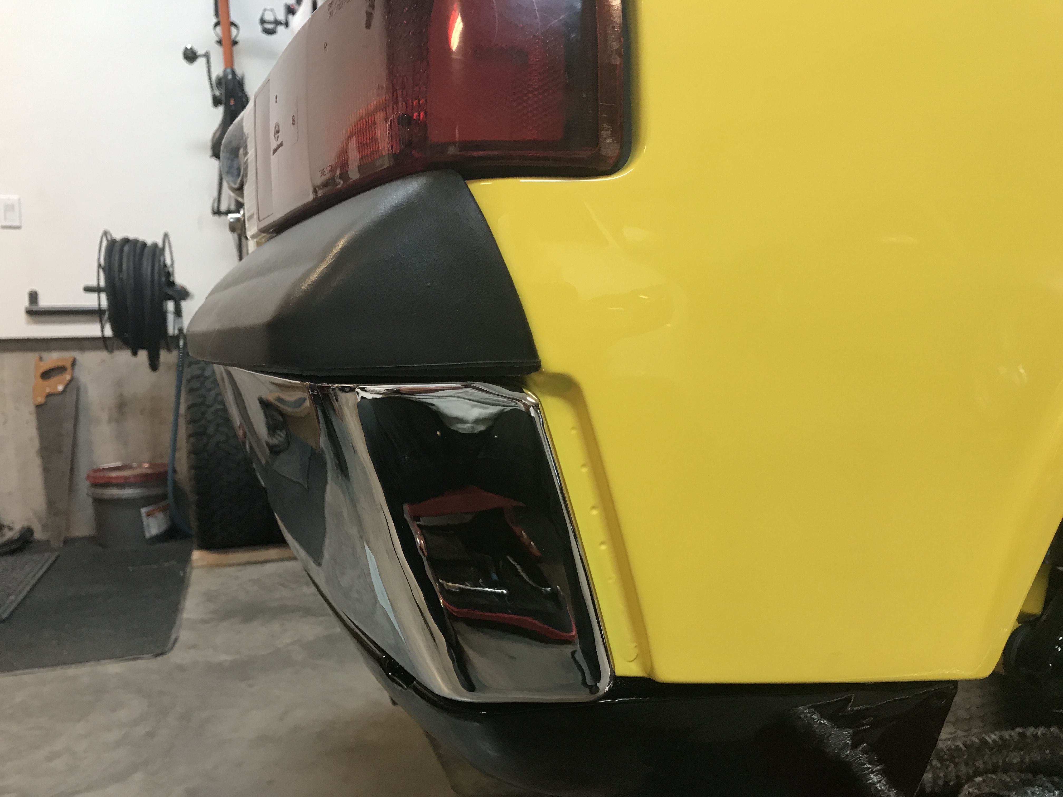

With the bumper back on, the rubber now sits tight to the bodywork, and the gap along the chrome is better.

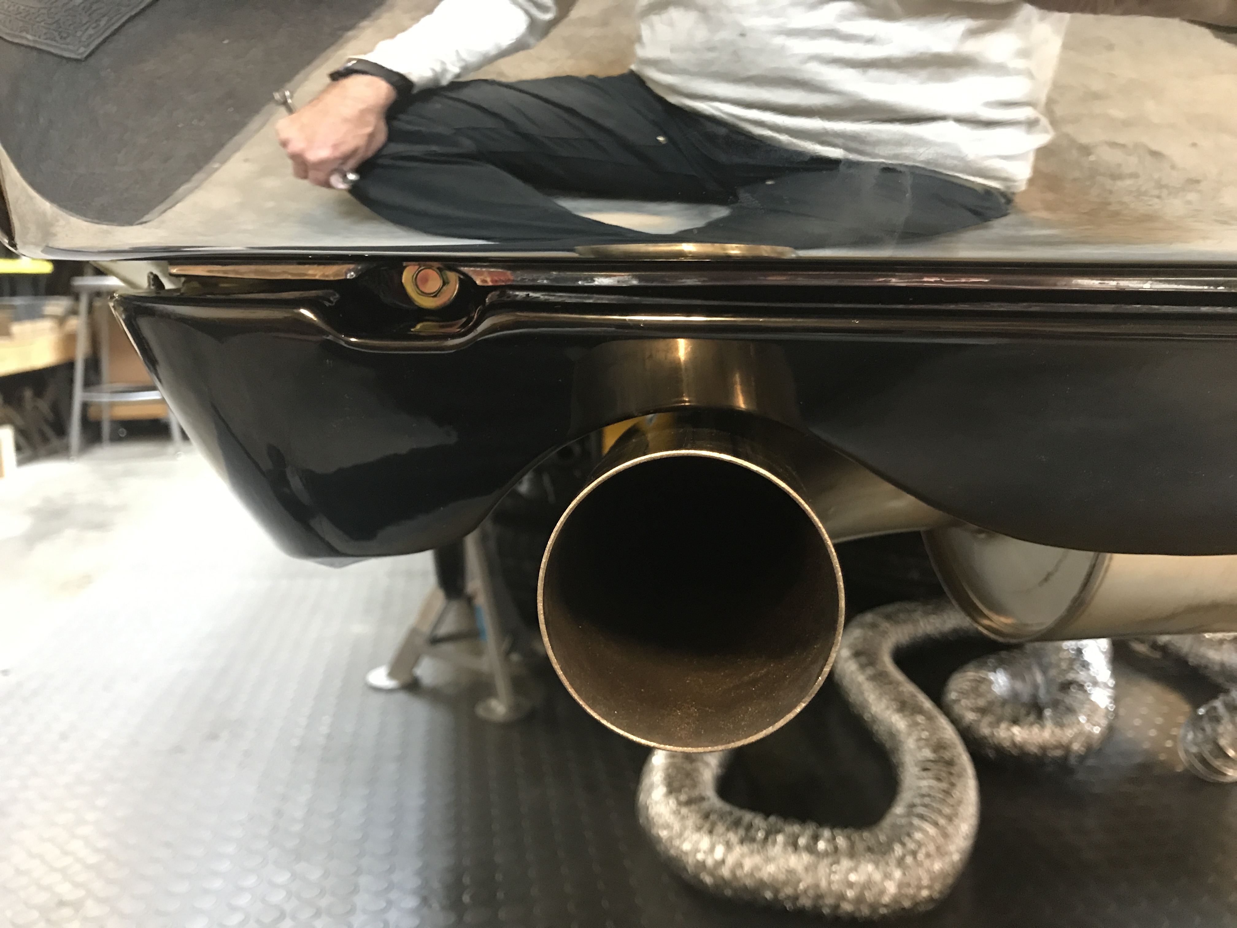

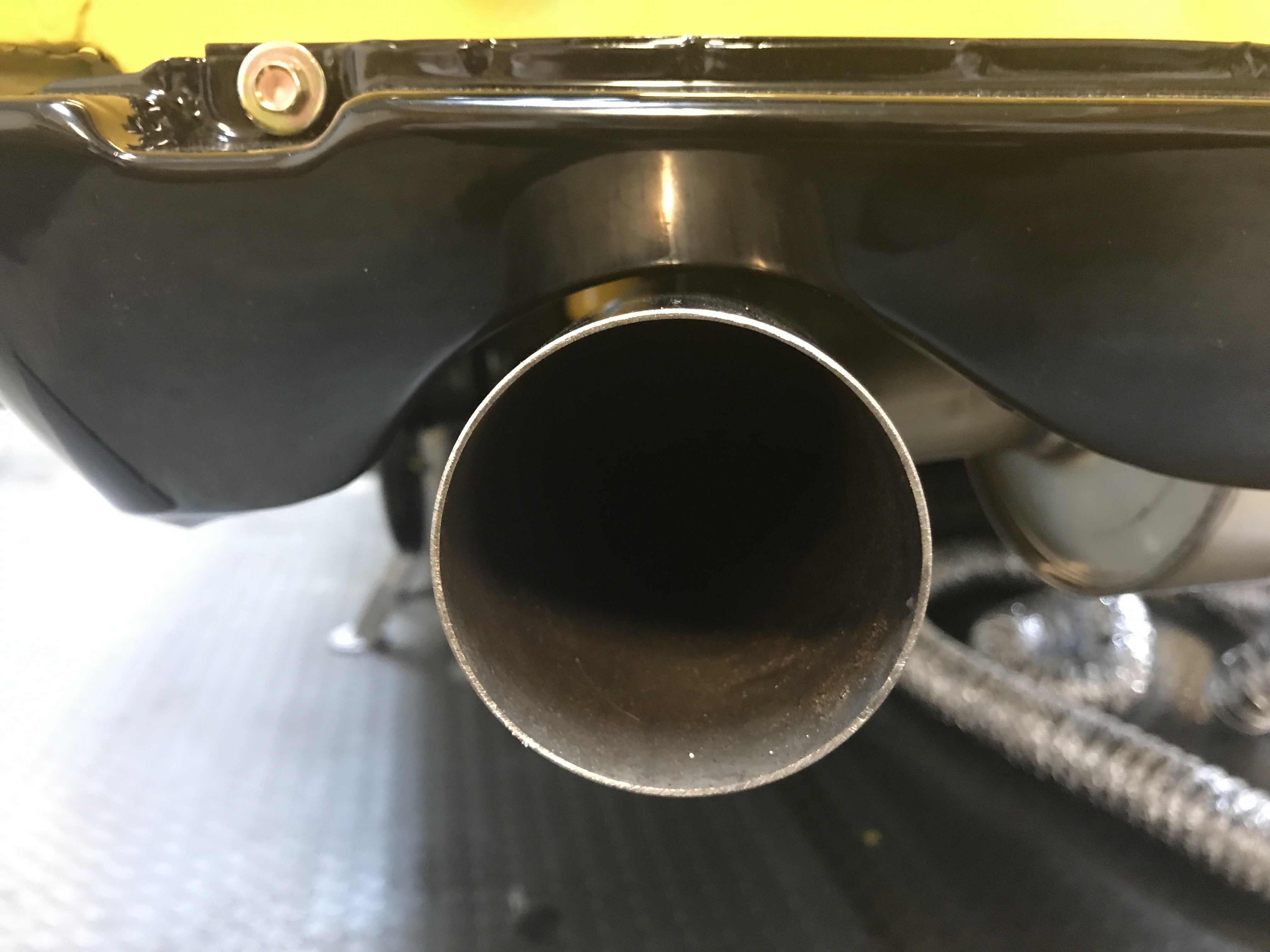

While fiddling with mine stuff, I also did not like the tight clearance between the tail pipe and valance. I can wiggle the engine and exhaust and make slight contact.
bkrantz
post Feb 16 2022, 09:00 PM
Post #4866
Posts: 8,530
Joined: 3-August 19
From: SW Colorado
Member No.: 23,343

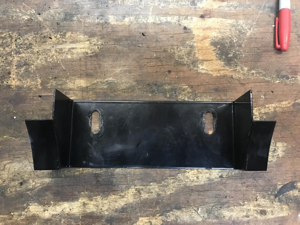

I removed the muffler bracket and lengthened the holes about 1/8 inch.
bkrantz
post Feb 16 2022, 09:01 PM
Post #4867
Posts: 8,530
Joined: 3-August 19
From: SW Colorado
Member No.: 23,343
That's enough to lower the muffler and tail pipe--no more contact.

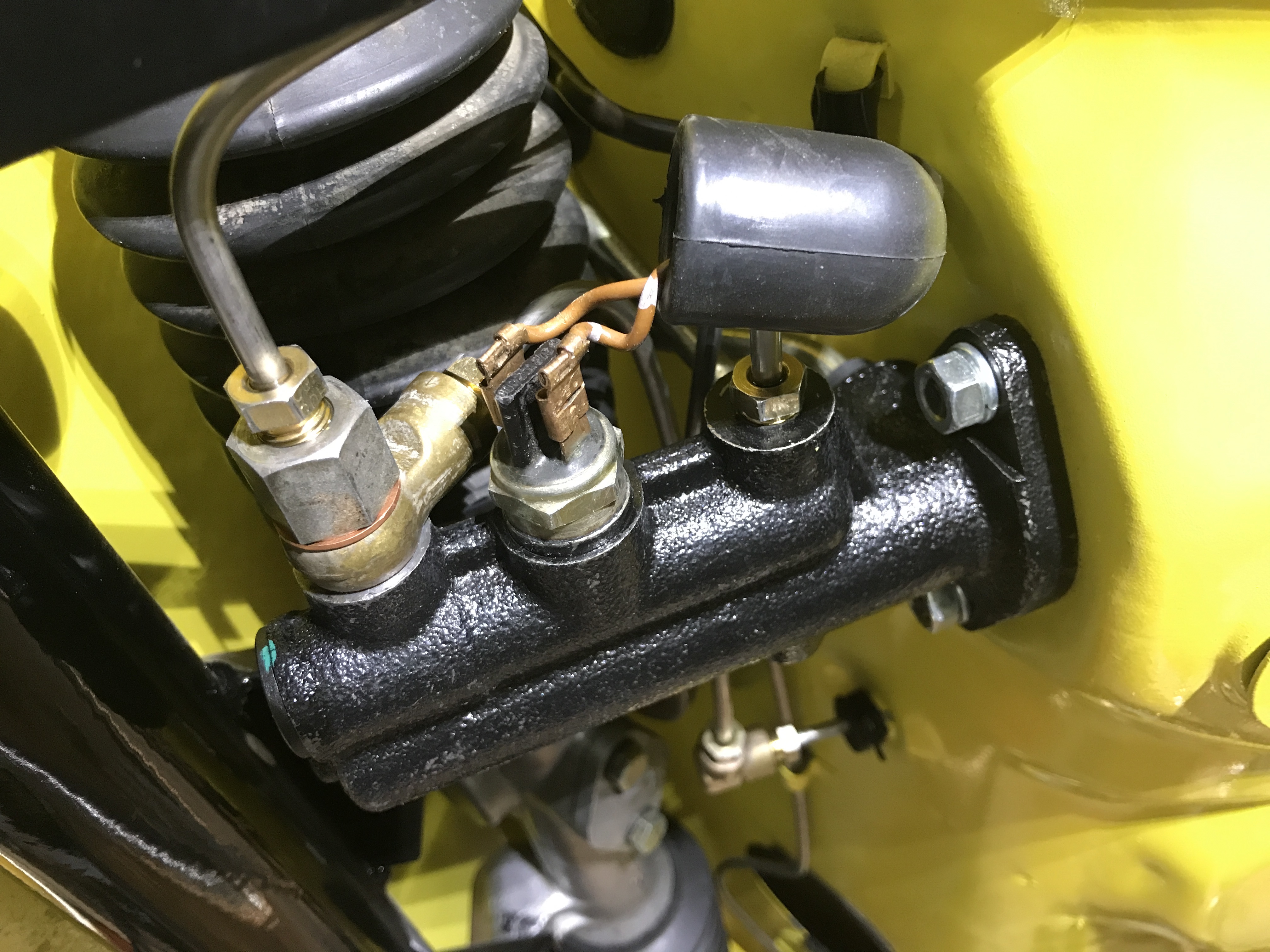

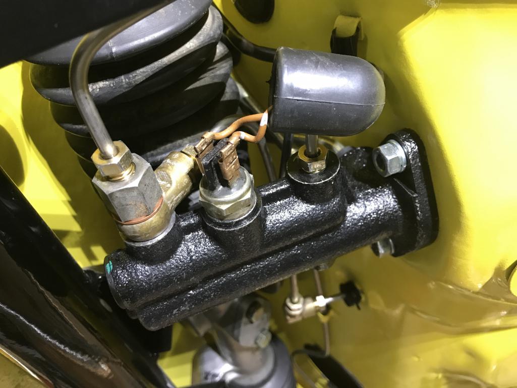

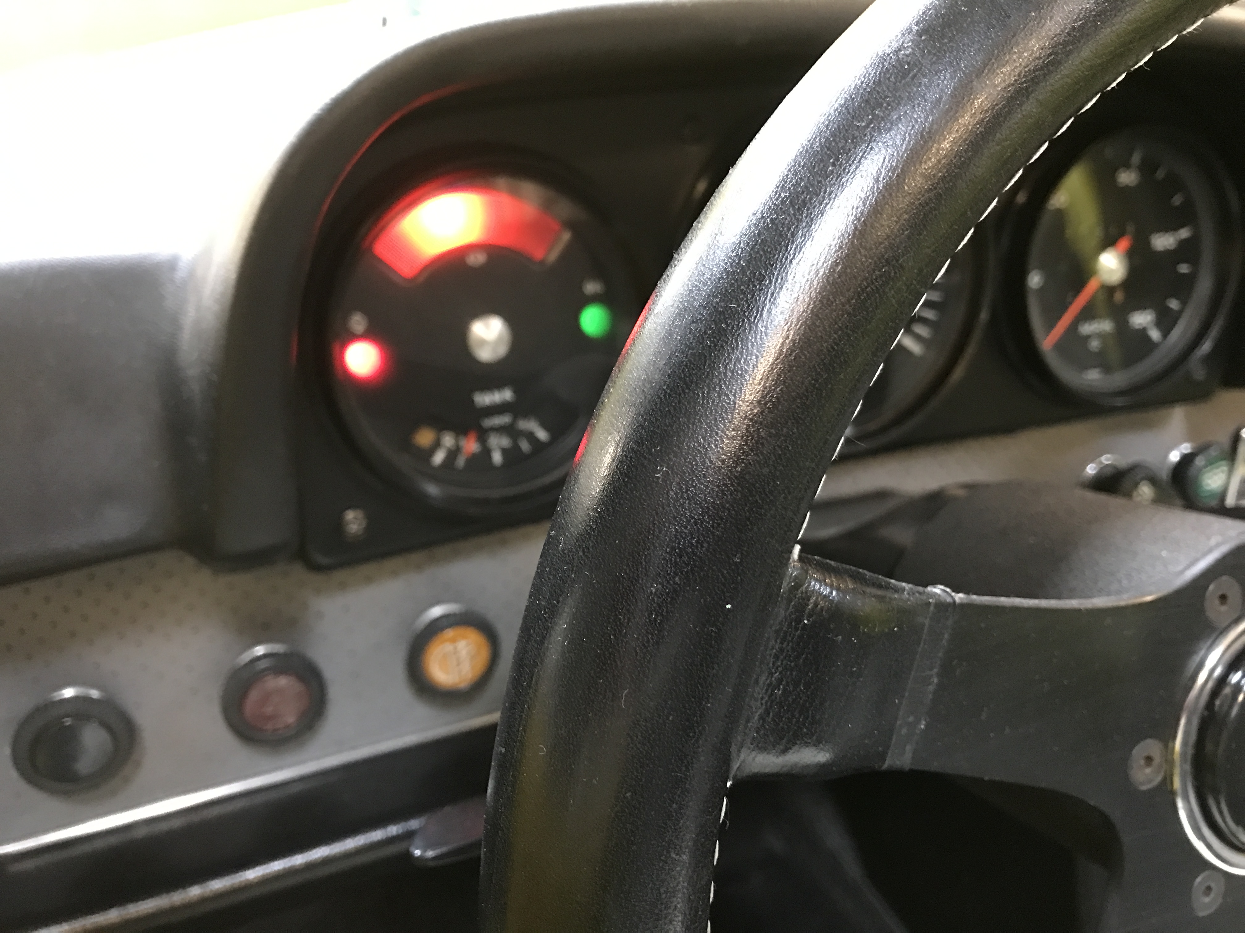

I finally remembered to check to see if I cured the flashing brake system warning. I turned the key on and...no. (IMG:style_emoticons/default/mad.gif)
bkrantz
post Feb 18 2022, 08:23 PM
Post #4870
Posts: 8,530
Joined: 3-August 19
From: SW Colorado
Member No.: 23,343

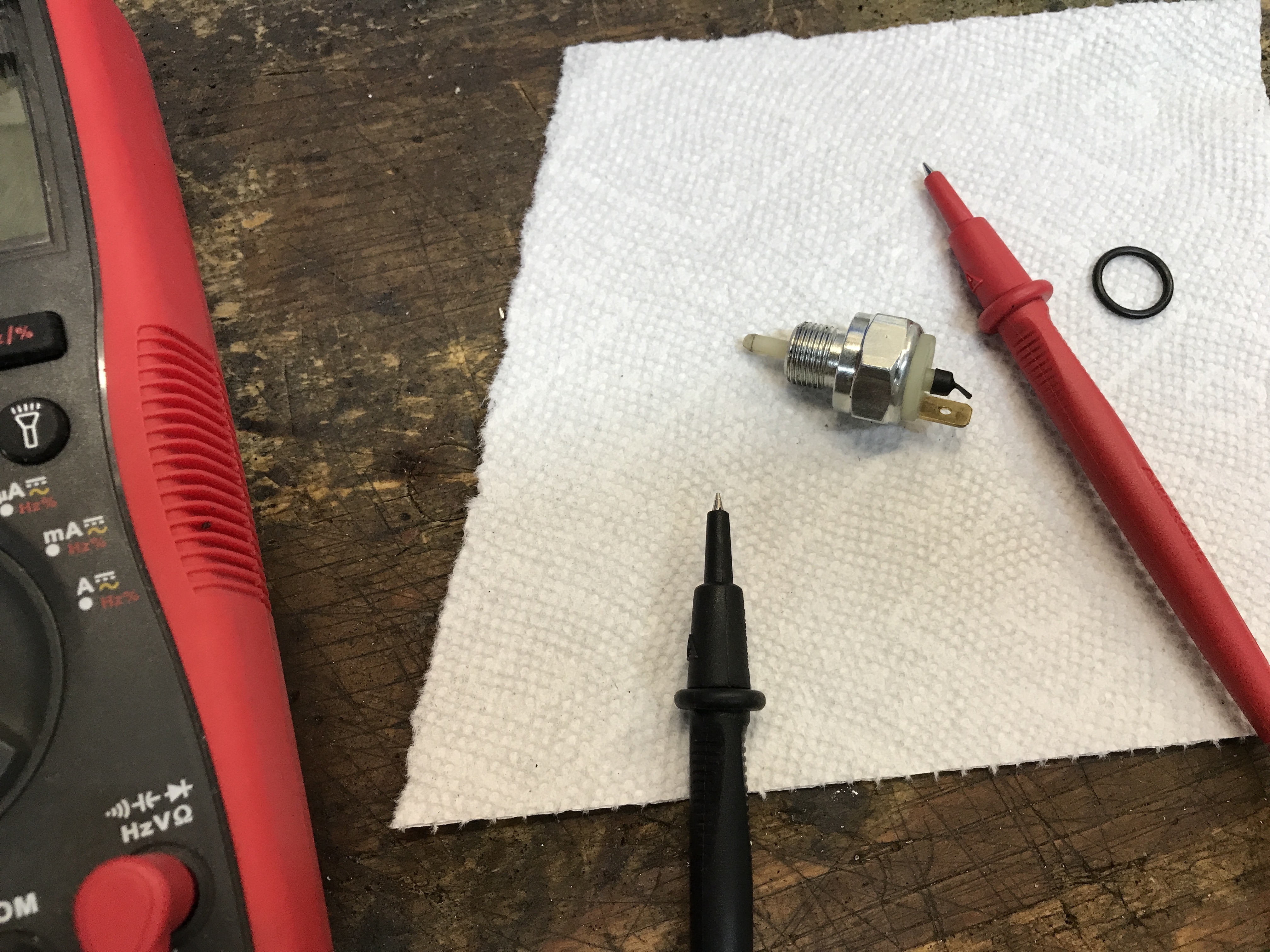

When I installed the replacement 19 mm master cylinder, I included the original 2-lead switch. I think (???) I tested this before putting it in, but now the switch is stuck "on", and connects the leads and grounds the circuit. Of course, this type of switch has no external reset button.
So now I have to replace the switch and bleed the brake system again. (IMG:style_emoticons/default/mad.gif) (IMG:style_emoticons/default/mad.gif) (IMG:style_emoticons/default/mad.gif)
bkrantz
post Feb 18 2022, 08:26 PM
Post #4871
Posts: 8,530
Joined: 3-August 19
From: SW Colorado
Member No.: 23,343
I dug out the switch that cam with the new MC, but this one seems to have the opposite problem: no matter the position of the plunger, the switch does not ground the single lead. (IMG:style_emoticons/default/mad.gif) (IMG:style_emoticons/default/mad.gif) (IMG:style_emoticons/default/mad.gif) (IMG:style_emoticons/default/mad.gif)

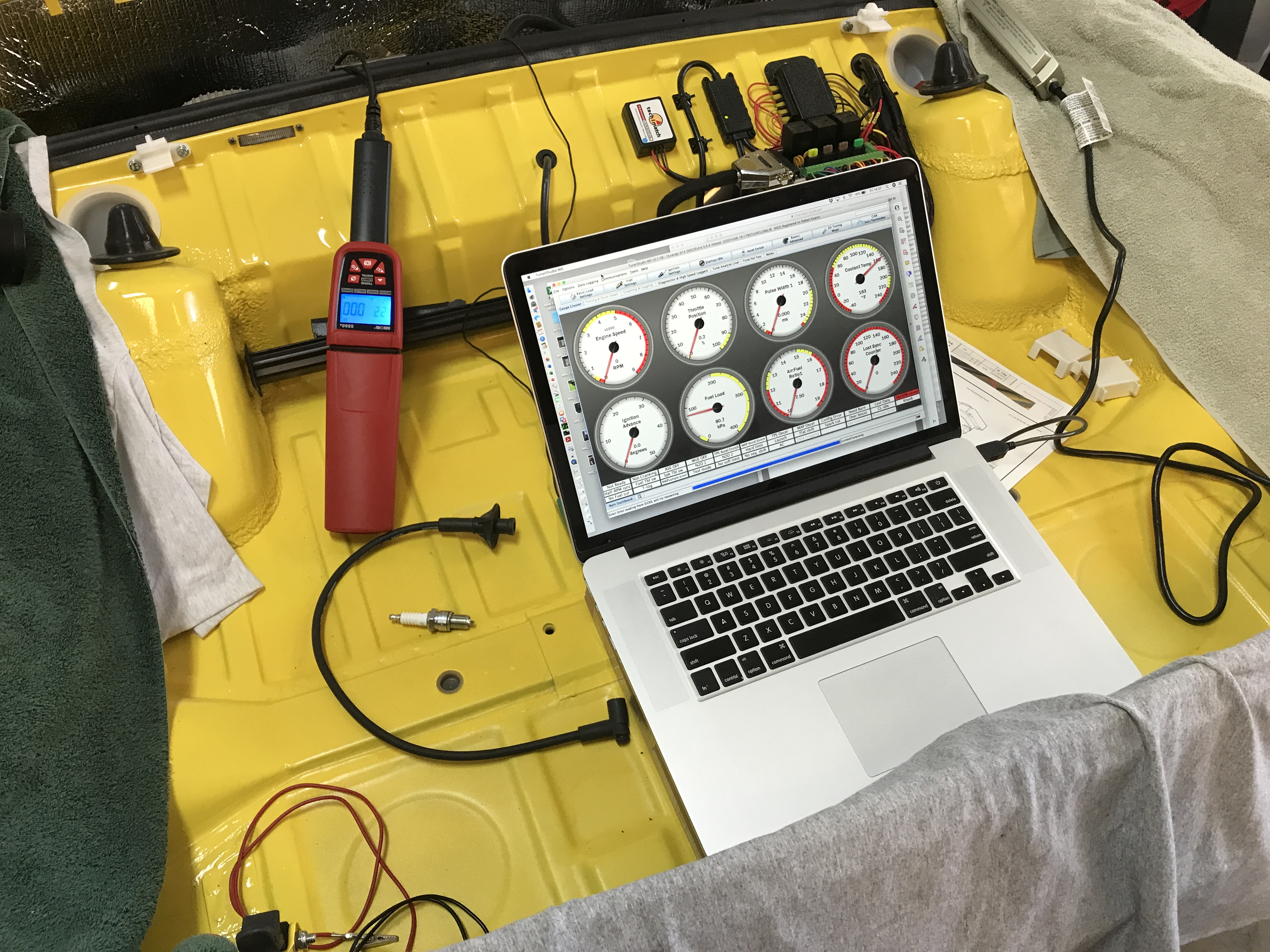

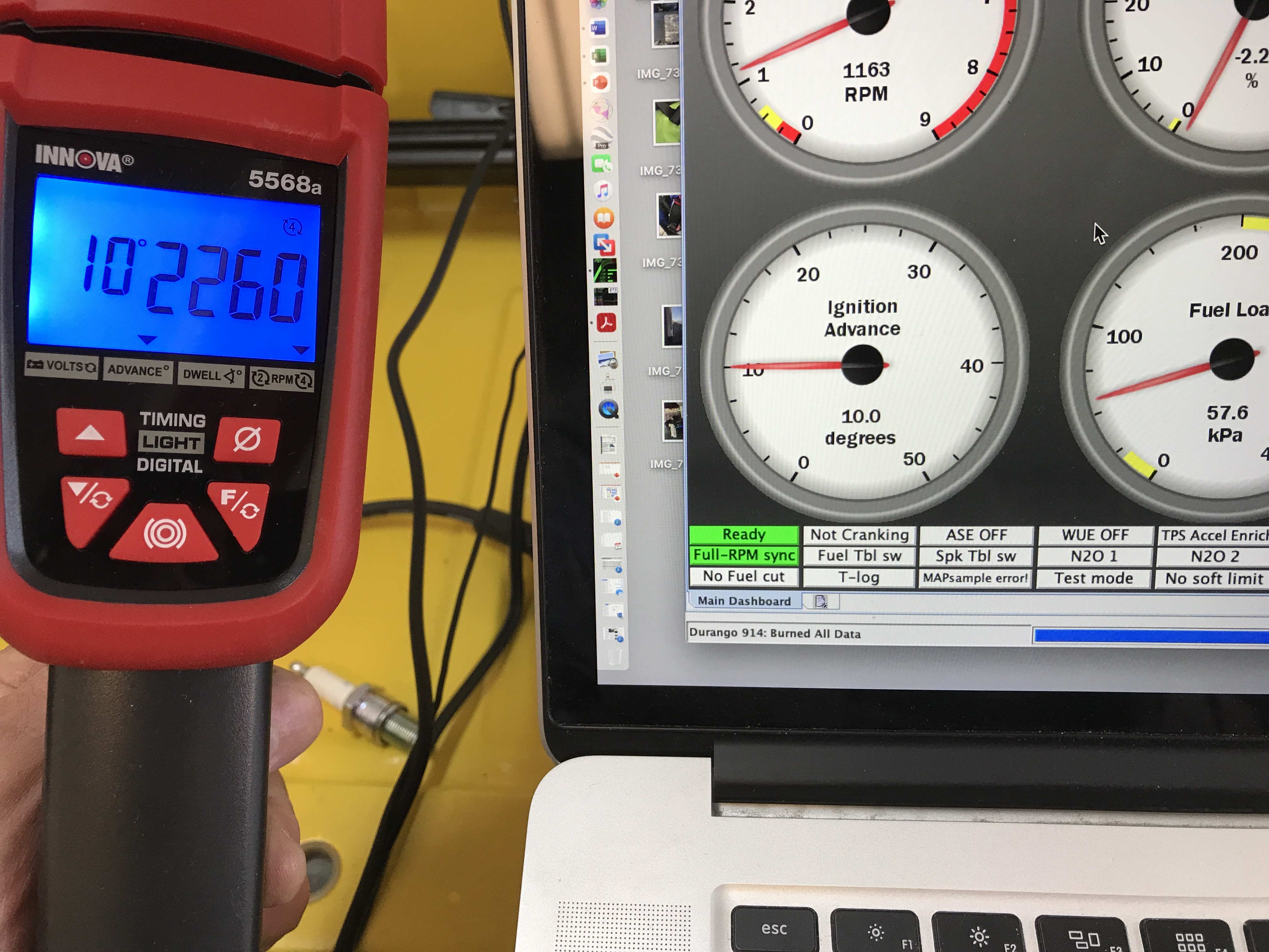

Enough of that. Let's get back to starting the engine and EFI tune. Step 1 is to calibrate the engine advance relative to the EFI setting.
bkrantz
post Feb 18 2022, 08:33 PM
Post #4873
Posts: 8,530
Joined: 3-August 19
From: SW Colorado
Member No.: 23,343

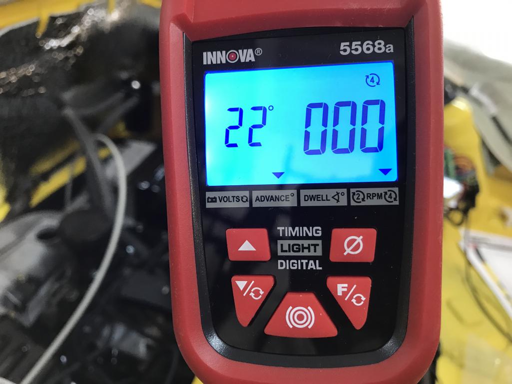

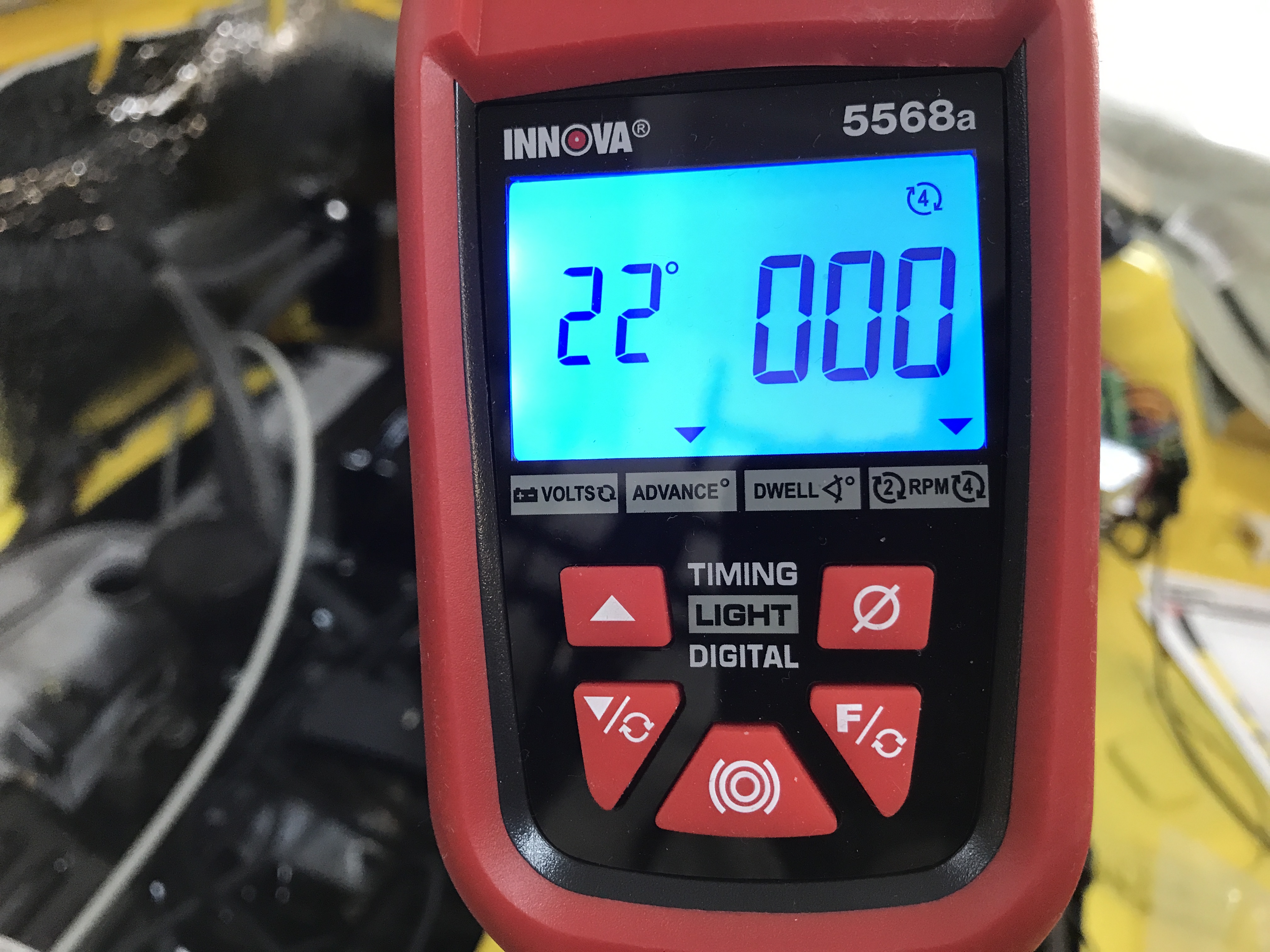

With the engine at fast idle, and the EFI set to constant 10° advance, here's what I measured at the blower fan pulley: 22°.
To adjust that, the TunerStudio software has an adjustment (Tooth Angle). A bit of trial and error, and...
bkrantz
Post #4874
Posts: 8,530
Joined: 3-August 19
From: SW Colorado
Member No.: 23,343
Success. The EFI and engine are both at 10° advance.
bkrantz
post Feb 18 2022, 08:36 PM
Post #4875
Posts: 8,530
Joined: 3-August 19
From: SW Colorado
Member No.: 23,343

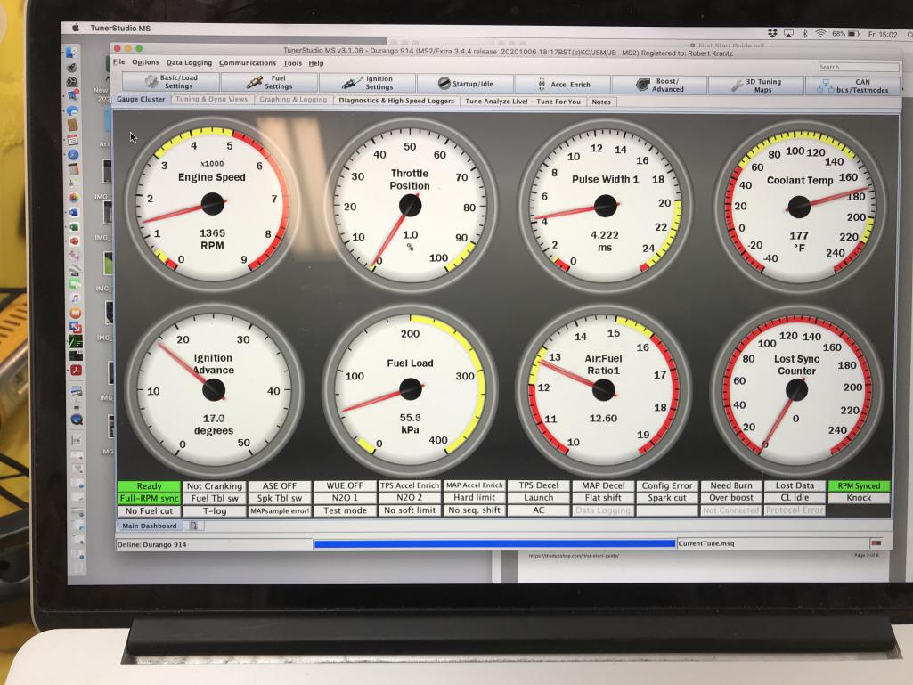

Readings with a rough fast idle. The advance is set back to an initial table so it can vary with rpm. And the "coolant" temp (actually the cylinder head temp, with a new sensor on the right head in the stock location.

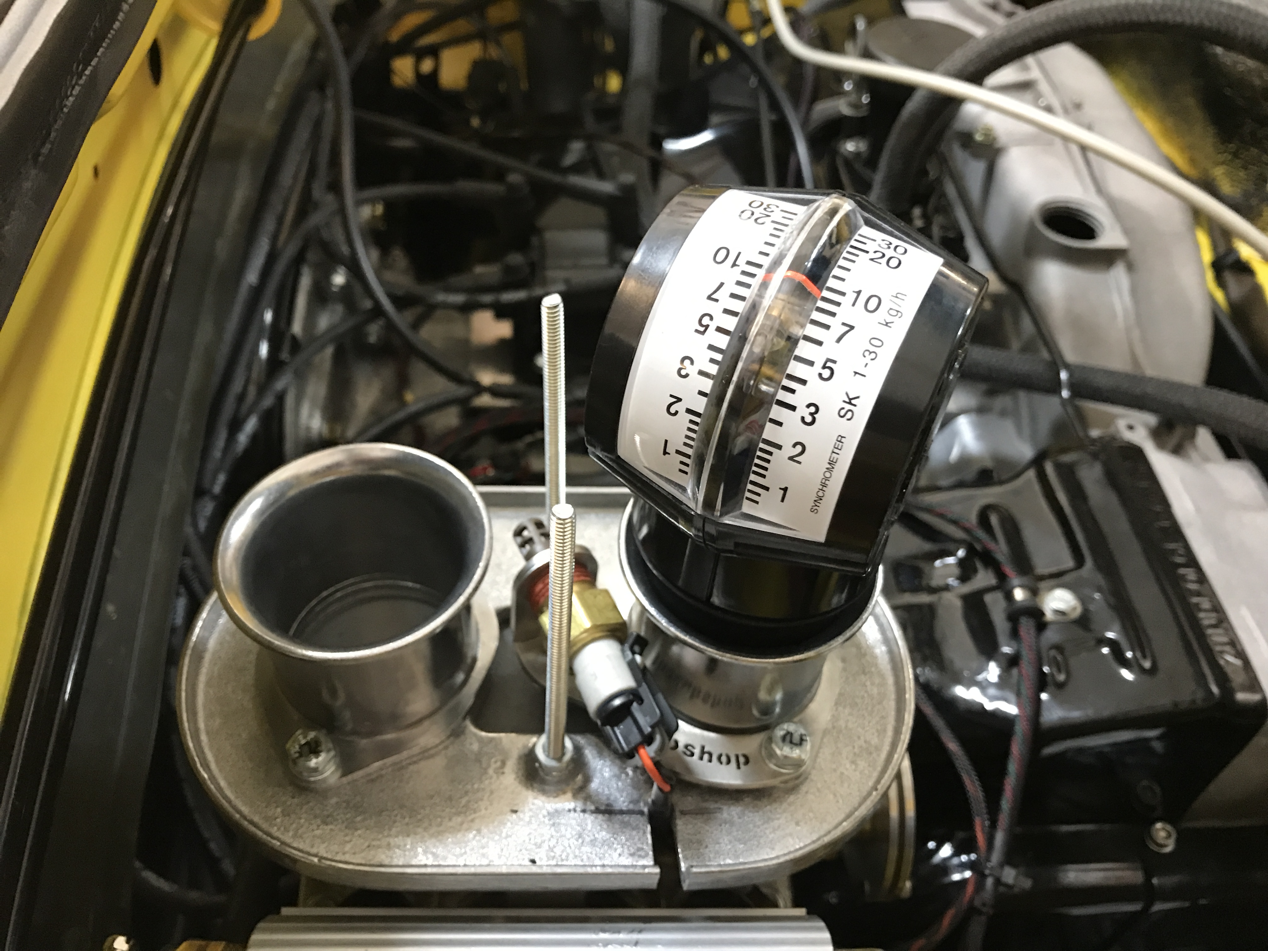

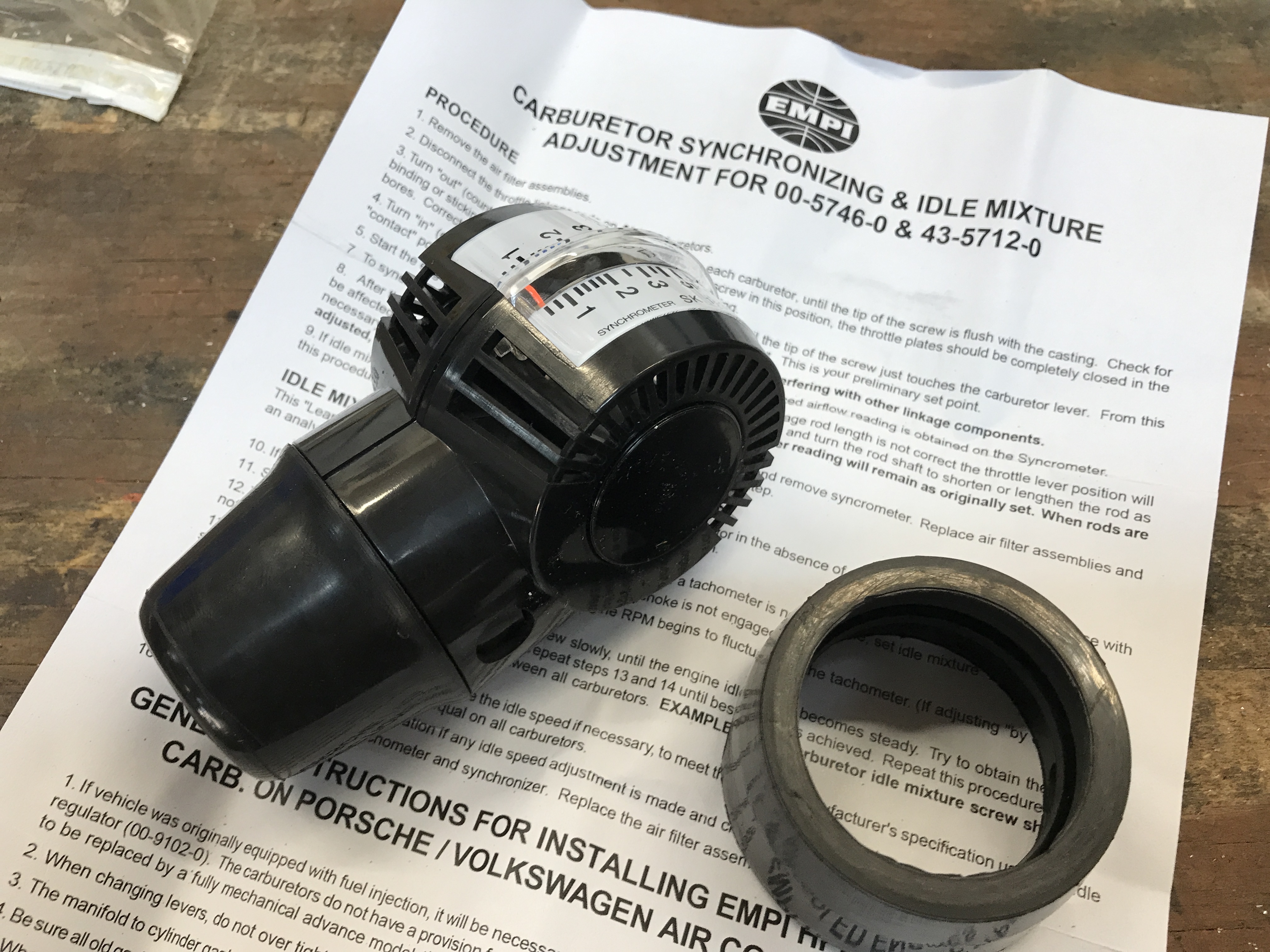

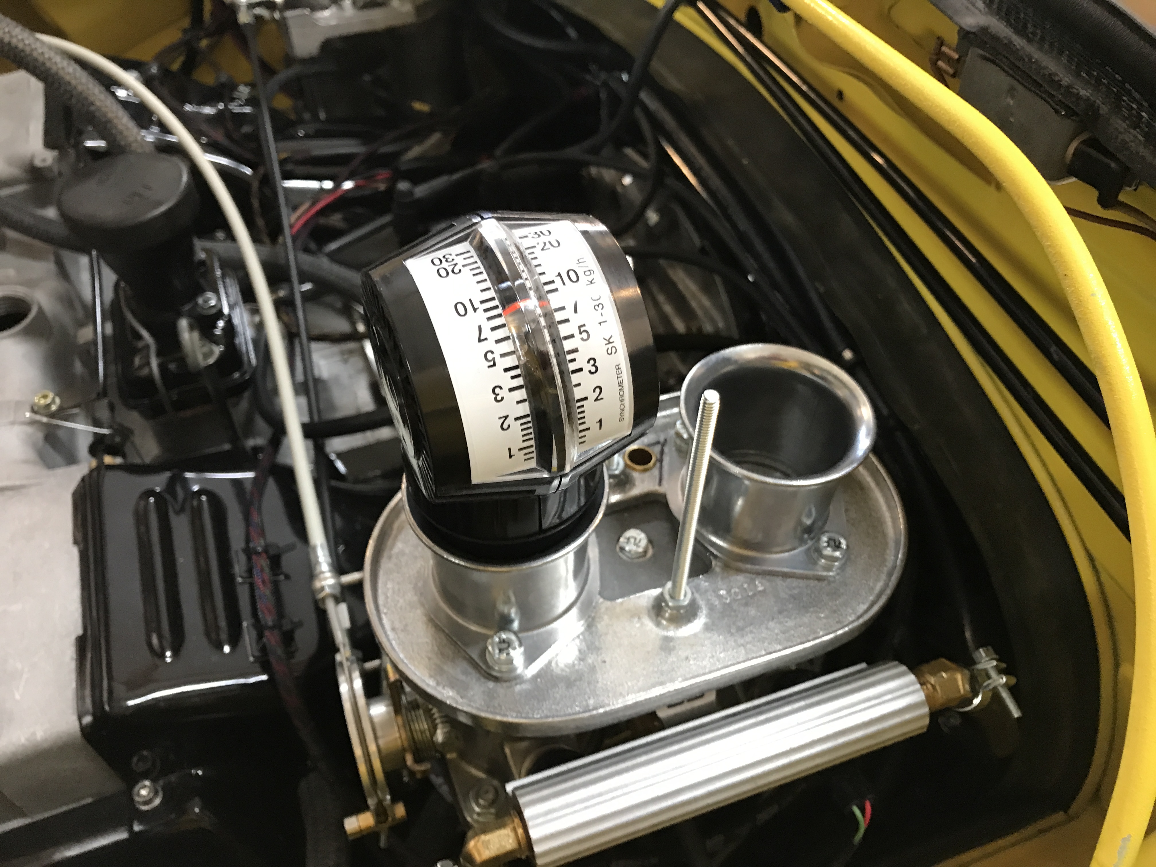

For an initial idle speed setting, I got out my new EMPI synchronizer.
bkrantz
post Feb 18 2022, 08:41 PM
Post #4877
Posts: 8,530
Joined: 3-August 19
From: SW Colorado
Member No.: 23,343
I backed out the idle screw on the right intake to get the rpm down and airflow to 8.
bkrantz
Post #4878
Posts: 8,530
Joined: 3-August 19
From: SW Colorado
Member No.: 23,343
And did the same on the left.

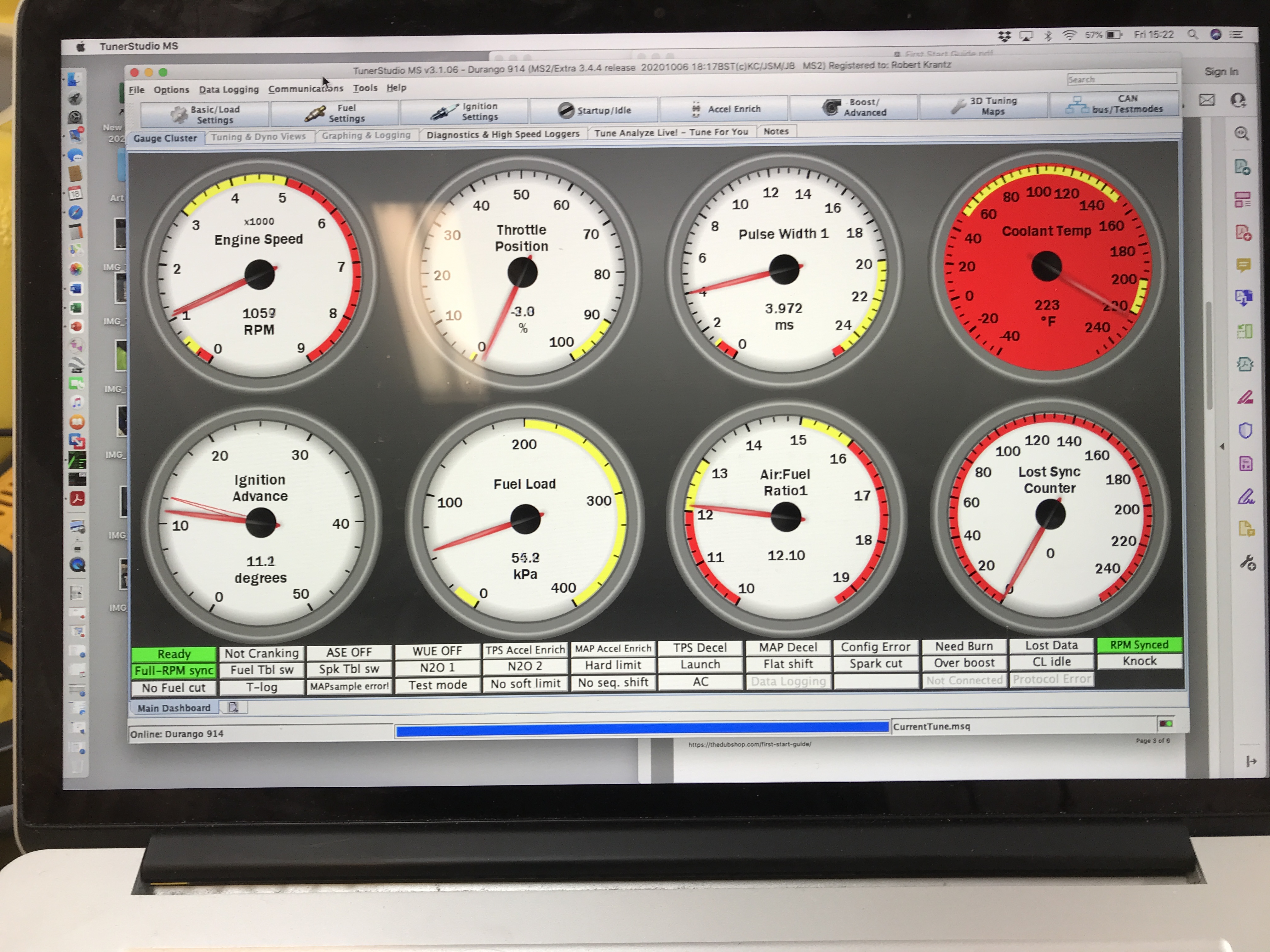

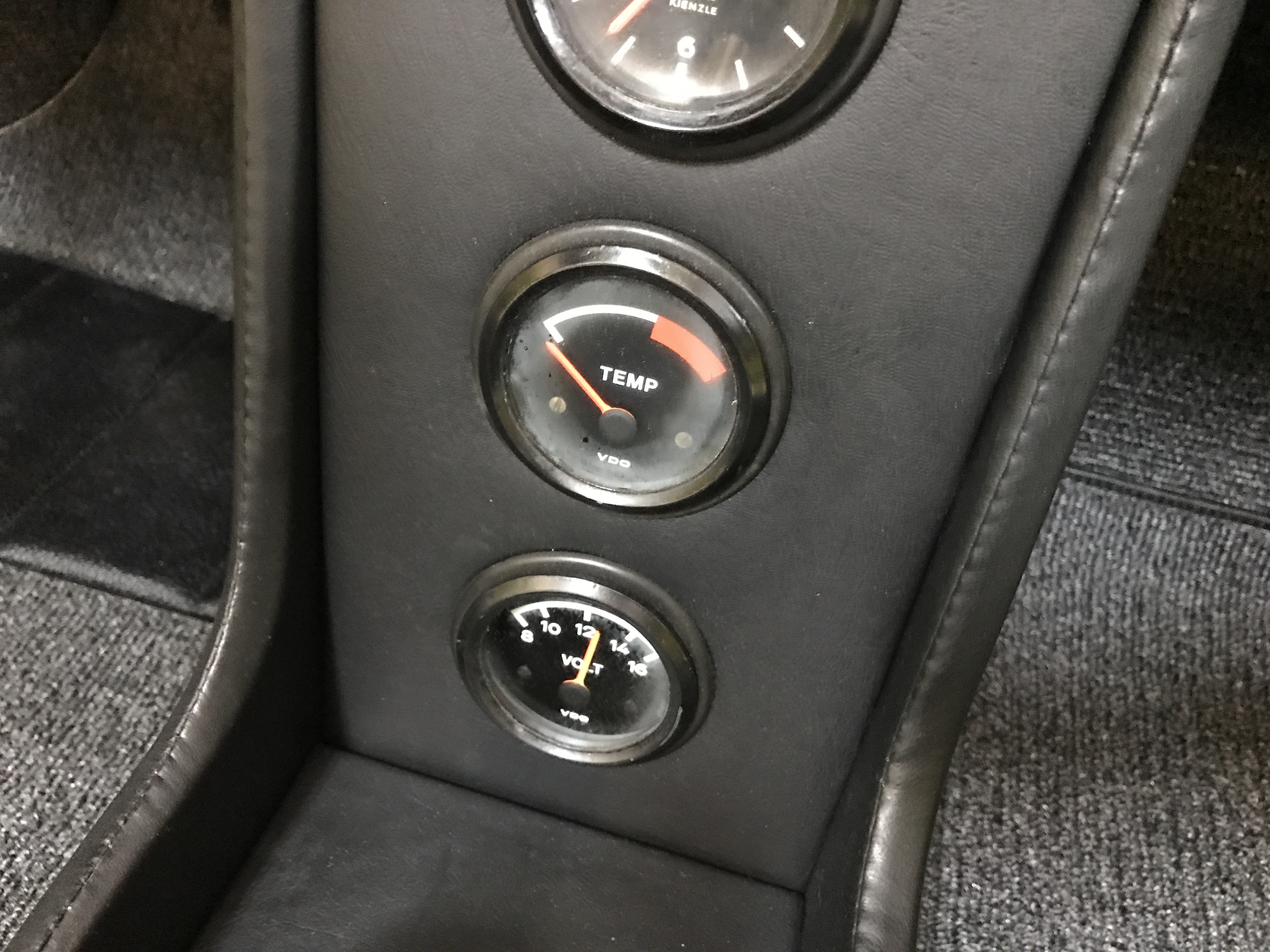

By this time, the "coolant" was pegging the default software setting--I need to change this.
bkrantz
post Feb 18 2022, 08:44 PM
Post #4880
Posts: 8,530
Joined: 3-August 19
From: SW Colorado
Member No.: 23,343
But the stock oil temp gauge still has not risen.
