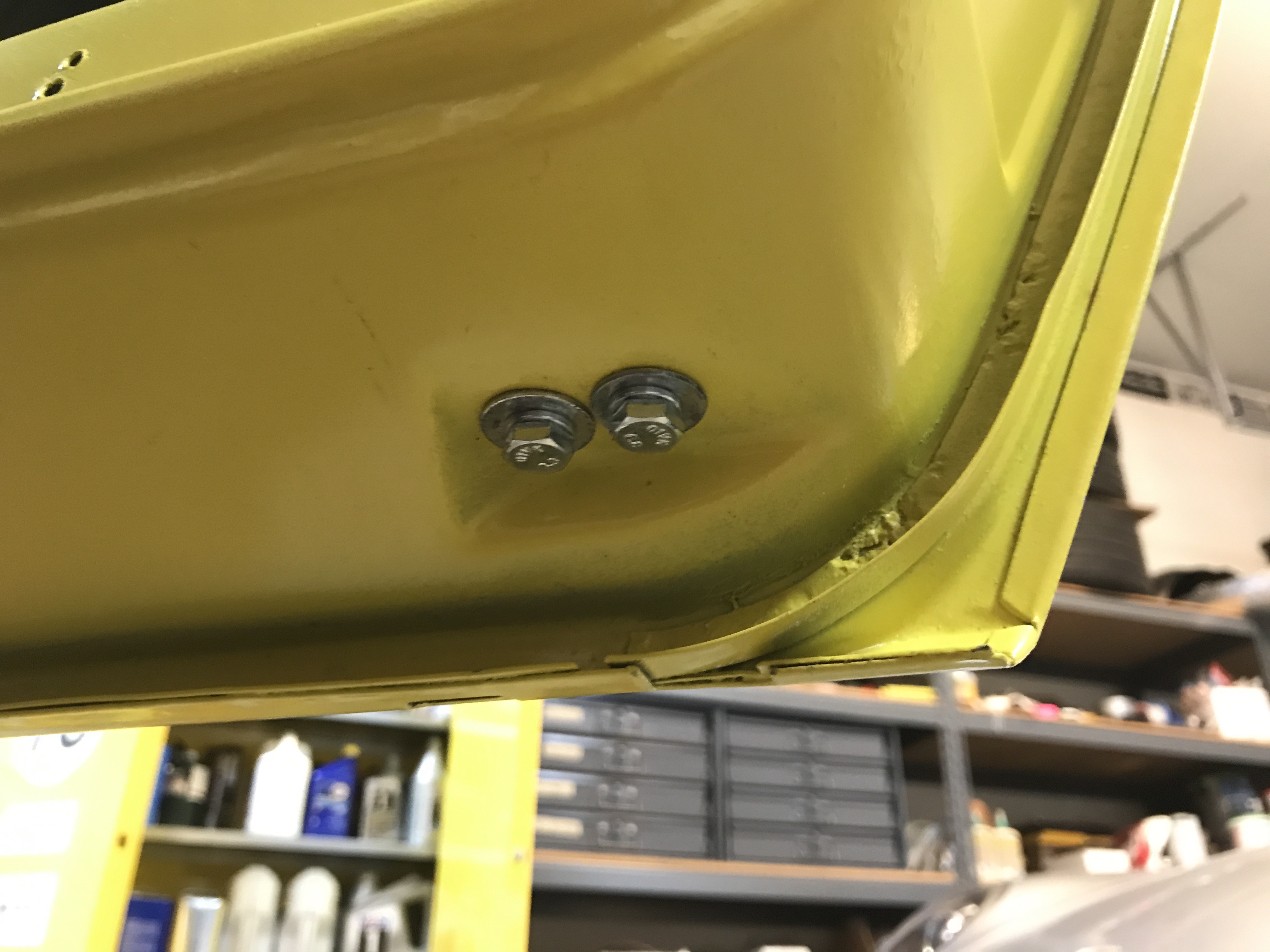

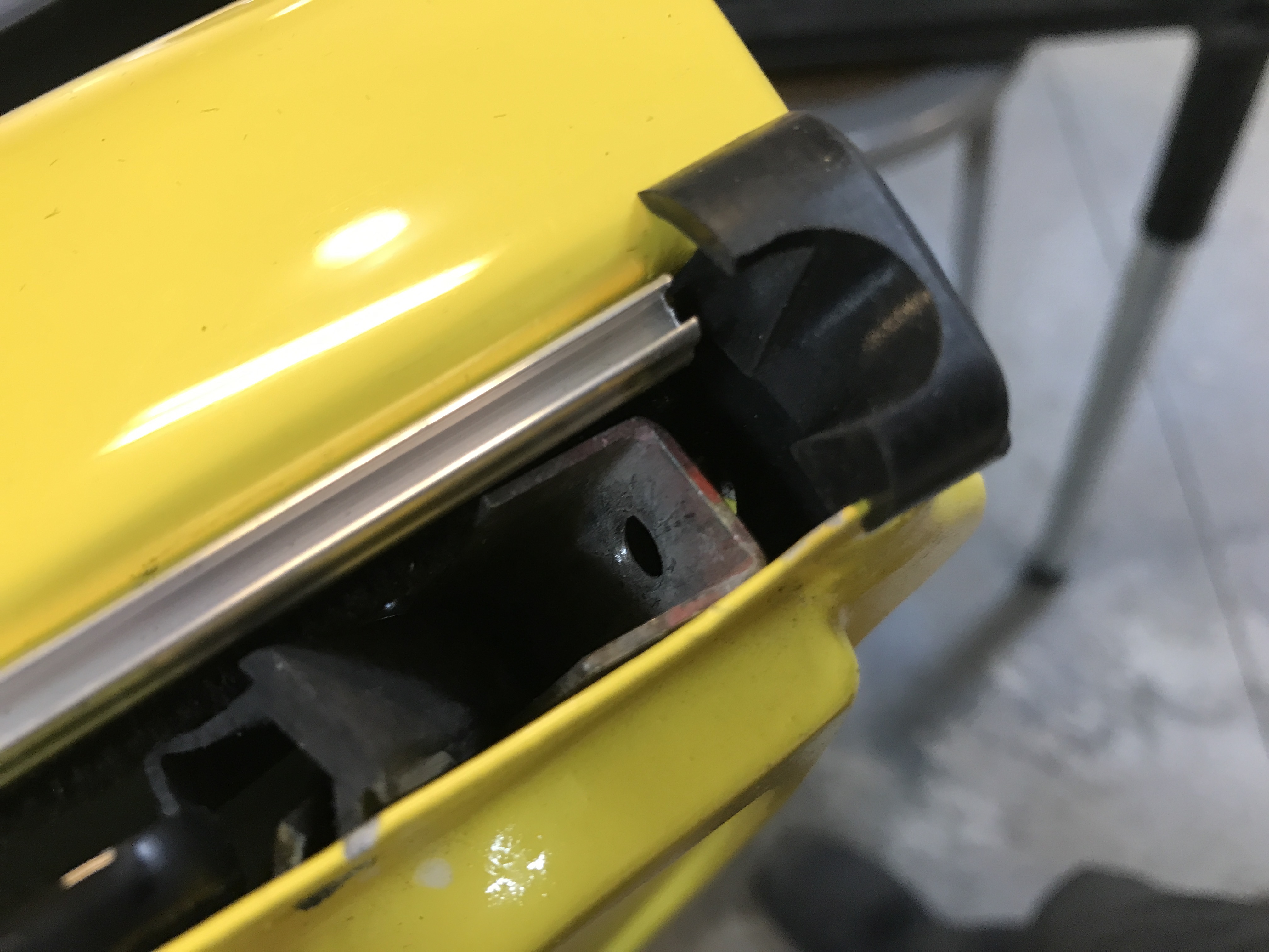

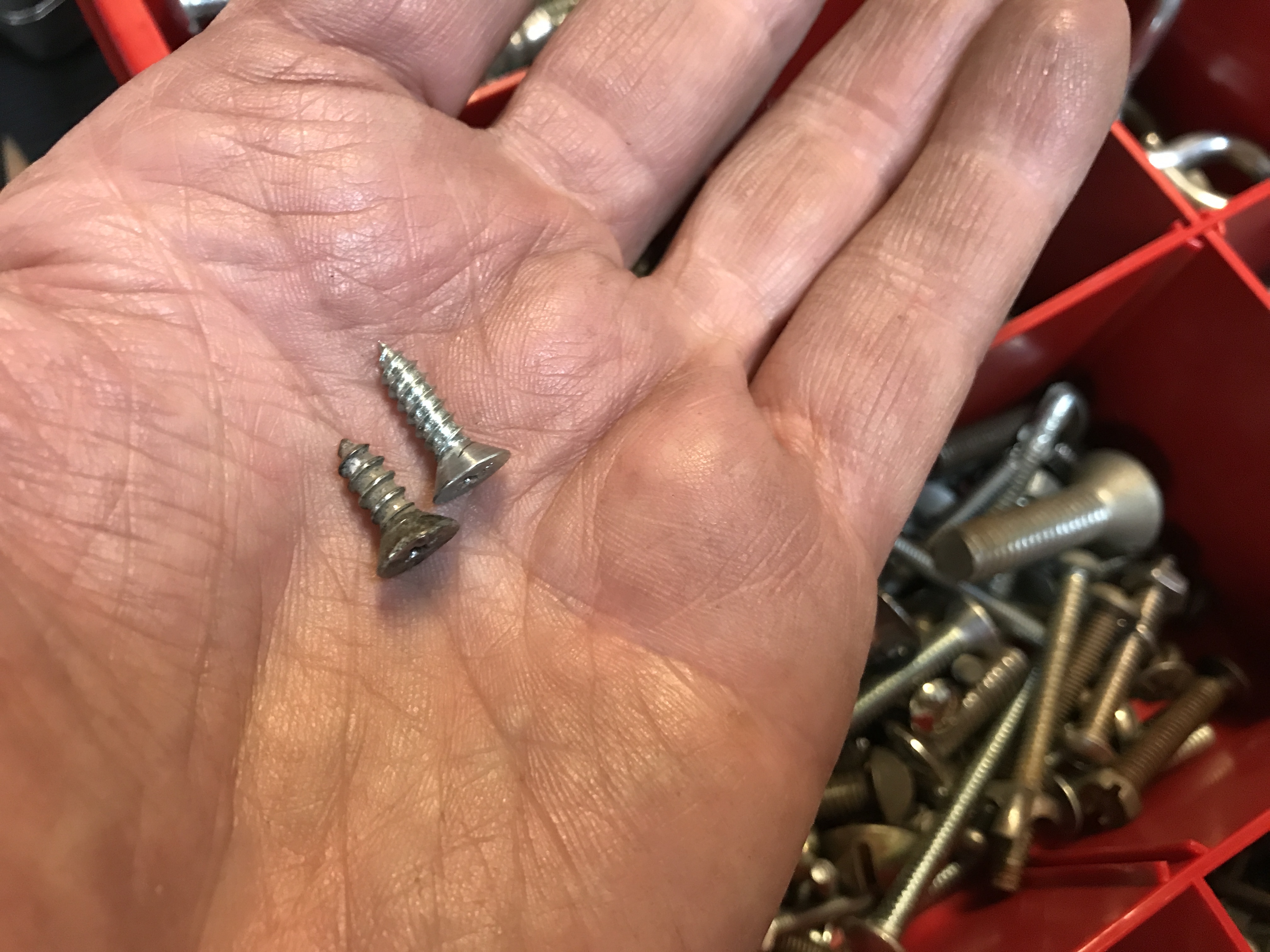

Original screw (left) has a messed-up head, and so I searched through my box of miscellaneous screws for a replacement (plus another for the left side).

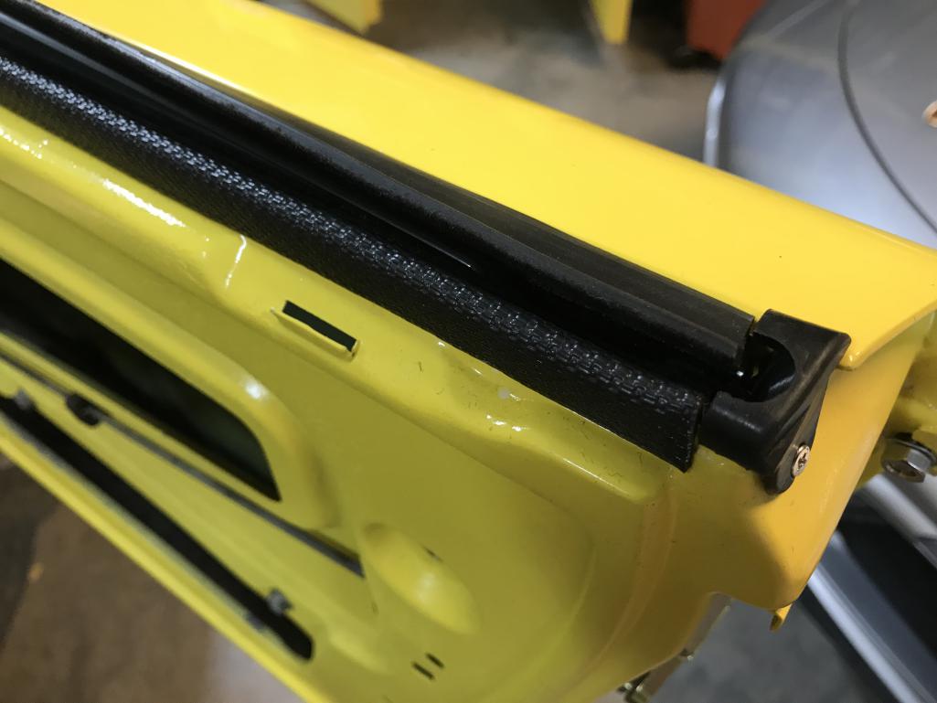

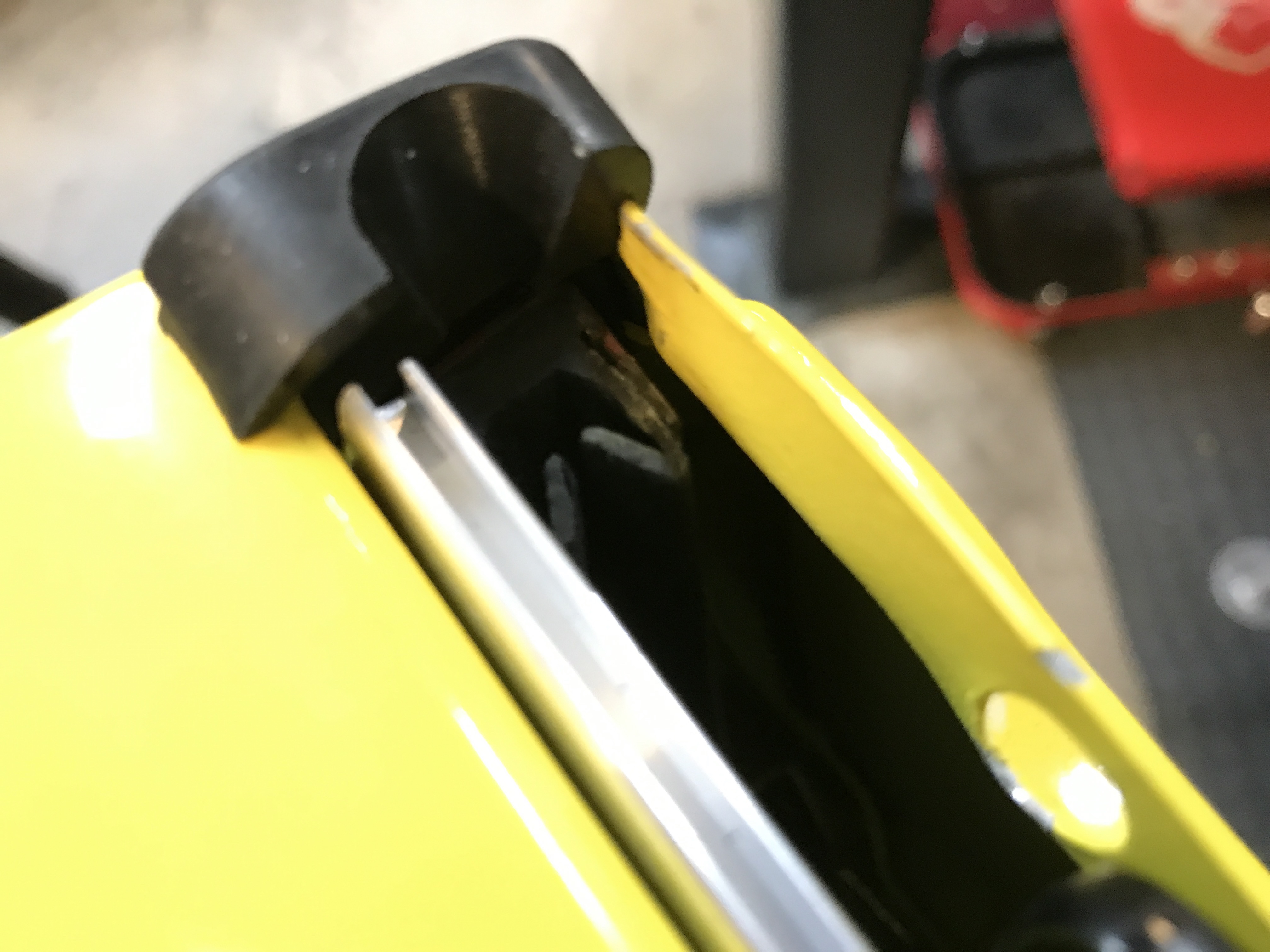

I got the strip in the door, and engaged with the lower rear corner of the glass. Then inserted the new cap, and pulled the top of the channel fuzzy out to reveal the screw hole.

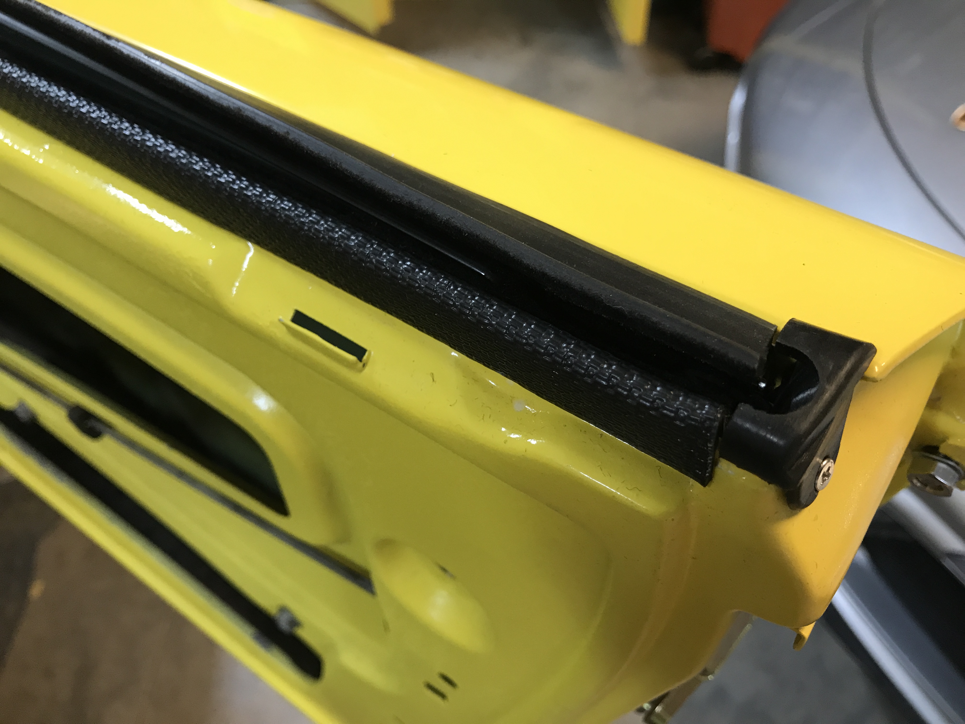

Channel screwed in place, and fuzzy re-inserted.

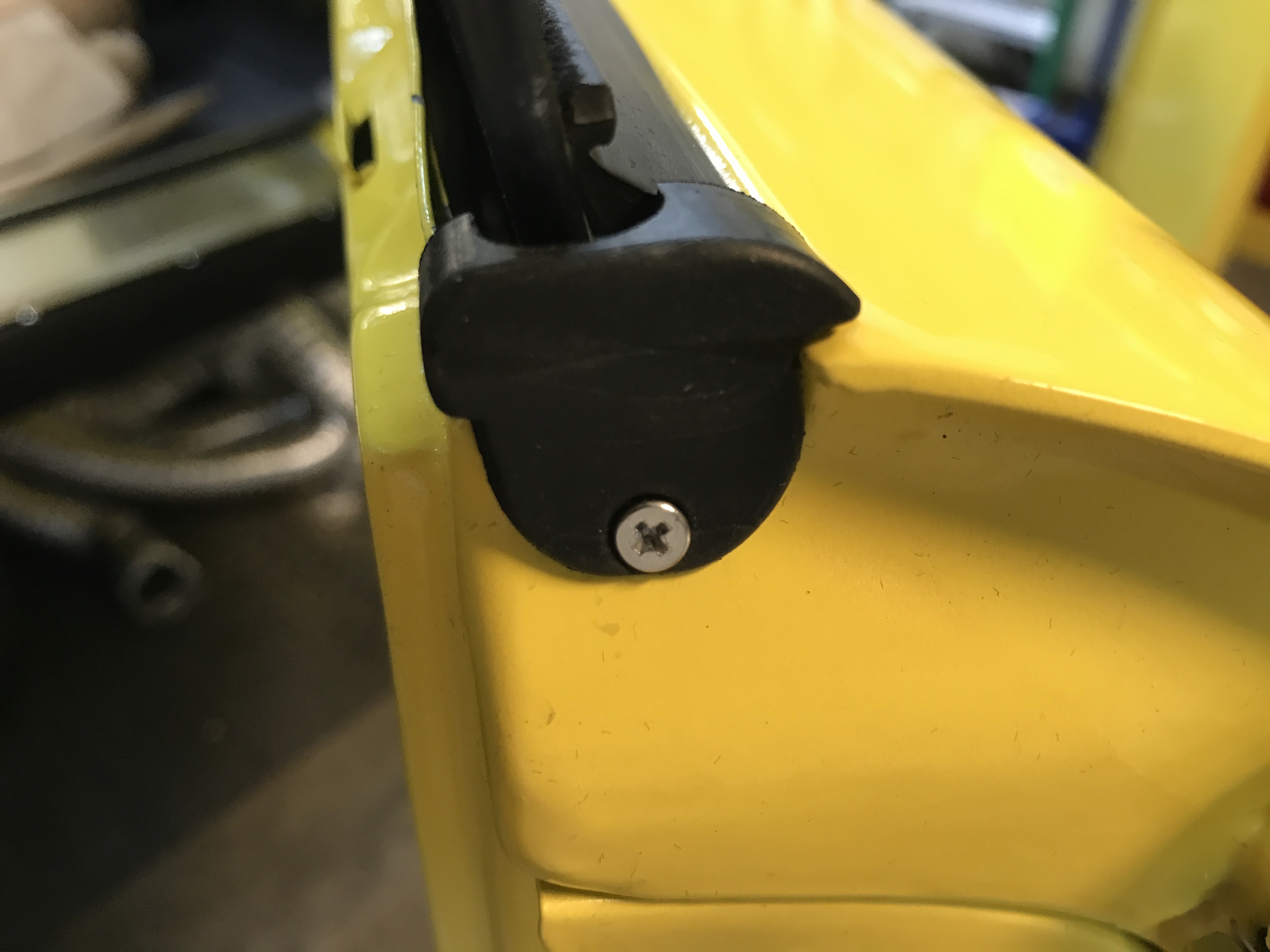

Plus a small screw into the outside of the cap.

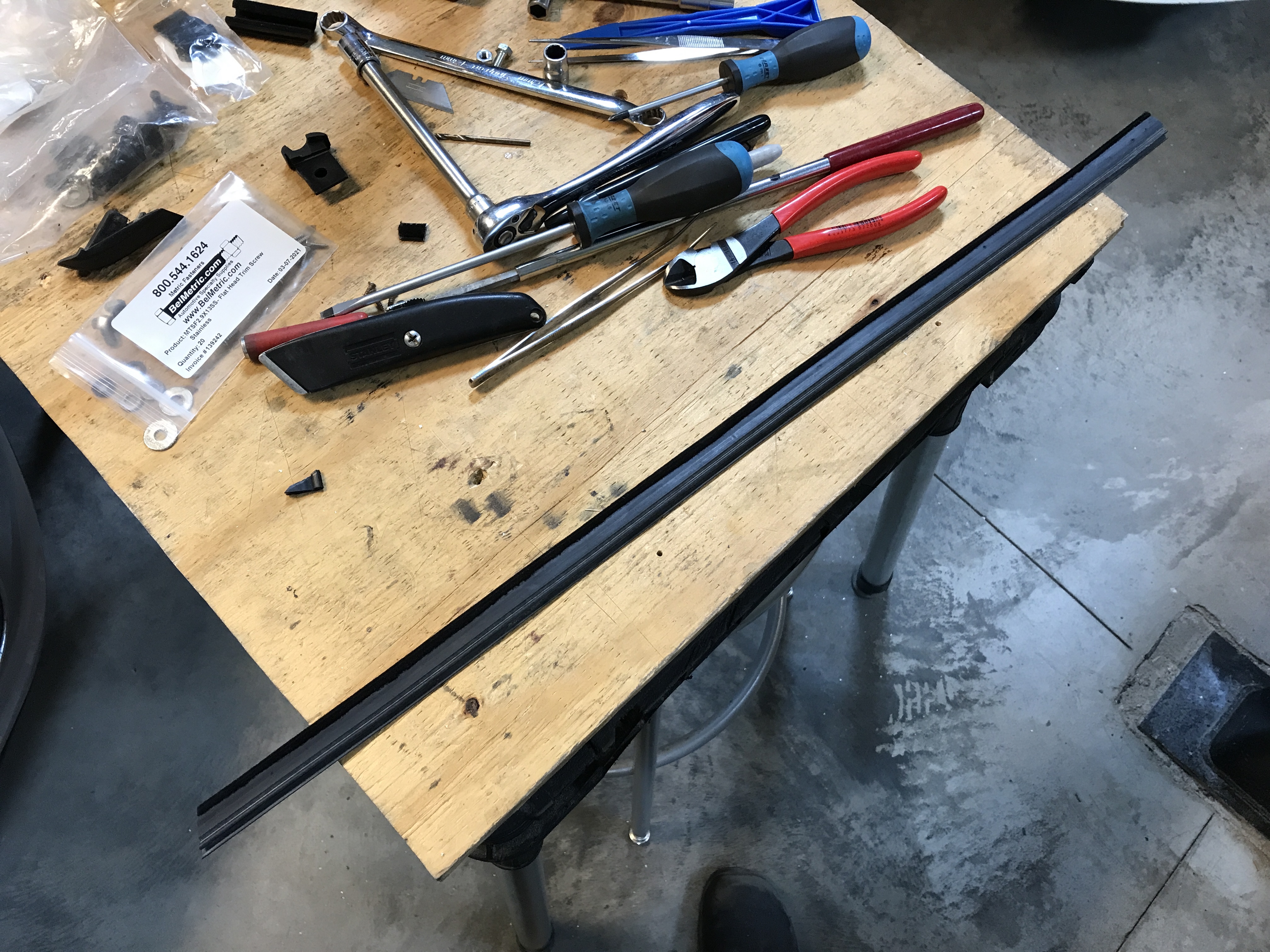

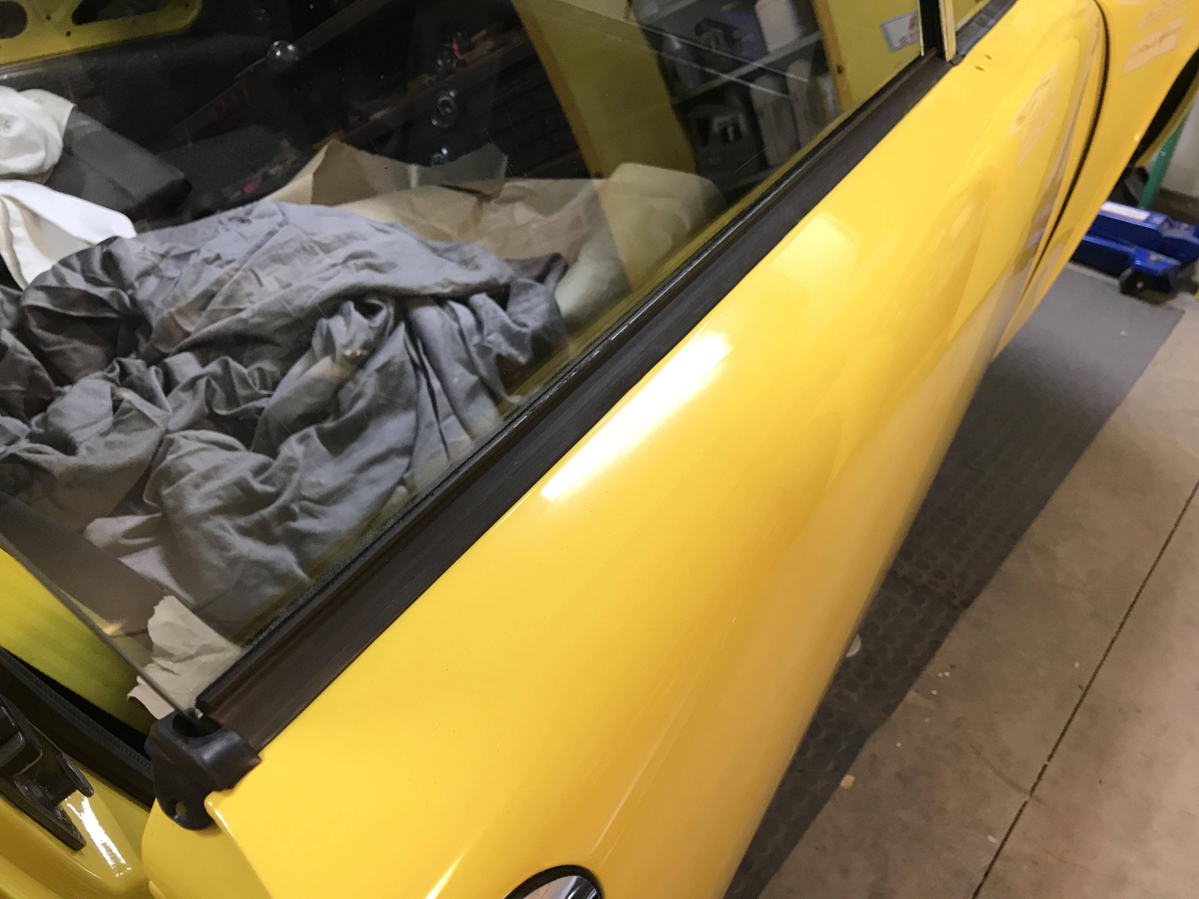

New outer window scraper.

I was able to press the bead on the scraper into the groove in sill strip, and not need to slide it.

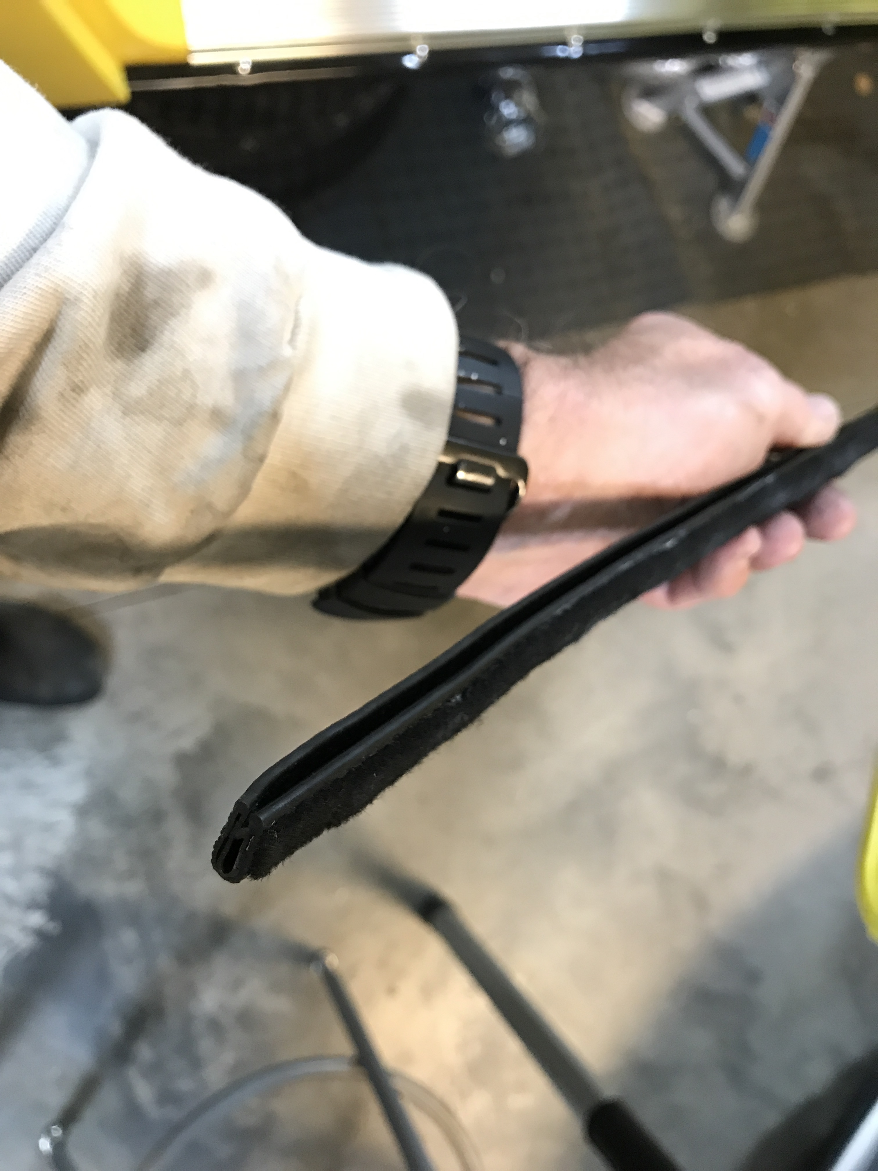

New inner fuzzy.

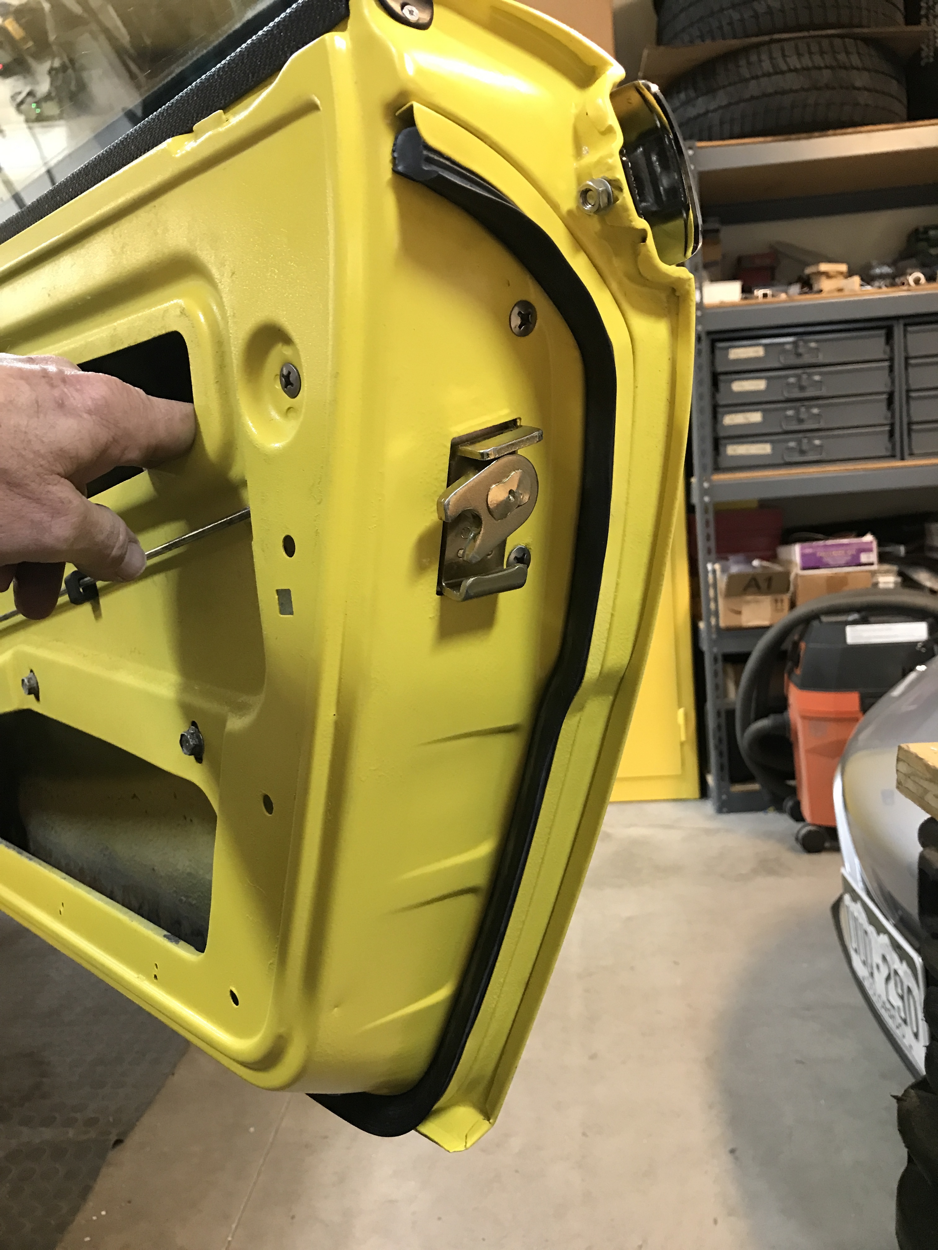

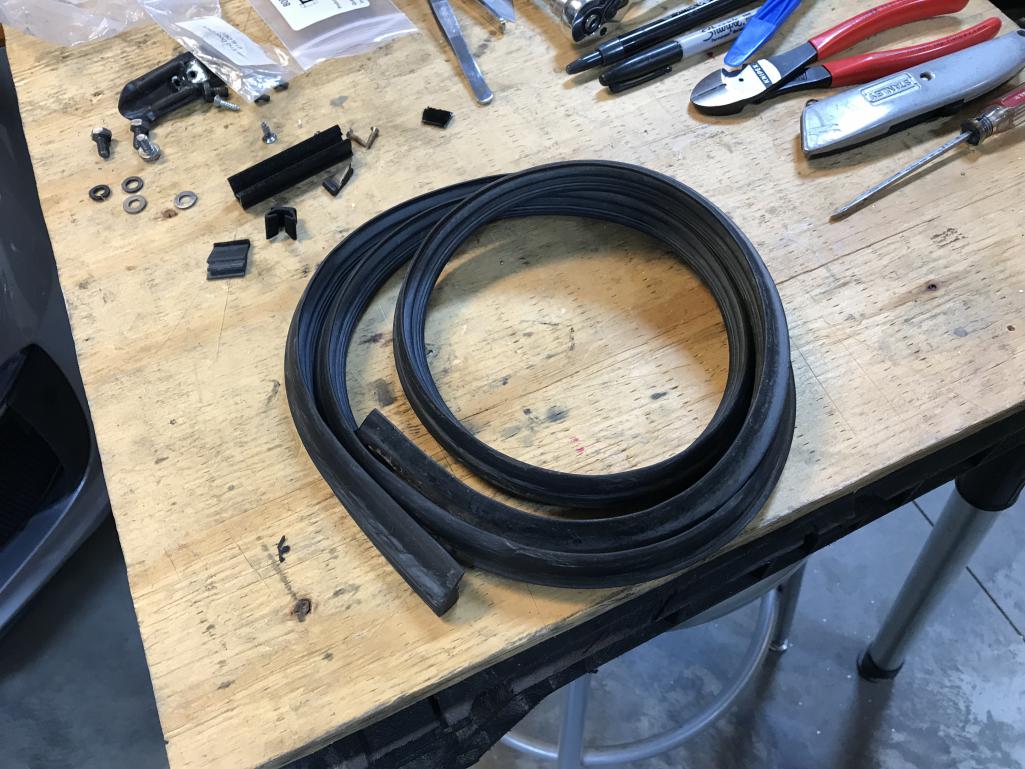

Then the new door seal rubber.
bkrantz
post Apr 6 2022, 07:51 PM
Post #4991
Posts: 8,530
Joined: 3-August 19
From: SW Colorado
Member No.: 23,343
Seal pressed into the door channel. It seems to fit snug without any adhesive.

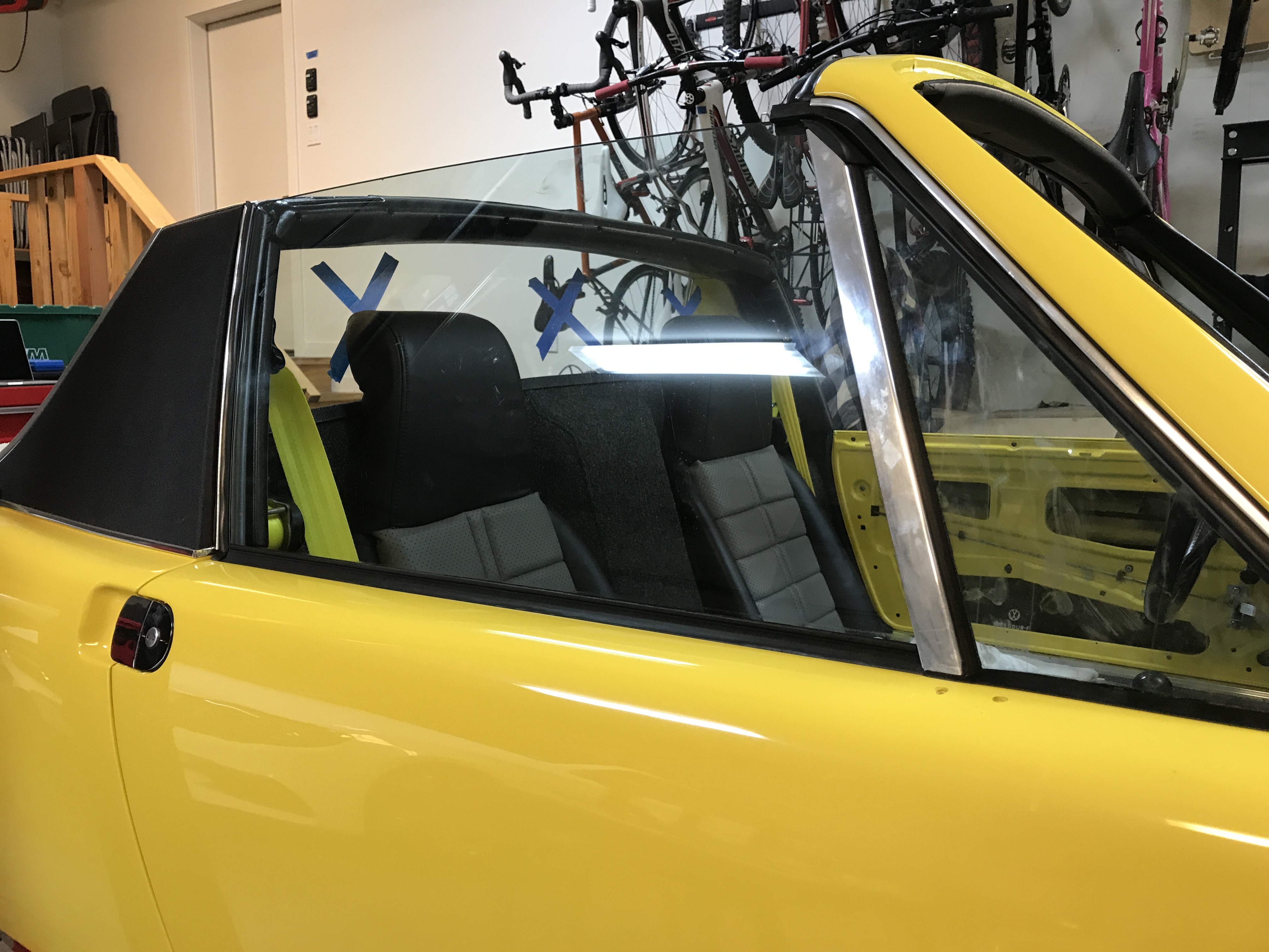

Make sure you get the top installed with all it's accompanying weatherstripping before you try to adjust the window(s) on the door.
It all goes together, so one affects the other.
Looking good.

QUOTE(raynekat @ Apr 6 2022, 08:50 PM) *
Looking good.
Yup. My problem is waiting on the paint shop that did my car to get the top done. But they are down on staff and up on other projects.

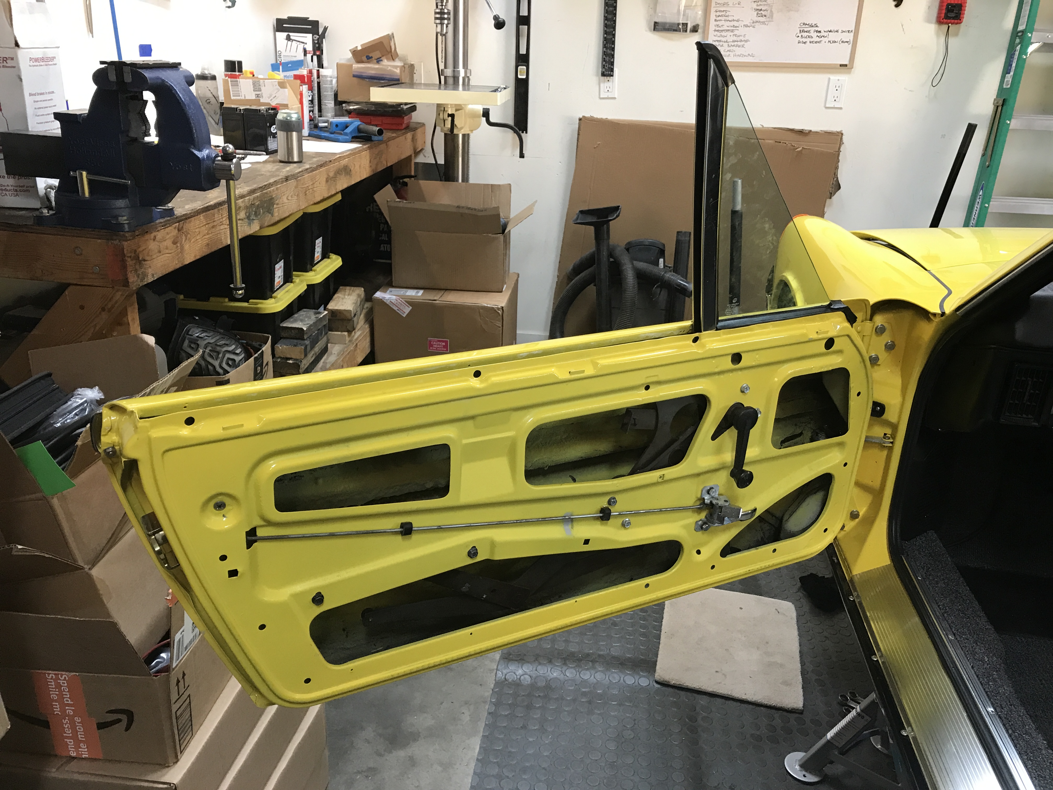

I got started on the left door today. I think that's the last door. (IMG:style_emoticons/default/idea.gif)

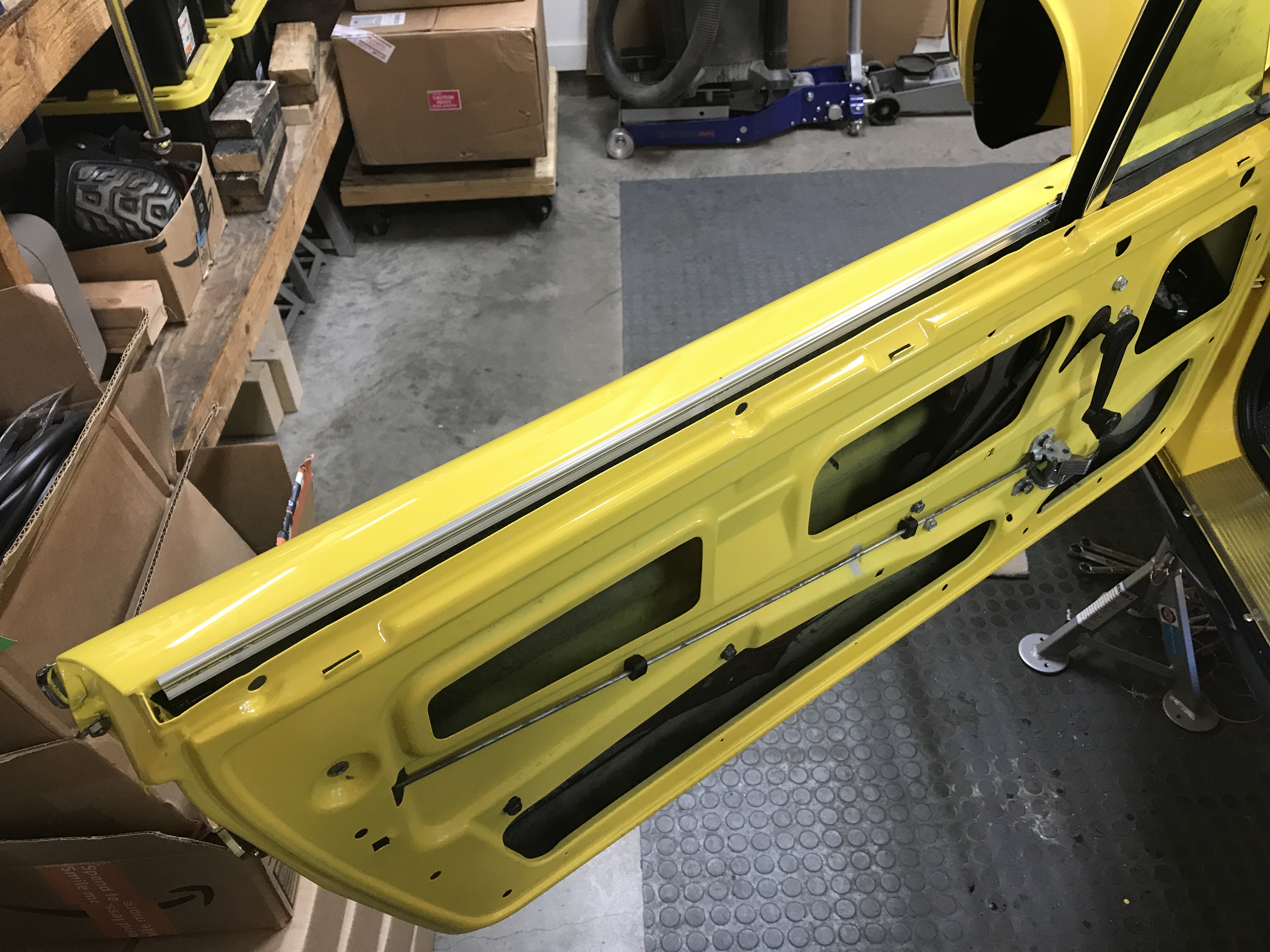

From: SW Colorado
Member No.: 23,343
Sill strip installed, with new stainless screws.

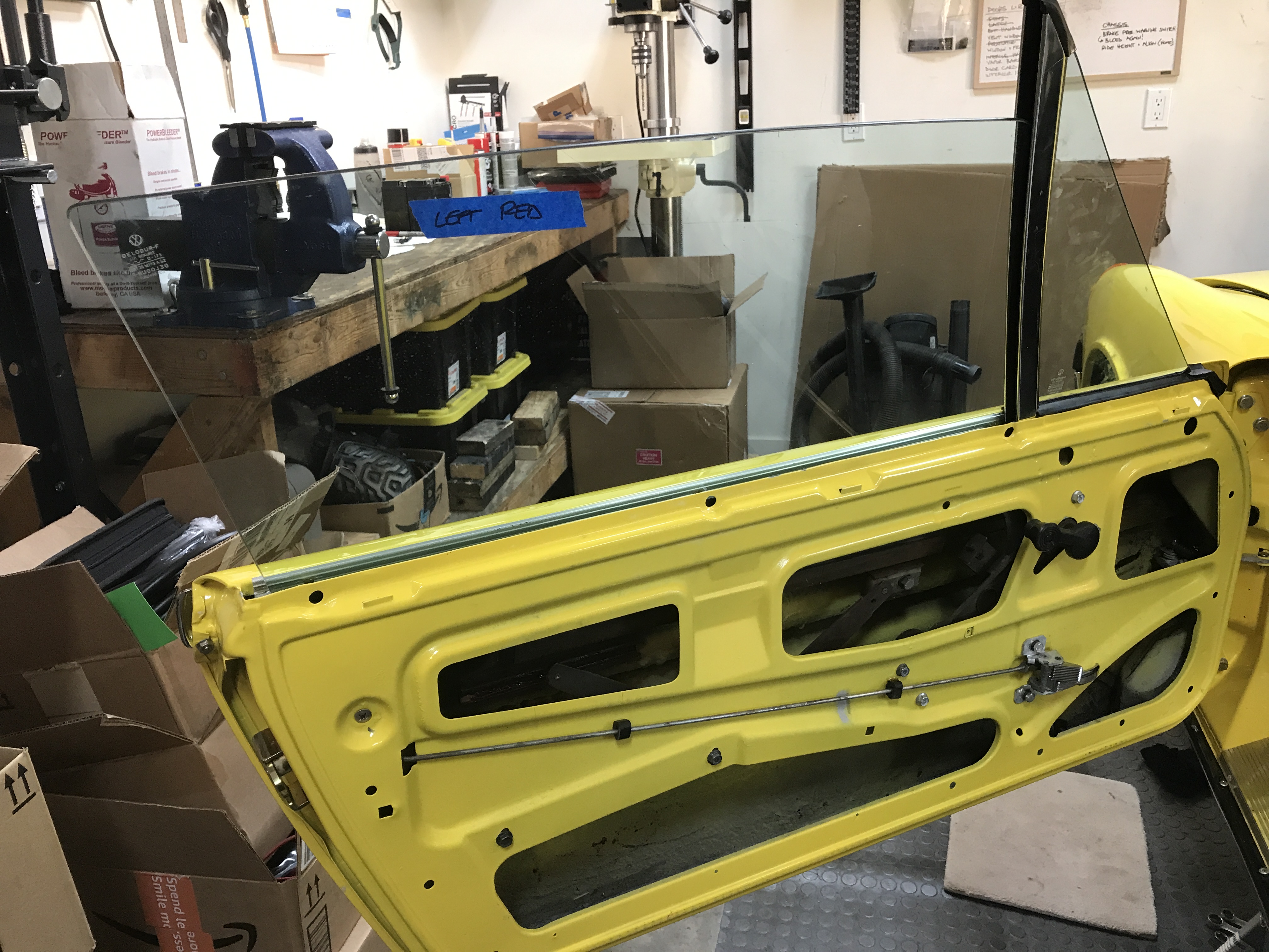

From: SW Colorado
Member No.: 23,343
Glass inserted and attached to the winder. More grease!
