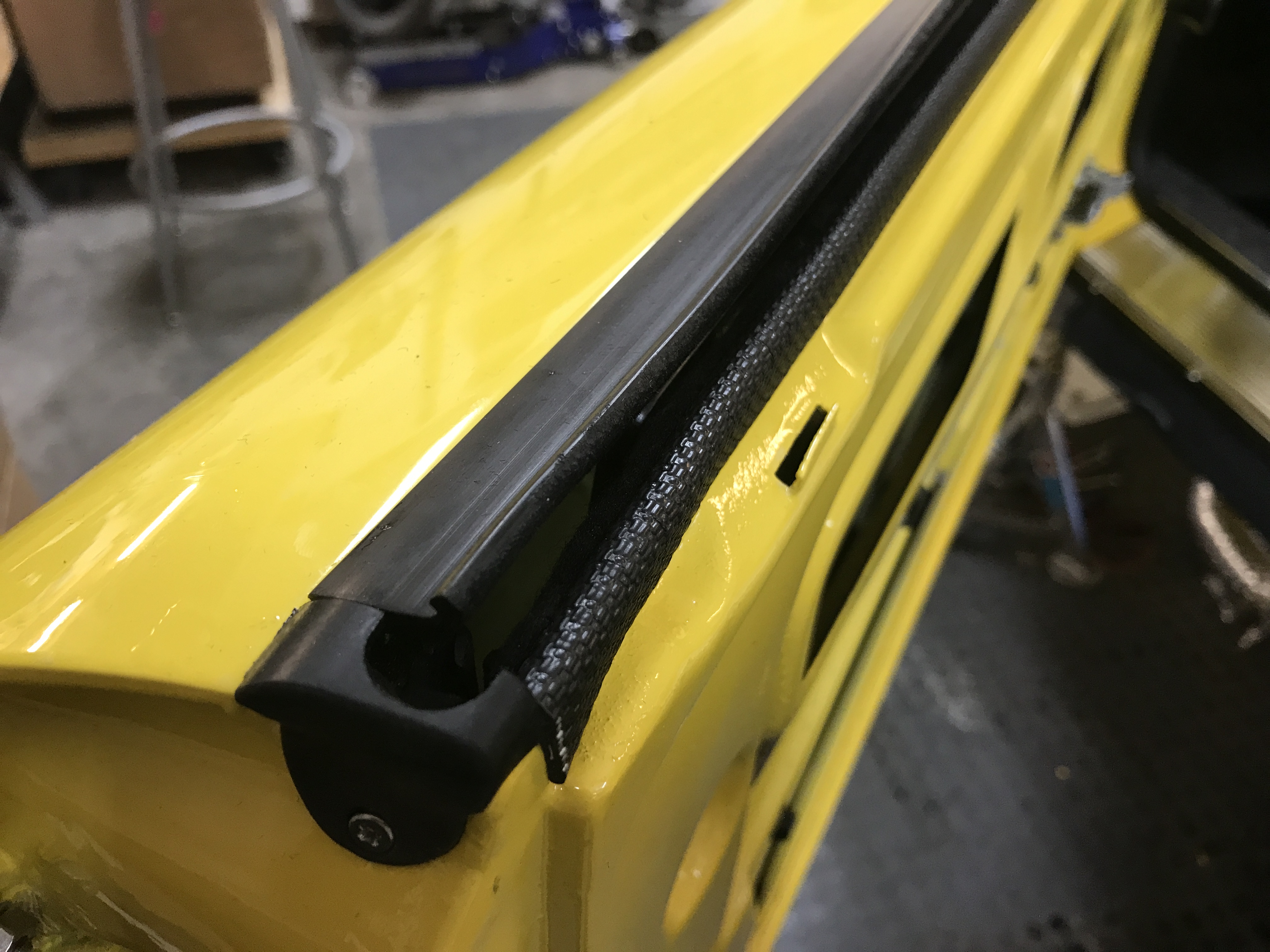

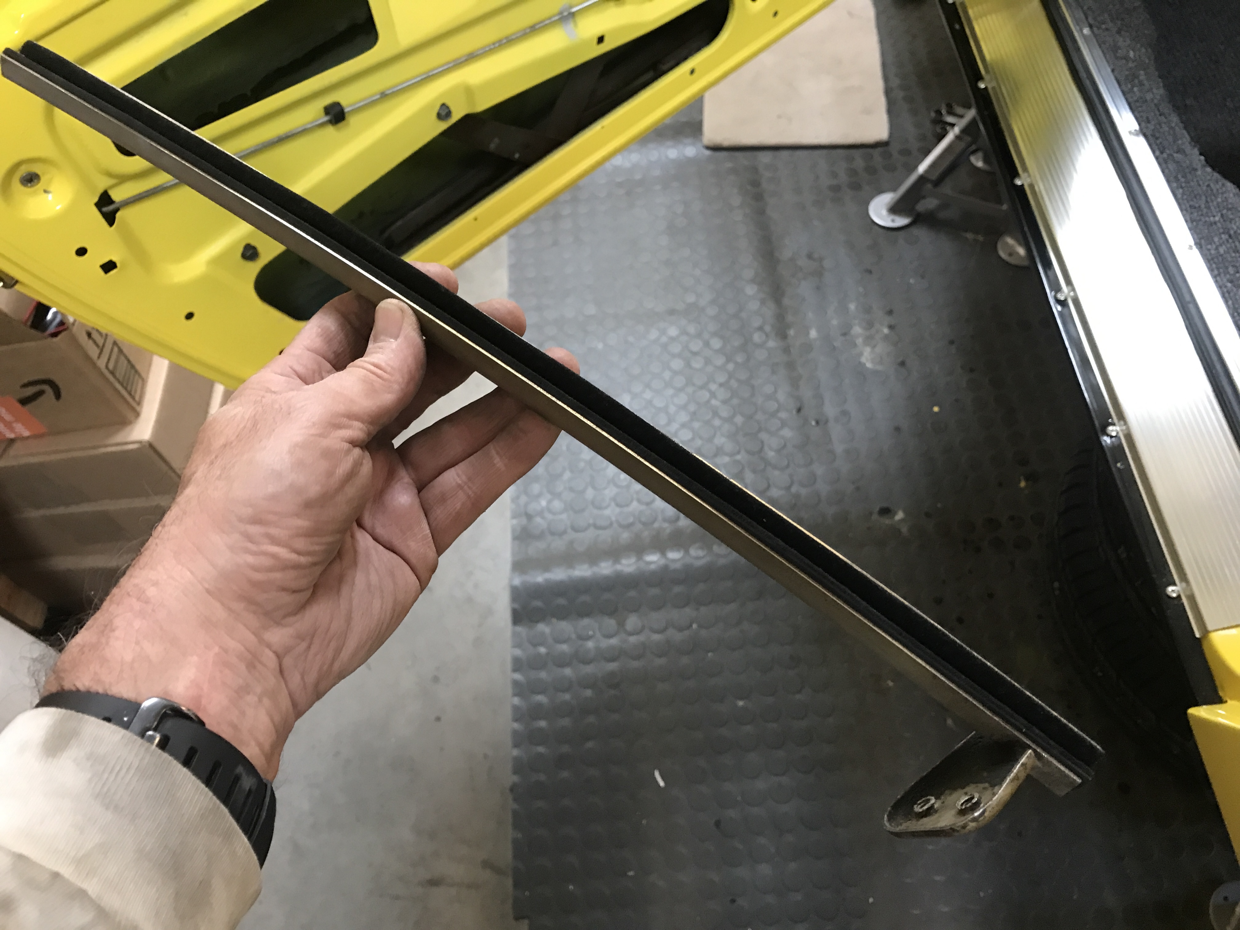

Rear window channel with new fuzzy.

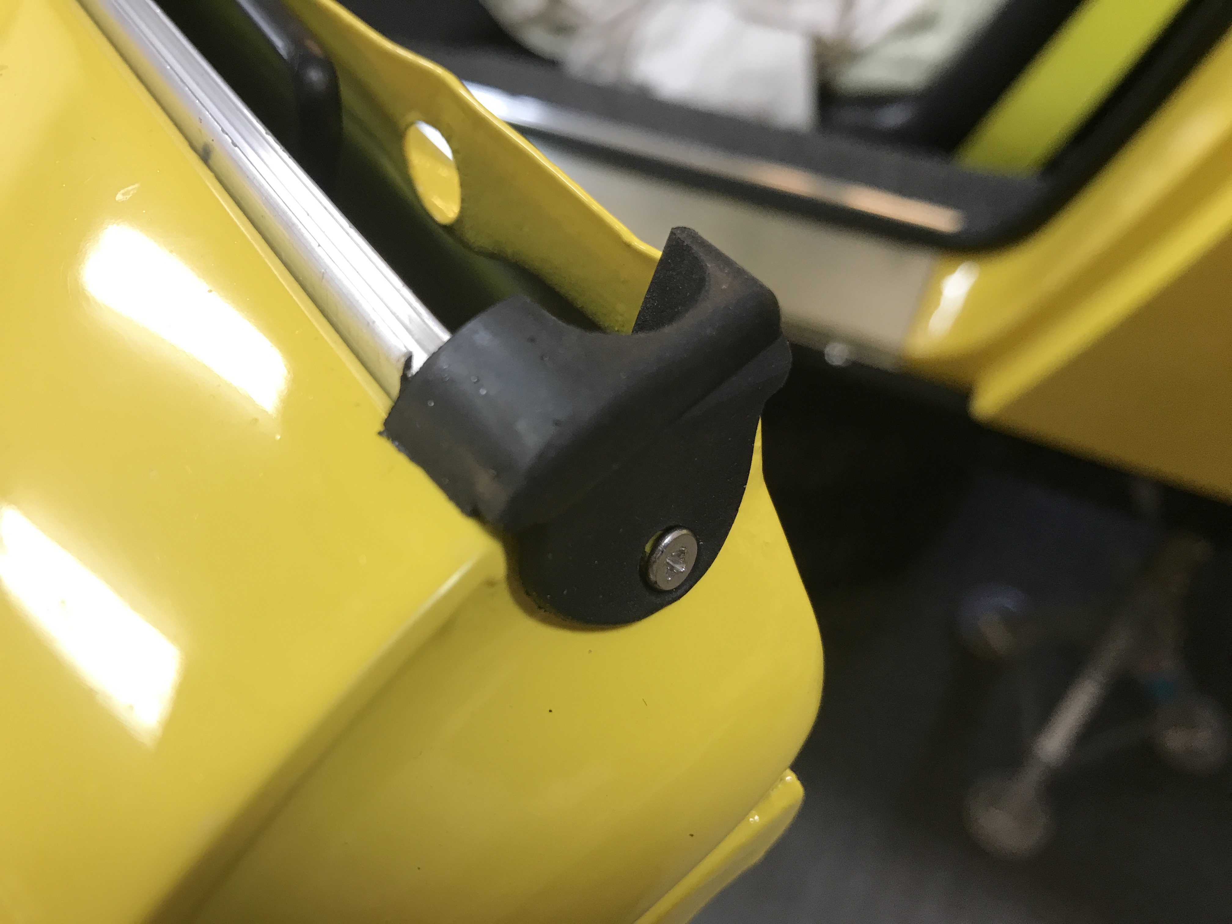

New rear cap, after screwing the channel top to the door.

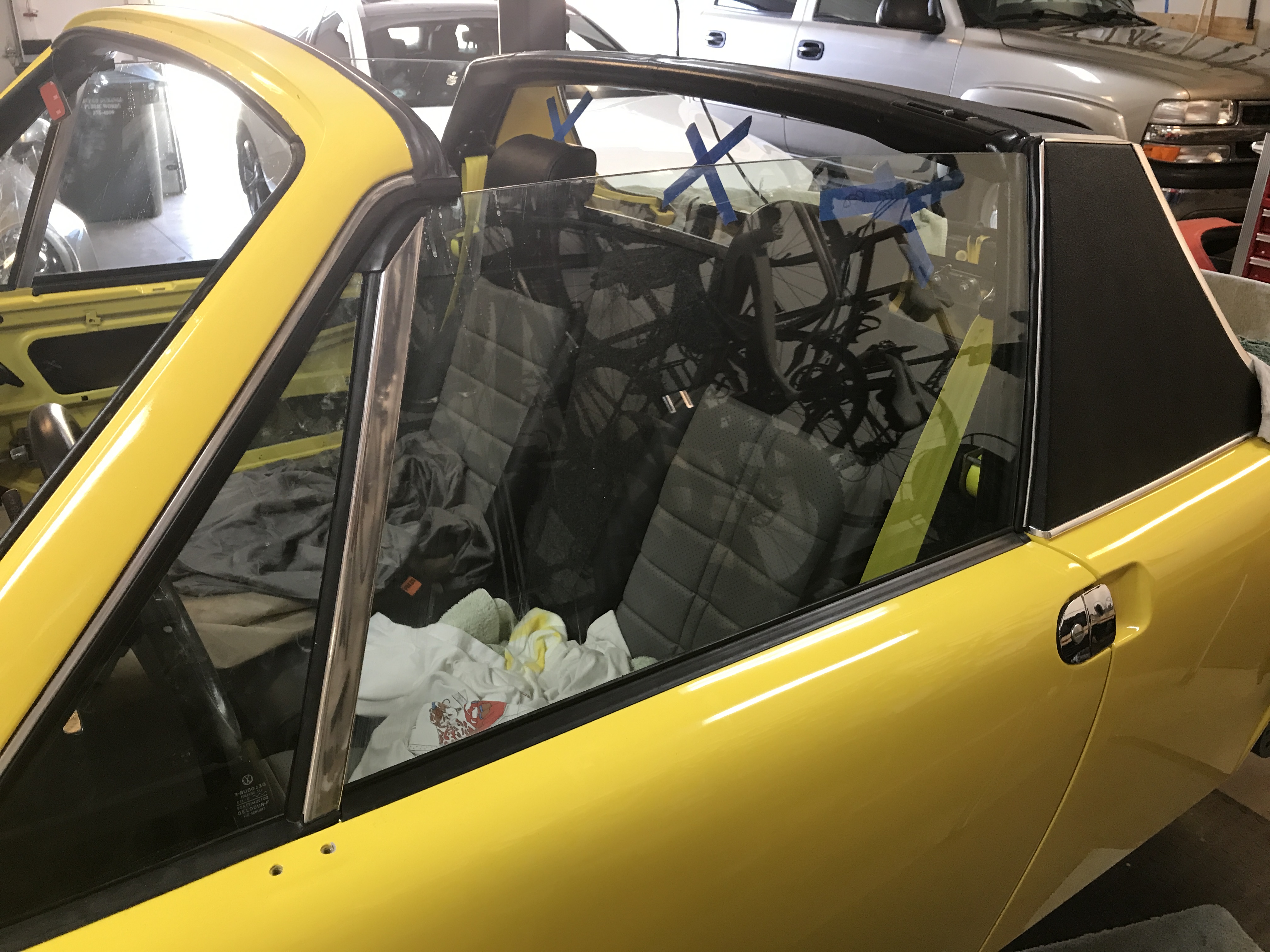

More on the left door today. New inner fuzzy and outer scraper.
bkrantz
post Apr 8 2022, 06:40 PM
Post #5005
Posts: 8,530
Joined: 3-August 19
From: SW Colorado
Member No.: 23,343

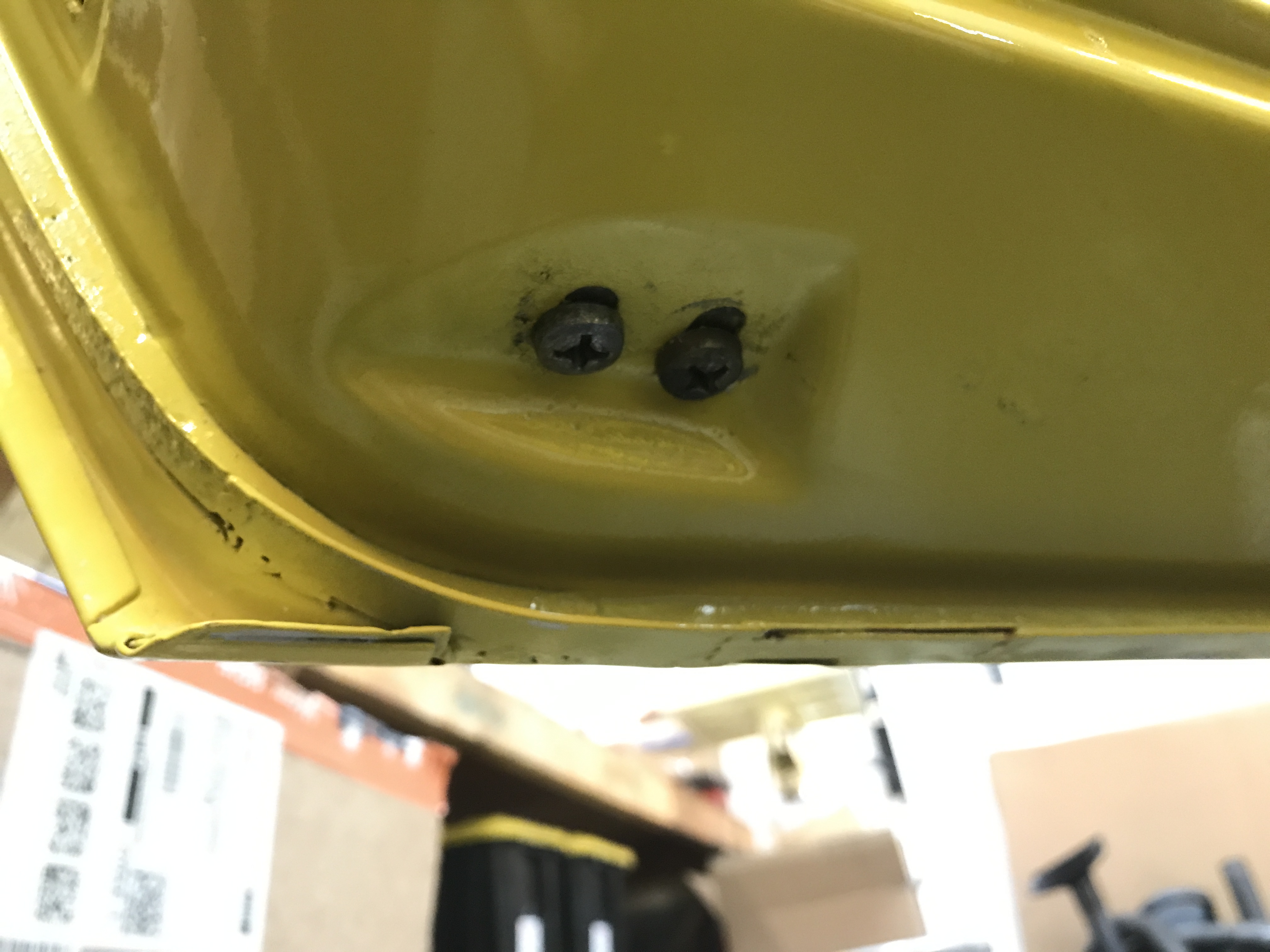

Bottom of rear window channel attached with oval head screws, as per PET. I went back to the right door to correct this, too.
bkrantz
post Apr 8 2022, 06:42 PM
Post #5006
Posts: 8,530
Joined: 3-August 19
From: SW Colorado
Member No.: 23,343

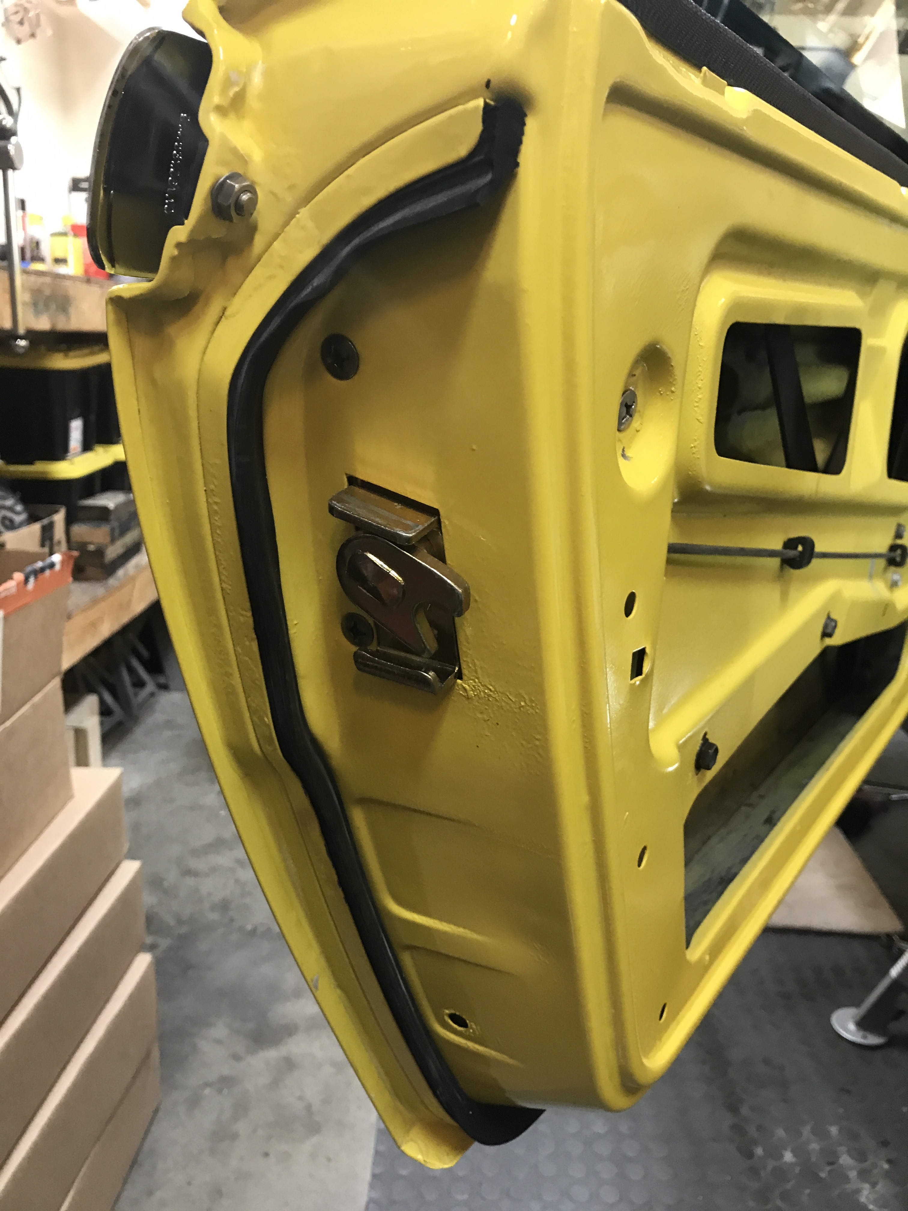

And then a new door weatherstrip. Again, a decent press fit without adhesive.
bkrantz
post Apr 8 2022, 06:44 PM
Post #5007
Posts: 8,530
Joined: 3-August 19
From: SW Colorado
Member No.: 23,343
Left door done for now. Final alignment will have to wait until I get my targa top back from the paint shop.
But it is nice to hear both doors close with a solid "thump". (IMG:style_emoticons/default/cheer.gif)

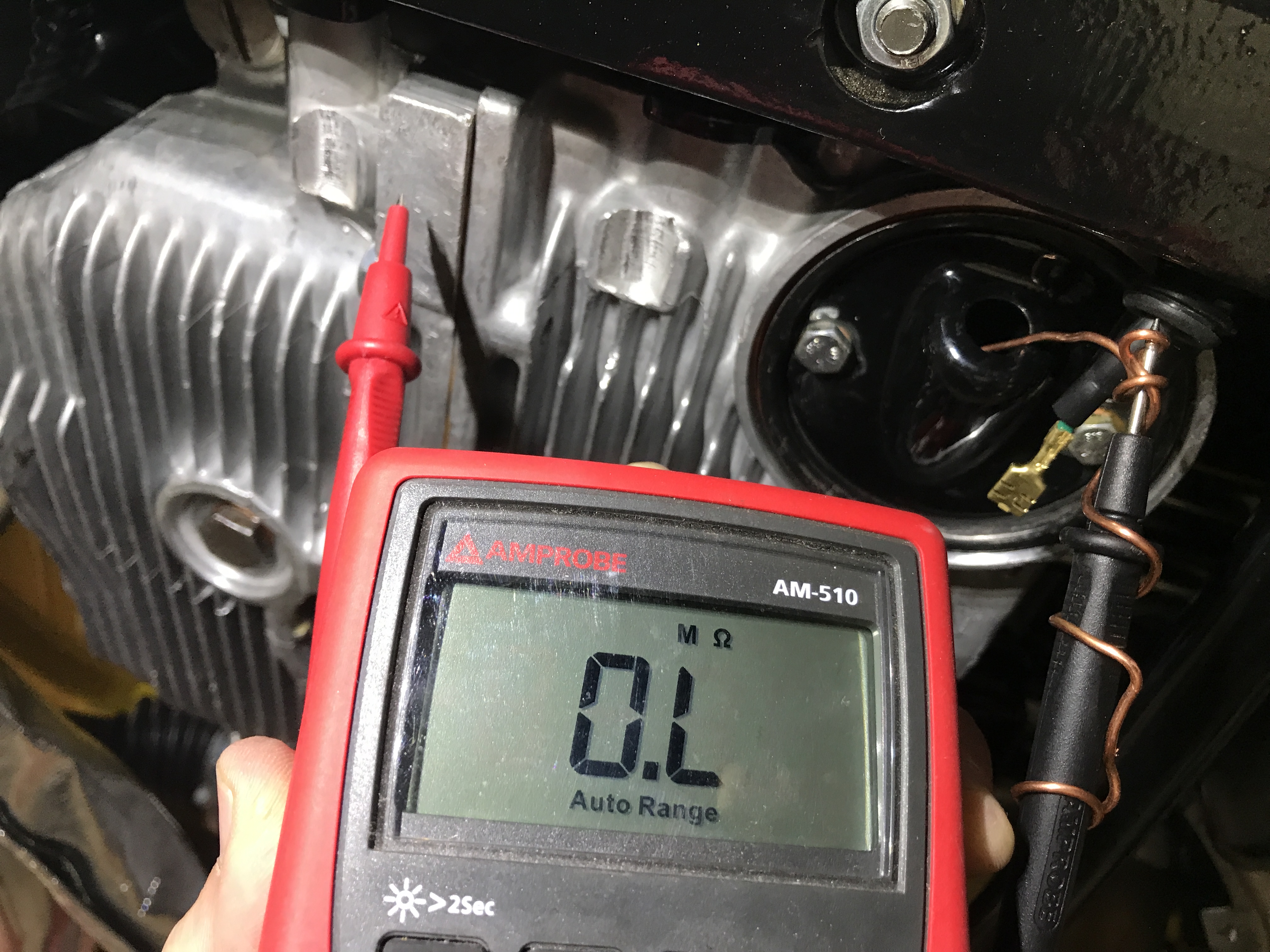

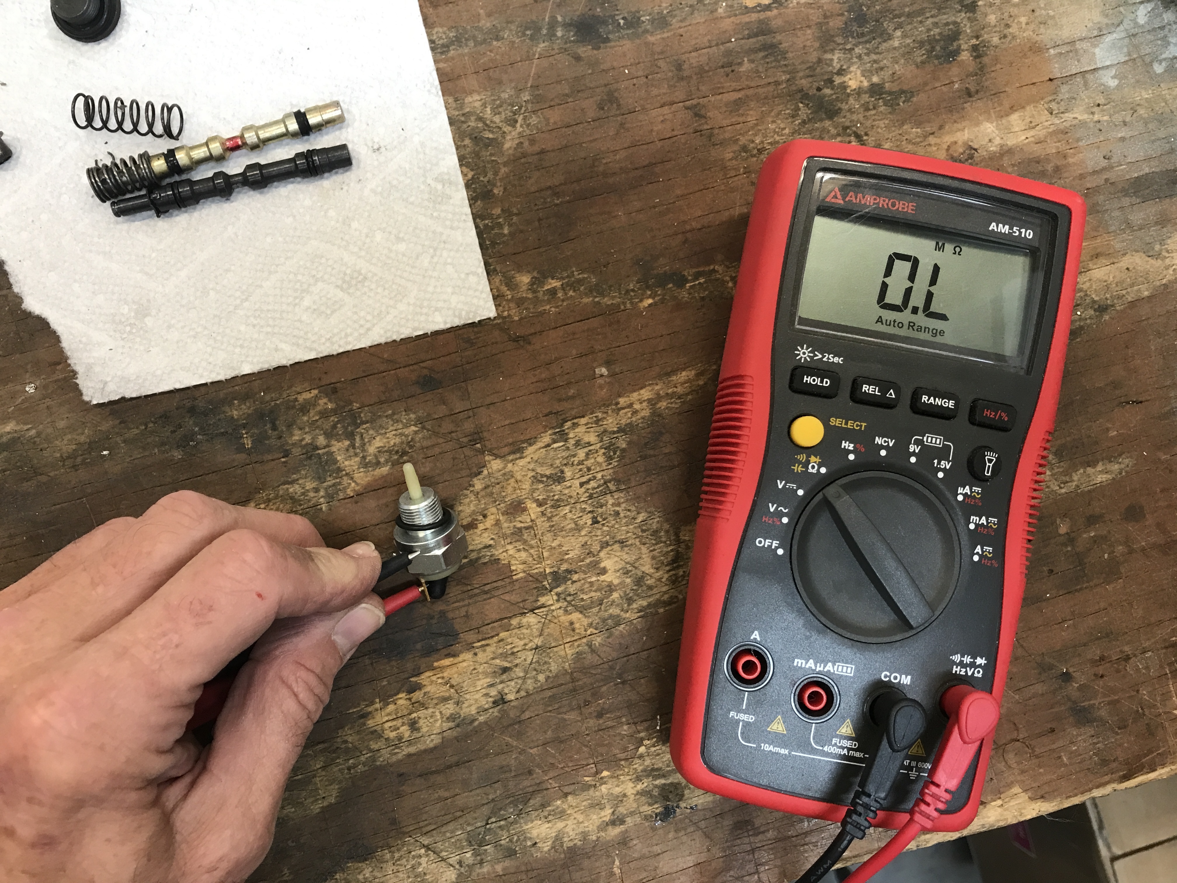

I started to track down my problem with the oil temp. The gauge seems to work (it flicks up slightly to indicate "cool"), but I have never seen it register any "heat".
I understand the sender should register about 1000 ohms when room temp. But I read a wide open circuit. (How do you like my custom probe extension?)

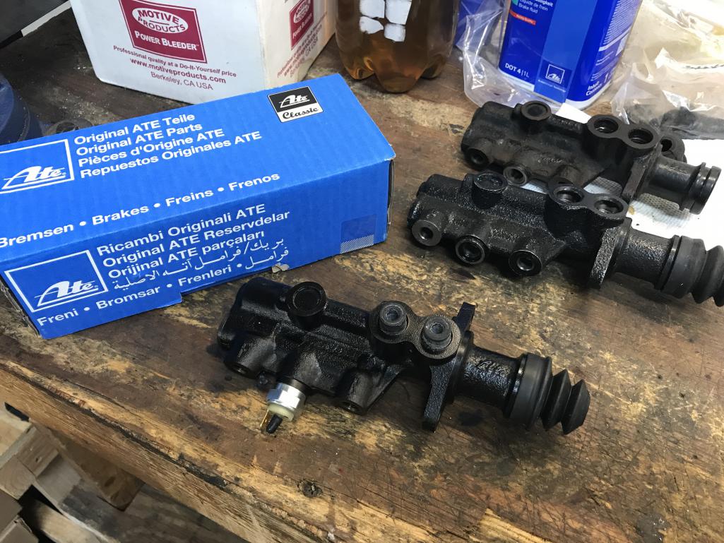

While I was pondering the oil temp sender, the Fedex driver delivered my new brake master cylinder. This one is genuine ATE.

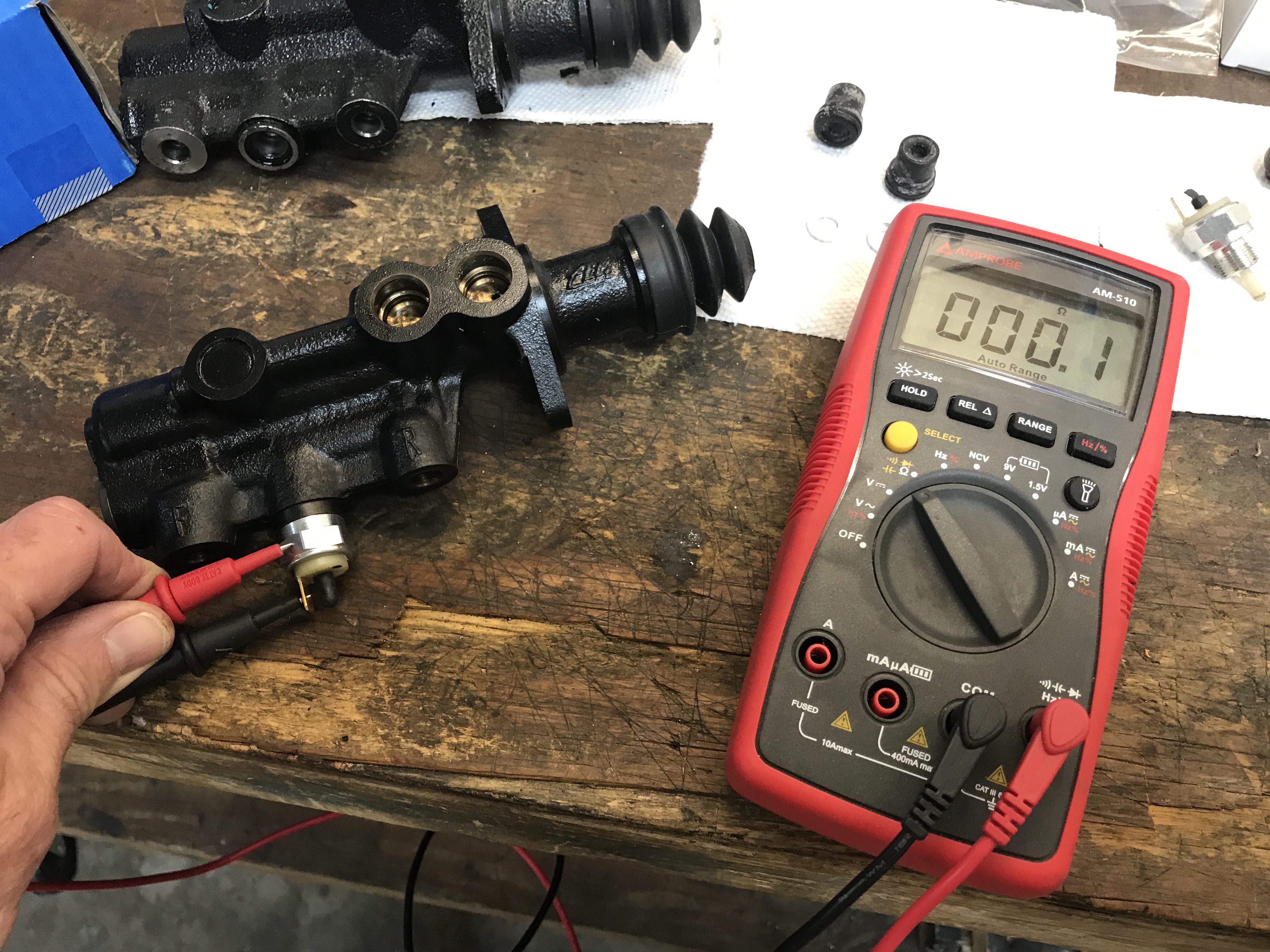

Since I have been burned by bad warning swtiches, I tested the new one--and found the circuit closed. i.e. it would trigger the warning light.

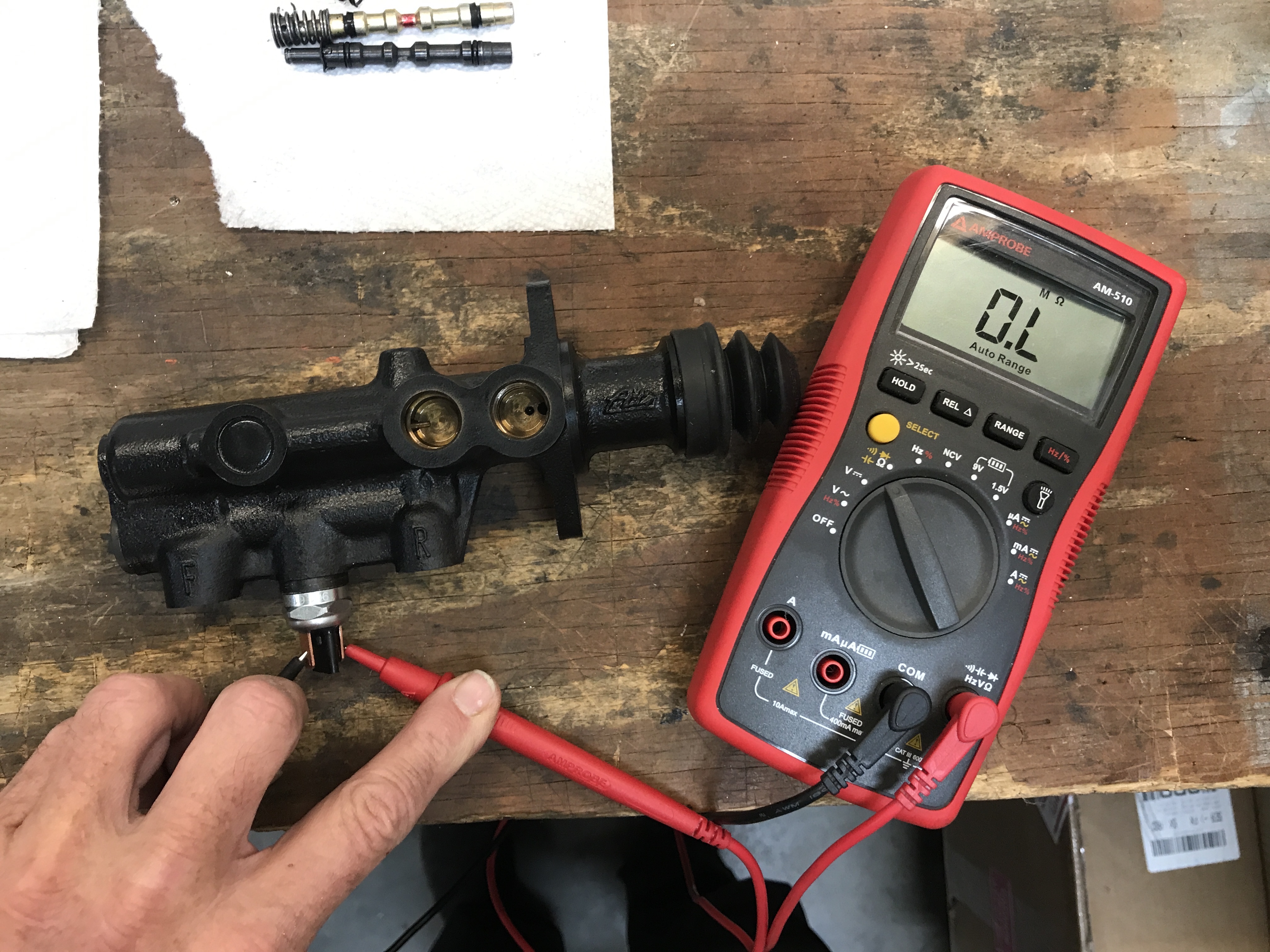

I pulled the new switch, and reset the plunger by pulling it out. Now the circuit is open.
bkrantz
post Apr 10 2022, 07:21 PM
Post #5013
Posts: 8,530
Joined: 3-August 19
From: SW Colorado
Member No.: 23,343
But I want to use my new dual-connector switch. I checked it again, installed it, and the circuit is open, as it should be.

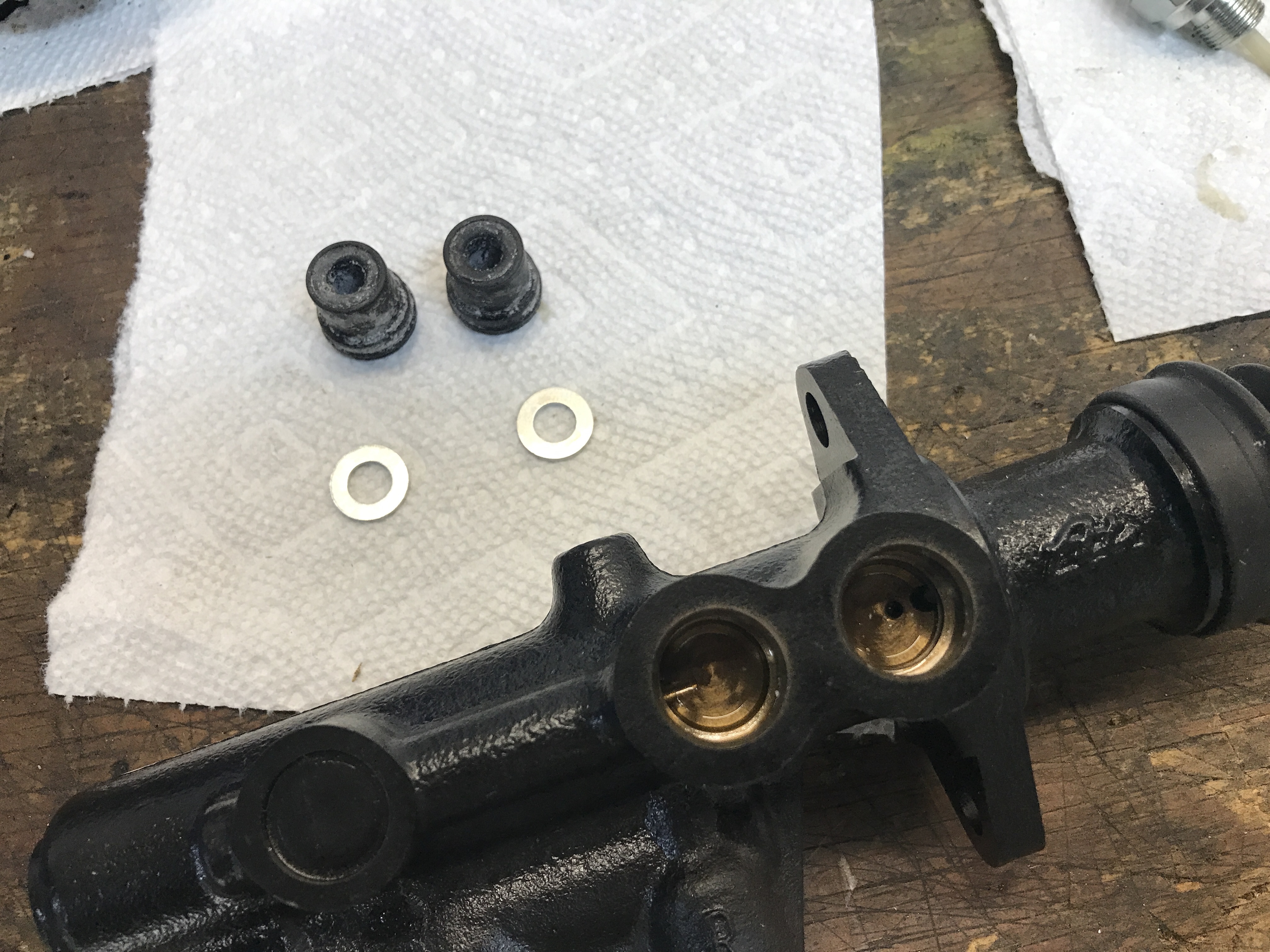

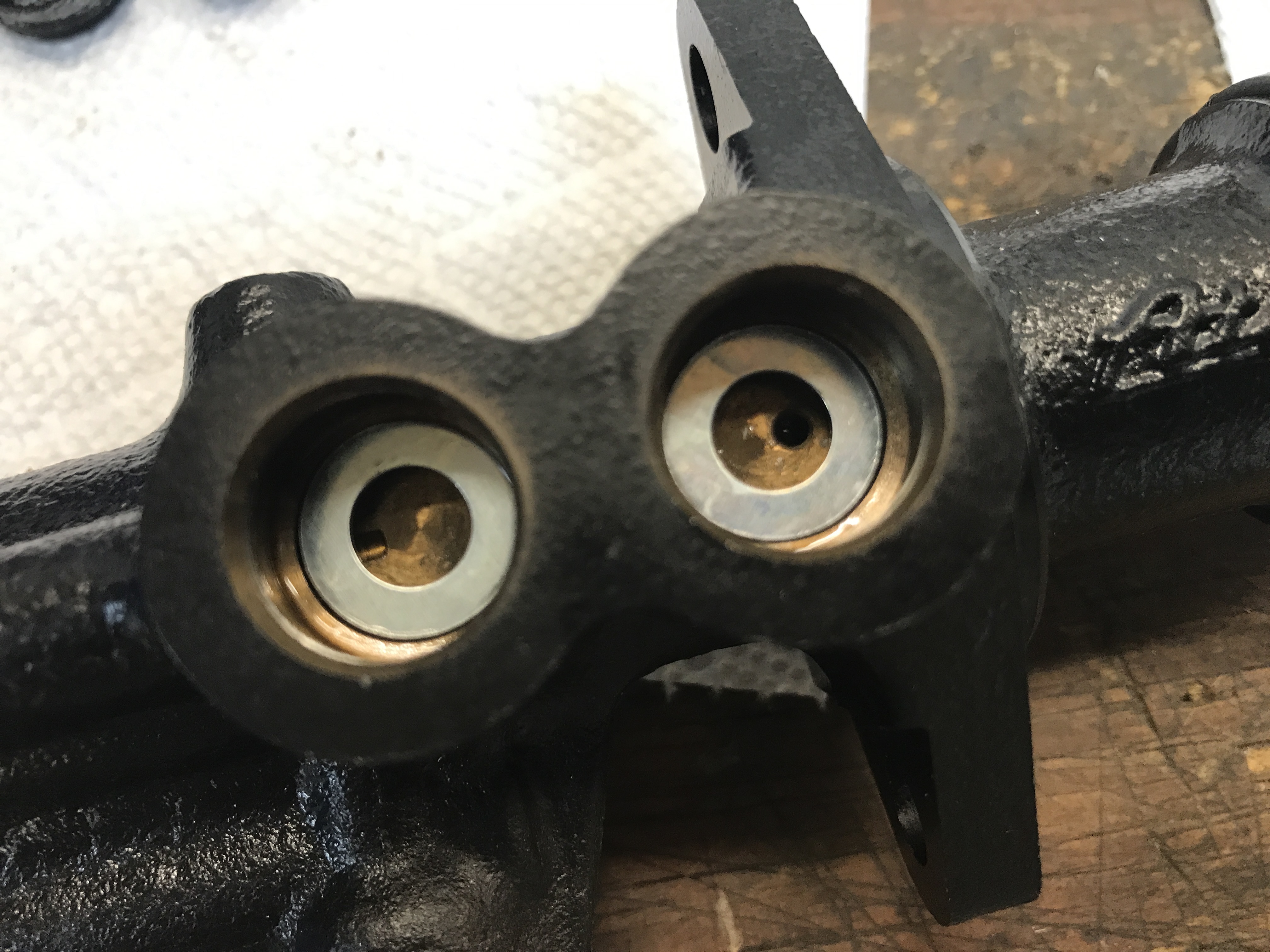

Now to install new washers and rubber bushings in the MC.
bkrantz
post Apr 10 2022, 07:23 PM
Post #5015
Posts: 8,530
Joined: 3-August 19
From: SW Colorado
Member No.: 23,343
Just a photo to remind me that I did not forget the washers!

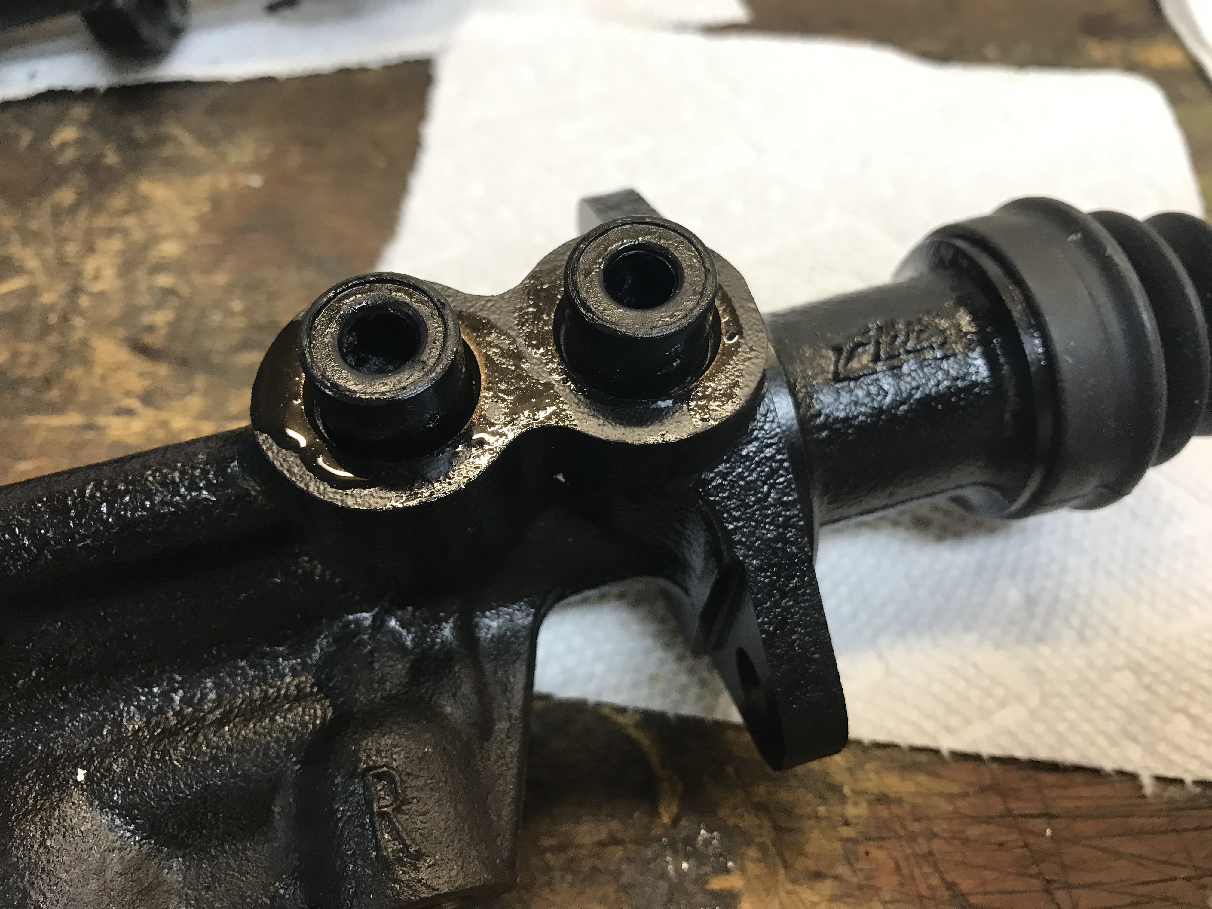

And new grommets, lubed with brake fluid.

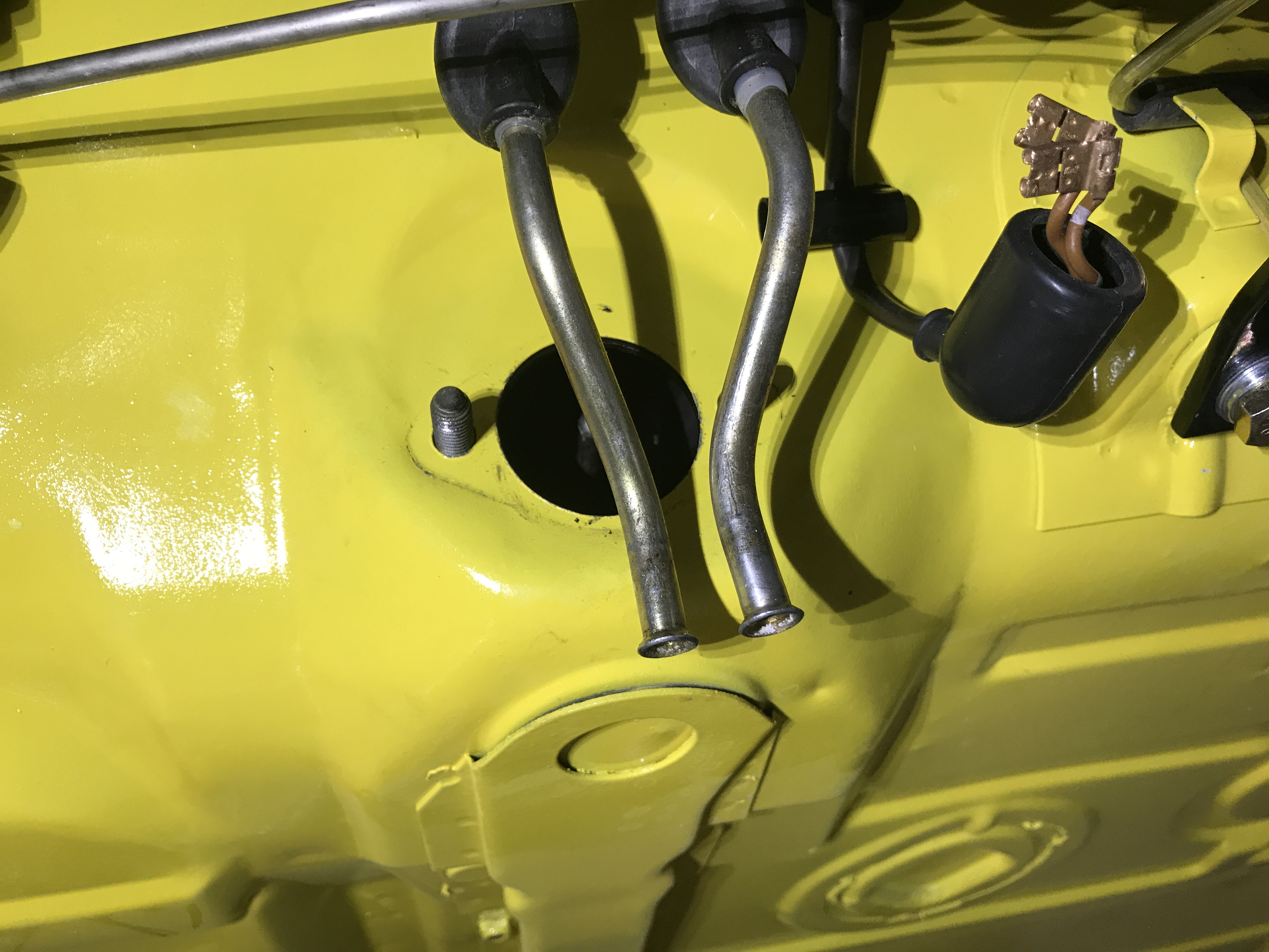

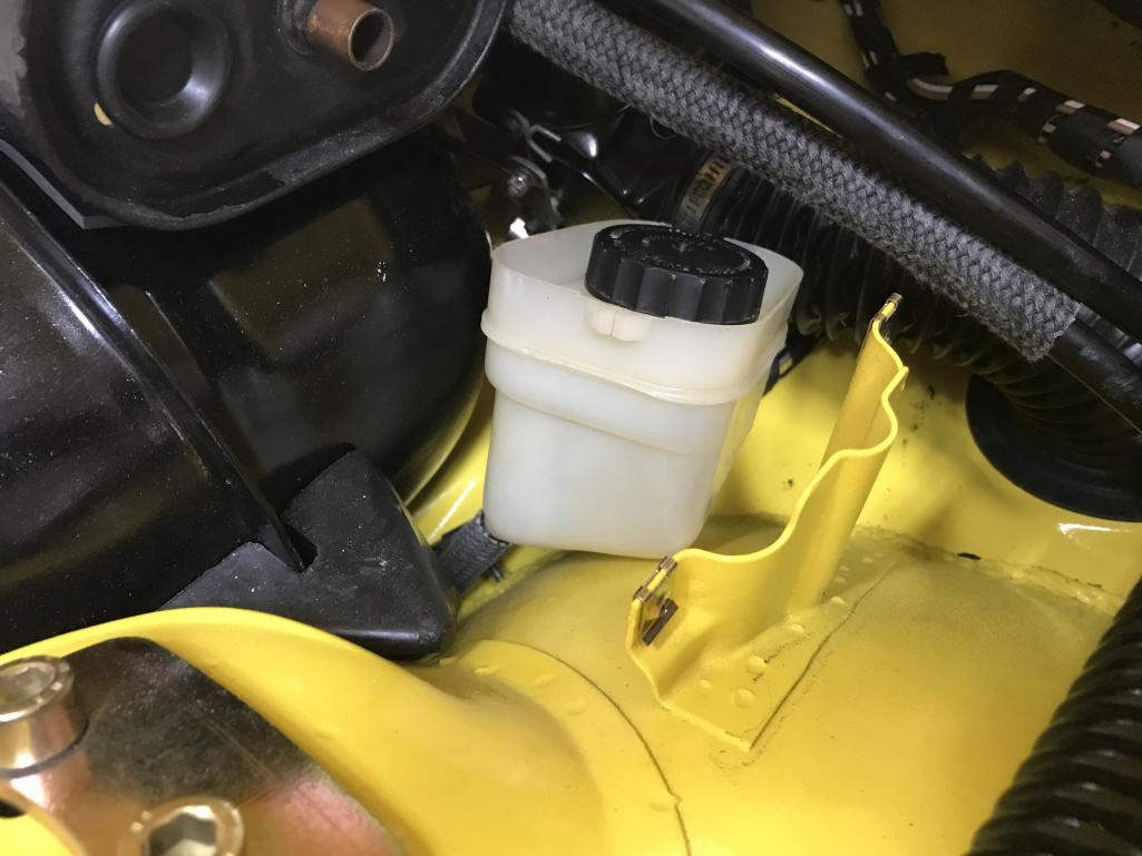

Meanwhile, in the car I detached the brake reservoir and pushed it down.
bkrantz
post Apr 10 2022, 07:28 PM
Post #5018
Posts: 8,530
Joined: 3-August 19
From: SW Colorado
Member No.: 23,343
This lets the lines project out the bottom, with enough slack to work the lines into the MC.
bkrantz
post Apr 10 2022, 07:29 PM
Post #5019
Posts: 8,530
Joined: 3-August 19
From: SW Colorado

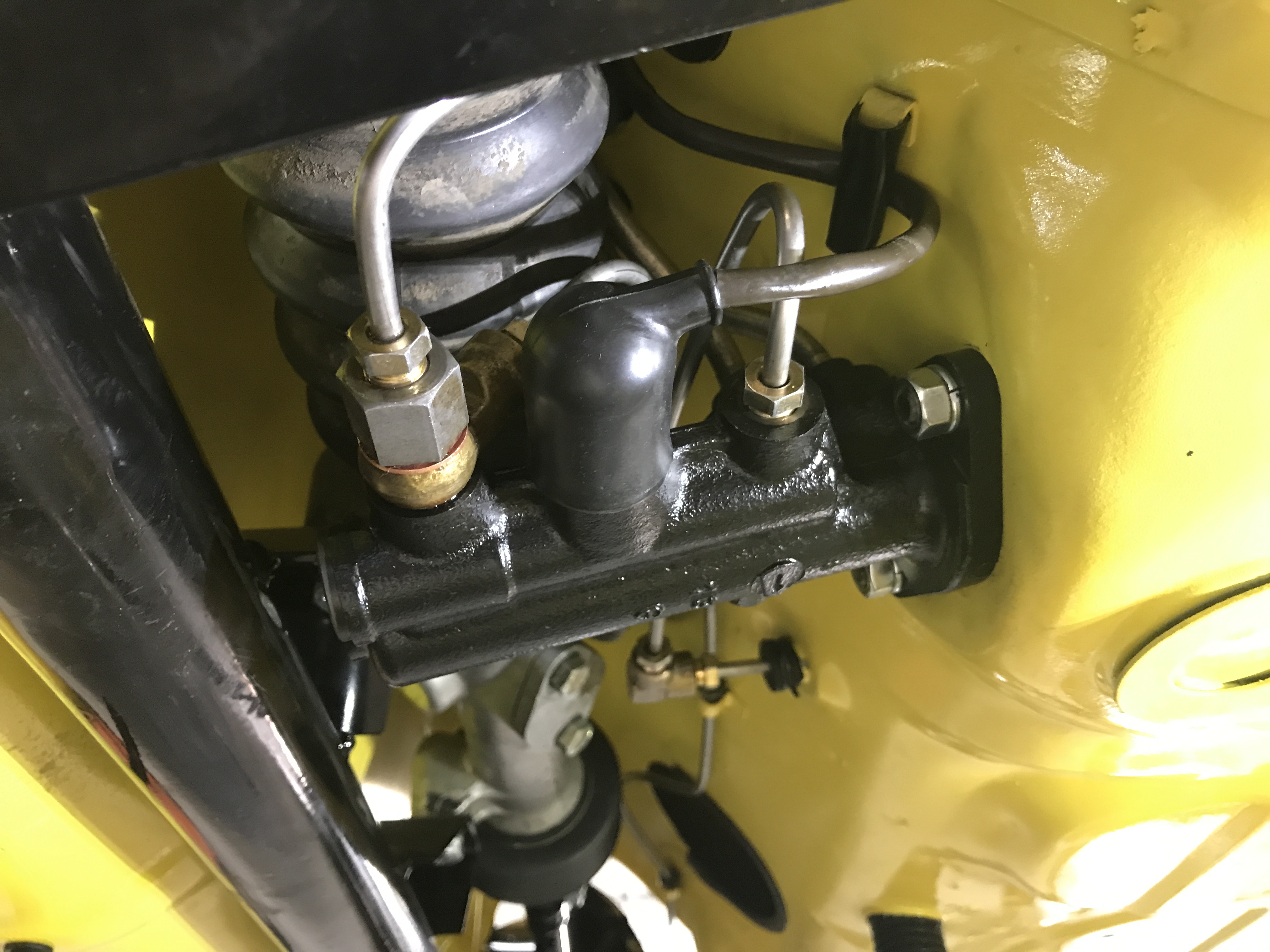

Member No.: 23,343
Like this.
bkrantz
post Apr 10 2022, 07:30 PM
Post #5020
Posts: 8,530
Joined: 3-August 19
From: SW Colorado
Member No.: 23,343

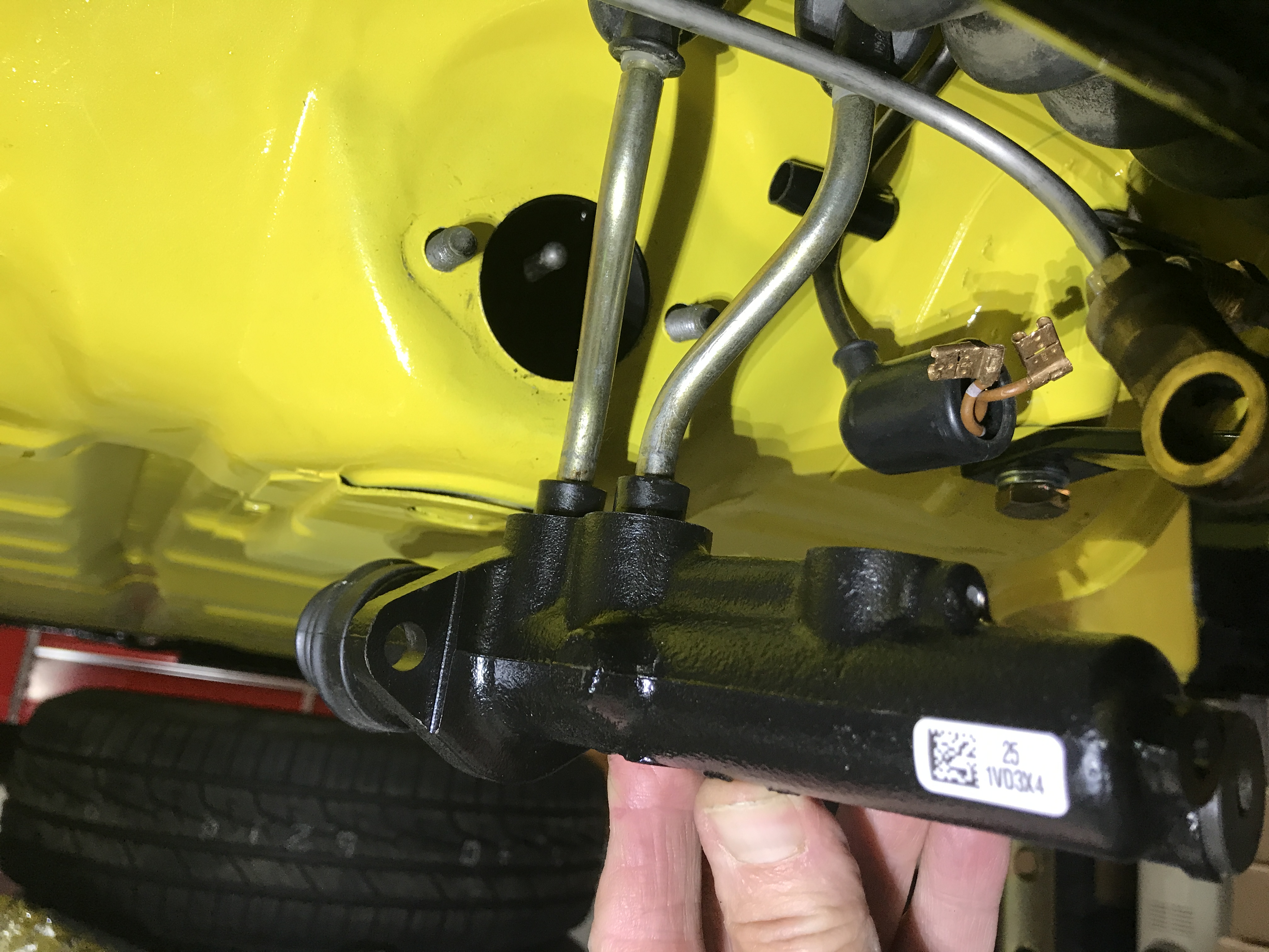

Here's the new MC installed, with all the lines connected the the emergency warning switch leads attached.
