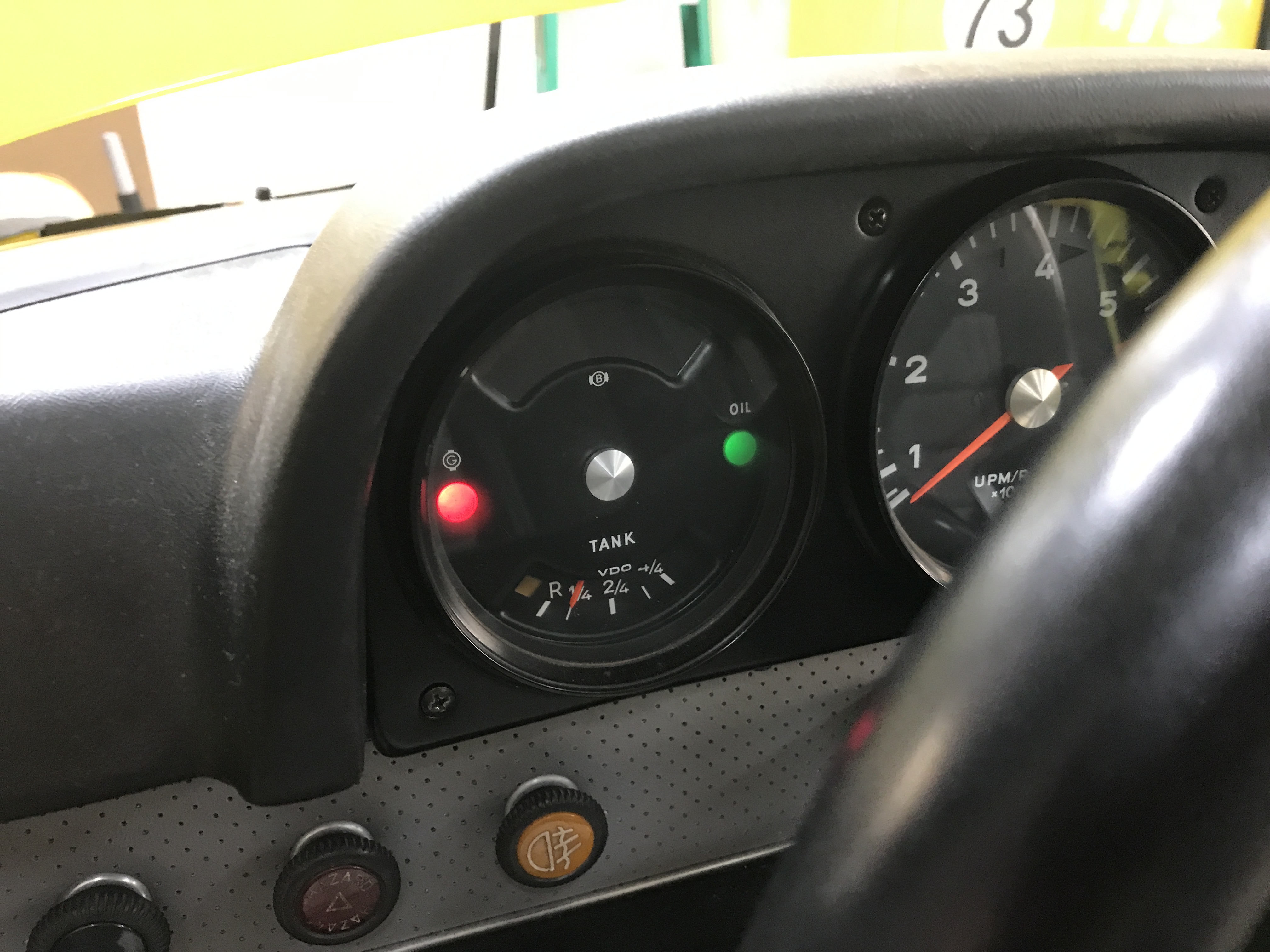

Hallelujah! For the first time I can turn on the ignition and the warning light is off! (IMG:style_emoticons/default/cheer.gif)

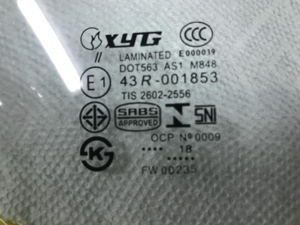

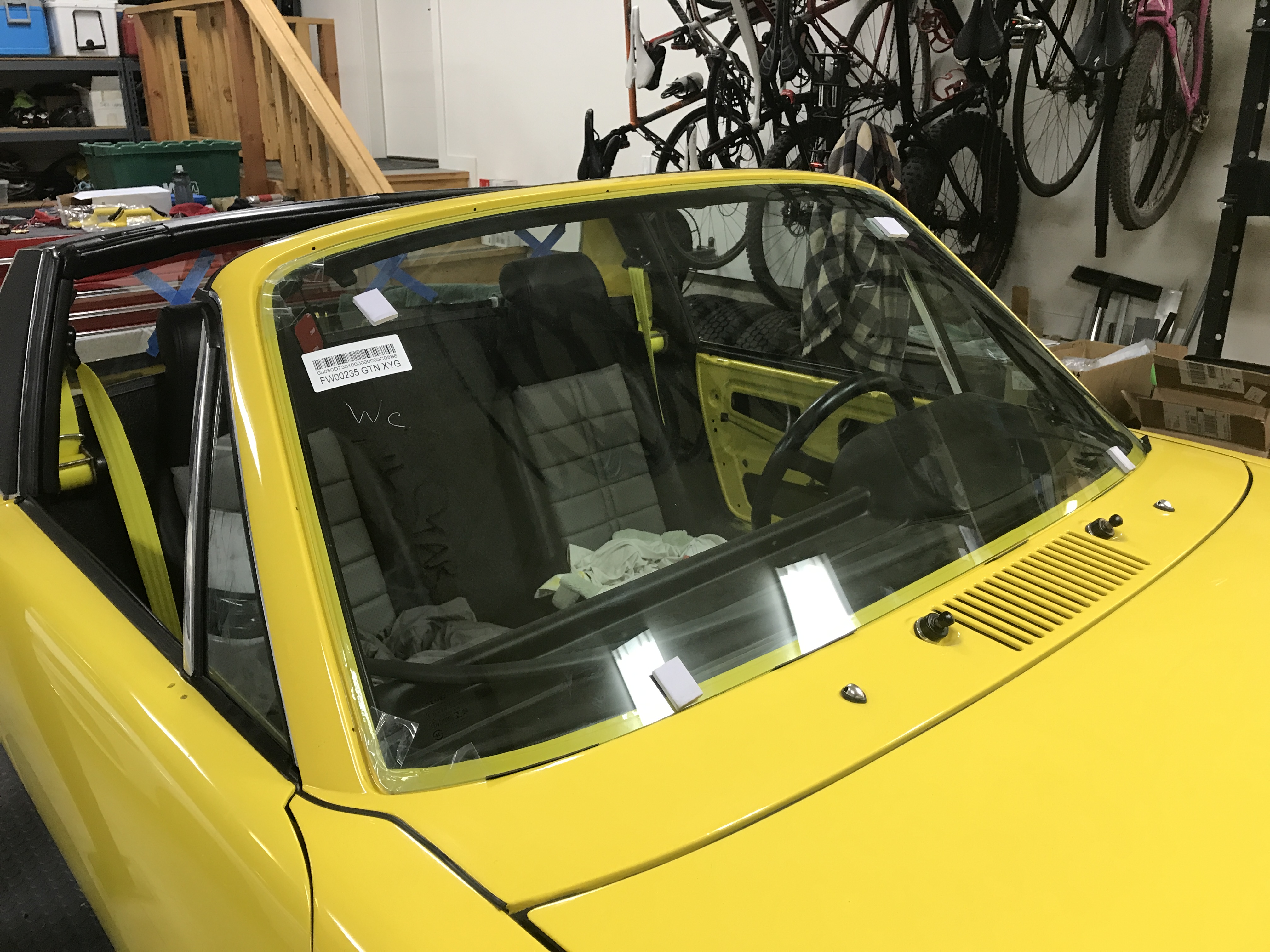

My one minute windshield installation! Just kidding. But I could not resist checking the fit. And for now, this is a relatively sage place.

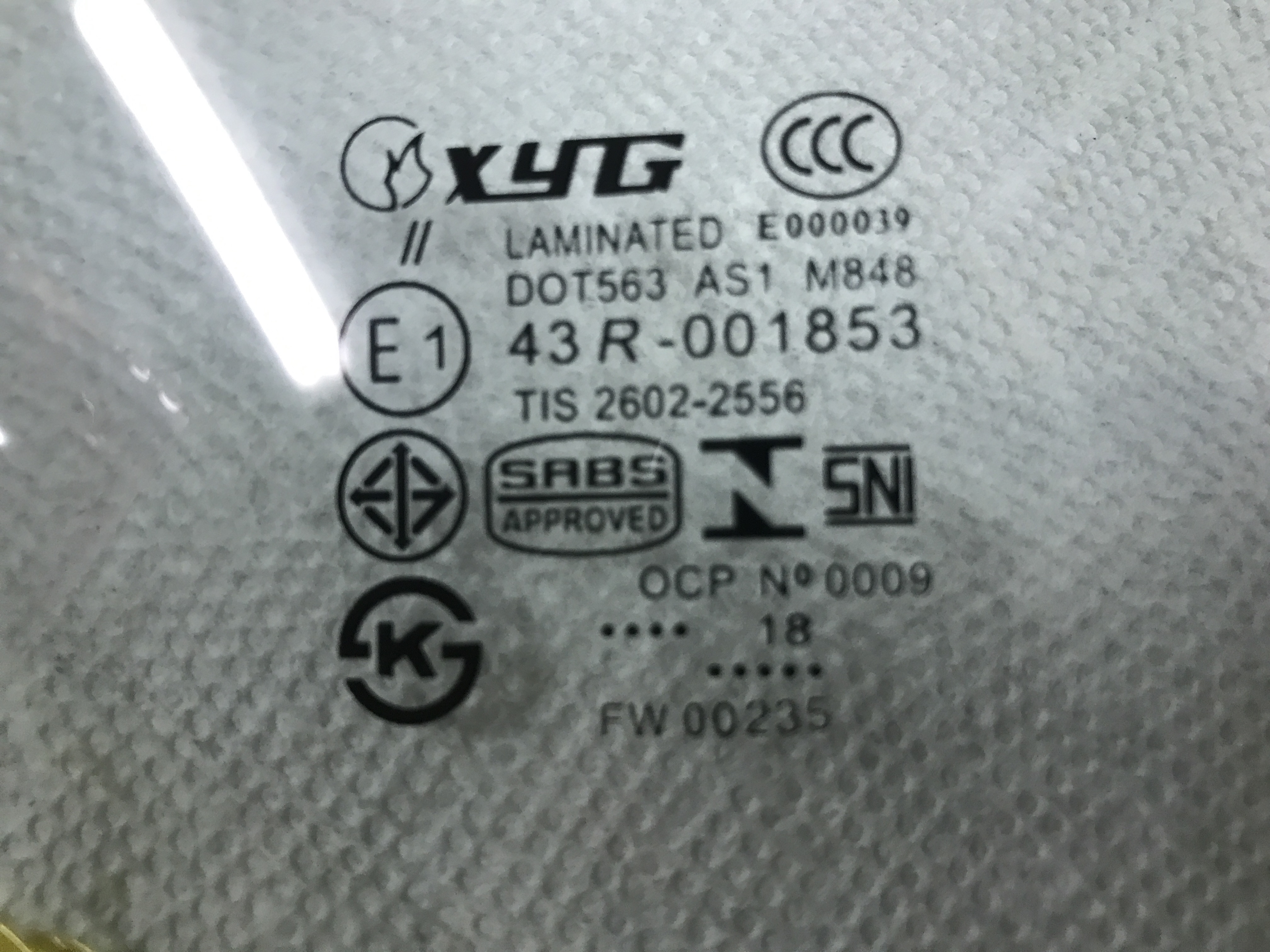

In case anyone is interested, here is the manufacturer info.

And the stocking info.

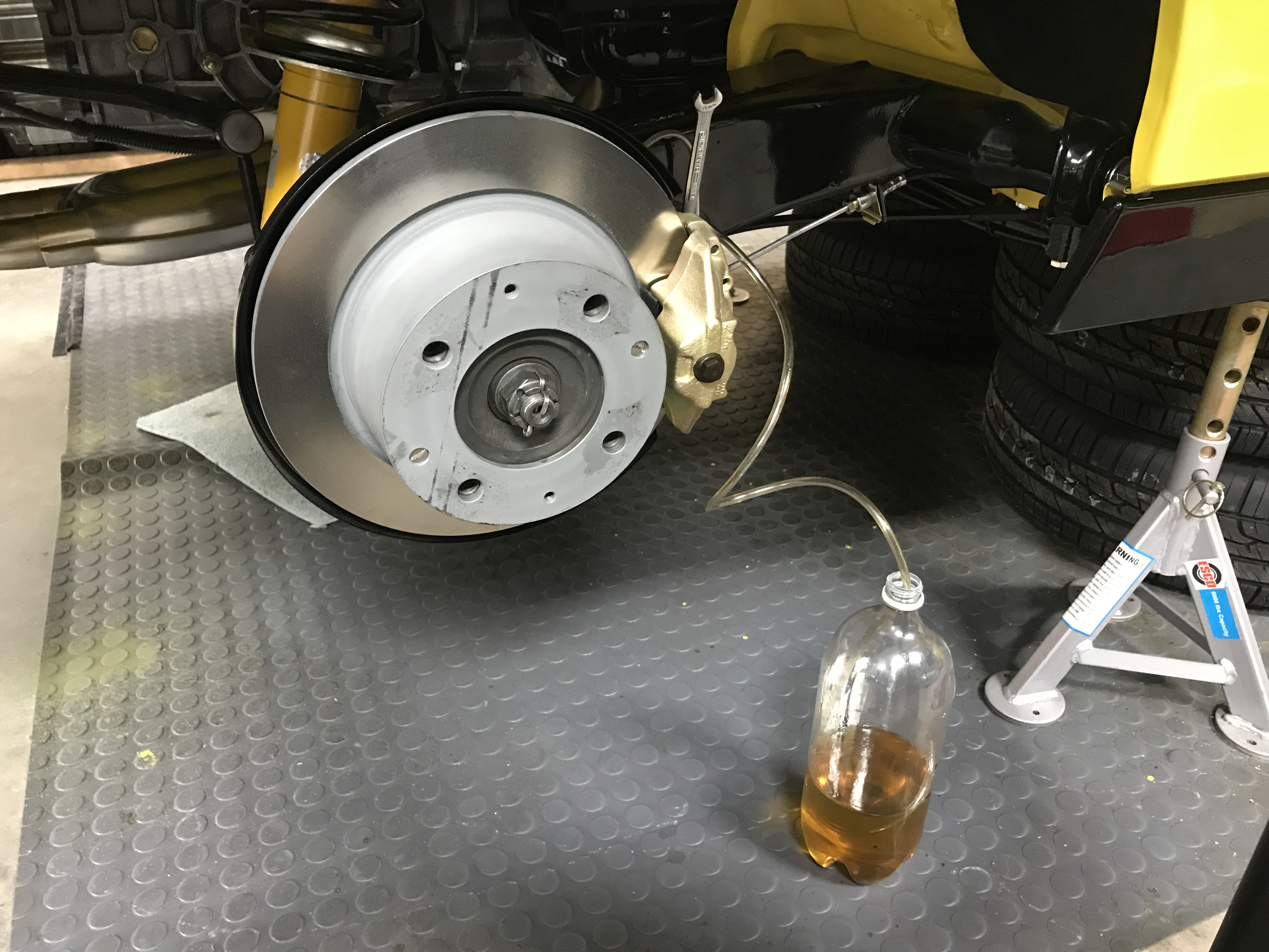

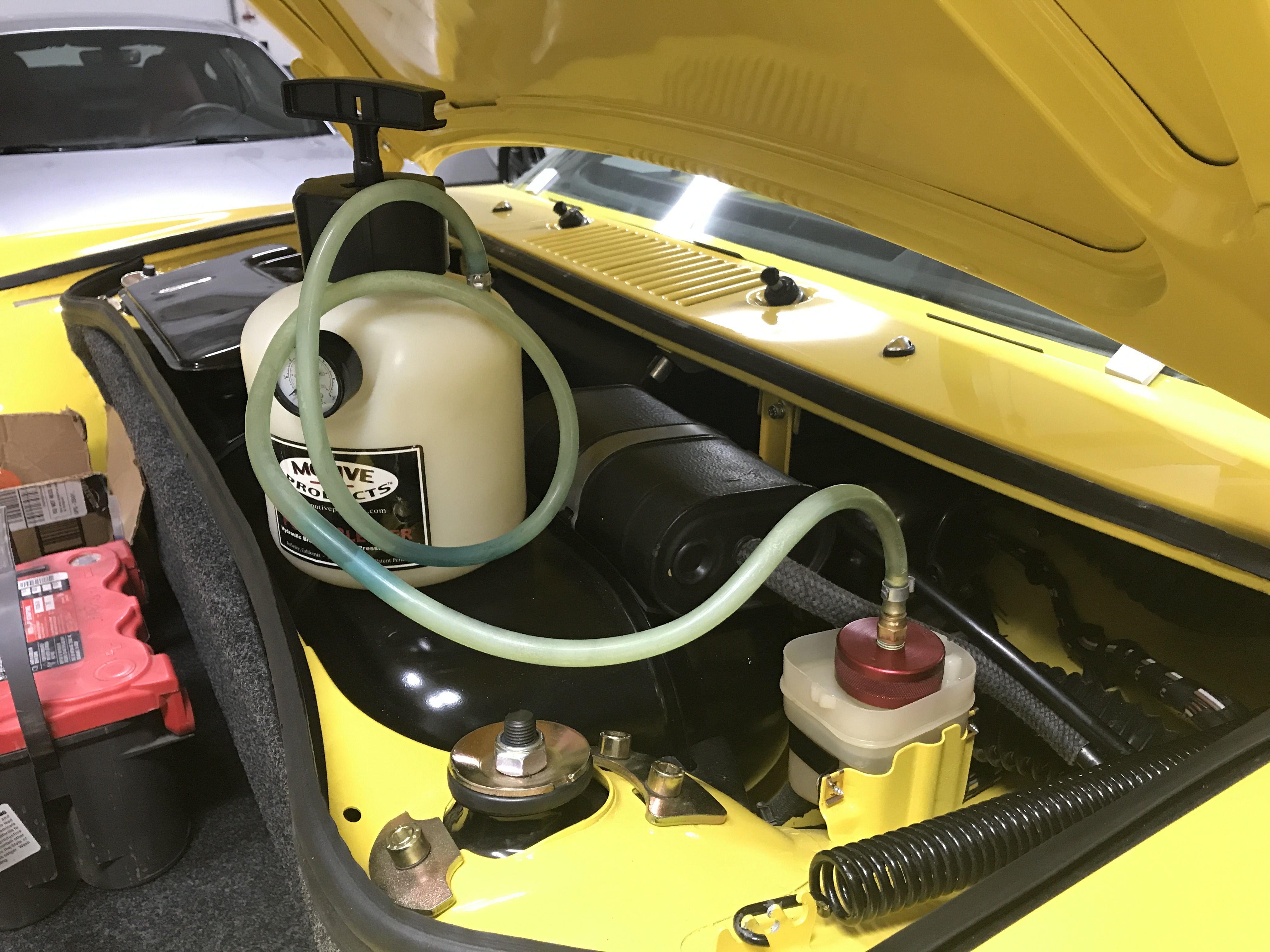

Then I got onto to bleeding the brakes, for the second time. I used "dry" pressure again, up to about 30 psi.
bkrantz
post Apr 12 2022, 07:48 PM
Post #5037
Posts: 8,530
Joined: 3-August 19
From: SW Colorado
Member No.: 23,343

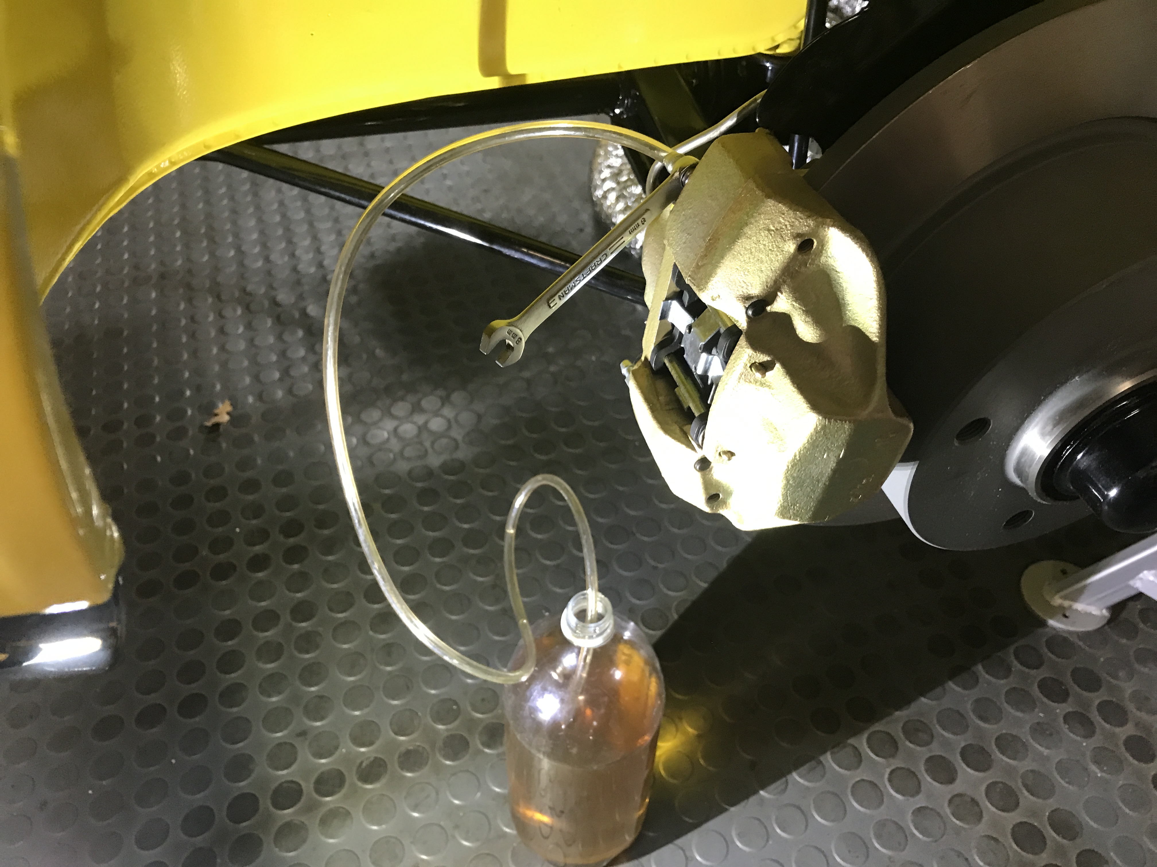

I made the rounds of all the calipers 3 times, and got a pretty firm pedal.

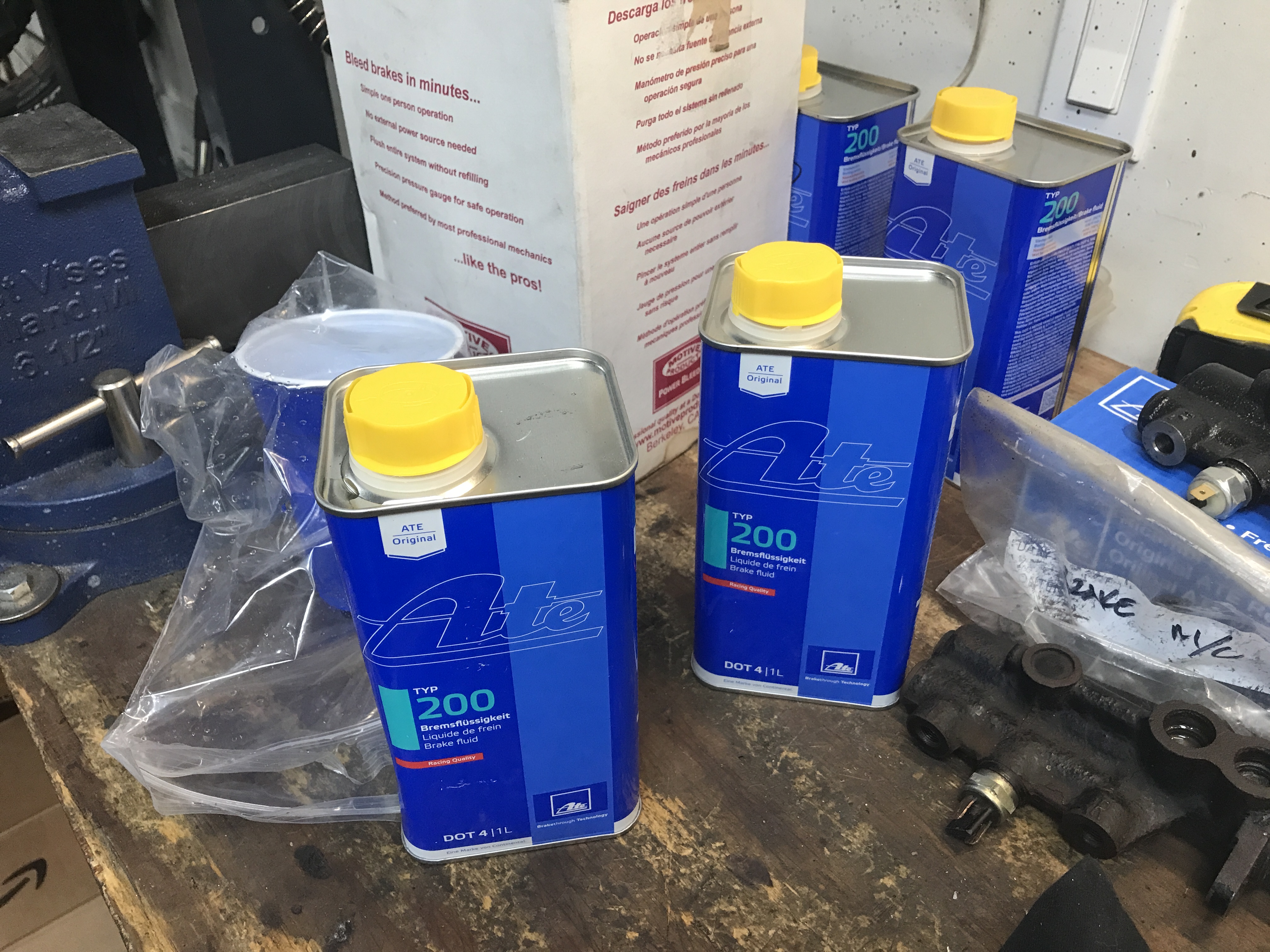

And used (so far) almost 3 liters of brake fluid.

After the car sat for 48 hours, I checked the system for leaks--none. And the pedal feel--firm. But I decided to use the rest of the open bottle of brake fluid and bleed the system again. I got a couple of small bubbles from the rear calipers.

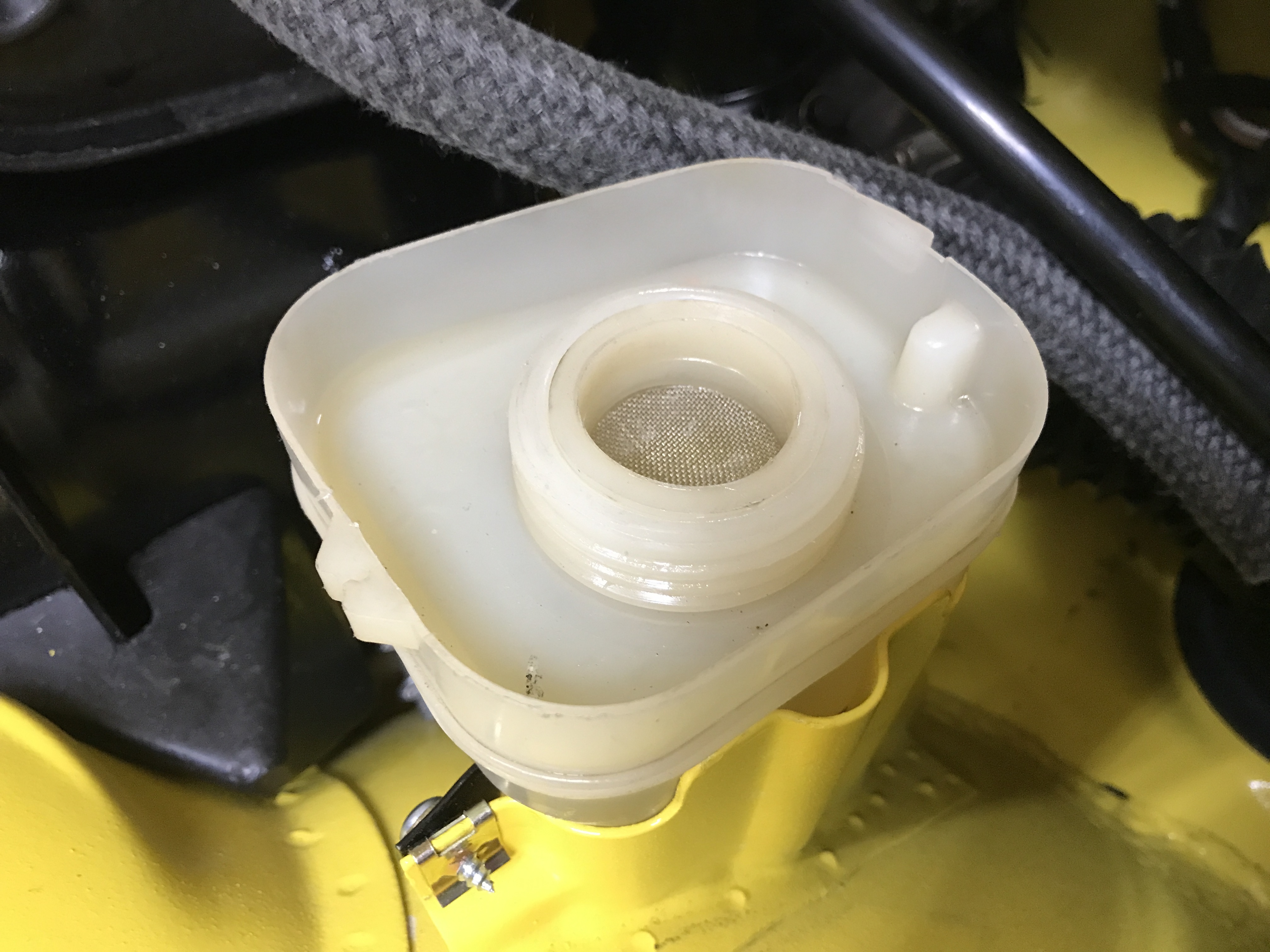

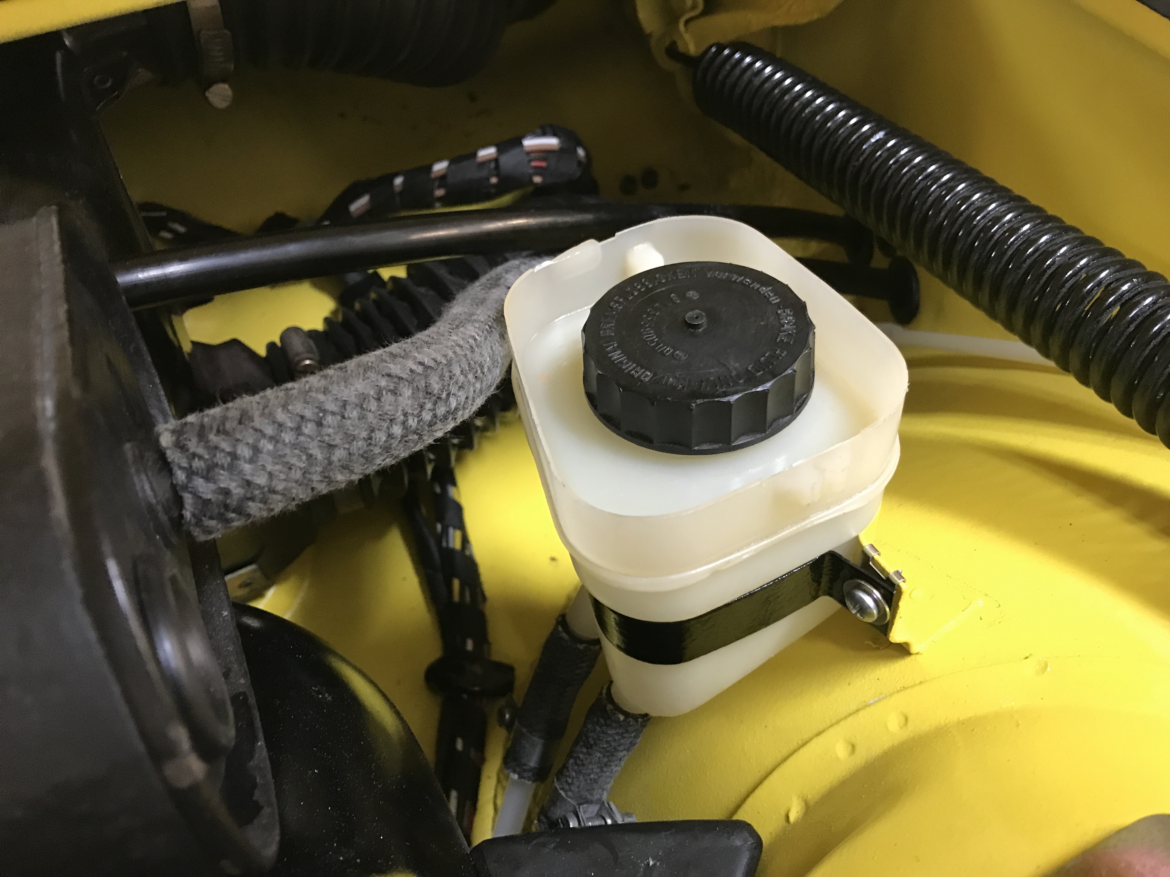

I am feeling confident, so I put the reservoir fill screen back in.
