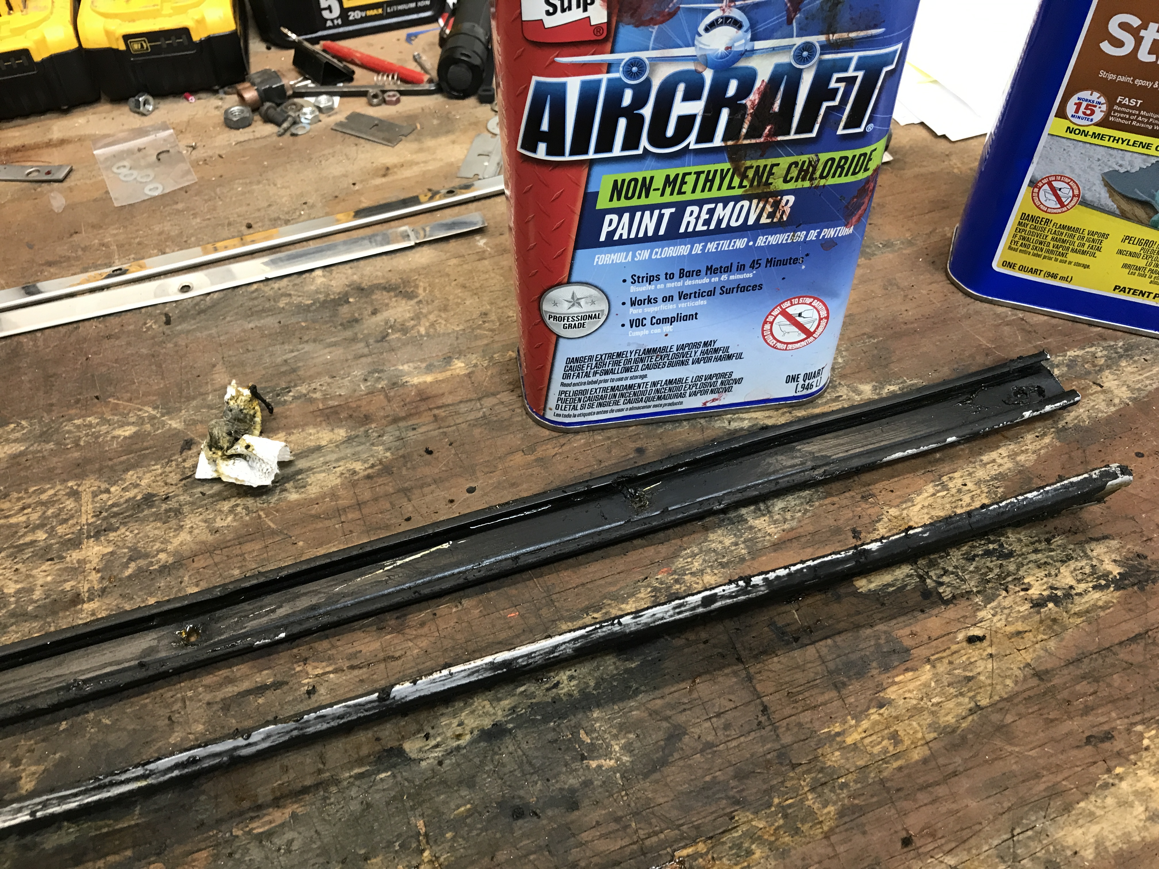

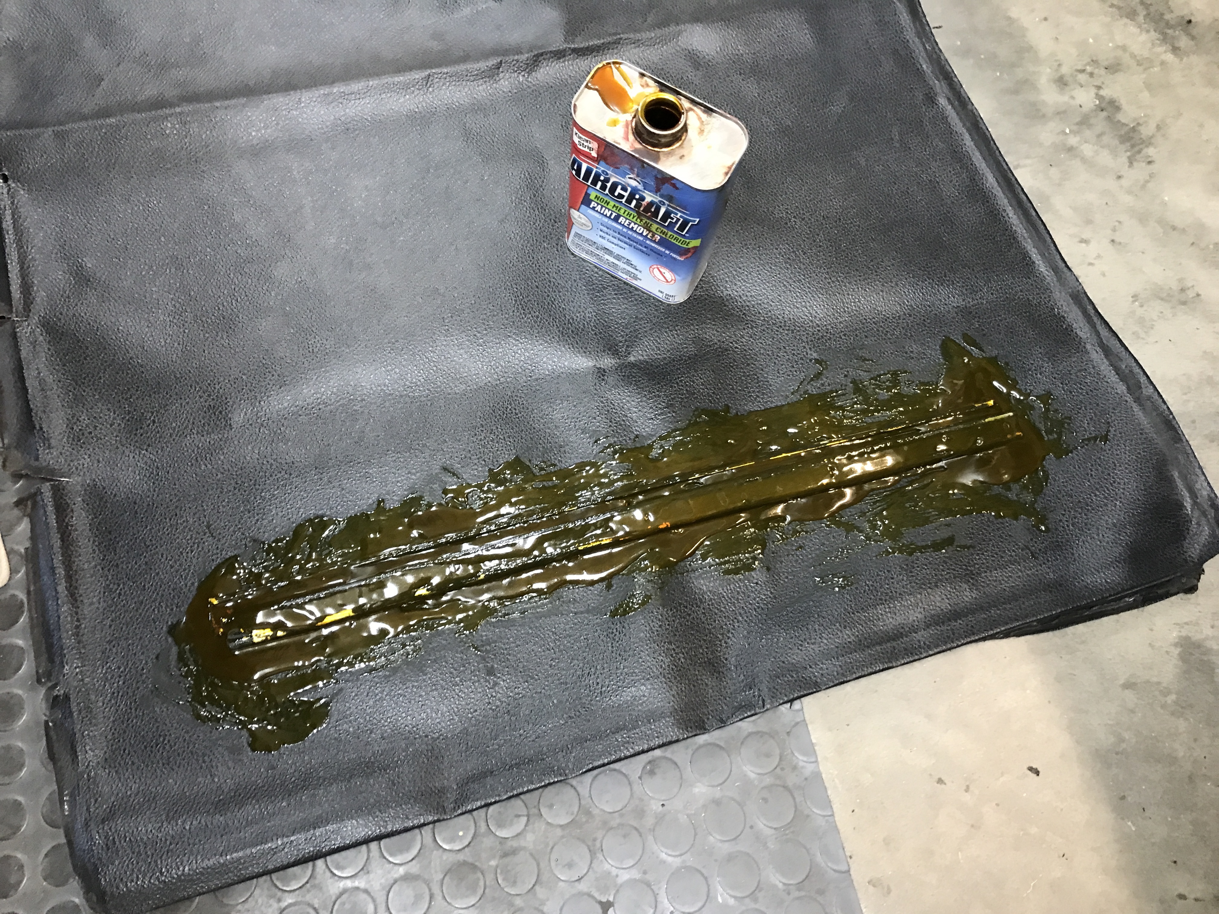

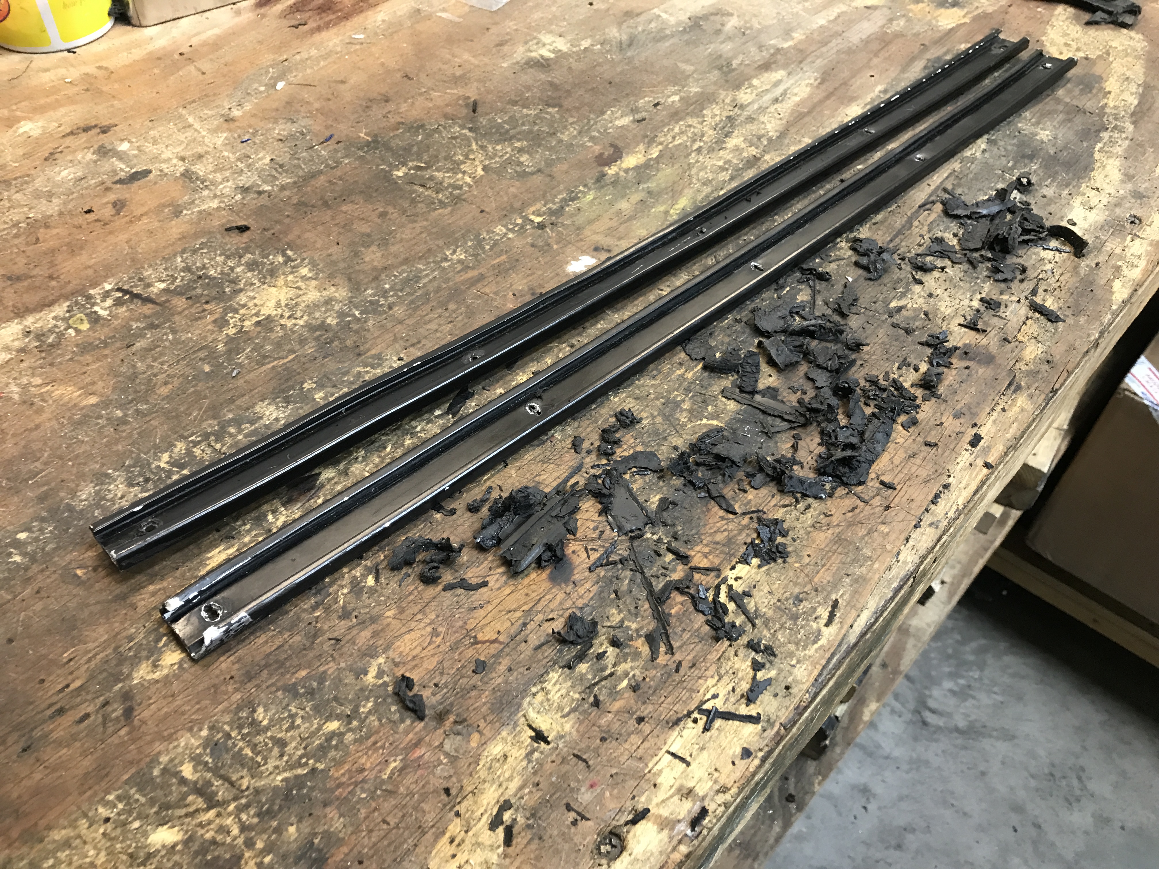

More prep for top assembly. I am not sure if the tracks for the window top weatherstripping were originally silver anodized or black, but I want silver.
Paint thinner had no effect. Goofoff and acetone had some effect, but would take a loooong time. So I got out some paint stripper. A fist test removed some paint.
bkrantz

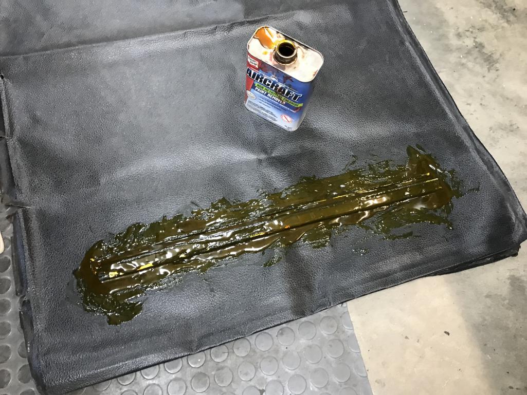

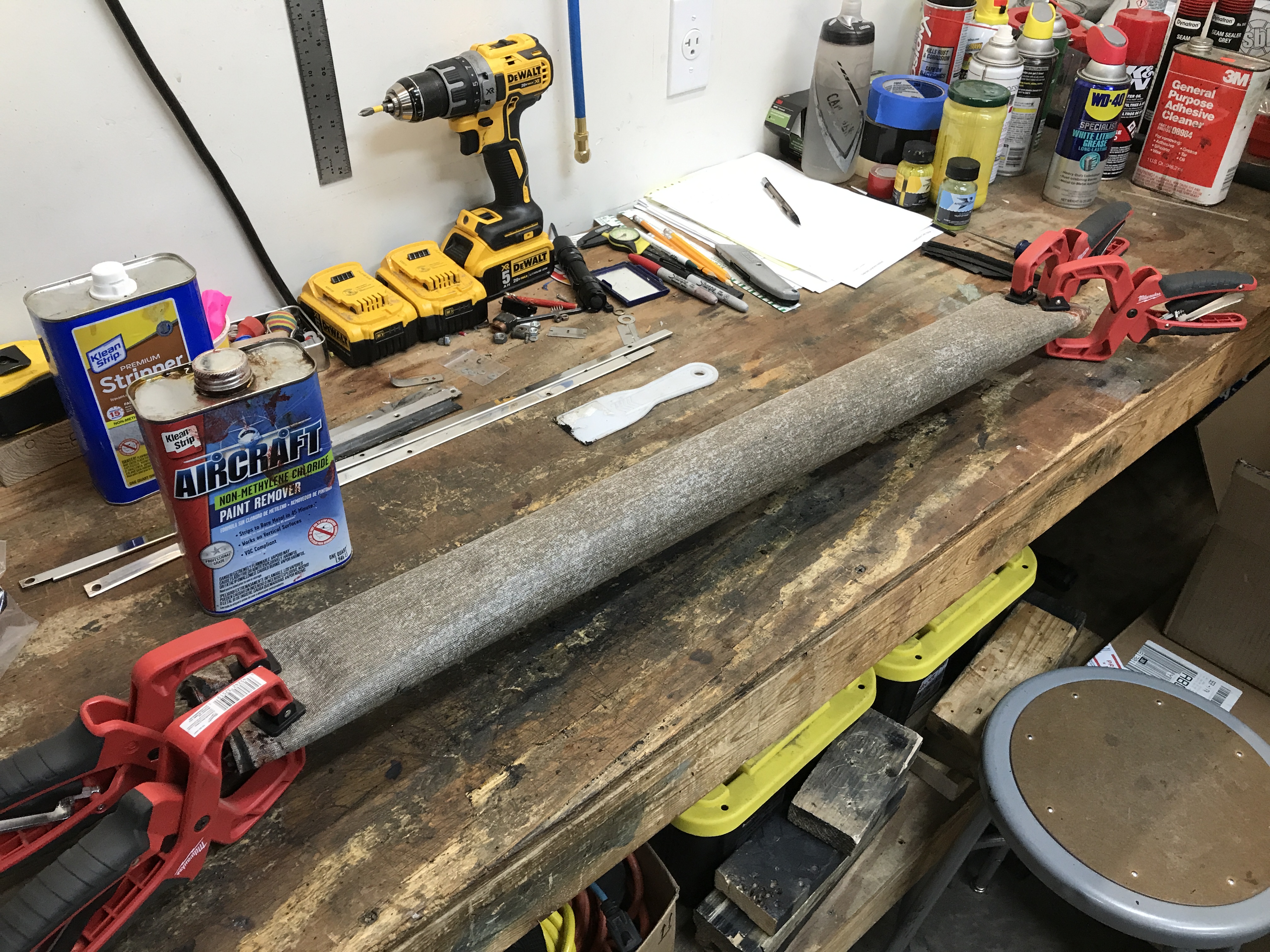

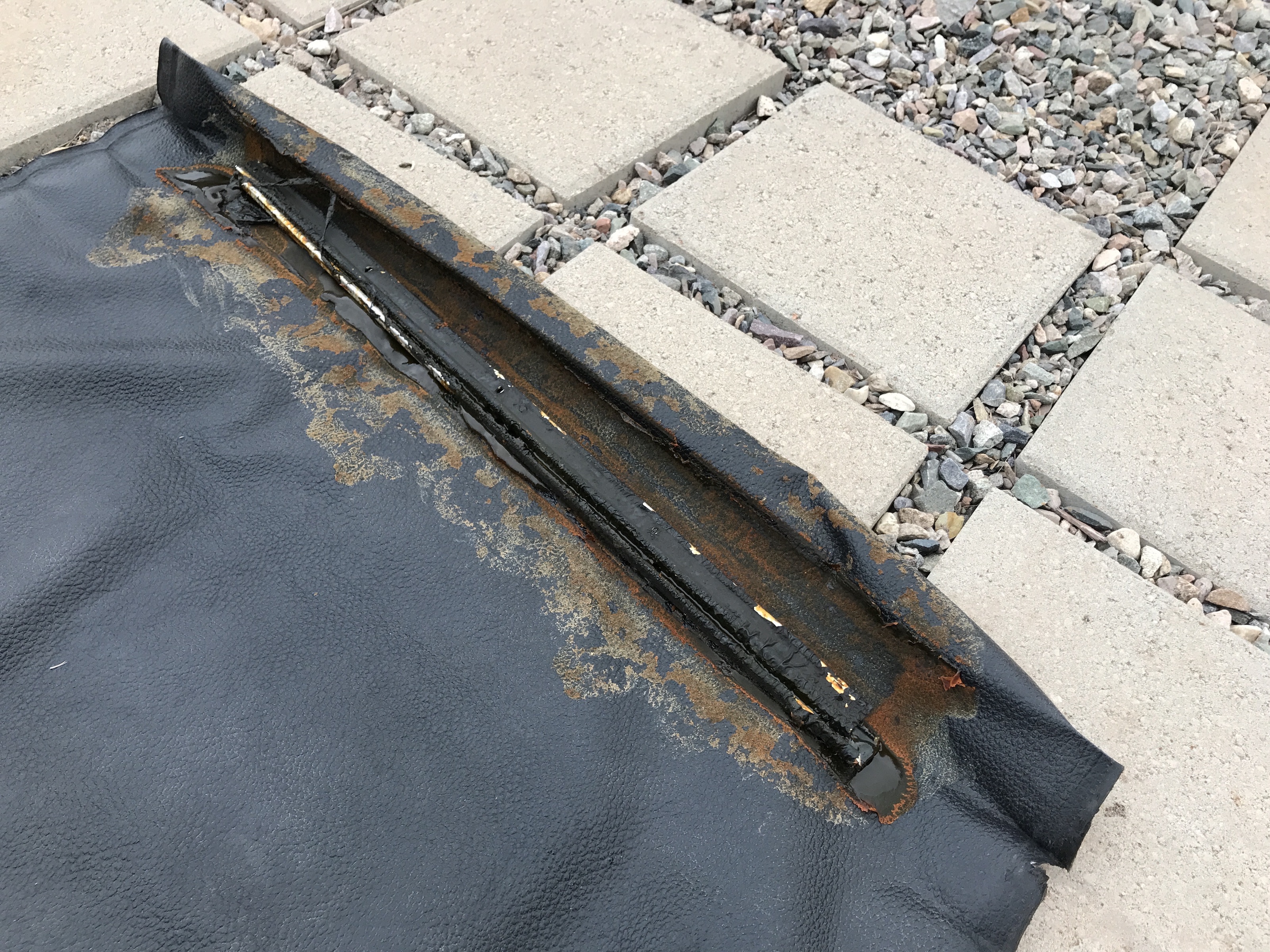

So I figure a saturated soaking might work faster. And I have the vinyl I removed from the PO version of the targa top in the trash, so...
bkrantz
post Apr 21 2022, 09:26 PM
Post #5086
Posts: 8,530
Joined: 3-August 19
From: SW Colorado
Member No.: 23,343
Here's my trim strip, paint stripper, vinyl burrito.

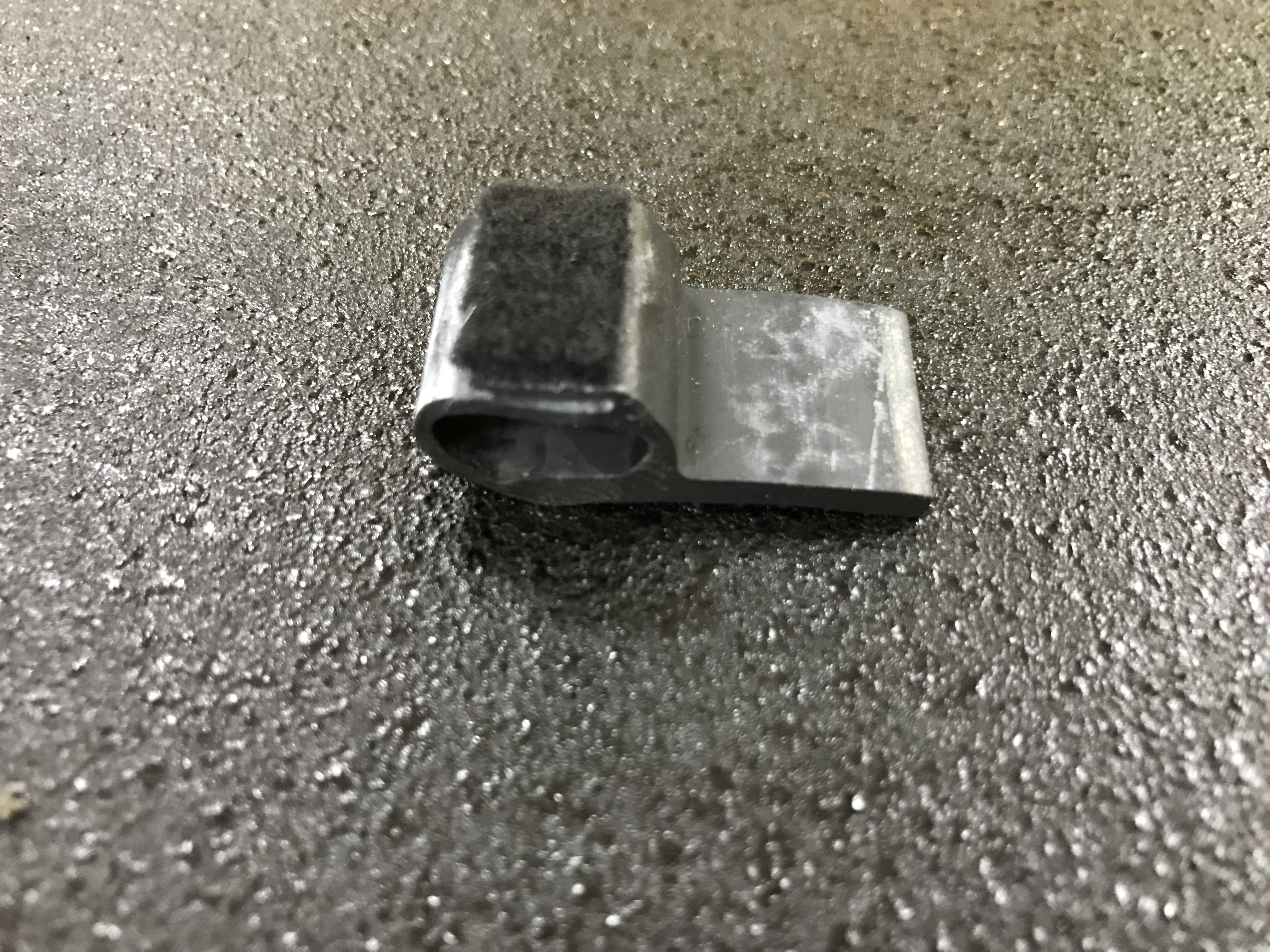

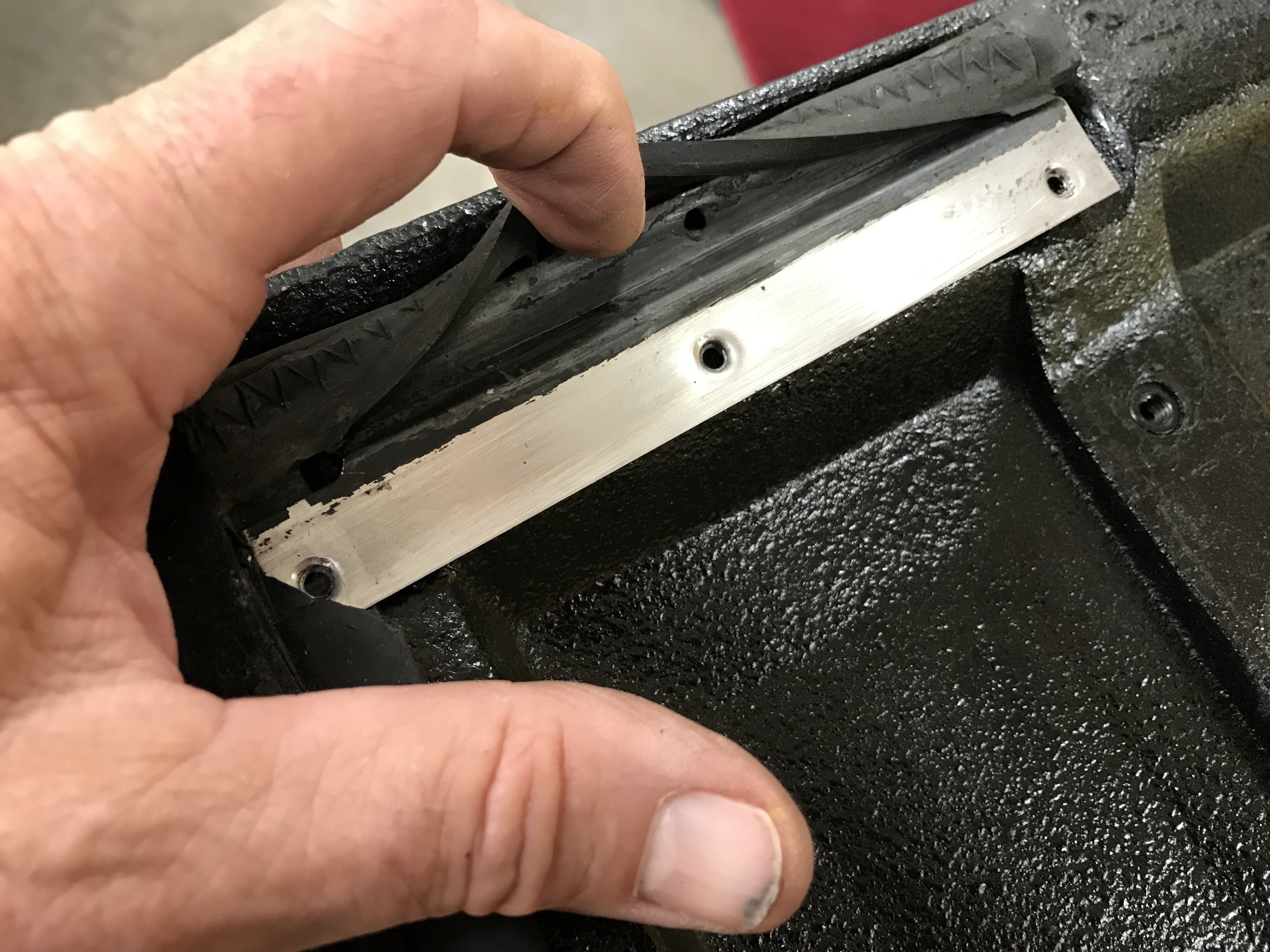

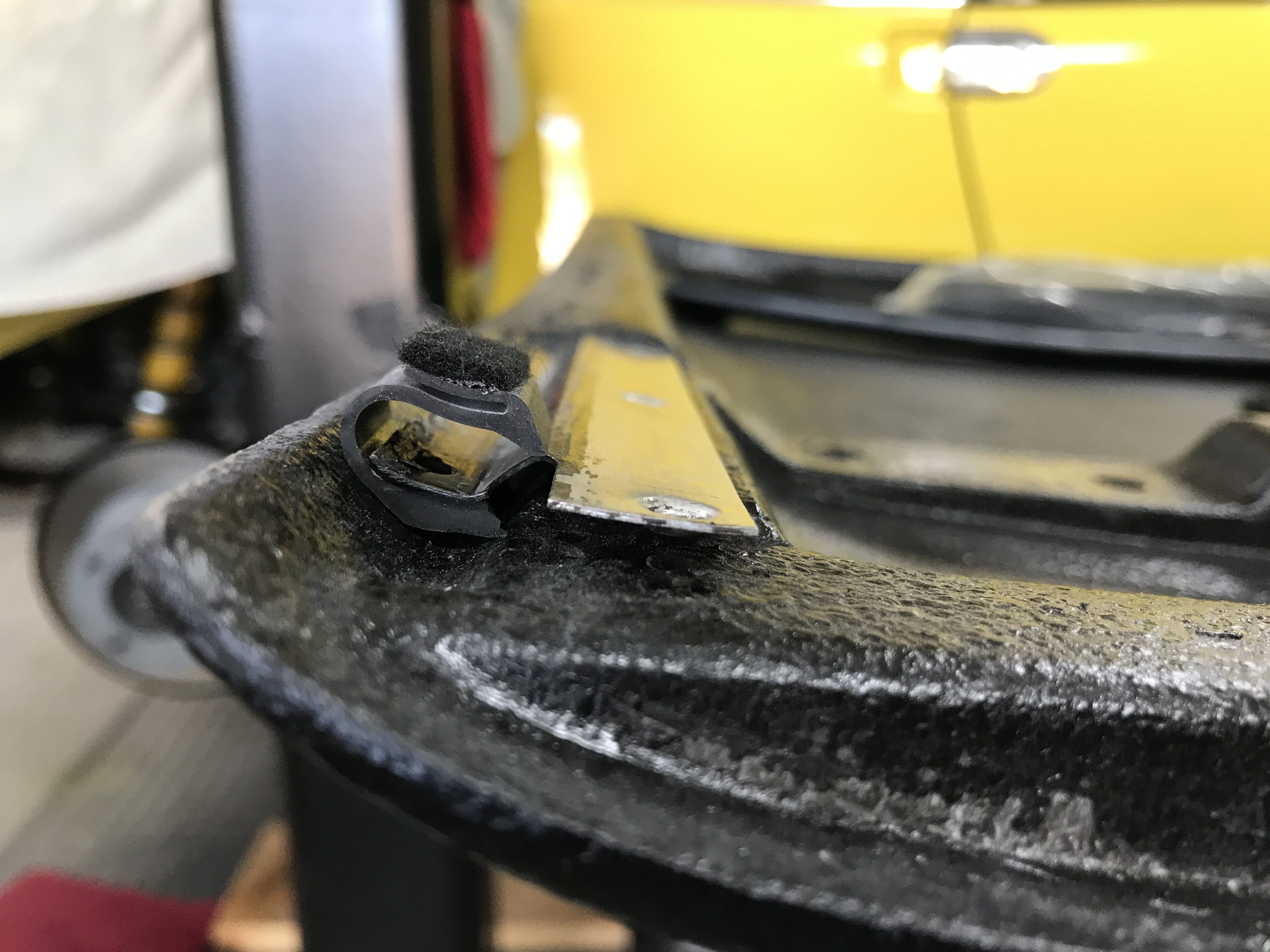

While the burrito soaks, I started playing with the targa top rear weatherstrip. Here is the original side piece, with the mounting metal strip inserted into the "O" of the rubber. I think the original rubber was vulcanized onto the metal.
bkrantz
post Apr 21 2022, 09:30 PM
Post #5088
Posts: 8,530
Joined: 3-August 19
From: SW Colorado
Member No.: 23,343

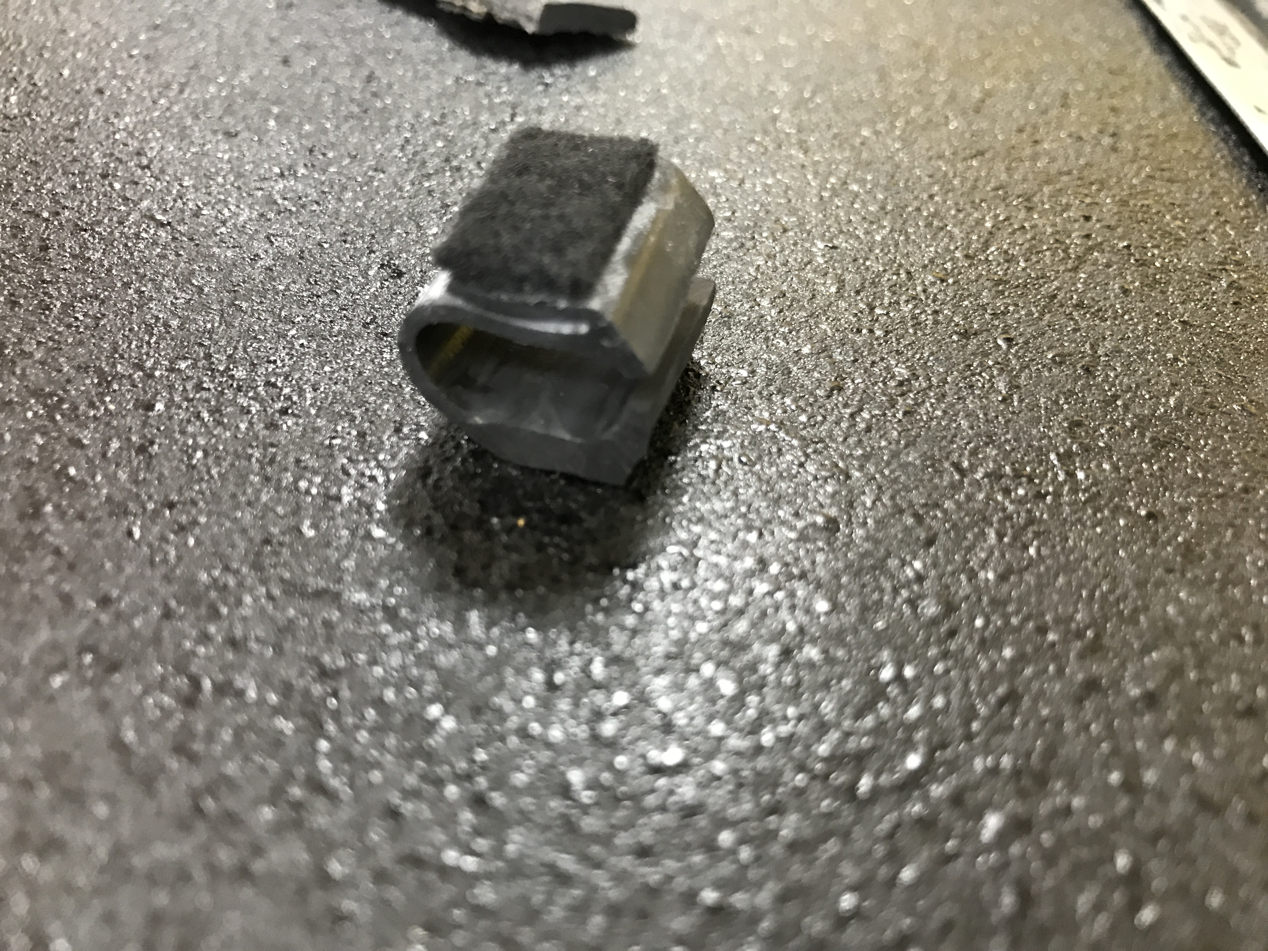

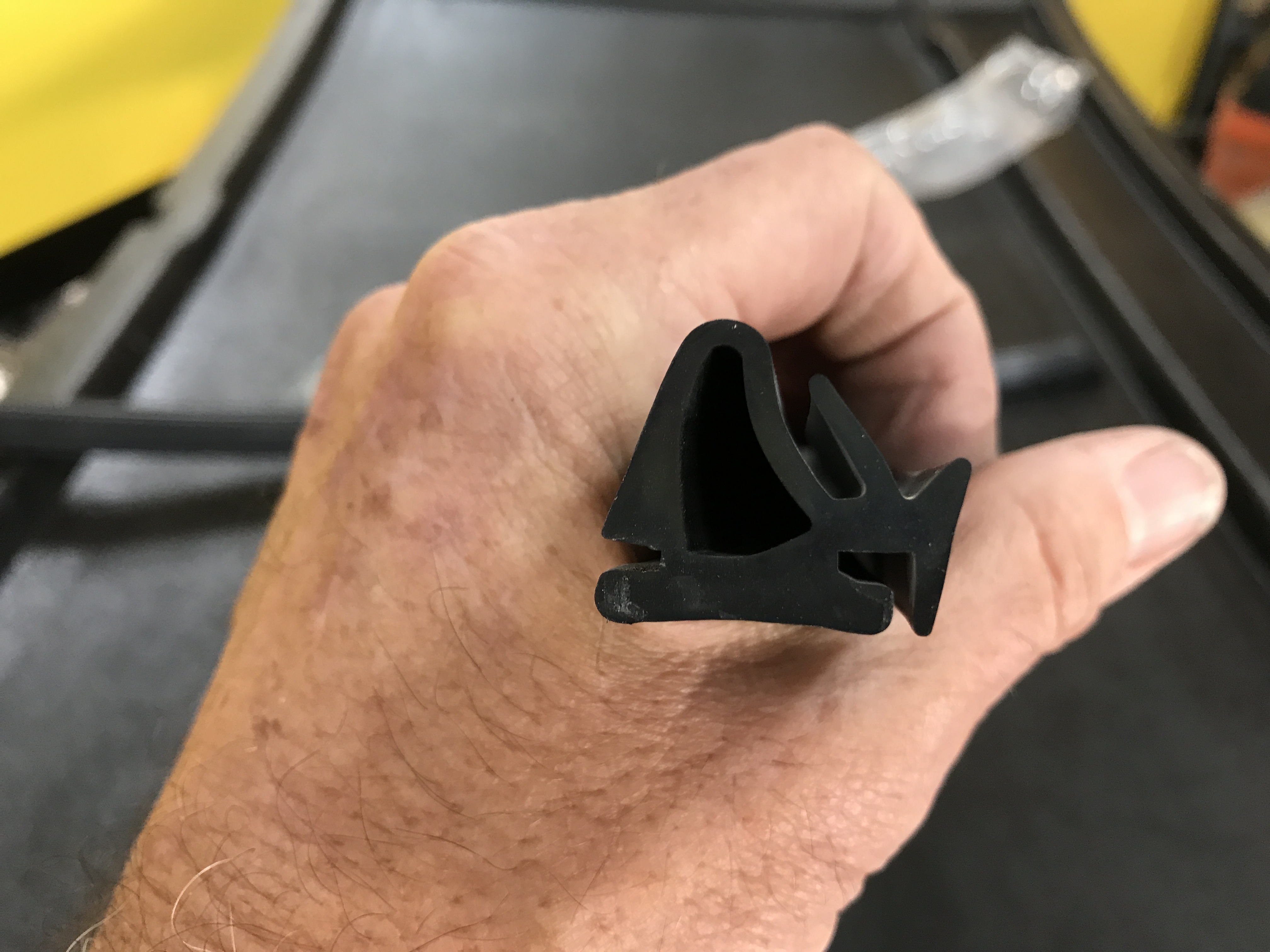

And here is a short bit of excess trimmed from the new rubber, as supplied by 914 Rubber. Note the thick flap section attached to the "O".
bkrantz
post Apr 21 2022, 09:31 PM
Post #5089
Posts: 8,530
Joined: 3-August 19
From: SW Colorado
Member No.: 23,343
And here's my experimental modification: flap section cut off, and a slit into the "O".
bkrantz
post Apr 21 2022, 09:35 PM
Post #5090
Posts: 8,530
Joined: 3-August 19
From: SW Colorado
Member No.: 23,343
And this is how it will fit onto the side metal. Note how the metal sits directly onto a raised flat on the side of the top, and how it projects above the flat along the rear. That rear flat is designed for the flap on the rubber. There is no space for the rubber flap on the sides.
Now I need to try gluing the modified rubber to the side metal strips.

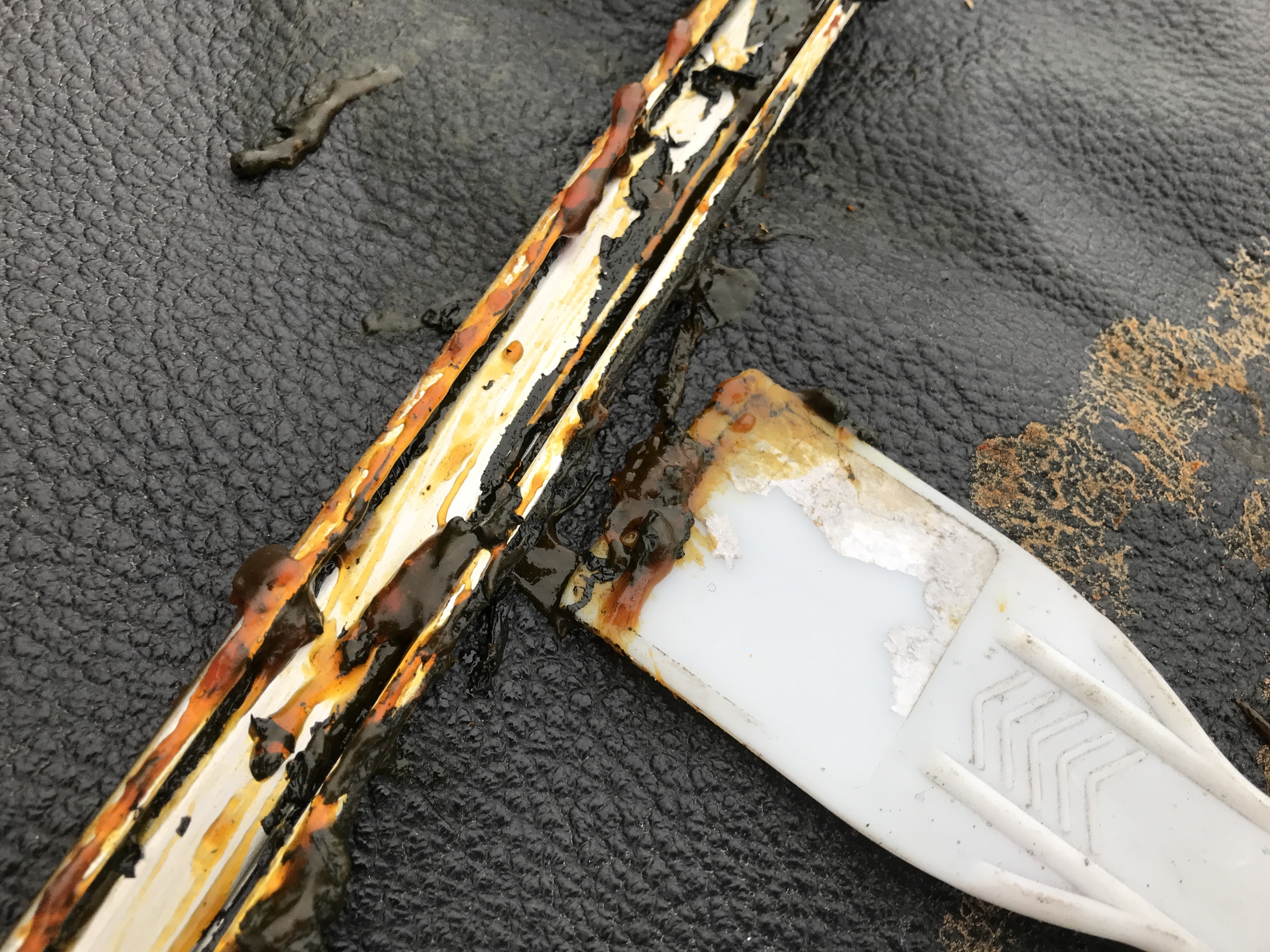

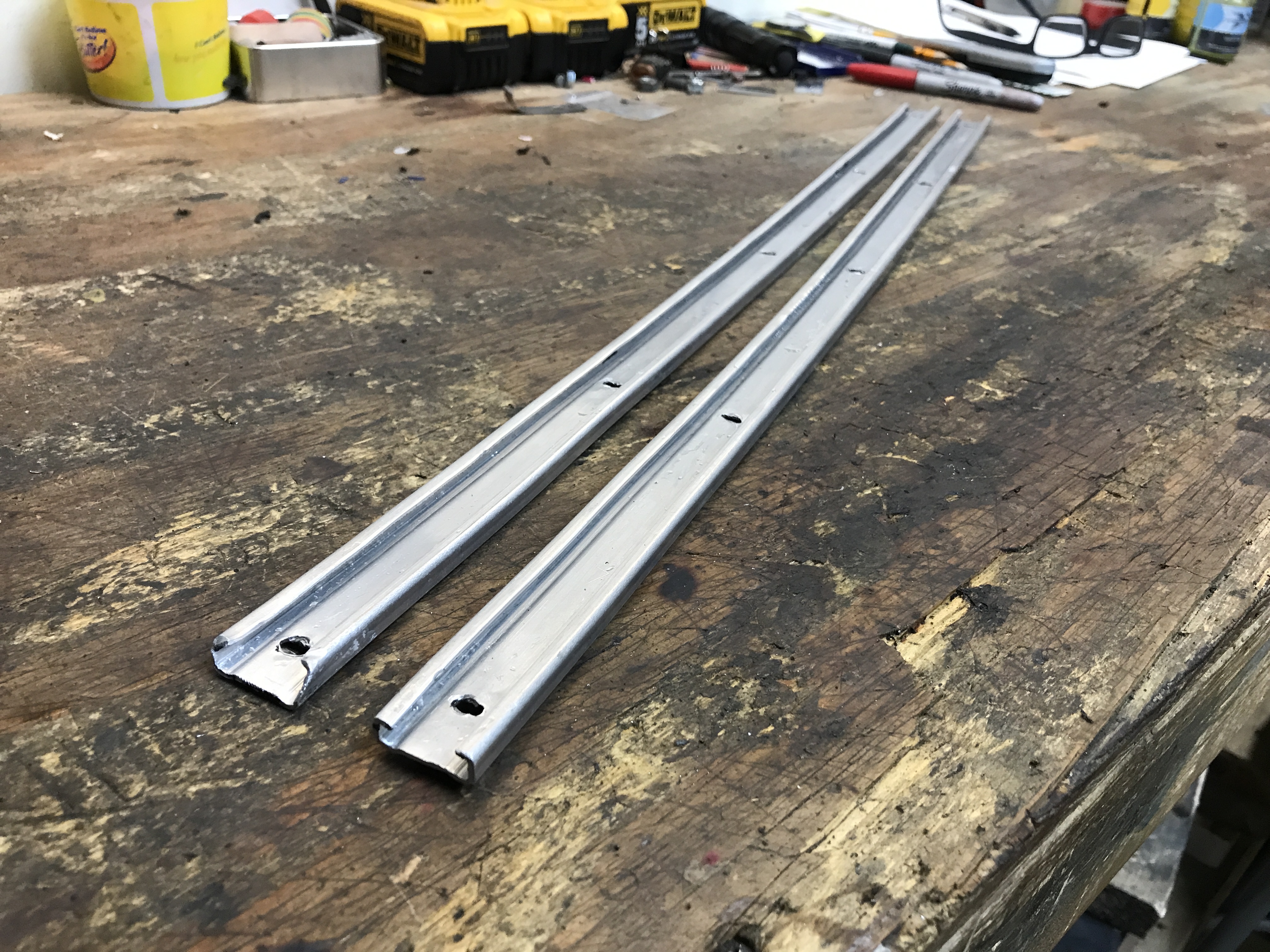

I opened my mounting strip-paint stripper burrito, after about 24 hours.
bkrantz
post Apr 22 2022, 08:30 PM
Post #5092
Posts: 8,530
Joined: 3-August 19
From: SW Colorado
Member No.: 23,343
It worked very well, and all the original paint was loose and easily scraped off with a plastic knife.

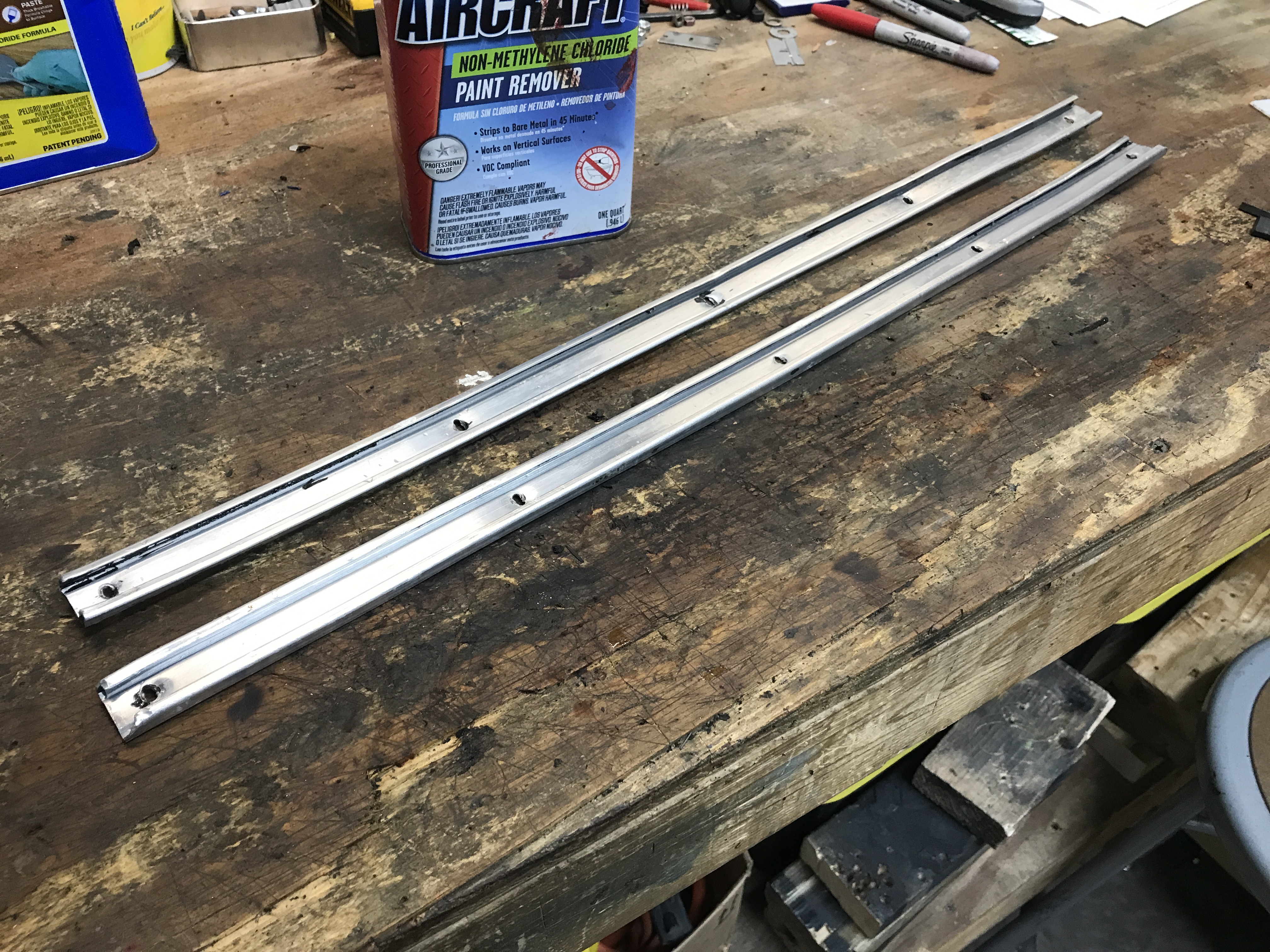

Member No.: 23,343

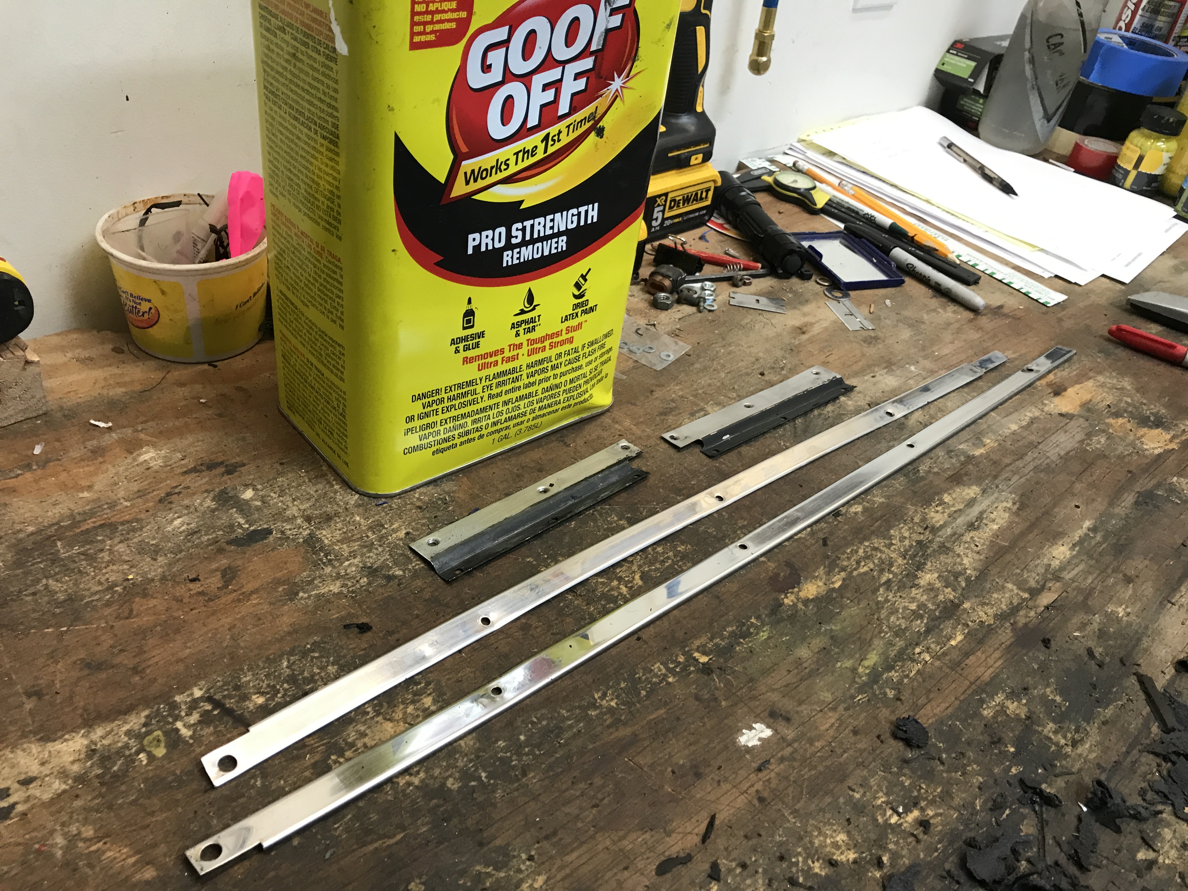

After a first rinse in hot water and some scrubbing with a brush, about 98% clean.
bkrantz
post Apr 22 2022, 08:33 PM
Post #5094
Posts: 8,530
Joined: 3-August 19
From: SW Colorado
Member No.: 23,343
And after straightening and another scrape and rinse, at least 99% done.
Puebloswatcop
post Apr 23 2022, 08:18 AM
Post #5095
Posts: 1,680
Joined: 27-December 14
From: Mineola, Texas
Member No.: 18,258
The burrito was a great way to use the PO junk wrap and they came out looking fantastic.

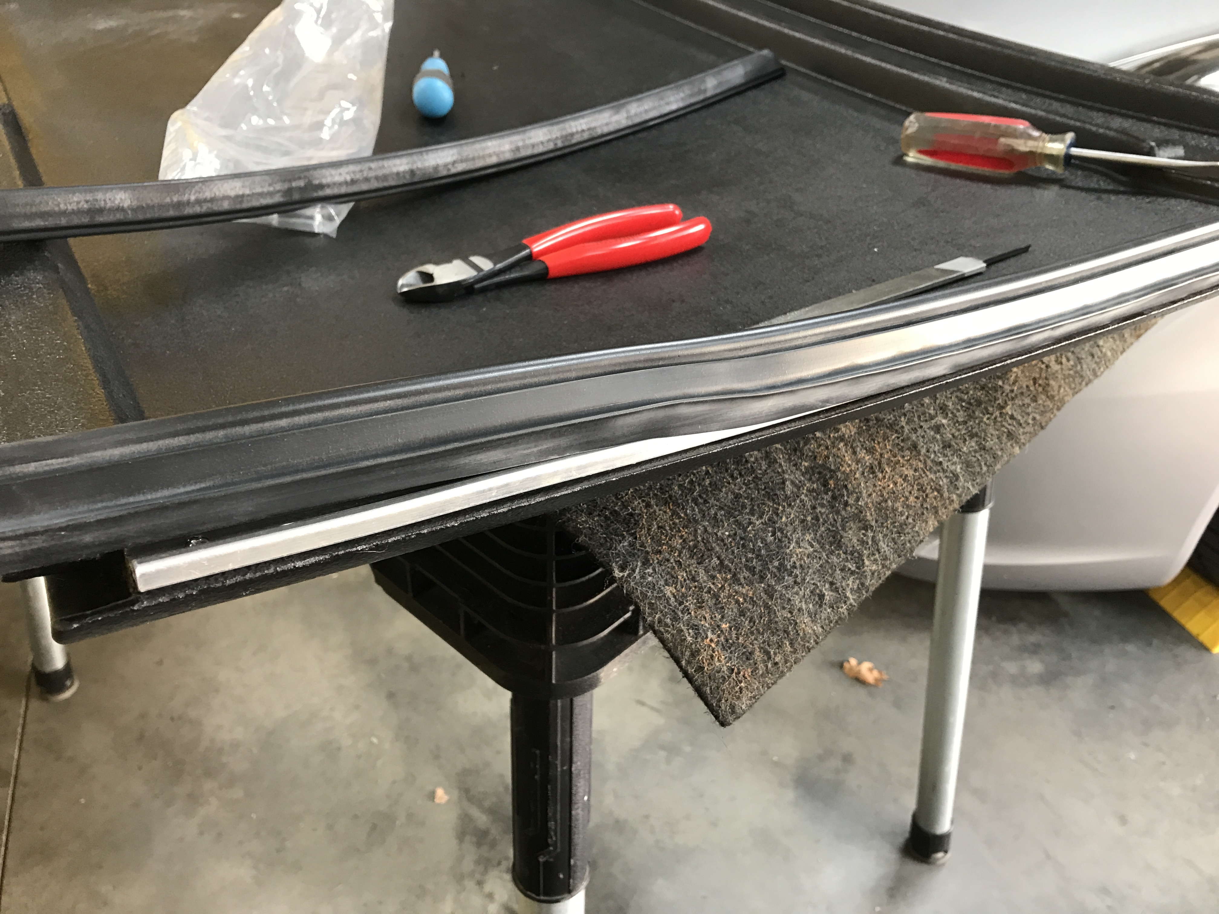

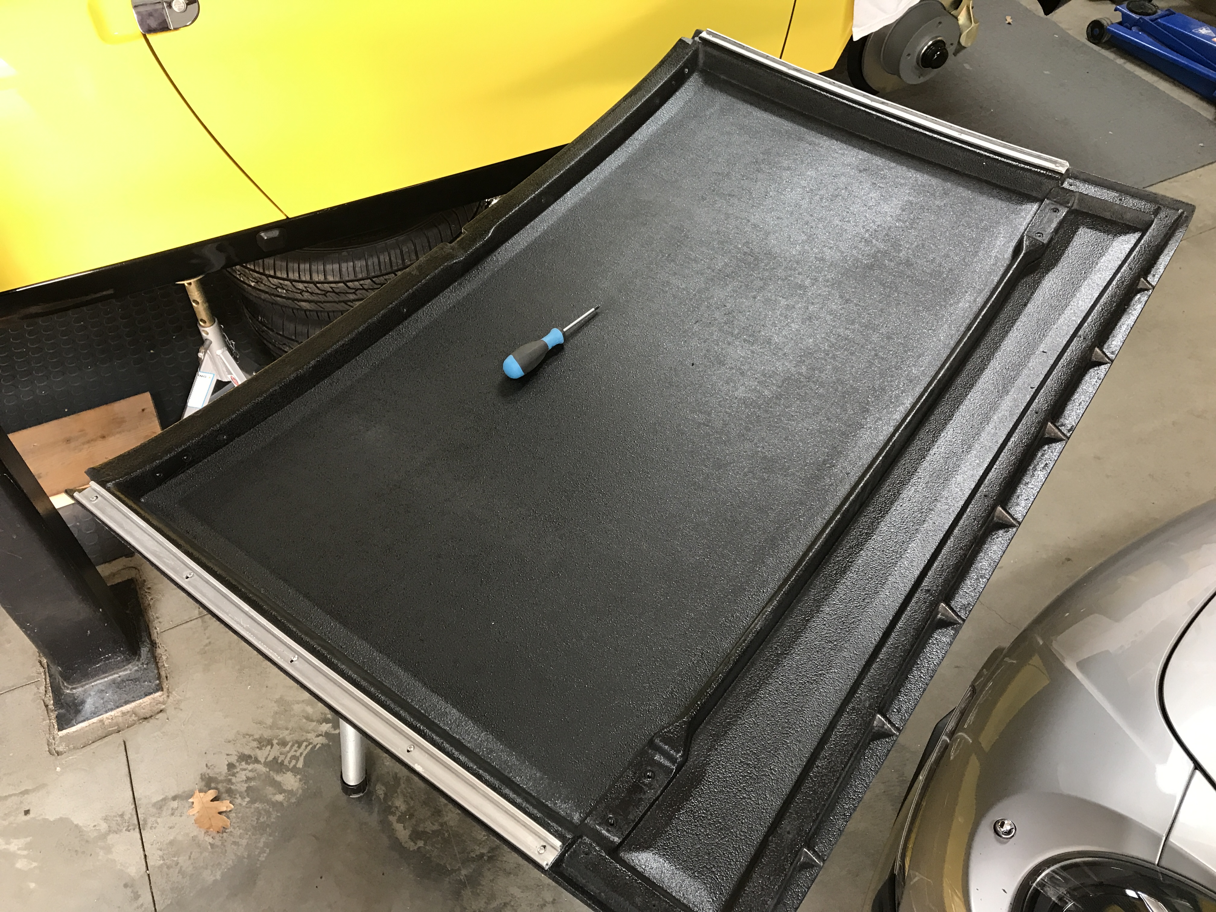

Back to working on the top. I installed the side trim strips with new SS screws.
bkrantz
post Apr 25 2022, 08:09 PM
Post #5099
Posts: 8,530
Joined: 3-August 19
From: SW Colorado
Member No.: 23,343
And then the new side rubber seals, where the upper window edge seats.
bkrantz
post Apr 25 2022, 08:10 PM
Post #5100
Posts: 8,530
Joined: 3-August 19
From: SW Colorado
Member No.: 23,343
These are too thick to slide into place, so I first seated the outer lip.
