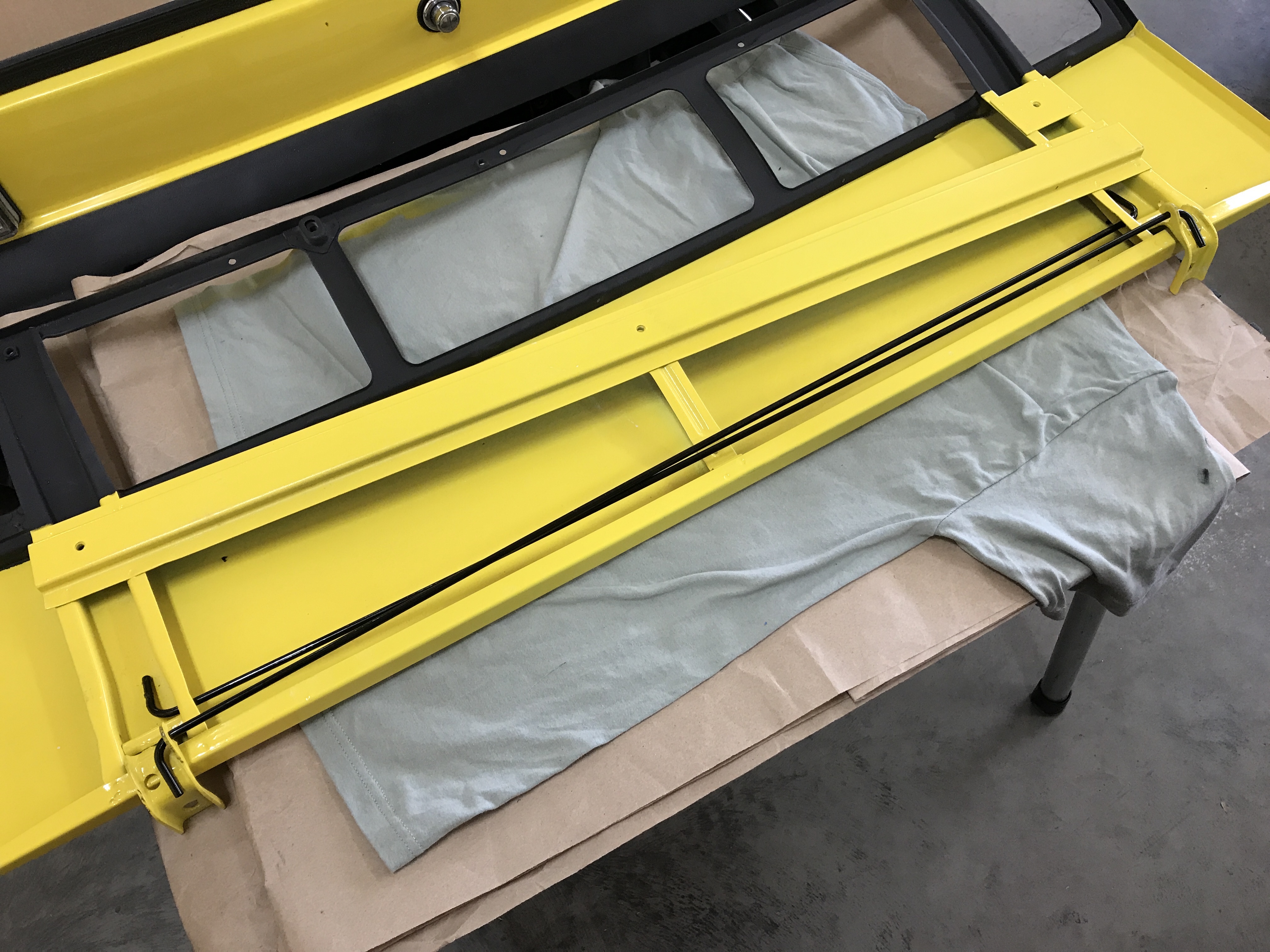

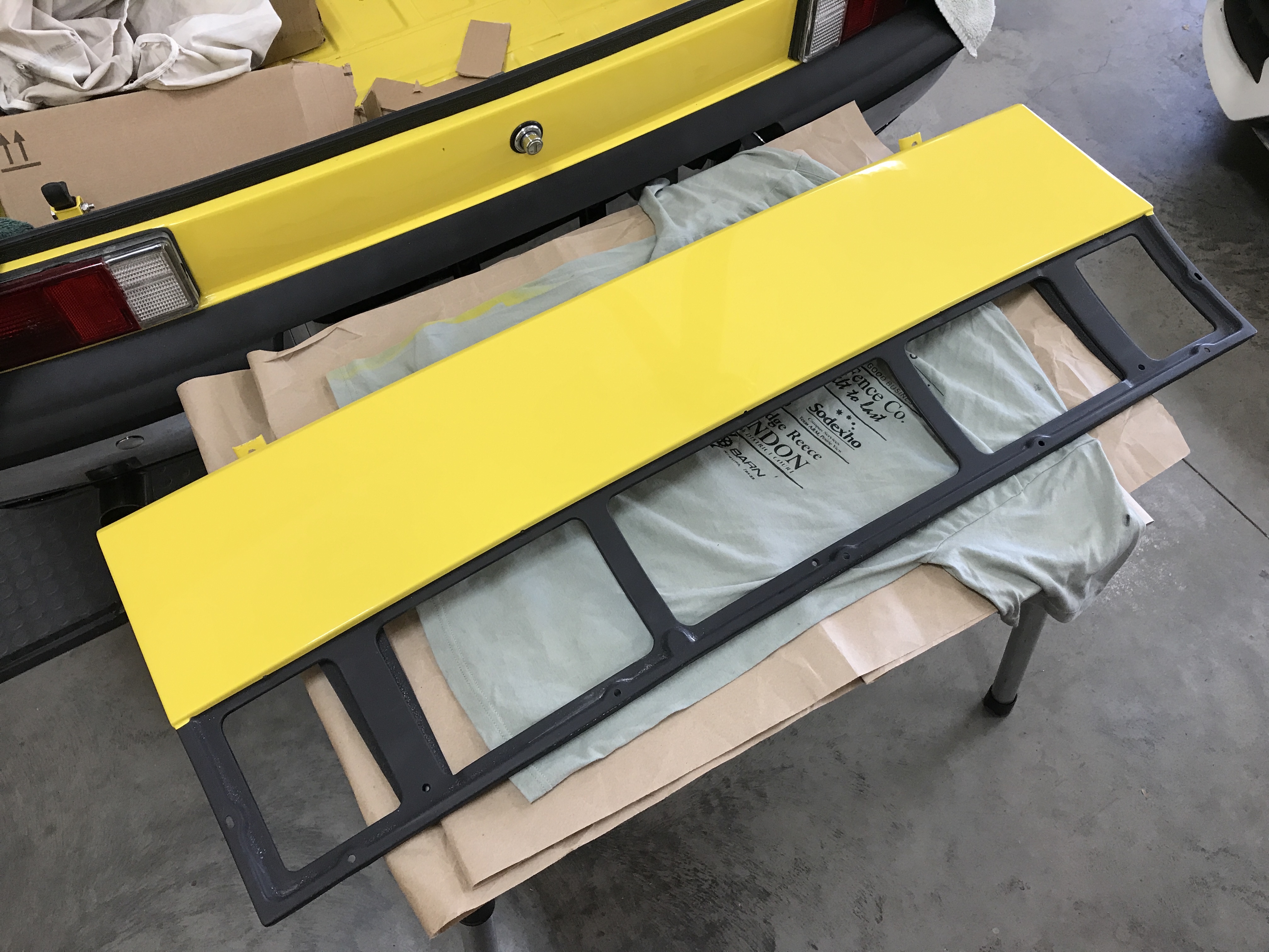

Onto the engine lid. This has been in my hall closet since October, 2020.

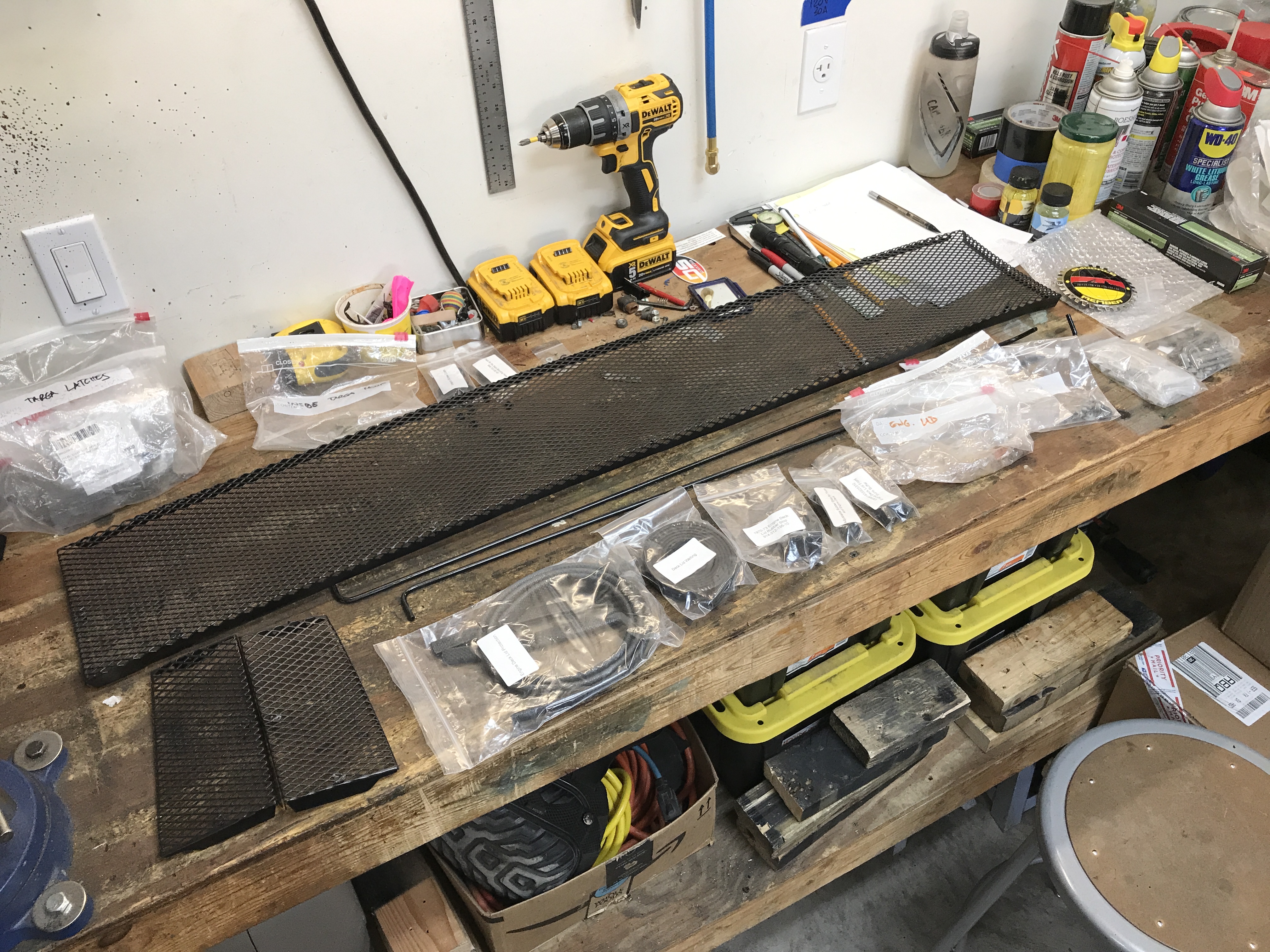

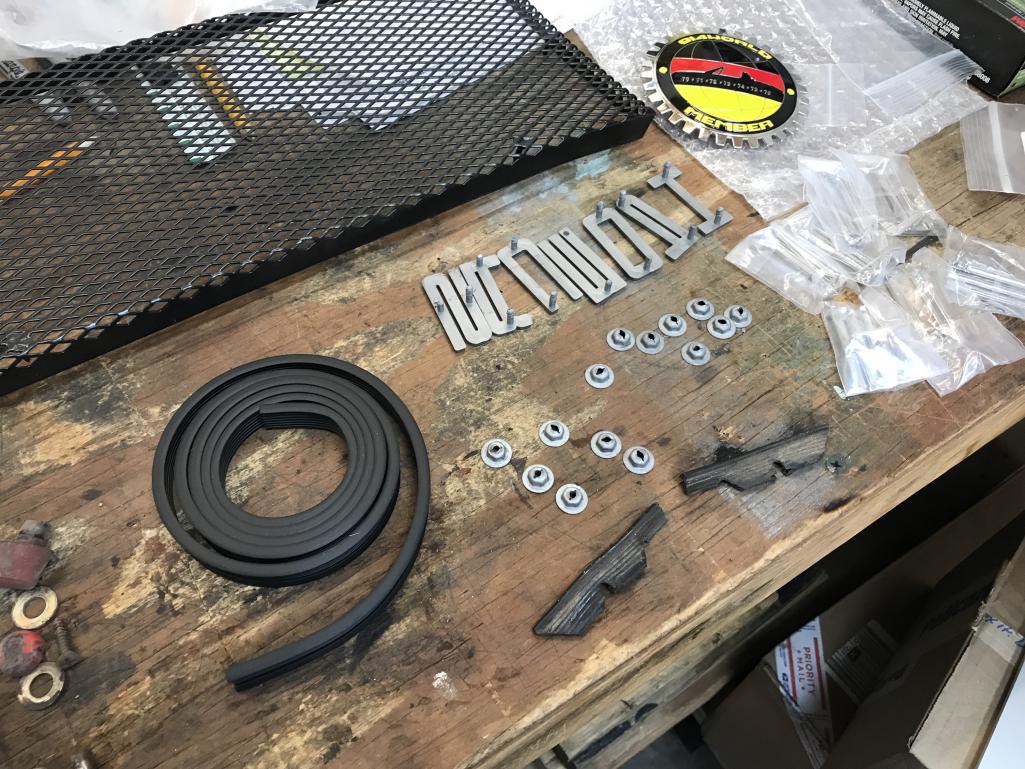

The grilles have also been stashed away. These were powder-coated. Some new hardware and rubber, too.

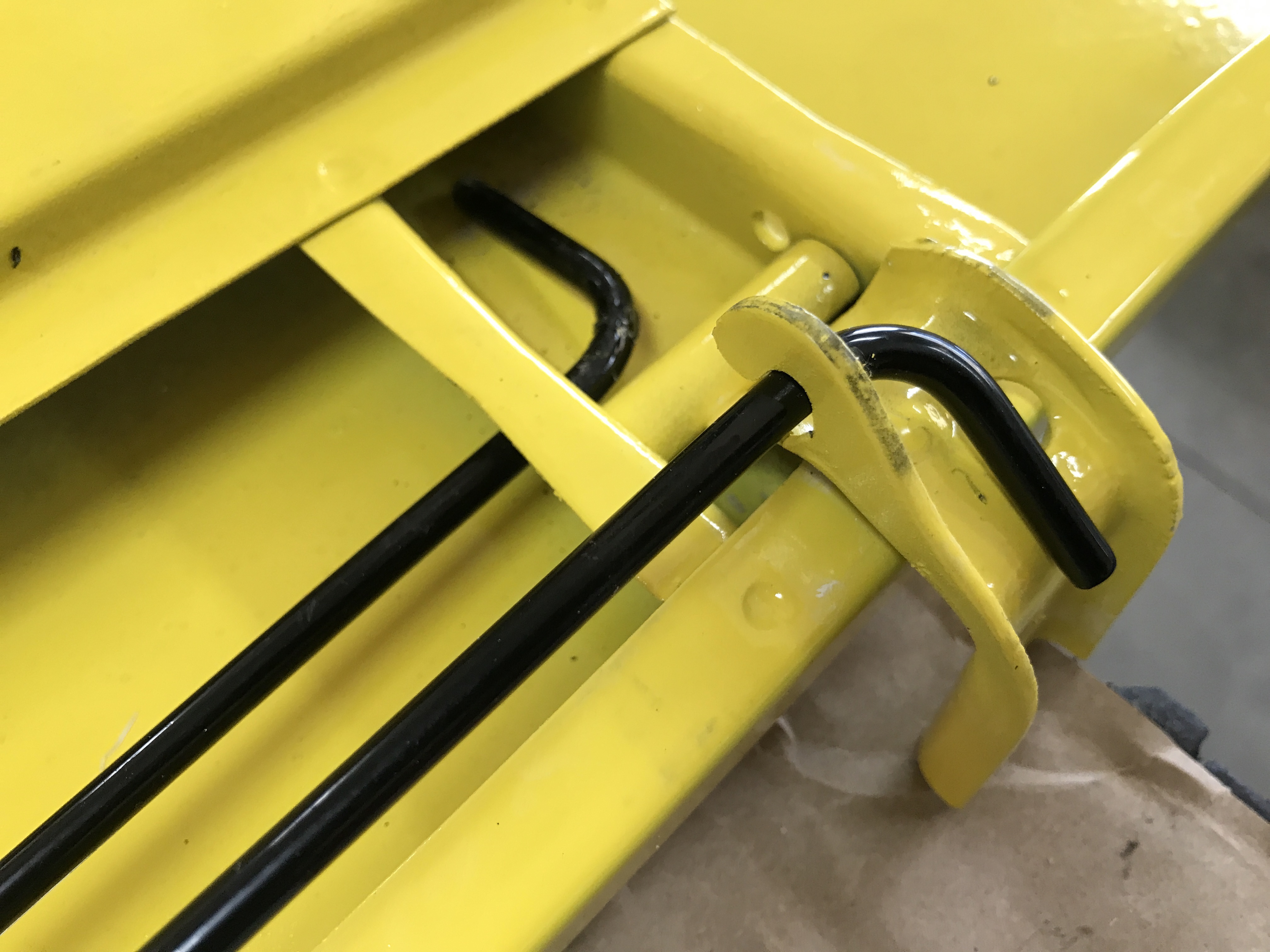

More torsion bars! But these are just babies.
bkrantz
post May 5 2022, 09:16 PM
Post #5185
Posts: 8,530
Joined: 3-August 19
From: SW Colorado
Member No.: 23,343
These go through holes in the cross members, and then slip unto hooks on the hinges.
bkrantz
Post #5186
Posts: 8,530
Joined: 3-August 19
From: SW Colorado
Member No.: 23,343
Like this.

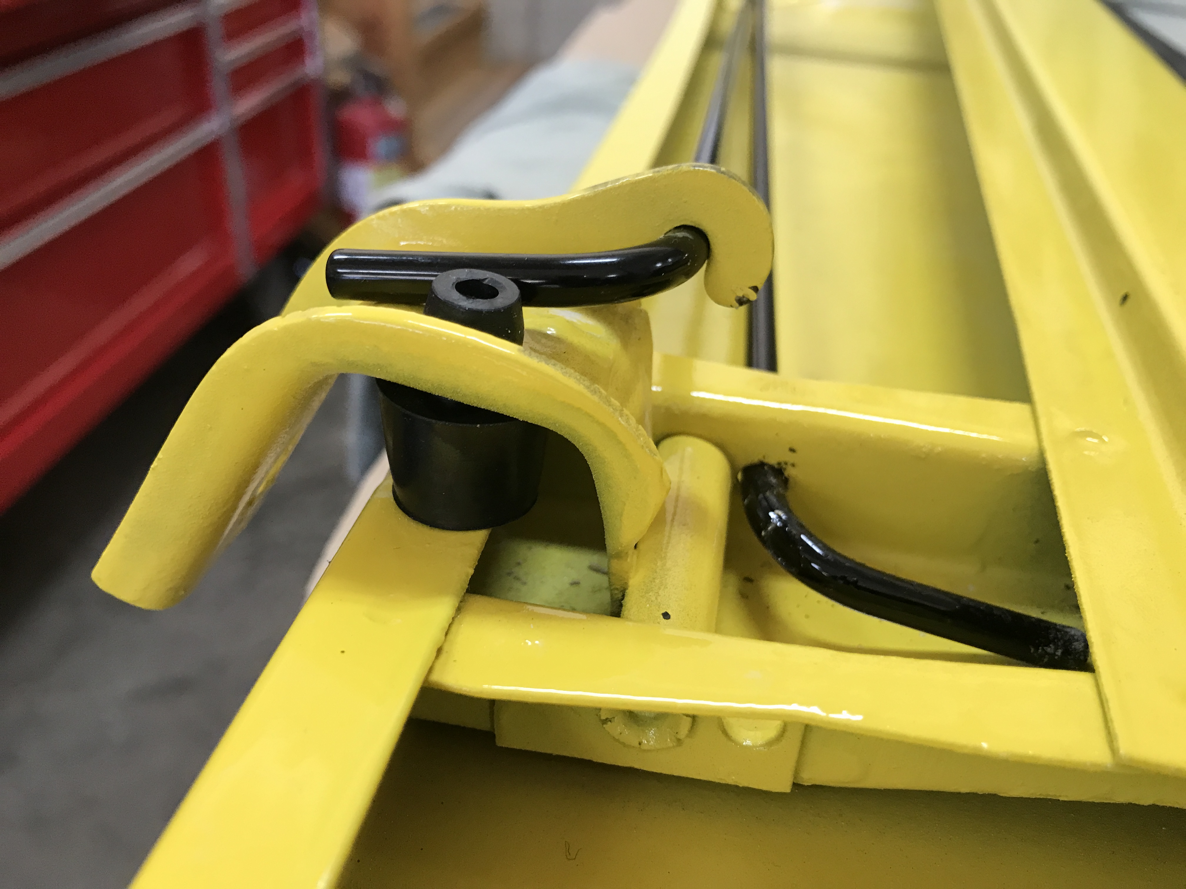

Then rubber stops that limit and soften hinge movement.
bkrantz
post May 5 2022, 09:18 PM
Post #5188
Posts: 8,530
Joined: 3-August 19
From: SW Colorado
Member No.: 23,343
They go into holes in the hinges like this.

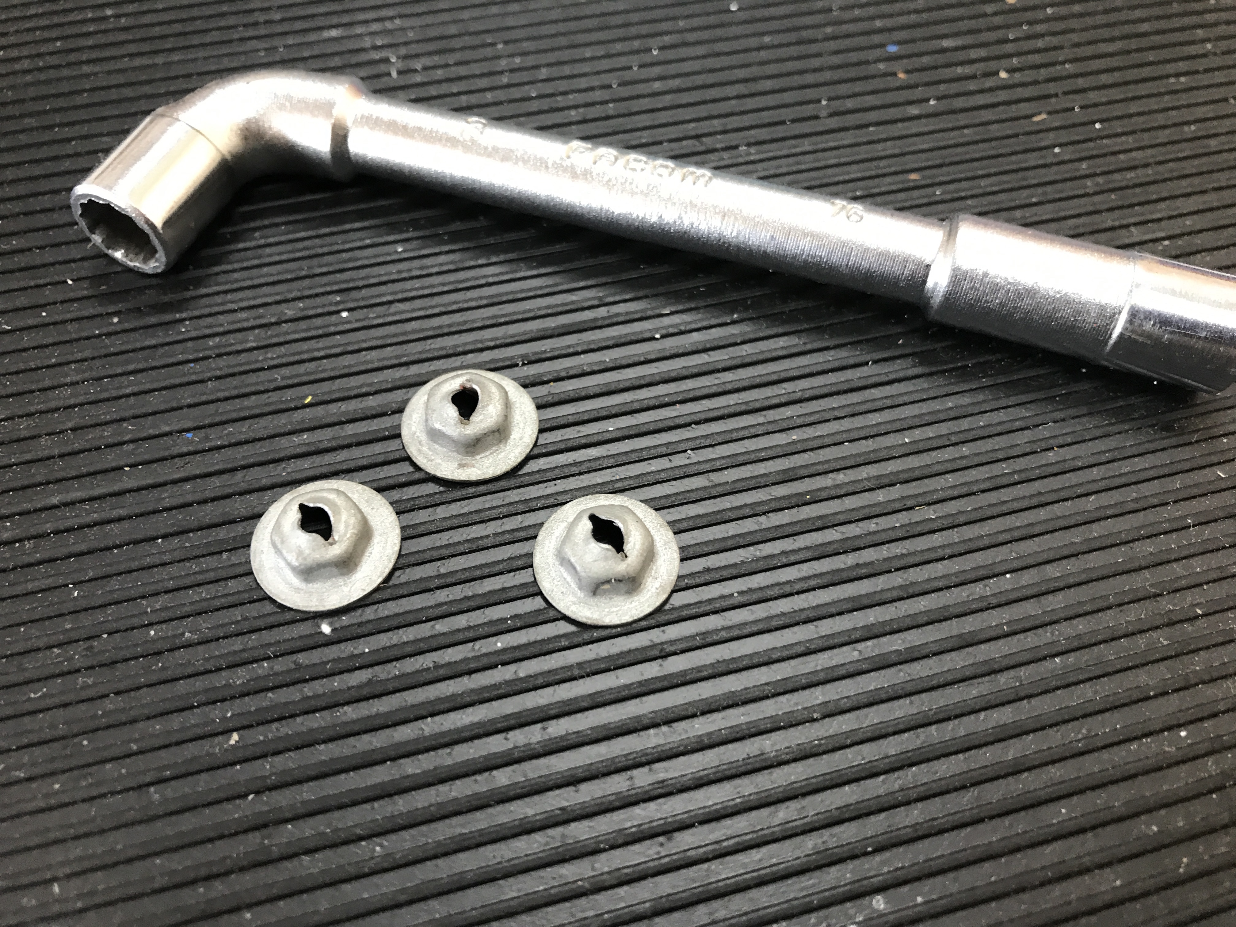

Next, I installed the side grilles. Sorting through the hardware, I found I am short a bunch of speed nuts. The letter kit I bought last year did not come with any and I forgot to add them.

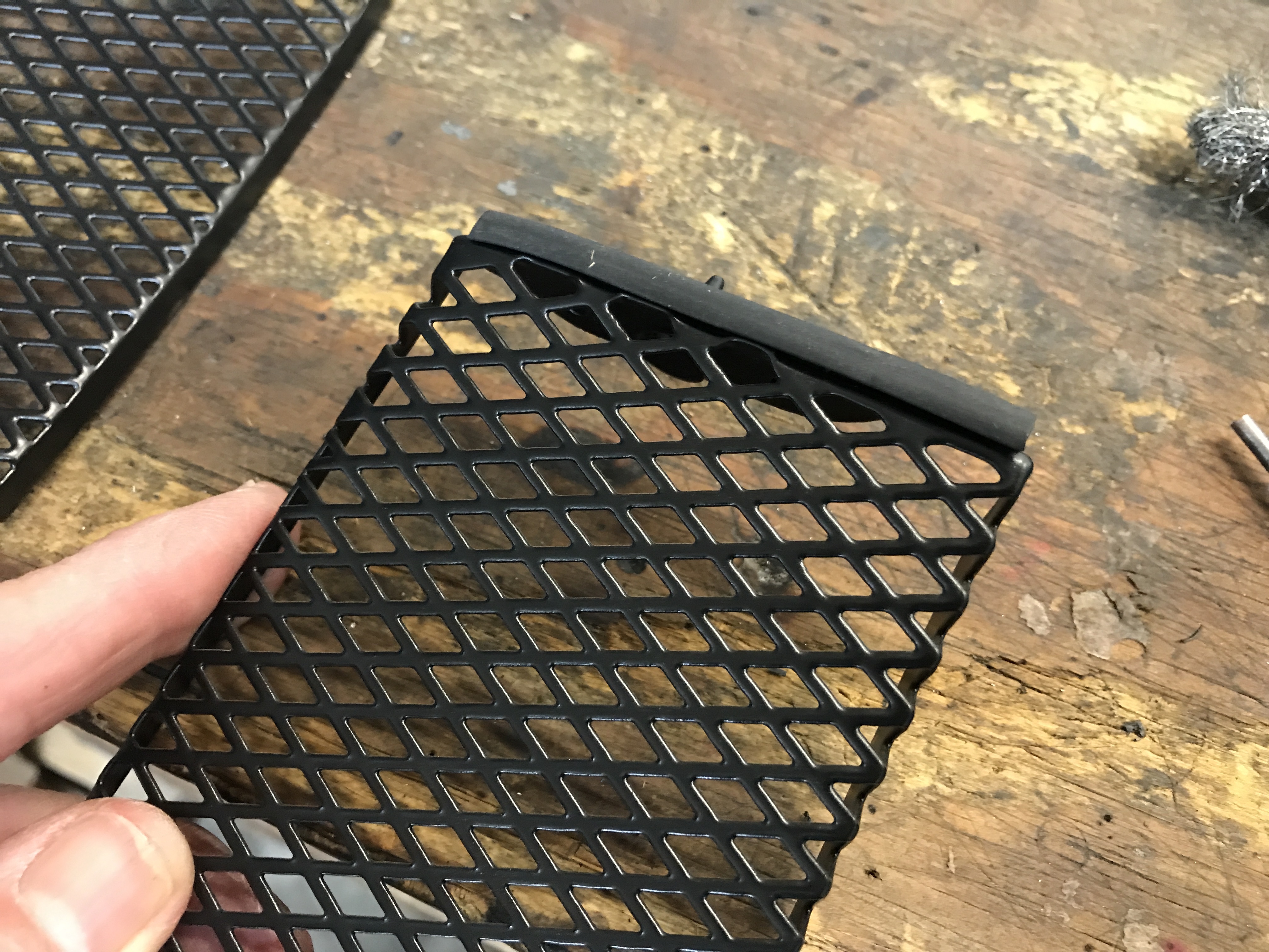

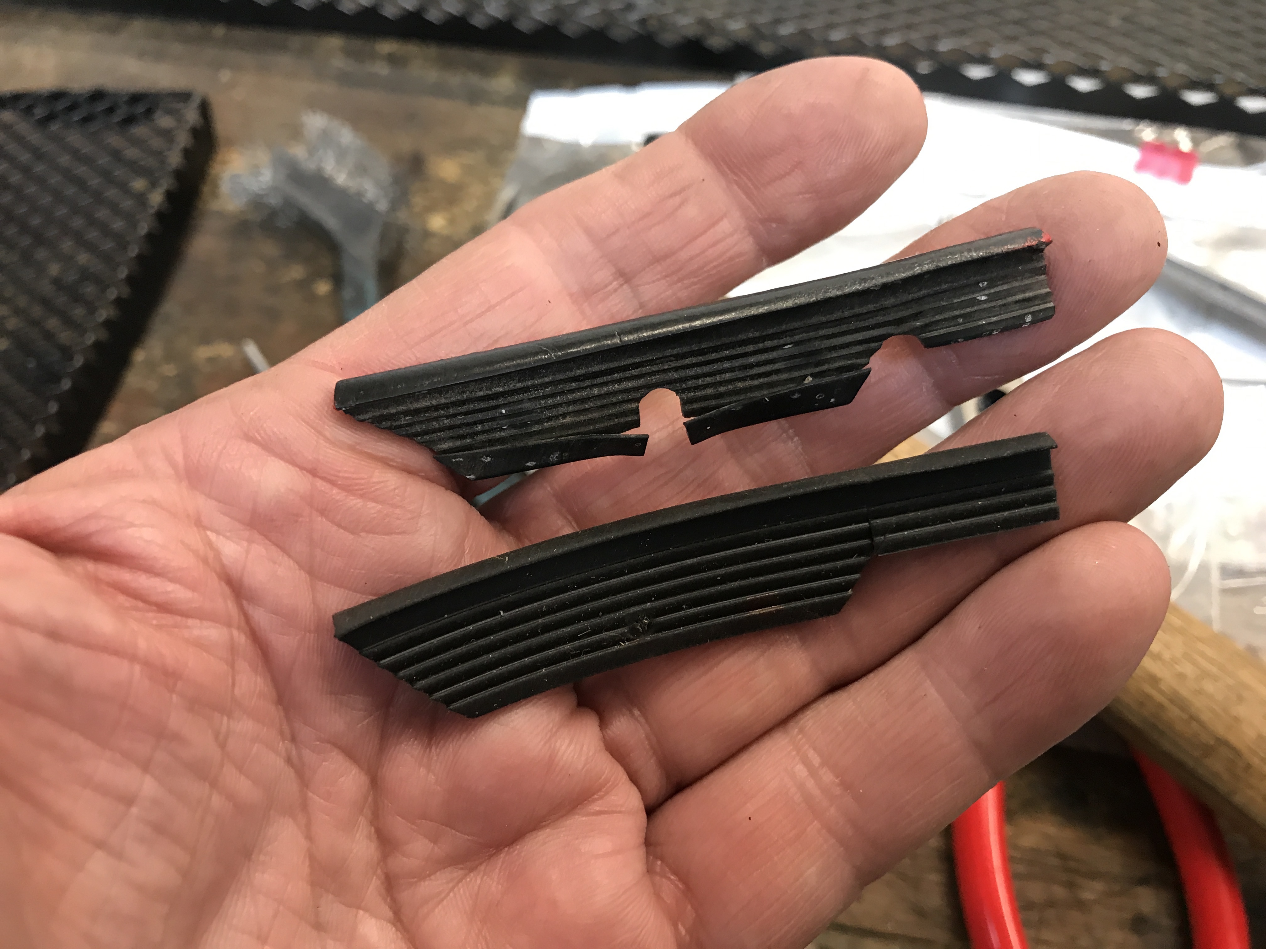

Welting piece cut for the side grille.
bkrantz
post May 5 2022, 09:23 PM
Post #5191
Posts: 8,530
Joined: 3-August 19
From: SW Colorado
Member No.: 23,343
Welting installed on grille.

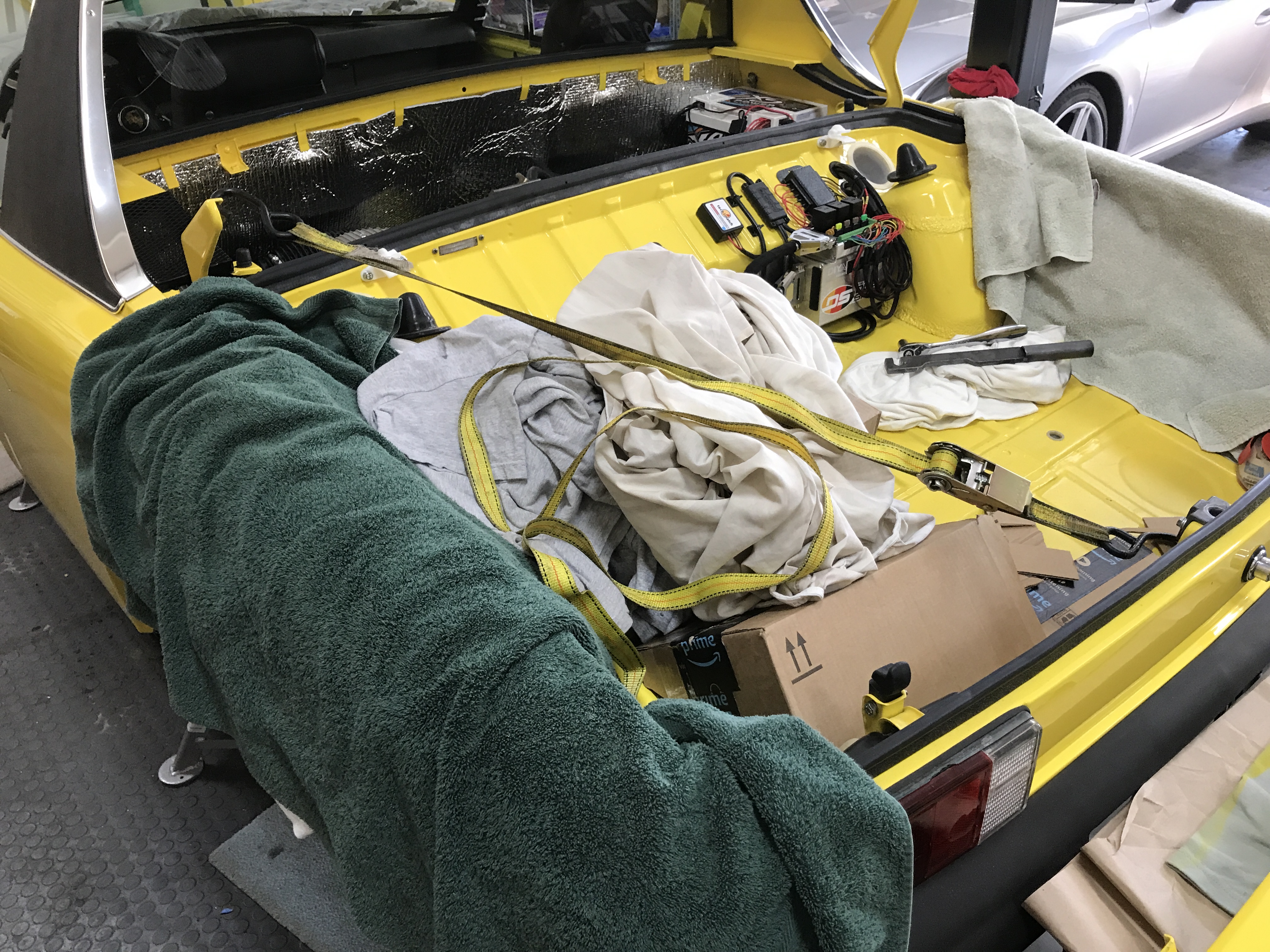

This is how I pulled the trunk hinge back for clearance to install the grille.

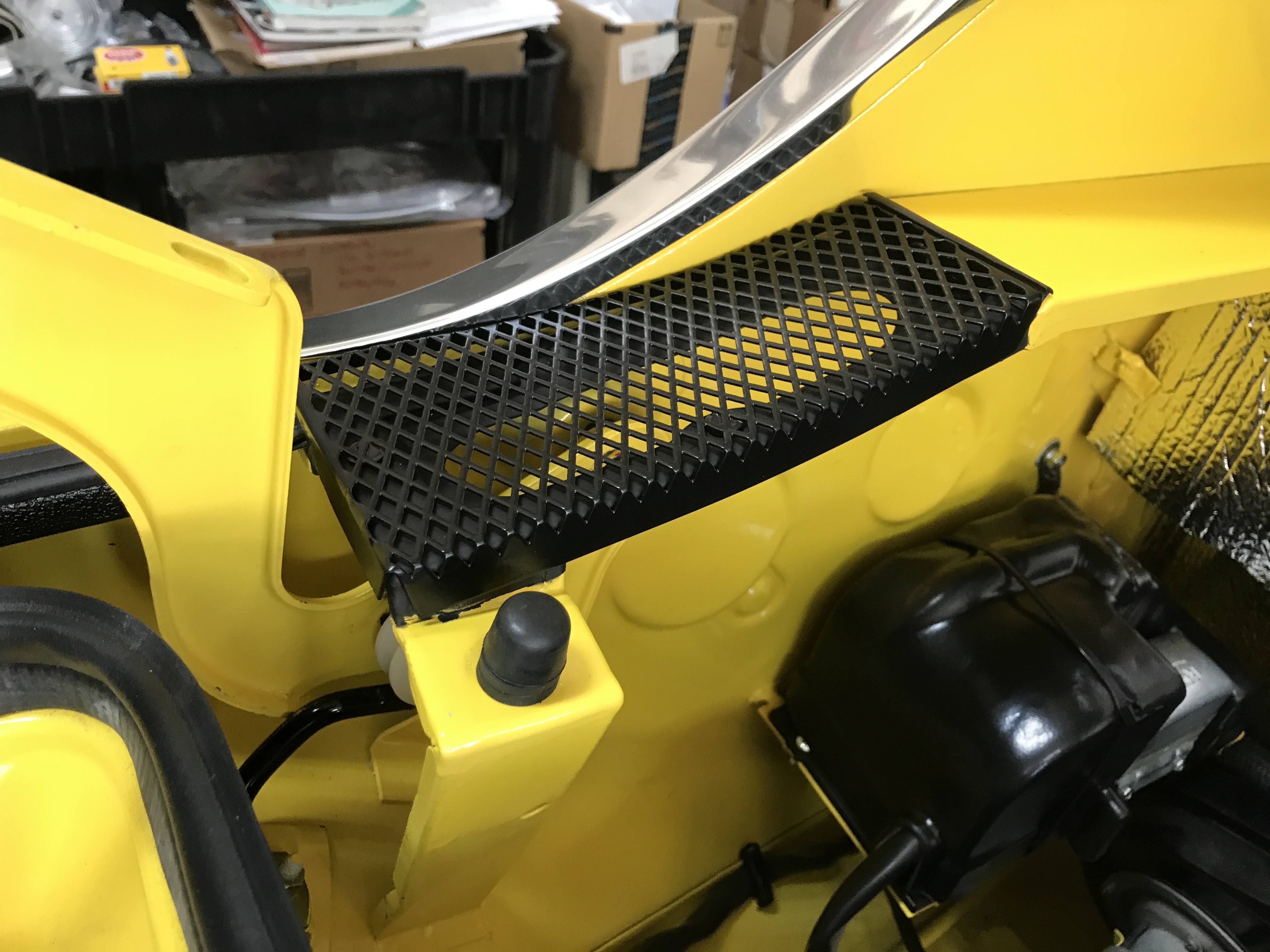

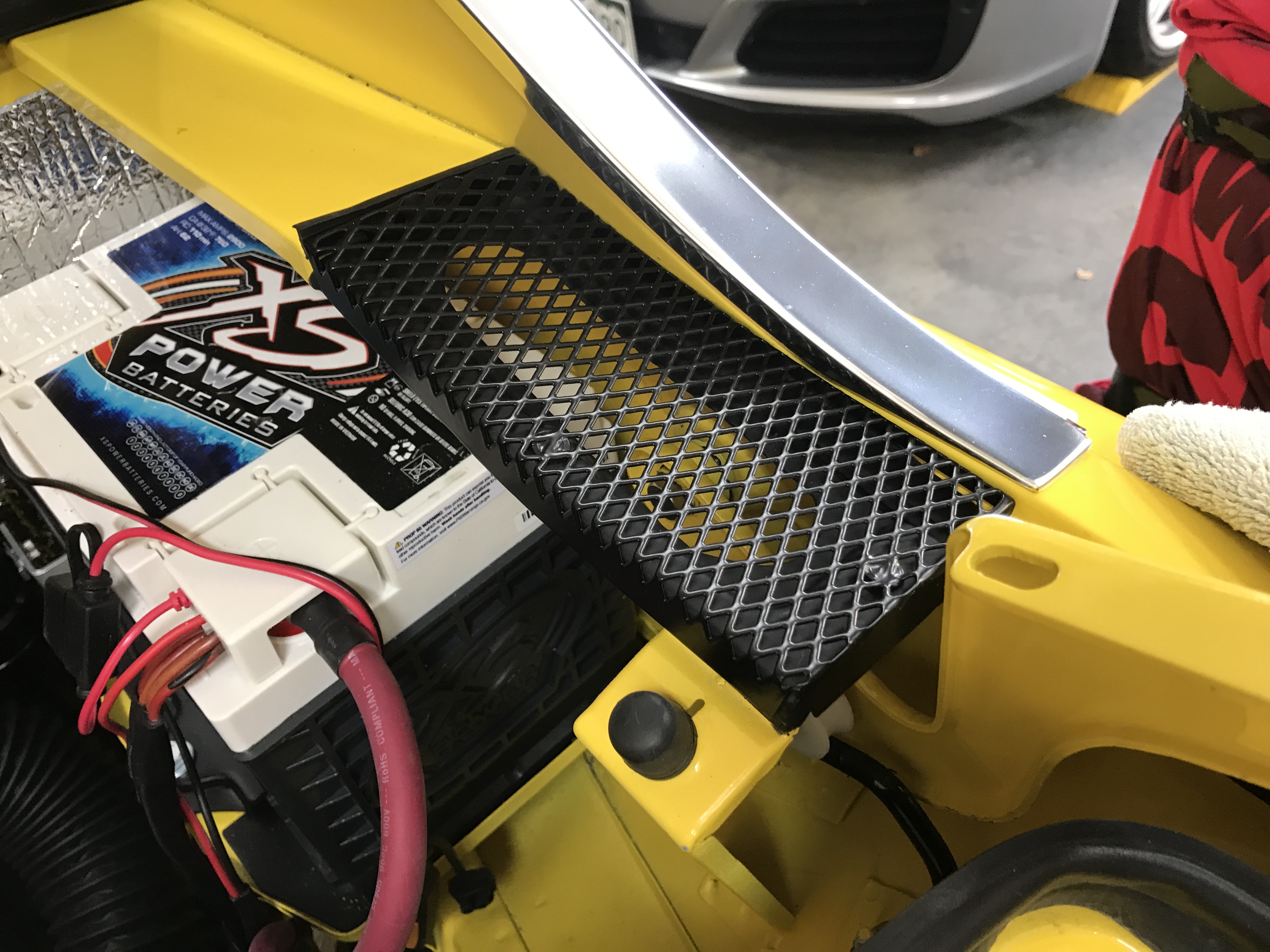

Left side grille in place.

And then speed nuts on the inside.

And I got the right side installed before dinner.

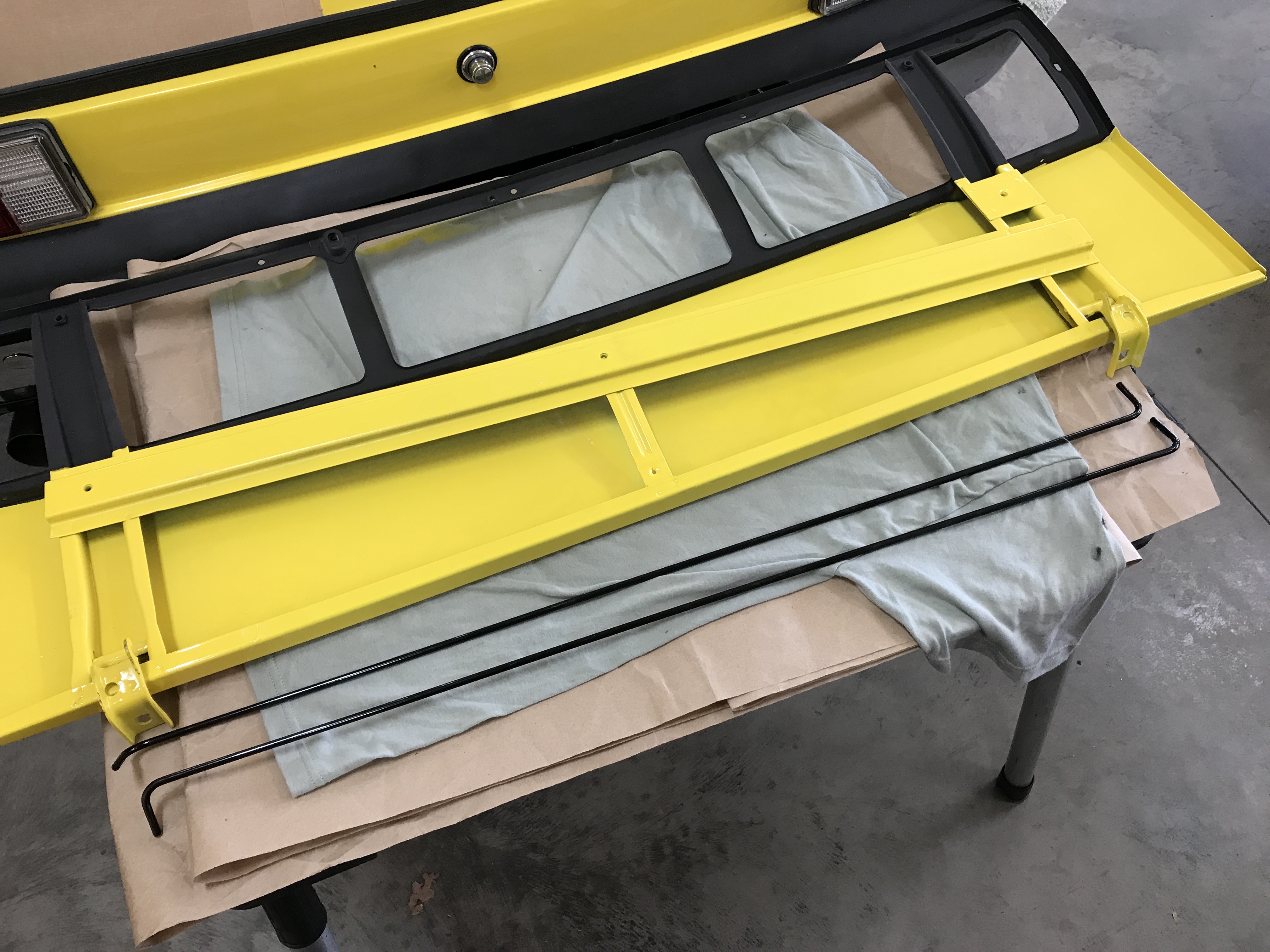

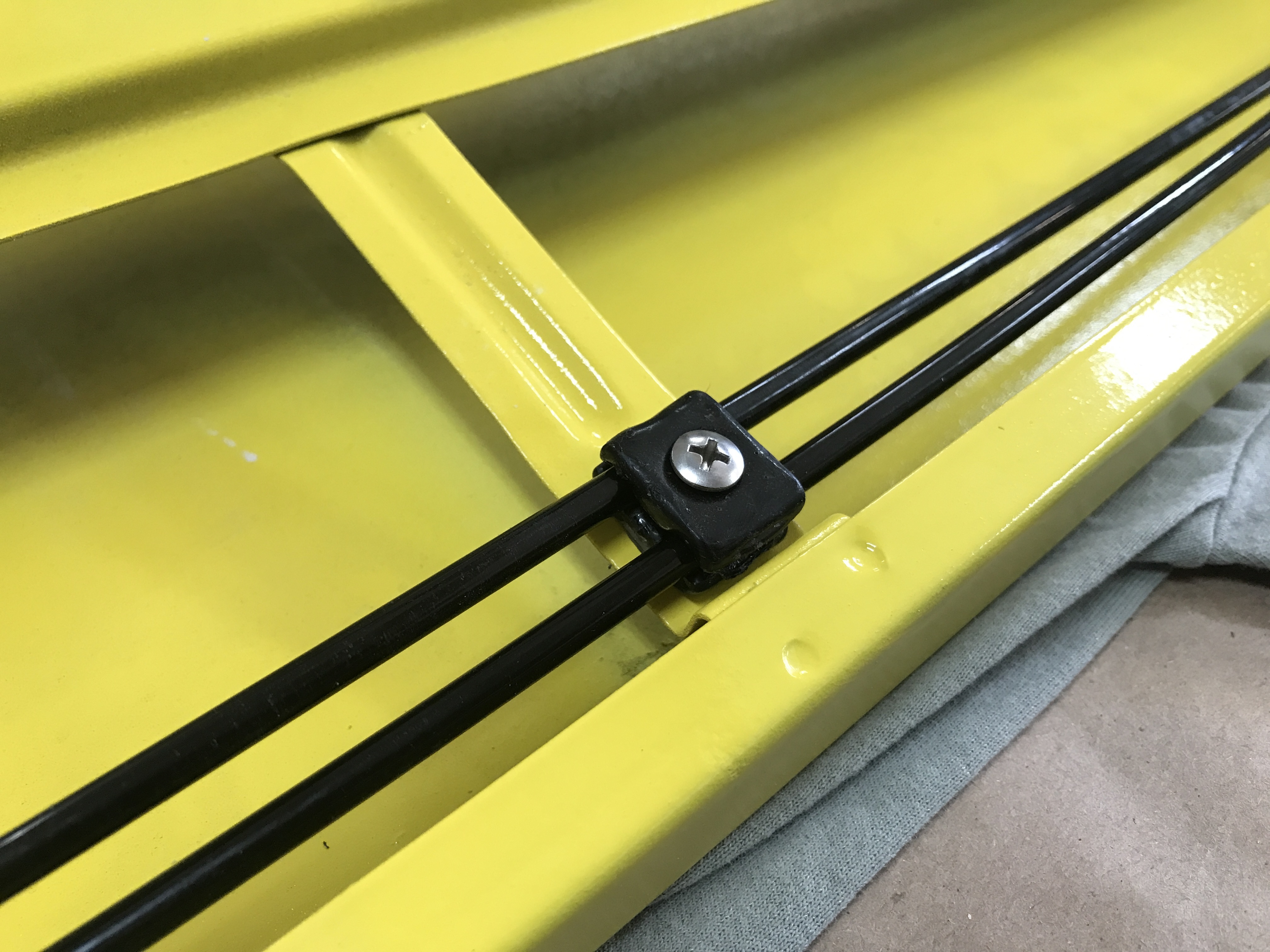

Some more bits on the engine lid. This is the plastic retainer for the baby torsion bars.

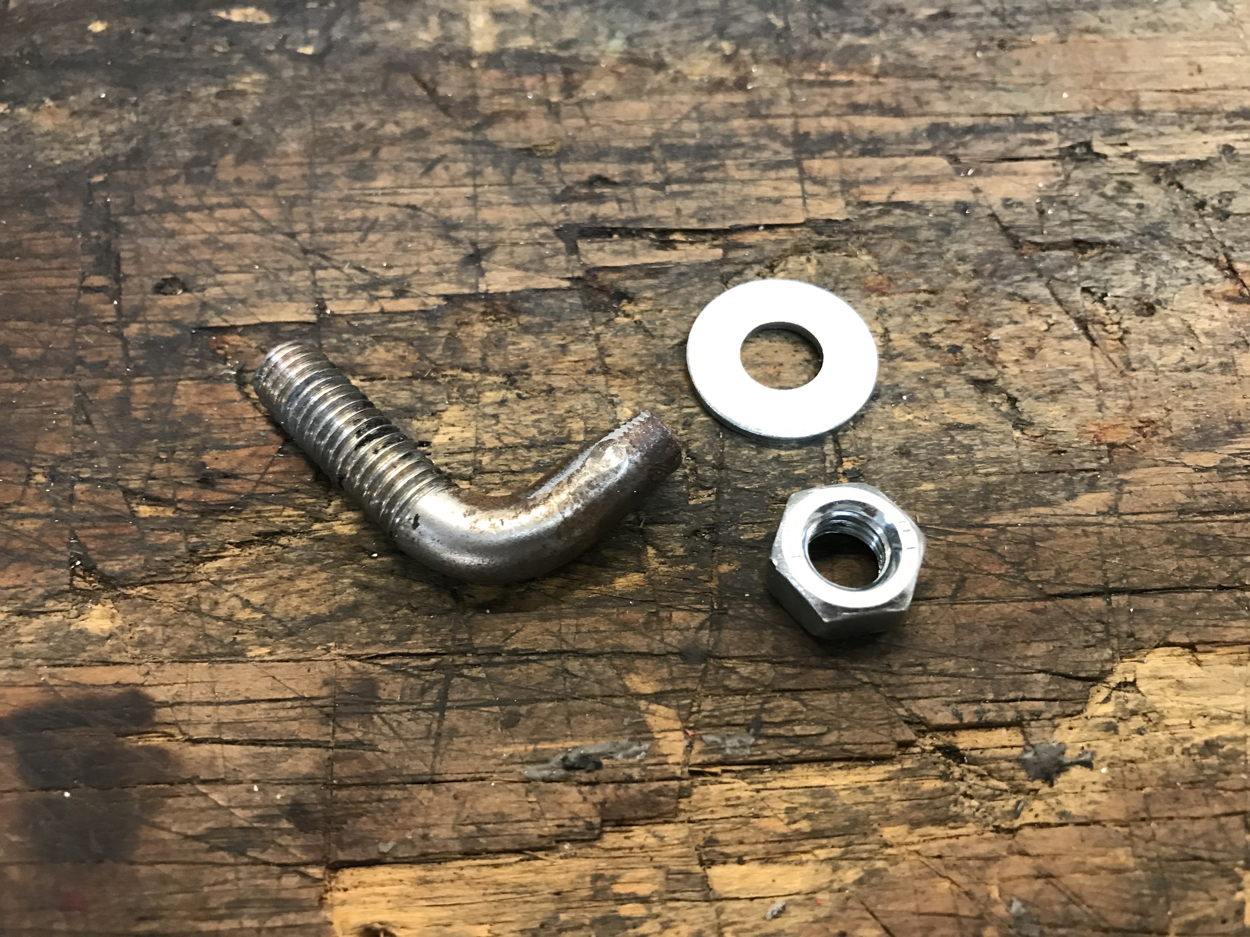

Latch hook.
