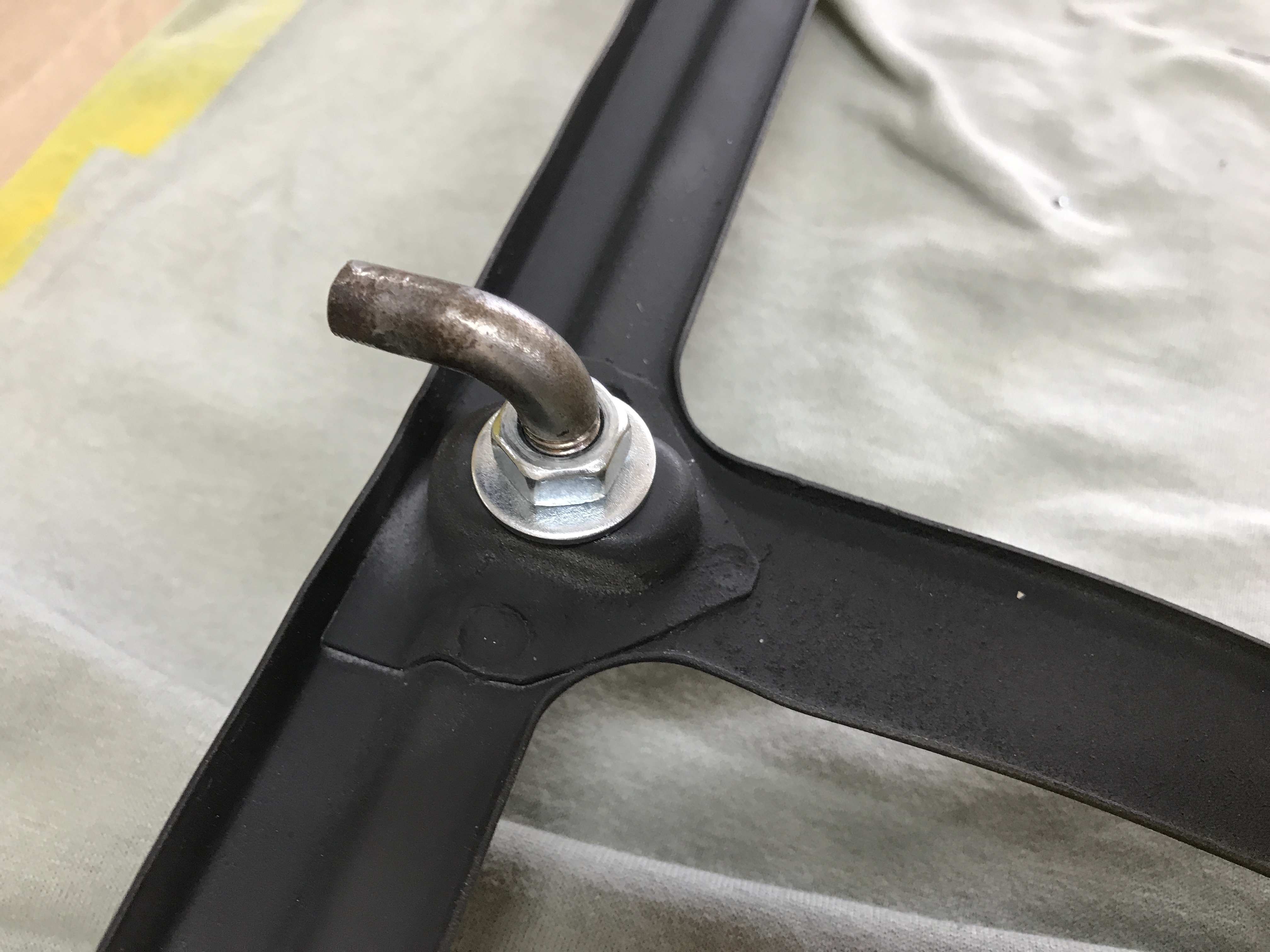

Installed.

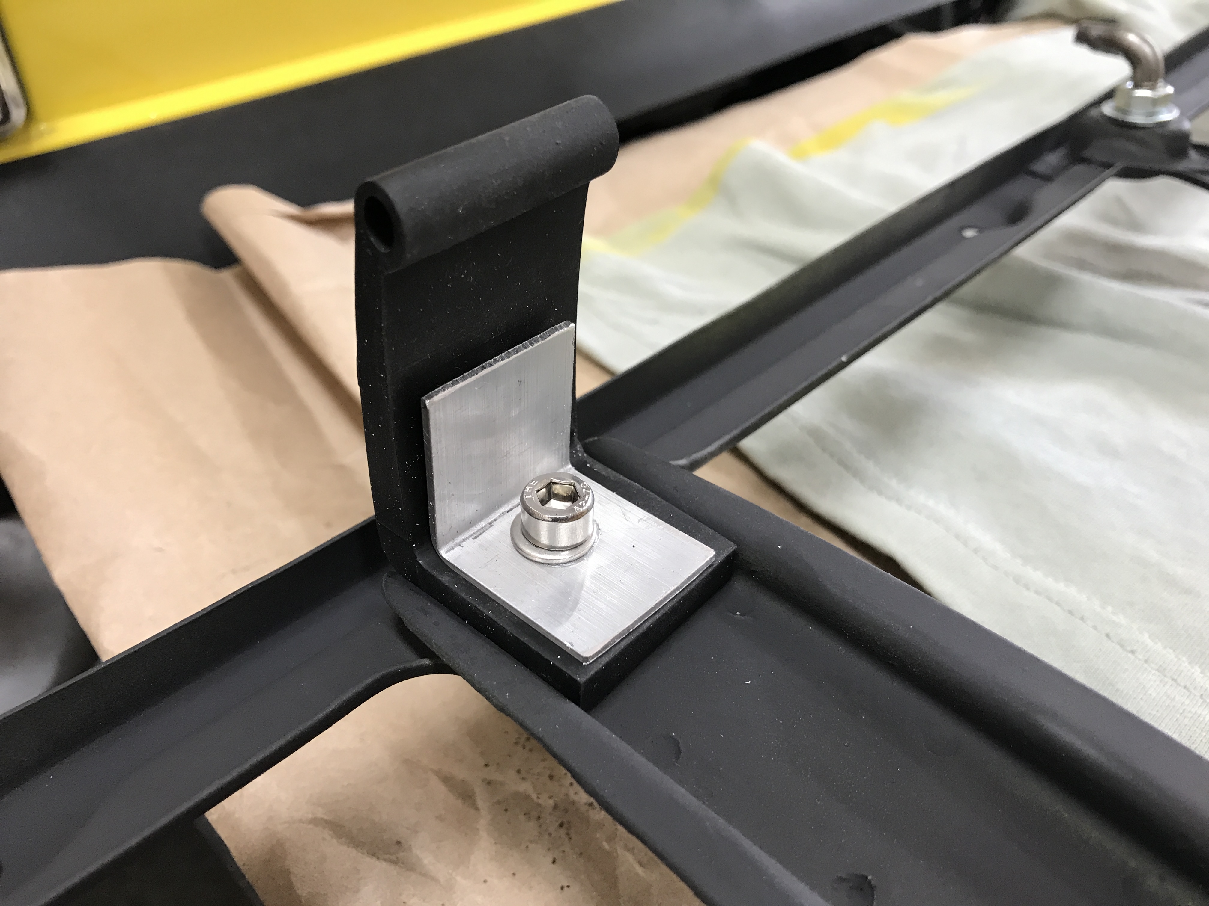

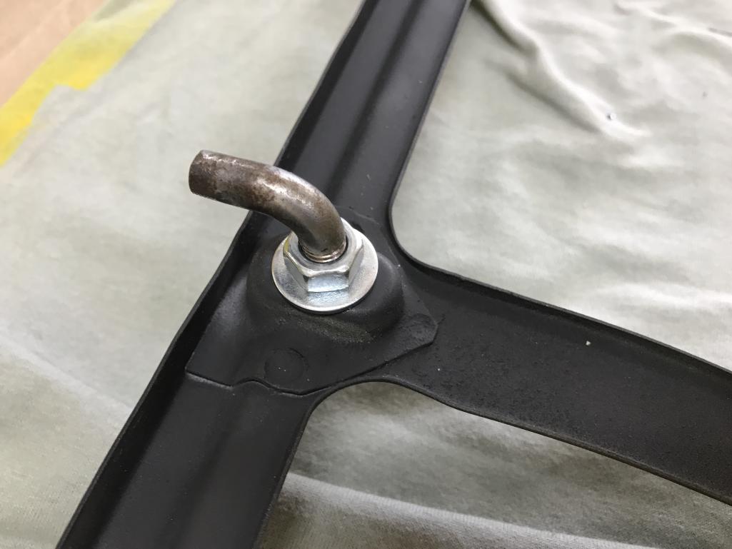

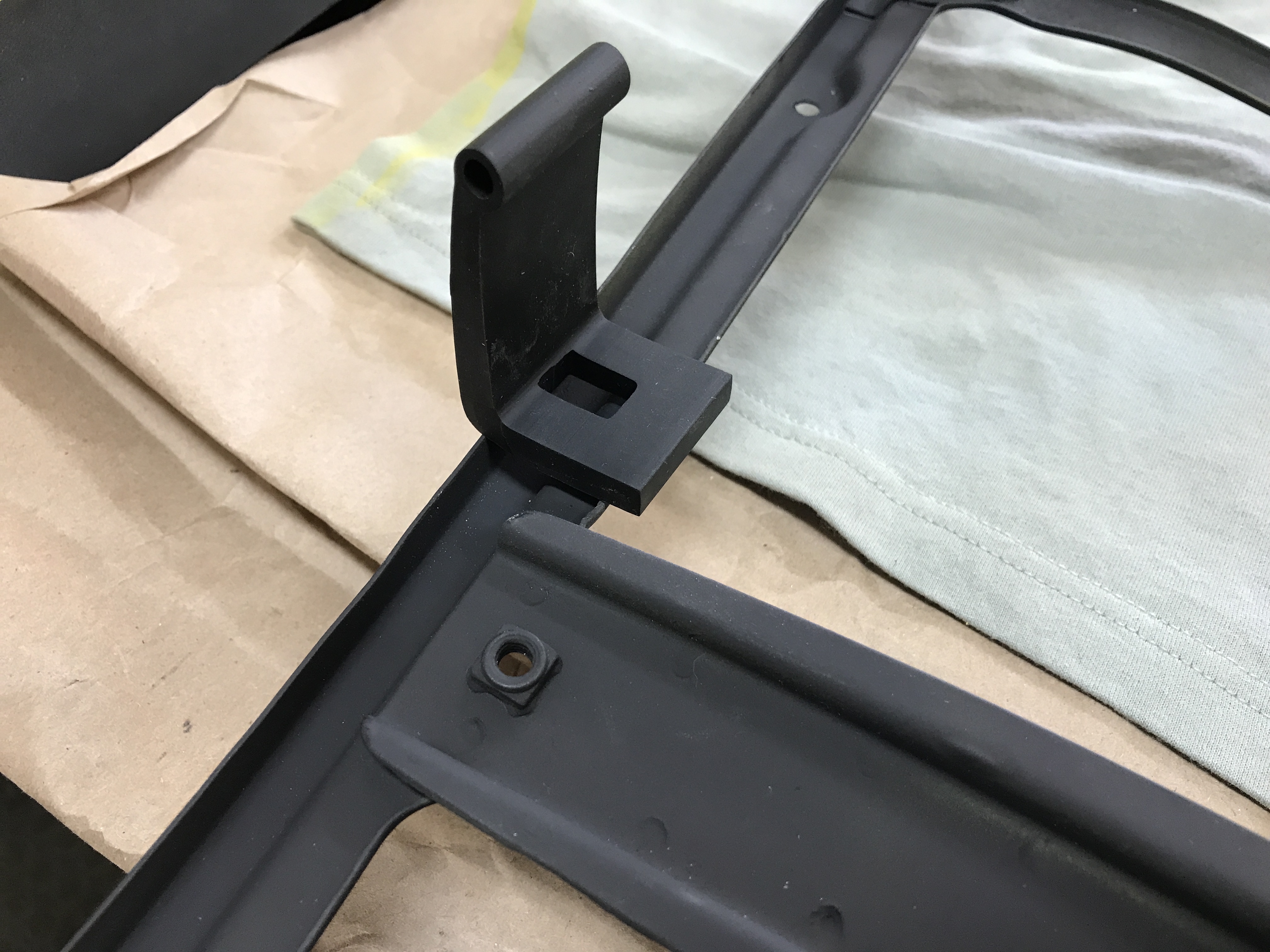

My lid was missing the trunk safety bumper. Here is the new rubber piece, but I did not have the metal retaining brace.
bkrantz
post May 6 2022, 08:01 PM
Post #5203
Posts: 8,530
Joined: 3-August 19
From: SW Colorado
Member No.: 23,343

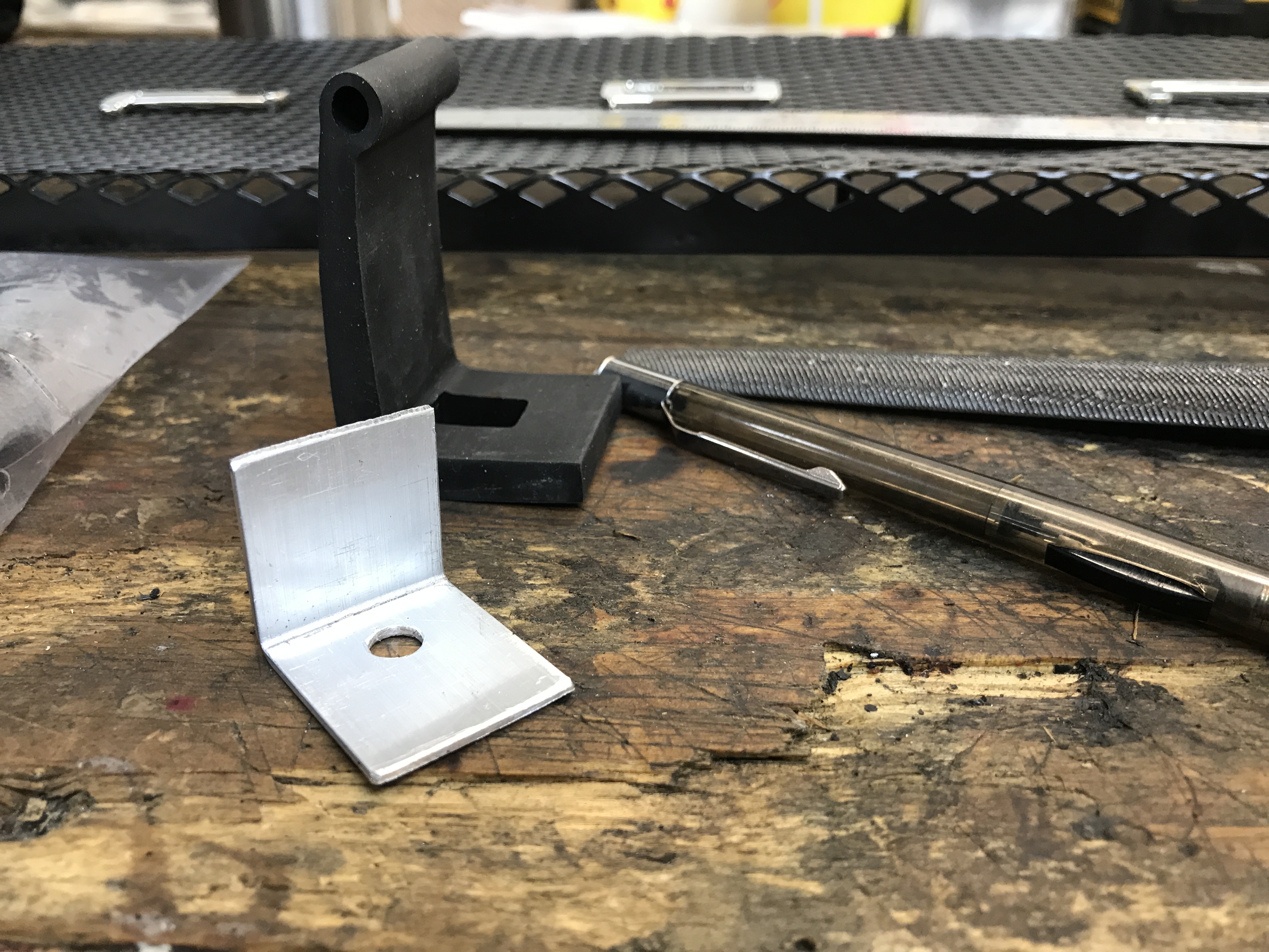

So I made a substitute from 1/16" aluminum.
bkrantz
post May 6 2022, 08:02 PM
Post #5204
Posts: 8,530
Joined: 3-August 19
From: SW Colorado
Member No.: 23,343
Installed.

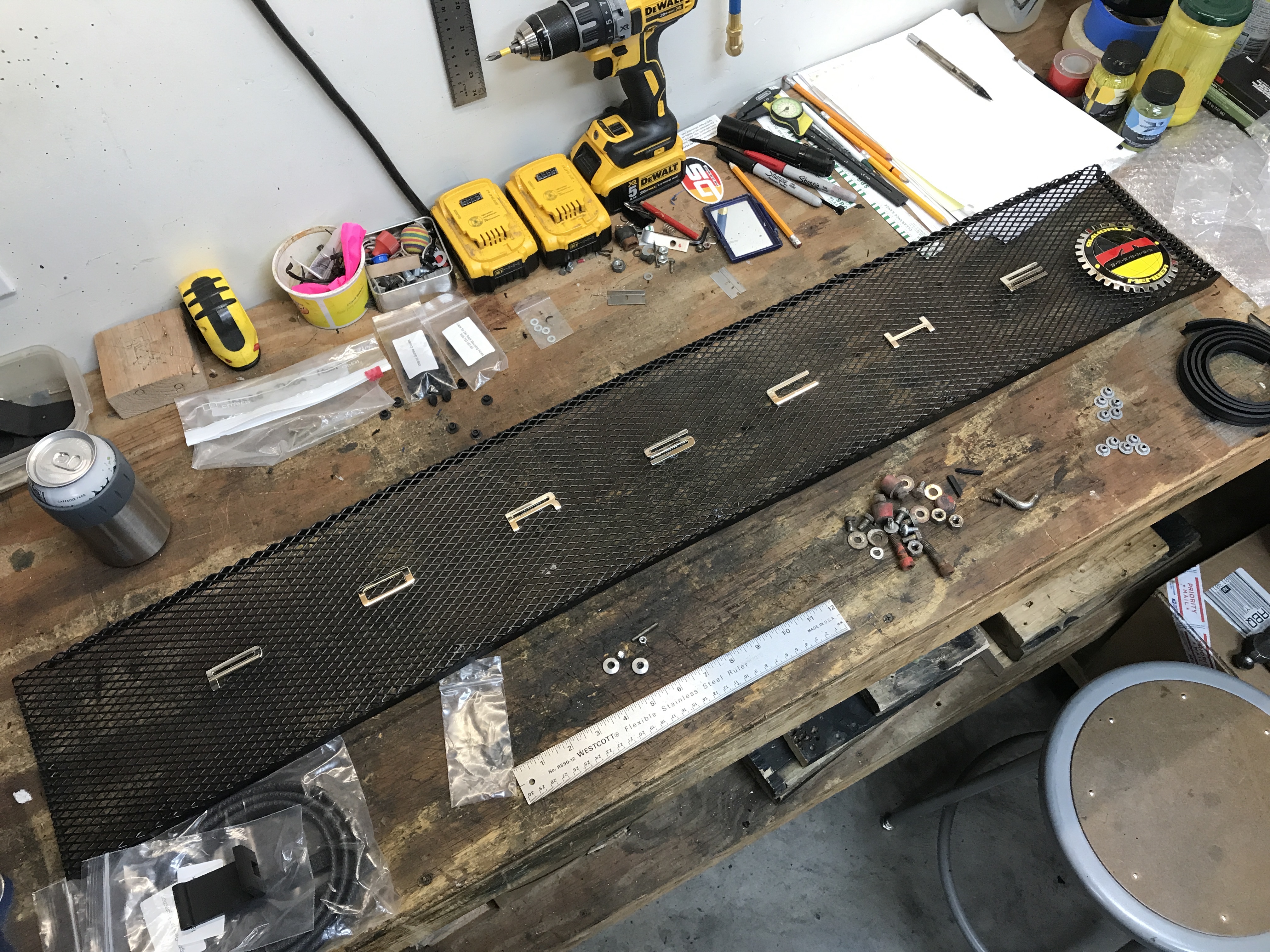

I had time to play with the layout of PORSCHE on the grille. It might not be stock, but I made room for the 914World badge on the right side. Now I need the postal service to deliver the retaining speed nuts I ordered.

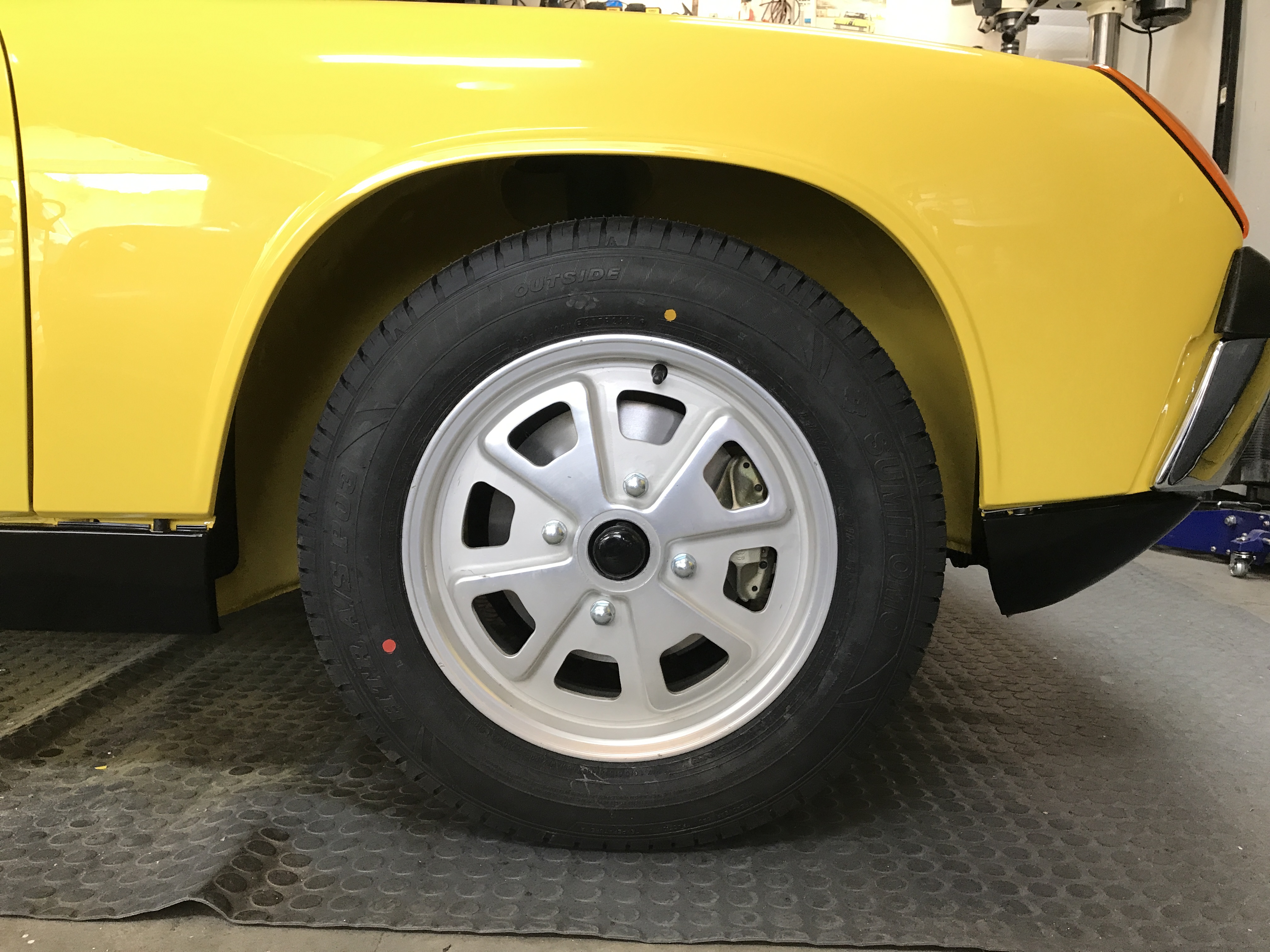

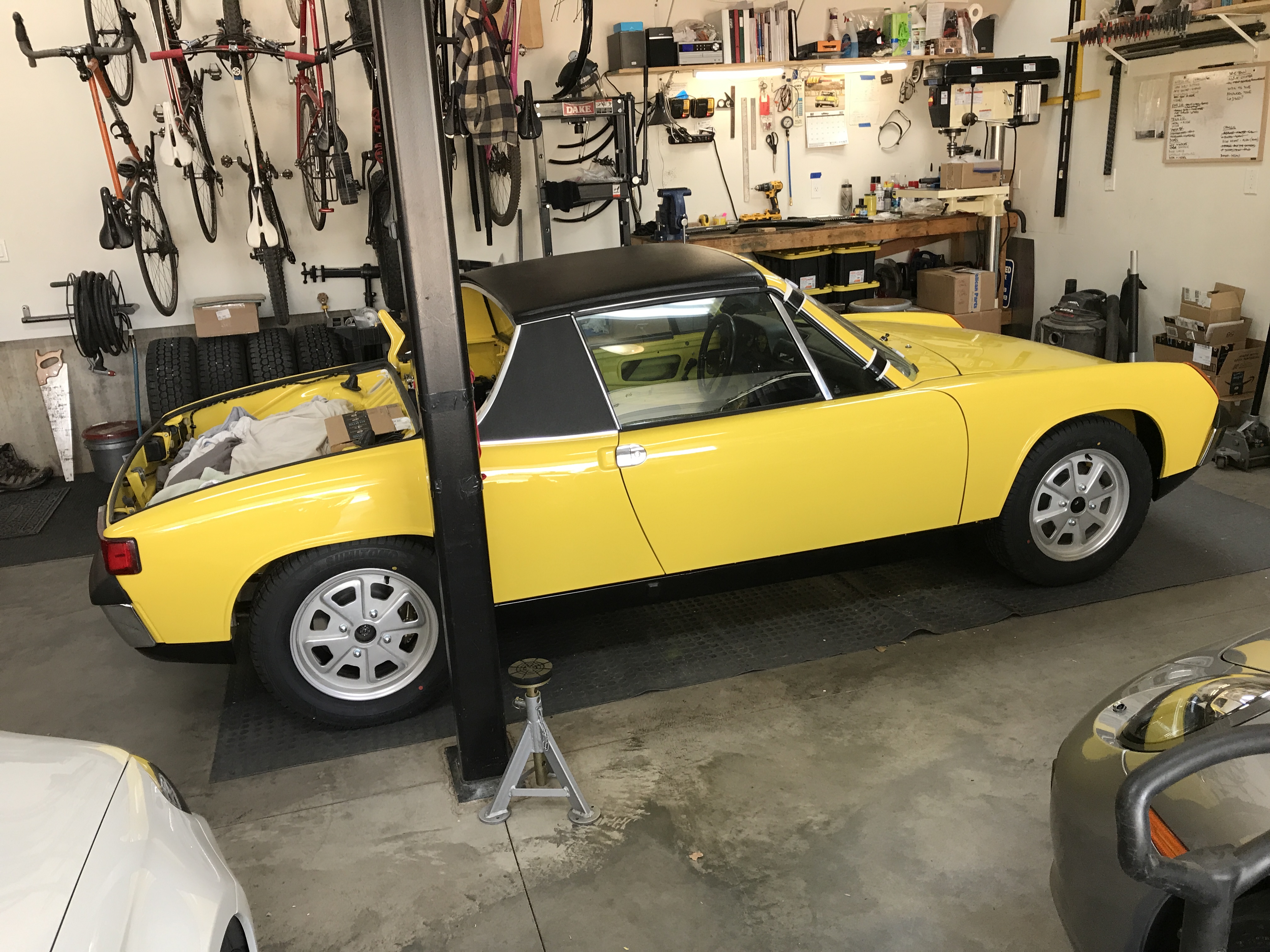

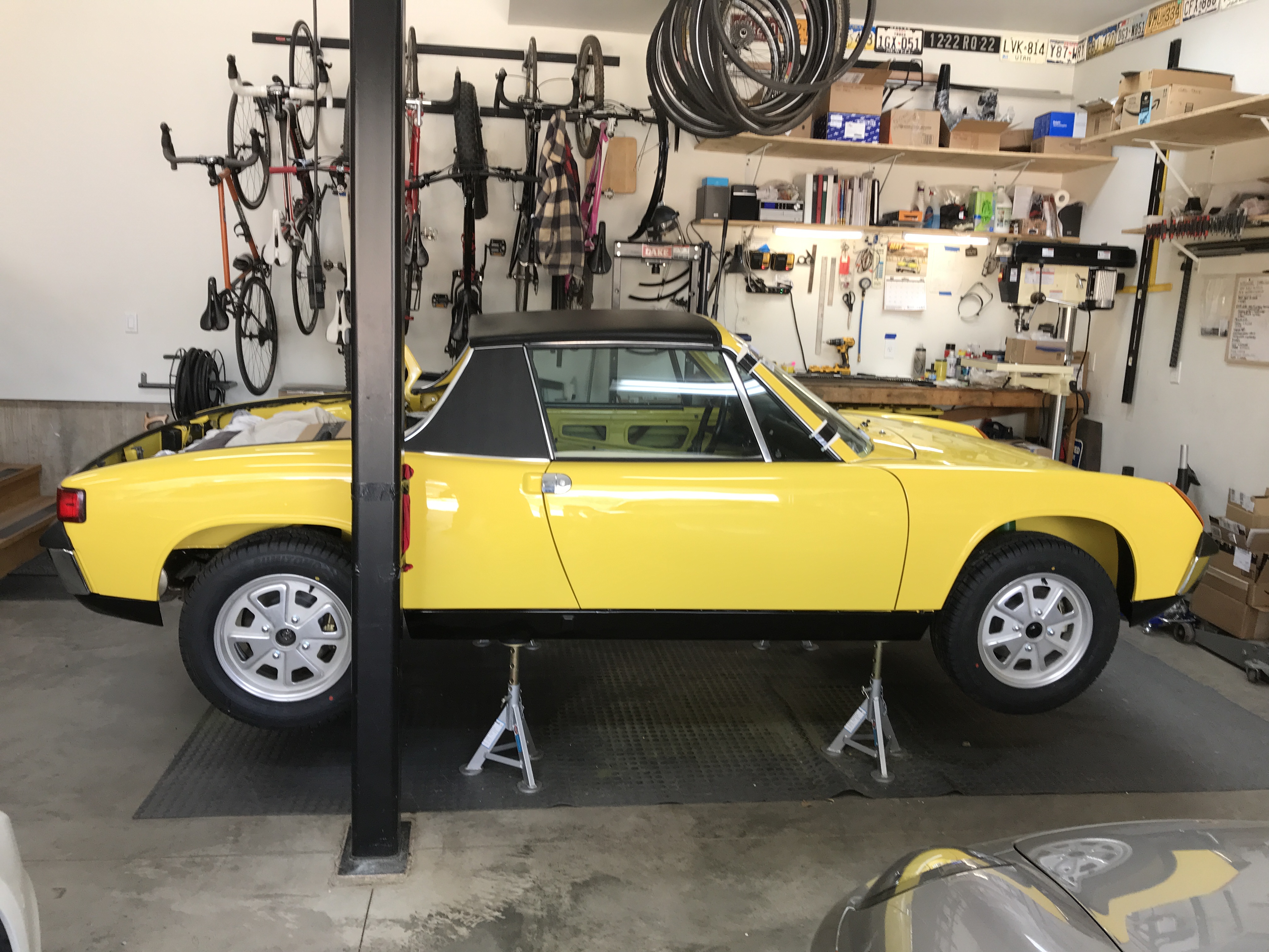

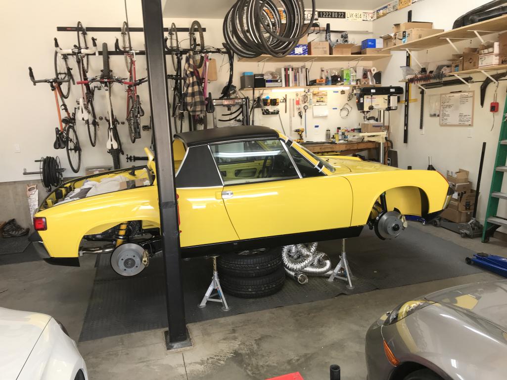

OK, today is the day. Time to put the car on its own feet, er, wheels.
One last look at the car up in the air. It has been on jack stands or a rotisserie since September of 2019. I think that means almost 3 years.
bkrantz
post May 7 2022, 08:05 PM
Post #5208
Posts: 8,530
Joined: 3-August 19
From: SW Colorado
Member No.: 23,343
All 4 wheels went on easy. I take that as a good sign.
bkrantz
post May 7 2022, 08:08 PM
Post #5209
Posts: 8,530
Joined: 3-August 19
From: SW Colorado
Member No.: 23,343
I lowered each side a bit at a time, and finally the wheels touched down. I was a bit worried that it might settle too low, but I think I have the opposite problem.
But anyway, excuse me if I celebrate this milestone. (IMG:style_emoticons/default/smilie_pokal.gif) (IMG:style_emoticons/default/piratenanner.gif) (IMG:style_emoticons/default/cheer.gif) (IMG:style_emoticons/default/smilie_pokal.gif) (IMG:style_emoticons/default/piratenanner.gif) (IMG:style_emoticons/default/cheer.gif) (IMG:style_emoticons/default/smilie_pokal.gif) (IMG:style_emoticons/default/piratenanner.gif) (IMG:style_emoticons/default/cheer.gif)
bkrantz
post May 7 2022, 08:10 PM
Post #5210
Posts: 8,530
Joined: 3-August 19
From: SW Colorado
Member No.: 23,343
Front wheel clearance. Pretty even on both sides but about 25 1/2 inches from the fender lip to the ground.

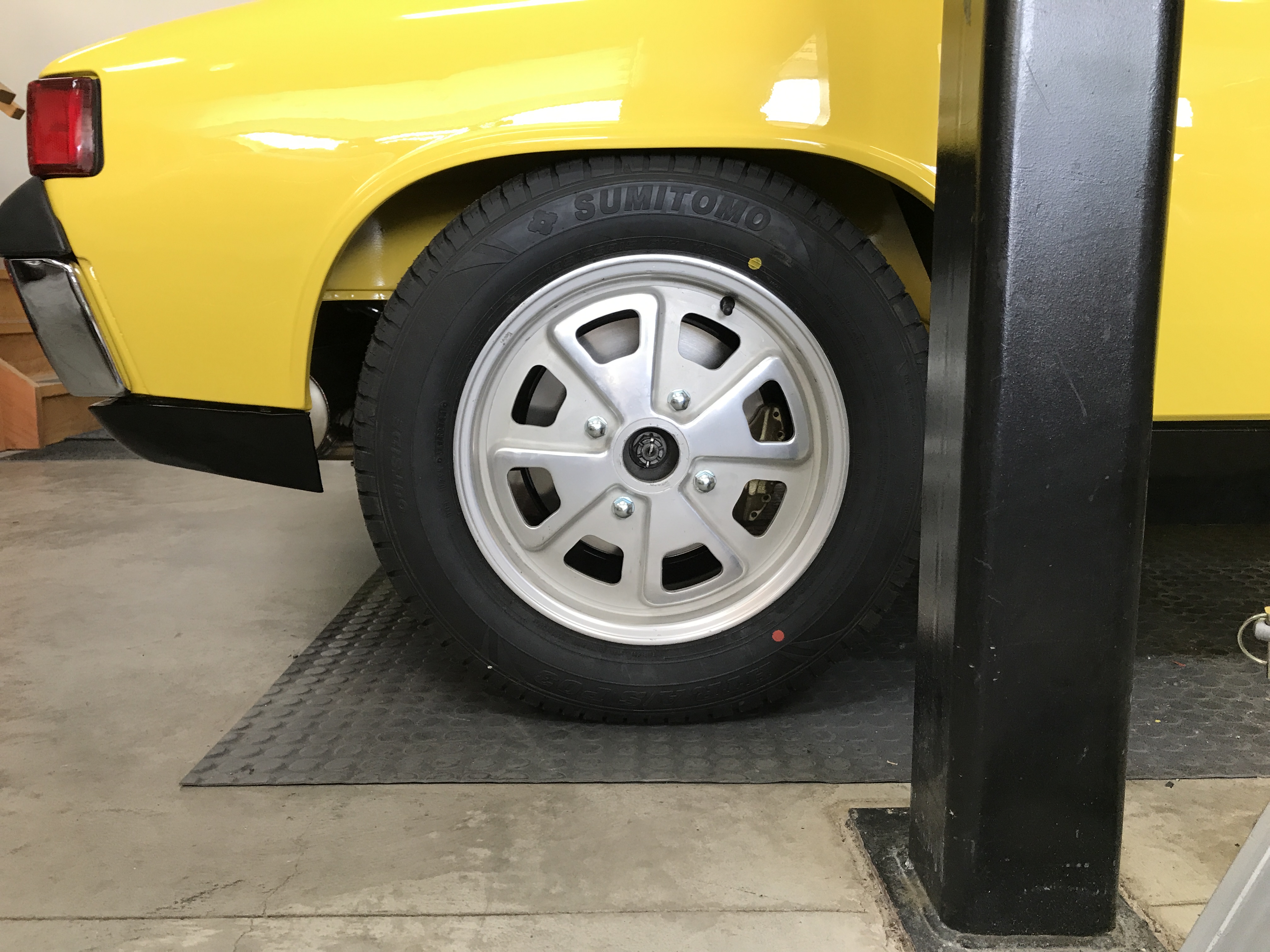

bkrantz
post May 7 2022, 08:11 PM
Post #5211
Posts: 8,530
Joined: 3-August 19
From: SW Colorado
Member No.: 23,343
Rear clearance. Fender lip about 23 1/2 inches high.
bkrantz
post May 7 2022, 08:12 PM
Post #5212
Posts: 8,530
Joined: 3-August 19
From: SW Colorado
Member No.: 23,343

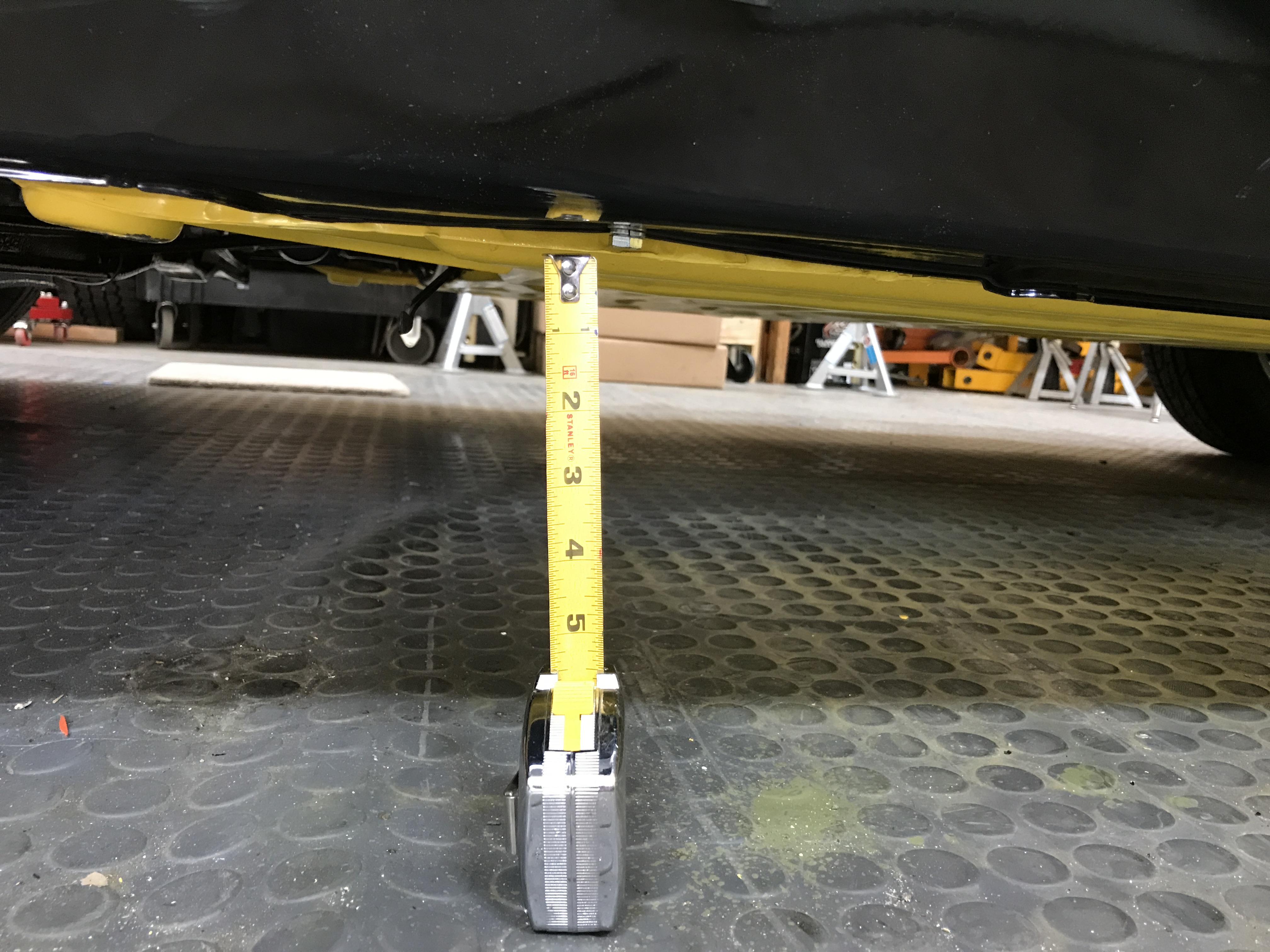

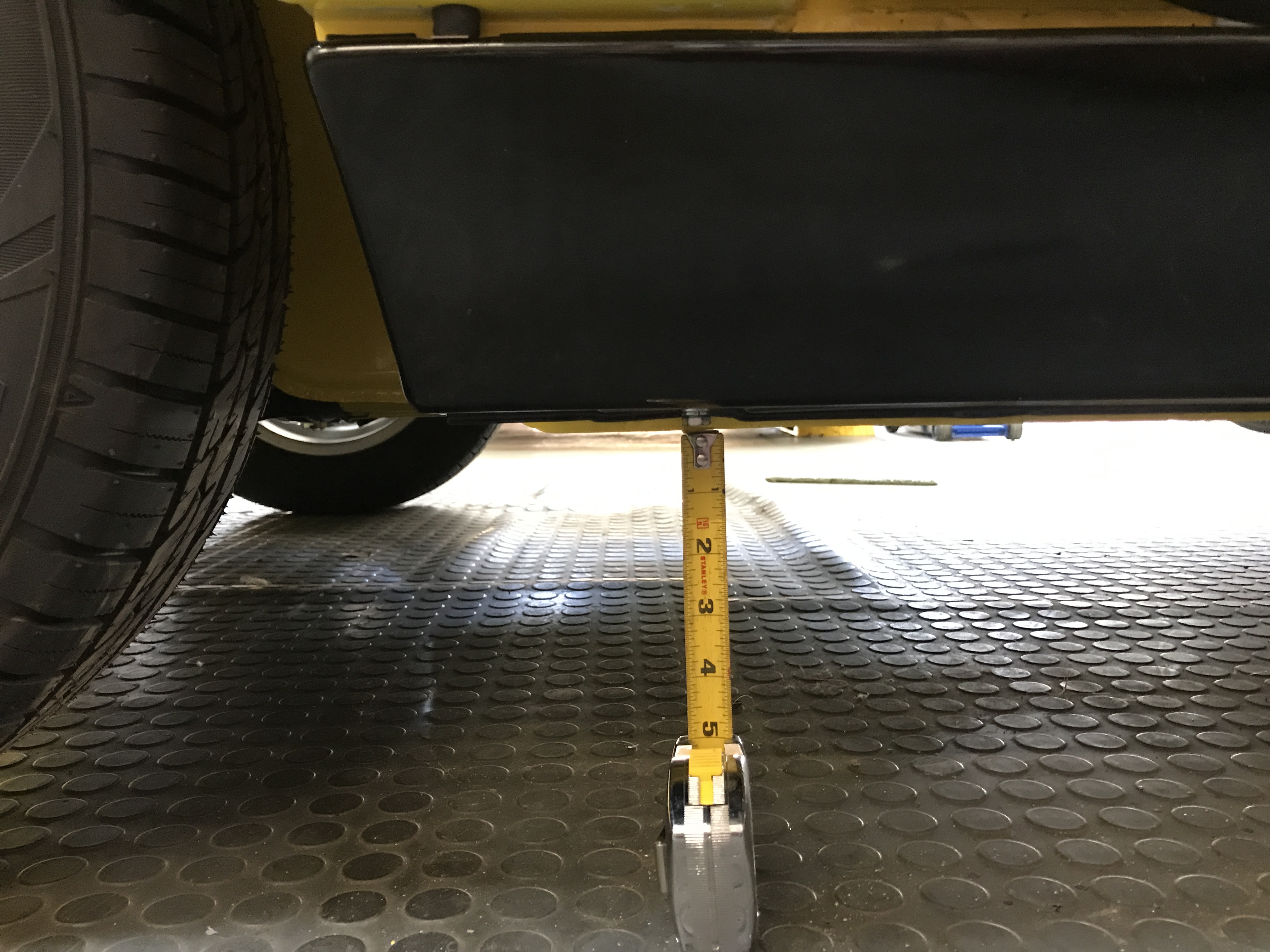

Front rocker seam height, about 7 1/2 inches.
bkrantz
post May 7 2022, 08:14 PM
Post #5213
Posts: 8,530
Joined: 3-August 19
From: SW Colorado
Member No.: 23,343
Rear rocker seam height, almost 8 inches.
My first guess is that the car is about 2.5 inches too high. This might be good for a safari style 914, but not what I have in mind.
bkrantz
post May 7 2022, 08:15 PM
Post #5214
Posts: 8,530
Joined: 3-August 19
From: SW Colorado
Member No.: 23,343

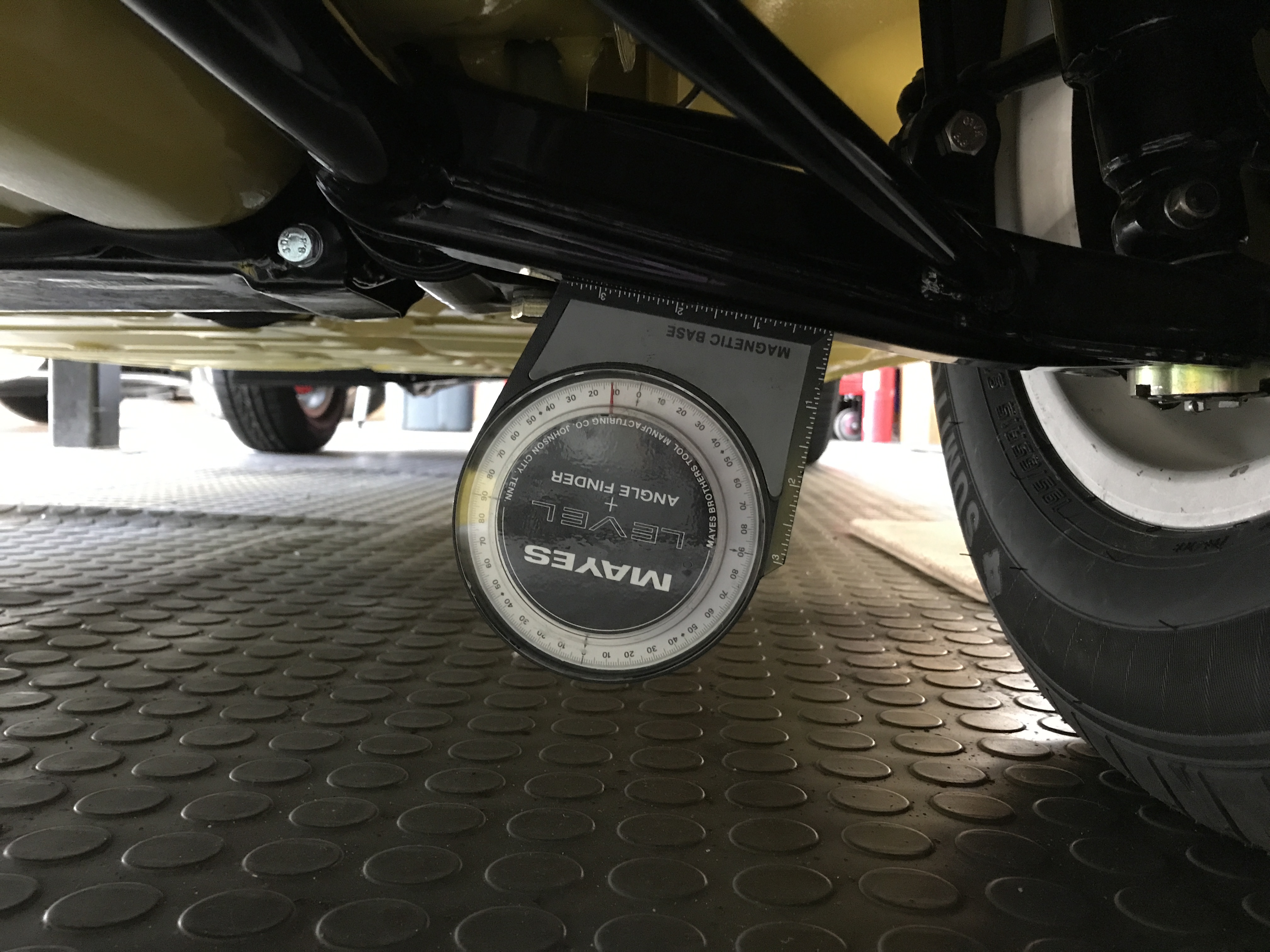

I also measured the angle of the front A-arms, and got 10° on both sides. My guess is that this should be more like 2 or 3°.
Tomorrow I can start trying to lower both ends.

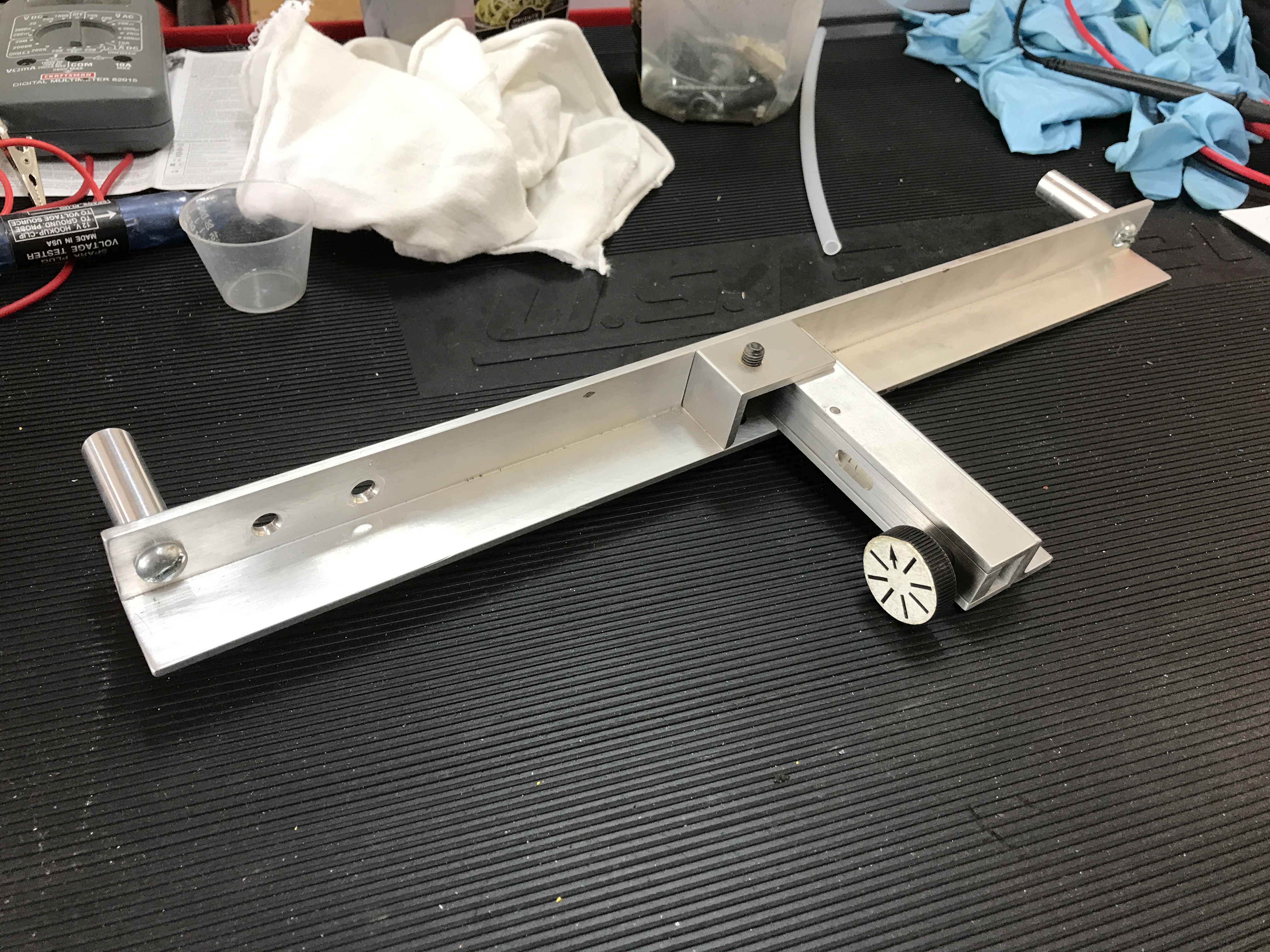

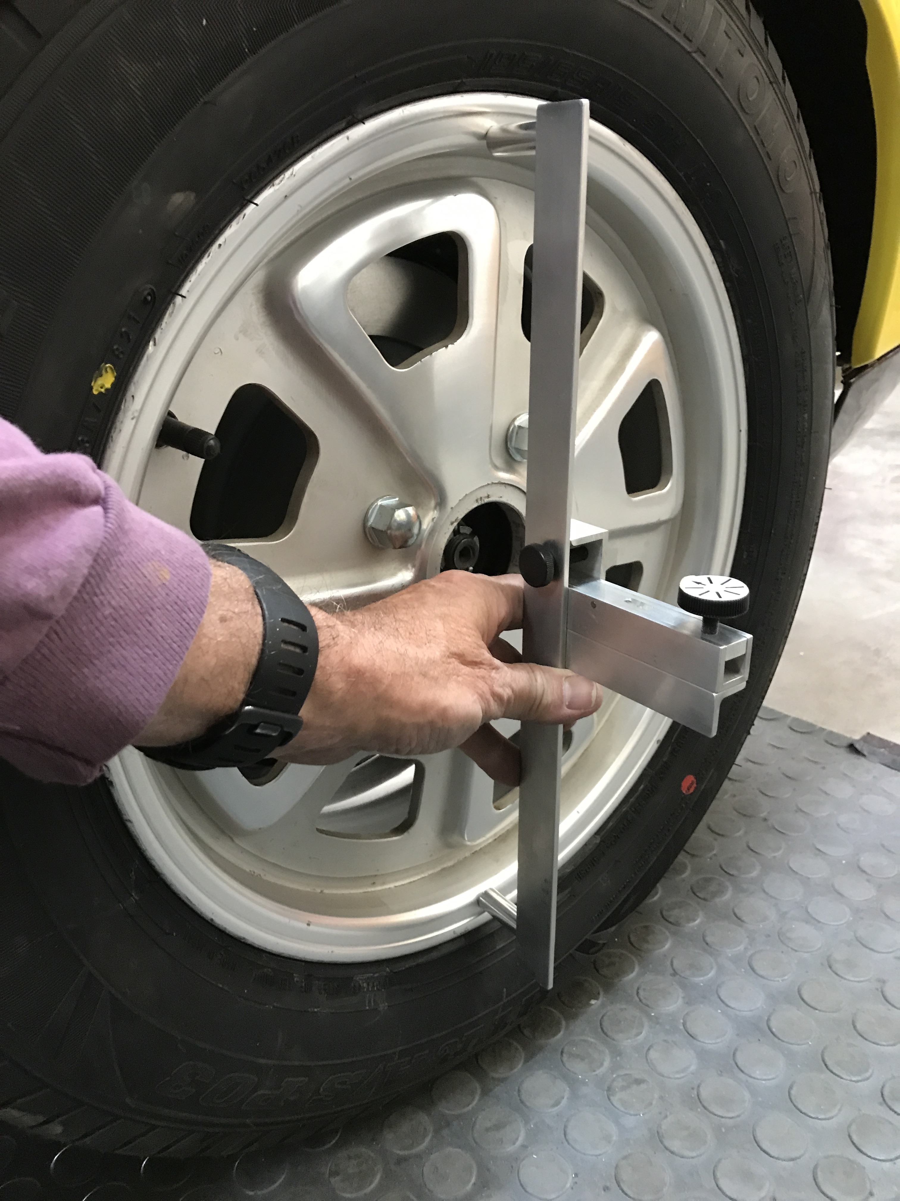

Too soon for real measurements, but I dug out my camber gauge. This dates from my racing days in the 80s and 90s, but was useful back then.
bkrantz
post May 7 2022, 08:22 PM
Post #5216
Posts: 8,530
Joined: 3-August 19
From: SW Colorado
Member No.: 23,343
Trying to remember how to use the gauge, just long enough for 15" wheels. Anyway, I got something like +0.2° camber in the front on both sides, and -0.25° and +1.25° in the rear. Of course, the camber will change as the car gets lowered, so these numbers are not quite real. But I am happy that I did not see anything like 5°!
ndfrigi
post May 7 2022, 08:55 PM
Post #5217
Posts: 2,969
Joined: 21-August 11
From: Orange County
Member No.: 13,474
I think you should roll the car back and forth so it will seat well and get the proper height.
930cabman
post May 8 2022, 06:07 AM
Post #5218
Posts: 4,325
Joined: 12-November 20
From: Buffalo
Member No.: 24,877
QUOTE(ndfrigi @ May 7 2022, 08:55 PM) *
Agreed, even better take her around the block to settle the suspension
iankarr
post May 8 2022, 06:44 AM
Post #5219
Posts: 2,578
Joined: 22-May 15
From: Heber City, UT
Member No.: 18,749

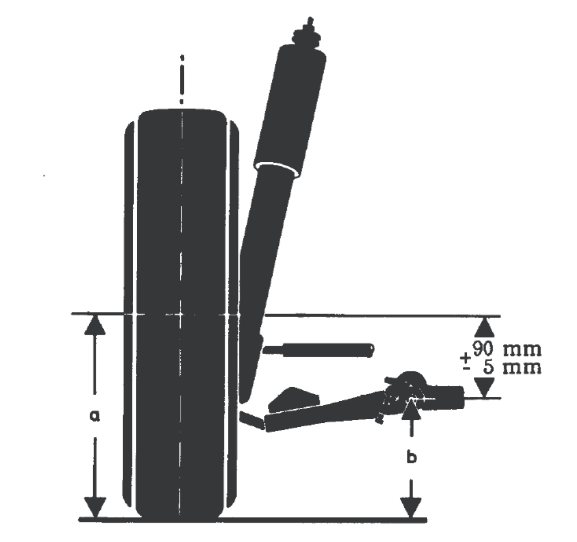

Congrats! Huge milestone. Here’s the “official” factory diagram for the front ride height in case you don’t have it. Keep in mind that this is for stock tires…and rumors are that the DOT mandated a slightly higher rake in front to optimize bumper positioning. I think having the front about an inch lower still looks stock and handles great…but I’m sure the suspension safety gurus will chime in. Small changes in the adjuster have a bigger effect than you might expect. But as others have said, the car needs to bounce/settle between every adjustment to really see the difference.
Again…super impressive work and thanks so much for detailing every step so well. This thread will be useful forever.
