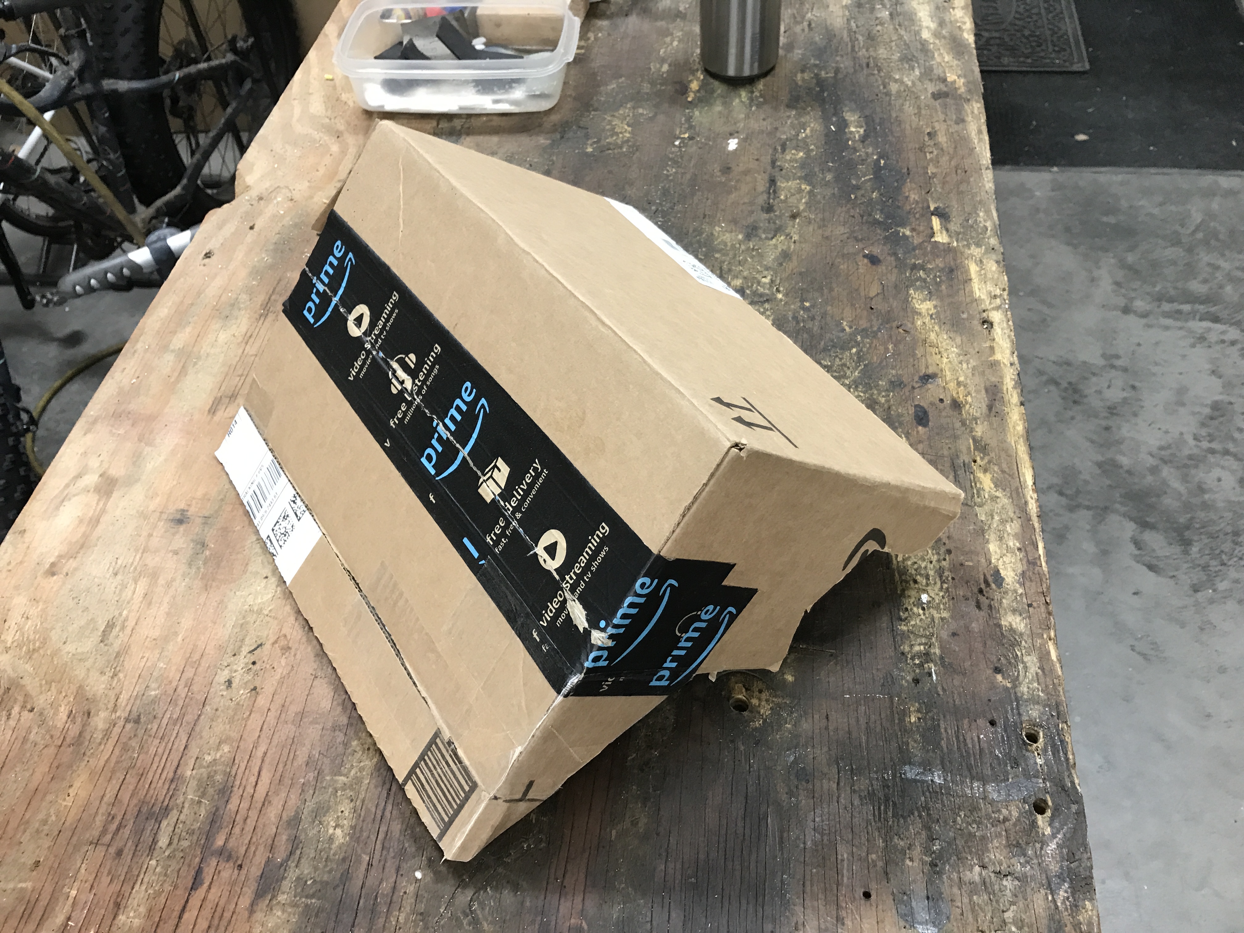

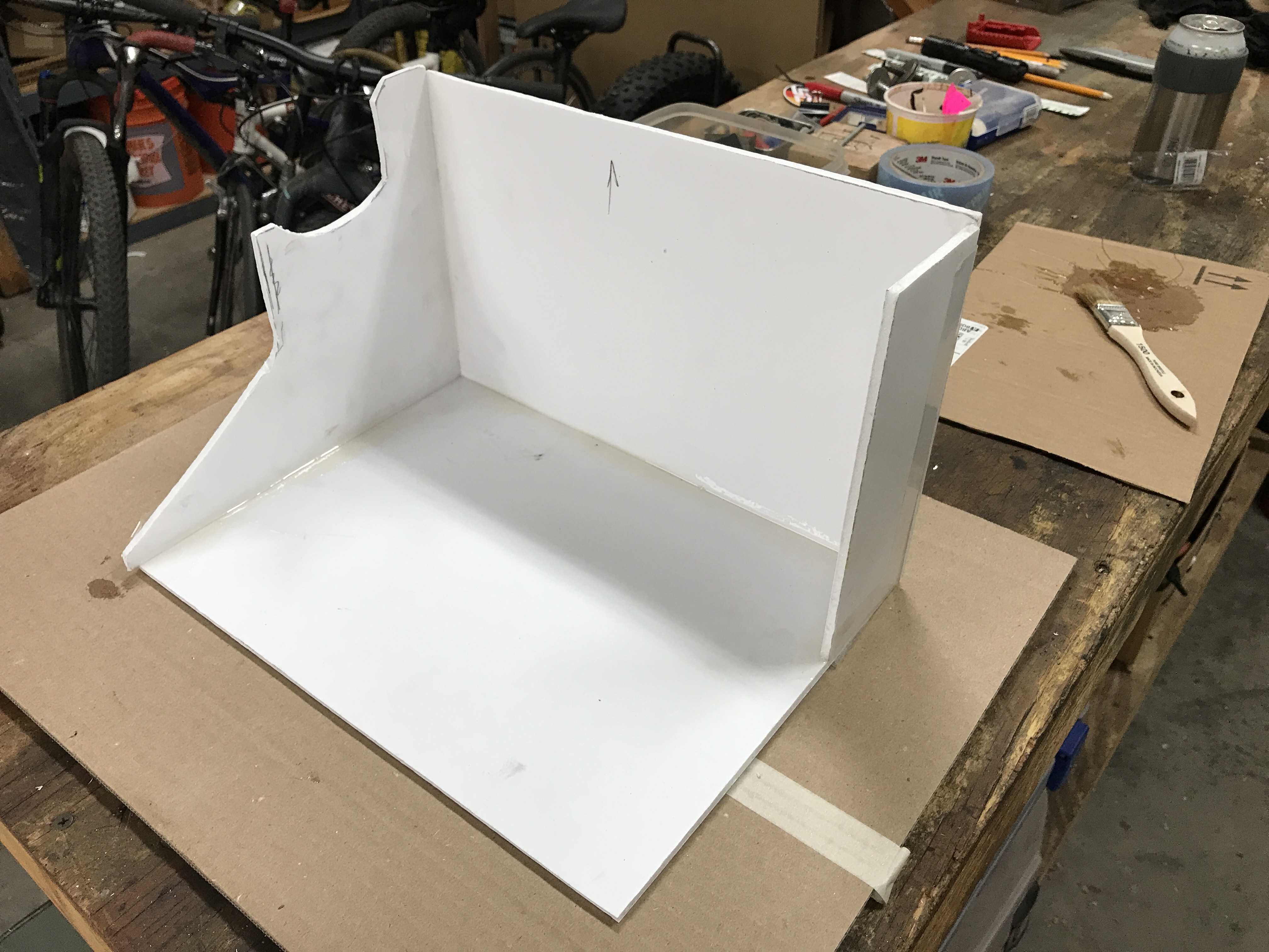

My mockup still seems like a good idea, so I want to reproduce this with better material.

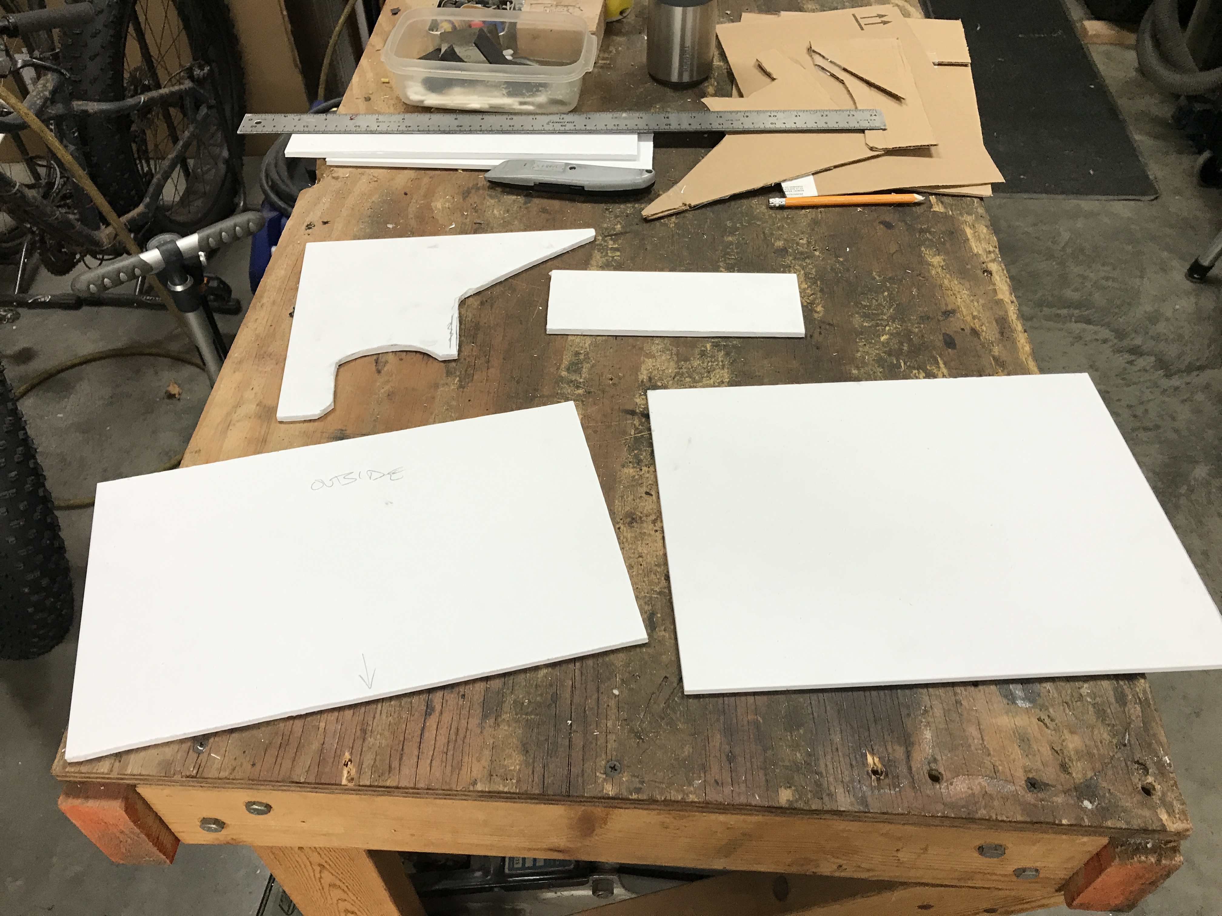

Member No.: 23,343

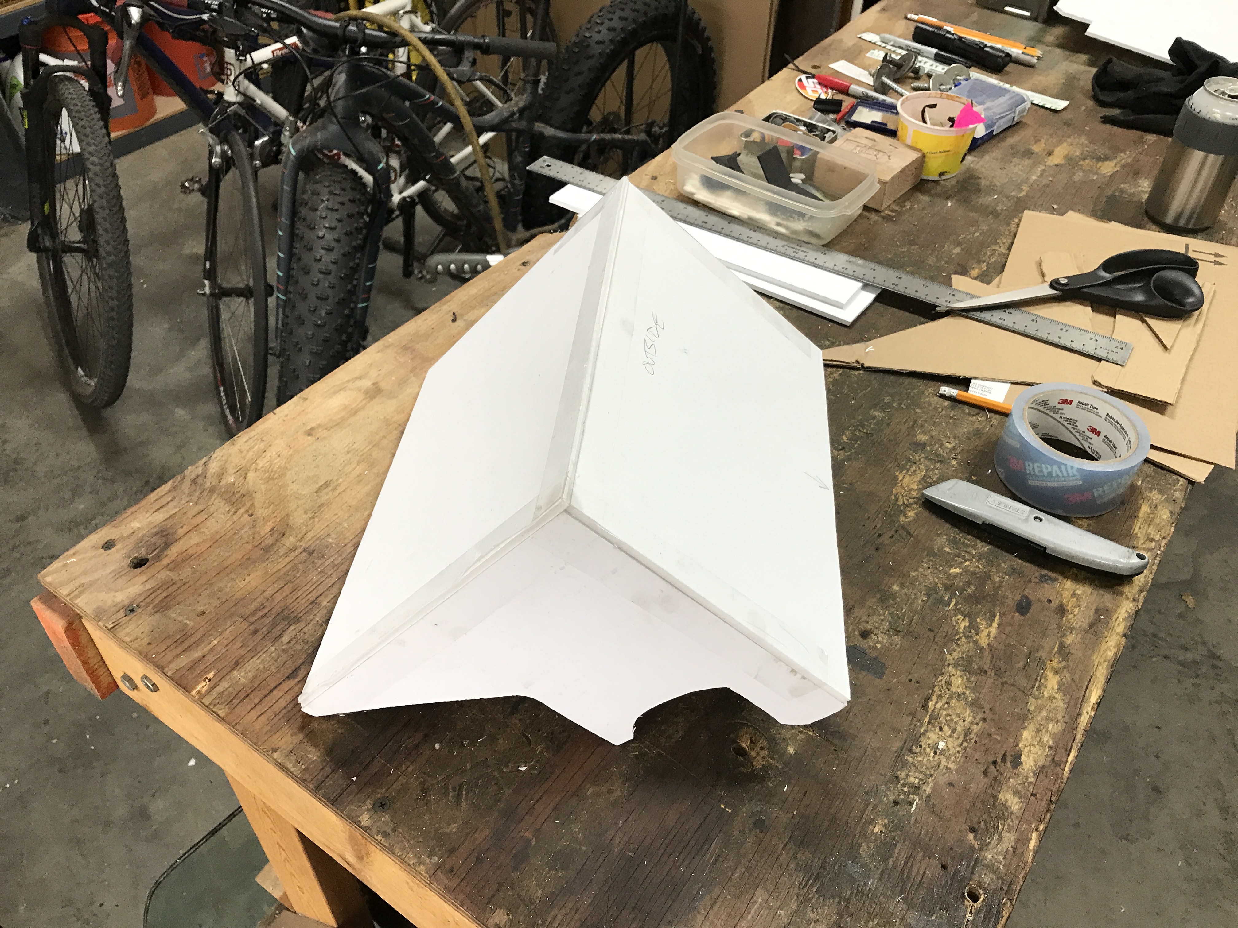

Cut down into separate panels.

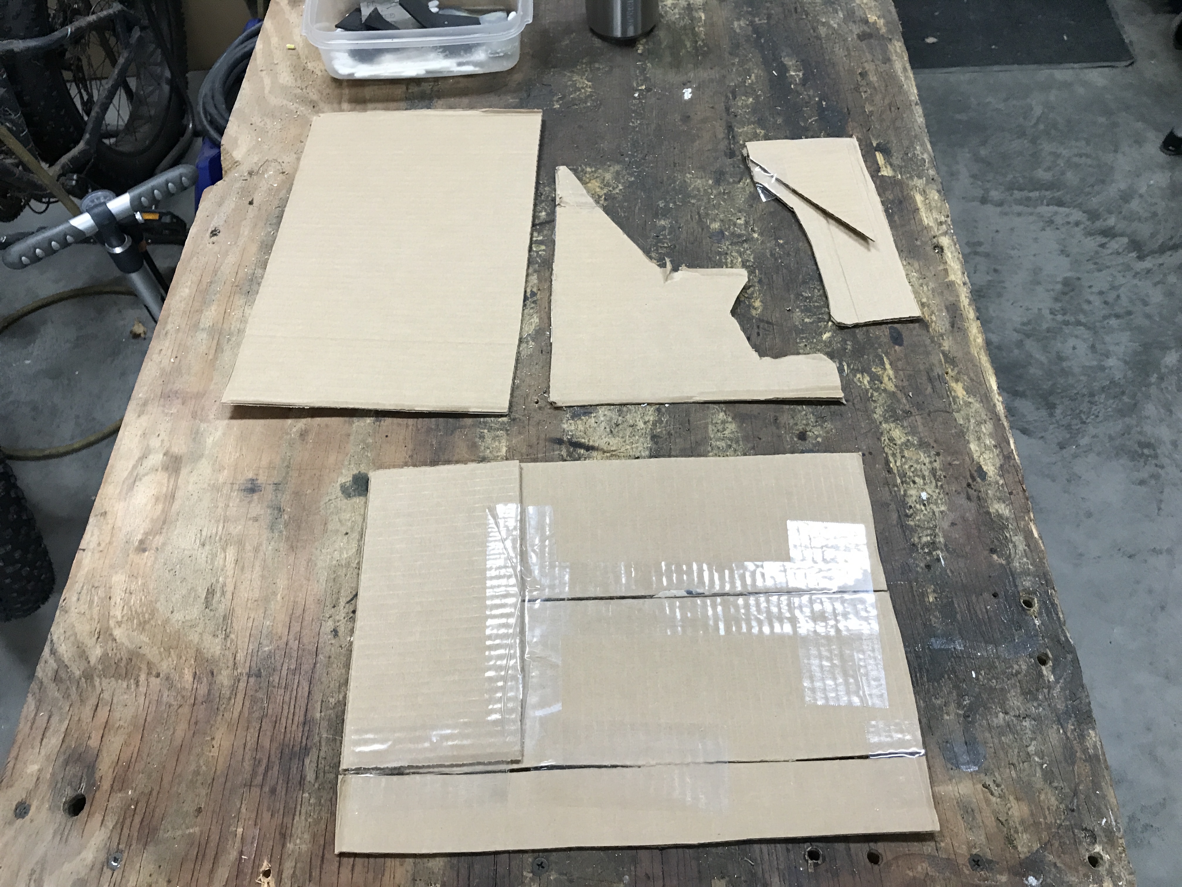

bkrantz
post May 29 2022, 07:49 PM
Post #5343
Posts: 8,530
Joined: 3-August 19
From: SW Colorado

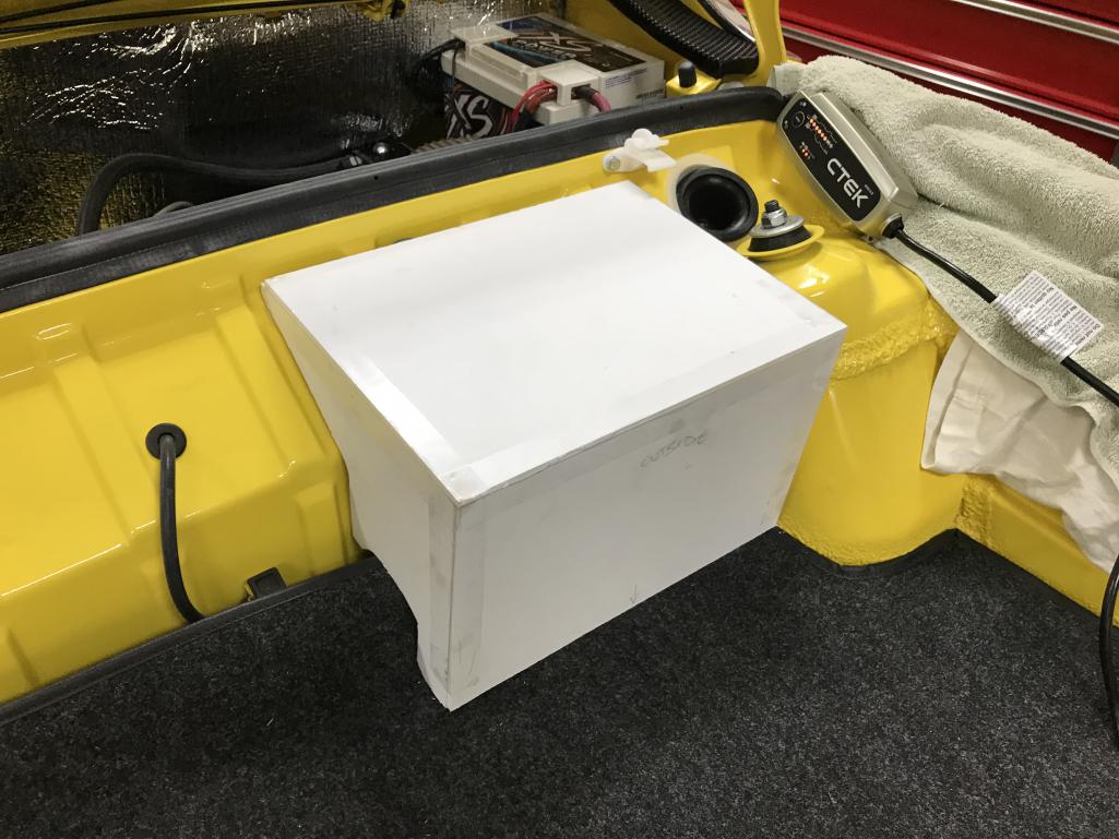

Member No.: 23,343
And then duplicated with gator board.
bkrantz
post May 29 2022, 07:50 PM
Post #5344
Posts: 8,530
Joined: 3-August 19
From: SW Colorado
Member No.: 23,343
I tried some 3M repair tape for initial assembly.
bkrantz
post May 29 2022, 07:51 PM
Post #5345
Posts: 8,530
Joined: 3-August 19
From: SW Colorado
Member No.: 23,343
Looks like a cover.
bkrantz
post May 29 2022, 07:52 PM
Post #5346
Posts: 8,530
Joined: 3-August 19
From: SW Colorado
Member No.: 23,343
And fits like a cover. I will trim to adjust the fit once the assembly is solid.

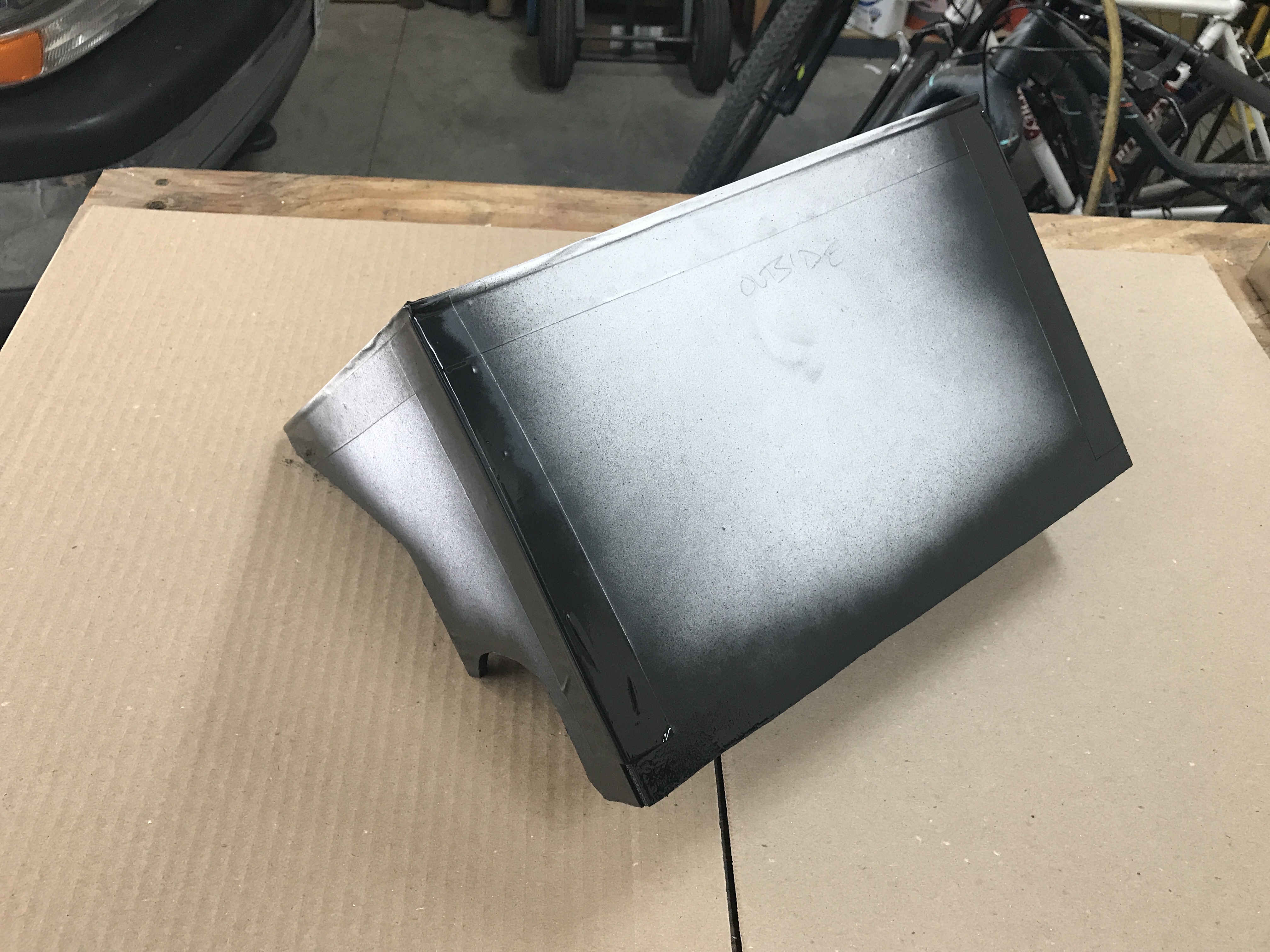

bkrantz
post May 30 2022, 07:55 PM
Post #5350
Posts: 8,530
Joined: 3-August 19
From: SW Colorado
Member No.: 23,343
Some flat black paint along the edges.

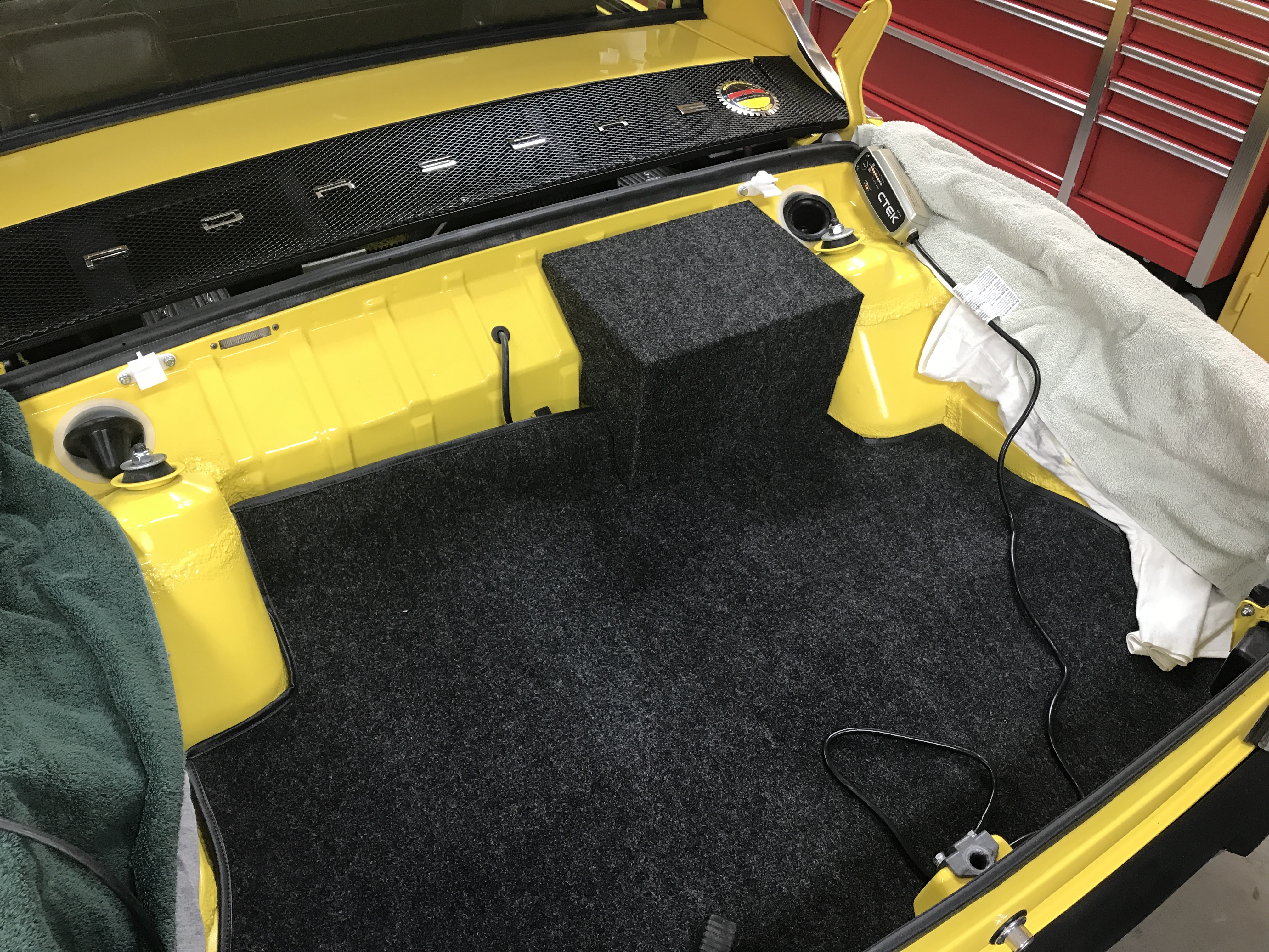

Member No.: 23,343

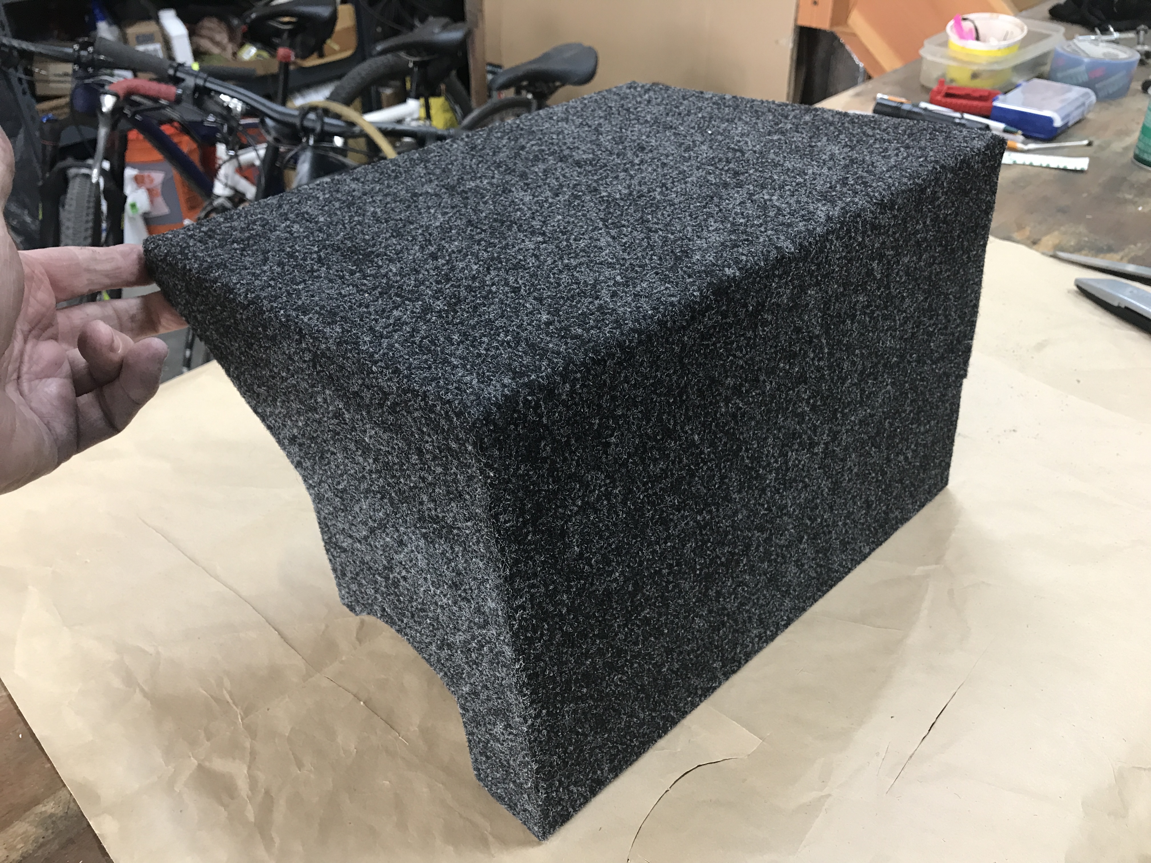

And then some more perlon material.

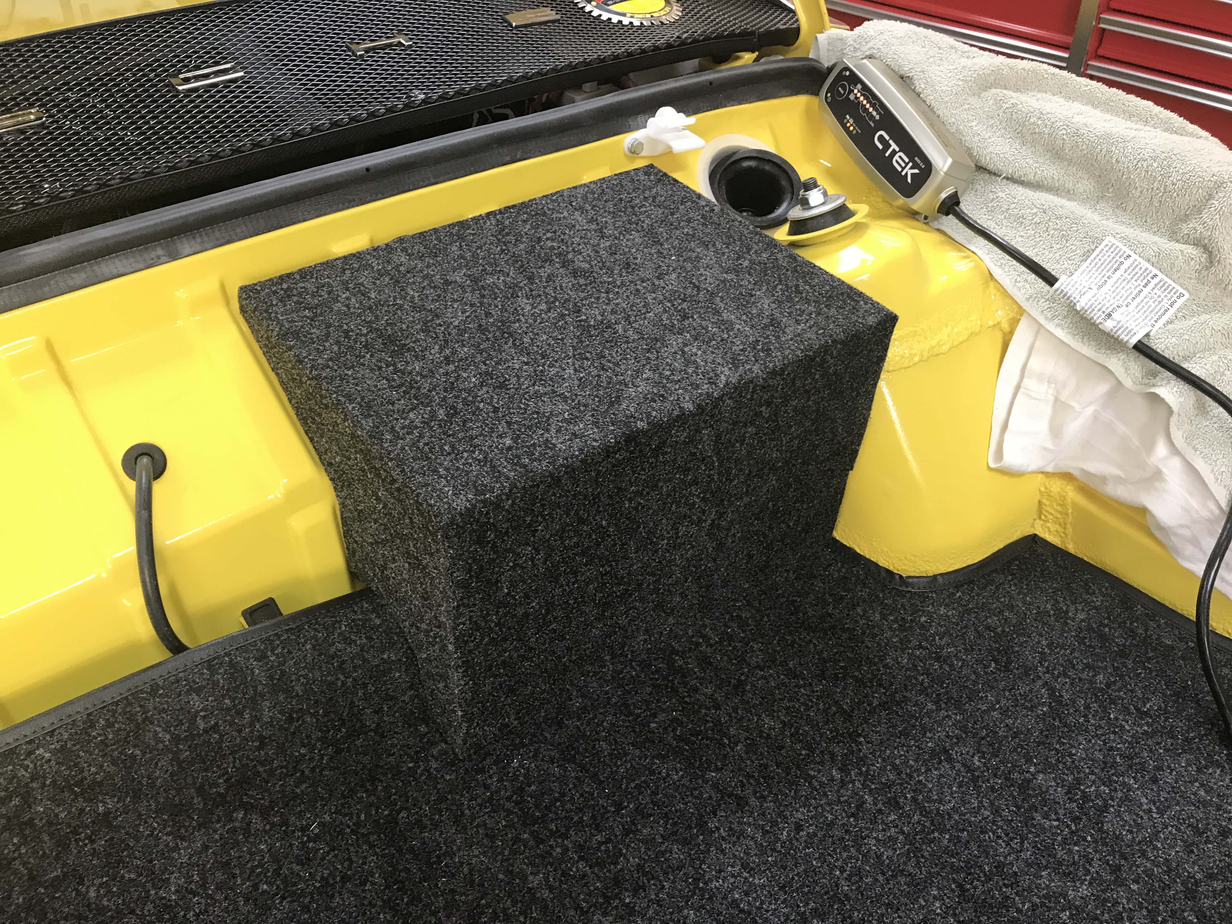

bkrantz
post May 30 2022, 07:58 PM
Post #5352
Posts: 8,530
Joined: 3-August 19
From: SW Colorado

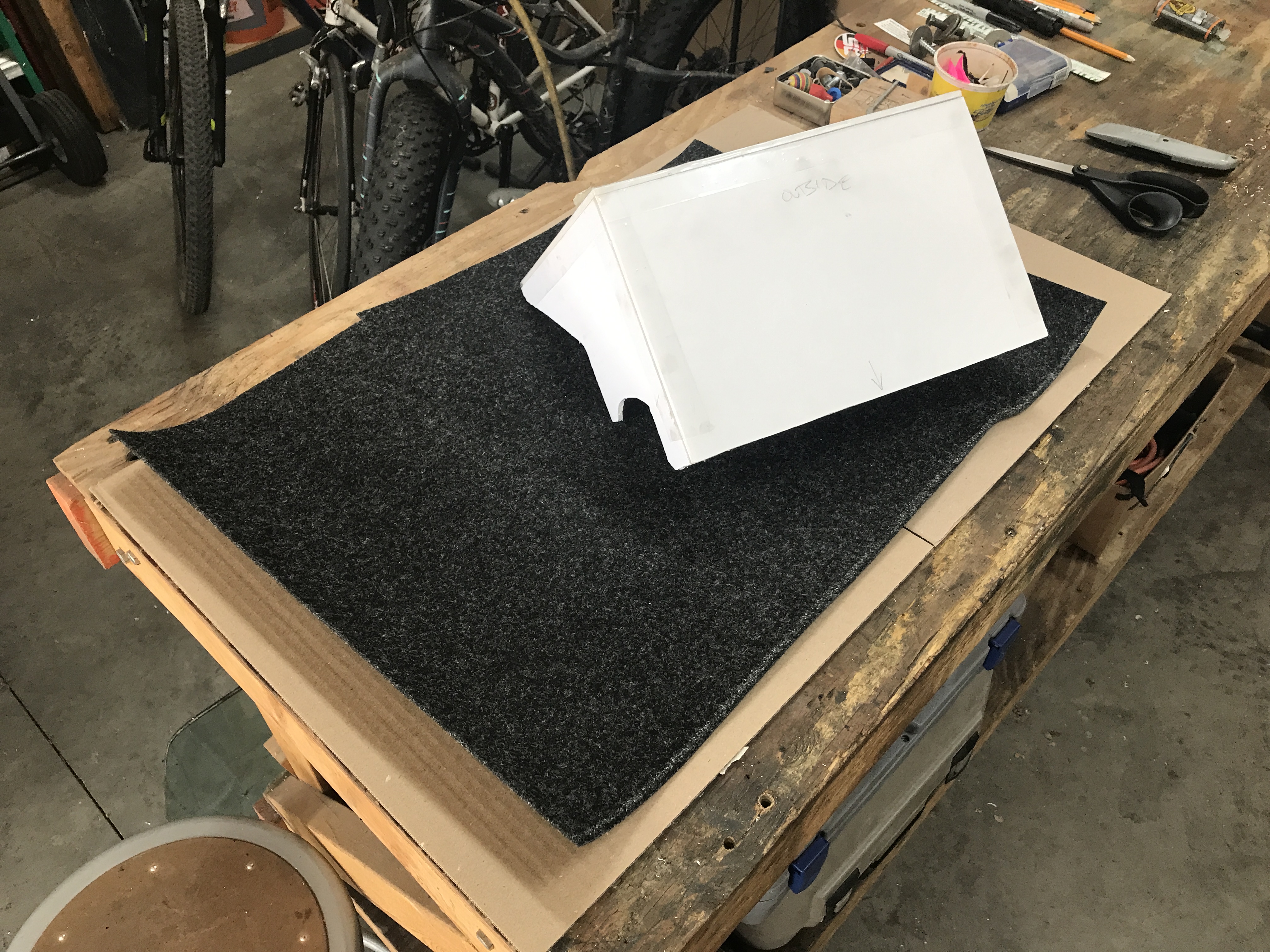

Member No.: 23,343
Perlon glued on with 3M spray, folded over top surface corners and butted along vertical corners.
bkrantz
post May 30 2022, 08:01 PM
Post #5353
Posts: 8,530
Joined: 3-August 19
From: SW Colorado
Member No.: 23,343
Looks pretty good.

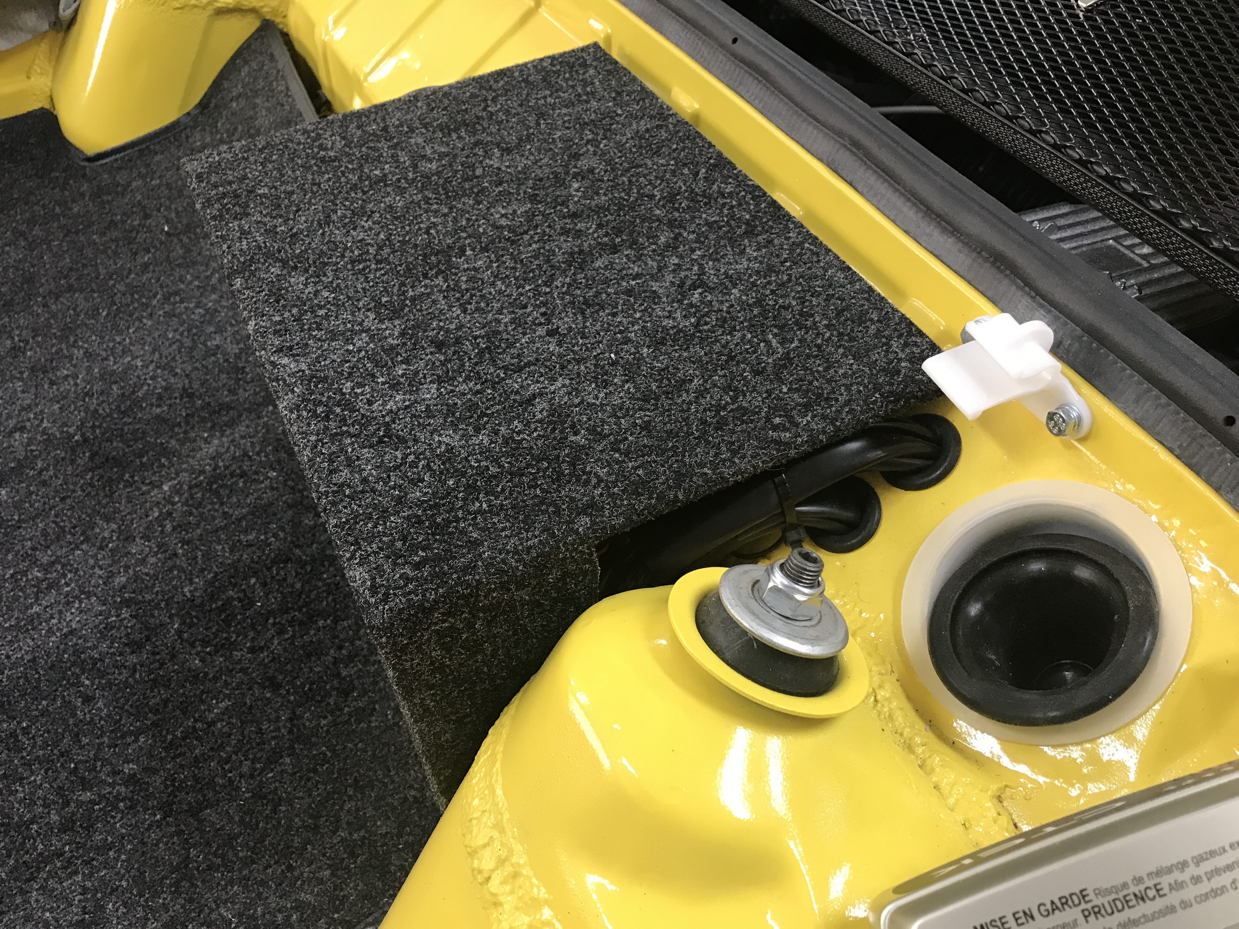

bkrantz
post May 30 2022, 08:02 PM
Post #5354
Posts: 8,530
Joined: 3-August 19
From: SW Colorado
Member No.: 23,343
Right side.
bkrantz
post May 30 2022, 08:07 PM
Post #5355
Posts: 8,530
Joined: 3-August 19
From: SW Colorado

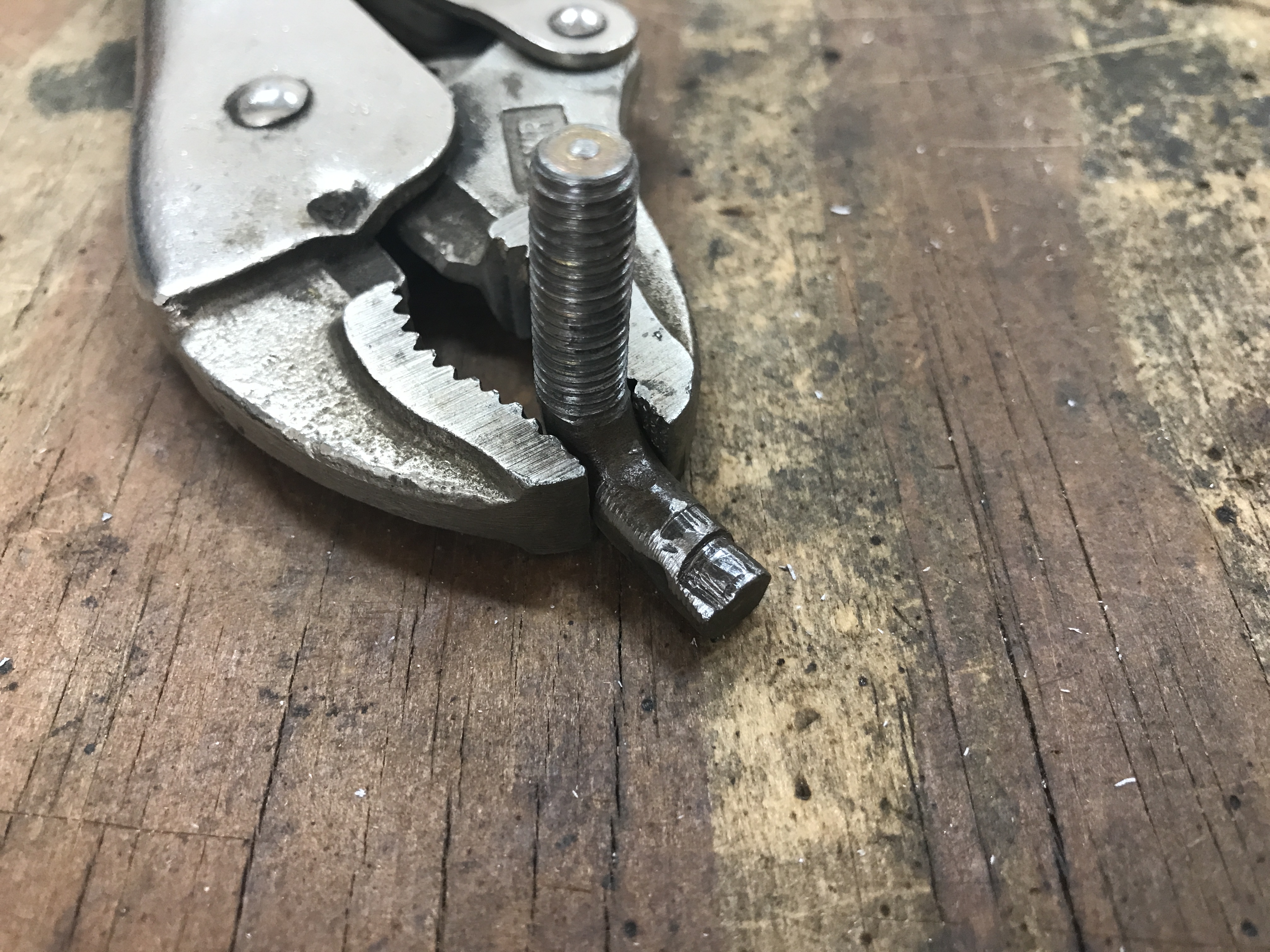

Member No.: 23,343
That reminded me of another little task. The engine lid latch has a lot of play. The latch hook end is very warn. Some of this might be the stock notch, but the diameter is much less.

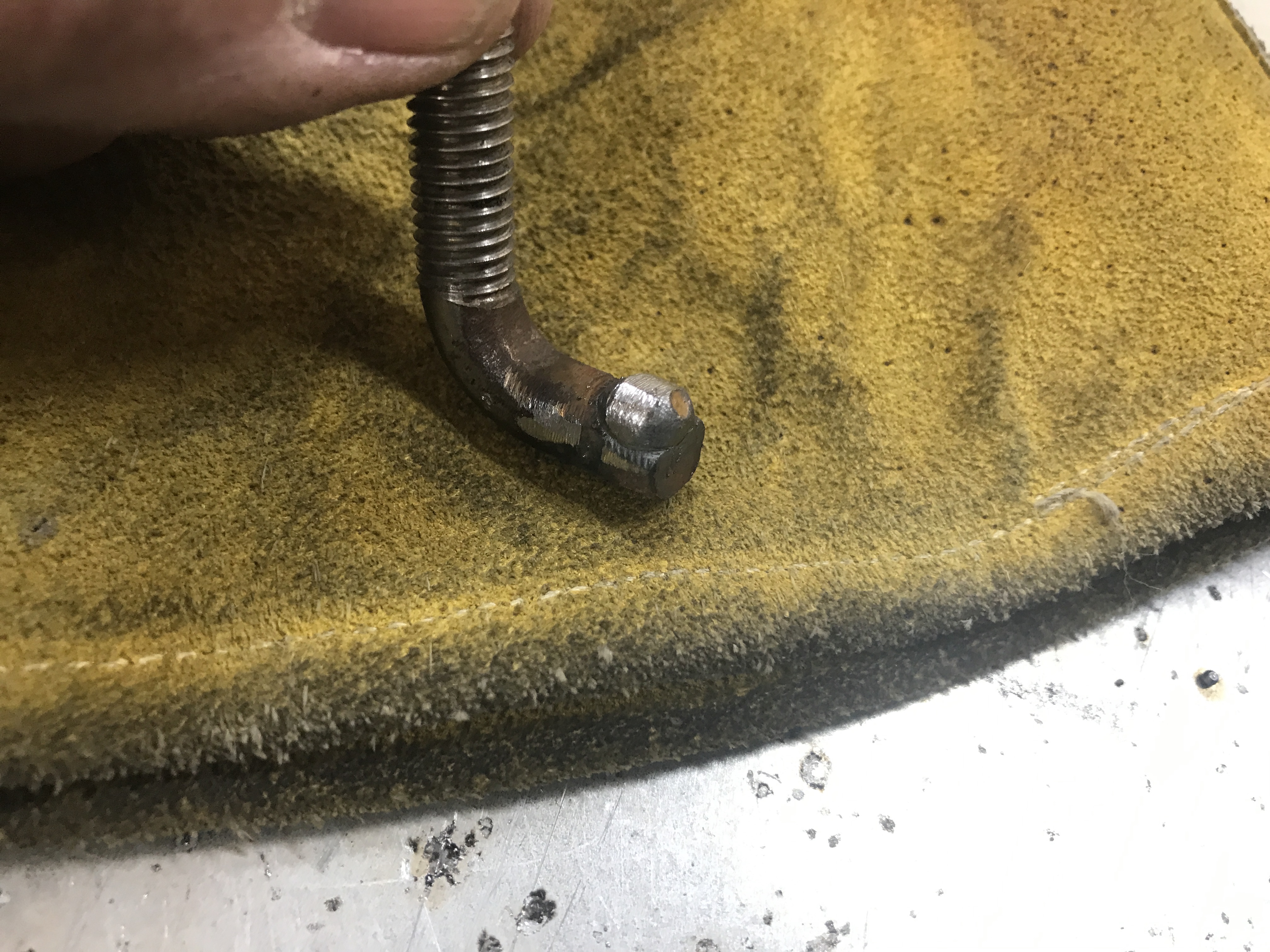

bkrantz
post May 30 2022, 08:08 PM
Post #5356
Posts: 8,530
Joined: 3-August 19
From: SW Colorado
Member No.: 23,343
A welding bead and some hand filing, and the end of the hook is fatter.
bkrantz

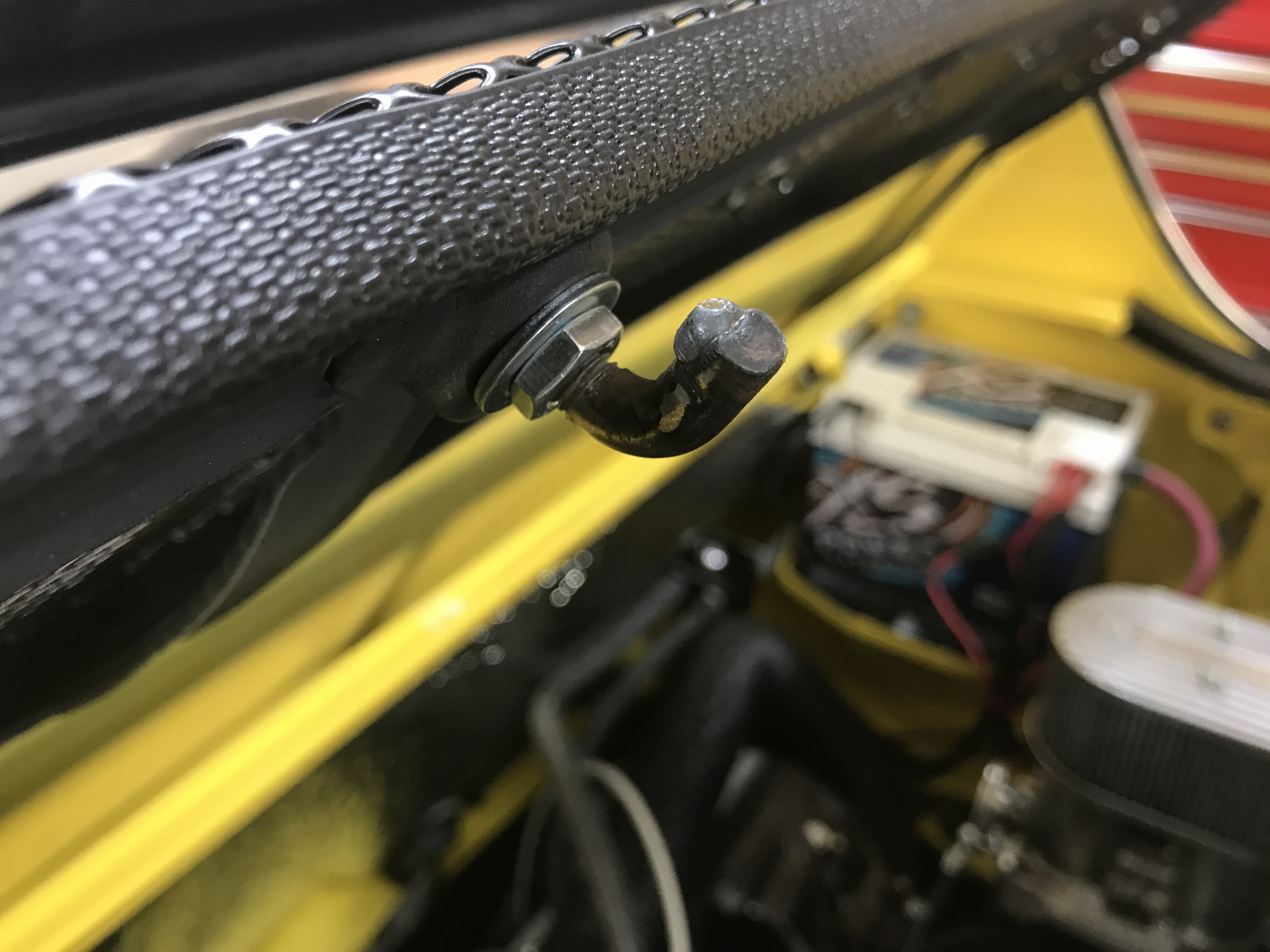

post May 30 2022, 08:09 PM
Post #5357
Posts: 8,530
Joined: 3-August 19
From: SW Colorado
Member No.: 23,343
Installed.
bkrantz
post May 30 2022, 08:10 PM
Post #5358
Posts: 8,530
Joined: 3-August 19
From: SW Colorado
Member No.: 23,343
The engine lid now closes without play.

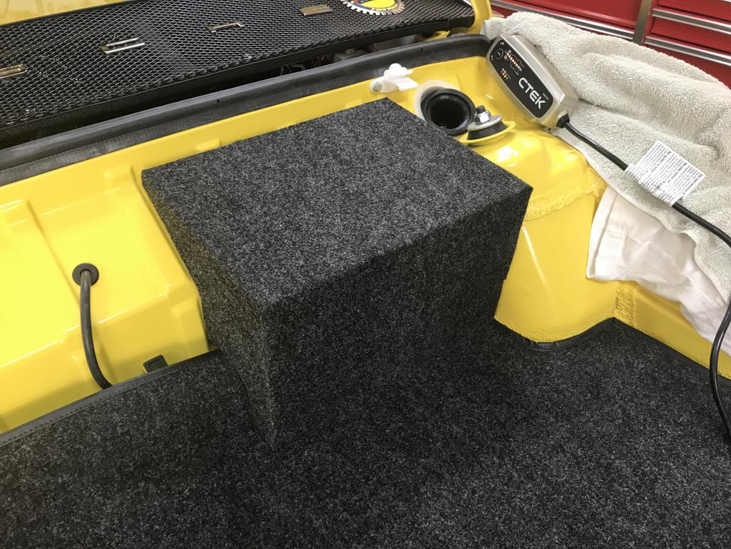

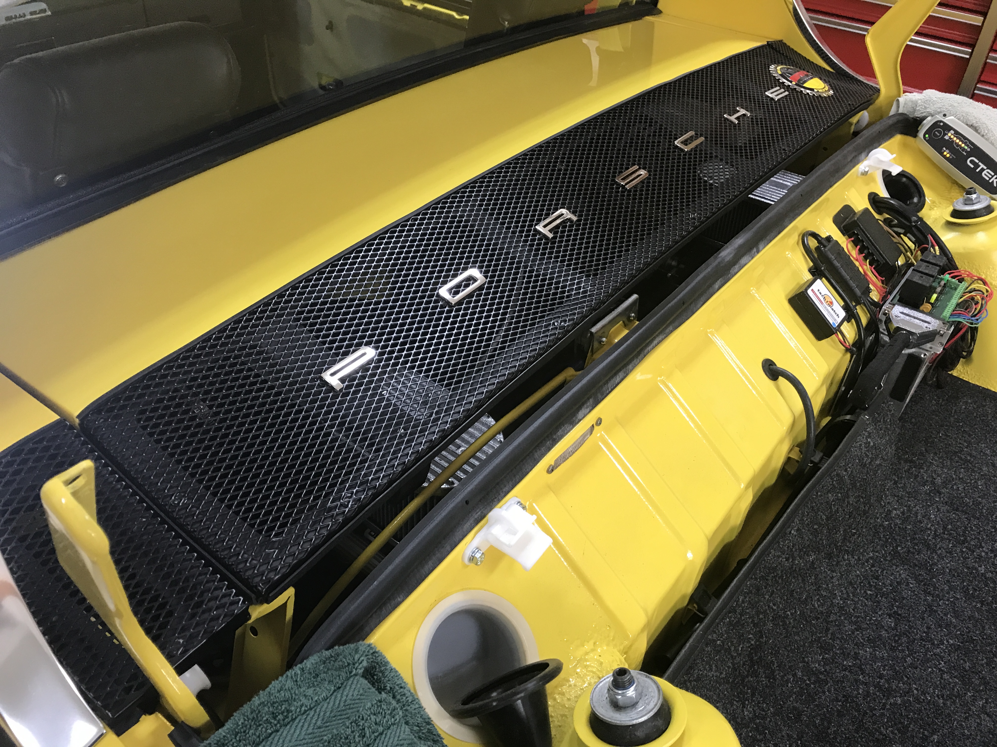

bkrantz
post May 30 2022, 08:13 PM
Post #5359
Posts: 8,530
Joined: 3-August 19
From: SW Colorado
Member No.: 23,343
Rear is looking tidy--ready for the trunk lid.
