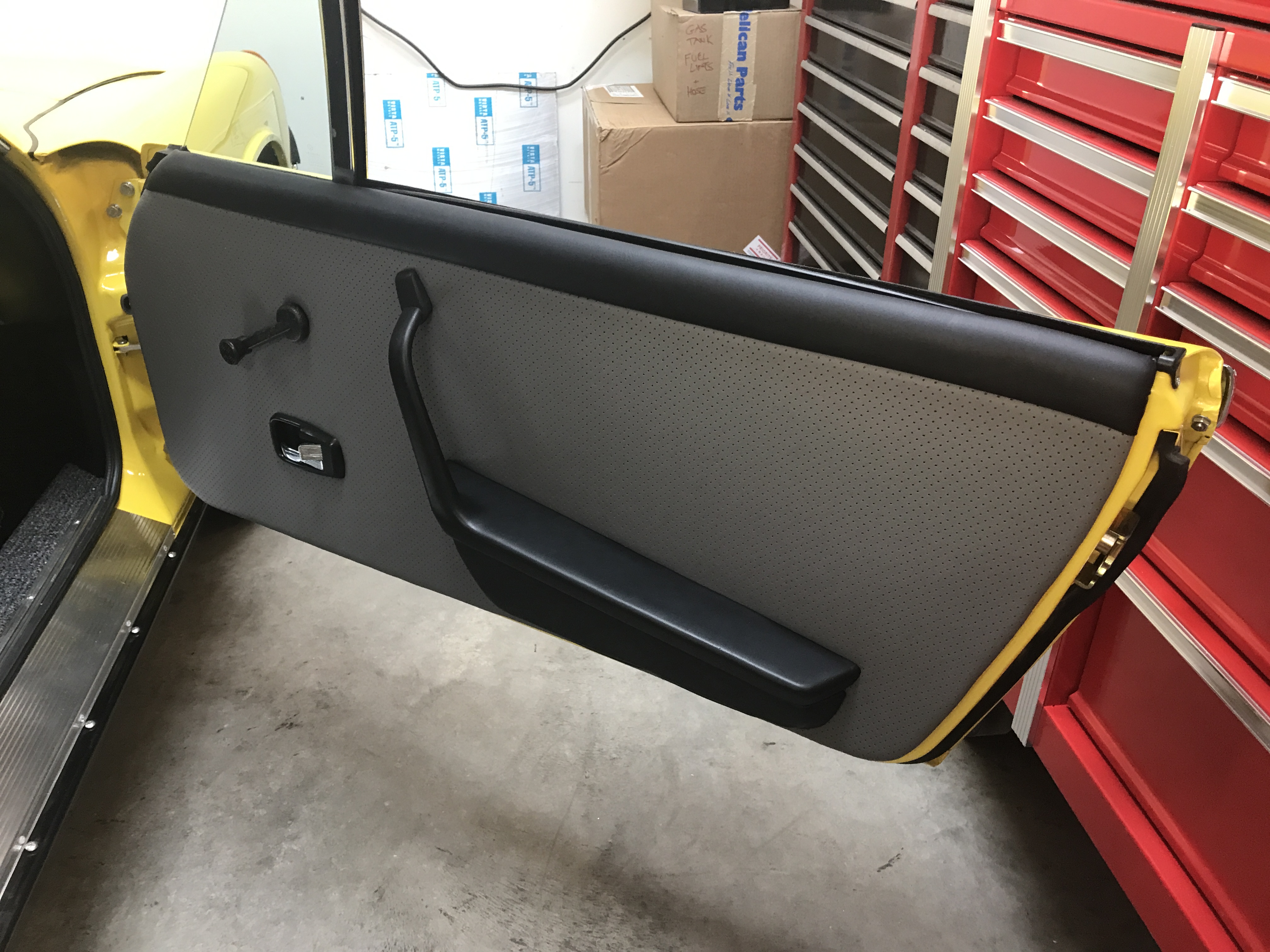

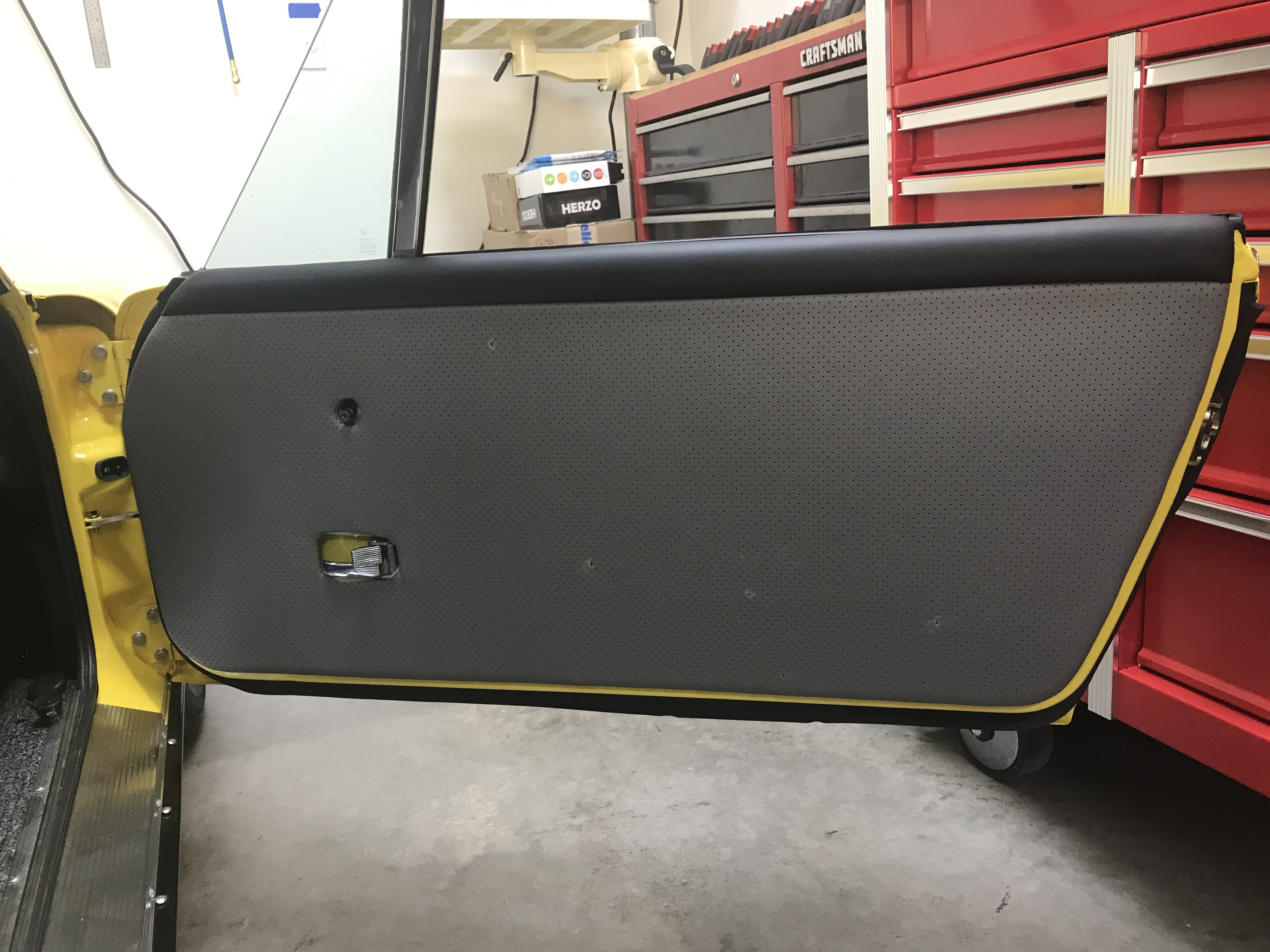

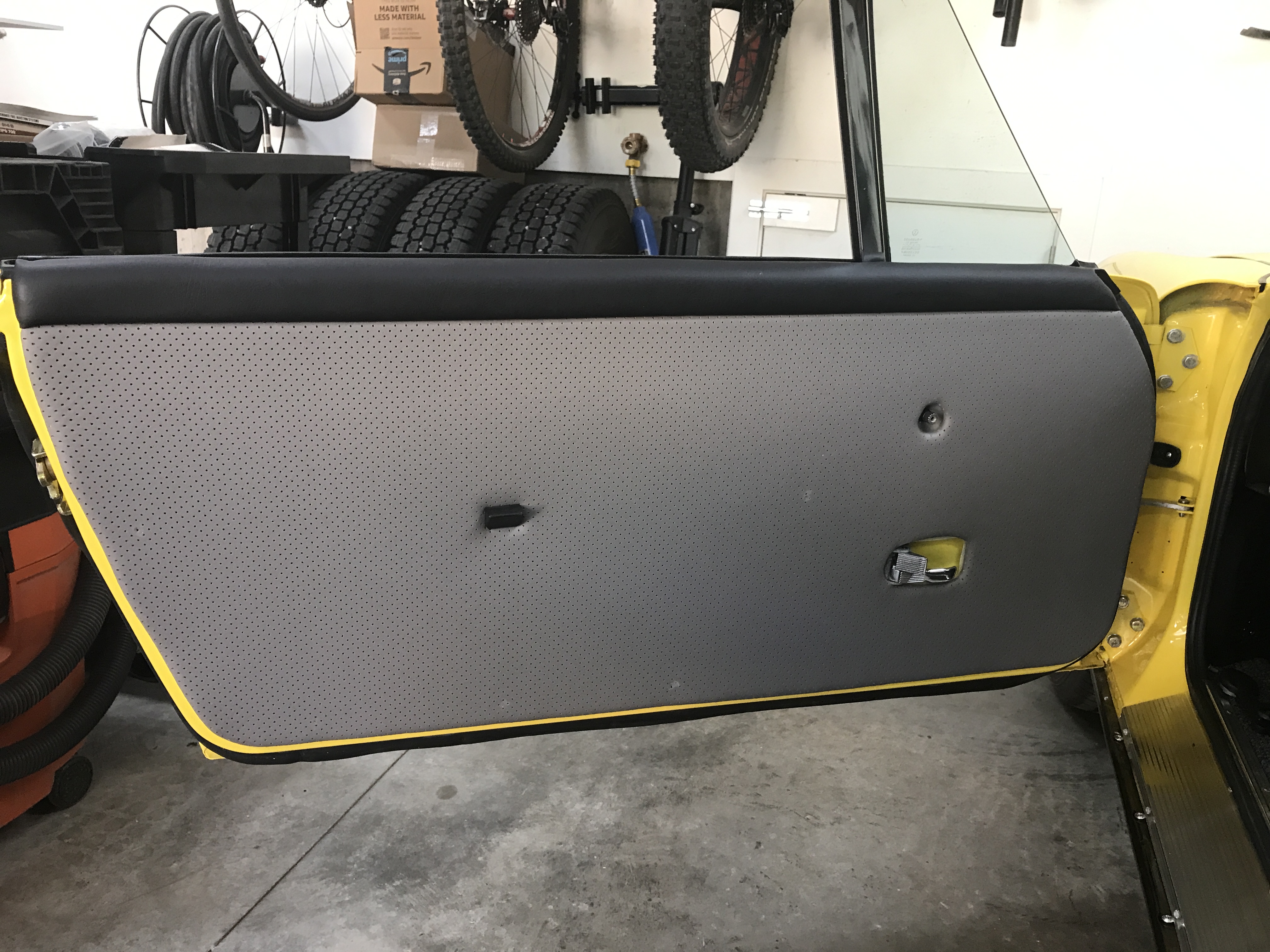

Door card installed. One of the retaining clips along the top edge was a bit fussy.

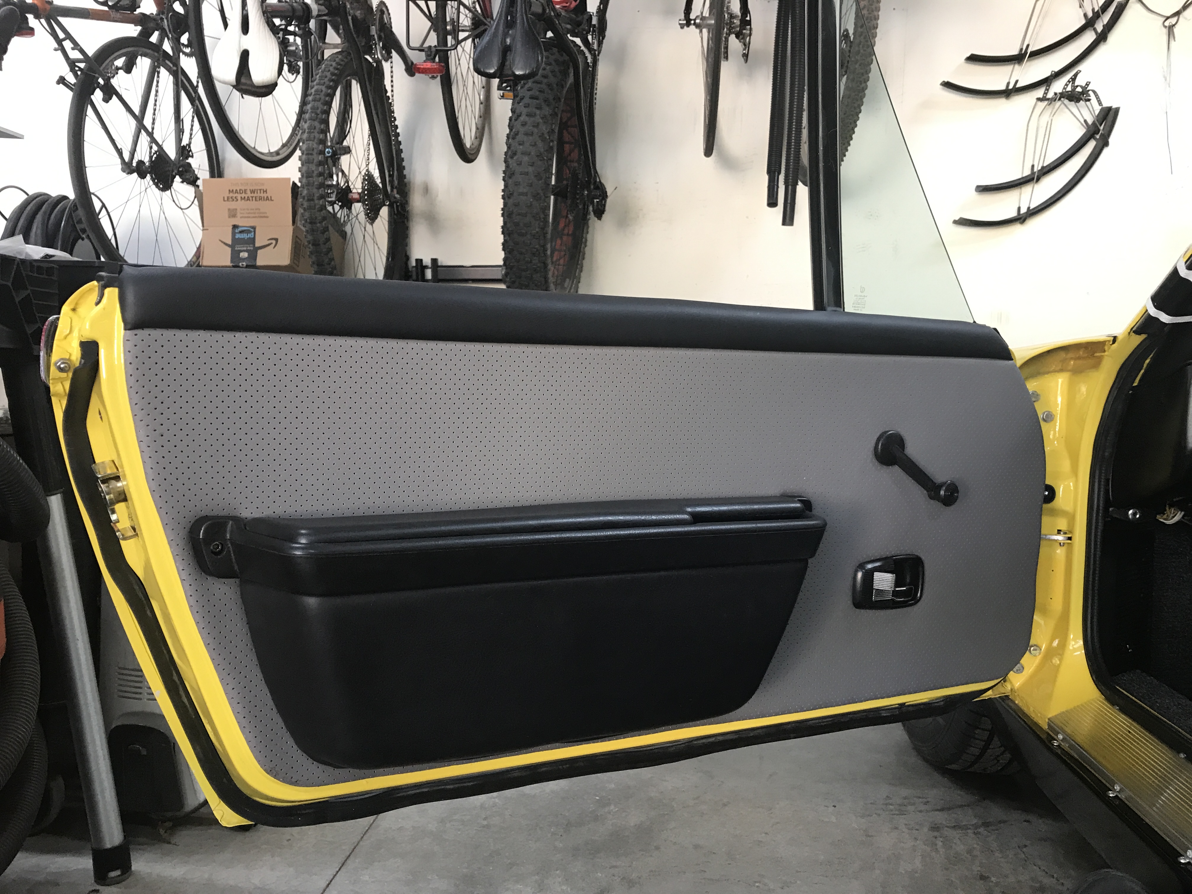

And then fully dressed with handle-arm rest and trim.

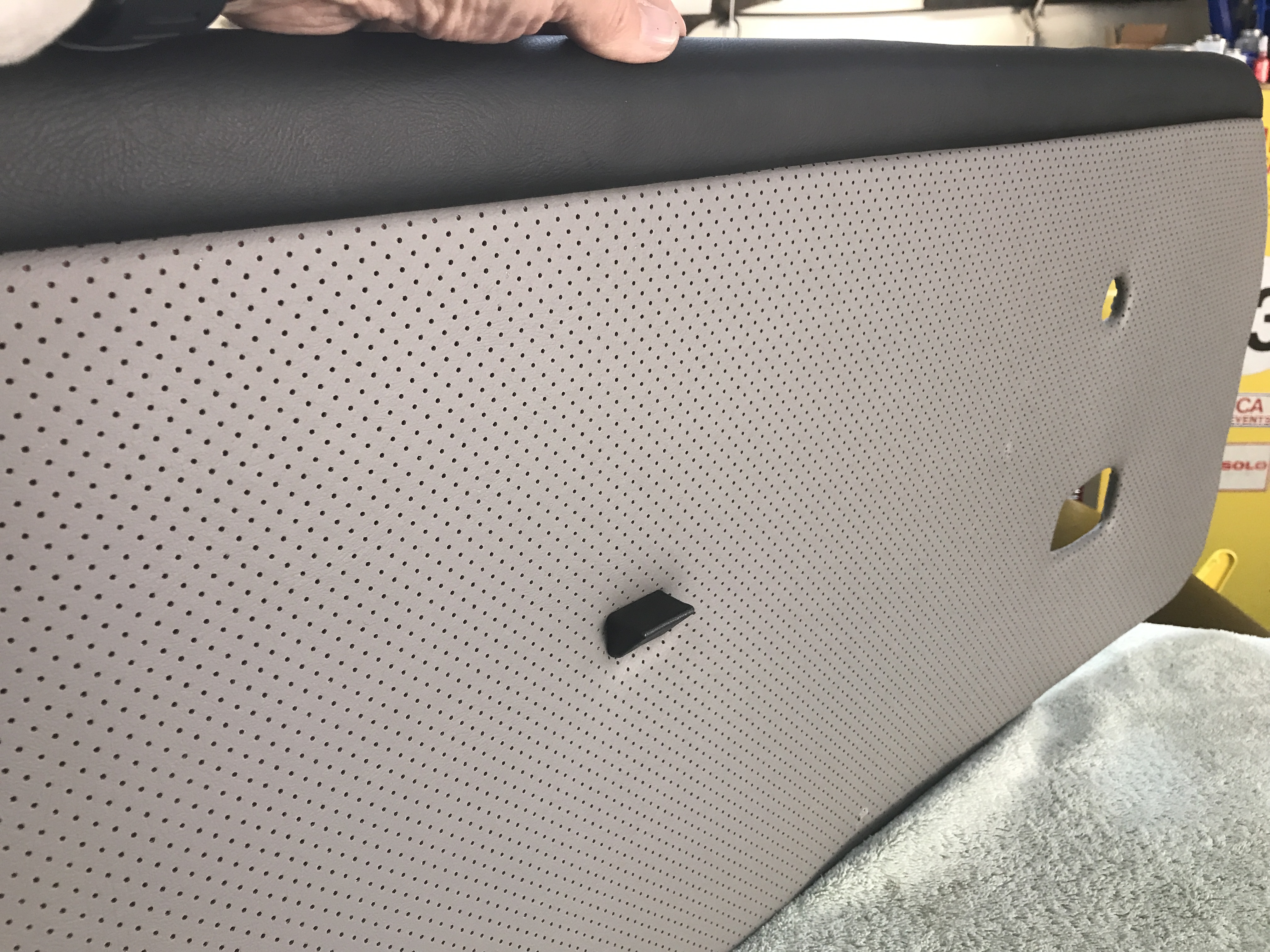

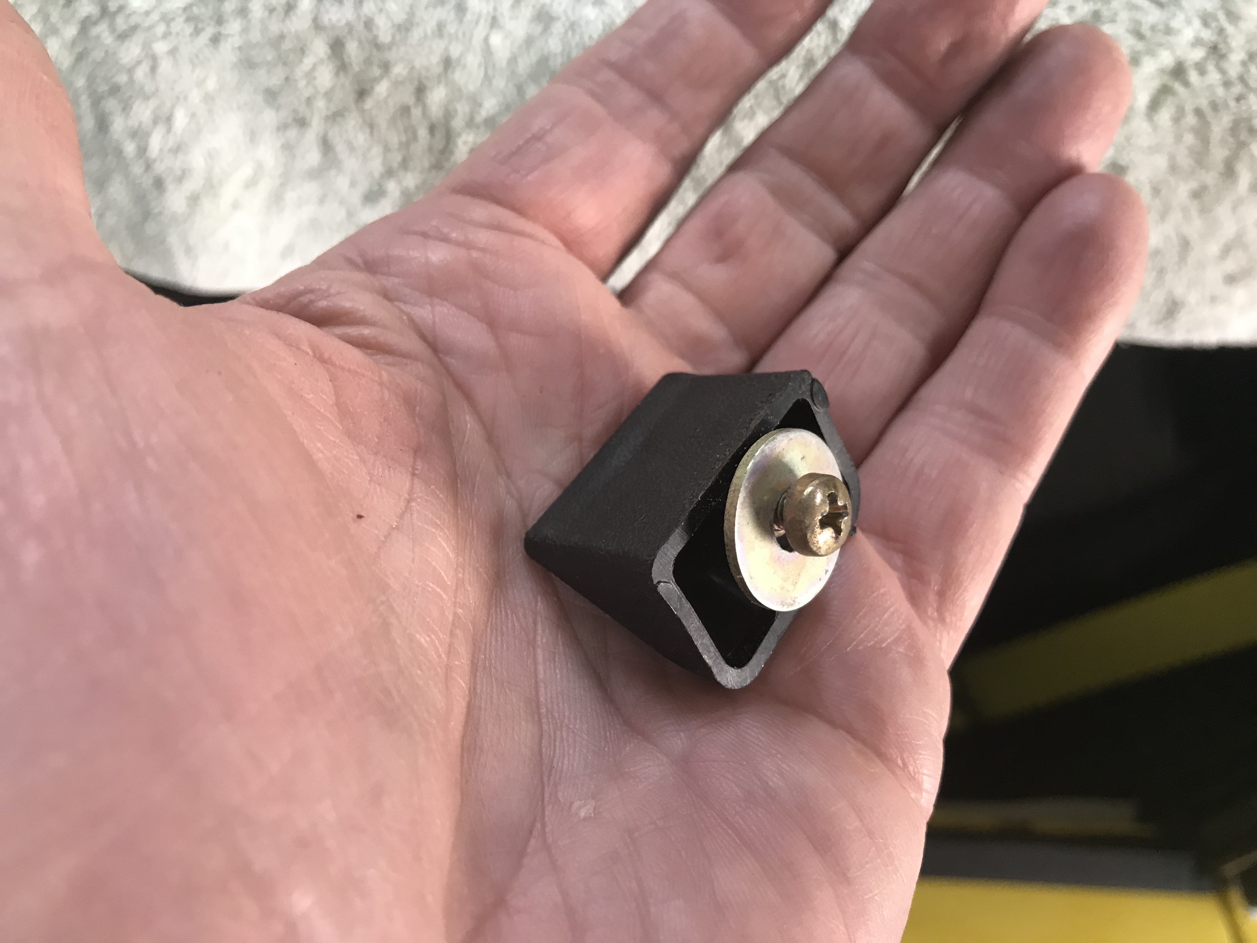

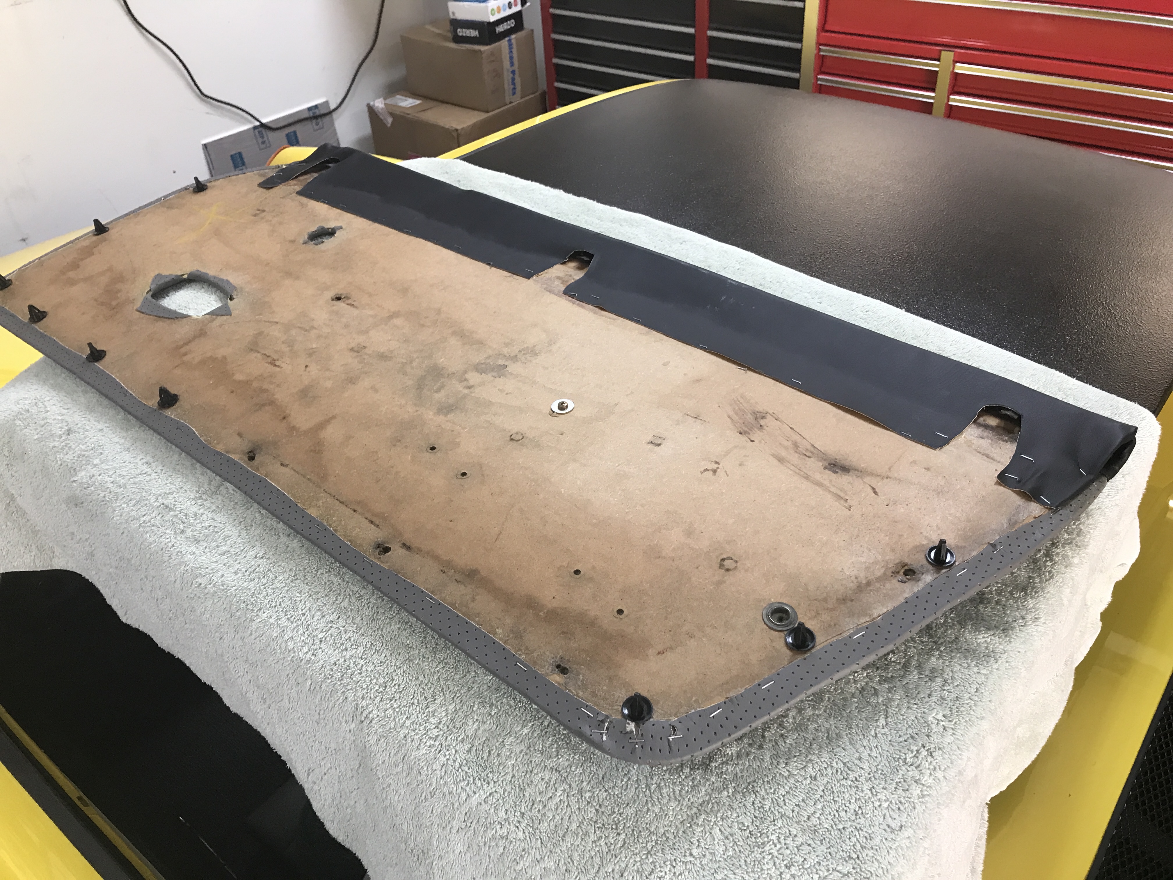

On the left side, I remembered this: the little support for the middle of the door pocket lid.
bkrantz
post Jun 1 2022, 08:19 PM
Post #5384
Posts: 8,530
Joined: 3-August 19
From: SW Colorado
Member No.: 23,343

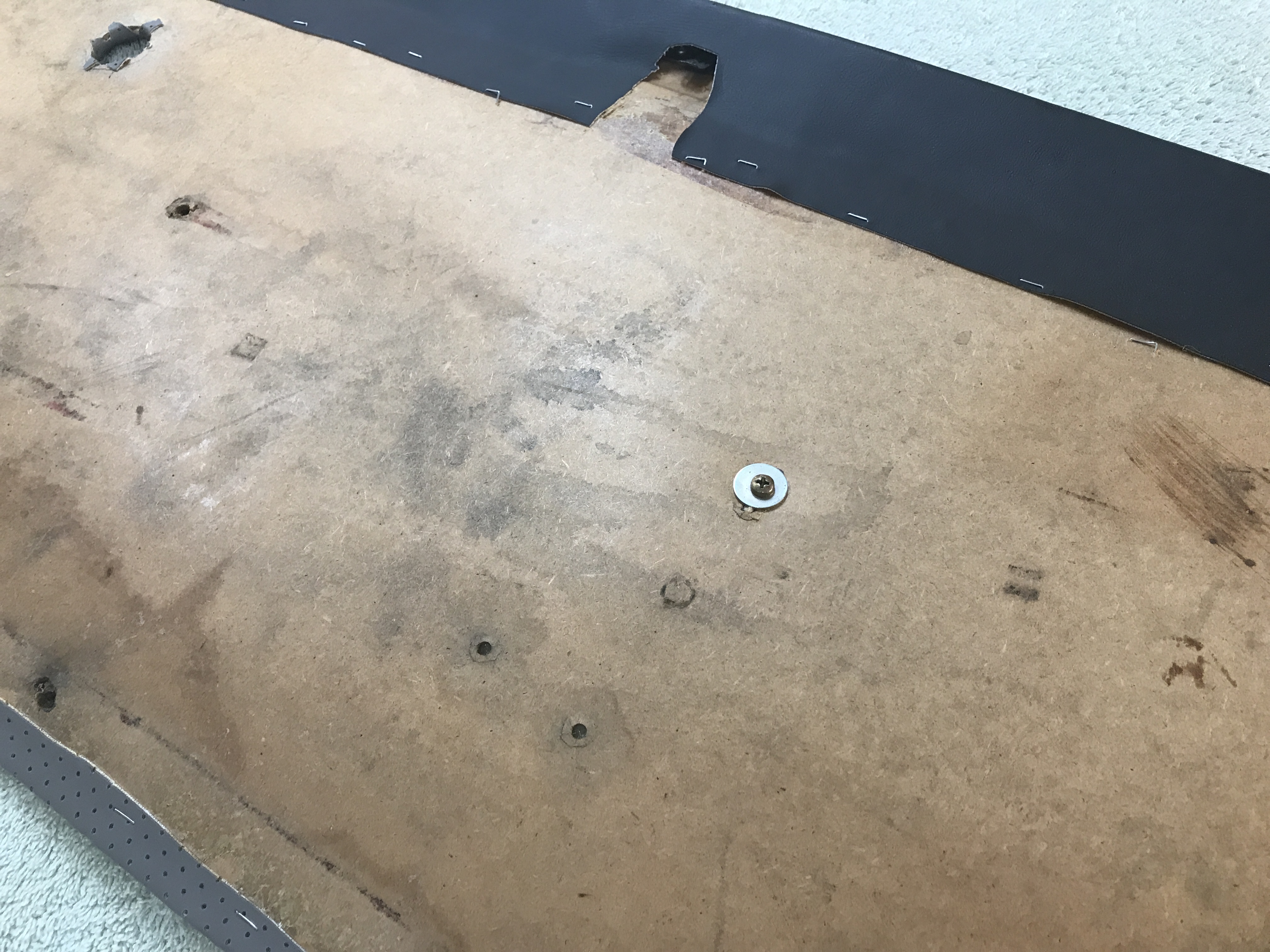

This gets screwed on from the back of the door card, so must be attached before mounting the card.

Thin new pins in the door card.

bkrantz
post Jun 1 2022, 08:22 PM
Post #5388
Posts: 8,530
Joined: 3-August 19
From: SW Colorado
Member No.: 23,343

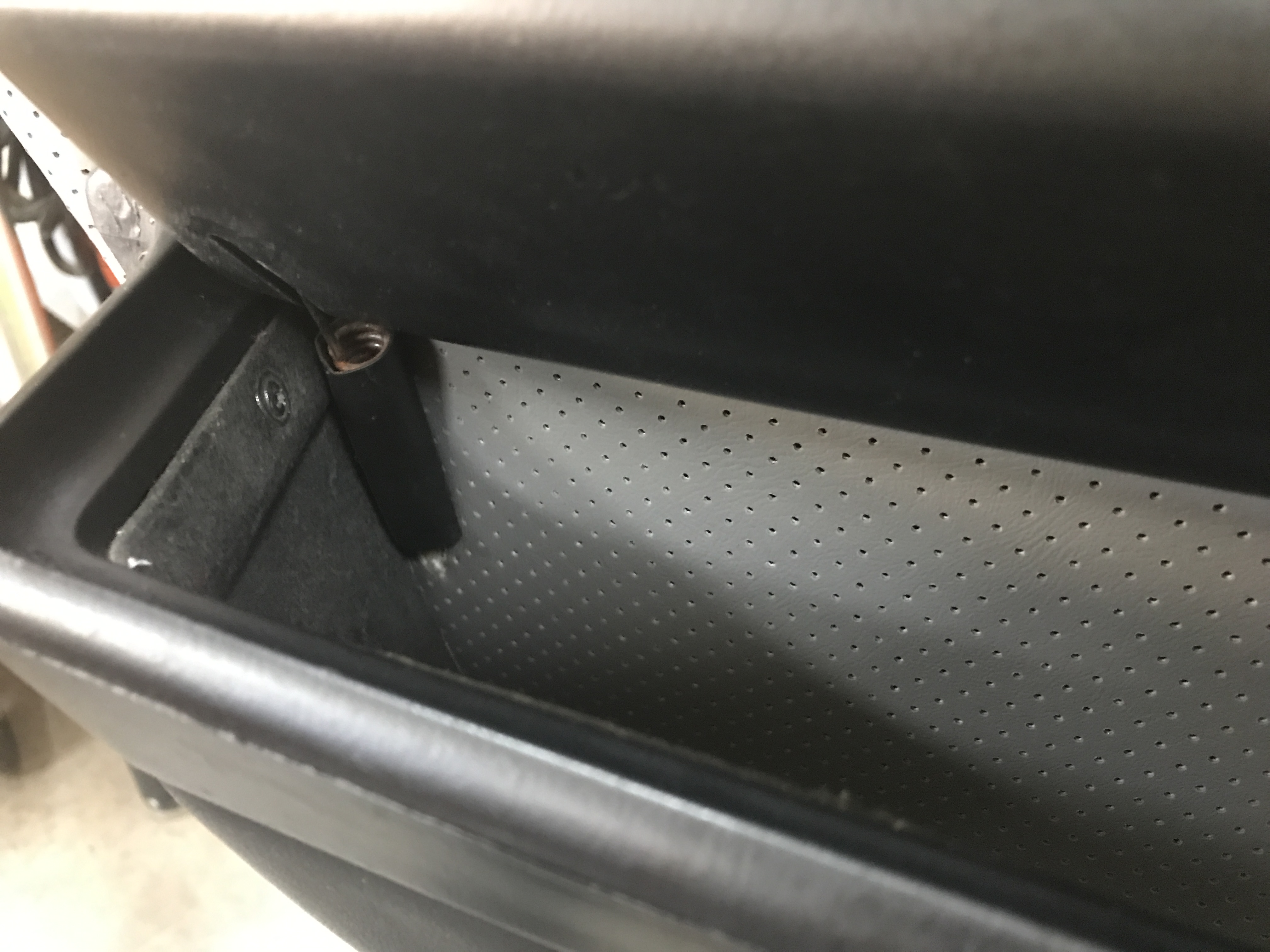

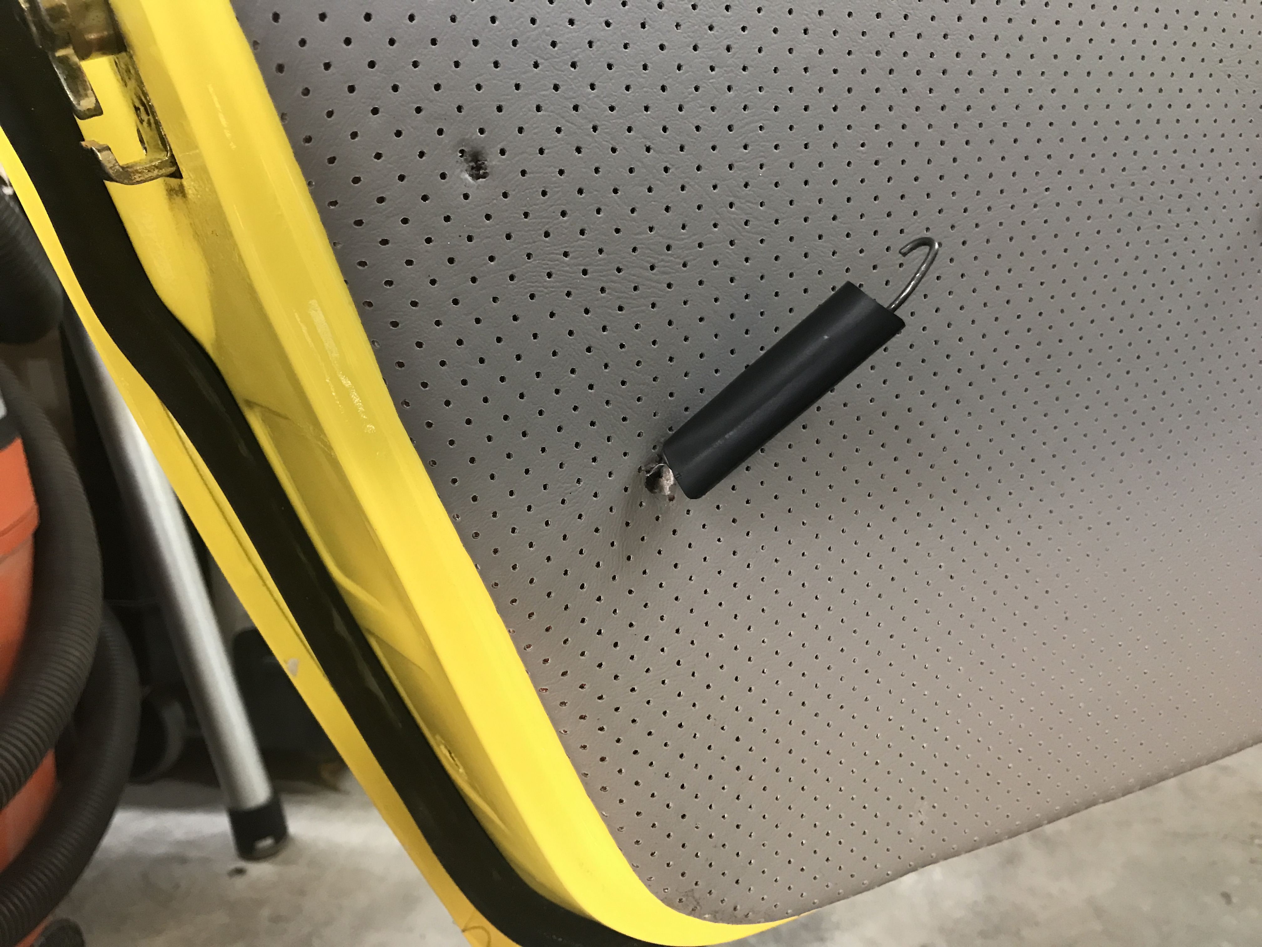

And then I spent a half-hour with this fussy little bastard: the spring that holds the lid down. What worked in the end was to have the spring top end inserted into the lid, and then feed the lower end into the door card hole (actually a metal grommet). The fussy part was catching the spring hook on the grommet, keeping it caught, and shifting the door pocket and lid into alignment with the mounting holes in the door.
bkrantz
post Jun 1 2022, 08:27 PM
Post #5390
Posts: 8,530
Joined: 3-August 19
From: SW Colorado
Member No.: 23,343
Got it after about a dozen attempts.
bkrantz
post Jun 1 2022, 08:28 PM
Post #5391
Posts: 8,530
Joined: 3-August 19
From: SW Colorado
Member No.: 23,343
Left door done.

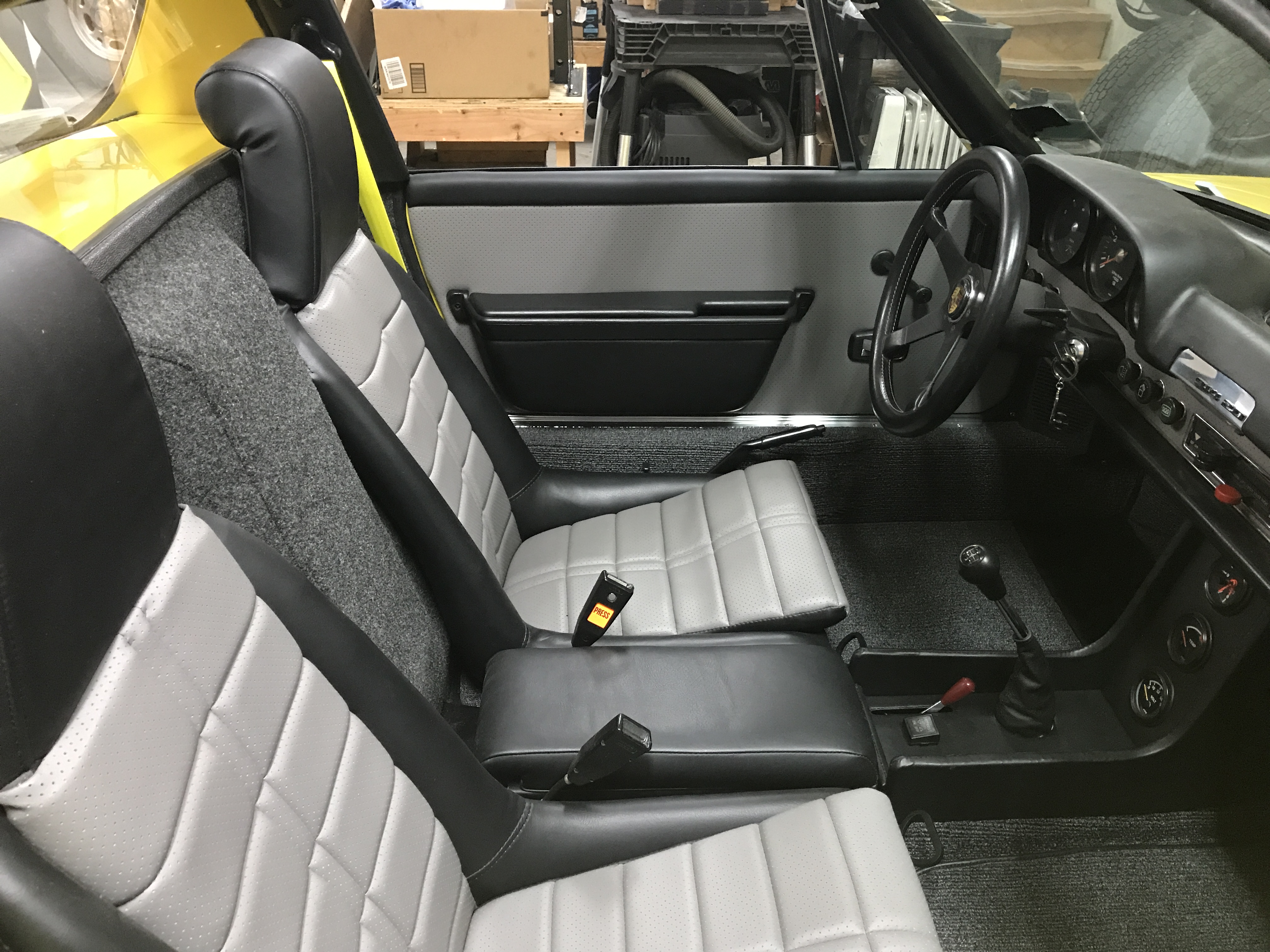

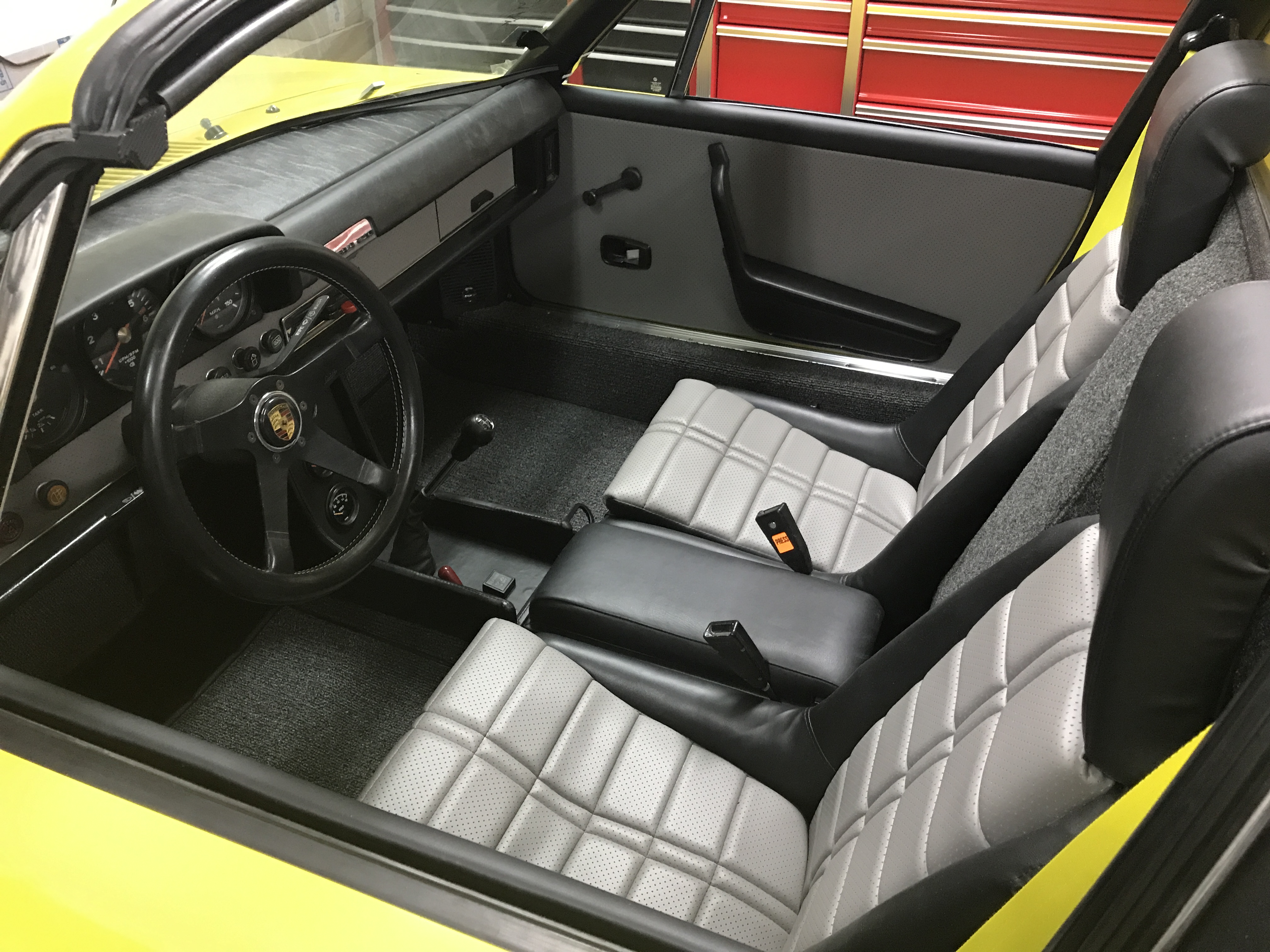

bkrantz
post Jun 1 2022, 08:32 PM
Post #5393
Posts: 8,530
Joined: 3-August 19
From: SW Colorado
Member No.: 23,343
Here's a look at the interior.
bkrantz
post Jun 1 2022, 08:33 PM
Post #5394
Posts: 8,530
Joined: 3-August 19
From: SW Colorado
Member No.: 23,343
Another look. I think it's pretty good. (Sorry, all you original purists.)
bbrock
post Jun 1 2022, 08:34 PM
Post #5395
Posts: 5,269
Joined: 17-February 17
From: Montana
Member No.: 20,845
QUOTE(bkrantz @ Jun 1 2022, 08:25 PM) *
(IMG:style_emoticons/default/av-943.gif) I know exactly what you are talking about. But seriously, only a half hour? You must be a natural.
That interior is (IMG:style_emoticons/default/drooley.gif)
