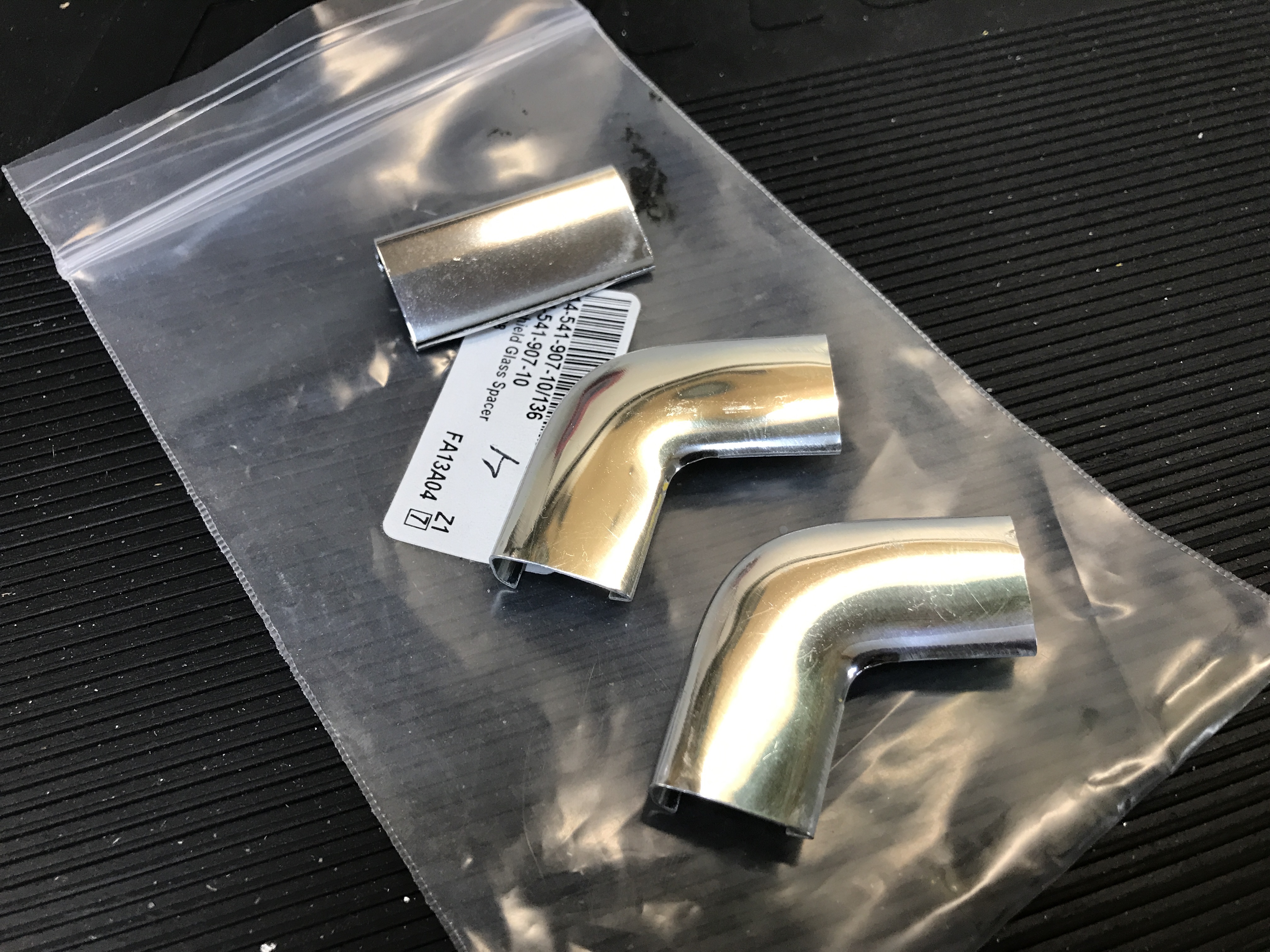

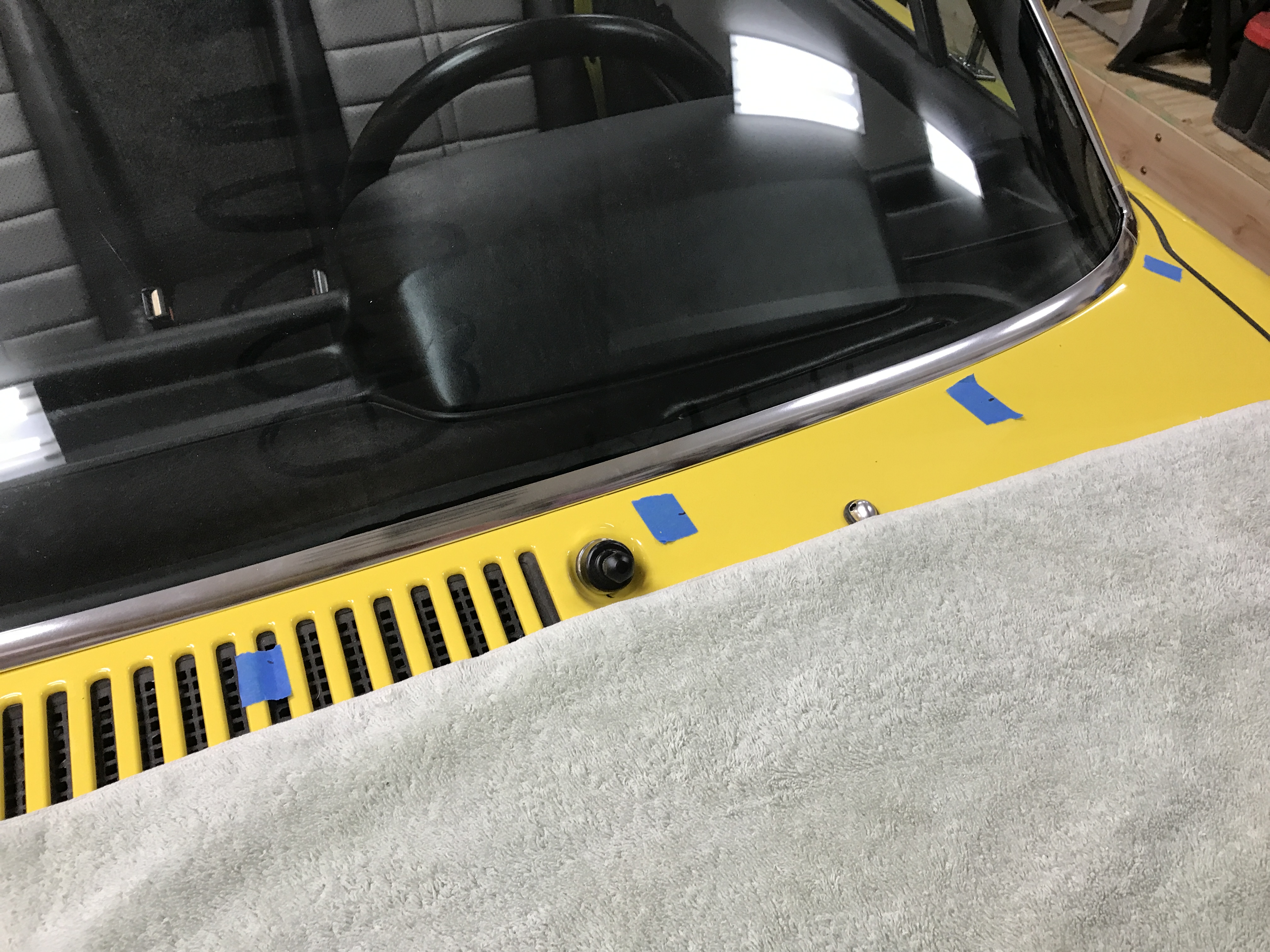

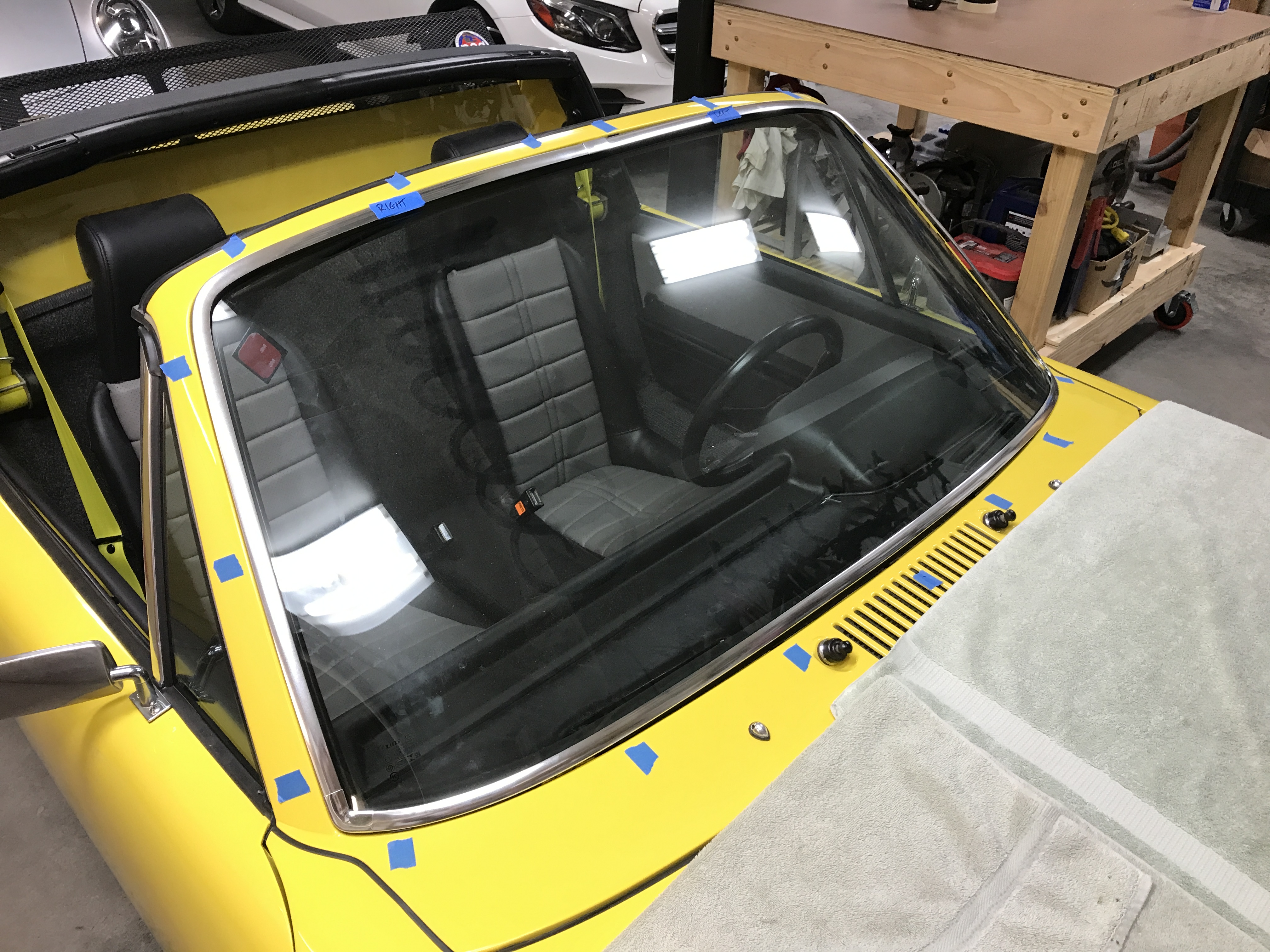

I finally tacked the trim today. I guess I was a little nervous about if and how it might fit. I did know that the joint pieces were not a perfect fit, but I decided against trying to adjust that.
bkrantz
post Jun 17 2022, 08:54 PM
Post #5563
Posts: 8,673
Joined: 3-August 19
From: SW Colorado
Member No.: 23,343
I assembled the complete frame and did one more session of bending and degree of insertion into all the joints to get everything lined up.
bkrantz
post Jun 17 2022, 08:56 PM
Post #5564
Posts: 8,673
Joined: 3-August 19
From: SW Colorado
Member No.: 23,343

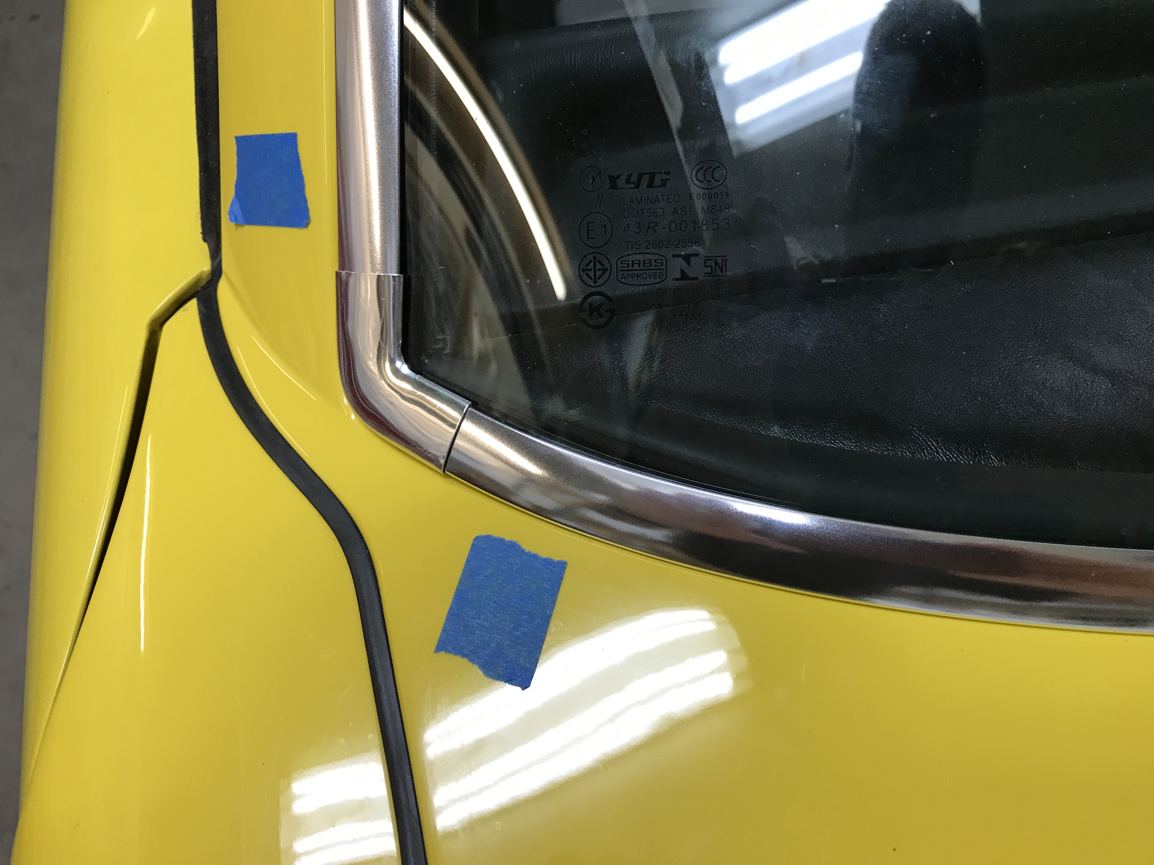

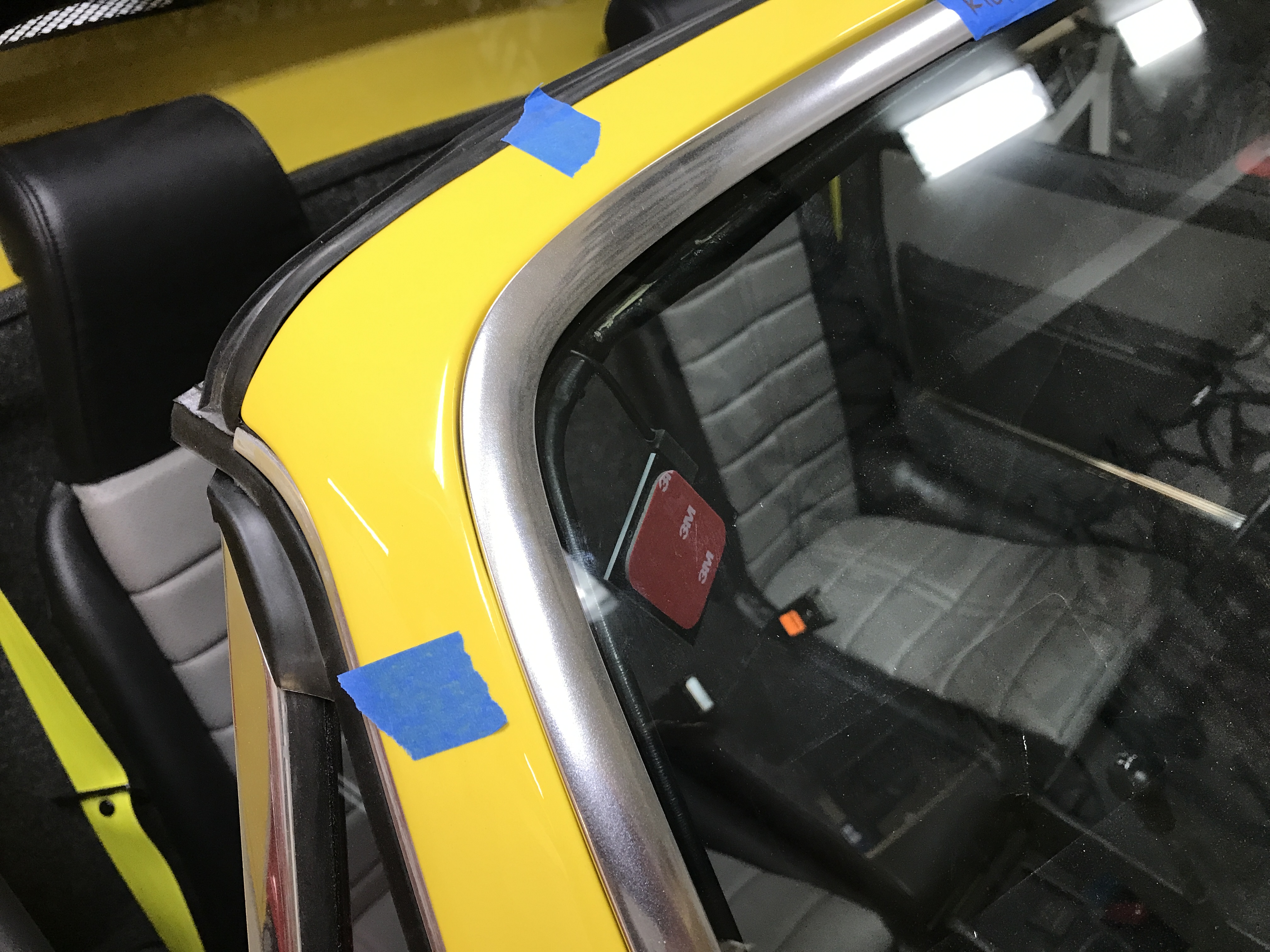

I figured one of the upper corners was the place to start, since the position is determined by the angle of both the trim piece and the frame. I snapped the trim into the two closest clips.
bkrantz
post Jun 17 2022, 08:58 PM
Post #5565
Posts: 8,673
Joined: 3-August 19
From: SW Colorado
Member No.: 23,343
Then I snapped in the other upper corner, and worked my way across the top, inward from both corners.
bkrantz
post Jun 17 2022, 09:00 PM
Post #5566
Posts: 8,673
Joined: 3-August 19
From: SW Colorado
Member No.: 23,343
At the bottom, I started in the middle, and then worked towards both lower corners, since the slip joints there made it easy to adjust lengths.
bkrantz
post Jun 17 2022, 09:01 PM
Post #5567
Posts: 8,673
Joined: 3-August 19
From: SW Colorado
Member No.: 23,343
I ended at the lower right corner.
bkrantz
post Jun 17 2022, 09:03 PM
Post #5568
Posts: 8,673
Joined: 3-August 19
From: SW Colorado
Member No.: 23,343

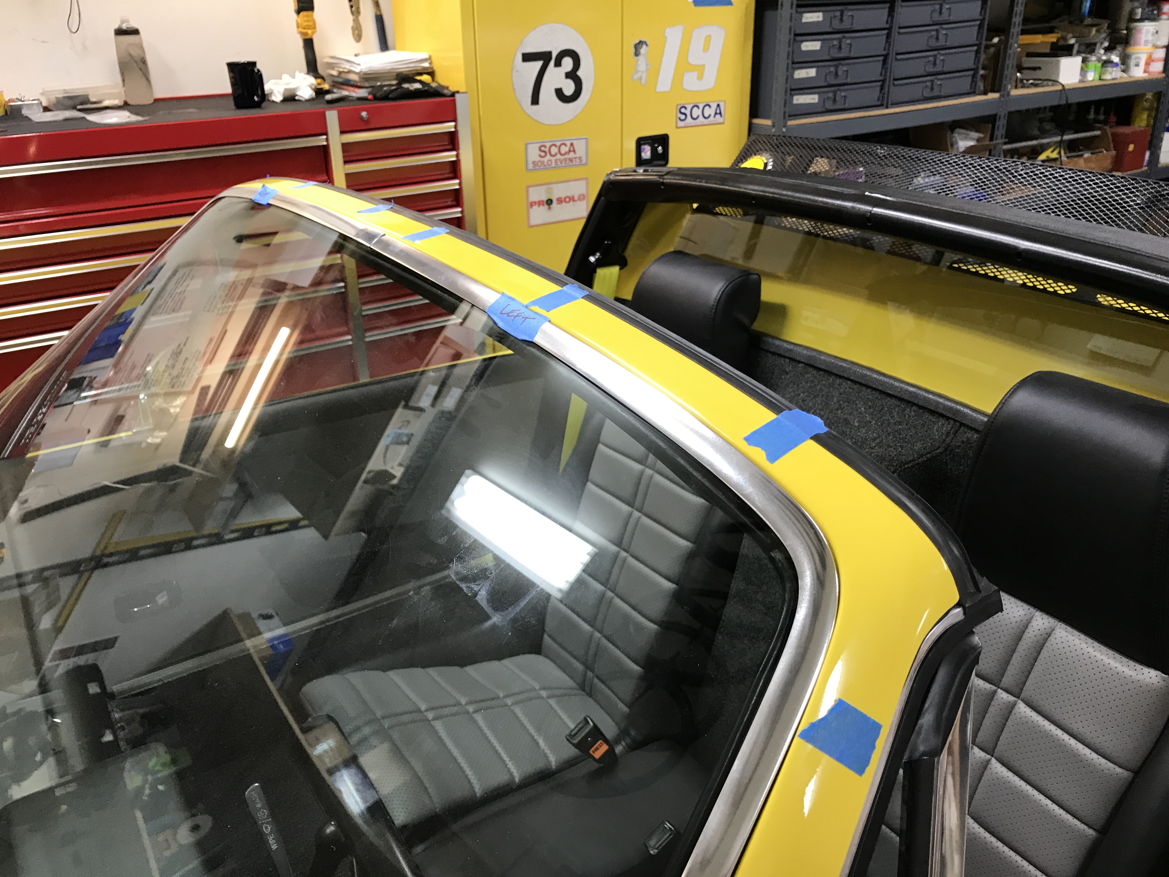

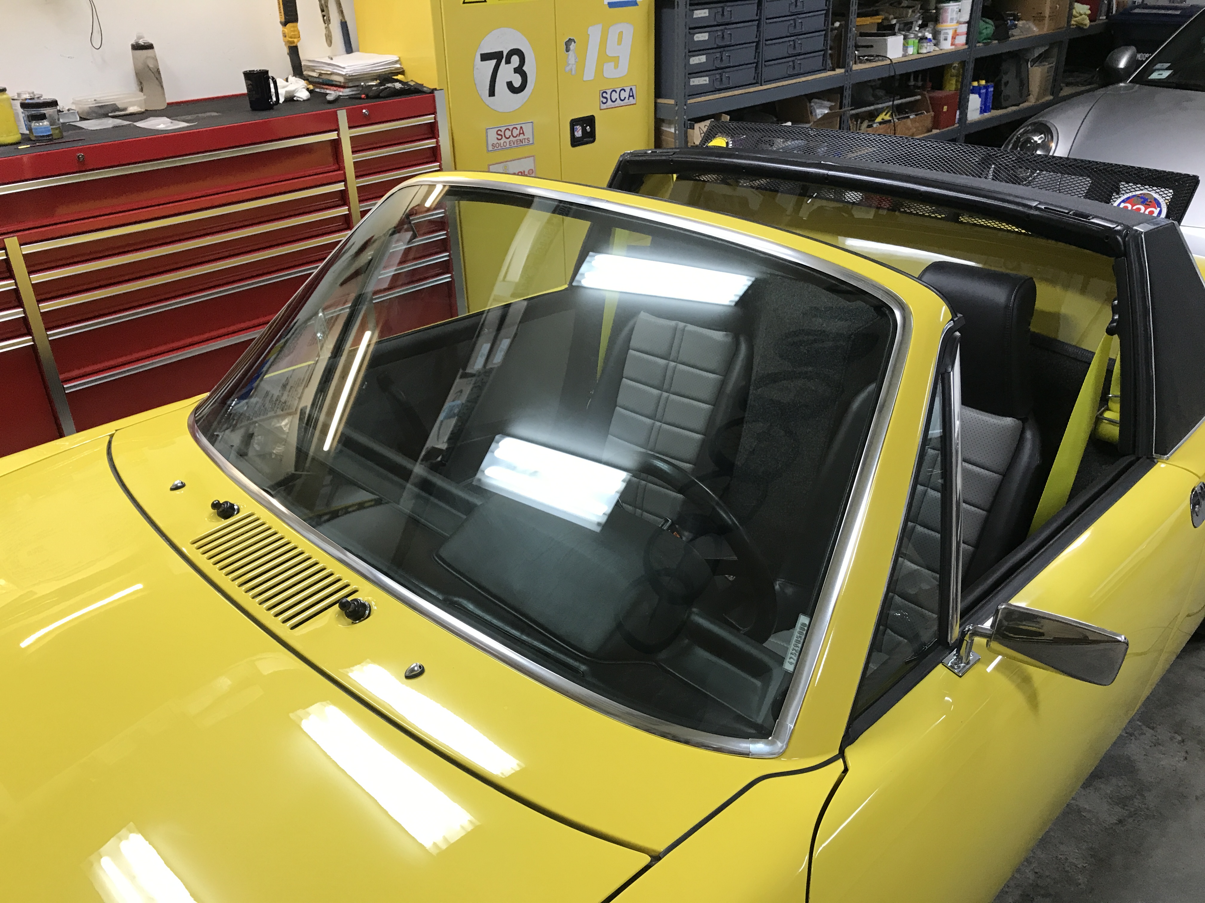

Here's the complete trim in place. Now things are looking fancy.

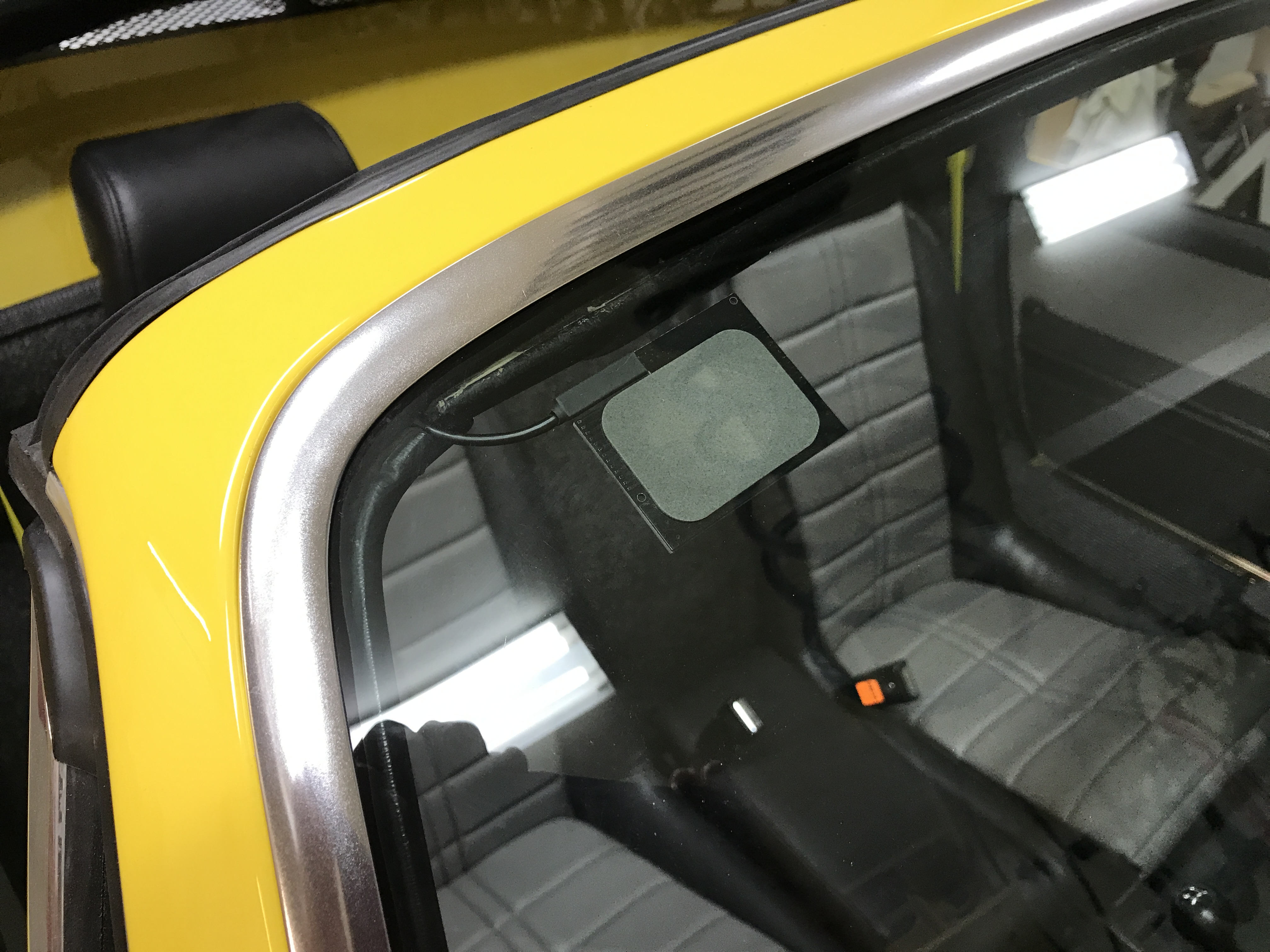

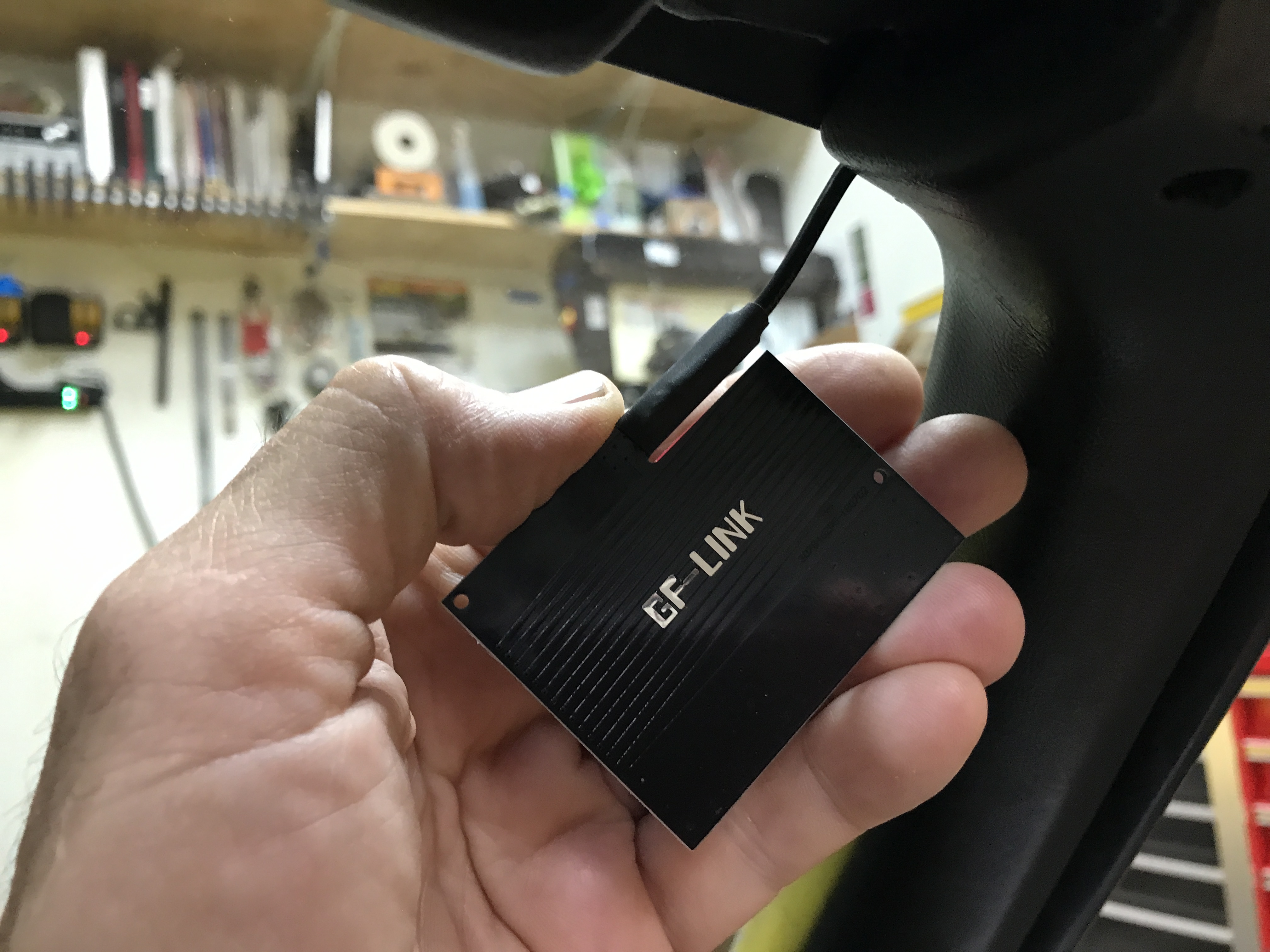

My fancy, high tech almost hidden FM antenna.
bkrantz
post Jun 17 2022, 09:06 PM
Post #5570
Posts: 8,673
Joined: 3-August 19
From: SW Colorado
Member No.: 23,343
Stuck to the inside of the glass. Later we can listen to some tunes. Or the weather band, which might be more useful in a 914.

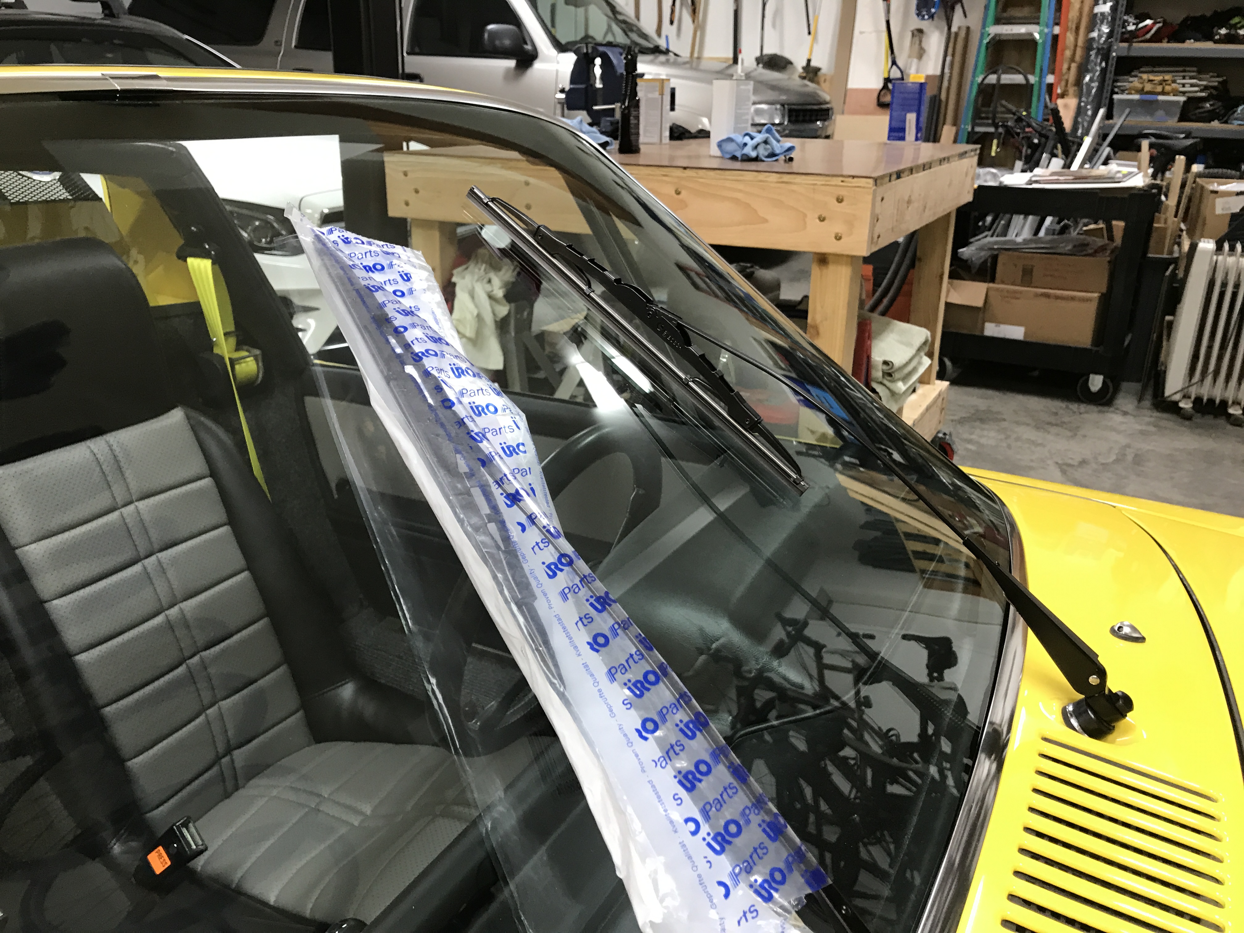

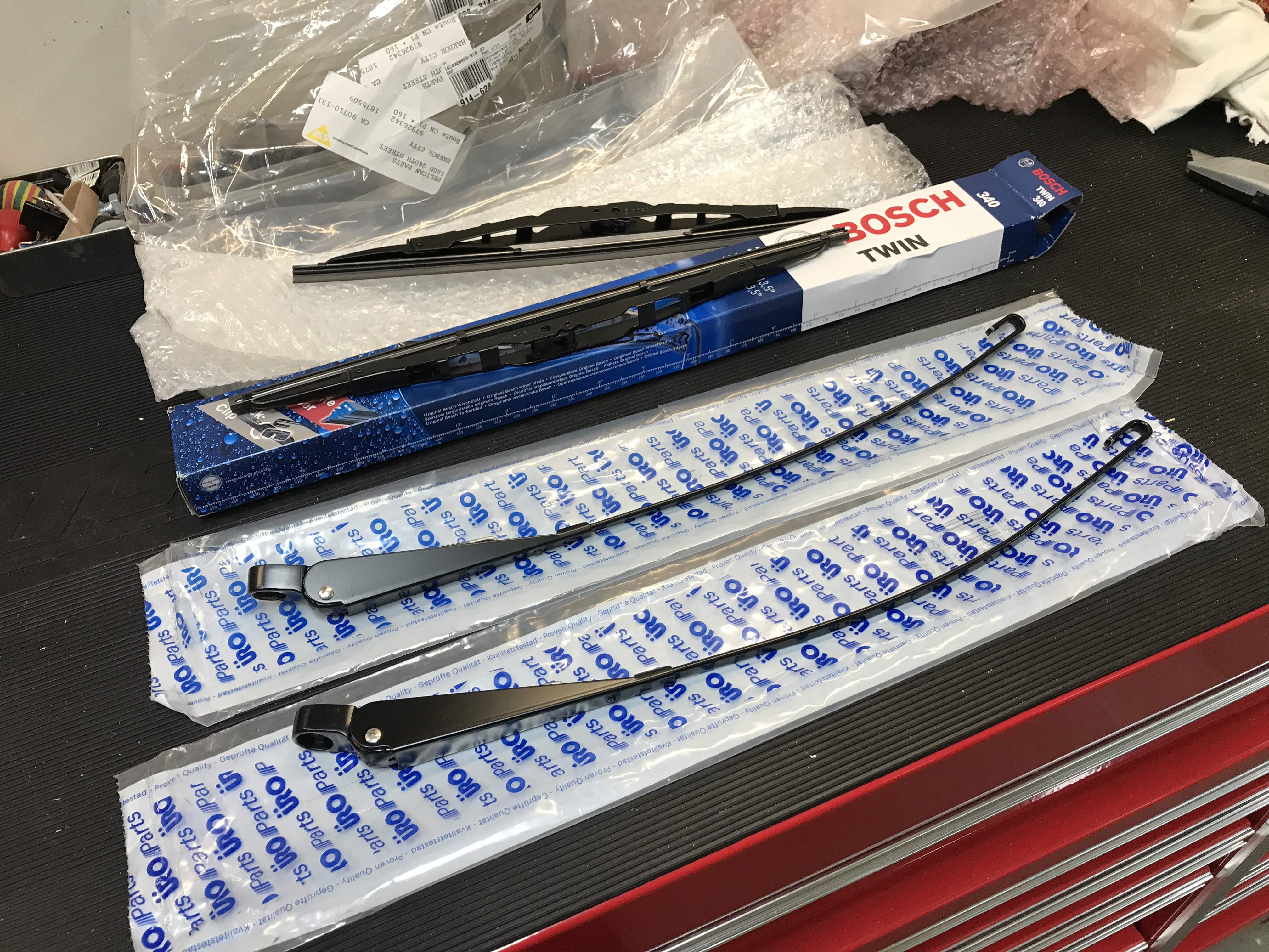

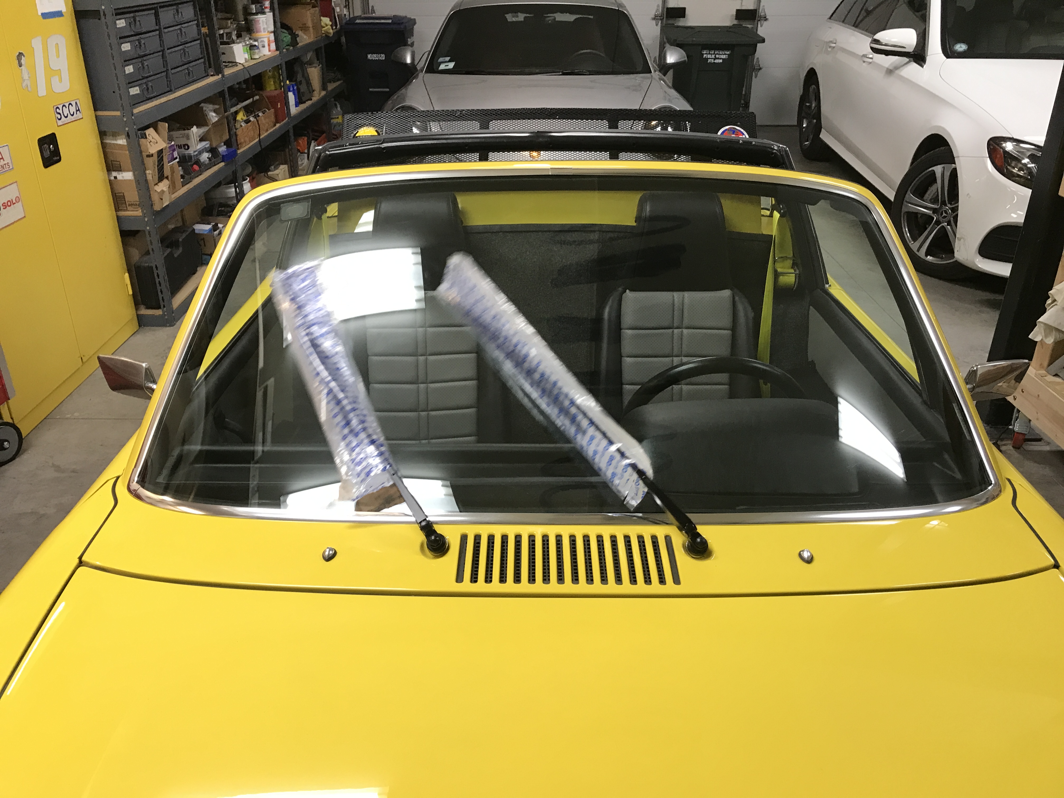

Then, I got out the wipers. New arms and new blades.
bkrantz
post Jun 17 2022, 09:07 PM
Post #5572
Posts: 8,673
Joined: 3-August 19
From: SW Colorado
Member No.: 23,343

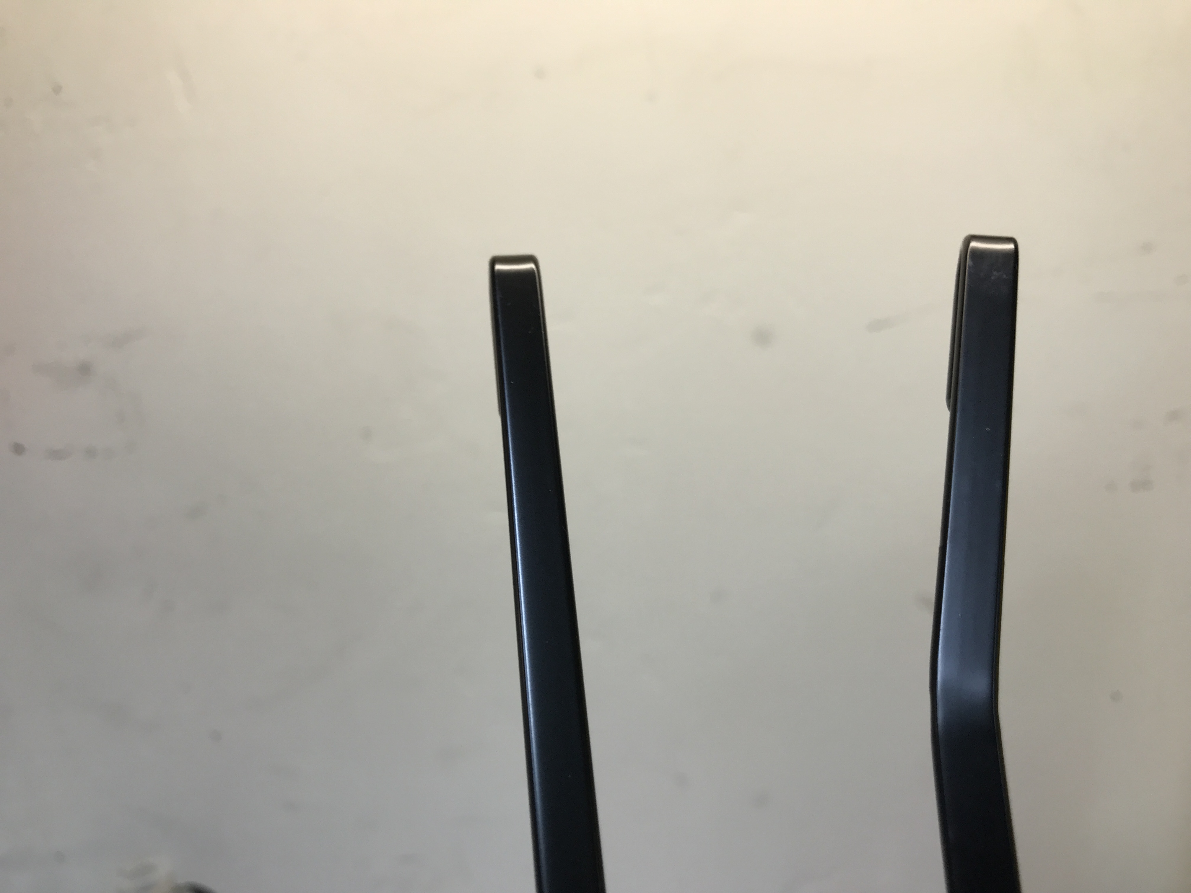

Bent arm goes on the right, right?
bkrantz
post Jun 17 2022, 09:10 PM
Post #5573
Posts: 8,673
Joined: 3-August 19
From: SW Colorado
Member No.: 23,343
I put the blades on the arms, and then the arms on the spindles. To check the alignment, I ran the wipers. In order to avoid scraping the dry rubber on the glass, I used the plastic bags the arms came in.
bkrantz
post Jun 17 2022, 09:11 PM
Post #5574
Posts: 8,673
Joined: 3-August 19
From: SW Colorado
Member No.: 23,343

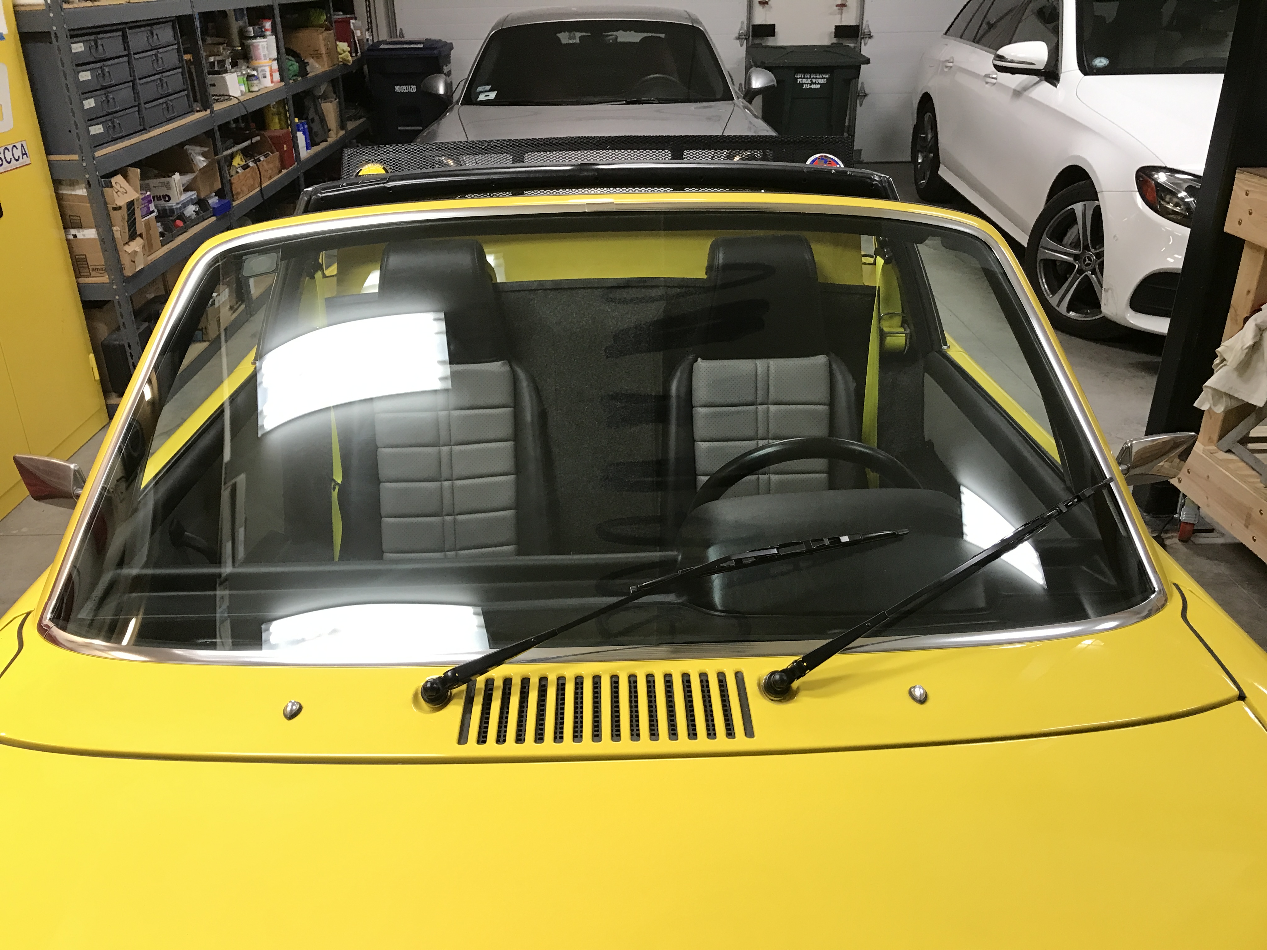

Here's my set alignment.
bkrantz
post Jun 17 2022, 09:12 PM
Post #5575
Posts: 8,673
Joined: 3-August 19
From: SW Colorado
Member No.: 23,343
The correct 340mm (13.5") blades sure look small.

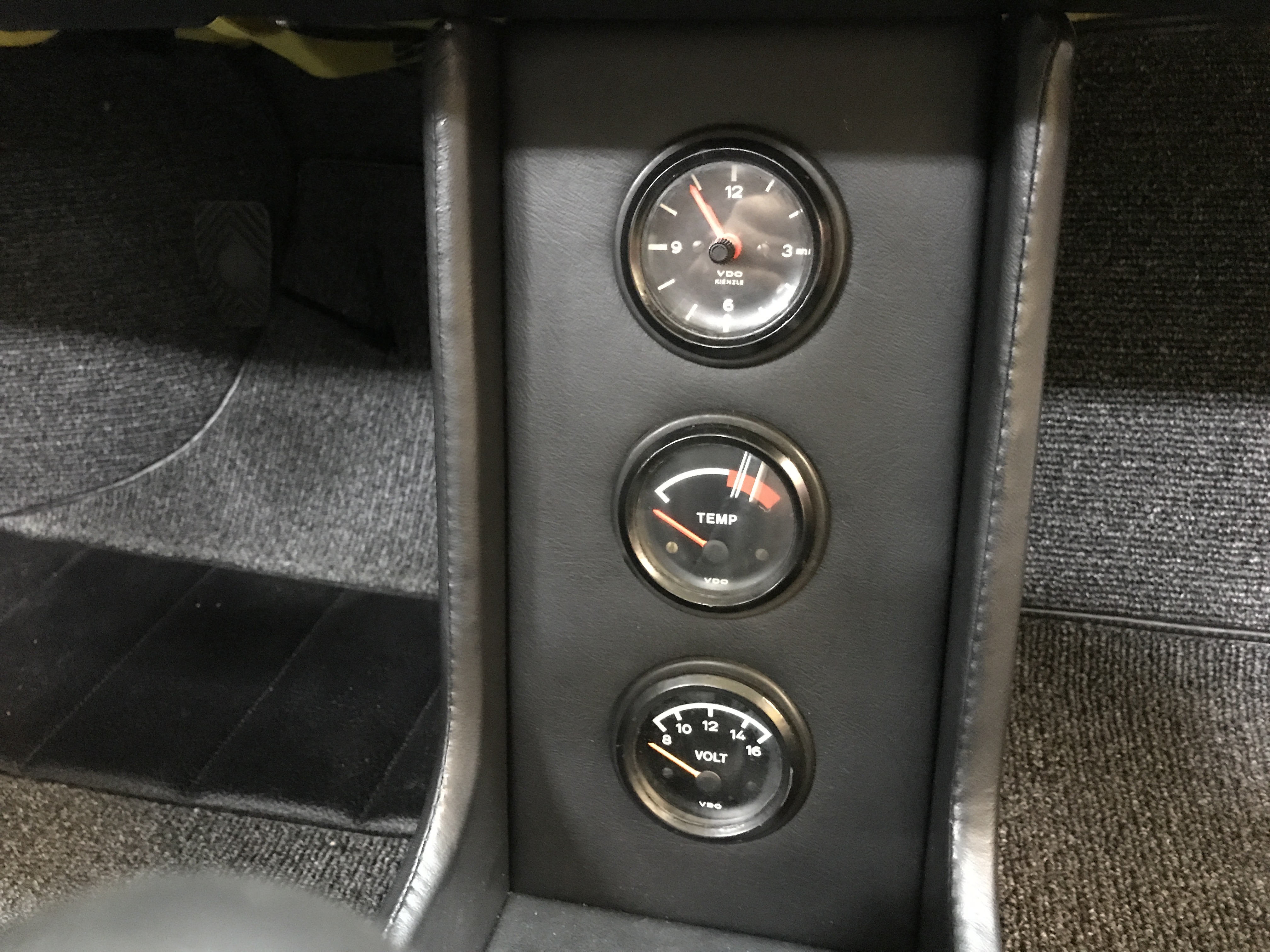

I checked my clock again, and given that it lost no time since yesterday, I closed the center panel.
bkrantz
post Jun 17 2022, 09:18 PM
Post #5577
Posts: 8,673
Joined: 3-August 19
From: SW Colorado
Member No.: 23,343
Really almost done.

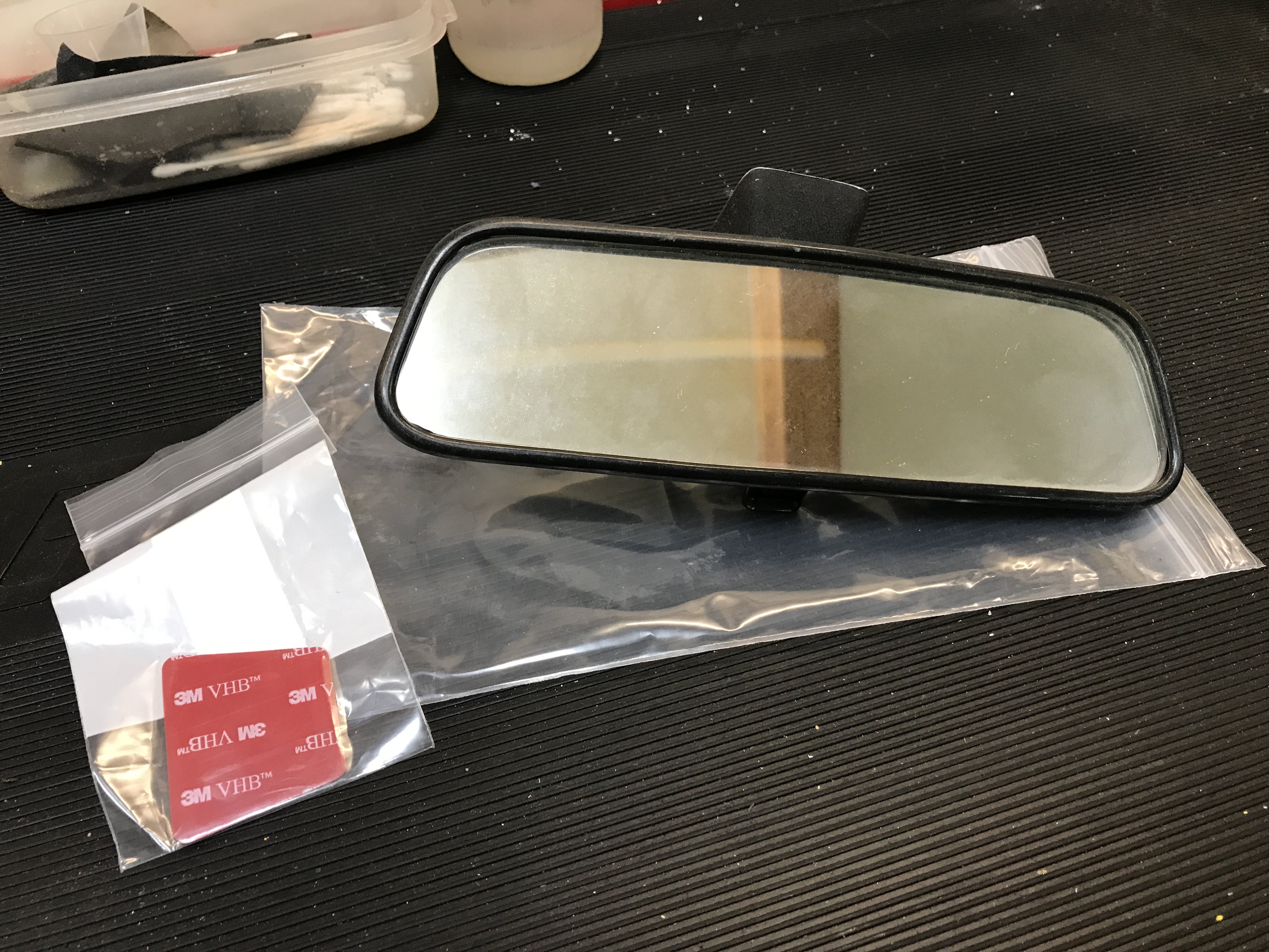

I did get out the interior rear view mirror, which needs a bit of cleanup before installation.

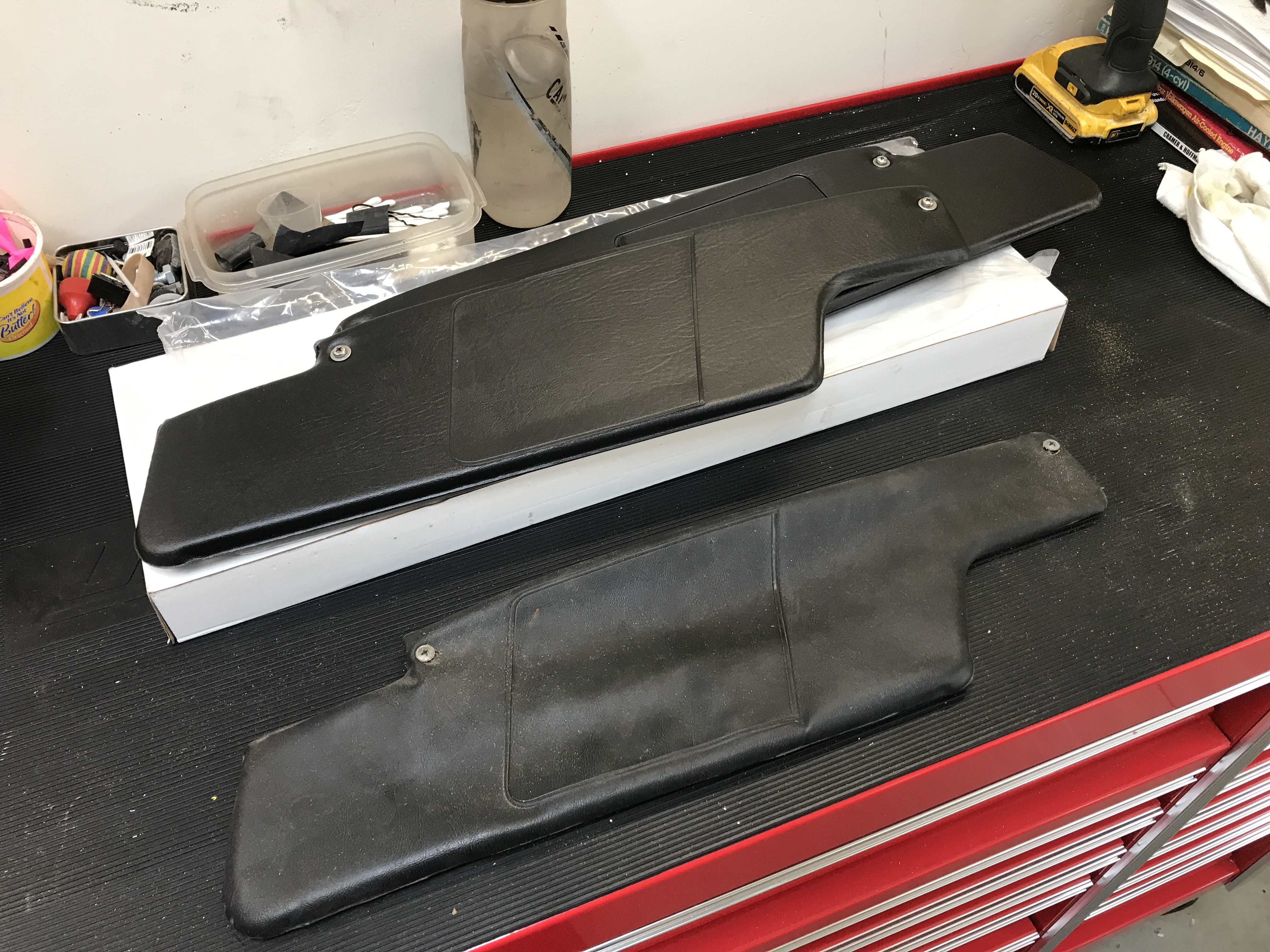

Before mounting the mirror, I want to make sure it will clear the visors, so I got out my new repro pair from 914 Rubber. The car came with just a left visor. It might be original, but the foam inside has turned into dust.
