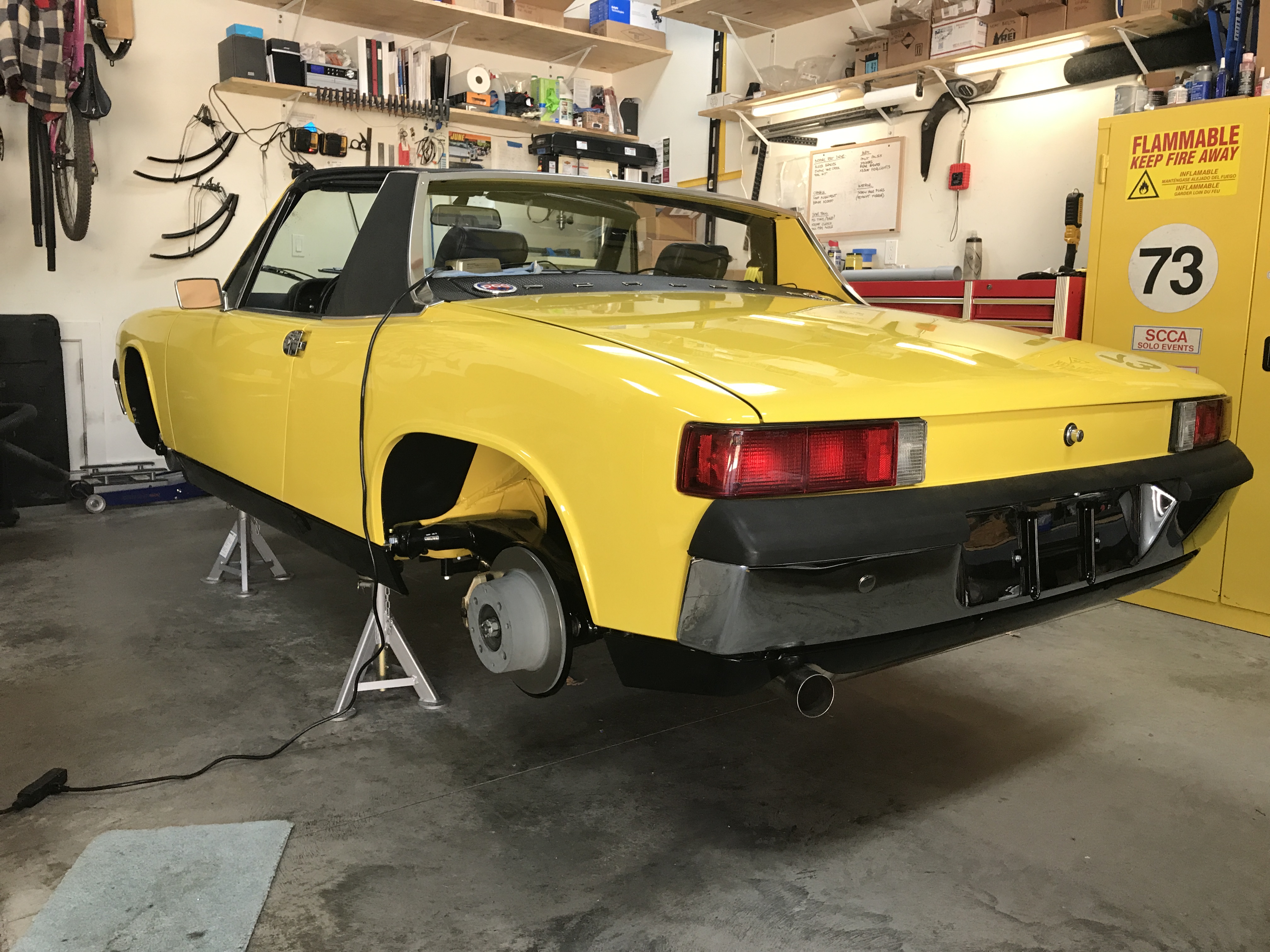

Well, here we are again on jack stands. I hope I can resolve the soft brake pedal quickly.

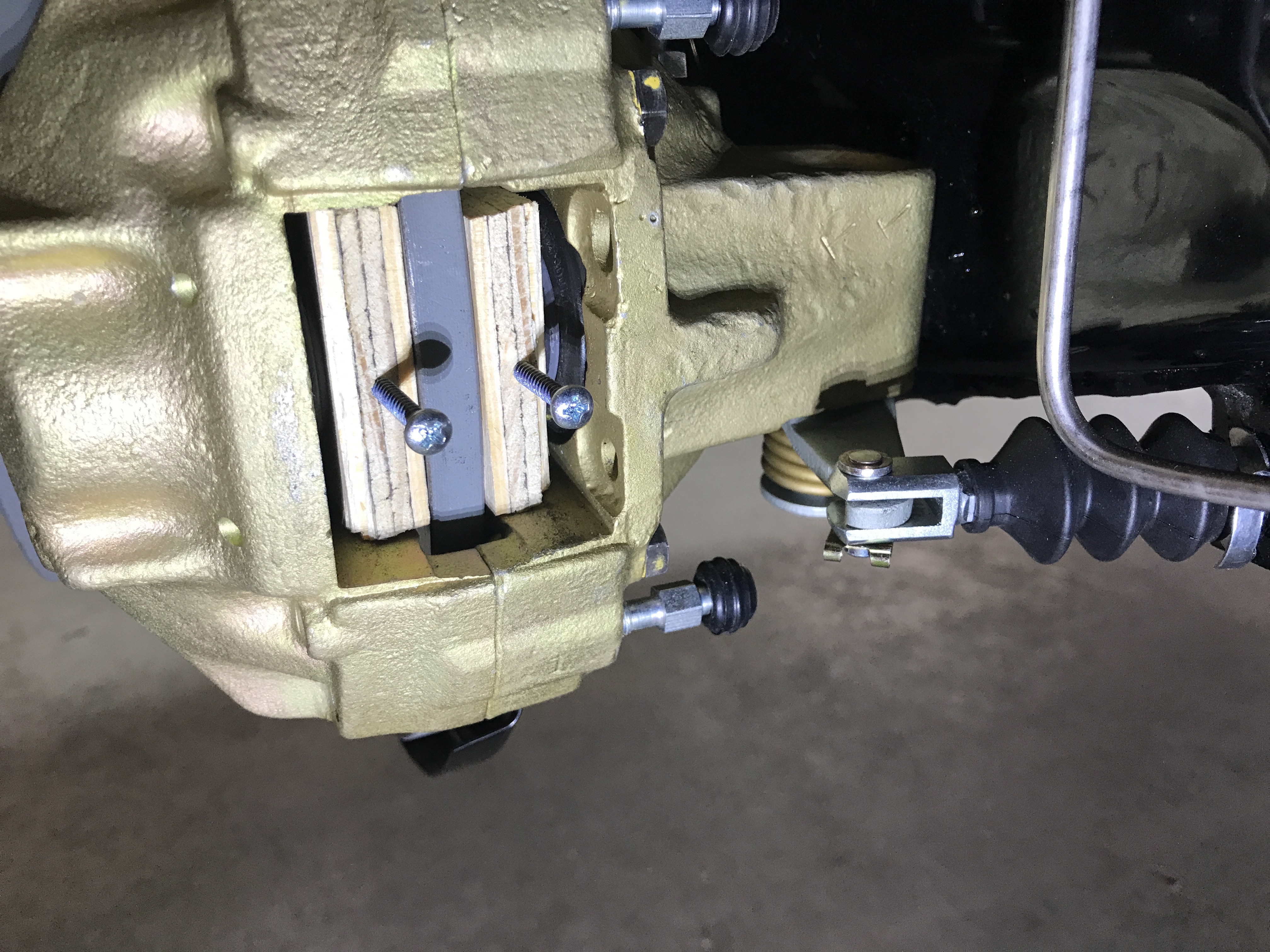

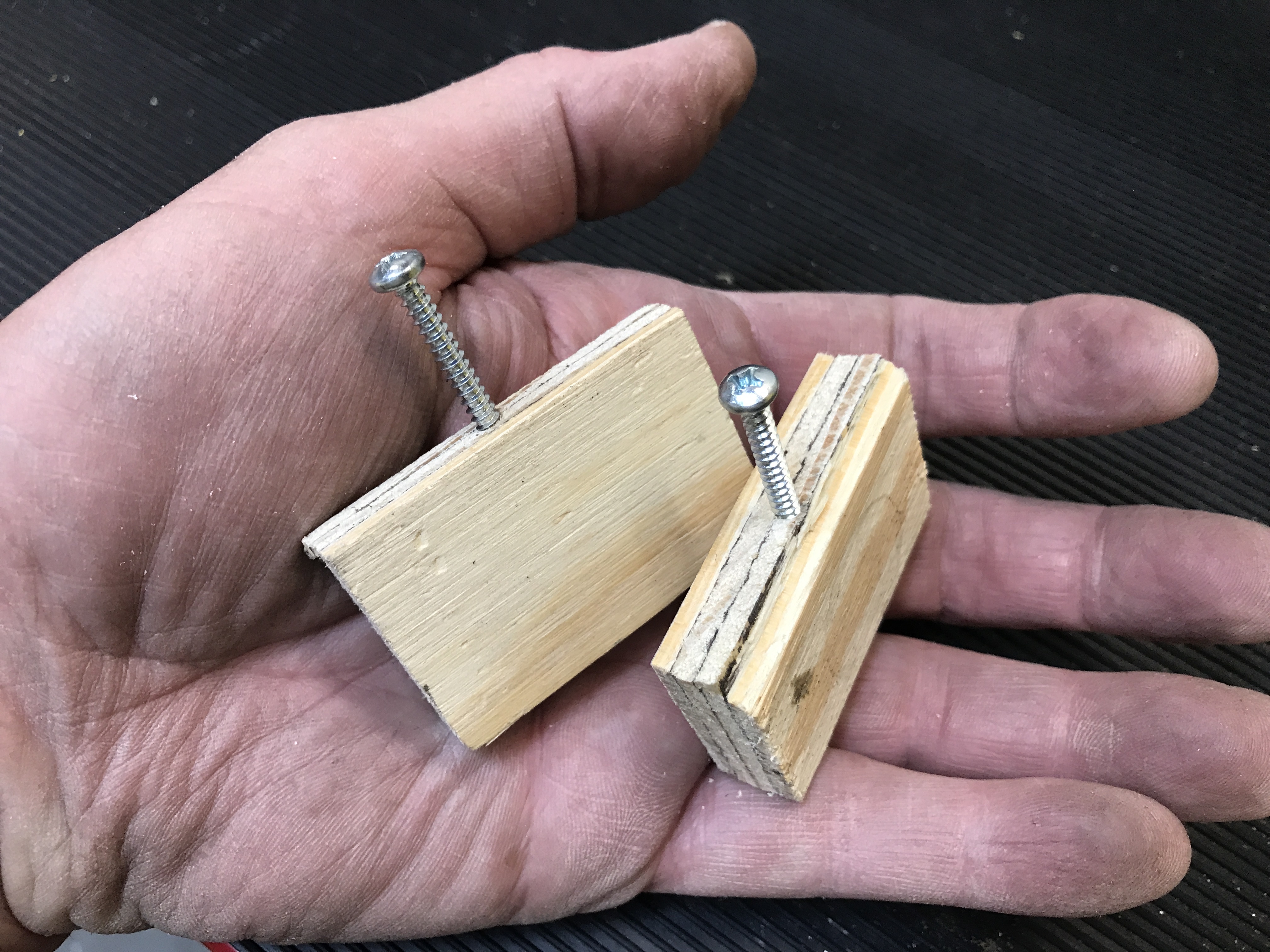

I want to try moving the pistons in each caliper, so I made a couple of blocks from 3/8" plywood.
bkrantz
post Jun 20 2022, 07:25 PM
Post #5608
Posts: 8,673
Joined: 3-August 19
From: SW Colorado
Member No.: 23,343
With some nifty handles.
bkrantz
post Jun 20 2022, 07:30 PM
Post #5609
Posts: 8,673
Joined: 3-August 19
From: SW Colorado
Member No.: 23,343

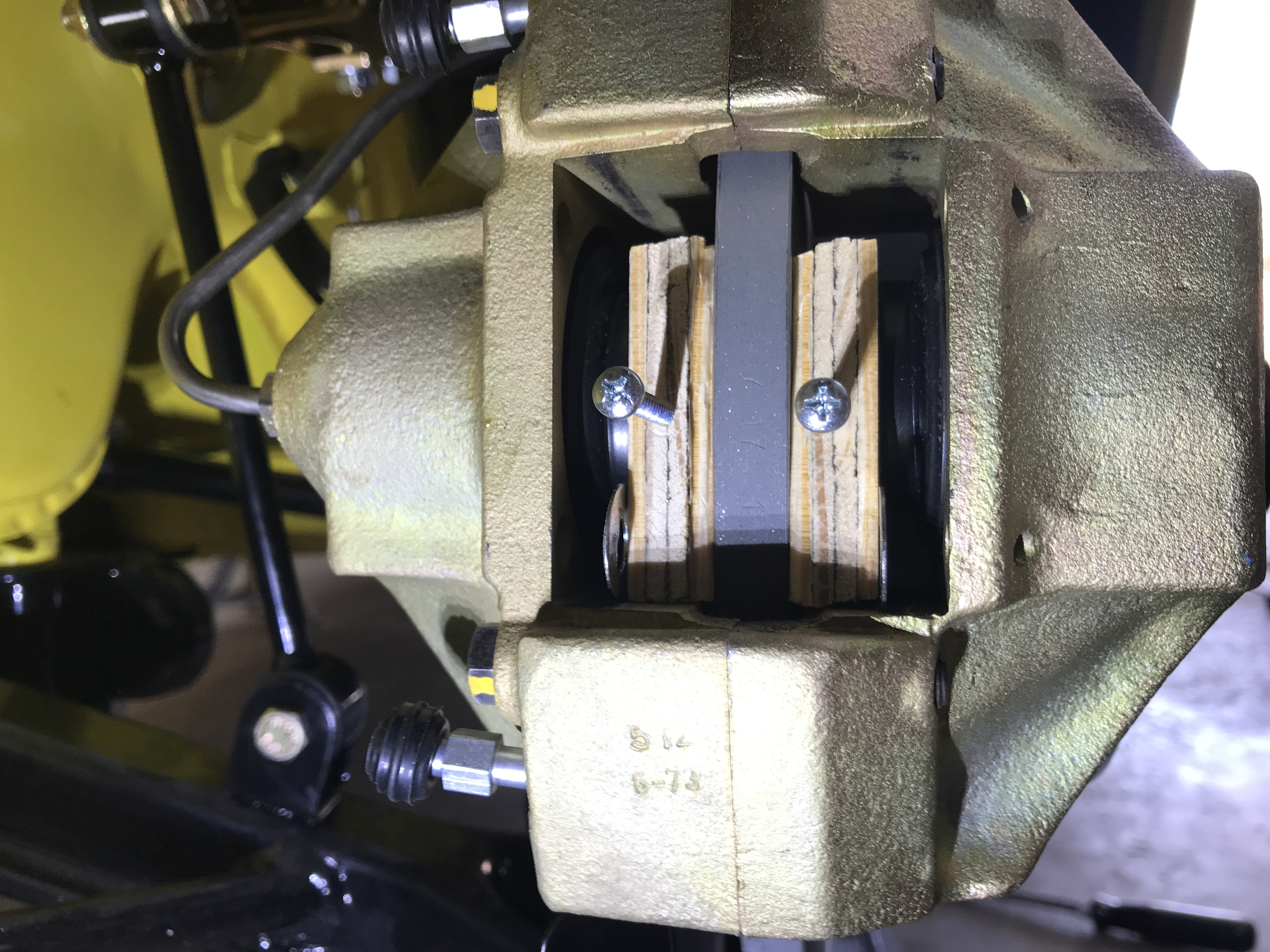

These give the pistons about 1/8" space to move.
But then I re-learned that piston movement in the rear calipers is limited by the parking brake adjustment.
I also relearned that the soft pedal also reflects the rear pad clearance. With the adjustment very loose, the pedal was very soft.

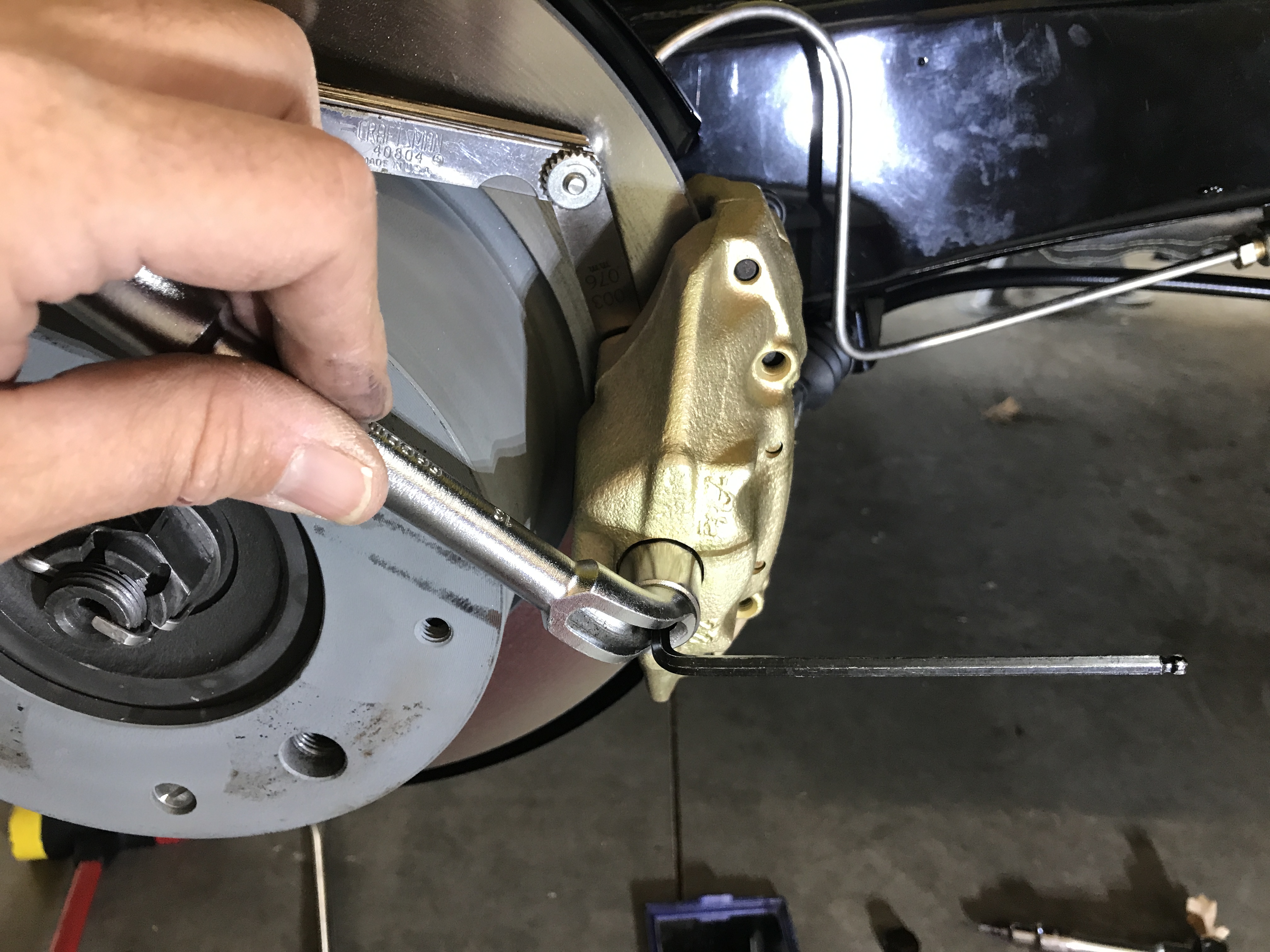

So I re-installed the brake pads, and went through the clearance adjustment again, setting both sides to .004". That made the brake pedal feel nice and firm.

Hey Bob where did you get the pass through wrench to do your brake adjustment? I really need one of these in my tool collection......
bkrantz
post Jun 21 2022, 07:42 PM
Post #5615
Posts: 8,673
Joined: 3-August 19
From: SW Colorado
Member No.: 23,343
QUOTE(Puebloswatcop @ Jun 21 2022, 04:56 PM) *
QUOTE(bkrantz @ Jun 20 2022, 06:32 PM) *
Tomorrow, I will mess with the other side, and then maybe the fronts, before another round of bleeding.
That's a Facom brand wrench. I bought a few when I lived in France in the 80s. I think there are US distributors.

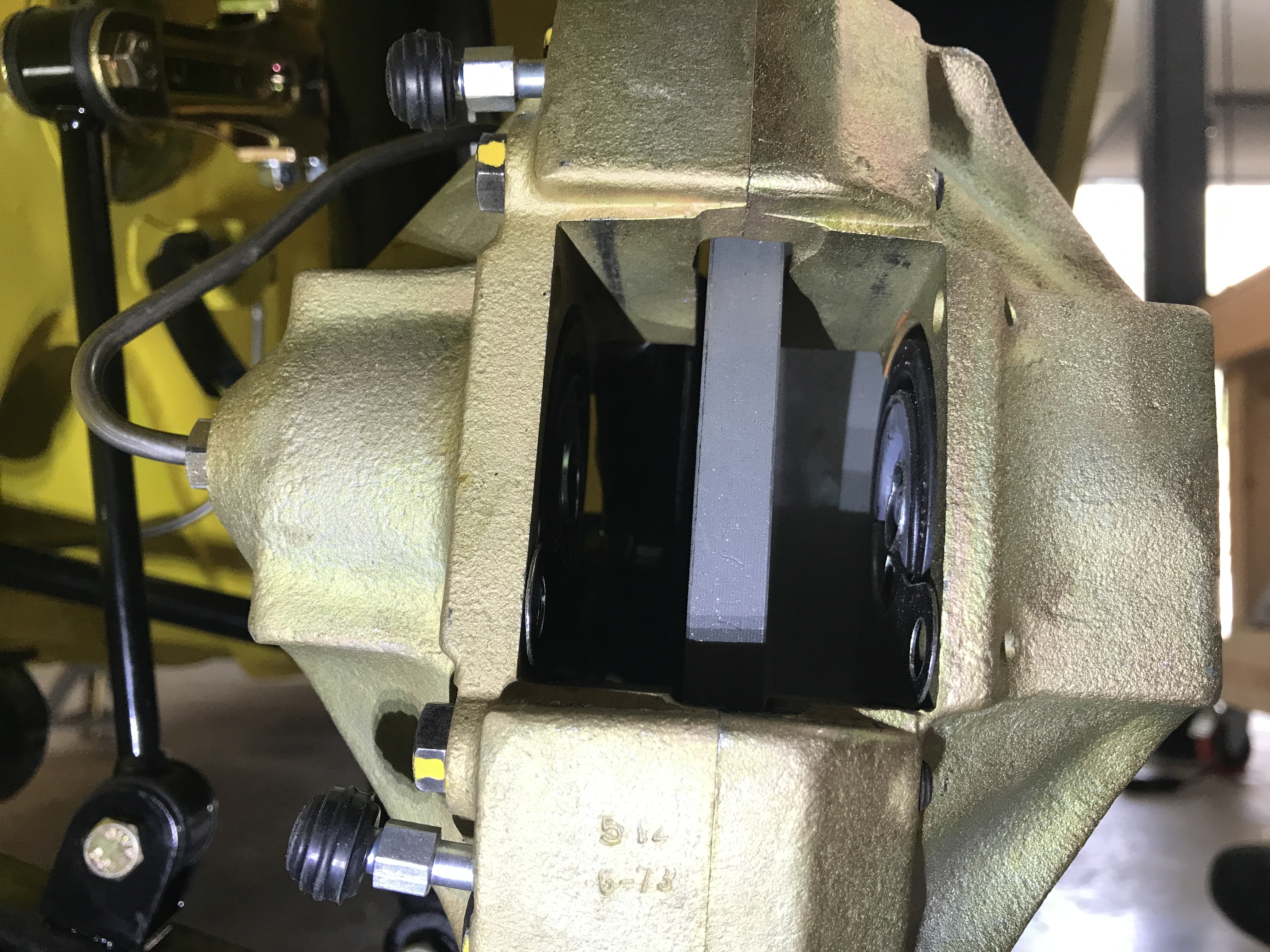

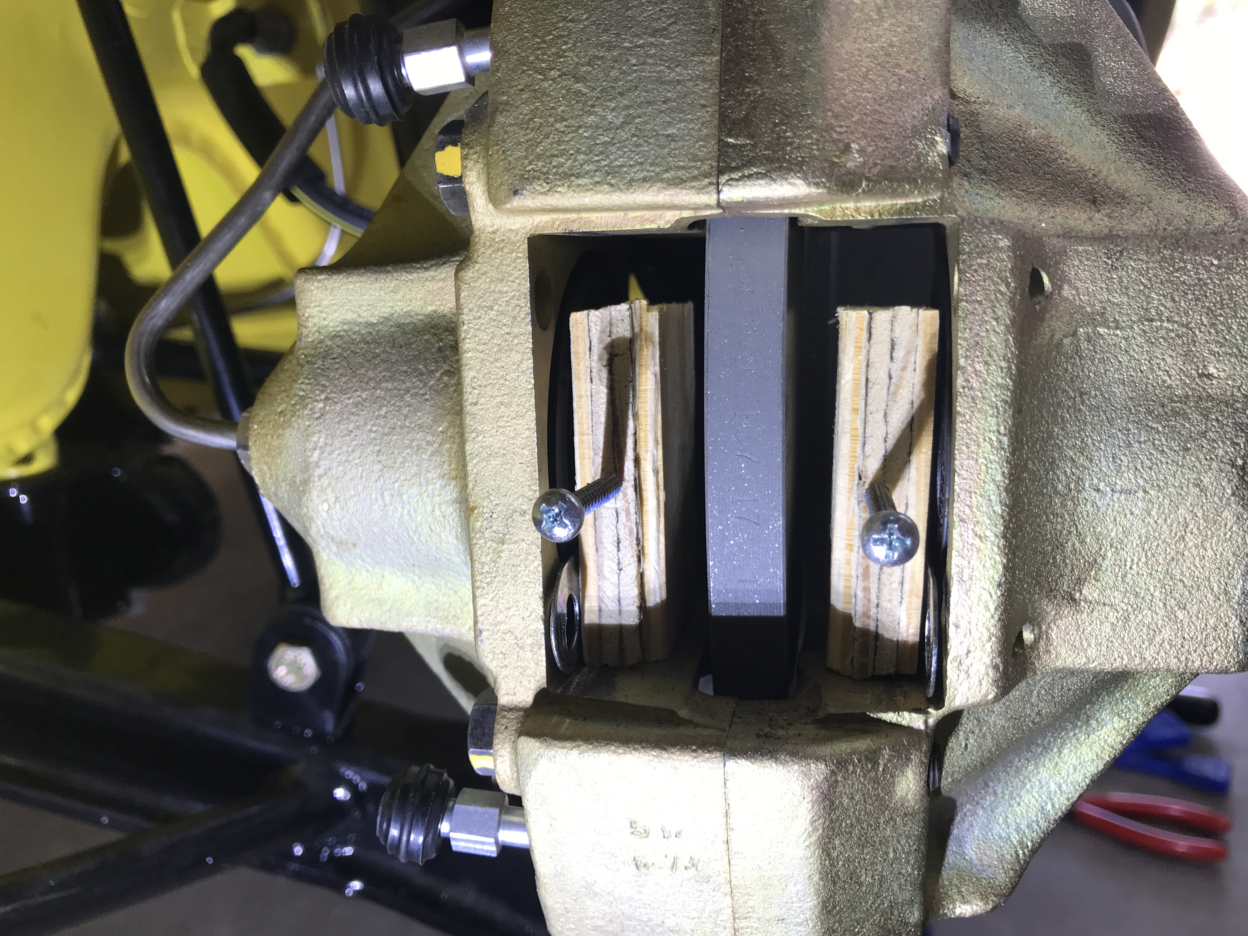

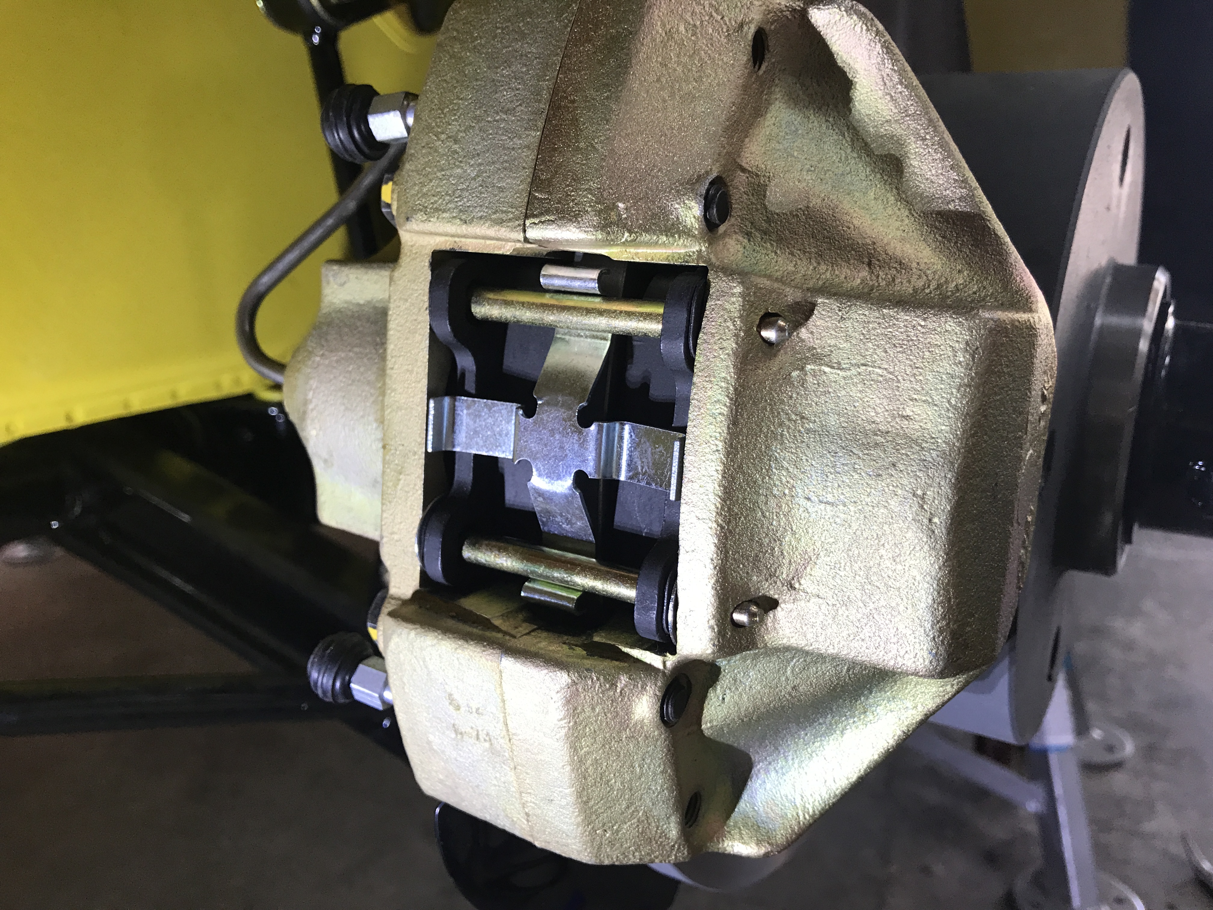

I adjusted the left rear caliper clearance, and then switched to the front. Here are the spacer blocks in the front caliper after taking out the pads.
bkrantz
post Jun 21 2022, 07:48 PM
Post #5617
Posts: 8,673
Joined: 3-August 19
From: SW Colorado
Member No.: 23,343

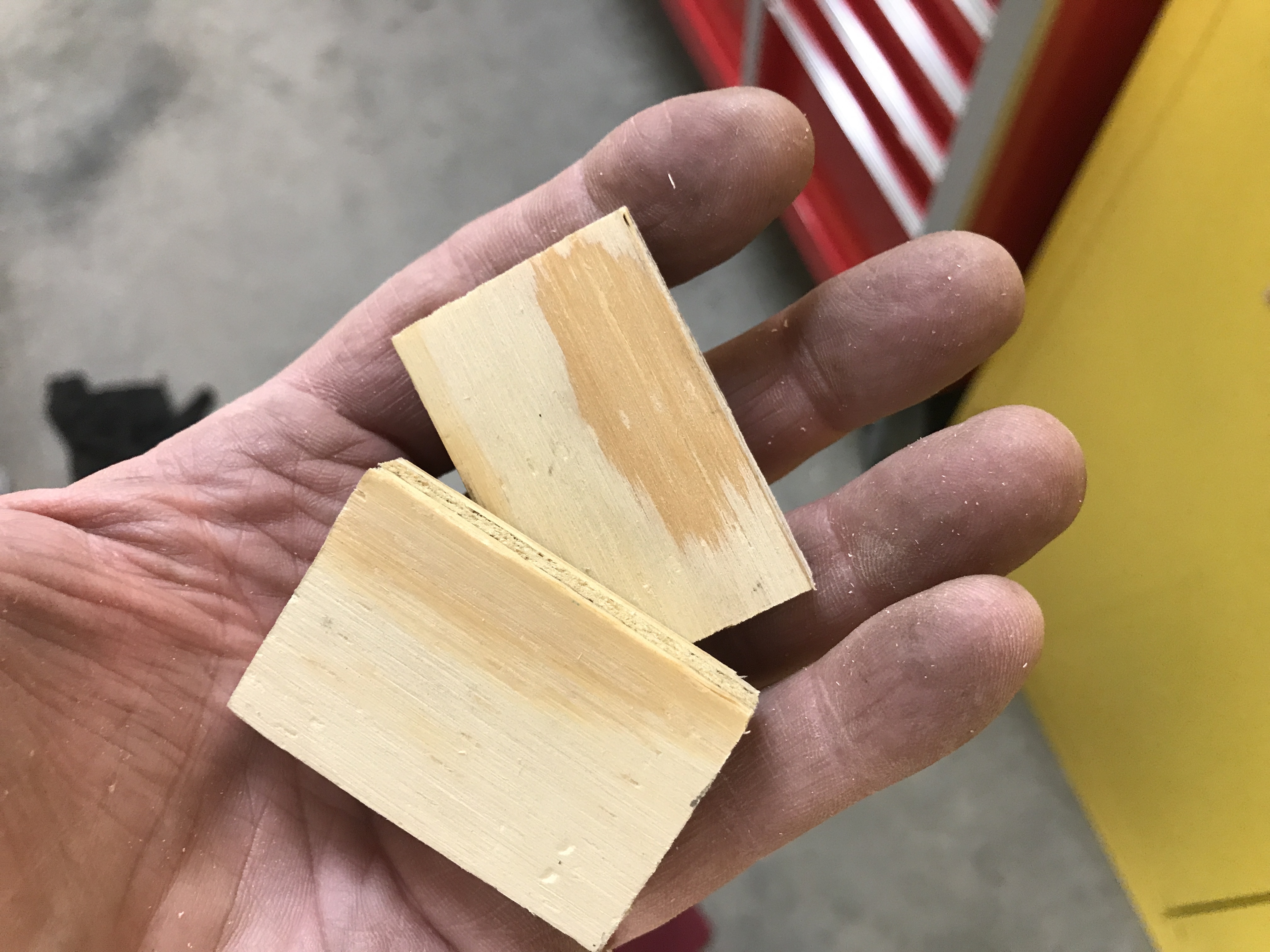

After about 10 pedal strokes, the pistons closed on the spacers, moving about 1/4".

I then pushed the pistons back in.
bkrantz
post Jun 21 2022, 07:50 PM
Post #5619
Posts: 8,673
Joined: 3-August 19
From: SW Colorado
Member No.: 23,343
I then put the pads and hardware back it, and did the other side. After that I did another round of bleeding. The pedal now feels very firm.

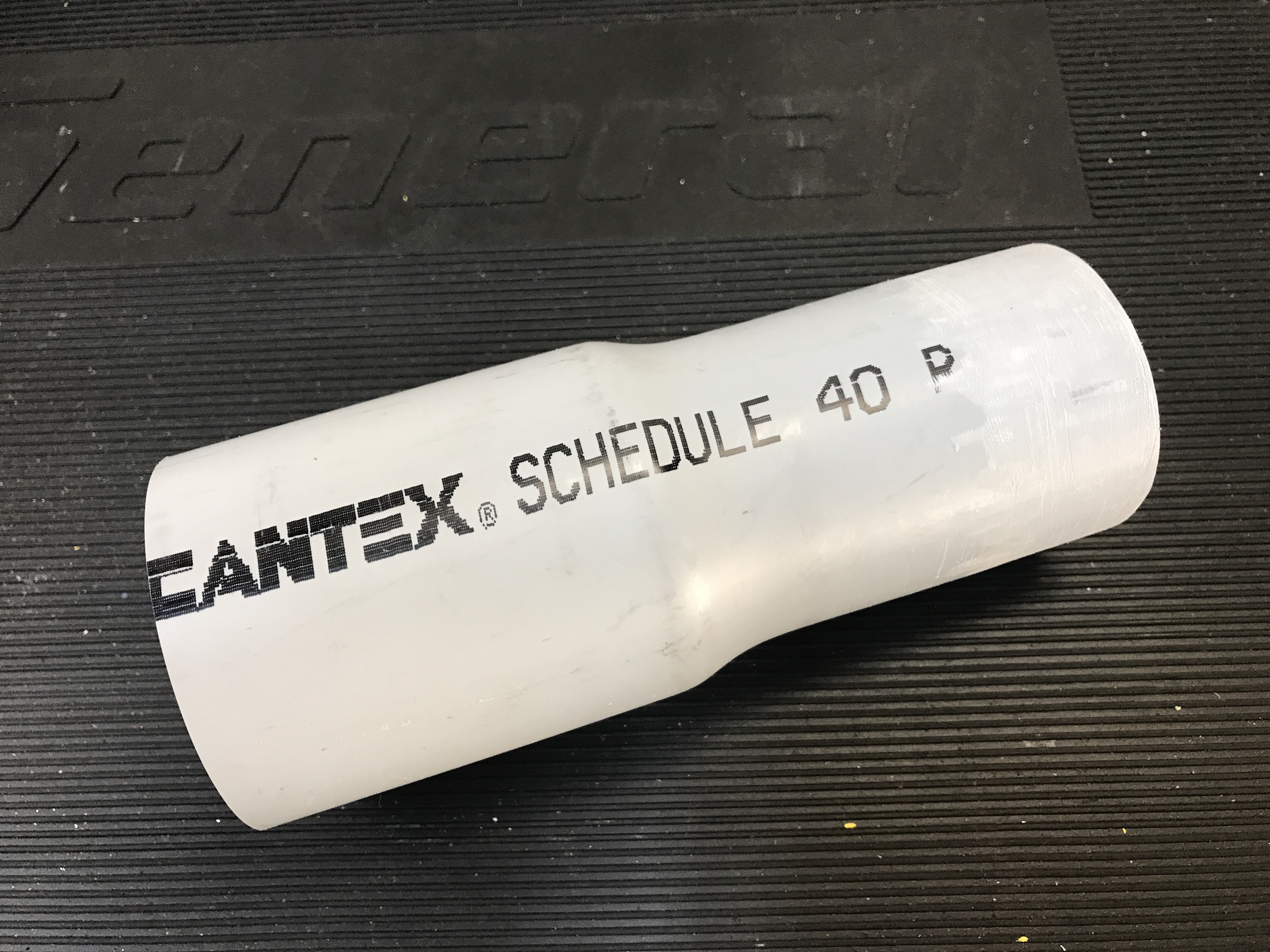

Before I put the wheels back on, I installed the center caps. Like many others, I made my own tool from a joint end of PVC pipe.
