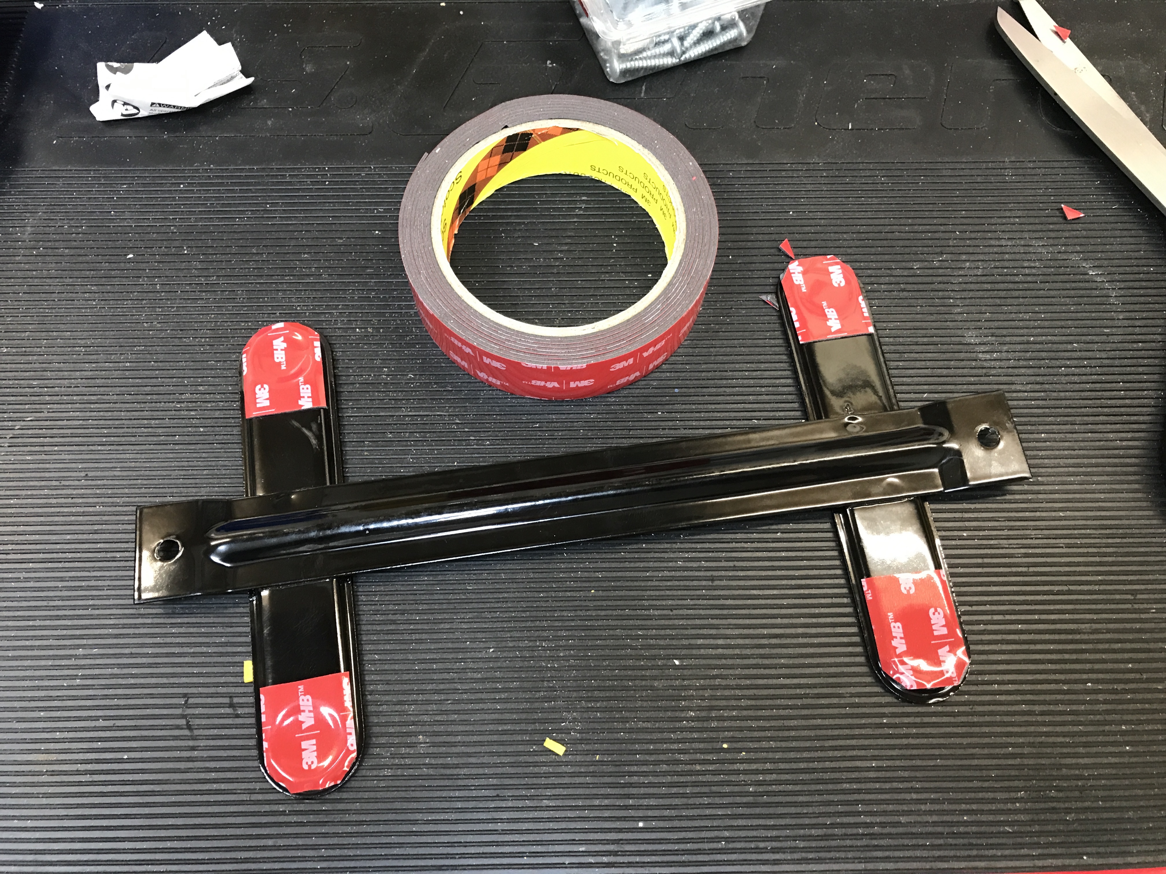

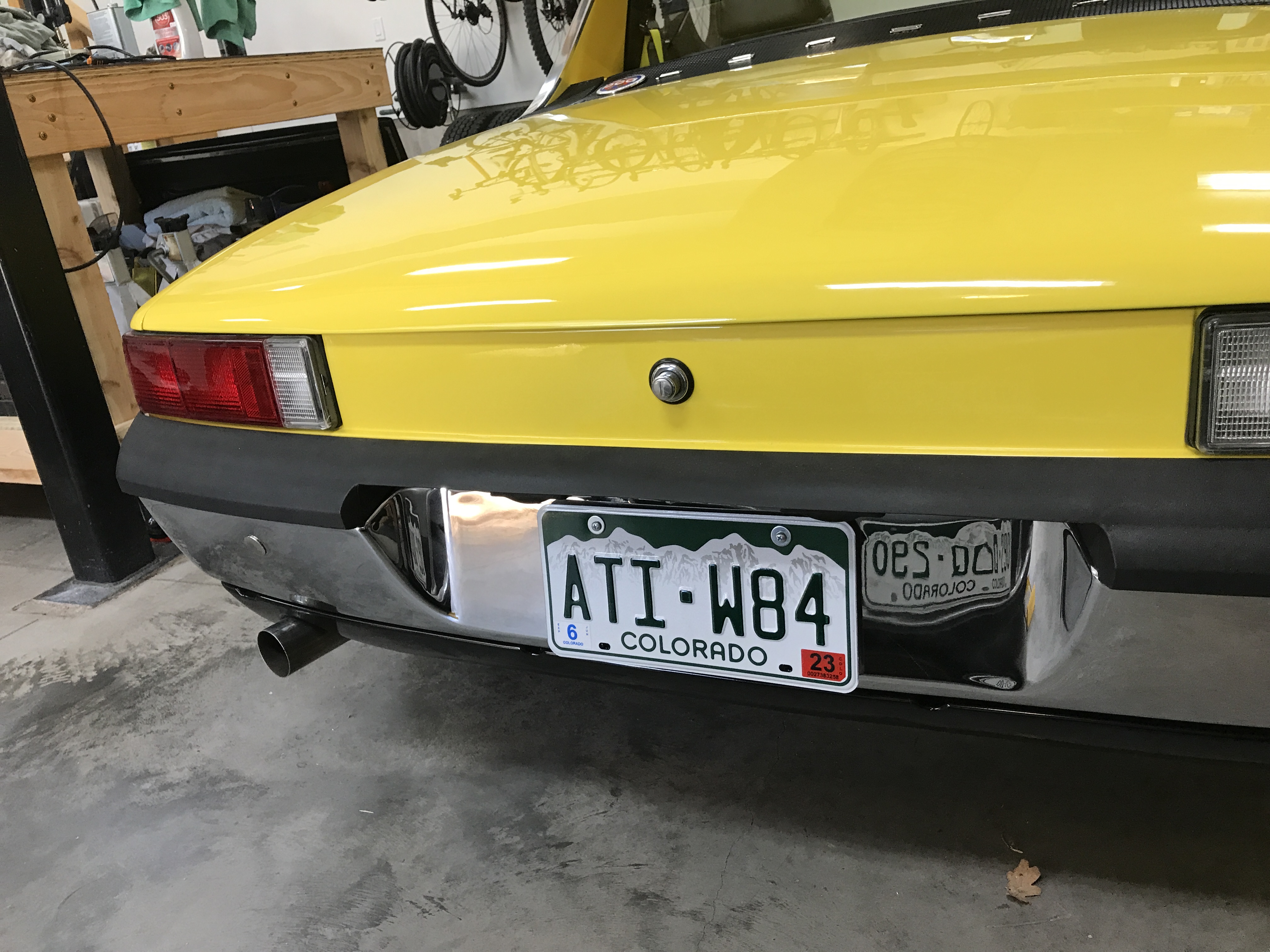

Still feeling paranoid about mounting the rear plate with little clearance, so I made some rubber pads behind the screw holes, and cut some screws down to about 1/4" long.
bkrantz
post Jun 23 2022, 08:18 PM
Post #5642
Posts: 8,673
Joined: 3-August 19
From: SW Colorado
Member No.: 23,343
Rear plate on.

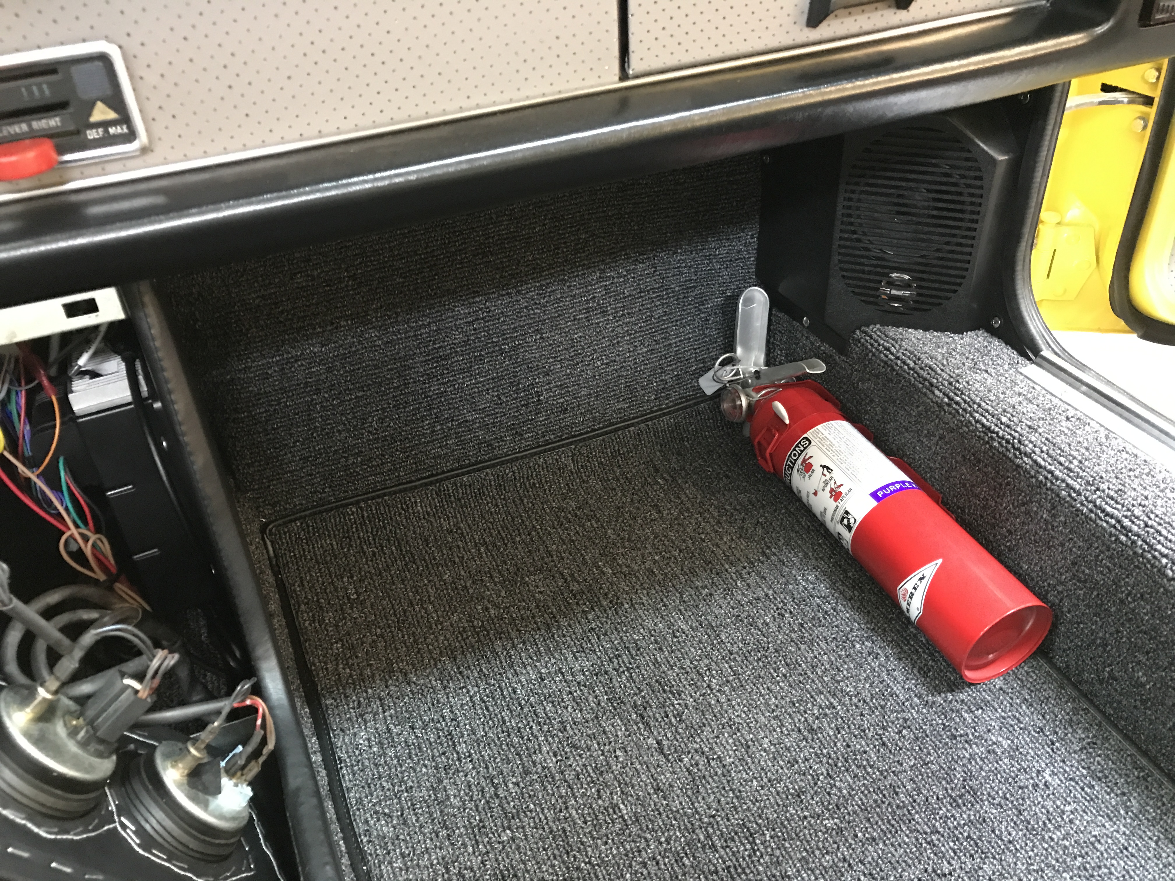

Now I need to mount my fire extinguisher someplace. I have one in every car, and especially want one in my 914. So far, I like this location best. Any other ideas?

When you auto-crossing this car?
I mean that's the most important thing at this point, eh?
Ha
Car looks great....too great. (IMG:style_emoticons/default/tongue.gif)
Cairo94507
post Jun 24 2022, 06:26 AM
Post #5646
Michael
Posts: 10,618
Joined: 1-November 08
From: Auburn, CA
Member No.: 9,712
I love your car; is it possible to fabricate a bracket to attach the fire extinguisher to the bottom front of the passenger seat? (IMG:style_emoticons/default/beerchug.gif)

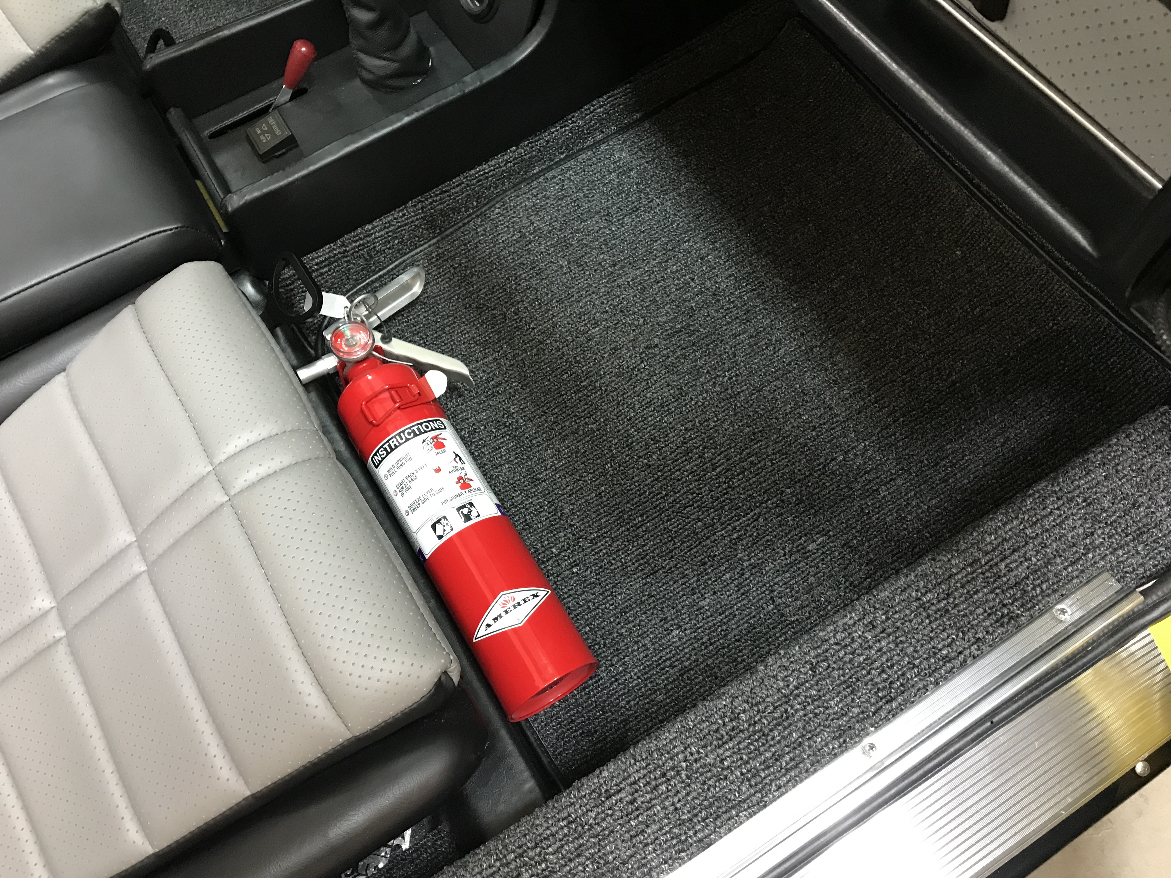

QUOTE(Cairo94507 @ Jun 24 2022, 06:26 AM) *
Check out below.
bkrantz
post Jun 24 2022, 07:33 PM
Post #5649
Posts: 8,673
Joined: 3-August 19
From: SW Colorado
Member No.: 23,343

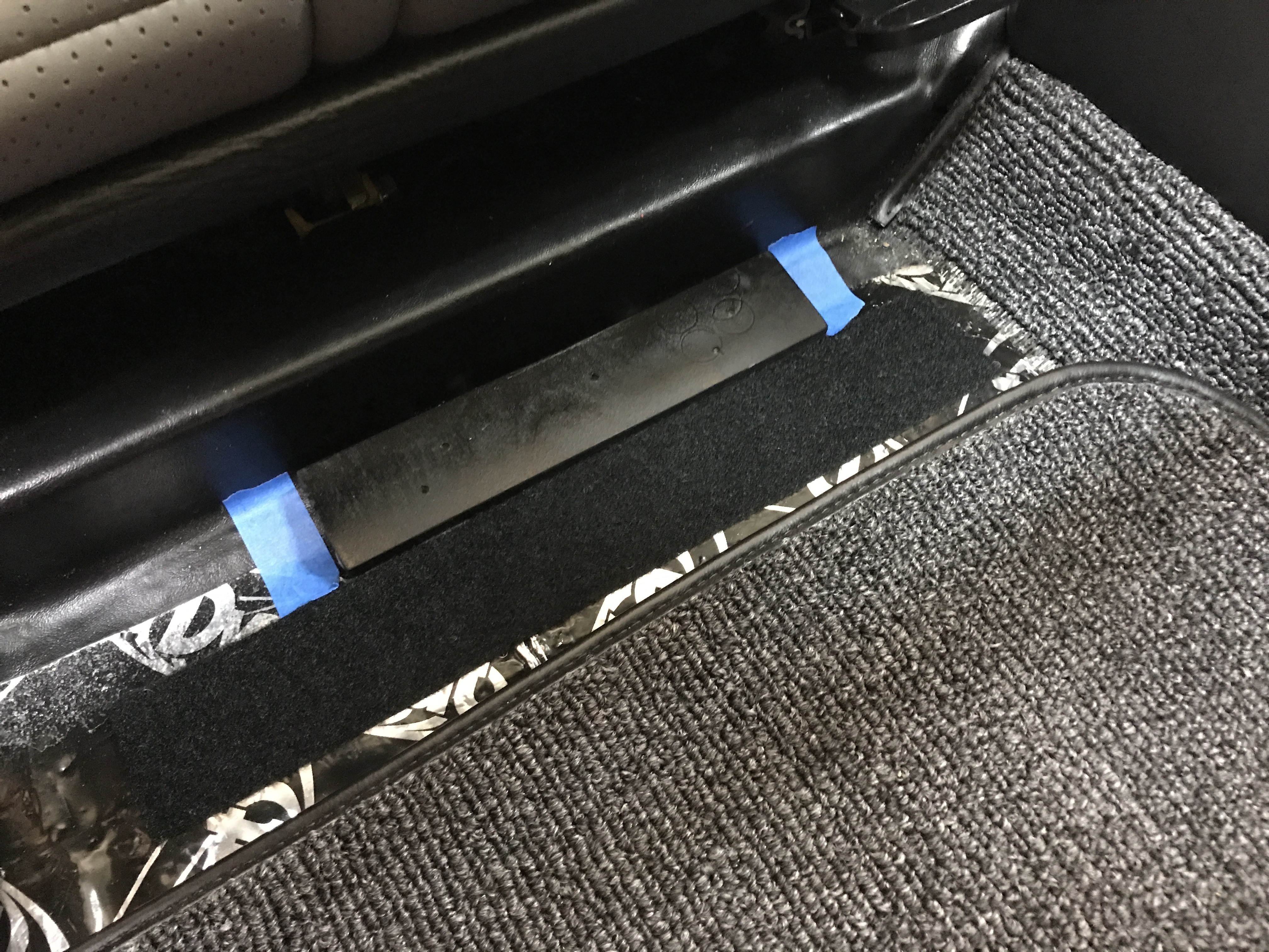

I decided to try this position, as most out of the way, protected for the trigger, and in reach of the driver. I thought about creating a bracket to bolt to the seat rails or bottom, and might try that someday.
bkrantz
post Jun 24 2022, 07:36 PM
Post #5650
Posts: 8,673
Joined: 3-August 19
From: SW Colorado
Member No.: 23,343

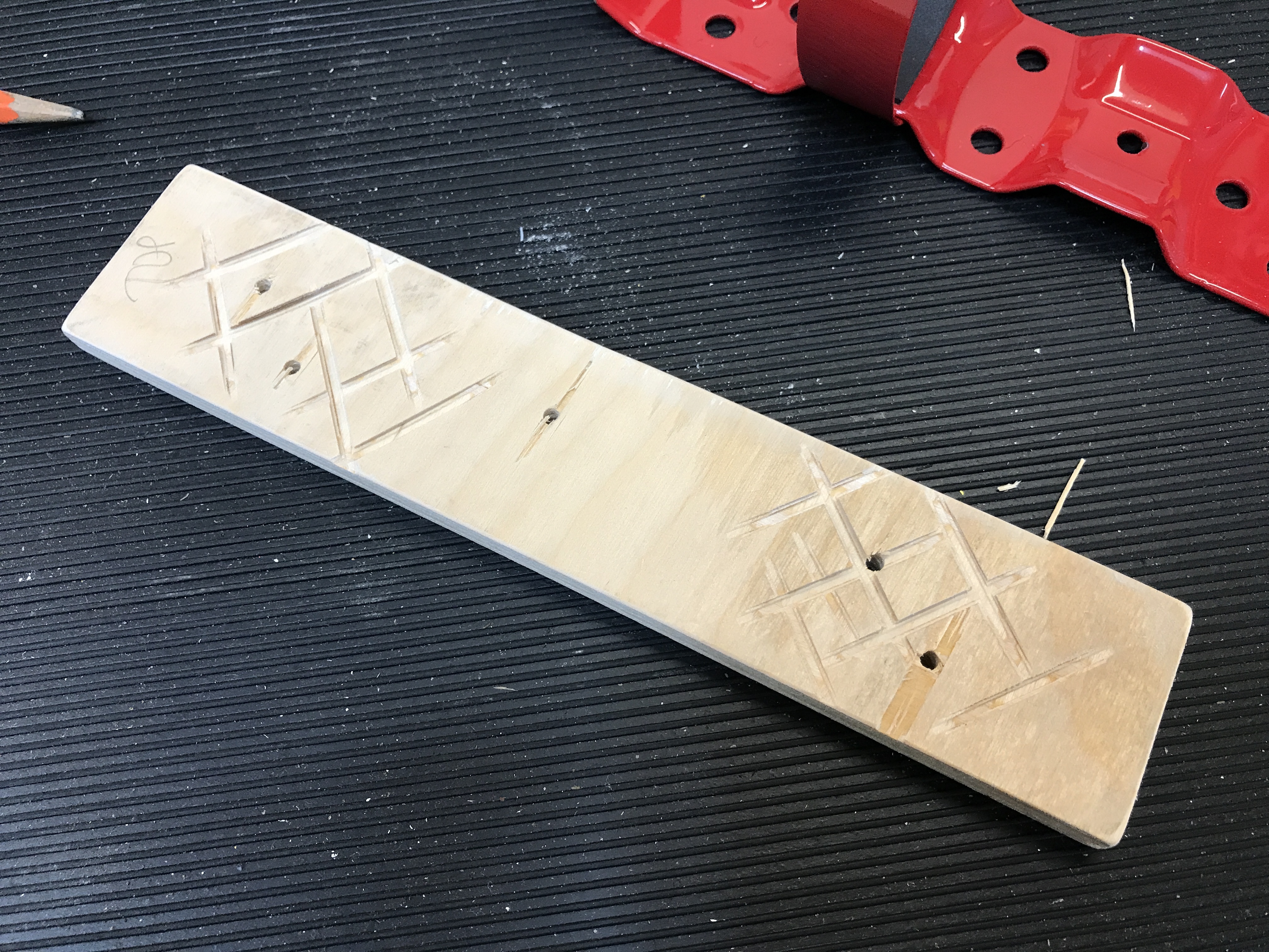

Meanwhile, I will try screwing the bracket into a plywood block that I will glue to the floor. I figure this is smarter than screwing directing into the floor.

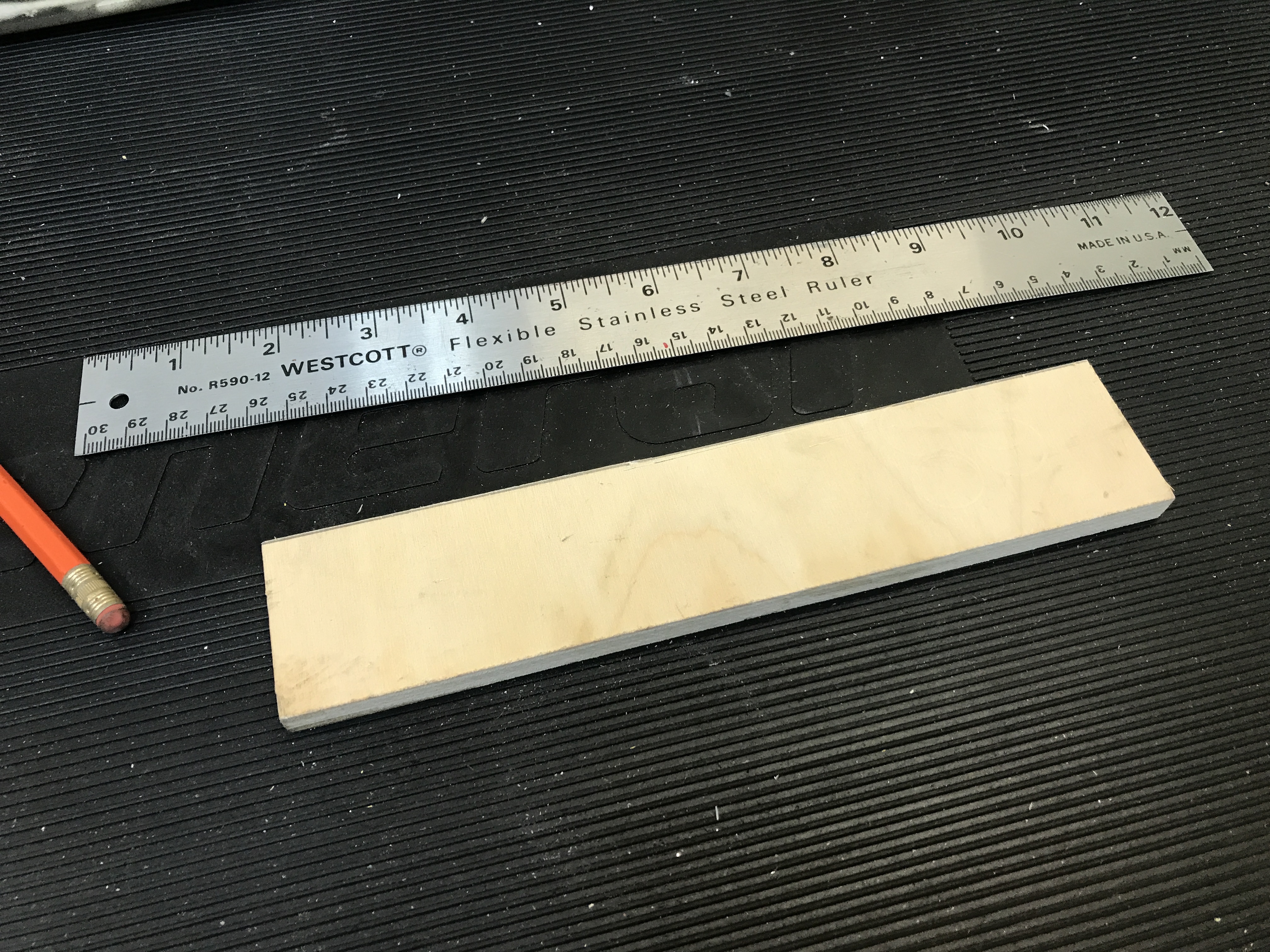

I used some hardwood plywood, about 5/16" thick.
bkrantz
post Jun 24 2022, 07:39 PM
Post #5652
Posts: 8,673
Joined: 3-August 19
From: SW Colorado
Member No.: 23,343
I drilled some holes for mounting screws, and scored some grooves for better gluing.
bkrantz
post Jun 24 2022, 07:40 PM
Post #5653
Posts: 8,673
Joined: 3-August 19
From: SW Colorado
Member No.: 23,343
I have this all purpose magic construction adhesive. We'll see.

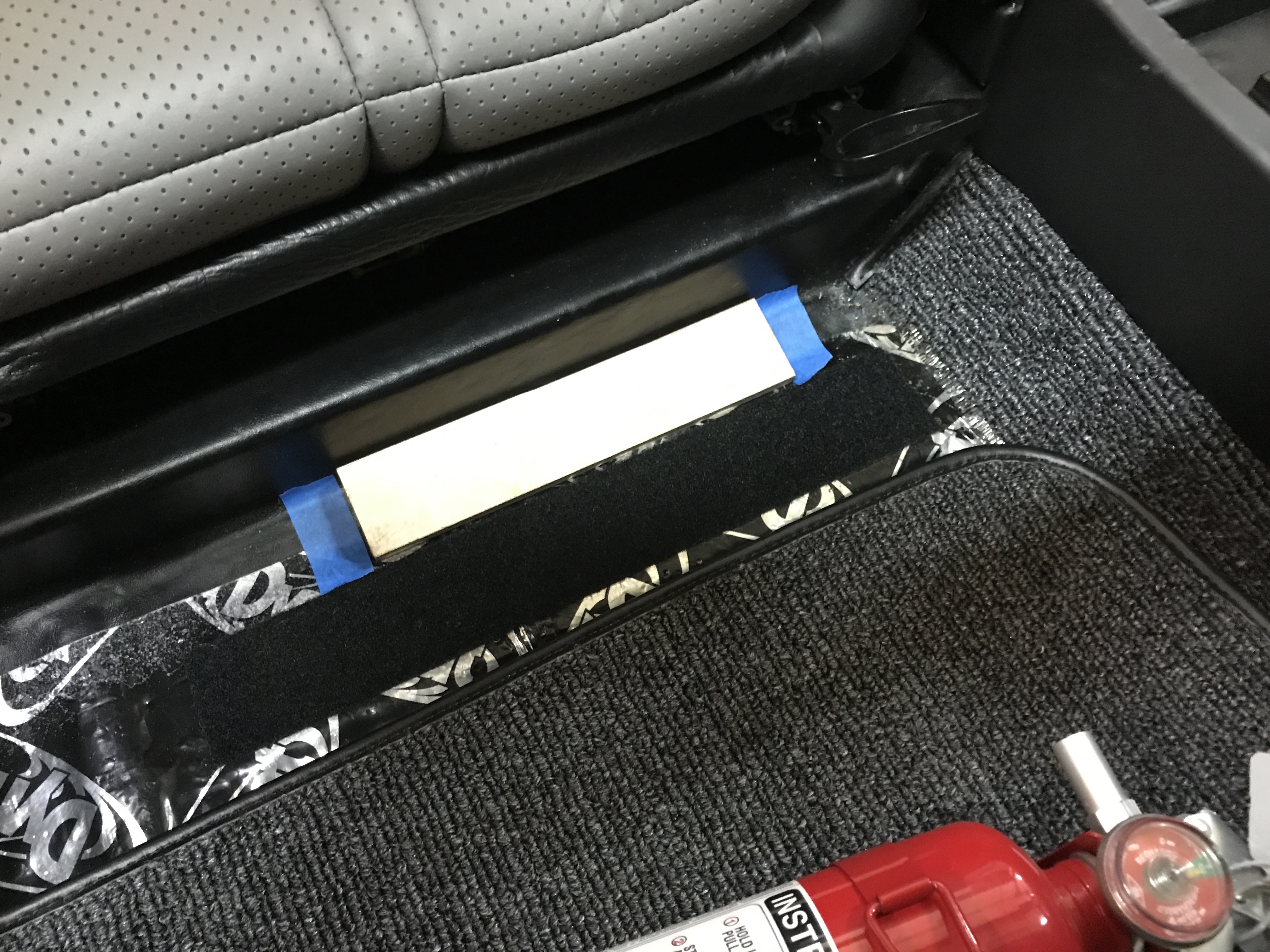

I painted the strip black and glued it in place. Tomorrow I will see how strong the attachment is.

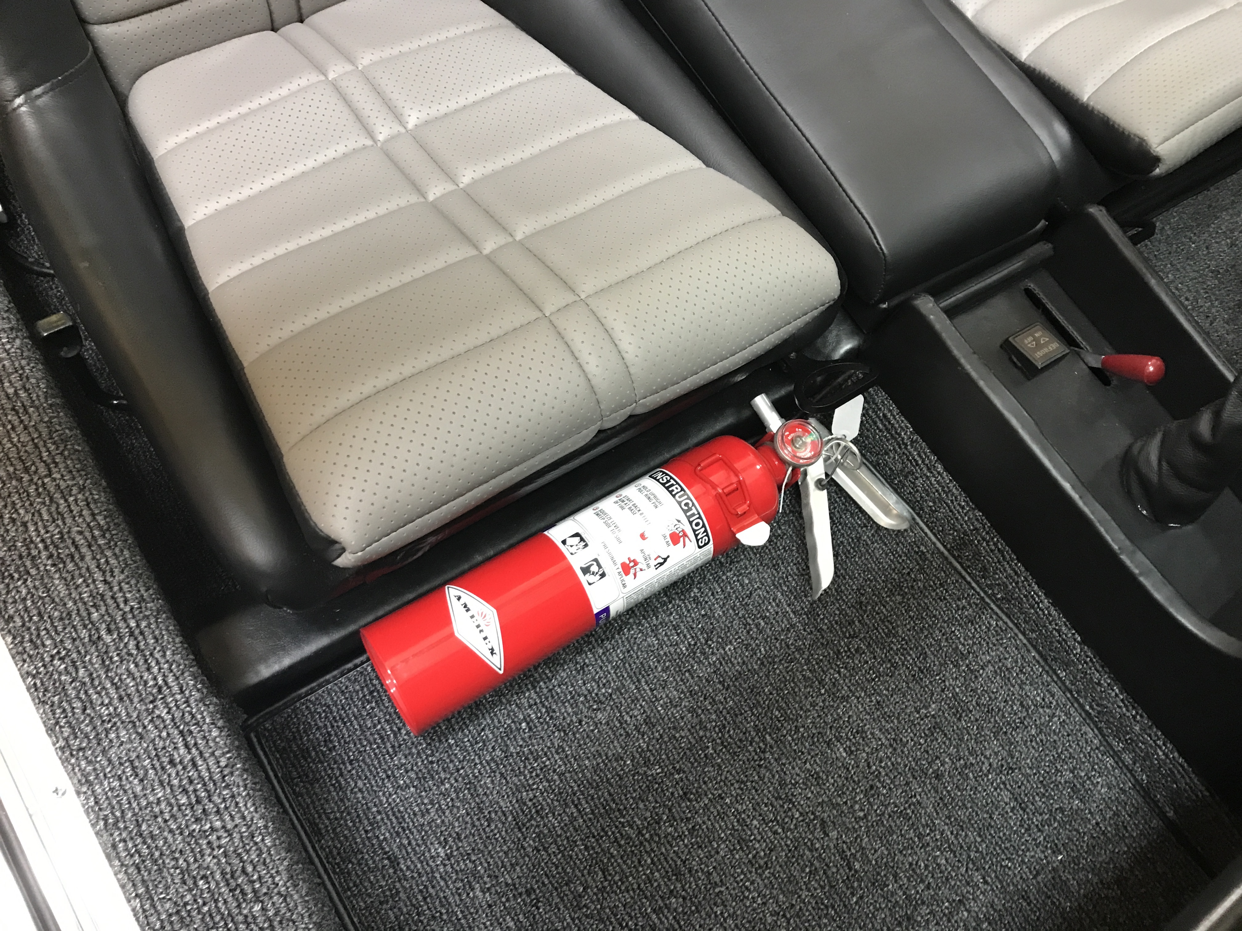

QUOTE(FlacaProductions @ Jun 24 2022, 08:43 PM) *
Fully on board with the extinguisher but thoughts on doing a vinyl wrap or painting that fire bottle black or something - unless there is some rule against it? That interior and the whole car, quiet honestly is too nice and could do without that bright red visual distraction.
Interesting idea. See below for views.

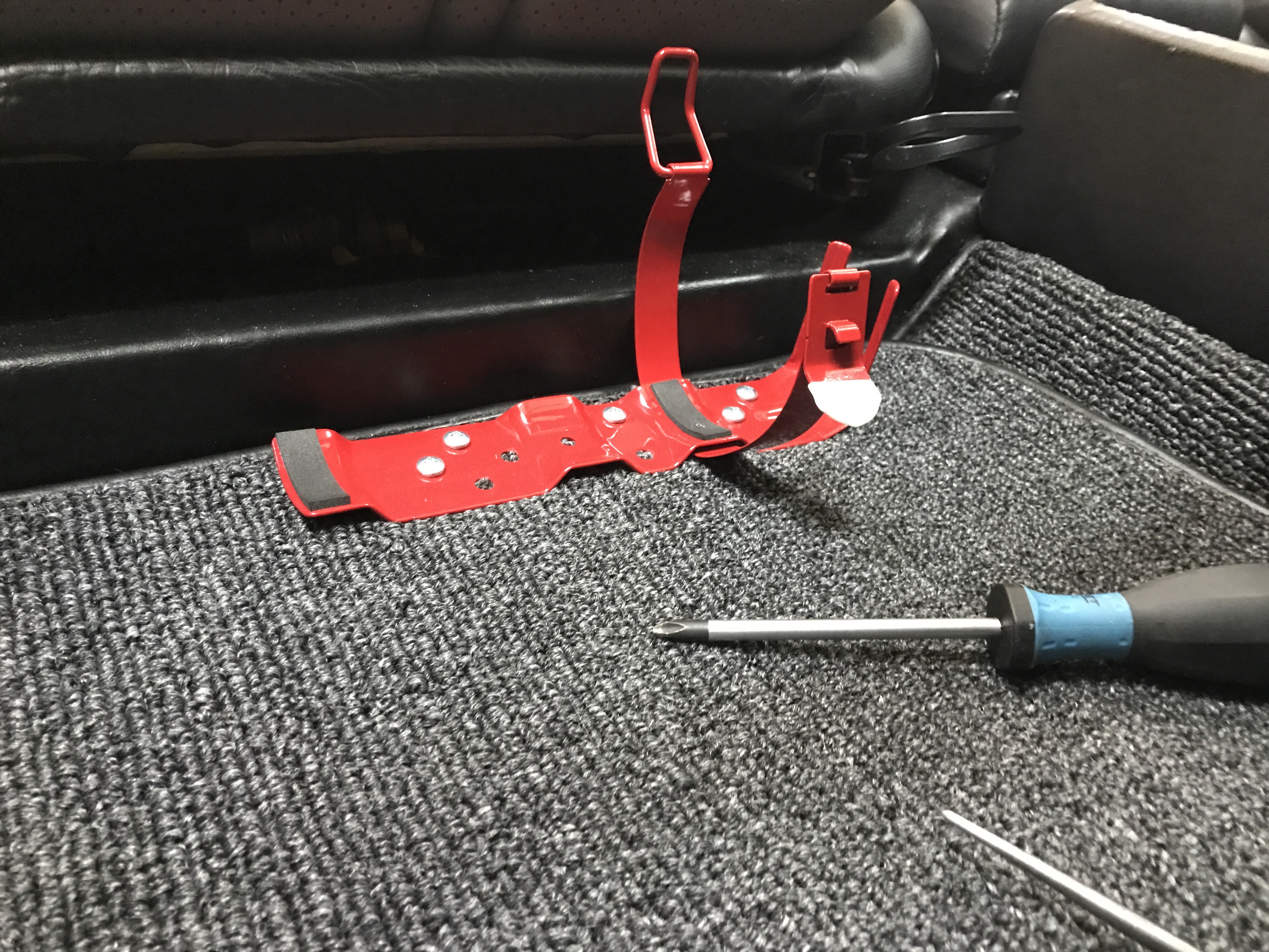

The plywood seems pretty well stuck on, so I screwed the bracket in place.
bkrantz
post Jun 25 2022, 07:57 PM
Post #5658
Posts: 8,673
Joined: 3-August 19
From: SW Colorado
Member No.: 23,343
Fire extinguisher attached.

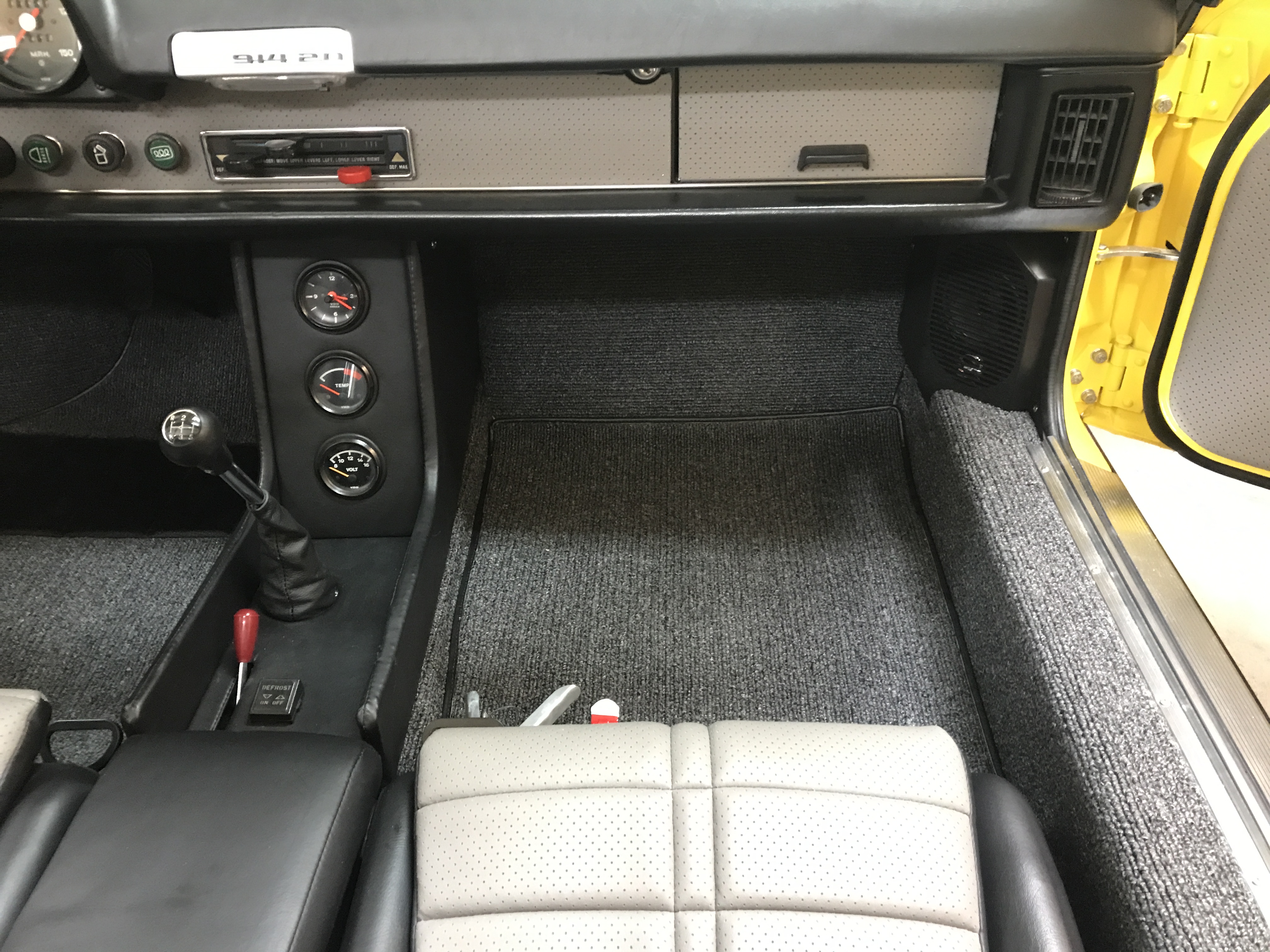

Member No.: 23,343

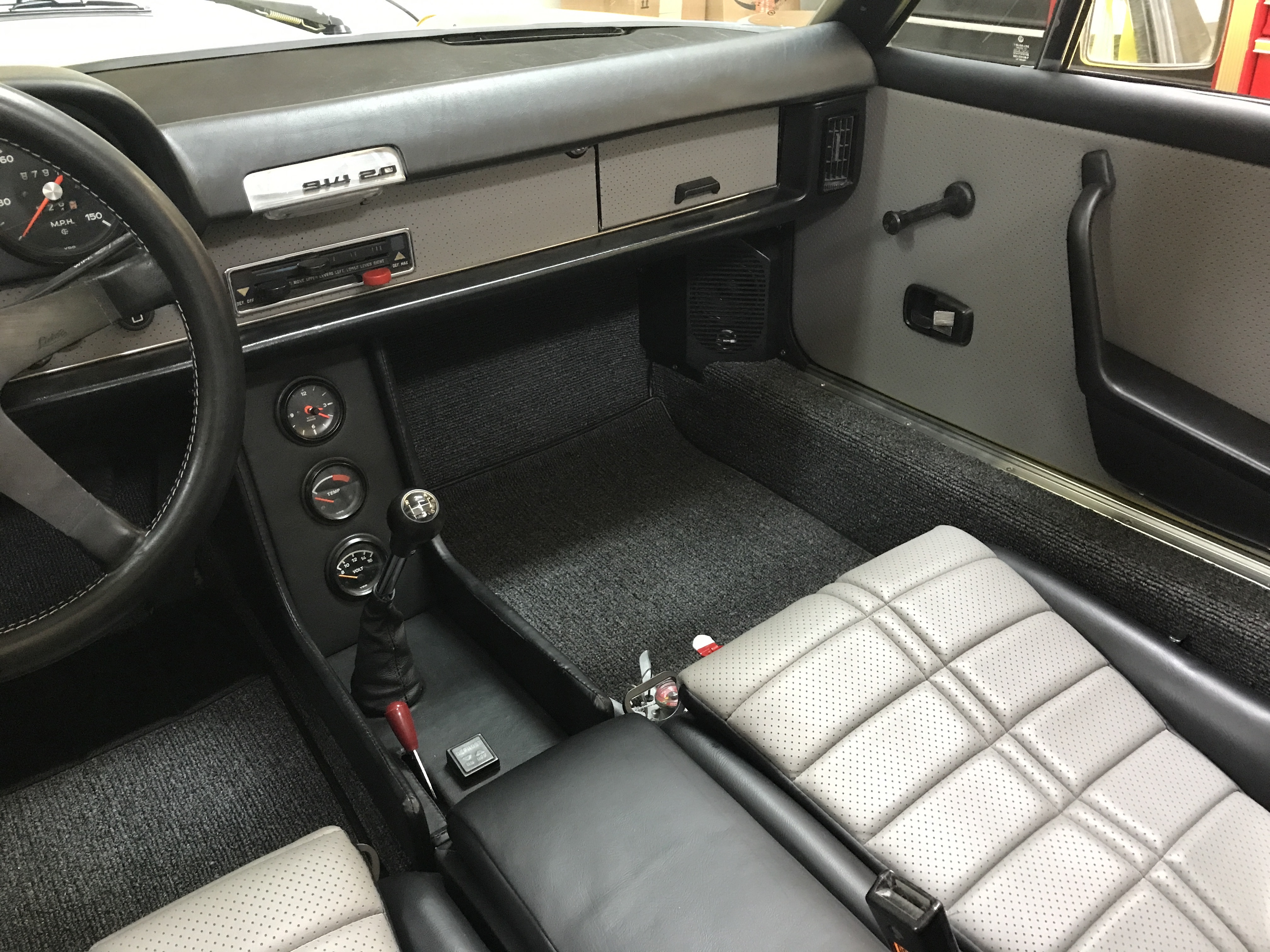

New from the passenger seat.
bkrantz
post Jun 25 2022, 07:59 PM
Post #5660
Posts: 8,673
Joined: 3-August 19
From: SW Colorado
Member No.: 23,343
View from driver seat. I can also reach the extinguisher while seated.
