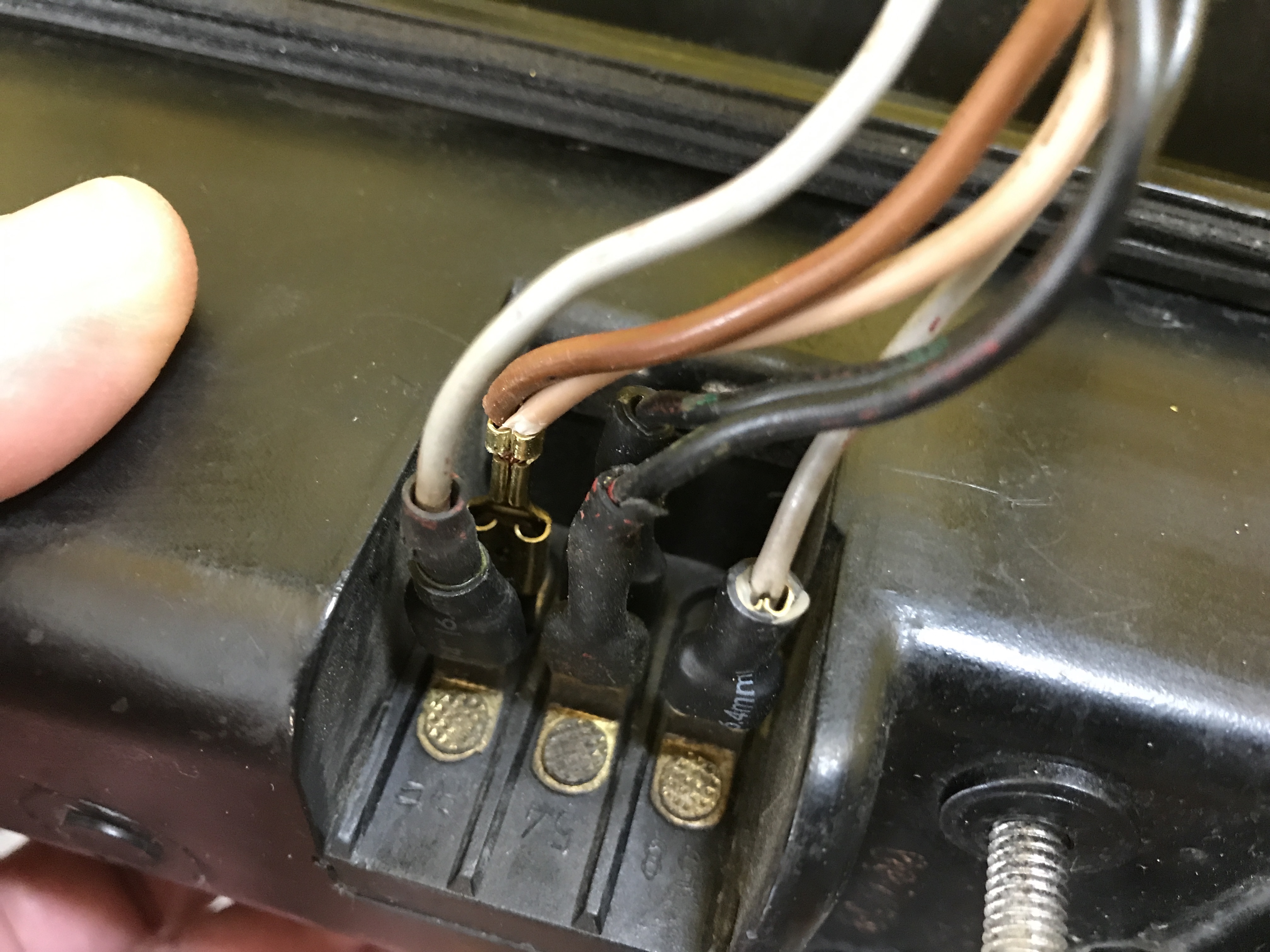

The electrical schematic I have does not have complete number codes for the tail lights. Here's a picture of the leads on my left light.

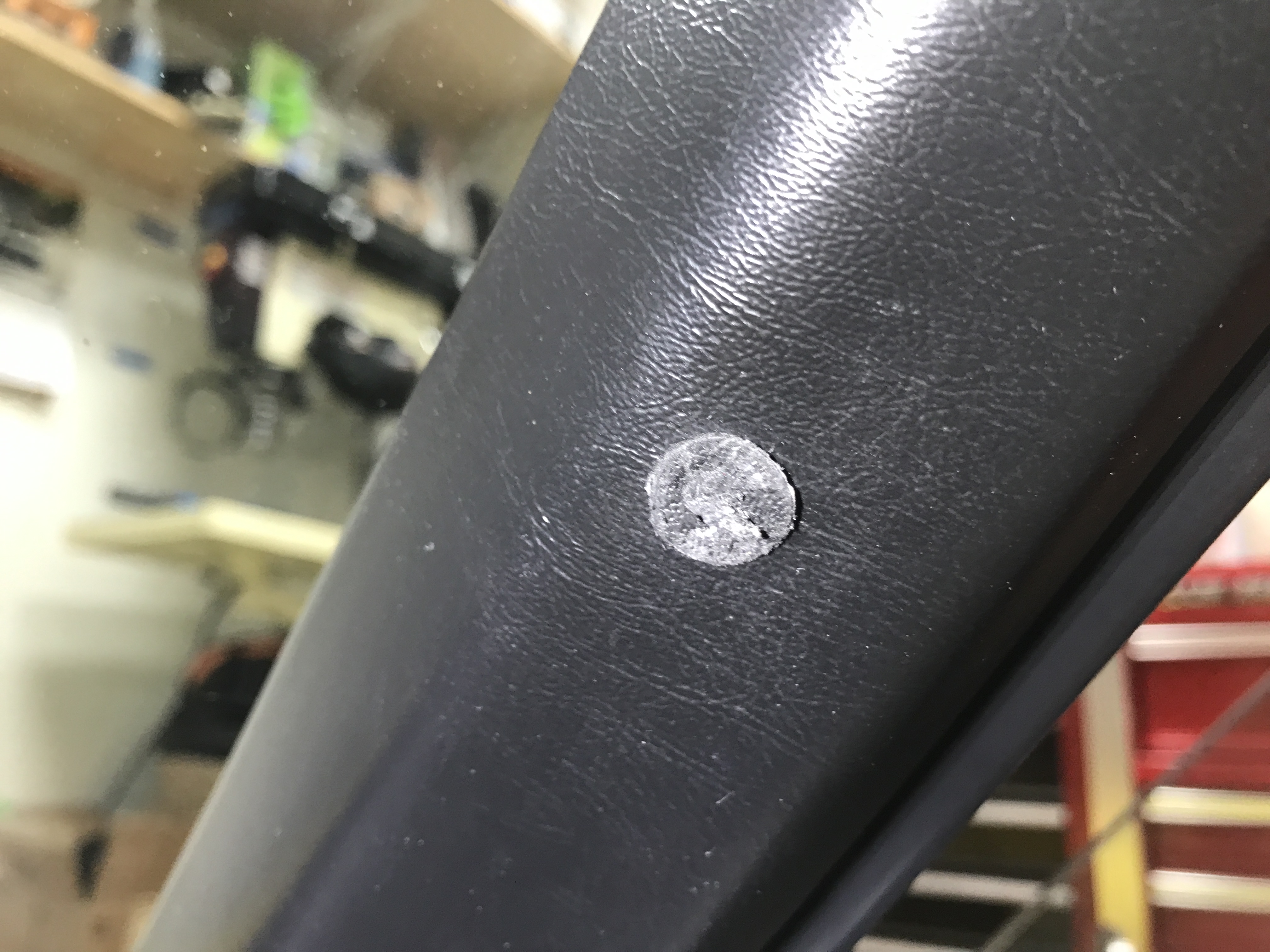

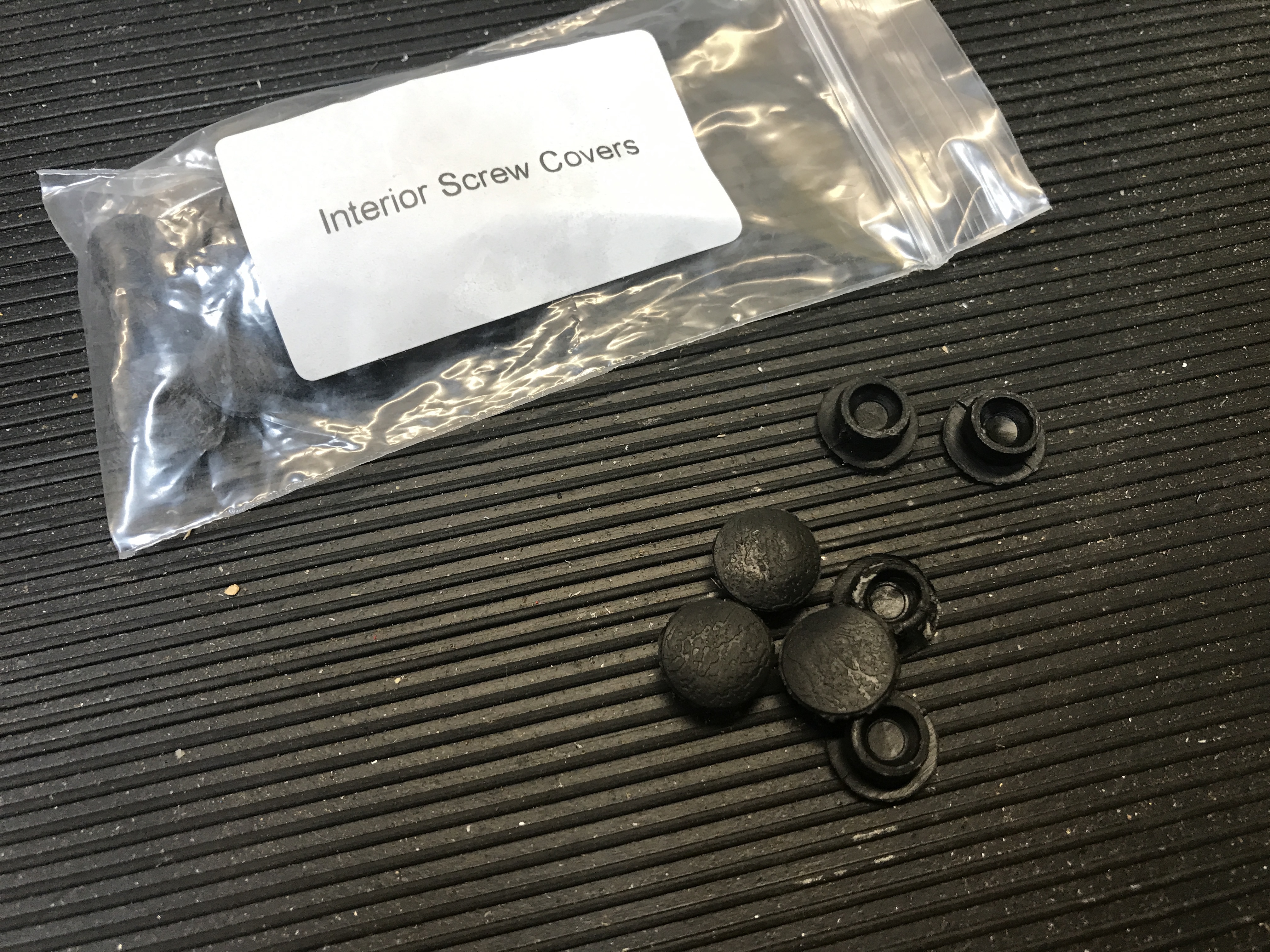

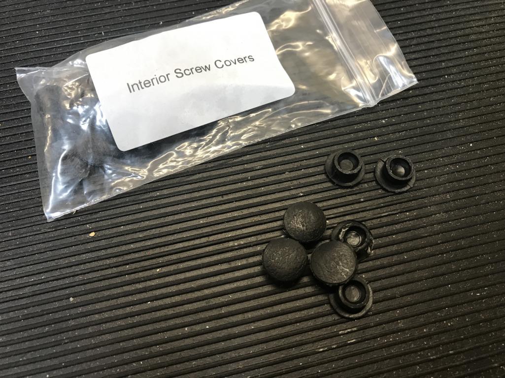

I got out the repro screw covers for the interior.
bkrantz
post Jun 26 2022, 08:24 PM
Post #5670
Posts: 8,673
Joined: 3-August 19
From: SW Colorado
Member No.: 23,343
They are soft, and squish in but don't hold their shape. And the surface gets flaky.

From: SW Colorado
Member No.: 23,343

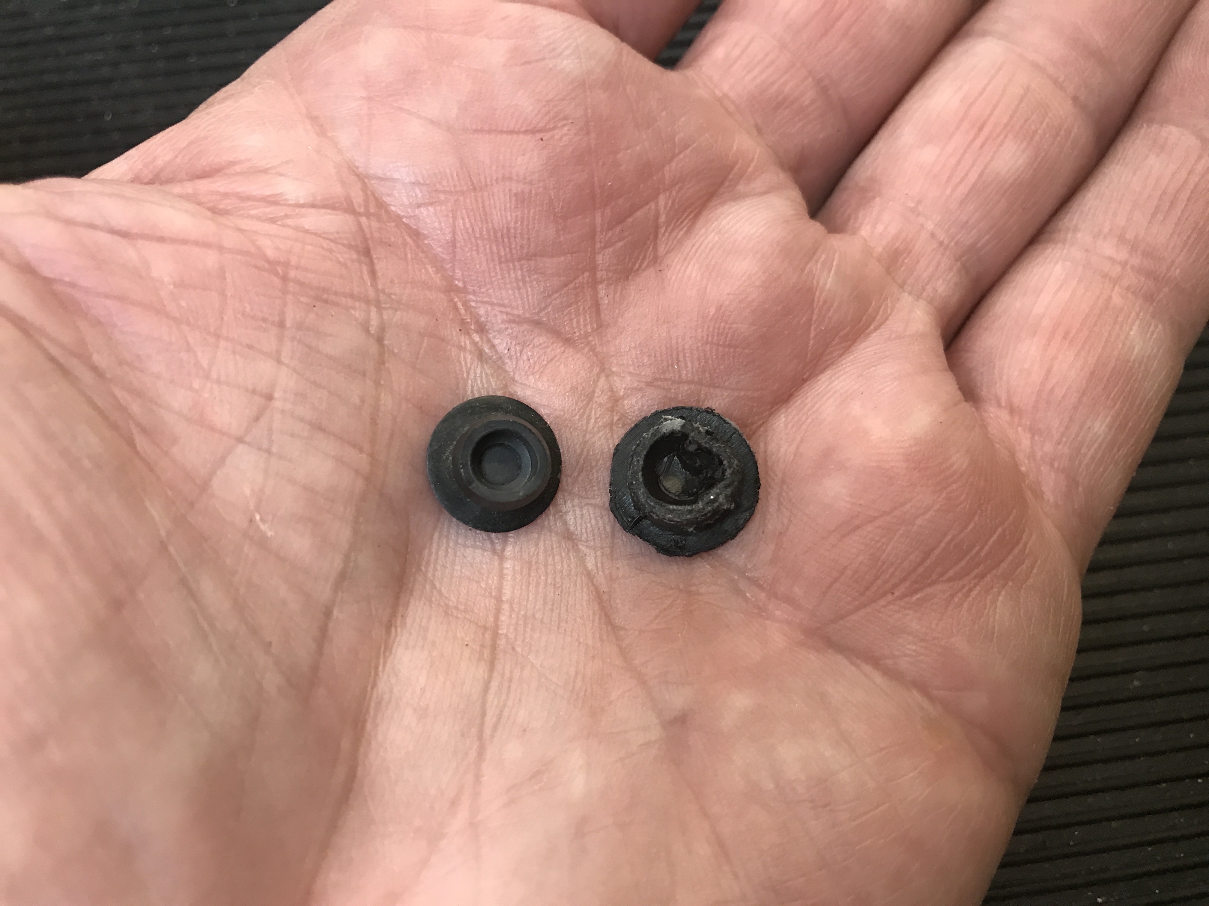

Compared to the original (left) that are stiff plastic.

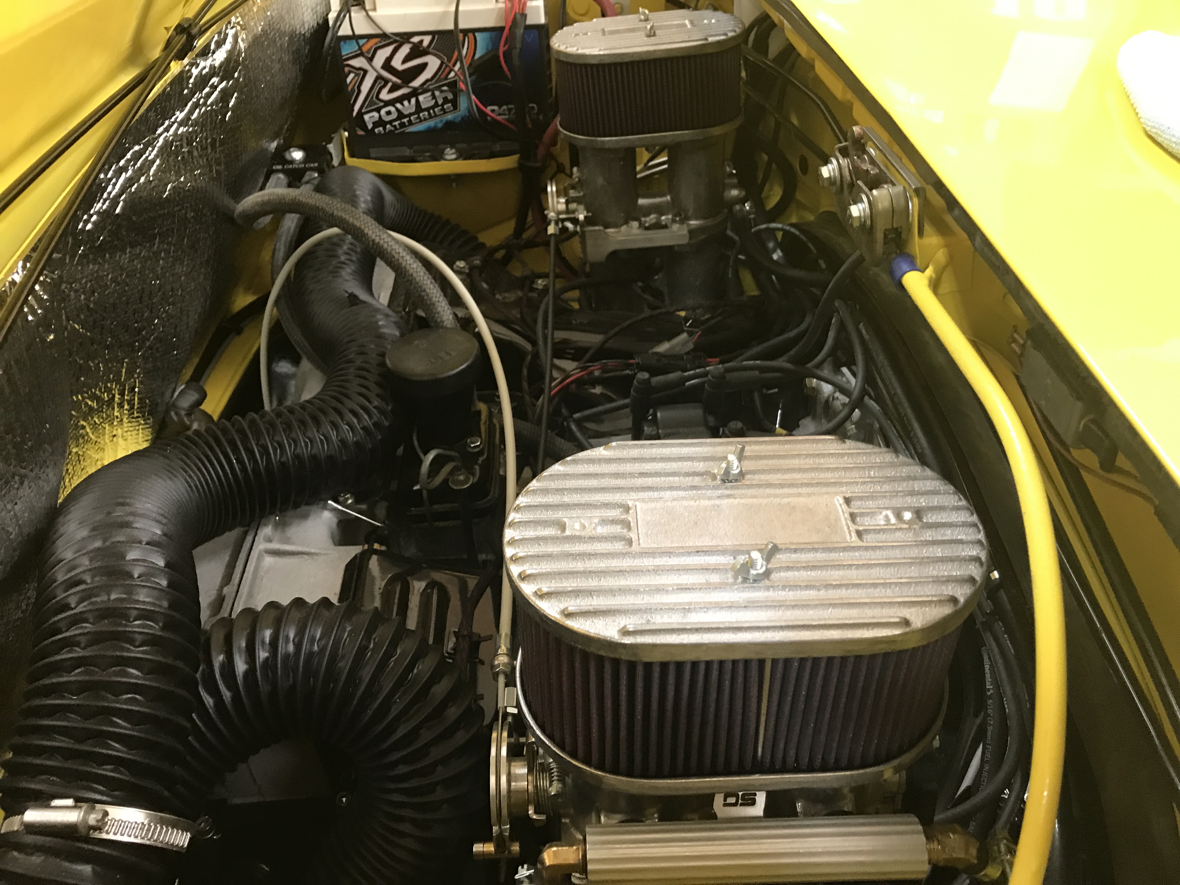

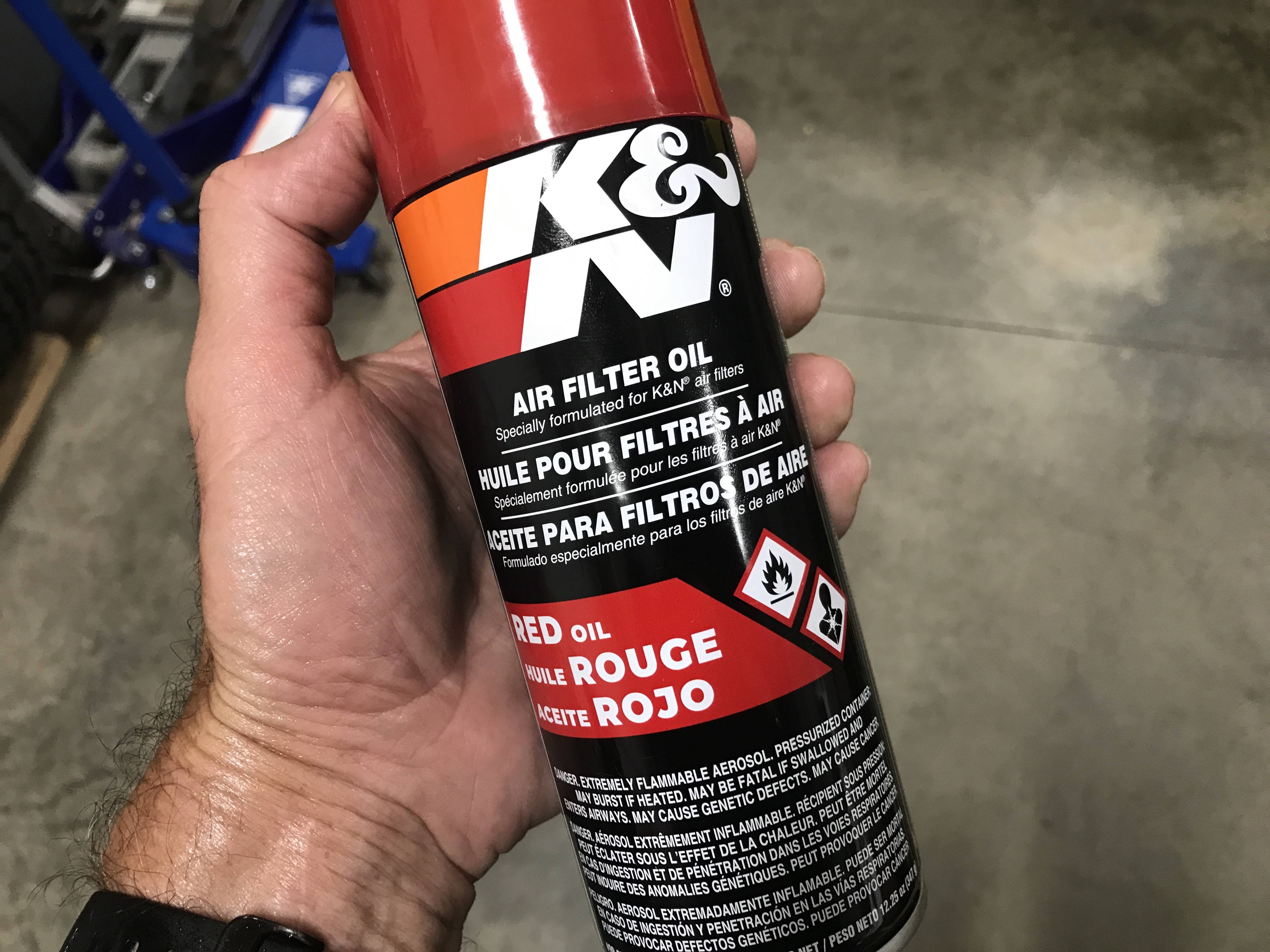

bkrantz
post Jun 26 2022, 08:38 PM
Post #5673
Posts: 8,673
Joined: 3-August 19
From: SW Colorado
Member No.: 23,343

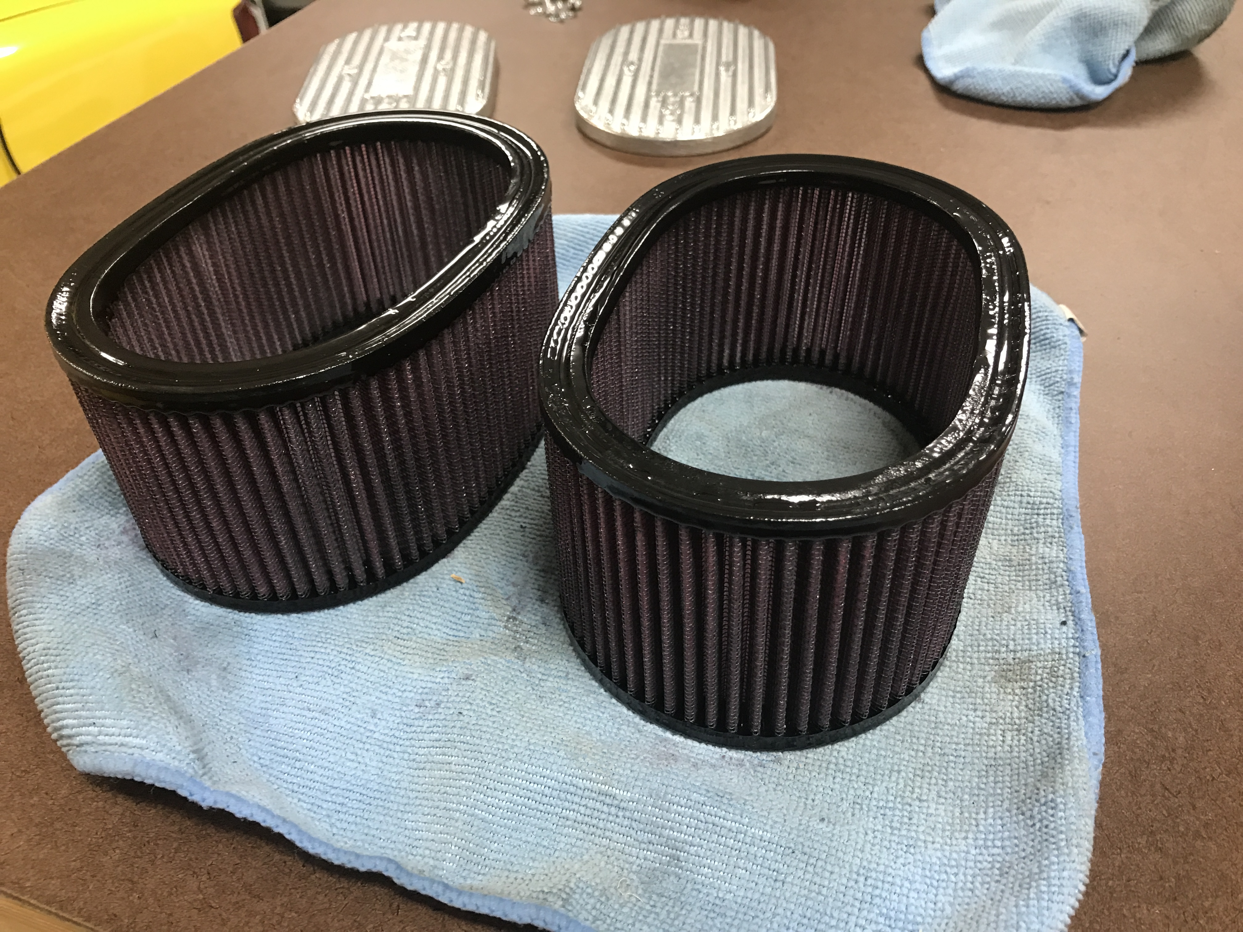

And I gave the air filters a moderately heavy spray for the first treatment, and left them out for the carrier to evaporate.

Member No.: 23,343
I had just a few minutes today, so I re-installed the air filters.

Joined: 3-August 19
From: SW Colorado
Member No.: 23,343
Yup, another task off the list.

If by outer panels you mean the top covers or the plastic light surrounds, then yes, they go on after installing the mechanism.
I do not know about a source to decode the tail light terminals. Once you have the ground wire on the correct tab, you can figure out the others by trial.

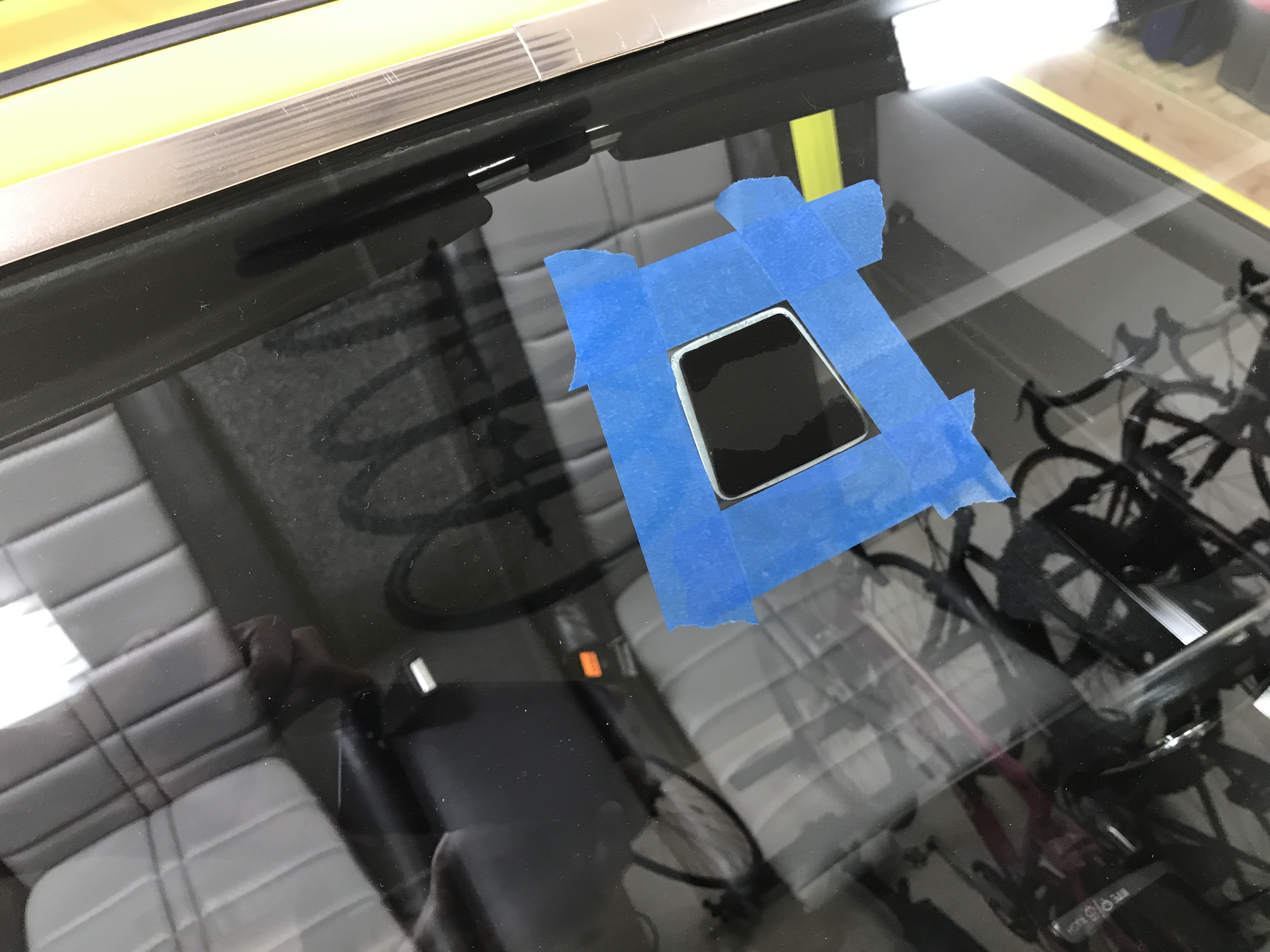

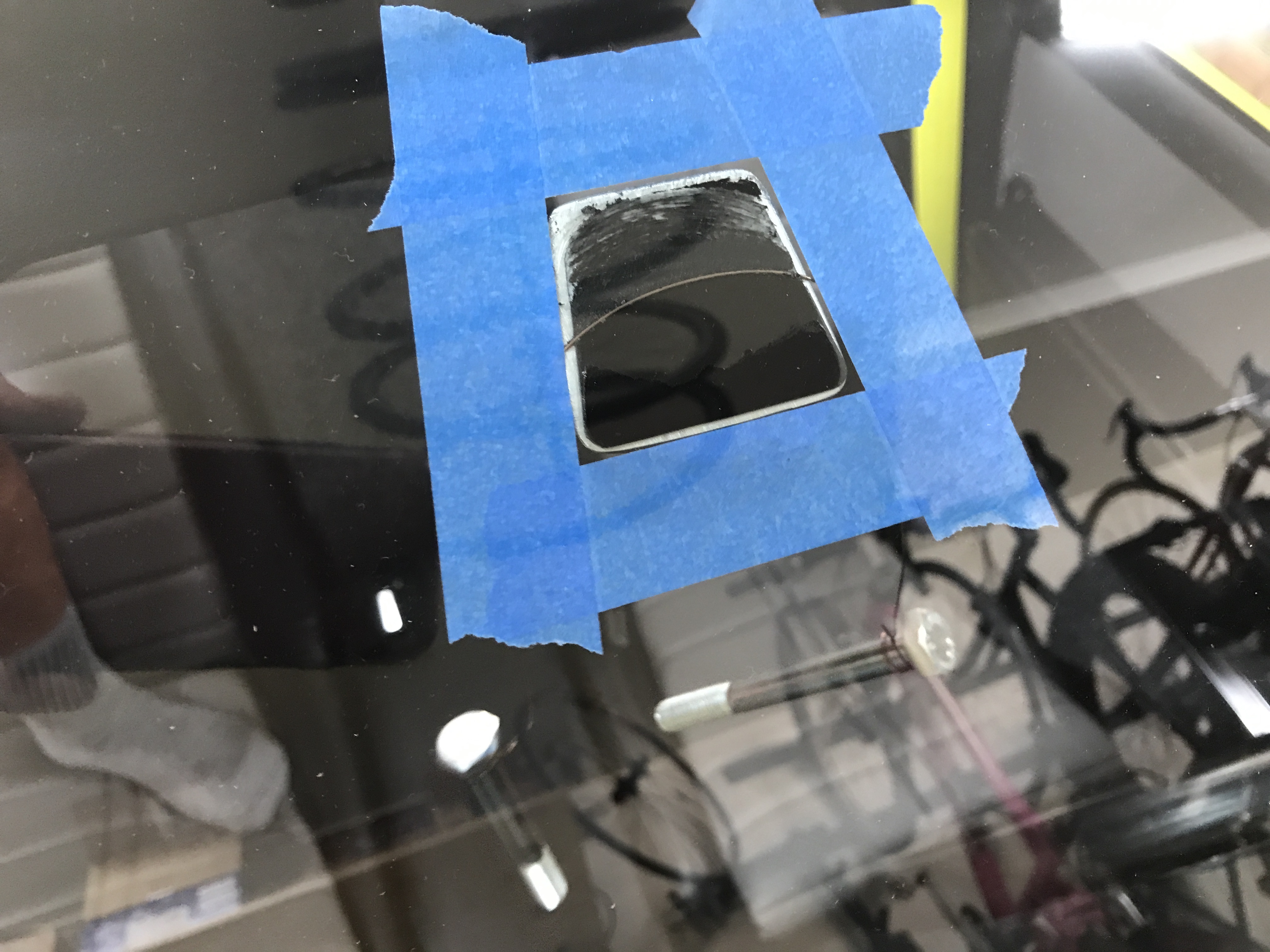

I got a replacement adhesive pad for the mirror mount, so I decided to see if I could improve the portion stuck to the glass. You might be able to see that after my last attempt, only a strip across the top and bottom shows adherence, and the middle is not stuck on.

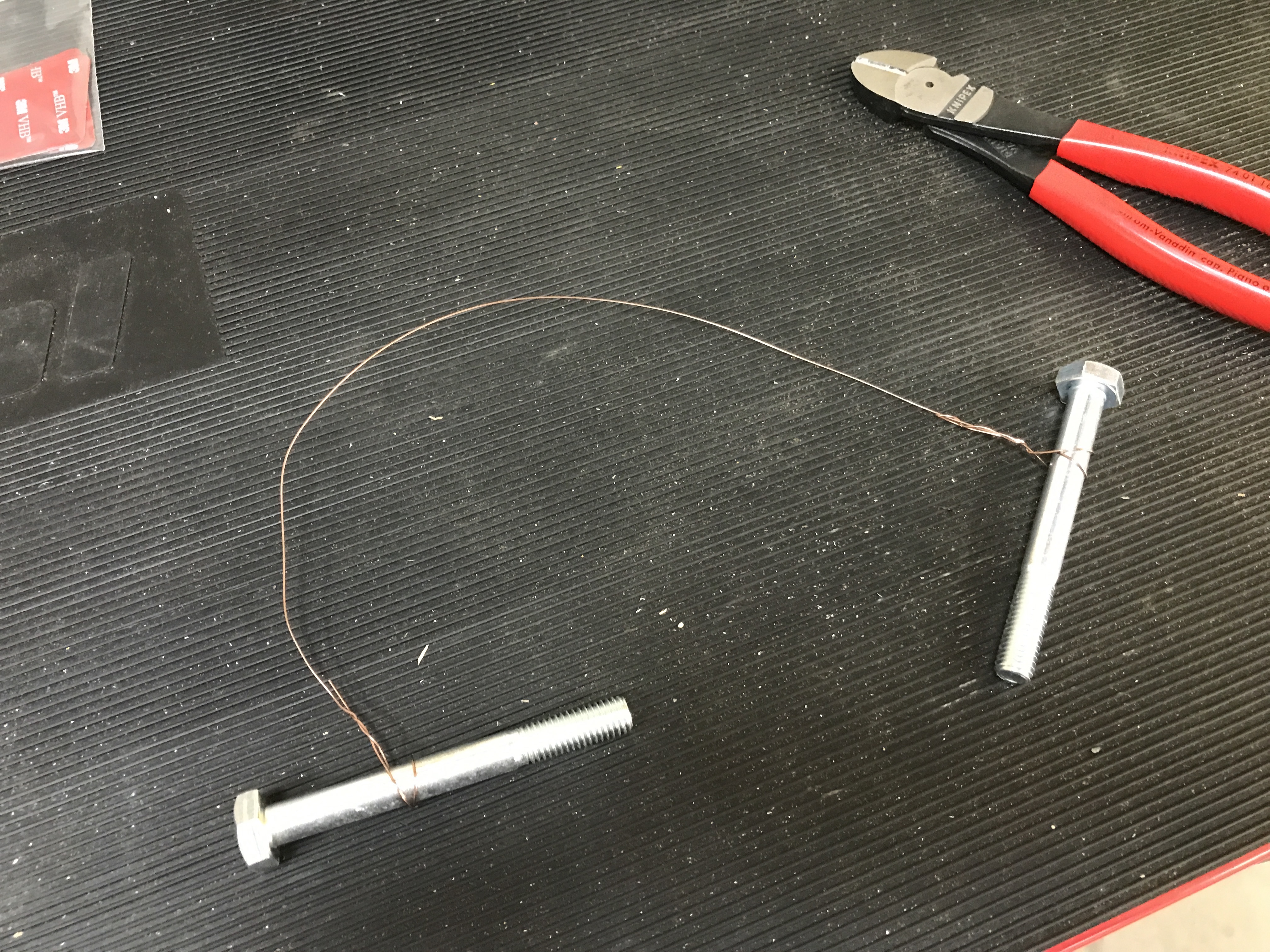

To cut through the adhesive, I made a wire garrote.

From: SW Colorado
Member No.: 23,343
Wire pulled about half way through.
