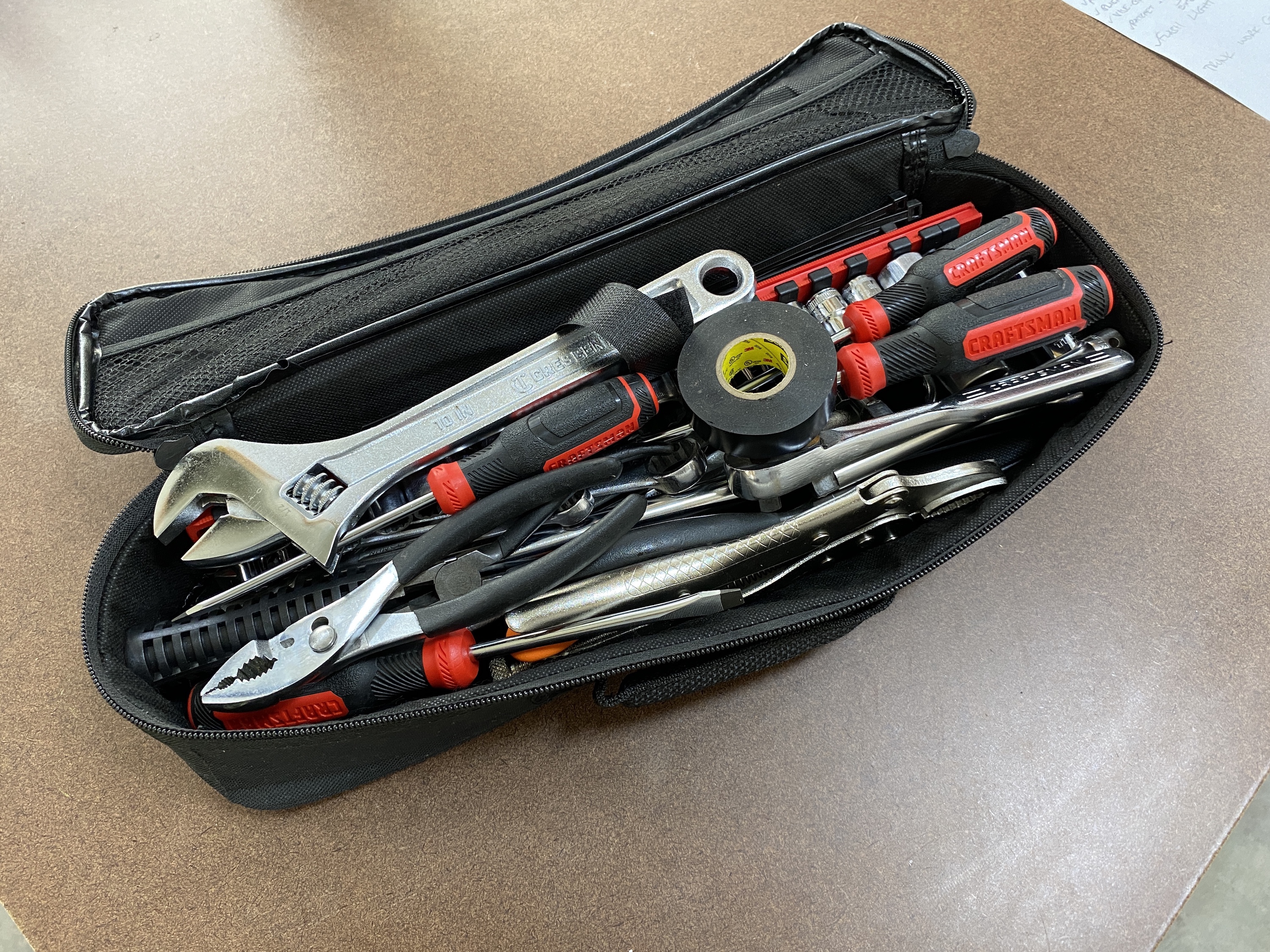

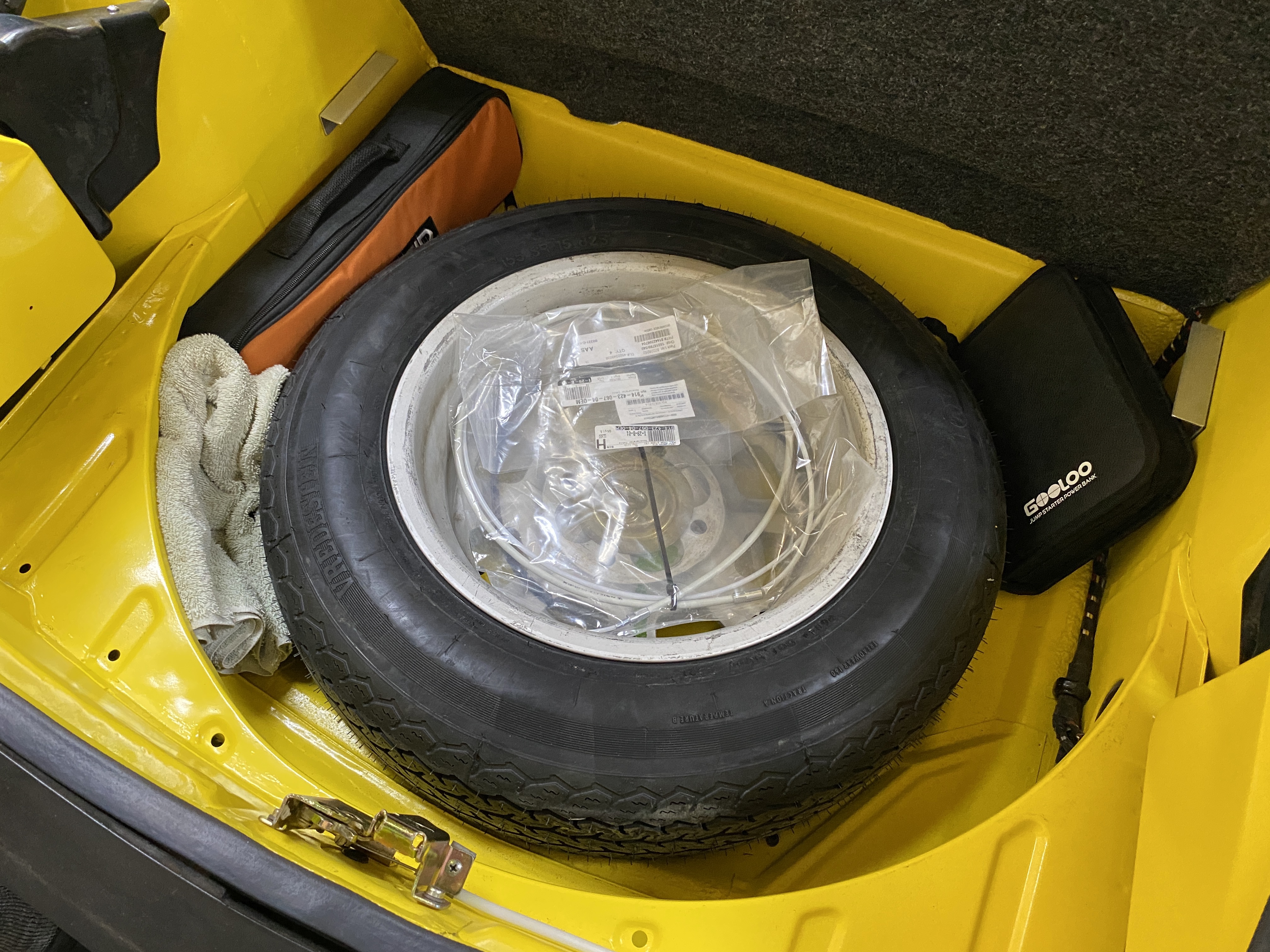

Every 914 needs a toolkit onboard, right? I have long been a fan of voodoo, at least the kind that seems to prevent any incidents I am prepared for. I grabbed some old tools and some new ones, and a tool bag that was sitting on a shelf. This includes wrenches, pliers, screw drivers, sockets (including a 19mm deep socket and breaker bar for lug bolts), and a few other things.

Good spot for the tool bag on the right side of the spare tire. I also stocked the usual clutch and throttle cables, plus another small bag with electrical spares.

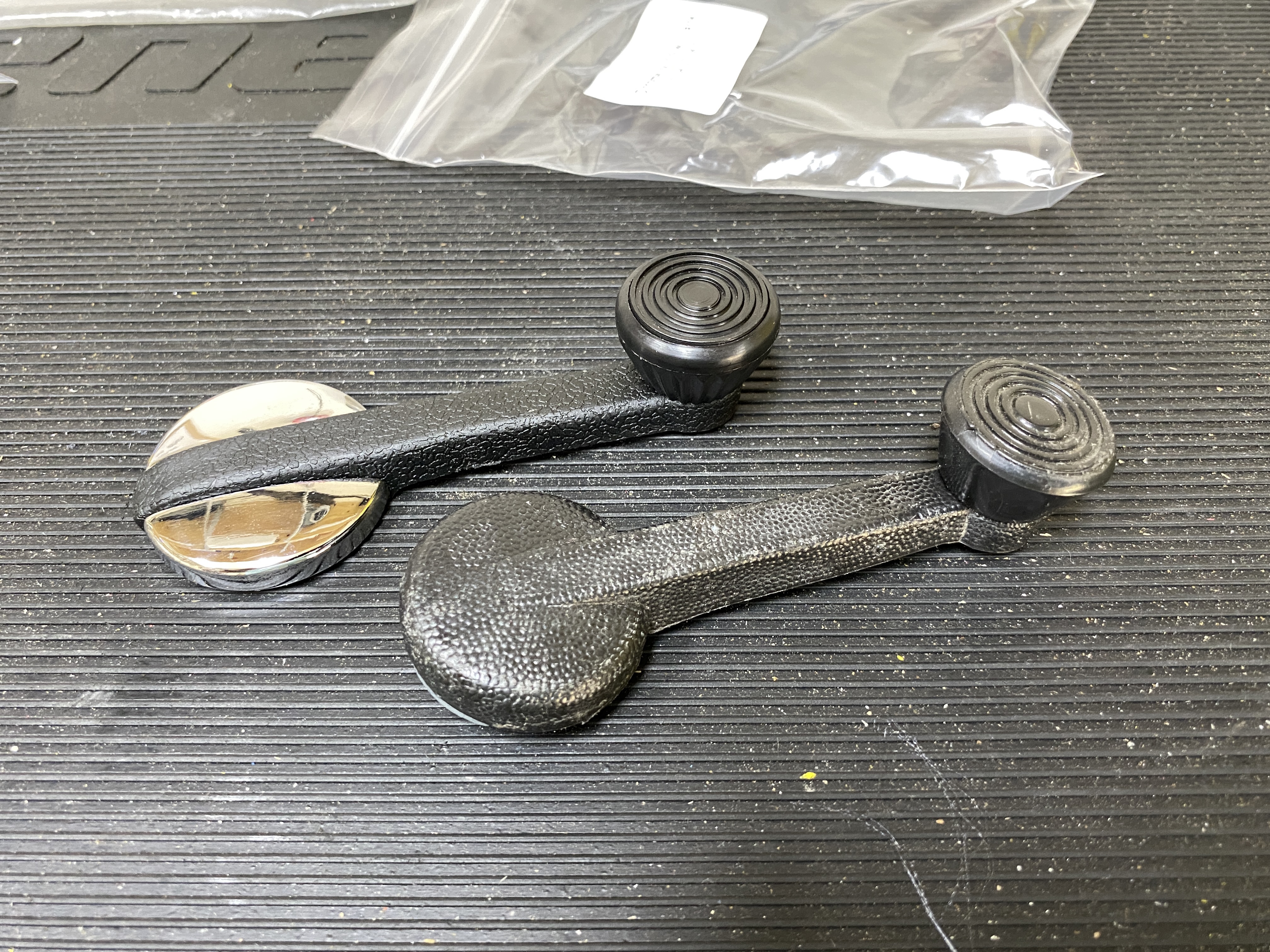

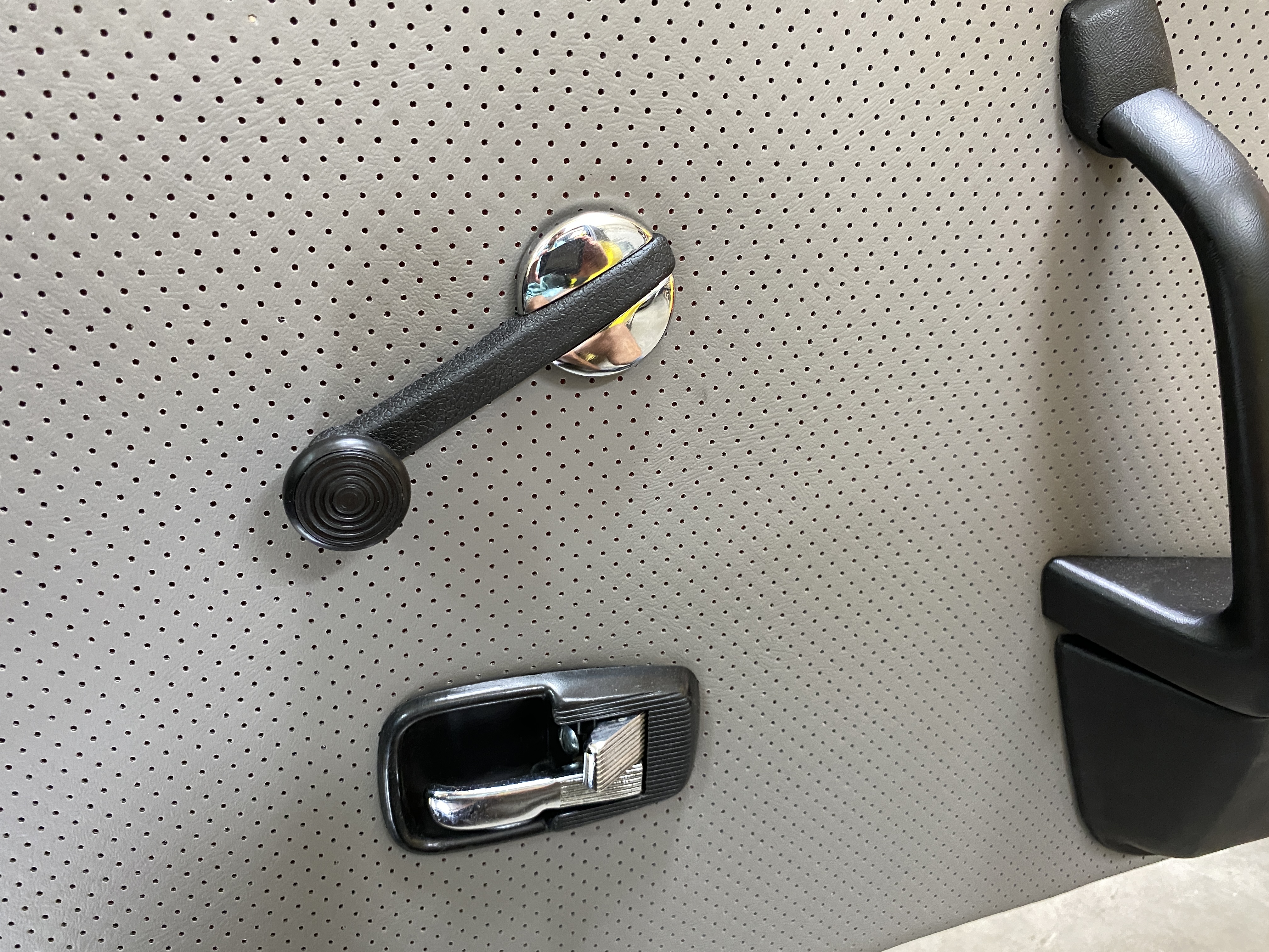

Some bling: new window cranks. The originals were a bit chewed up. I know the early cranks are not correct, but they are more shiny.

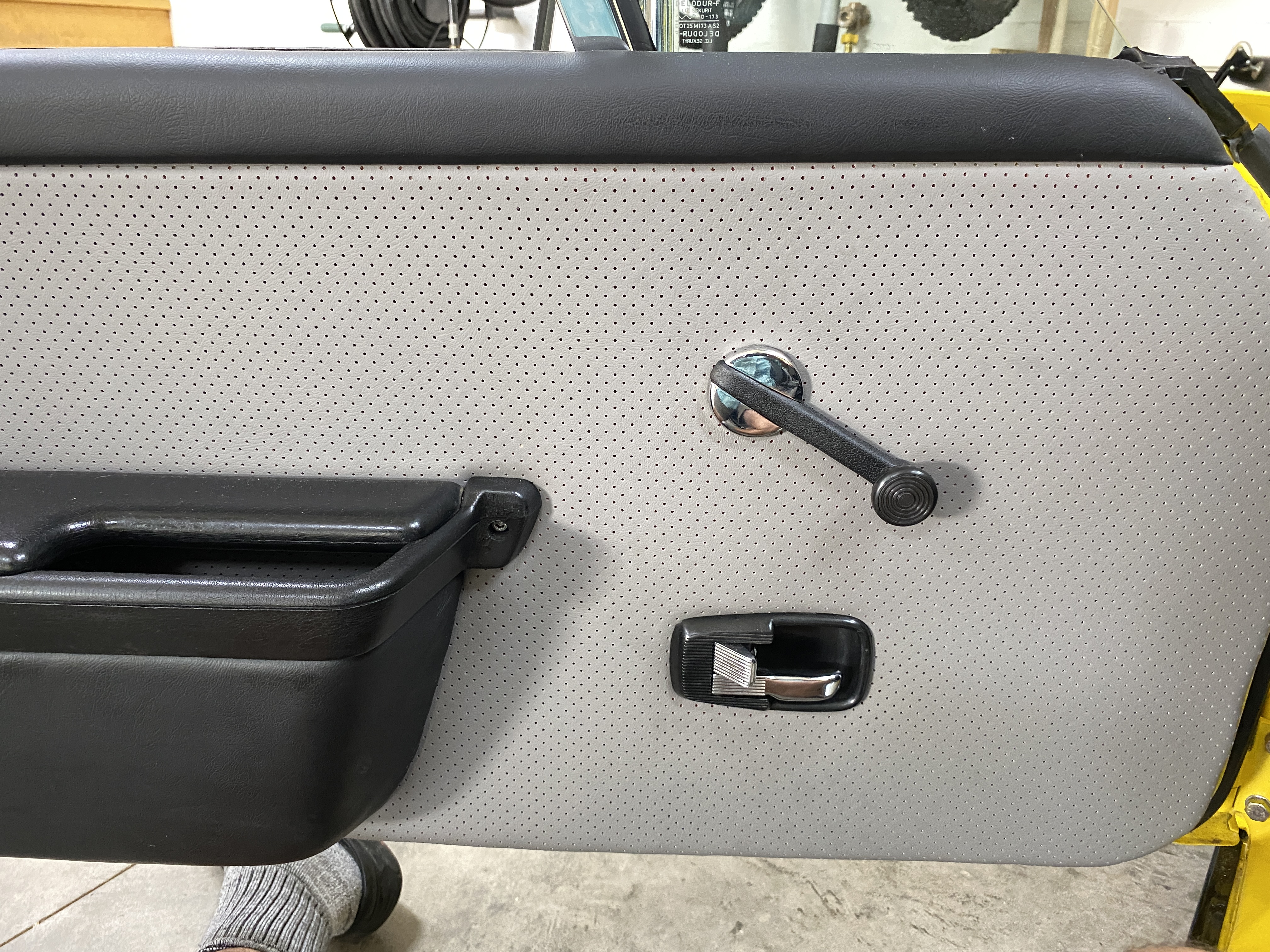

I like it.

Left side too. The bit of shiny metal matches the rest of the interior.

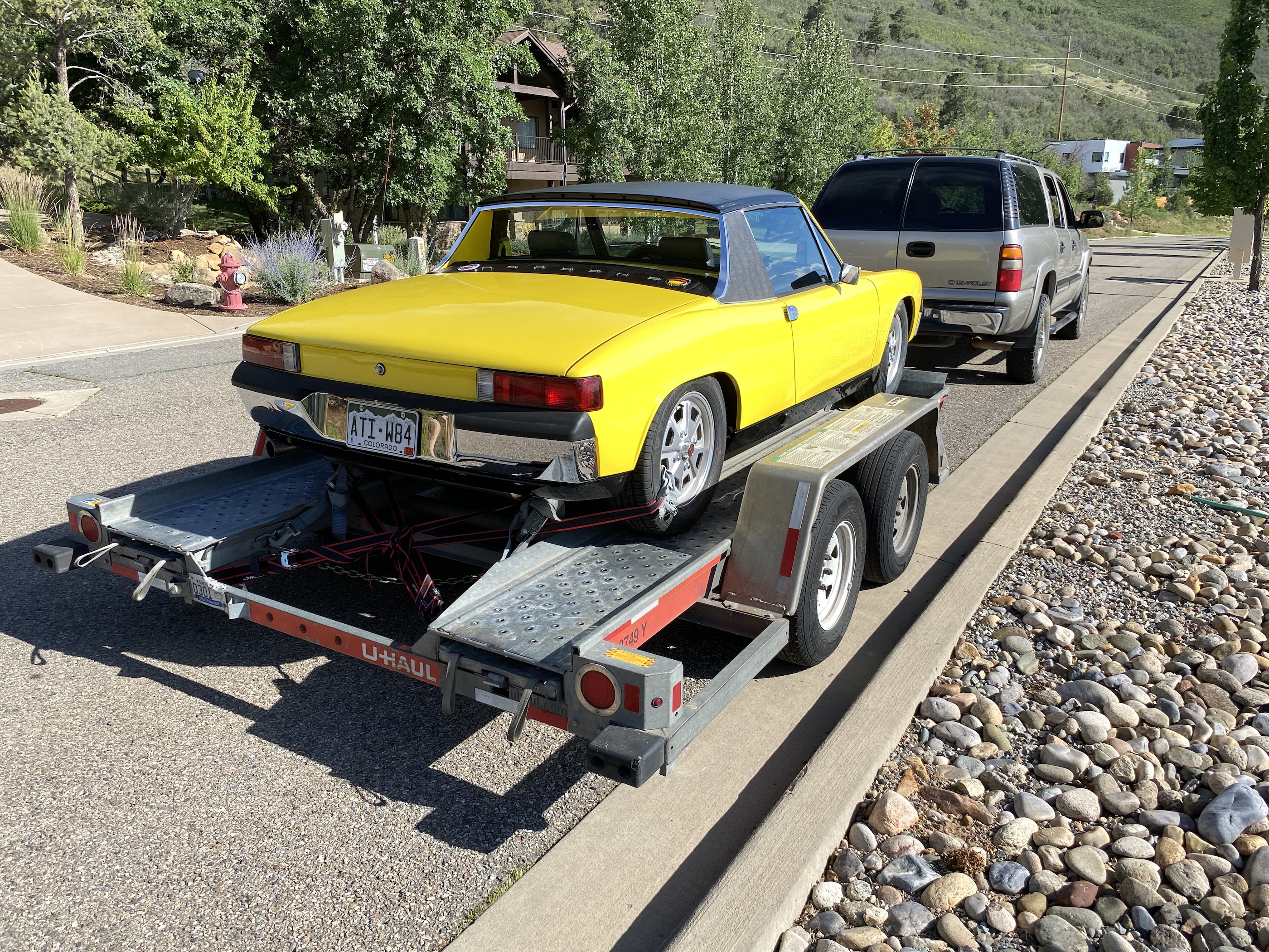

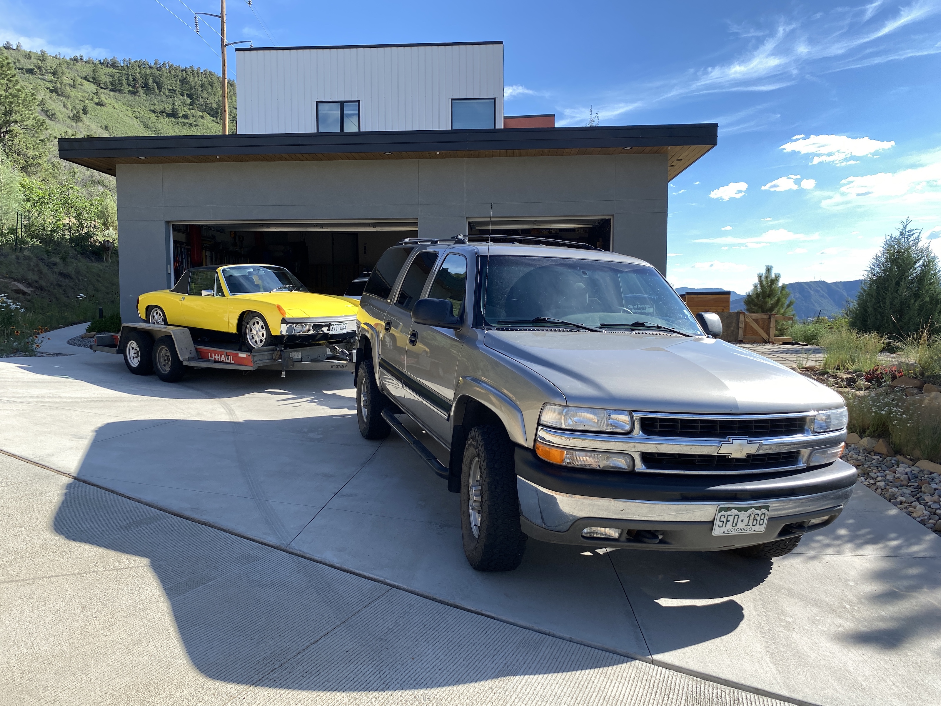

Getting ready to haul the 914 to the big city, and do some dyno tuning. First, I drove to the corner gas station, and put several gallons in the tank. Good news: the gas gauge seems to work. Bad news: the speedo and odo do not.
Then I picked up a rental trailer, and got the 914 loaded and tied down.

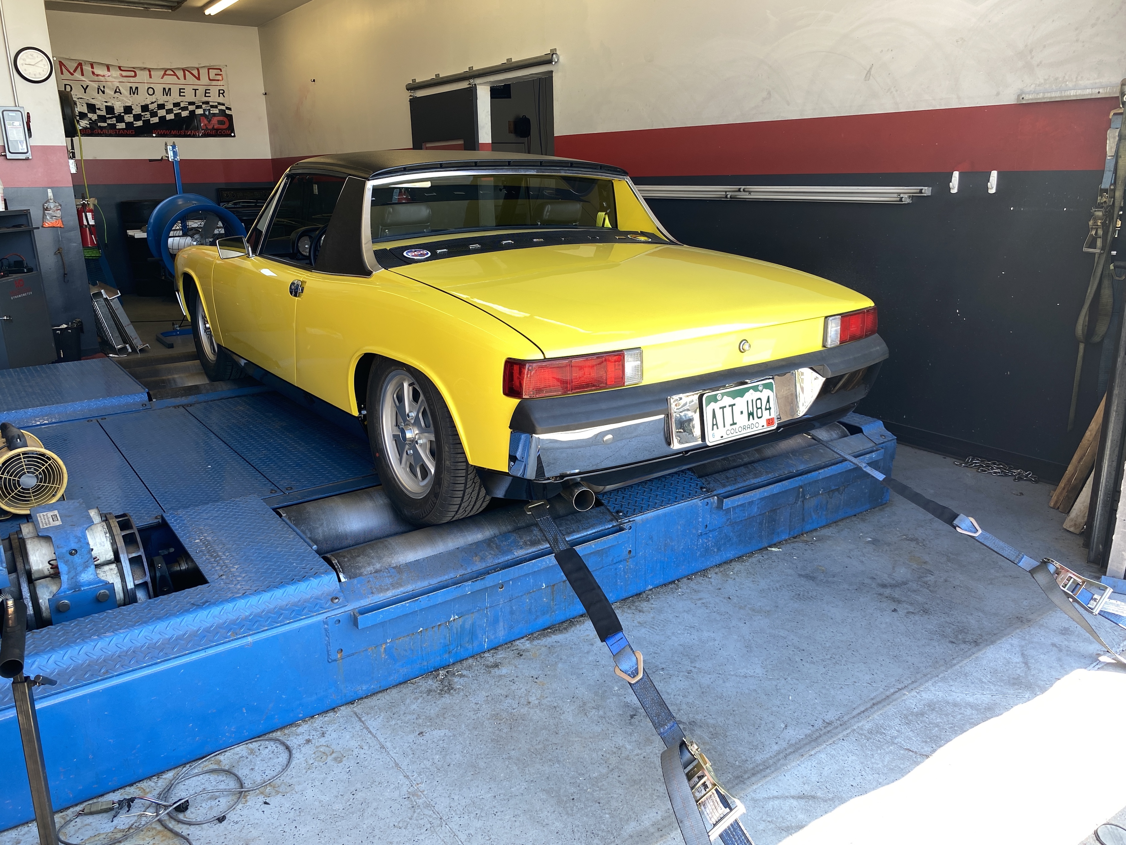

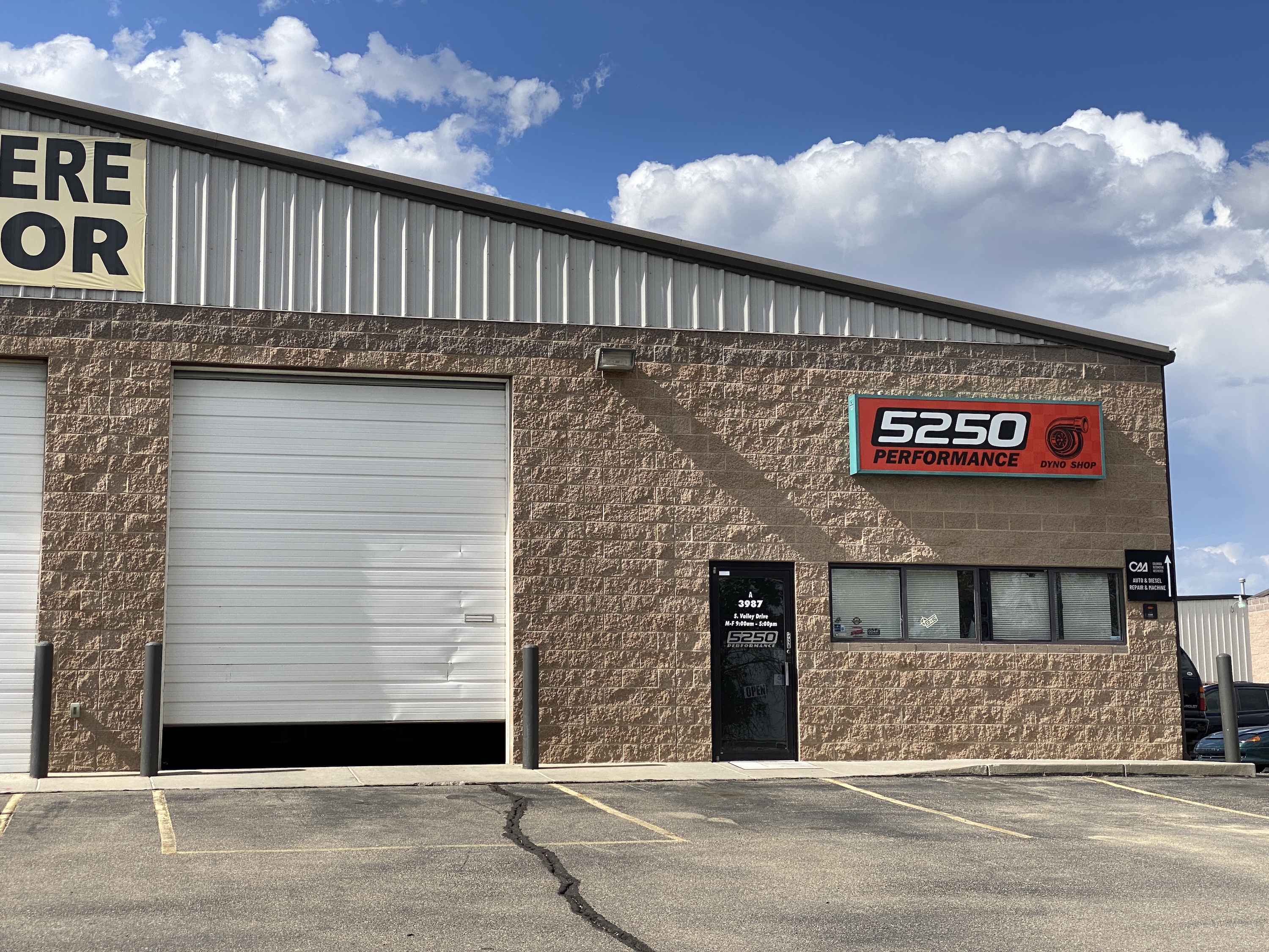

At 5250 Perfomance in Longmont, CO. Nice shop with lots of EFI tuning experience.

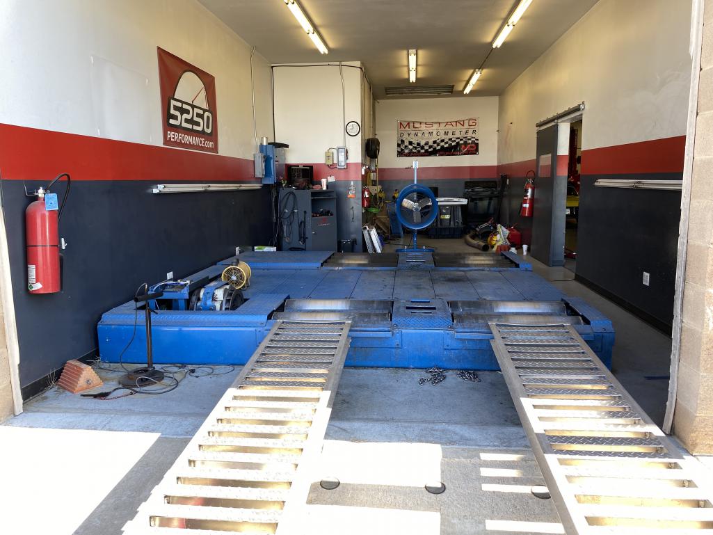

Here's their Mustang dyno.

And the 914 strapped down. Mike was not too worried about controlling all the awesome 2 liter horsepower.

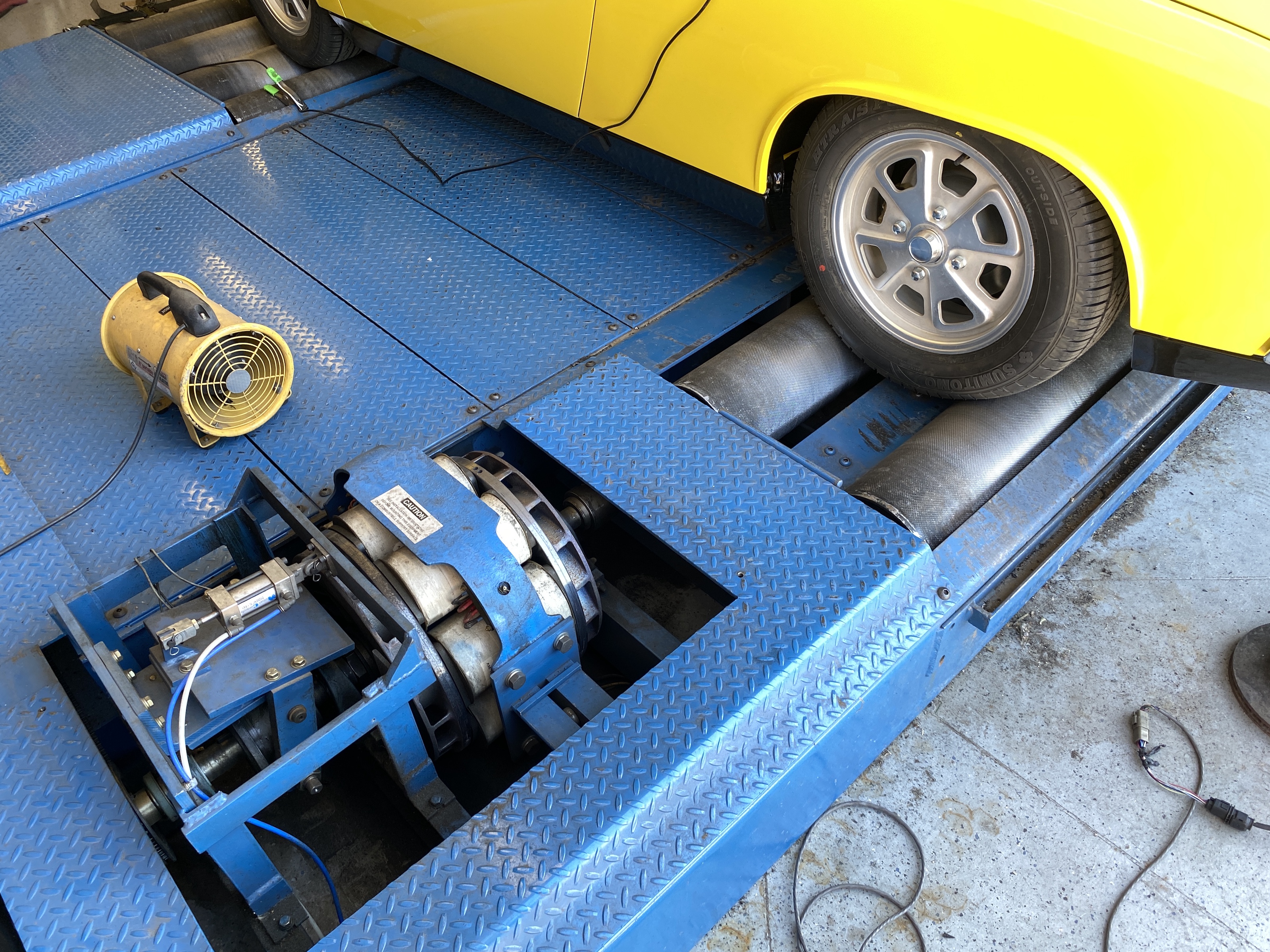

The core of the dyno: electromagnetic brakes, with computer control.

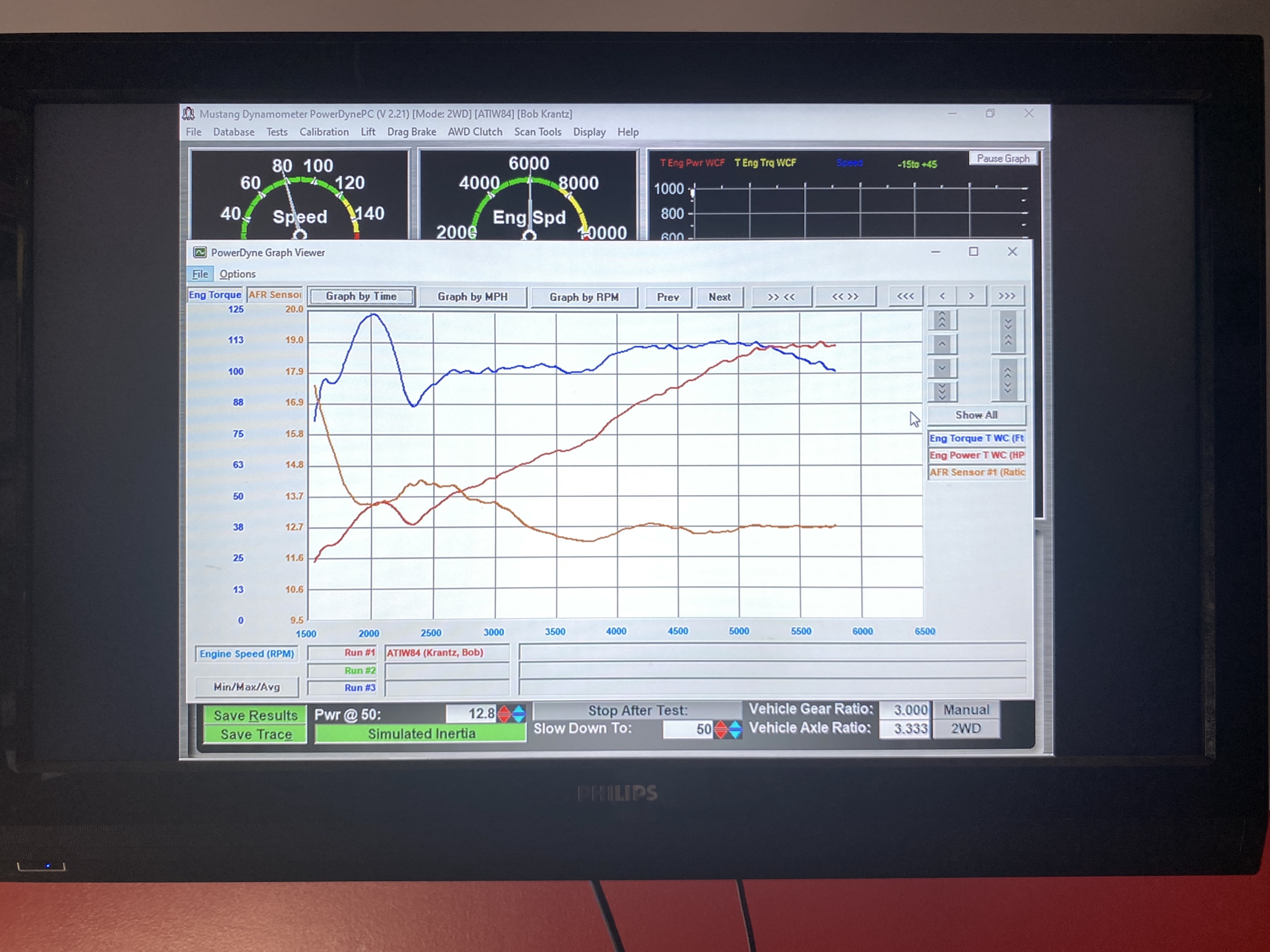

A quick review of the day. Once home and after reviewing all the files, I will post more.
The initial checks went well, and the car started and ran (no surprise to me, but Mike said he is often skeptical of people who show up with cars that will not start).
Then we had a problem with the throttle sensor (TPS) reading. At first we thought the sensor was bad, then the leads were reversed, and then a software problem. Finally we figured out that the bad reading "might" be due to cross-talk with the crank position sensor. We rewired that, and got a reasonable TPS reading.
Mike then went through his complete tuning process, starting with the fuel table, then the spark (advance) table, and then tip-in enrichment and a few other drivability tweaks.
I was not after "max" horsepower, and my goal with the engine mods (bump to 2056 cc, compression about 8.8:1, new EFI and ignition) was 120 hp. At the end of the day we saw consistent peak hp of 113 at the wheels (corrected for the altitude. Assuming a 10% loss through the transaxle, half-shafts, and hubs, that means 125 hp at the crank. Yay!
Note that the curve data below 2500 is not "real", based on the settings for this pull.
I did not have time to drive the car (I was late to help my uber-gardener wife pick up plants at two area nurseries, so that will have to wait until we get home.
