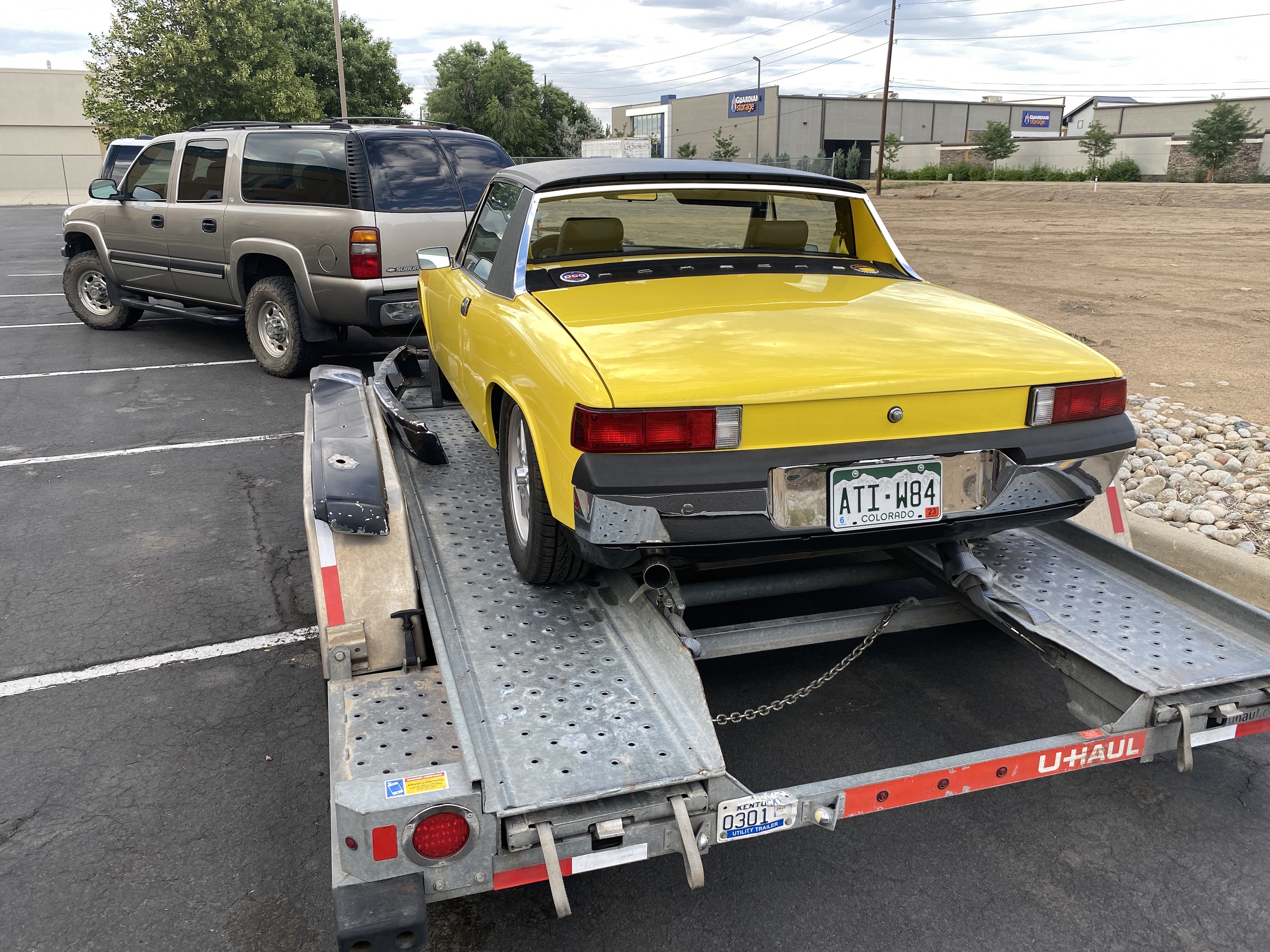

Ready to go home.
BTW, the old bumpers went to Chad, who recently bought a 73 1.7, and lives in Longmont.

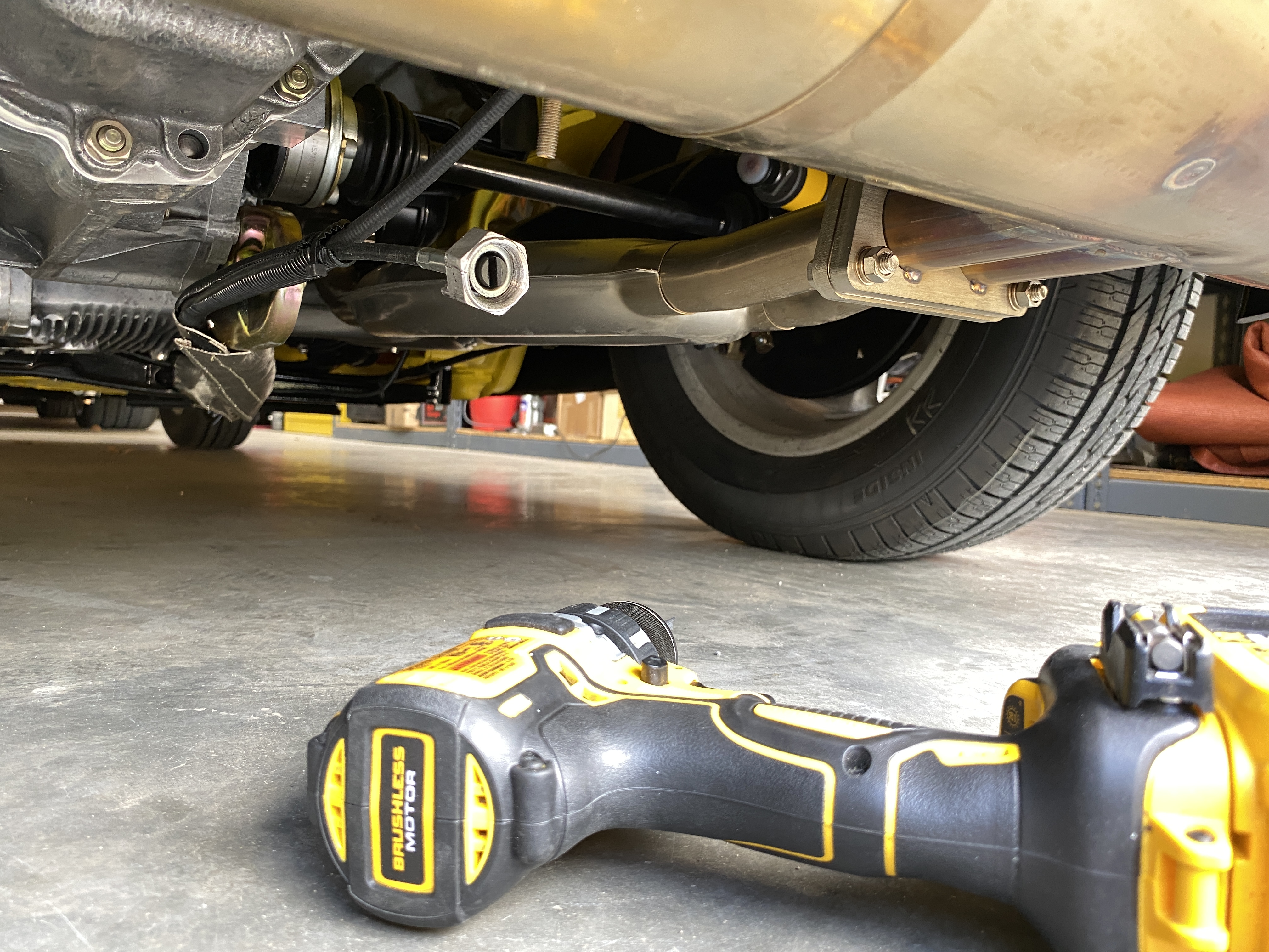

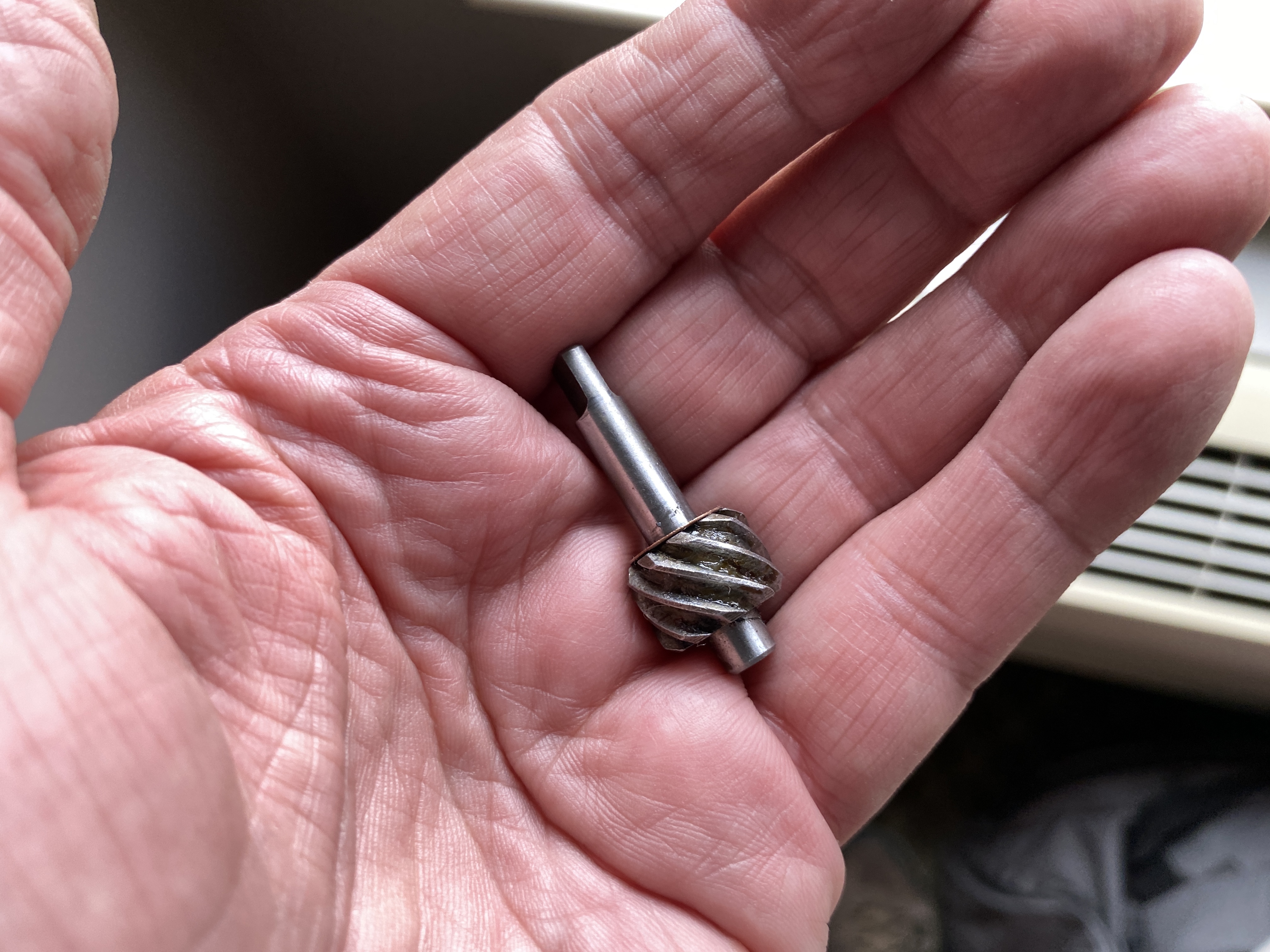

BTW, we found this under the transaxle during the dyno session. Looks like the speedo angle drive self-destructed, and left the cable hanging. That might explain why the speedometer did not work.

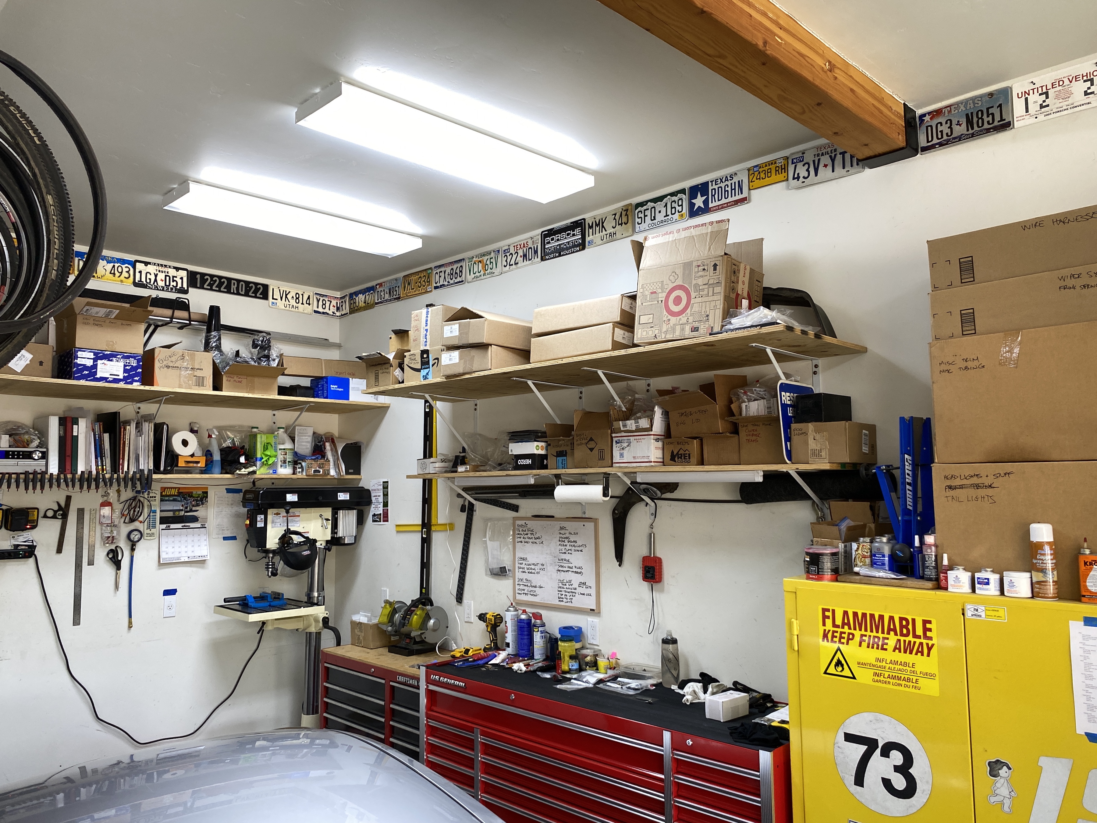

Then I started thinking about how to sort through all the remaining boxes of 914 parts, some that I took off and did not use, others that I had refurbished in some way.

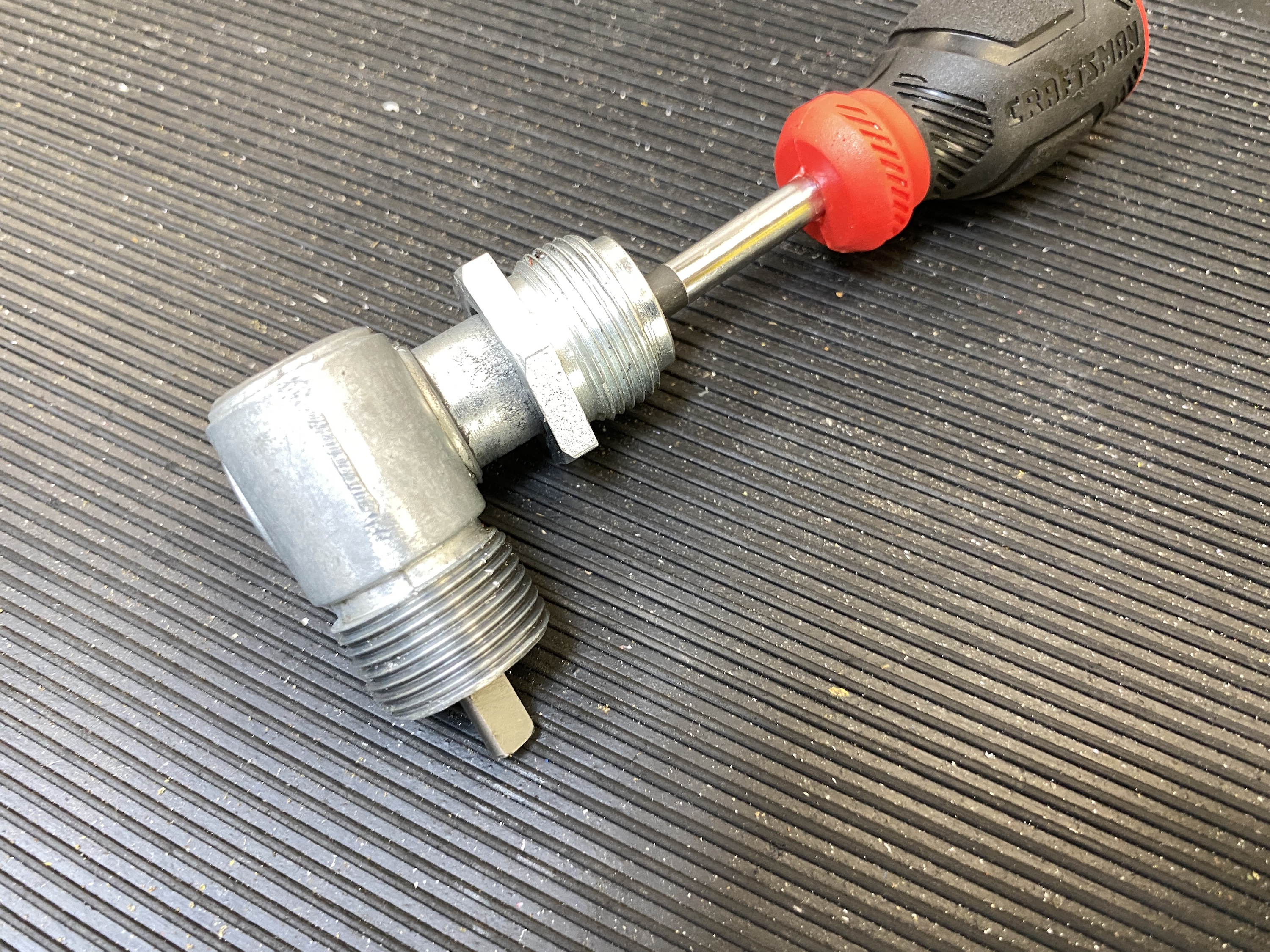

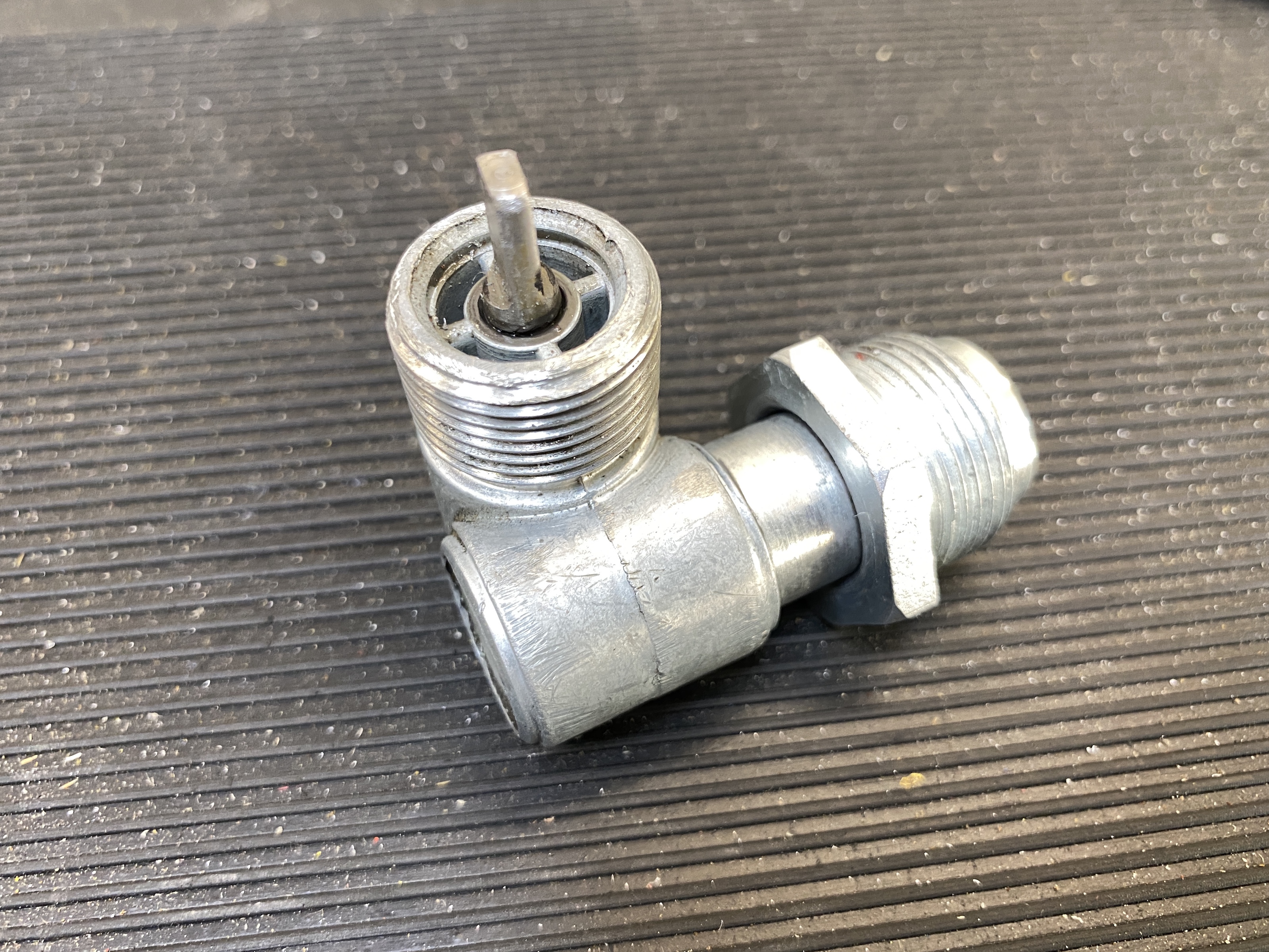

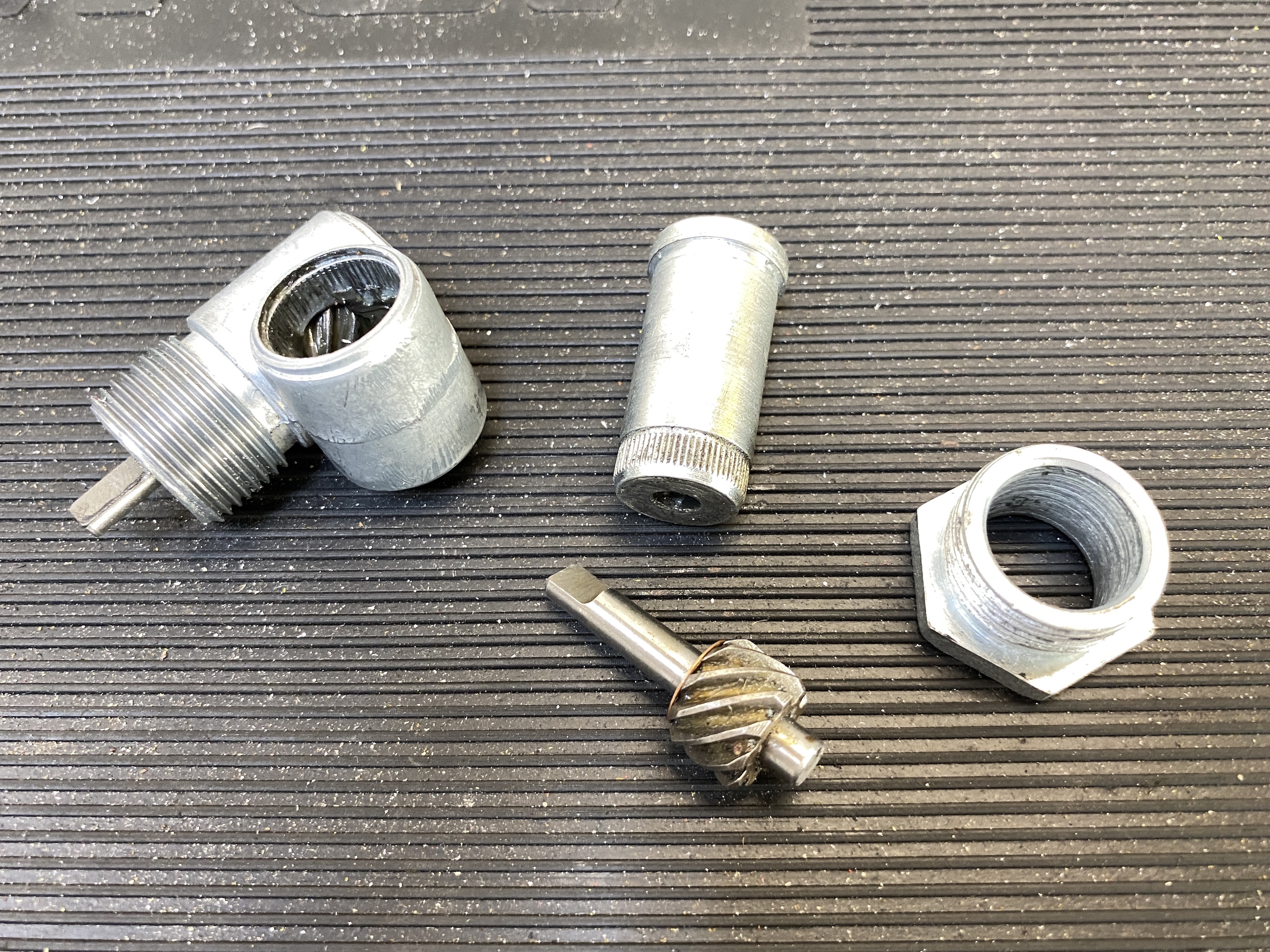

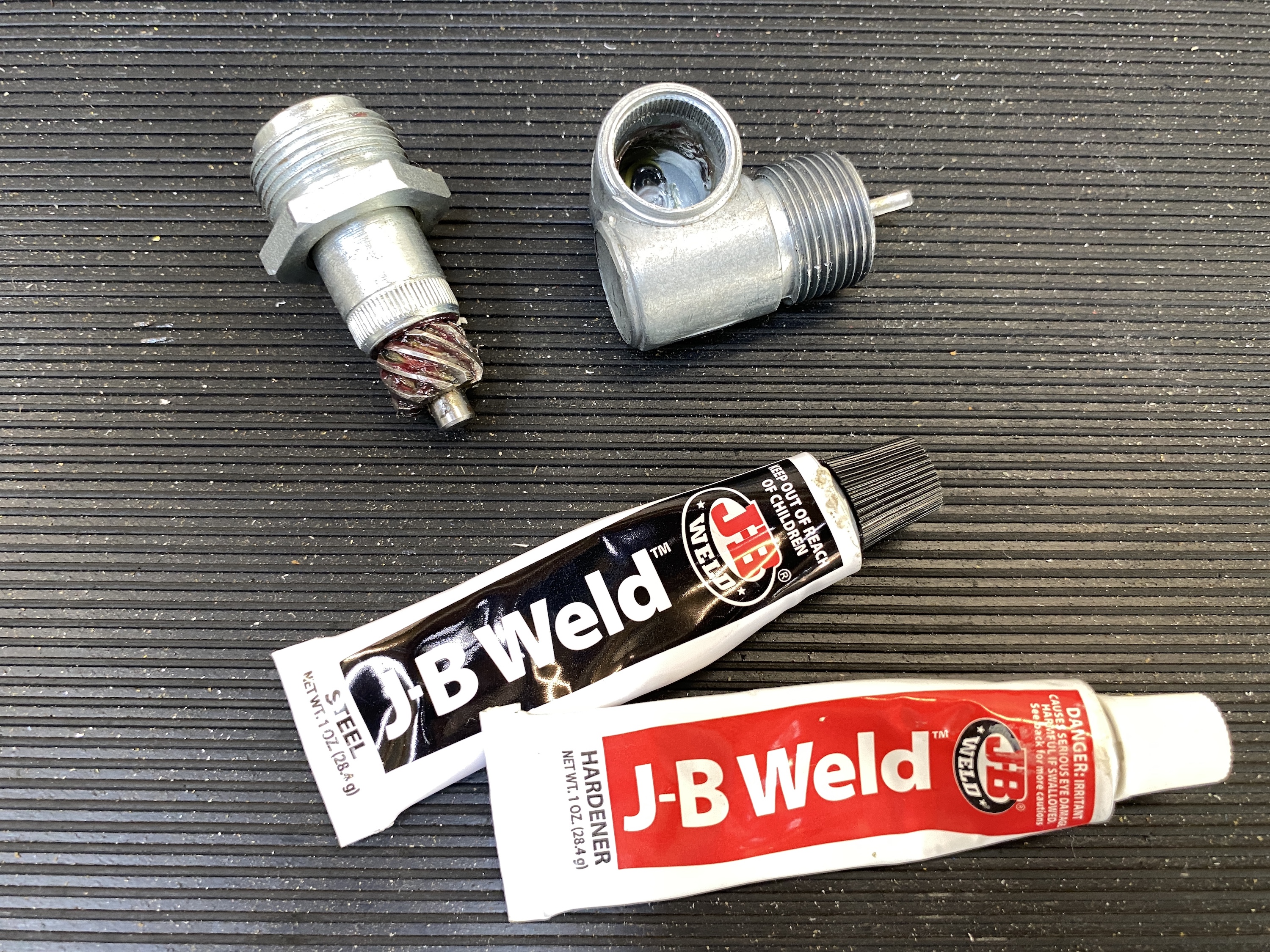

Here's my speedo cable again drive that "exploded" on the dyno.
bkrantz
post Jul 23 2022, 07:30 PM
Post #5729
Posts: 8,673
Joined: 3-August 19
From: SW Colorado
Member No.: 23,343
First I tried pressing the pieces together, but it pulled apart under moderate tension. So I decided to make it permanent.
bkrantz
post Jul 23 2022, 07:31 PM
Post #5730
Posts: 8,673
Joined: 3-August 19
From: SW Colorado
Member No.: 23,343
Looks ready to go, but...
bkrantz
post Jul 23 2022, 07:33 PM
Post #5731
Posts: 8,673
Joined: 3-August 19
From: SW Colorado
Member No.: 23,343
First I confirmed that if I spun the speedo cable counter-clockwise, the speedometer works. Yay.
bkrantz
post Jul 23 2022, 07:36 PM
Post #5732
Posts: 8,673
Joined: 3-August 19
From: SW Colorado
Member No.: 23,343
But then I figured out that the angle drive transmits the transaxle output into a clockwise spin at the cable--opposite what I need. Looks like the shop that did the transaxle rebuild put on a 911 angle drive. That might also explain why I had trouble getting the cable end nut to screw onto the angle drive.
Oh, well. Another part to buy.

You have angle drive. You can drive in reverse and your speedo will work.
Same issue I had on my previous 75 1.8.
bkrantz
post Jul 24 2022, 06:52 PM
Post #5734
Posts: 8,673
Joined: 3-August 19
From: SW Colorado
Member No.: 23,343
QUOTE(ndfrigi @ Jul 23 2022, 10:31 PM) *
Yeah, I learned late that the 914 and 911 angle drives spin in opposite directions.

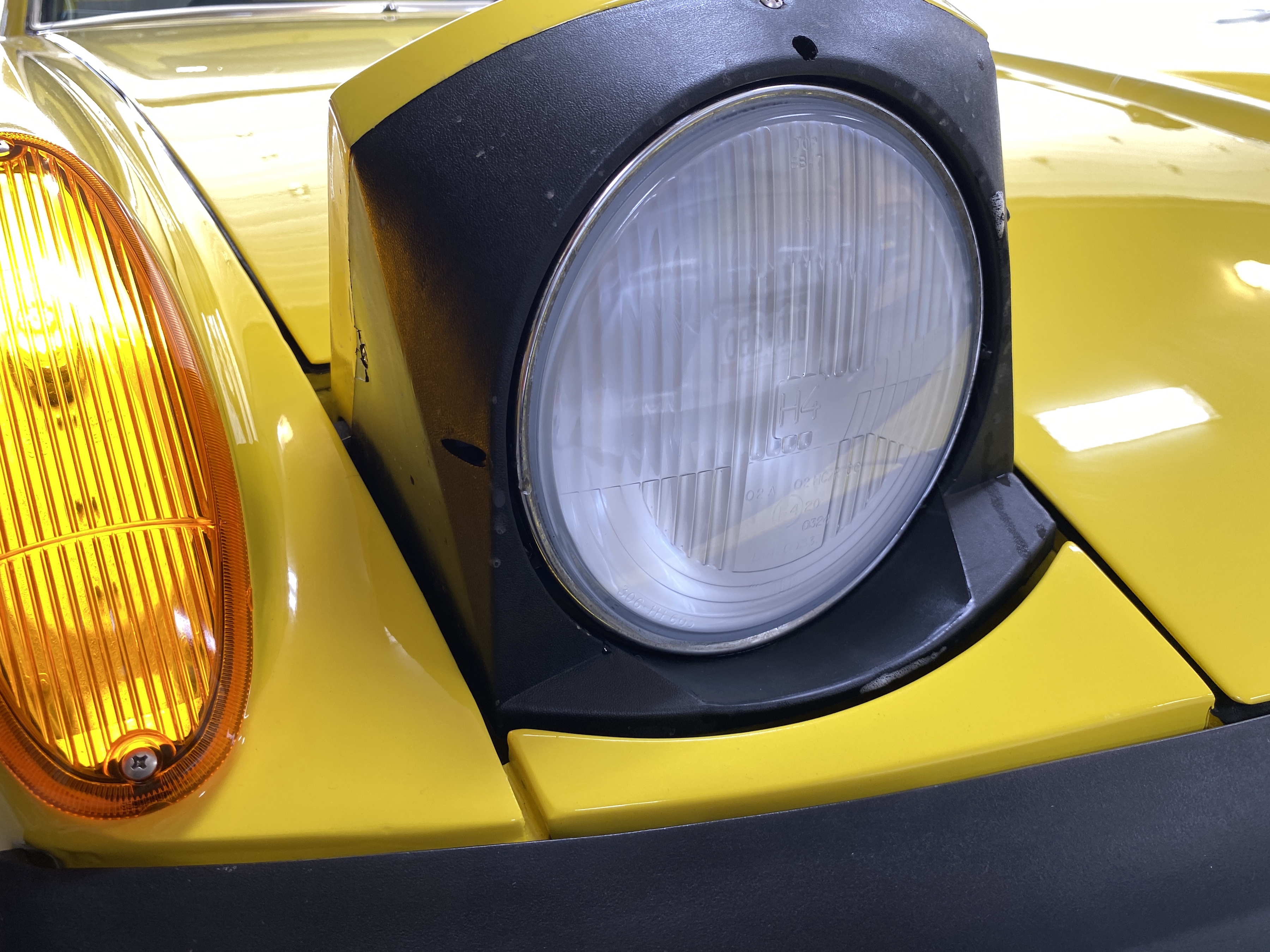

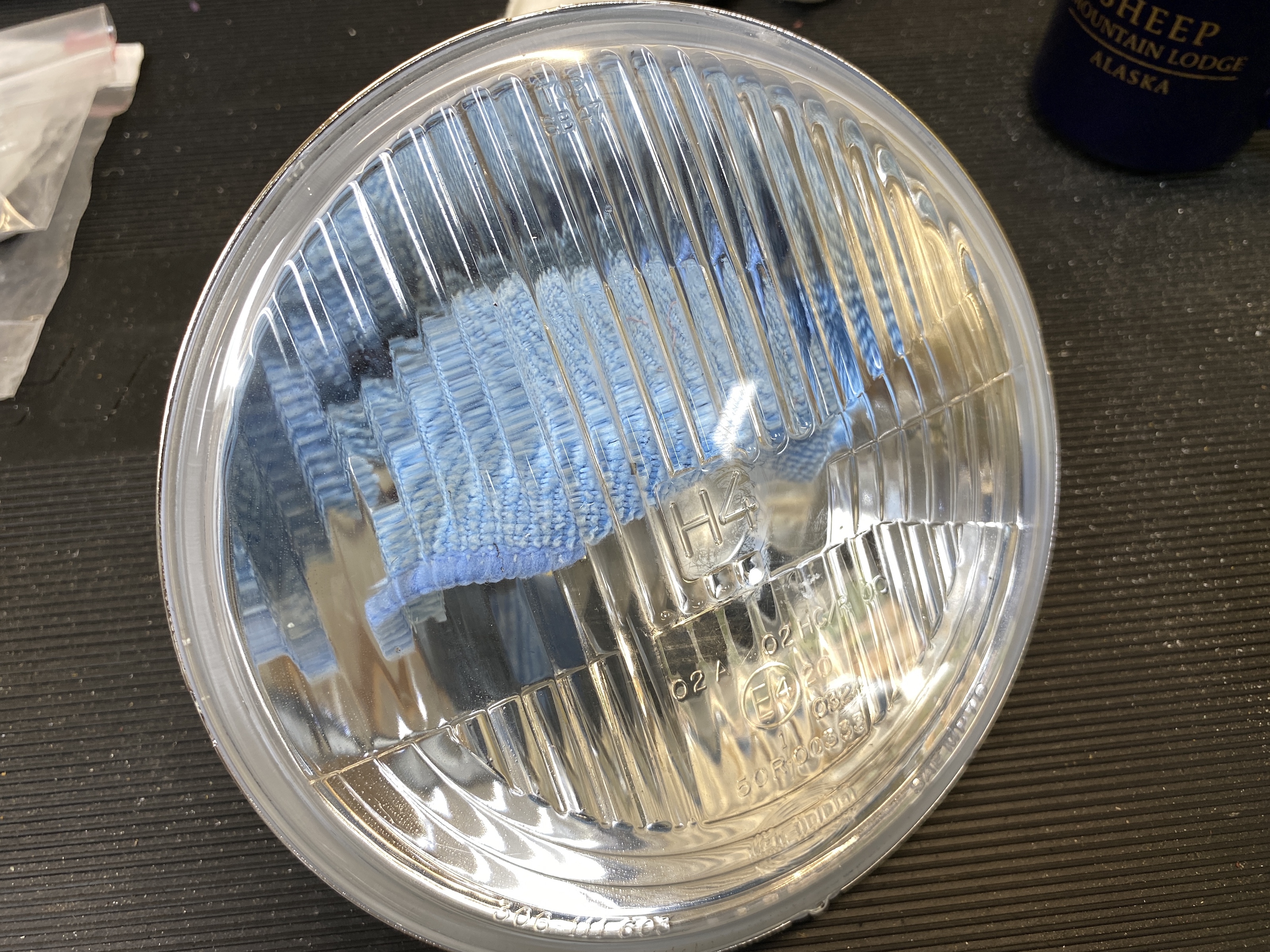

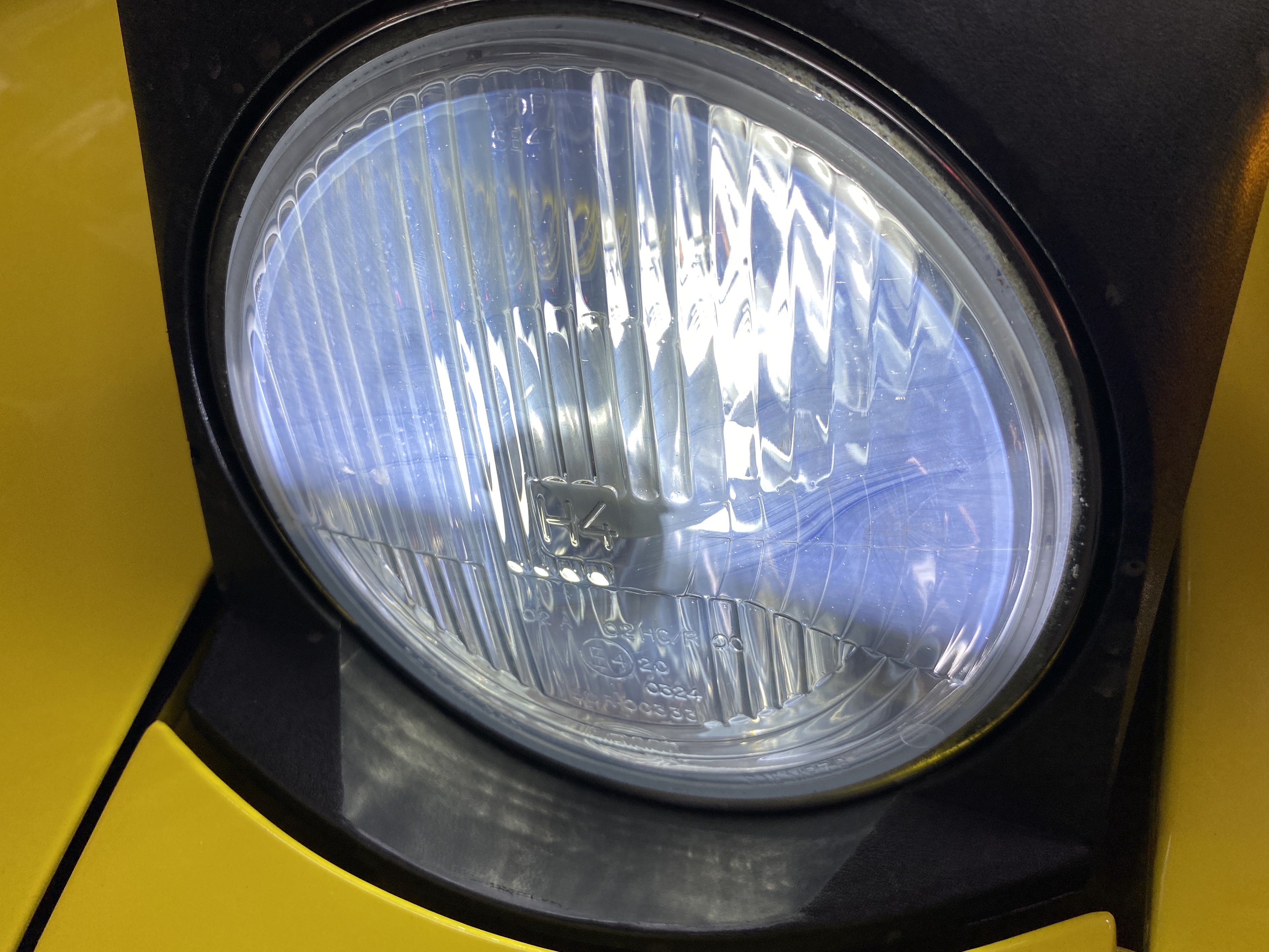

I tackled the headlights today. It might be hard to see, but the general fogginess of the lens, and the bands on the right, are on the inside. This was not how they looked when installed.
bkrantz
post Jul 24 2022, 06:56 PM
Post #5736
Posts: 8,673
Joined: 3-August 19
From: SW Colorado
Member No.: 23,343

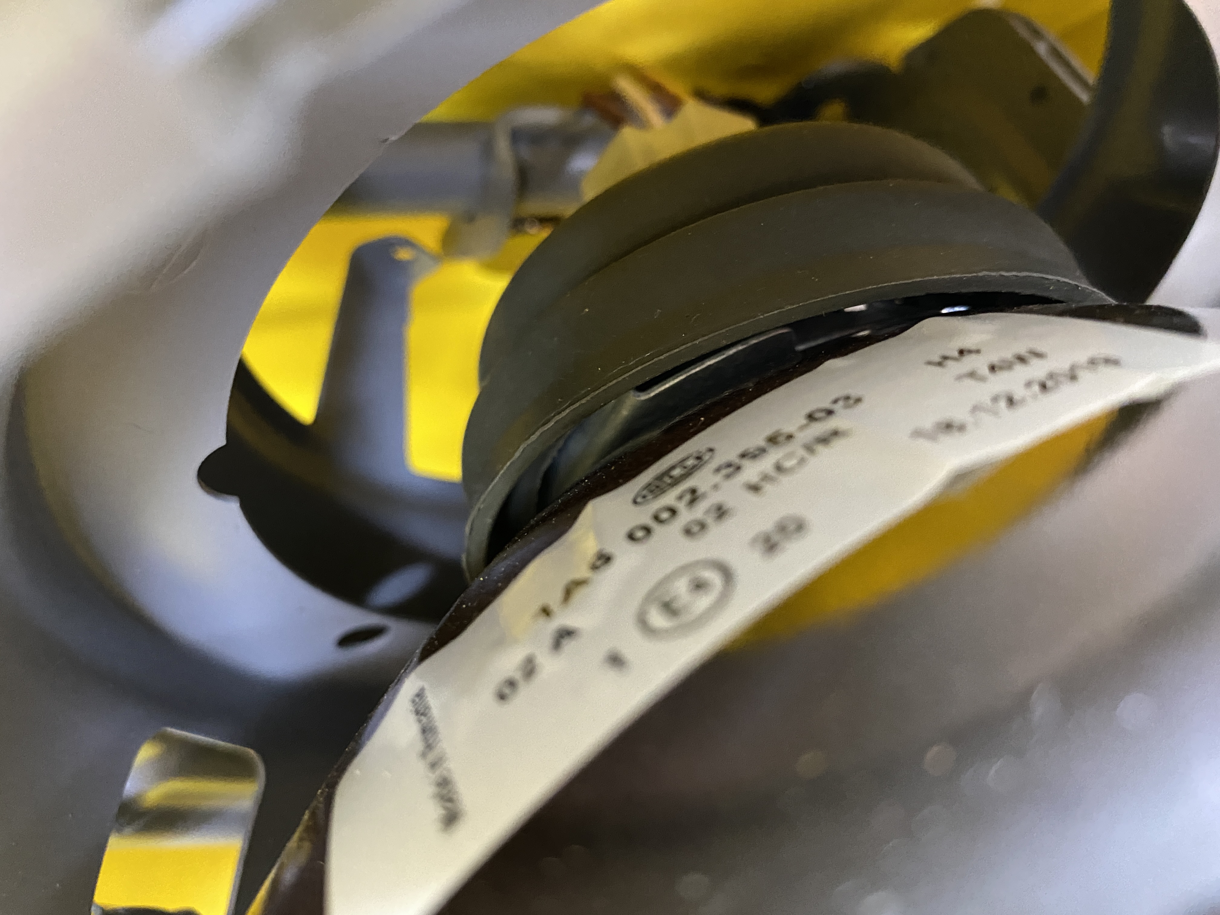

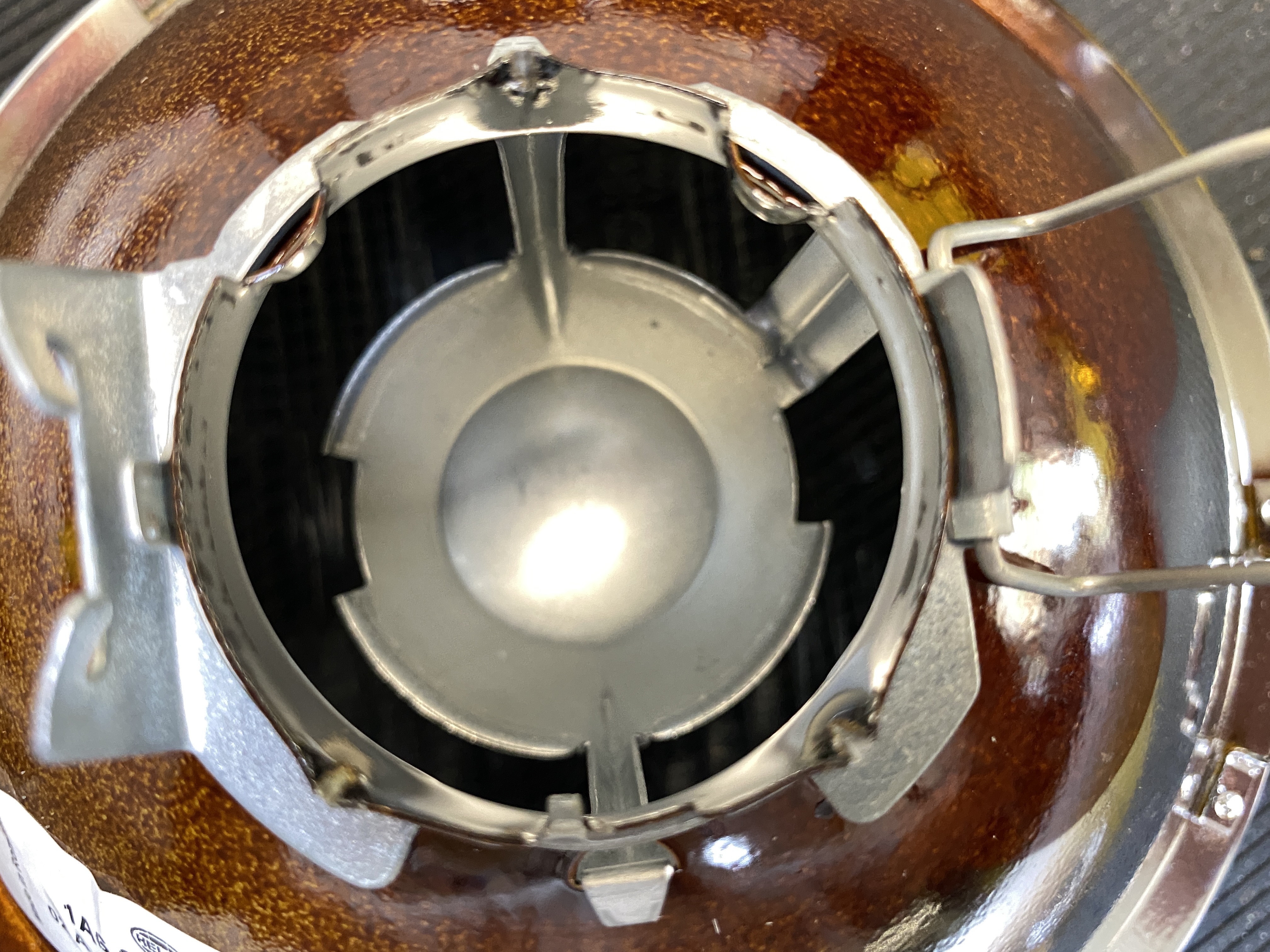

Here's the likely problem: the rubber cap that is supposed to seal the bulb mounting is wide open. Last week, with the 914 on an open trailer, we drove through a few rain squalls. And then I gave the car a quick wash at home.
bkrantz
post Jul 24 2022, 06:58 PM
Post #5737
Posts: 8,673
Joined: 3-August 19
From: SW Colorado
Member No.: 23,343

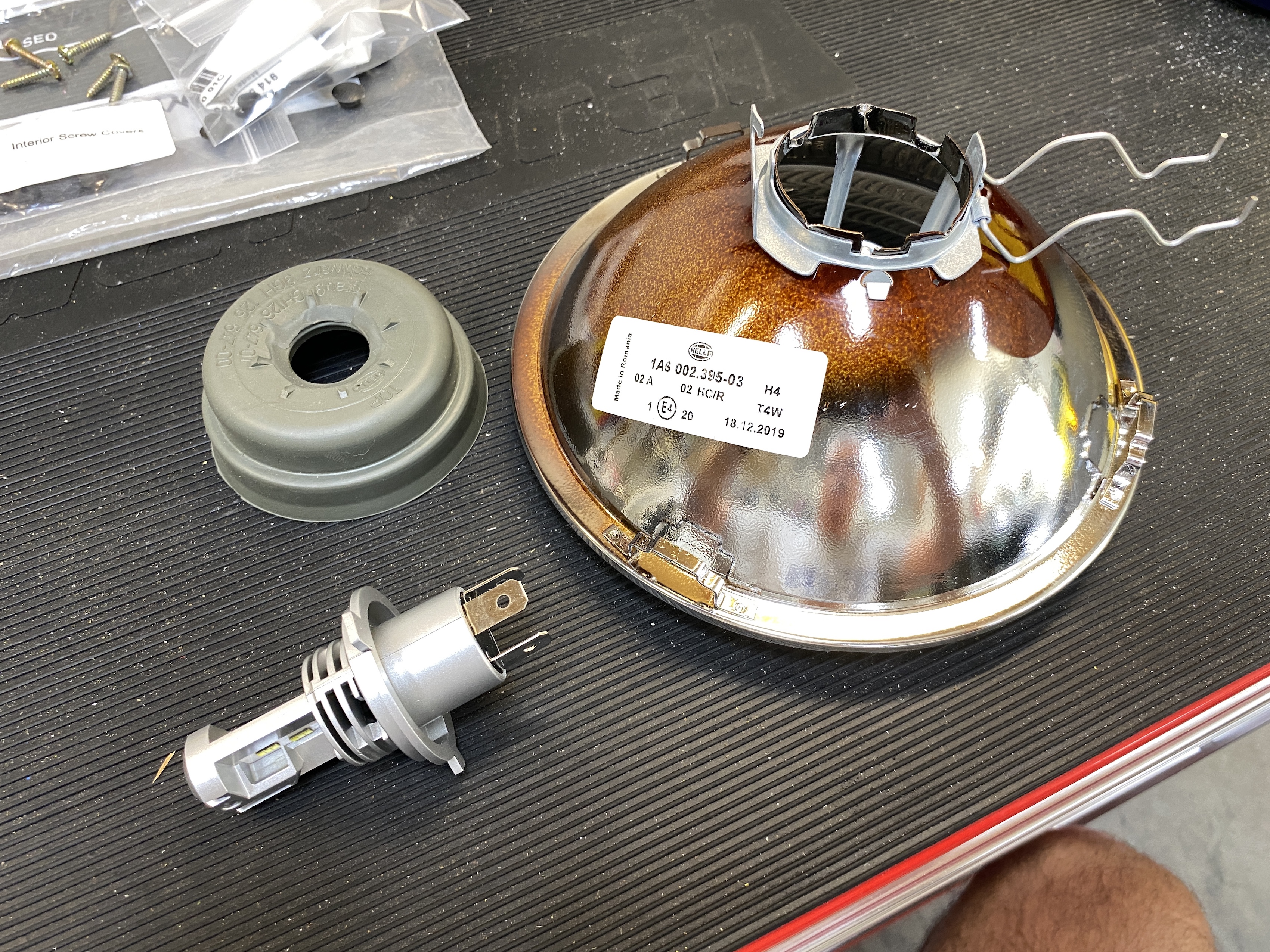

Assembly out, and separated into lens and reflector housing, LED bulb, and rubber seal.
bkrantz
post Jul 24 2022, 06:59 PM
Post #5738
Posts: 8,673
Joined: 3-August 19
From: SW Colorado
Member No.: 23,343
it would be easy to clean inside the lens, except for the bulb shield.
bkrantz
post Jul 24 2022, 07:01 PM
Post #5739
Posts: 8,673
Joined: 3-August 19
From: SW Colorado
Member No.: 23,343

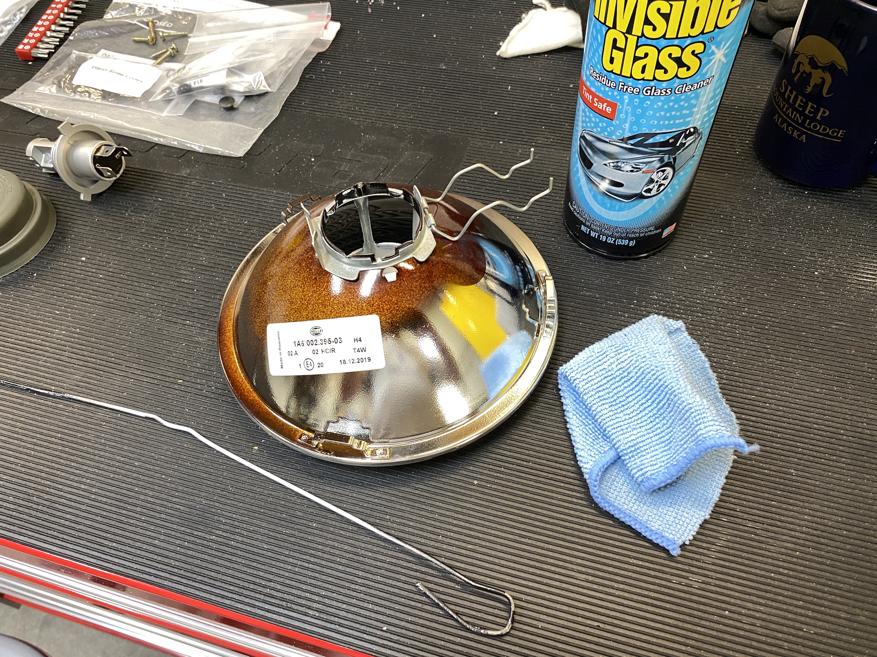

Here's my solution: a piece of synthetic rag, glass cleaner, and bit of coat hanger.
bkrantz
post Jul 24 2022, 07:02 PM
Post #5740
Posts: 8,673
Joined: 3-August 19
From: SW Colorado
Member No.: 23,343
Working the rag with cleaner around the inside.
