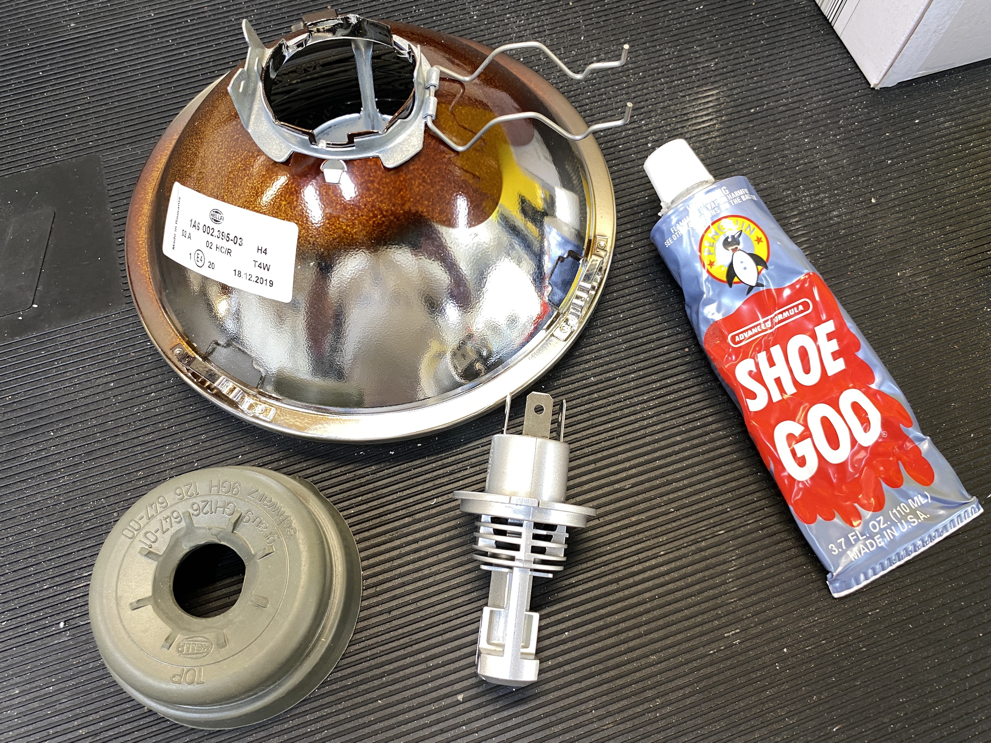

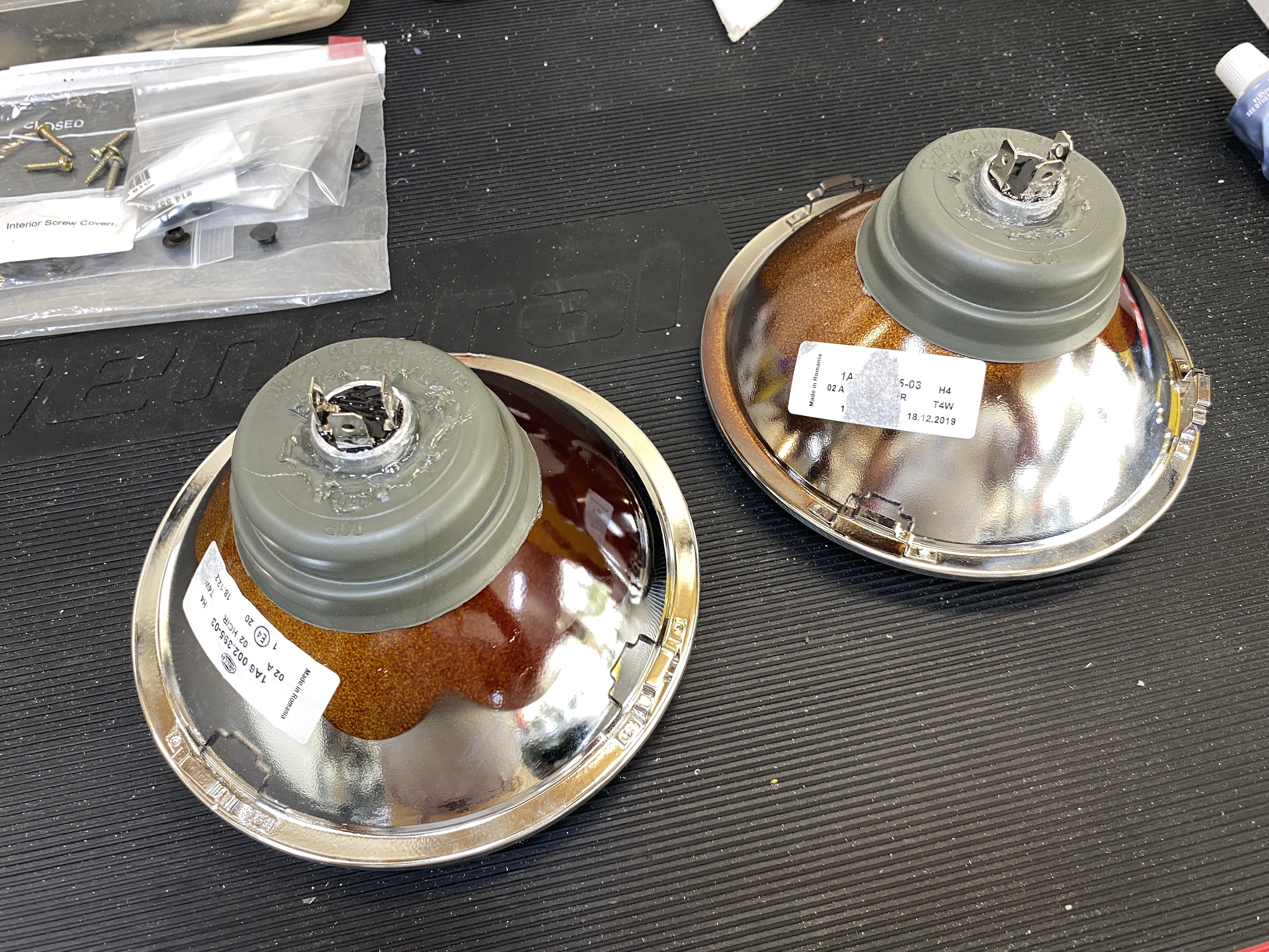

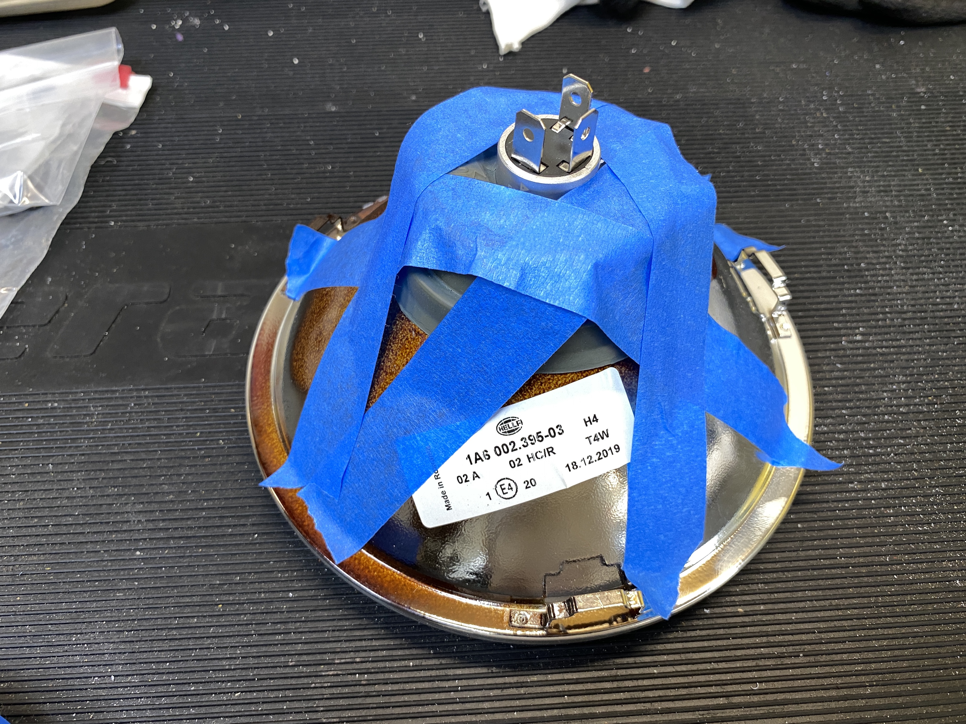

How about sealing all the openings, with my favorite stuff.
bkrantz
post Jul 24 2022, 07:04 PM
Post #5743
Posts: 8,673
Joined: 3-August 19
From: SW Colorado
Member No.: 23,343

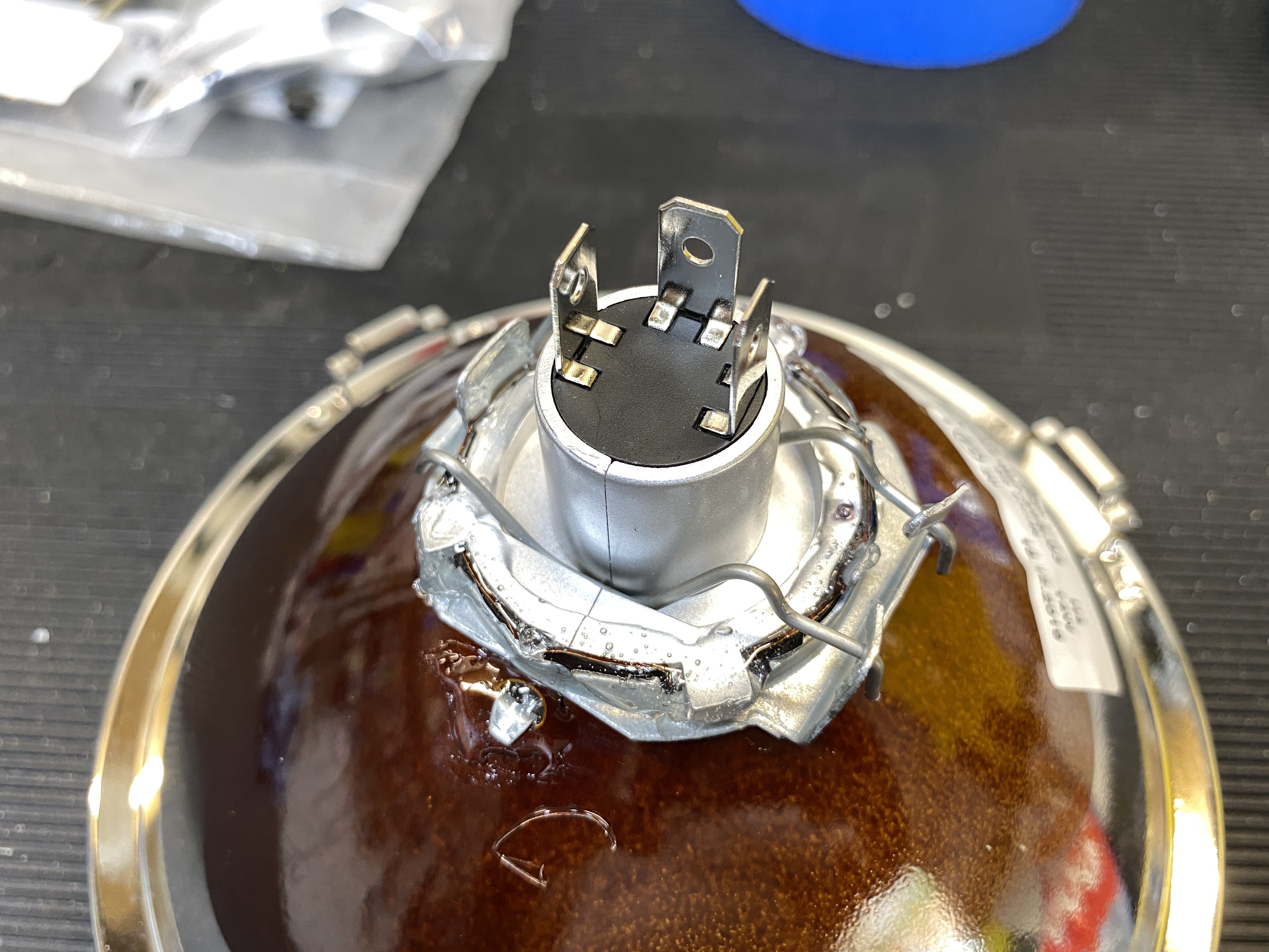

First, I sealed around the bulb.
bkrantz
post Jul 24 2022, 07:06 PM
Post #5744
Posts: 8,673
Joined: 3-August 19
From: SW Colorado
Member No.: 23,343

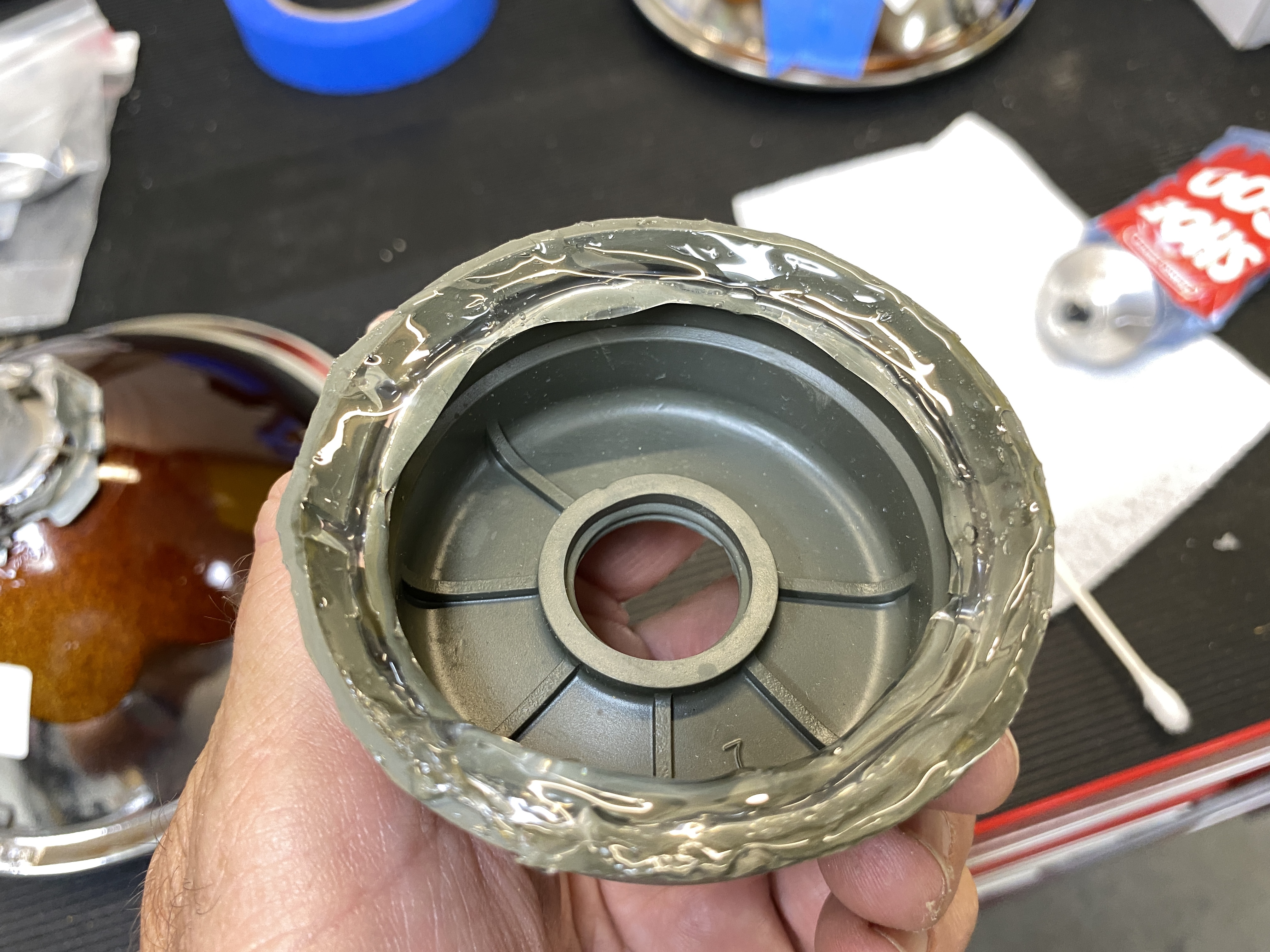

Then a bead of goop around the rubber cap edge, since no matter how I adjusted the fit, the edge would not stay sealed against the reflector.
bkrantz
post Jul 24 2022, 07:07 PM
Post #5745
Posts: 8,673
Joined: 3-August 19
From: SW Colorado
Member No.: 23,343
We'll see tomorrow if it stays sealed.

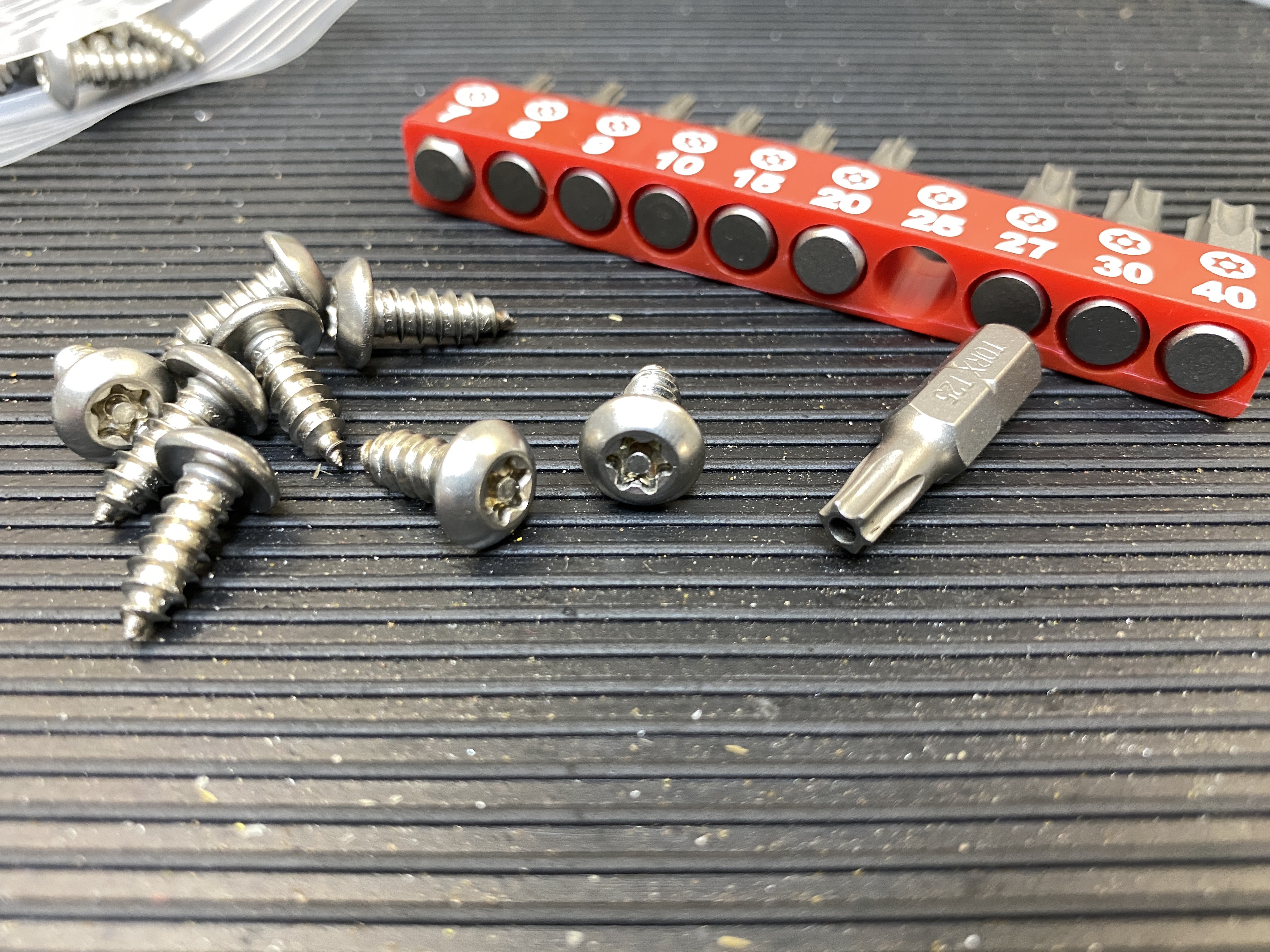

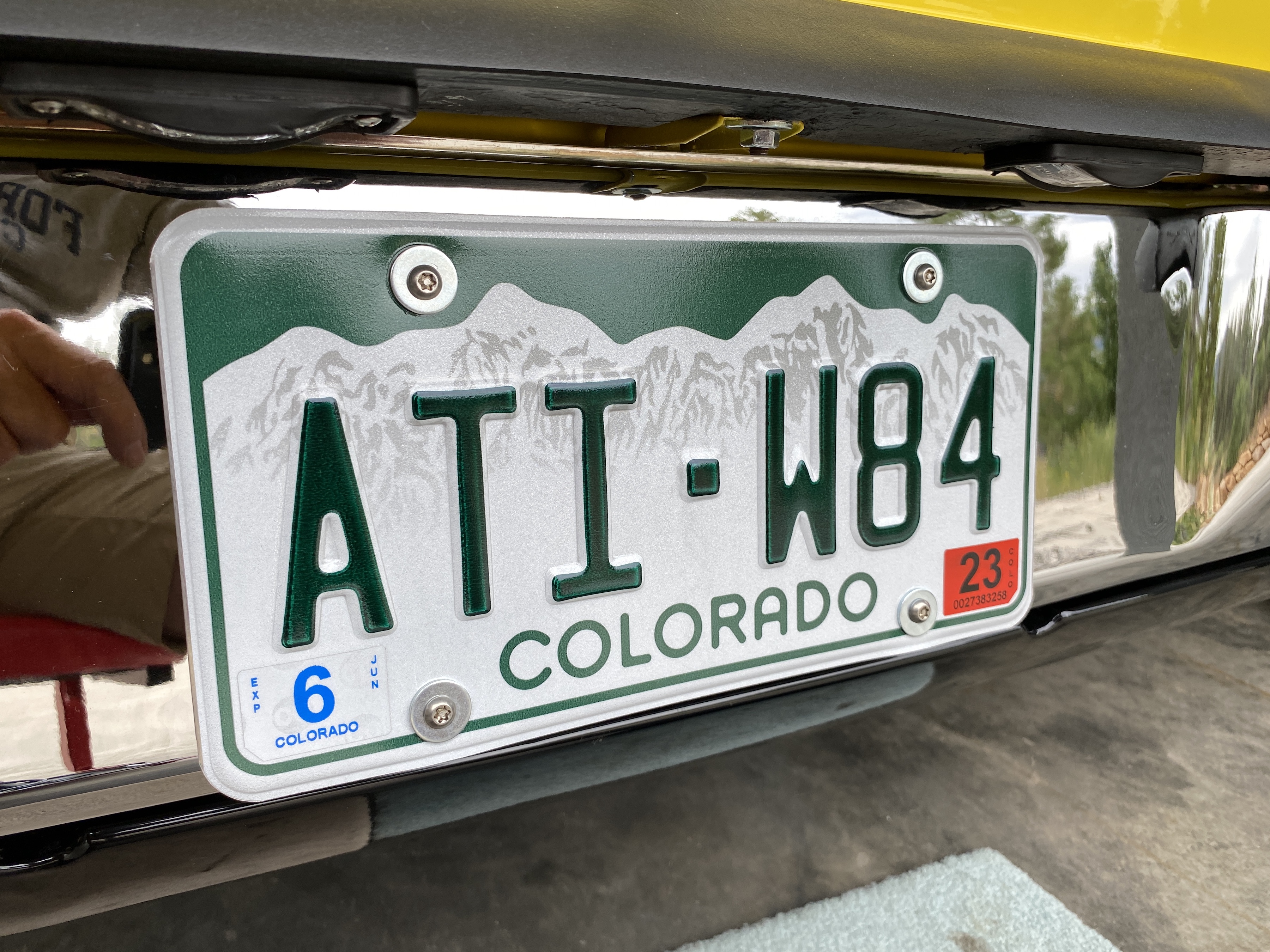

Another quick task: replacing the license plate screws with security Torx. Maybe a bit paranoid--and OCD--but why not?
bkrantz
post Jul 24 2022, 07:10 PM
Post #5747
Posts: 8,673
Joined: 3-August 19
From: SW Colorado
Member No.: 23,343
Now I have to avoid losing the security Torx bit.

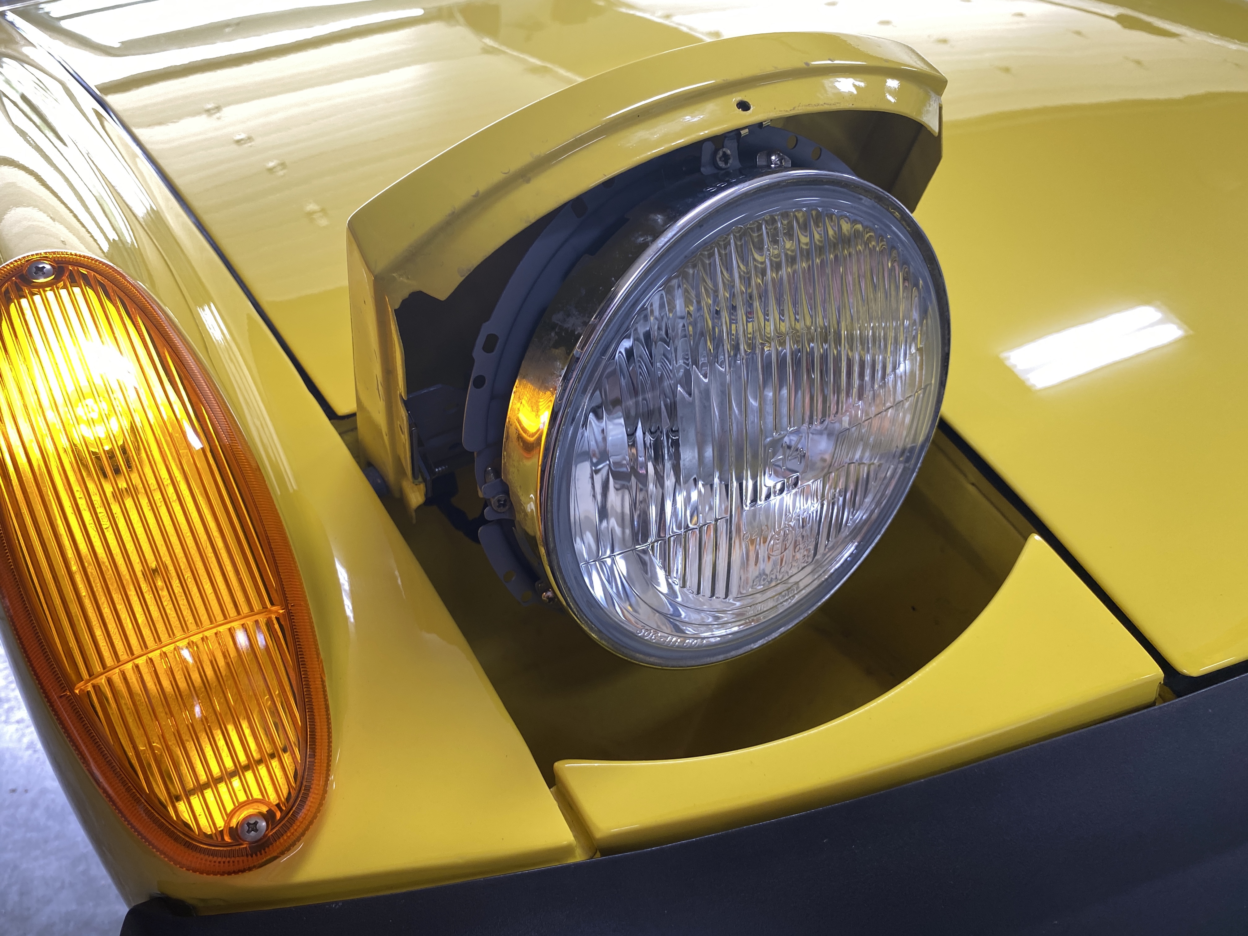

Headlights ready to instal, with a bead of goop around the bulb itself.
bkrantz
post Jul 25 2022, 07:50 PM
Post #5749
Posts: 8,673
Joined: 3-August 19
From: SW Colorado
Member No.: 23,343

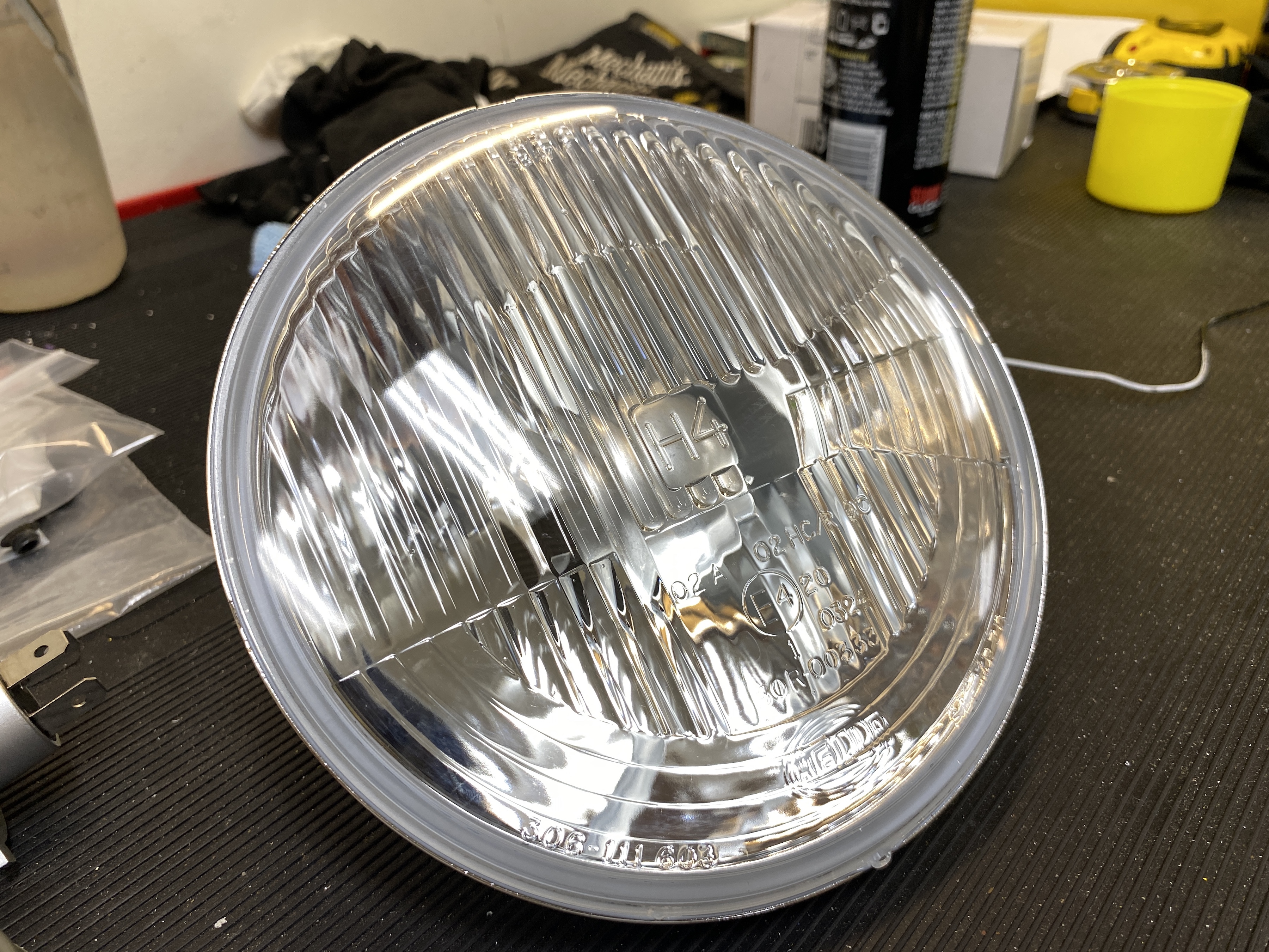

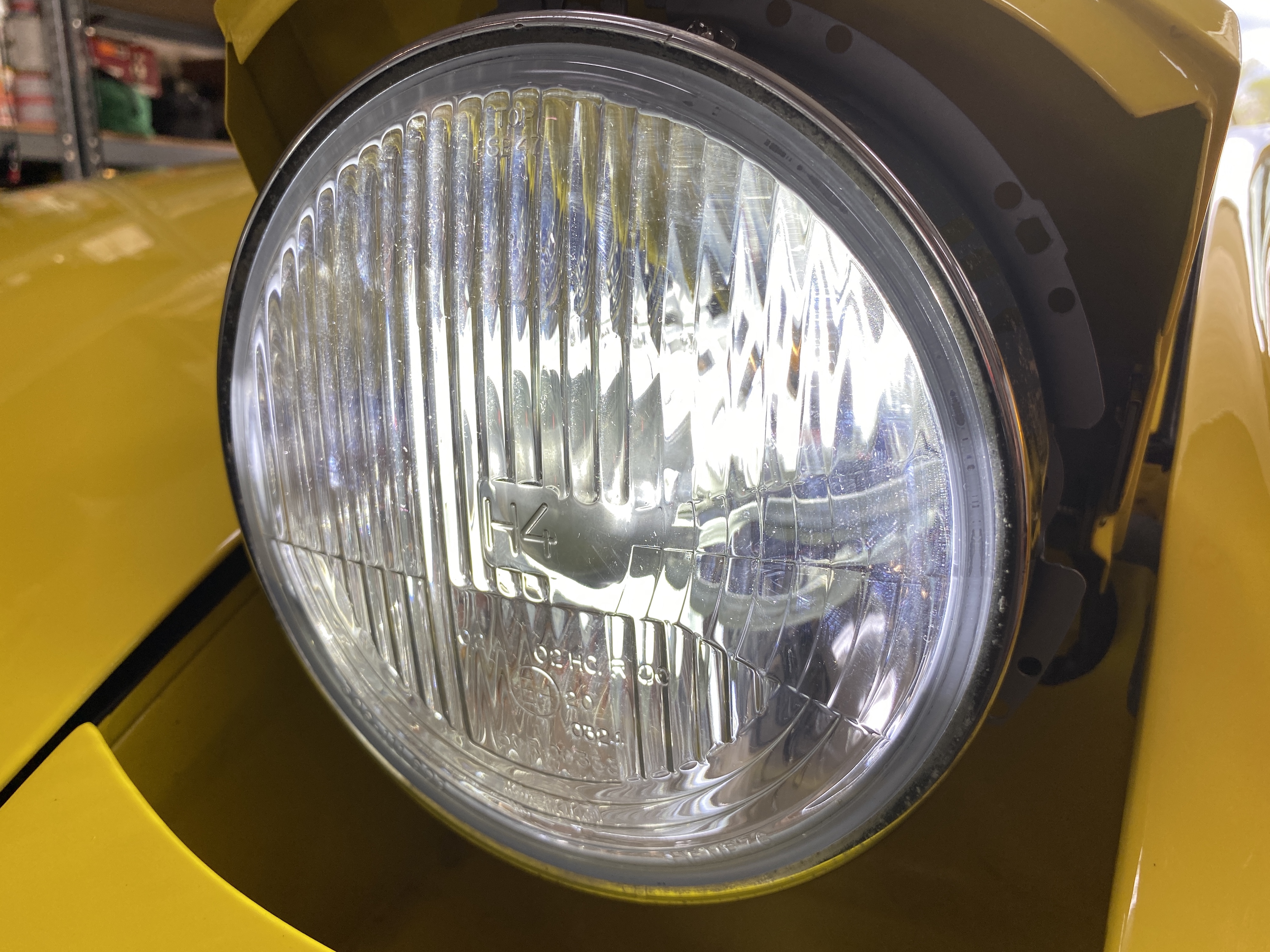

installed with the lights off and it looks clear.

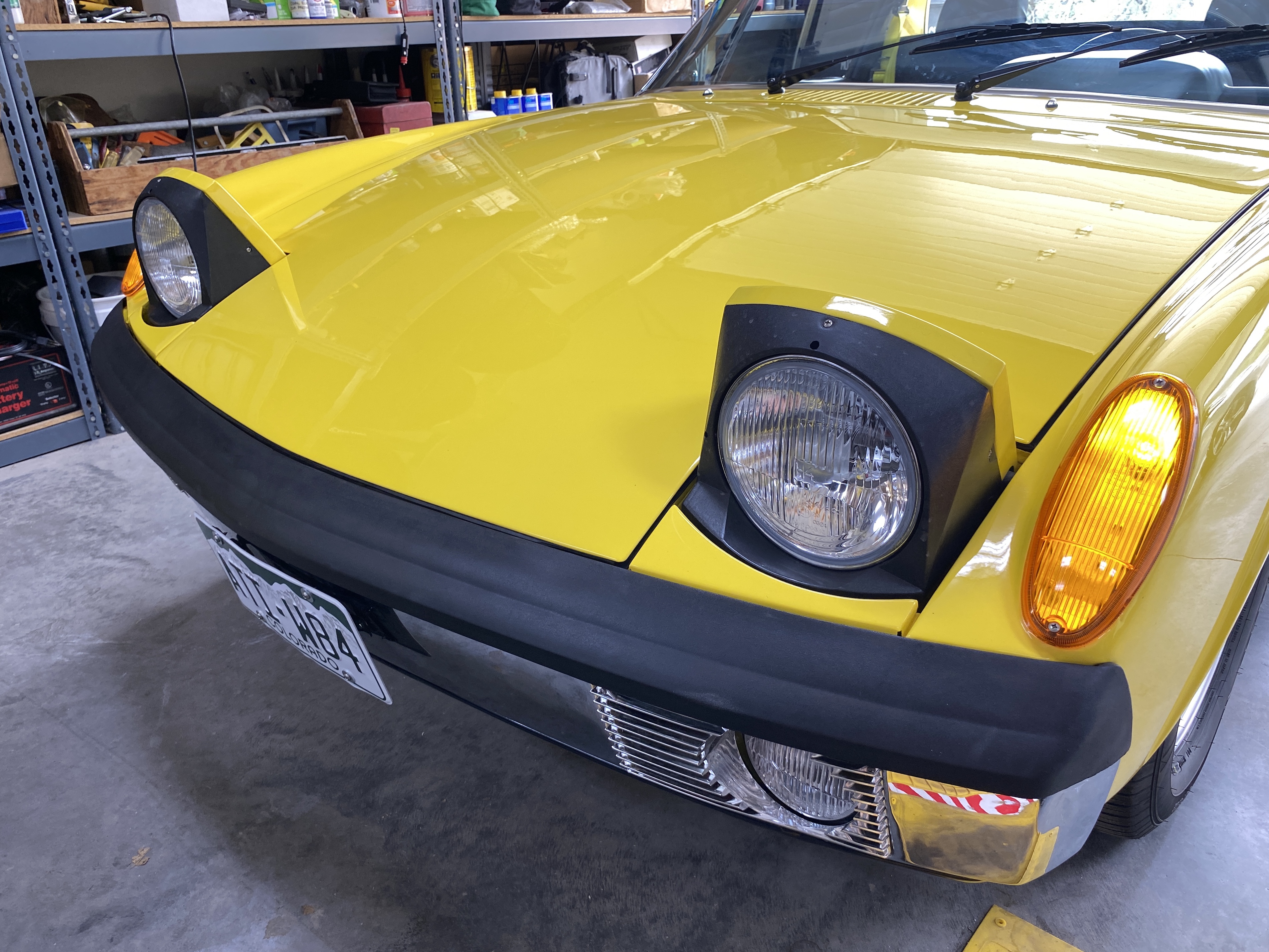

bkrantz
Post #5750
Posts: 8,673
Joined: 3-August 19
From: SW Colorado
Member No.: 23,343
And with the lights on, still looks good.
bkrantz
post Jul 25 2022, 07:51 PM
Post #5751
Posts: 8,673
Joined: 3-August 19
From: SW Colorado
Member No.: 23,343

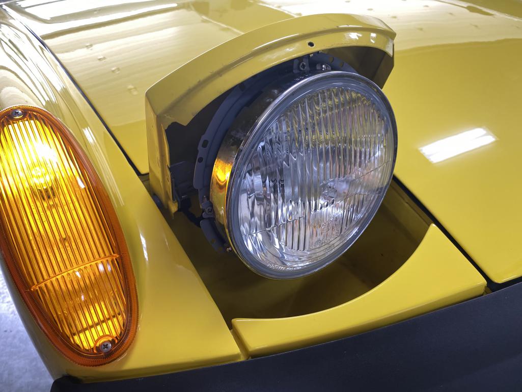

Covers back on, ready for some night driving (after some aiming).

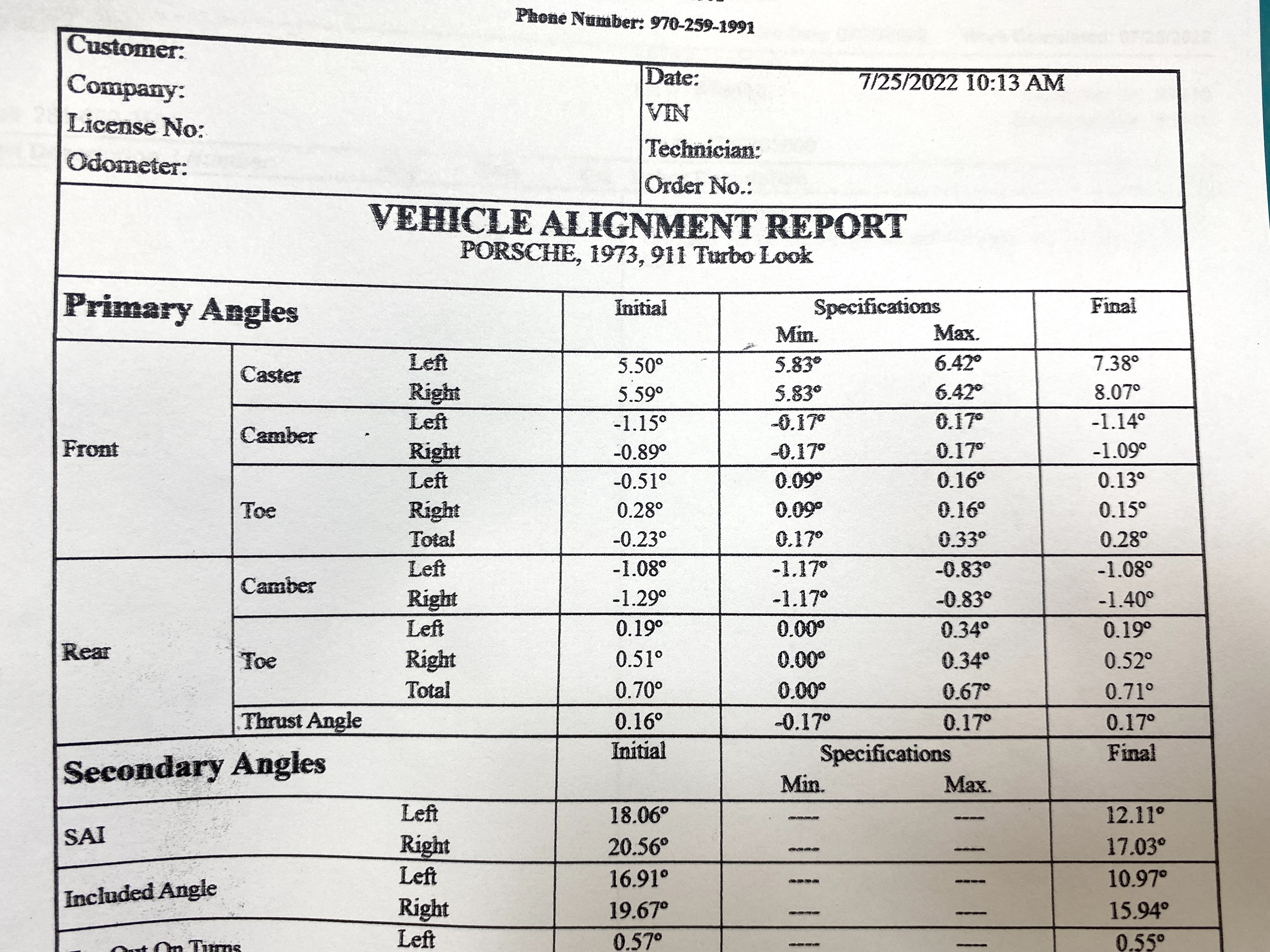

I took the 914 to a shop for a "real" four wheel alignment, but the process failed. After getting the car on the rack and some initial measurements, the tech reported that the assemblies mounted on the front wheels ran into the fenders when the wheels turned. So no camber possible and questionable measurements all around. Rats.

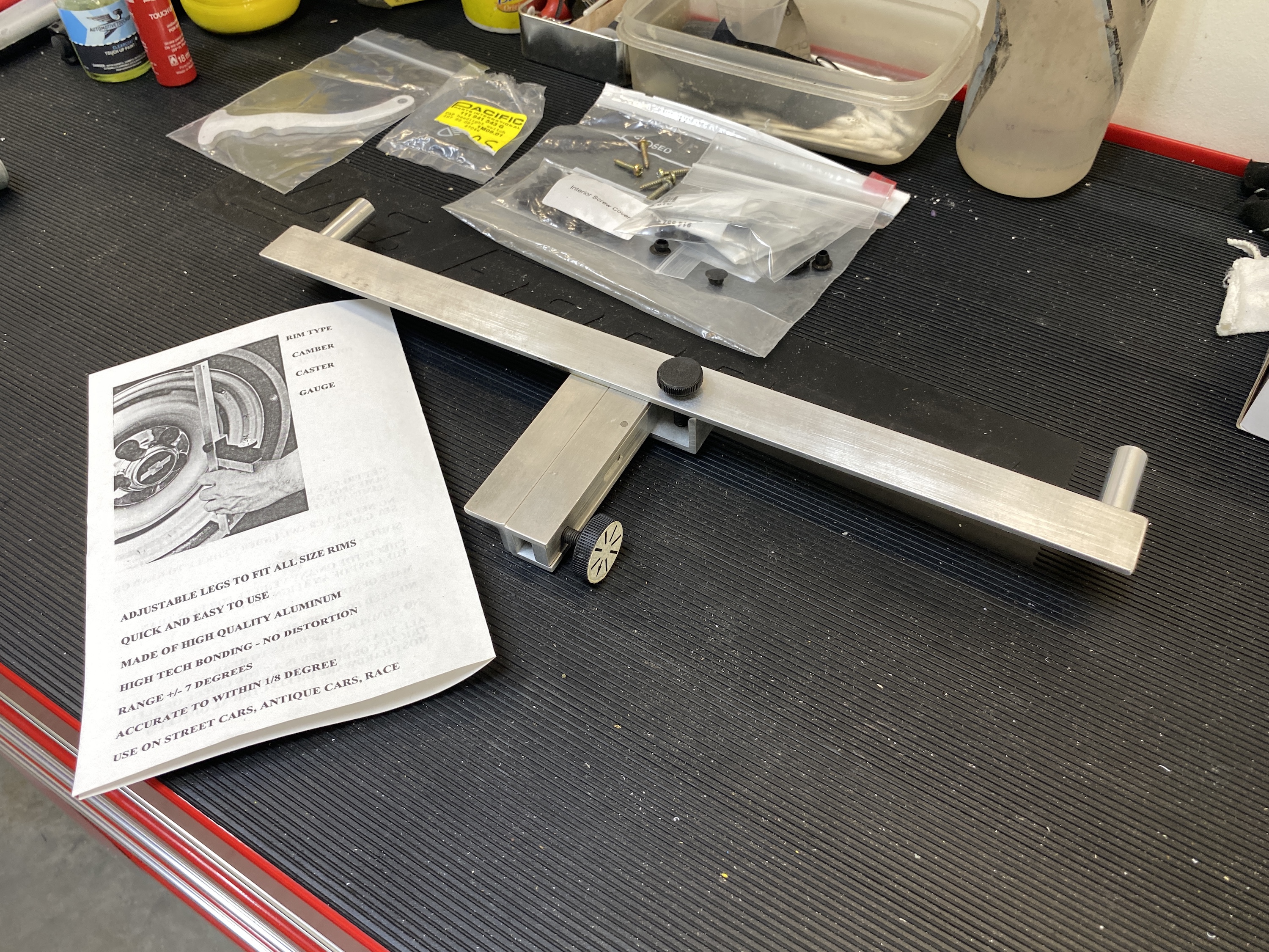

Once home I got out my vintage primitive camber gauge.
bkrantz
post Jul 25 2022, 07:59 PM
Post #5754
Posts: 8,673
Joined: 3-August 19
From: SW Colorado
Member No.: 23,343
But my home readings are not close to the suspect shop readings. Now what?
bkrantz
post Jul 26 2022, 08:13 PM
Post #5755
Posts: 8,673
Joined: 3-August 19
From: SW Colorado
Member No.: 23,343
First step: I checked the zero on the gauge (I know I did this last year), and found it off by about 0.2°. Unfortunately, it has no calibration, but I know the correction factor now.

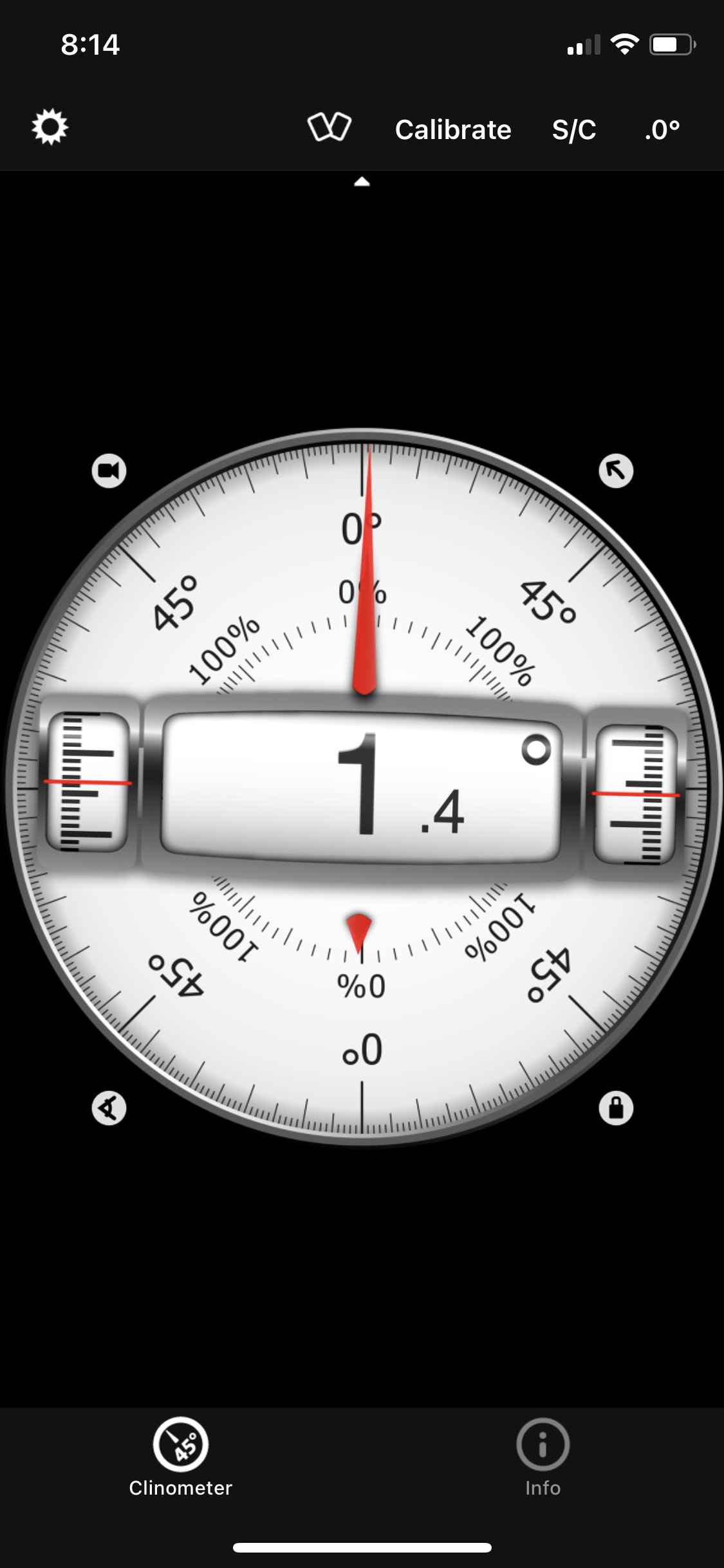

I also tried using my iPhone, with a clinometer app that claims 0.1° precision. To use the phone I had to hold it against a straight edge, while holding a straight edge against the rim, and with a spacer in-between so the phone side buttons did not screw up the measurements.
bkrantz
post Jul 26 2022, 08:21 PM
Post #5757
Posts: 8,673
Joined: 3-August 19
From: SW Colorado
Member No.: 23,343
Here's my new measurements, with the phone app and the corrected camber gauge. The variation is probably within error, and these better match the preliminary camber numbers from the shop.

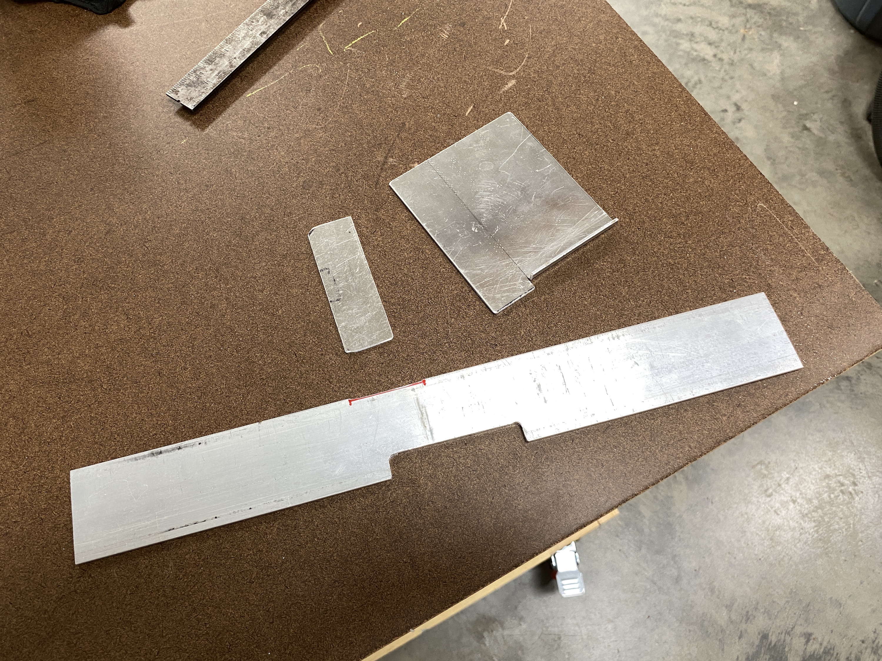

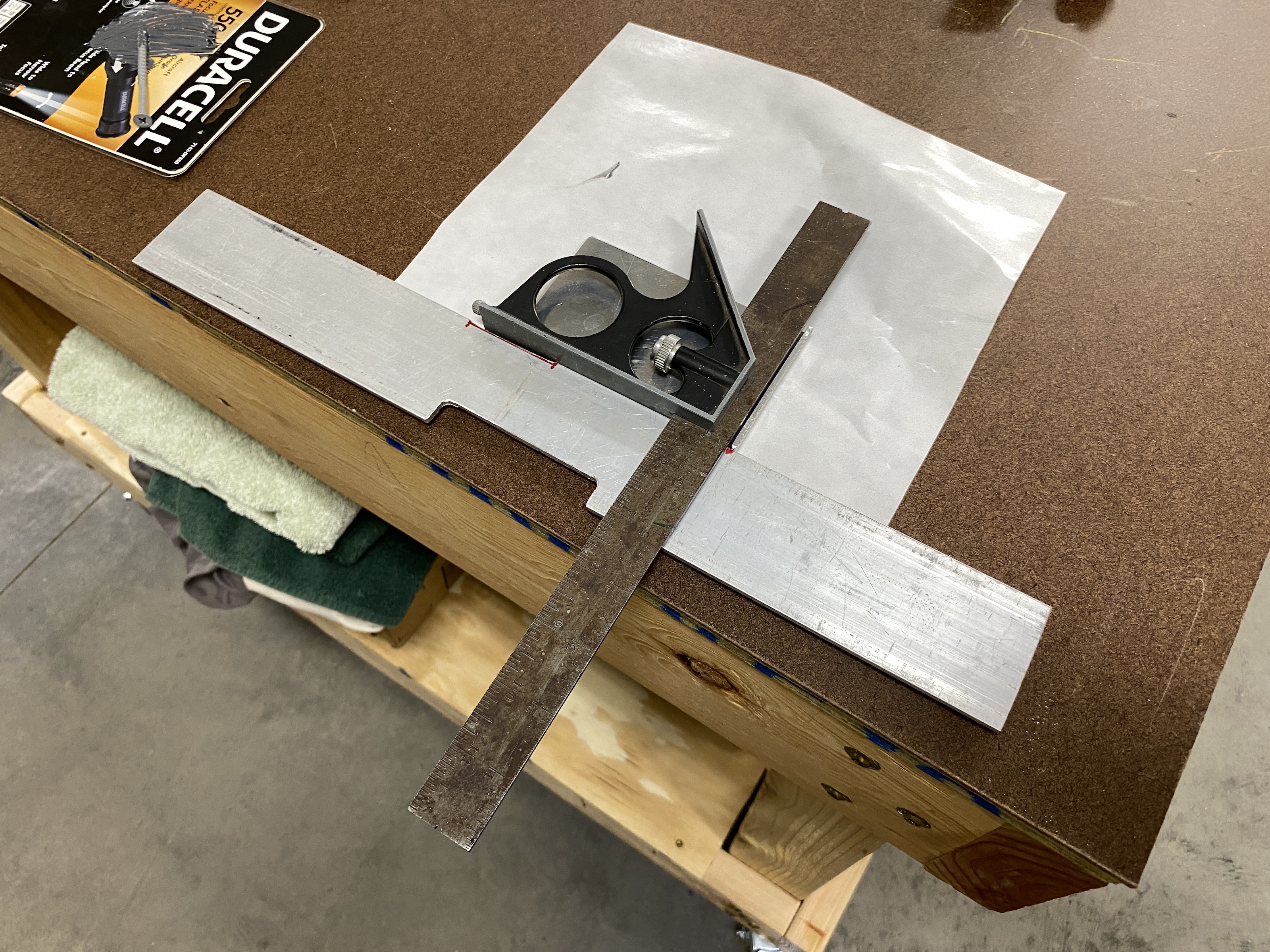

Member No.: 23,343

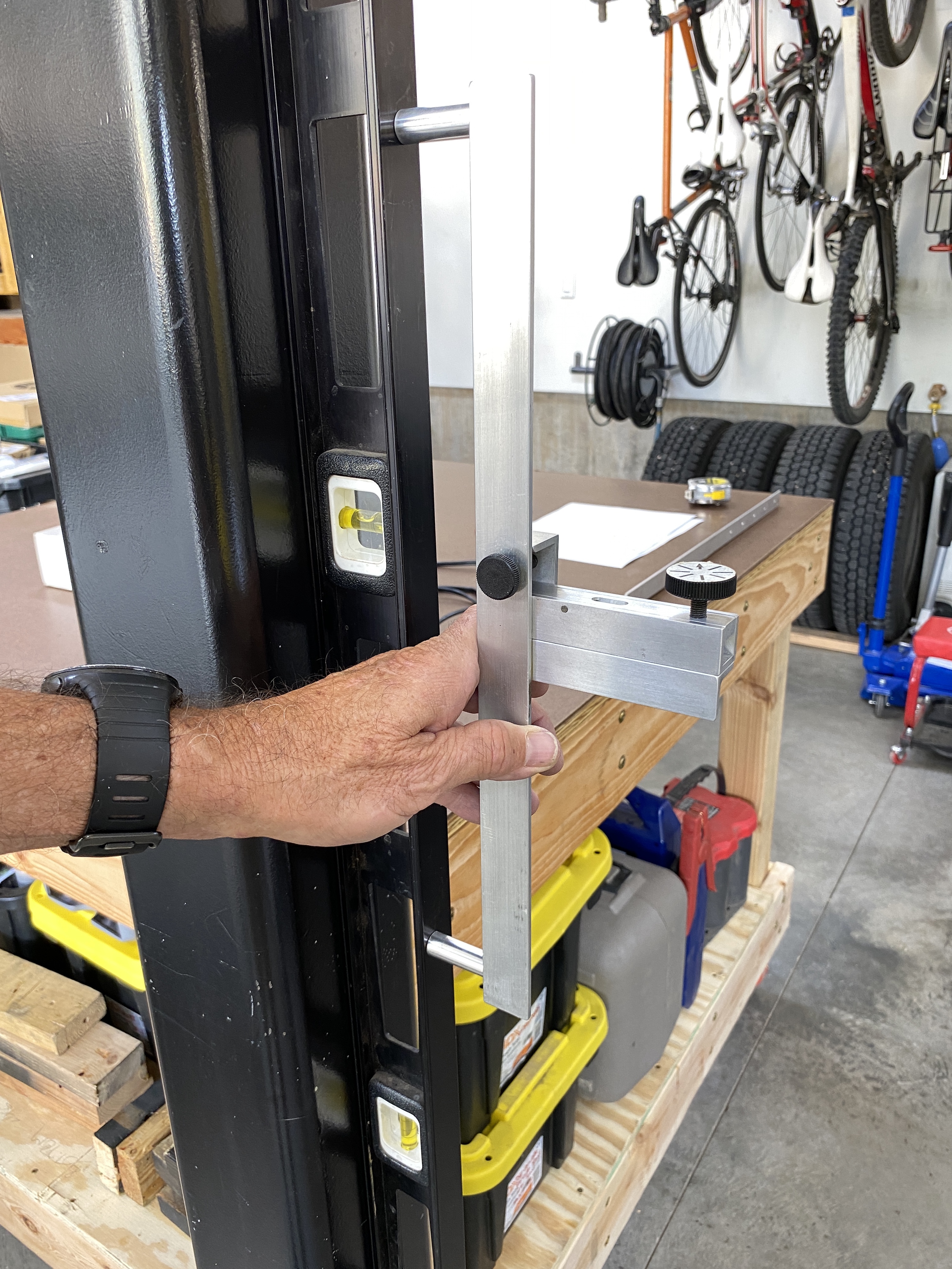

I decided to make a new gauge to use my phone from aluminum bits around the garage.
bkrantz
post Jul 26 2022, 08:26 PM
Post #5759
Posts: 8,673
Joined: 3-August 19
From: SW Colorado
Member No.: 23,343
I used more JB Weld to glue the parts together. I will test this tomorrow.

QUOTE(bkrantz @ Jul 24 2022, 06:09 PM) *
If ever you visit the city of Pueblo, this is a "must" upgrade.....
