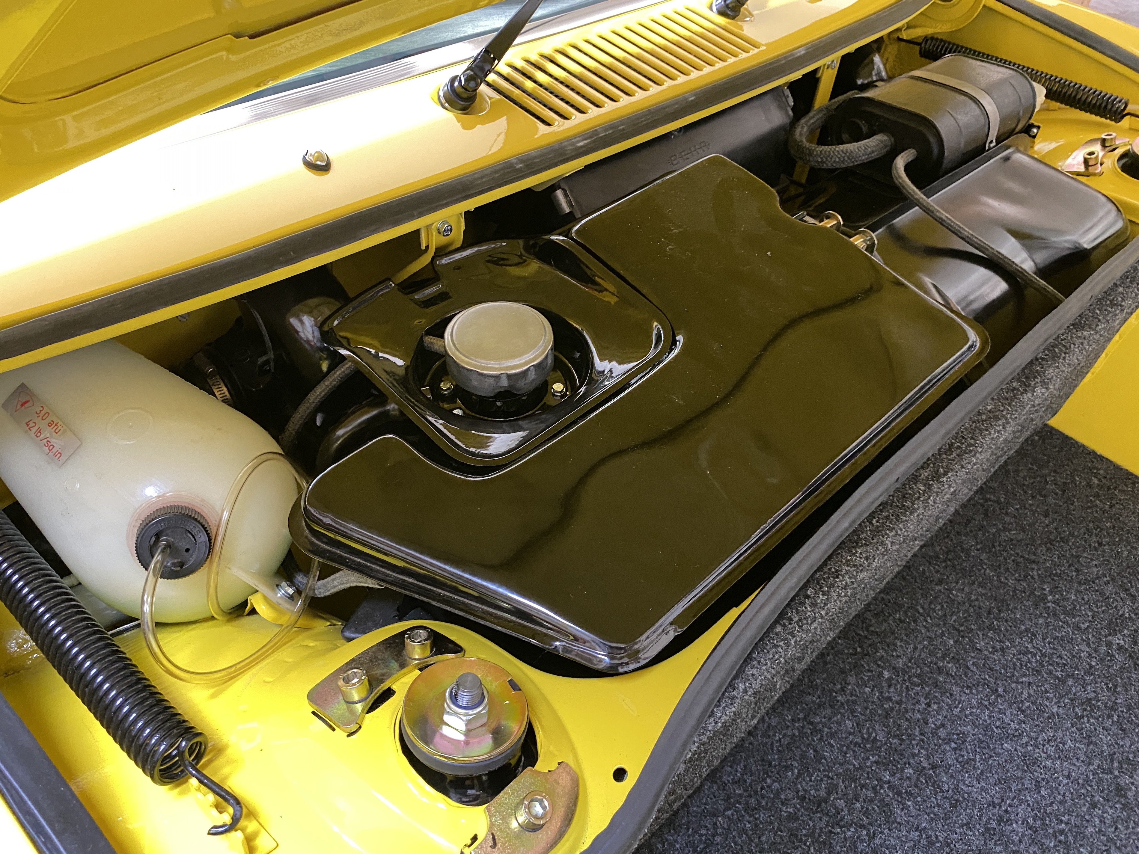

I checked the toe measurements and camber (with my old bubble gauge) one more time, then took down the strings. I put the fuel evaporation tank back on, and closed it all up.
I then uploaded a new file to the Megasquirt ECU, since I had too many pops and a few backfires when the engine spun down.

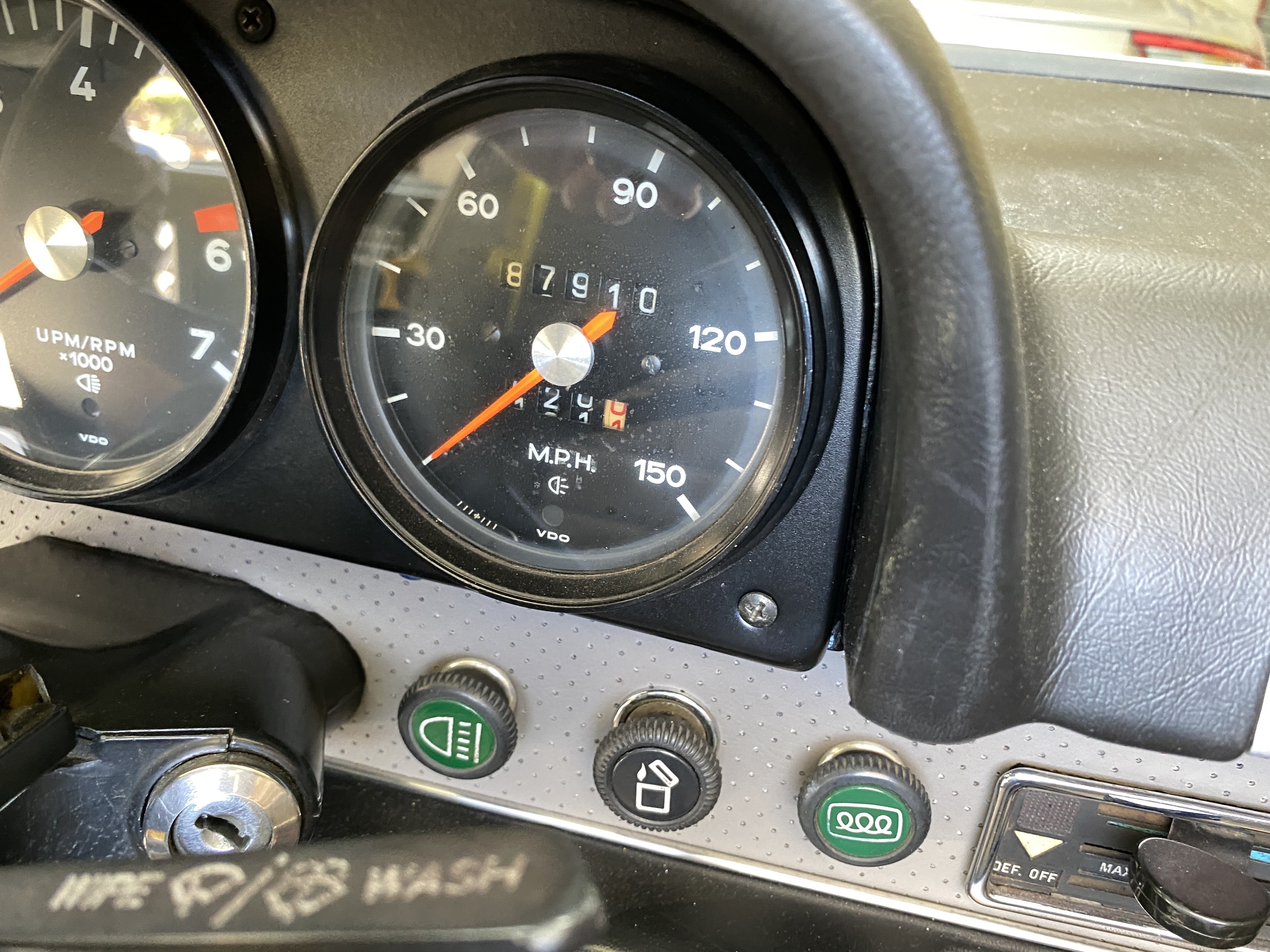

With a new correct angle drive, the speedometer works but seems to read fast. My tires are within 1% of original diameter, so it must be internal to the gauge. No odometer function.
I stopped for gas on the way home. The gauge indicated a bit more than 1/4 tank. I put in 6.5 gallons, and it read about 3/4, so it seems to work.

With my son watching his GPS app, we figured out that the speedometer reads consistently 5 mph too high.

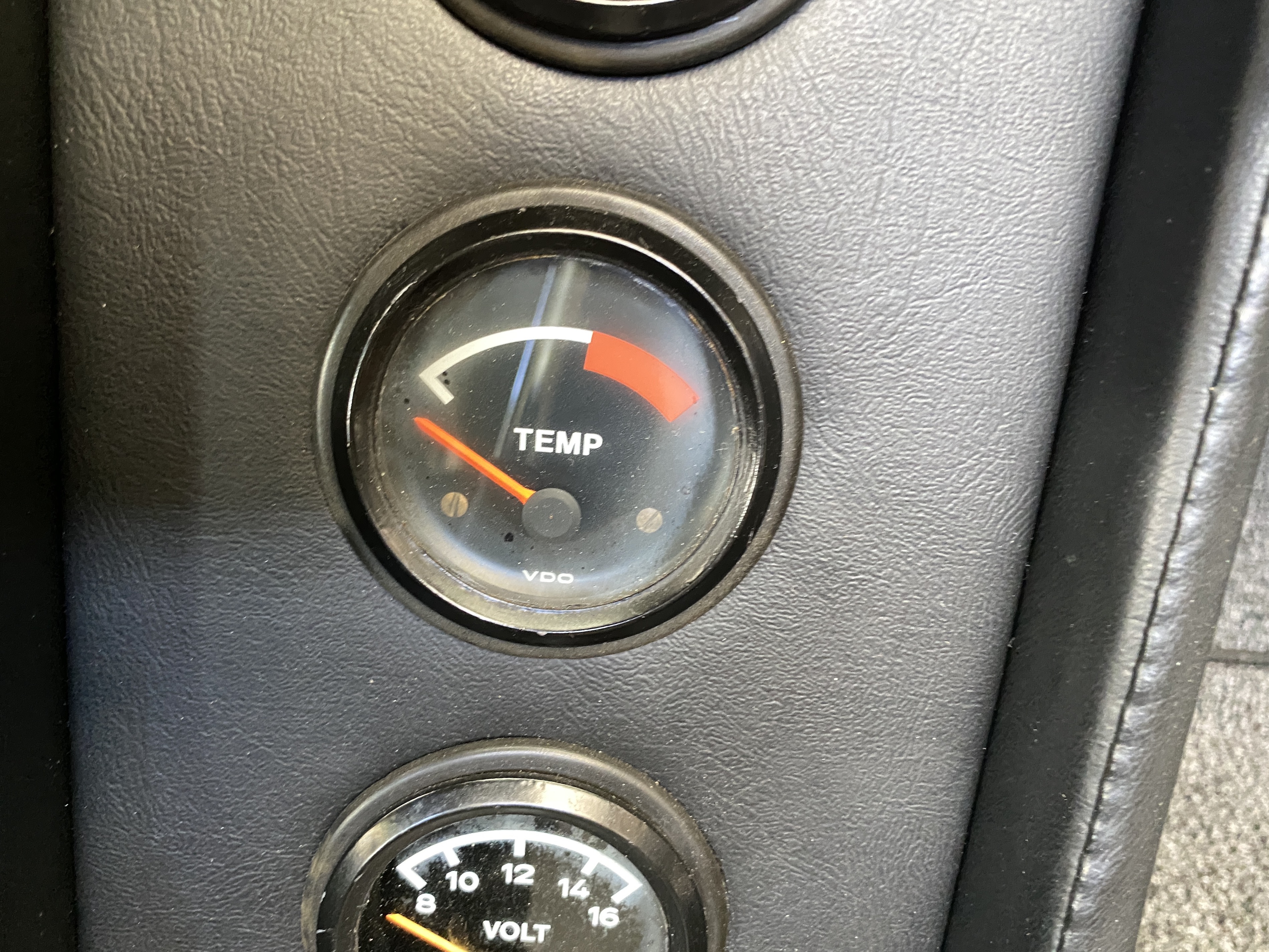

When we got home, I saw what looks like condensation inside the temp gauge. Strange, since this has been indoors for the past 3 years and not near water.

Hate to say it, but this stuff will never go away. I have experienced the same thing with gauges and wondered if a small (tiny) pack of desiccant would help.
