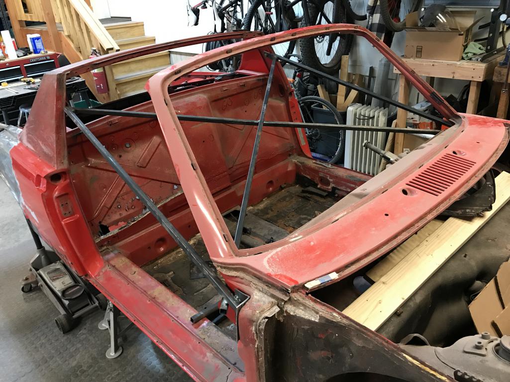

Completed the interior bracing with some diagonals. Not sure if necessary but my son was having fun with the new TIG welder.

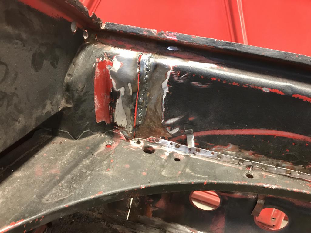

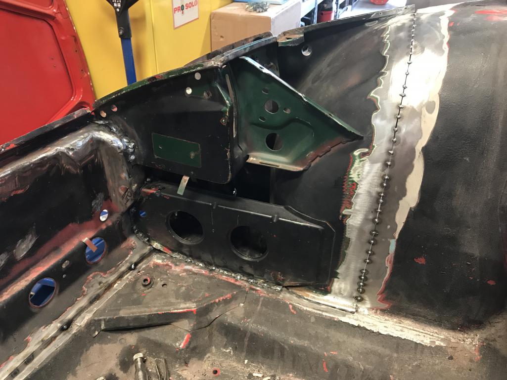

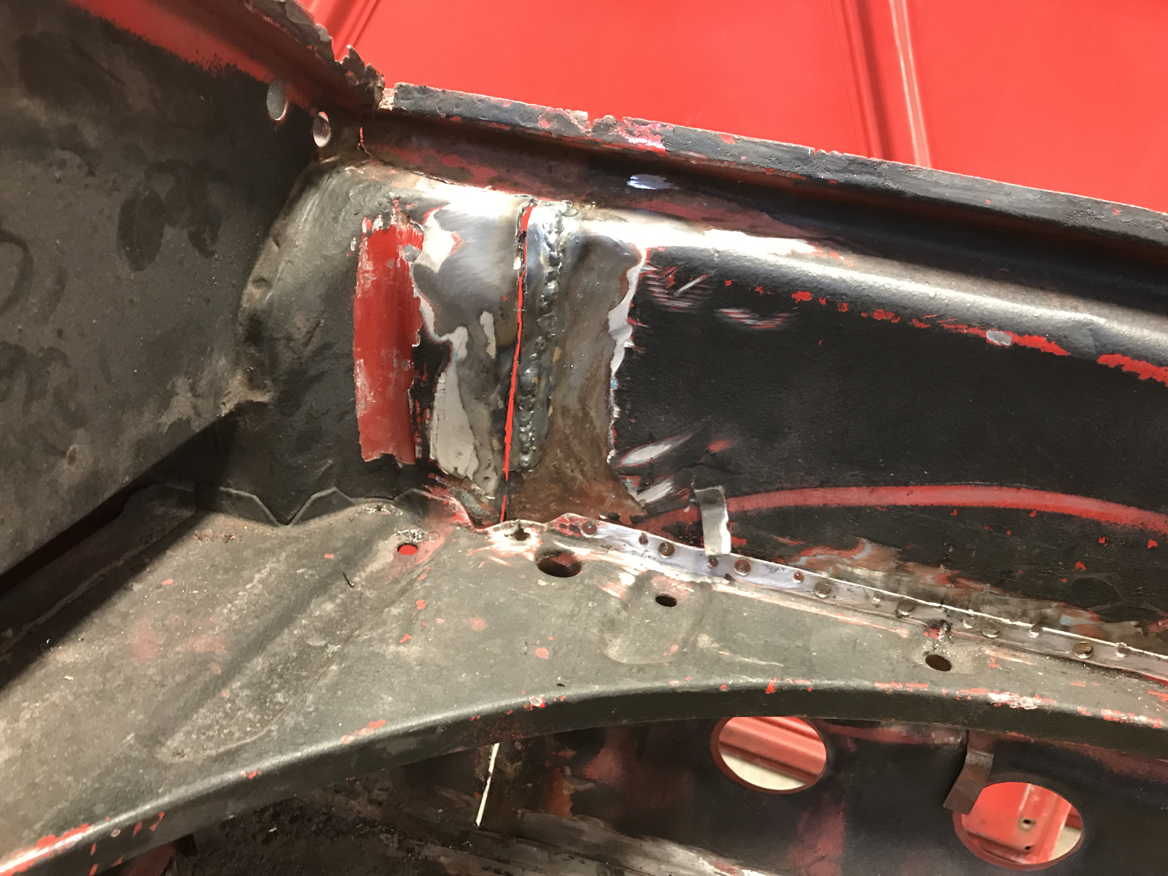

And completed the patches on the right front inner fender splice.

Two steps forward, at least one back!

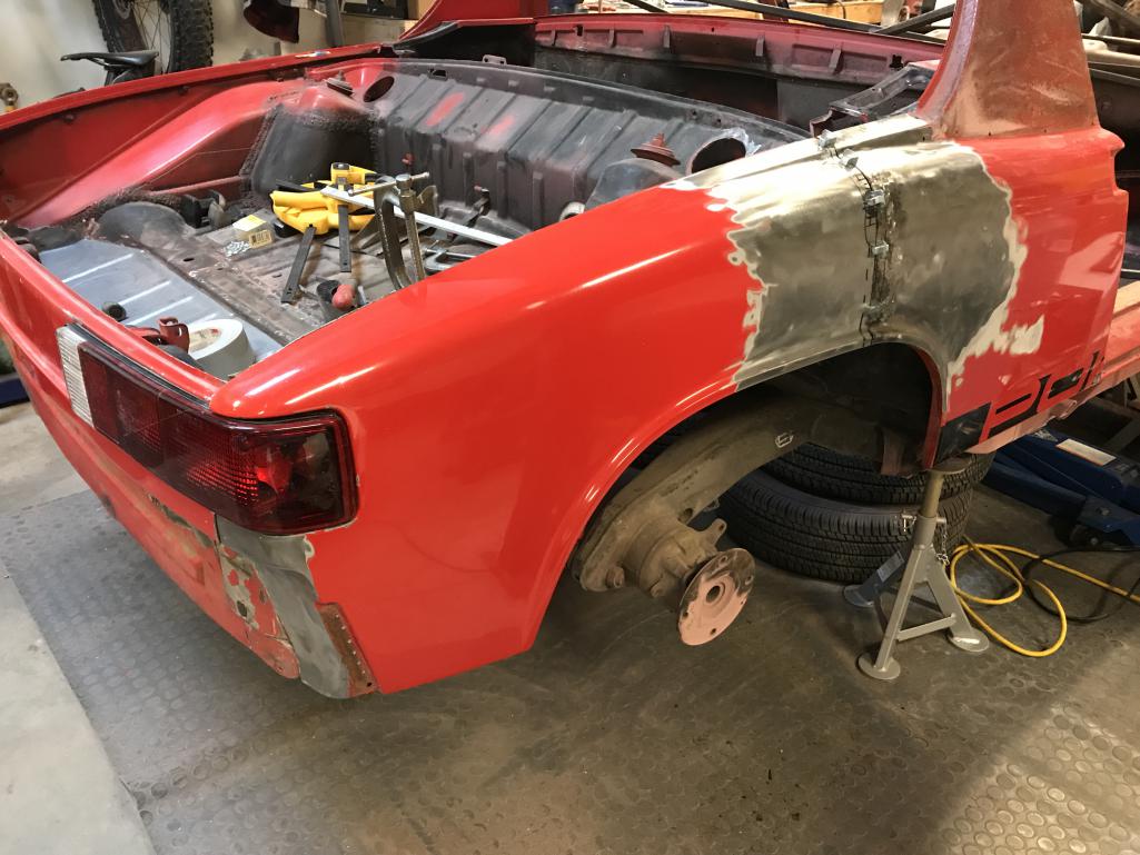

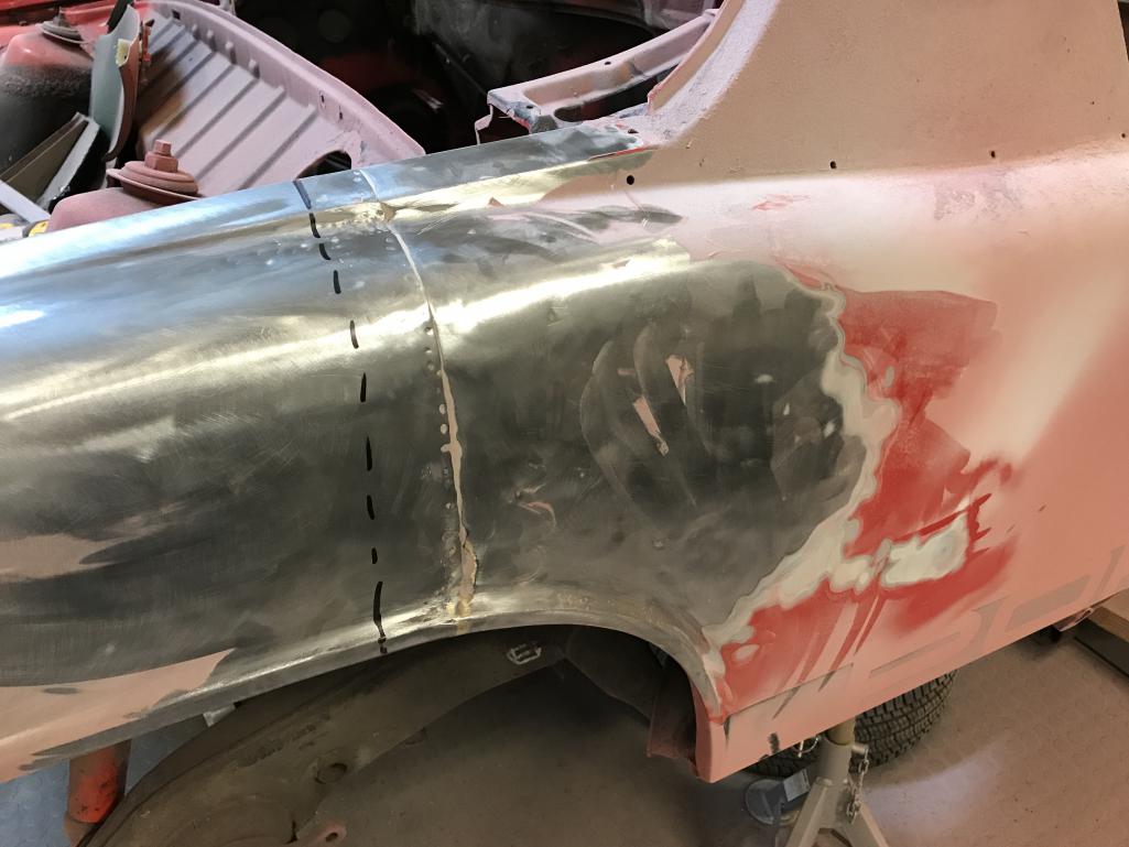

I knew about this "surprise", with a crappy lap joint in the outer rear fender. I tried to ignore it for as long as possible, but decided to at least see how bad. Only attached on the outer lap with some spot welds and brazing.
bkrantz
post Dec 22 2019, 09:35 PM
Post #64
Posts: 8,824
Joined: 3-August 19
From: SW Colorado
Member No.: 23,343
Decided to separate, in order to make it right. This also gives me better access to finish work on the inner fender. Pretty easy since the fender was only attached at the lap joint, some brazing around the tail light opening, and one spot of brazing on the top seam.

This has to be a nomination for the worst lap joint. Crude cut left open inside the fender.
My question was more about spot-welded seams, where paint access will be difficult at best.

Here's the front corner mostly welded in place. A few more tweaks and we can finish the butt seam.

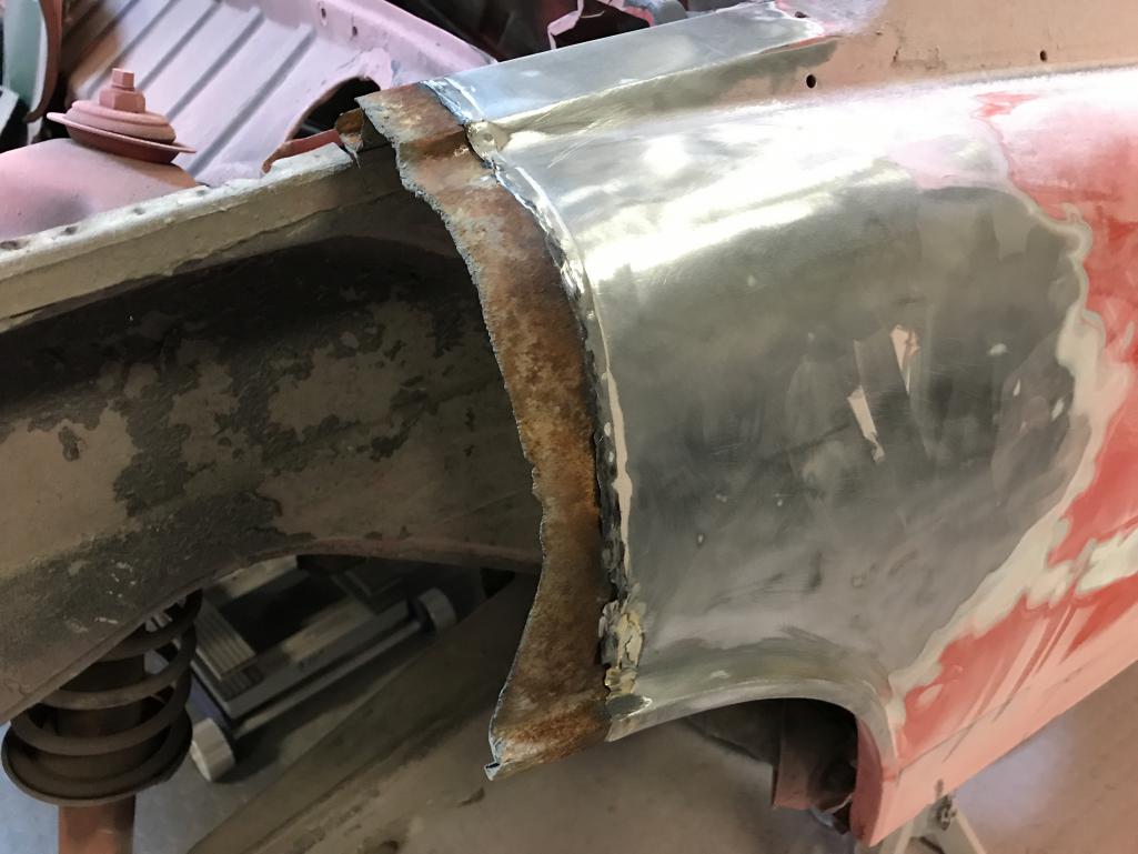

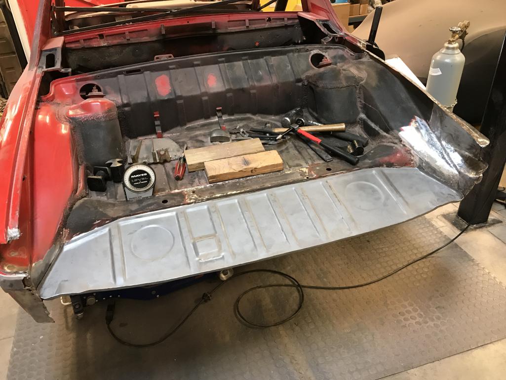

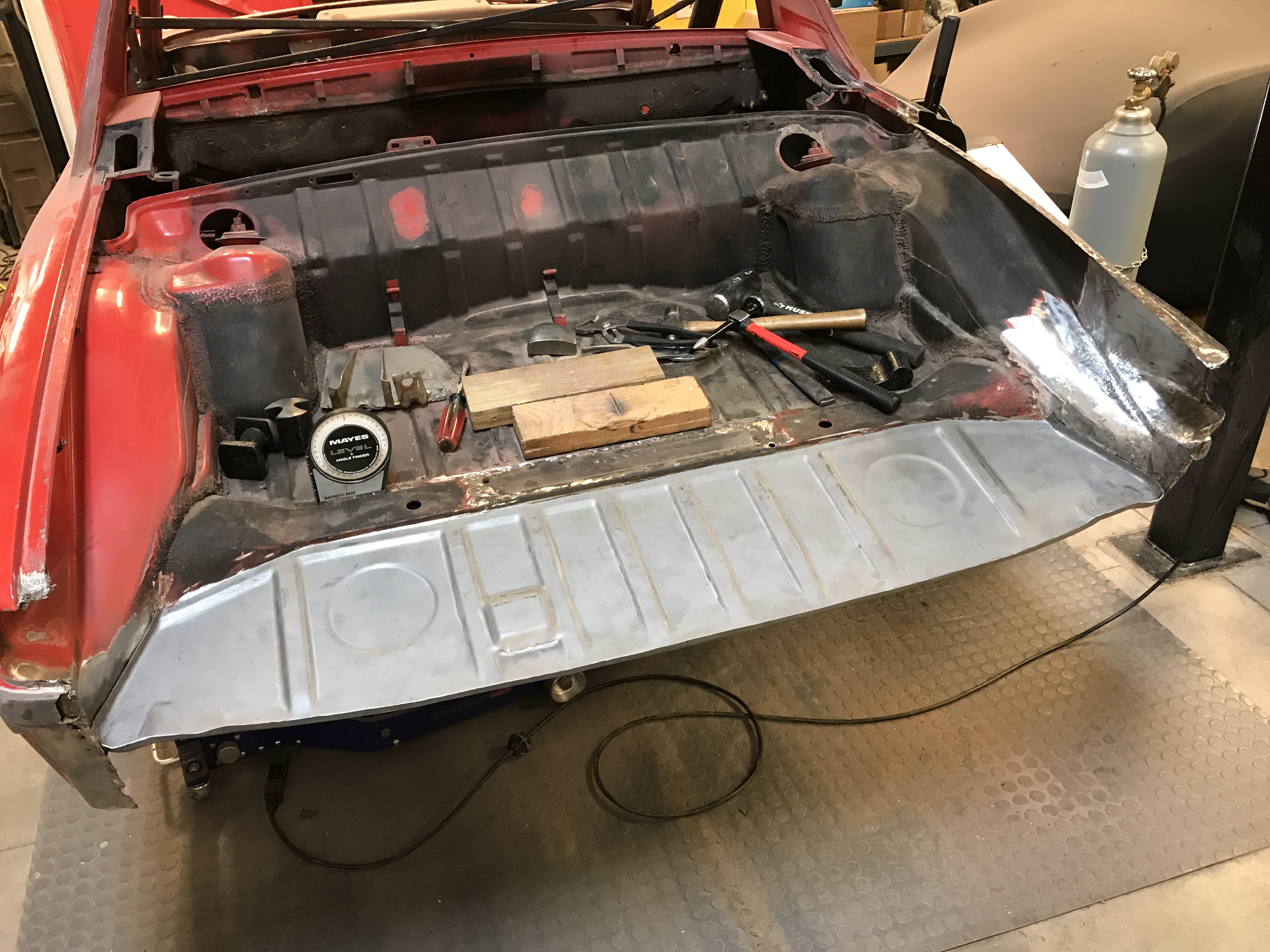

Meanwhile, getting started on the rear. First trim and fit for the trunk floor.
bkrantz
post Dec 23 2019, 09:34 PM
Post #69
Posts: 8,824
Joined: 3-August 19
From: SW Colorado
Member No.: 23,343
And starting the fit for the rear panel. This will need some work.

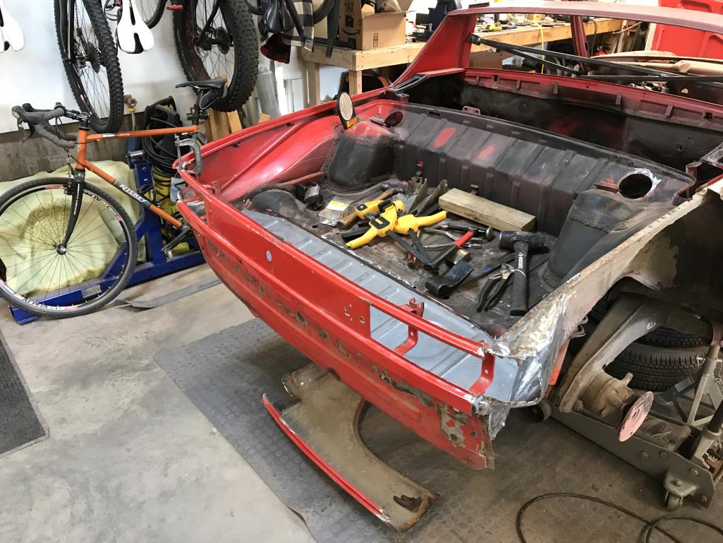

Right side is looking better, with access after removing the outer fender.

Got the outer fender cut and fit. A few more tweaks and it should be ready for welding, along with the floor and the rear panel.

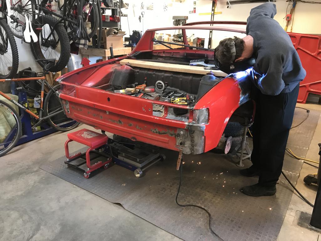

bkrantz
post Dec 24 2019, 10:00 PM
Post #75
Posts: 8,824
Joined: 3-August 19
From: SW Colorado
Member No.: 23,343

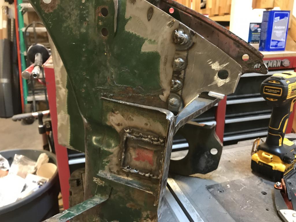

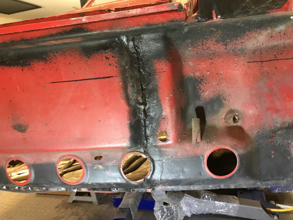

And...here's the last dodgy previous repair, where somebody spliced a replacement front panel with a lap joint, just inside of the left head light. Time to fix this.

Only a half-day for xmas, since I want to get as much done as possible during my son's visit.
Working on the dodgy front lap joint, starting with a cut through the overlapping metal.
bkrantz
post Dec 25 2019, 09:21 PM
Post #77
Posts: 8,824
Joined: 3-August 19
From: SW Colorado
Member No.: 23,343
And a further adjustment and test fit for all the rear pieces--almost ready to start welding. Fits are within about 1/16 inch and alignment looks good with my replacement trunk lid.

bkrantz
post Dec 26 2019, 09:09 PM
Post #80
Posts: 8,824
Joined: 3-August 19
From: SW Colorado
Member No.: 23,343

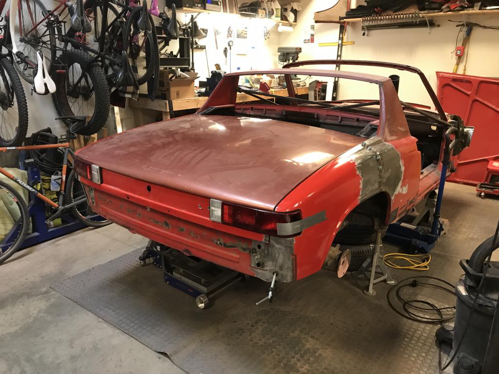

Got the rear panel and outer fender welds mostly done.
