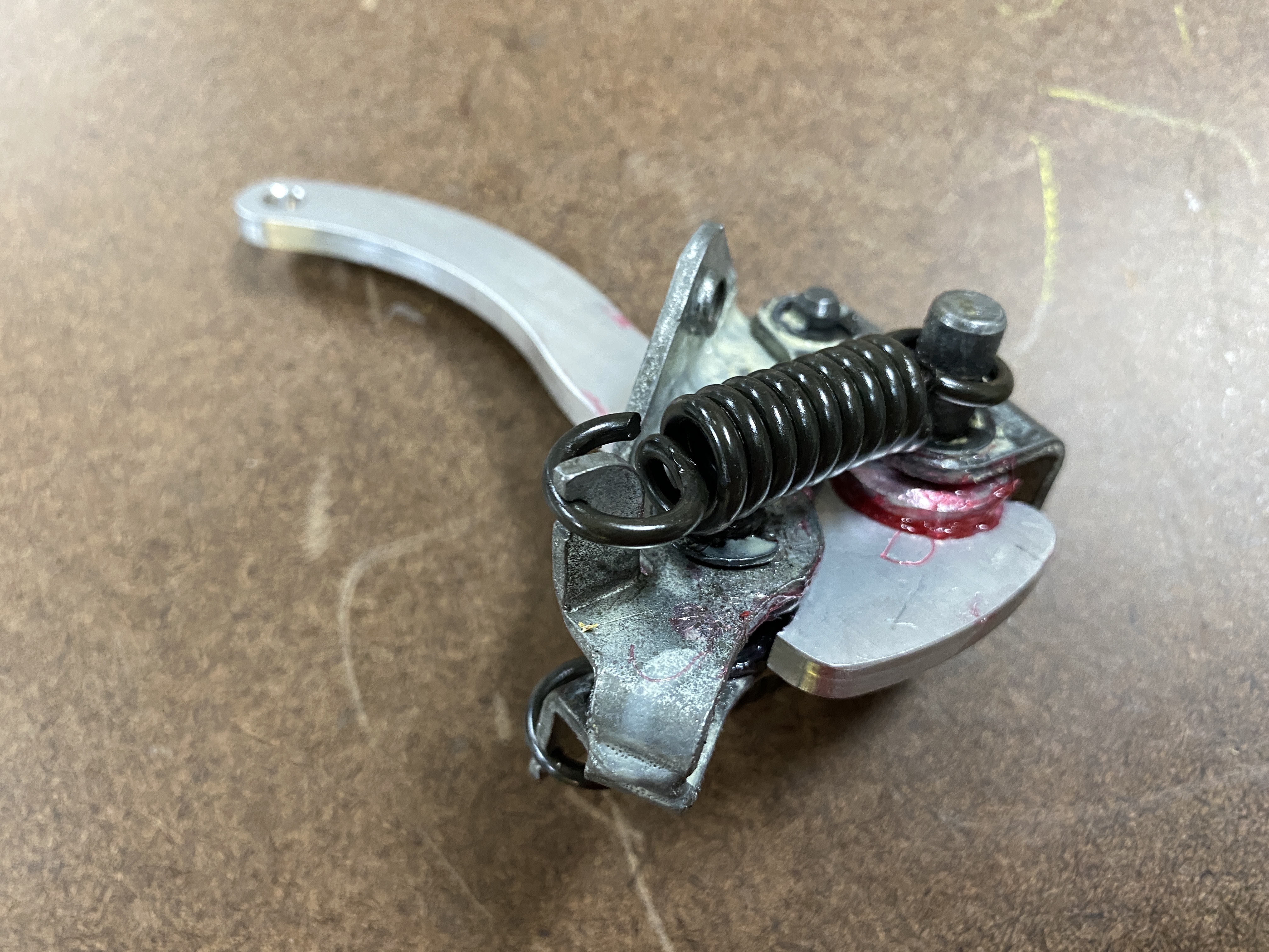

One side rebuilt.

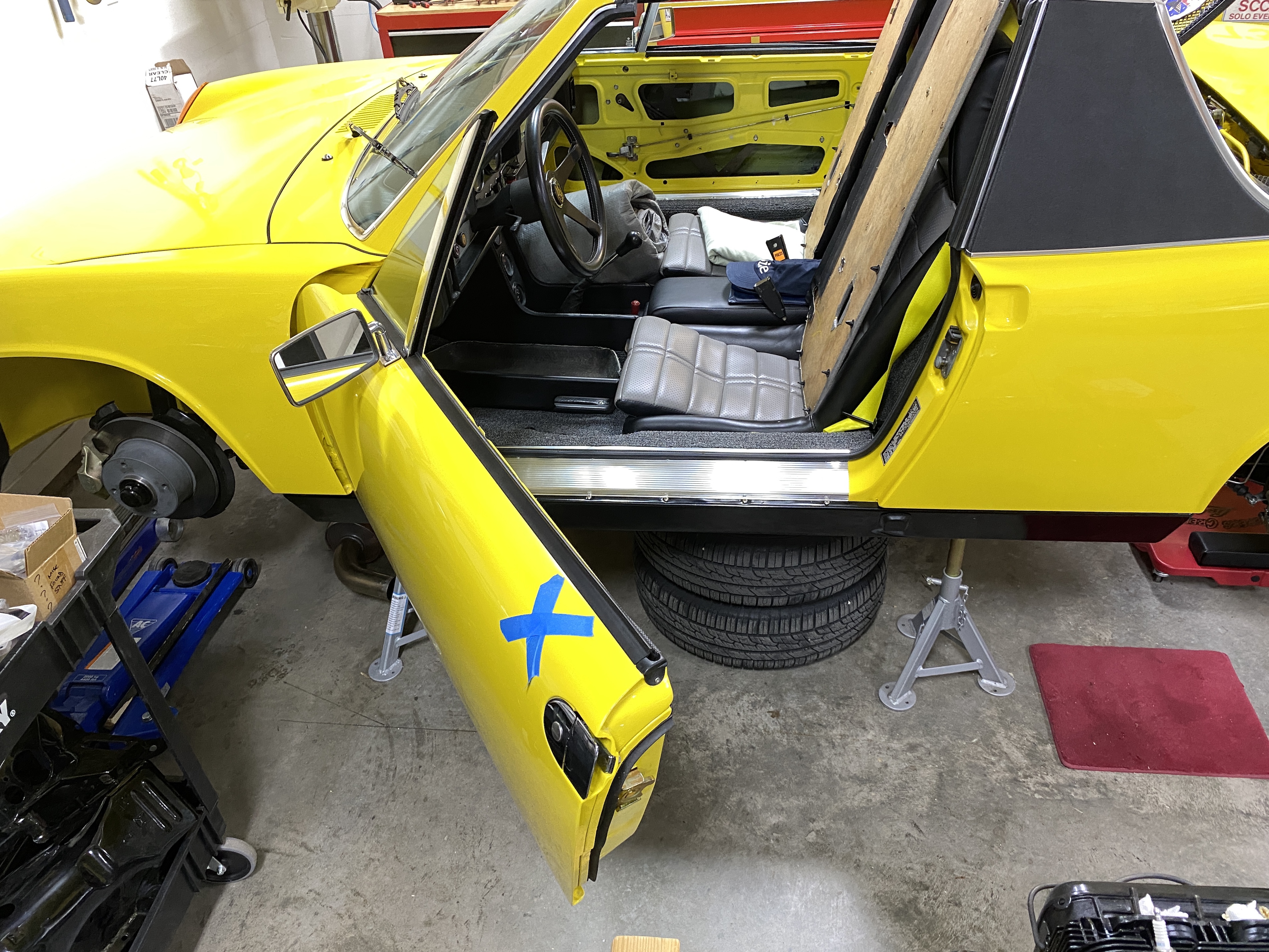

And installed. Now this door has two firm opened positions. And I can remove the blue tape X to remind me not to open the door too far without the stay.

I actually did both sides.

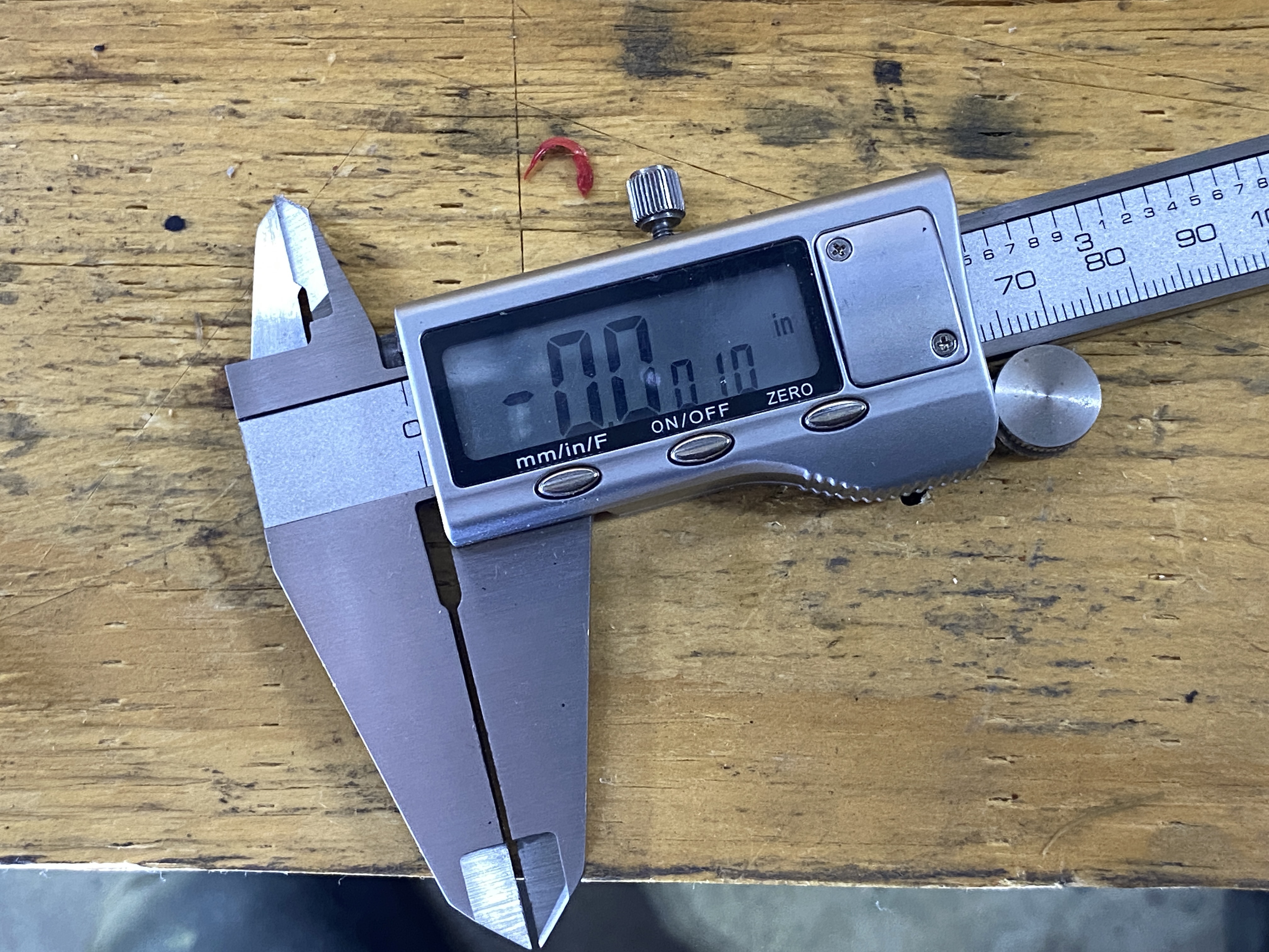

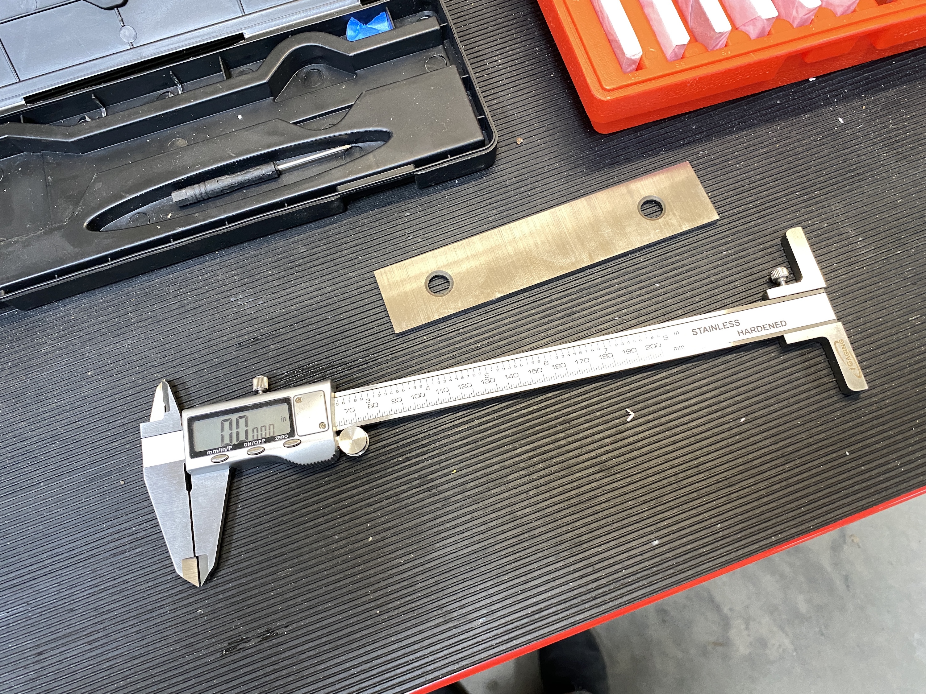

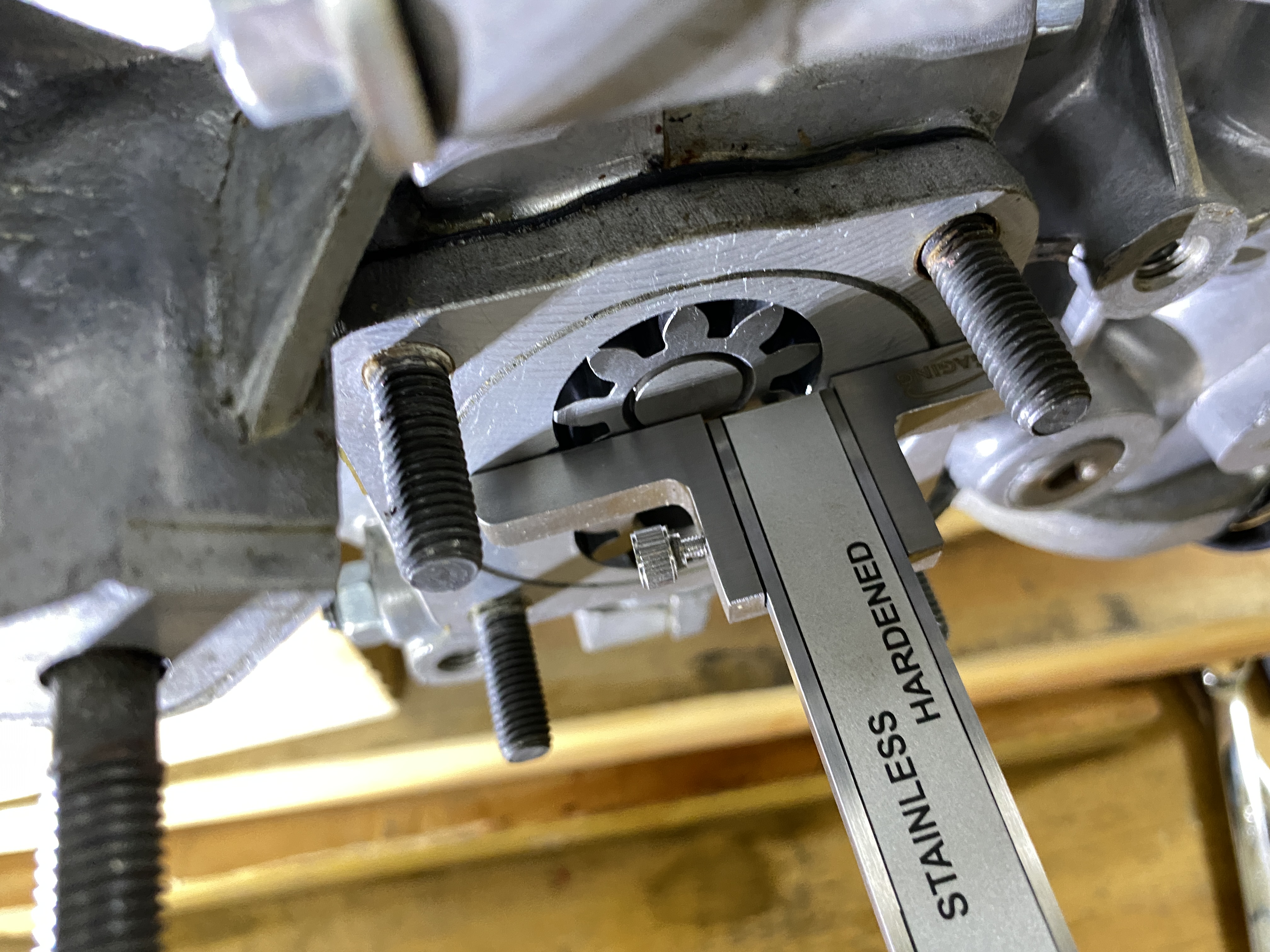

Back to working on oil leaks, and the pump. I set up my digital caliper with a plunge adapter.
bkrantz
post Jan 23 2023, 08:05 PM
Post #6085
Posts: 8,746
Joined: 3-August 19
From: SW Colorado
Member No.: 23,343
Measuring from the face of the pump to the tops of the gears.
bkrantz
post Jan 23 2023, 08:07 PM
Post #6086
Posts: 8,746
Joined: 3-August 19
From: SW Colorado
Member No.: 23,343
I got measurements from .000" to .002", with most in the range of .0005" to .001"
bkrantz
post Jan 23 2023, 08:08 PM
Post #6087
Posts: 8,746
Joined: 3-August 19
From: SW Colorado
Member No.: 23,343

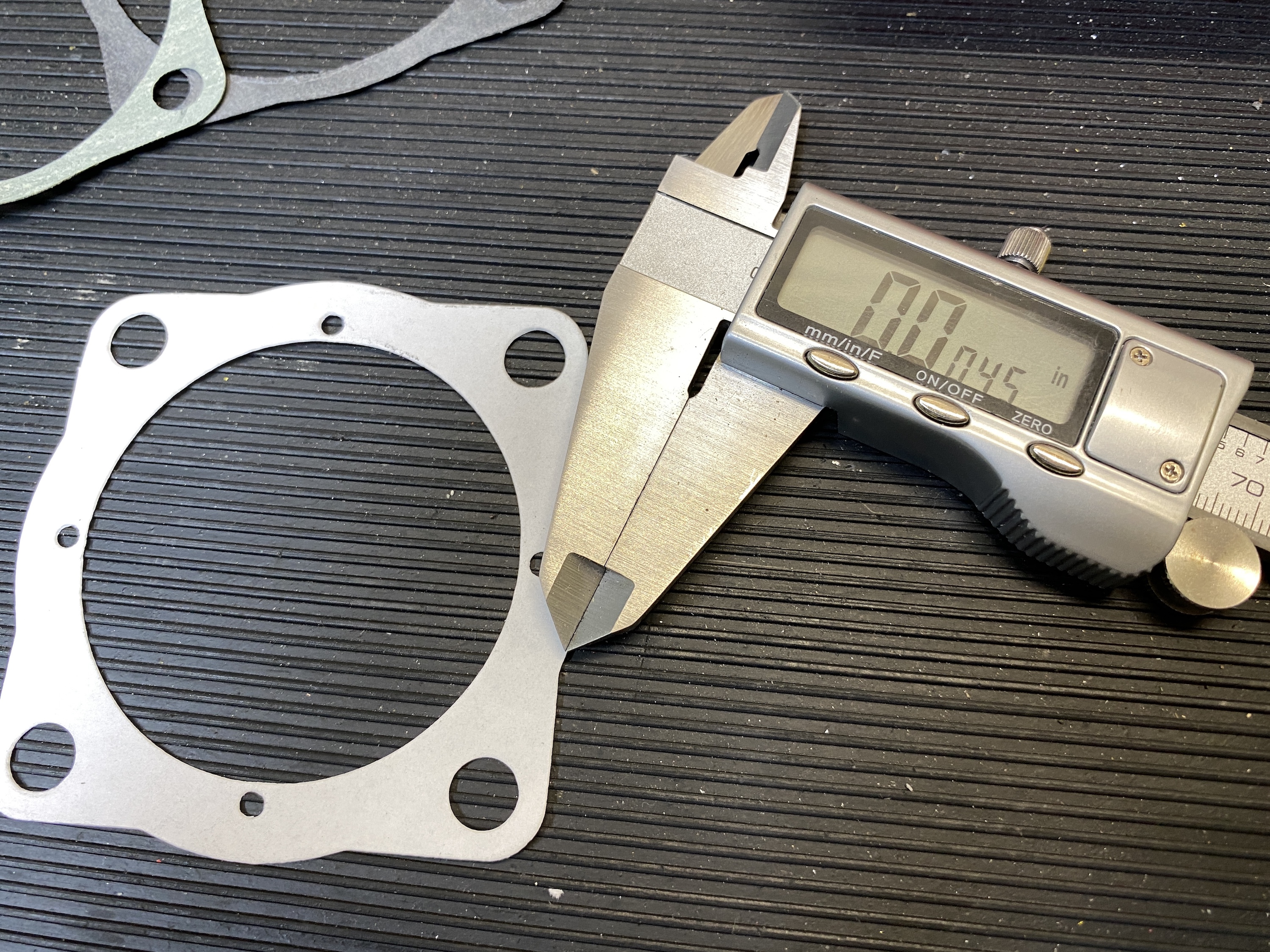

The gasket I have in my supply measures .0045" thick.
As I understand, optimum gear clearance is .003", so I need a thinner gasket.

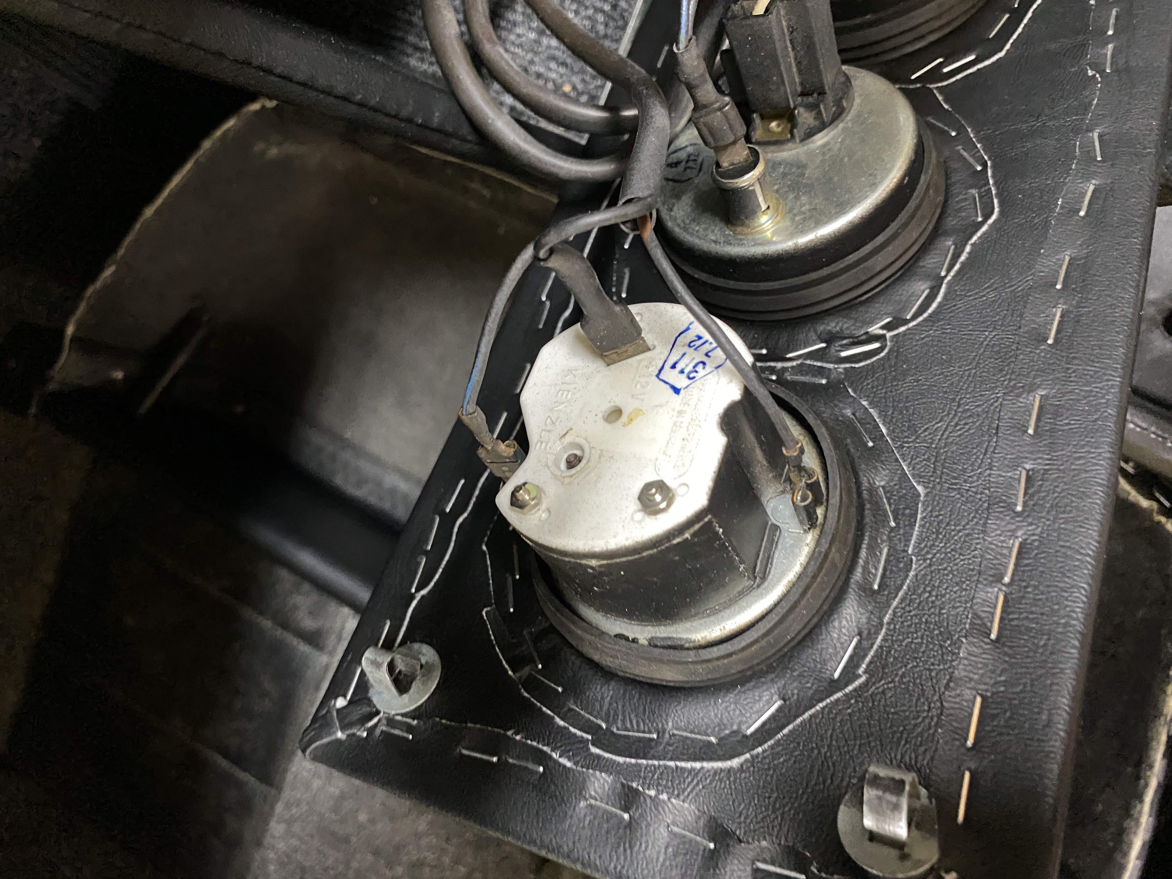

Before quitting, I took out the clock. I am still bummed that it worked for months, and then quit.

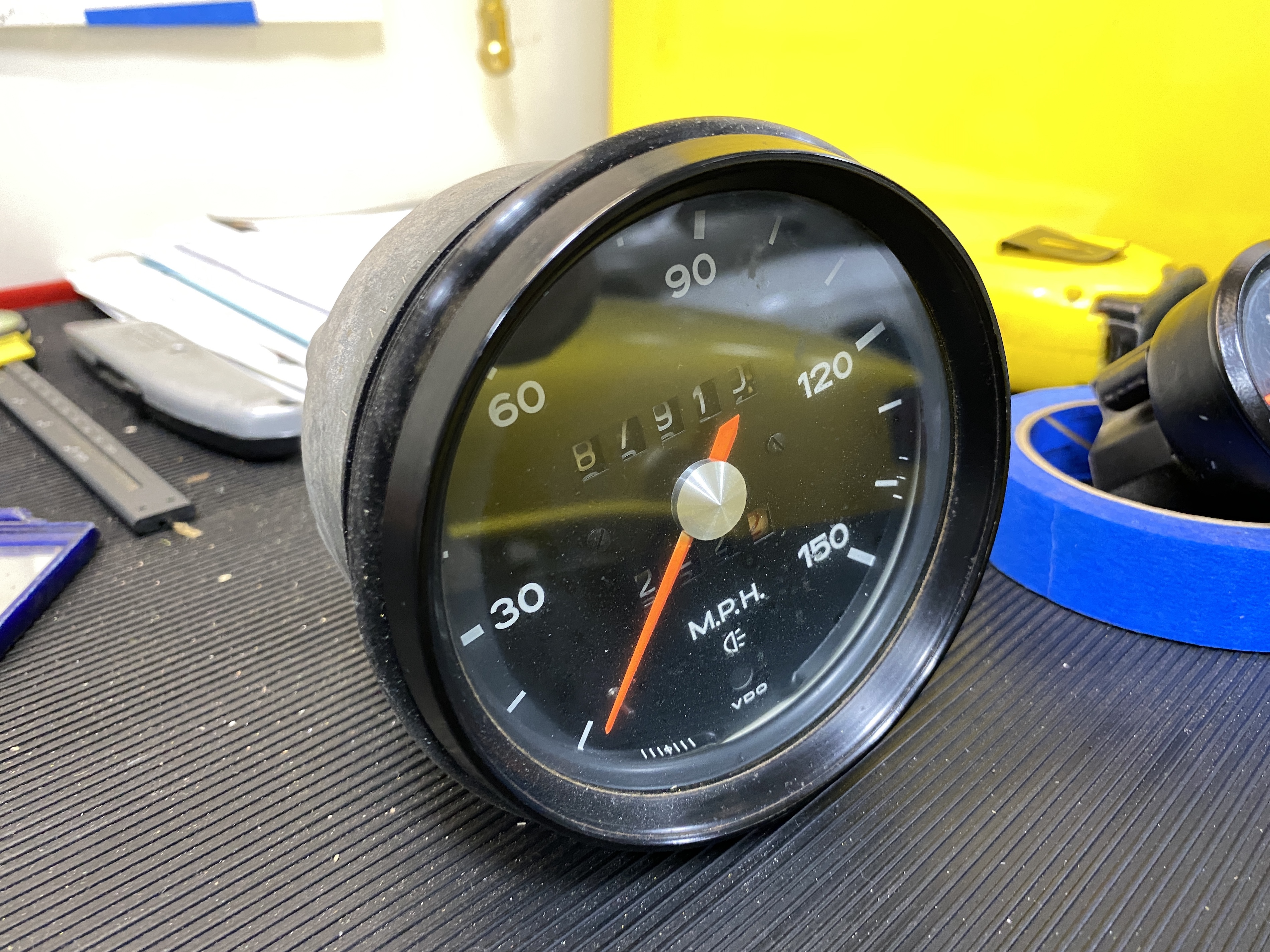

And I pulled the speedometer, too. This read about 10 mph off, and the odo never worked. I still have not decided if I want to try this myself or send it off (or source another one).

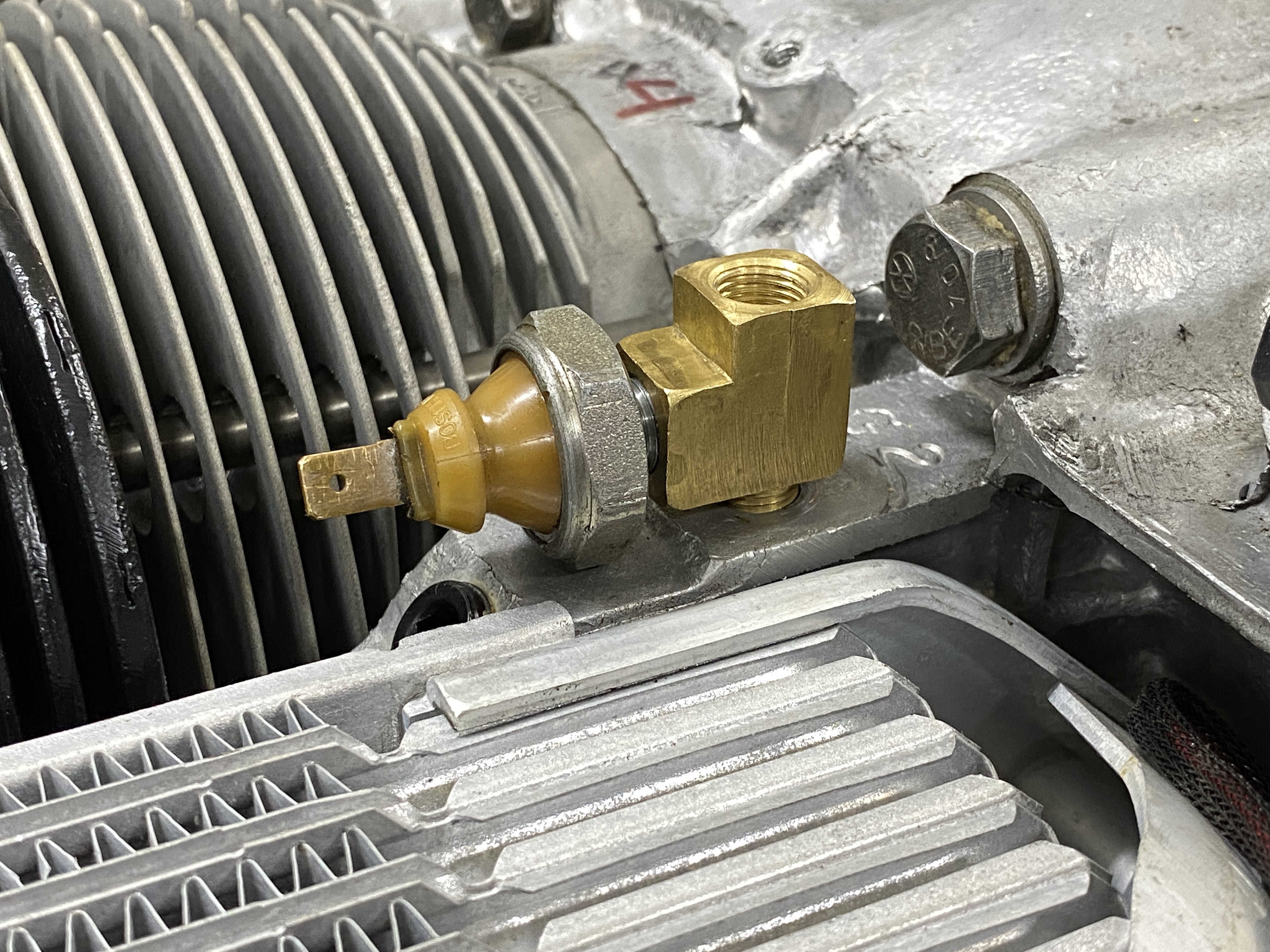

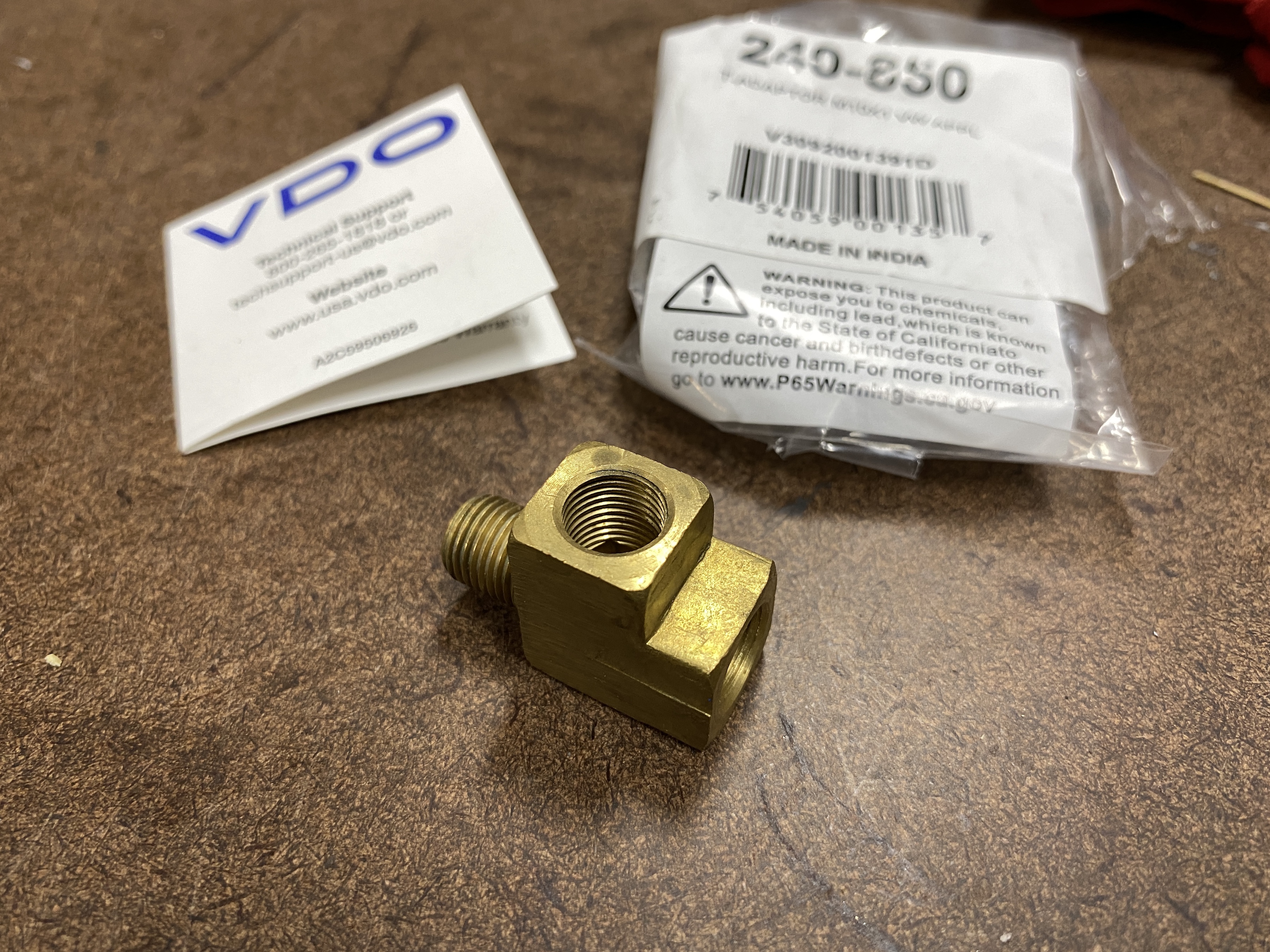

OK, time to start another project.
I want to add an oil pressure gauge. And I want to keep the idiot light.
From what I understand, the VDO dual sender triggers the idiot light at 7 psi, which is too high. Better to keep the stock pressure sensor, which triggers at 3 psi.
I also know that one popular solution is to mount a T-fitting on a flex hose. But the flax hose makes me nervous, so I want to try a solid approach. That can have other problems, but I have some ideas--have to see how things work out.
Anyway, here is a VDO brass adapter.
bkrantz
post Jan 25 2023, 08:55 PM
Post #6091
Posts: 8,746
Joined: 3-August 19
From: SW Colorado
Member No.: 23,343

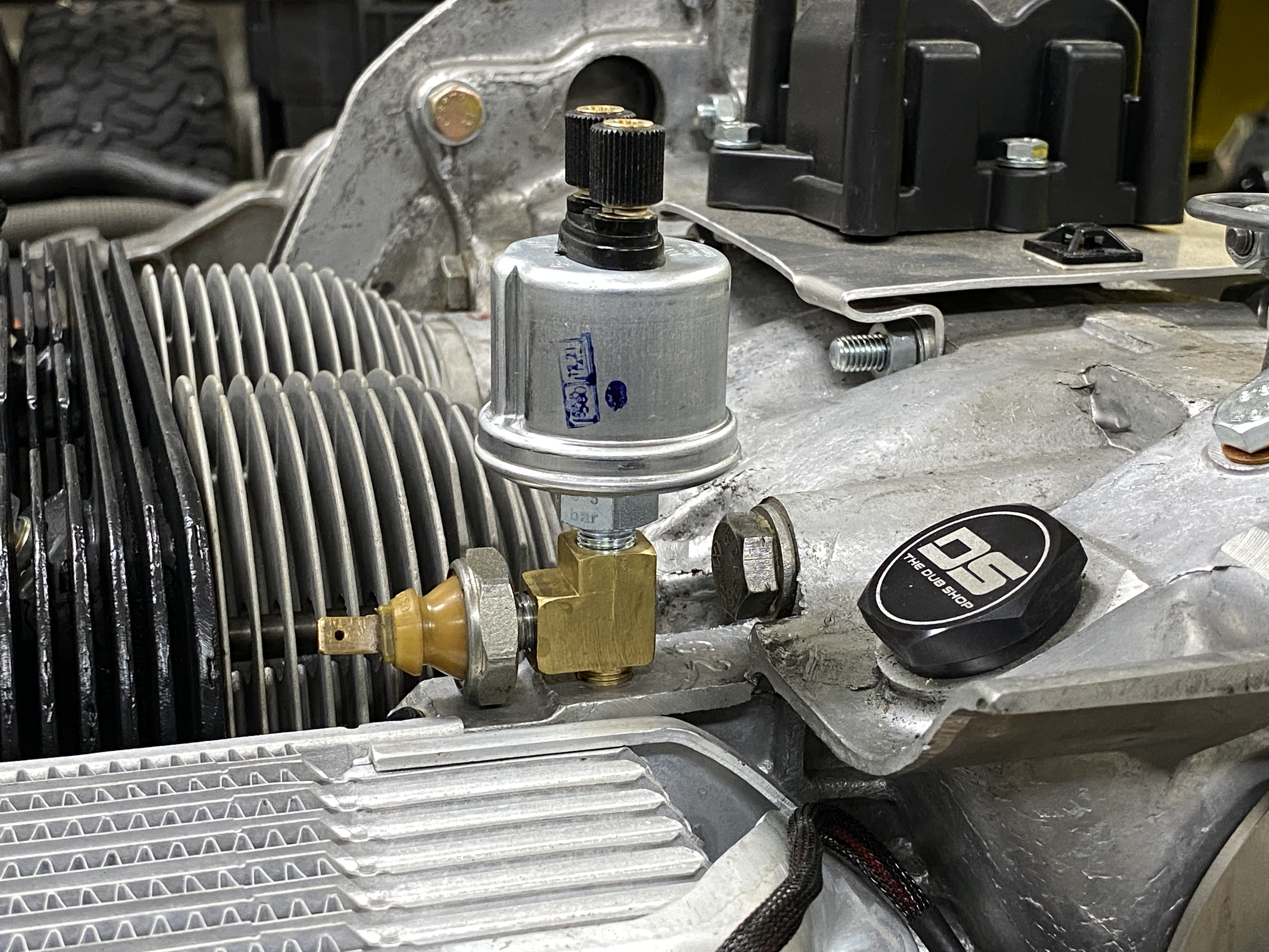

A trial fitting. Yes, the stock sensor will live inside the air ducting, and will need an extension for the wire.

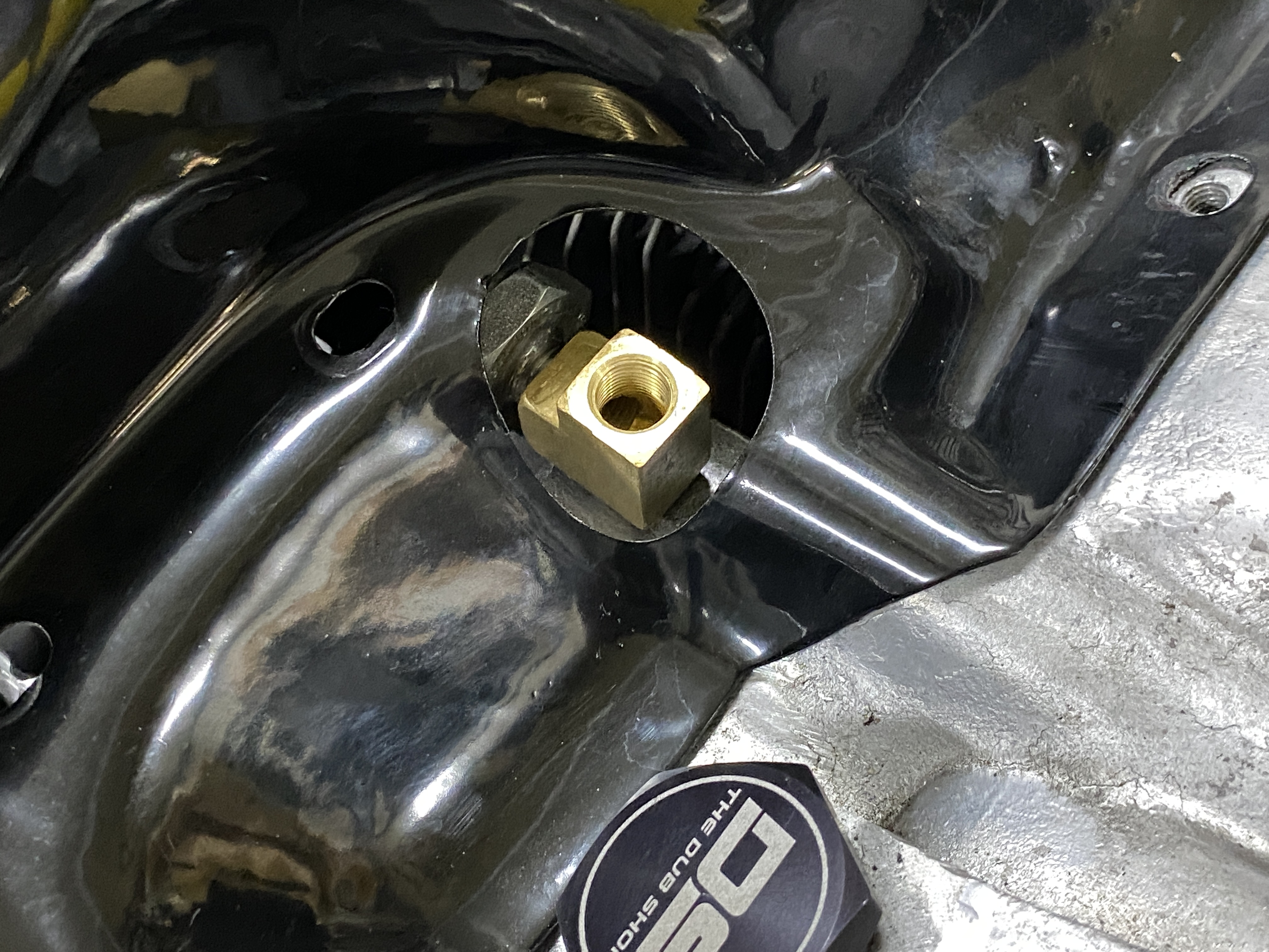

bkrantz
post Jan 25 2023, 08:57 PM
Post #6092
Posts: 8,746
Joined: 3-August 19
From: SW Colorado
Member No.: 23,343
A view from above the sheet metal. The stock hole will probably need enlarging for the VDO sender. That was supposed to get delivered yesterday, but my local USPS is full of excuses.

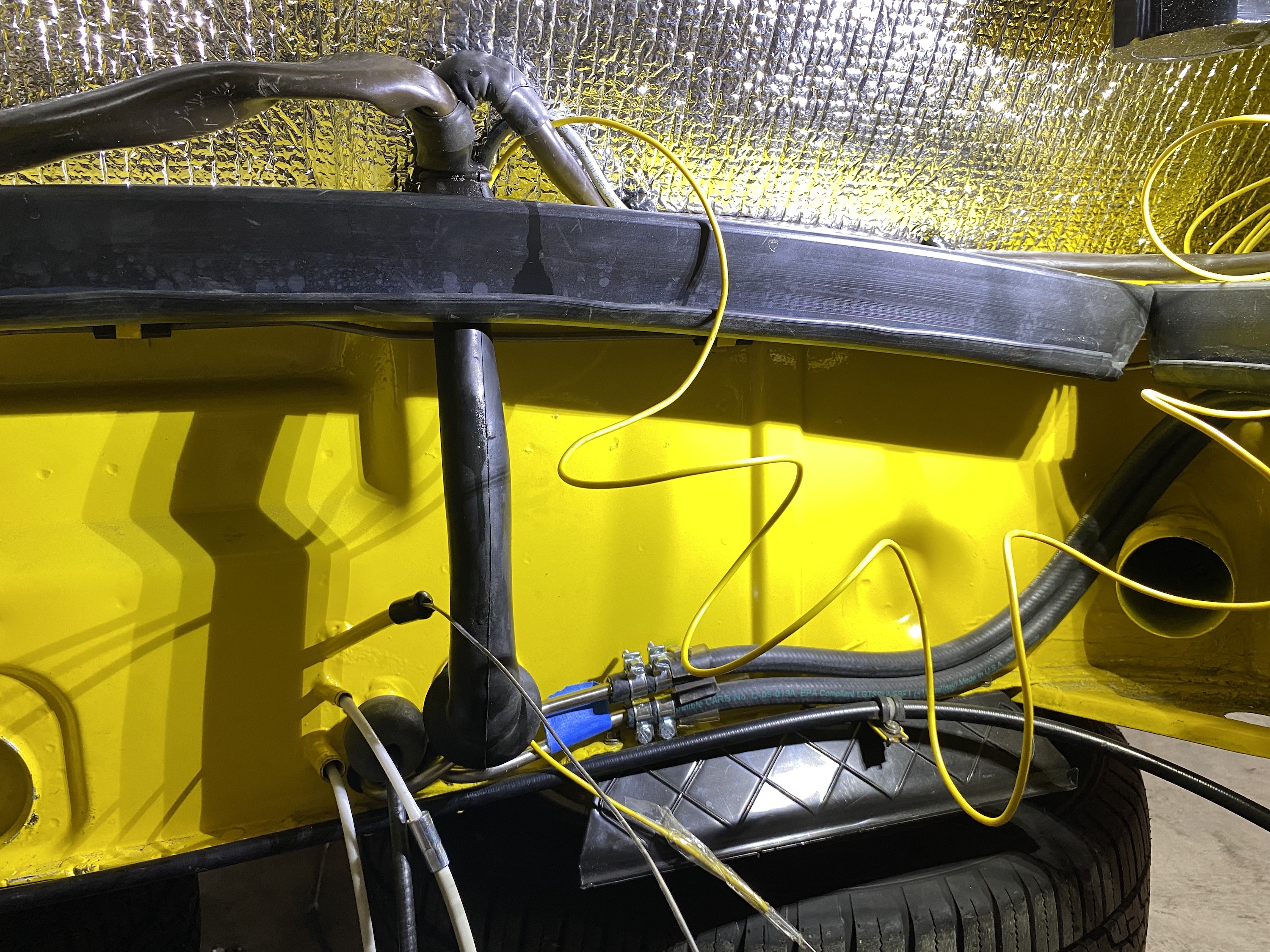

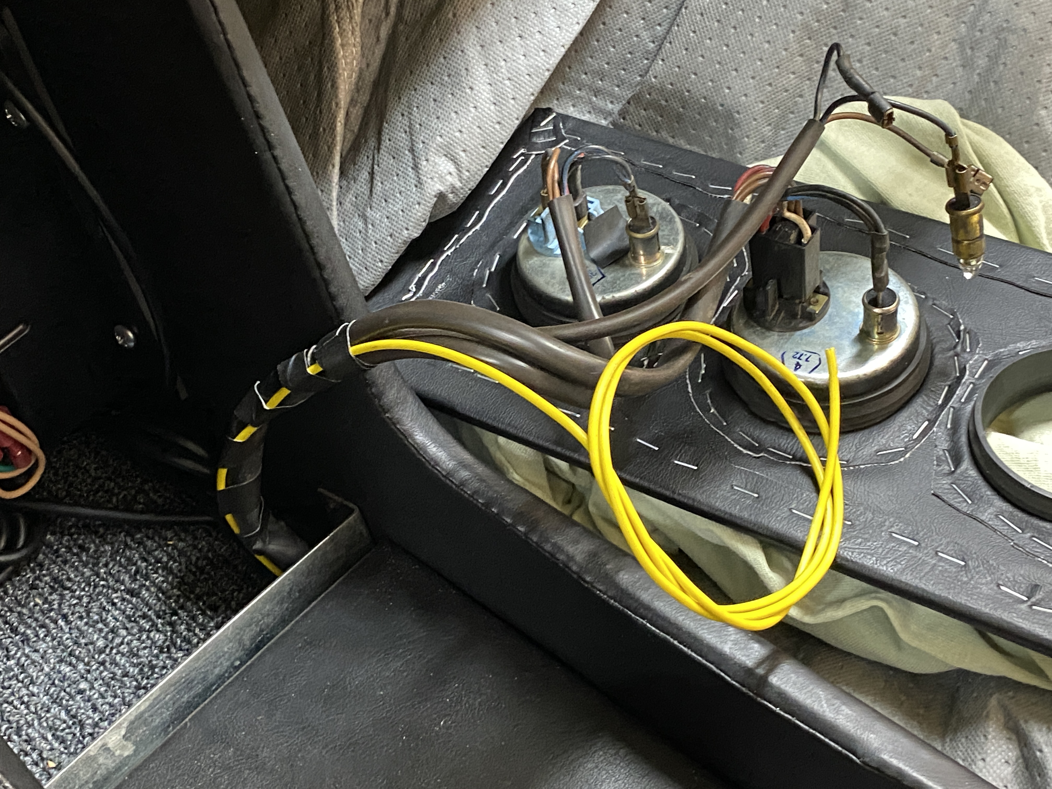

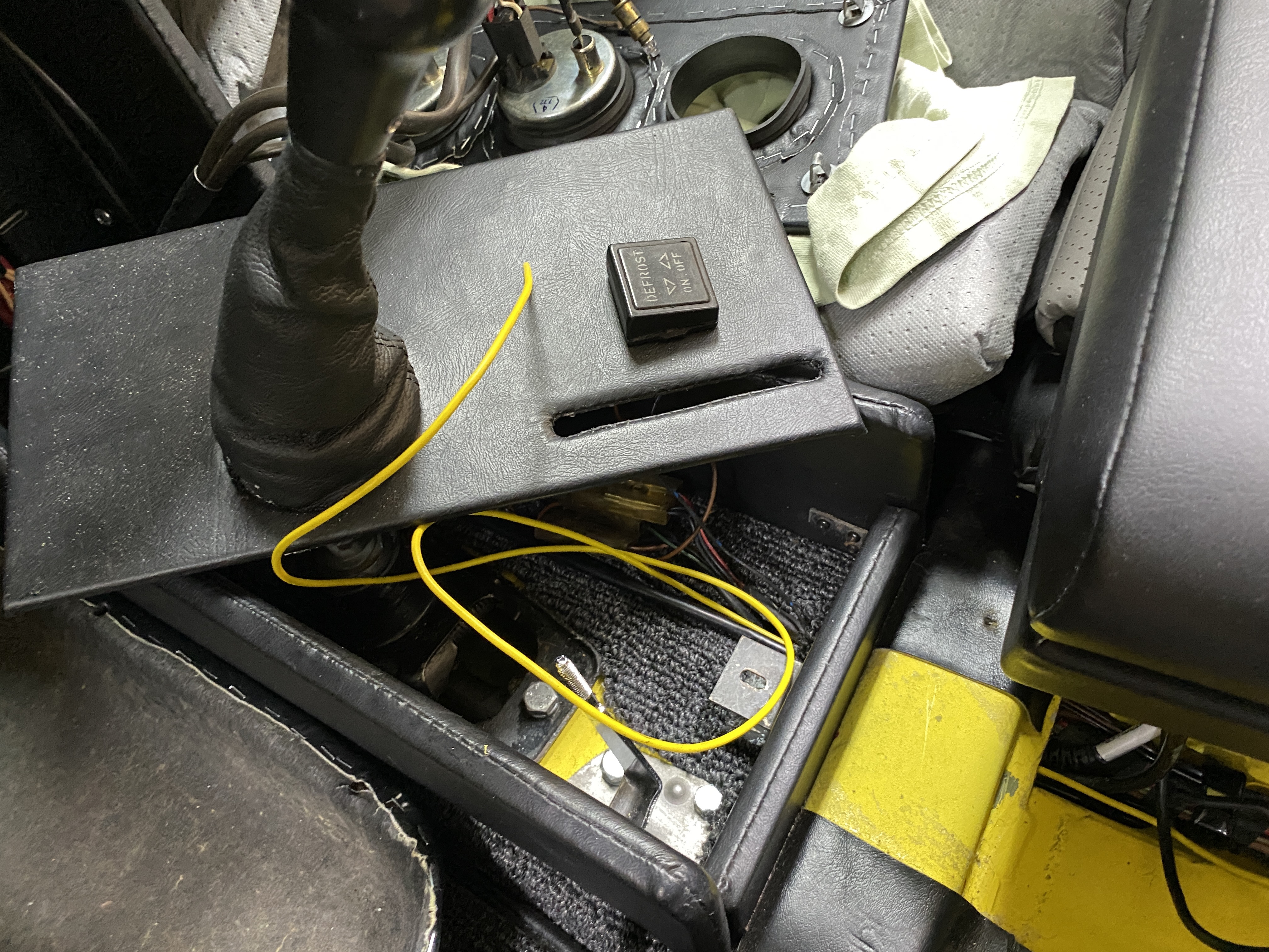

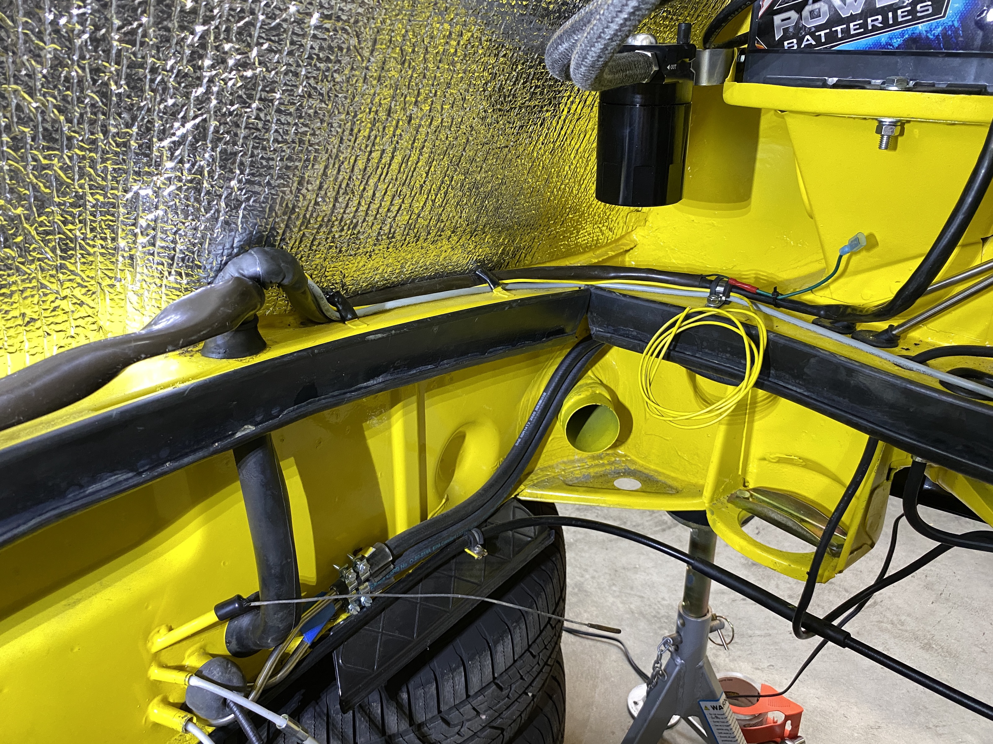

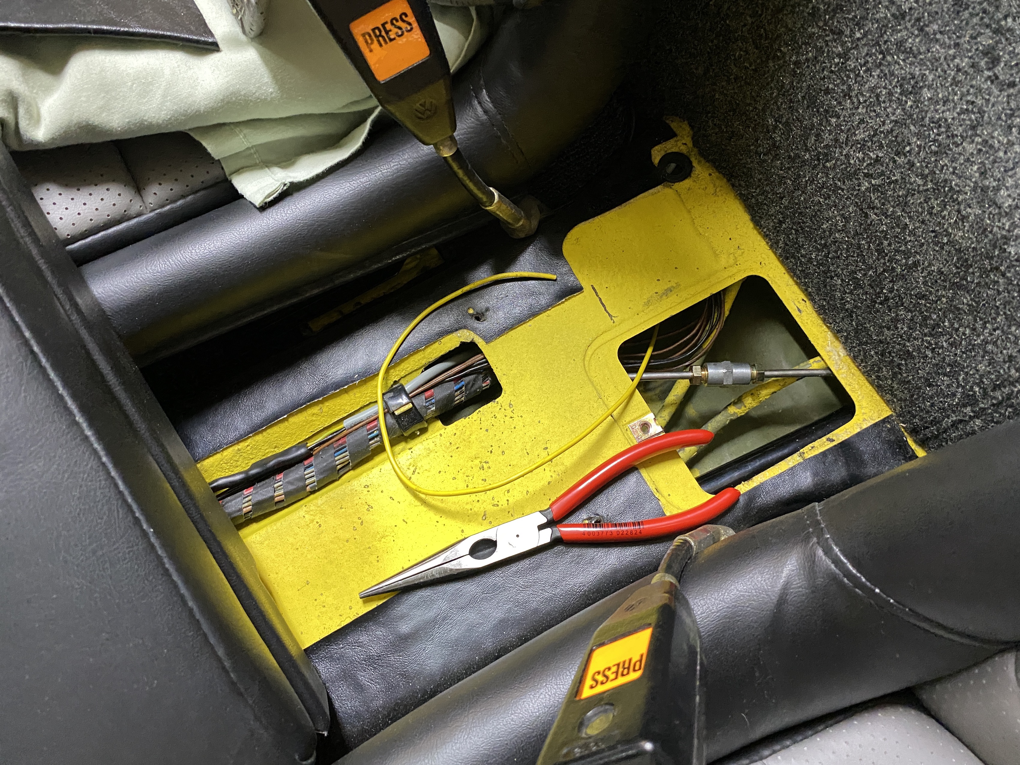

The pressure gauge will also need a new wire from the engine to the center console. Here I started the new yellow wire through the snorkel. Why yellow? Duh.
bkrantz
post Jan 25 2023, 09:00 PM
Post #6094
Posts: 8,746
Joined: 3-August 19
From: SW Colorado
Member No.: 23,343
Into the center tunnel.
bkrantz
Post #6095
Posts: 8,746
Joined: 3-August 19
From: SW Colorado
Member No.: 23,343
Up to the shift console.
bkrantz
post Jan 25 2023, 09:01 PM
Post #6096
Posts: 8,746
Joined: 3-August 19
From: SW Colorado
Member No.: 23,343
Ready for the gauge.

And ready at the engine end.

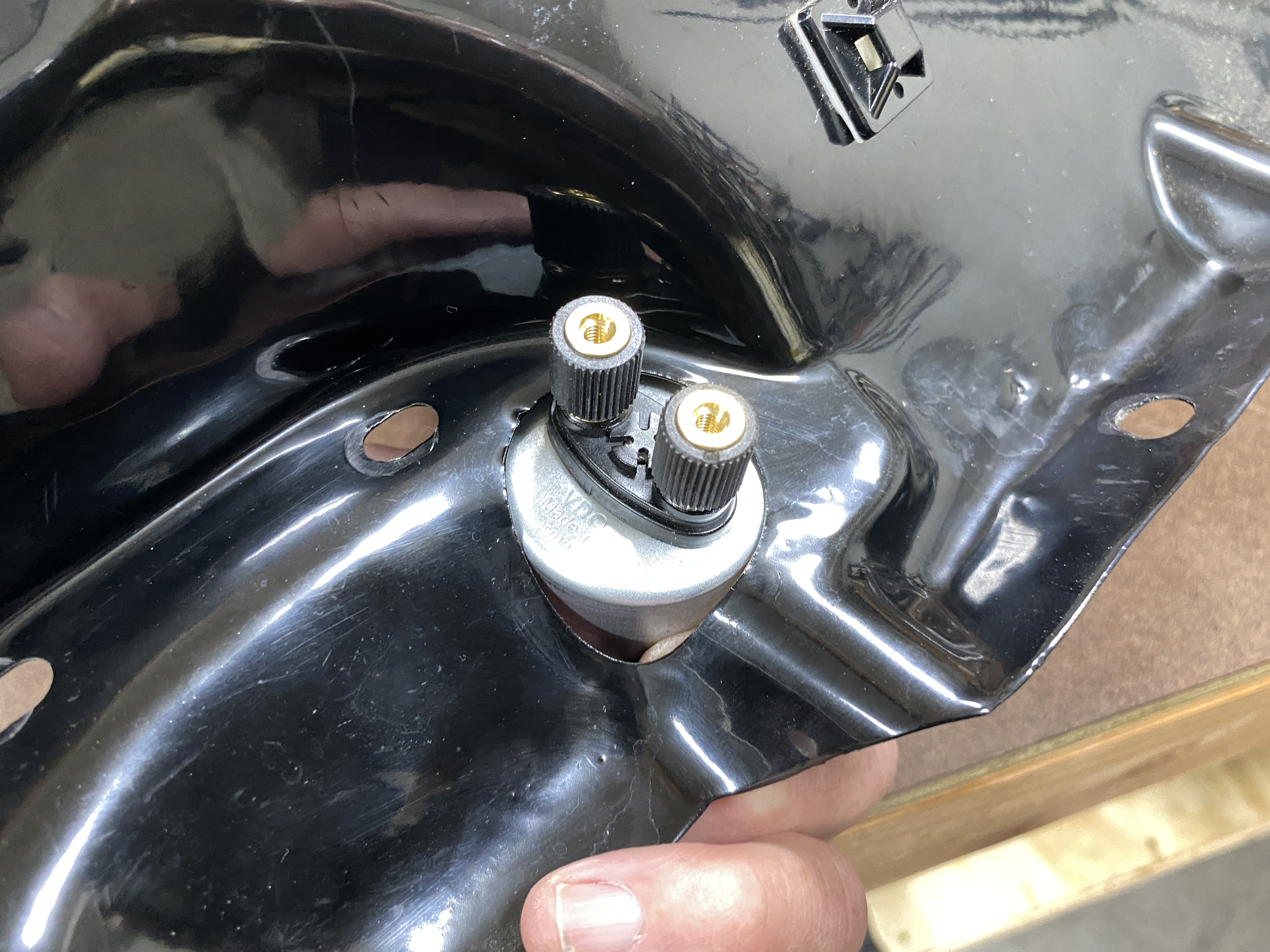

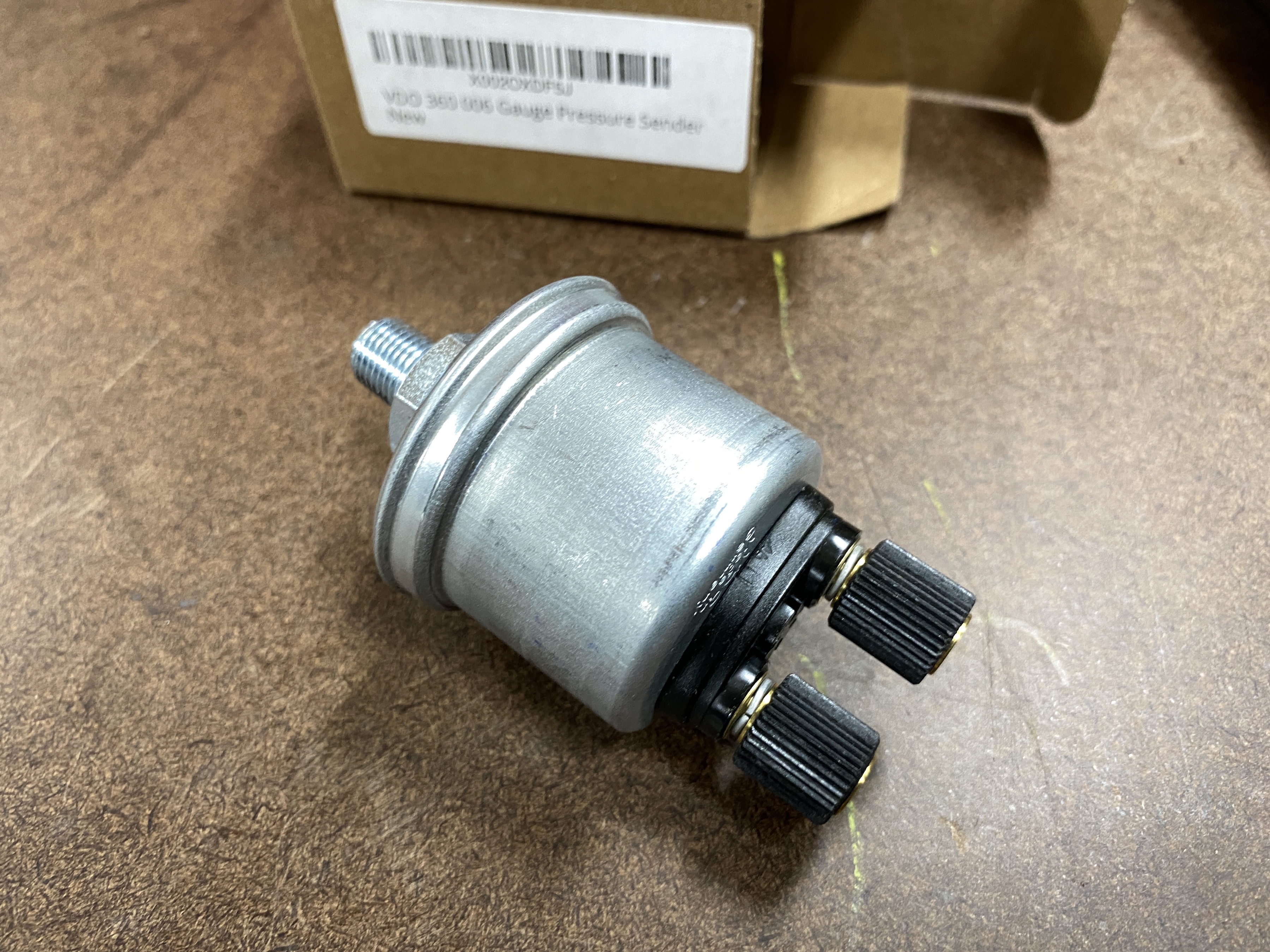

A bit more progress (or planning) for the oil pressure system. Here is the VDO sender. I got the dual sender, even if I don't use the low pressure trigger.
bkrantz
post Jan 28 2023, 07:49 PM
Post #6099
Posts: 8,746
Joined: 3-August 19
From: SW Colorado
Member No.: 23,343
The hole in the sheet metal is tool small, but not by much. I will worry about this later.

Here's the configuration I have in mind. I know this has a bit of weight unsupported, and could lead to fatigue.
