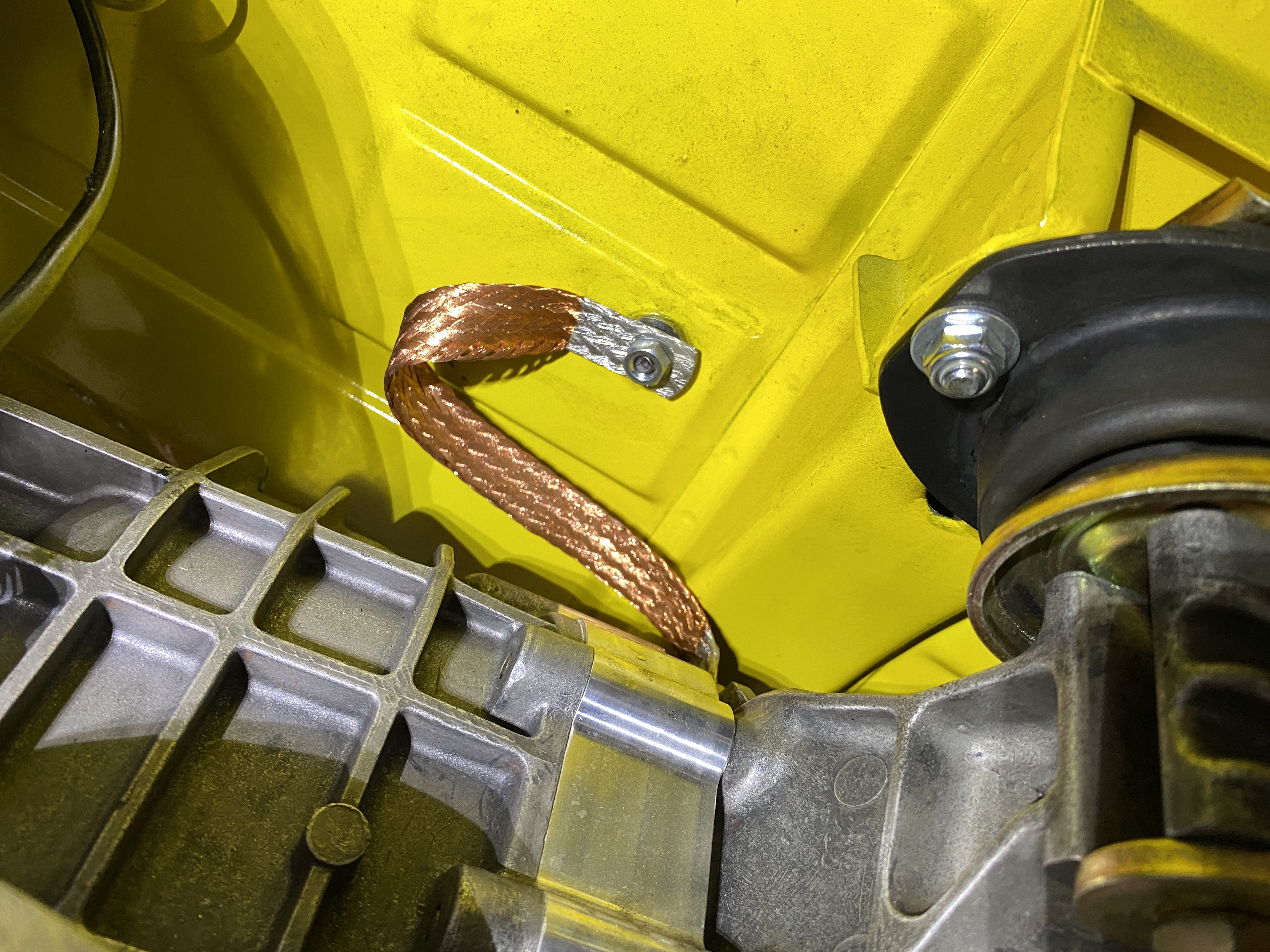

Back under the car today. First, I connected the ground strap before I forget.

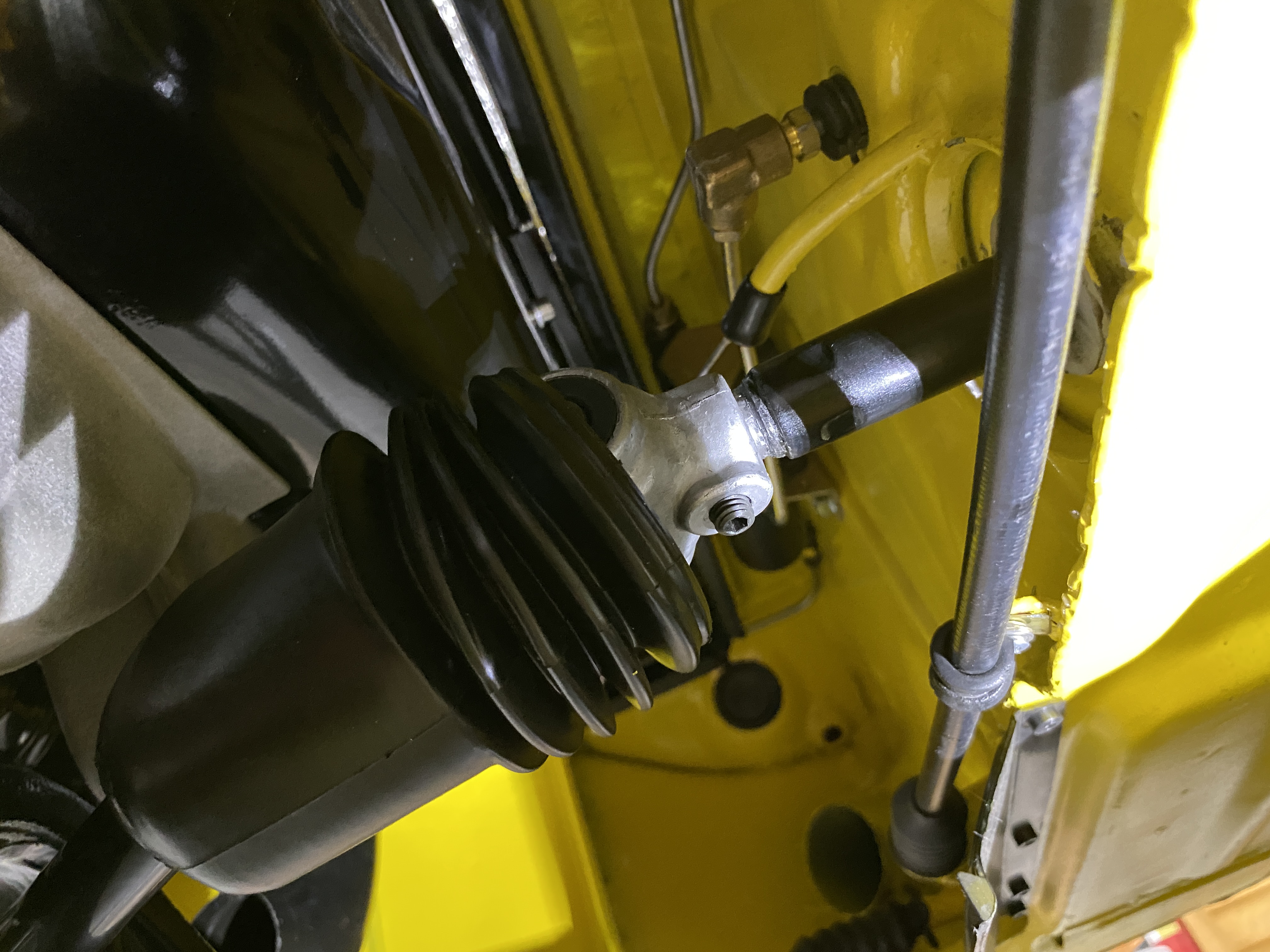

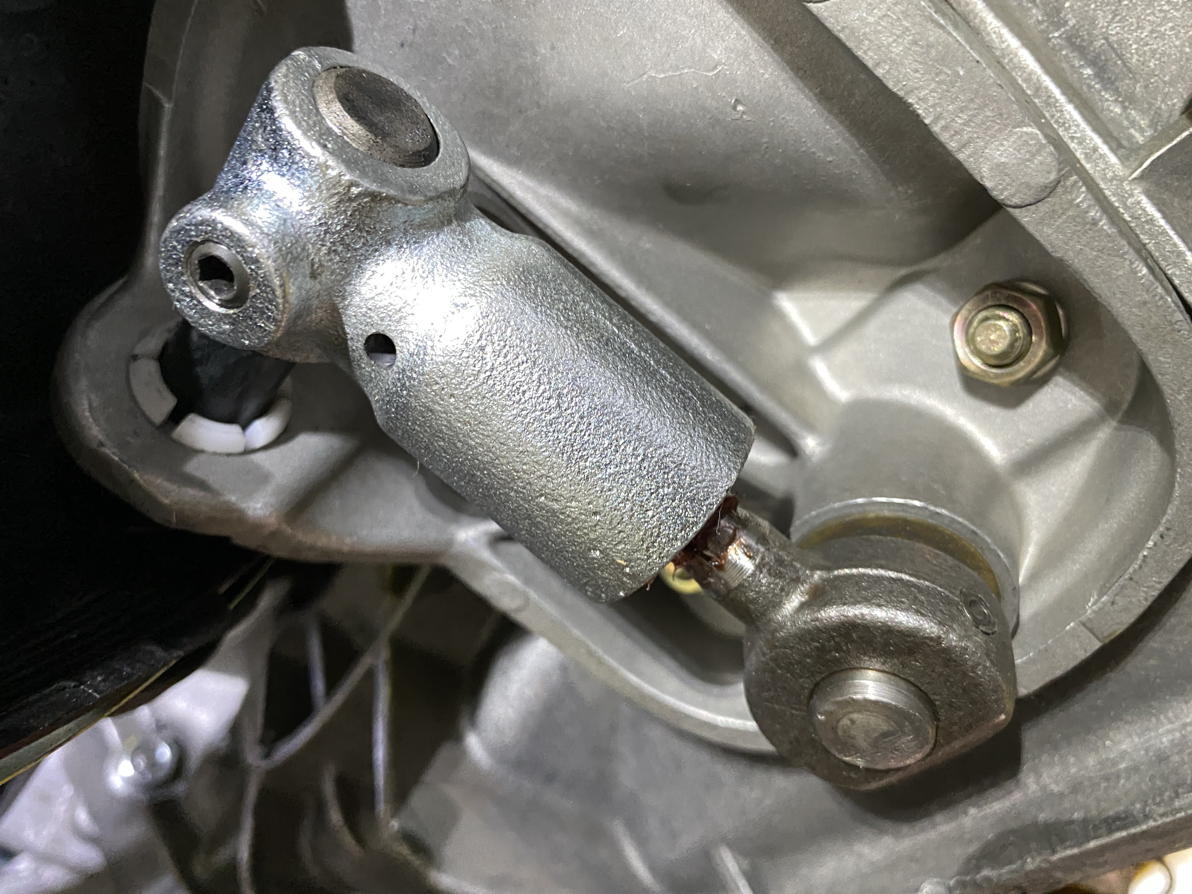

Then the shift rod, starting with the front coupling.
bkrantz
post Feb 20 2023, 08:54 PM
Post #6226
Posts: 8,746
Joined: 3-August 19
From: SW Colorado
Member No.: 23,343
Then the rear.

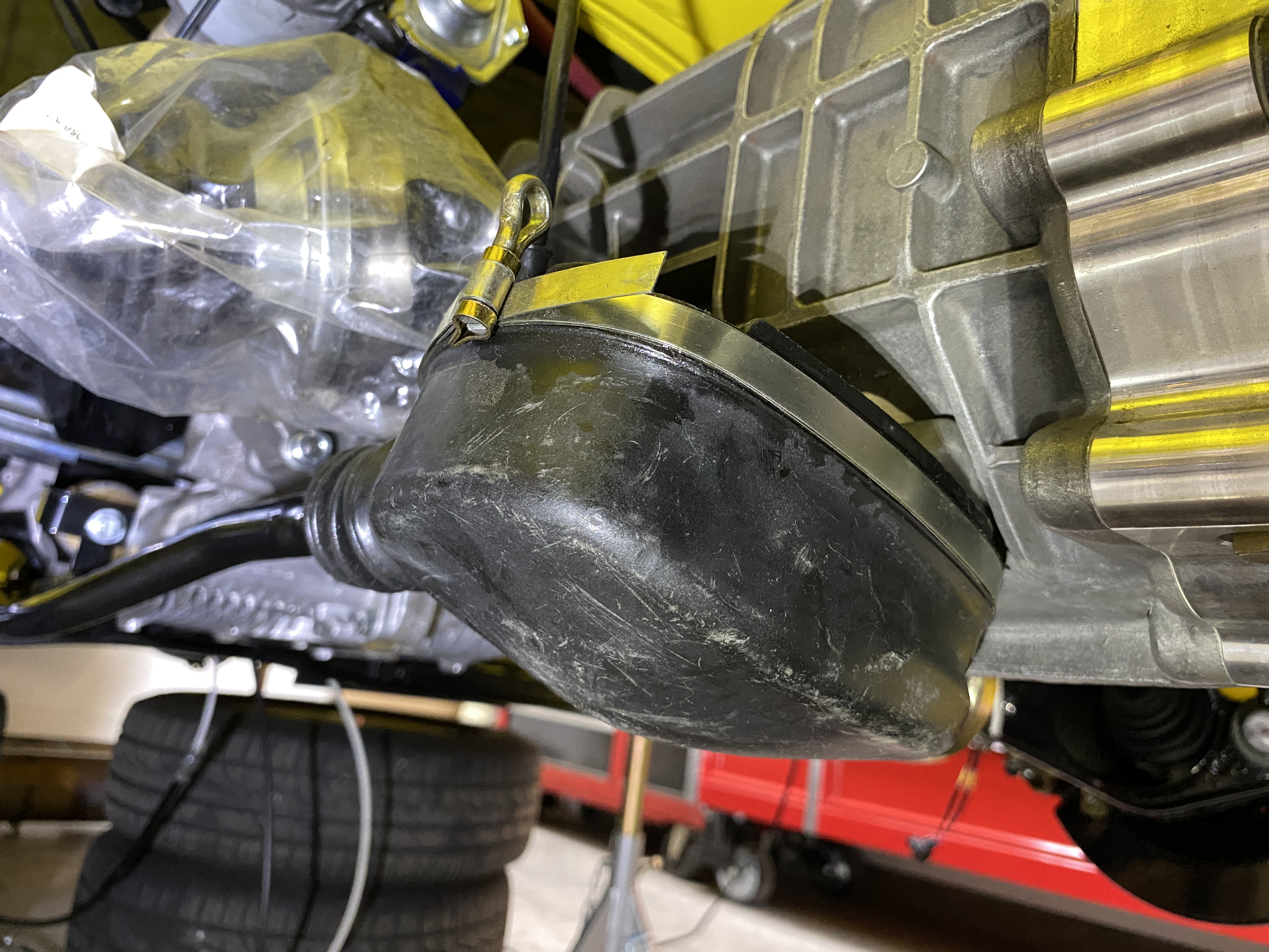

The back cover is easy, and I was able to re-use the clamp.

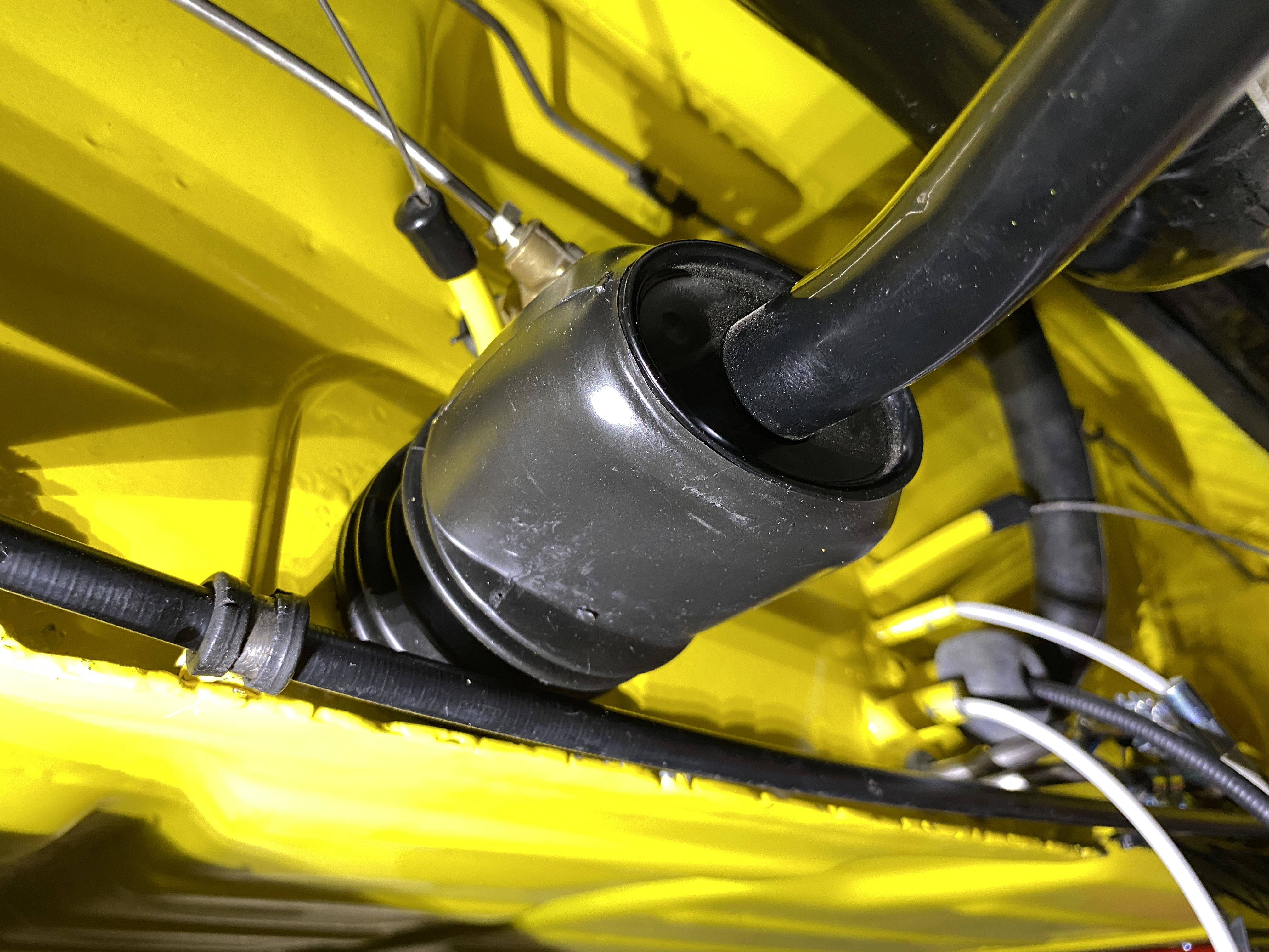

But I hate the front rubber cover. It took me 20 minutes to get it around the flange on the firewall.

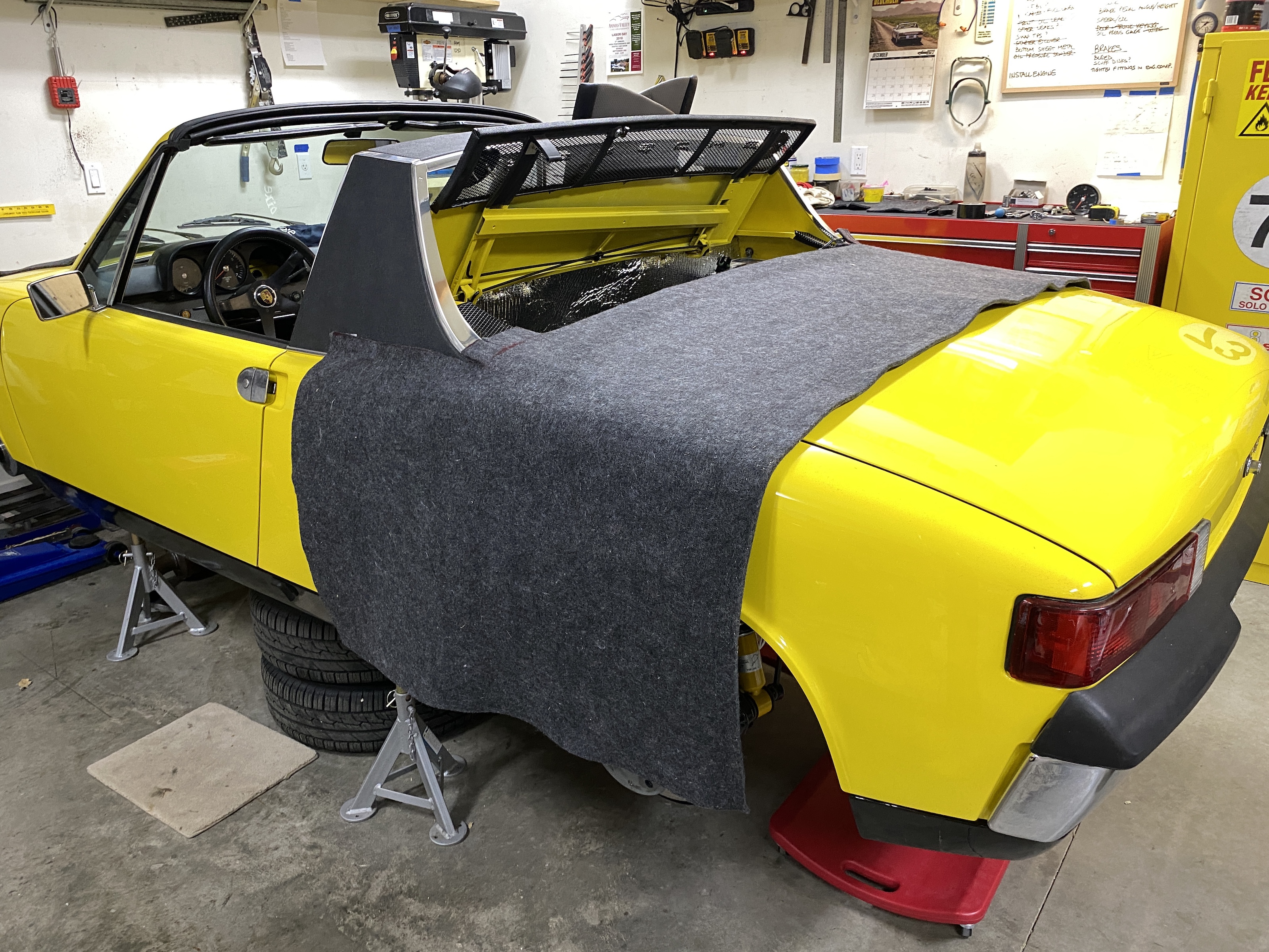

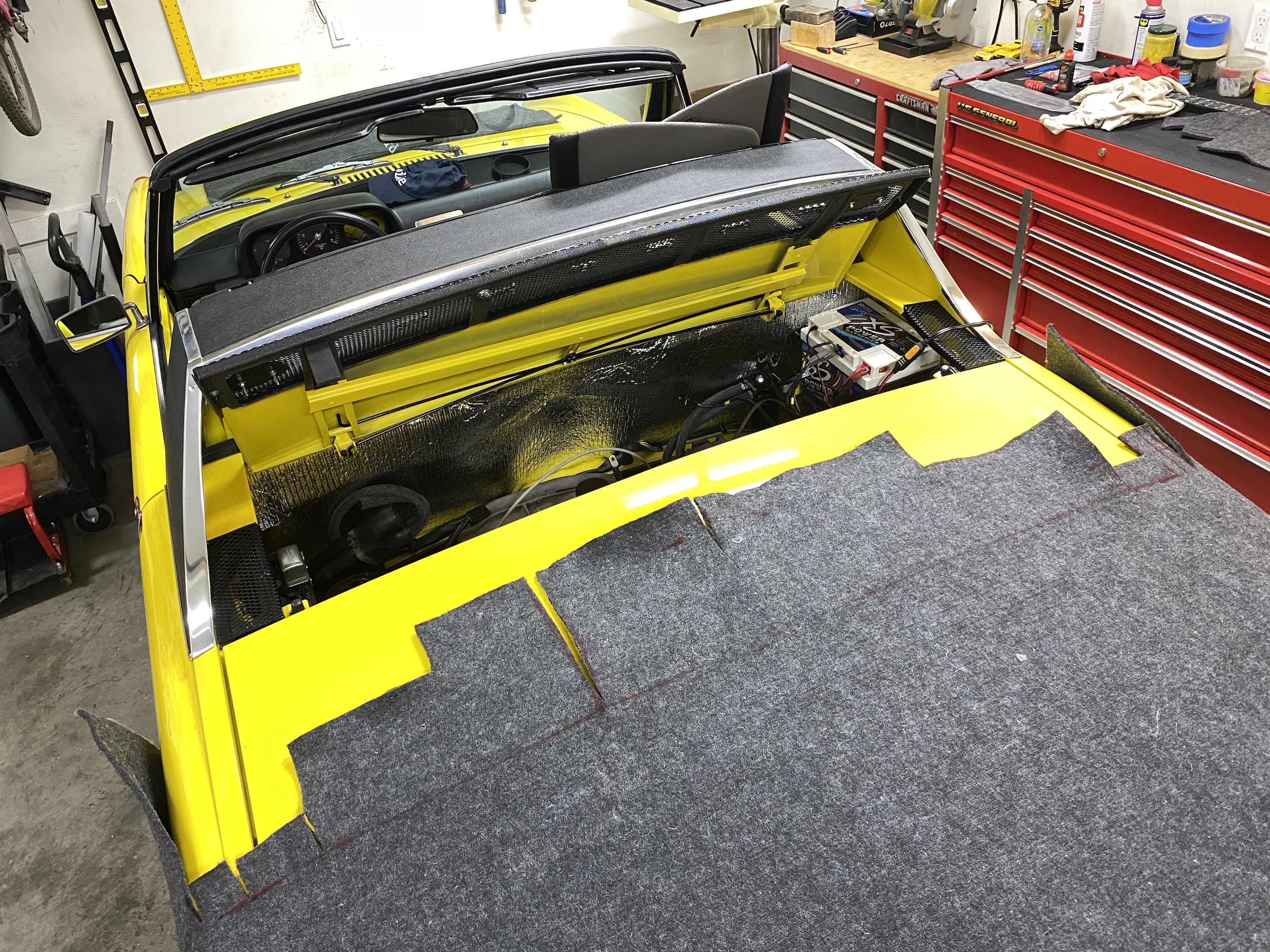

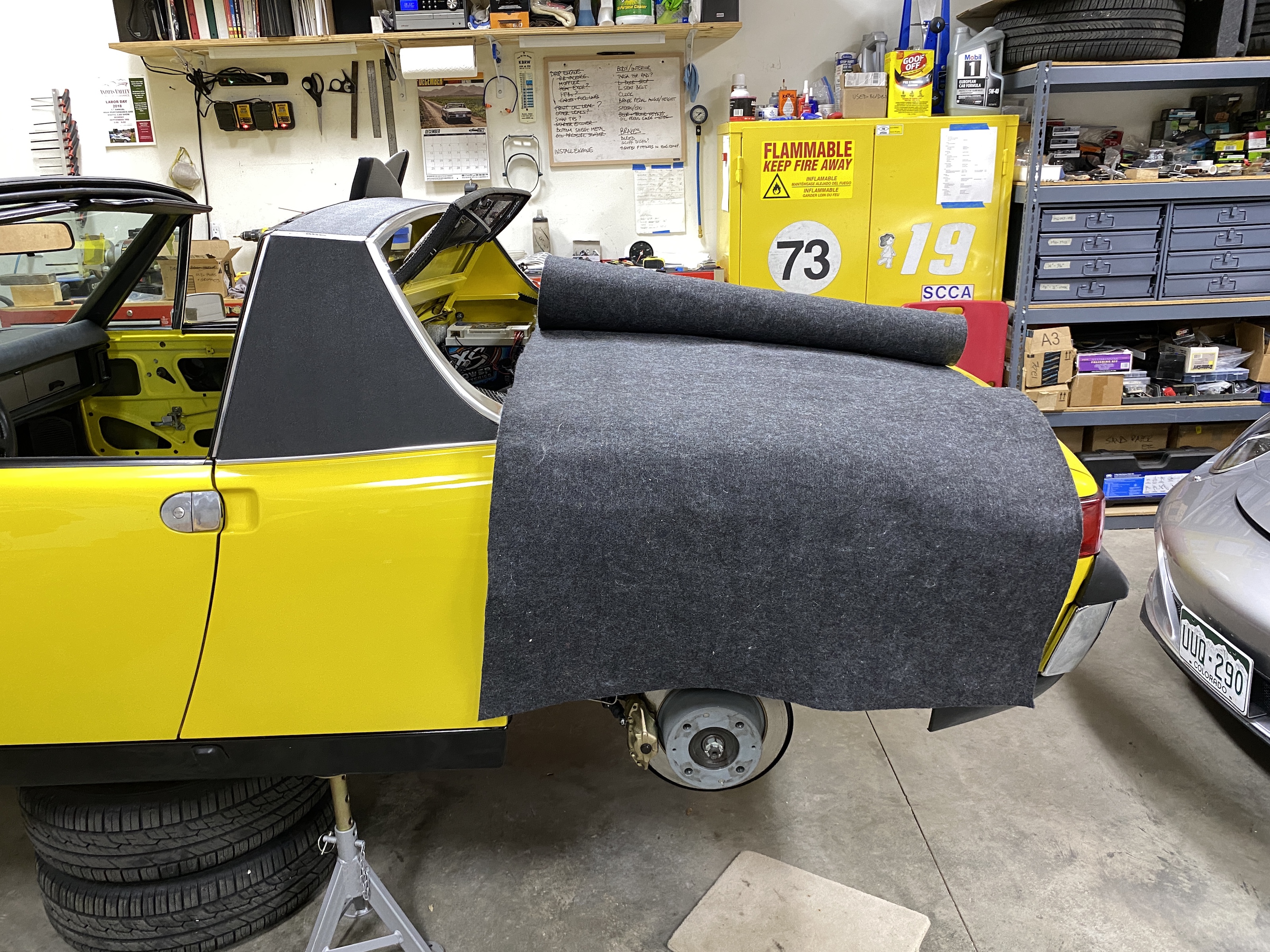

Here's the first version of my work cover. Total length is a about 3 yards, with cuts to fit into the engine compartment.

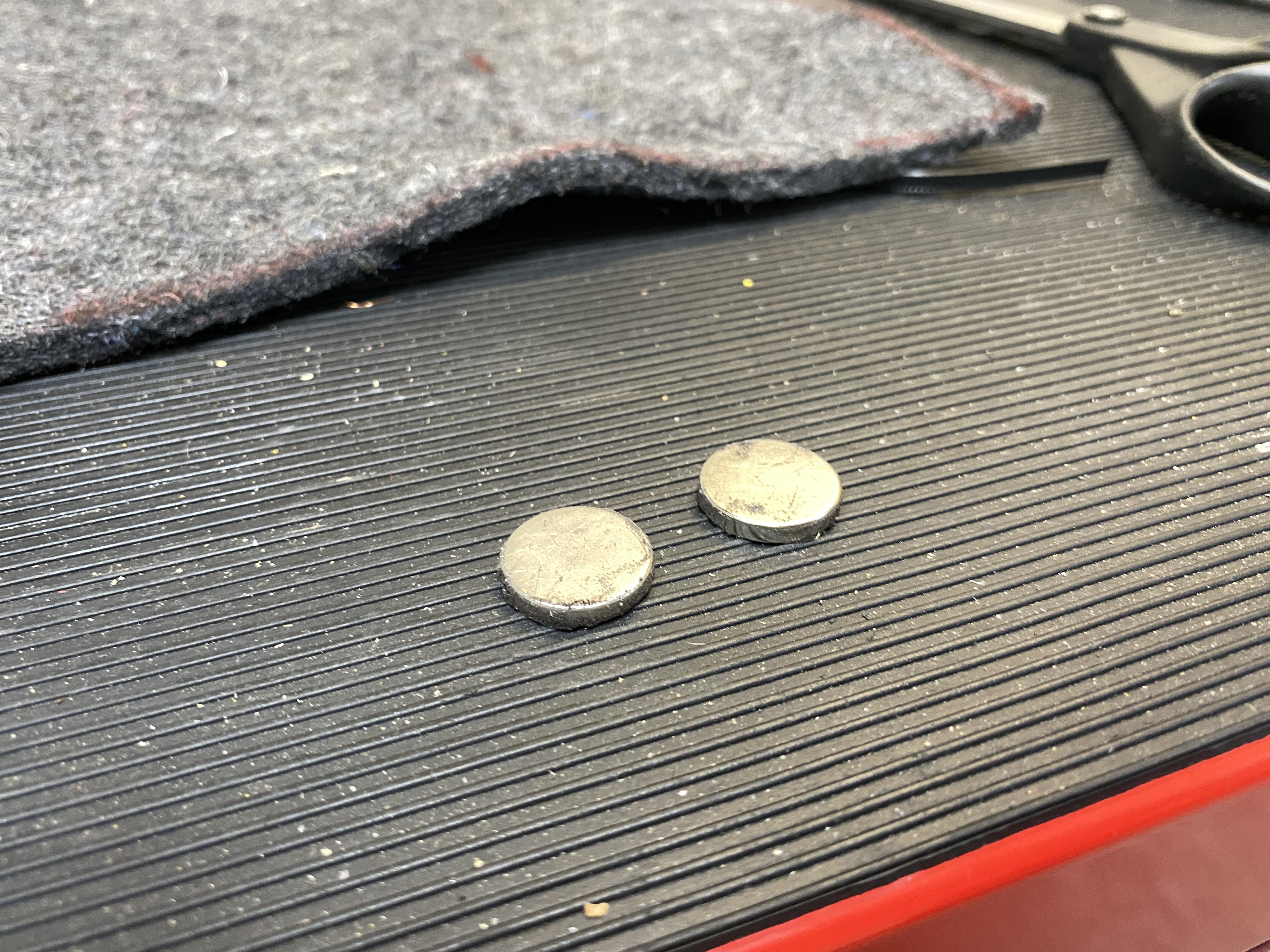

Plus a couple of magnets. (I decided to get some bigger and stronger magnets.)

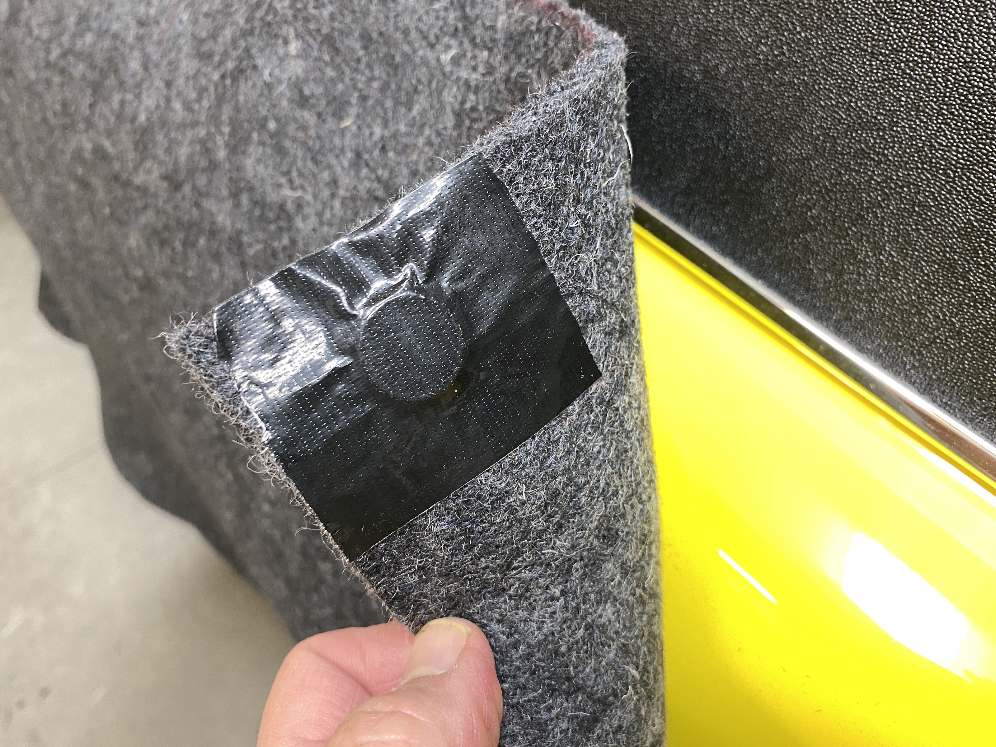

Taped to the front corners.

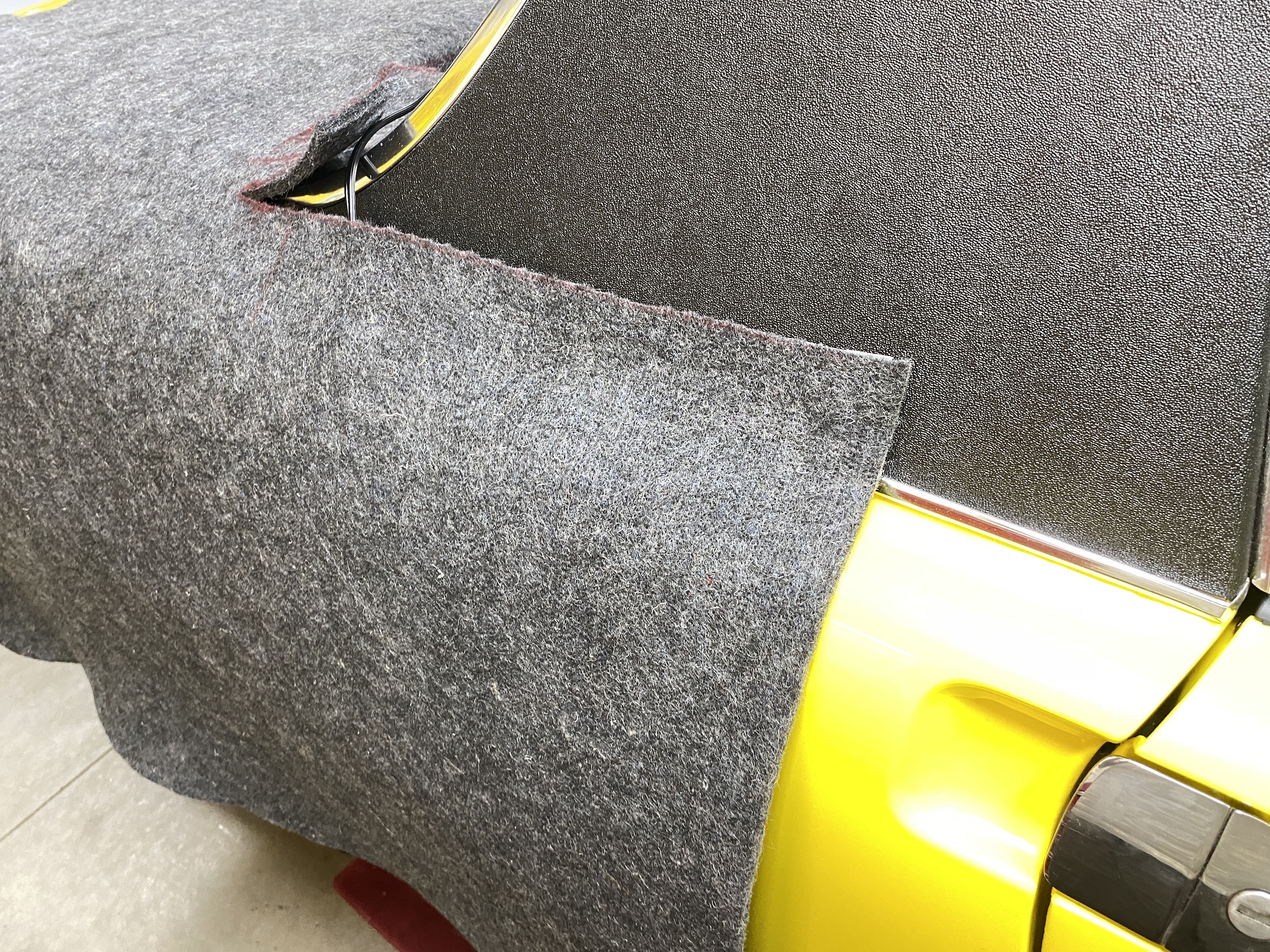

Magnets stick to the sails on vinyl.

I think this could work.

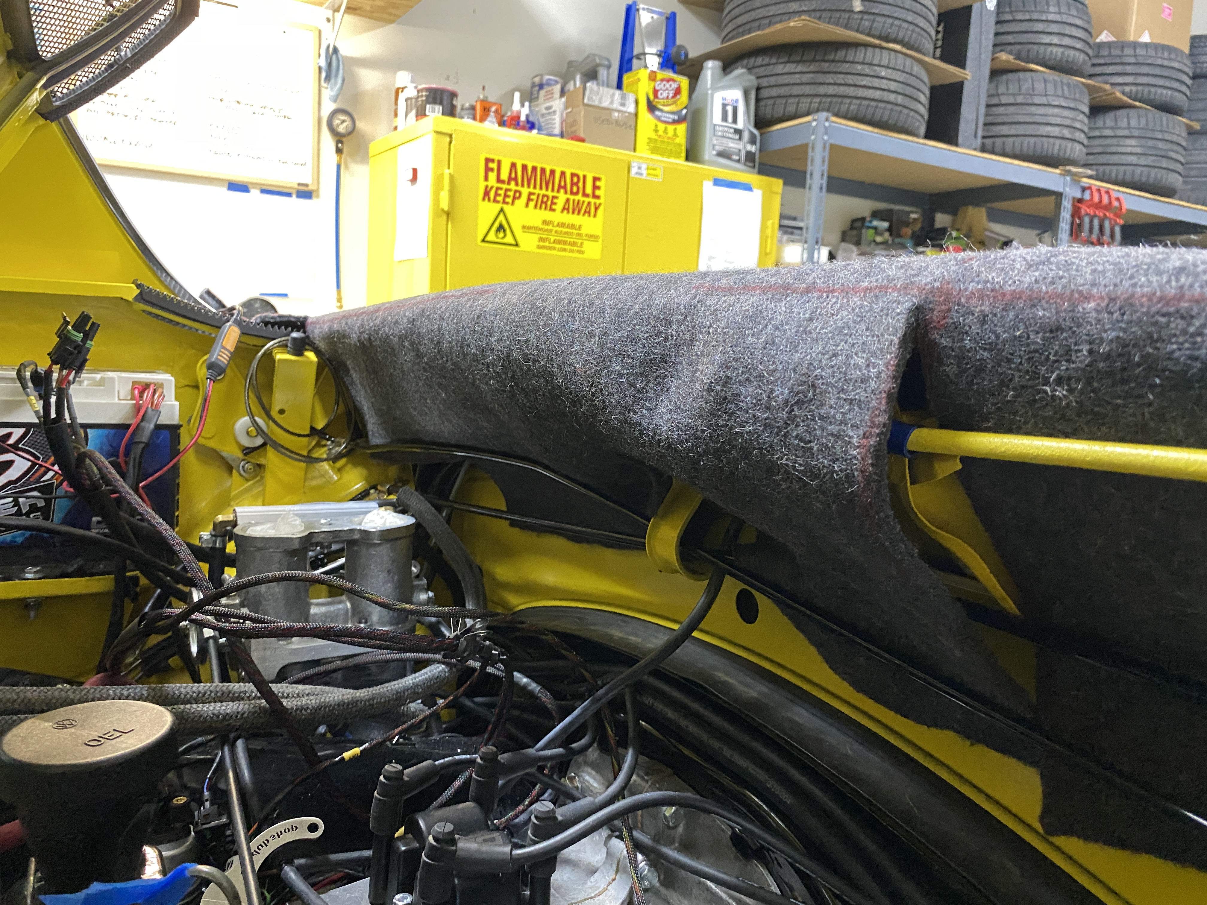

View on the inside. The edge tucks under the torsion bars and release cable tube, so the trunk lid edge is protected.

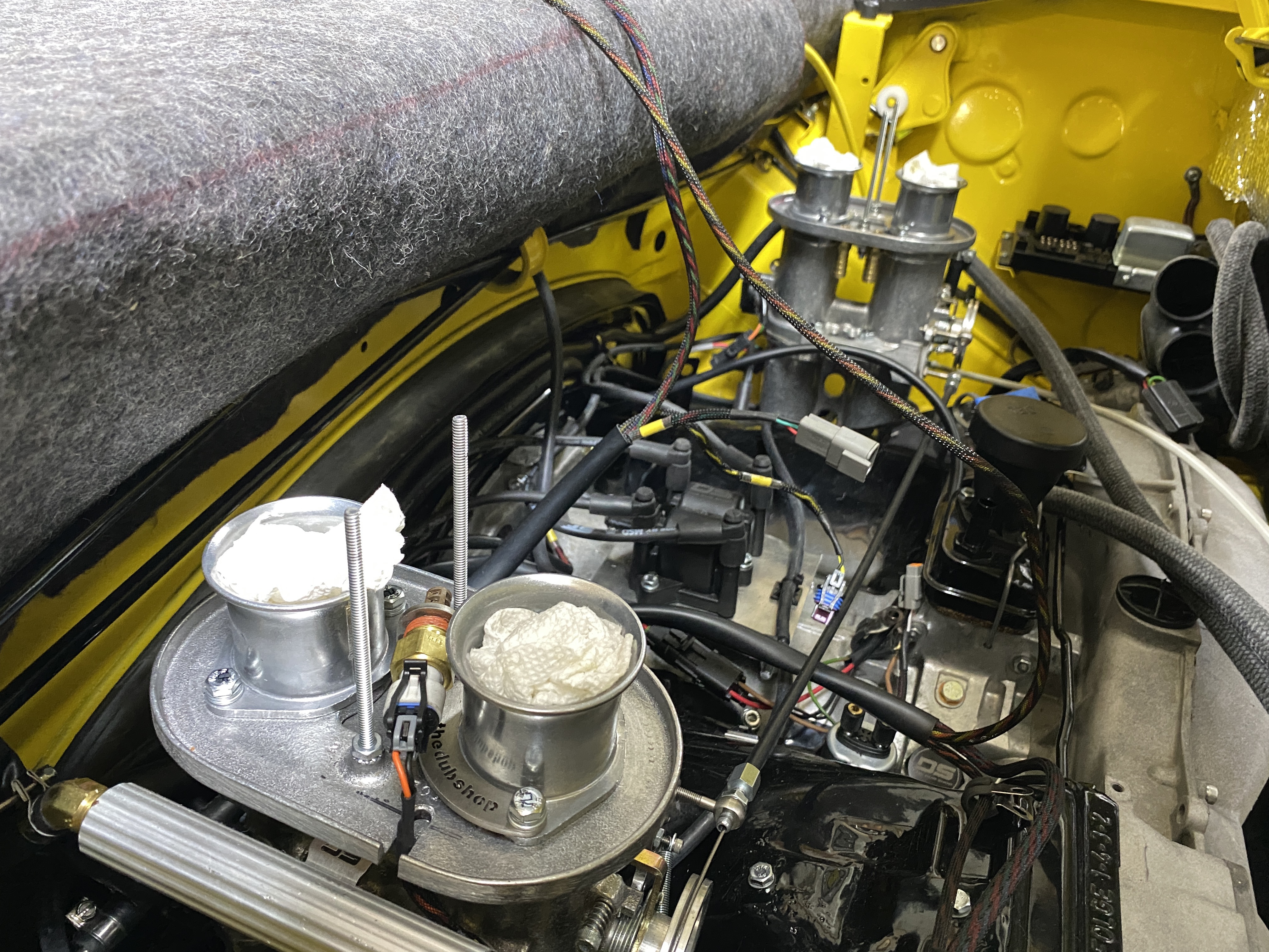

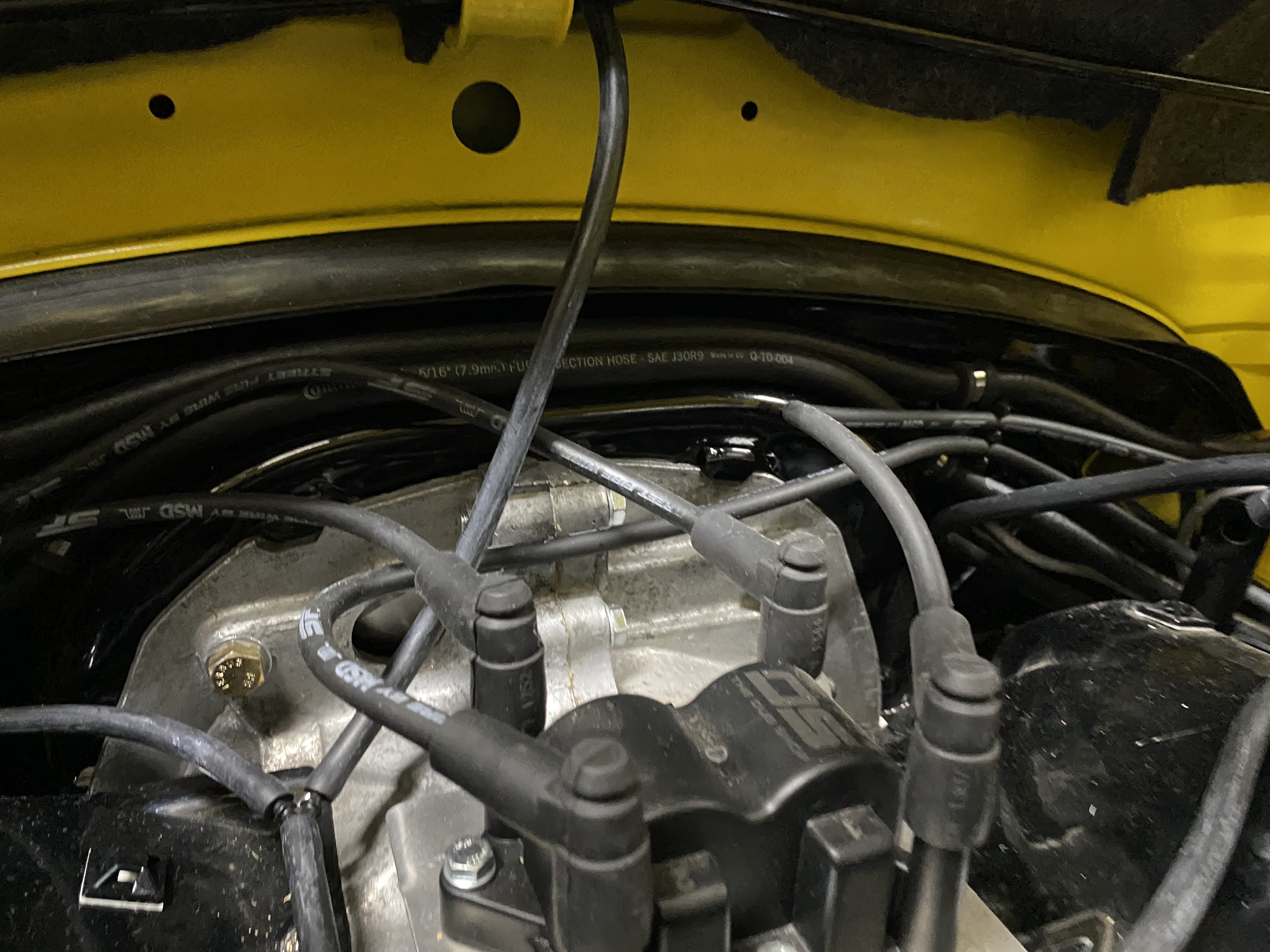

I tested the cover with some work on the engine top. I hooked up the vacuum lines, including the line that goes through the trunk wall to the EFI CPU.
bkrantz
post Feb 21 2023, 09:35 PM
Post #6237
Posts: 8,746
Joined: 3-August 19
From: SW Colorado
Member No.: 23,343
And I installed the air filter bases and intake horns. Now to connect all the stock and EFI cables.

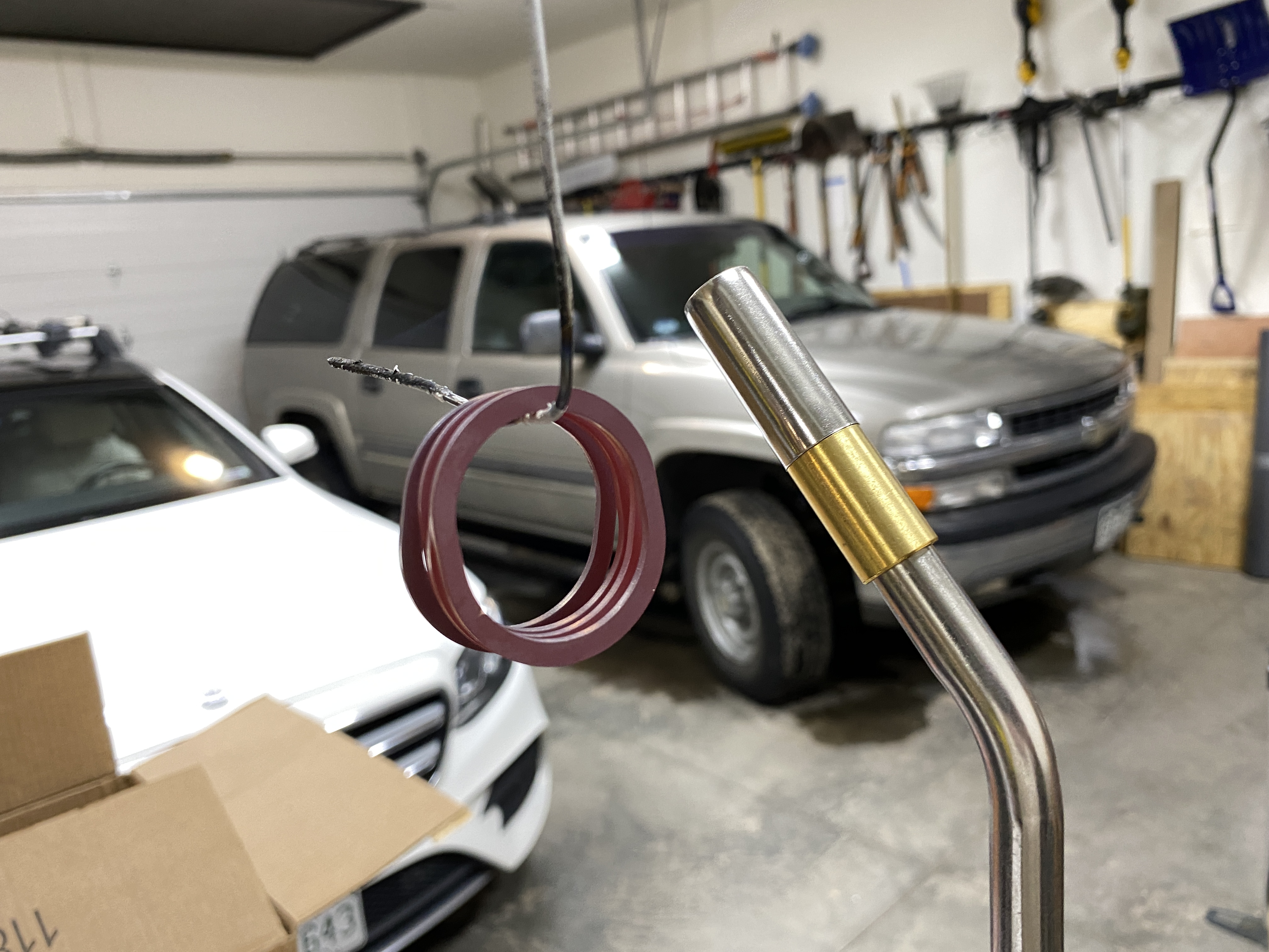

Back in town and on the job. I need to connect things below and above.
In prep for bolting on the heat exchangers, I gave the copper gaskets a heat treatment.

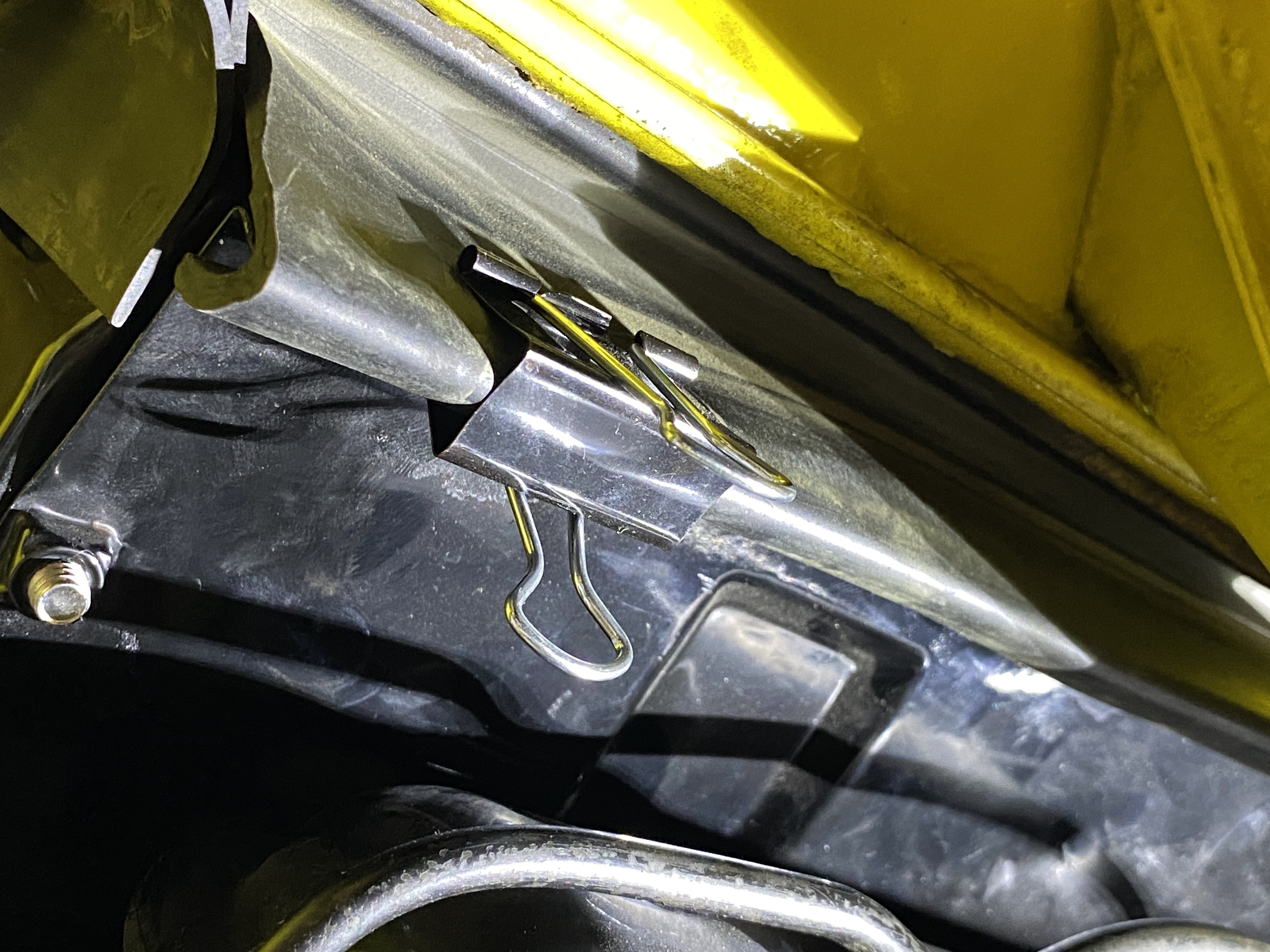

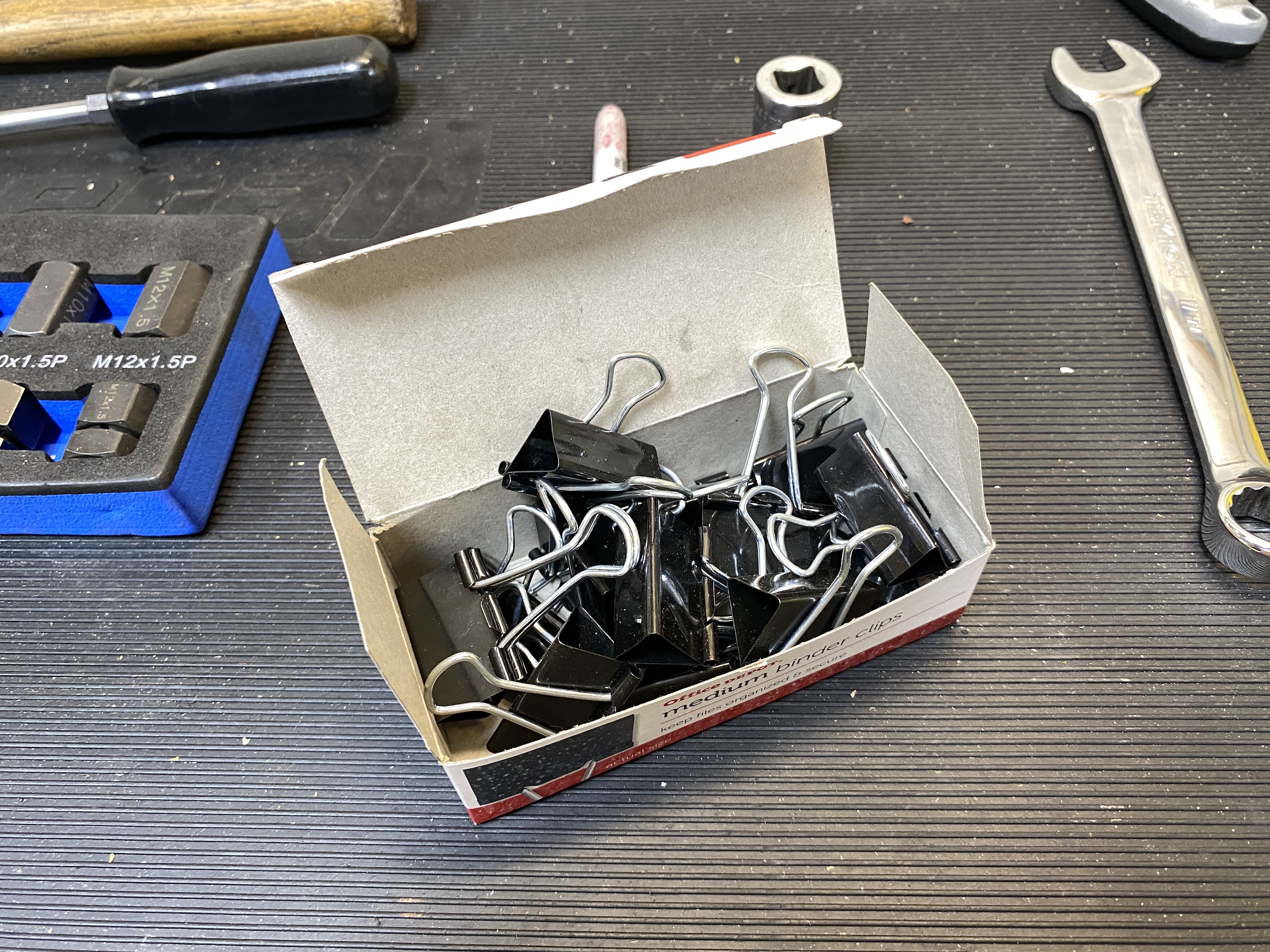

Then time for rubber surround clips. They might look like office supplies, but they are actually custom 914 parts.
bkrantz
post Mar 2 2023, 09:02 PM
Post #6240
Posts: 8,746
Joined: 3-August 19
From: SW Colorado
Member No.: 23,343
Here's a clip as initially installed.
