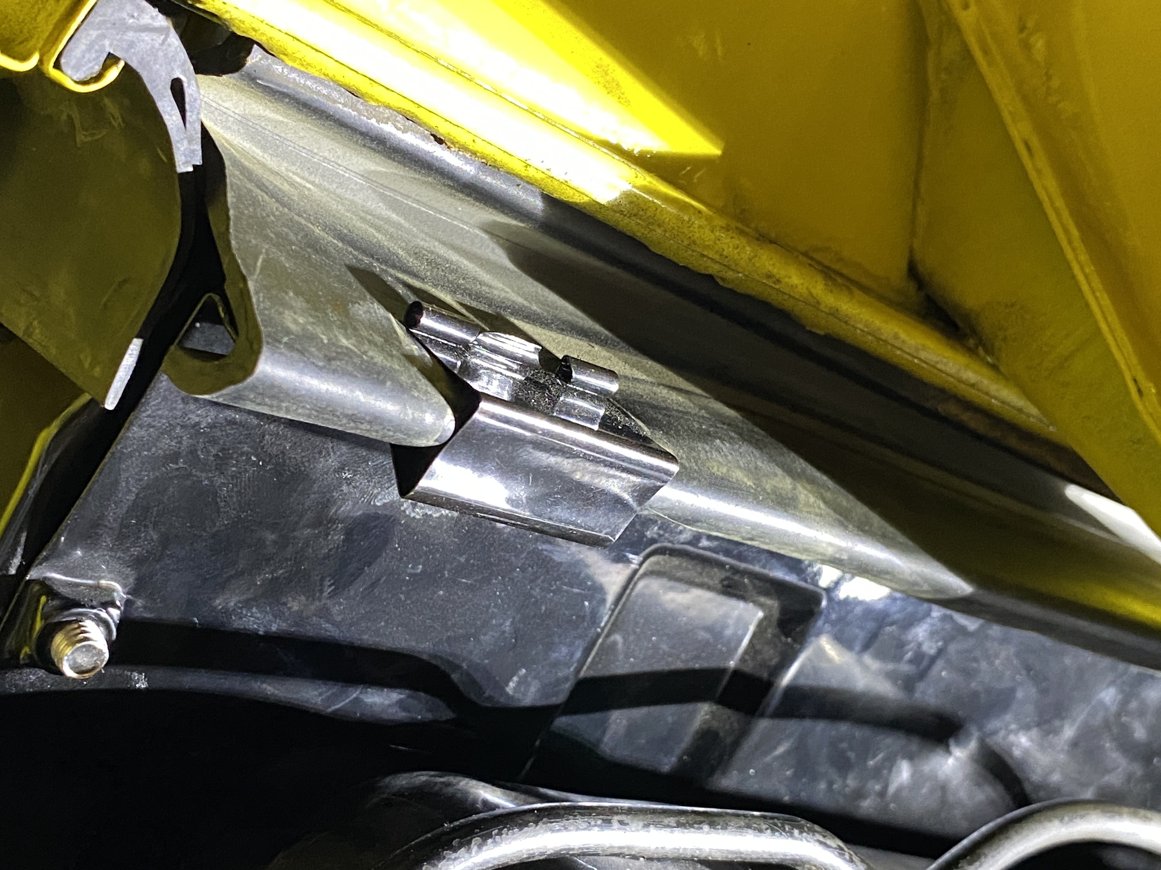

BTW, after my initial engine installation last year, the rubber surround kept pulling away from the sheet metal. This was an effective fix.

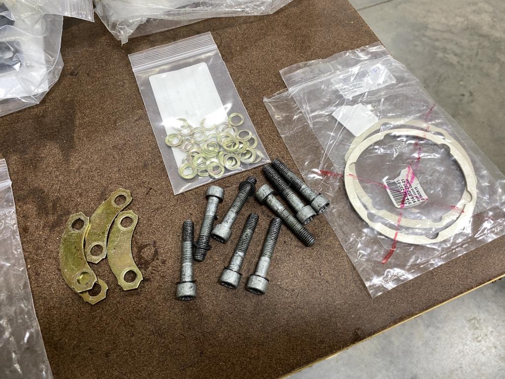

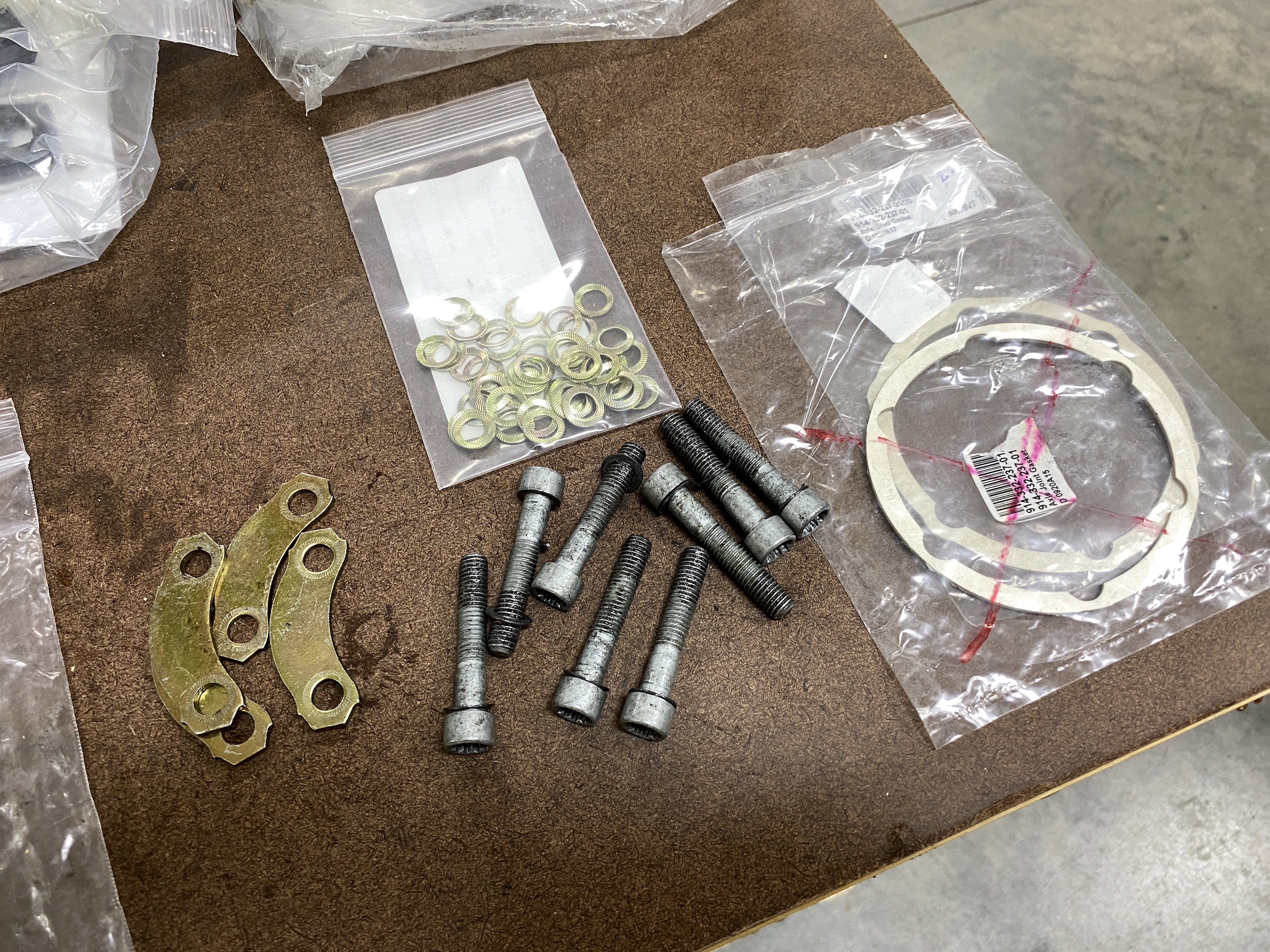

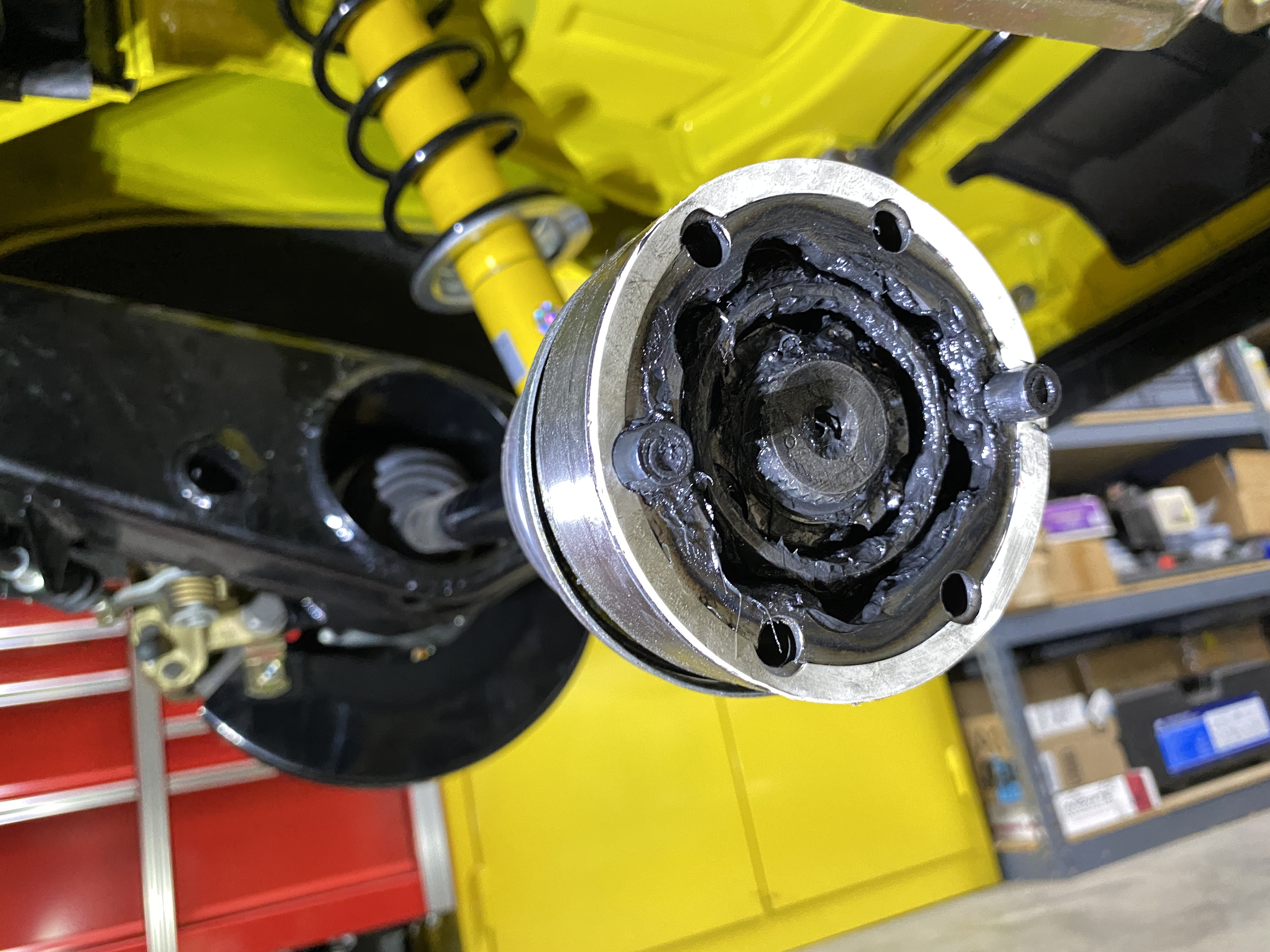

Then I got out all the CV joint hardware, especially new gaskets and Schnorr washers.
bkrantz
post Mar 2 2023, 09:09 PM
Post #6243
Posts: 8,746
Joined: 3-August 19
From: SW Colorado
Member No.: 23,343

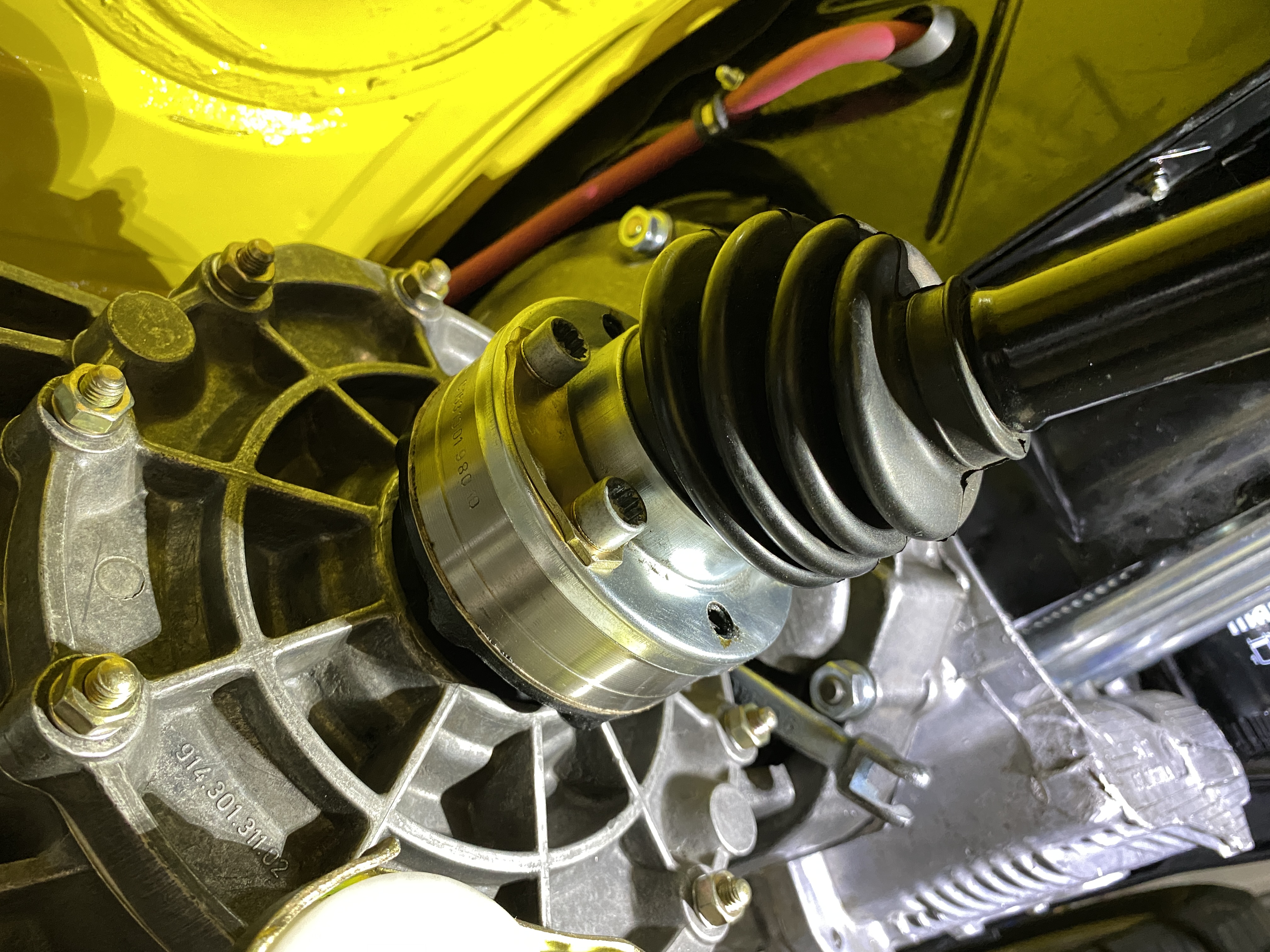

Gasket installed. The fit is tight, and it was a bit tricky to keep the gasket in place in the CV body recess.
bkrantz
post Mar 2 2023, 09:10 PM
Post #6244
Posts: 8,746
Joined: 3-August 19
From: SW Colorado
Member No.: 23,343
CVs bolted up and torqued.

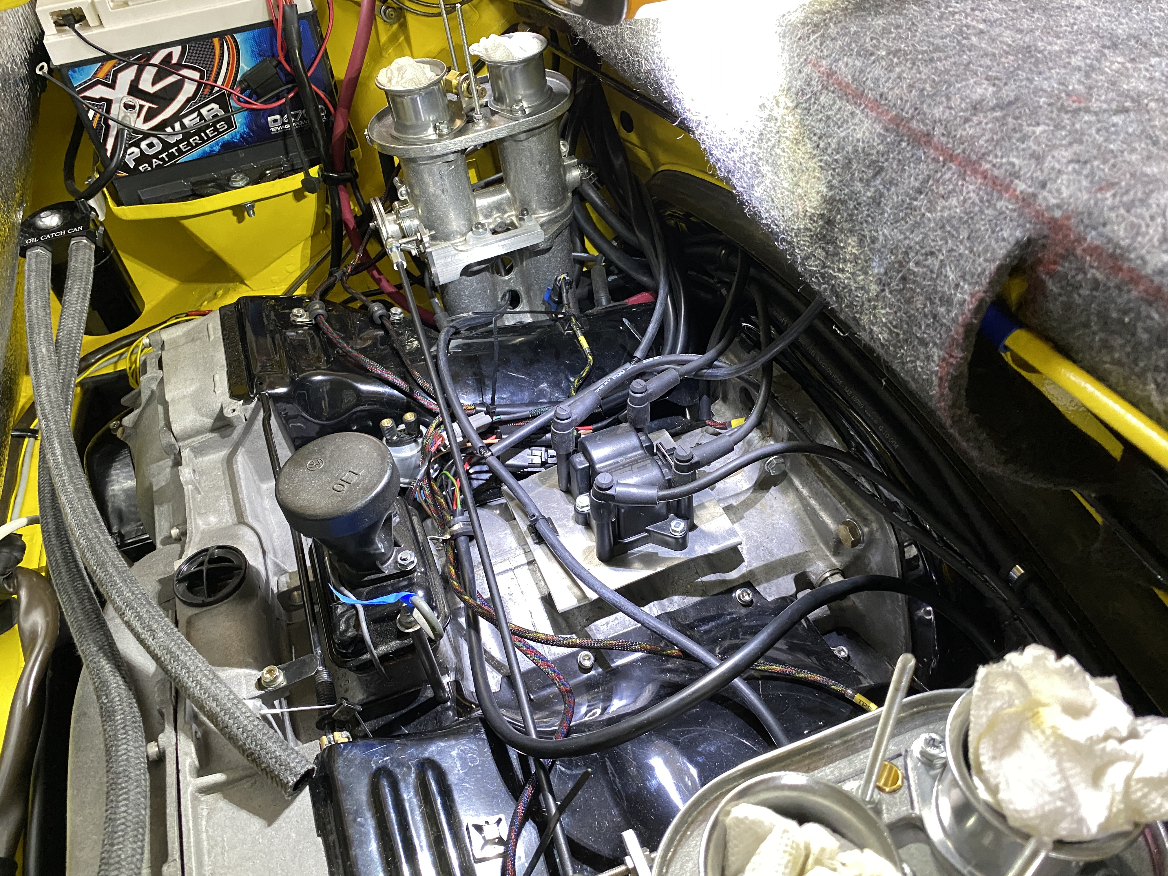

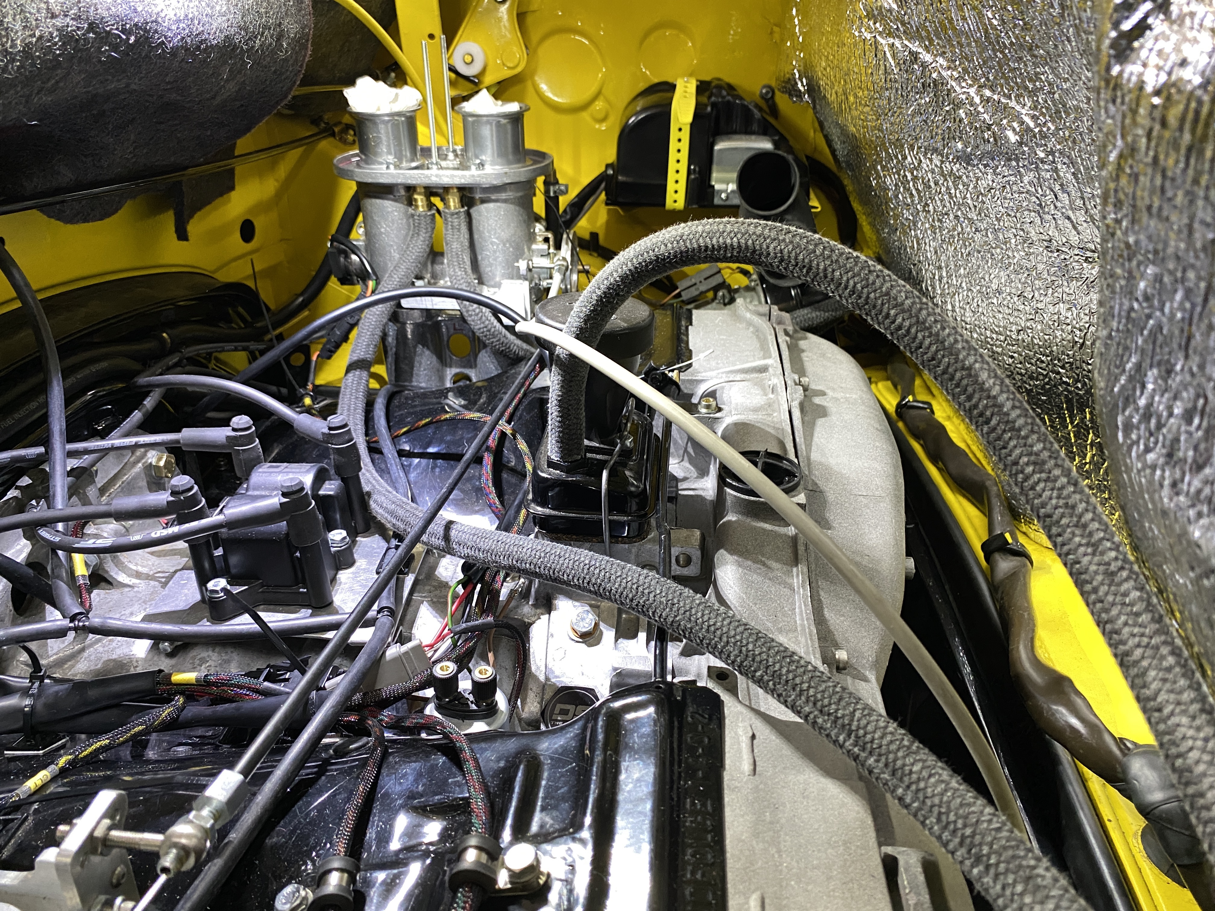

I then worked on making all the EFI cable connections, and tying down the cables.

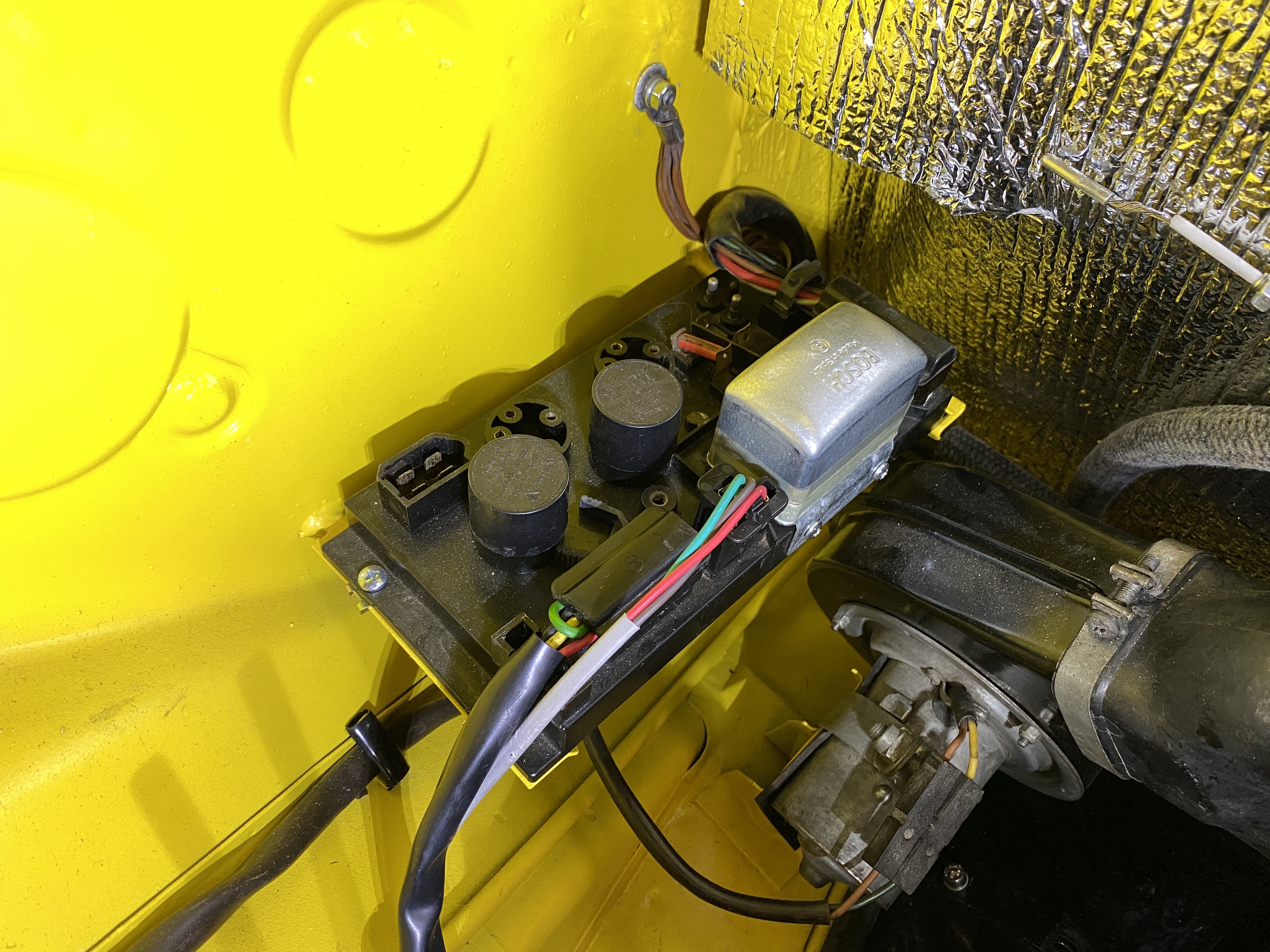

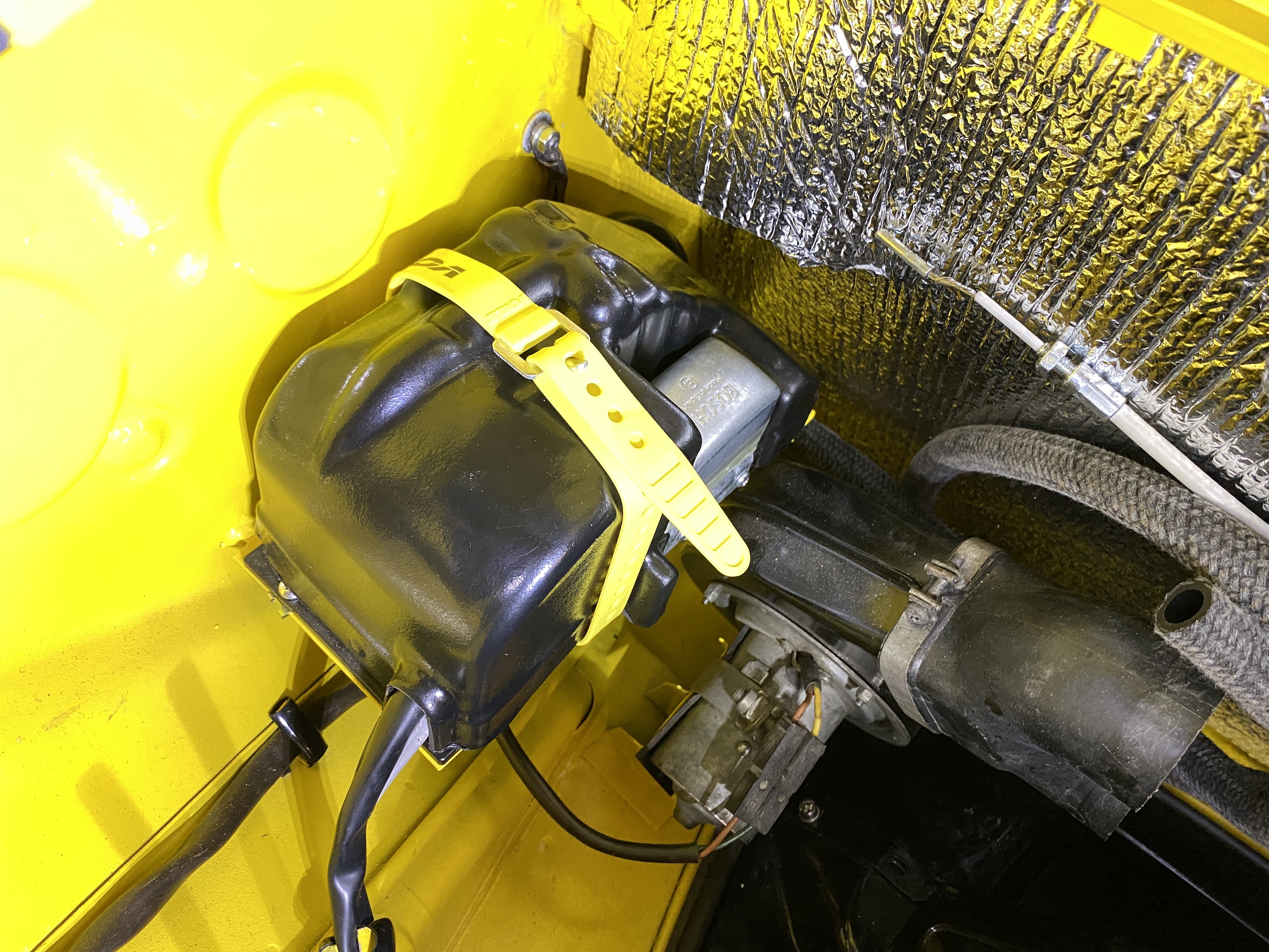

Plus the connections on the relay board. The alternator cable is stock, but the 12 pin cable is a hybrid of original wires plus new leads for the EFI.
bkrantz
post Mar 2 2023, 09:15 PM
Post #6248
Posts: 8,746
Joined: 3-August 19
From: SW Colorado
Member No.: 23,343
Relay cover and custom strap.

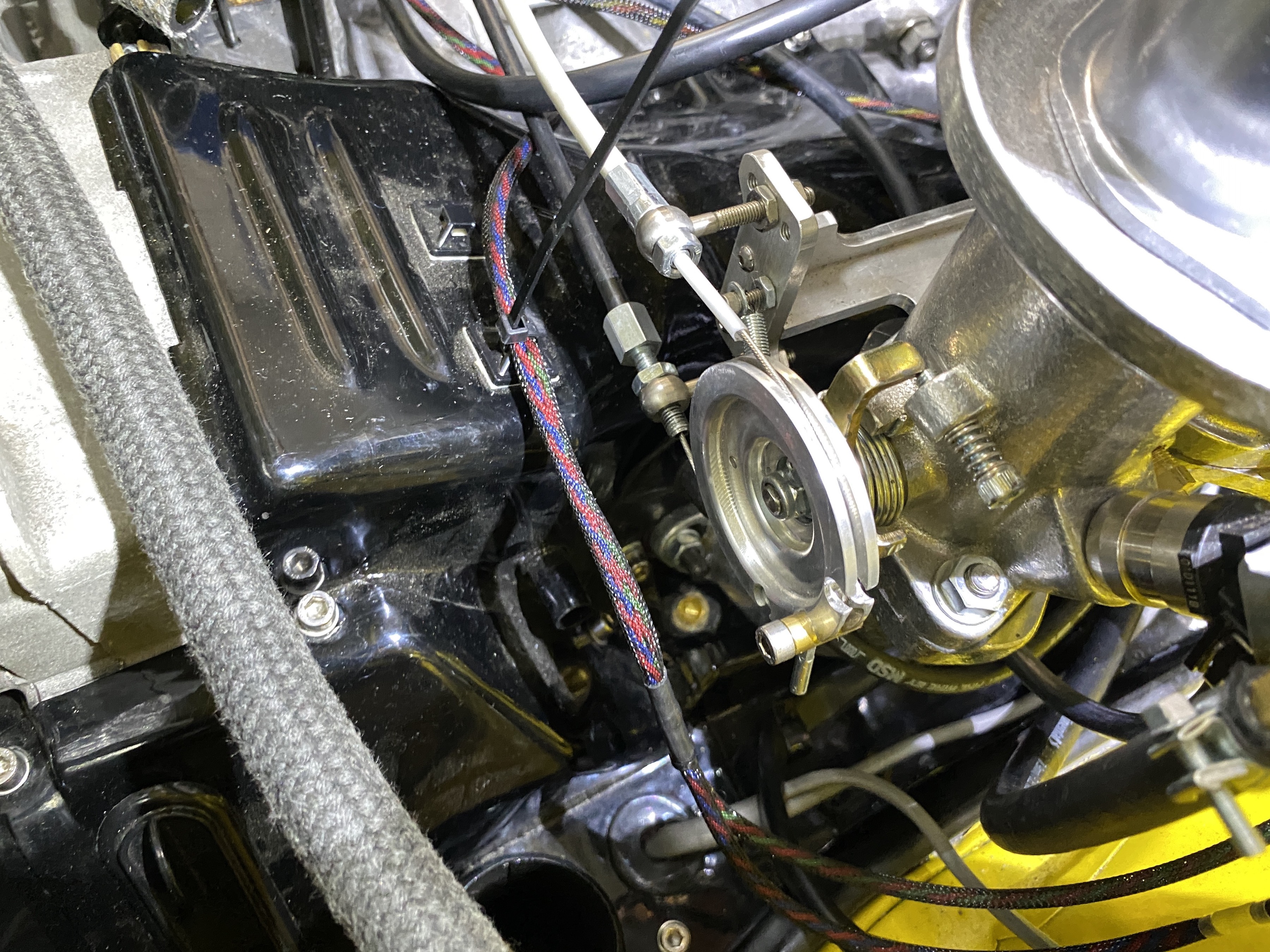

Then the throttle cable

Last thing today, connect all the breather hoses.

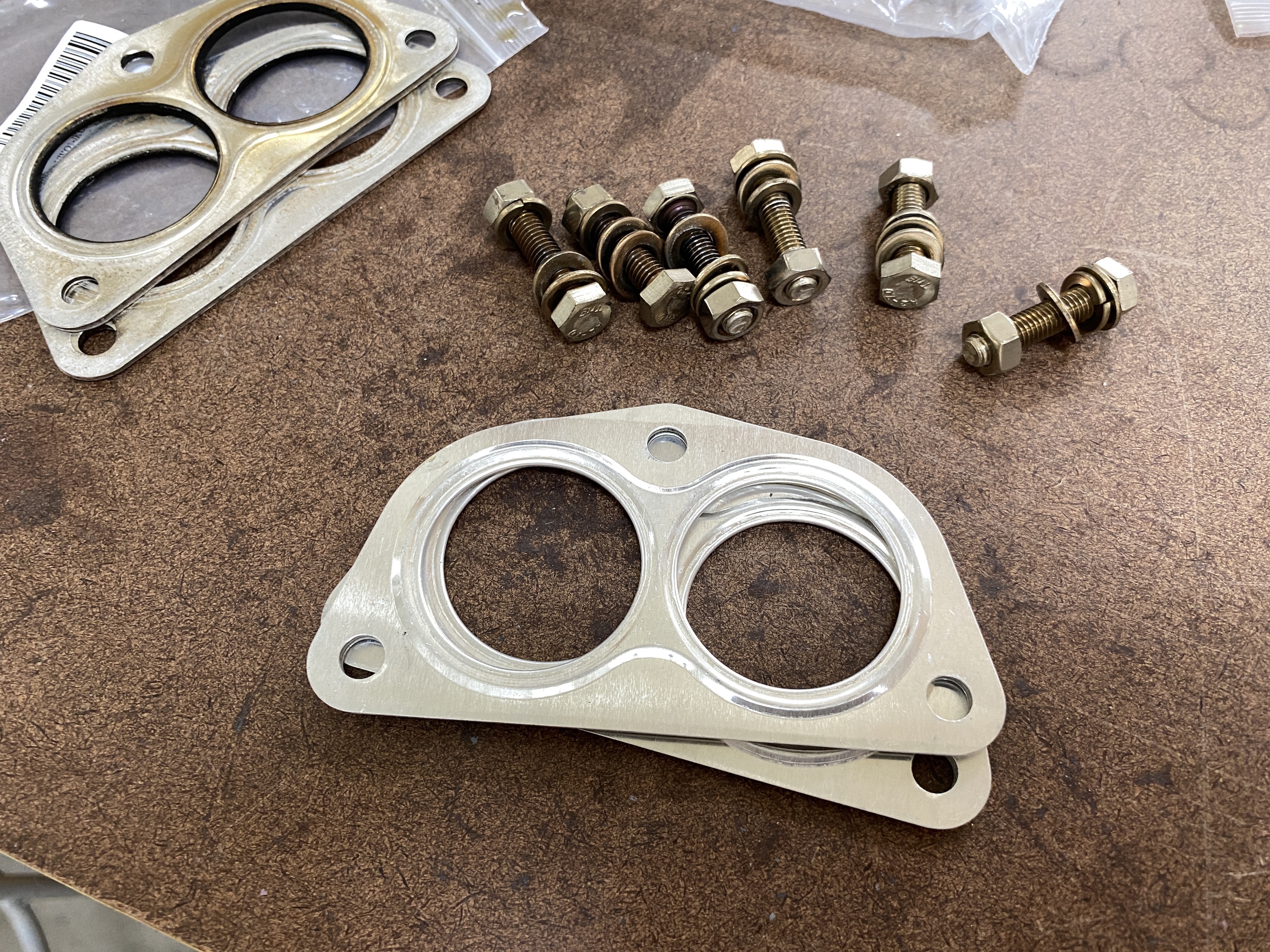

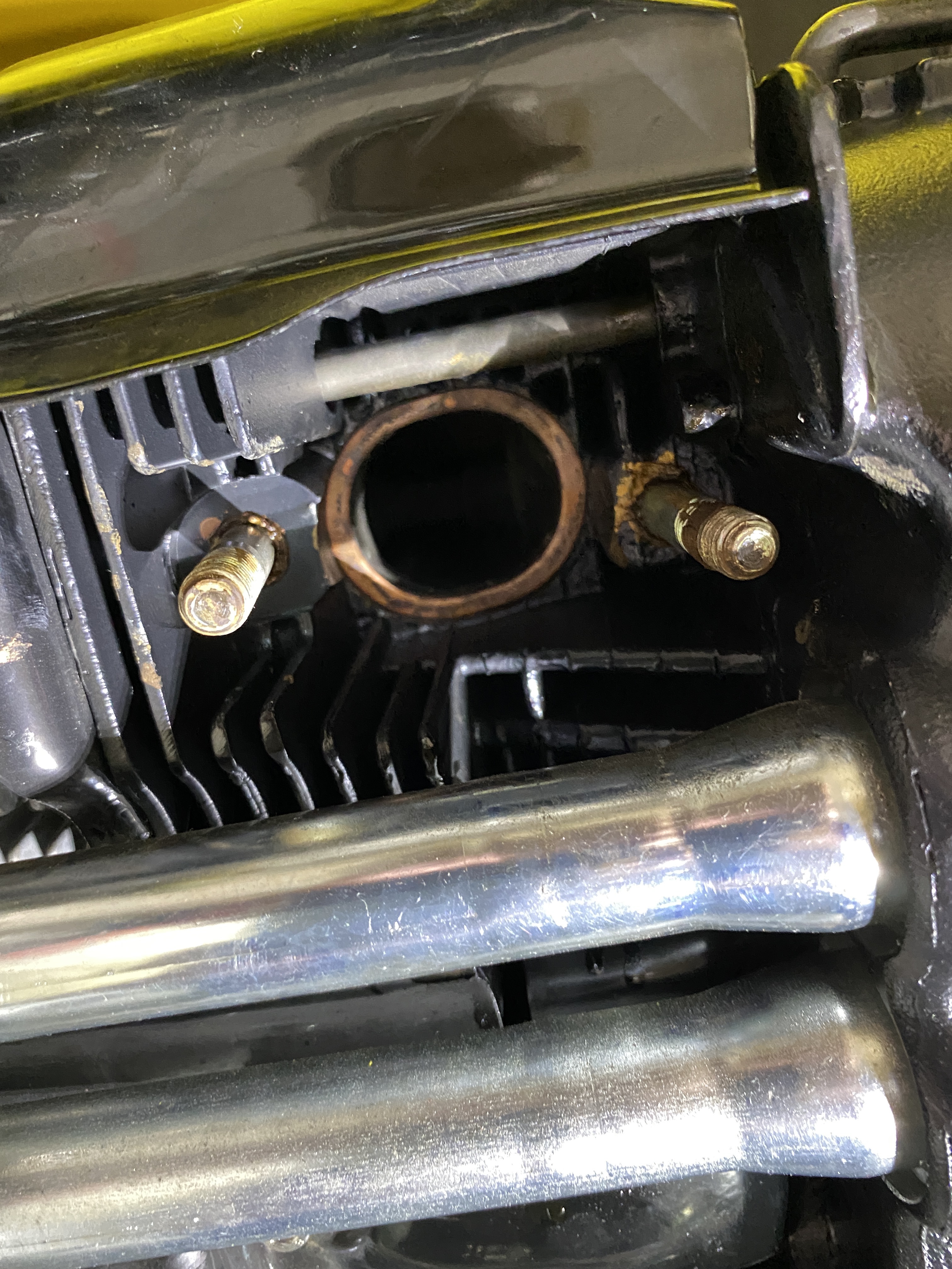

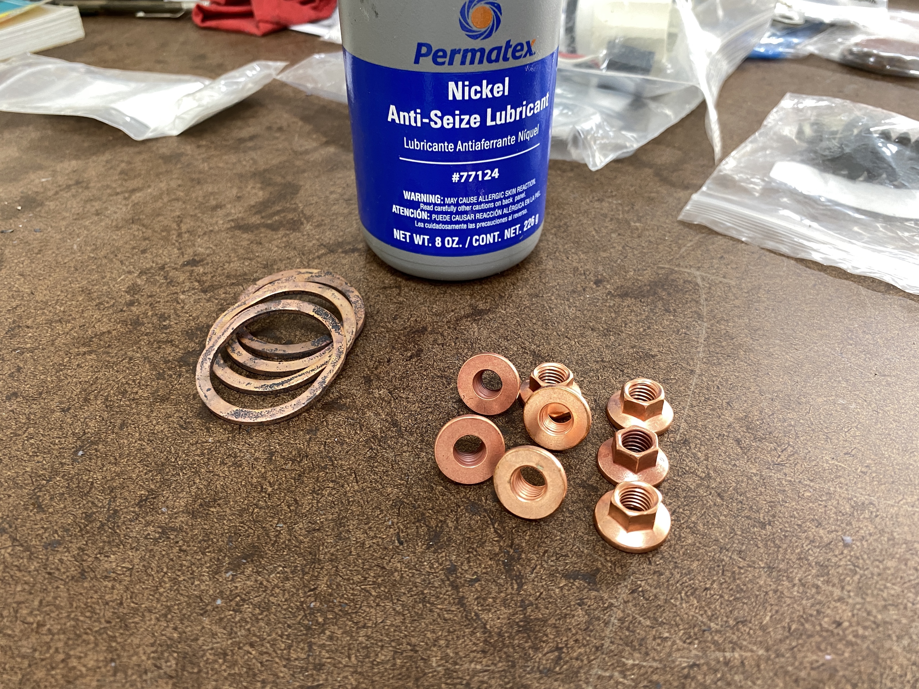

Ready for mounting the exhaust. The copper gaskets are new--the "dirt" is from heat treatment.
bkrantz
post Mar 4 2023, 08:52 PM
Post #6253
Posts: 8,746
Joined: 3-August 19
From: SW Colorado
Member No.: 23,343
Gaskets installed. Pushed in just right, they stay in place.

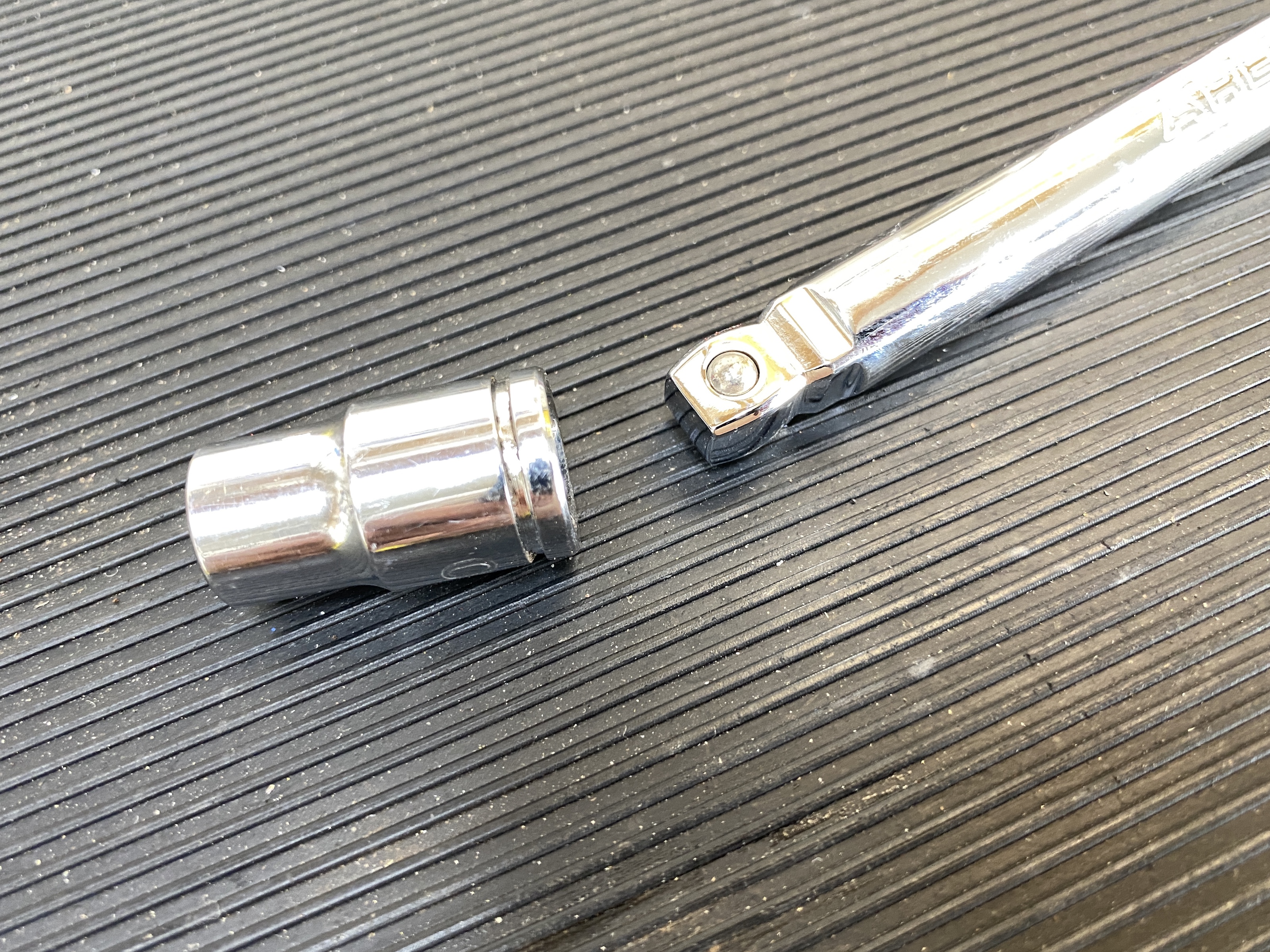

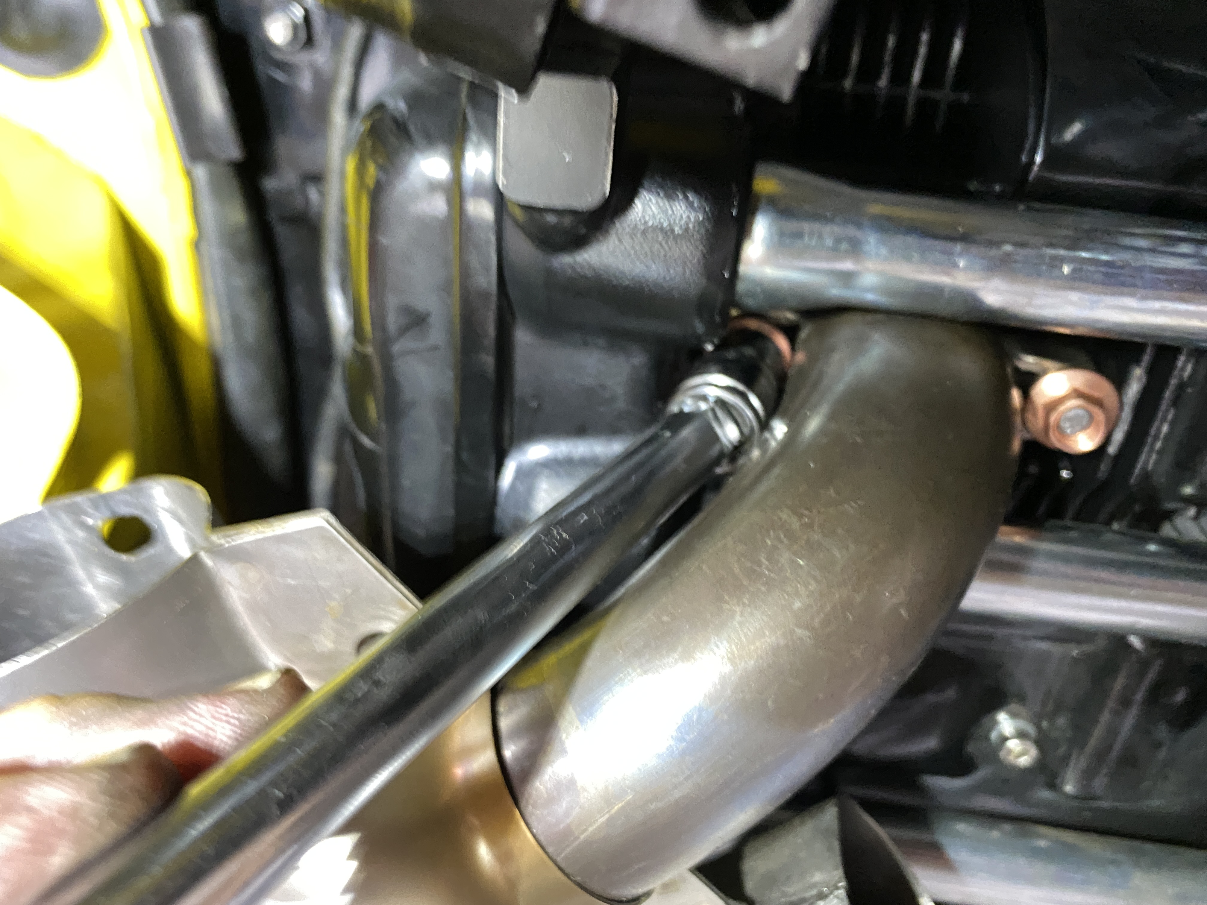

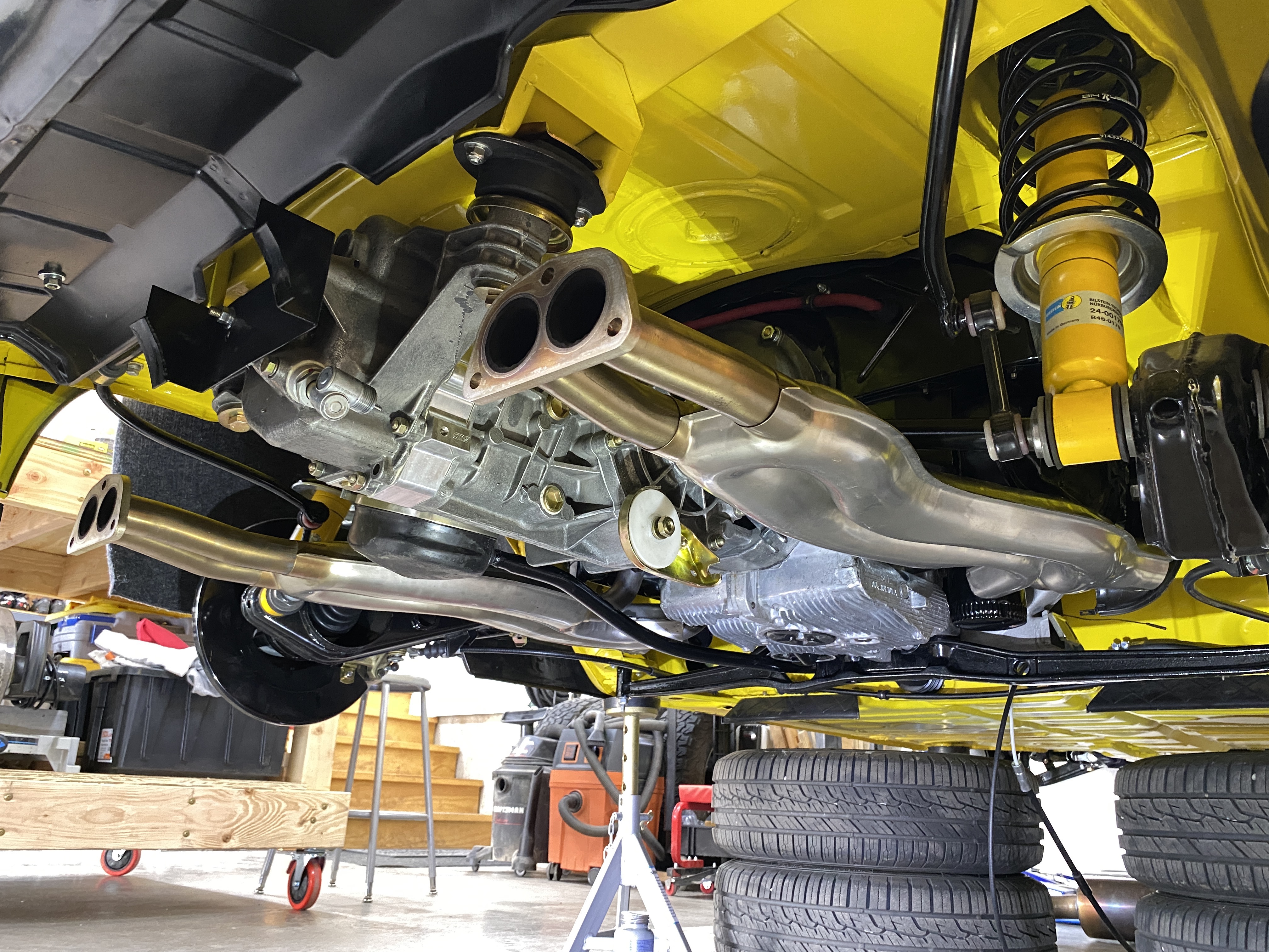

I got to try my wobble extension.
bkrantz
post Mar 4 2023, 08:53 PM
Post #6255
Posts: 8,746
Joined: 3-August 19
From: SW Colorado
Member No.: 23,343
Just enough flex to reach past the exhaust tube.

Member No.: 23,343

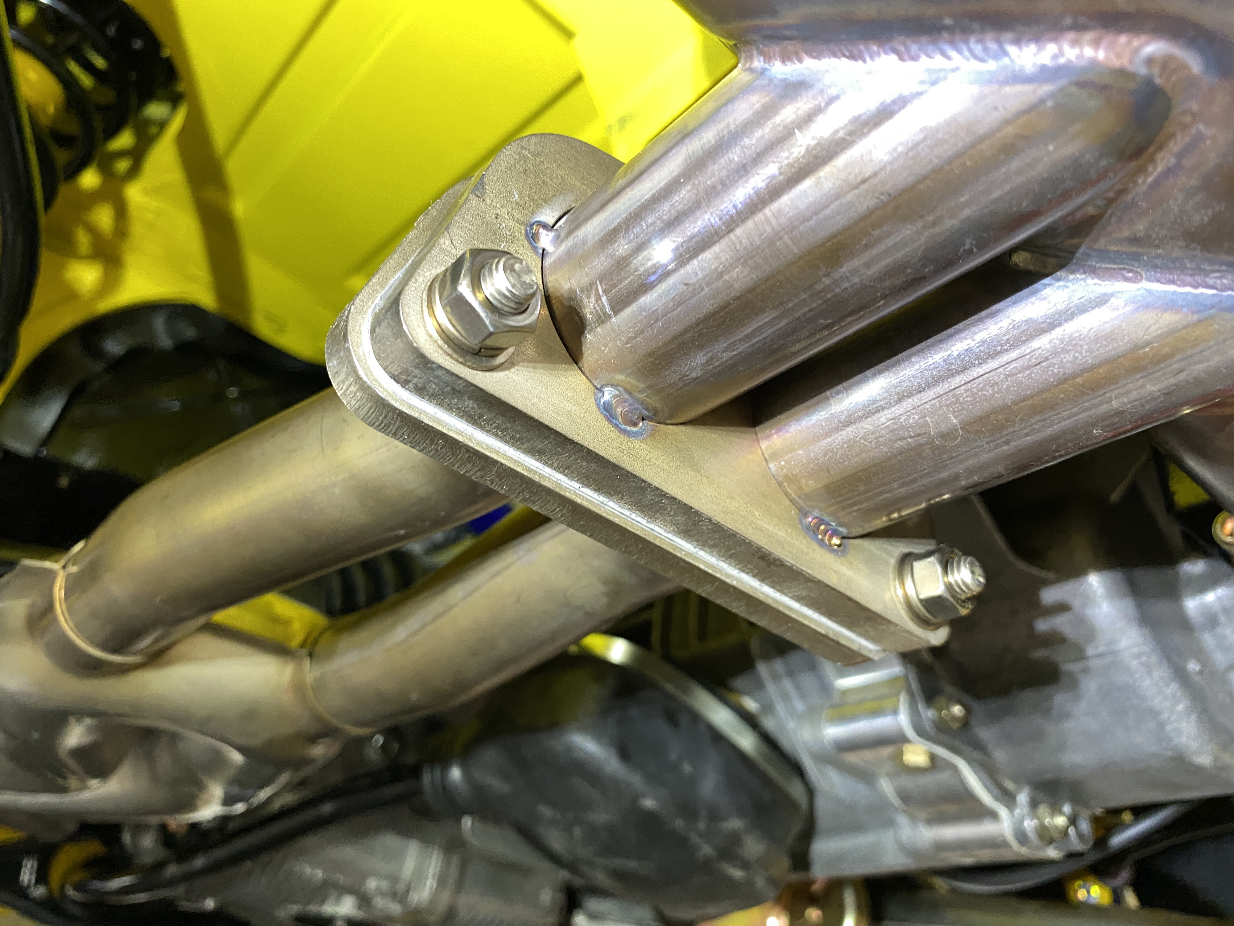

Heat exchangers installed.

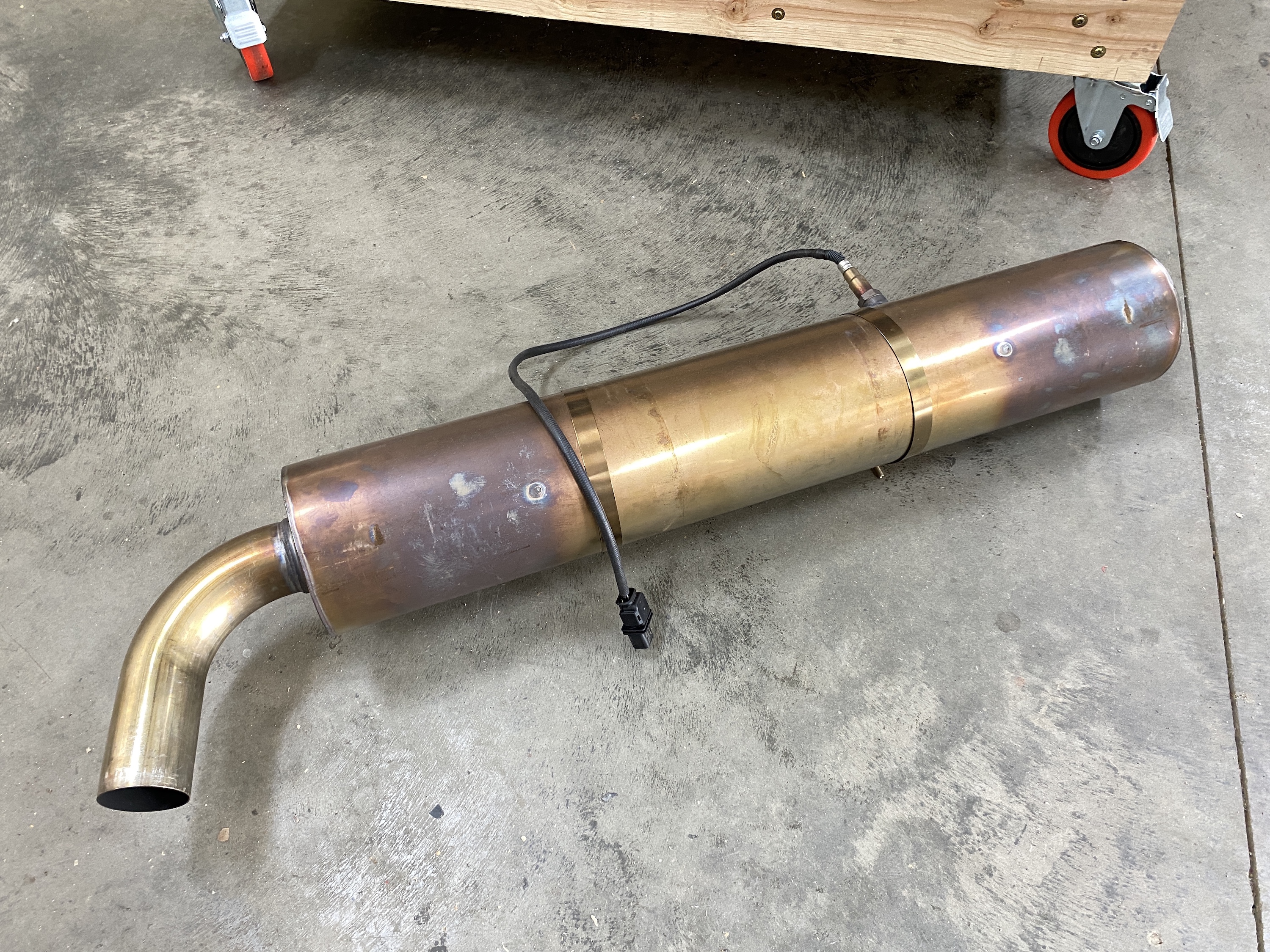

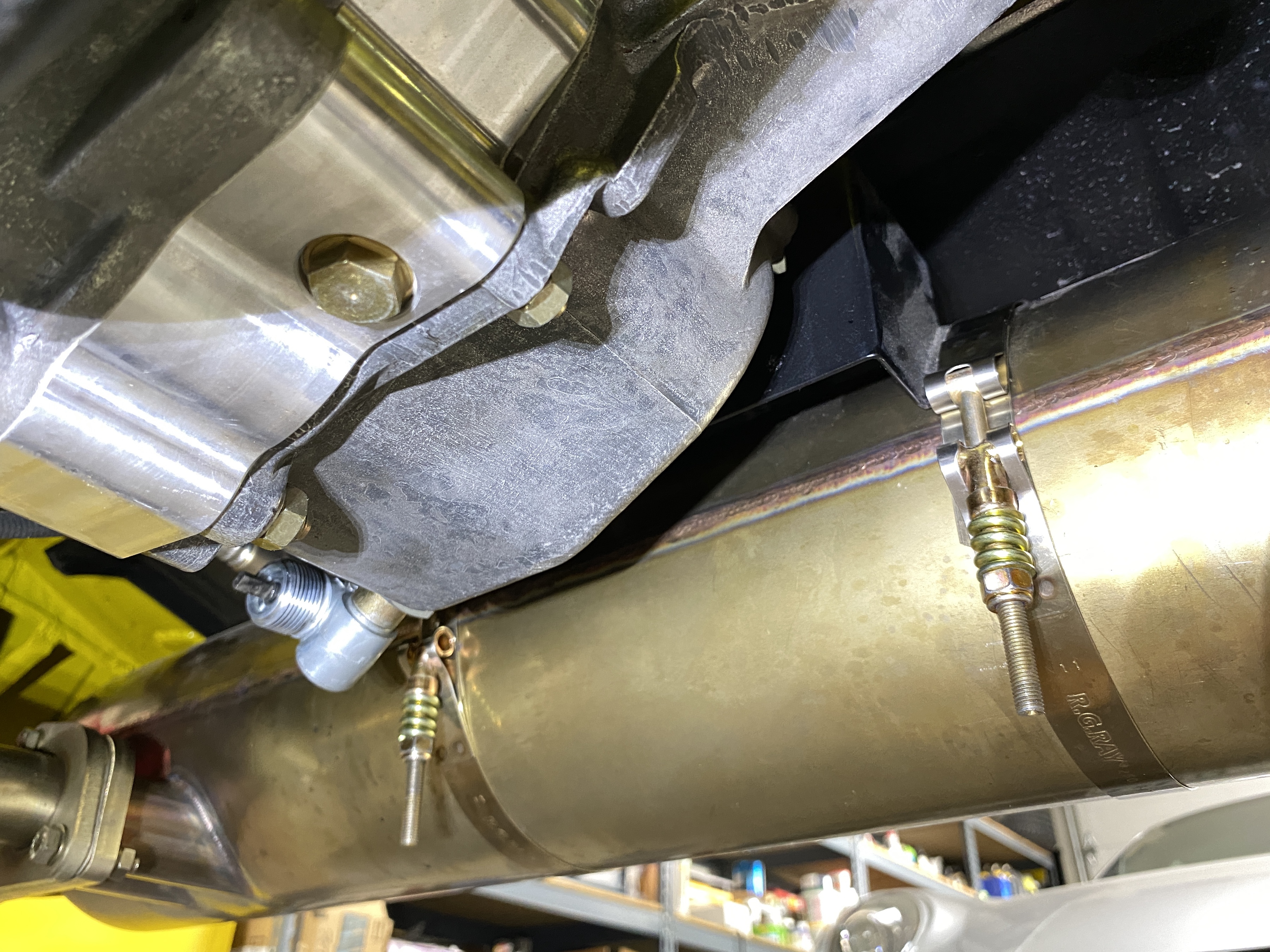

Muffler time. It did run kinda hot during the dyno tune session last summer.

Member No.: 23,343
New gaskets.

Member No.: 23,343
Flanges aligned and bolted--I did have to loosen the nuts on the cylinder heads to get the exchangers lined up.

Member No.: 23,343
And then the muffler mounting clamps.
