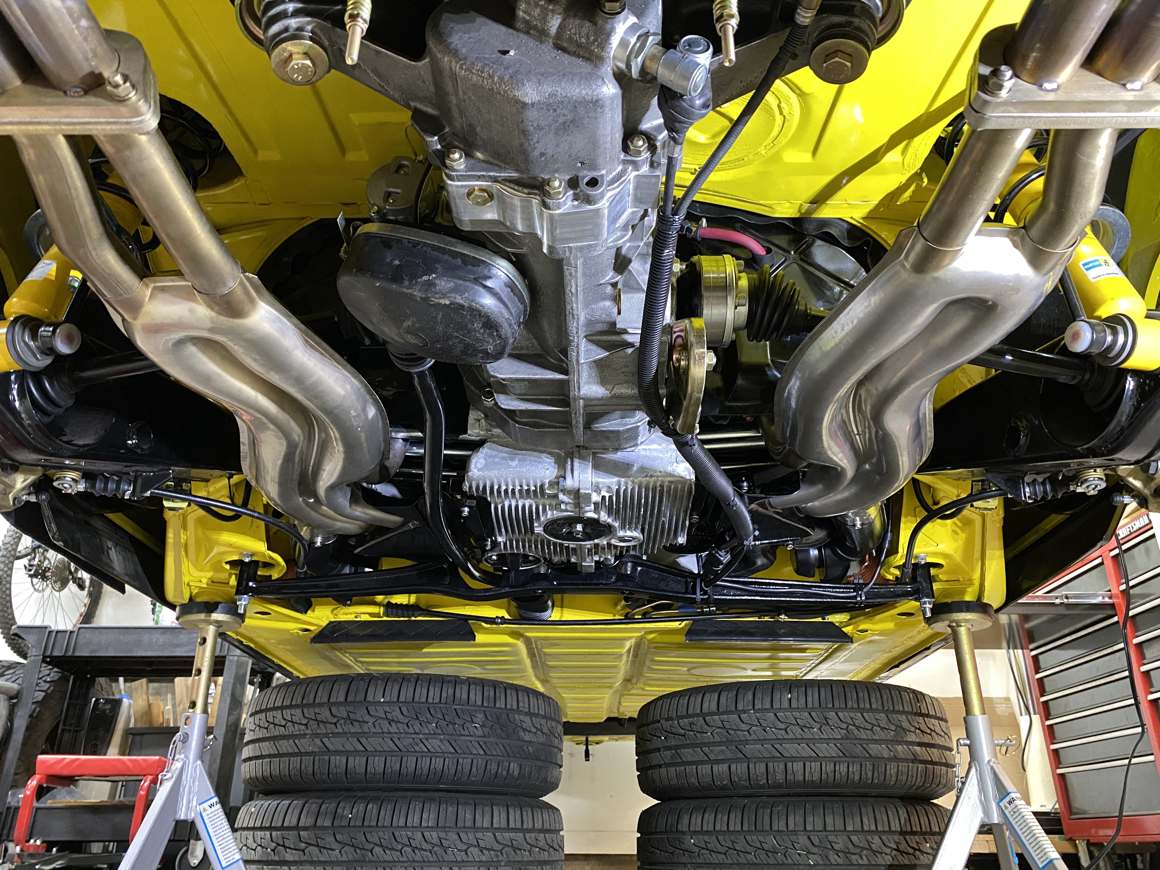

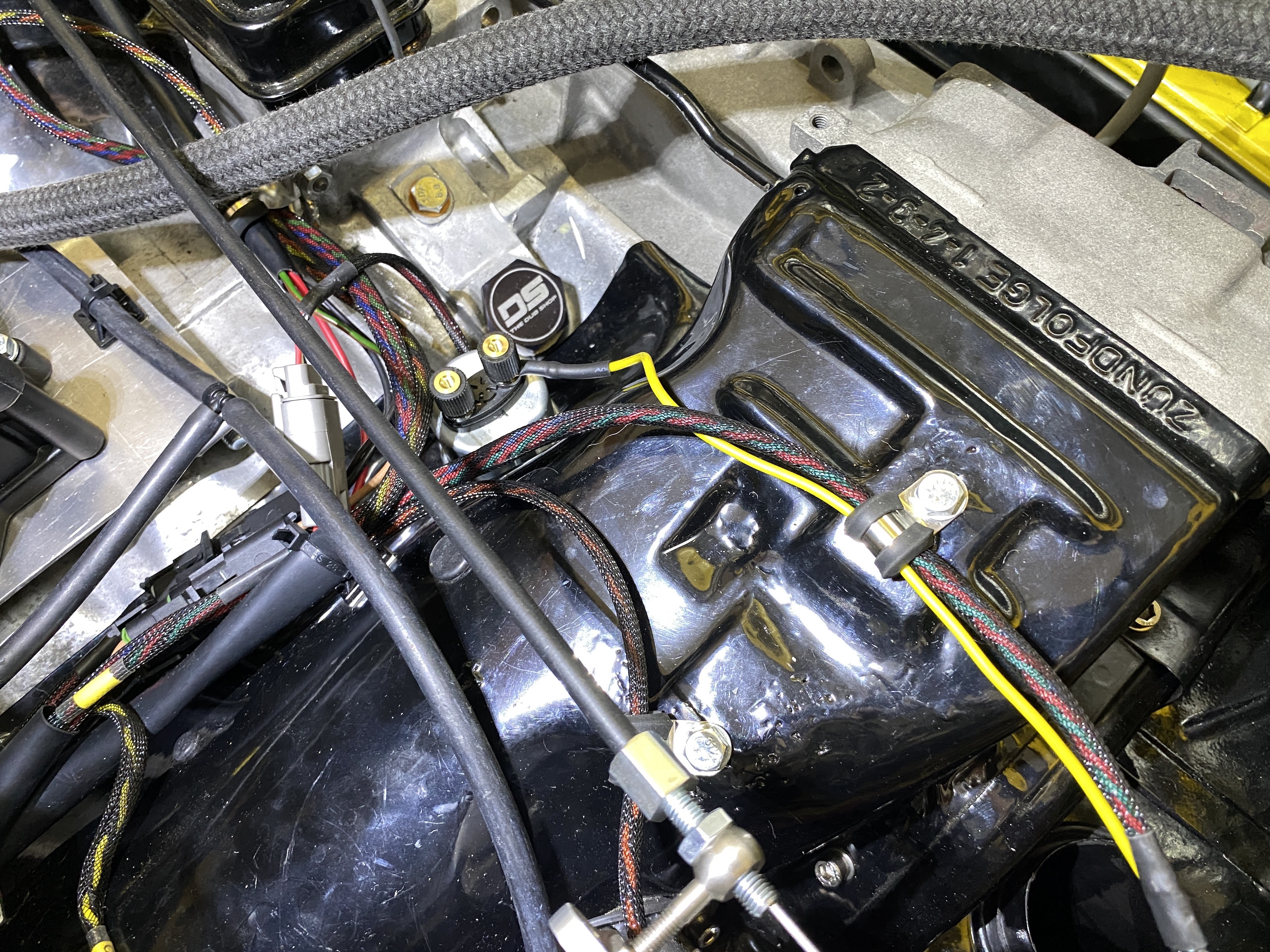

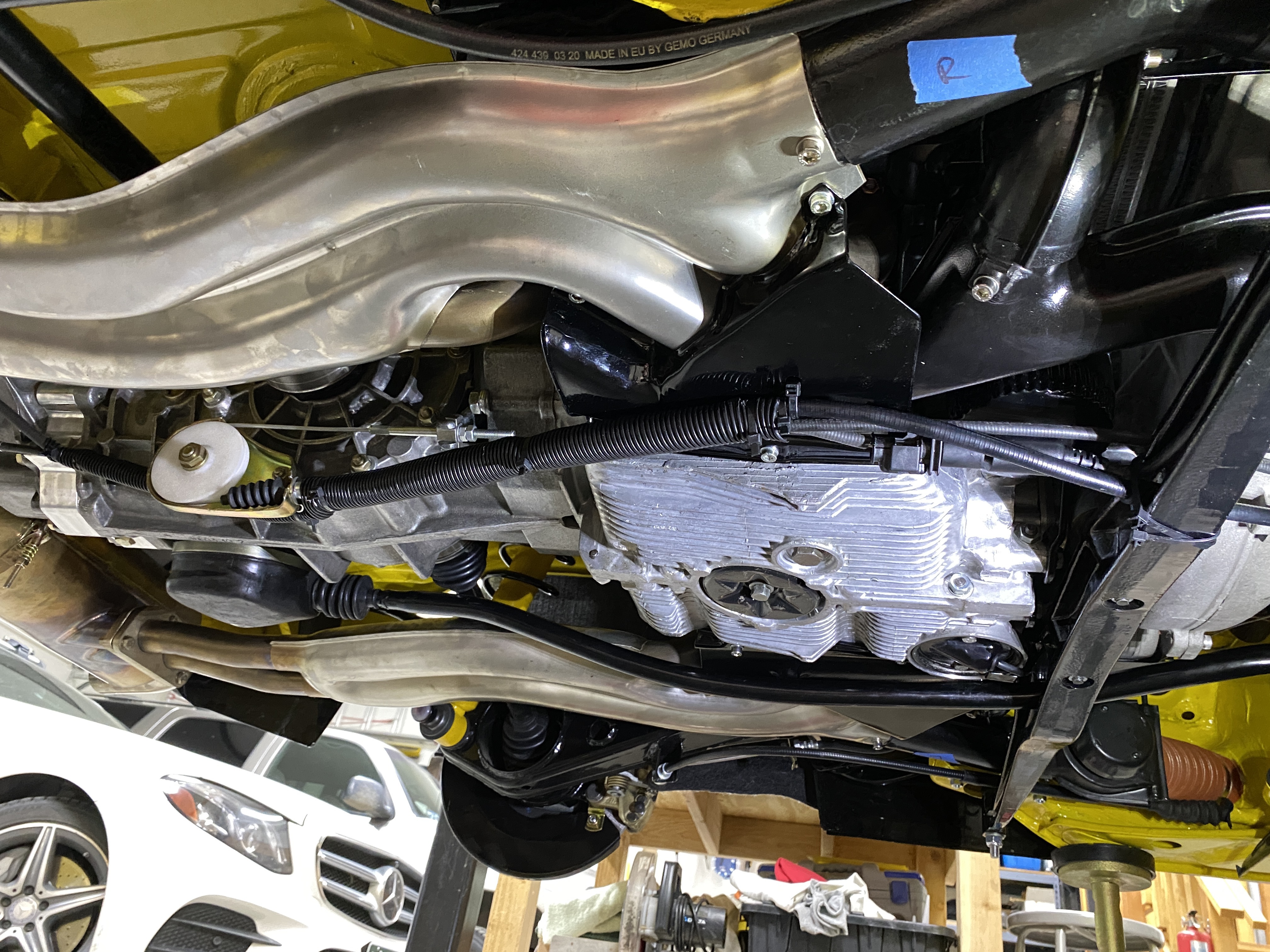

I bundled all the cables and covered then with the plastic cable wrap.
bkrantz
post Mar 5 2023, 08:43 PM
Post #6282
Posts: 8,746
Joined: 3-August 19
From: SW Colorado
Member No.: 23,343

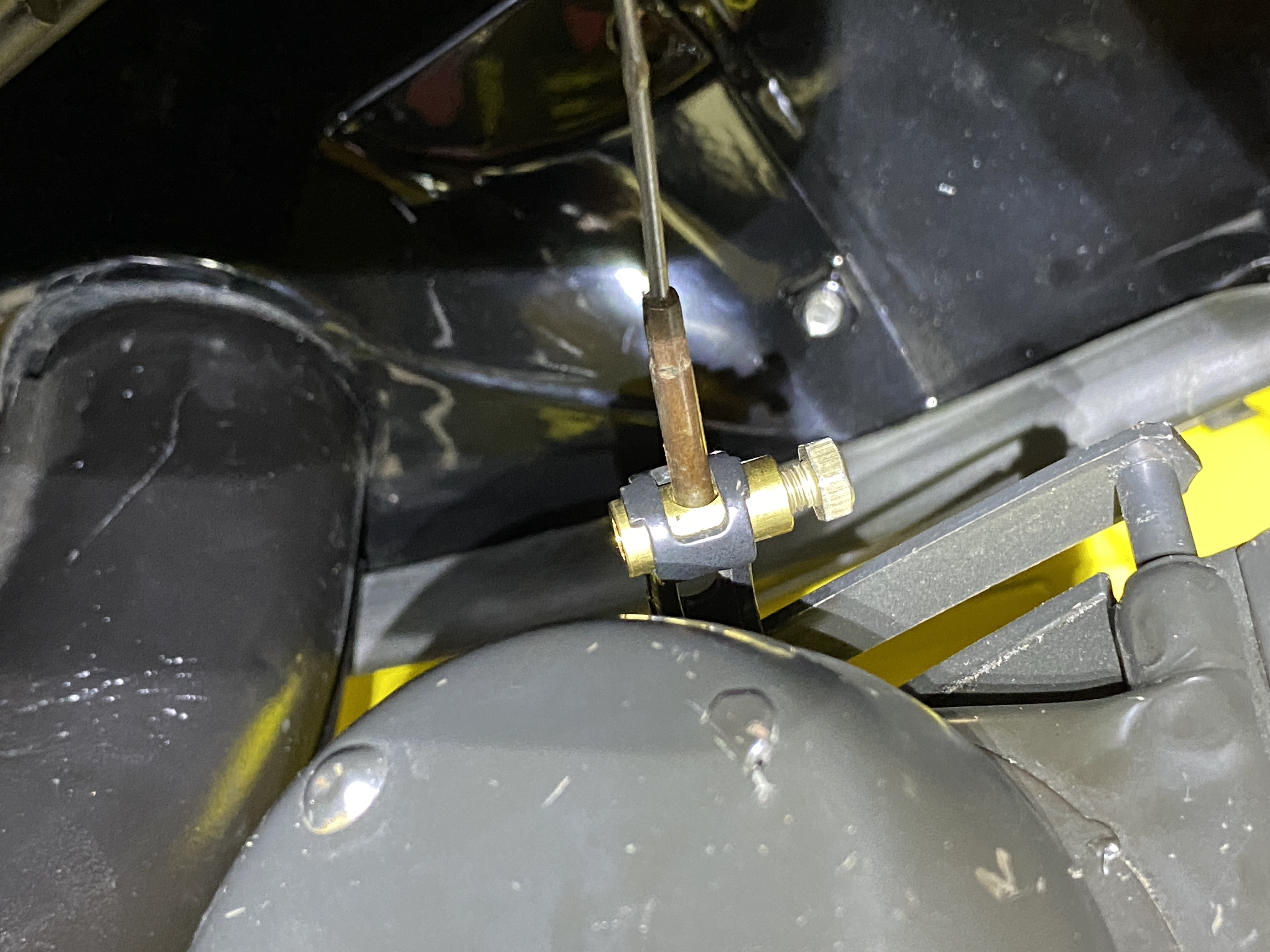

Last thing: connecting the heater valve control cables. Seems like they work.
bkrantz
post Mar 5 2023, 08:44 PM
Post #6283
Posts: 8,746
Joined: 3-August 19
From: SW Colorado
Member No.: 23,343
OK, that should be everything underneath. Yay!
bkrantz
post Mar 5 2023, 08:45 PM
Post #6284
Posts: 8,746
Joined: 3-August 19
From: SW Colorado
Member No.: 23,343
Checklist check.

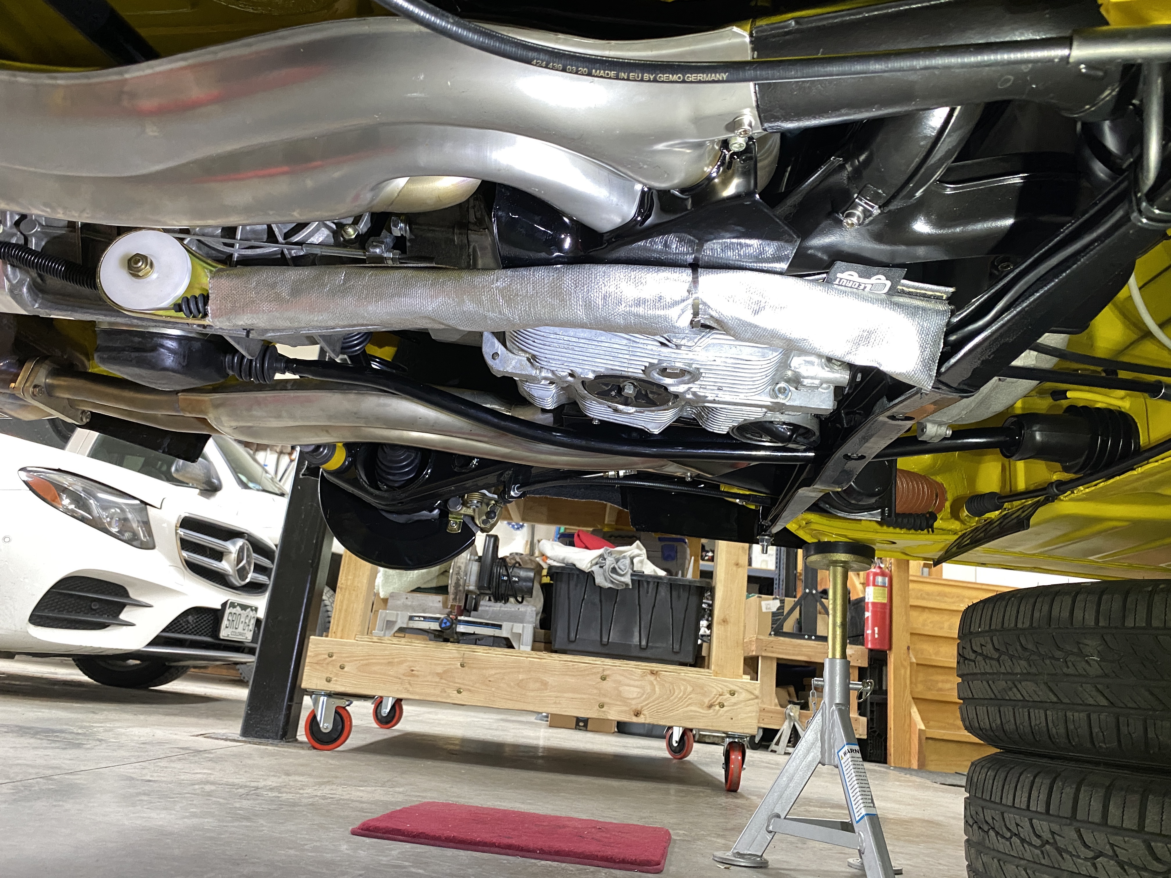

Instead of plastic on cables you might want to use Fire Sleeve
bkrantz
post Mar 6 2023, 09:26 PM
Post #6286
Posts: 8,746
Joined: 3-August 19
From: SW Colorado
Member No.: 23,343
QUOTE(Van914 @ Mar 6 2023, 05:03 AM) *
Thanks for reminding me. I had that on last year.

I found the heat sleeve, and a metal zip tie.

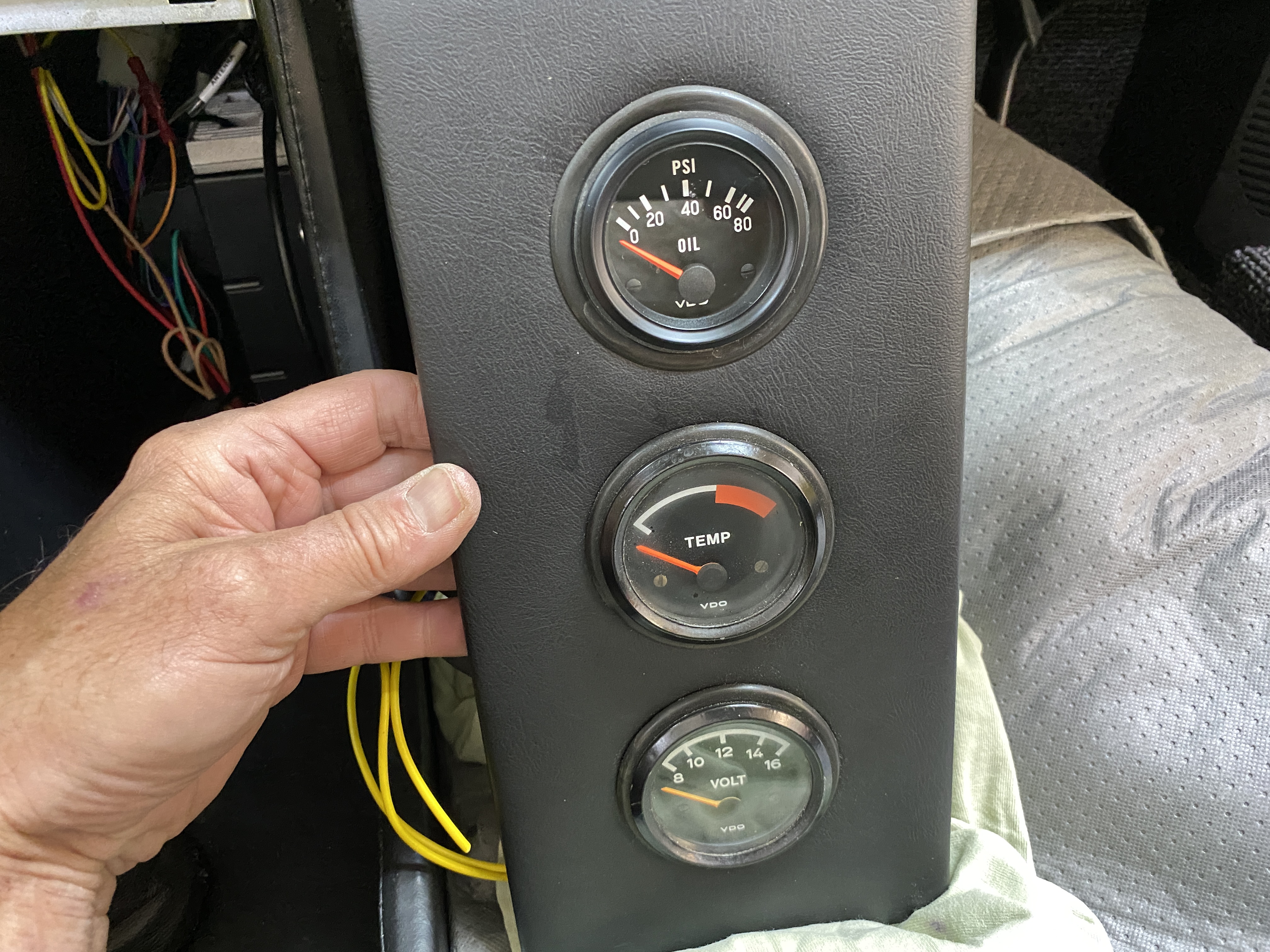

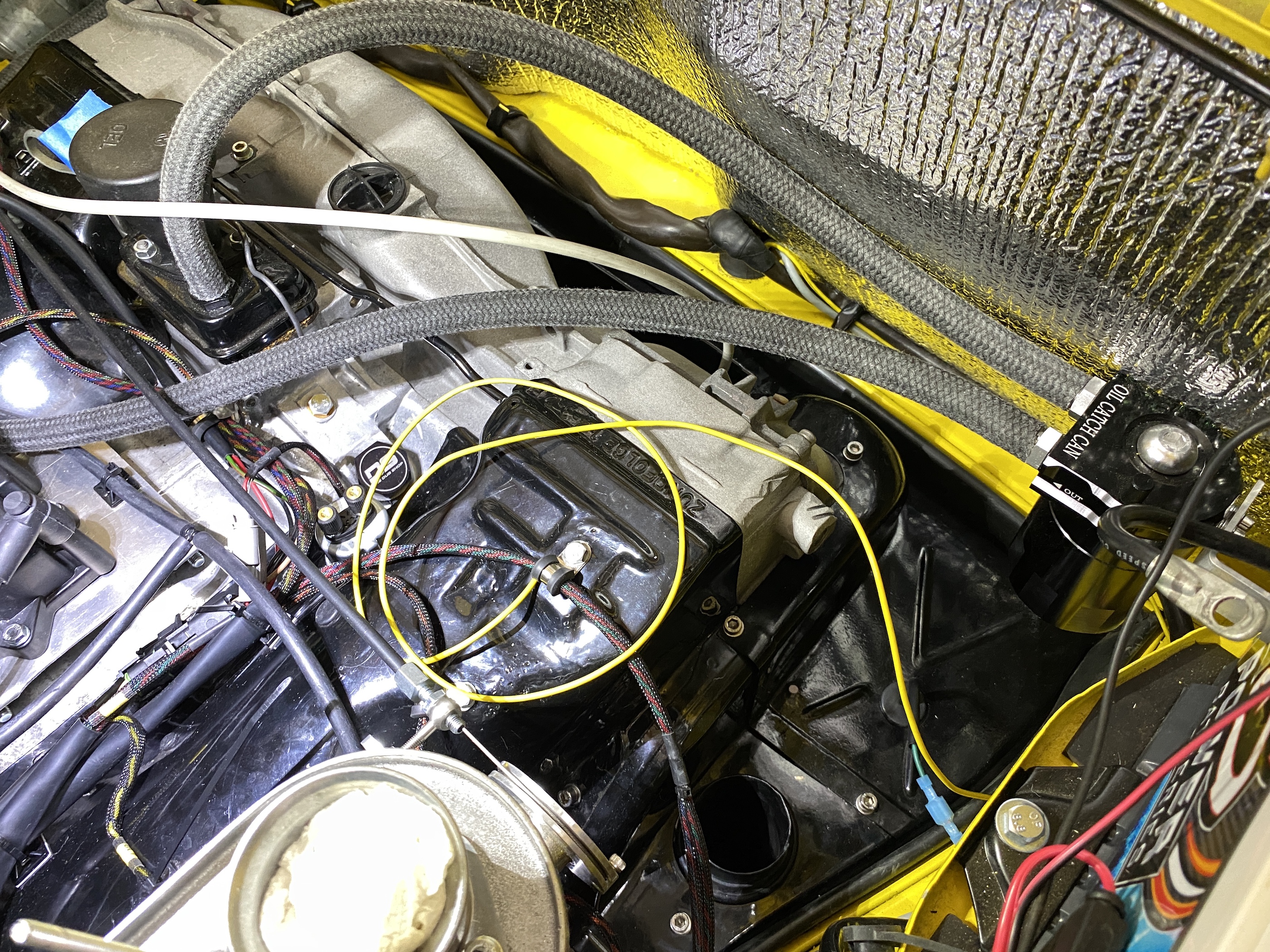

Time to get my new oil pressure sender and gauge wired.
bkrantz
post Mar 9 2023, 08:38 PM
Post #6289
Posts: 8,746
Joined: 3-August 19
From: SW Colorado
Member No.: 23,343

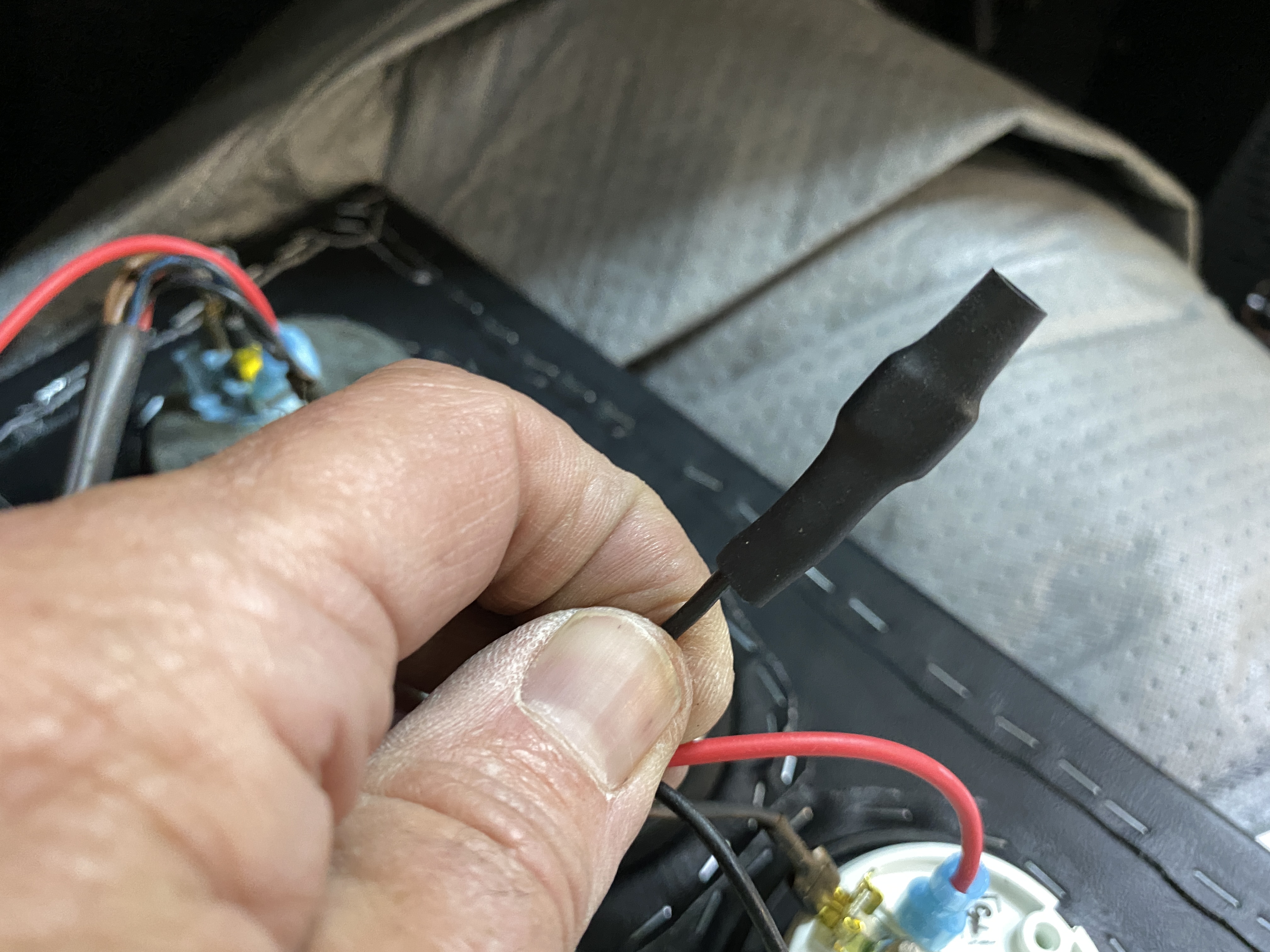

Back into crimp and heat-shrink mode.
bkrantz
post Mar 9 2023, 08:39 PM
Post #6290
Posts: 8,746
Joined: 3-August 19
From: SW Colorado
Member No.: 23,343
Sender end is done.
bkrantz
post Mar 9 2023, 08:40 PM
Post #6291
Posts: 8,746
Joined: 3-August 19
From: SW Colorado
Member No.: 23,343
The other end is more complicated.

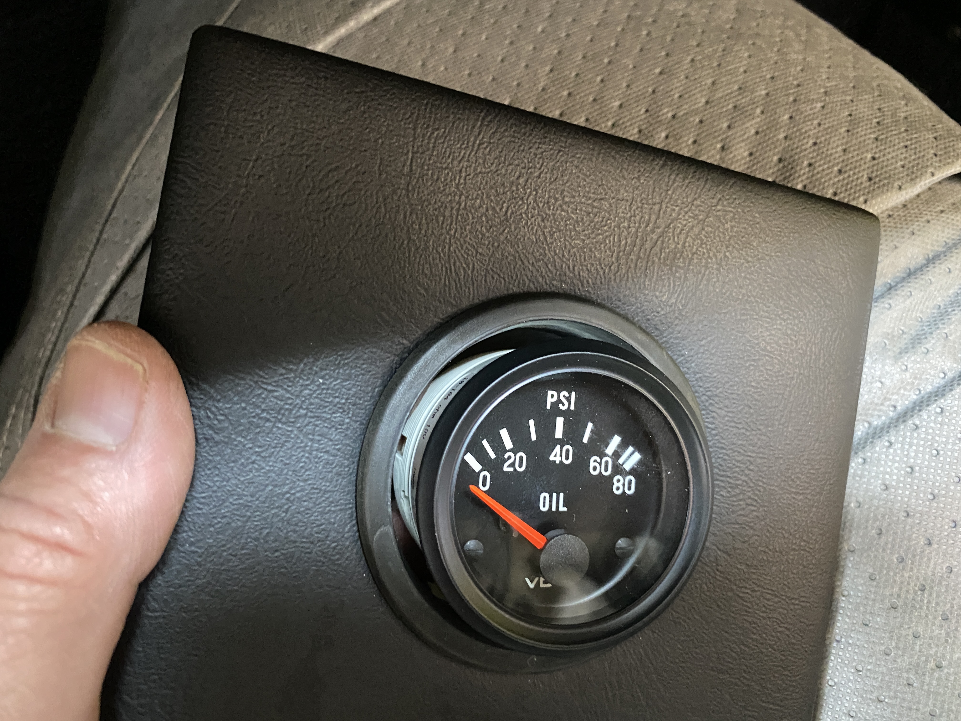

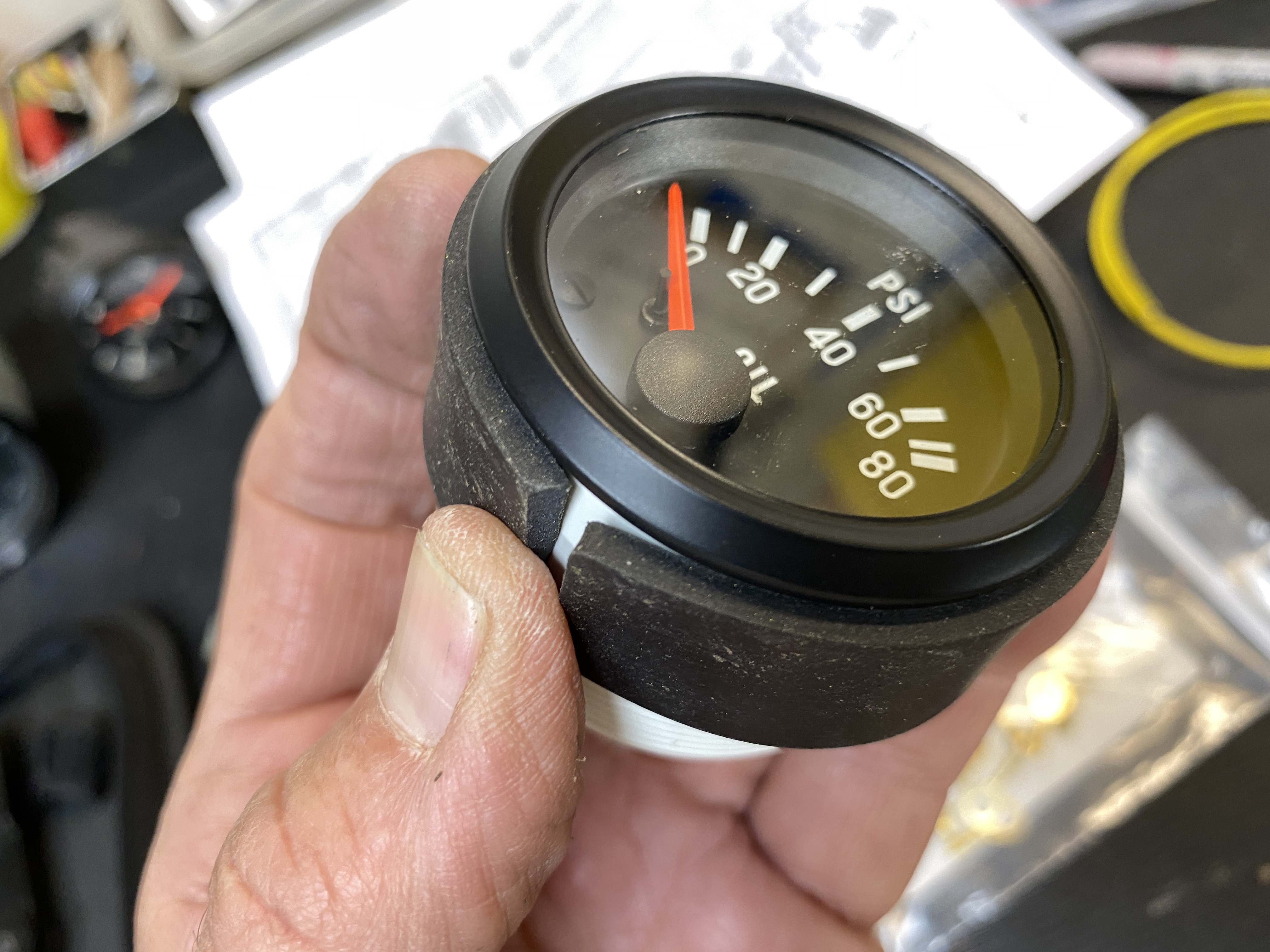

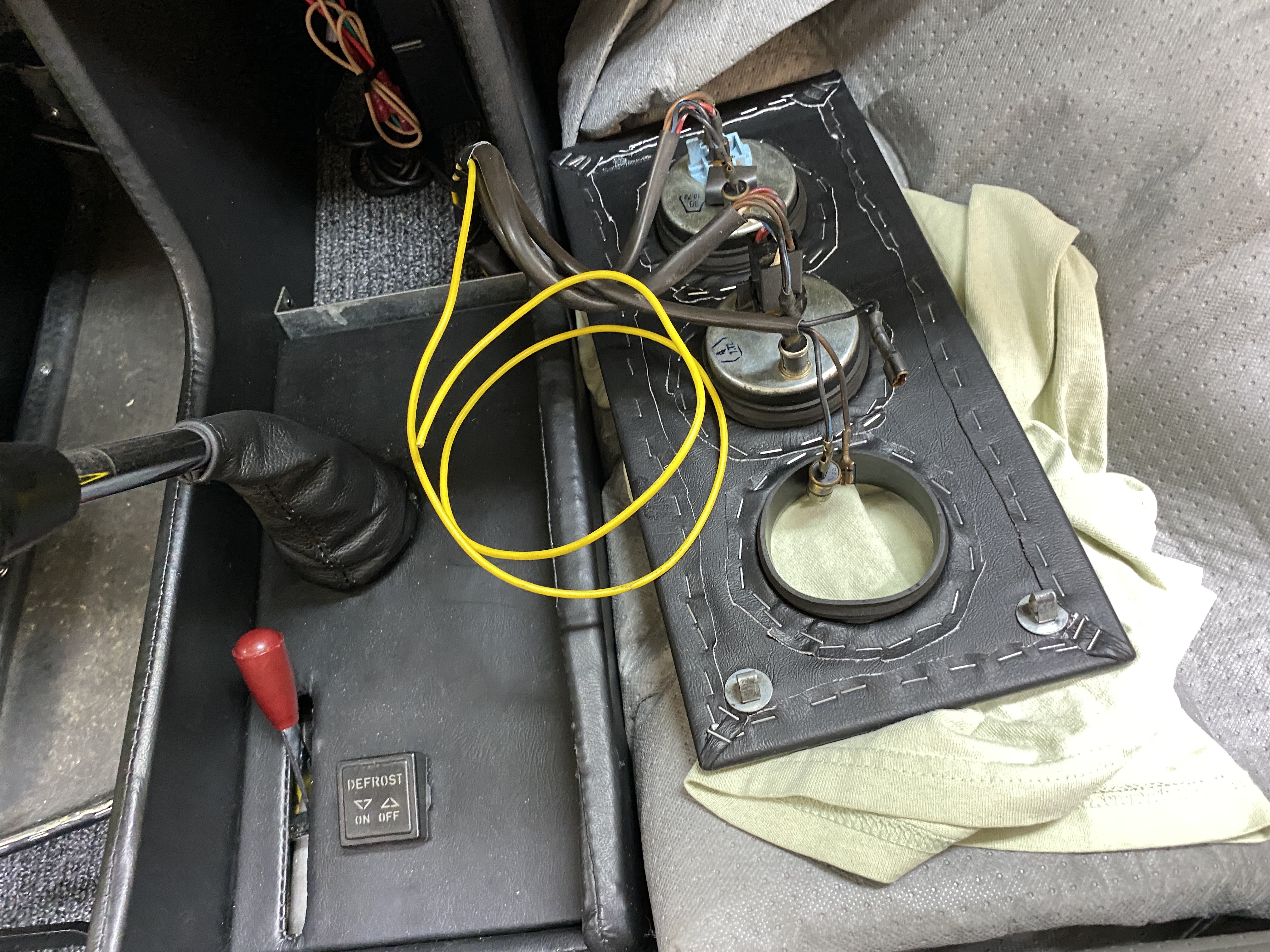

First of all, the gauge diameter is too small.
bkrantz
post Mar 9 2023, 08:42 PM
Post #6293
Posts: 8,746
Joined: 3-August 19
From: SW Colorado
Member No.: 23,343

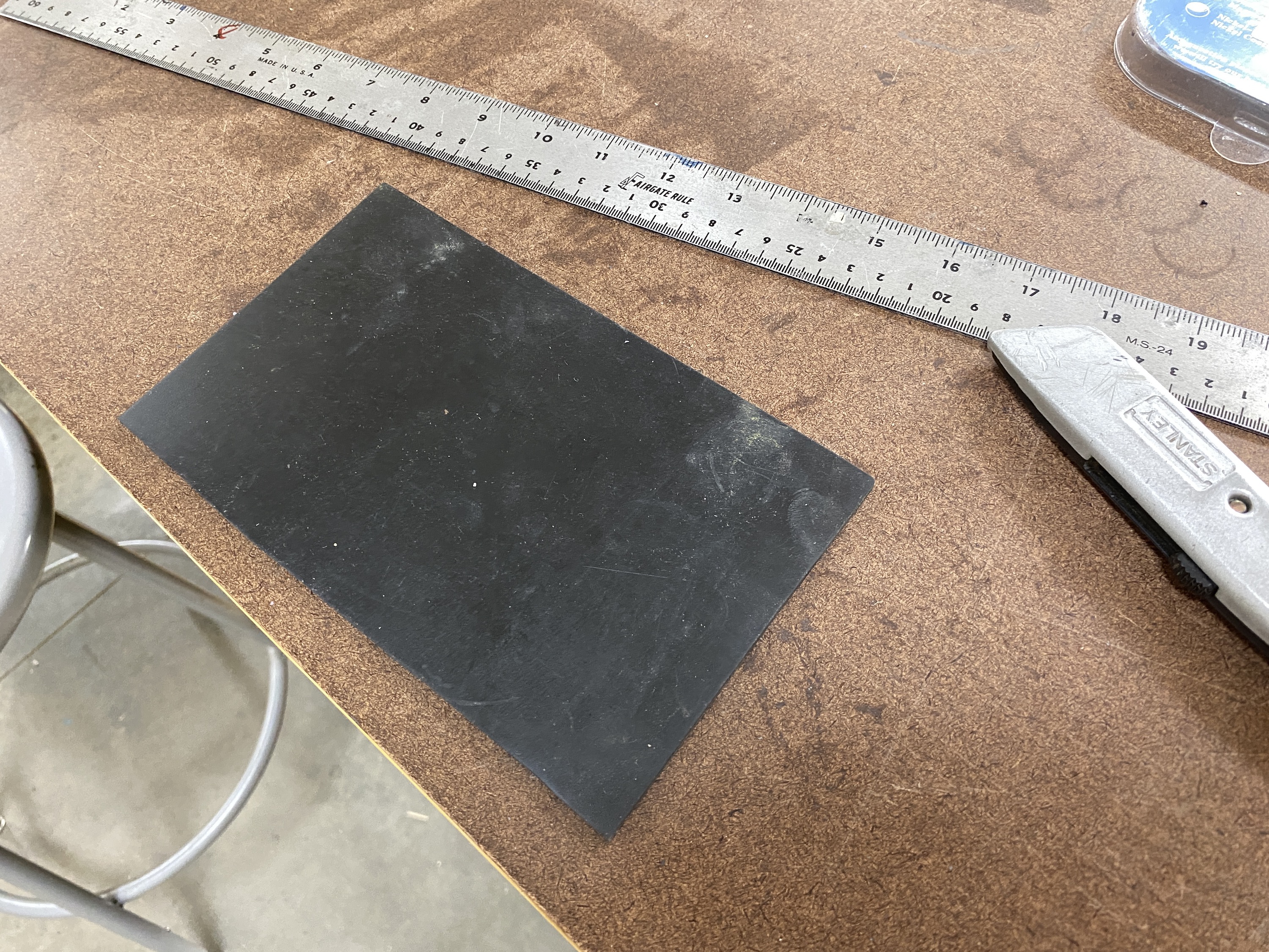

I have an idea: 1/8" thick rubber.
bkrantz
post Mar 9 2023, 08:43 PM
Post #6294
Posts: 8,746
Joined: 3-August 19
From: SW Colorado
Member No.: 23,343
Here's a 1/2" wide strip wrapped around the gauge.
bkrantz
post Mar 9 2023, 08:44 PM
Post #6295
Posts: 8,746
Joined: 3-August 19
From: SW Colorado
Member No.: 23,343
Now it's a snug fit, and looks pretty good.

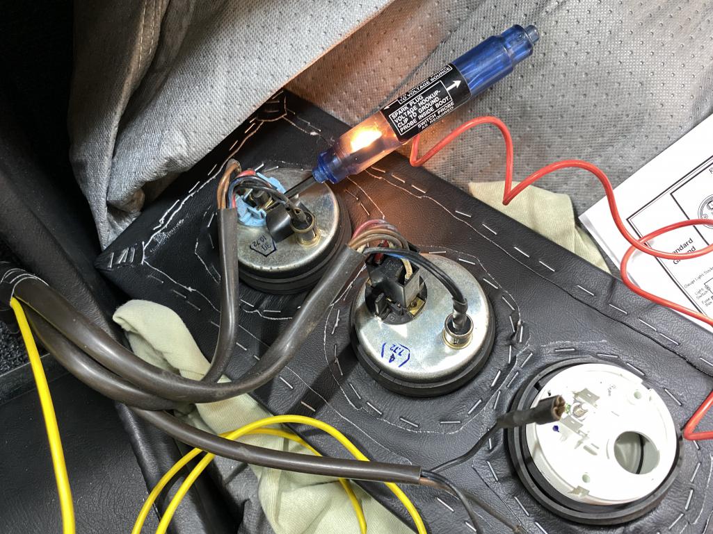

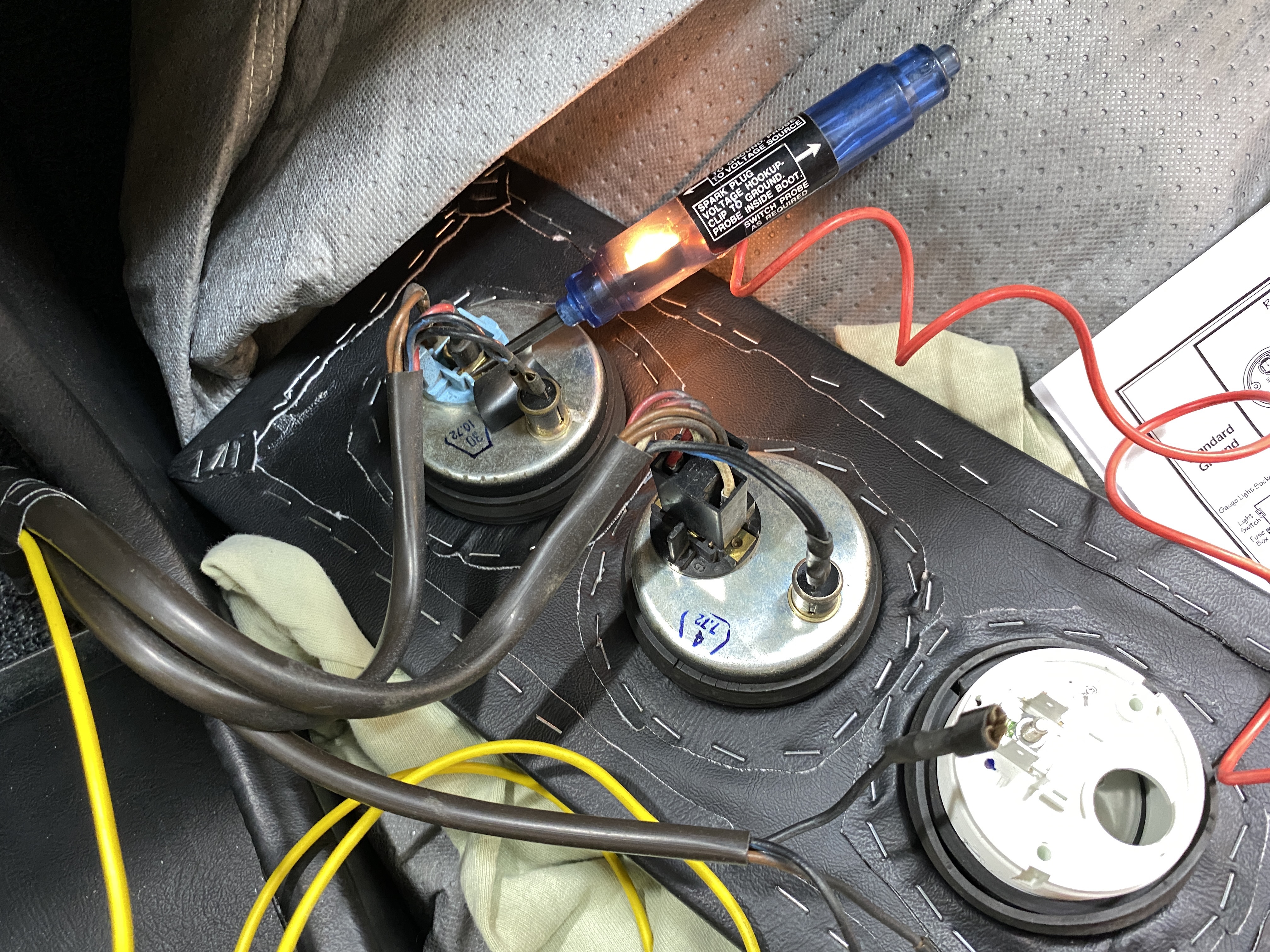

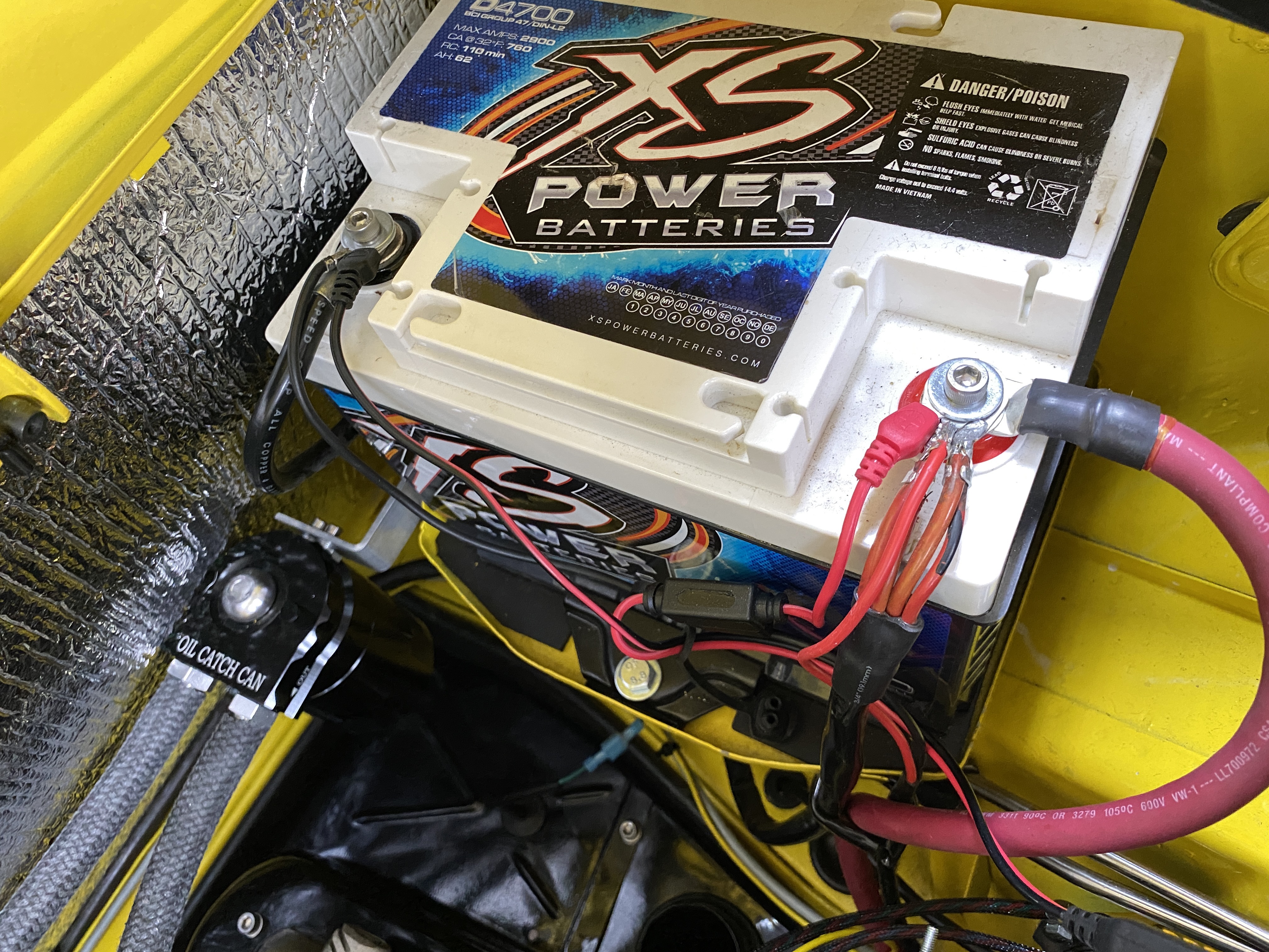

Time to sort out the wiring, so connect the battery for the first time since December.
That also let my cycle the fuel pump and check for leaks. Nothing obvious!
bkrantz
post Mar 9 2023, 08:51 PM
Post #6297
Posts: 8,746
Joined: 3-August 19
From: SW Colorado
Member No.: 23,343

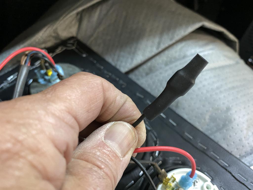

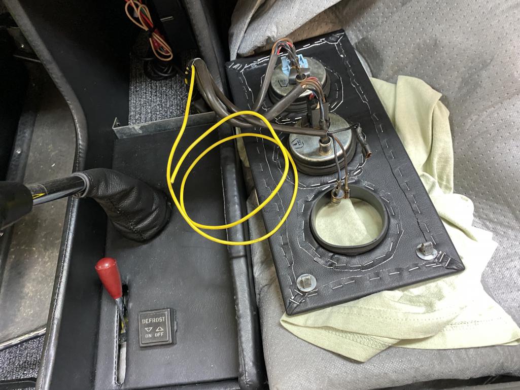

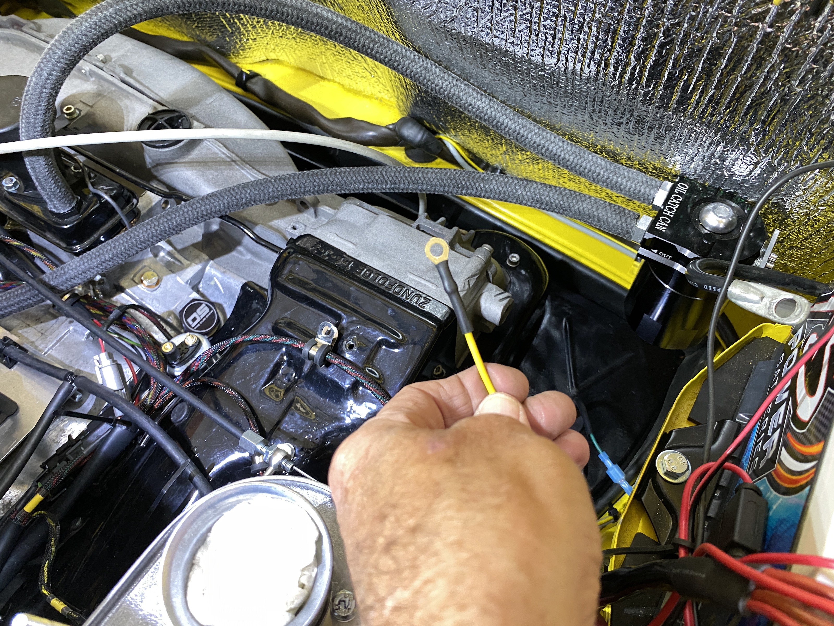

I need a switched positive lead. I deleted the clock, but can't use the lead for that since it is unswitched. Instead, I will take power from the volt meter.
bkrantz
post Mar 9 2023, 08:52 PM
Post #6298
Posts: 8,746
Joined: 3-August 19
From: SW Colorado
Member No.: 23,343

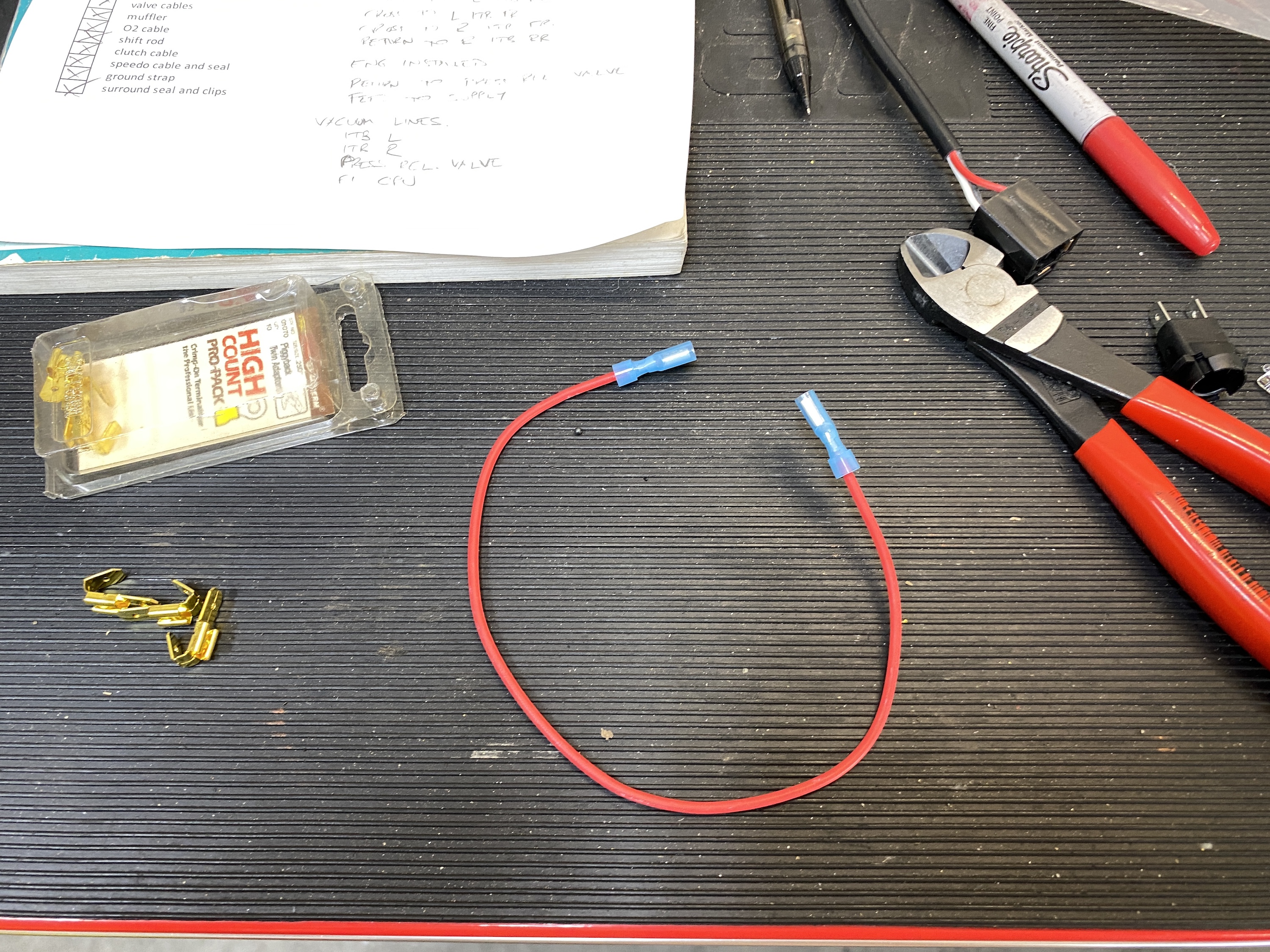

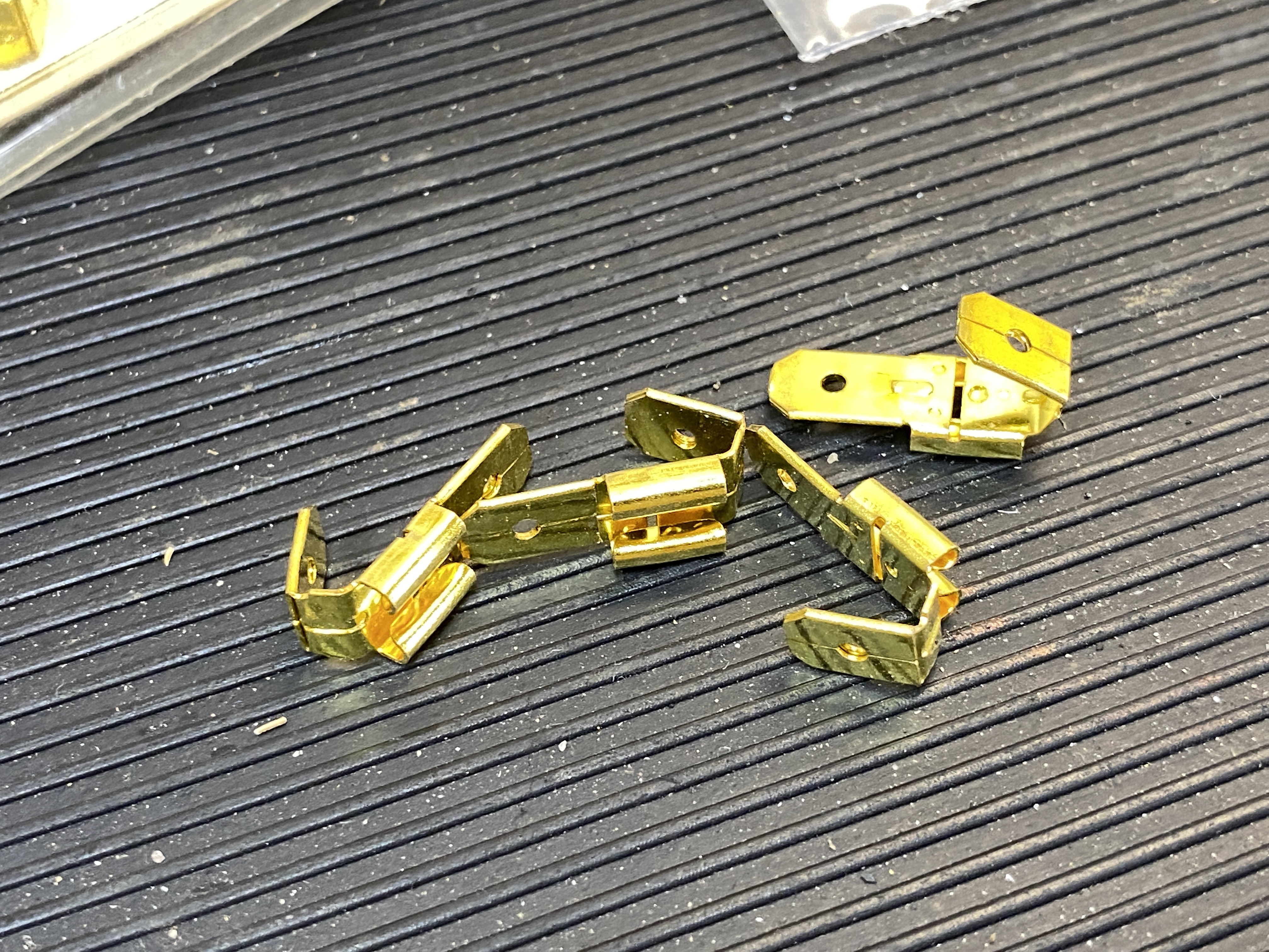

That means time for a twin spade adapter.
bkrantz
post Mar 9 2023, 08:53 PM
Post #6299
Posts: 8,746
Joined: 3-August 19
From: SW Colorado
Member No.: 23,343
And a jumper lead.
bkrantz
Post #6300
Posts: 8,746
Joined: 3-August 19
From: SW Colorado
Member No.: 23,343
And isolating the power lead for the clock.
