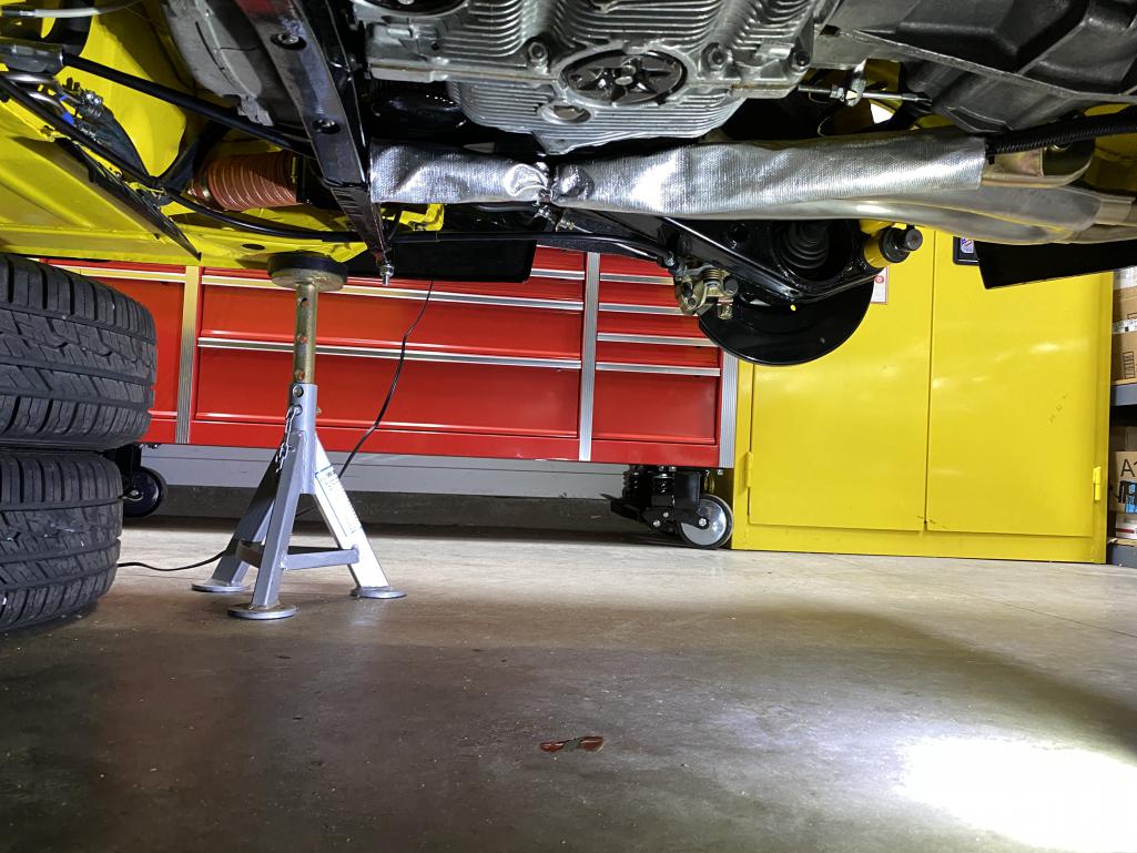

And losing progress. It looks like the oil strainer cover plate is leaking. (IMG:style_emoticons/default/headbang.gif)

I always use new paper gaskets and permatex sealant at this connection

That's what I did. My best guess is that one of the gaskets did not seat properly.
I will have to drain and toss the new oil fill. I guess 4 quarts is cheap to make sure I get this leak stopped.

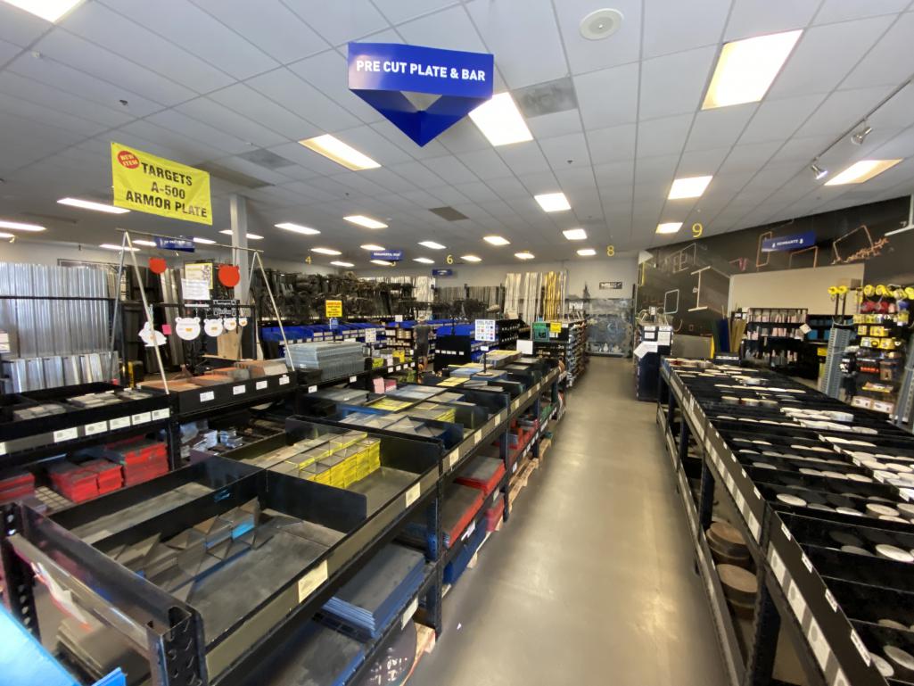

Another trip to Tucson, and another stop at my favorite (metal) store, Industrial Metal Supply. All kinds of steel and aluminum, including amazing cut-off scrap plate and bar sold by the pound. A true candy store for some of us.
ogdougy
post Mar 18 2023, 10:25 PM
Post #6369
Posts: 49
Joined: 9-May 22
From: Arizona
Member No.: 26,536
Hey, thats my second home. So many sheets of metal and trips to the scrap bin there.

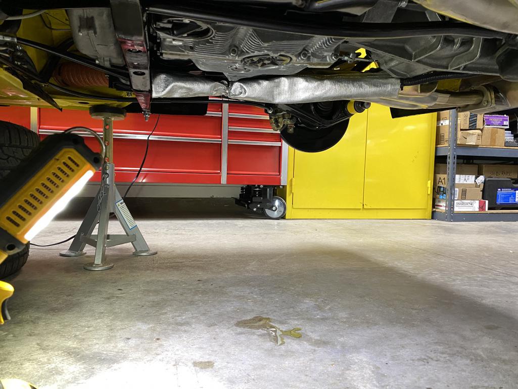

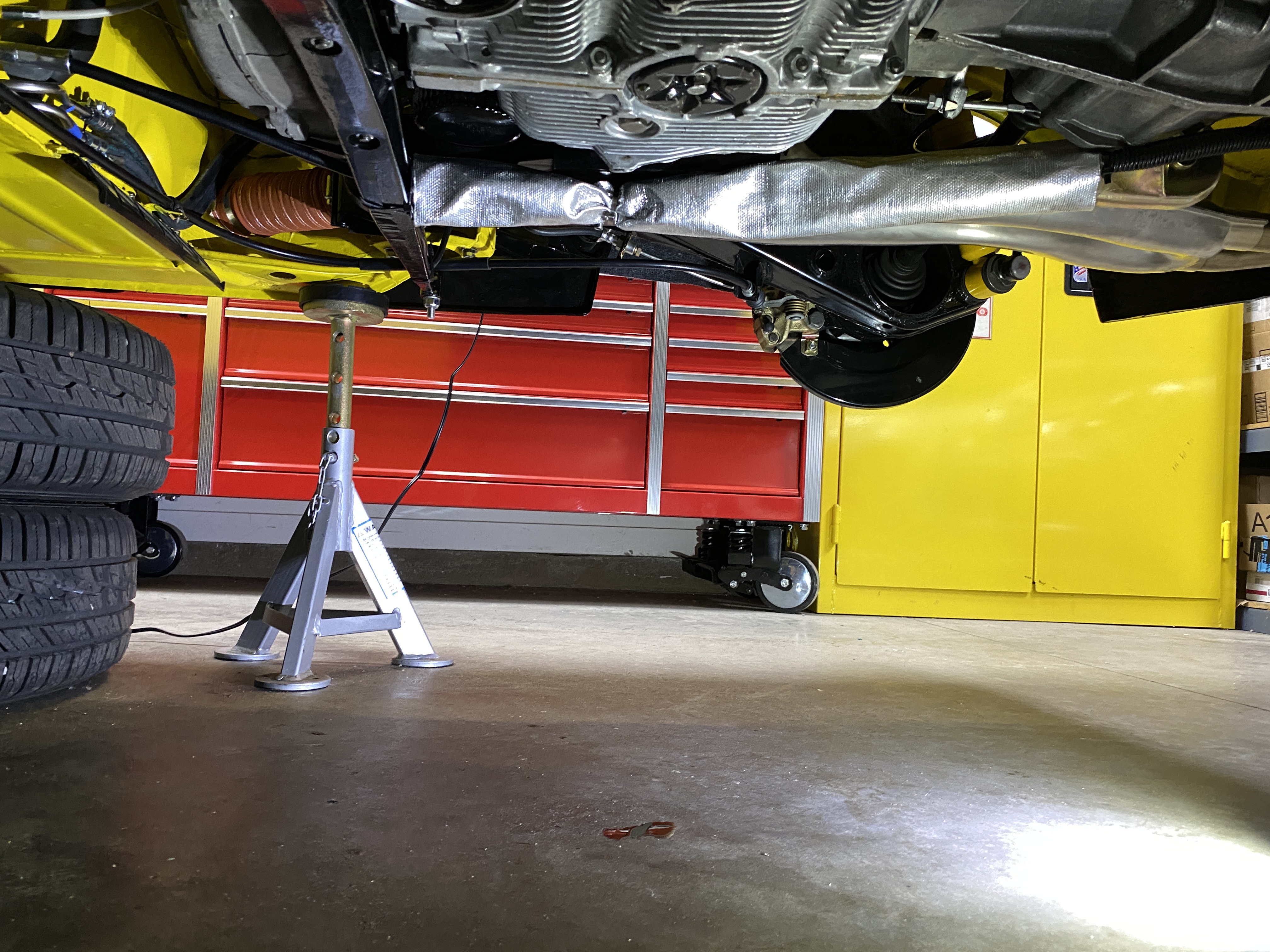

Home again, and the strainer cover continued to leak while I was gone.
bkrantz
post Mar 27 2023, 07:17 PM
Post #6371
Posts: 8,746
Joined: 3-August 19
From: SW Colorado
Member No.: 23,343

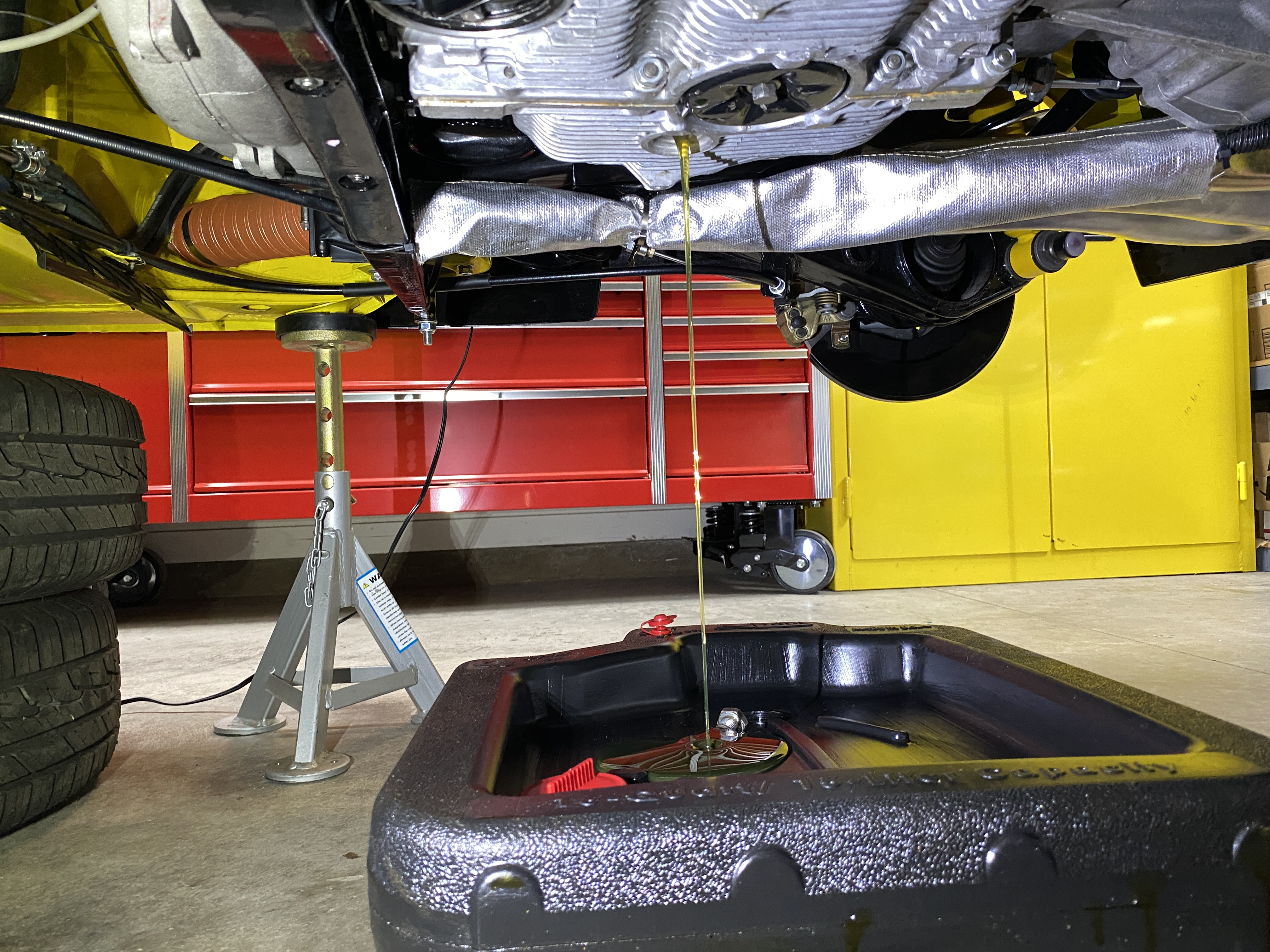

There goes 4 new quarts of Valvoline race oil.
And then I could not find my bag of spare gaskets, so have to order some for the strainer cover. Best I could tell, the leak was from the center retaining nut.

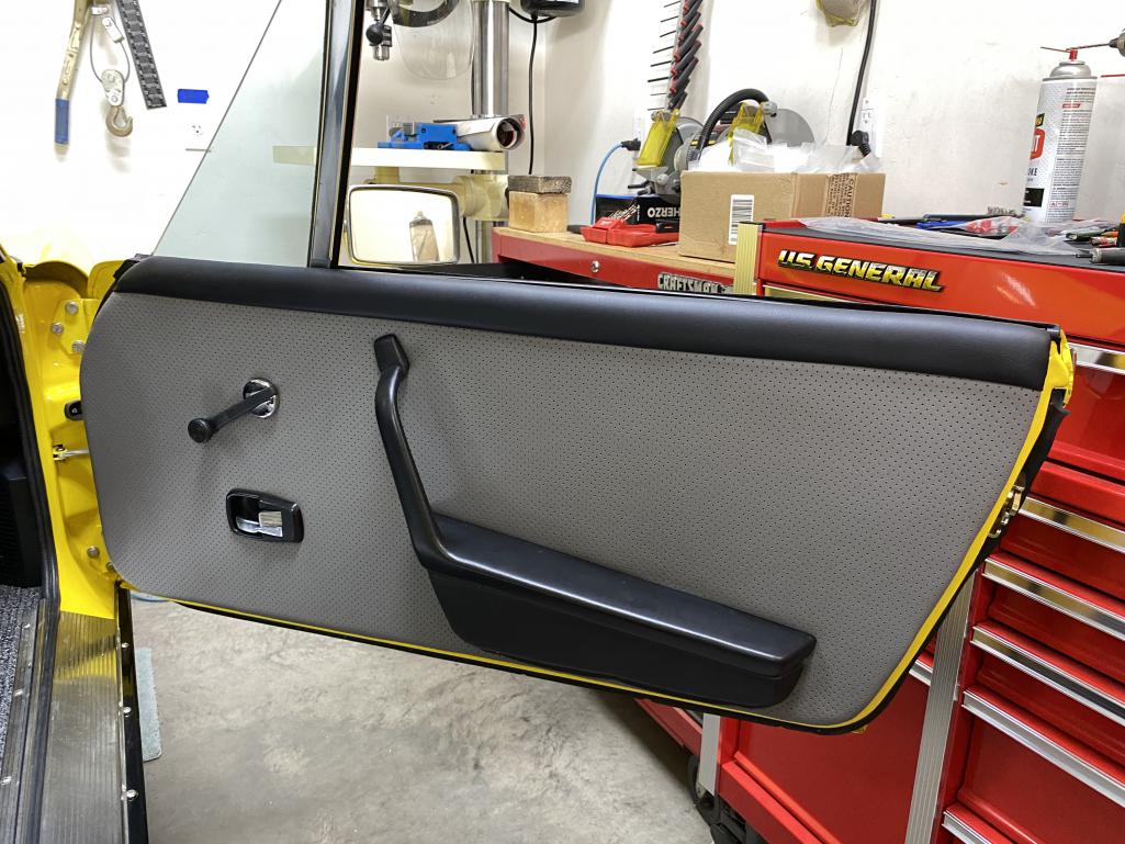

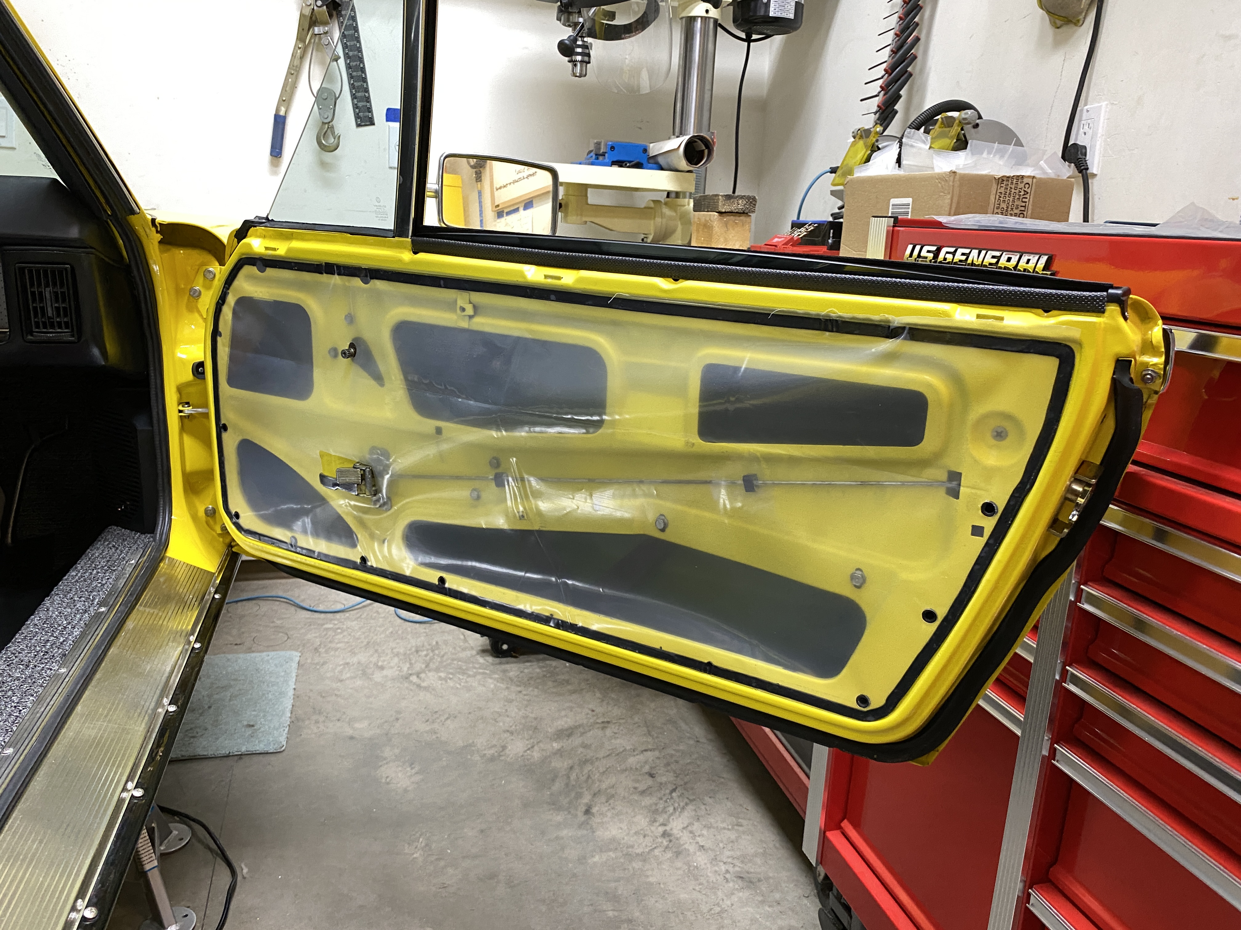

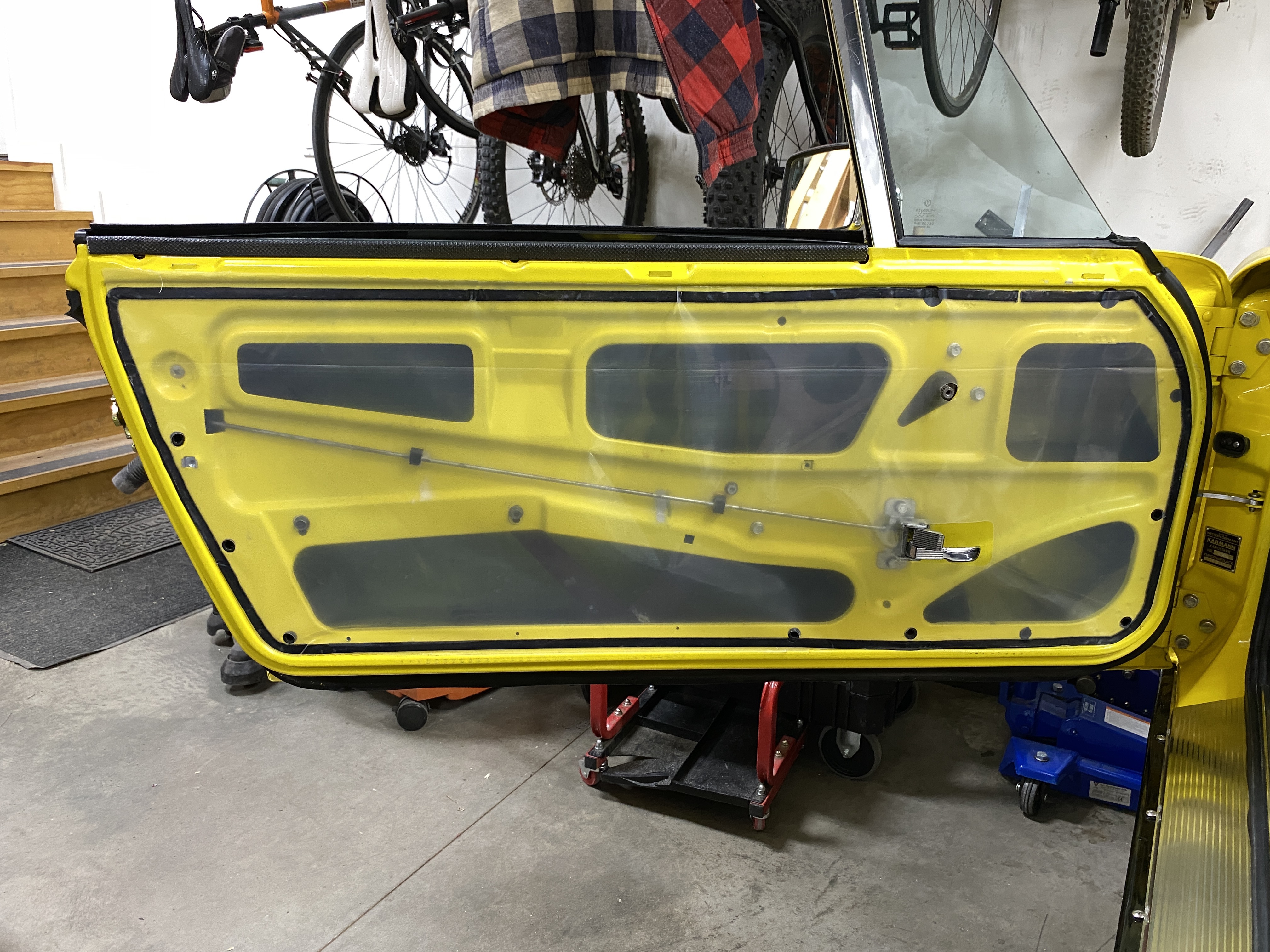

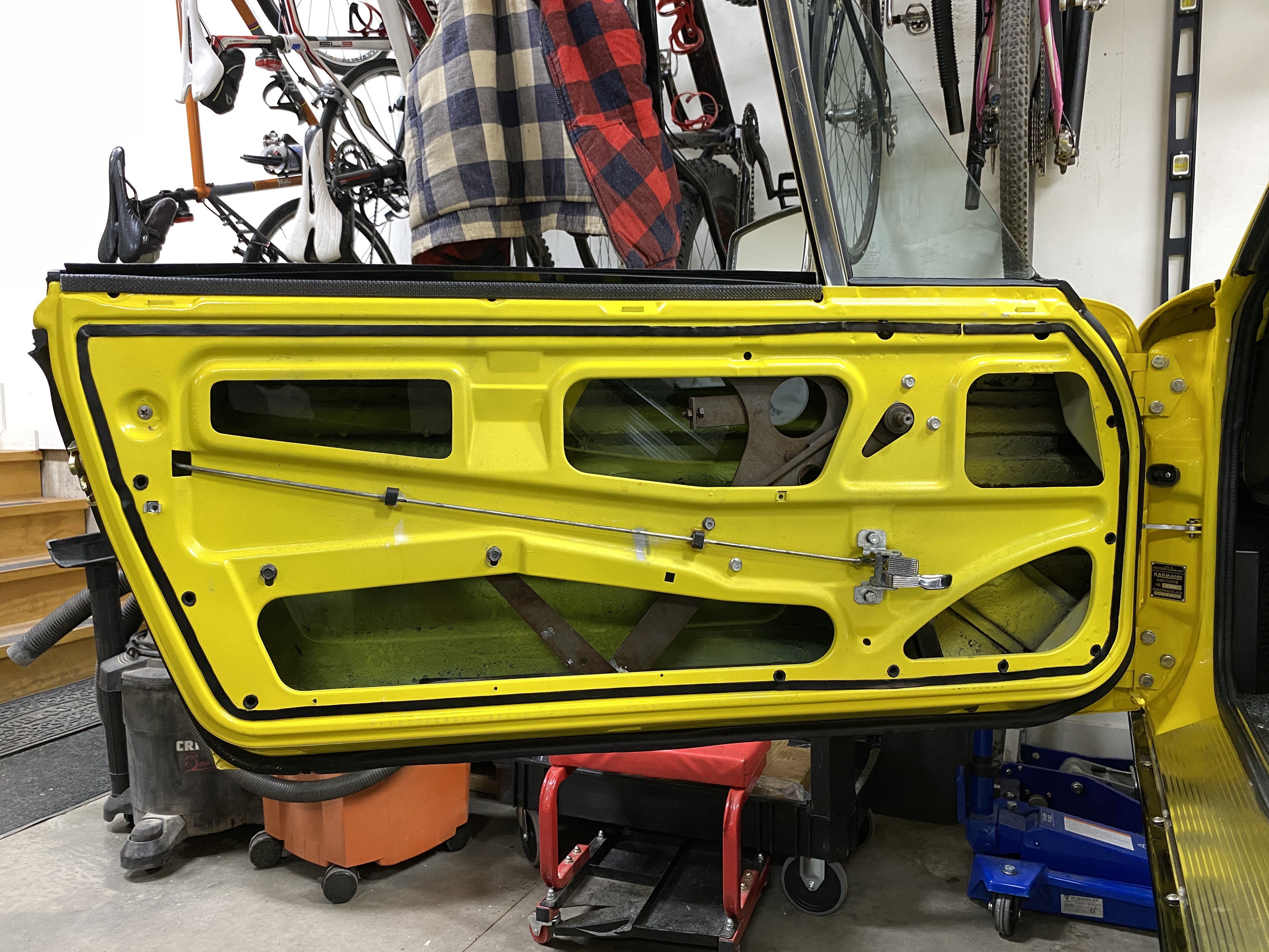

While waiting for new gaskets, I got back to the interior. Earlier, I removed and replaced the internal door latch mechanisms, and also rebuilt the door stays. I got another liner kit from 914 Rubber.
bkrantz
post Mar 29 2023, 07:32 PM
Post #6373
Posts: 8,746
Joined: 3-August 19
From: SW Colorado
Member No.: 23,343
Starting on the left door, with adhesive strip attached all around.

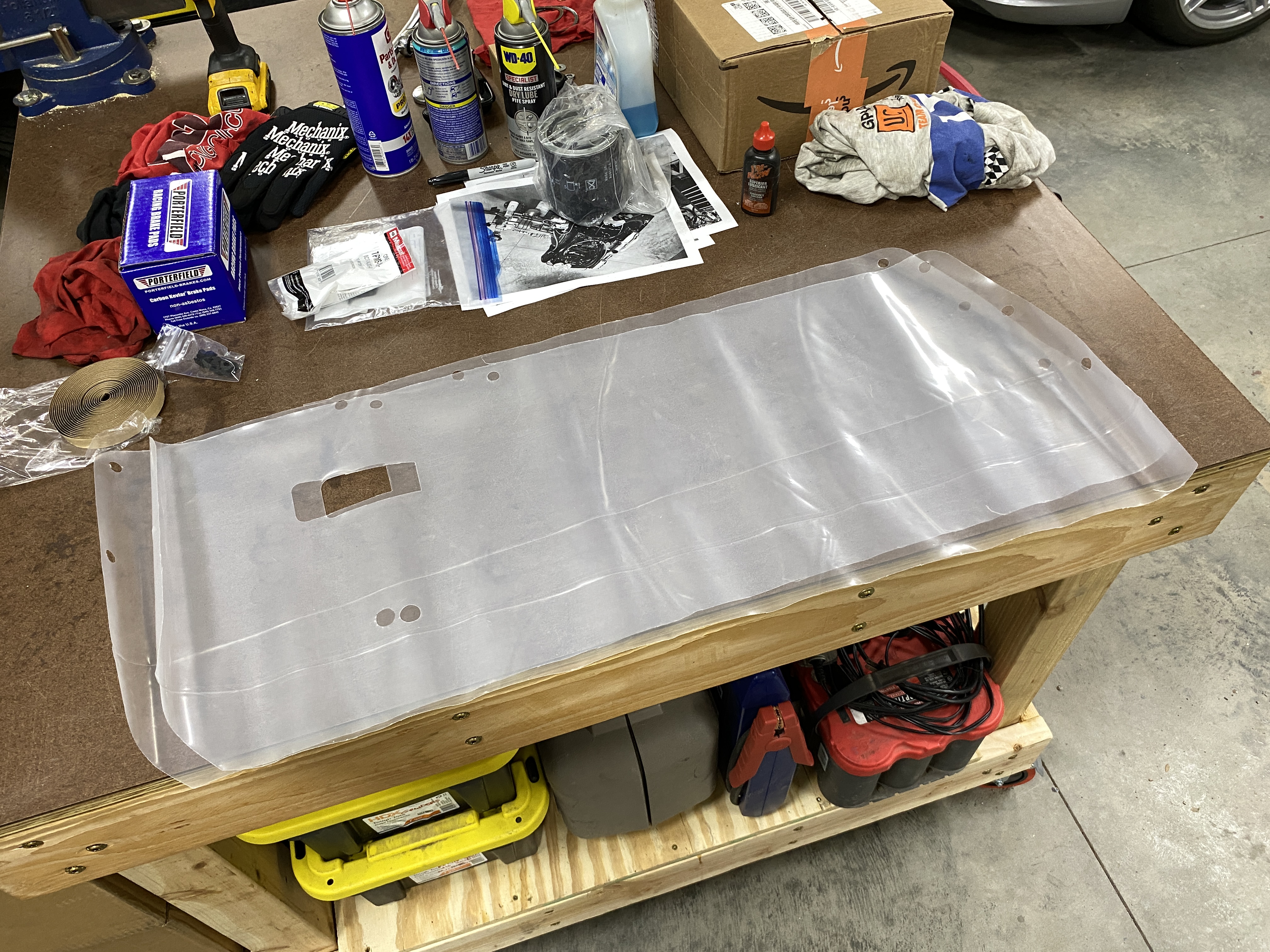

bkrantz
post Mar 29 2023, 07:34 PM
Post #6374
Posts: 8,746
Joined: 3-August 19
From: SW Colorado
Member No.: 23,343
Plus the plastic liner. Note that with extreme adhesion of the butyl strip, this is essentially permanent--or at least not reusable.
bkrantz
post Mar 29 2023, 07:35 PM
Post #6375
Posts: 8,746
Joined: 3-August 19
From: SW Colorado
Member No.: 23,343

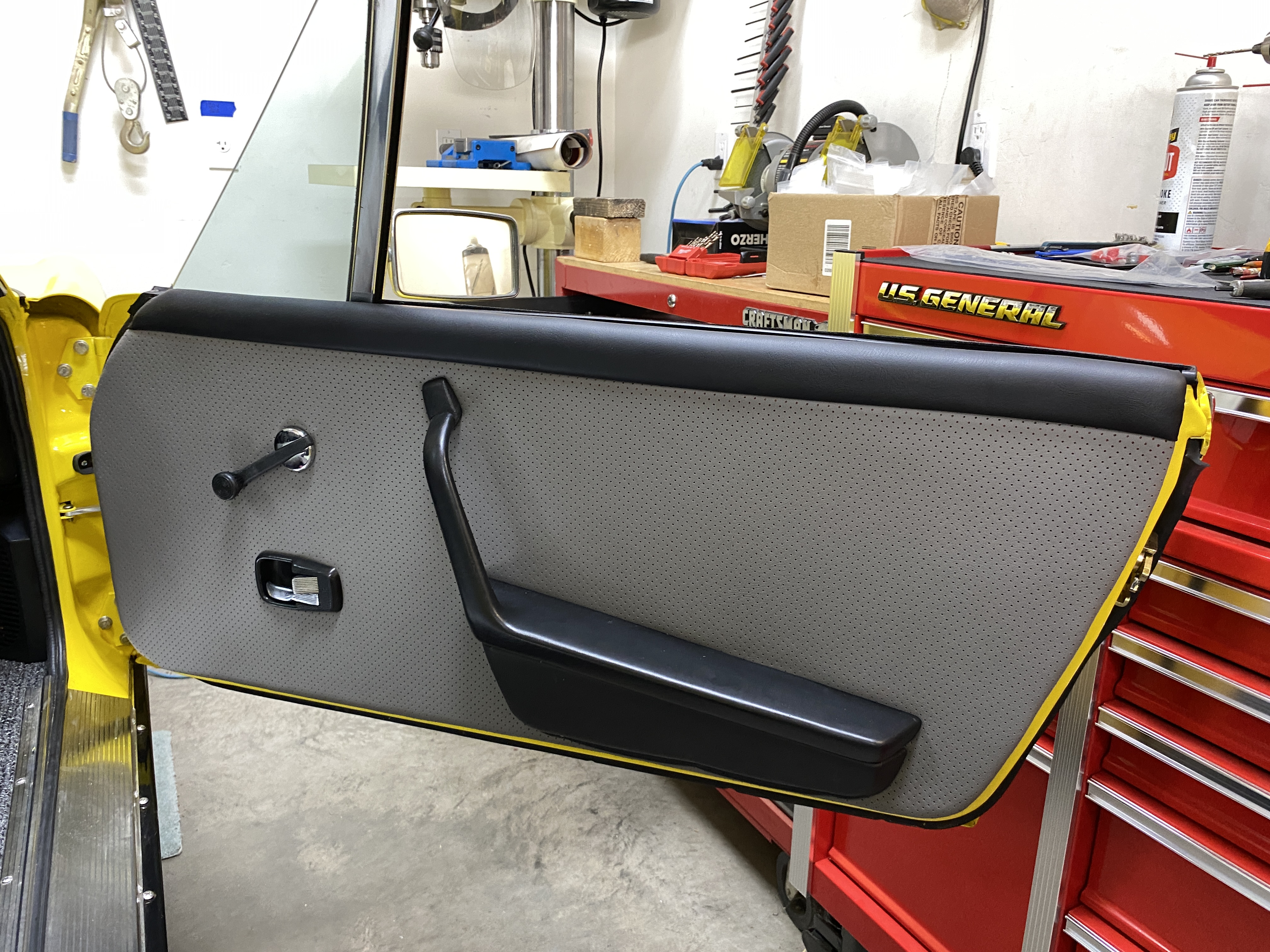

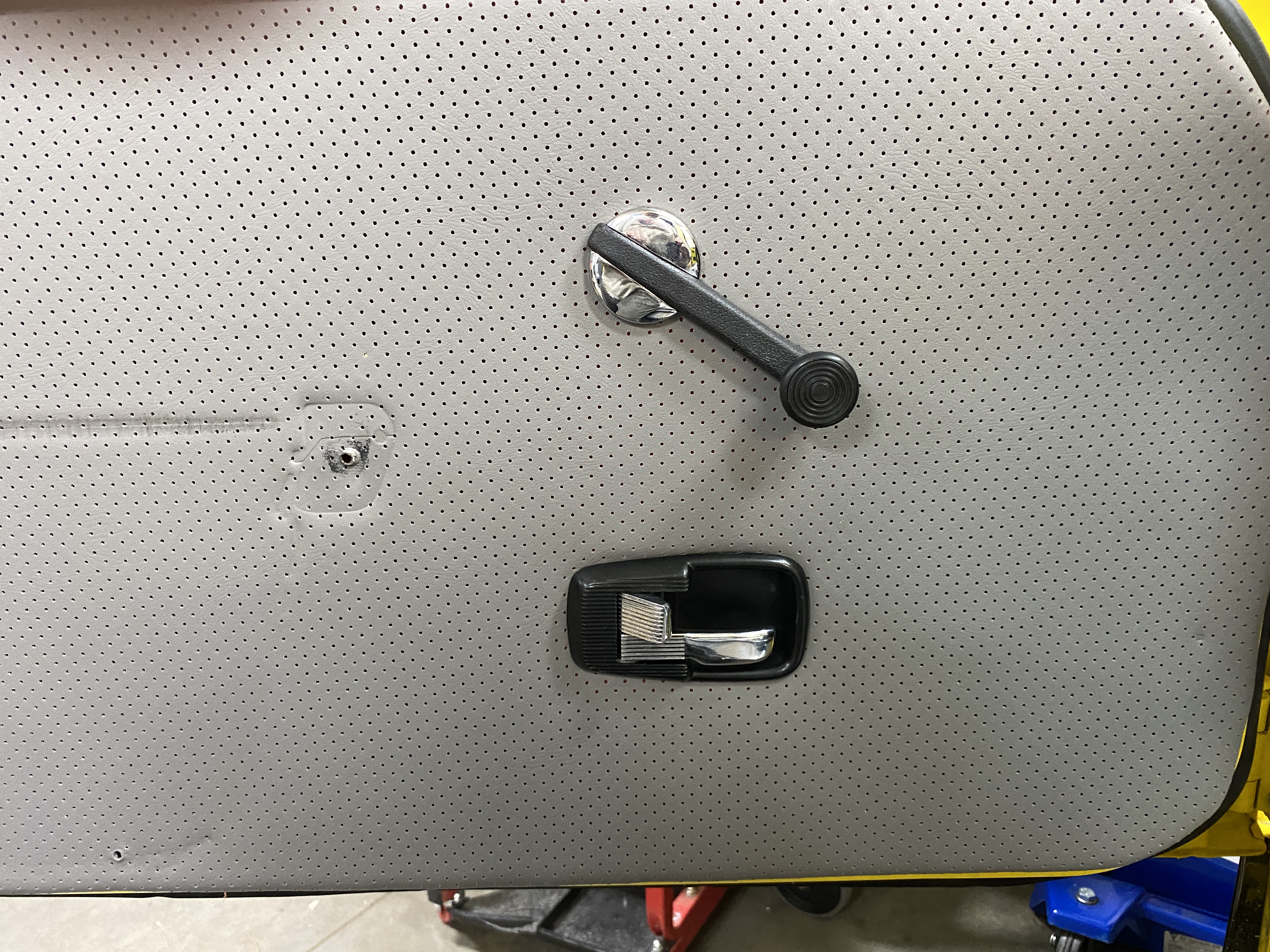

Door card on, plus the winder and the latch surround.
bkrantz
post Mar 29 2023, 07:38 PM
Post #6376
Posts: 8,746
Joined: 3-August 19
From: SW Colorado
Member No.: 23,343

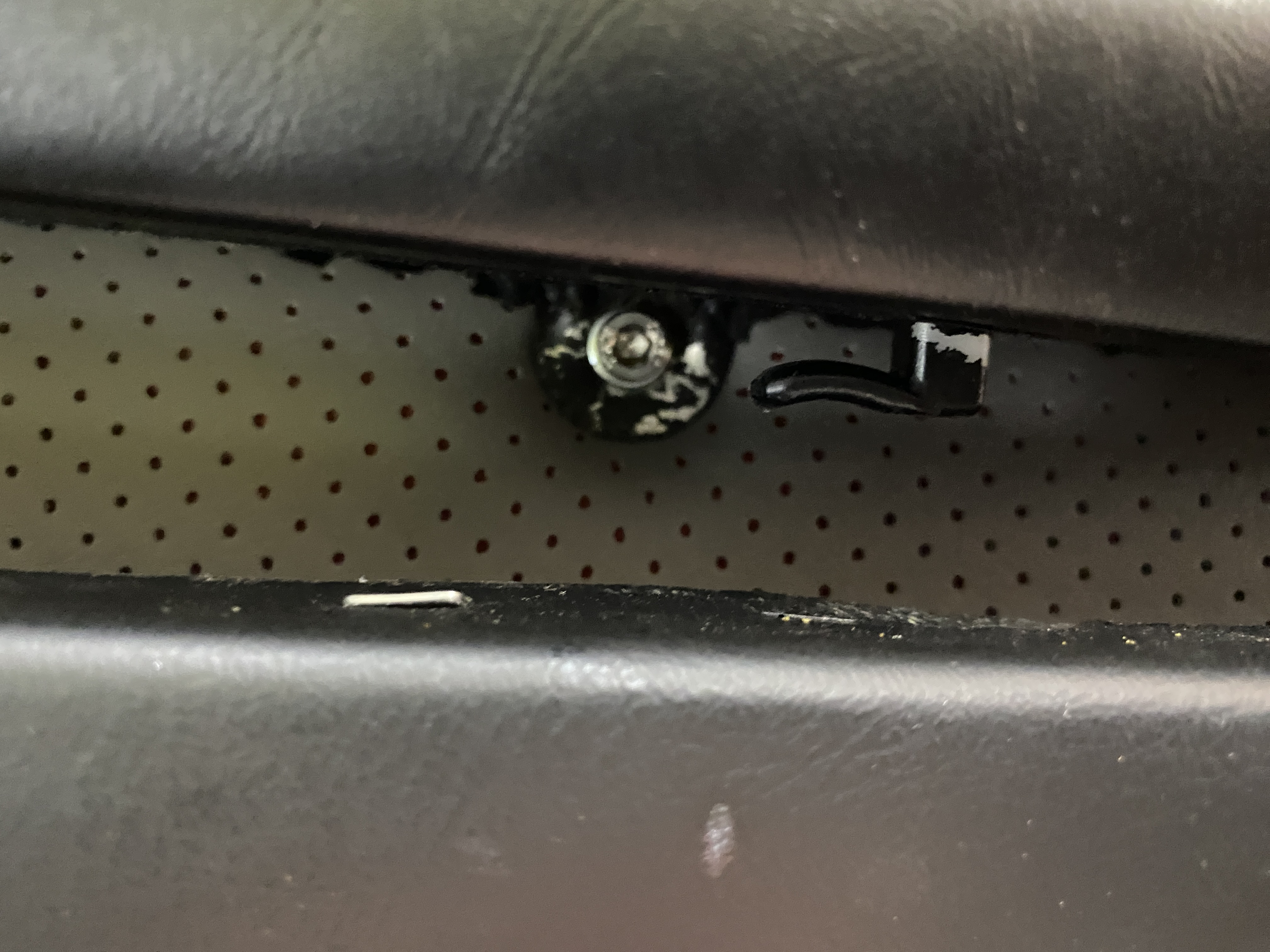

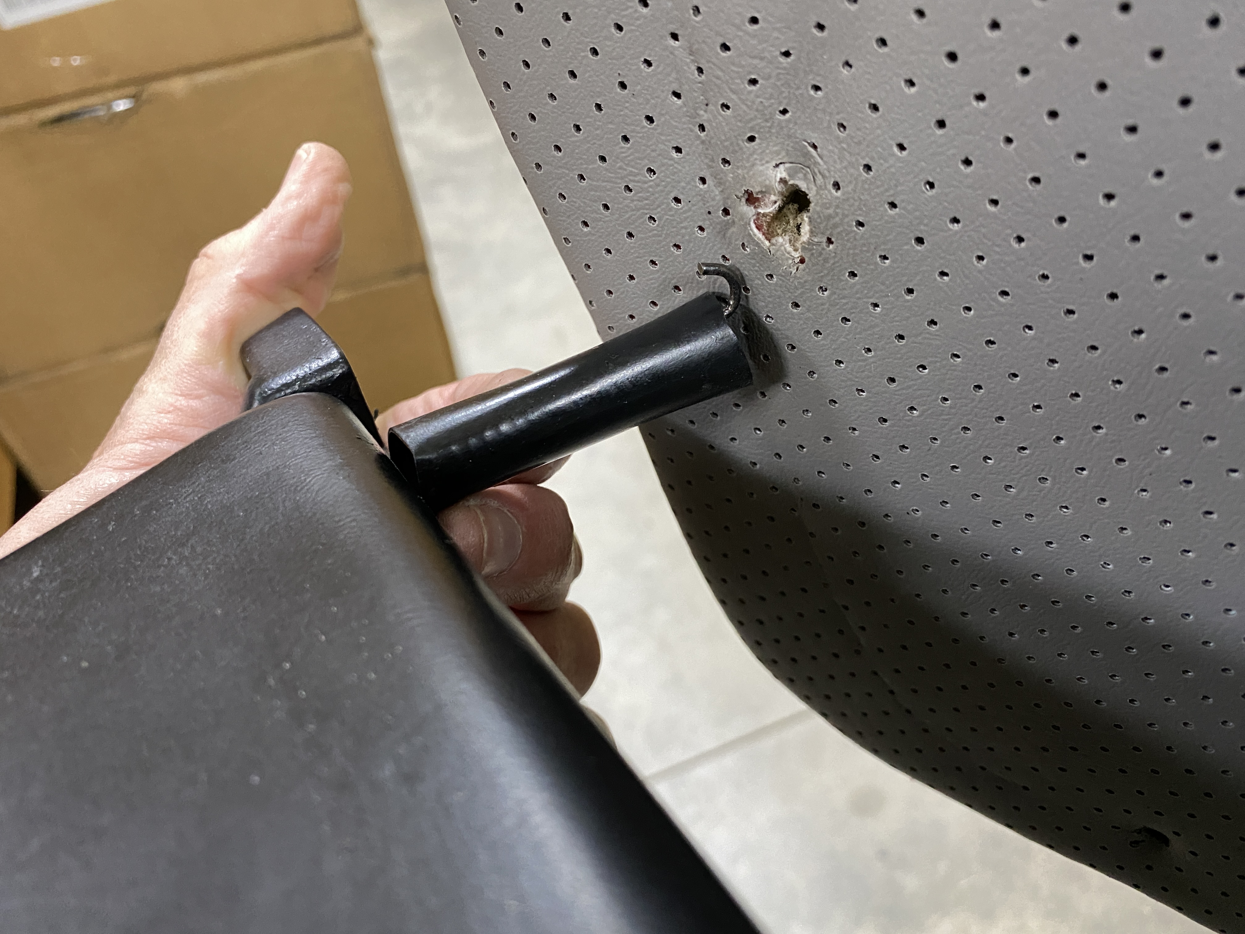

Then my least favorite part: the retaining spring for the cover of the armrest bin. Last year this took me 20 minutes. This time, I got it on the first try.
bkrantz
post Mar 29 2023, 07:39 PM
Post #6377
Posts: 8,746
Joined: 3-August 19
From: SW Colorado
Member No.: 23,343
All done.
bkrantz
post Mar 29 2023, 07:40 PM
Post #6378
Posts: 8,746
Joined: 3-August 19
From: SW Colorado
Member No.: 23,343

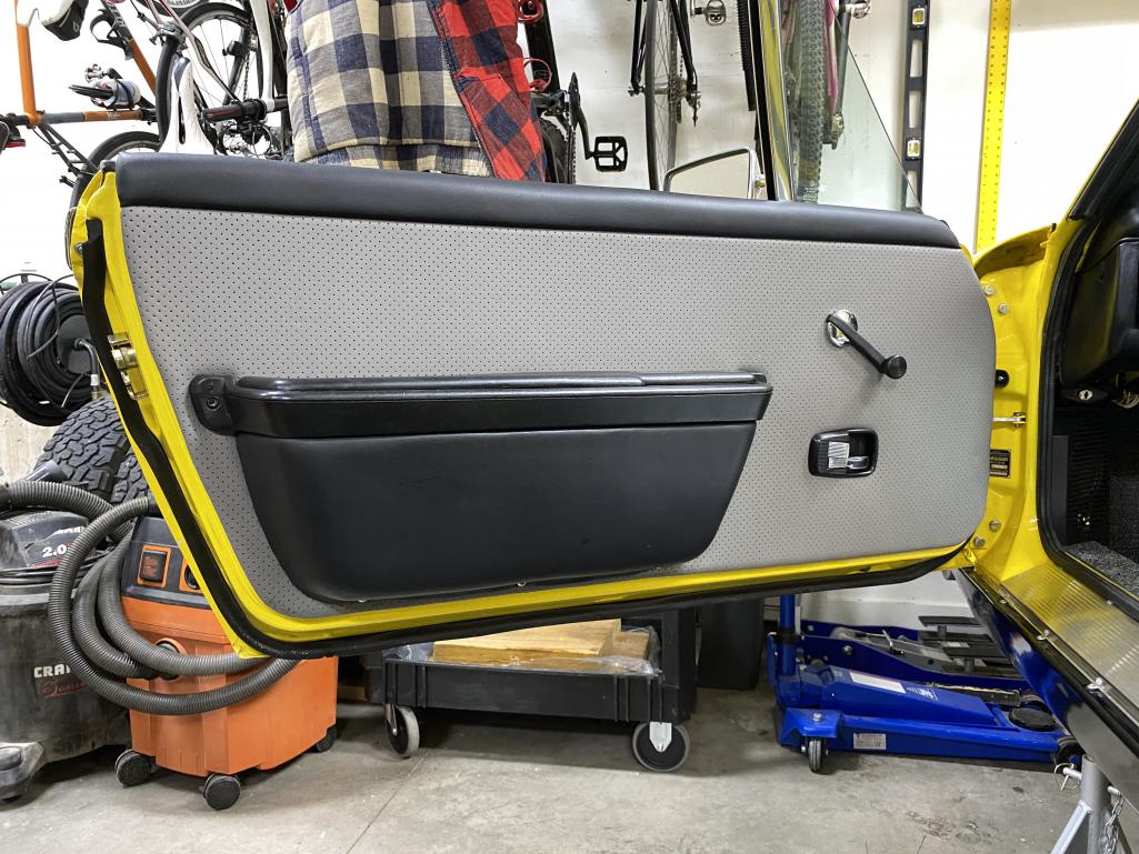

Then I did the right door, with basically the same procedure.
bkrantz
post Mar 29 2023, 07:41 PM
Post #6379
Posts: 8,746
Joined: 3-August 19
From: SW Colorado
Member No.: 23,343
The difference is the lower part of the armrest. To install, this slides rearward onto these L-shaped fittings on the bottom of the armrest.
bkrantz
post Mar 29 2023, 07:42 PM
Post #6380
Posts: 8,746
Joined: 3-August 19
From: SW Colorado
Member No.: 23,343
Done here, too.
