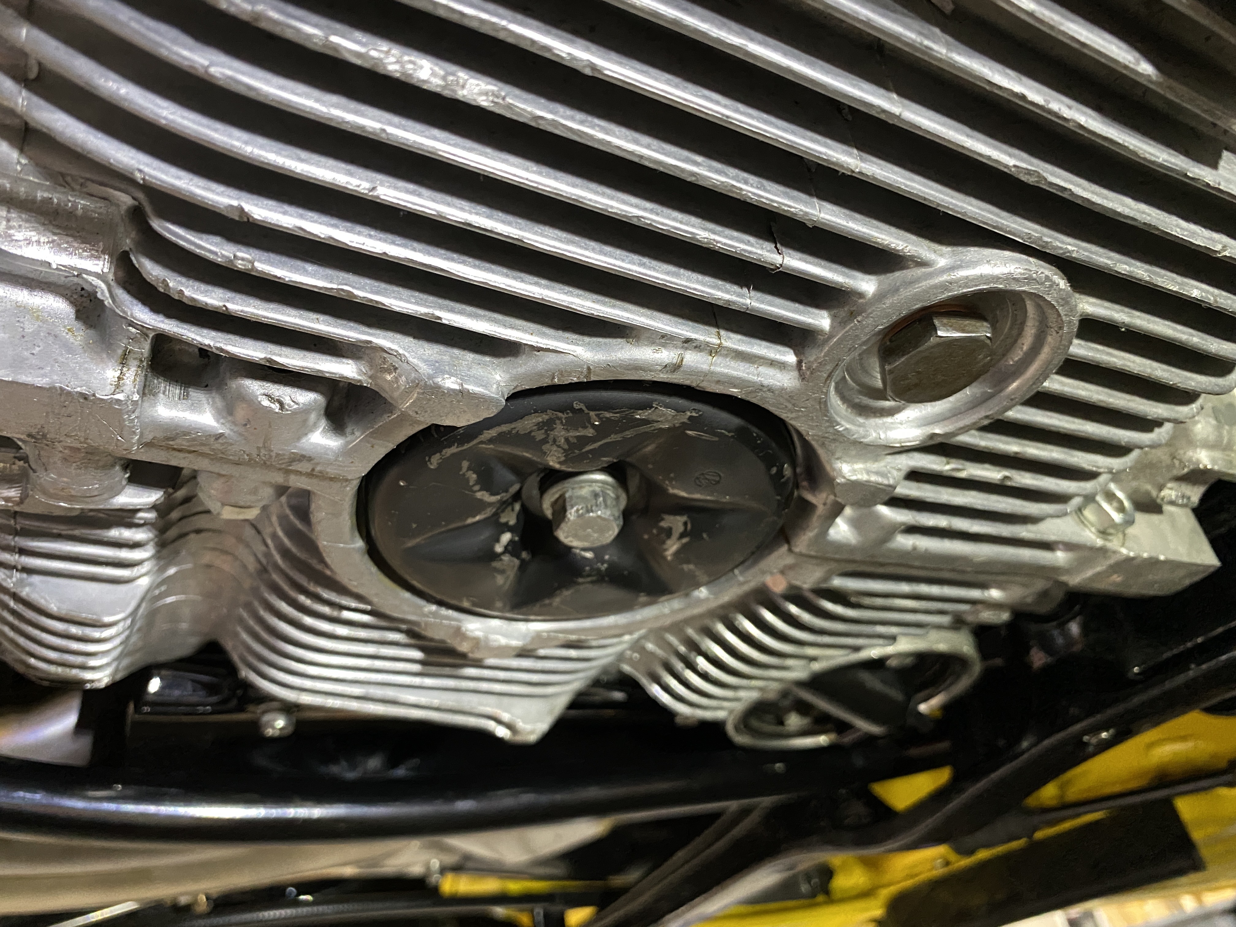

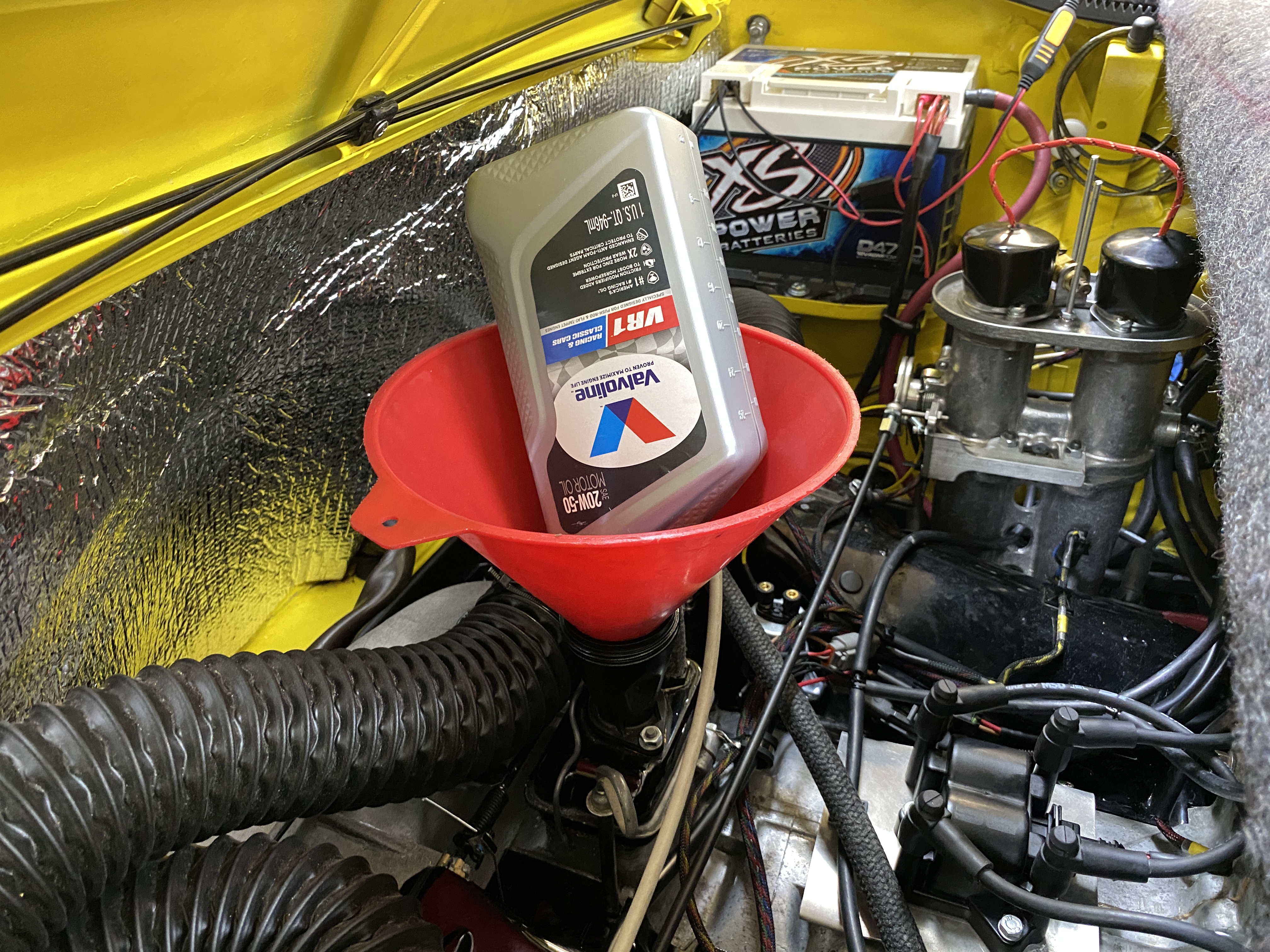

Before tempting fate too much, I poured in one quart. Watching the floor--no drips (yet).

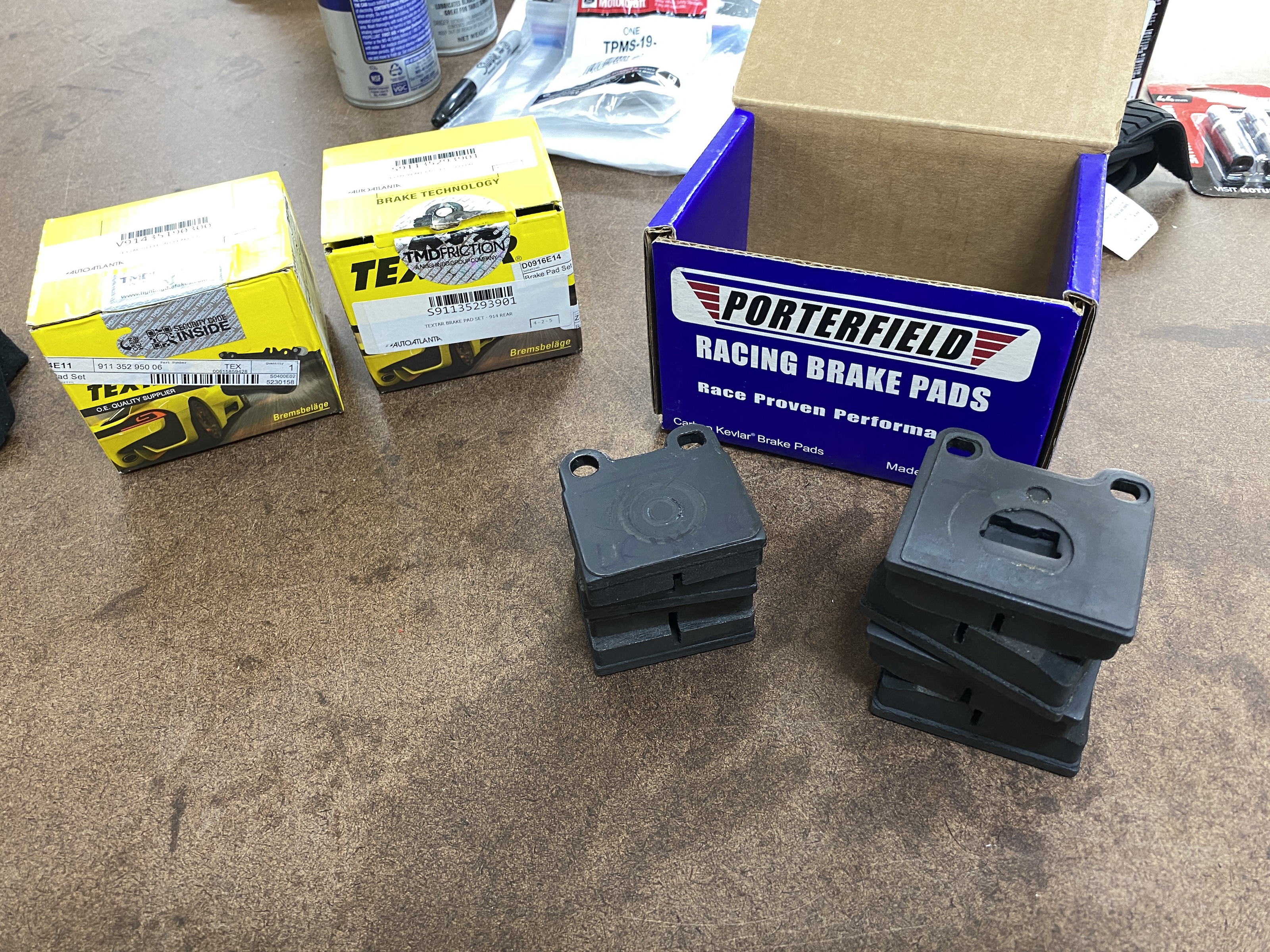

My next task is dealing with brakes. First step: remove the Textar pads and go back to Porterfields. Originally, I could get the front brakes to lock but not with Textar.

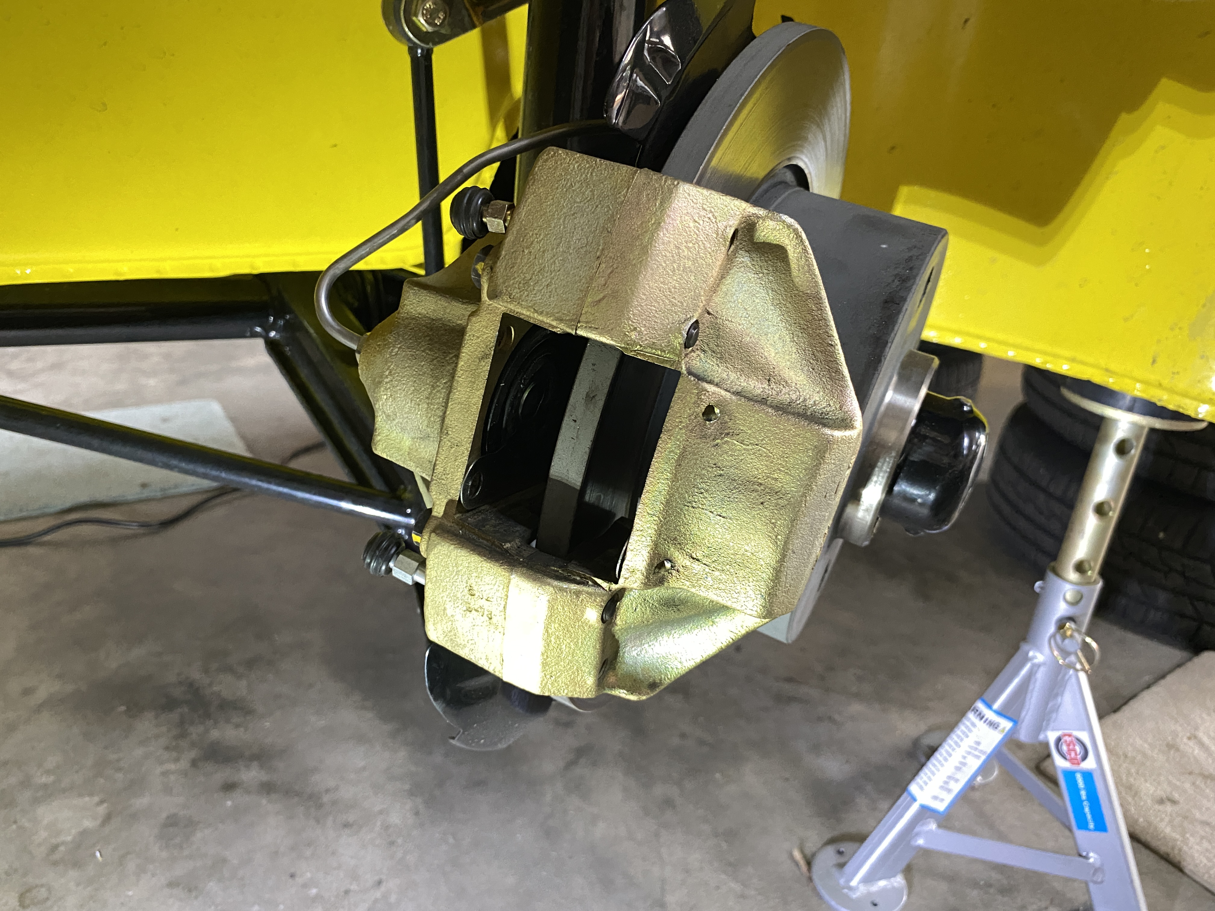

Starting in the front, Textar pads removed.
bkrantz
post Apr 12 2023, 07:38 PM
Post #6404
Posts: 8,746
Joined: 3-August 19
From: SW Colorado
Member No.: 23,343

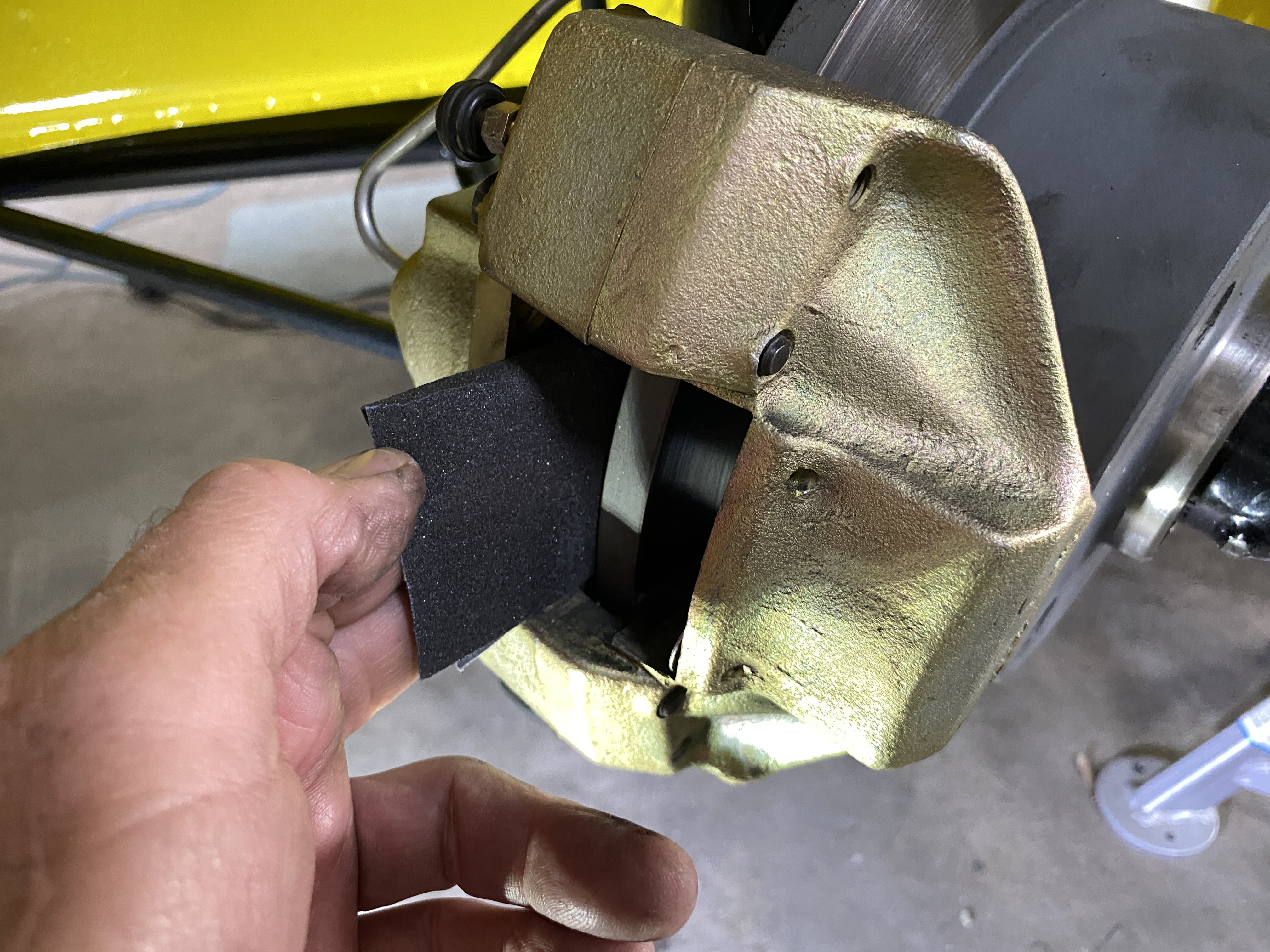

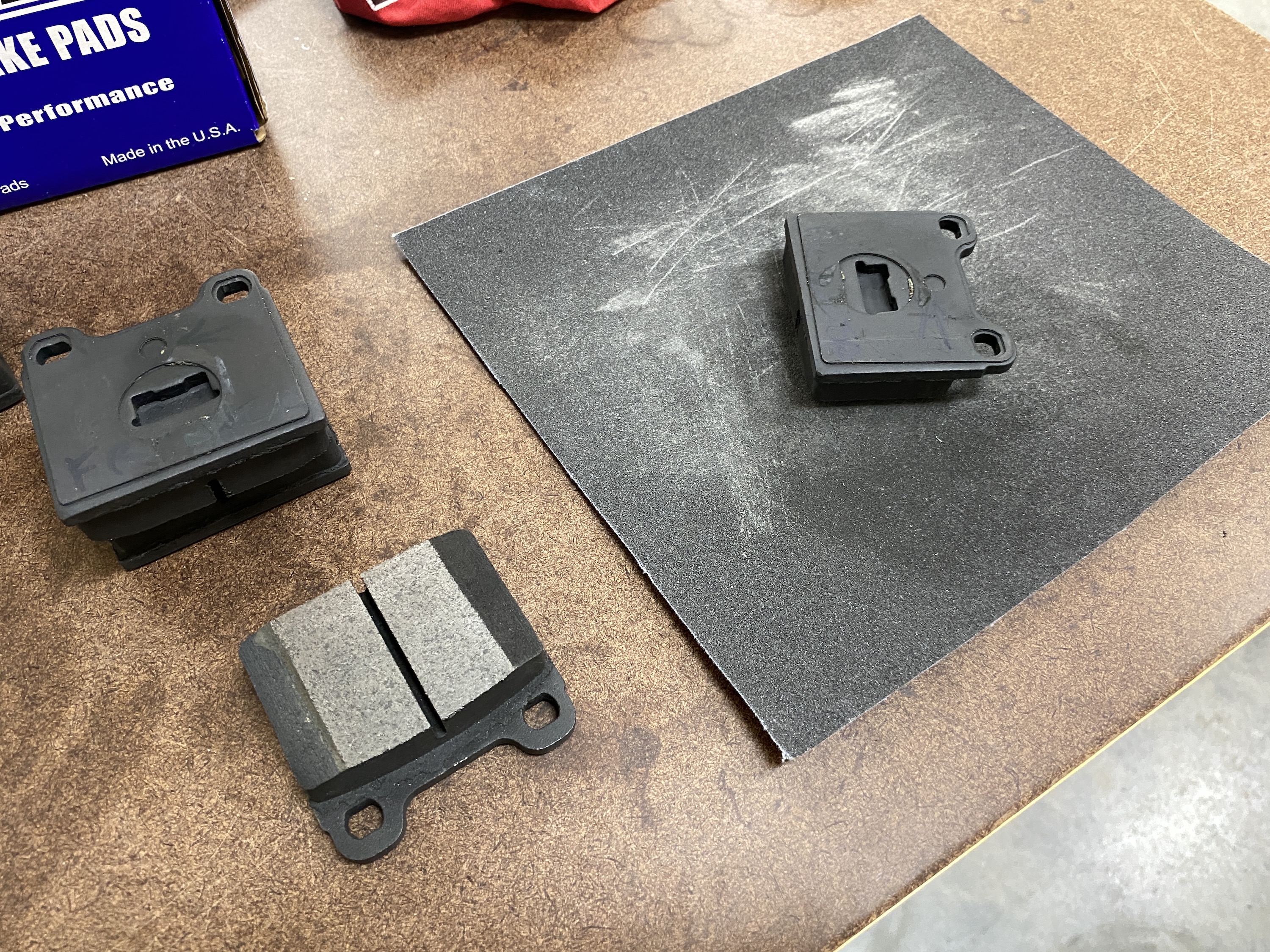

I lightly scuffed the disk with some medium emery paper.
bkrantz
Post #6405
Posts: 8,746
Joined: 3-August 19
From: SW Colorado
Member No.: 23,343
And did the same with the pads.

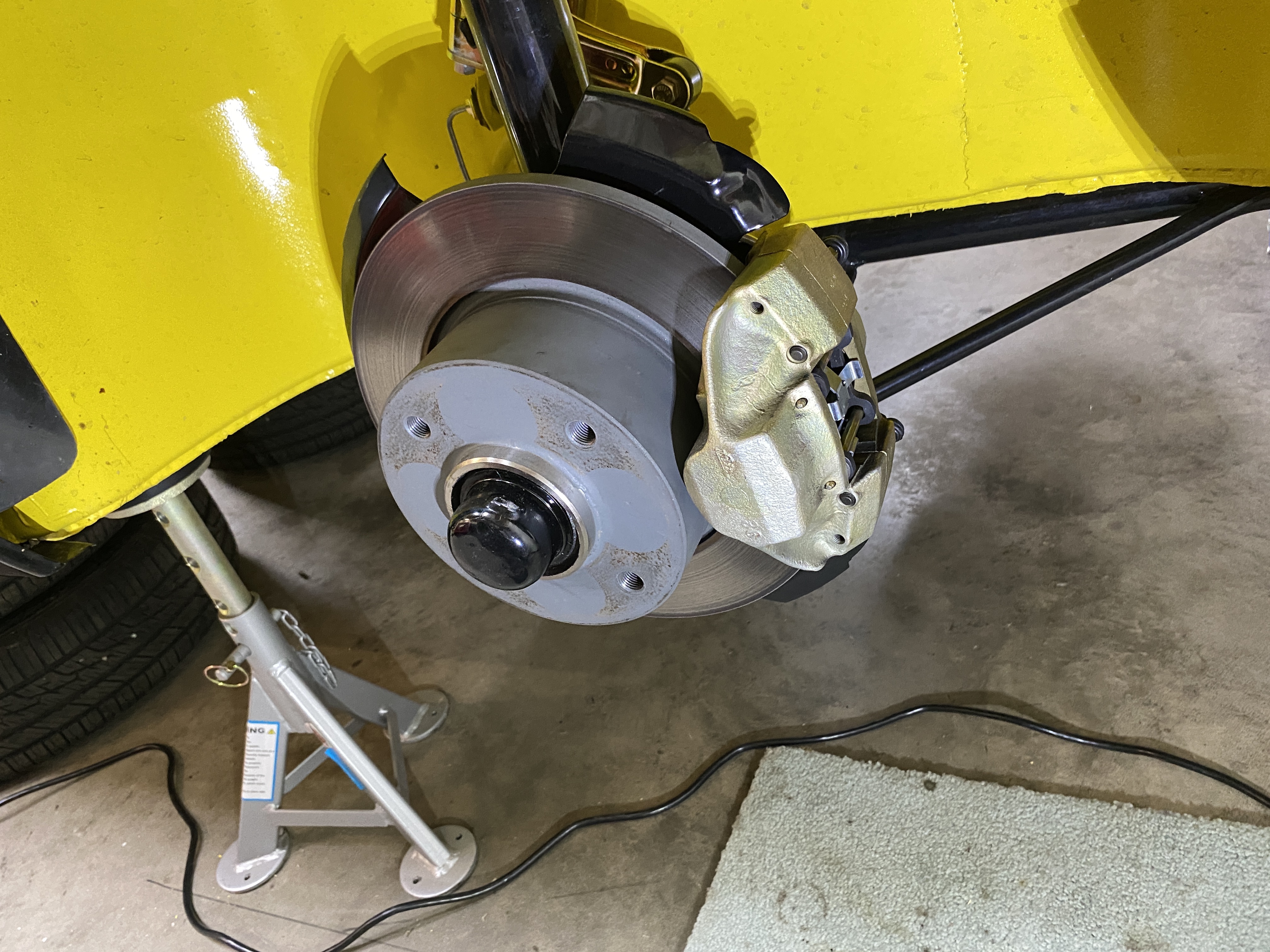

Left front done.

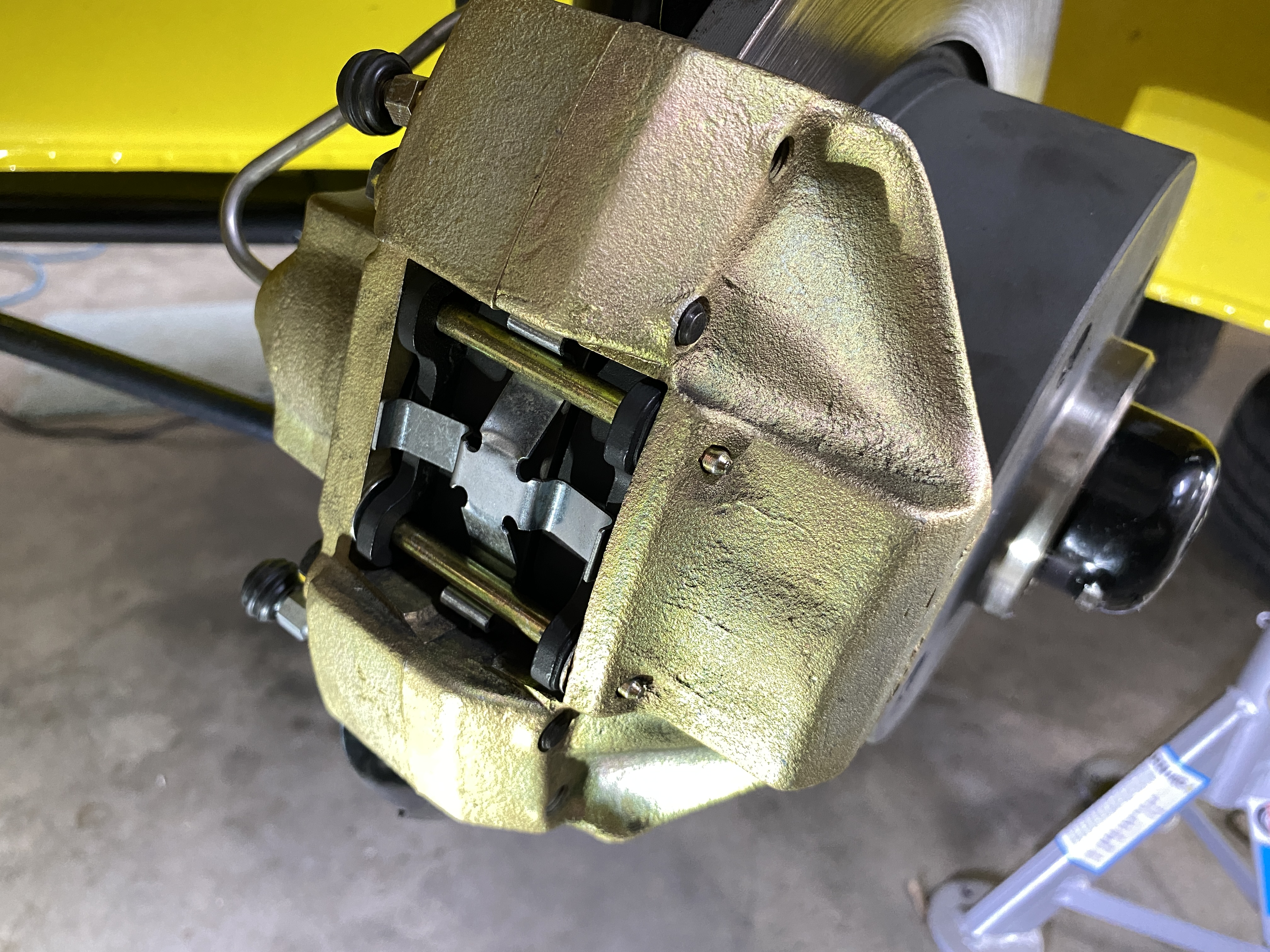

And the right front.

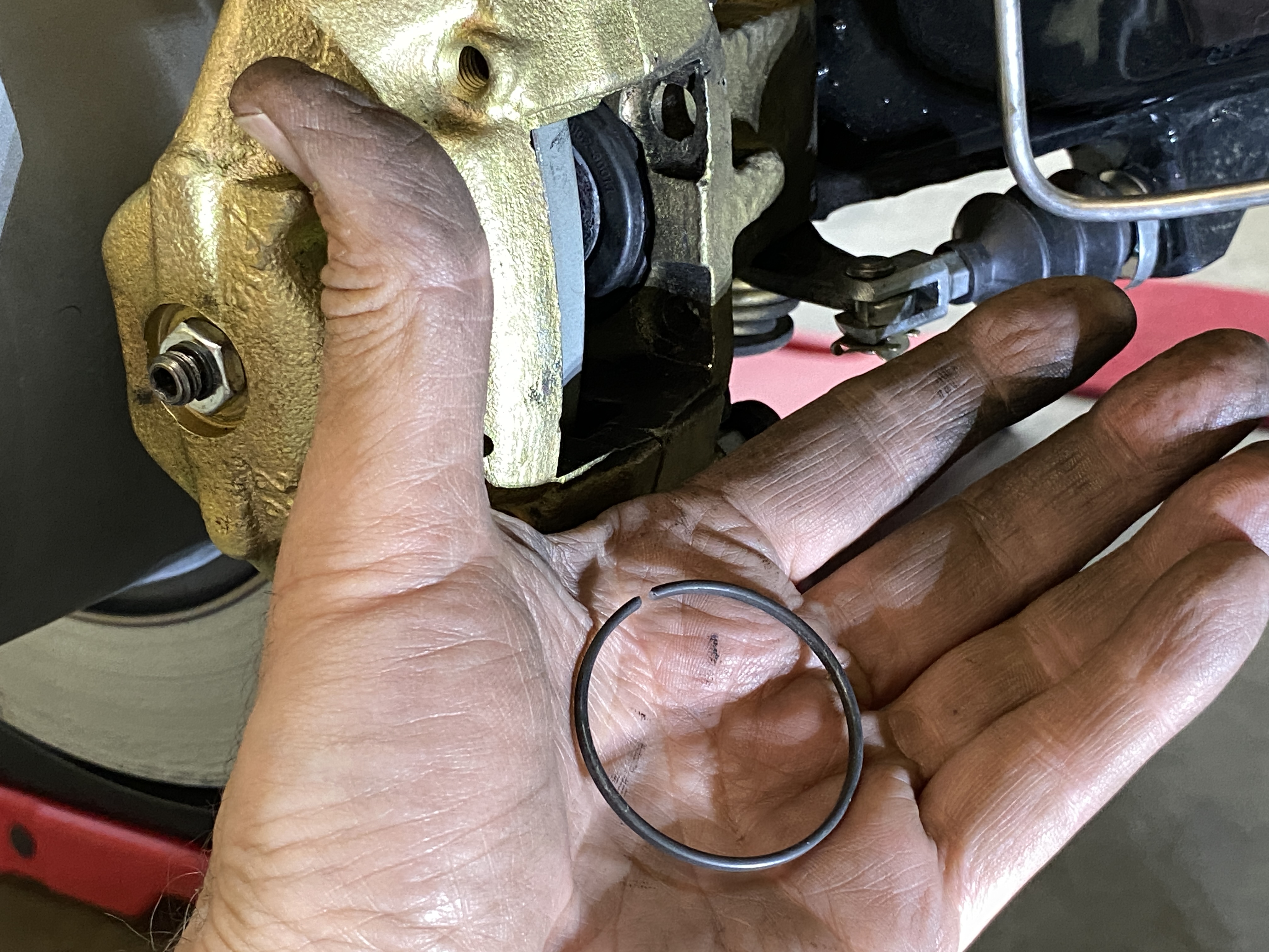

I started on the rears, but got side-tracked. The retaining ring for the inner piston bellows fell out. This is a job for tomorrow.

No drips! So I put in another 2 quarts.

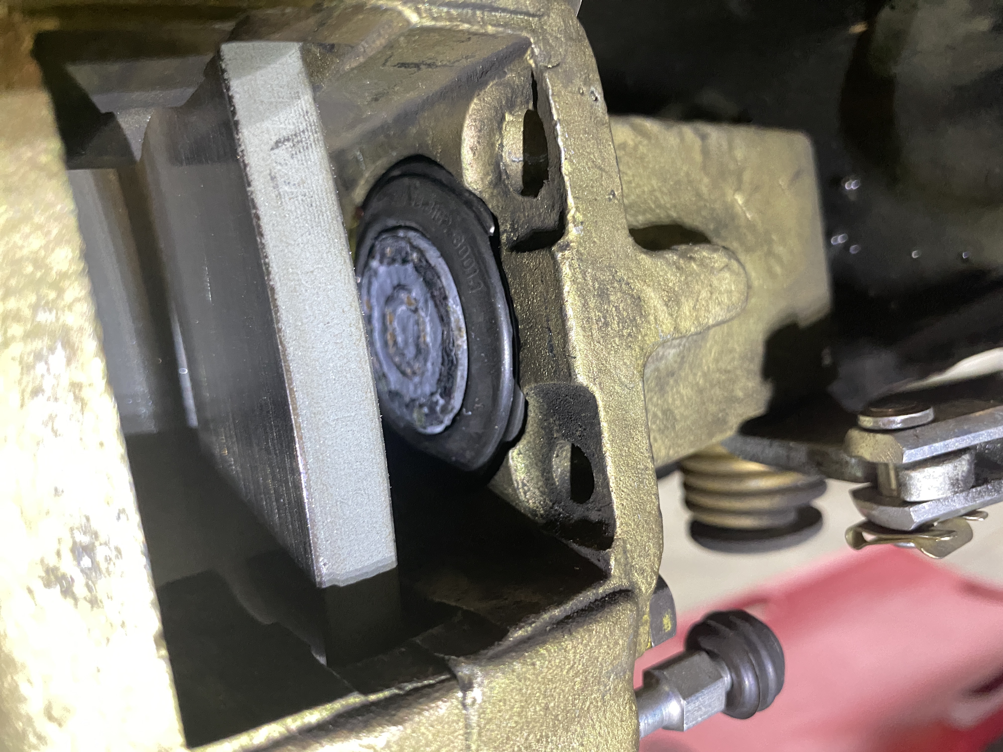

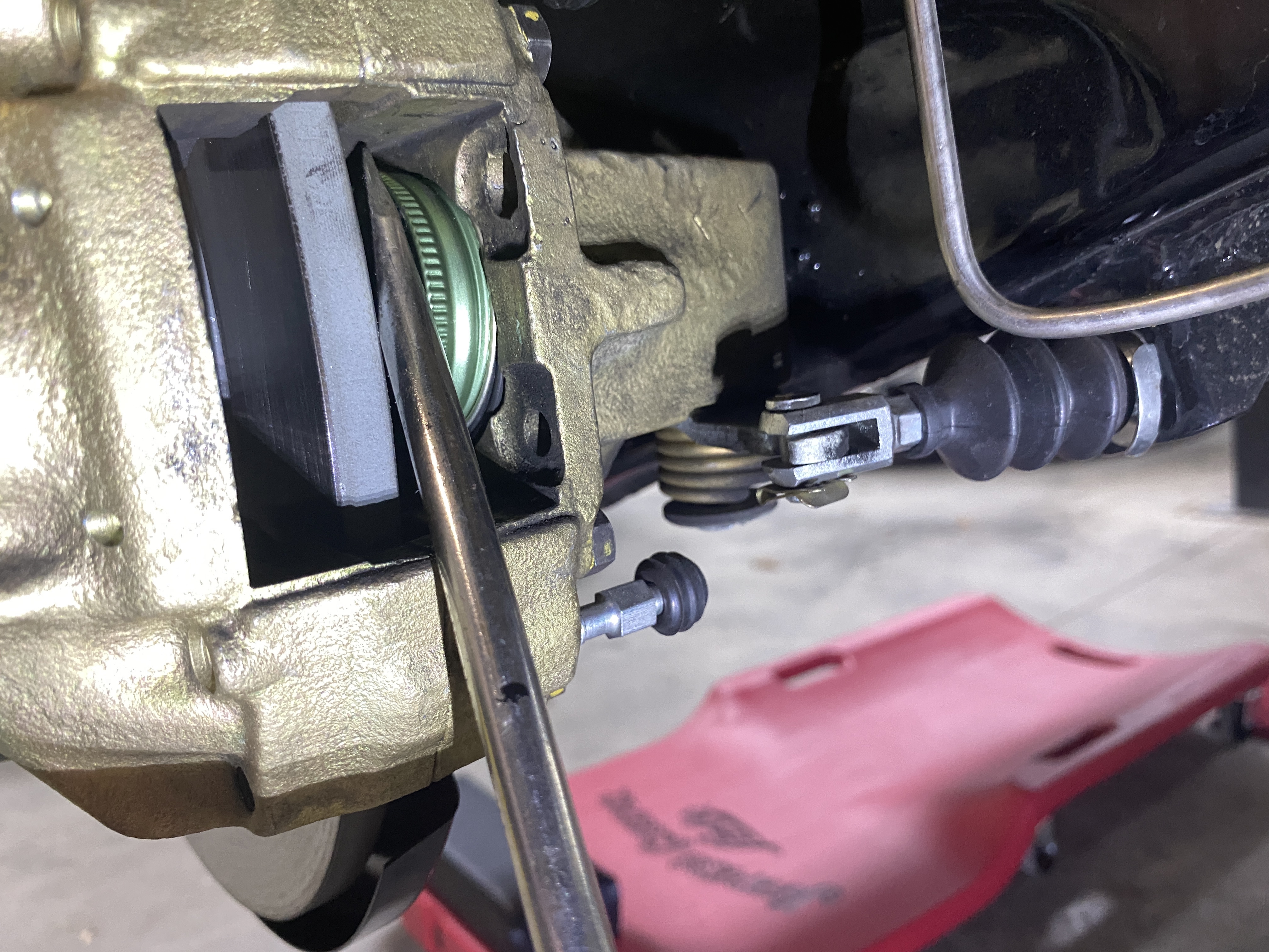

I had a few minutes between other stuff today, and searched out a tool to seat the caliper seal retaining ring. I found one in my wife's spice cabinet. Don't tell her.
bkrantz
post Apr 18 2023, 08:08 PM
Post #6411
Posts: 8,746
Joined: 3-August 19
From: SW Colorado
Member No.: 23,343
Tool in use. Just big enough to fit over piston.
bkrantz
Post #6412
Posts: 8,746
Joined: 3-August 19
From: SW Colorado
Member No.: 23,343
Success (I hope).
bkrantz
post Apr 18 2023, 08:09 PM
Post #6413
Posts: 8,746
Joined: 3-August 19
From: SW Colorado
Member No.: 23,343

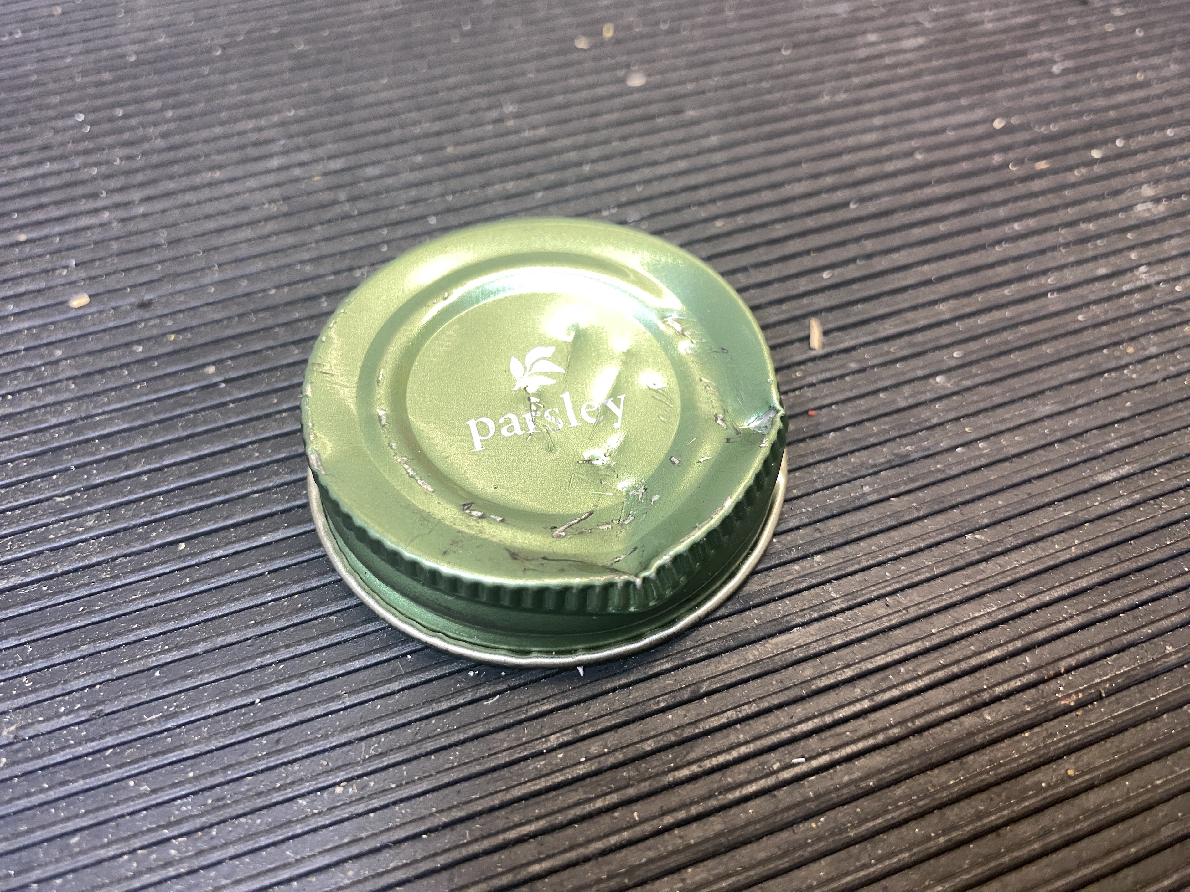

Uh-oh. The tool looks a little worn. Now to get it back to the kitchen.

QUOTE(bkrantz @ Apr 18 2023, 08:09 PM) *
Oops, good thing your wife is forgiving, or get that hunk of junk out of the garage for once and for all

Well, I got busted. She caught me before I could hide the jar in the back. At least parsley is not expensive or important, so I got off with a warning.

I had a distracting week, especially with a good friend from Scotland who spent an extra long weekend, when we drank a good bit of the whisky he brought.

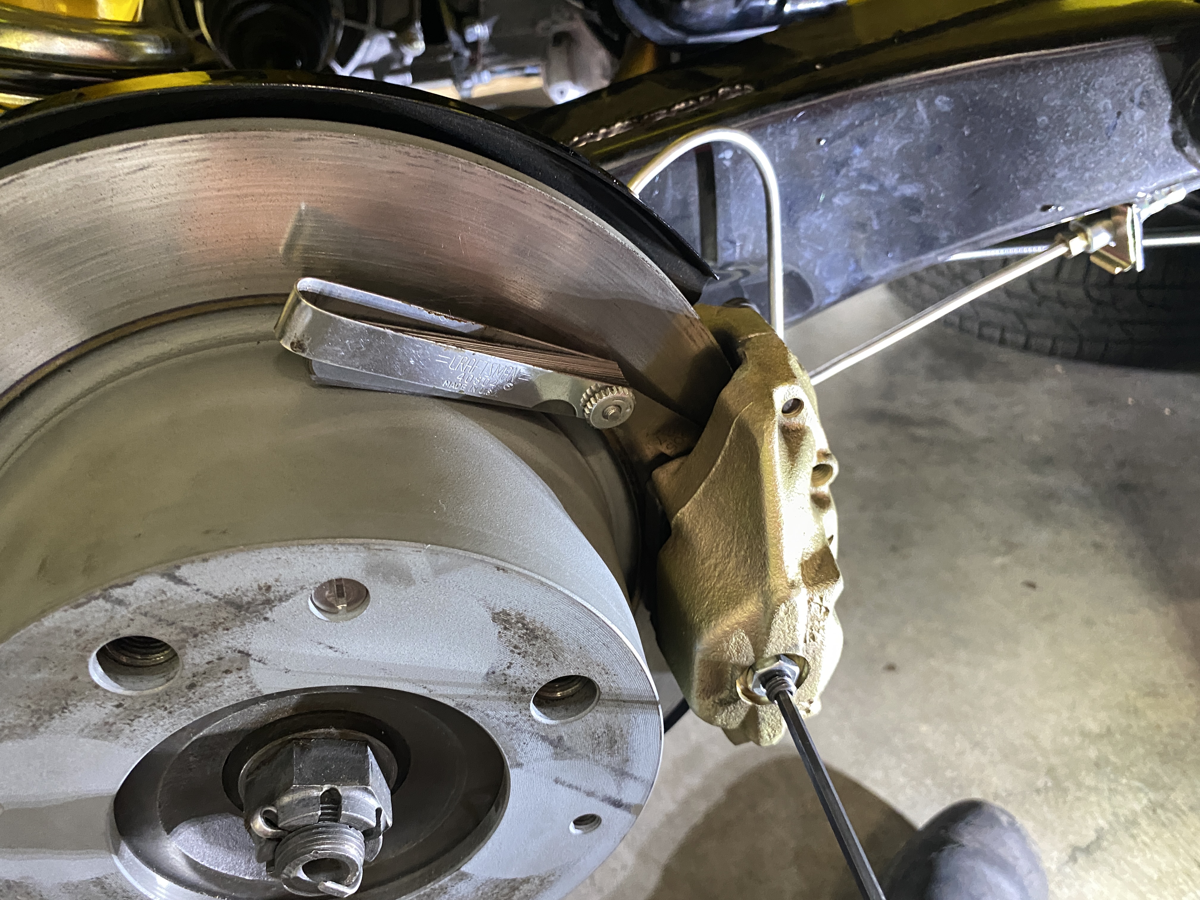

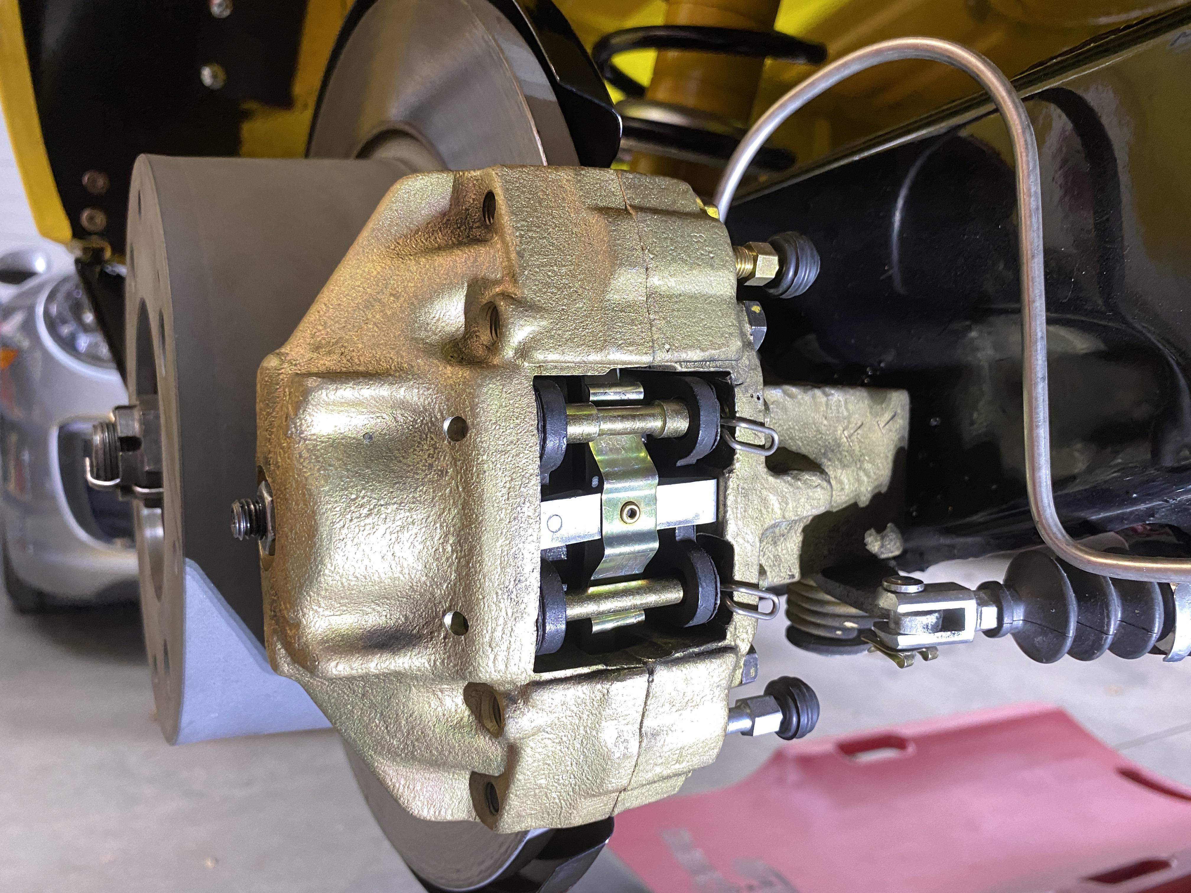

Once I sobered up, I finally finished swapping the brake pads, back to the Porterfield pads I started with. Here I have the right rear ready for adjustment.
bkrantz
post Apr 26 2023, 07:22 PM
Post #6420
Posts: 8,746
Joined: 3-August 19
From: SW Colorado
Member No.: 23,343
.004" clearance.
