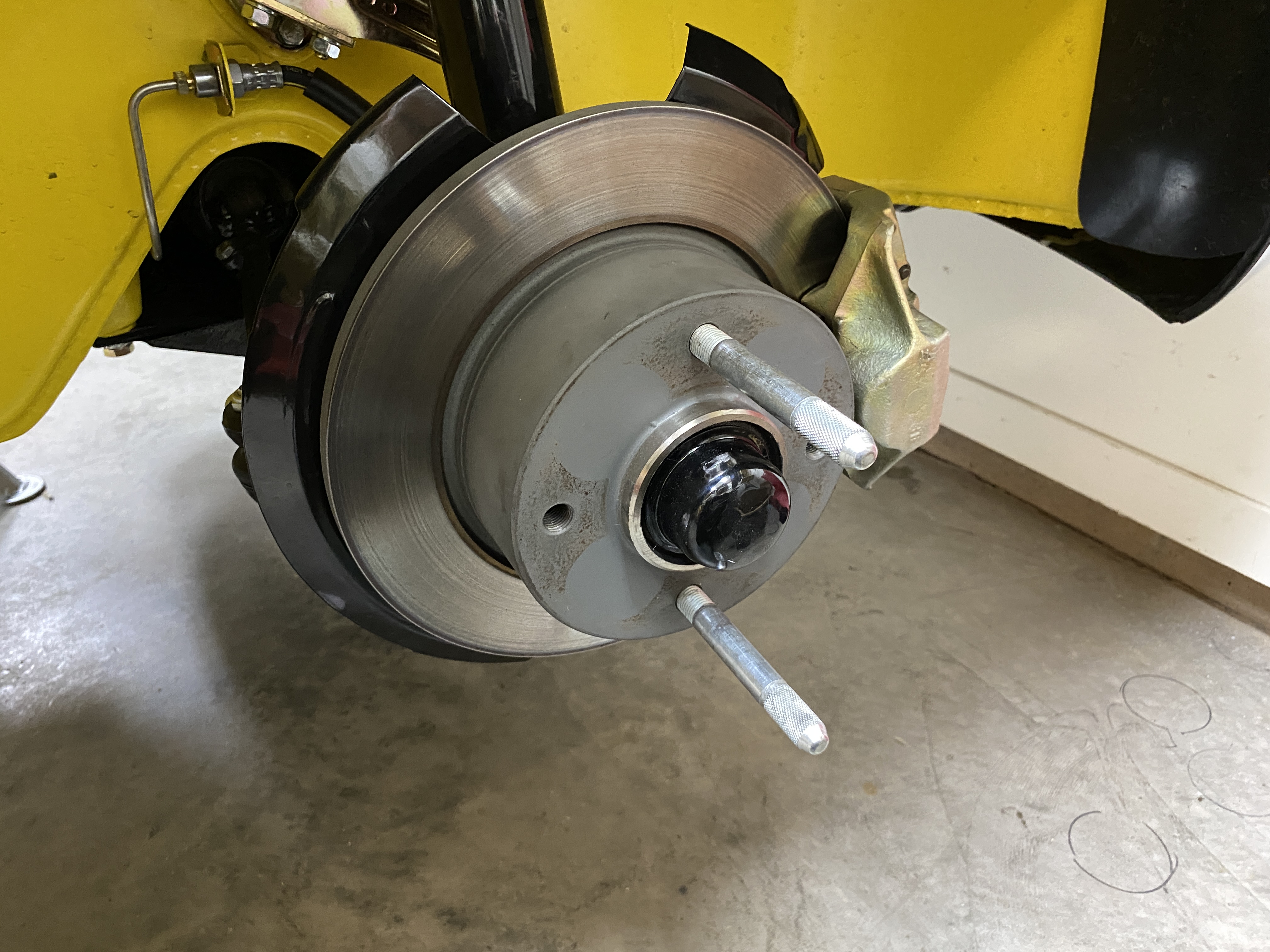

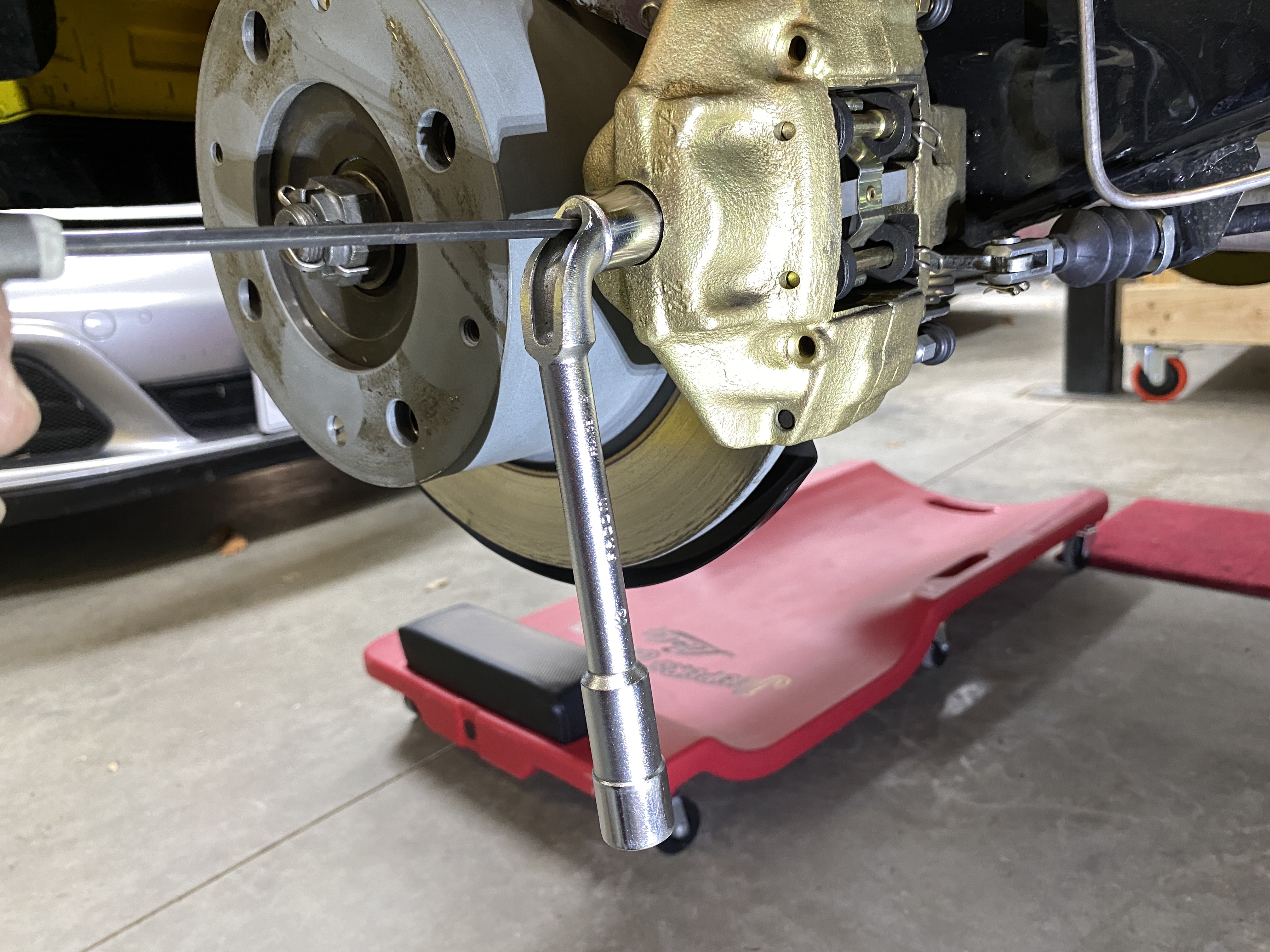

And I had a chance to use my Facom angle wrench, the perfect tool for the outer adjuster.
bkrantz

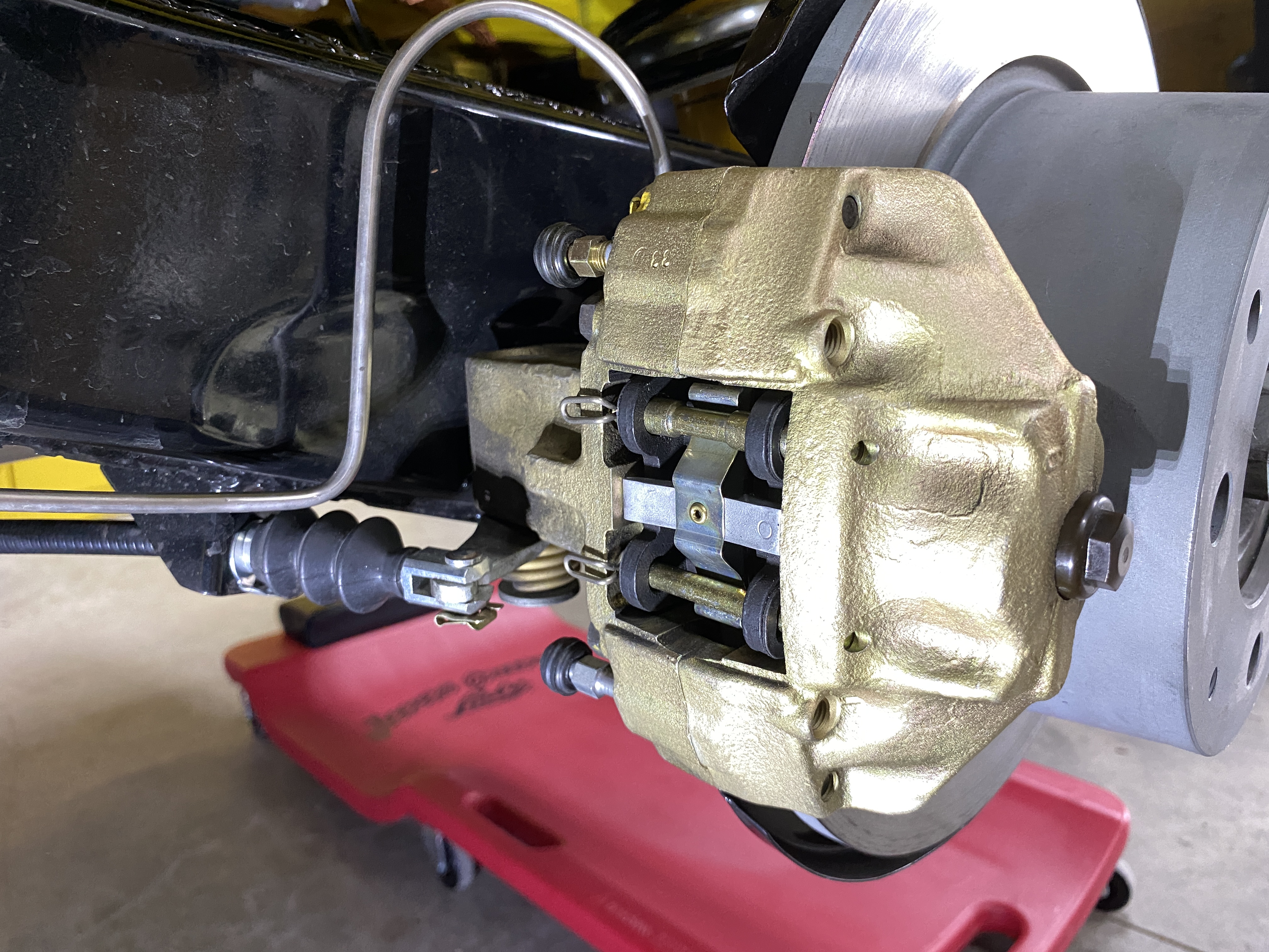

Left side done, too.

You set the inside, as well - right?
bkrantz
post Apr 27 2023, 07:54 PM
Post #6425
Posts: 8,746
Joined: 3-August 19
From: SW Colorado
Member No.: 23,343
QUOTE(FlacaProductions @ Apr 26 2023, 07:35 PM) *
Yes I did--thanks for the reminder check. And the pedal feels very firm so I will skip another round of bleeding for now.

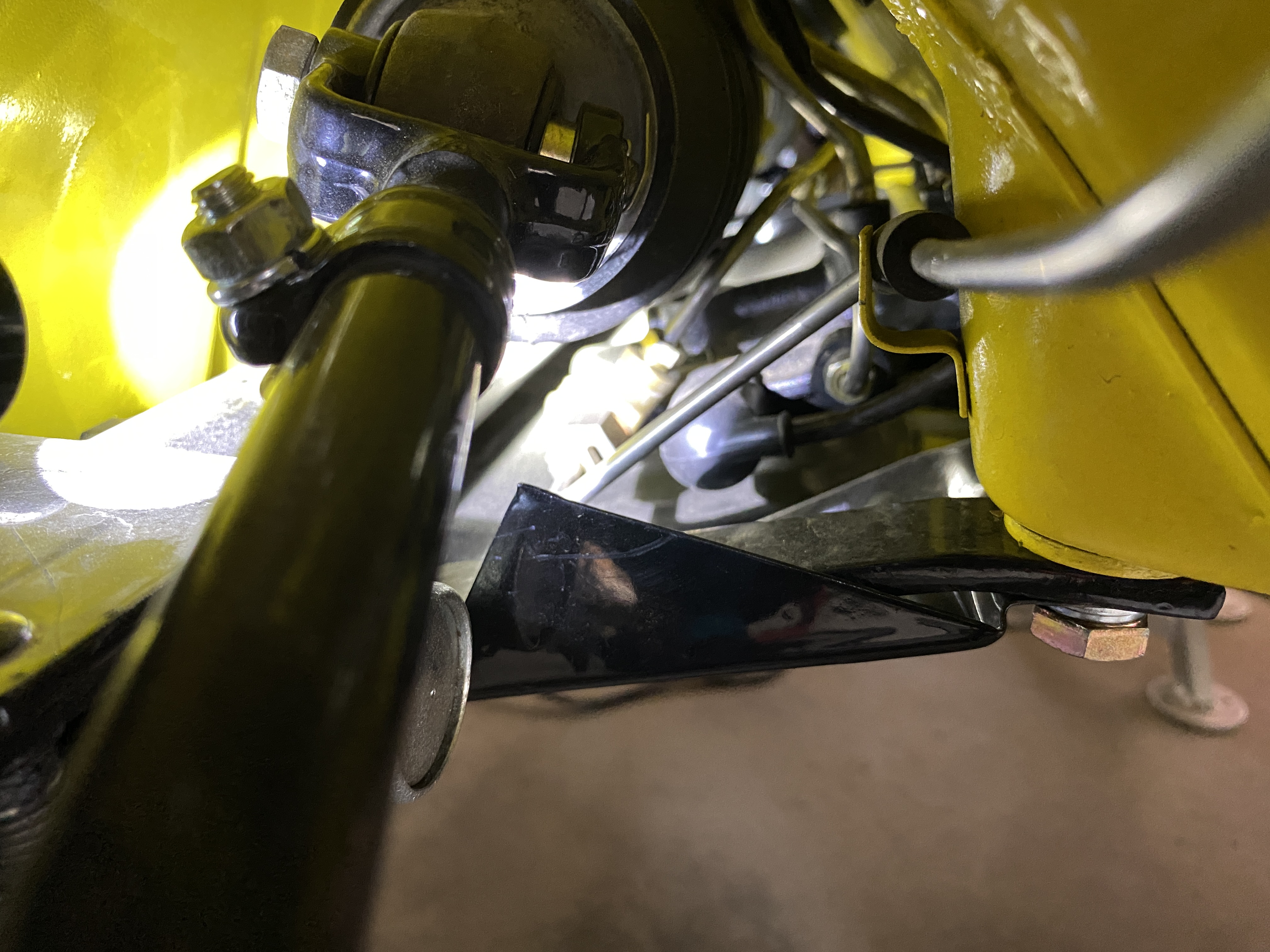

Still thinking about the somewhat weak brake performance from last summer, I remembered to see how much flex the master cylinder shows with the pedal pushed hard. With me in the car and my wife looking in from the side, I pushed and she said "It moves!"
When I restored the floor the area around the pedal cluster looked very solid.
bkrantz
post Apr 30 2023, 06:42 PM
Post #6427
Posts: 8,746
Joined: 3-August 19
From: SW Colorado
Member No.: 23,343
I pulled the splash pan off and confirmed that I could pull the MC down . The motion is mostly vertical.

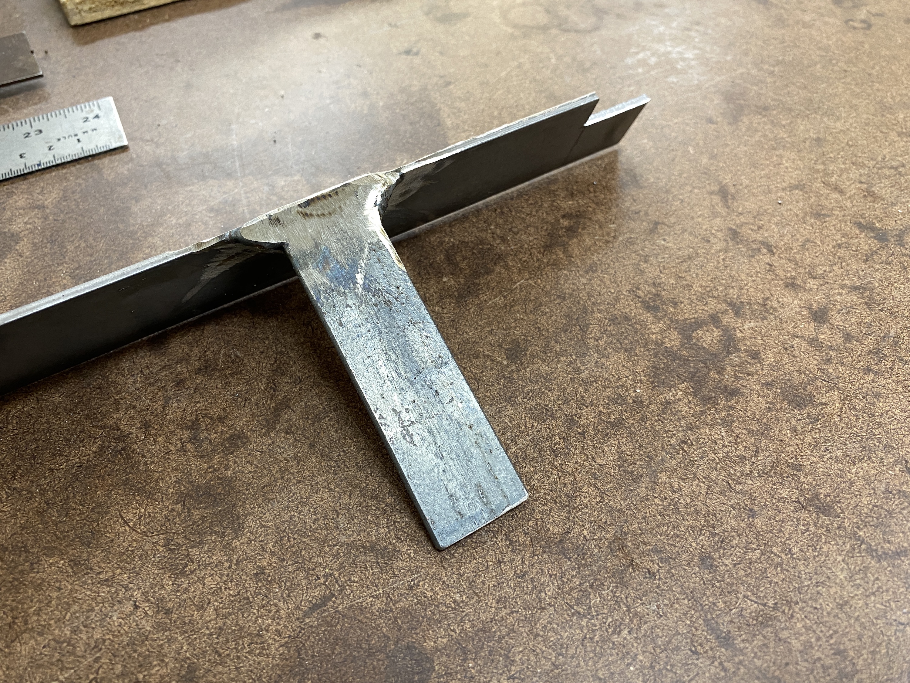

Member No.: 23,343

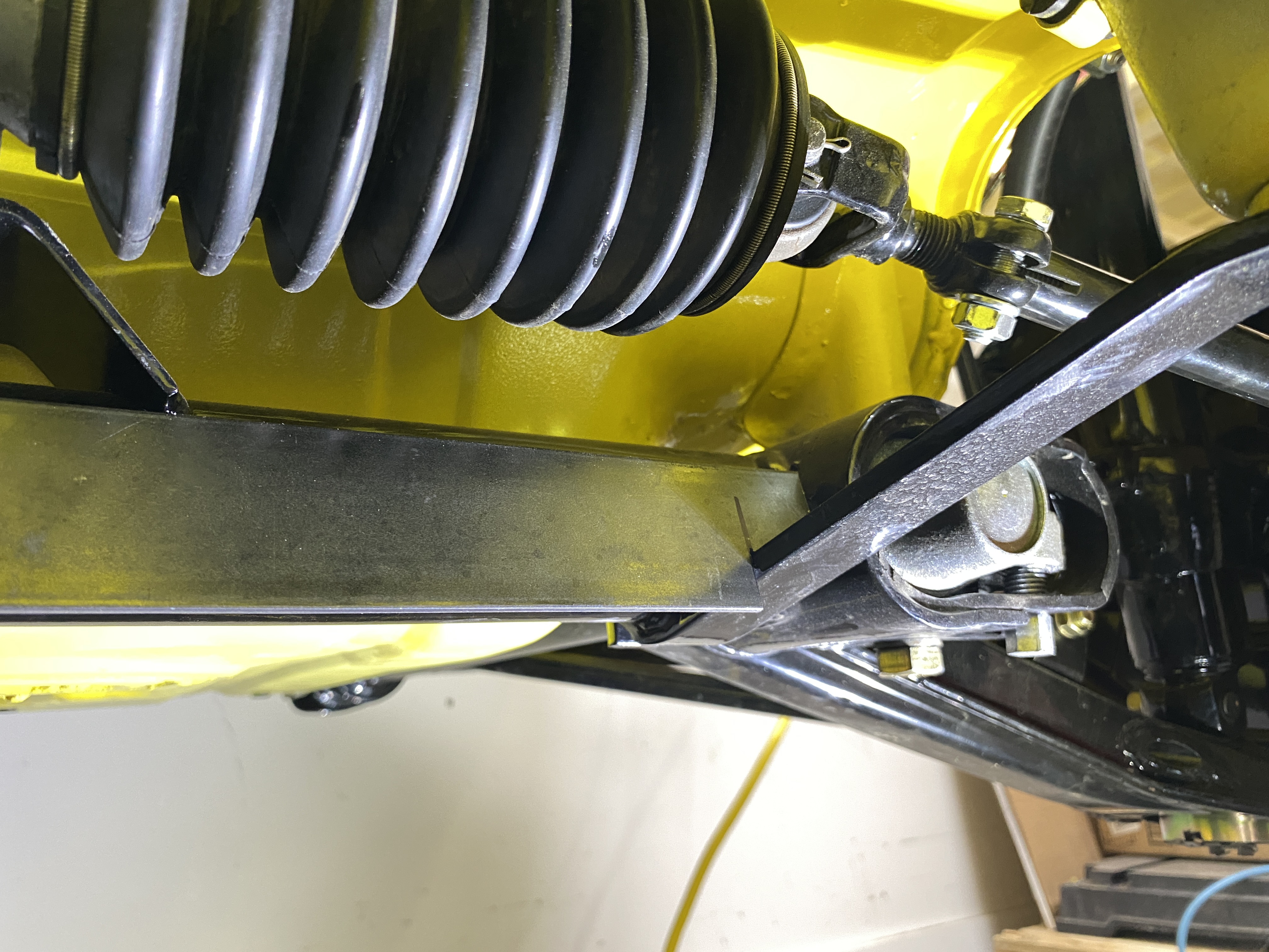

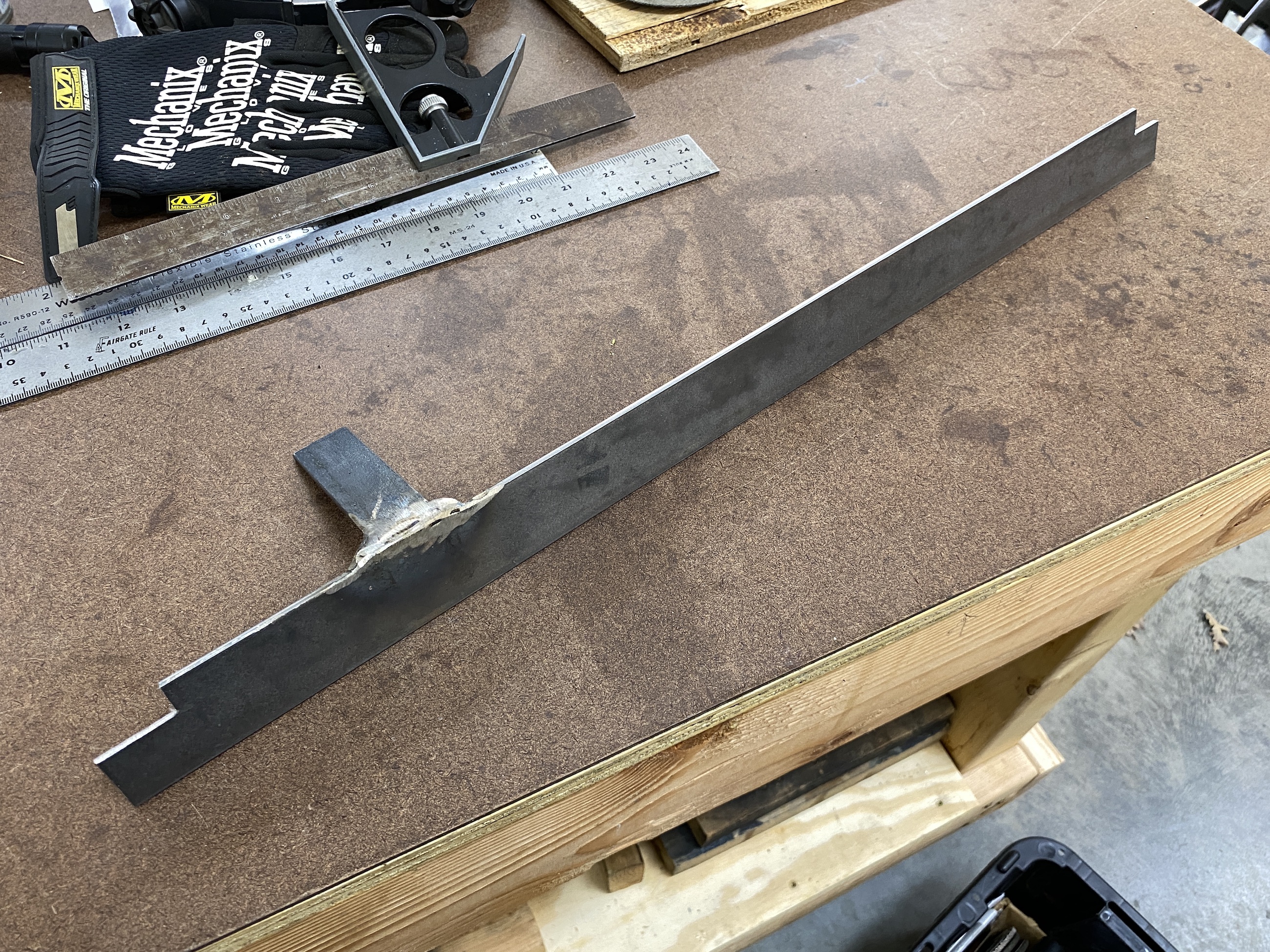

I know that people have applied different devices that brace the MC against the suspension cross tube. For fun, I tried to create something new. Here's my solution, a section of 1/8 x 1.5" bar, with a short bracket welded to it. I notched the bar to fit between the trailing braces on the cross tube.
bkrantz
post Apr 30 2023, 06:47 PM
Post #6429
Posts: 8,746
Joined: 3-August 19
From: SW Colorado
Member No.: 23,343
Close up of the bracket, made from a piece of 1/8 x 3/4" stock.

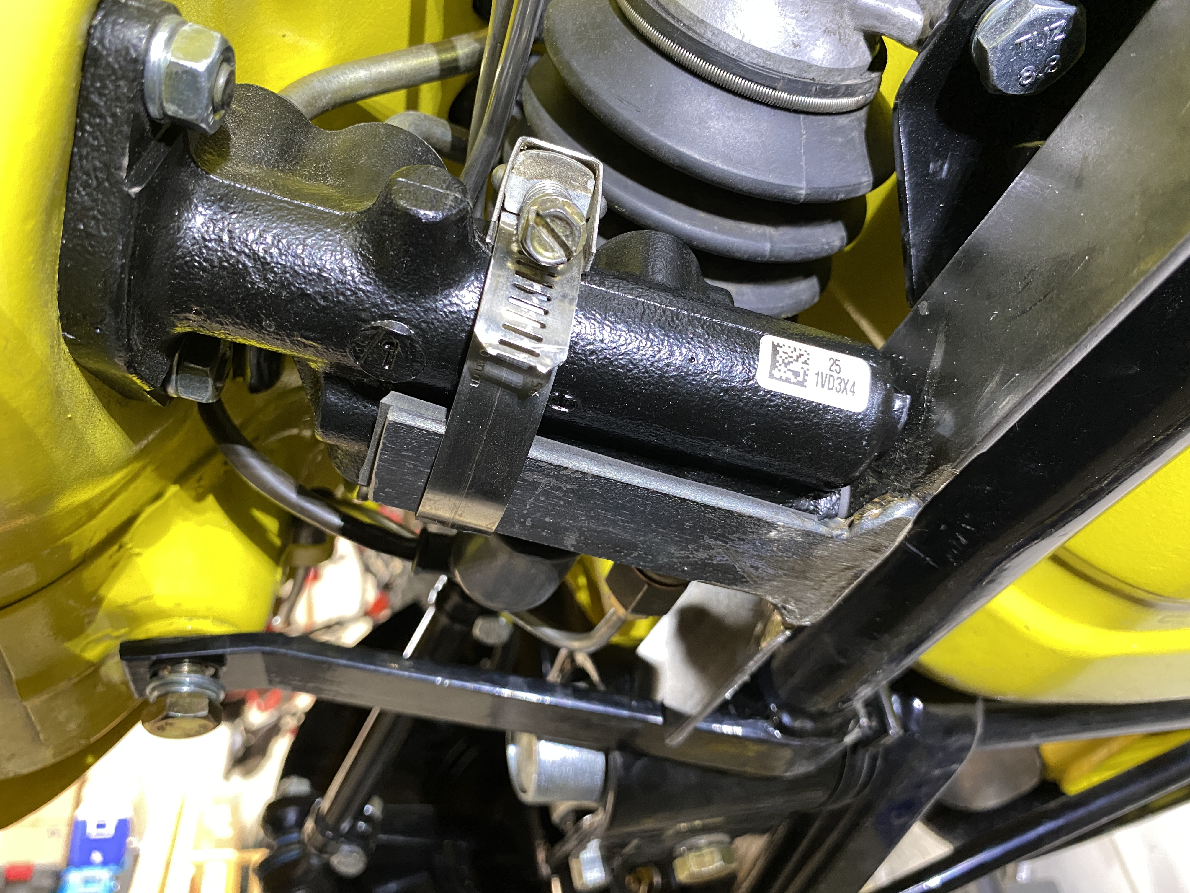

Member No.: 23,343

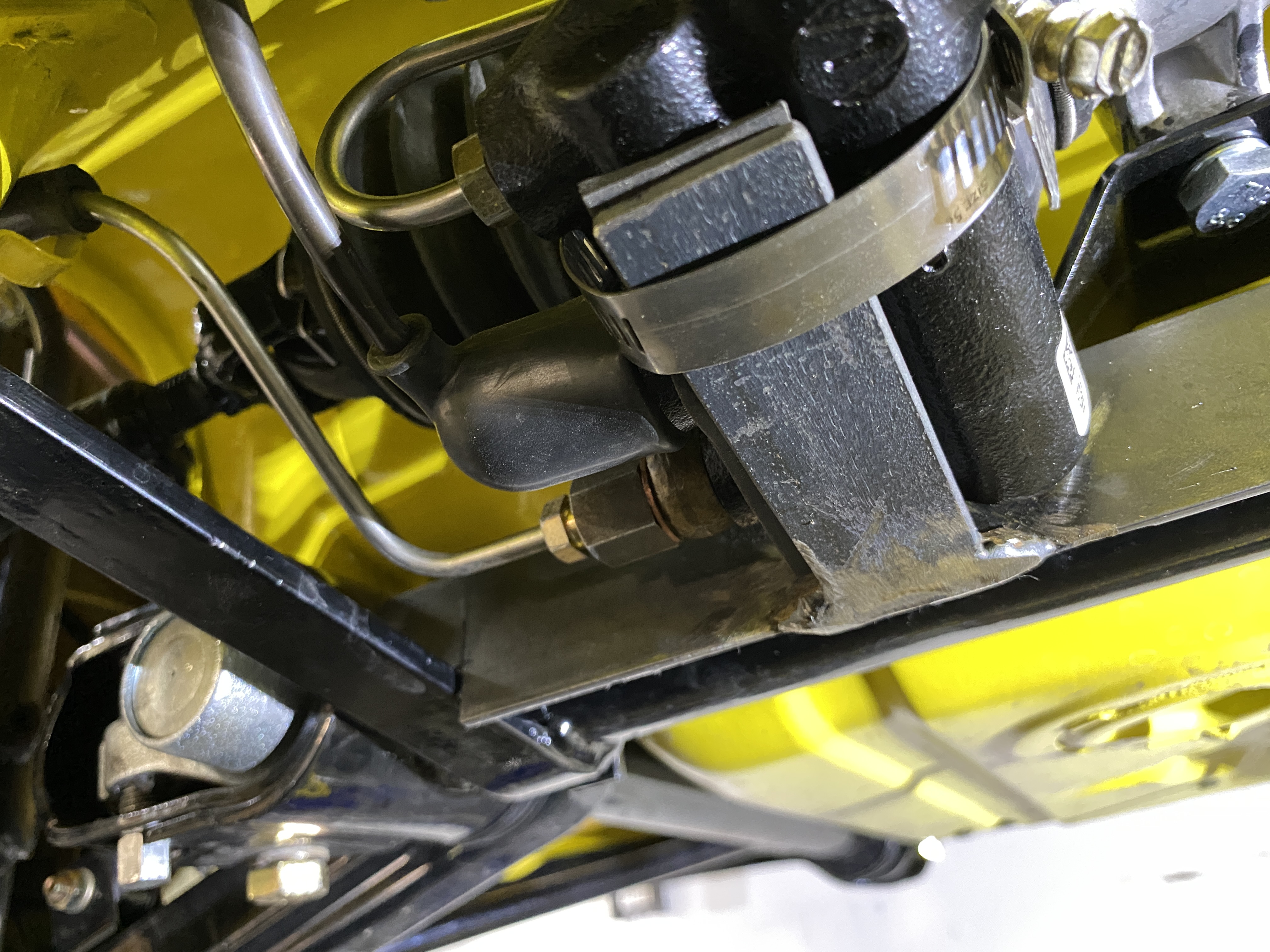

First installation. I know the hose clamp is a bit ghetto, but I want to see how it works. I used some 1/8" dense rubber sheet as a pad. The end of the MC sits in metal to metal contact on the new bracket.
bkrantz
post Apr 30 2023, 06:50 PM
Post #6431
Posts: 8,746
Joined: 3-August 19
From: SW Colorado
Member No.: 23,343
Right end.
bkrantz
post Apr 30 2023, 06:52 PM
Post #6432
Posts: 8,746
Joined: 3-August 19
From: SW Colorado
Member No.: 23,343
The MC seems much stiffer when I pulled on it, and my wife claims it did not move when I pushed hard on the brake pedal. This might work. I will test it on the road, and then see if I can refine the mounting method.

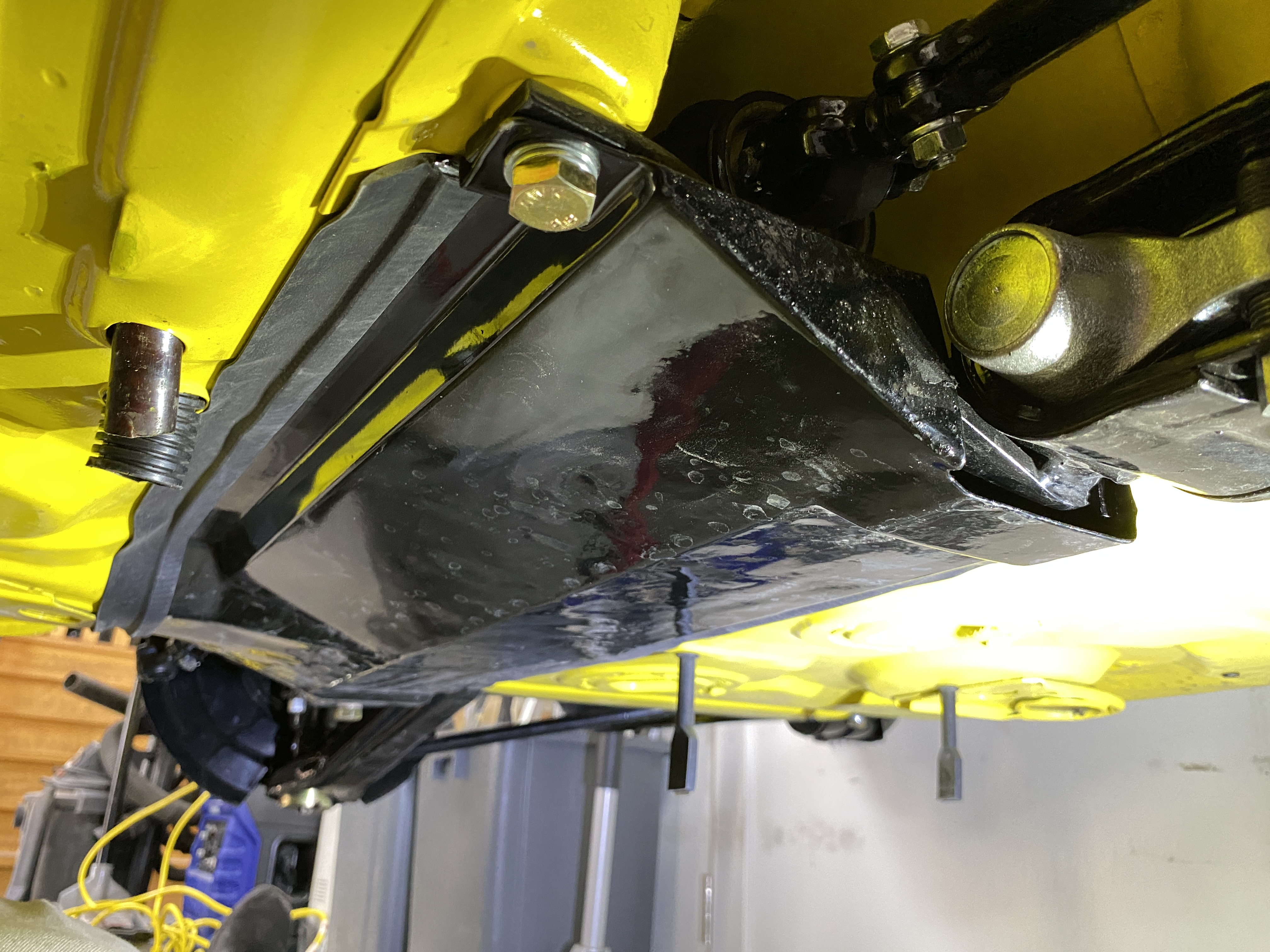

Member No.: 23,343

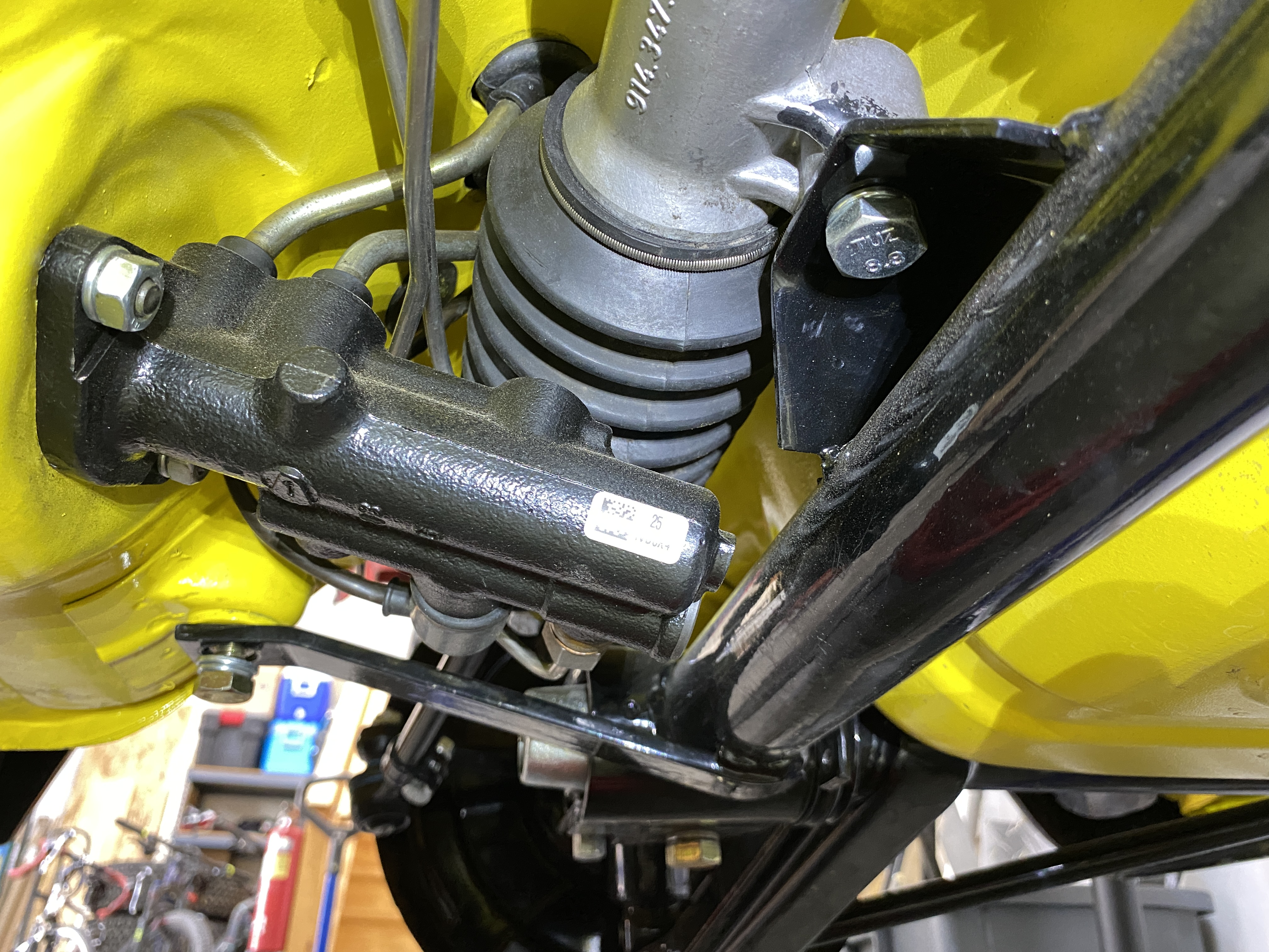

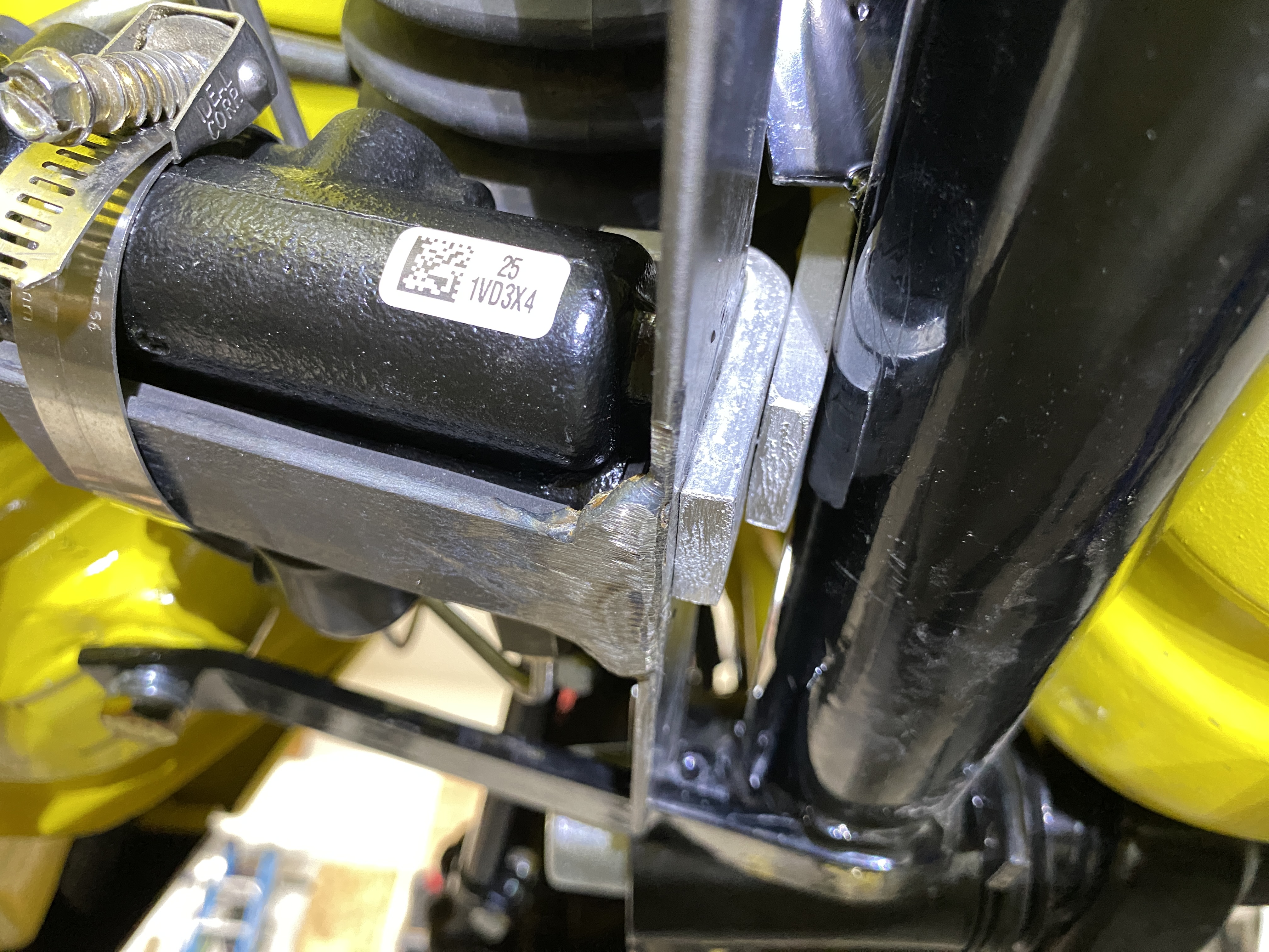

I decided to add one more brace to the master cylinder, and made a sandwich of two 1/4" aluminum scrap pieces. They fit snug and will keep the MC from flexing forward.
bkrantz
post May 1 2023, 08:37 PM
Post #6436
Posts: 8,746
Joined: 3-August 19
From: SW Colorado
Member No.: 23,343
I re-installed the splash shield. Some dirty spots hide the lumpiness.

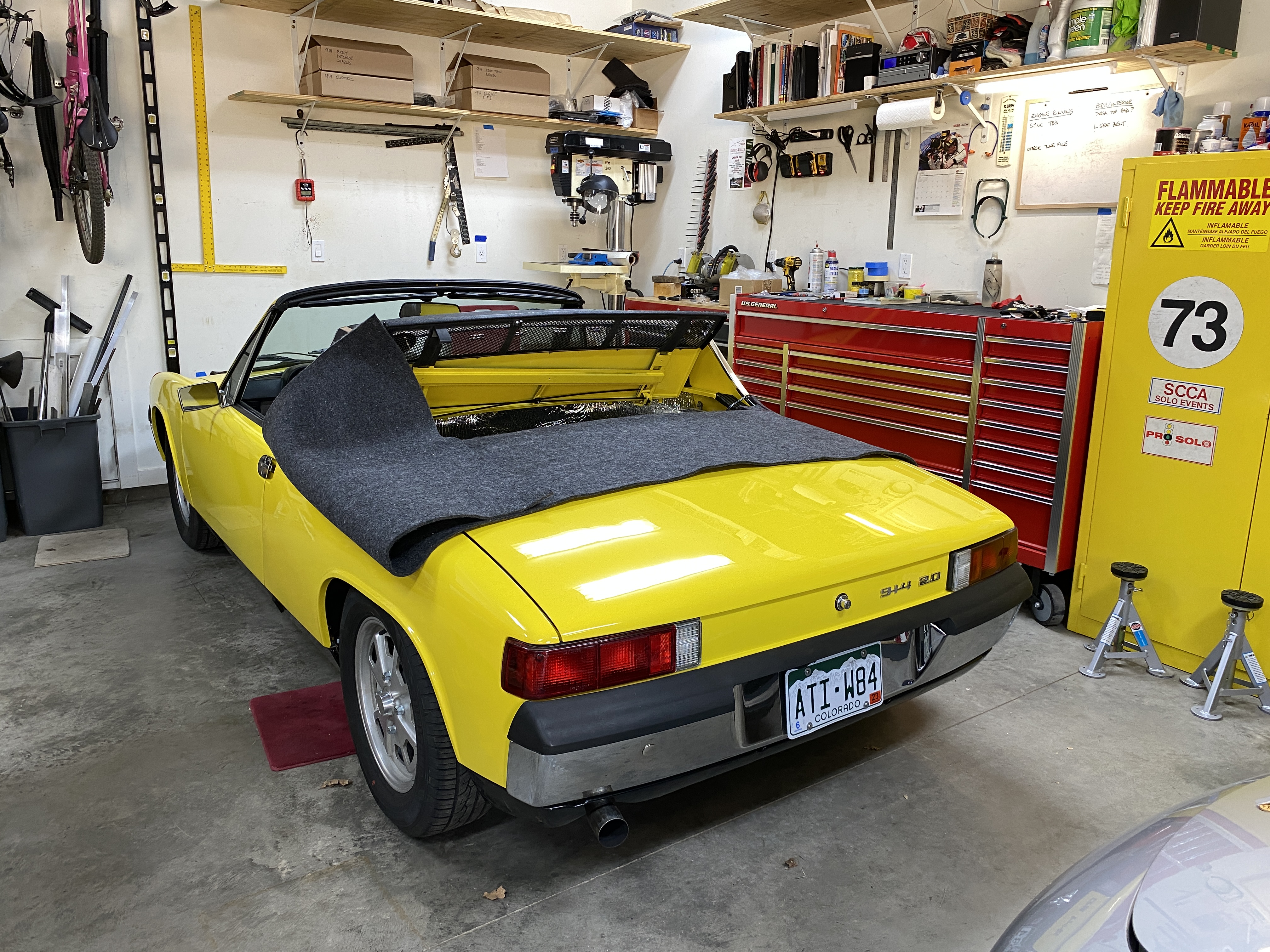

My 914 is back on its own wheels for the first time since last December. (IMG:style_emoticons/default/cheer.gif)
