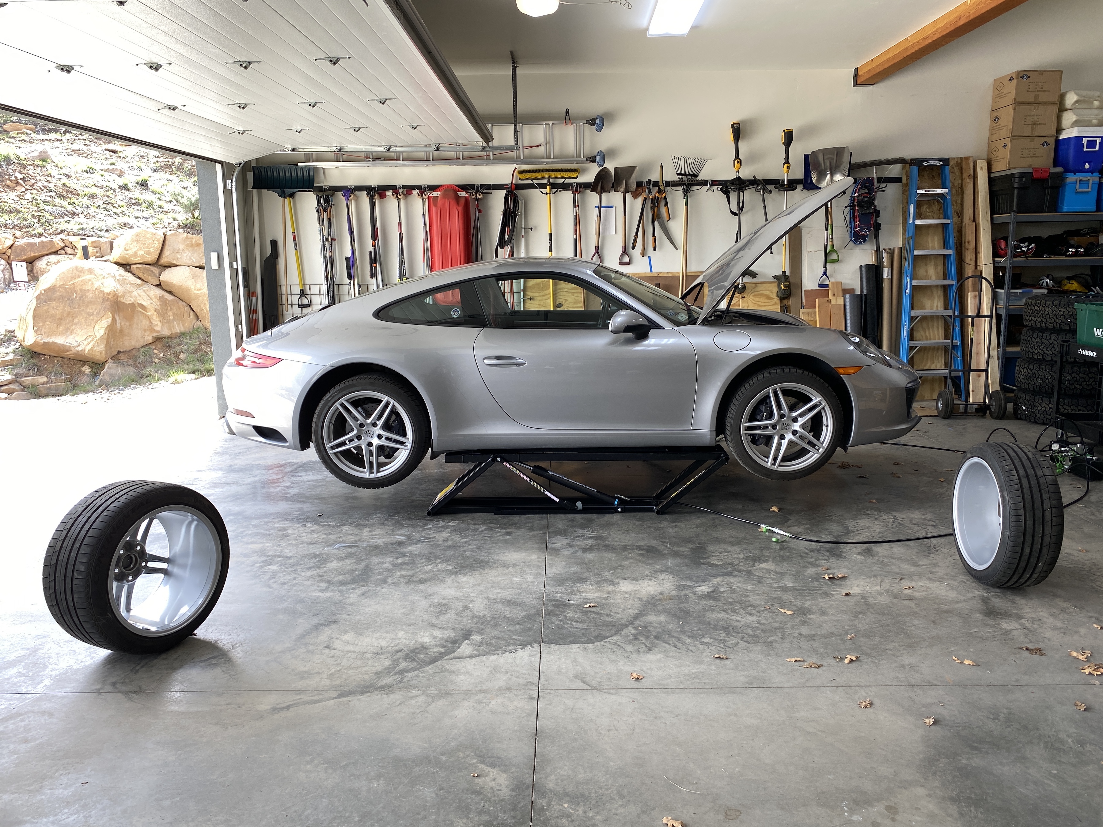

Busy garage day. First I put the summer tires on my 911.

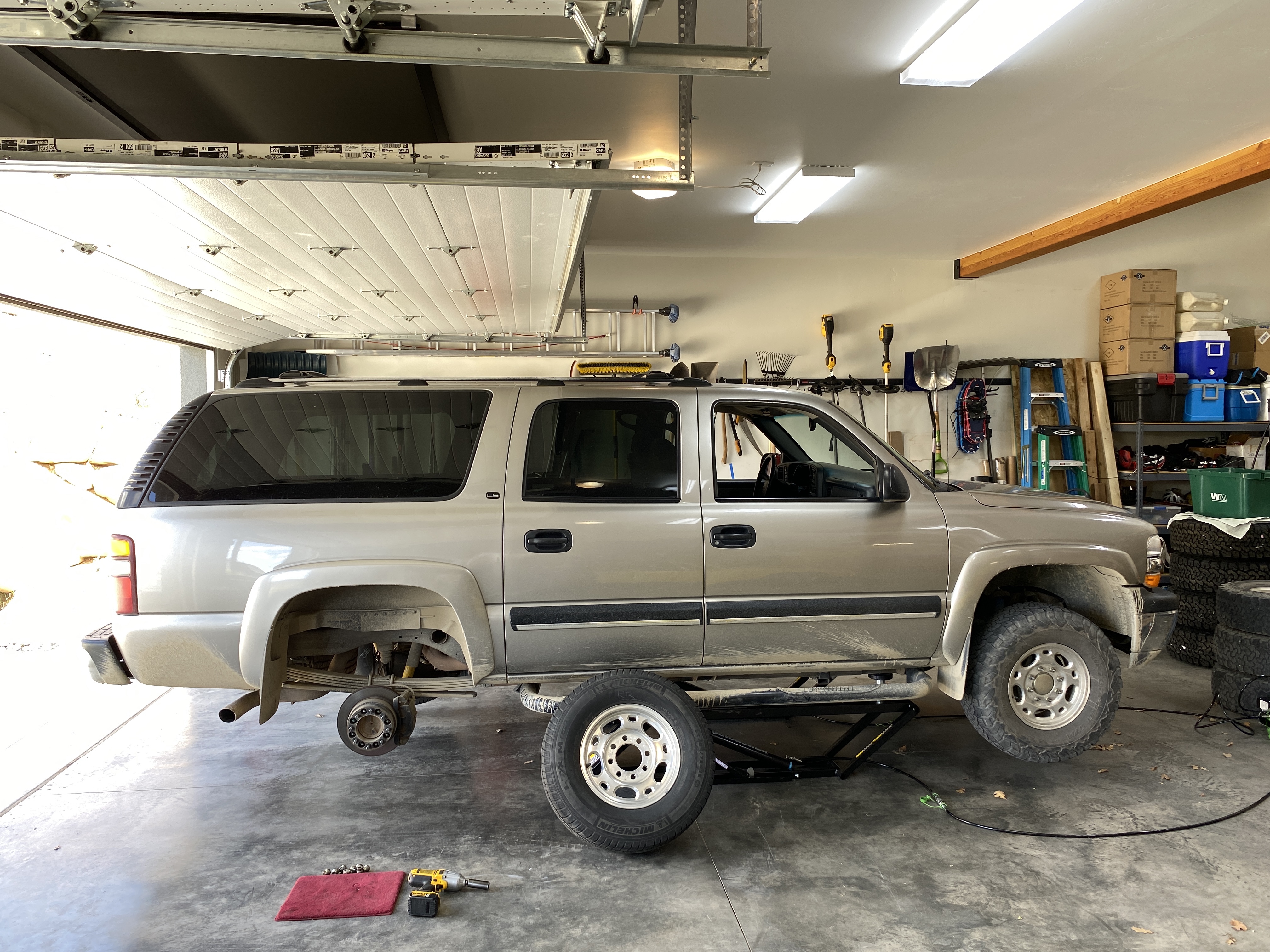

Then I put the street treads on my Suburban (saving the AT tires for the dirt).

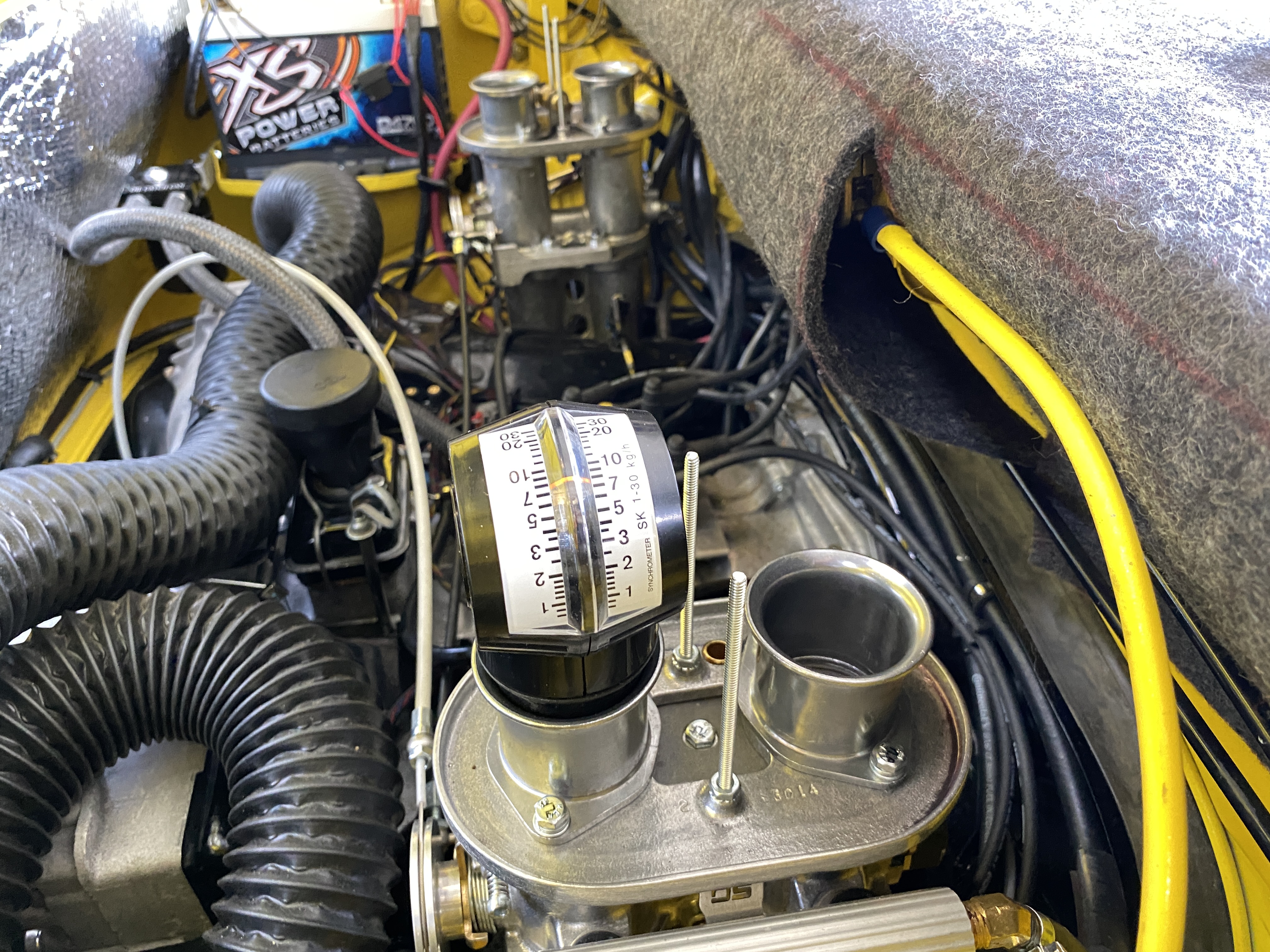

Then I fired up the 914, let it warm up, and balanced the idle setting air flow through the L and R throttle bodies.

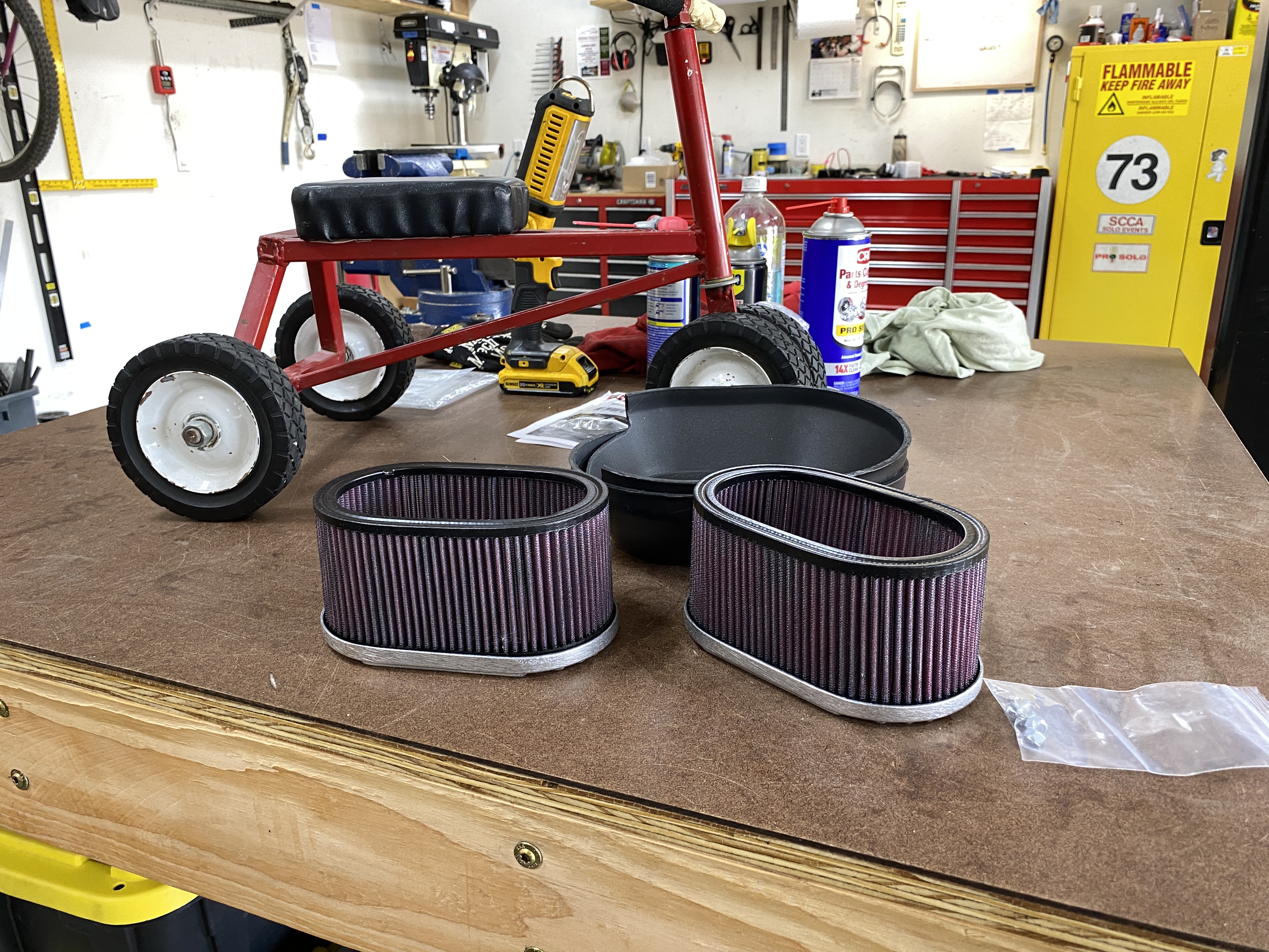

Last parts to install: air filters.

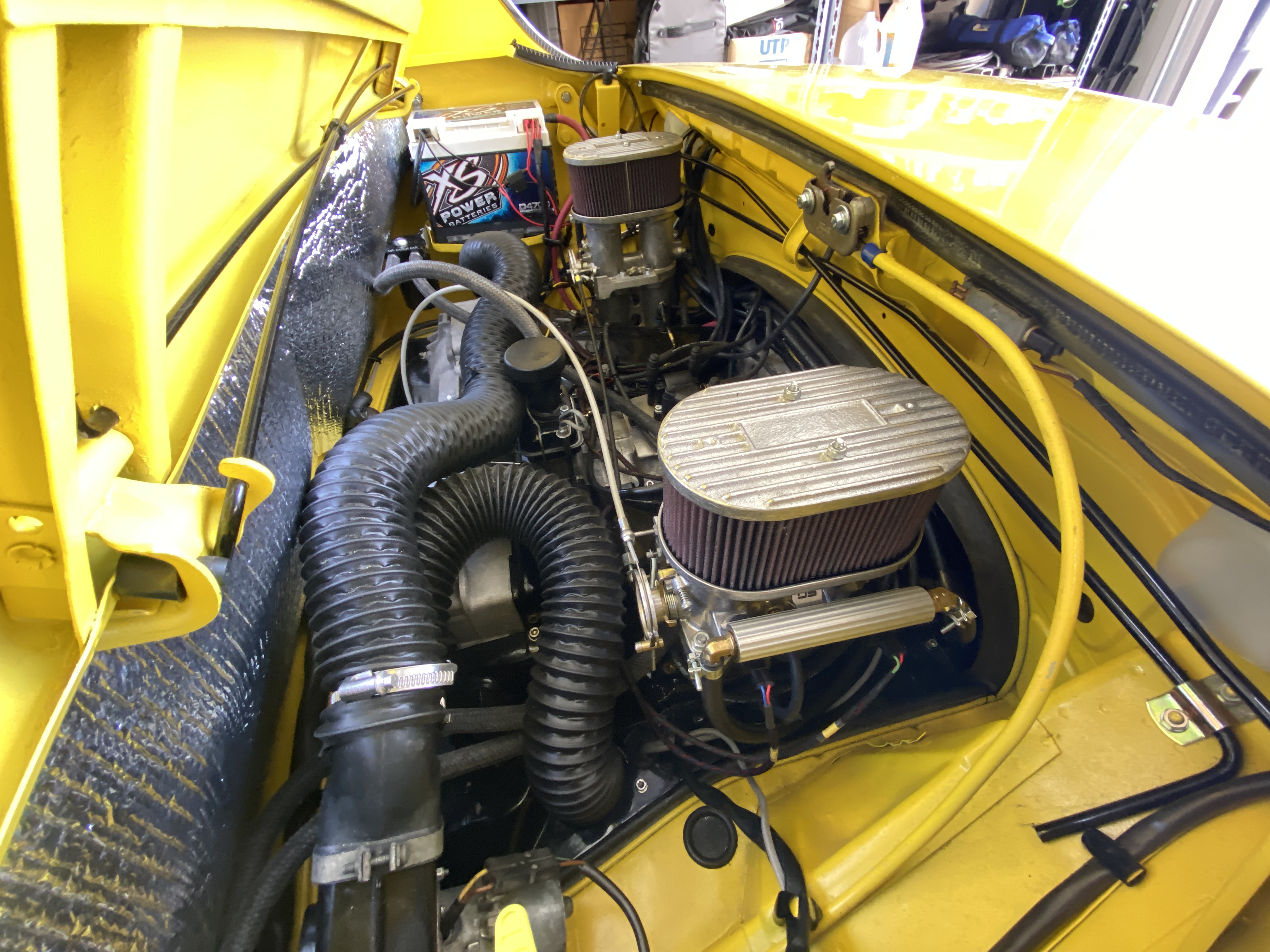

That's 100% of the engine bay again.

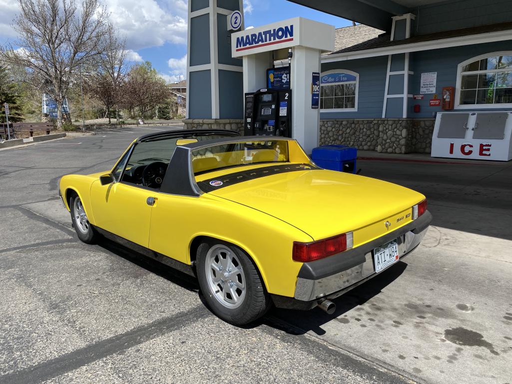

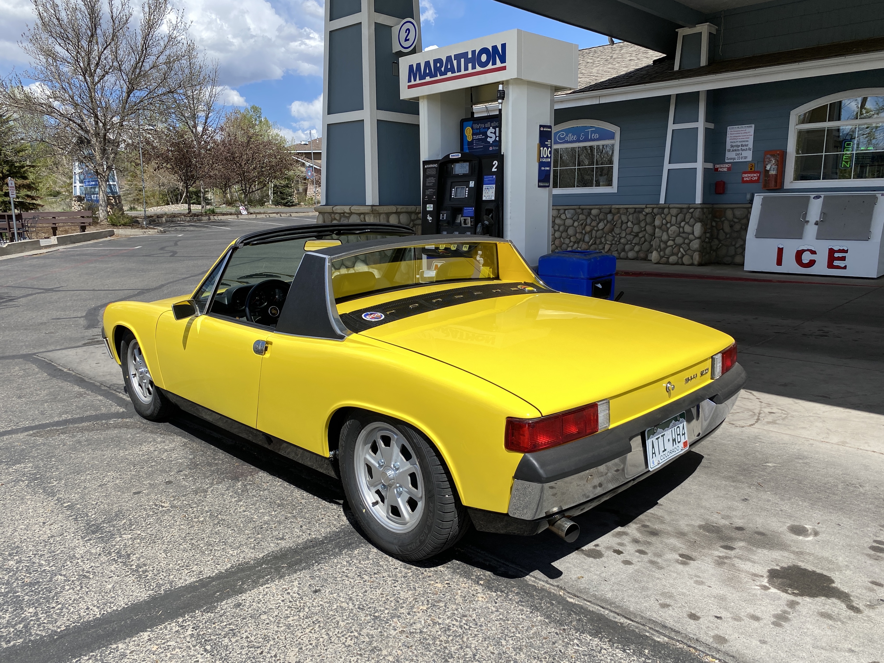

I went for a 20 minute drive and all was good. Best of all, the brakes finally feel pretty strong, even with the pads not quite bedded in again. I felt a pull to the right with hard braking.
Stopped to fill the tank on the way home.

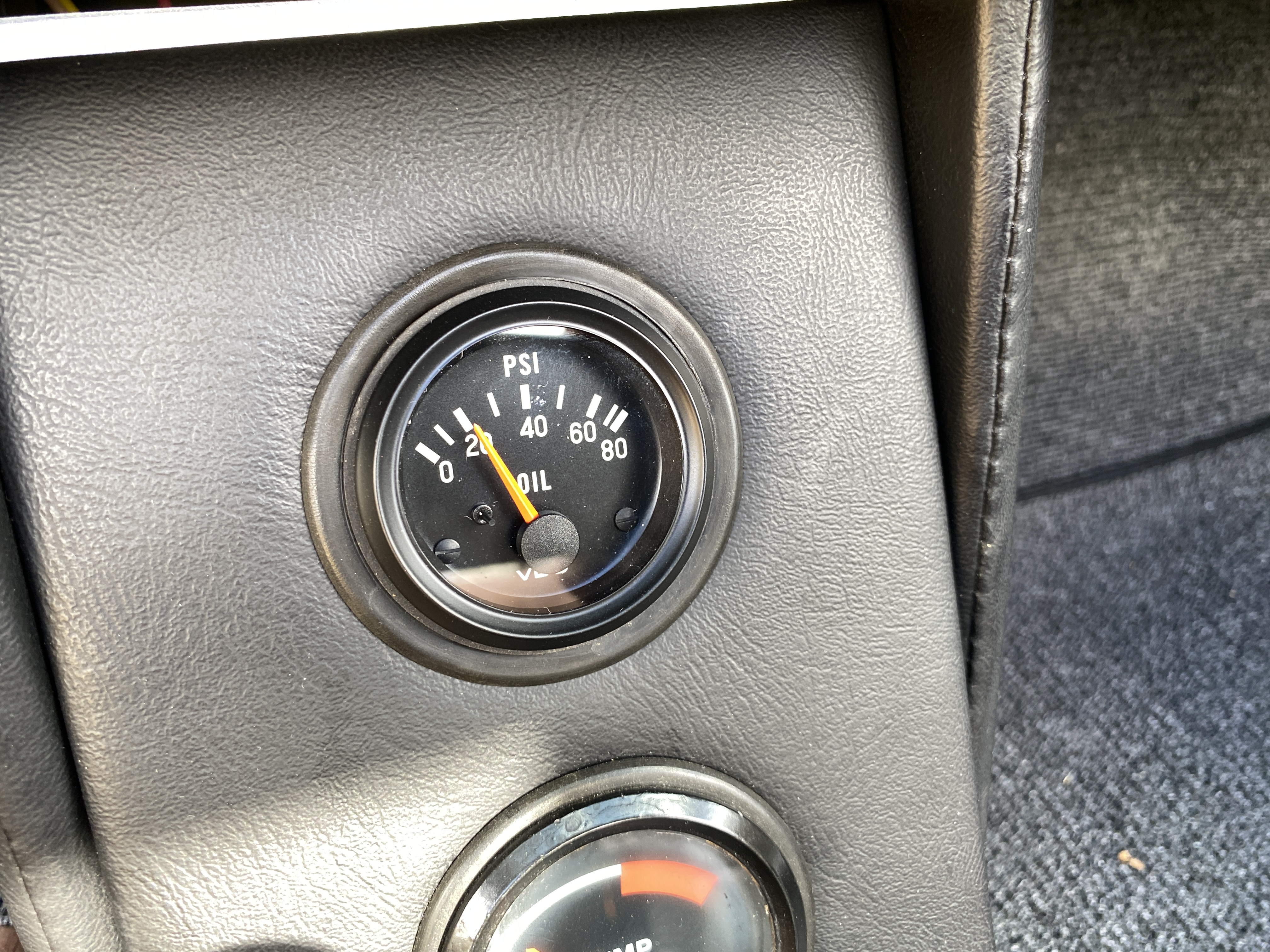

Some other good news: I like my new oil pressure gauge. This is at about 1500 RPM. At idle when hot I saw about 10 psi. When running at speed I think it was about 40.

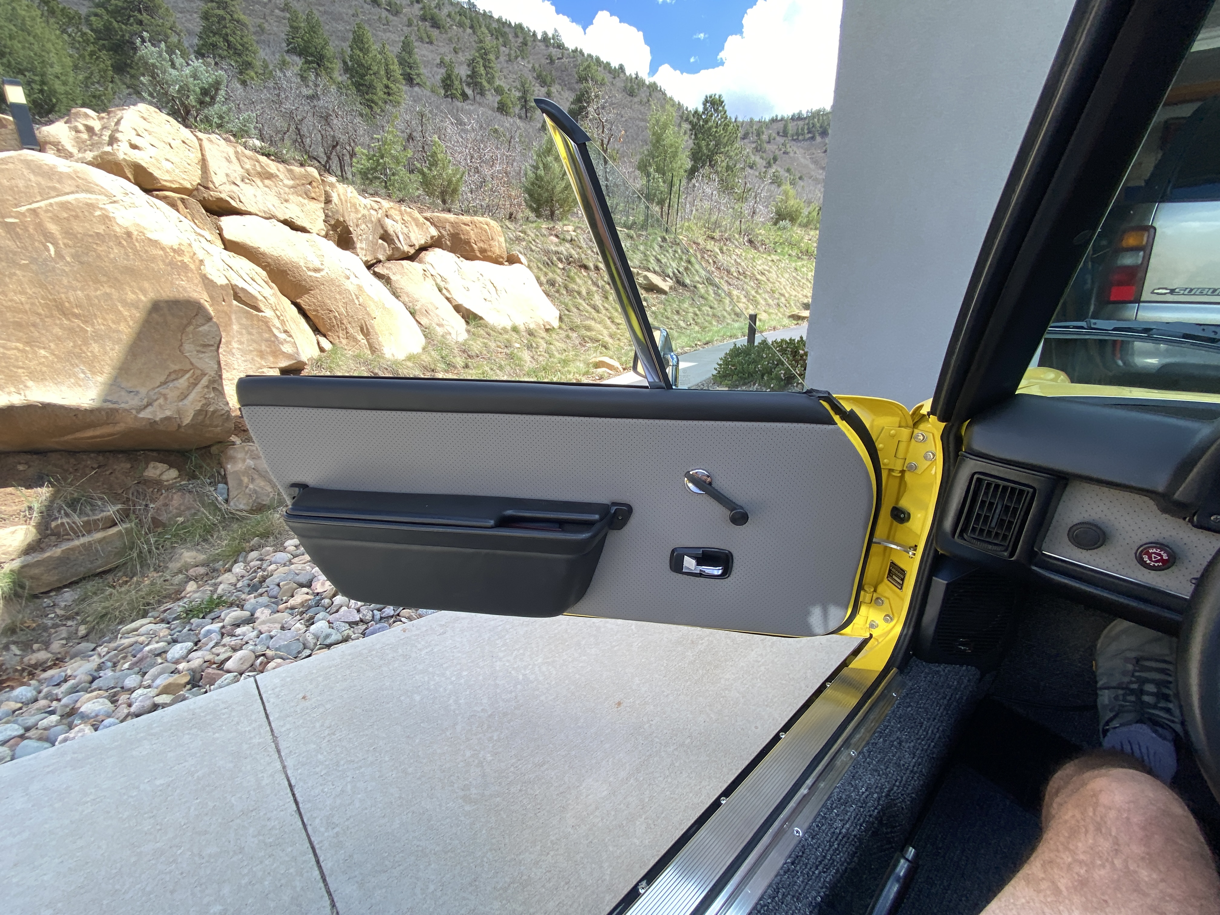

I almost forgot I replaced the door stays. Nice for the doo to stay open on a slight incline.
In other news, the odometer now works!

Curious - where does your oil pressure gauge start when cold - pegged at 80? If so - how long does it take to drop?
Mine runs much higher than yours - confirmed by a mechanical one in the engine bay. Like 60 at 3k flat cruise. I never see anything as low as 20 - even hot at idle.

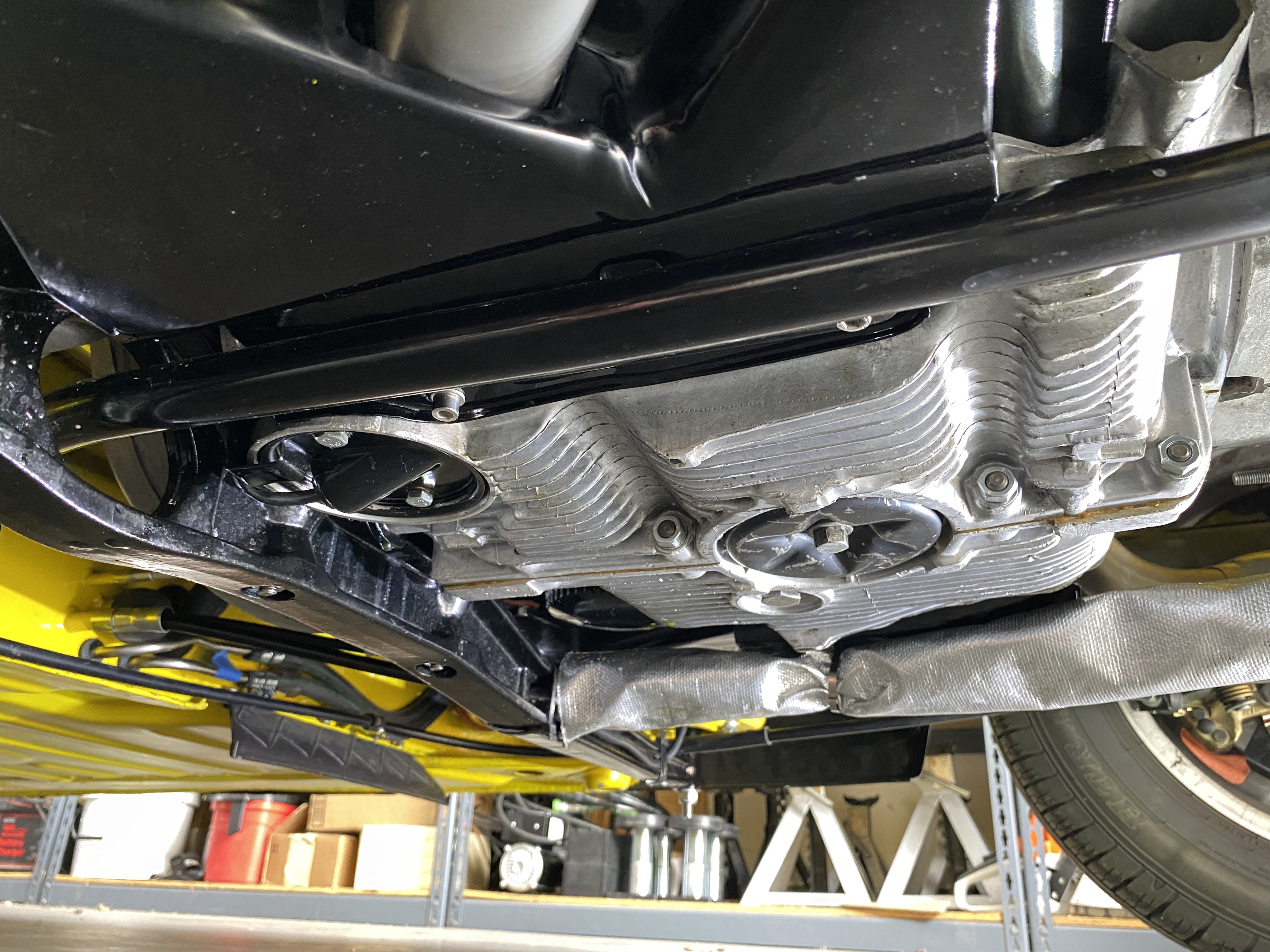

Finally, when I shut it off in the garage I did not see any oil leaks--yet.
Altogether, a good first drive for 2023. Now I can start building up my time driving my 914. Right now the ratio of drive to wrench time is about 1:1000.

Member No.: 23,343
QUOTE(FlacaProductions @ May 3 2023, 07:54 PM) *
Yes, around 70 to 80 at cold start. From what I have read, 10 psi at hot idle is normal.

Ok - interesting - thank you. Wonder why mine is so high...not that it's a bad thing, I guess...
