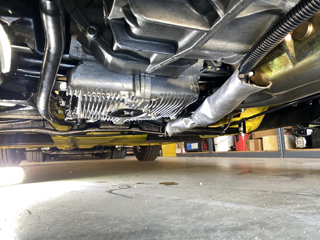

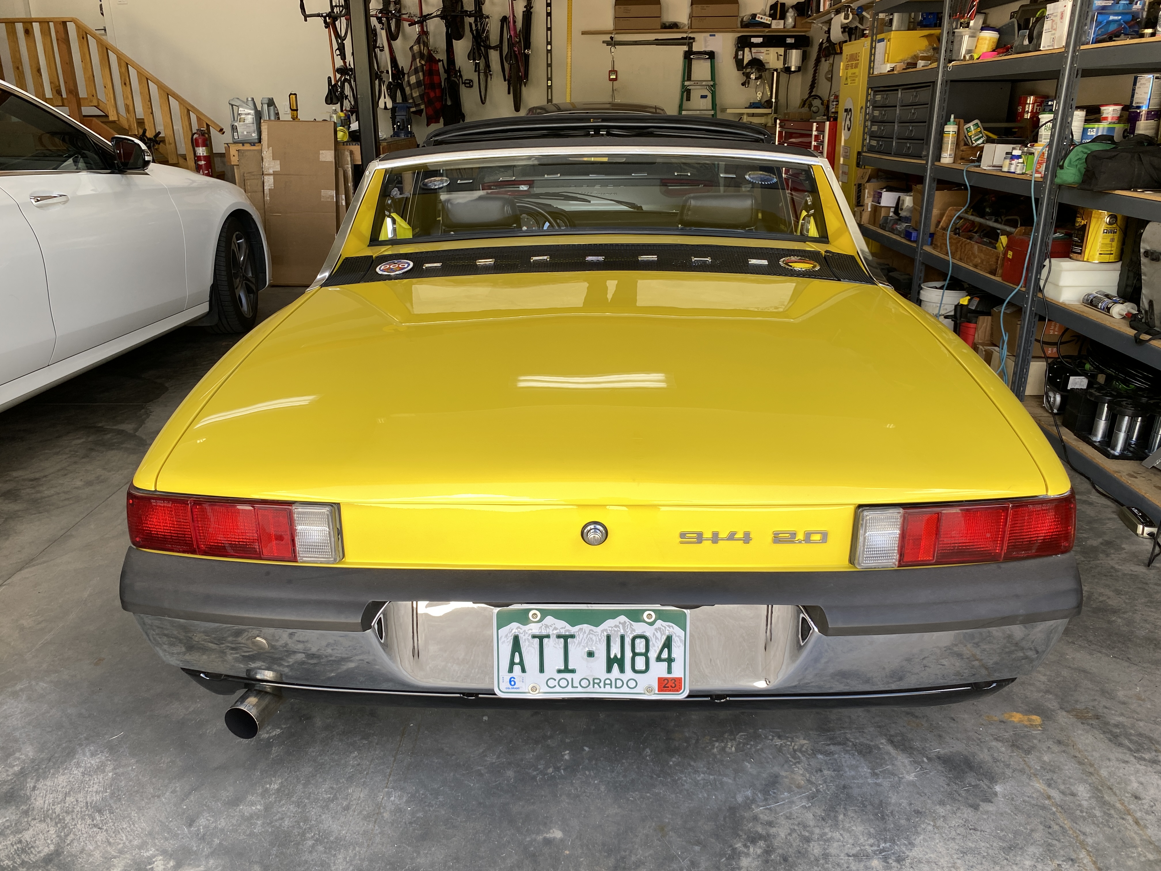

I looked under my 914, parked since I drove it home from C&C on Saturday.
Oil drips from near the front of the engine.
Fudging you know what!

QUOTE(bkrantz @ May 8 2023, 08:32 PM) *
i feel your pain lol! is that from the oil filter area?
Phil

QUOTE(DRPHIL914 @ May 9 2023, 06:55 AM) *
Phil
Seems more like center to left side. I am too frustrated to explore more right now. (IMG:style_emoticons/default/headbang.gif)

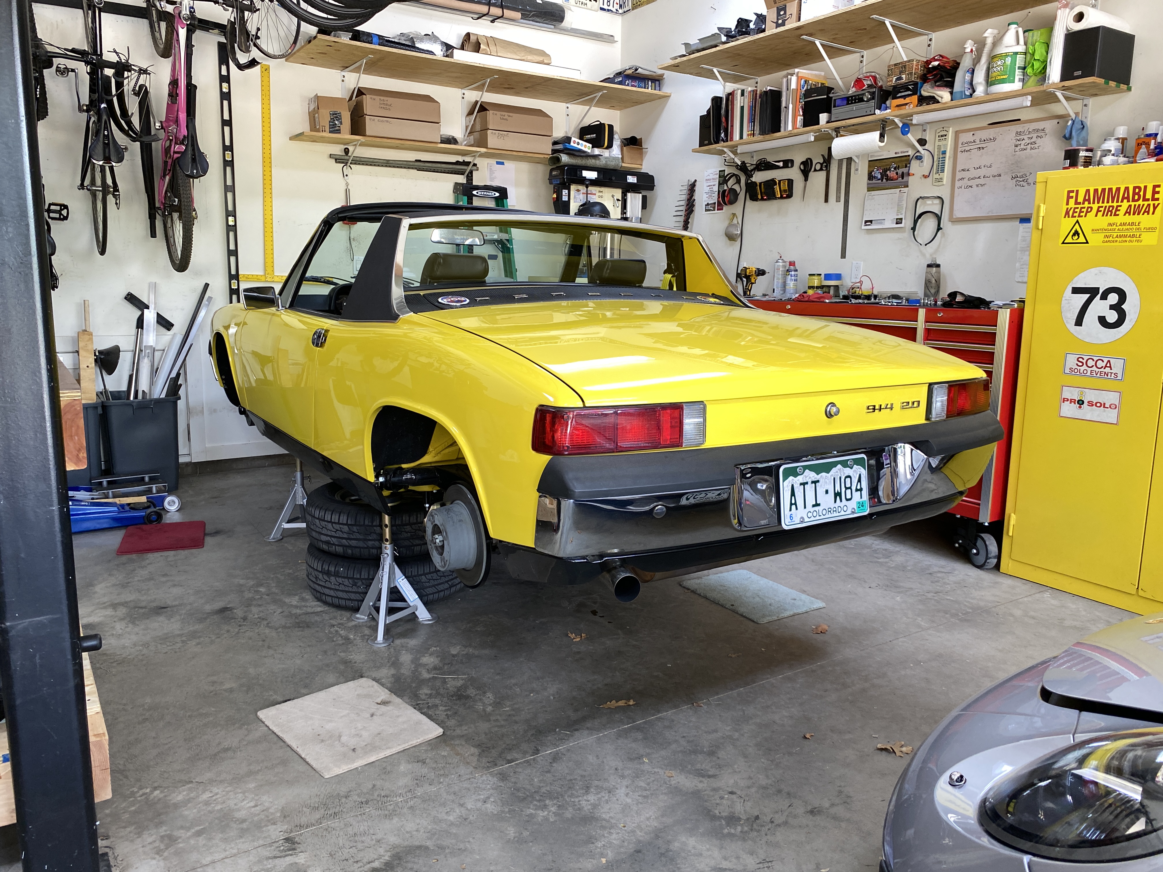

In any case, I put the car back on stands so I can check brake action and clearance.

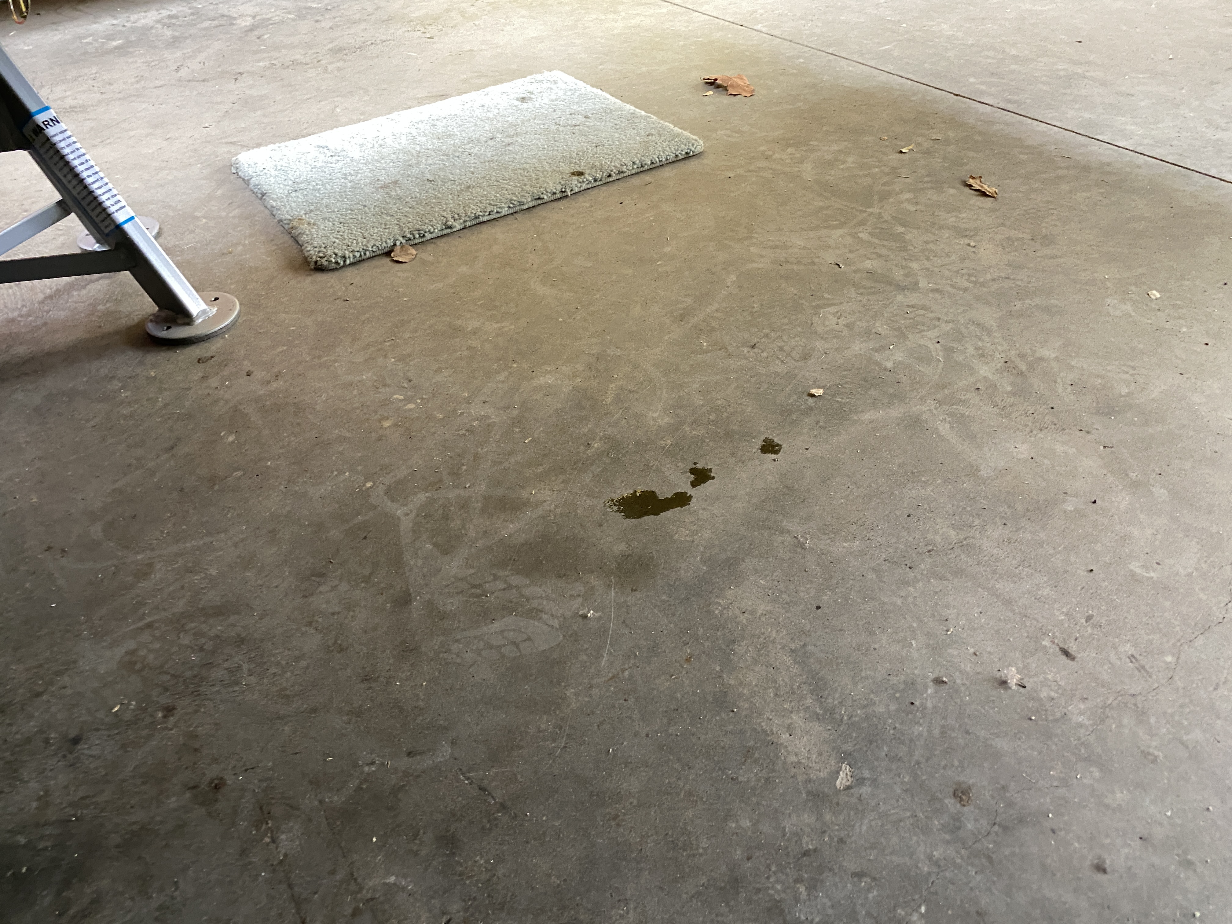

And I need to start looking for the oil leak source--again. Here is what dropped on the floor after driving for about 45 minutes today.
