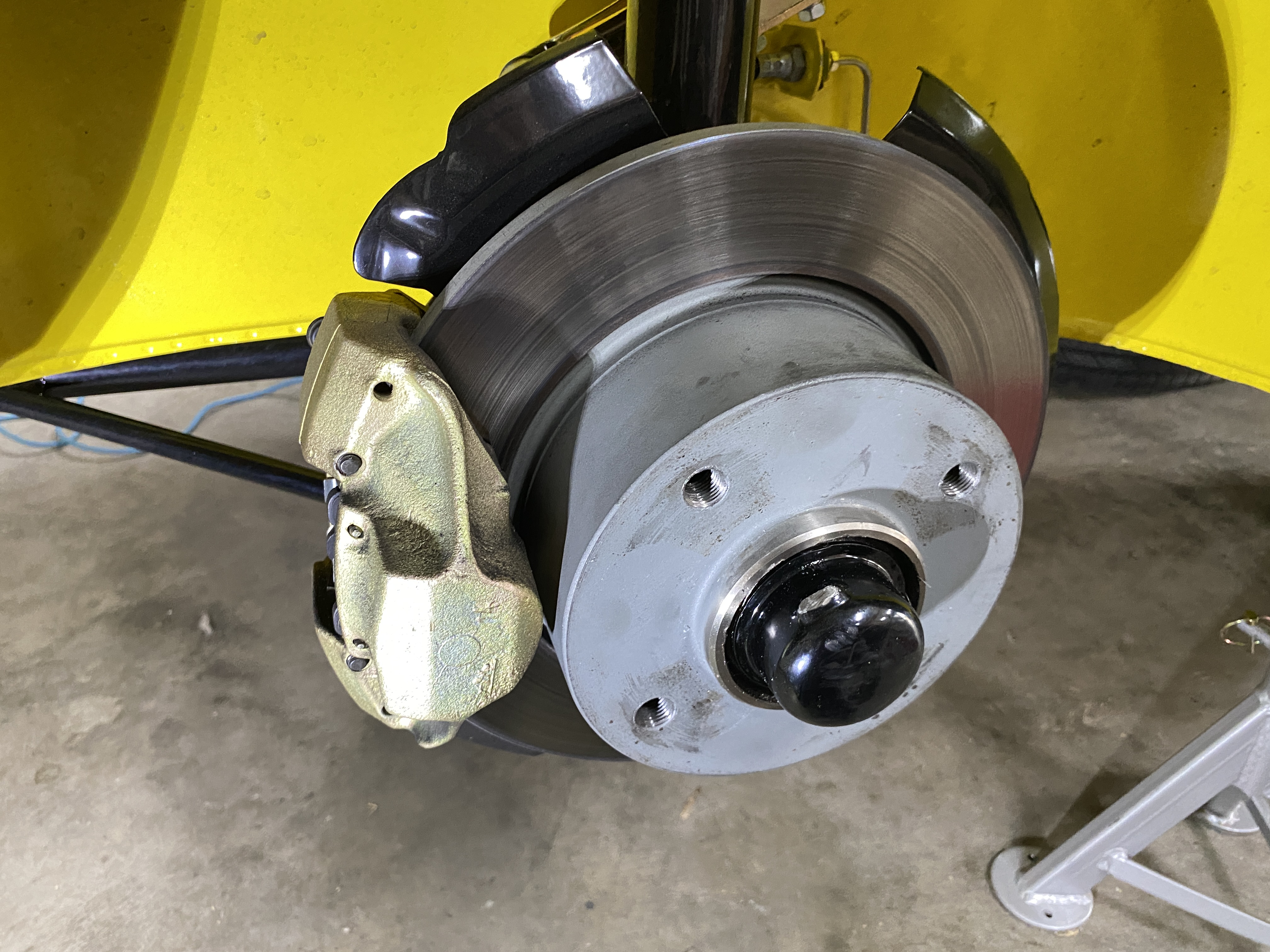

I did a quick review of the brakes today. Every looks good. Both fronts spin freely, and no signs of drag or overheating.

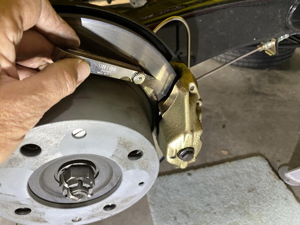

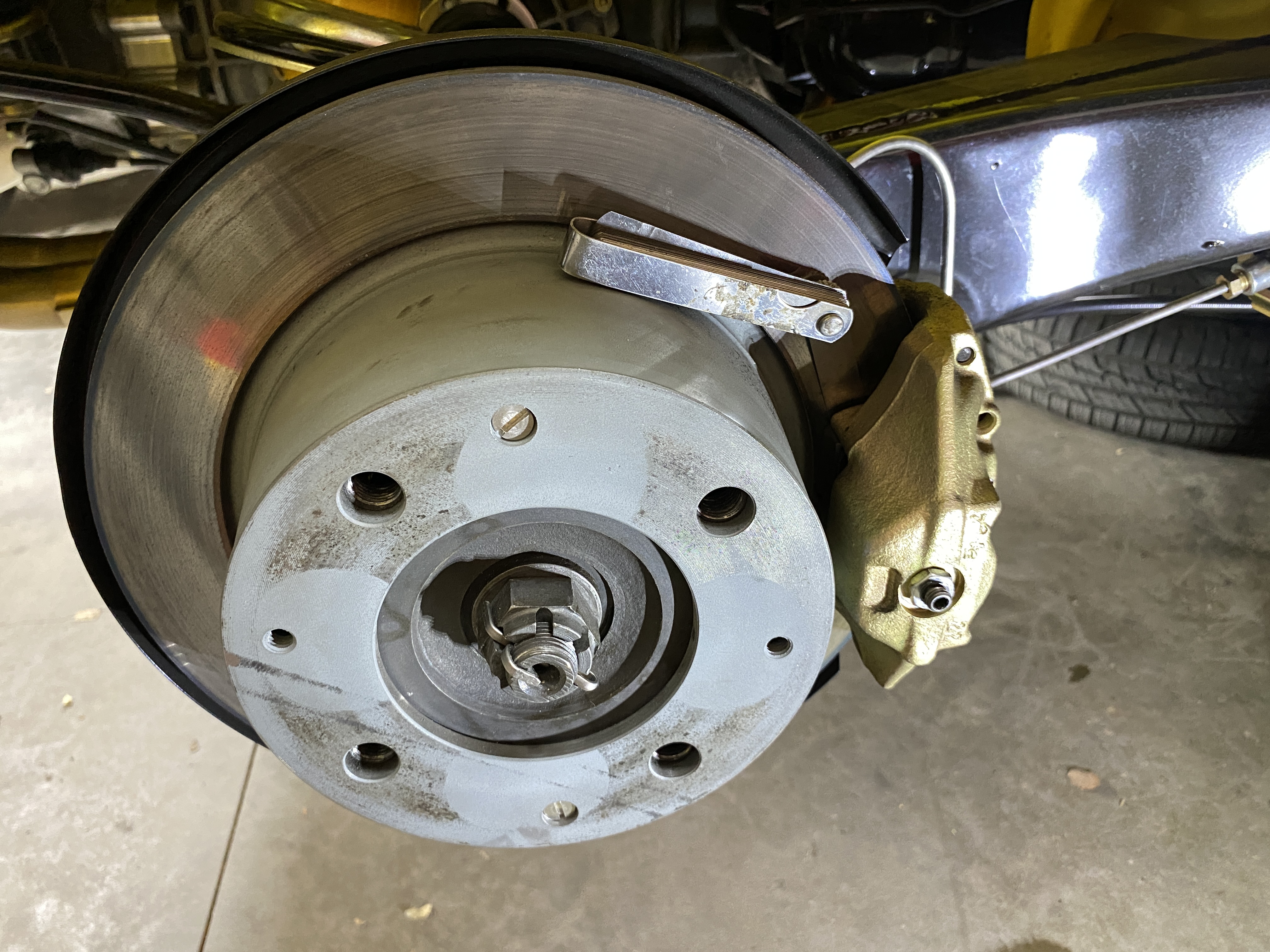

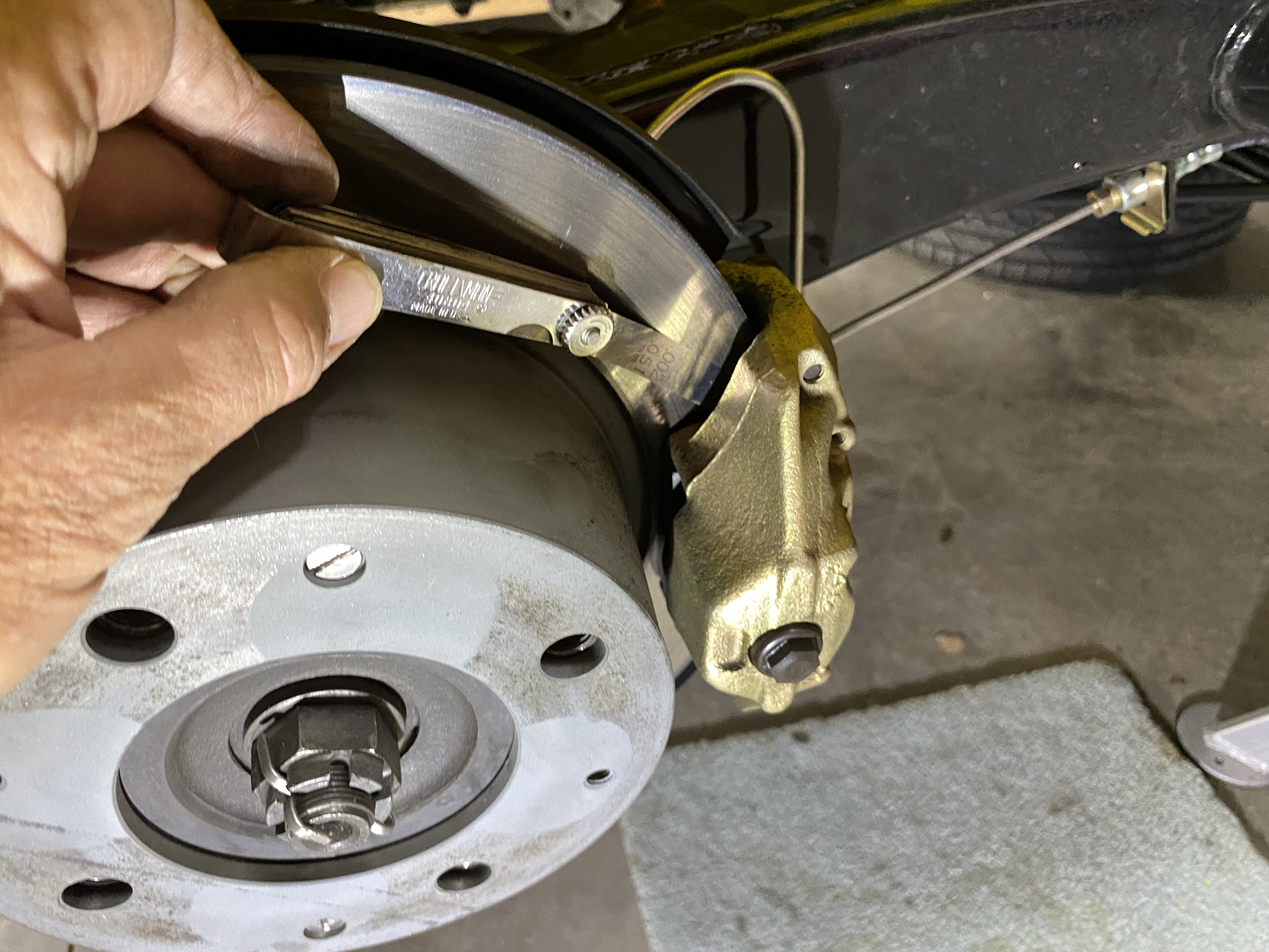

The rears also look good and spin. But the clearance on both sides dropped to less than .002".

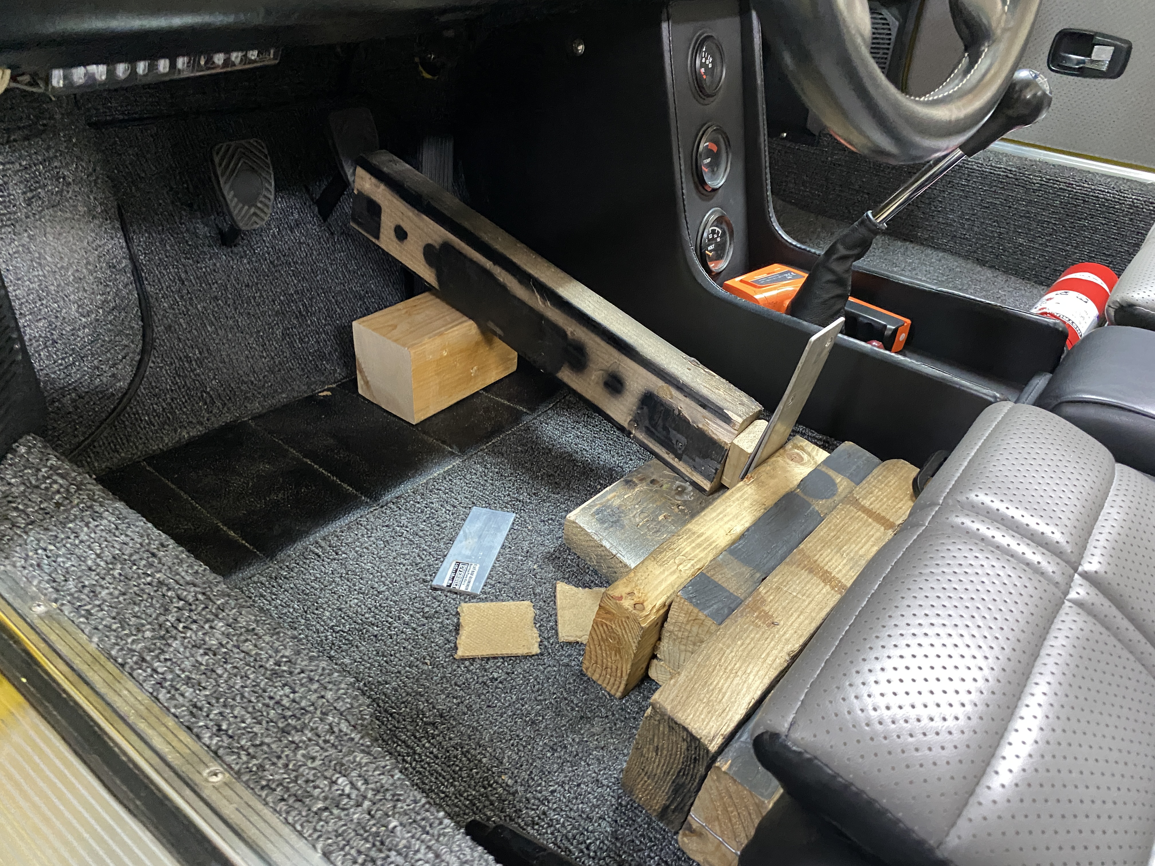

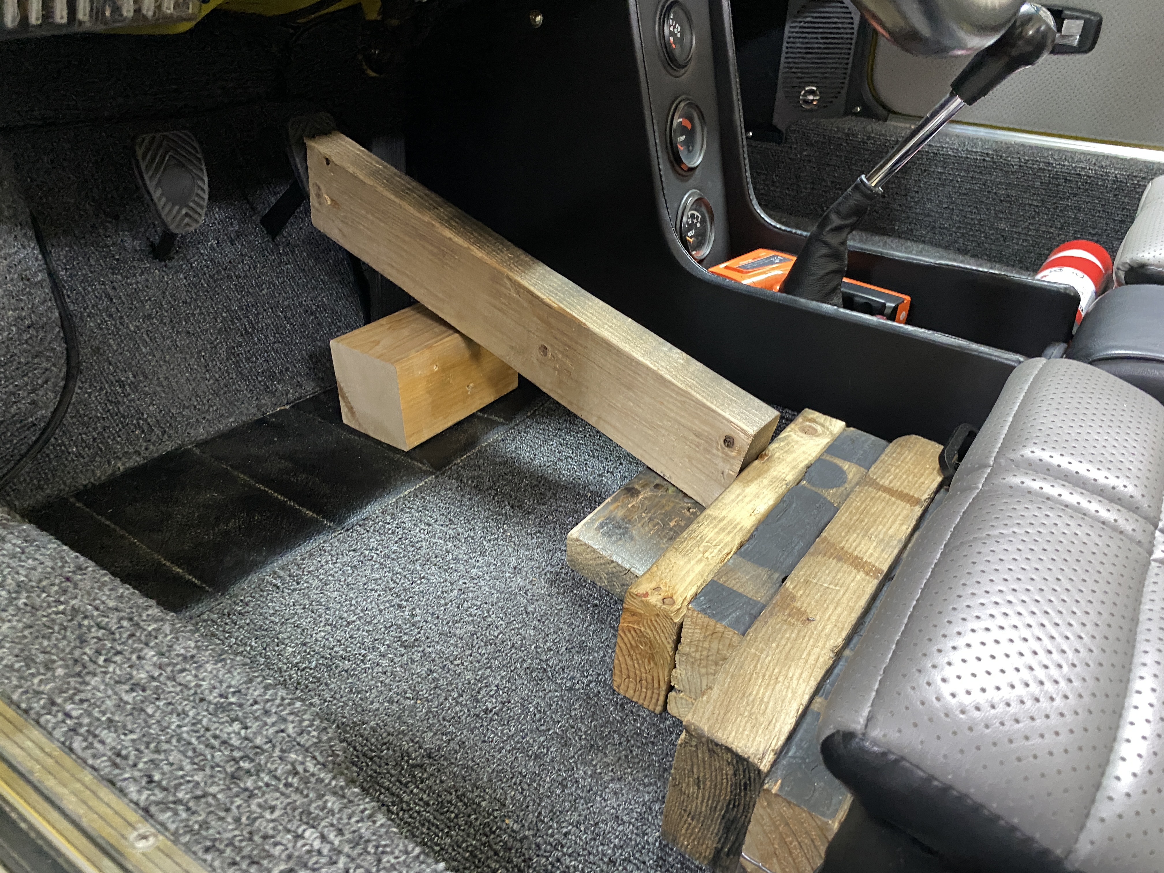

For my next test, I set up a prop for the brake pedal so I could gradually add pressure. Here's what I found.
With just a small amount of pressure after taking up the free-play, both fronts had a small amount of drag, and equal L and R. Both rears spun freely.
With a bit more pressure, both fronts locked up (at least with hand power on the disks). Both rears could still move, with slight drag, again equal L and R.
And with more pressure, all 4 wheels locked up.
Seems good, but I want to check it again tomorrow.

I set the rear brake pad clearance to .005" (not sure how the similar gap I set months ago got closed to new zero).

And again I tested brake action from L to R as I very gradually stepped on the brake pedal, with my fancy robot driver. Both front and rear braking was very equal side to side.

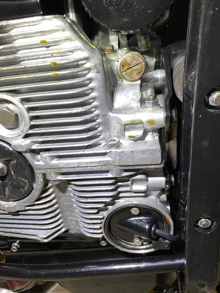

And then the big problem. Where is the oil leak? Here's a photo before I did any cleaning. I will do that and then try the UV dye.

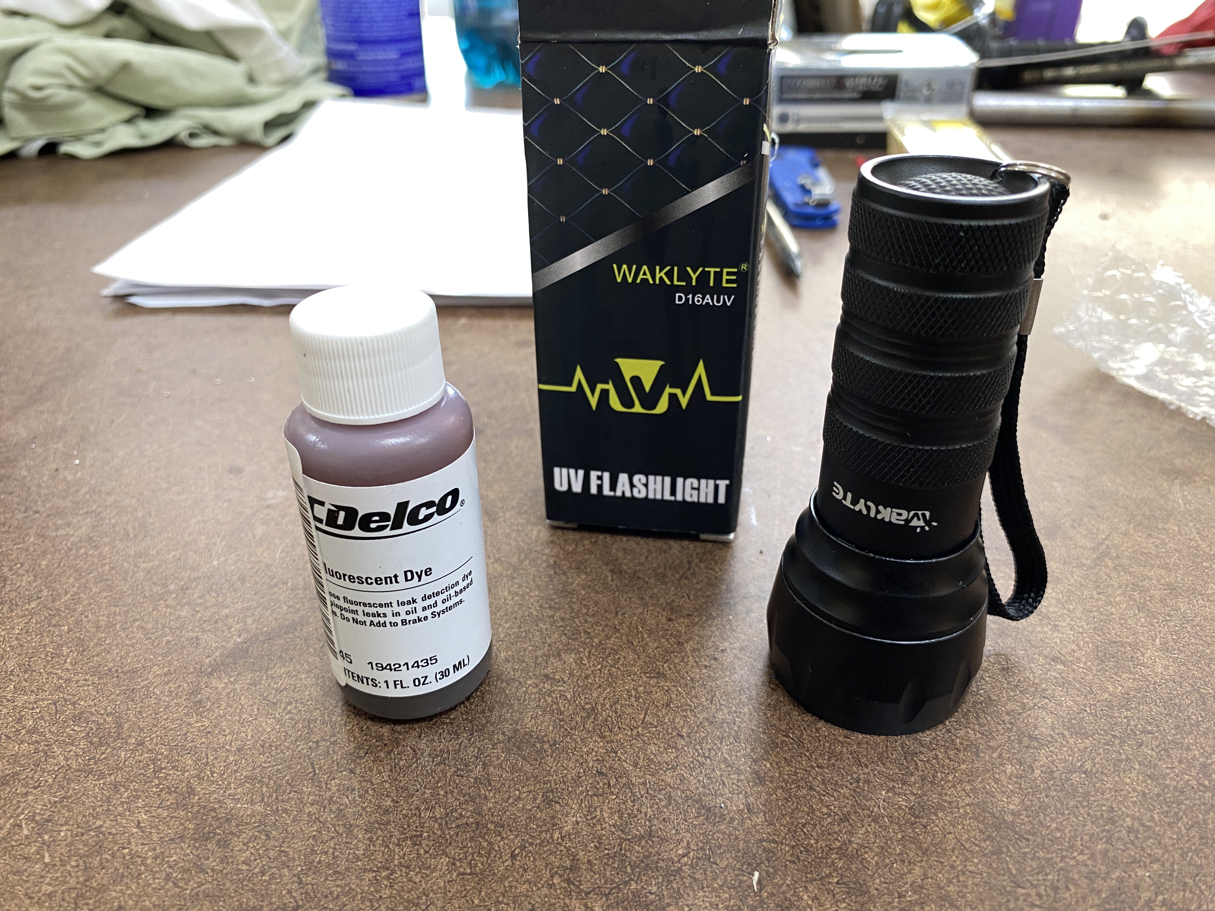

Getting ready for finding the oil leak with my new UV light and dye.

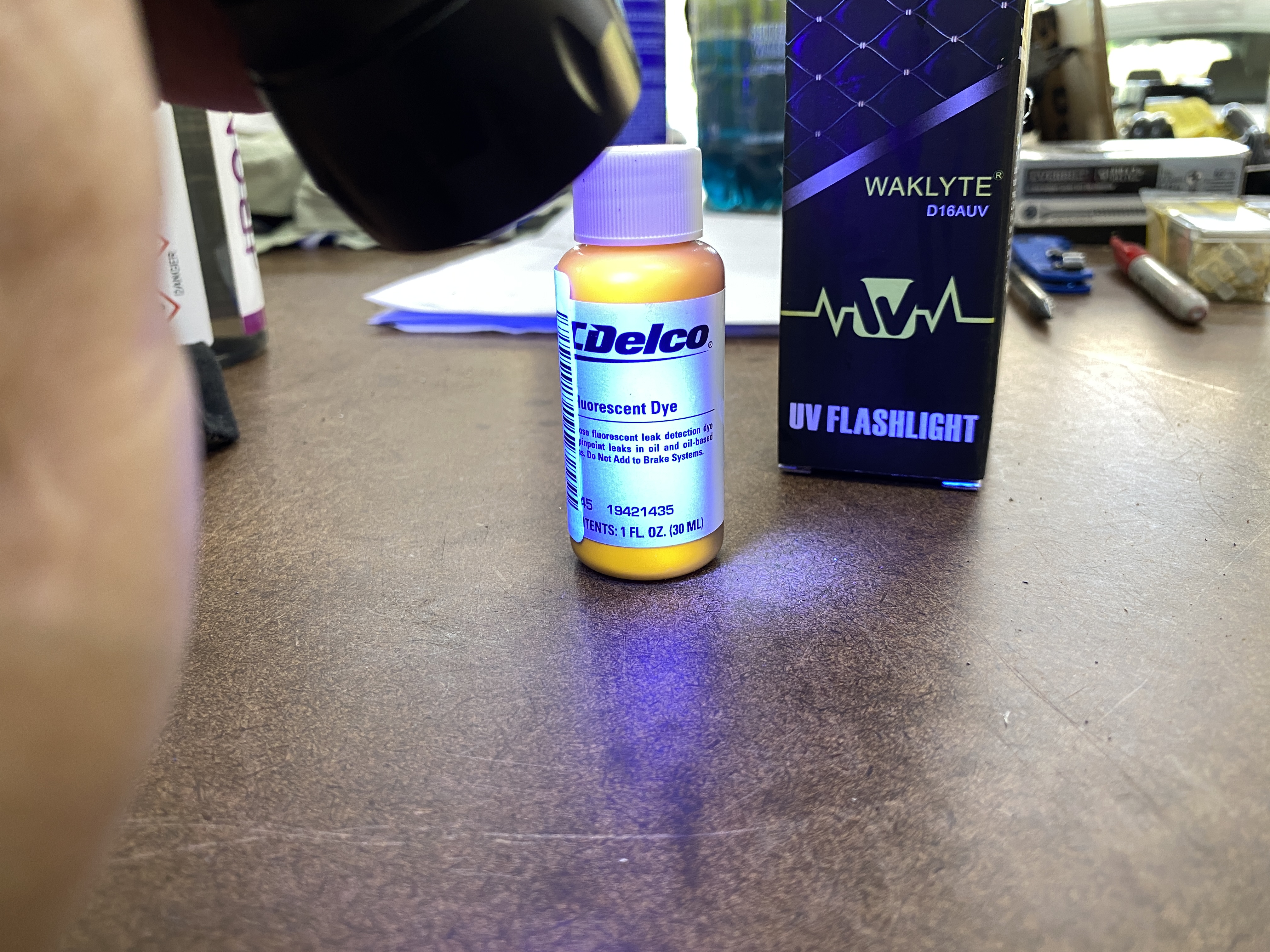

Just testing, and the light makes the dye glow bright yellow-orange.

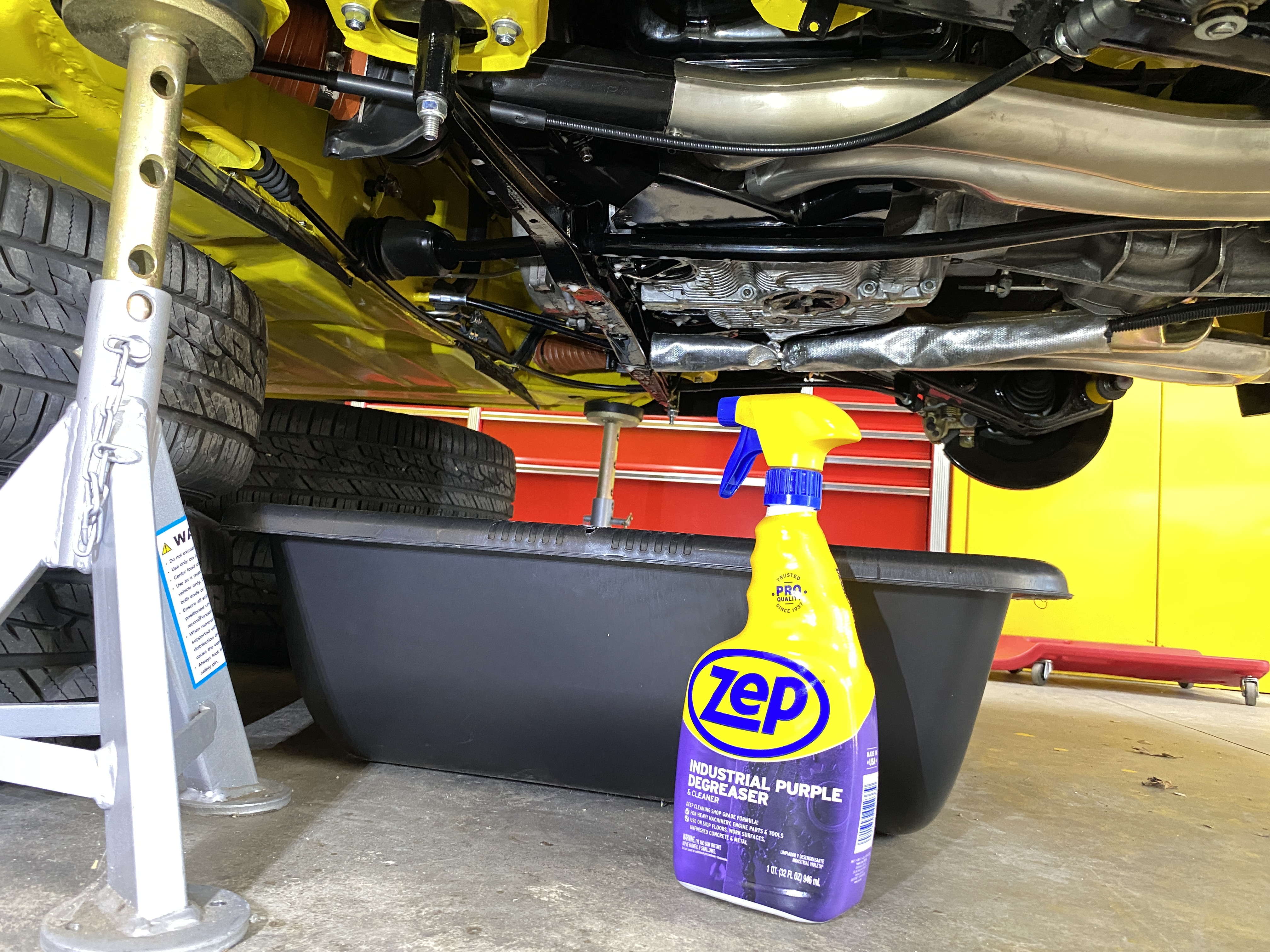

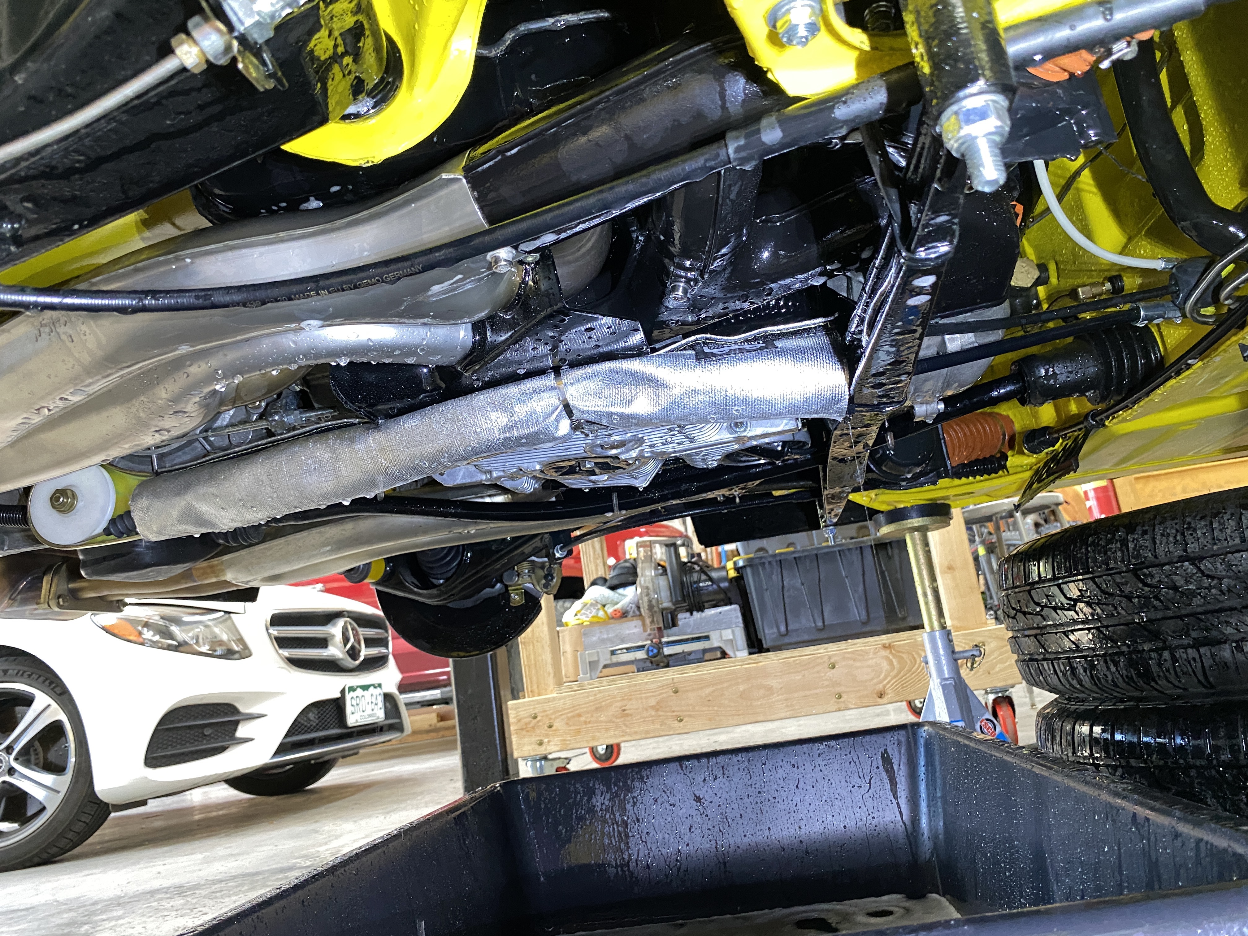

I figured I should clean off as much oil as possible, so I first wiped everything I could reach and then drenched the motor top and bottom with cleaner.

And then flushed it all with water. Once it dries I can get ready for the dye test.

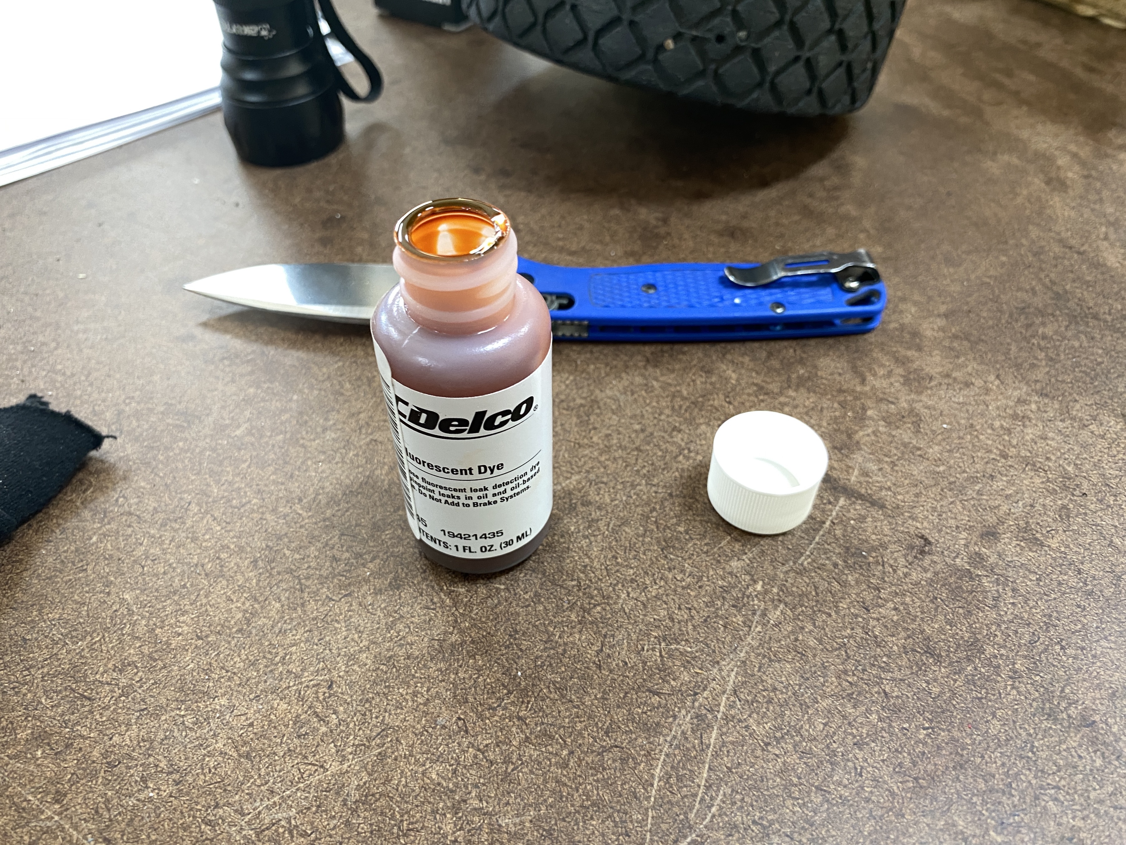

Here we go, with the AC Delco fluorescent dye.

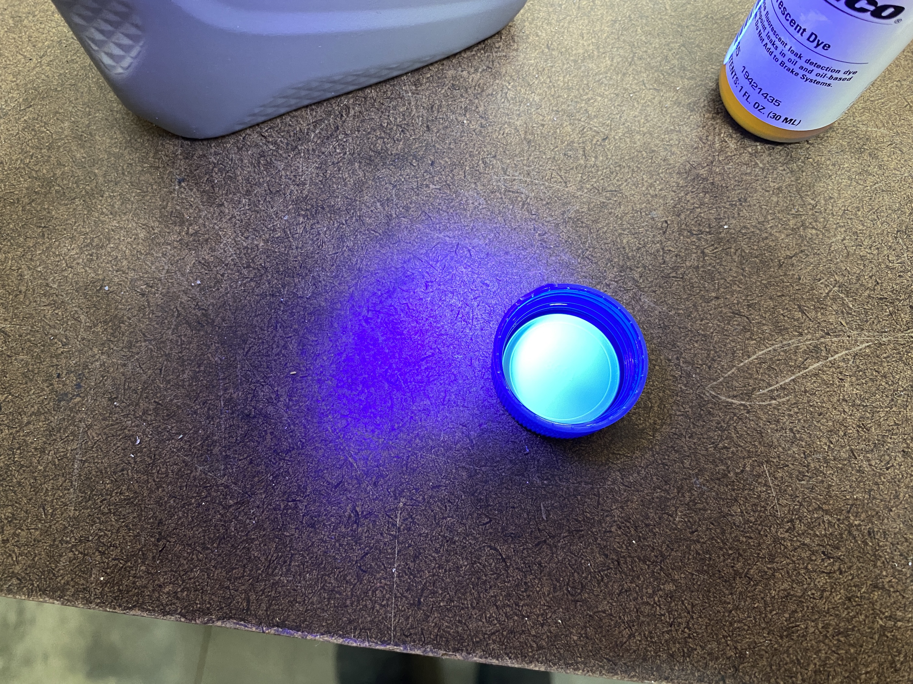

Just to check, the Valvoline 20W-50 I used glows light blue in UV light.
