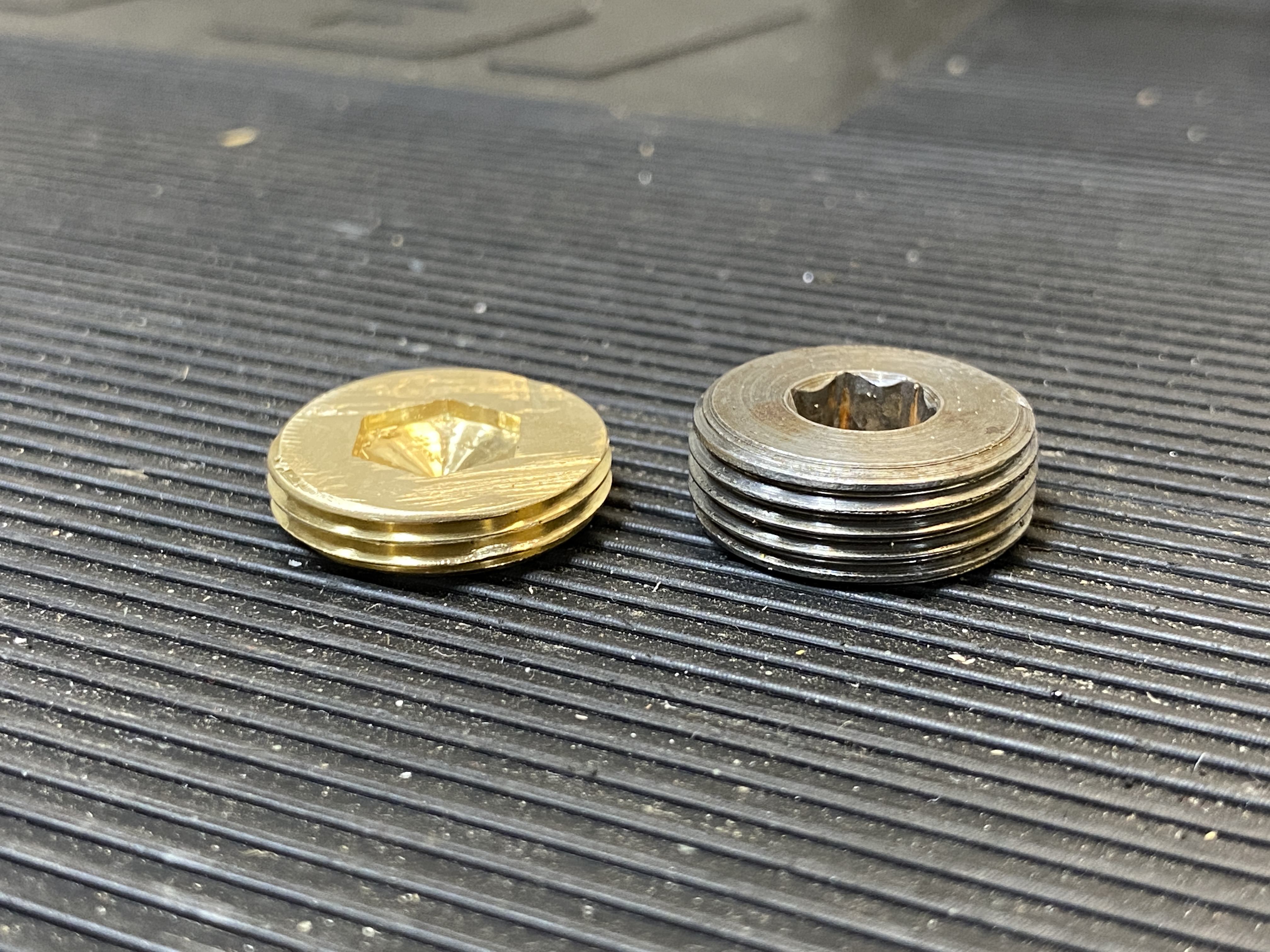

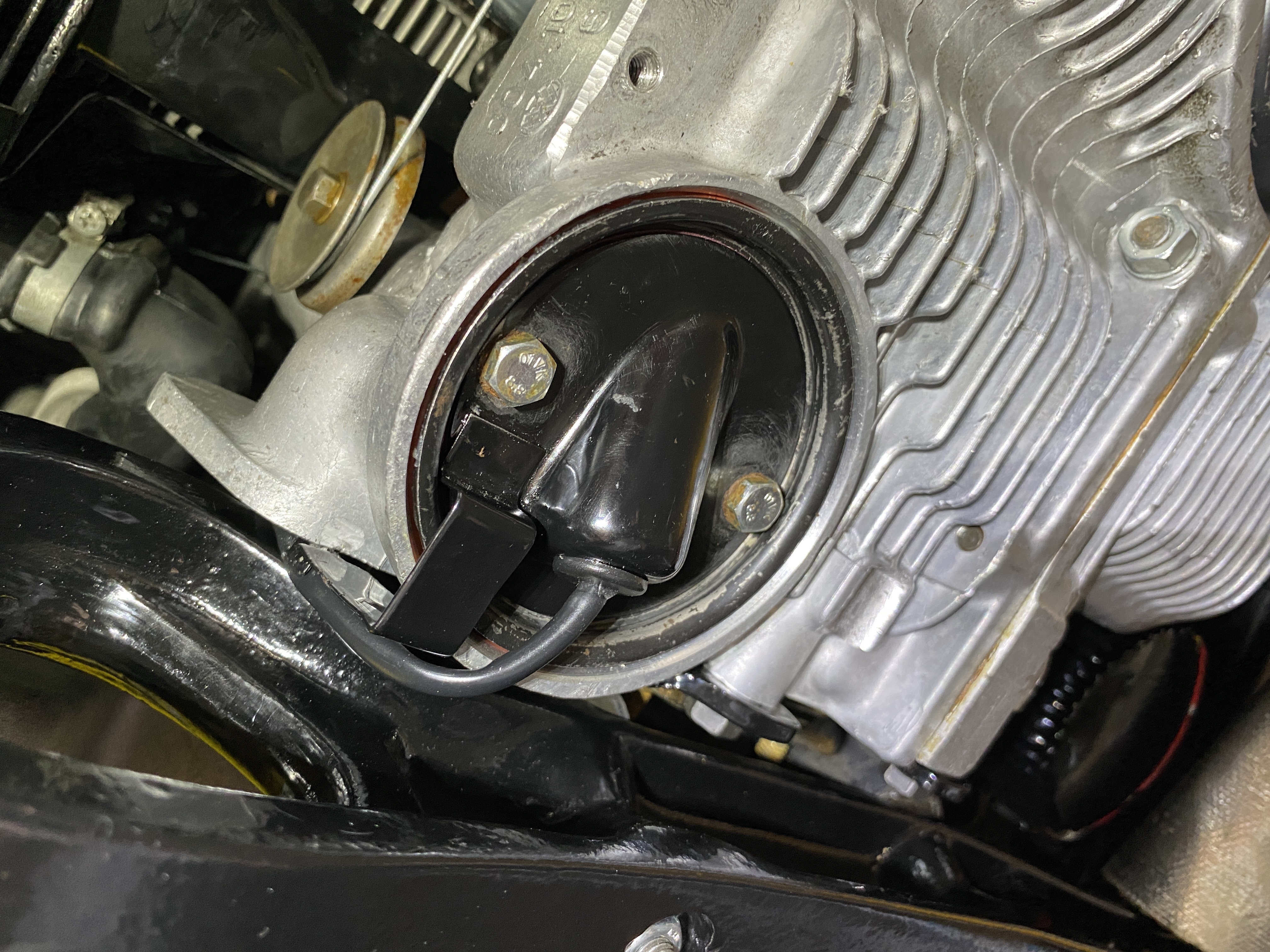

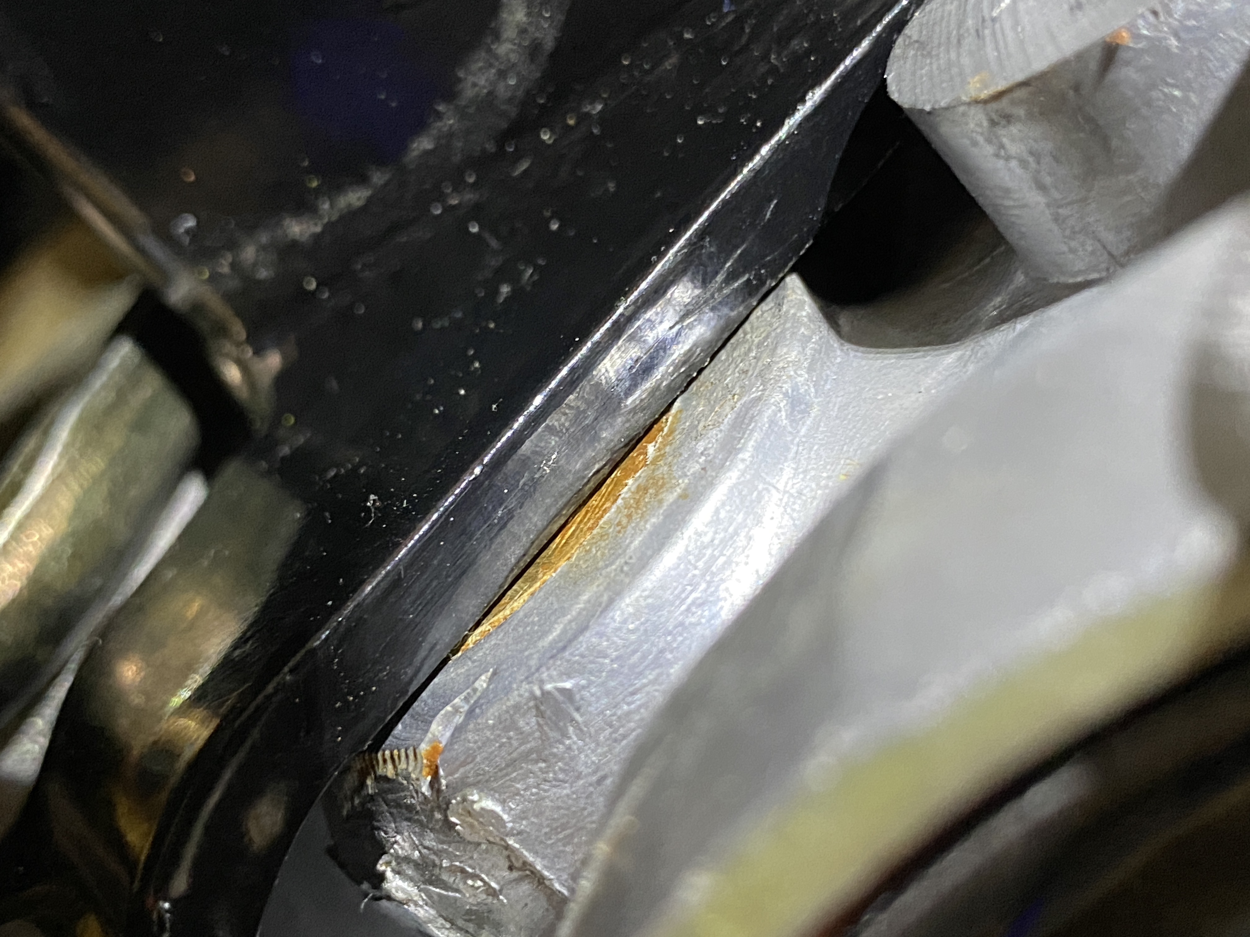

A reminder, the stock plug screws in flush to clear the motor mount bracket.
bkrantz
post Jul 10 2023, 07:37 PM
Post #6662
Posts: 8,746
Joined: 3-August 19
From: SW Colorado
Member No.: 23,343

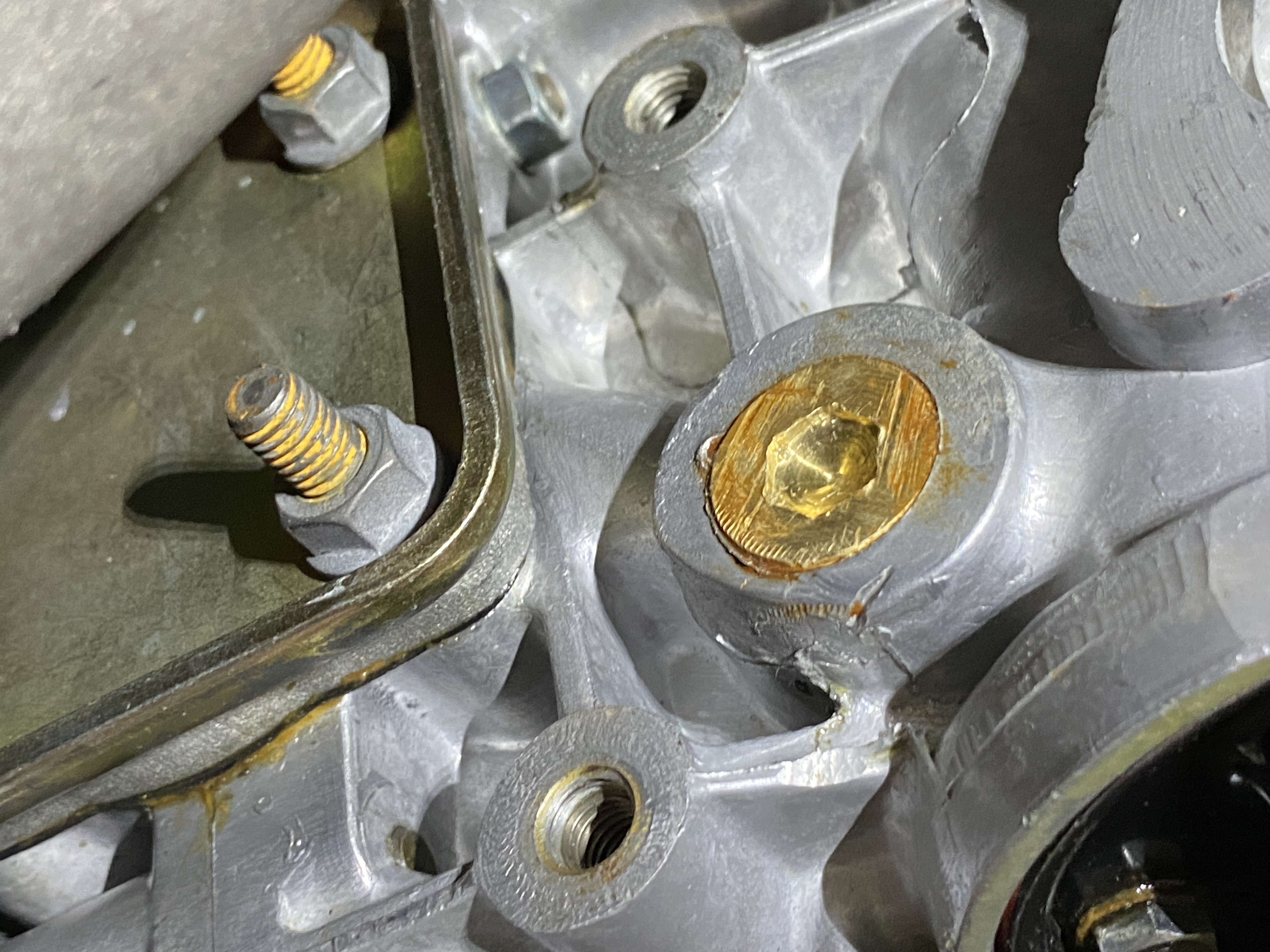

So I tried this, and cut off as much of the plug top as I could and still left enough of the hex to (barely) seat the Allen wrench.
bkrantz
post Jul 10 2023, 07:39 PM
Post #6663
Posts: 8,746
Joined: 3-August 19
From: SW Colorado
Member No.: 23,343

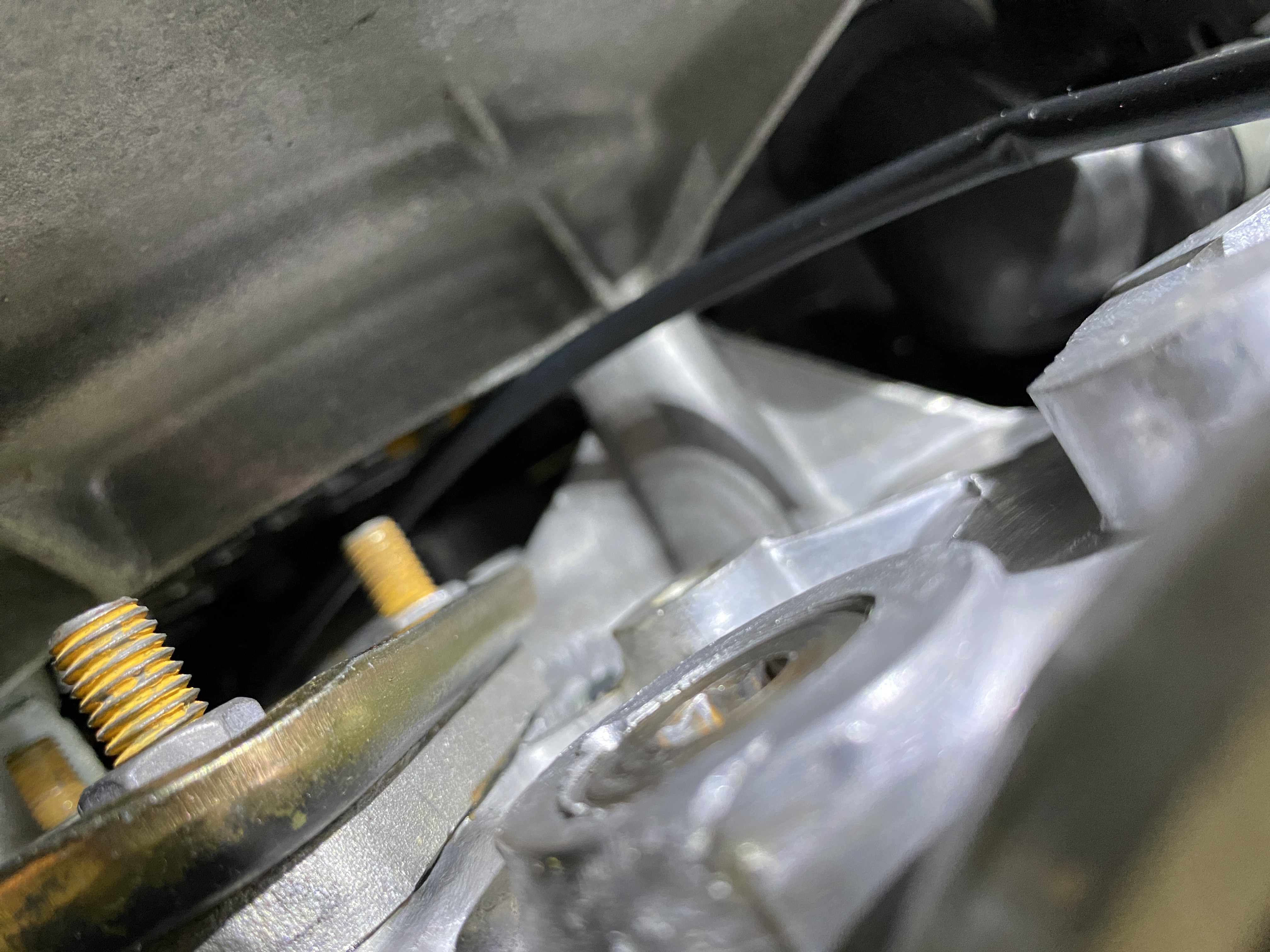

A test fit, and without torquing too hard I got it almost flush. I did grind the end of my 10mm Allen wrench to get some sharp corners.
bkrantz
post Jul 10 2023, 07:41 PM
Post #6664
Posts: 8,746
Joined: 3-August 19
From: SW Colorado
Member No.: 23,343
And a new goo to try, hard-setting Permatex. I rubbed a bit of this into the case hole threads, and then coated the plug threads.

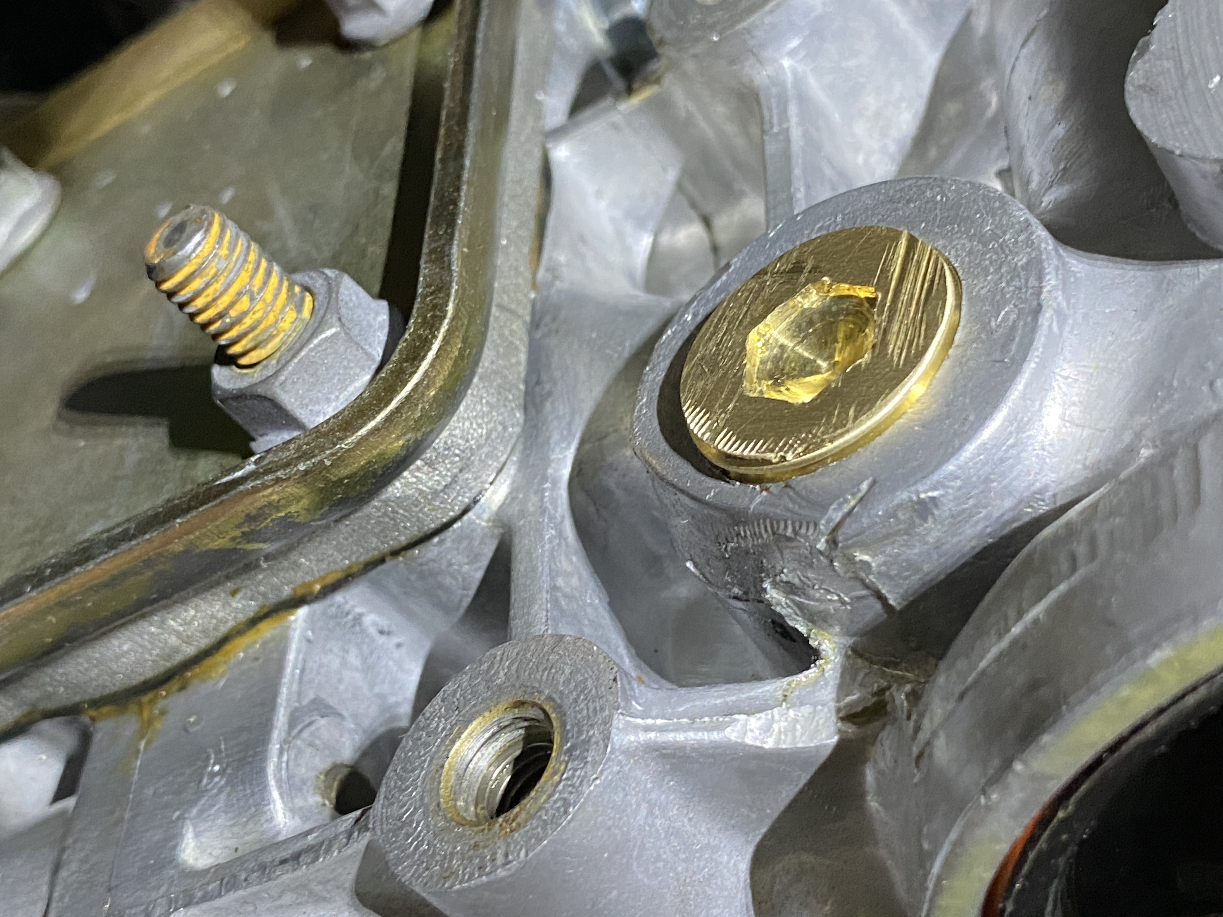

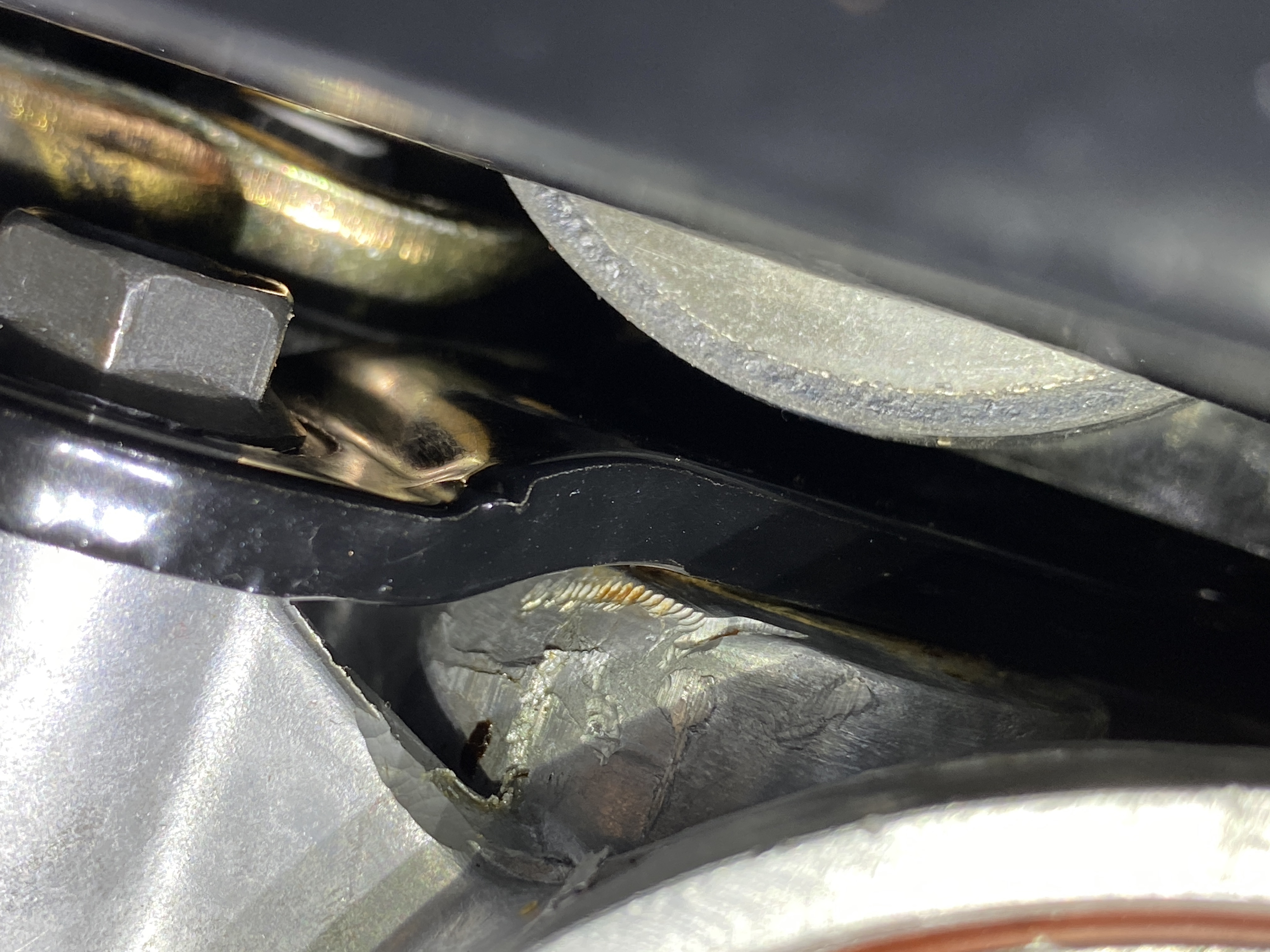

I was able to screw the plug in almost flush. I did not want to risk slipping the wrench and ruining the plug.
bkrantz
post Jul 10 2023, 07:47 PM
Post #6666
Posts: 8,746
Joined: 3-August 19
From: SW Colorado
Member No.: 23,343
Just enough clearance for the motor mount.
I bolted in the cross bar, and will wait at least 48 hours before I try to run the engine.

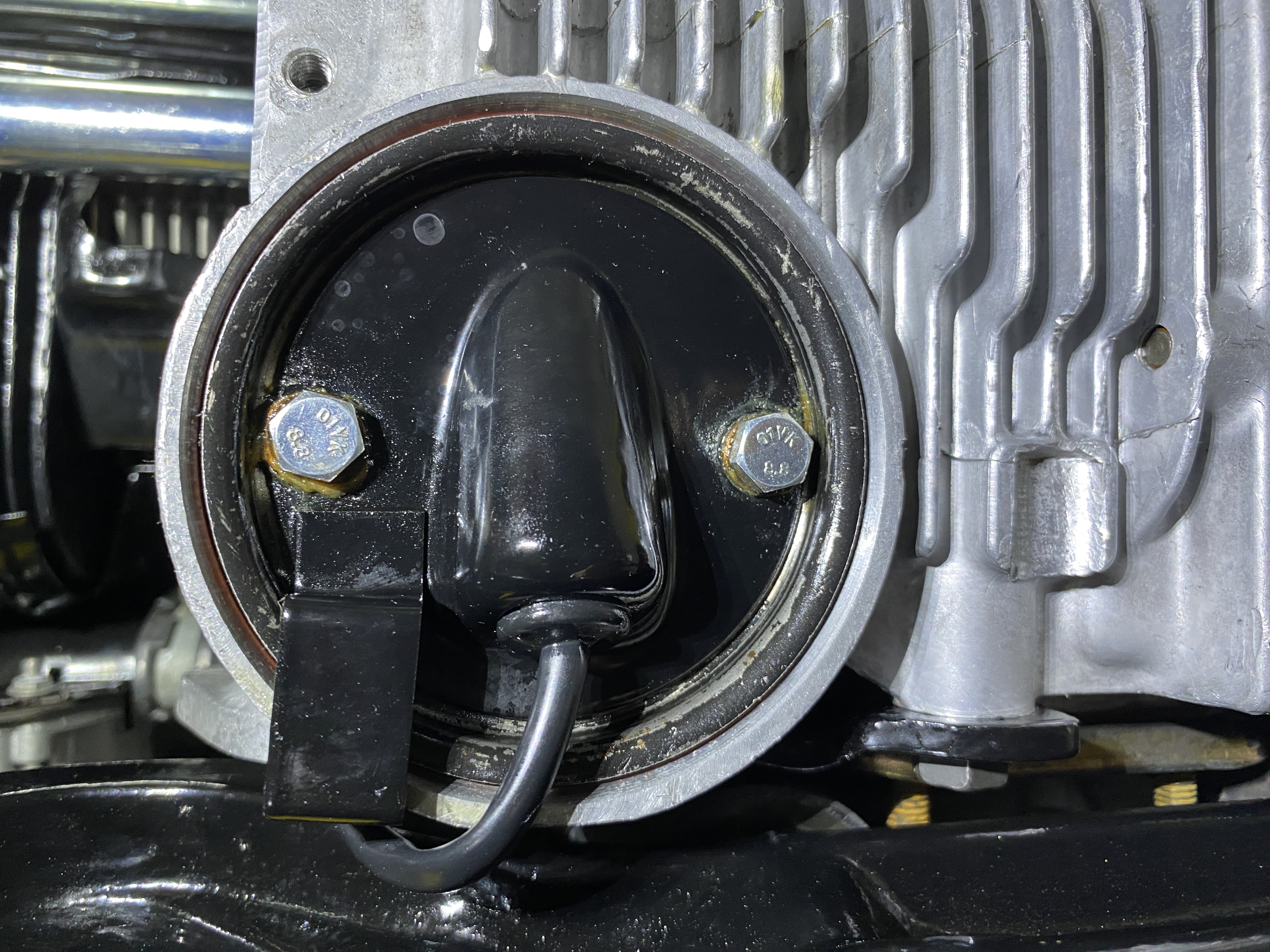

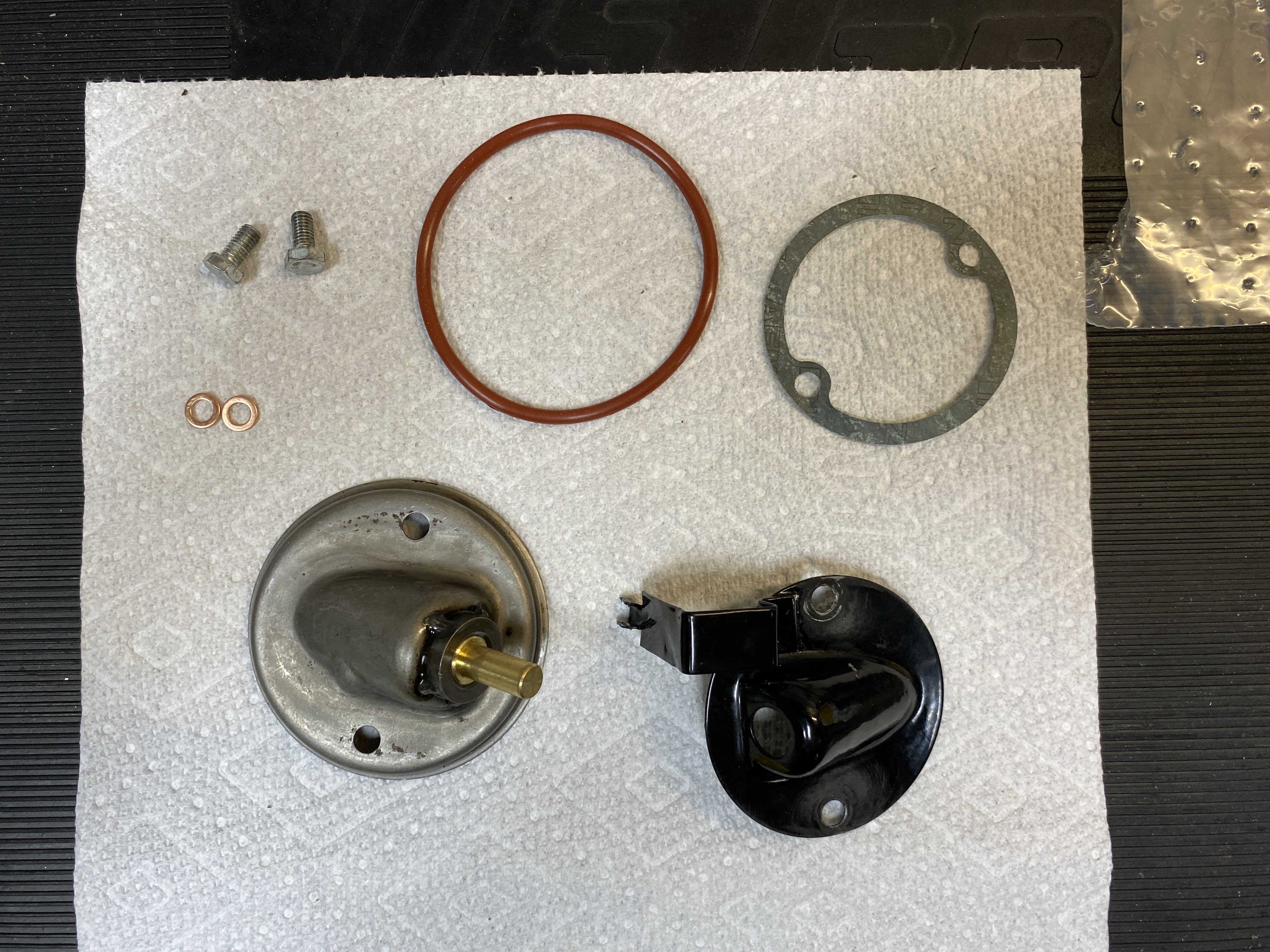

Still letting my latest plug attempt cure. I decided to replace the taco plate seals since there seems to be some weeping there.
bkrantz
post Jul 11 2023, 06:49 PM
Post #6668
Posts: 8,746
Joined: 3-August 19
From: SW Colorado
Member No.: 23,343
All the parts, with new O-ring, gasket, and copper washers.
bkrantz
post Jul 11 2023, 06:50 PM
Post #6669
Posts: 8,746
Joined: 3-August 19
From: SW Colorado
Member No.: 23,343
All set, with a dab of sealant under the bolt heads.

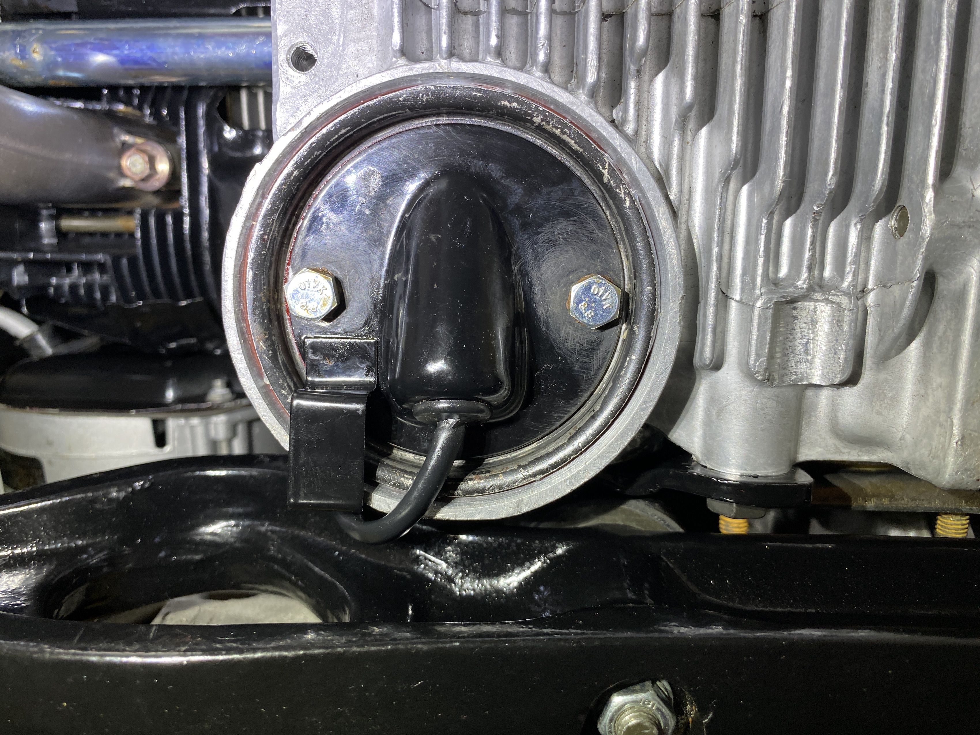

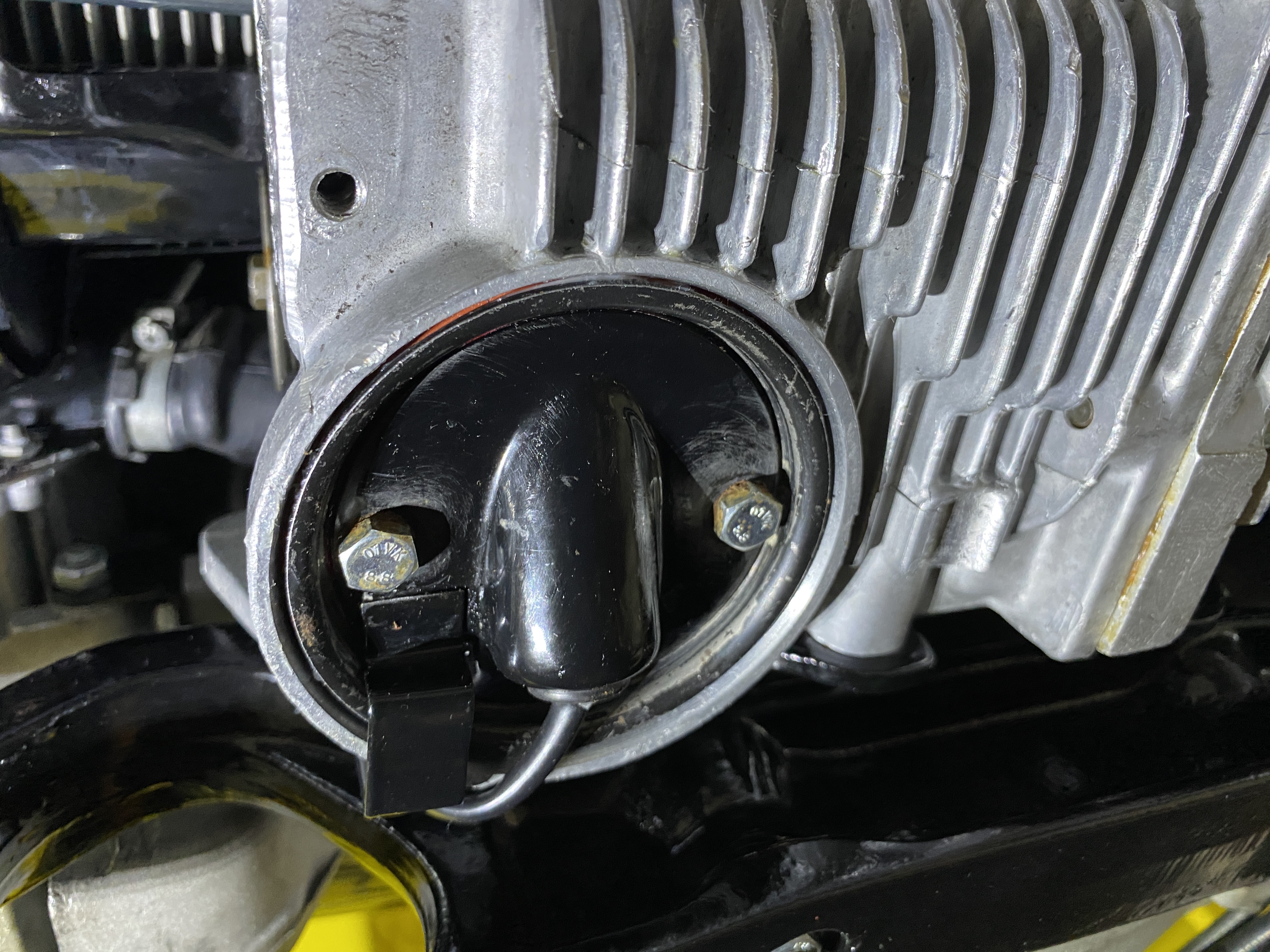

After giving the Permatex 72 hours to set, I ran the engine for about 20 minutes, enough to get it close to hot. No visible leaks from the brass plug.
bkrantz
post Jul 13 2023, 06:58 PM
Post #6671
Posts: 8,746
Joined: 3-August 19
From: SW Colorado
Member No.: 23,343
The taco plate is dry, too. But I need to let it cool down overnight to be more sure.

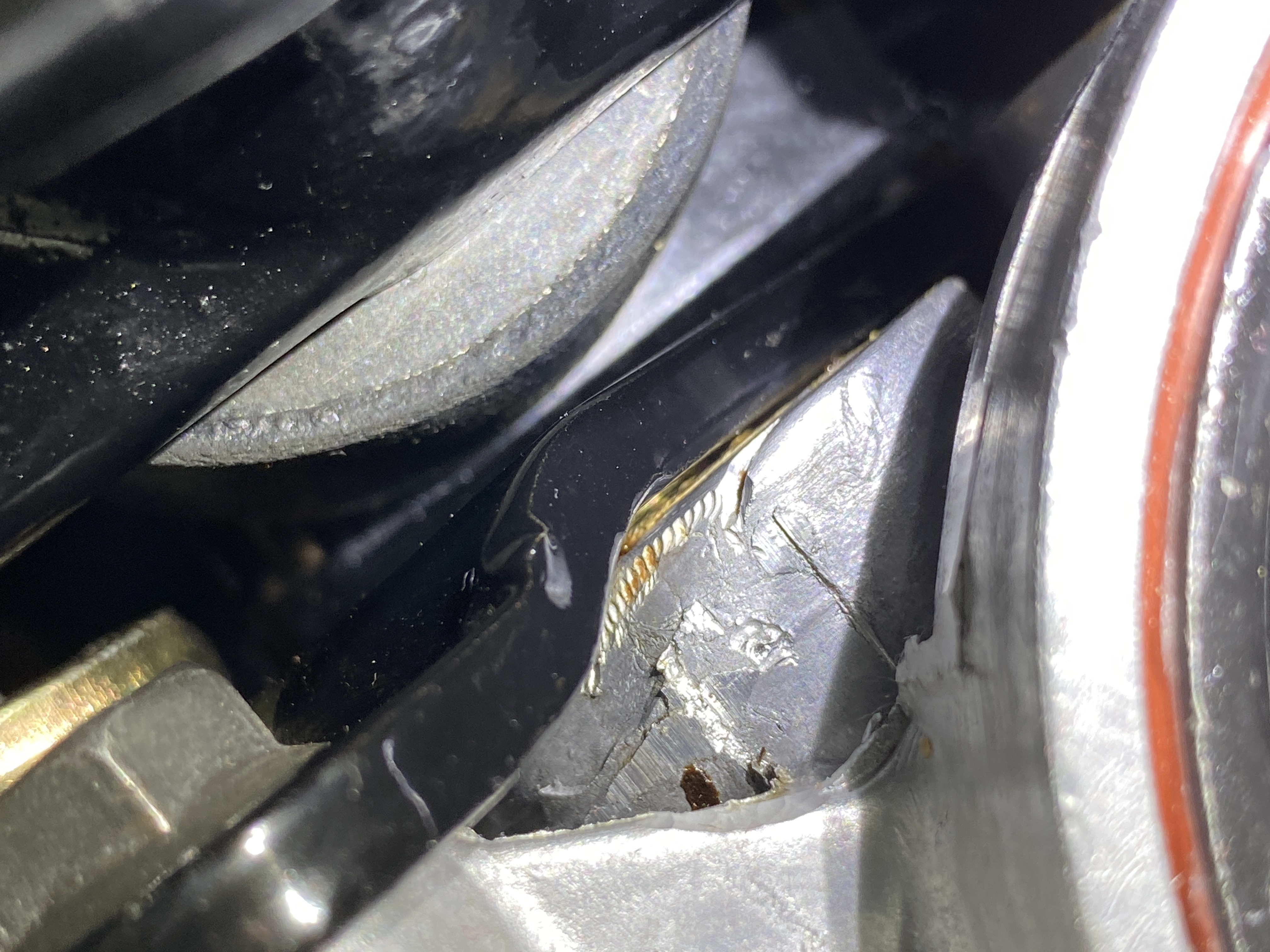

Well, I took a quick look this morning...
bkrantz
post Jul 14 2023, 07:35 PM
Post #6675
Posts: 8,746
Joined: 3-August 19
From: SW Colorado
Member No.: 23,343
No oil drips!
bkrantz
post Jul 14 2023, 07:37 PM
Post #6676
Posts: 8,746
Joined: 3-August 19
From: SW Colorado
Member No.: 23,343
And as best I can see, the new plug is also dry.
I don't want to jinx things, so I will not even think about claiming success. But I do feel good enough to put everything back together and take the car for a drive.
