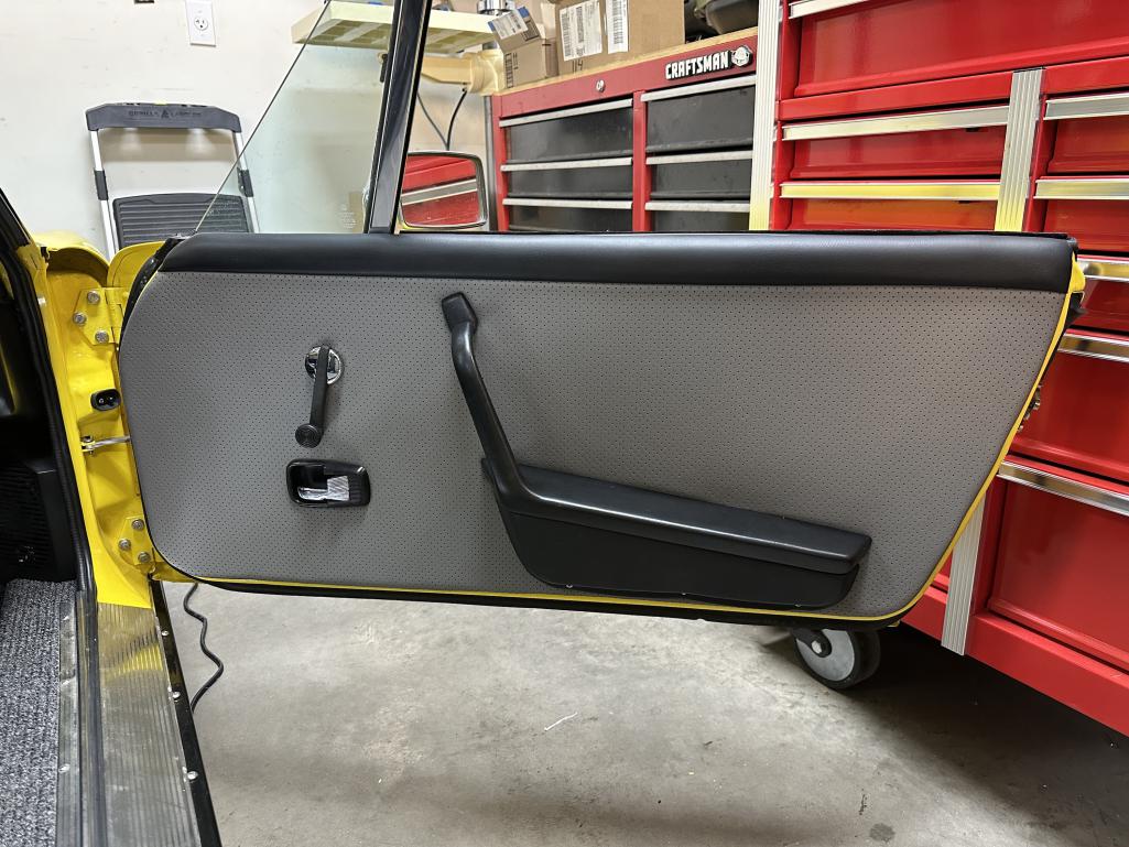

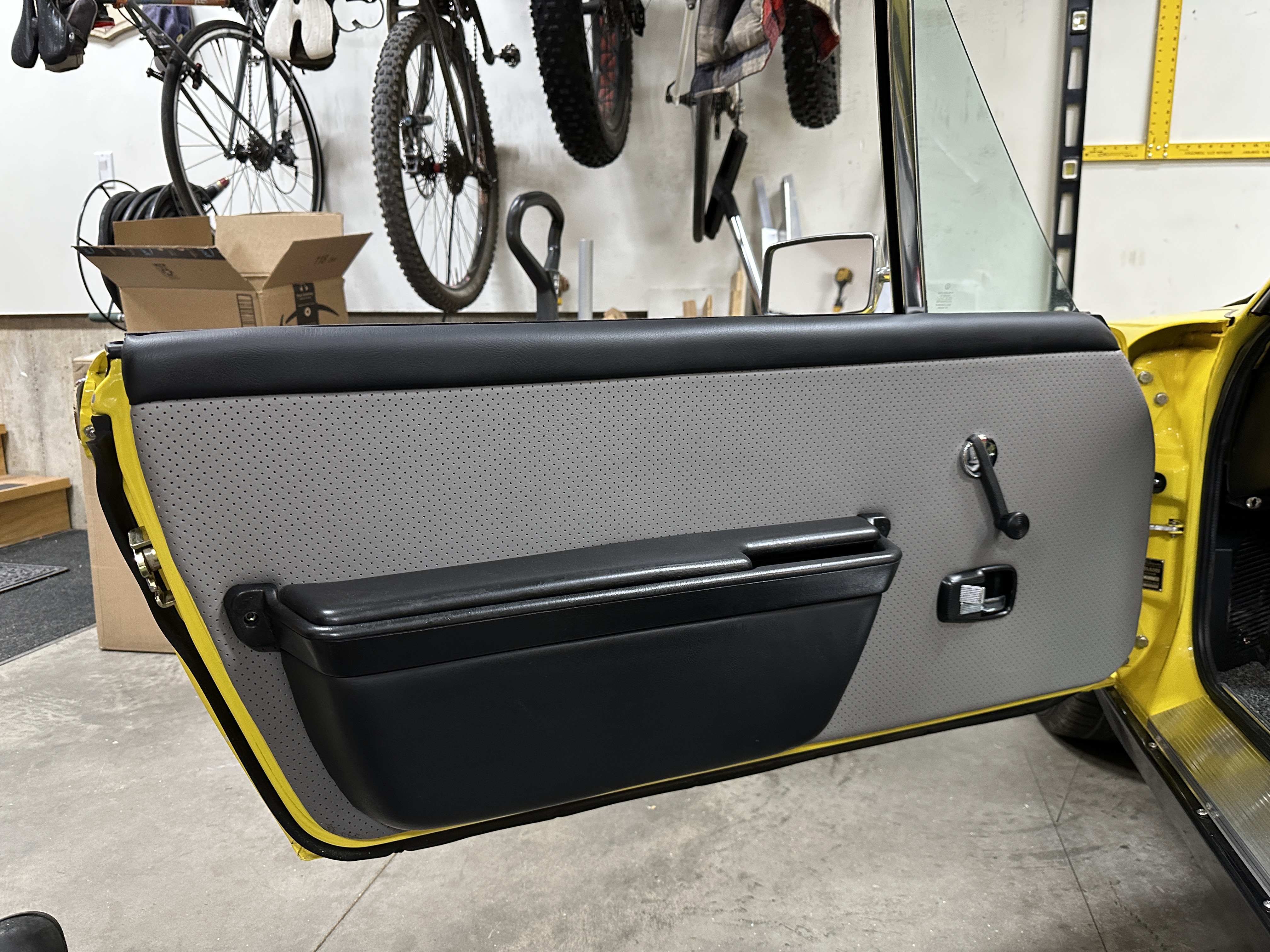

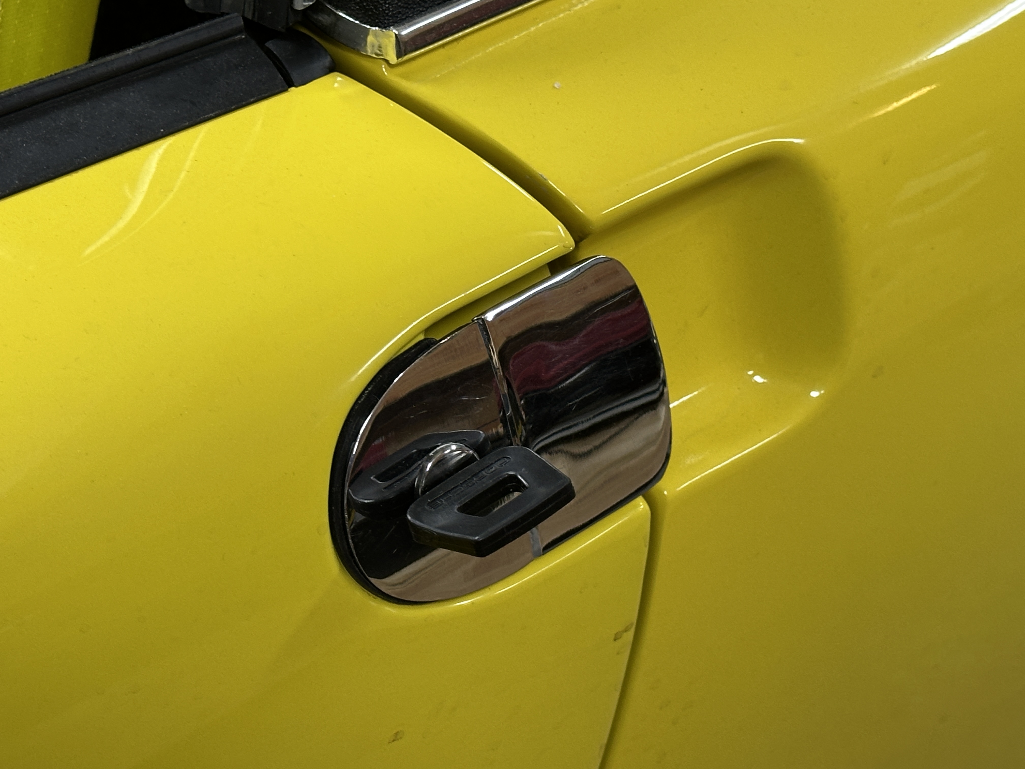

Now installing rebuilt handles. So nice to feel the key turn smoothly, and the door lock and unlock every time.

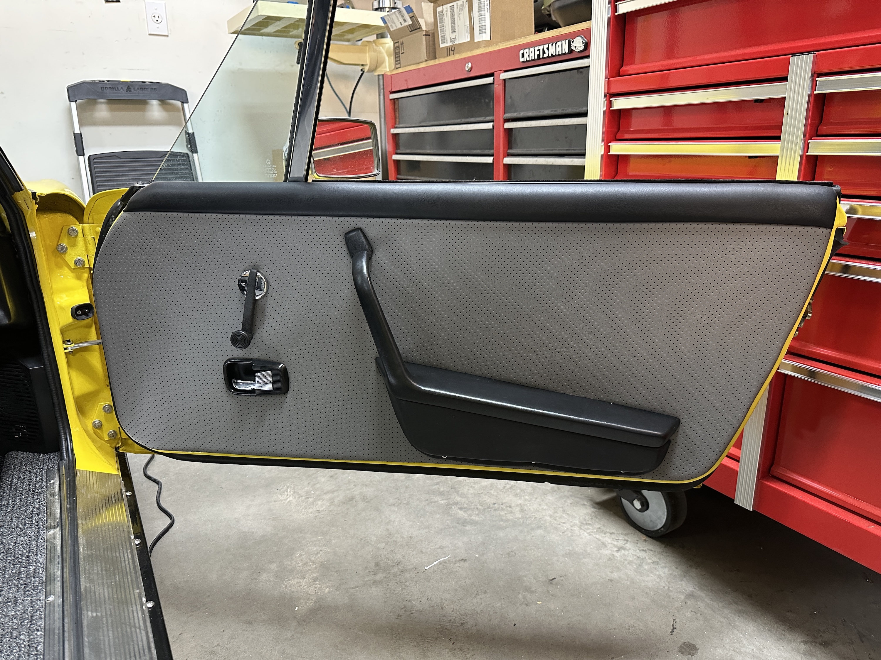

Left door back together.

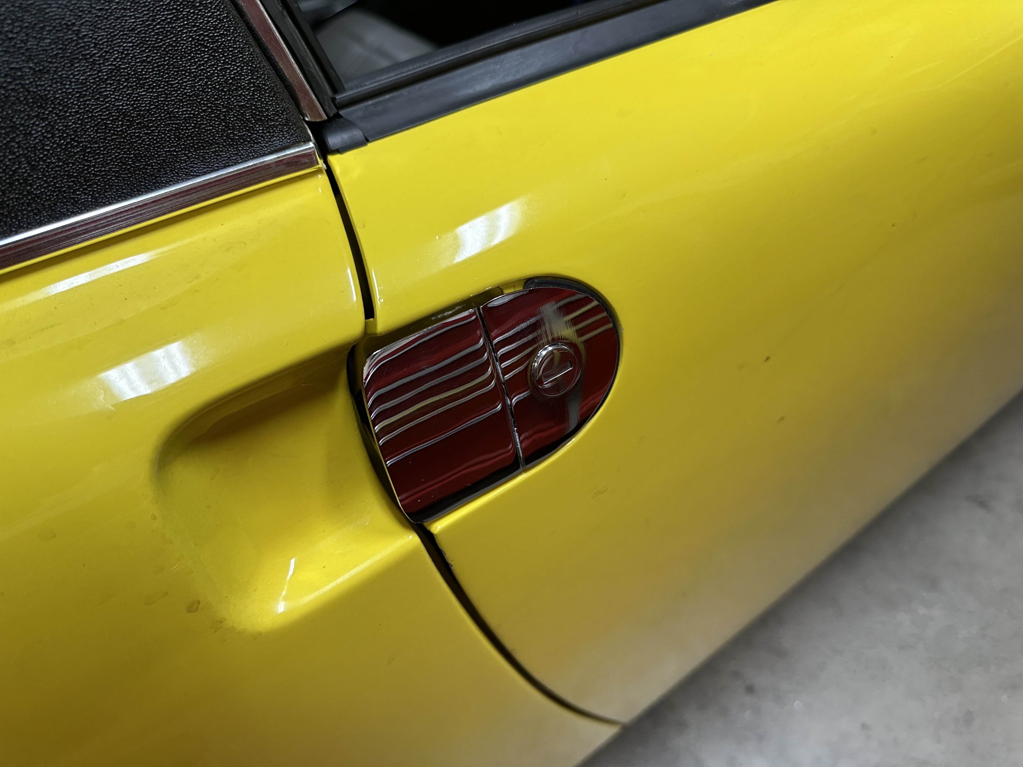

Right handle.
bkrantz
post Feb 27 2025, 07:56 PM
Post #6845
Posts: 8,780
Joined: 3-August 19
From: SW Colorado
Member No.: 23,343
Right door done.

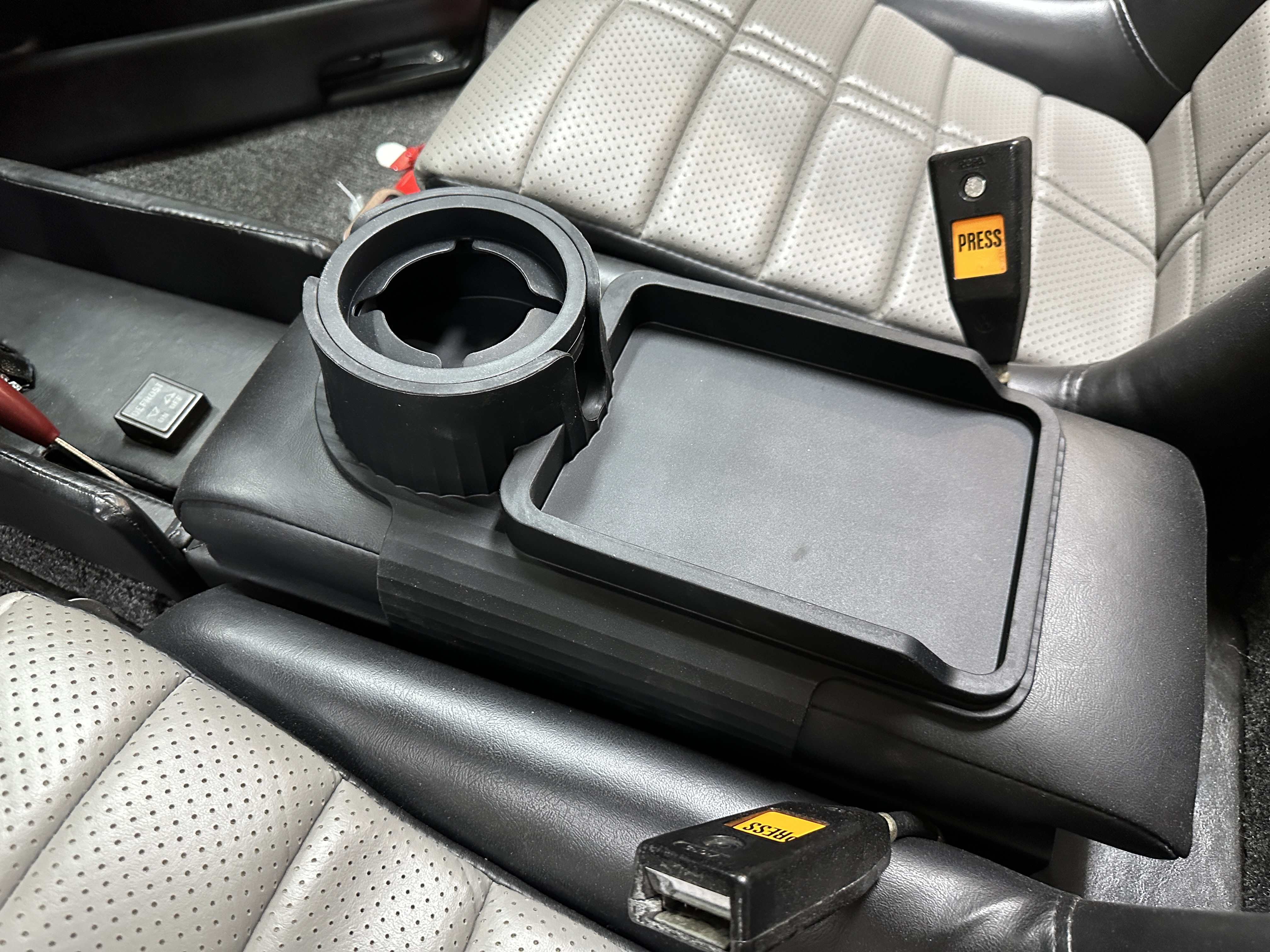

Member No.: 23,343

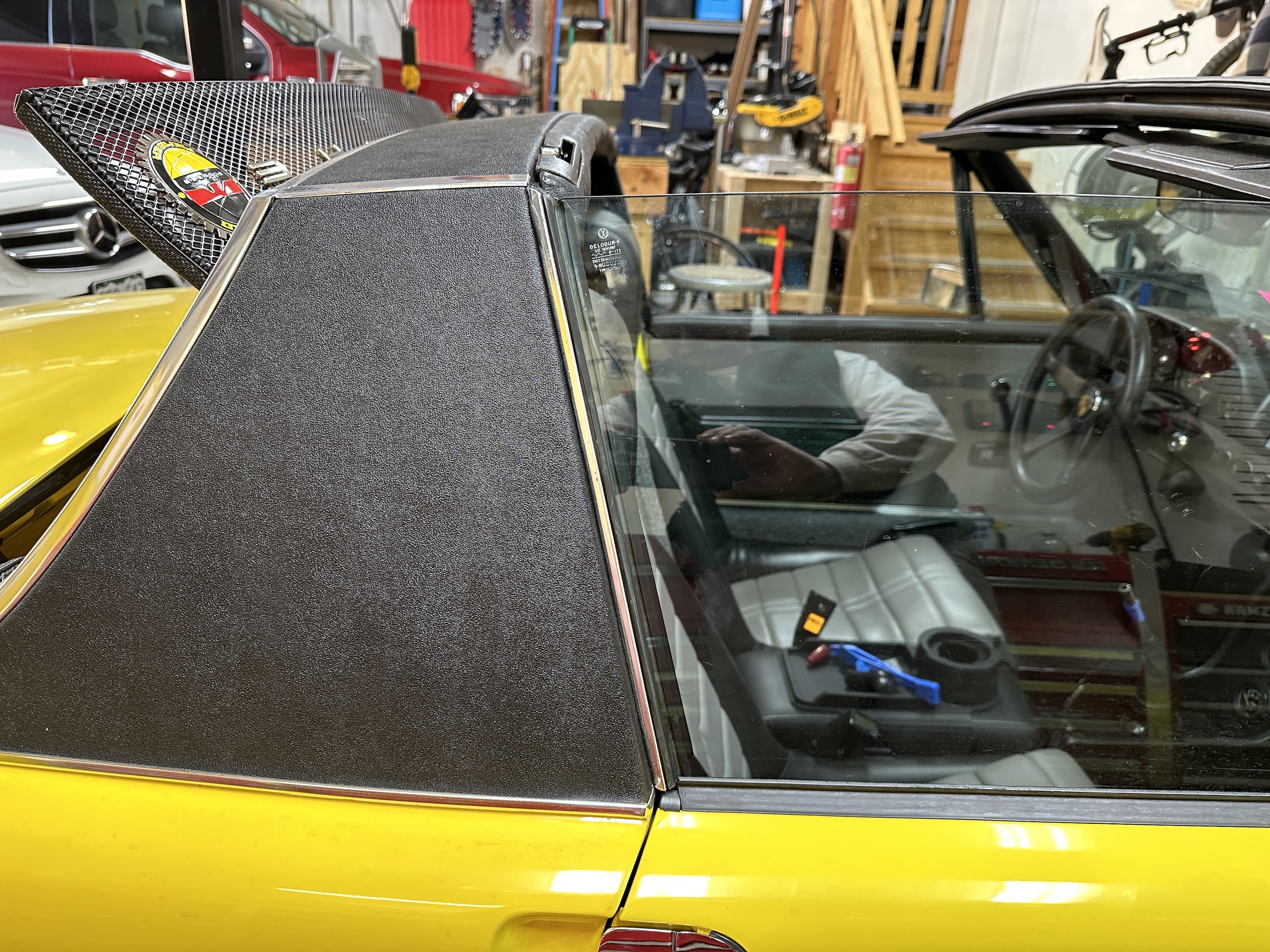

A possible cup holder solution. It straddles the center cover and has weighted flaps that hang down.

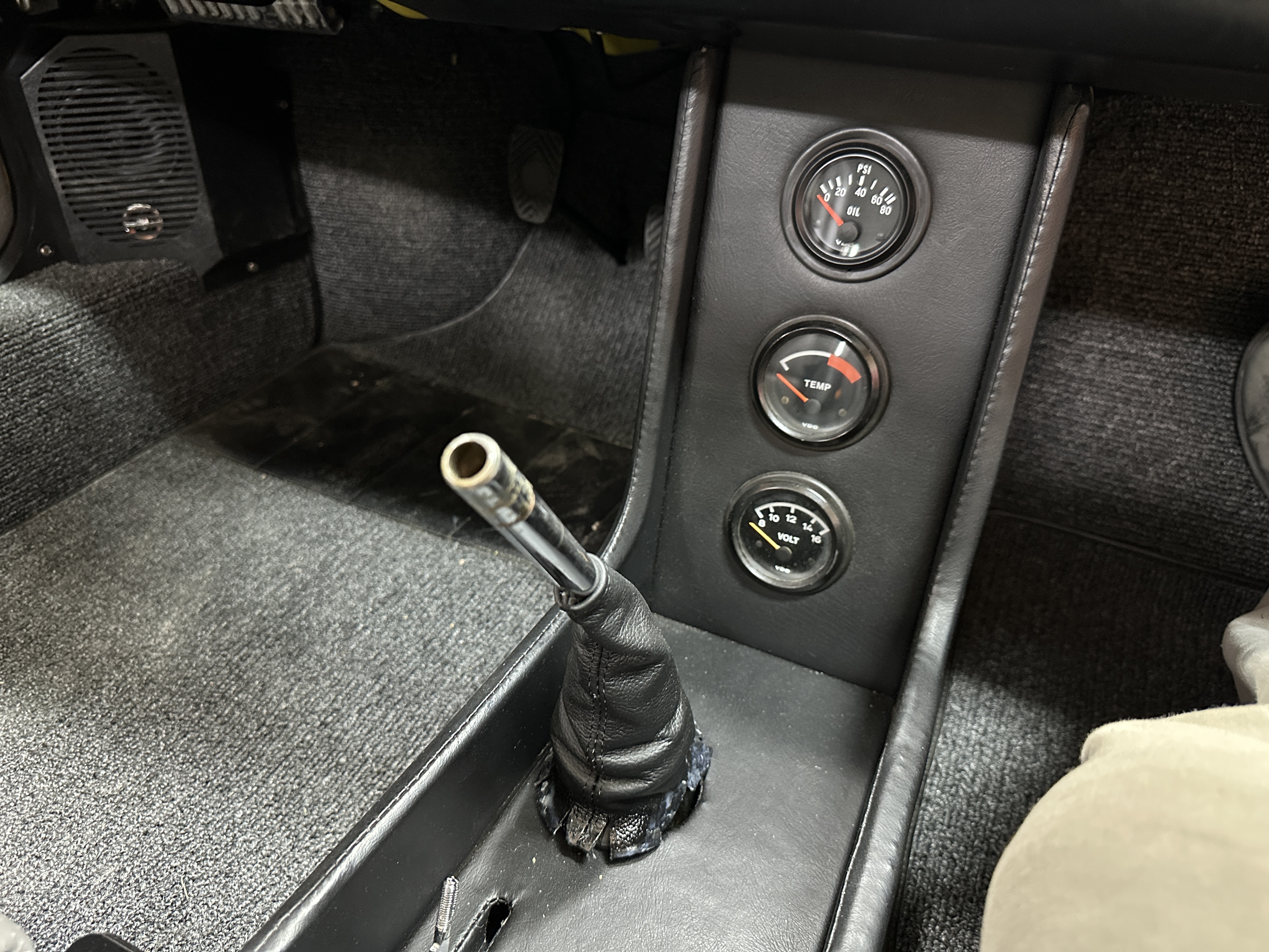

Member No.: 23,343

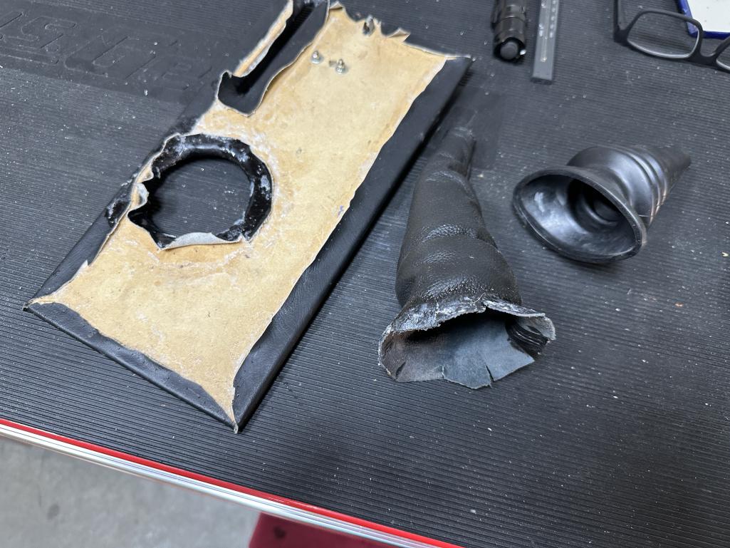

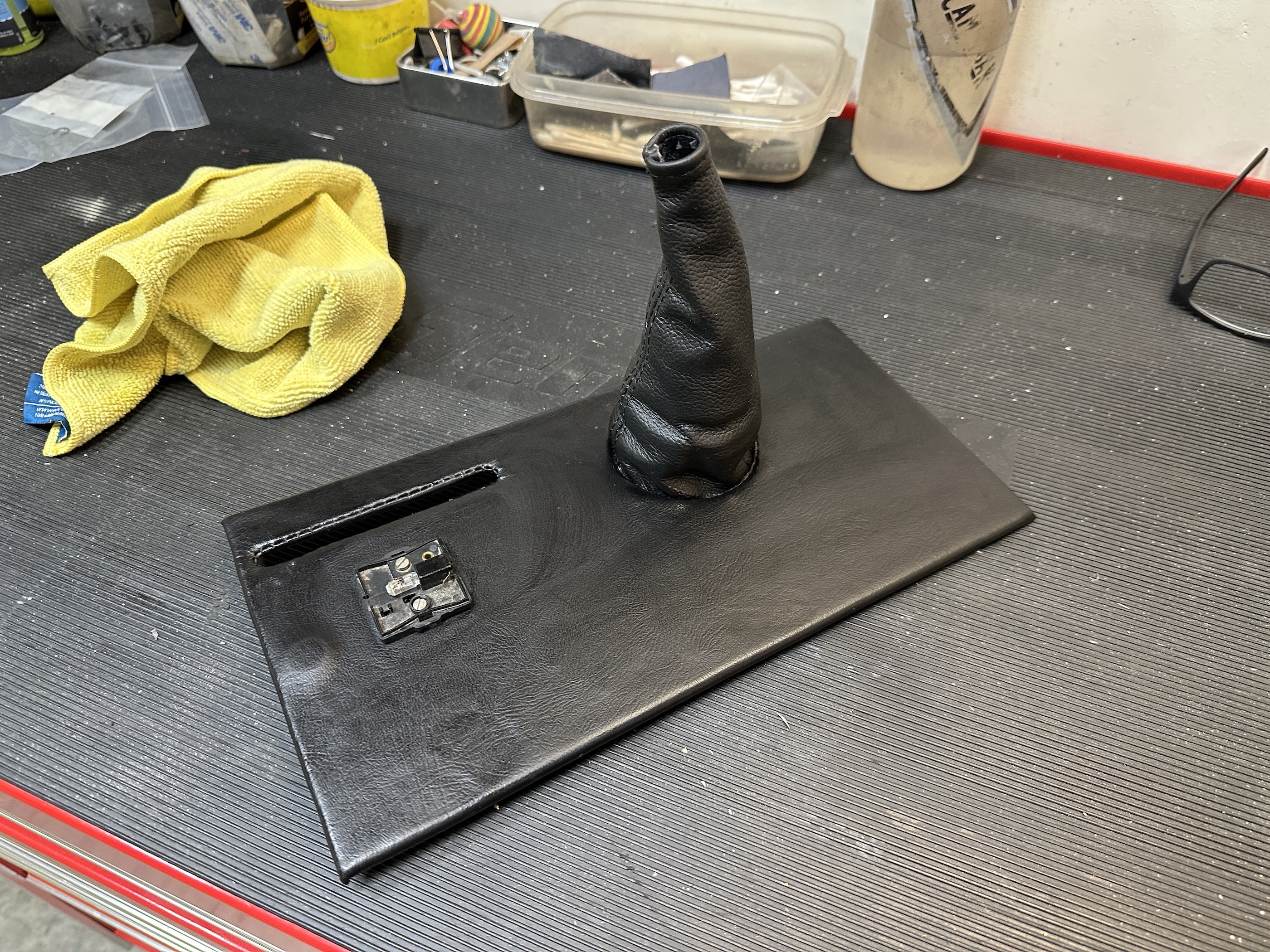

Next job: re-gluing the outer shifter leather boot. This pulled loose during my last drive in the fall. I already removed the knob.

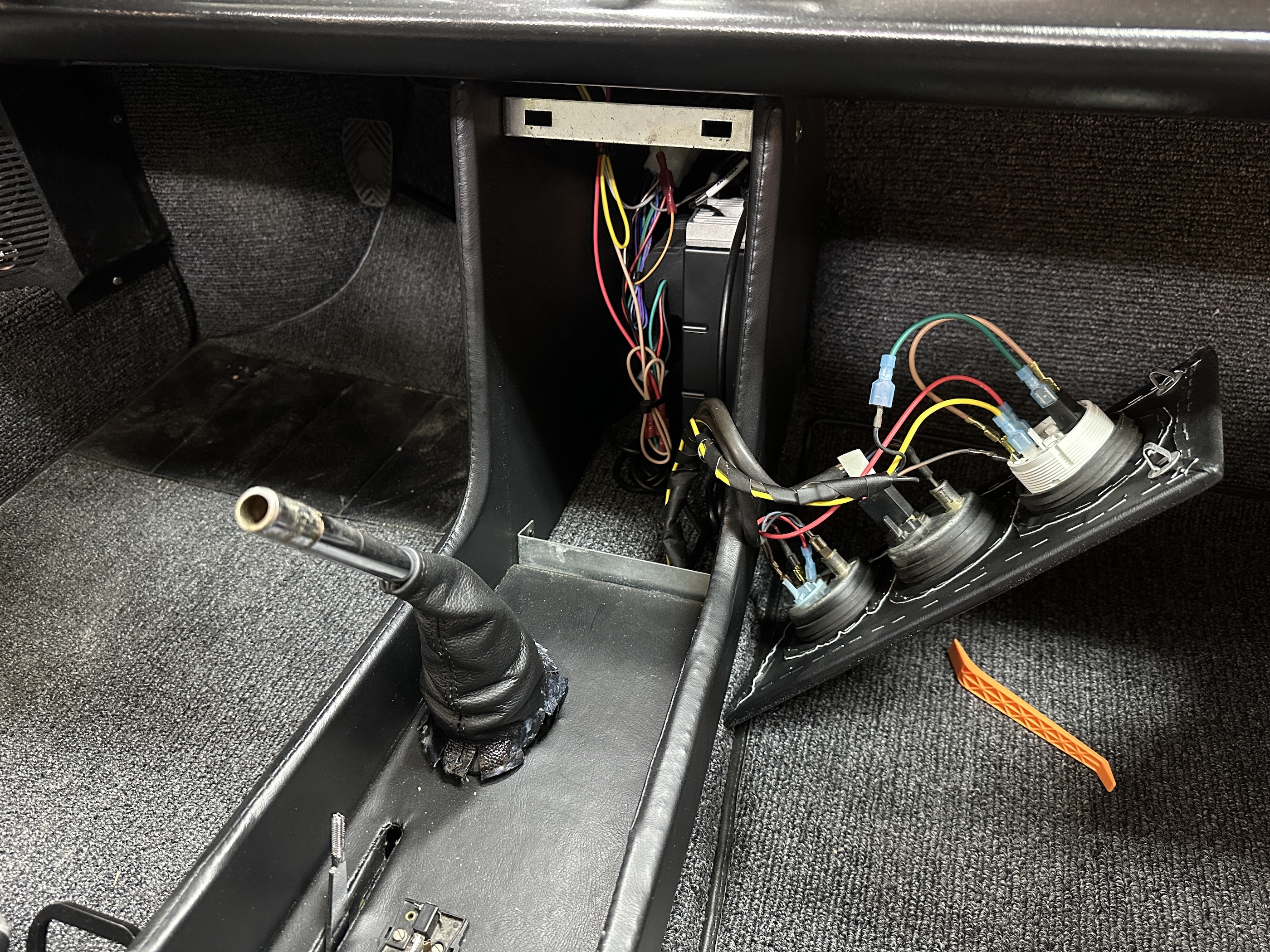

Member No.: 23,343
Gauge panel set aside.

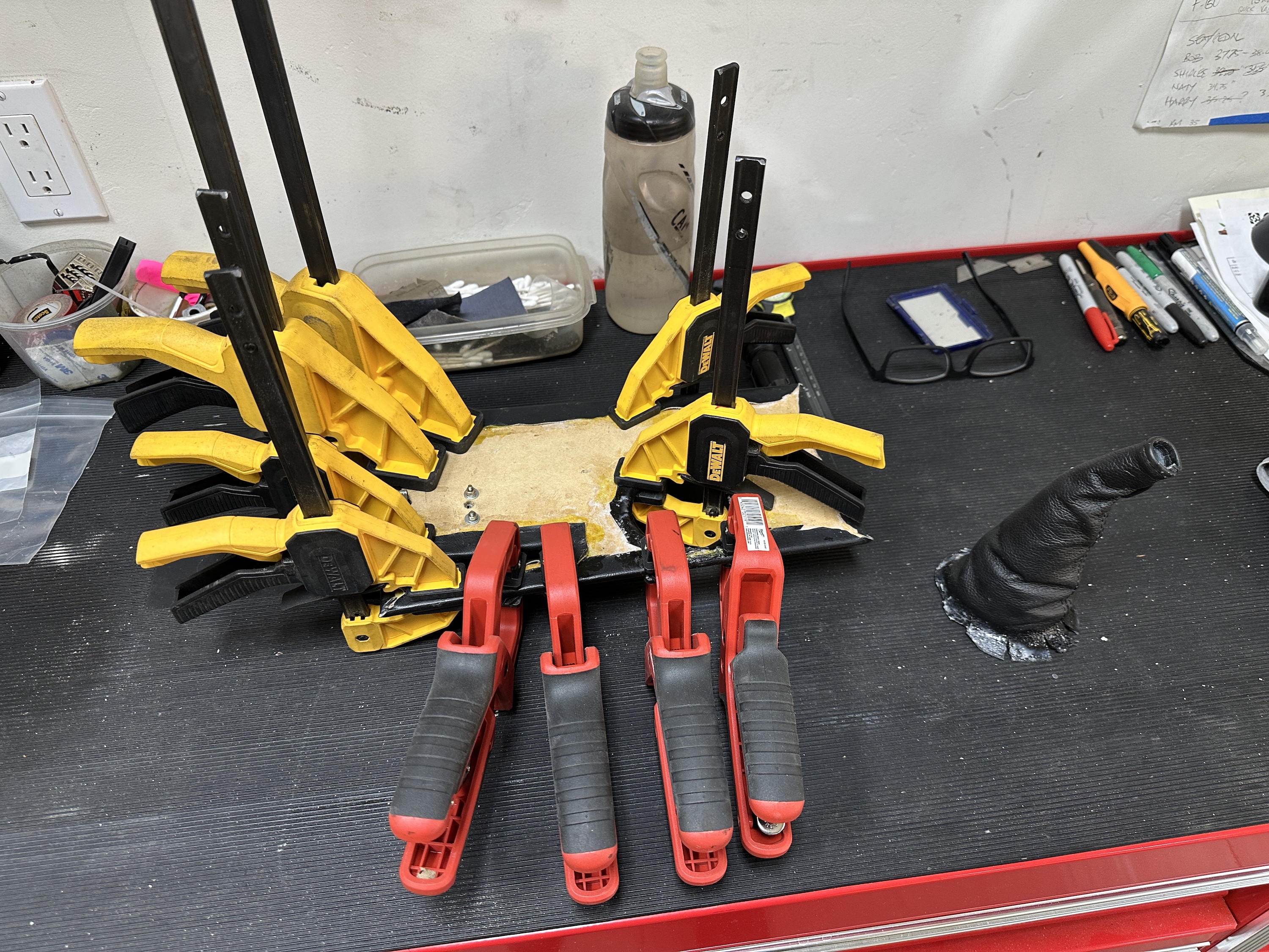

Member No.: 23,343

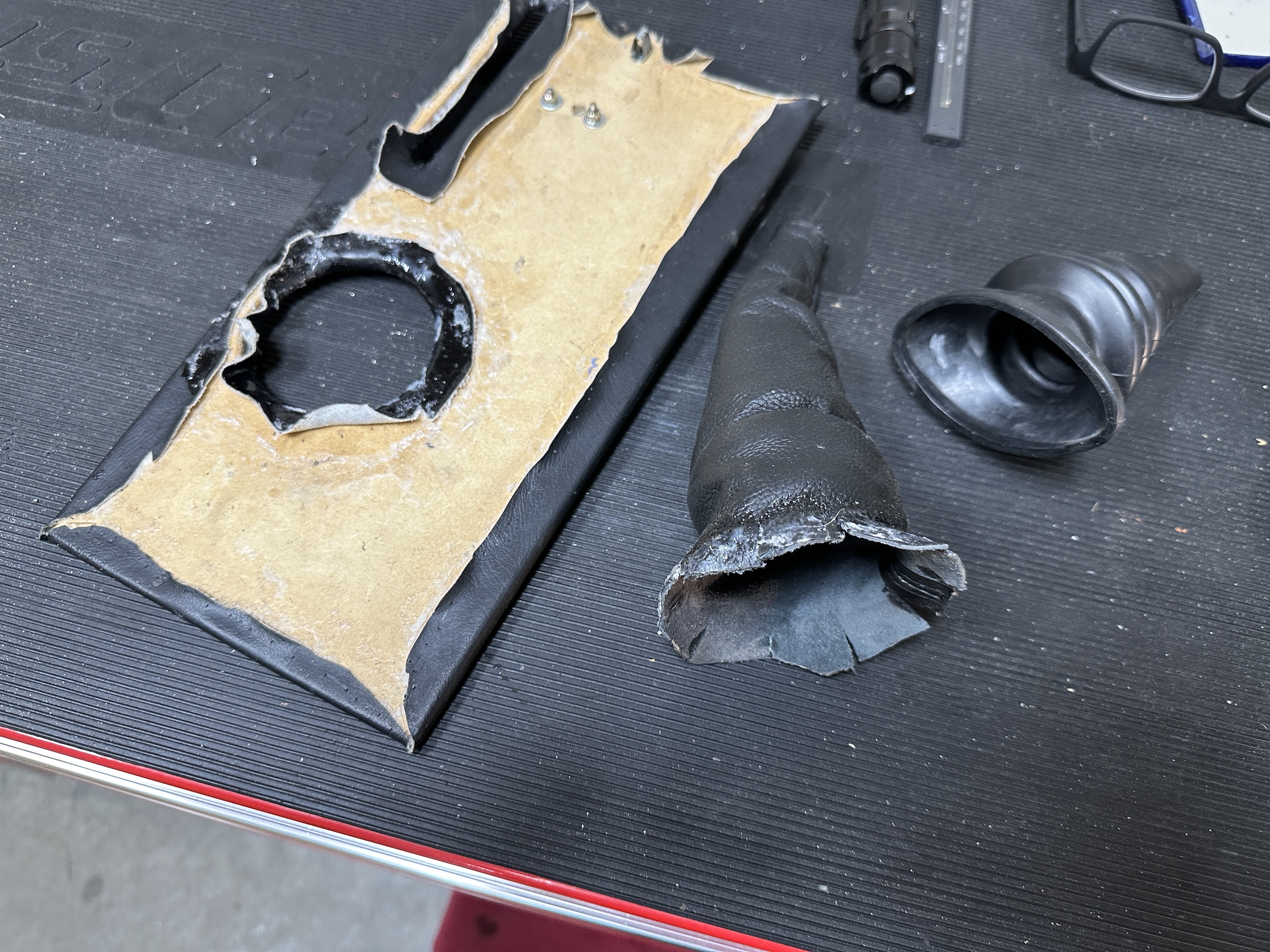

All the parts on the bench. Looks like most of the glue (Wildwood aerosol) did not set properly.
bkrantz
post Mar 5 2025, 08:46 PM
Post #6851
Posts: 8,780
Joined: 3-August 19
From: SW Colorado
Member No.: 23,343
I re-glued everything with Weldwood liquid contact cement.
bkrantz
post Mar 5 2025, 08:47 PM
Post #6852
Posts: 8,780
Joined: 3-August 19
From: SW Colorado
Member No.: 23,343
And did the same with the leather boot.
bkrantz
post Mar 5 2025, 08:50 PM
Post #6853
Posts: 8,780
Joined: 3-August 19
From: SW Colorado

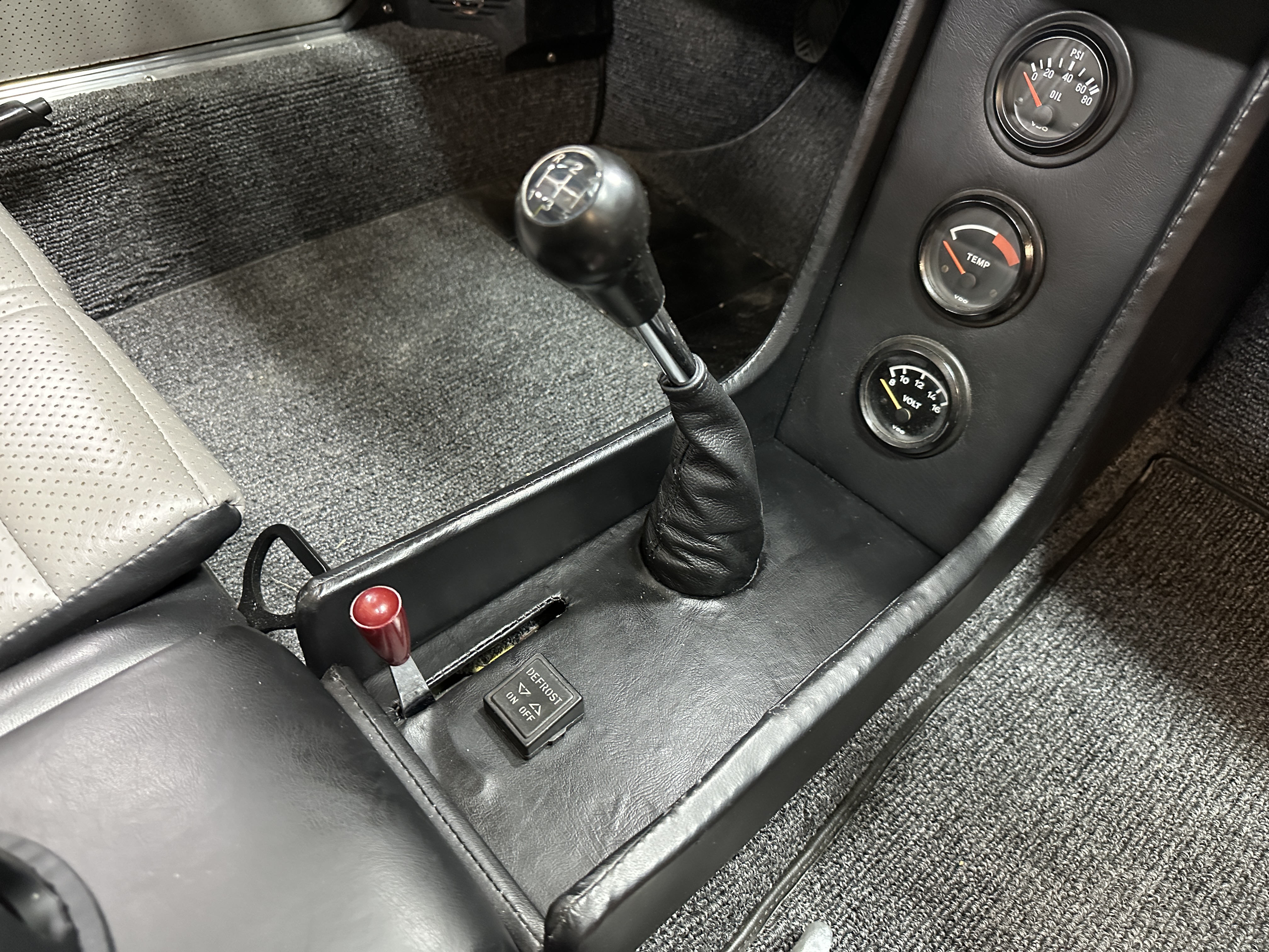

Member No.: 23,343
Back together. The console is not my best work but will do.
bkrantz
post Mar 5 2025, 08:52 PM
Post #6854
Posts: 8,780
Joined: 3-August 19
From: SW Colorado
Member No.: 23,343
Progress!

Greatest American invention of all time - cup holder
(IMG:style_emoticons/default/smile.gif) (IMG:style_emoticons/default/biggrin.gif) (IMG:style_emoticons/default/smile.gif)
QUOTE(bkrantz @ Feb 27 2025, 08:59 PM) *

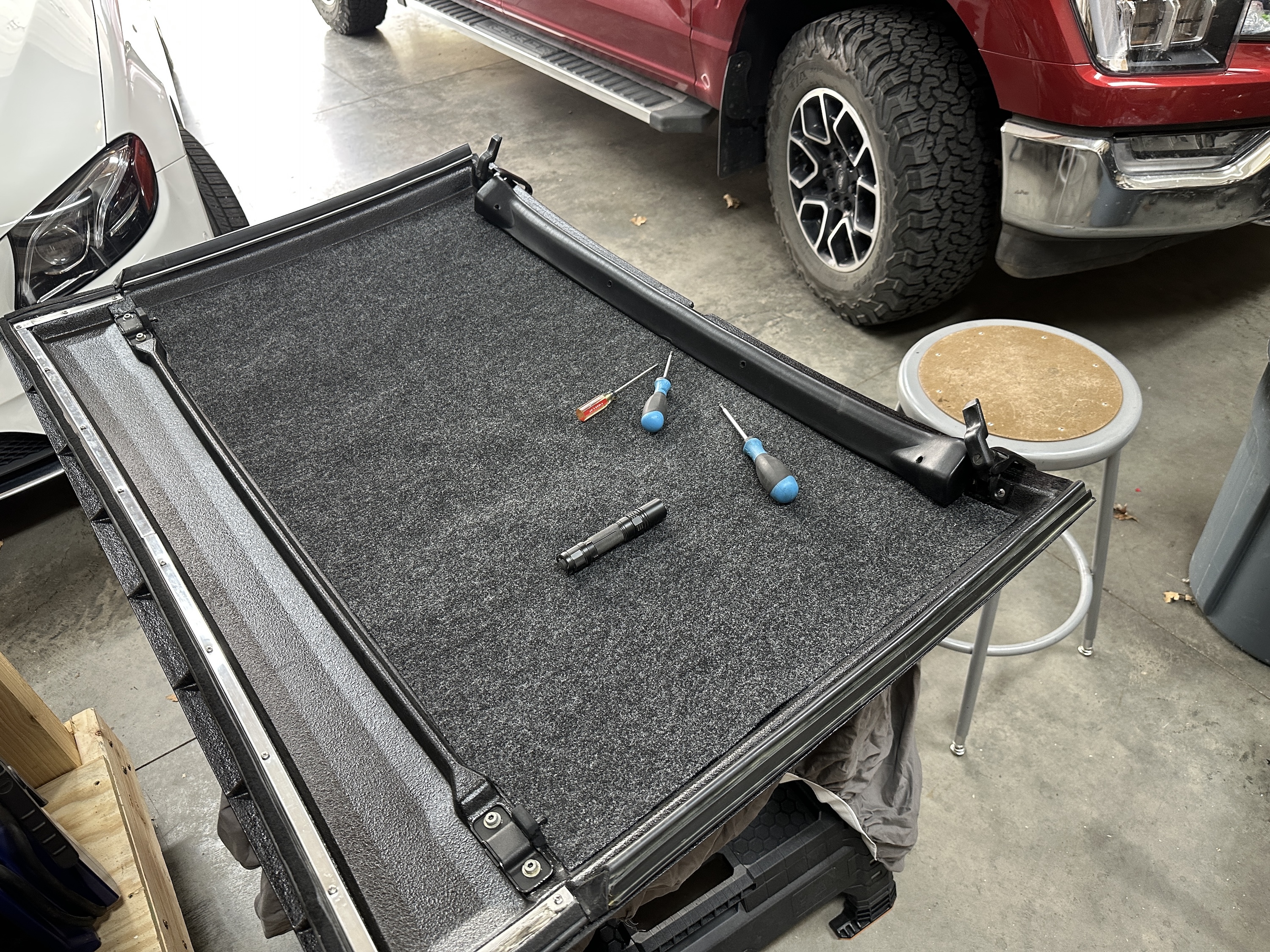

Our winter is over, and time to get on the road. And that is motivation to finish the last few off-season tasks.
Hard to see in the photo, but last summer the roof liner detached in a few patches.

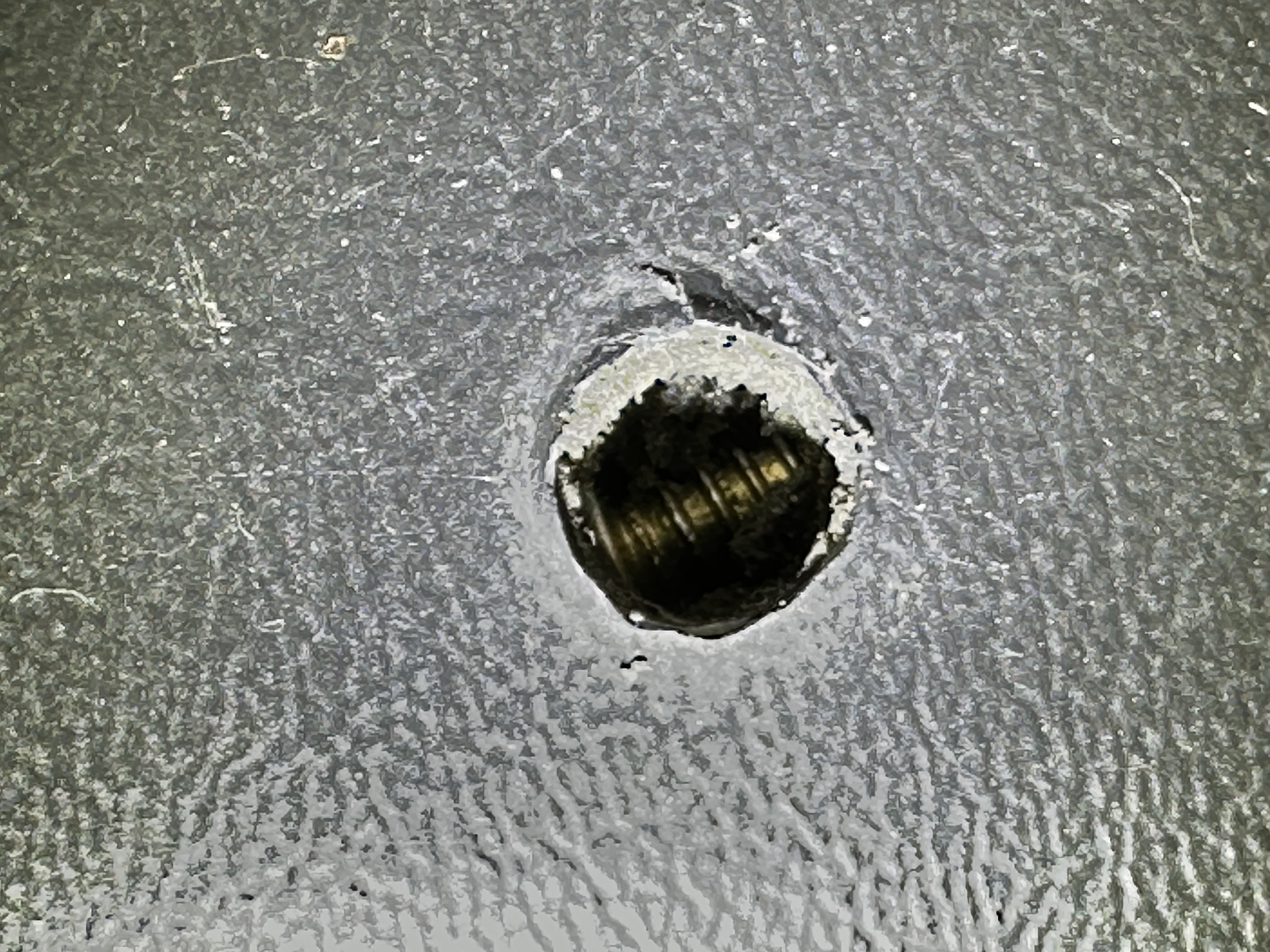

Unscrewing the front pad took a bit longer, since I was confused by an extra screw in one hole. Finding the actual screw heads is hard enough.
