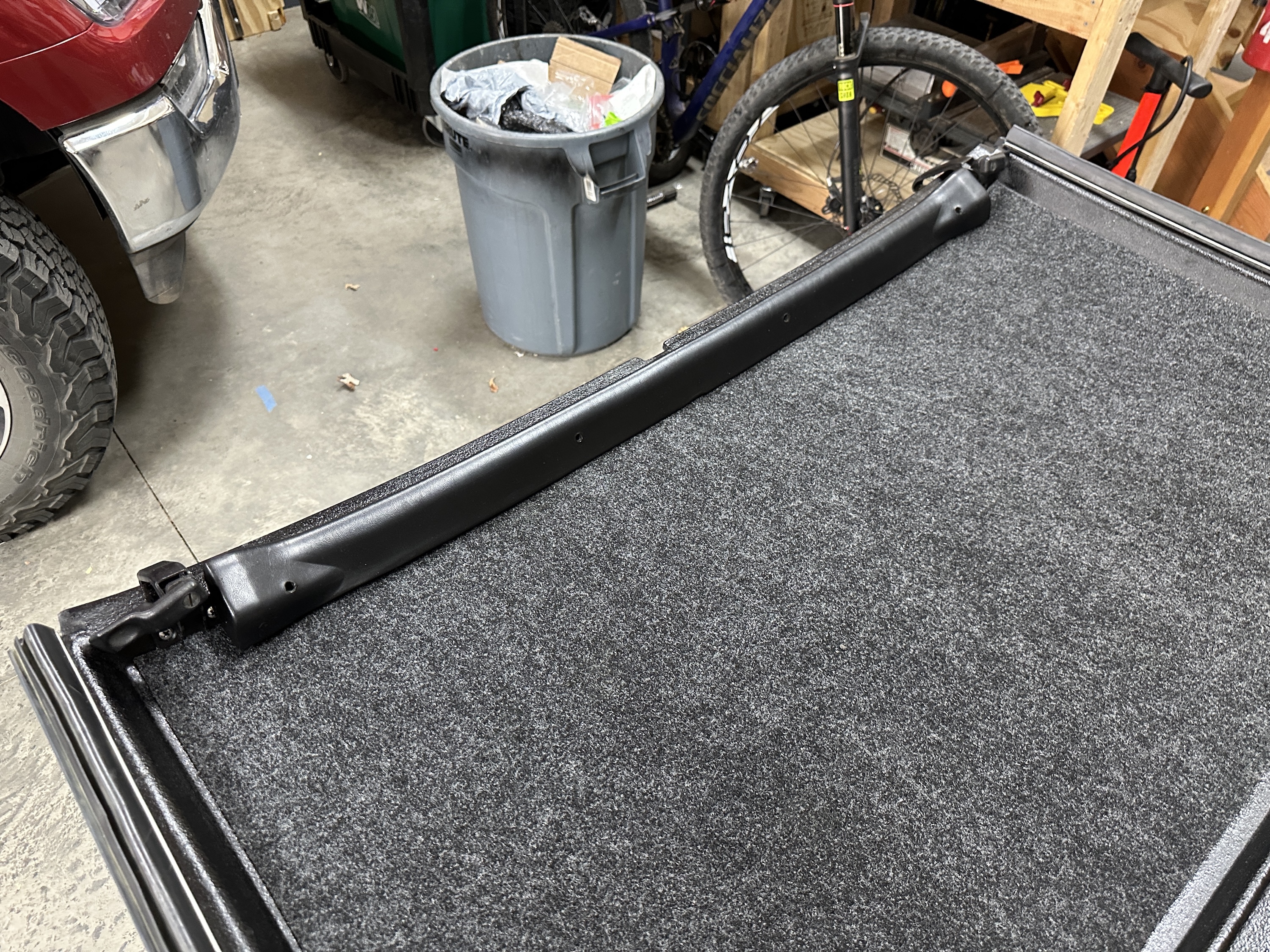

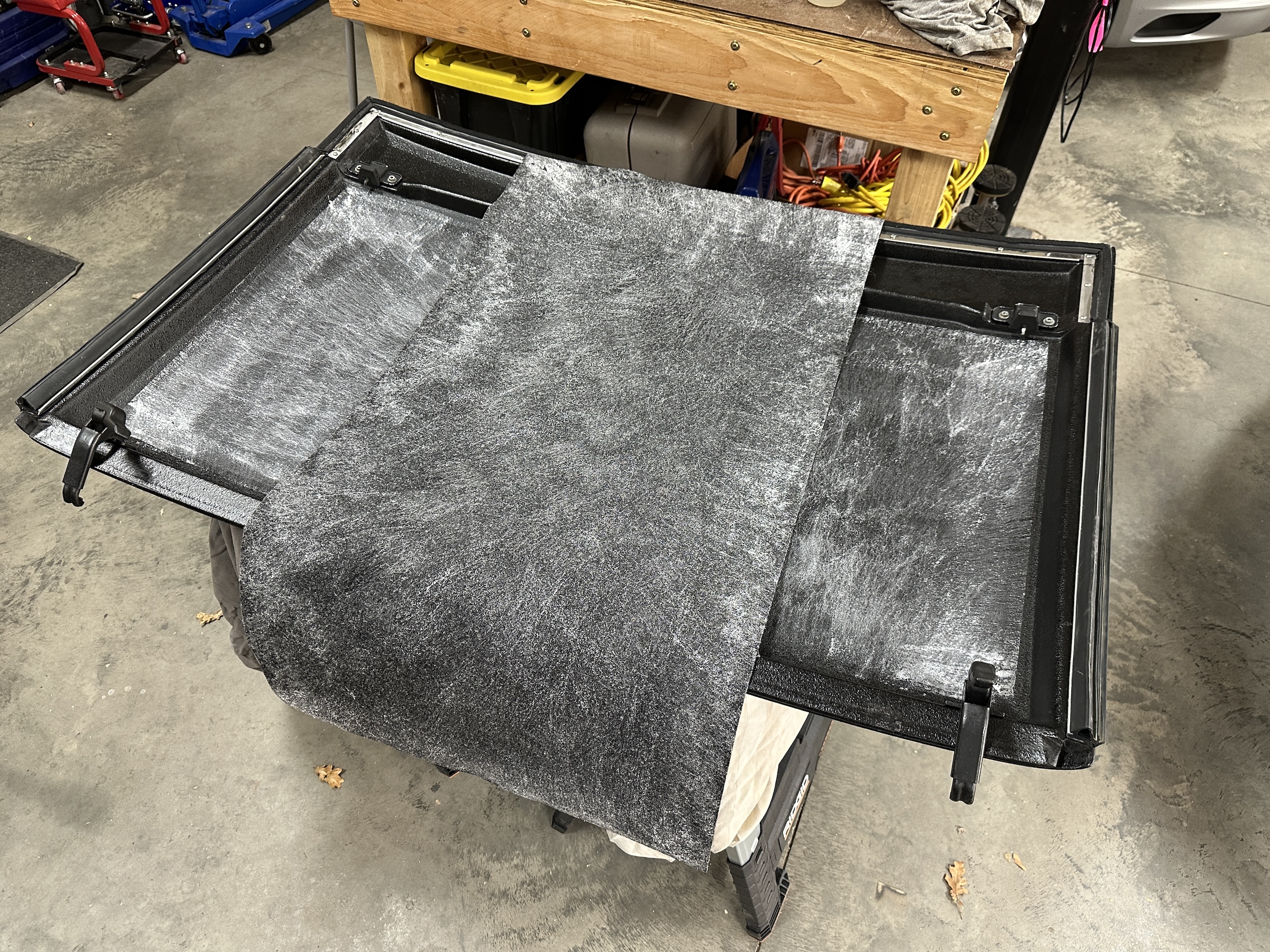

So, pad off and liner removed. 3 years ago I used a spray contact cement, but the porous nature of the material made that unreliable.
bkrantz
post May 2 2025, 08:39 PM
Post #6862
Posts: 8,780
Joined: 3-August 19
From: SW Colorado
Member No.: 23,343

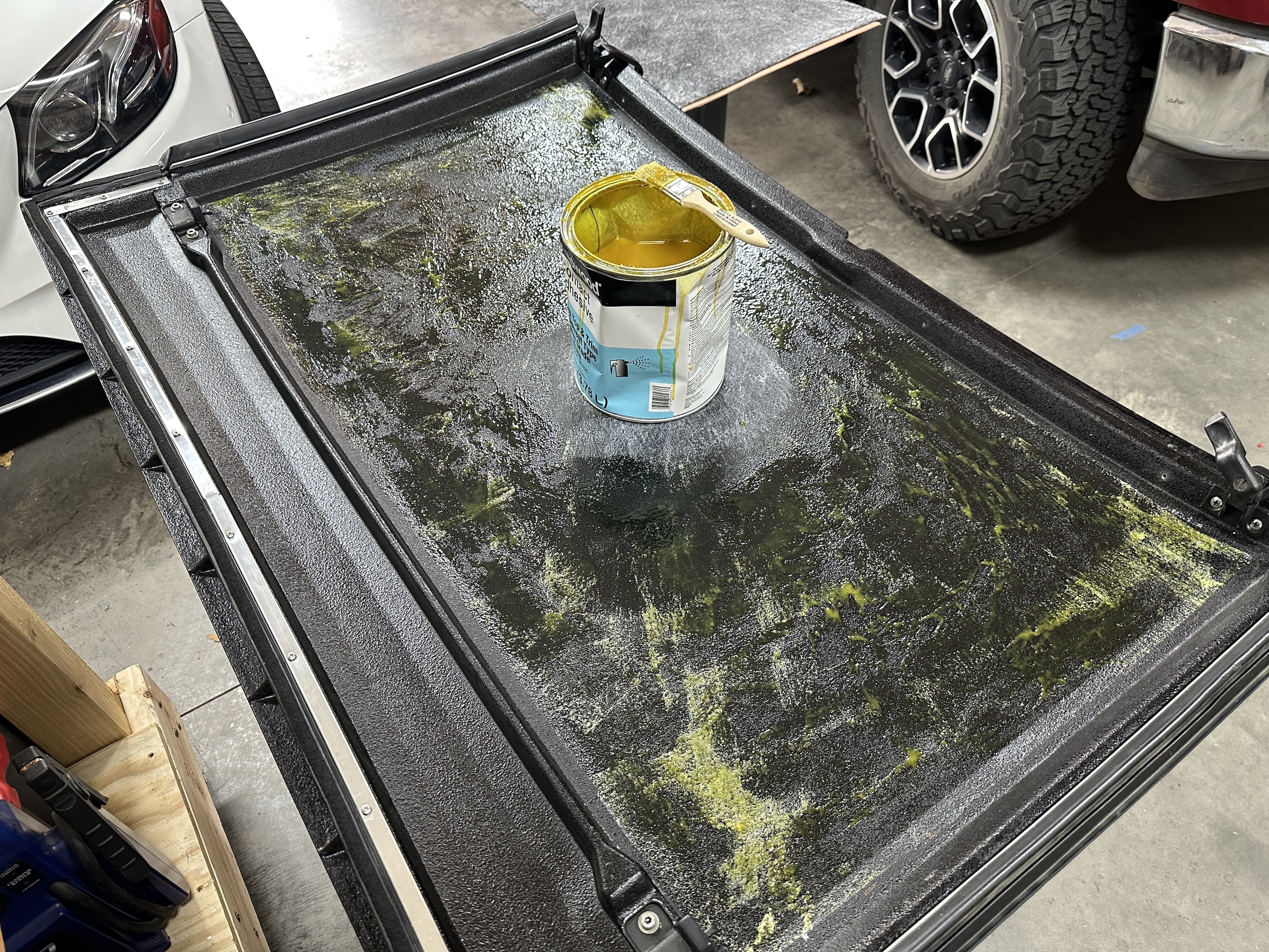

So this time I brushed on the contact cement, and maybe went a bit thick.
bkrantz
post May 2 2025, 08:40 PM
Post #6863
Posts: 8,780
Joined: 3-August 19
From: SW Colorado
Member No.: 23,343

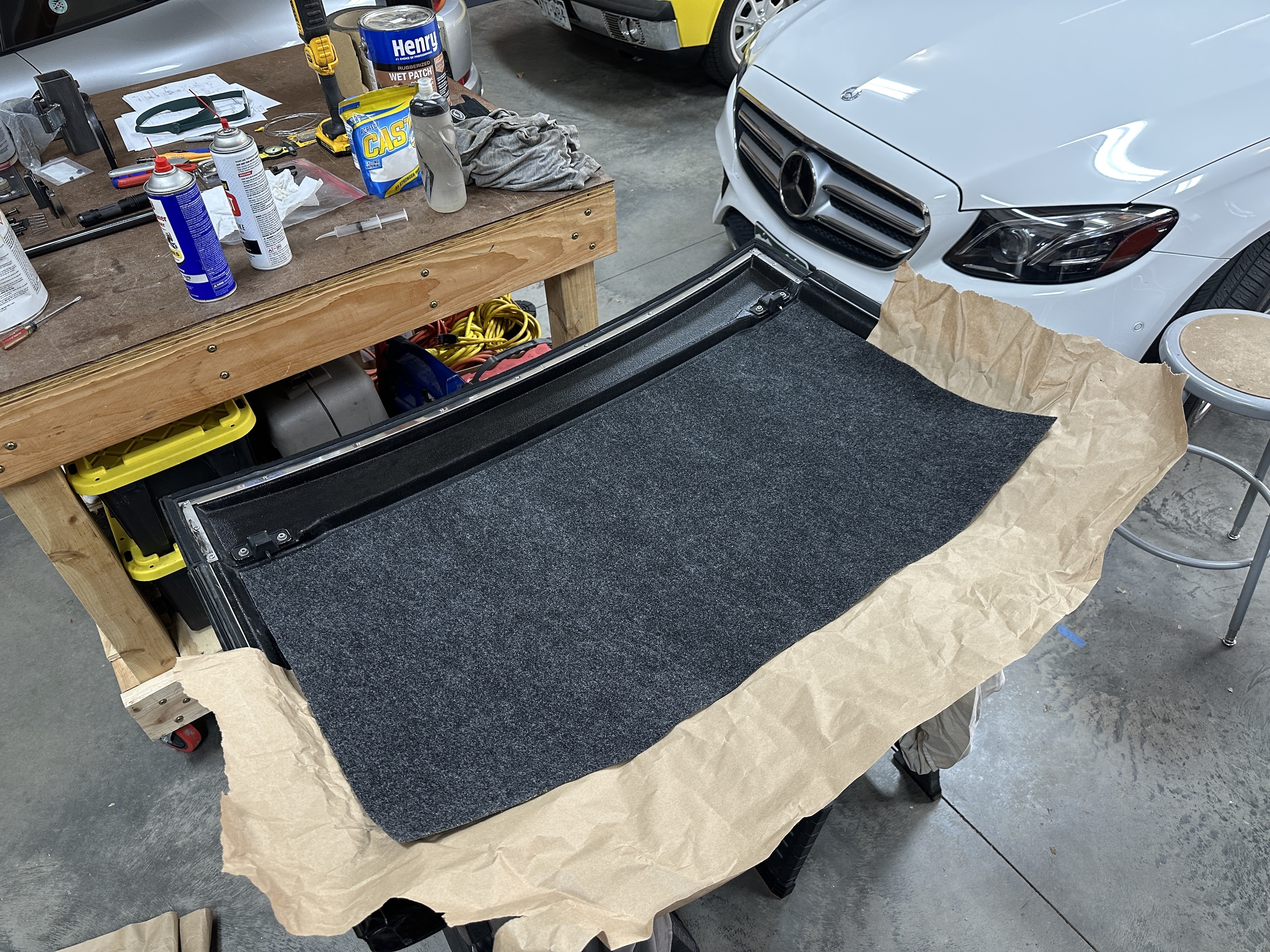

Getting the liner in place, while some brown paper keeps the two sides from sticking.
bkrantz
post May 2 2025, 08:43 PM
Post #6864
Posts: 8,780
Joined: 3-August 19
From: SW Colorado
Member No.: 23,343
Stuck on better (I hope), and ready to roll.

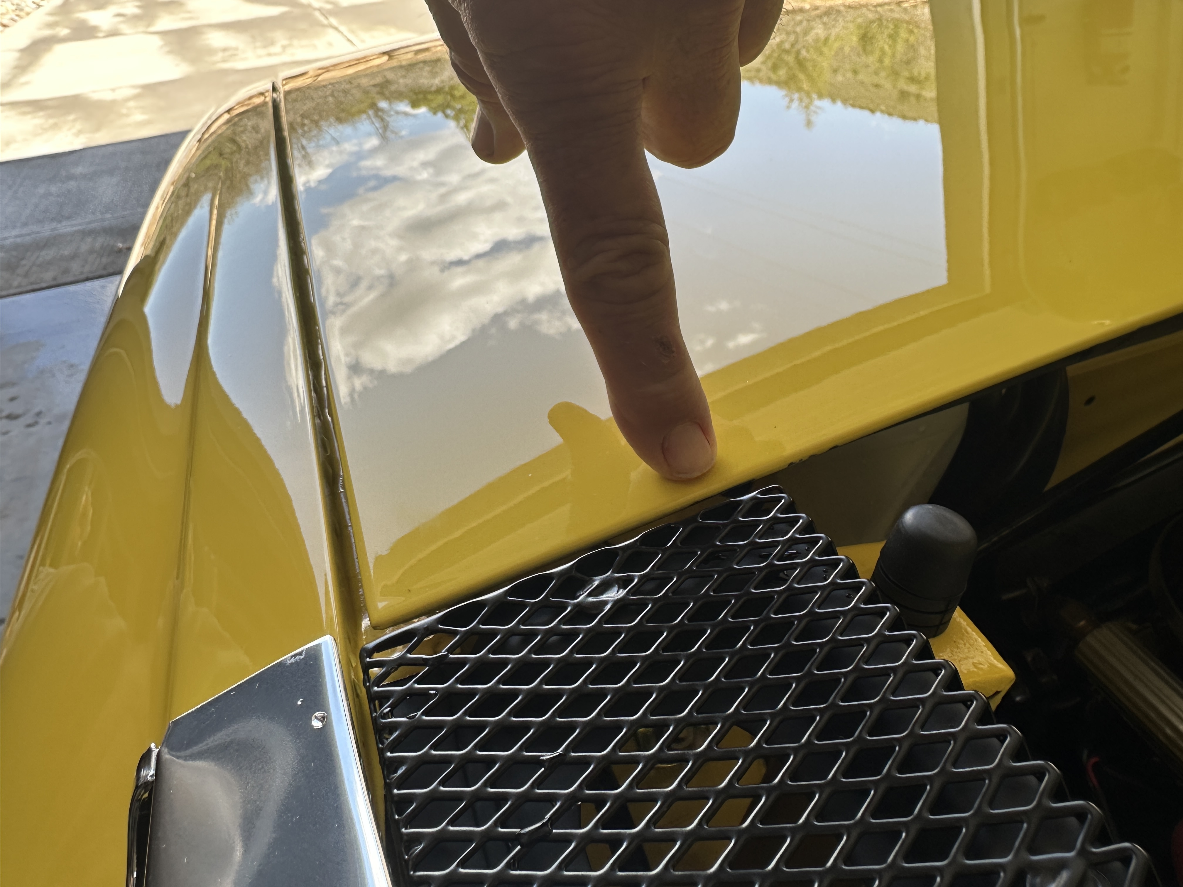

Next up, a slight snap noise--sometimes--when I opened the trunk lid. Turns out the right side engine grill panel was barely high enough to make contact. Easy fix.

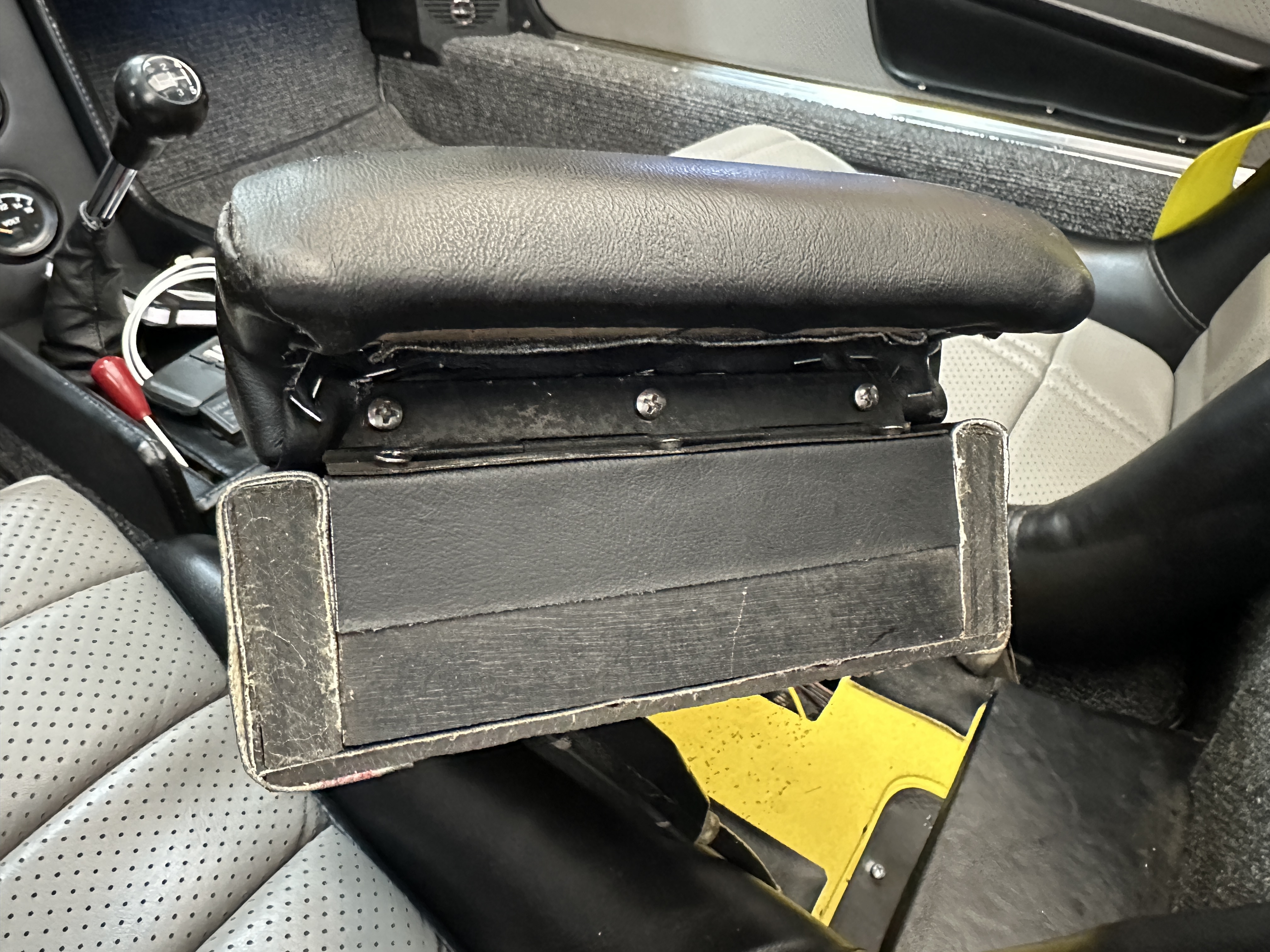

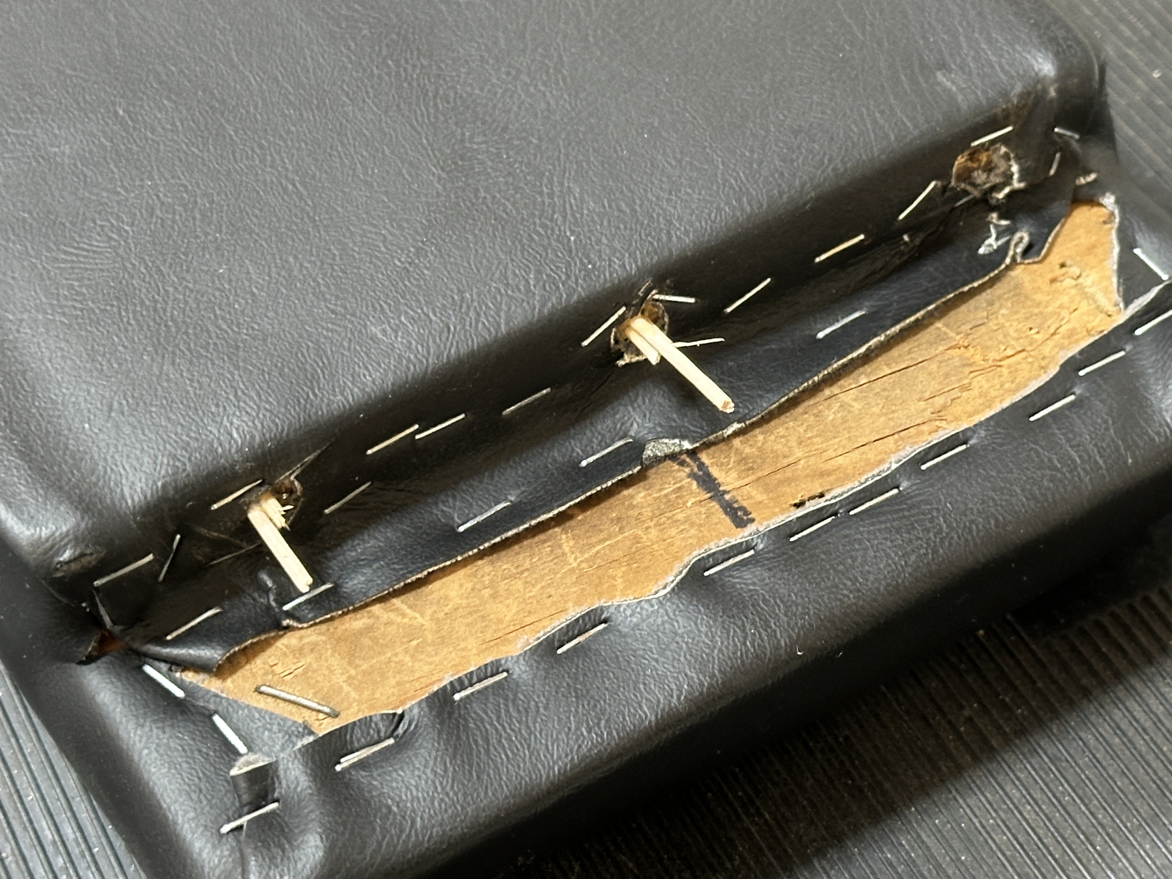

Still revisiting things I "fixed" during the main rebuild. This time the console lid. The screws that hold the hinge to the lid were always dodgy, but recently 2 of 3 pulled out.
To restore the holes I glued in some pieces of toothpick. When dried, I trimmed the excess.

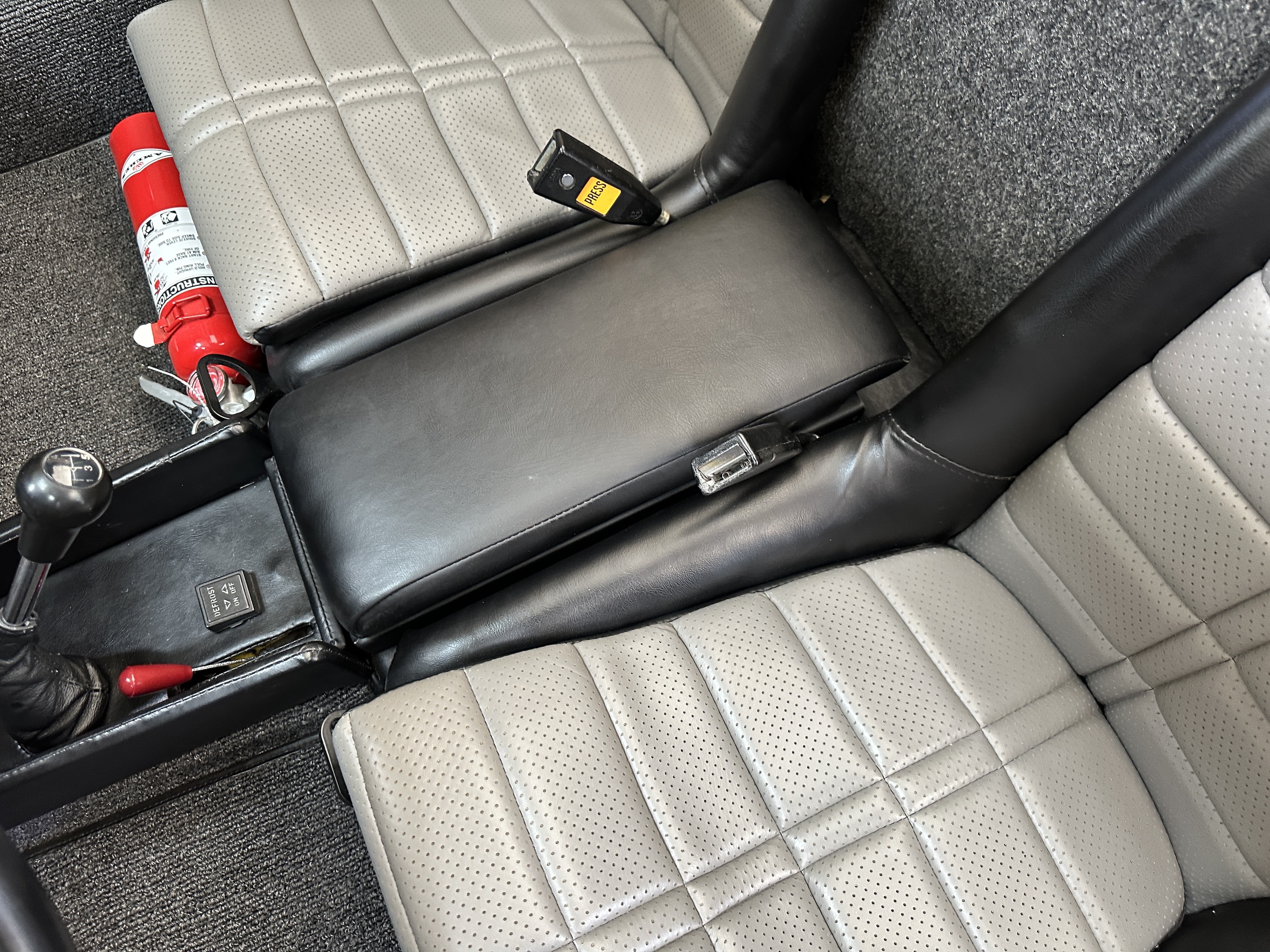

Now all the screws can bite hard, and hold the hinge firmly.

Better, open.

Better, closed.

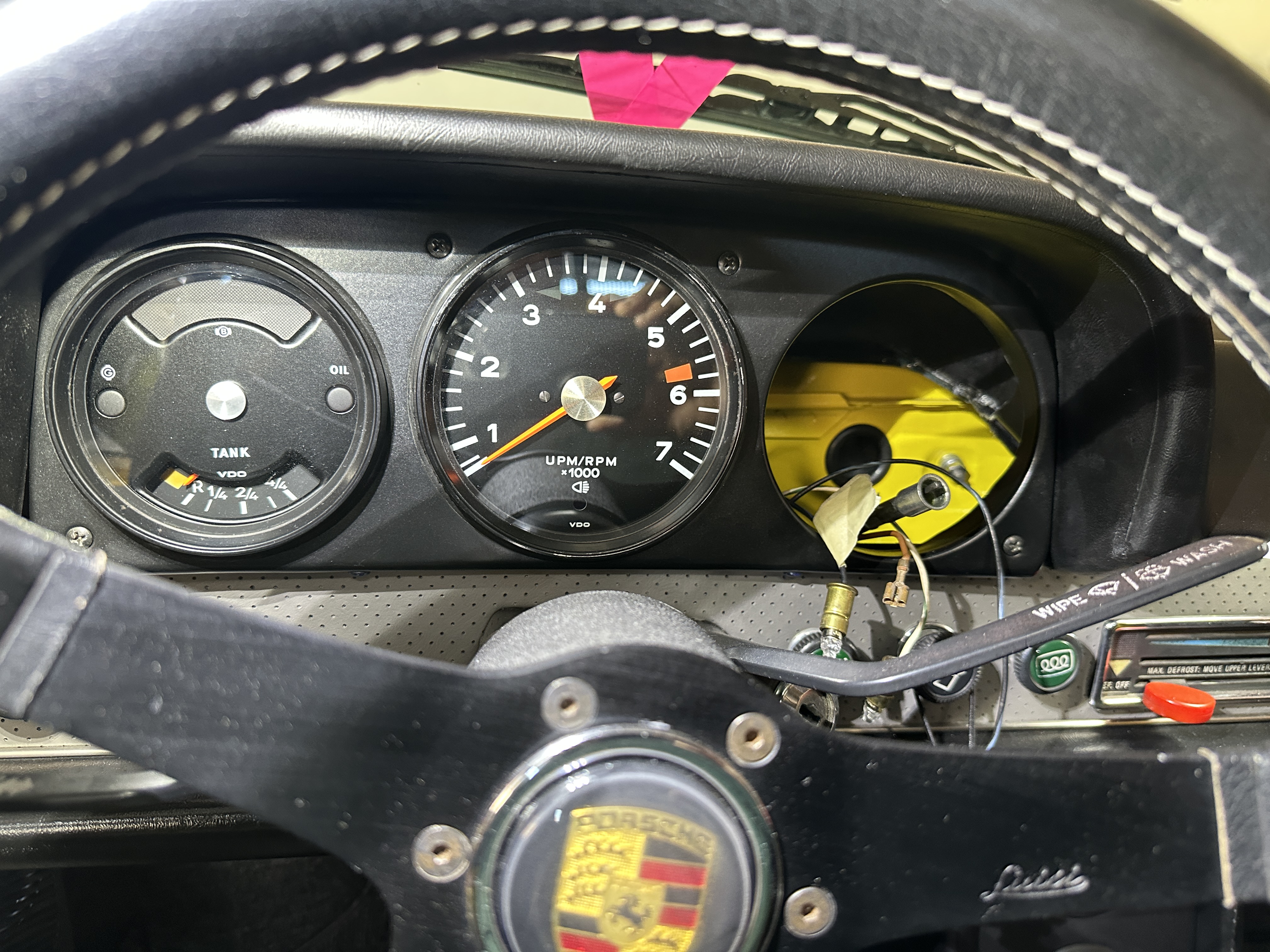

hey, everyone. Hope you all had a good year. My 914 is running strong and has not needed much attention. I posted on a separate thread back in July about playing with the door locks again since I still had occasional problems trying to unlock from the outside with the key. That seems to have done the trick.

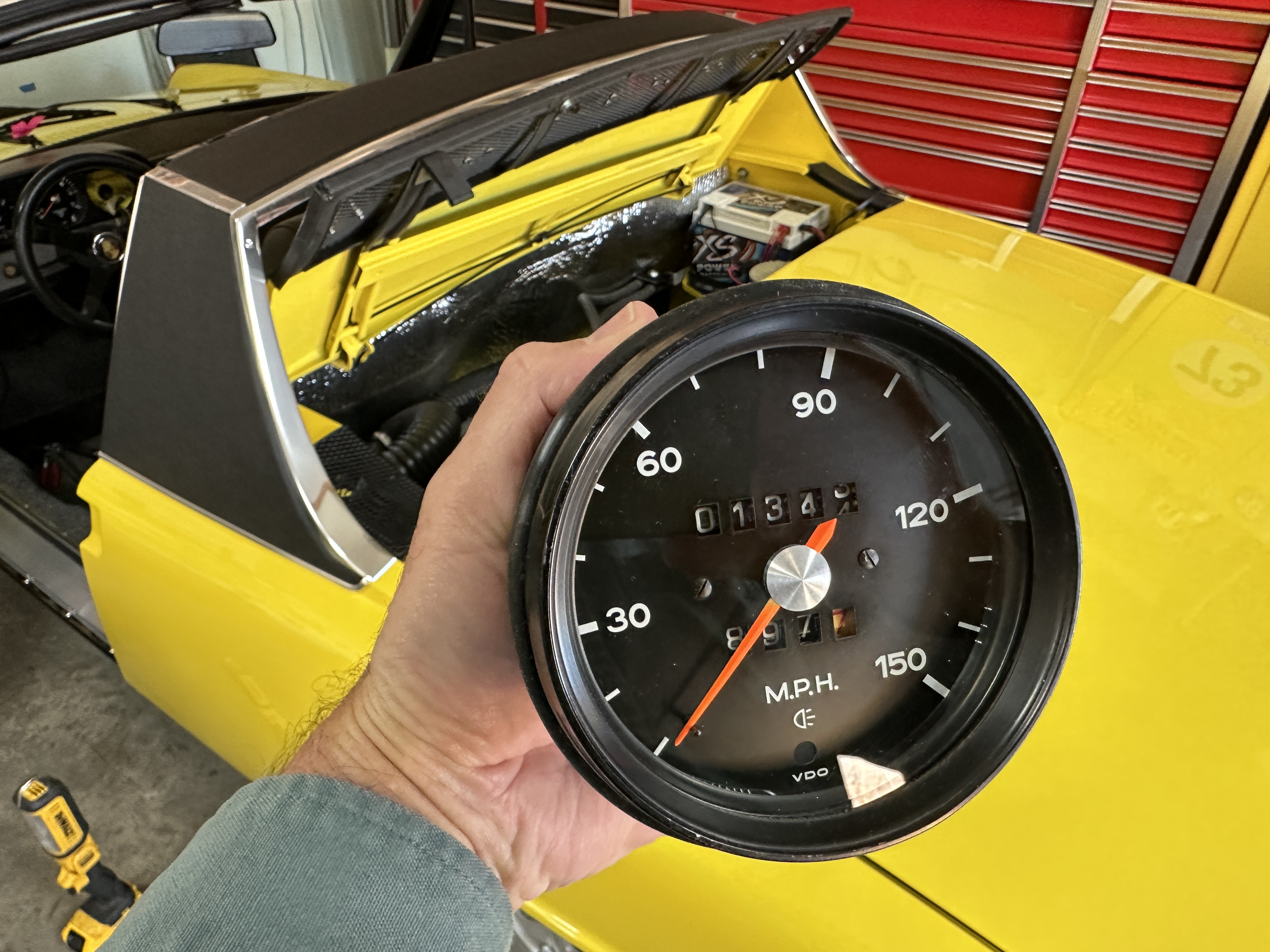

Sometime earlier in the year my odometer gave out again, so with the car ready for a winter nap, I decided to take action. First, since the weather was nice enough (sunny and 55°) I took the 914 for one last drive this year. With my wonderful wife taking notes, we tested the speedometer against a GPS phone app. As I already knew, the dash gauge reads about 3 mph too high. And the odometer still does not work. So the speedometer came out.
bkrantz
post Dec 11 2025, 10:33 PM
Post #6874
Posts: 8,780
Joined: 3-August 19
From: SW Colorado
Member No.: 23,343
Tomorrow I will fix it up and send it to John Bell, to fix the odo and re-calibrate the speedo.

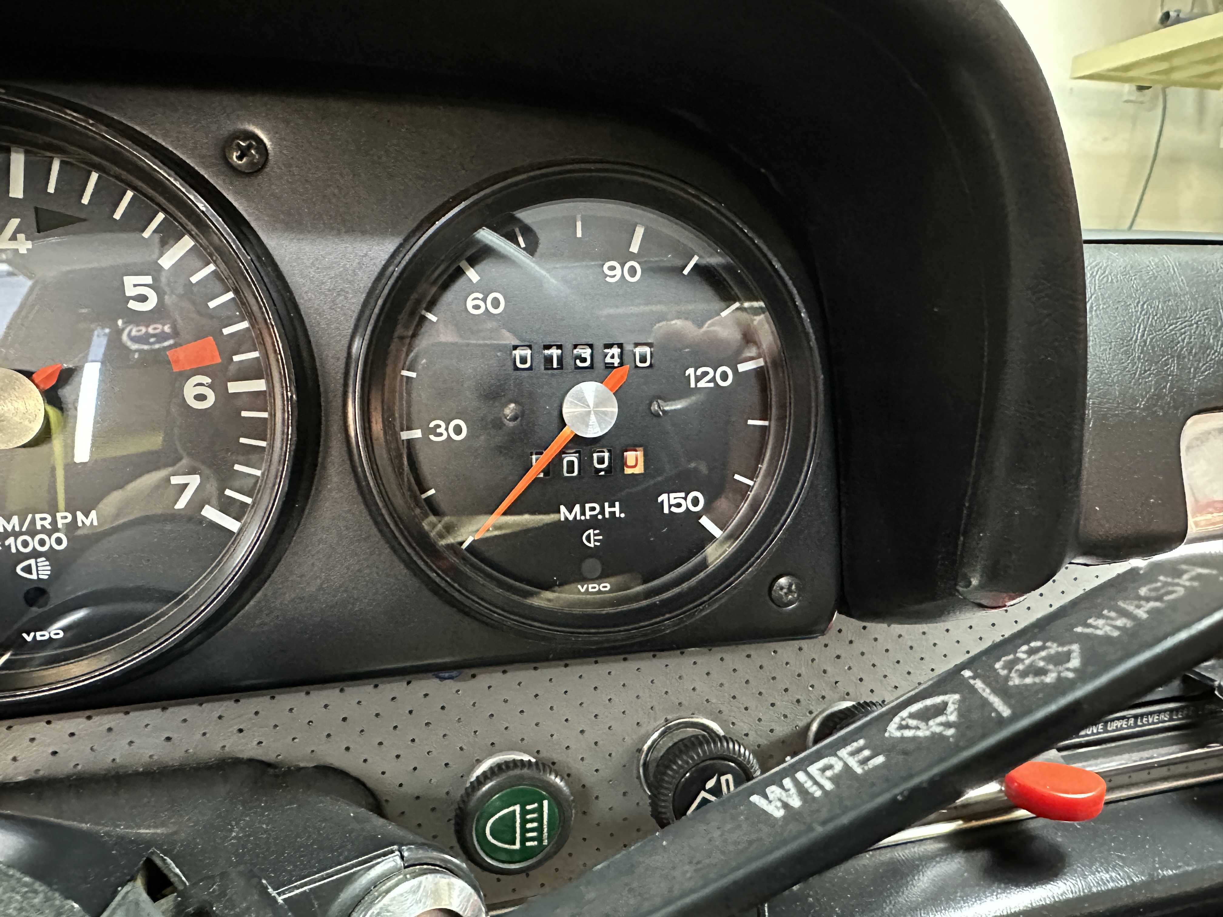

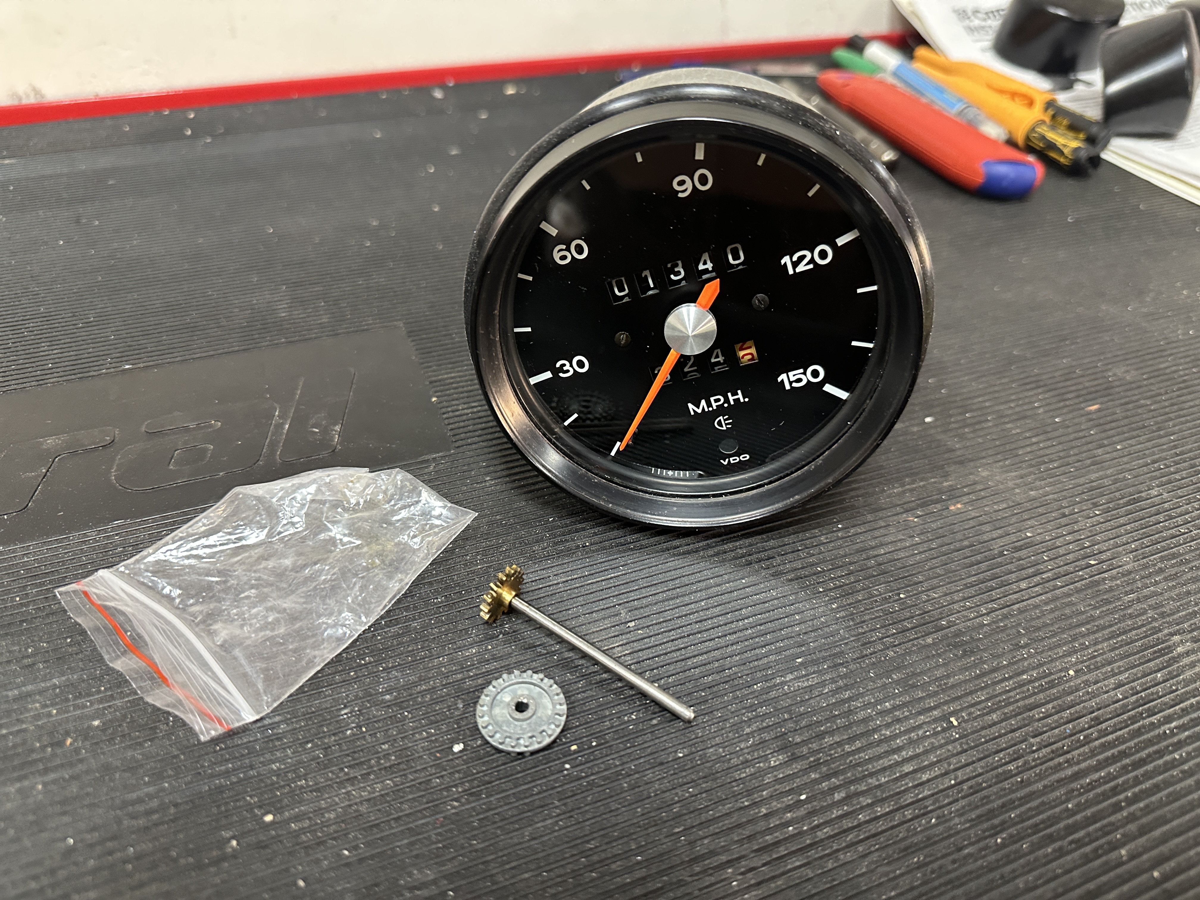

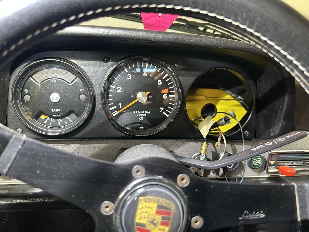

Got my repaired speedometer back from John Bell (thanks, John!). Looks like my attempt to refix the drive gear to the odometer shaft failed.
bkrantz
post Jan 15 2026, 08:23 PM
Post #6879
Posts: 8,780
Joined: 3-August 19
From: SW Colorado
Member No.: 23,343

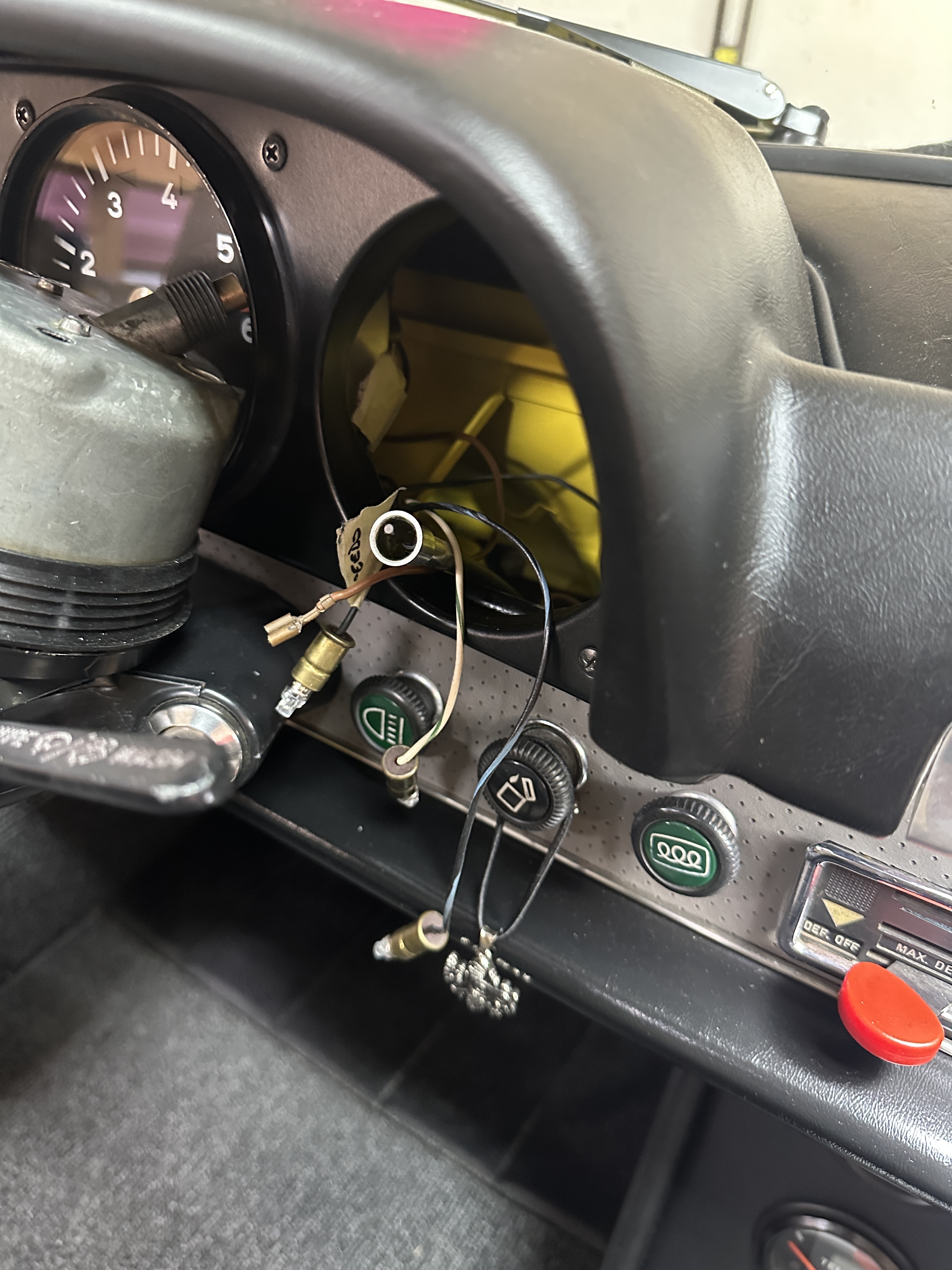

Now where do all these wires go?
bkrantz
post Jan 15 2026, 08:25 PM
Post #6880
Posts: 8,780
Joined: 3-August 19
From: SW Colorado
Member No.: 23,343
All set for testing. If our lack of winter keeps up, that might be soon.
