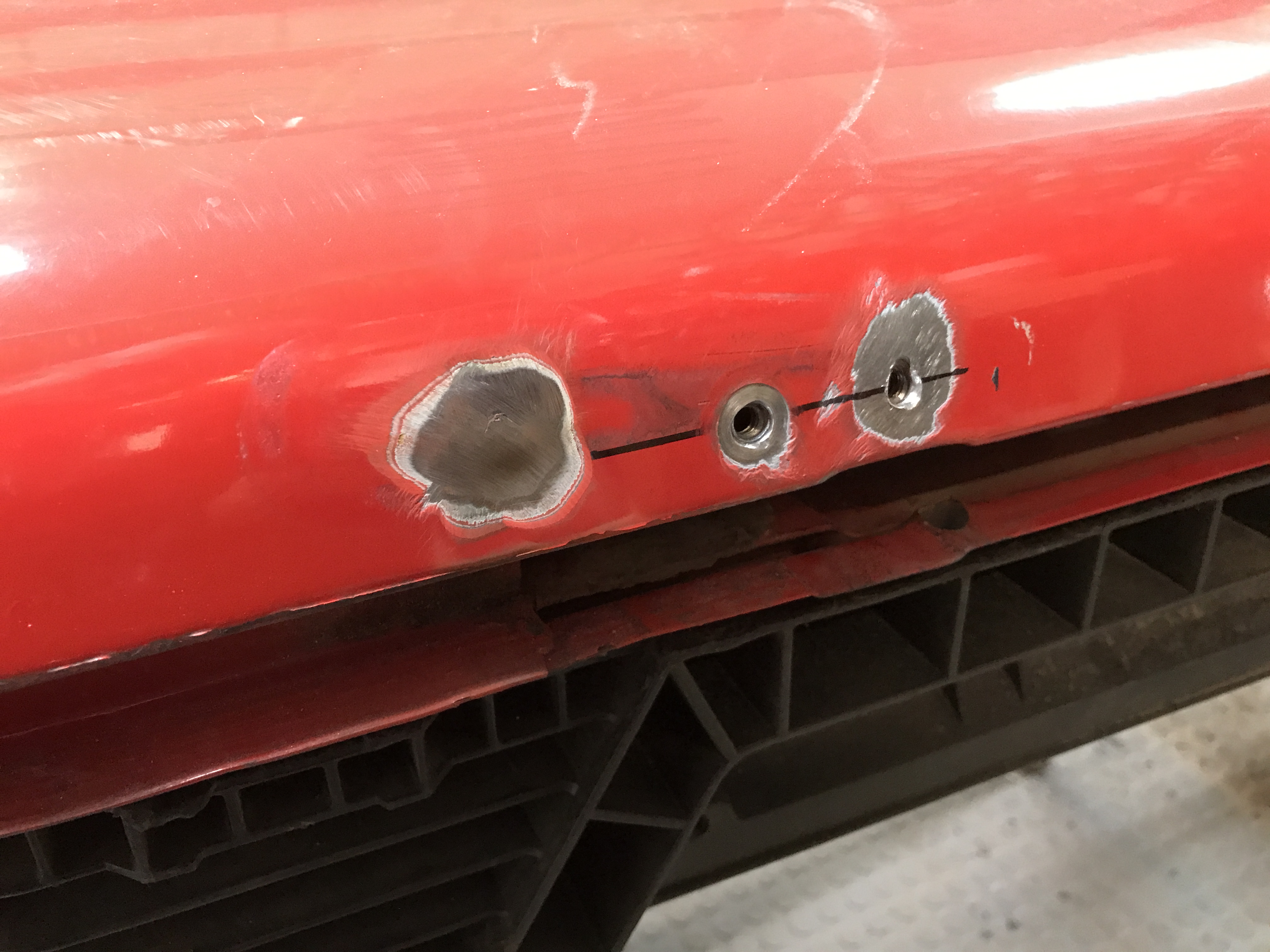

I got back to working on the doors today. On the right (original) door that meant welding shut the hole the PO drilled for an aftermarket mirror, and then opening up the stock mirror hole and chasing the threads.

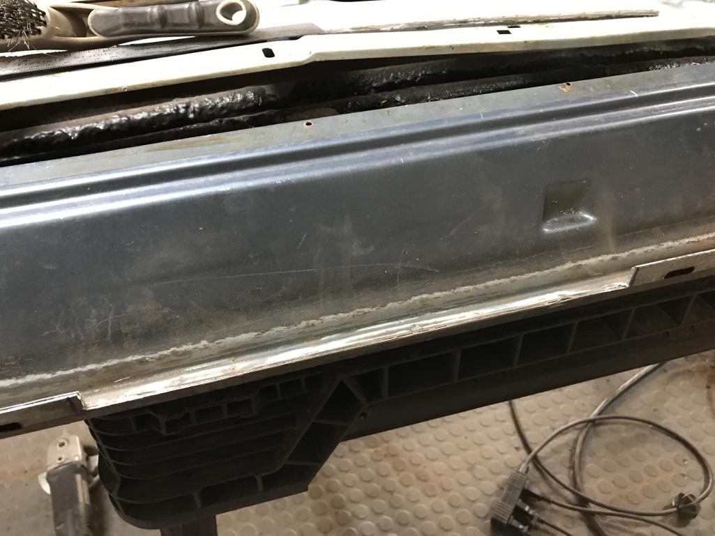

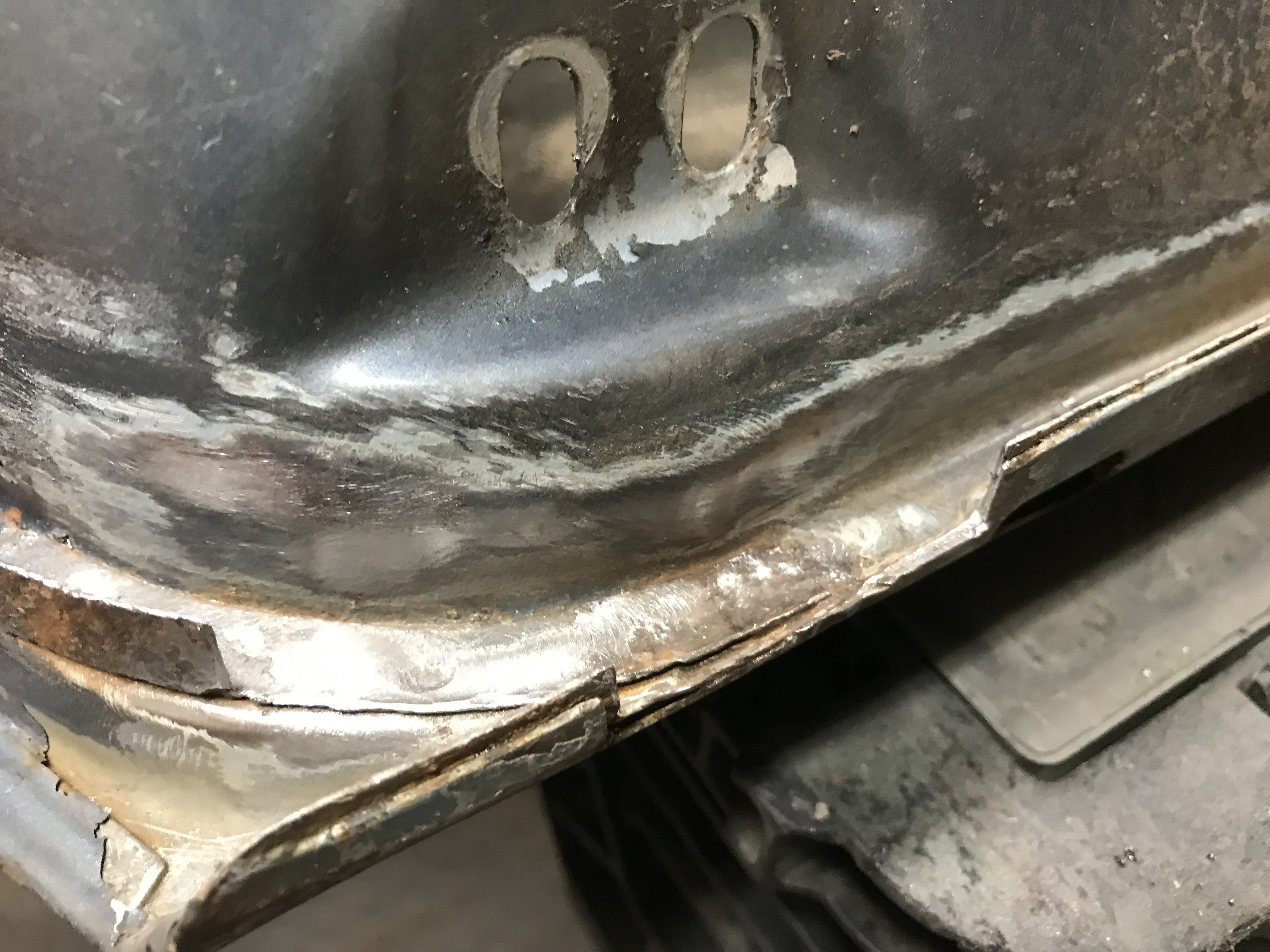

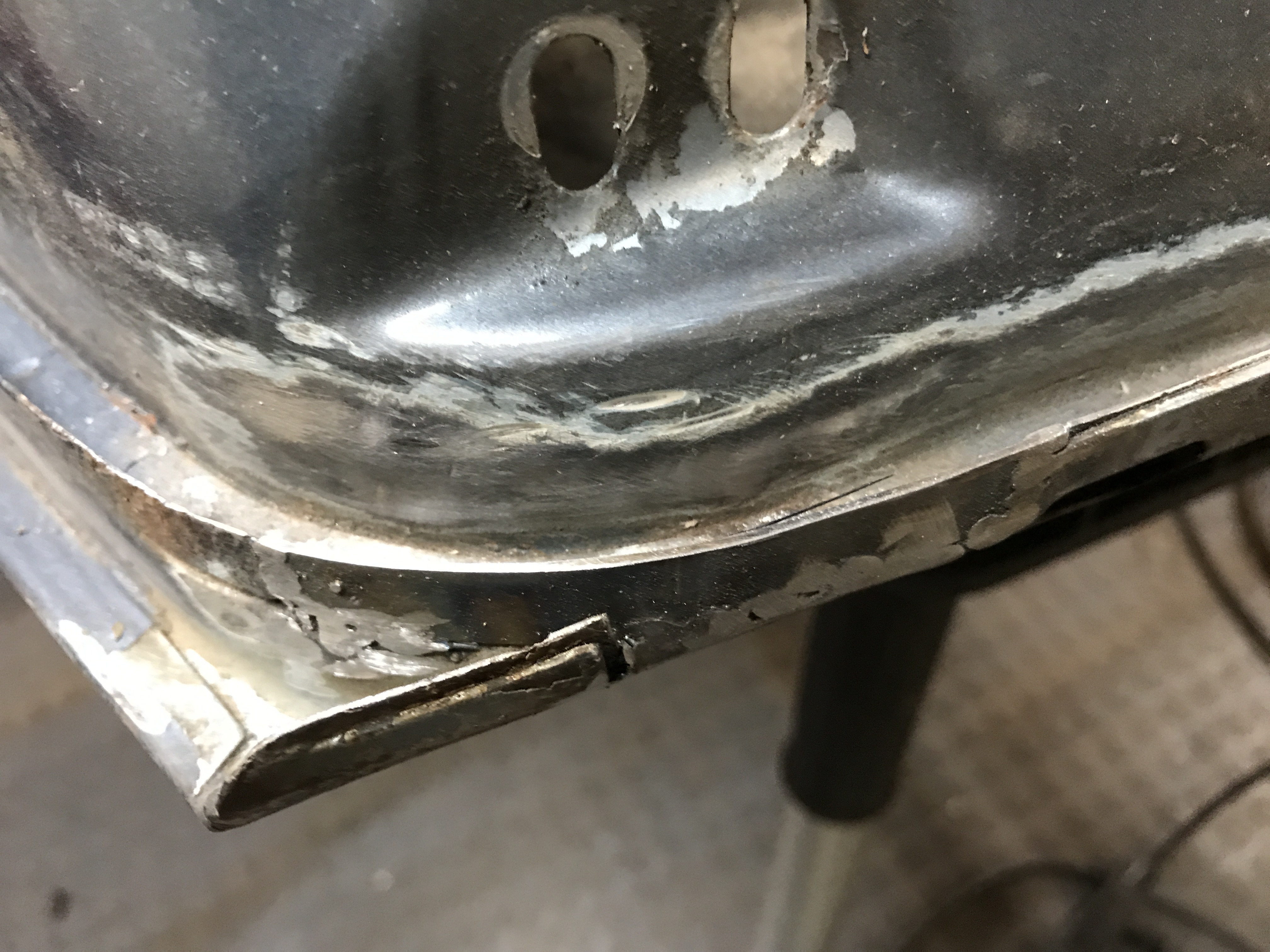

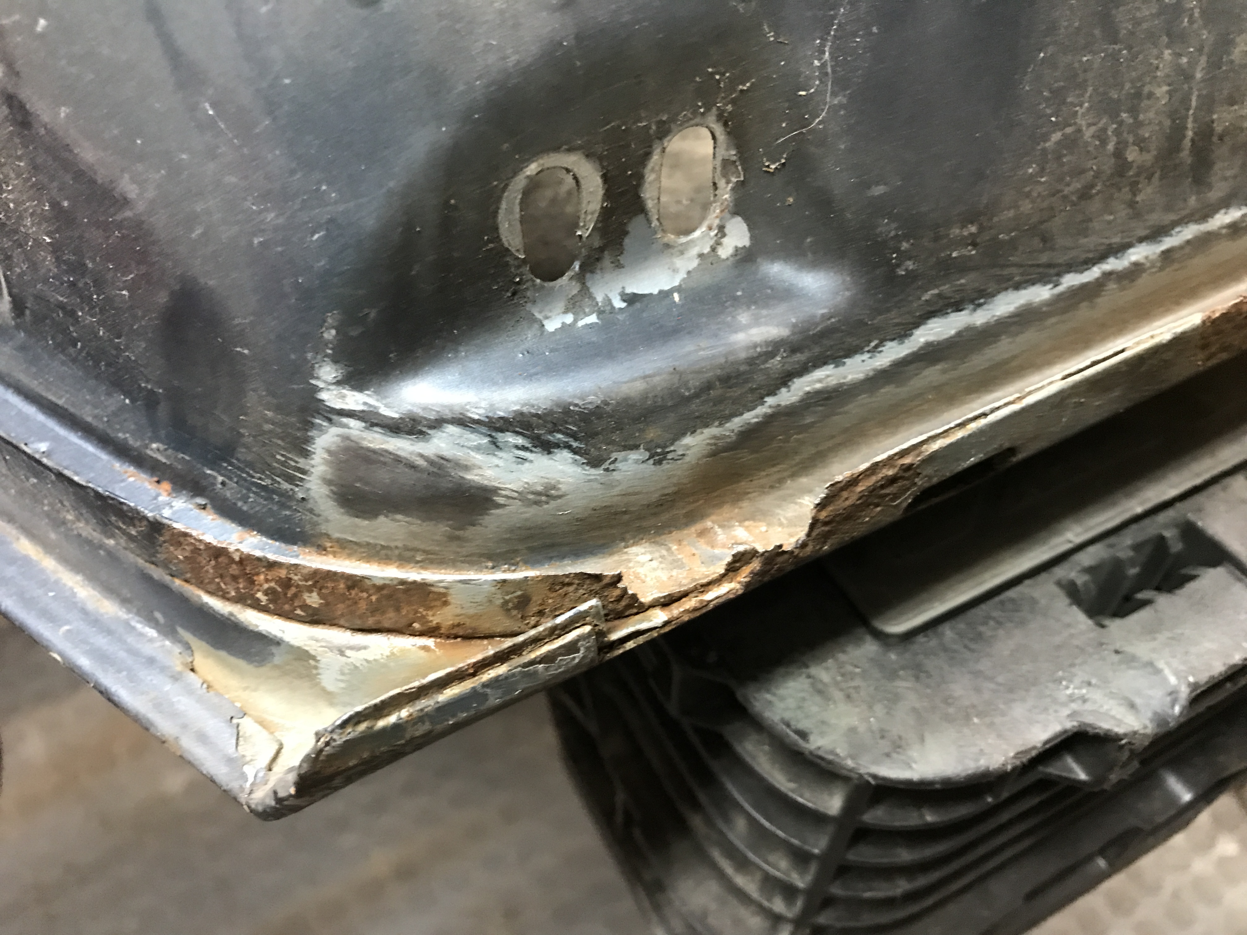

On the left (donor) door I have to replace some rusty sections of the weatherstrip channel flange along the lower edge. The worst spot is at the rear curve.
bkrantz
post Jun 6 2020, 09:10 PM
Post #744
Posts: 8,796
Joined: 3-August 19
From: SW Colorado
Member No.: 23,343
Rusted section cut out.

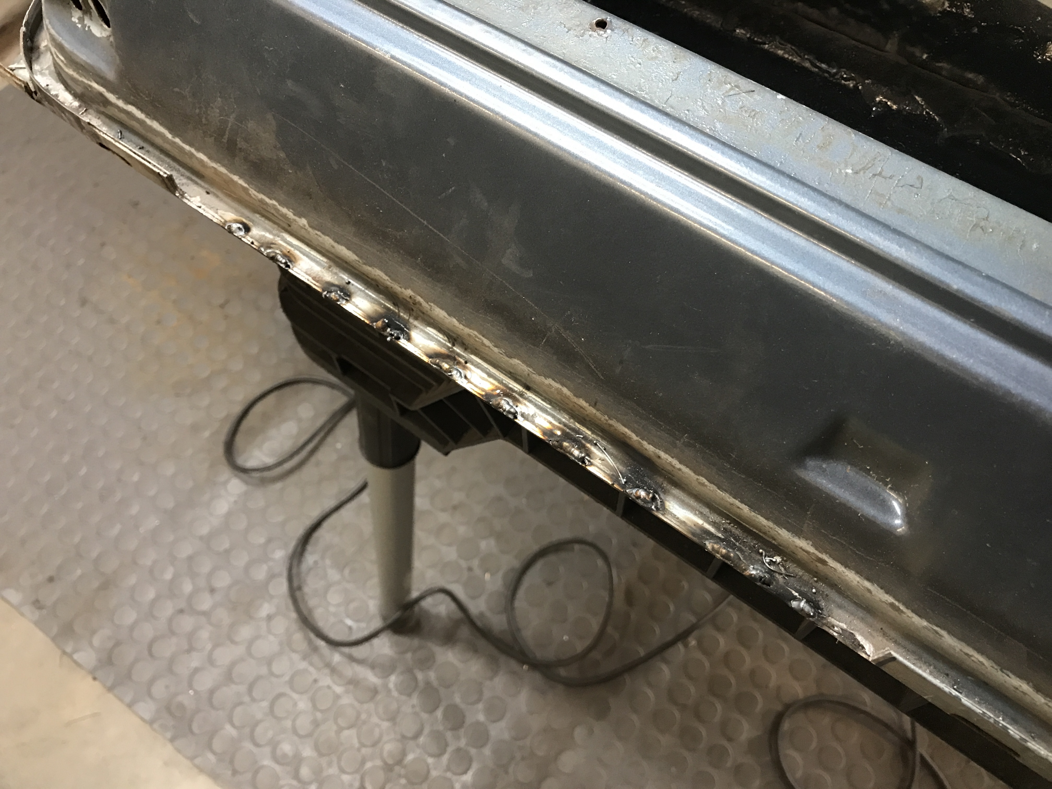

New metal welded in, and ground smooth and even.

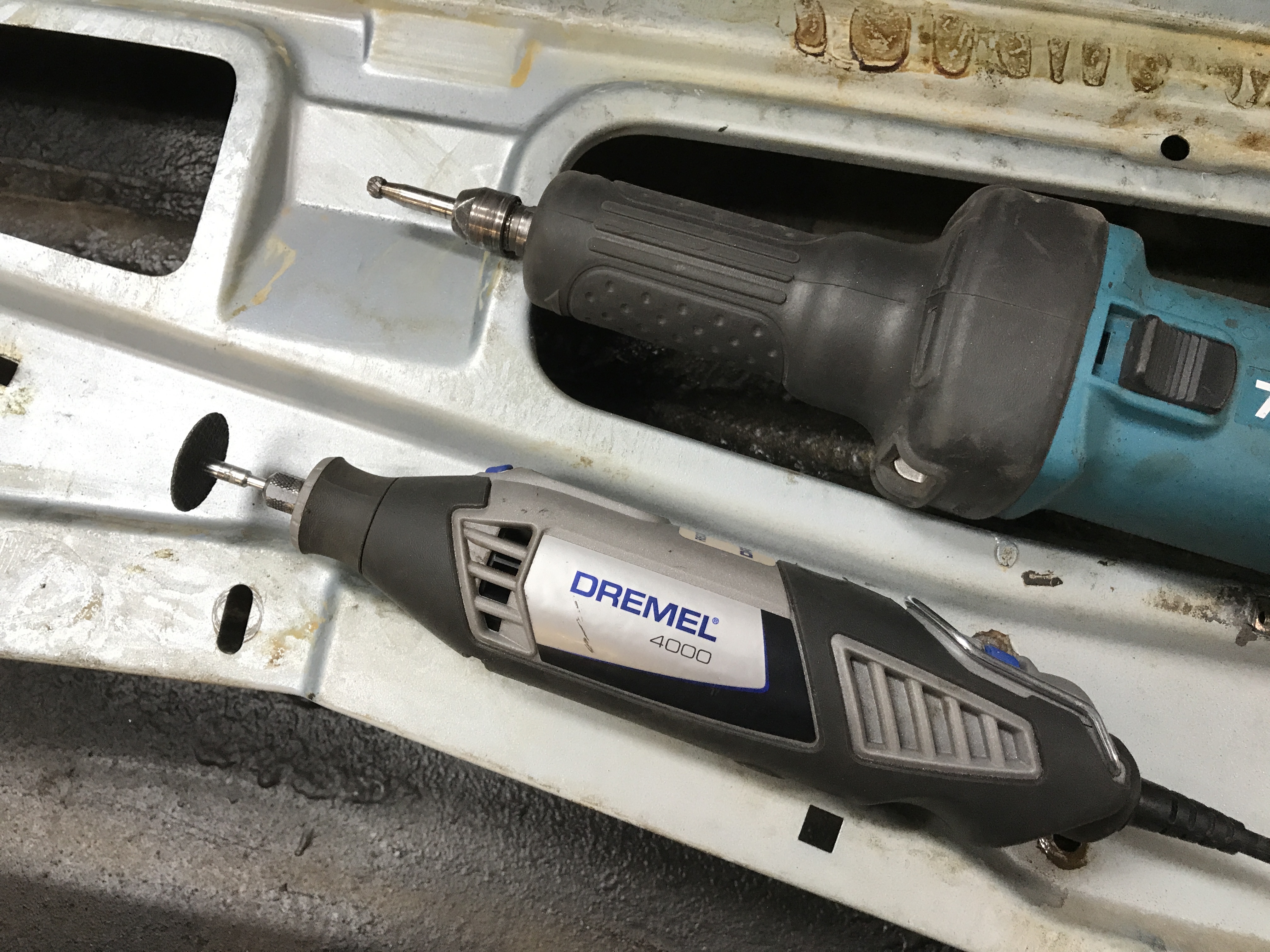

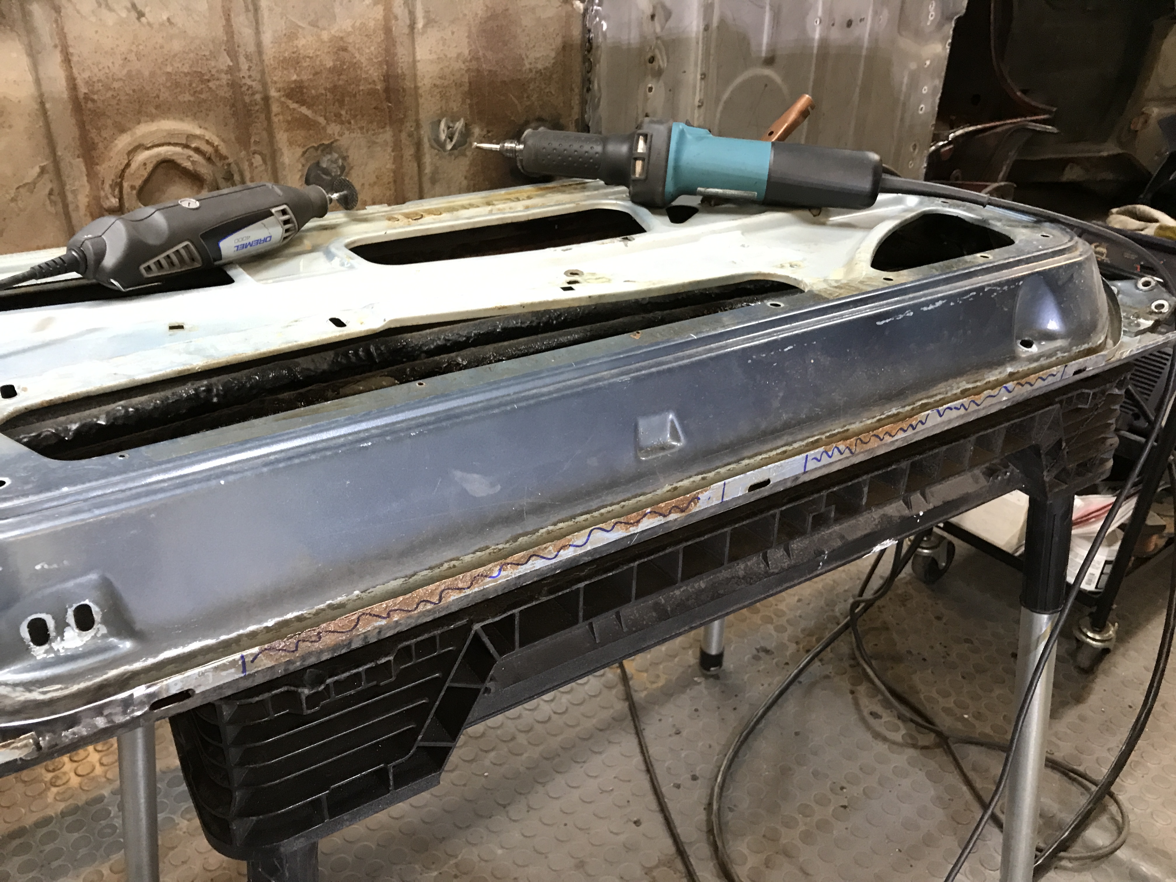

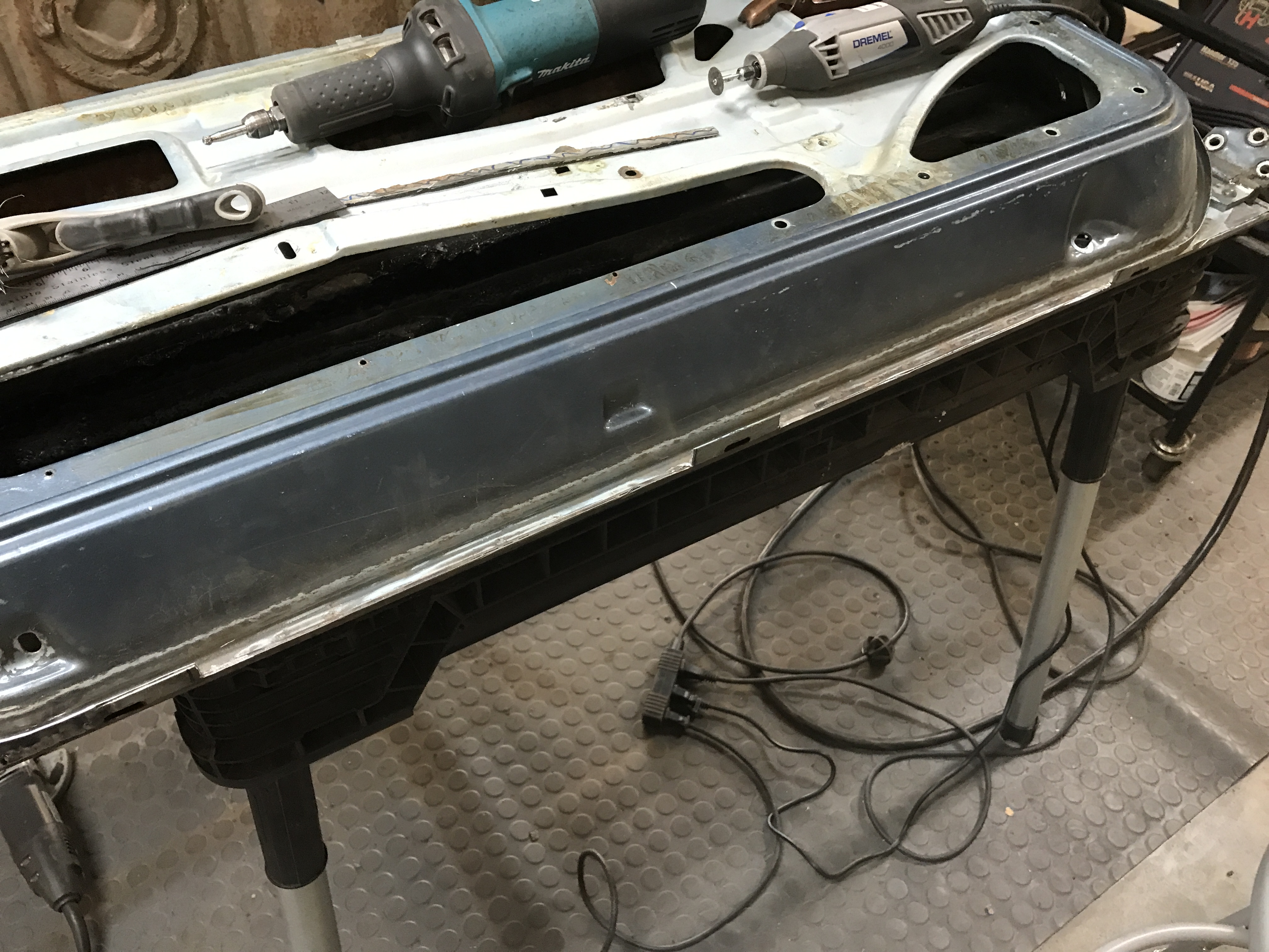

Today, the hero tools were the Dremel with mini cutoff disk, and the die grinder with small ball bit.

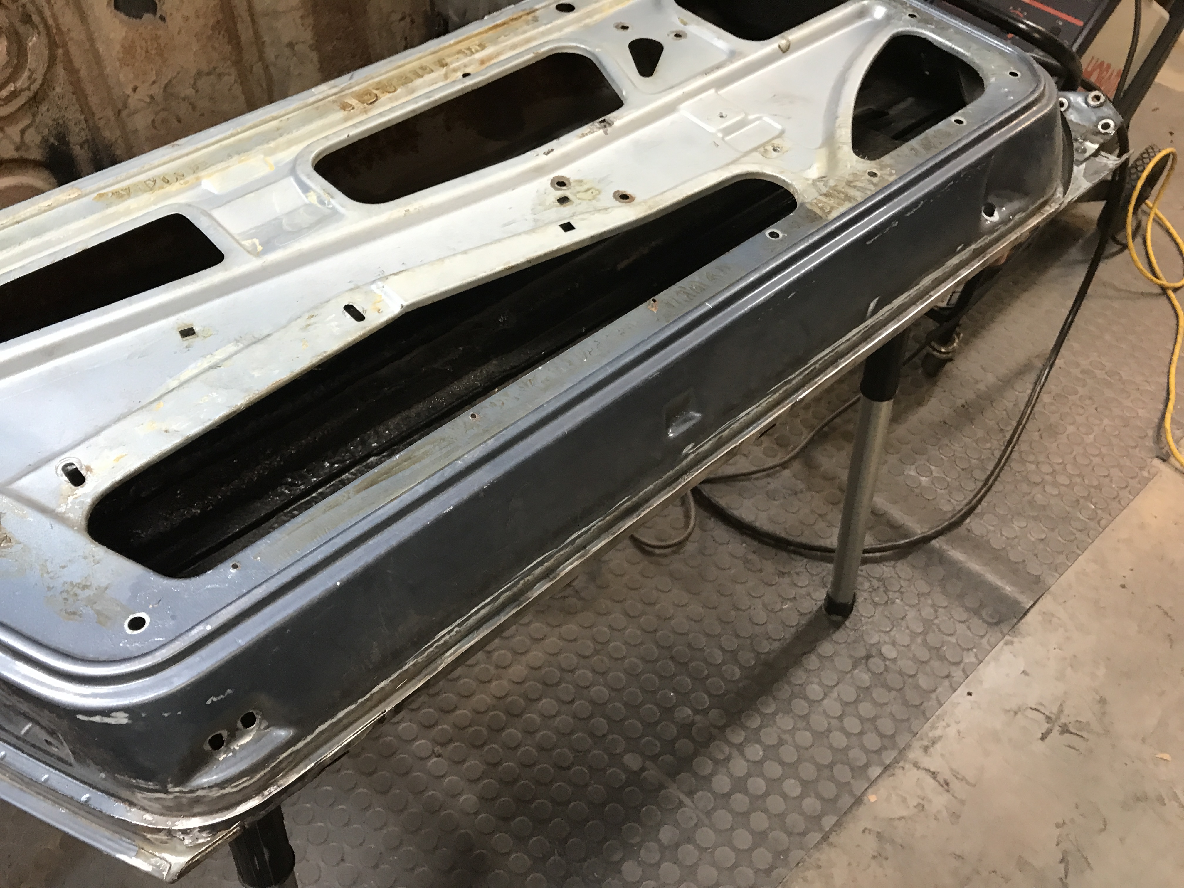

Another day in 914 restoration paradise.
Here's the door with the long rusty sections removed.
bkrantz
post Jun 7 2020, 08:07 PM
Post #749
Posts: 8,796
Joined: 3-August 19
From: SW Colorado
Member No.: 23,343

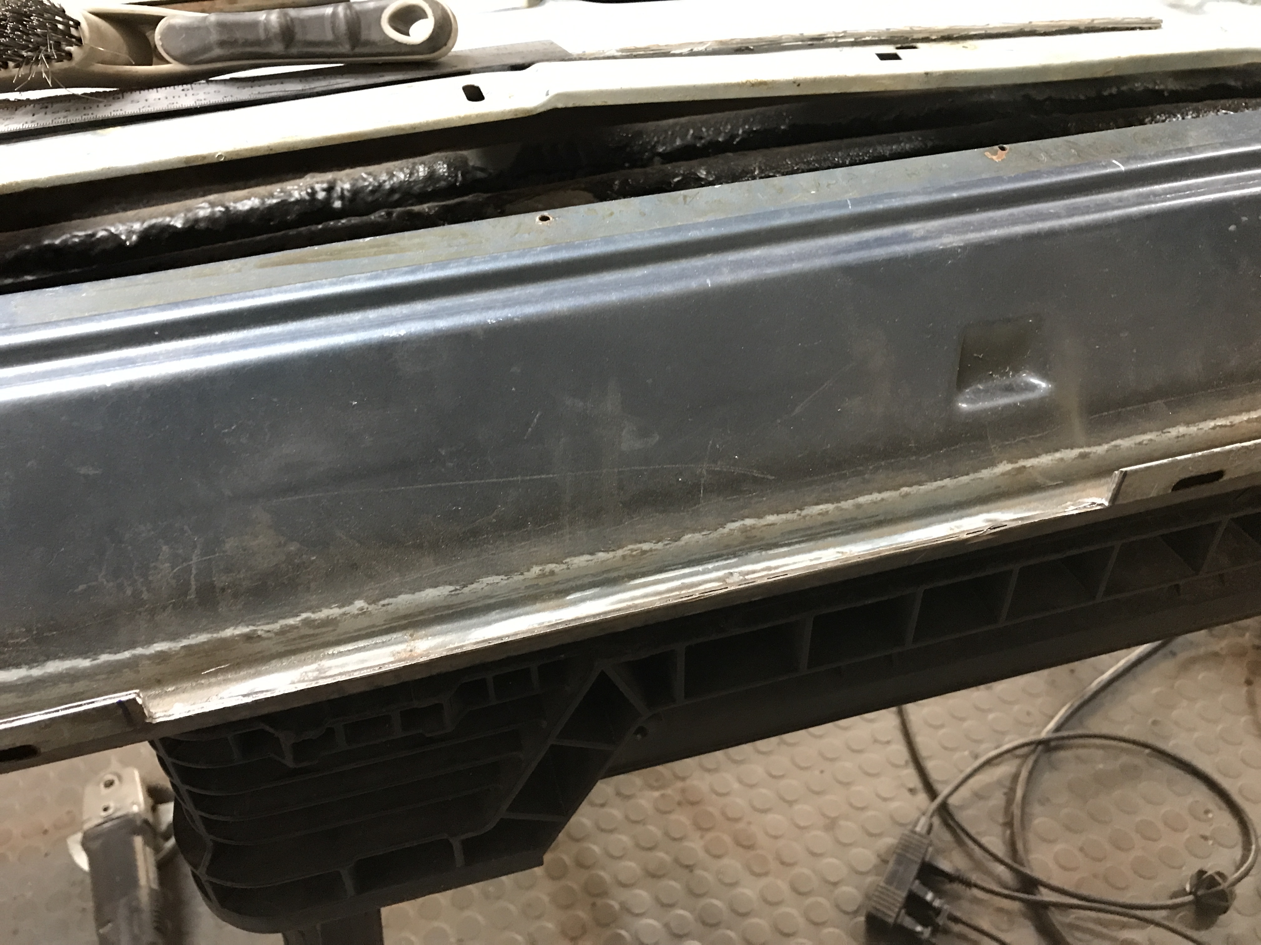

A close-up of one section.

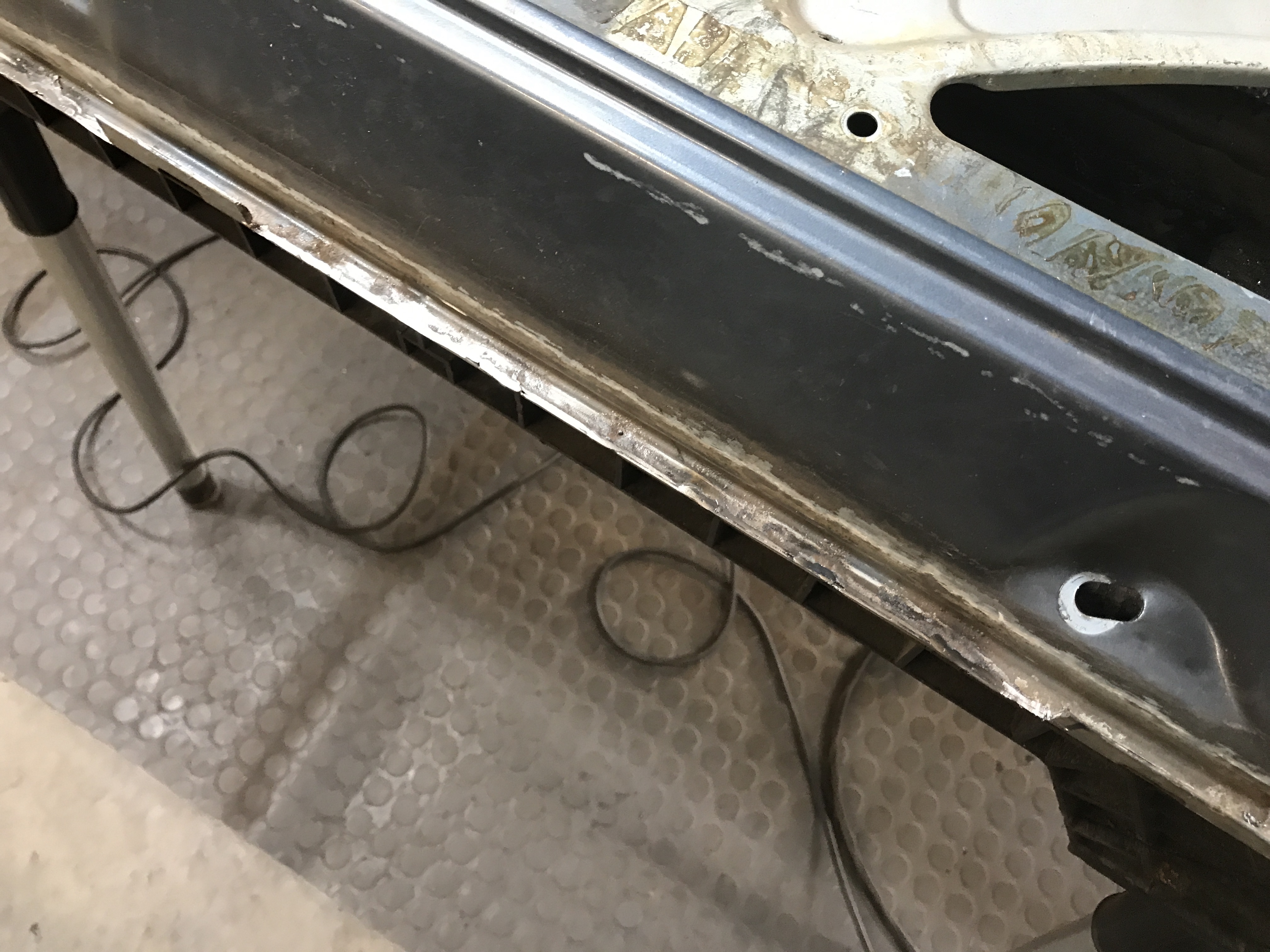

I did realize that these sections no longer have any connection between the door skin and inner panel, so added some short weld beads.

And then ground then down flush.

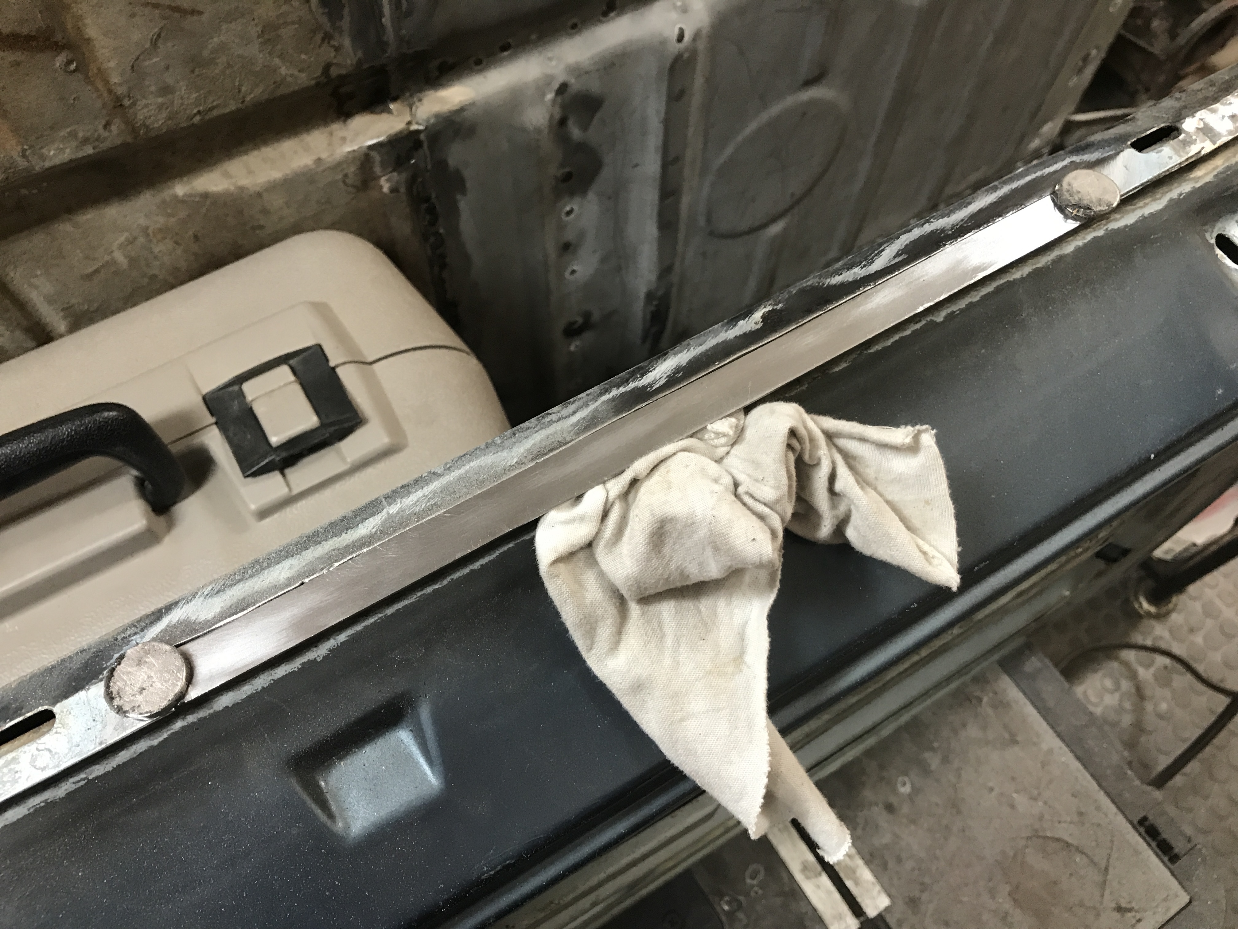

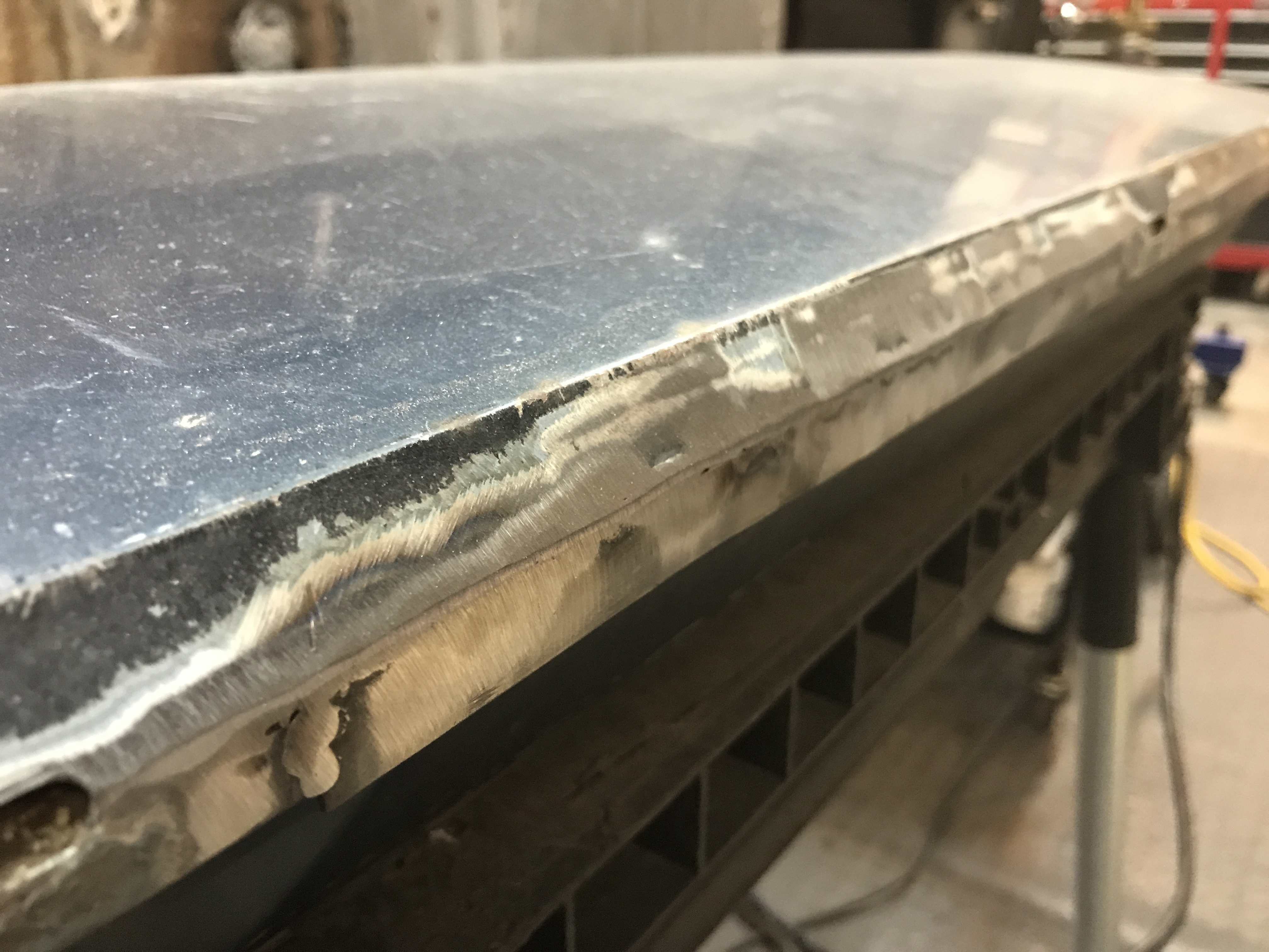

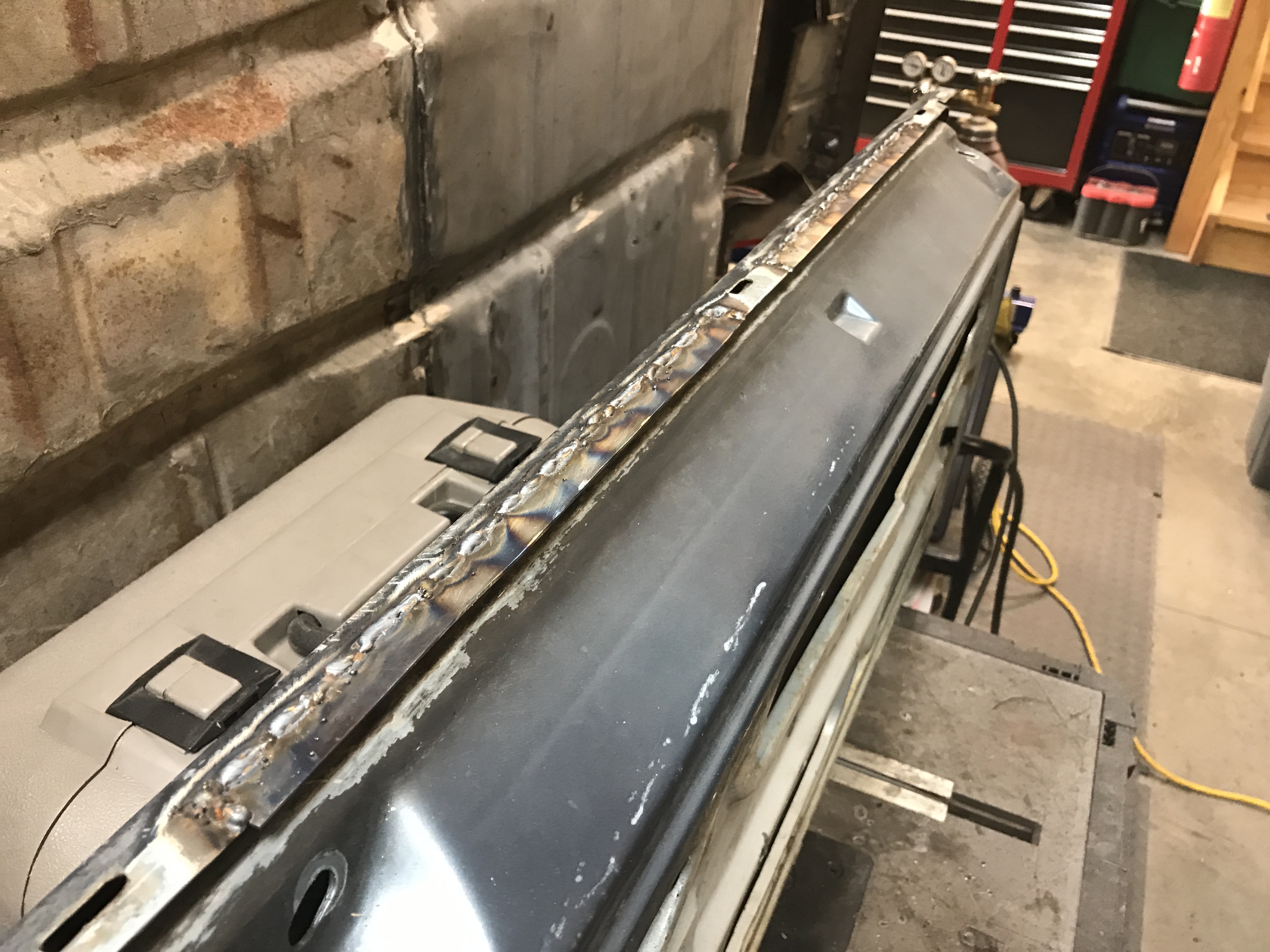

Time to fit the replacement strips. I made these from heavier 18 gauge so they better the original double thickness.
bkrantz
post Jun 7 2020, 08:12 PM
Post #753
Posts: 8,796
Joined: 3-August 19
From: SW Colorado
Member No.: 23,343
Both pieces welded in place.
bkrantz
post Jun 7 2020, 08:13 PM
Post #754
Posts: 8,796
Joined: 3-August 19
From: SW Colorado
Member No.: 23,343
Ground down to smooth and almost pretty.
bkrantz
post Jun 7 2020, 08:15 PM
Post #755
Posts: 8,796
Joined: 3-August 19
From: SW Colorado
Member No.: 23,343
The channel is back to solid metal.

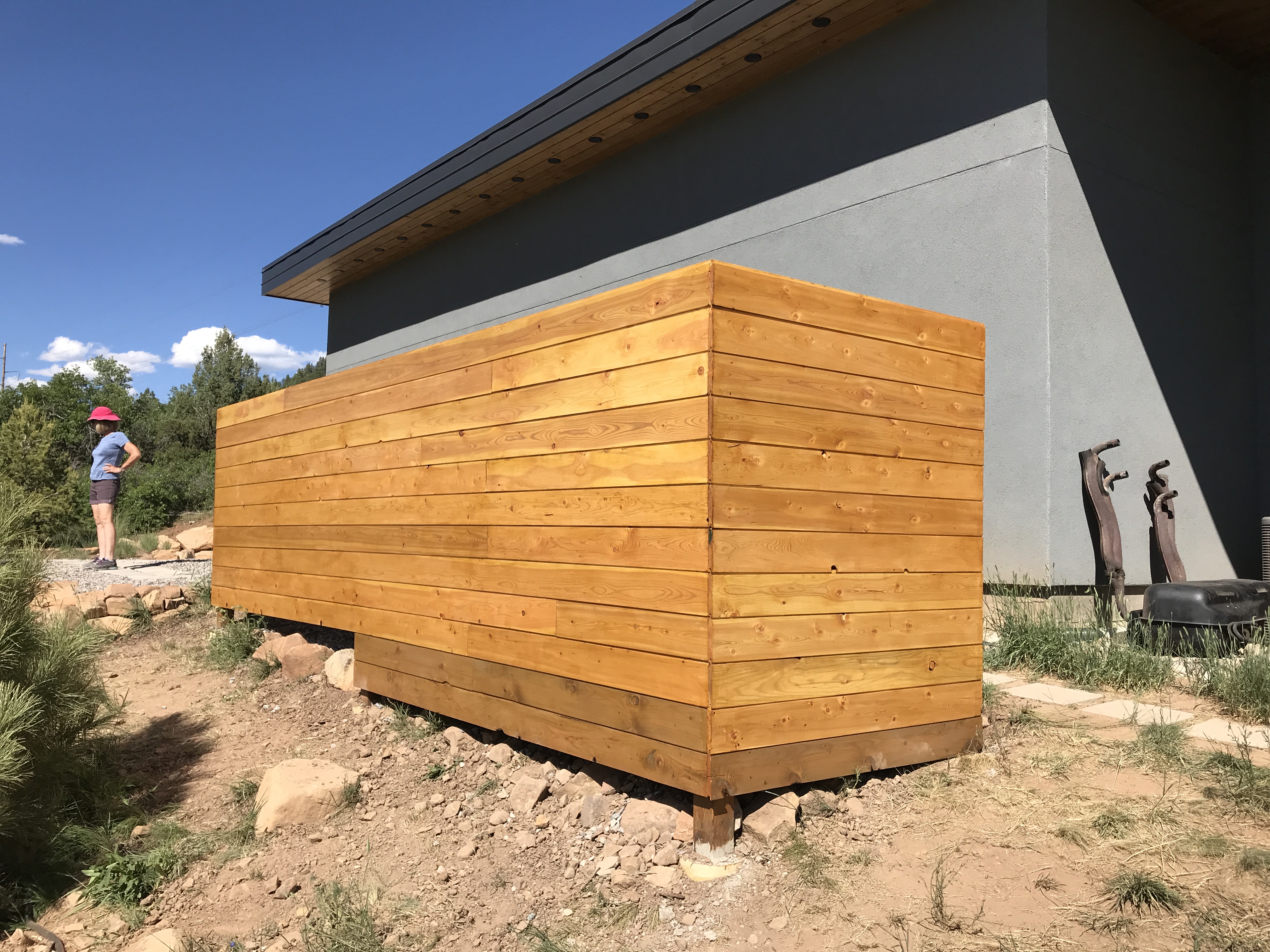

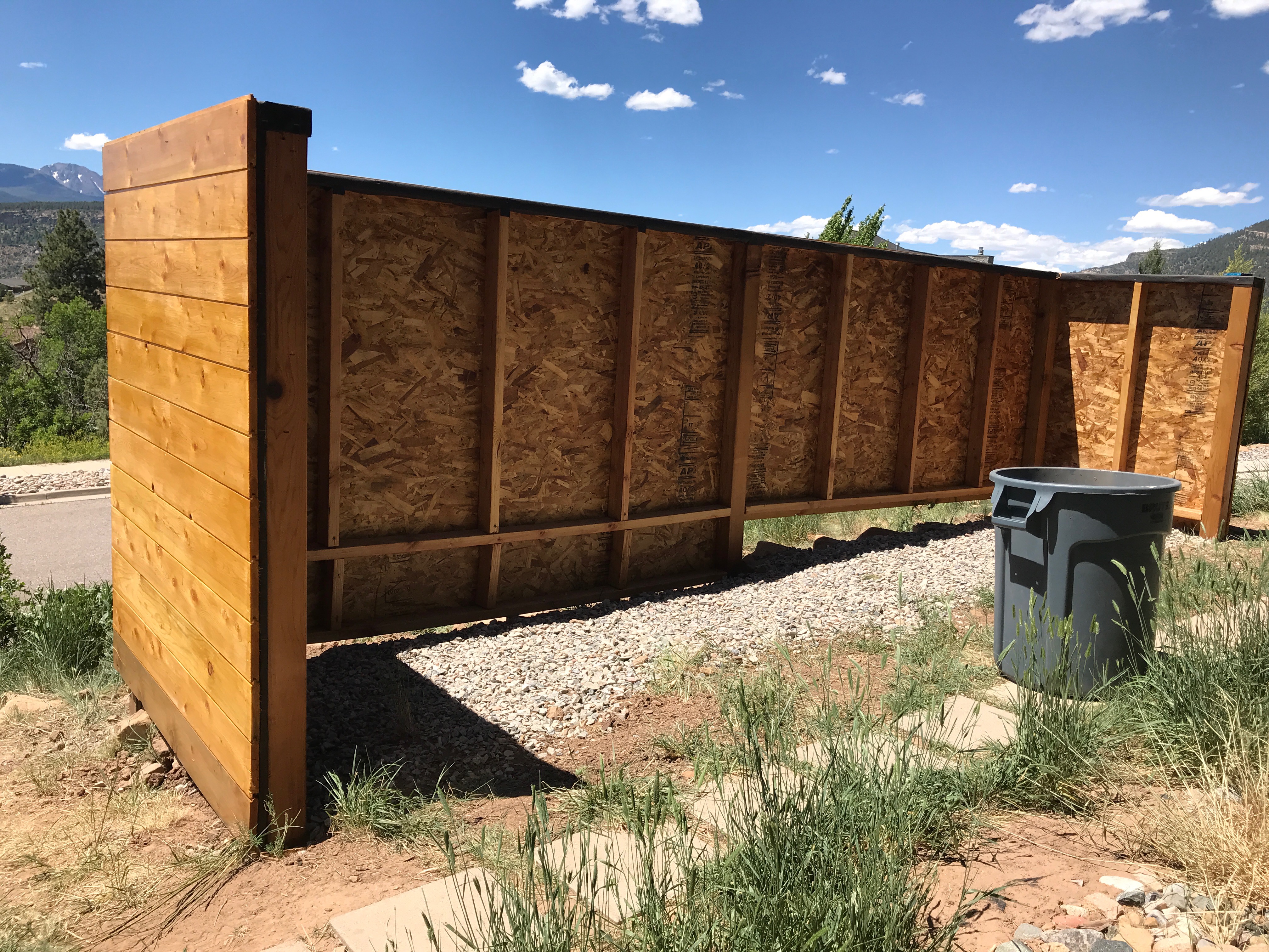

I have been busy with my annual battle with mice in the crawl space under my house, and building a short section of fence between my garage and street, party to screen all the utilities on the wall that is the "front" of the house.
bkrantz
post Jun 11 2020, 08:45 PM
Post #758
Posts: 8,796
Joined: 3-August 19
From: SW Colorado
Member No.: 23,343
The fence also creates a place to hide junk over-flowing from garage and yard.

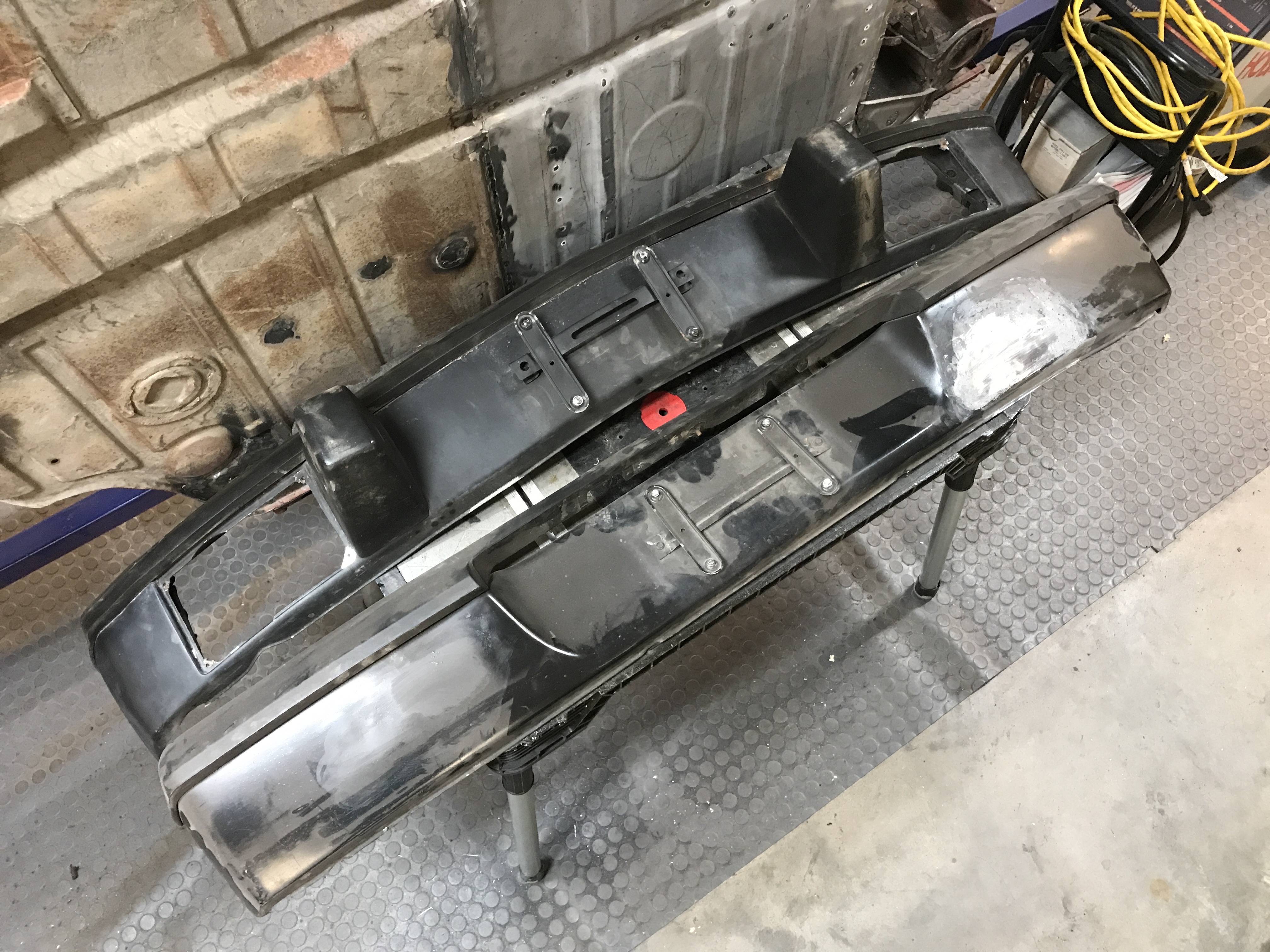

Now that those other chores are nearly done, back to 914 work. Coming soon: bumpers!

Good to see your progress. lots of work (IMG:style_emoticons/default/biggrin.gif)
@bkrantz What do you plan for the bumpers? Chrome or painting them?
