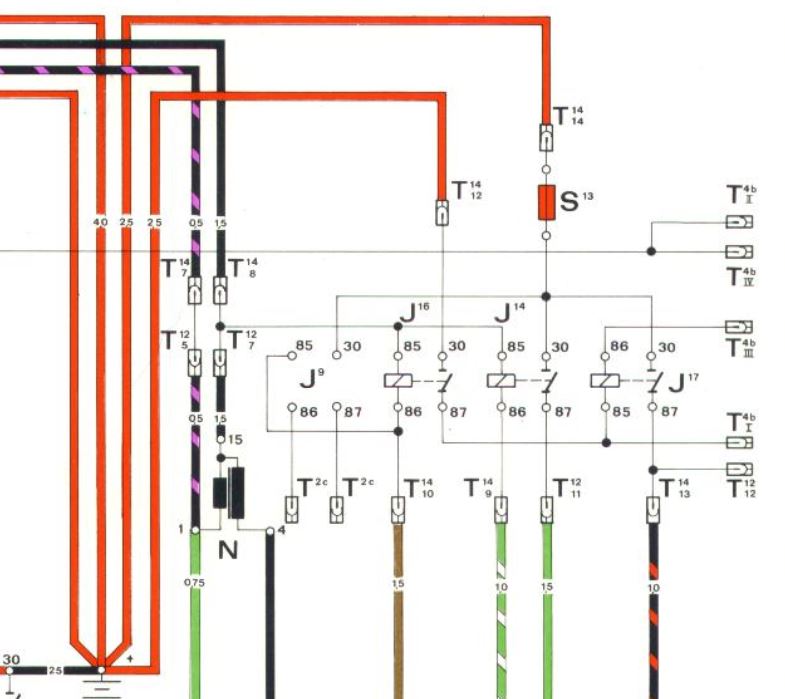

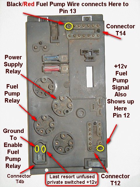

GregAmy   Post how you have it wired?   Oct 22 2019, 09:01 PM
surfdogskier   Post how you have it wired? I have it wired the ...   Oct 23 2019, 07:50 AM
GregAmy   Post how you have it wired? I have it wired the...   Oct 23 2019, 08:35 AM
surfdogskier   [quote name='surfdogskier' post='2756654' date='O...   Oct 23 2019, 08:52 AM
GregAmy   Edited noon for errors. I know. I did the SirAnd...   Oct 23 2019, 09:40 AM

sixnotfour   go by the picture   Oct 23 2019, 09:48 AM
GregAmy   go by the picture With key on and pump runnin...   Oct 23 2019, 10:02 AM
surfdogskier   go by the picture With key on and pump runni...   Oct 23 2019, 11:32 AM
GregAmy   Fuel pump relay pulled, pump goes off. Power supp...   Oct 23 2019, 11:39 AM
Gatornapper   #1 - you need this jumper on your relay board (low...   Oct 23 2019, 10:12 AM
surfdogskier   #1 - you need this jumper on your relay board (lo...   Oct 23 2019, 06:11 PM

sixnotfour   the ground needs to be #3 not #4 as before mentio...   Oct 23 2019, 02:22 PM
sixnotfour   the ground needs to be #3 not #4 as before menti...   Oct 23 2019, 06:48 PM
