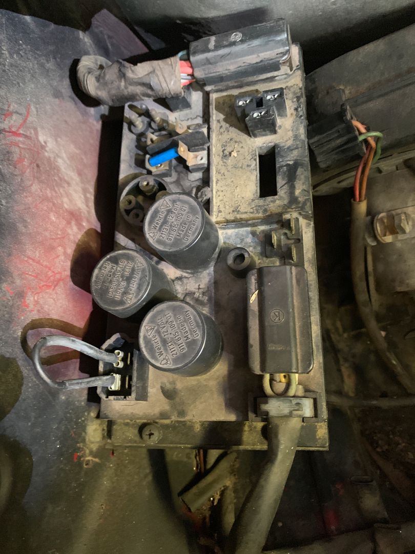

I will work on the fuel pump not shutting off after I get this thing started.
My rotor goes clockwise and I have my plug wires firing in order. Is it suppose to fire off the #1 plug first every time and then move on to the #4, #3, #2?
I am getting backfires through both carbs while cranking. Does this mean I am not getting enough fuel? I have not adjusted either carb. From what the instructions showed, she should start and then you can fine tune.

sixnotfour
post Oct 23 2019, 02:22 PM
Post #44
Posts: 11,423
Joined: 12-September 04
Member No.: 2,744
the ground needs to be #3 not #4 as before mention.. to work with carbs ..
the second version pictured works for him , but the norm is ground #3

[quote name='Gatornapper' post='2756688' date='Oct 23 2019, 12:12 PM']
#1 - you need this jumper on your relay board (lower left):
(IMG:http://www.914world.com/bbs2/uploads_offsite/i890.photobucket.com-21449-1571847147.1.jpg)
#2. - you need to get a fuel pressure regulator and gauge and set the pressure to 3psi max.
My dual Weber 44's run fine with the above.
GN
This didn't work in my case. Pump still stayed on.

sixnotfour
post Oct 23 2019, 06:48 PM
Post #53
Posts: 11,423
Member No.: 2,744
QUOTE(sixnotfour @ Oct 23 2019, 02:22 PM) *

surfdogskier
post Oct 23 2019, 07:33 PM
Post #55
Posts: 164
Joined: 20-May 16
From: East TN

surfdogskier
post Oct 23 2019, 08:38 PM
Post #56
Posts: 164
Joined: 20-May 16
From: East TN
Member No.: 20,019
QUOTE(rhodyguy @ Oct 23 2019, 09:21 PM) *
Where on the cap did #1 wind up? Normally it would be around 2 o'clock. Glad it started for you. You'll note in a picture in andy's write up the ground wire runs from the front one of the 2 jumped terminals to the ground post on the chassis forward of the relay plate.
Mine was closer to around the 4 o'clock spot if I remember correctly.
That is the way I did the ground. But when I leave it hooked up and turn off the key, the pump will stay on. I have to unplug that wire from ground to shut it off.
