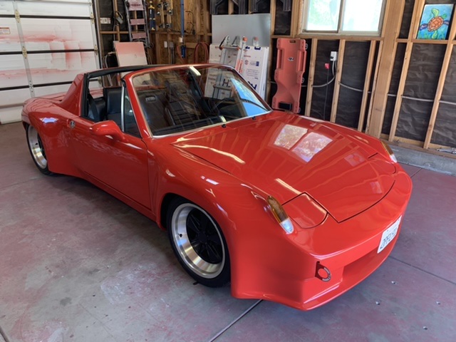

Hi World, I am moving on to the next phase of my project, and have enough things planned that I will call it phase 2. Hopefully this thread will motivate me to see it through quicker, and maybe help someone else at the same time.
Phase 1 was my 7 year adventure taking a banged up 73 roller and installing a SBC, renegade kit, and Sheridan body kit. Here is basically what it looks like now
Had fun driving it for a summer and a winter, then realized I am ready to start the next round of upgrades. The list in no particular order and consists of:

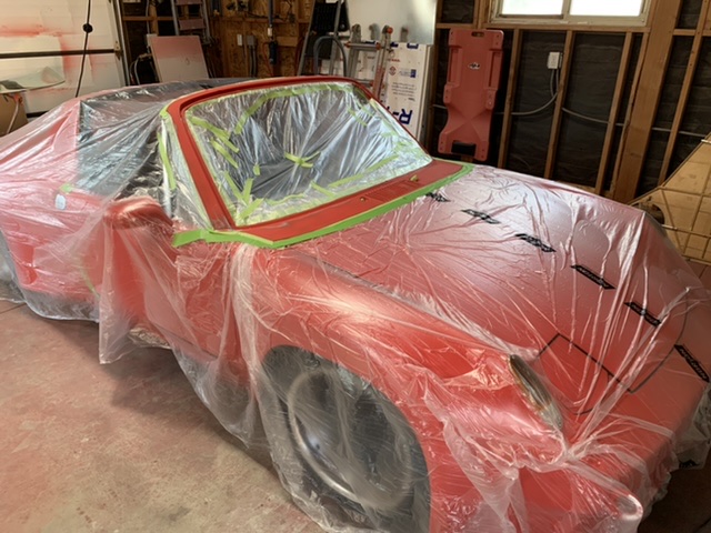

FL 000   Next up got the car on supports to adjust the door...   Sep 6 2020, 01:55 PM
76-914   Insert some wood shims from inside between the doo...   Sep 6 2020, 02:21 PM
914forme   You will always get a bit of shrinkage when you we...   Sep 6 2020, 05:57 PM

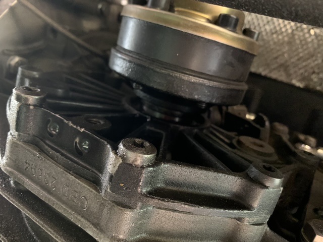

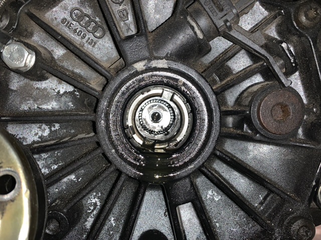

FL 000   Decided I was going to do the Audi 01E install aft...   Nov 8 2020, 03:40 PM

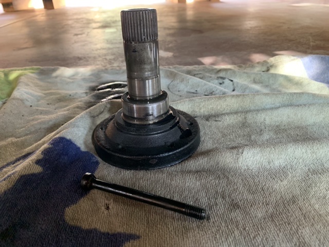

FL 000   Alright it turns out the heads were jacked up. Too...   Jan 8 2021, 08:11 PM
FL 000   So put my heads on tonight and adjusting the valve...   Jan 8 2021, 08:18 PM
rhodyguy   WOW! That could have been a life changing even...   Jan 8 2021, 09:13 PM
djway   Holy Crap. What brand is that stand? Glad you stil...   Jan 8 2021, 09:28 PM
FL 000   Holy Crap. What brand is that stand? Glad you sti...   Jan 9 2021, 10:14 AM
808 WRX   Glad your feet are ok! Hope the motor is ok t...   Jan 9 2021, 10:48 AM
djway   Holy Crap. What brand is that stand? Glad you st...   Jan 10 2021, 01:39 AM
76-914   Aww Man. Sorry dude. I've got one of those but...   Jan 9 2021, 10:24 PM
cali914   You are lucky from the head situation and the acci...   Jan 10 2021, 01:29 AM
Andyrew   Wow that is nuts with the engine stand! I have...   Jan 10 2021, 01:33 AM
