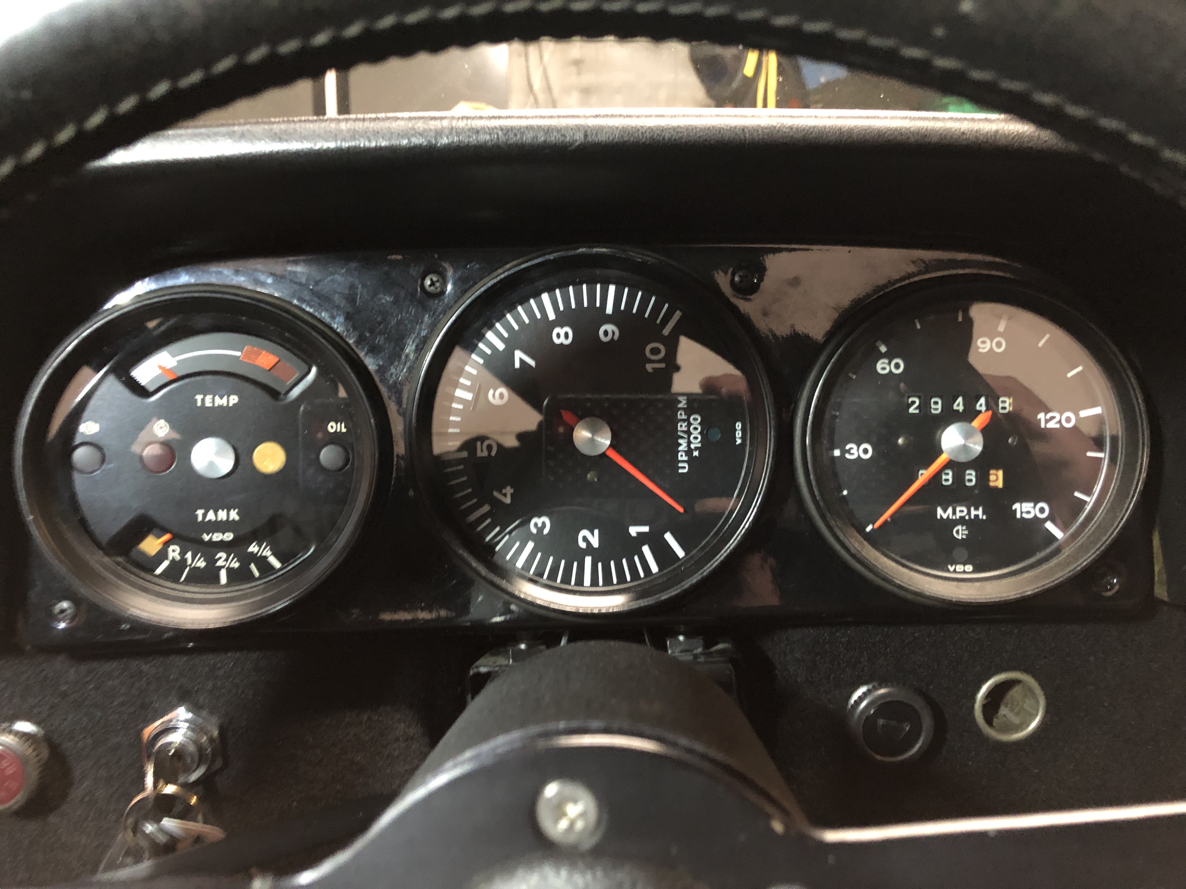

SO there are some threads floating around which detail the conversion of a stock 914 VDO tachometer to use a modern Bosch drive core. Improved ballistics and more modern internals are the main motivation for this; the VDO cores tend to overshoot as they age.
I modified one to match to a 10,000 upm GT style fascia - sourced from Germany - and fitted it to my car. The core needs to be calibrated to the motor type (4 or 6 cylinders) but once done works with a wide range of inputs (Bosch CDI, MSD, etc) and is a talking point to anyone remotely familiar with the details of racing Porsches. The original 10K tach units appear for sale occasionally - but are fairly pricey. Hence the motivation to make a more accessible solution.
Here is mine completed:
and in the car:

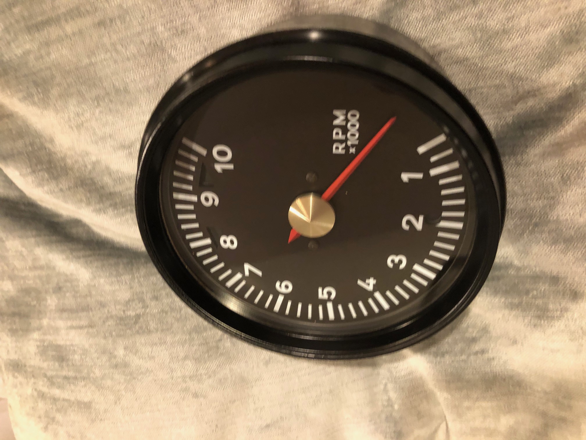

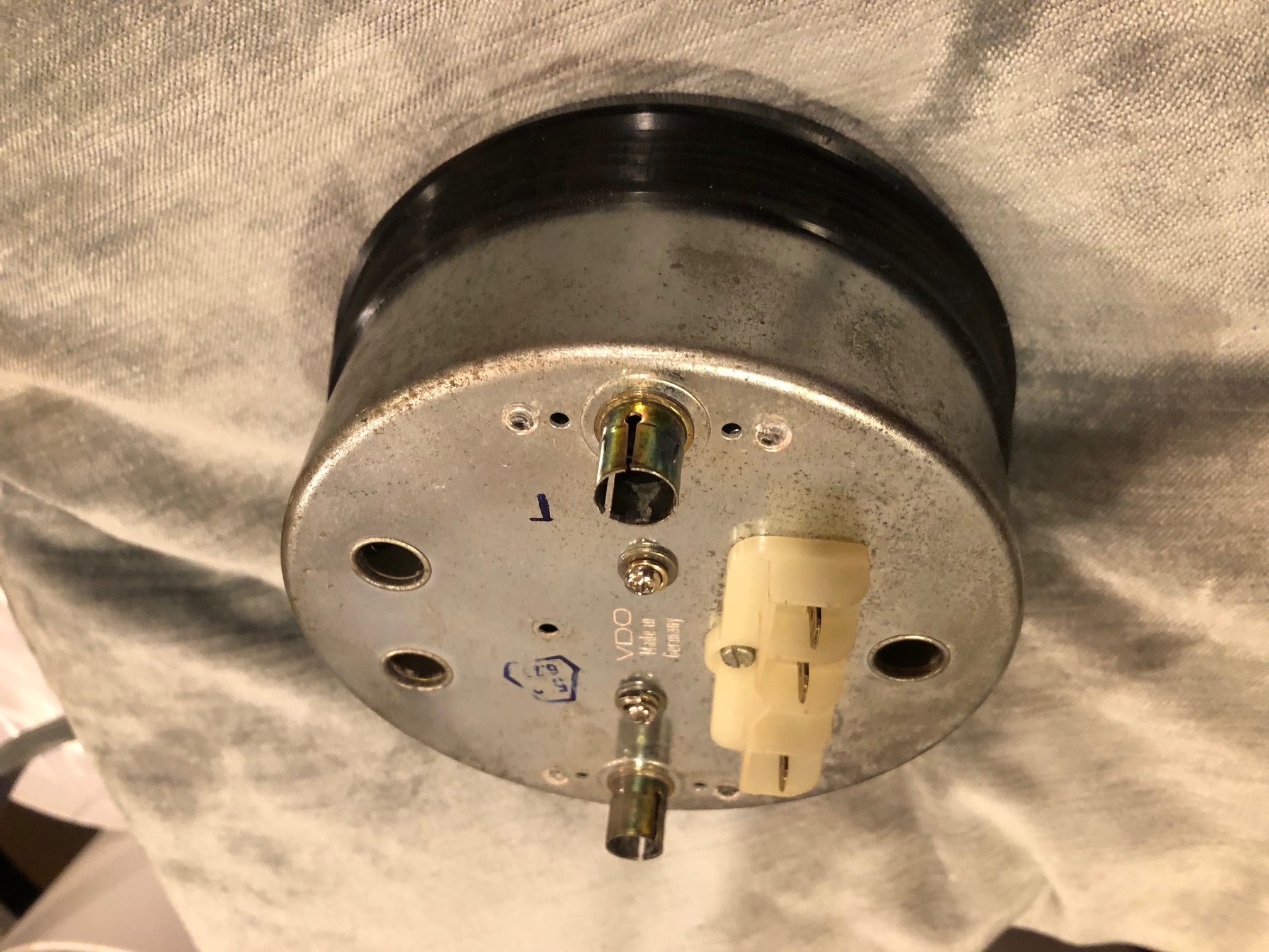

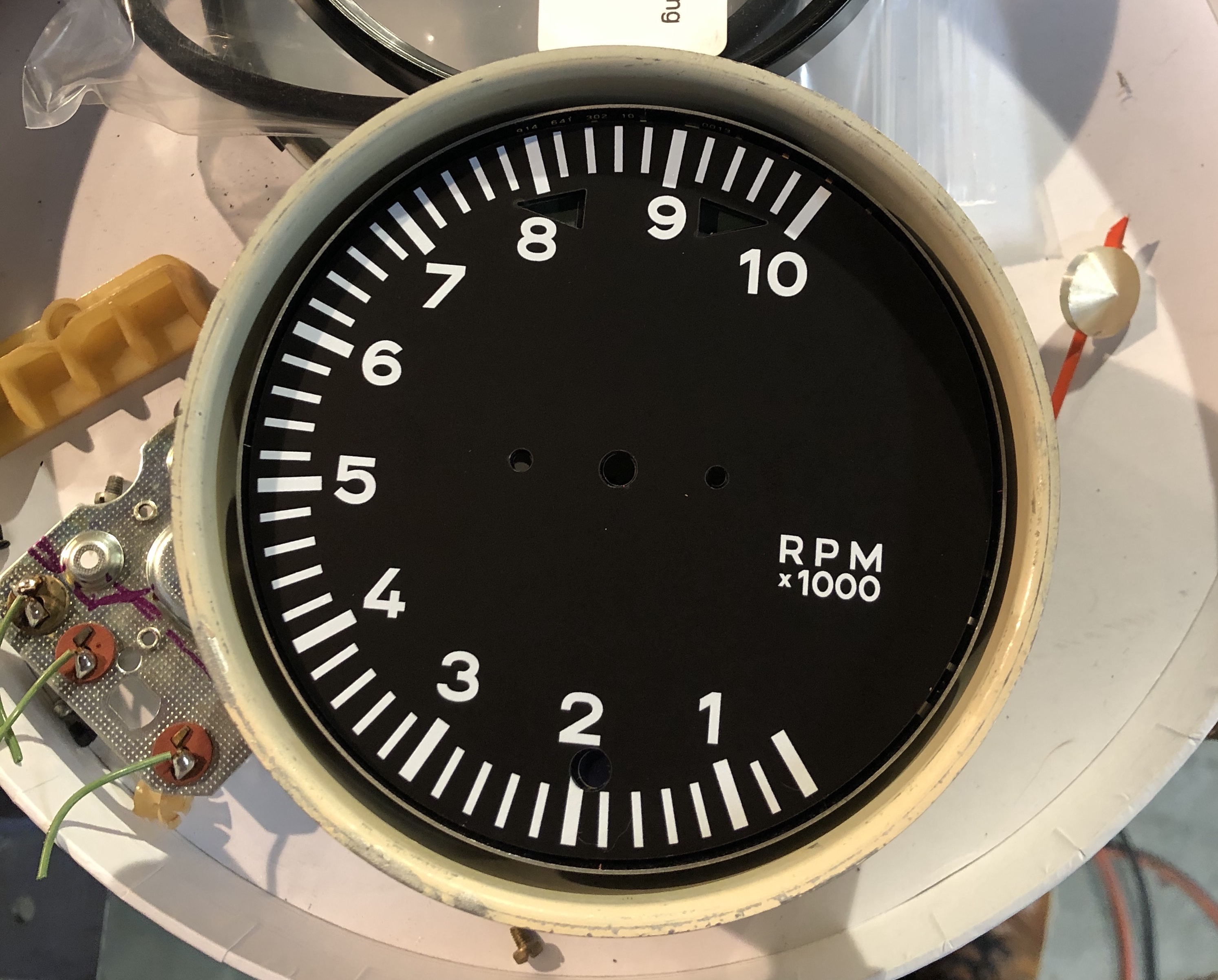

Update for those who expressed interest: so the tach fascias from Germany just cleared customs - arrived yesterday. Here's how the "clocked" version looks:
The fascias are super high quality pieces. I now have all the parts in house, I just need to the PCB mods, calibrate and test all 3 units - then zip them up.
- Tony

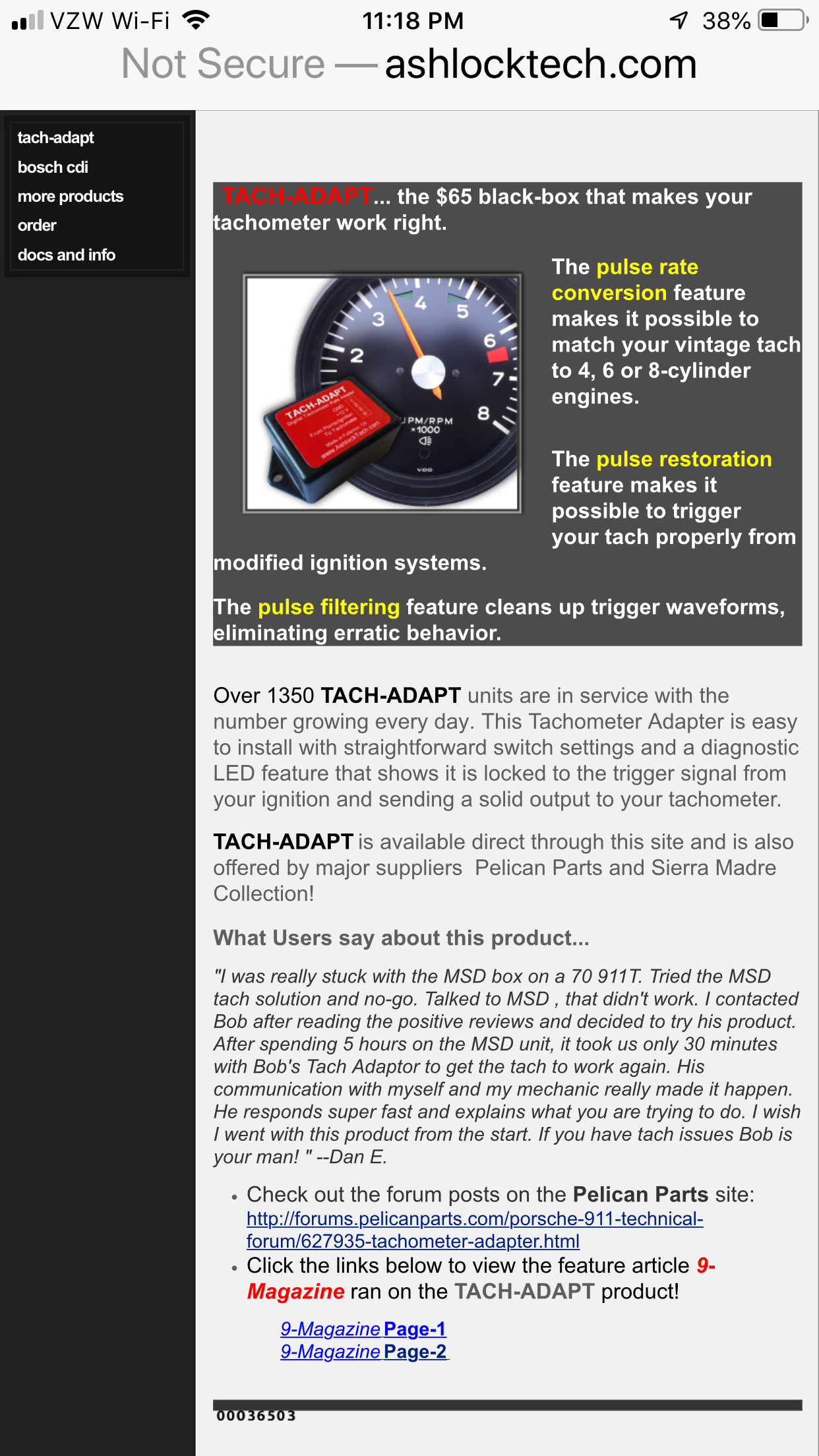

I had a 911T Tech converted to 10K by North Hollywood Speedometer for my 1970 914-6 It came out great, but it would not read the correct RPM. It was off by about 2000 rpms high. They did some reprogramming and then it would not work at all. Ended up selling it to a guy with an early 911 and he seemed to have no issues. I did not want to reface my factory six tach. Not sure what goes on inside as to compatibility, but it would be so nice to have one that would work.
post Nov 20 2019, 10:20 PM
Posts: 20,942
QUOTE(pete000 @ Nov 20 2019, 11:04 PM) *
@pete000
http://www.ashlocktech.com/
pete000
post Nov 26 2019, 08:14 PM
Posts: 1,887
Joined: 23-August 10
From: Bradenton Florida
Member No.: 12,094
Wow, that's cool. I might just have to build another 10K tach and try this solution. Thanks for sharing
targa72e
post Nov 26 2019, 10:18 PM
Posts: 307
Joined: 11-September 16
From: colorado
Member No.: 20,392
I am using one of these tach adapts with my -6 conversion. Have 911 3 pin CD box and use with stock -4 tach. works great.

Progress made over the long weekend, for those interested. The two "regular" 10K units are ready for test and final clean and assembly. Still waiting on a component for the "clocked" version.
Creating these things is a nice multi-discipllne challenge - electronics, metal bending / persuasion, machining, prep & painting, etc. Should be done and available before Christmas!

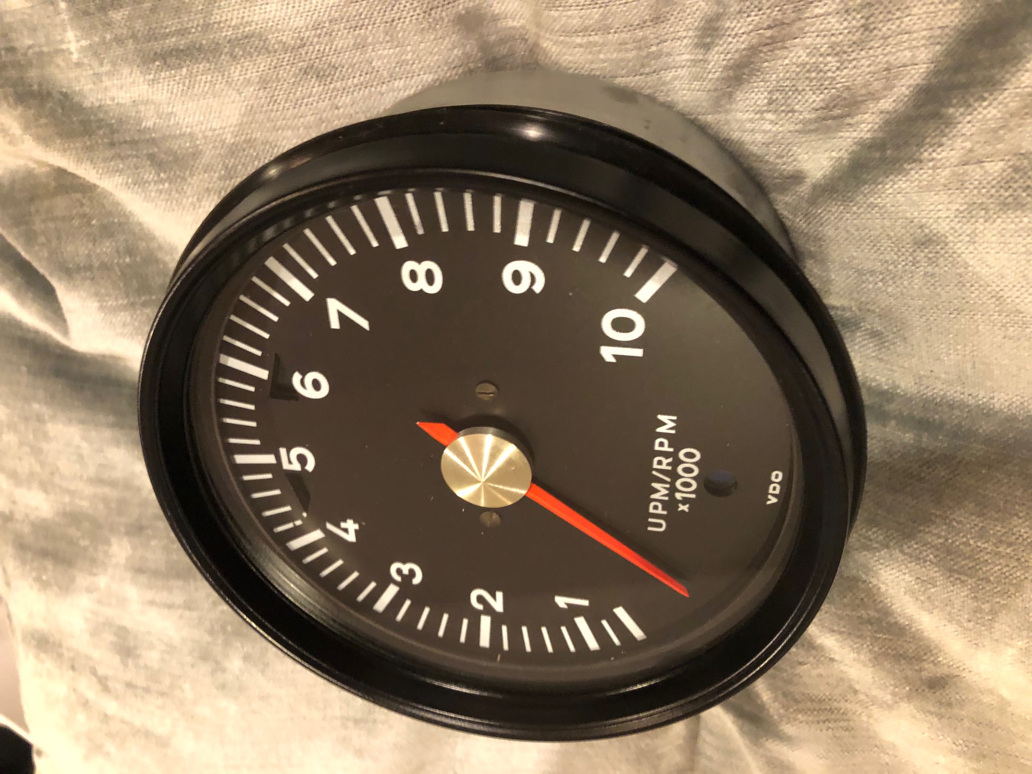

Retroracer

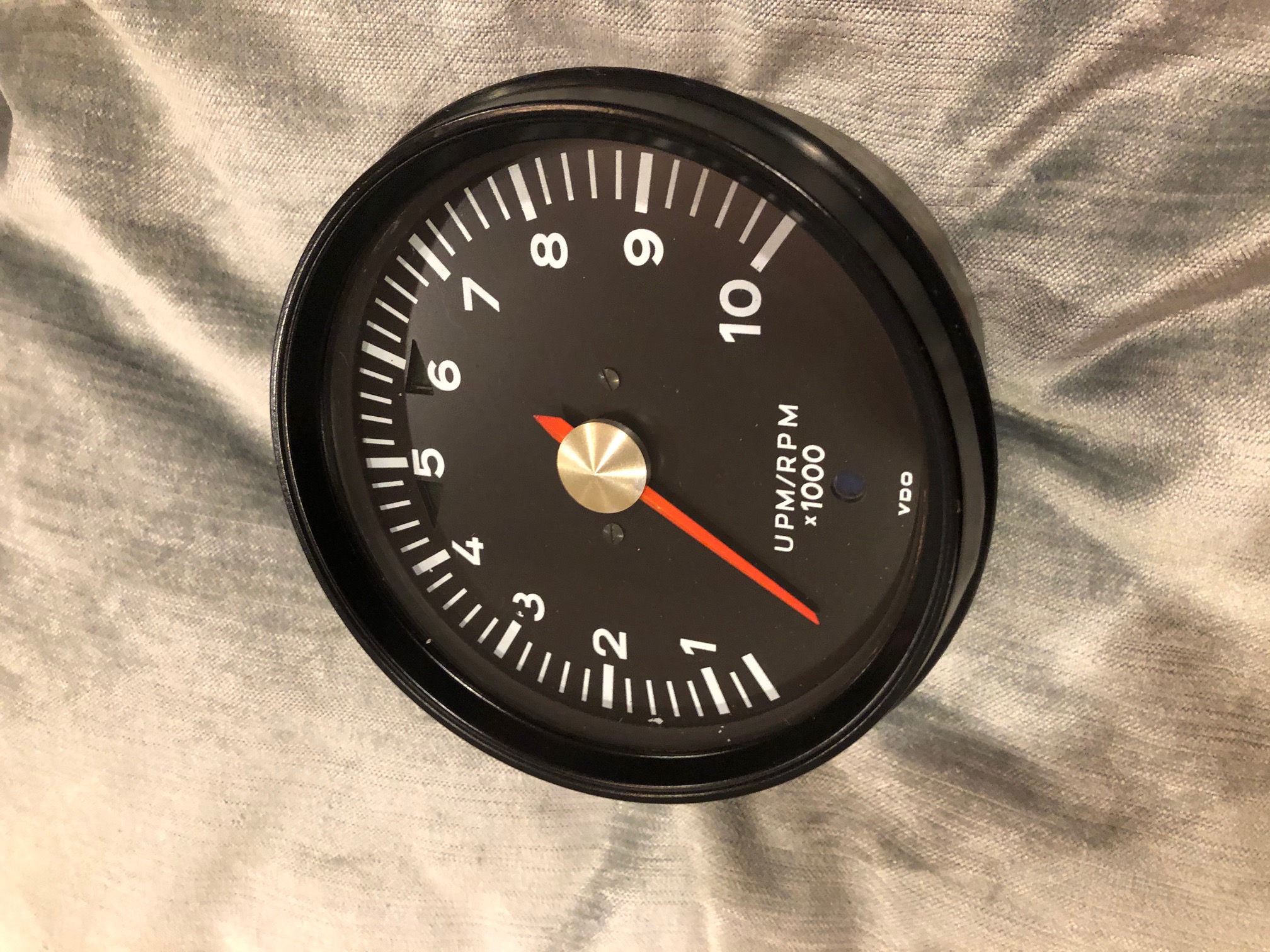

post Dec 19 2019, 09:50 PM
Posts: 669
Joined: 7-July 13
From: Bend OR
Member No.: 16,100
Now finished:
1969:
1972:

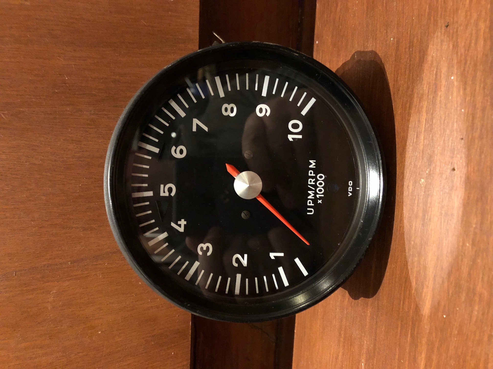

Retroracer
post Dec 19 2019, 09:52 PM
Posts: 669
Joined: 7-July 13
From: Bend OR
Member No.: 16,100
1973 (clocked):
- Tony

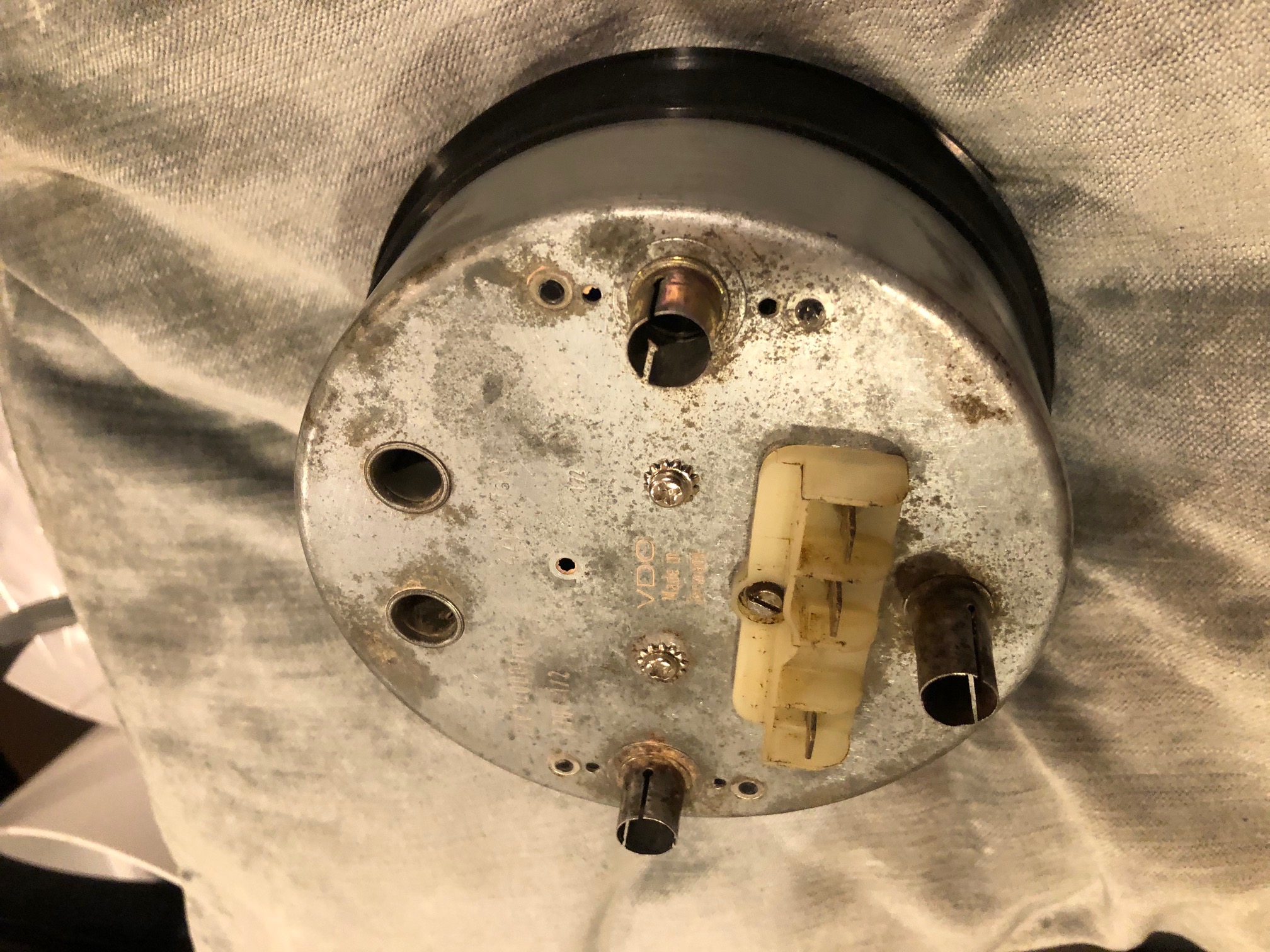

Retroracer
post Dec 21 2019, 08:19 PM
Posts: 669
Joined: 7-July 13
From: Bend OR
Member No.: 16,100
Batch sold!! These three all now have homes - thanks to all who responded.
