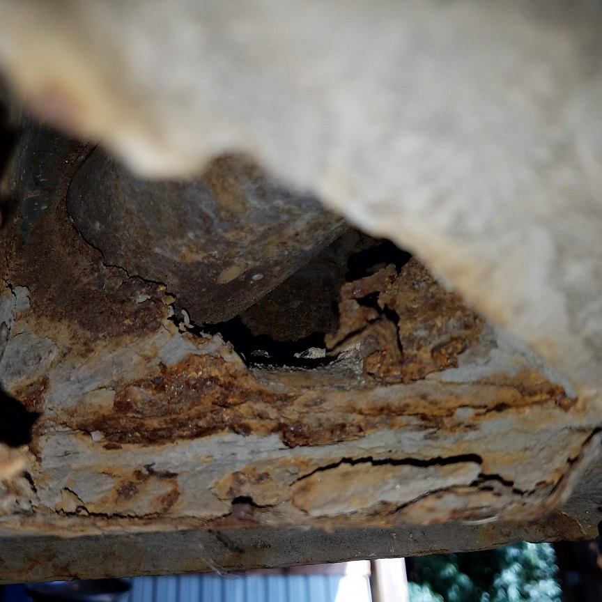

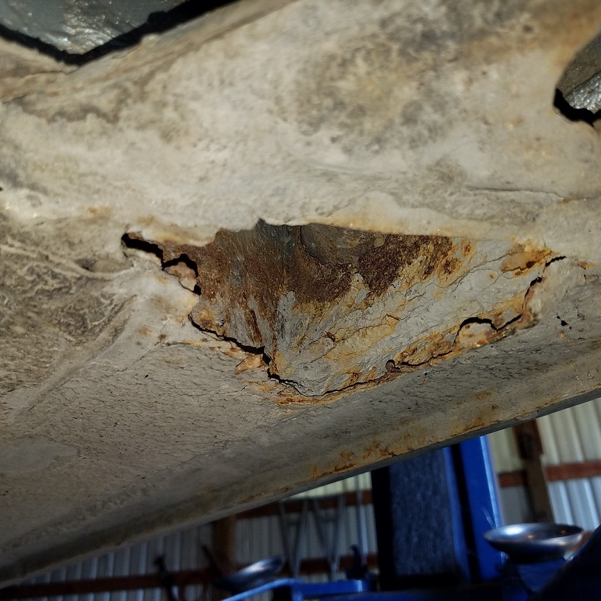

Last spring I got a call from a gentlemen that I will call DP. Please come by and look at my car.
My son and I rebuilt the engine in 2012 and never started it.
So Jack and I made a house call. Laying on the floor I saw the hole in the long. (IMG:style_emoticons/default/sad.gif)
Basically I told him car shouldn't be driven unless the rust is repaired.

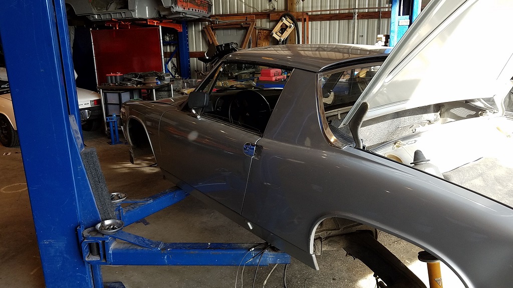

Picked up the car around the first of September.
Original scope of work :
1. Get engine up and running.
2. Get car shifting correctly.
3. Complete PMB brake restoration.
4. End of day, make car reliable

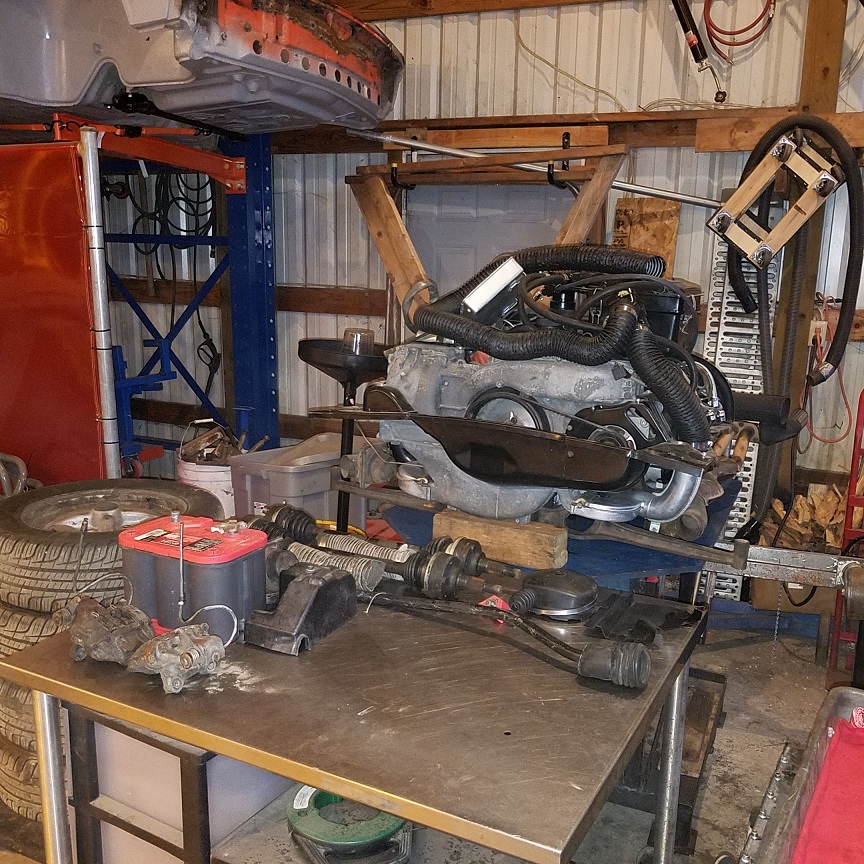

After getting the car on the lift I gave him my best guess on the hours needed to complete the job.
Drive train on the table

Next : the lie detectors for the seam sealer removal (IMG:style_emoticons/default/sad.gif)

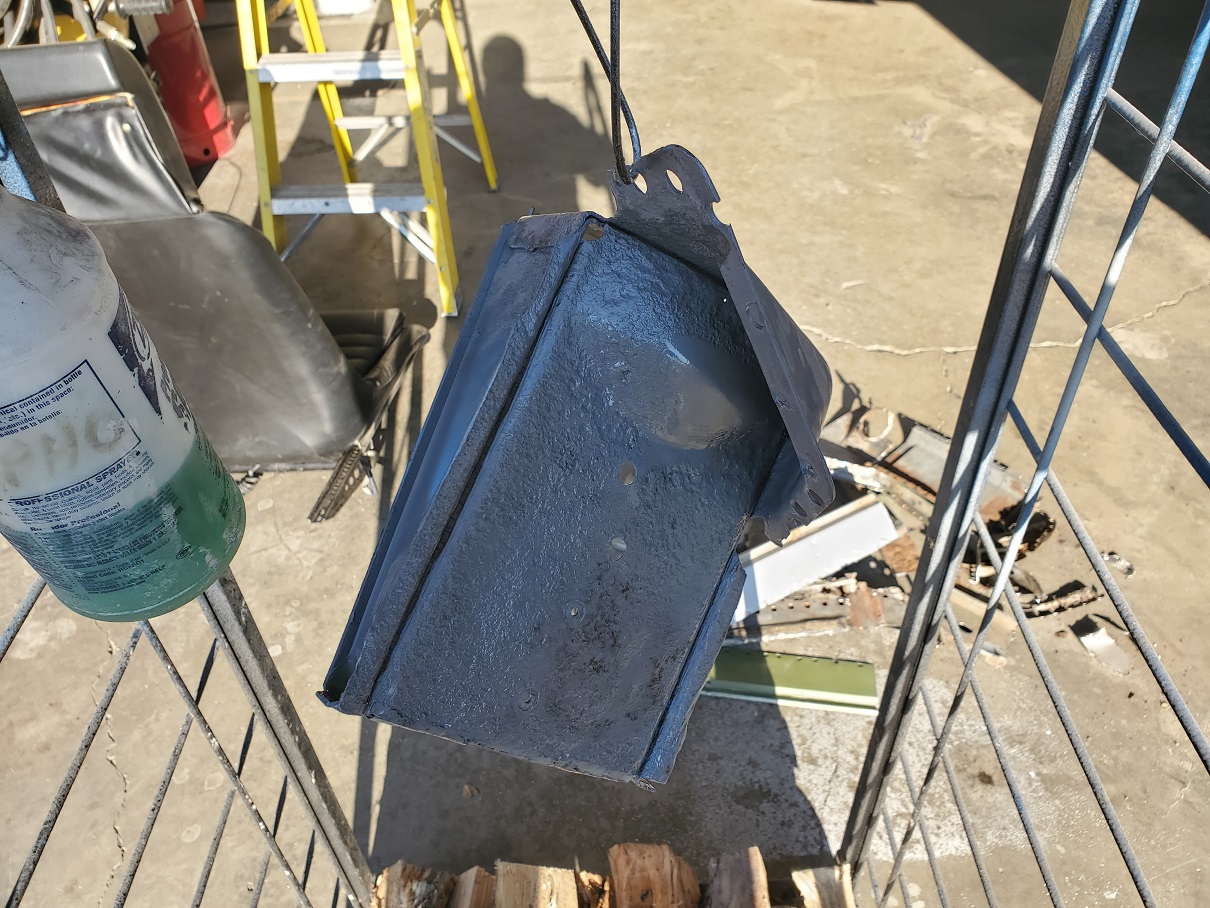

Trimming out the cancer in the engine bay.
After motor mount removed and treated with OSPHO. Ready for cold galvanizing.

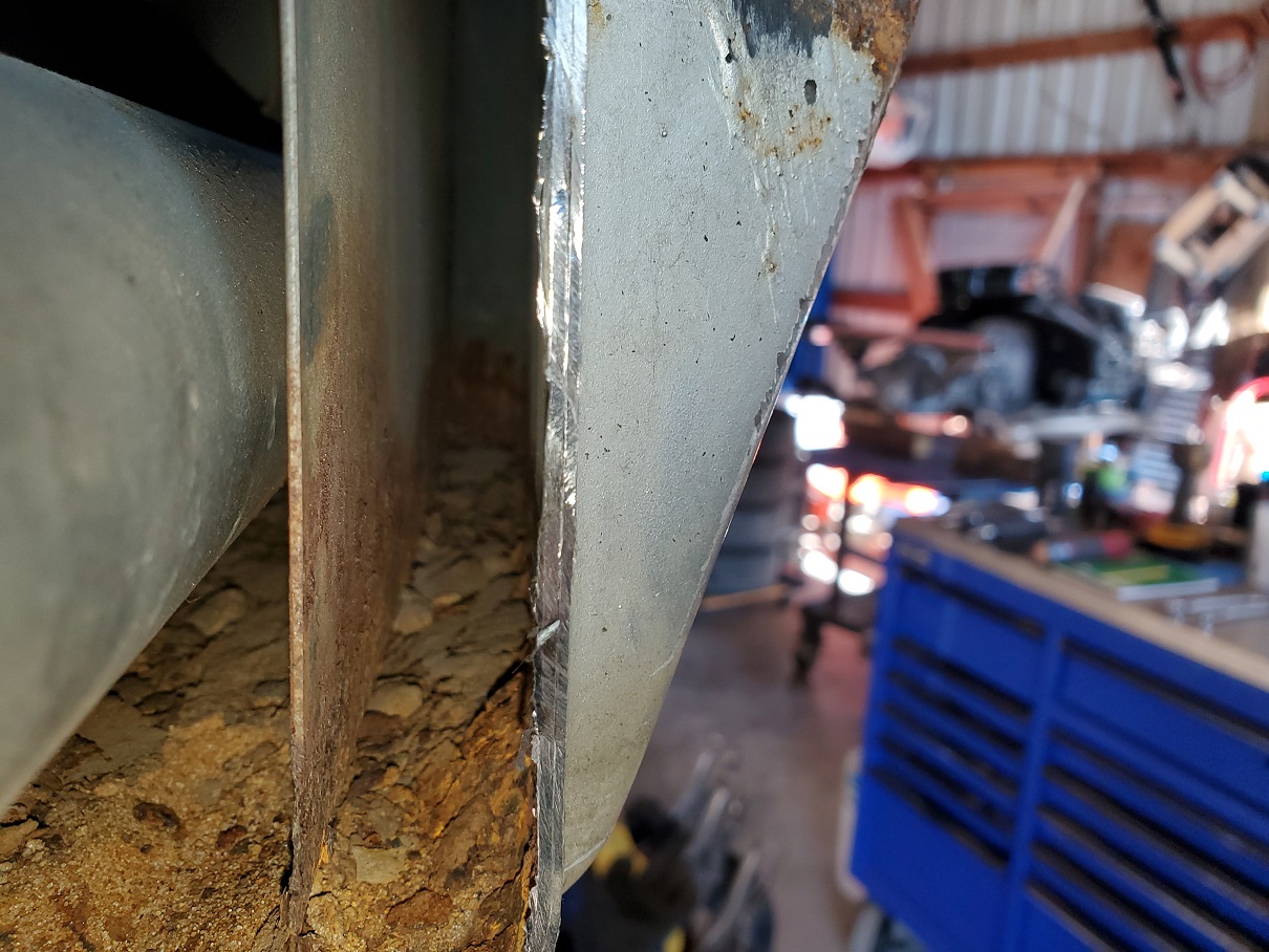

Now it was time to open up the long to see if I could do a partial repair/patch.
Not to be .................

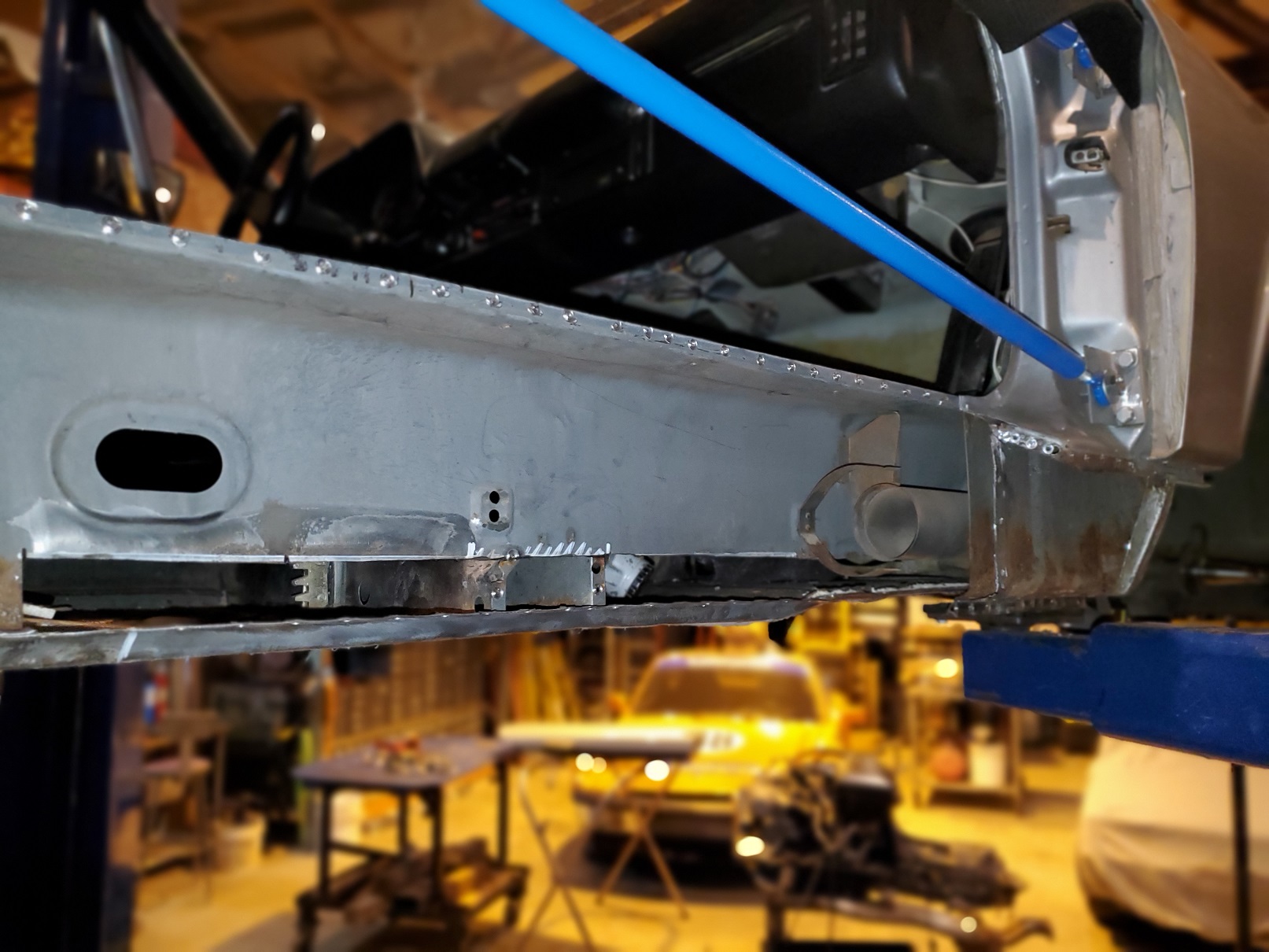

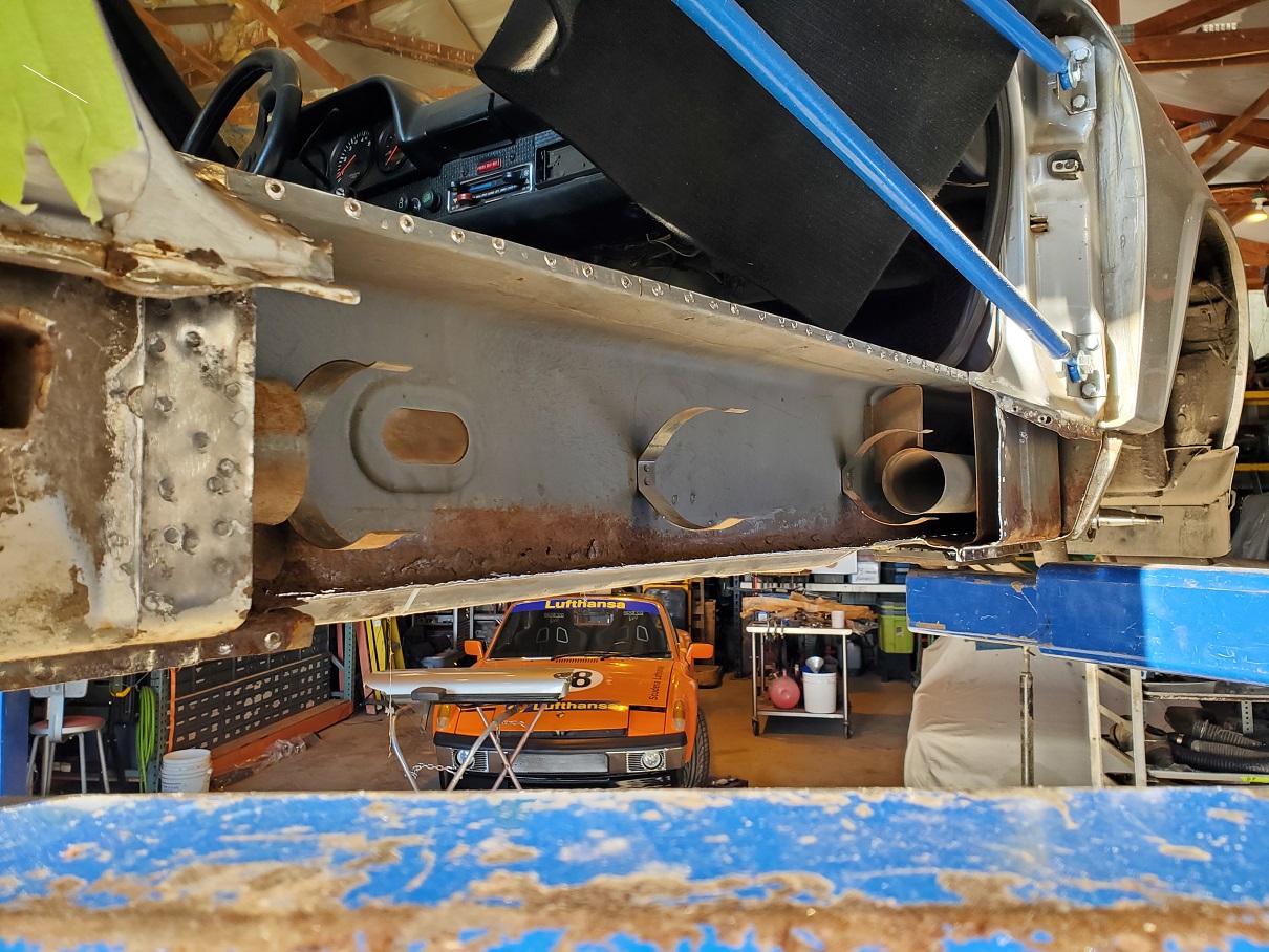

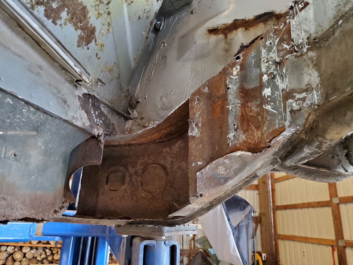

Now its time to get serious. Cutting open the long.
Then it was time to cut the cancer out of the long itself. (IMG:style_emoticons/default/mad.gif)

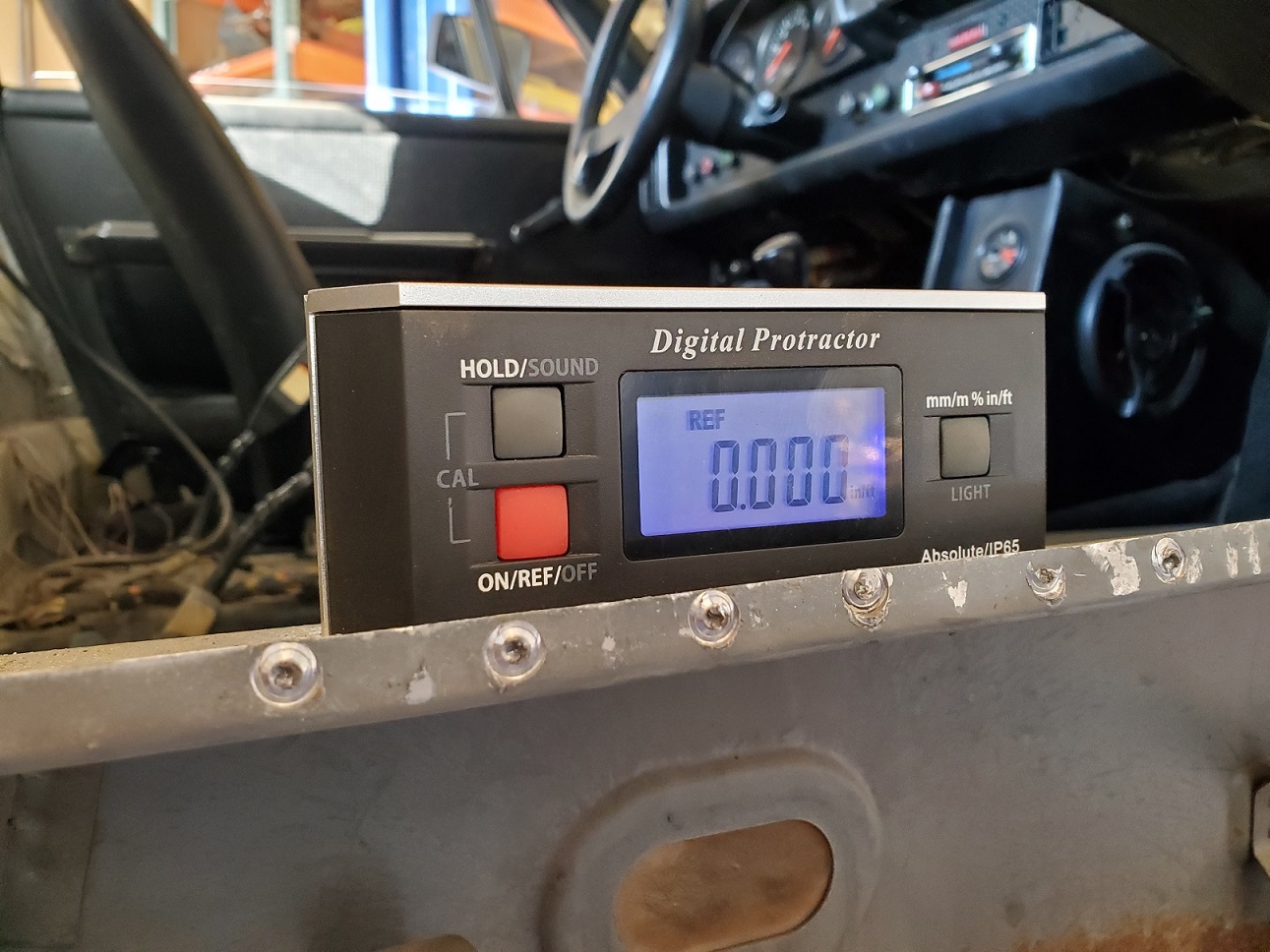

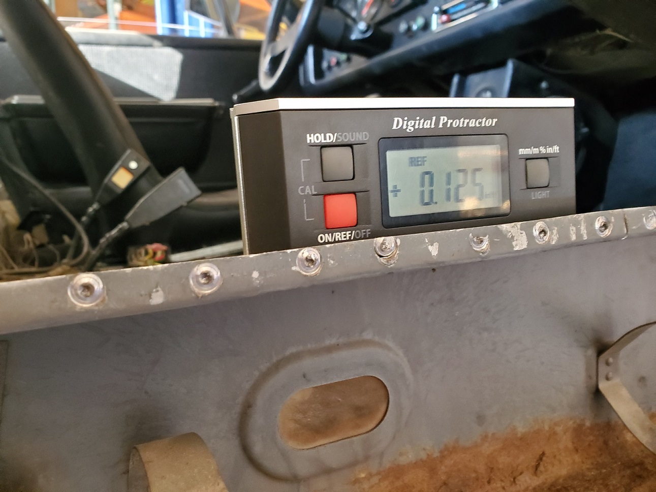

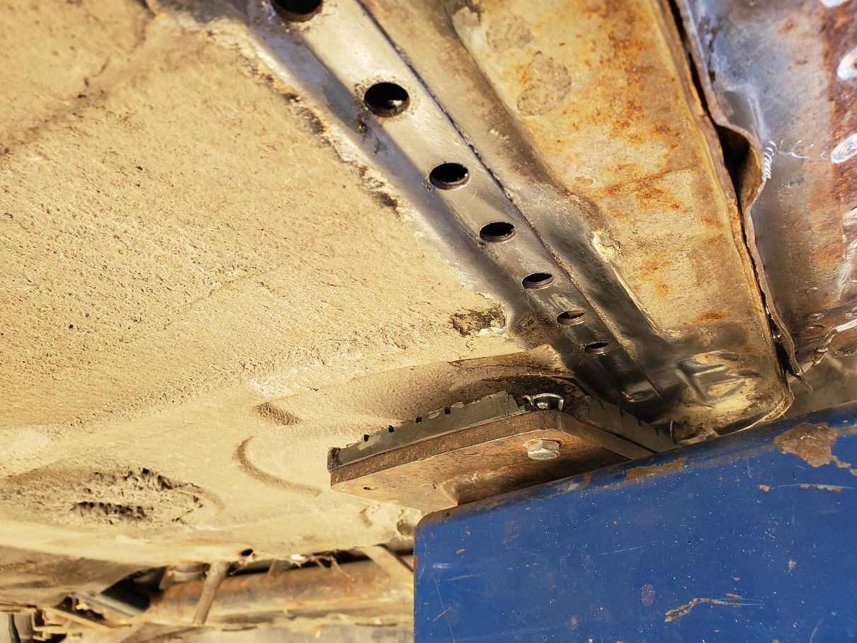

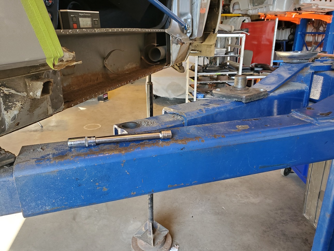

Using the 2 post lift I need to get the front arm out of the way.
Find my level.
With screw jack, raise the car enough to move the arm.
Took a .125" lift to move the arm.
Then dropped it back to zero.

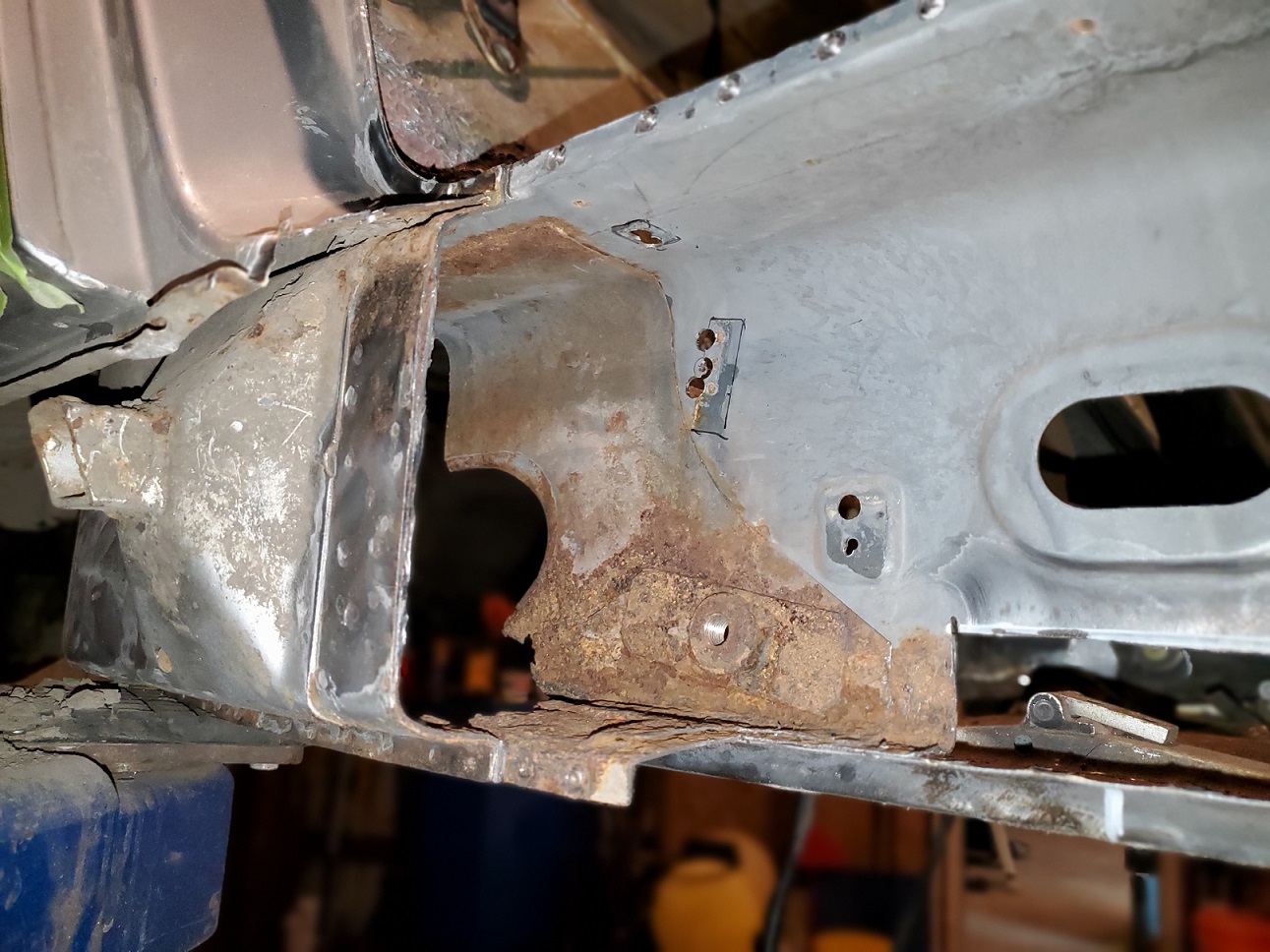

Here's a shot up into the base of the hinge post.
Lots of sand, lots of rust flakes. I may need to re create the bottom inch of the door
post behind new rocker door post support box.

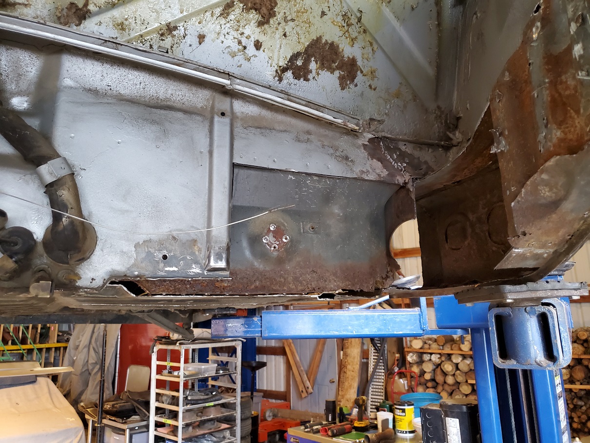

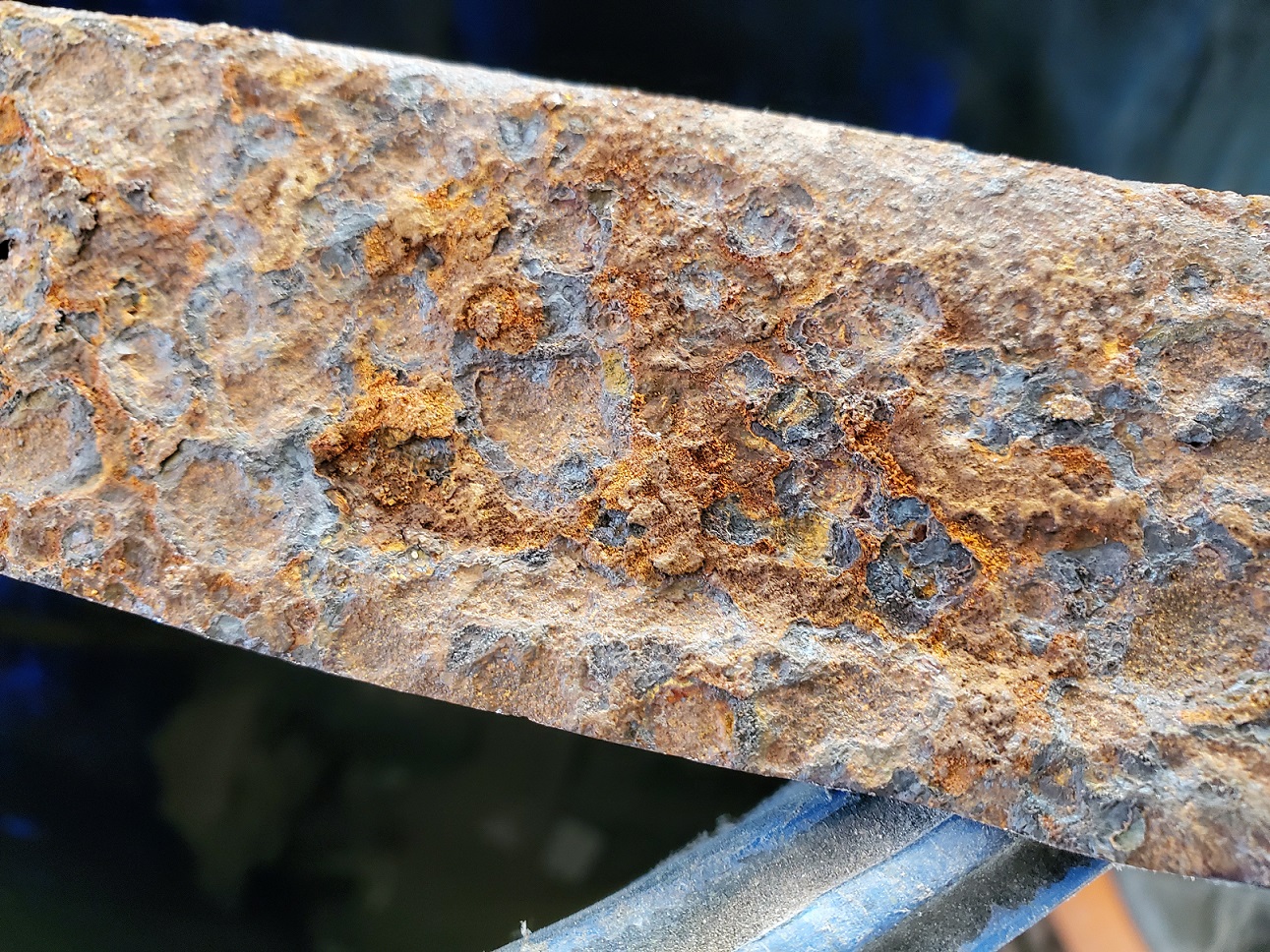

Swung for the fence on the floor pan and hit a home run. Absolutely no degradation on the floor pan under the long.
First a shot of the rusty long up to the edge of the floor pan.
A close up of what I removed.
Spot weld cutter drilling out the floor pan.

Long trimmed out.
Here's where we sit till the sheet metal arrives. Backbone won't be cut until I have 3 more screw jacks in my way. (IMG:style_emoticons/default/sad.gif)
