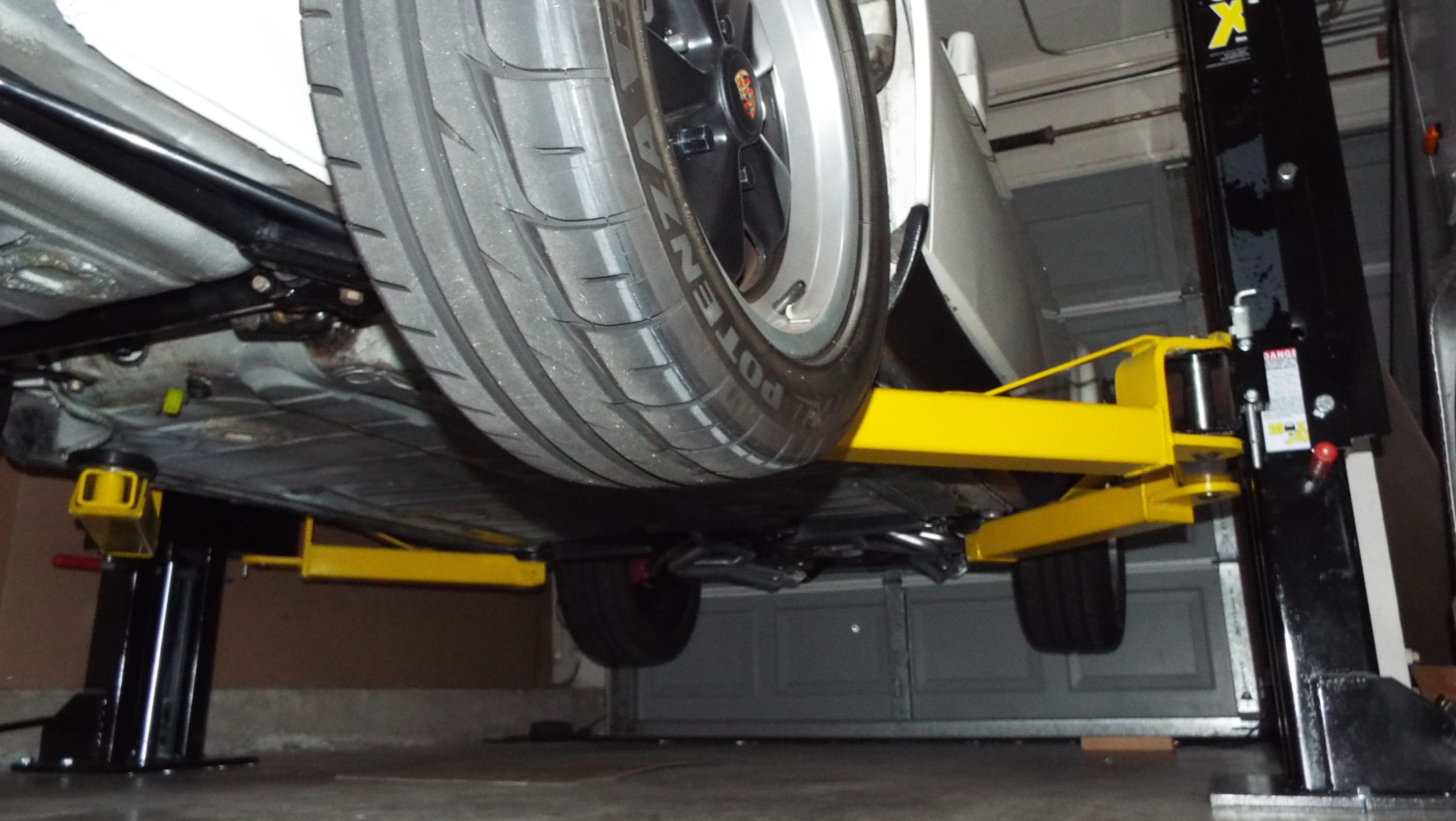

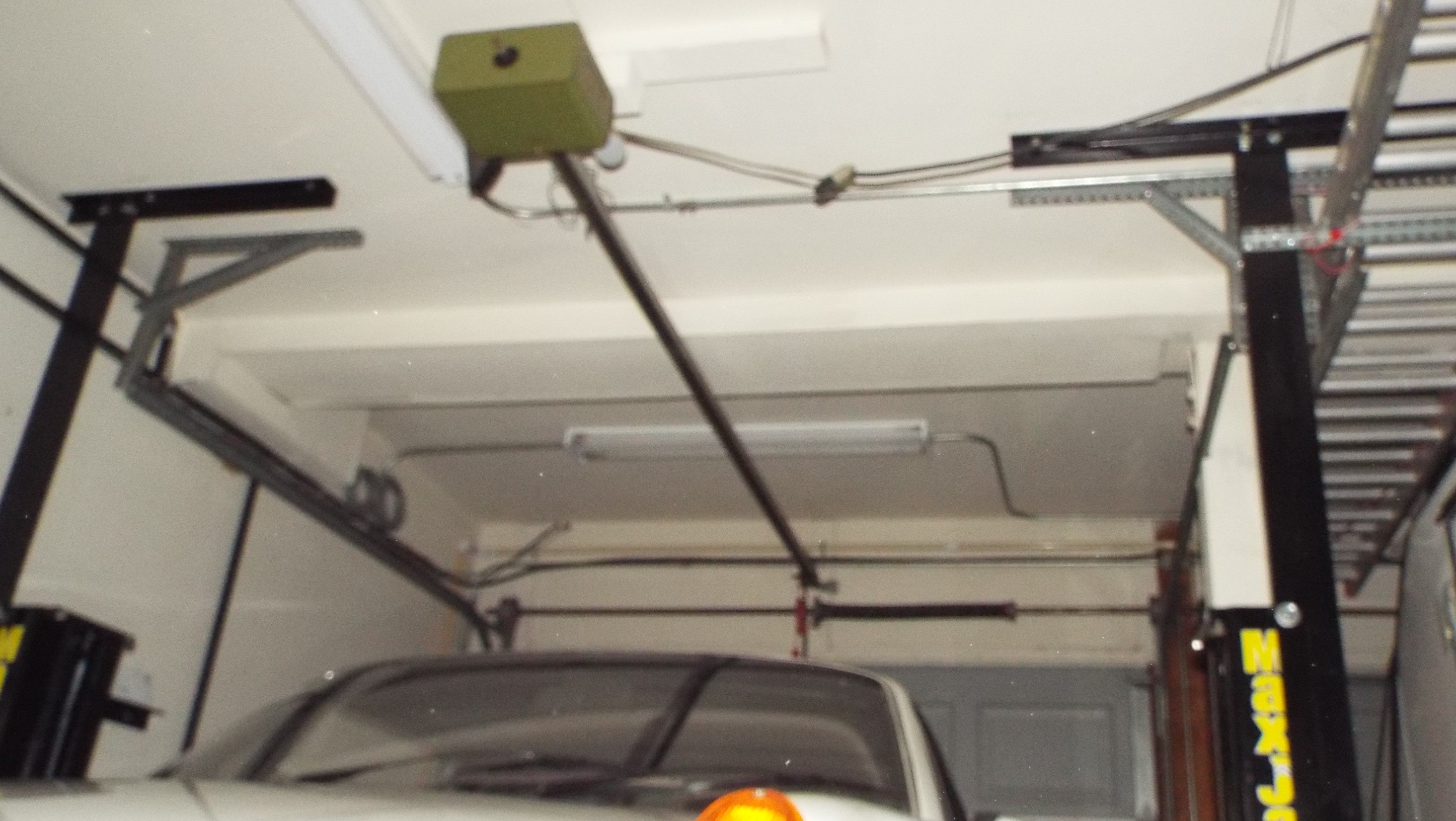

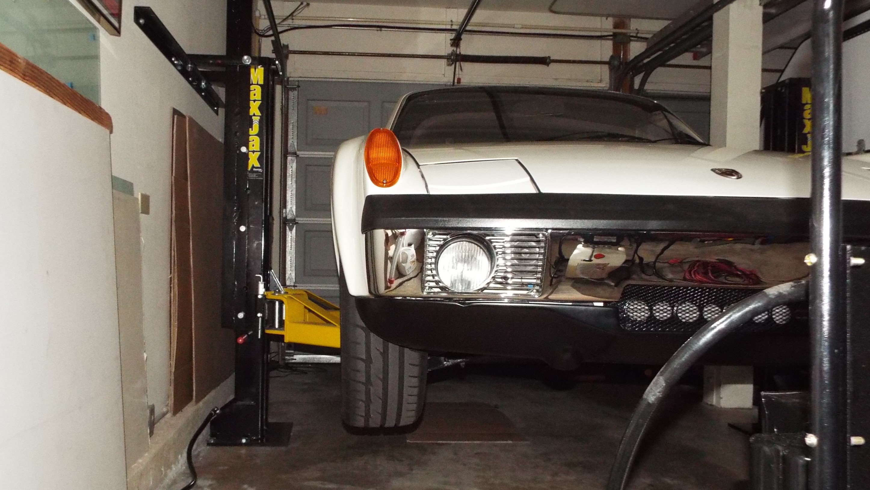

I did, I love it, and made my more permanent. I added structural steel to the ceiling as my 33 year old garage floor was not something I was tilling to trust with those 5 anchors.
Intended to be portable I came to learn that set up was crucial. Originally I thought I would install it on my side drive, just leaving the anchors in place, and putting the posts up when needed, but reading the instructions they want pretty much nats-ass alignment with all kinds of warnings. So I shelved it until I decided on the permanent install. I chose the single car side of my 3 car garage and although tight, it has worked out very very well. I can honestly say it has been a very useful addition and I use it all the time, because I can!
Up in the air
Because I wanted to mount it next to the stem wall, I also added wall attachment on that side as the cement pour for the slab was not done with the stem wall.
I created an "T" beam sorta out of 2" angle iron welded back to back and then tied those into the ceiling joist. Sorry about the blurry pic.
I also took the pump and tank and mounted it to the wall and ditched the cart.
With marks on the floor for car placement I can have my 914 up in the air in minutes.
Because the posts end up right where the door opens, I just back the car in a little further, get out and roll the car forward into position. Also, all these pics were from the install, I now back in all the time, which in my situation makes the getting in and out much easier. I have had my 911 on the lift as well. Love it!
Hope this helps for those considering.
