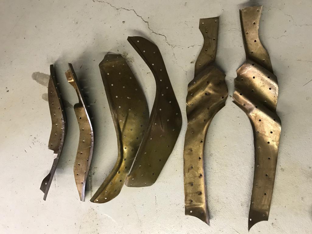

QUOTE(gms @ Nov 29 2019, 06:14 PM) *
That would be awesome if someone would make a proper GT stiffening kit. these rap around the bottom of the longitudinal up to the pinch weld and make the car stronger. the aftermarket kits mostly add weight.
The preformed type would be great!.....The current available flat ones are such a pain to form...
Definitely interested in this...

It's not any easy job...it's "easy" in the context that the parts fit like they should. It would be a job that any advanced DIY'er could do, if you're not then it would be best left to a pro.
Of course it has to be welded to a sound chassis, but the rust issue is why I suggested galvalume steel like RD uses. You could mask the inner holes and edges and use epoxy primer on the underside. Then it has to be plug welded, Epoxy primed, then seam sealed and painted. Since it's the greasy side the finish doesn't have to be perfectly smooth.

We already make the flat ones George, I could finish up the tooling for another 5-6k to form these. We sell plenty of the flat ones as those that use them are doing the work themselves, but I'm happy to work with you George if you already have these made up inexpensively.
I don't know how you propose to stamp these with tooling costs under 10k. To scan and design the tooling is 5k+ alone. Then there is steel costs of over 15k.
I never like to attach numbers to a project before I even look at CAD, but I'm 100% sure that this project is not doable for under 25K.
I don't want to discourage 914rubber or AA on teaming up, or doing these pieces alone, I just want the members here to have a realistic understanding of what tooling costs and the amount of work that goes into making quality parts in North America.

we have a "flat" set on order, awaiting delivery. I assume these can be formed reasonably easy, perhaps some heat introduced here and there.
