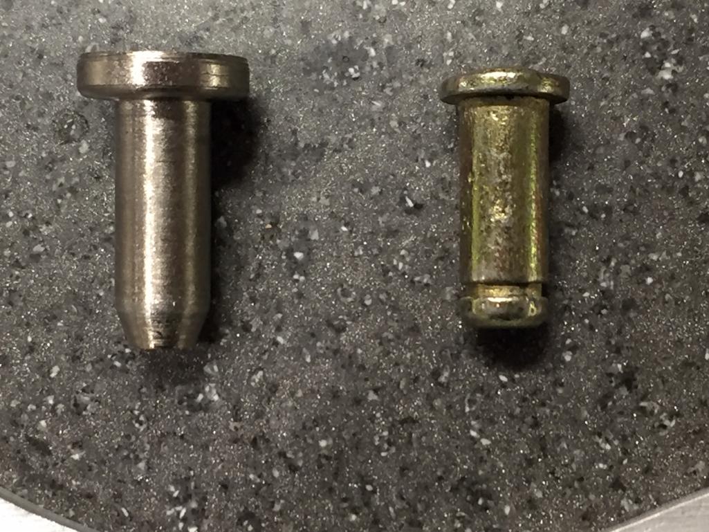

Help me understand. The door stay kit I’m using comes with a pin but it’s too big for the hole. I could make the hole bigger but there’s still no groove for a clip. Stock pin on right

Iirc the pins were made oversized because the monting holes on the bodies on some cars have ovaled due to wear. Also my memory says that the designer/pilot felt no clips were necessary unless the car was inverted. (IMG:style_emoticons/default/biggrin.gif)

We initially made them to the OEM size. The complaint was they "clicked" when the doors opened and closed. Problem was that not everyone had the problem. So we made them slightly larger to eliminate the problem. They can be easily filed down to get a get a custom fit for your car.
It's the only way to get a perfect fit.
By the way the steering rack rebuild service we do has a similar issue. The shafts often are darkened with oxidation and pitting. We actually make our bushings with a smaller diameter and hone each one for a perfect fit (after we polish the shaft).
The idea is that the tolerance will be back to if not tighter than the factory, but the process was difficult enough that we don't sell the bushings stand alone as the process of educating and with different levels of capabilities we would have a more difficult time selling just the parts.
The parallel is that there are varying levels of degradation in the mount holes. Fortunately this is a pretty simple application.
Gravity makes the clip redundant, they are difficult enough to remove when you are trying.

I appreciate that 914rubber is making the parts. It would be good to know they differ from stock and the reason behind it, what mods or fitting might be needed.
For example, if I just purchased the aluminum lever but not the kit, the hole would be too big for a stock pin and be useless without the larger aftermarket pin.

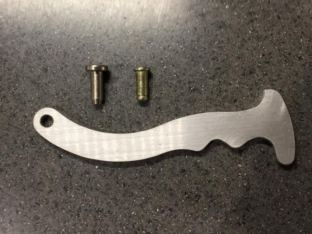

So if I have to file the pin smaller to fit the hole on the car....then the pin will be too loose in the new aluminum lever.
I fail to see how this helps and is my exact situation.
It would be better if the lever had no holes so you could drill the exact size you need.
I'm so confused on this part. And I've spent some time for sure trying to get it to fit.
I'm down to trying to ream the hole out in the chassis receiver just slightly so the oversize pin fits.
And then drill my own hole in the pin to accept a cotter pin just like the factory did.
Not sure I'll go that route...
Mark of 914Rubber.
The only problem with this is that if you file the pins a bit smaller, then they are too small for your lever arms. You'll get clicking there just as well. Pins might fit tight in the chassis receivers, but will will loose in your arms.

Forgot we did change the arms. So perhaps This next run we just go back to the stock configuration, and make a mount for body?

I do really appreciate the input. We made changes to our original exactly like stock design based on feedback. The information I'm getting is that we probably should not have made the changes.
We are actually looking at making an exact replica with the serrations, just like factory.
we are a few months away (like after summer), but yes sometimes we make changes that at the time seem to be an improvement.
The good news is that we do make the majority of the parts we sell, and can make the changes needed.
