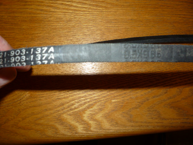

Make sure you are using the correct size belt. 9.5 x 965 mm or 021.903.137A
9.5 mm are you sure ? I thought it was 10 x 965 ?,2 of my engines have that size belt...not saying you are wrong but TBH have never checked.
914Sixer
post Dec 18 2019, 06:59 AM
Posts: 9,604
Joined: 17-January 05
From: San Angelo Texas
Member No.: 3,457
Belt
