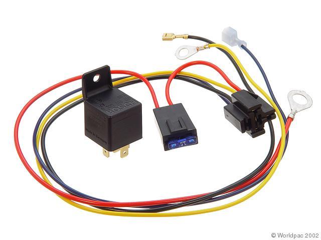

The "classic" hot start problem.
I use the "hated" aux relay quick and dirty fix.
this provides more voltage to turn the starter when it is internally expanded due to heat.
This works until the starter finally quits...
KT

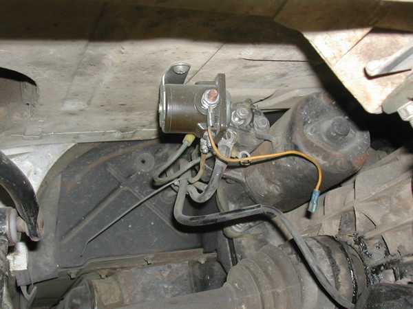

r bontempi and a guy you know got me a bosch starter when mine crapped out on the way to wcc04. it's performed flawlessly. $89. the ford relay method (pictured) isn't worth the hassle.

Why is the relay hated? I have one on my 911 and it's only been a problem solver. The hot start thing didn't happen often enough but it's nice to have the relay in there for those days it did...

so she buys a relay. if she isn't handy with a drill and tools, and has to pay shop rates to have it installed, there's no upside. with the new starter, i think the 2 wire nuts, 1 spade terminal, and 2 nuts for the starter are faster to install than the relay. to be more specific, my starter WITH a ford relay crapped out for good on the way to california in 04'. (IMG:http://www.914world.com/bbs2/html/emoticons/smile.gif)

Before spending money, I'd take the cables off the battery terminals and clean them with a wire brush. Then I'd do the same for the big ground wire on the transaxle. And make sure the connection on the starter solenoid is clean and tight. It could be just an oxidized dirty connection is causing a little more voltage drop, and when the starter solenoid gets hot (higher resistance) there's not enough voltage to engage it. I've had a brand-new IMI gear drive starter do this when hot. Even with a new ignition switch, there's only about 9V at the solenoid when you start it. The relay boosts this up to close to the battery voltage. It may still be a bad starter but I'm just saying check the simple stuff first, might save you some cash.
For me, because it's usually a crutch around another problem. It will "solve" some problems, but IMHO it's a band aid - and cleaning up the connections instead (like Guy said) will fix the problem correctly.
When I had "hot-start" problems, I REMOVED the "hot start relay" that a PO installed, put all the connections back the way Porsche intended them, cleaned them up good, and everything has been great since.
Electrical connections need to be clean. The more current they need, the cleaner they need to be. A hot-start relay will help a dirty circuit work, but I would rather clean it up than help it out with an add-on.
