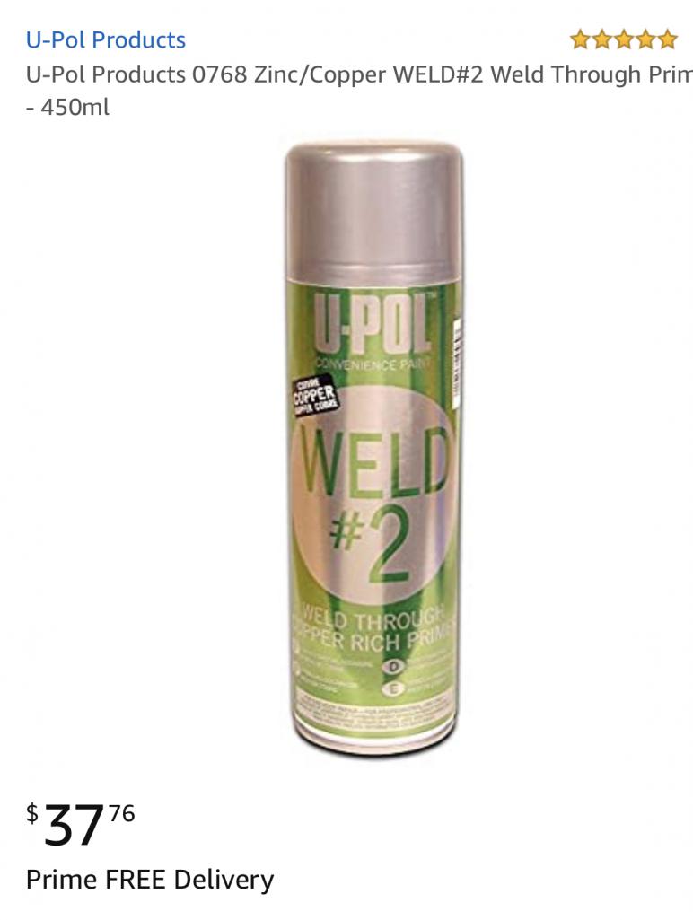

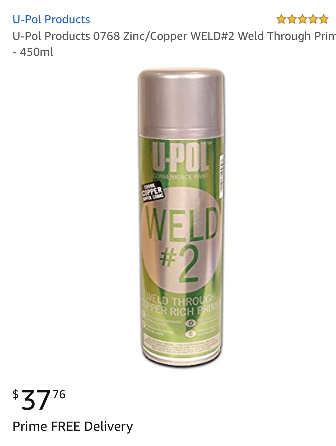

UPol high zinc does not burn back much it at all in my experience, good product.Attached Image

I use the same U-Pol weld thru primer.
But it only goes under the lapped or overlaid metal. Over-spray wiped off with lacquer thinner.
I scratch out the to be welded rosette hole with a blunt/cut off drill bit.

Regarding weld thru, I started out using zinc and using a broken/flat drill bit to clean it from the plug weld location, but, despite doing my best to remove it from the plug area, I didn't like how it welded at all. I switched to UPol copper and I don't even remove it from the plug weld location. It welds thru great IMHO. I only apply it to the projected 'heat affected zone' of the weld area. Apparently the theory with zinc weld thru is that it's proximity to the weld (where it was burned away during welding) is enough to inhibit rust even in the burned area. I'm hoping the copper works the same way.
