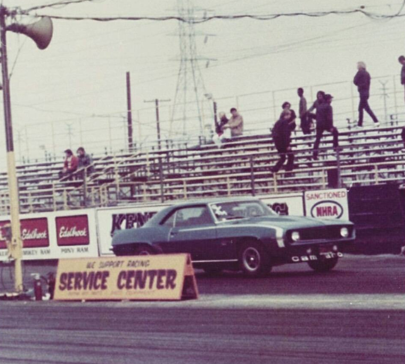

Before the 914 was available, this was the scene in 1969;
SS350 Camaro, a few bolt-ons and 13.20 @ 103 mph .
High 12 second bracket was just a gear change to 4:88 ratio (IMG:style_emoticons/default/biggrin.gif)
